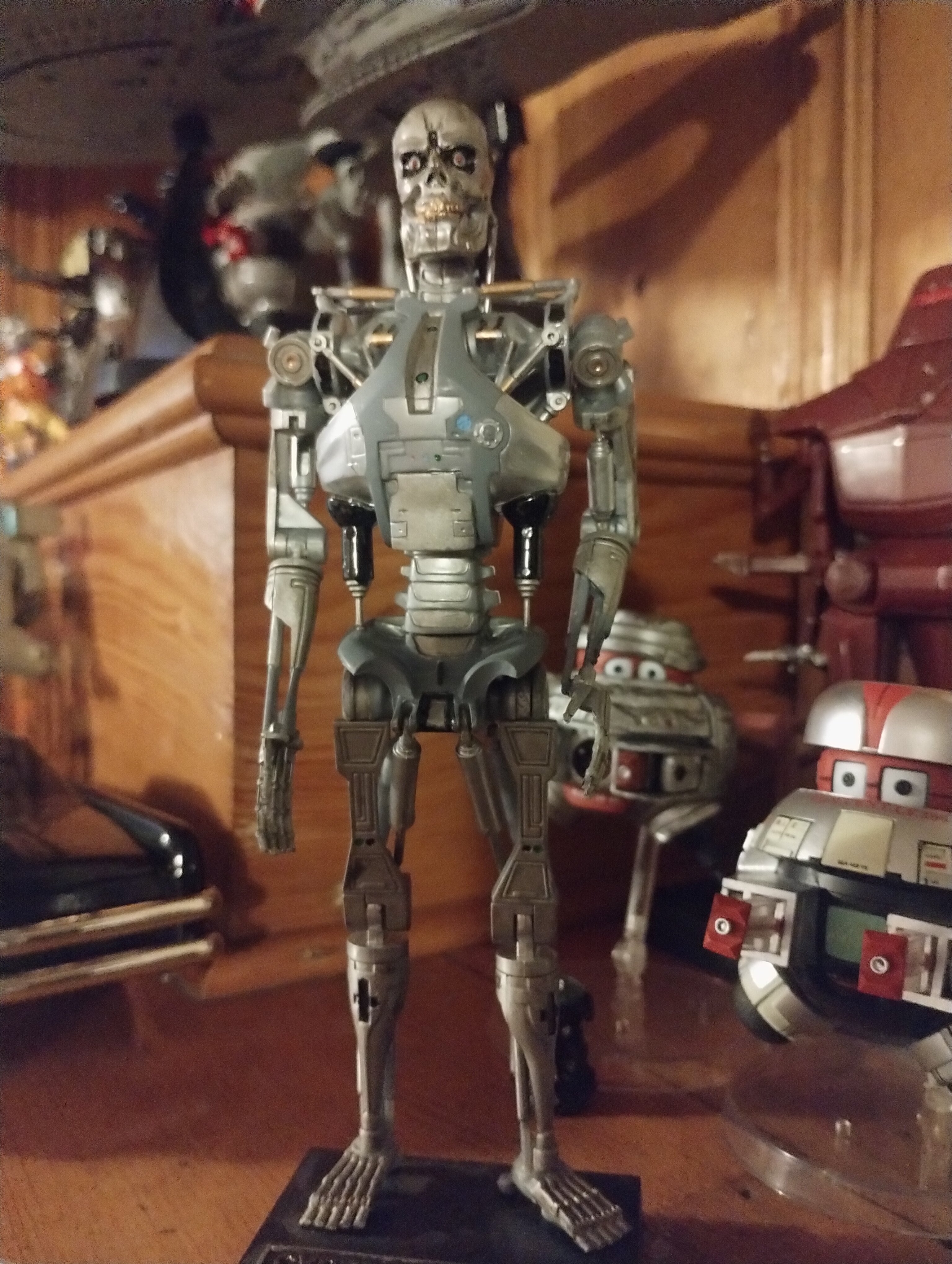

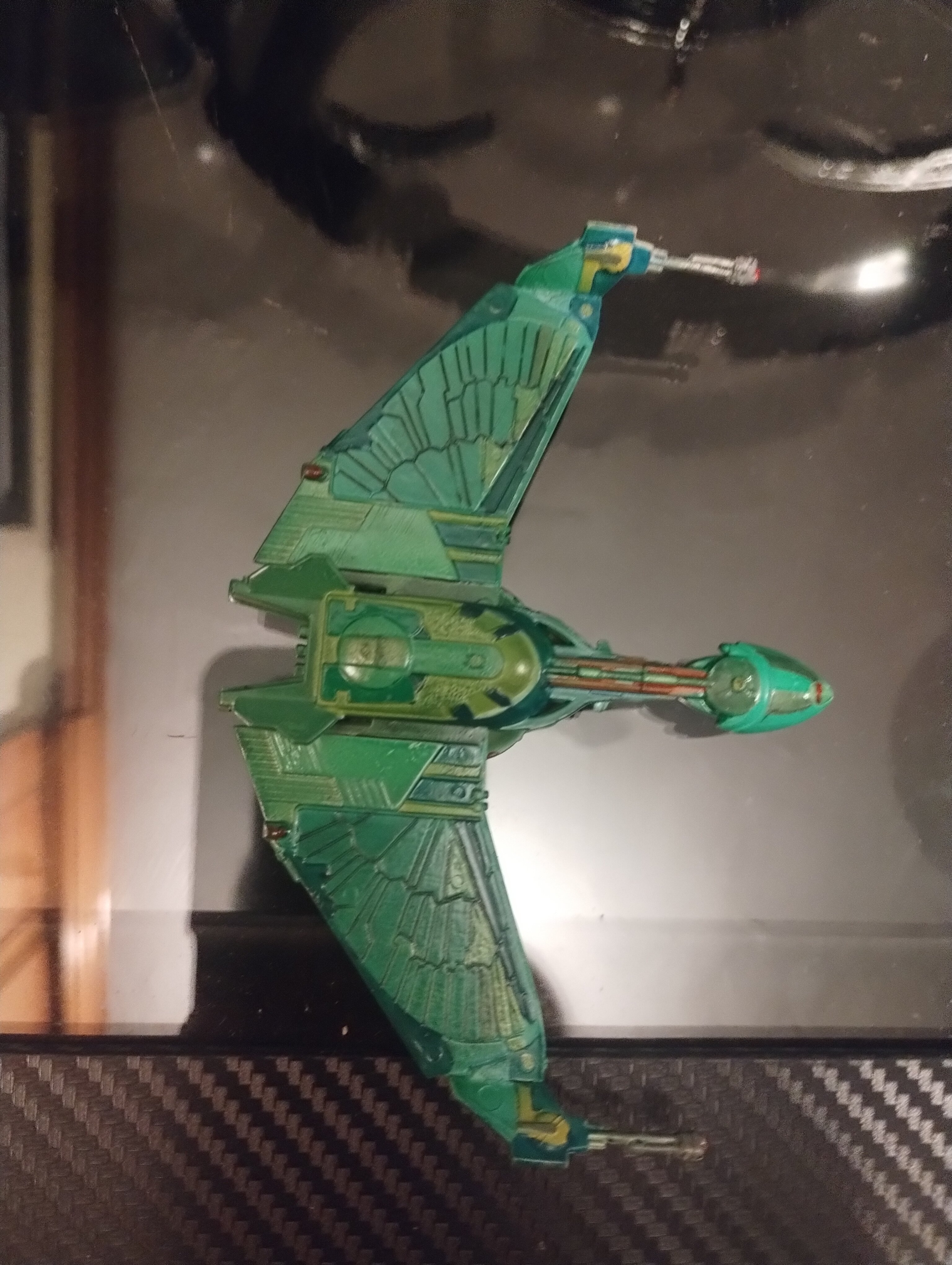

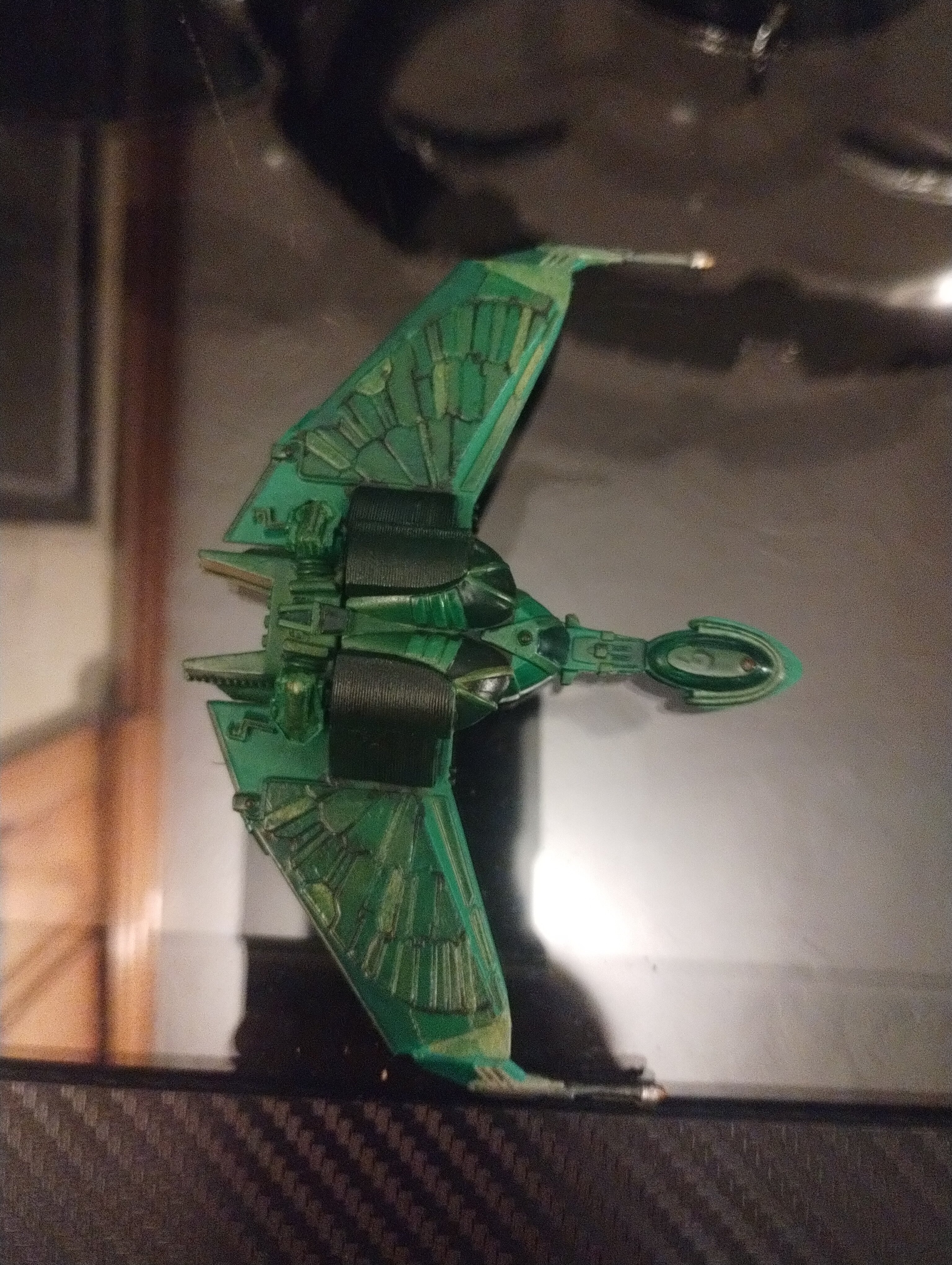

10 minutes ago, Big s said:
I get the feeling someone got their first airbrush and decided to try out different paints and techniques and these were the test items
That's what I would say if I saw post too. But Everything this guy had was pretty colorful to say the least..lol a didn't take a lot due to it..some I don't think I can fix especially being 30 40 year old kits.. enamel and glue
Looks like someone's form of 'free-style' modelling. Like they were just having fun with it. Or, daddy had the airbrush and kiddo was directing his/her 'vision.'
Are any of the kits redouble? A little soak in break cleaner or a night in the freezer to loosen up the joins?
If so, listen to @pengbuzz he is a master reclaimer!
1 hour ago, pengbuzz said:
Let me know if you want to get rid of any of them, or if you need advice on how to save them. This kind of thing is my specialty.
Sdf1😆
I don't want save it.

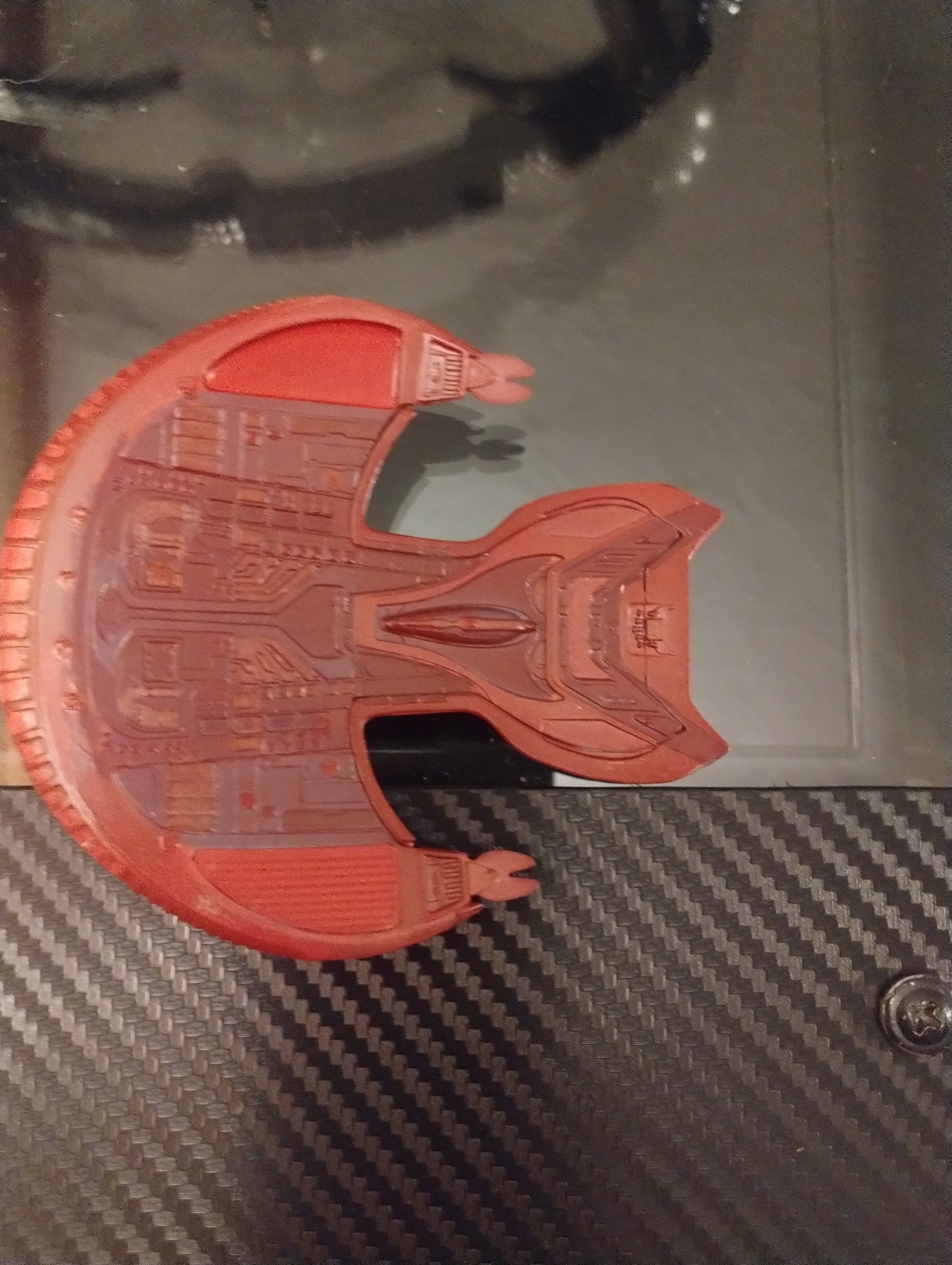

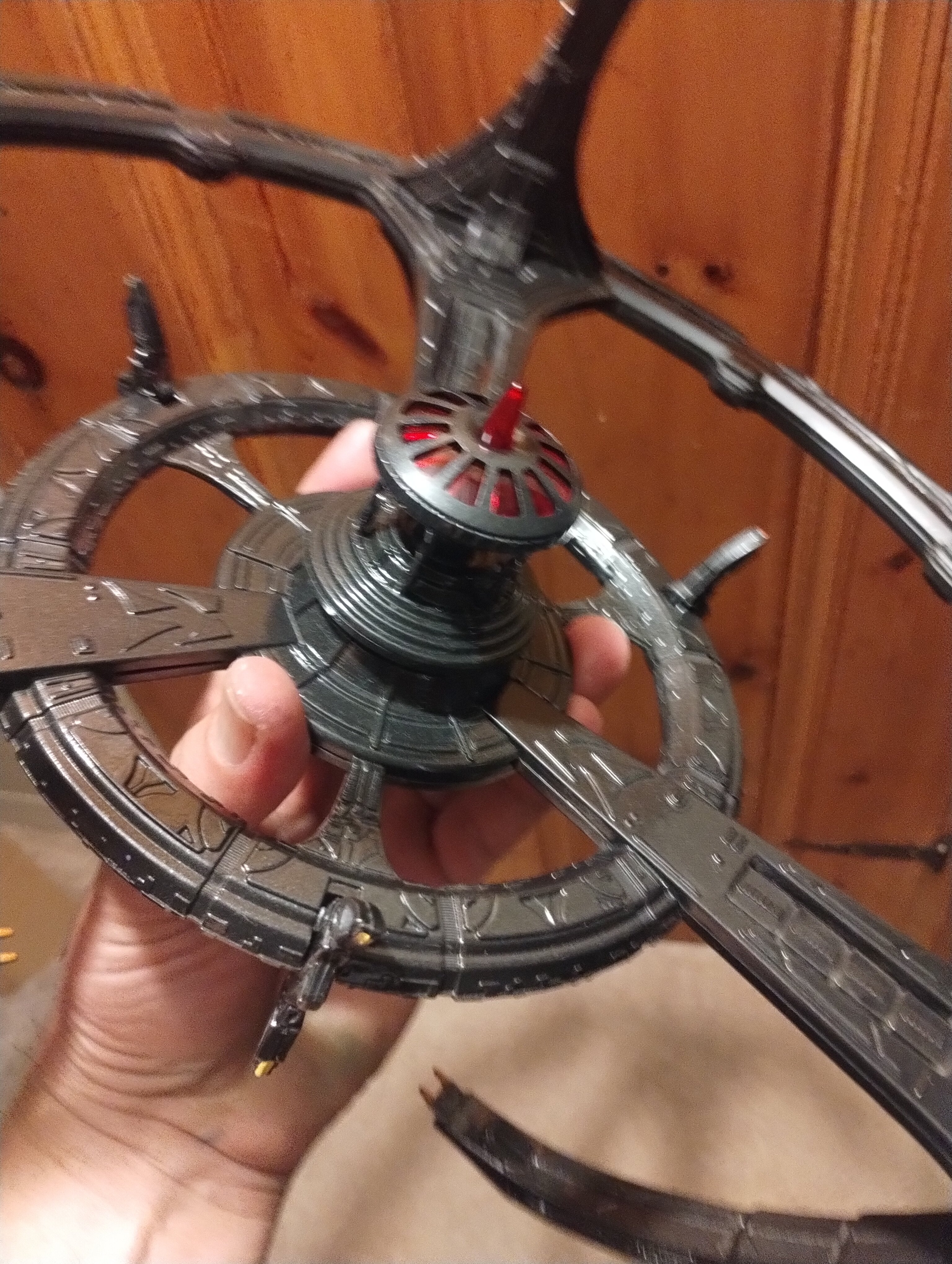

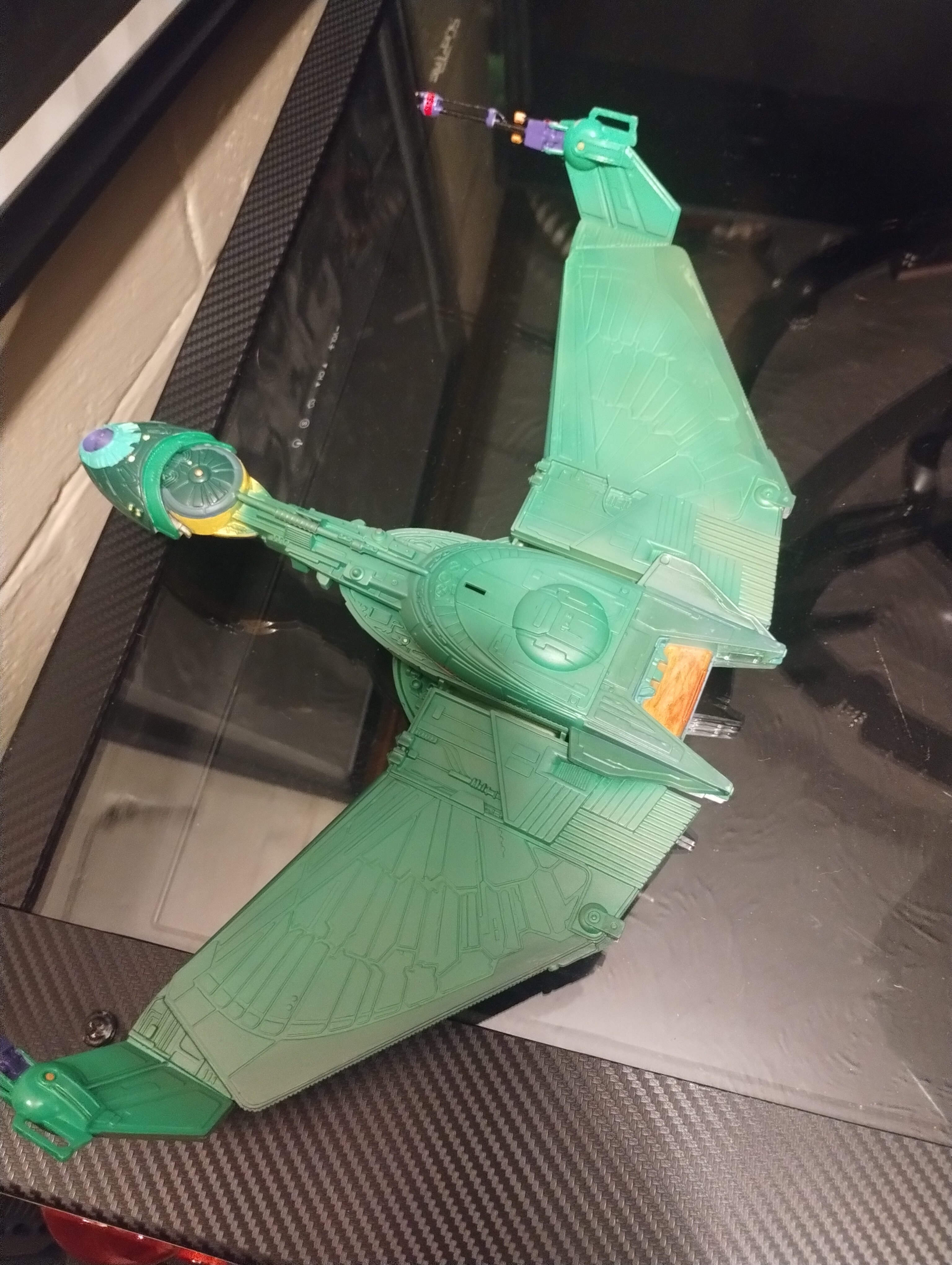

Well I started reclaiming today.
Boy do I have a lot more to do.
I'll definitely let you know what keep or not pengbuzz.
I picked the stuff I thought I could salvage the best. And if it hit my fancy. But room decides everything lol.
I have as much reassembly as paint and fixing to do .  Alot broke on transport..alot was on the verge at his house..😆
At least I'll know when I'm done with them they will be fairly sturdy. He went so light on glue some part I don't know if he used any at all. DS9 collapsed in my hands last night. Million pieces everywhere...at least I got it back together with only 1 missing pieces that I could prob just cut out of some plastic. I cried a little when it hit the floor.

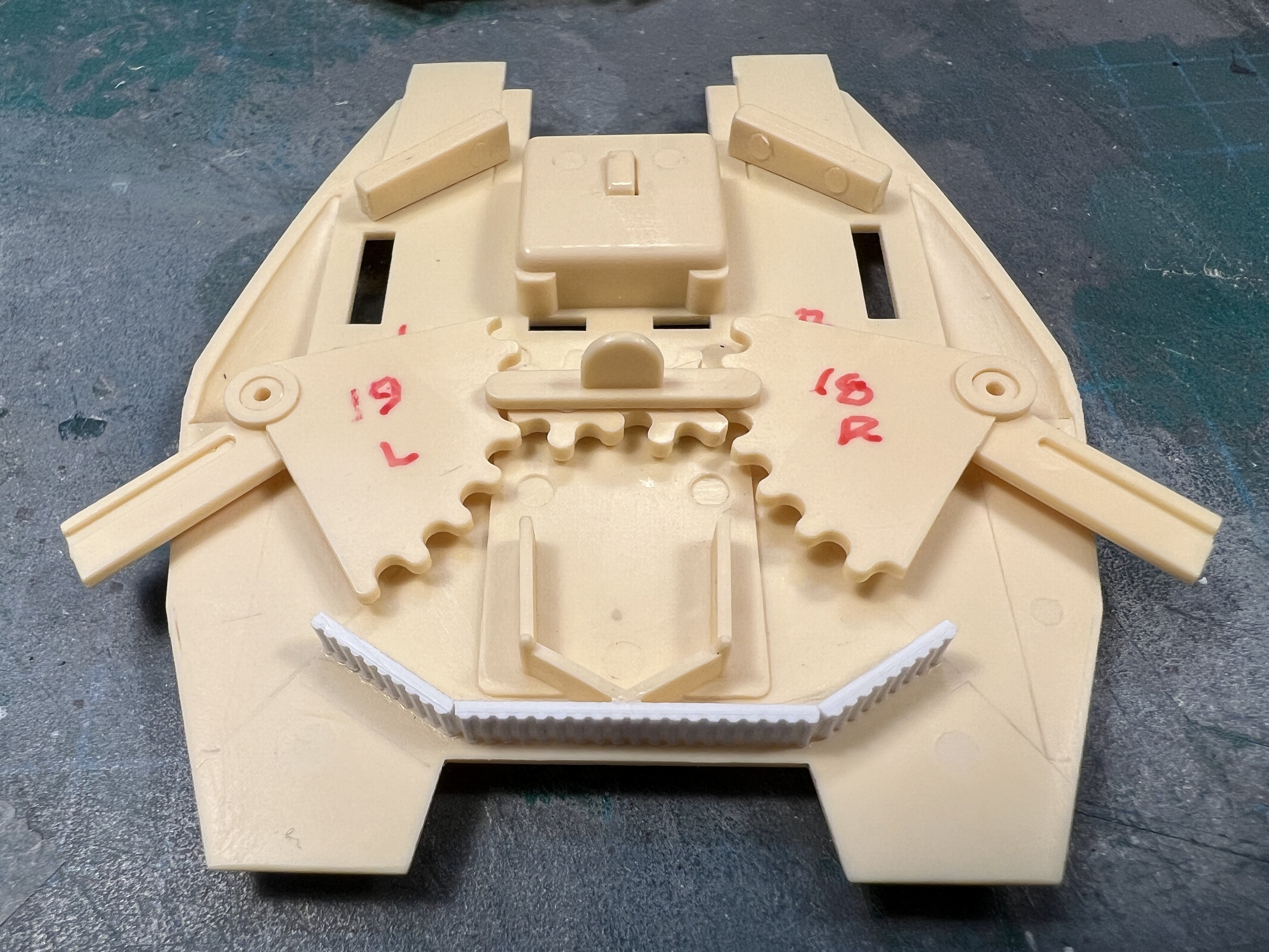

I think I've become a Regult Factory Satellite 😁:
First up, painting the rocket thrusters on all 3 kits—of course the typhoon has decided to make a u-turn, and is sending humid rainy weather my way again 😫:

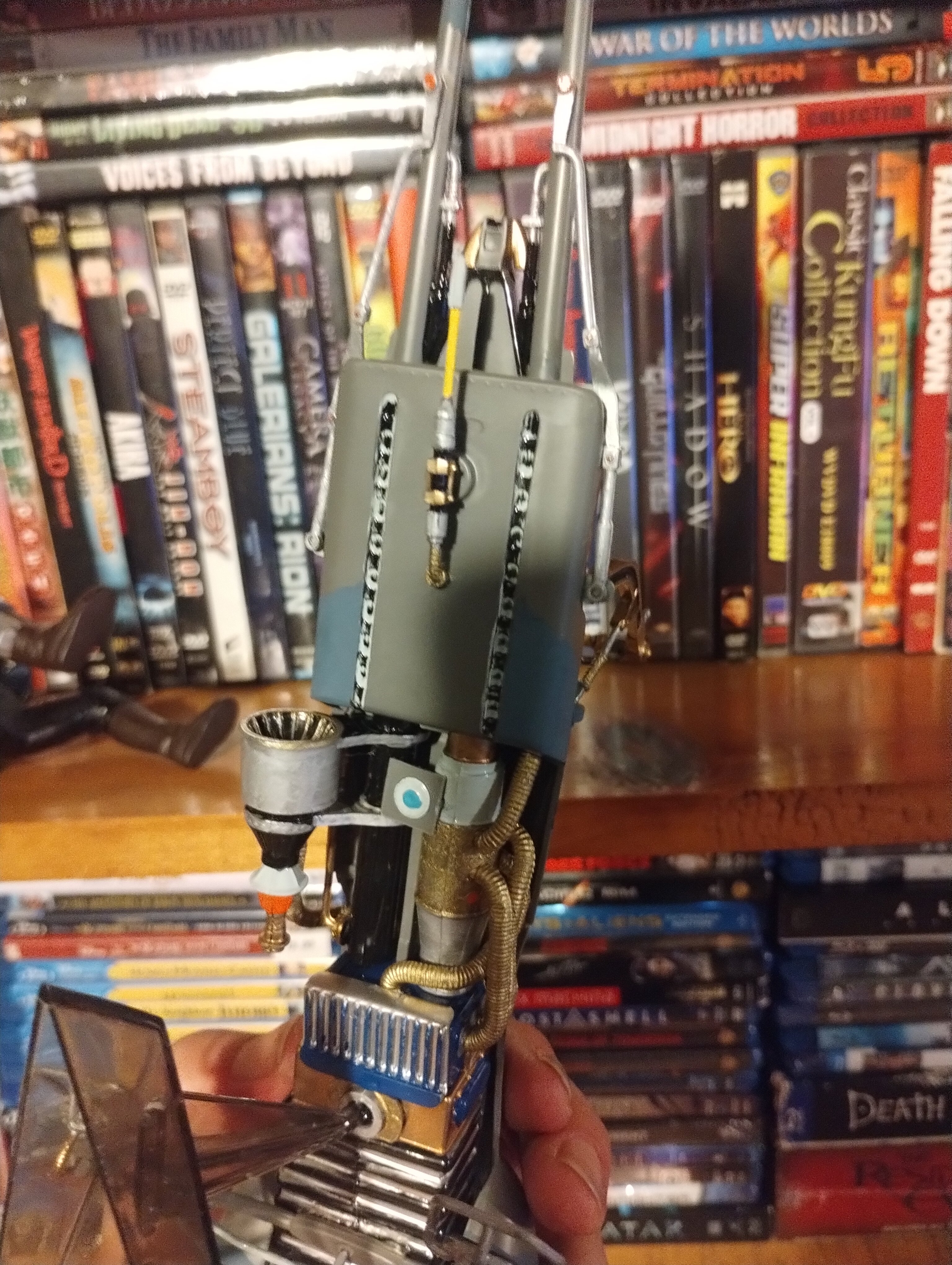

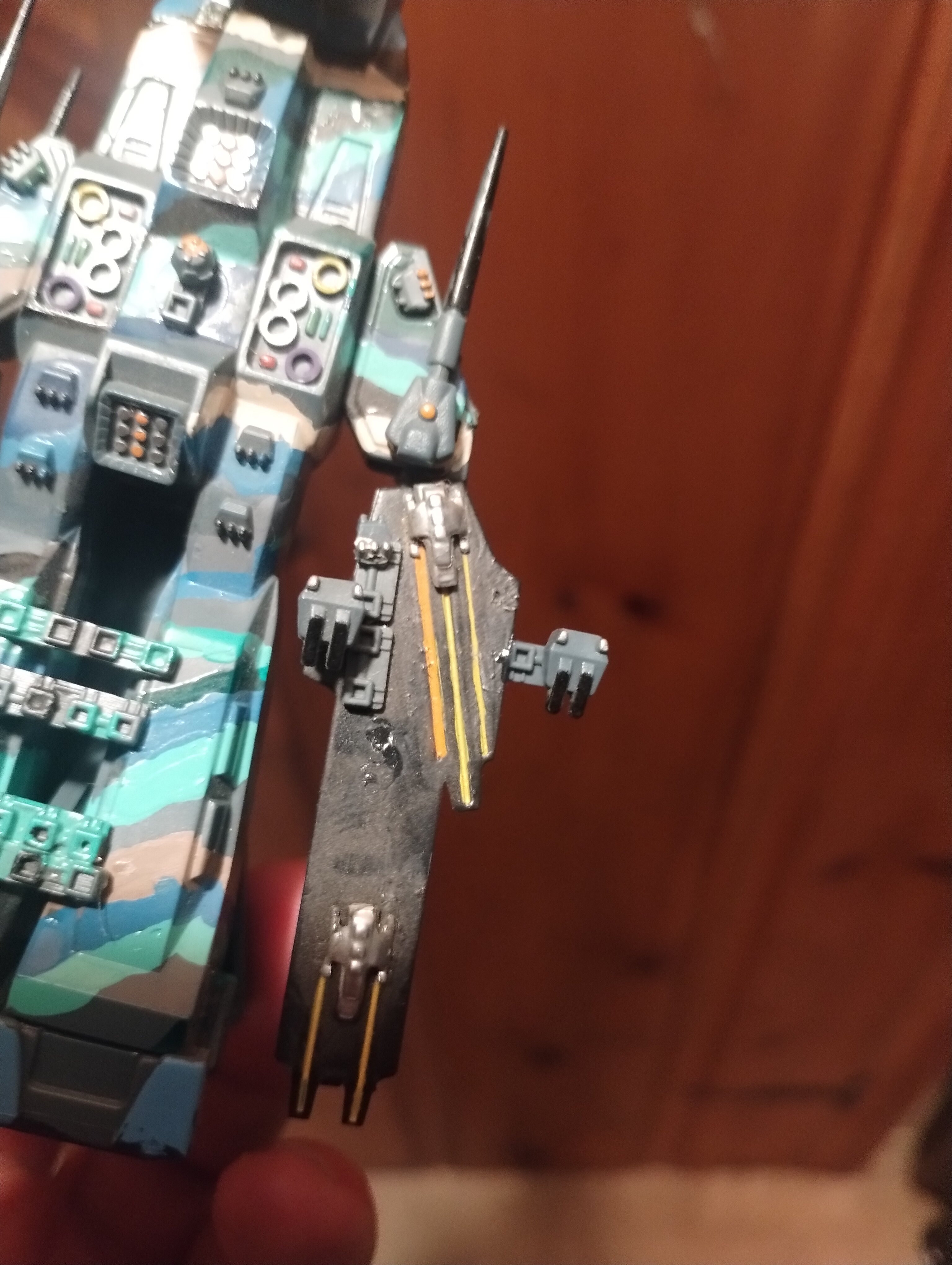

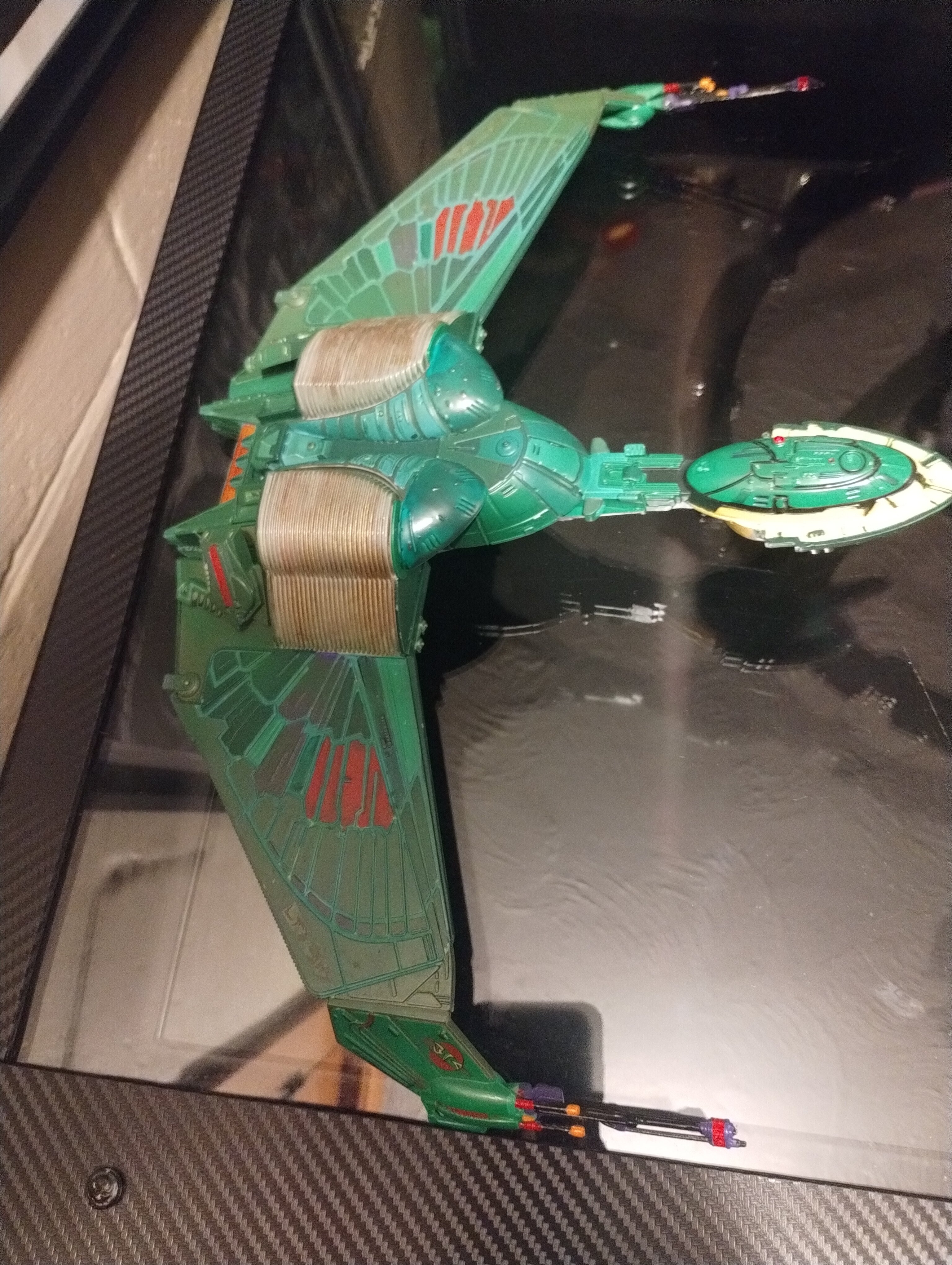

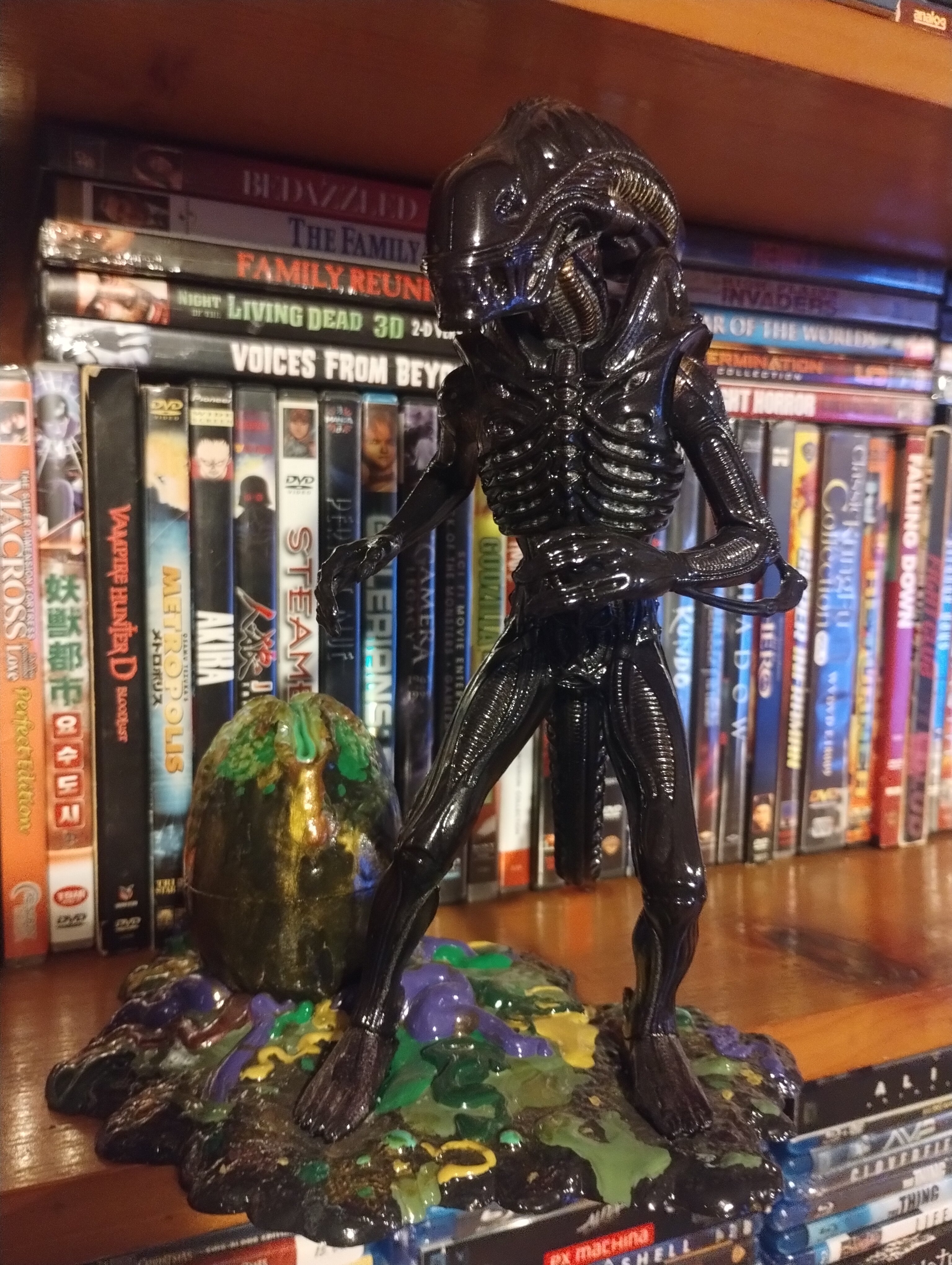

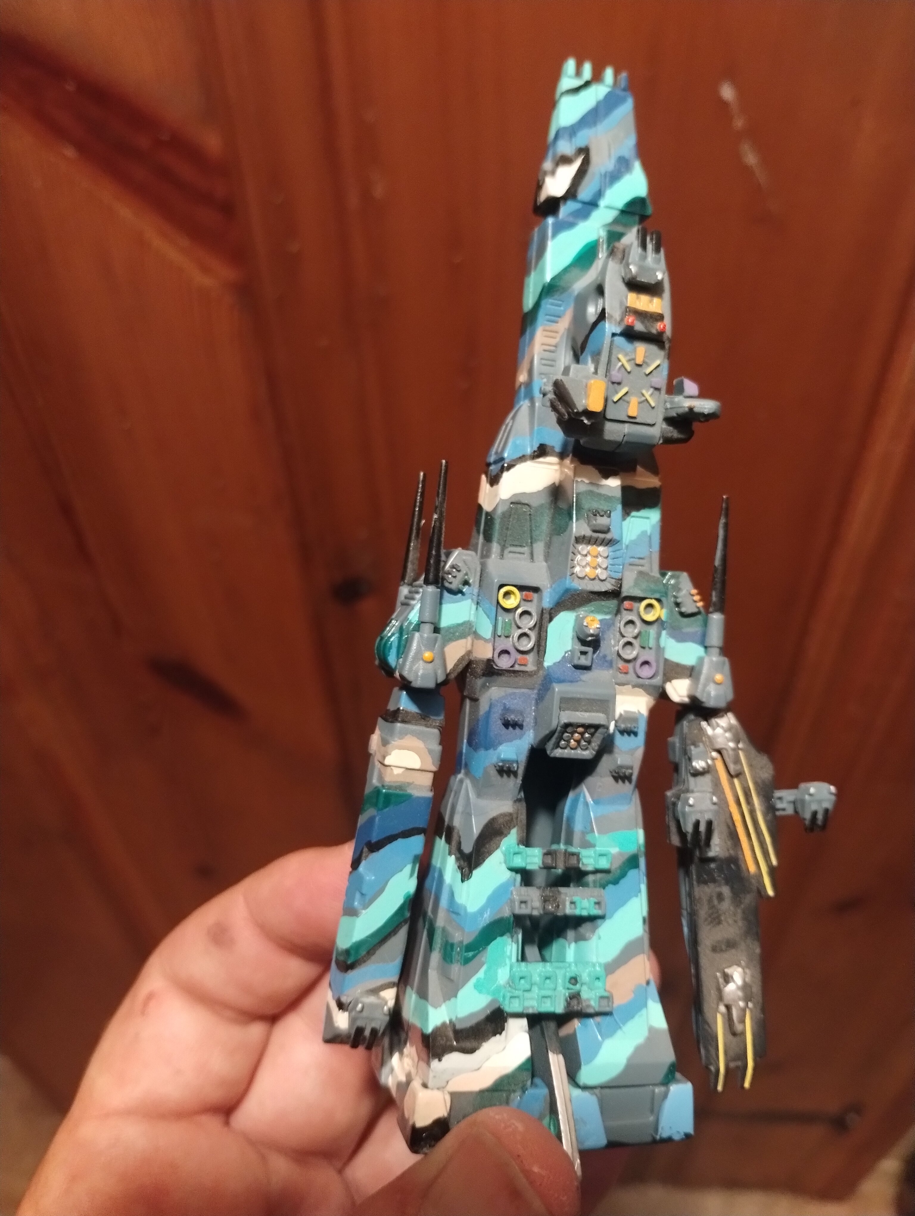

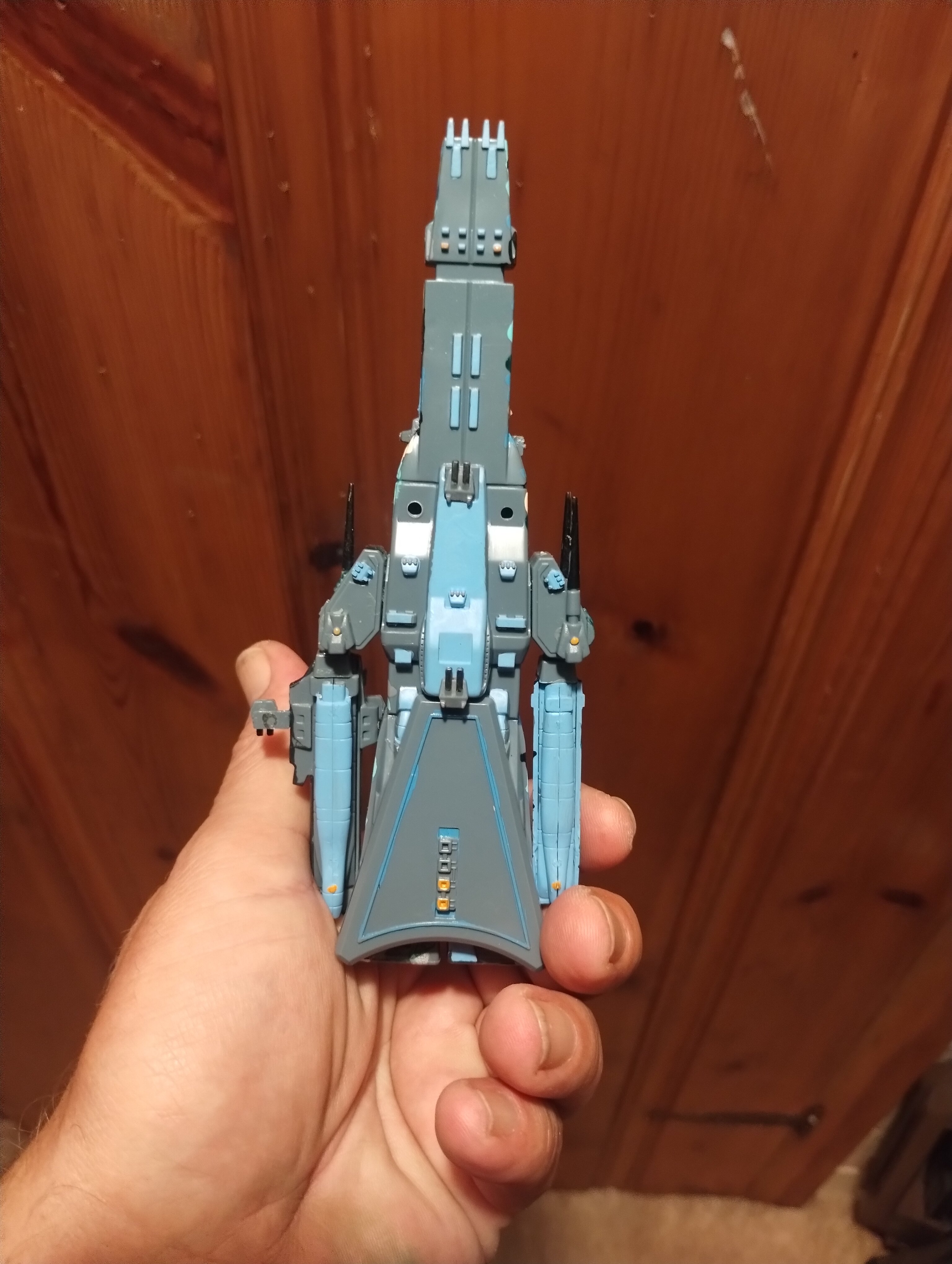

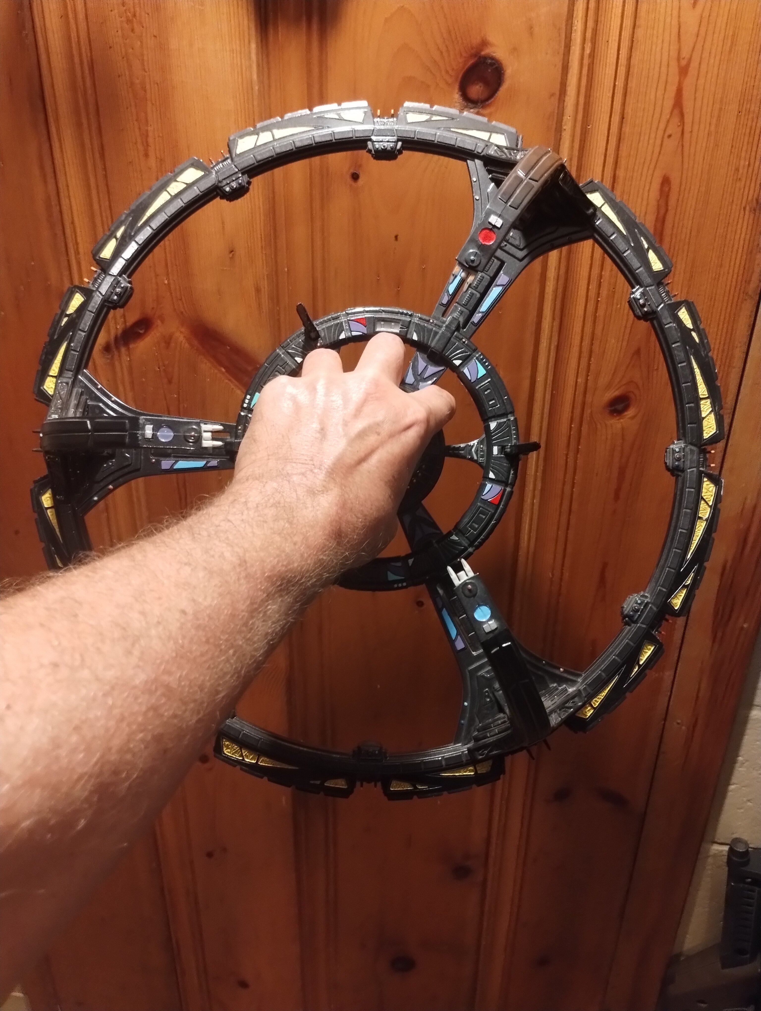

Not this hunk of whatever it is ..came in the lot part of random parts and broken stuff.
18 hours ago, nonner242 said:
Well you guys are pro here..WTF is this mess. Got a box of stuff with a really good deal on old airbrush and compressorless  air tank and found this in the parts pile😂
It's a hideous mess of I don't know what your thinking..no I will not try and fix it. Pengbuzz!
Send it to me; I'll need just a week to set it right.
There are some many choices in that that I do not understand...
However, it does look like an ideal candidate for an Ataria Island crash diorama!

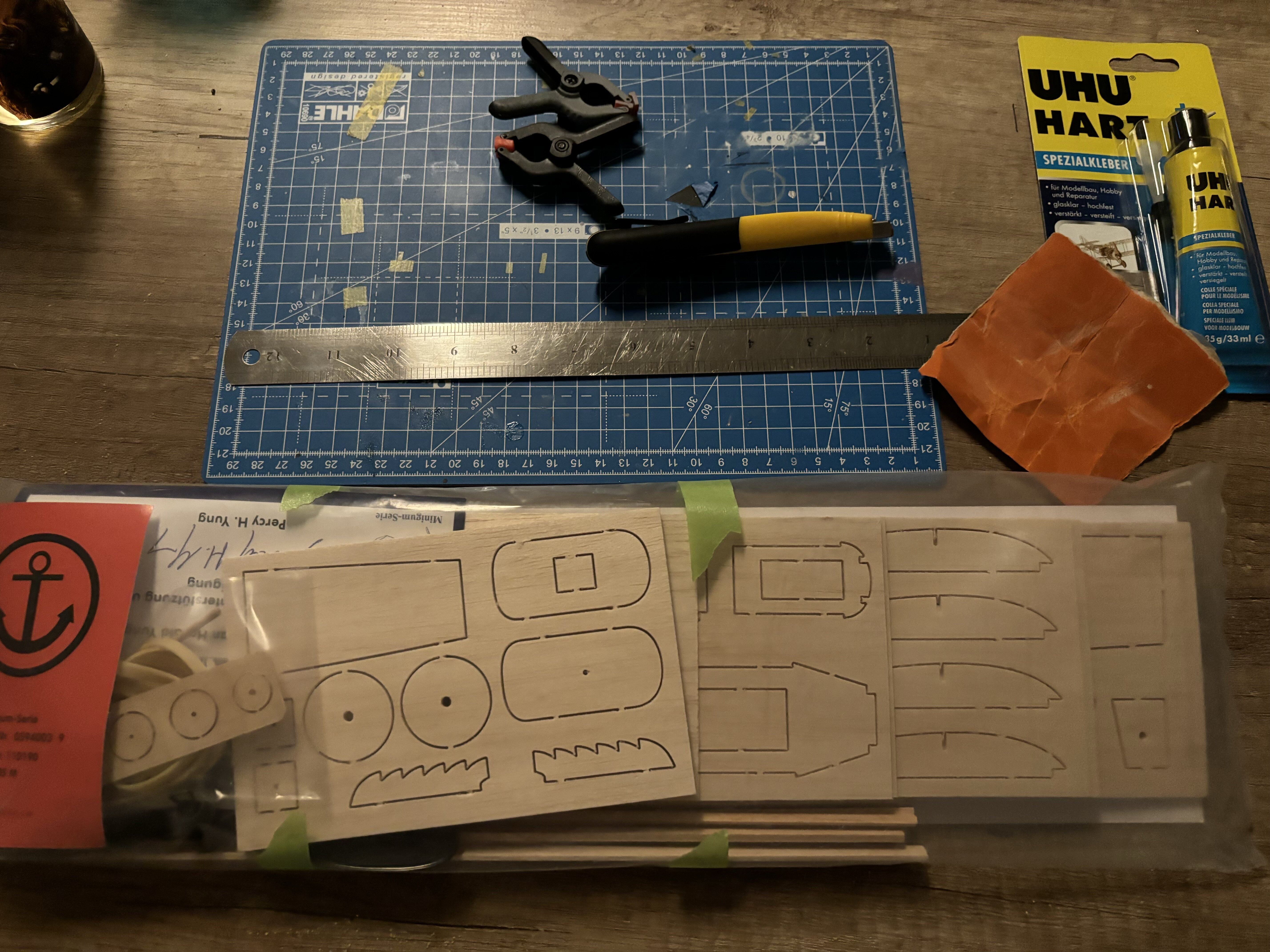

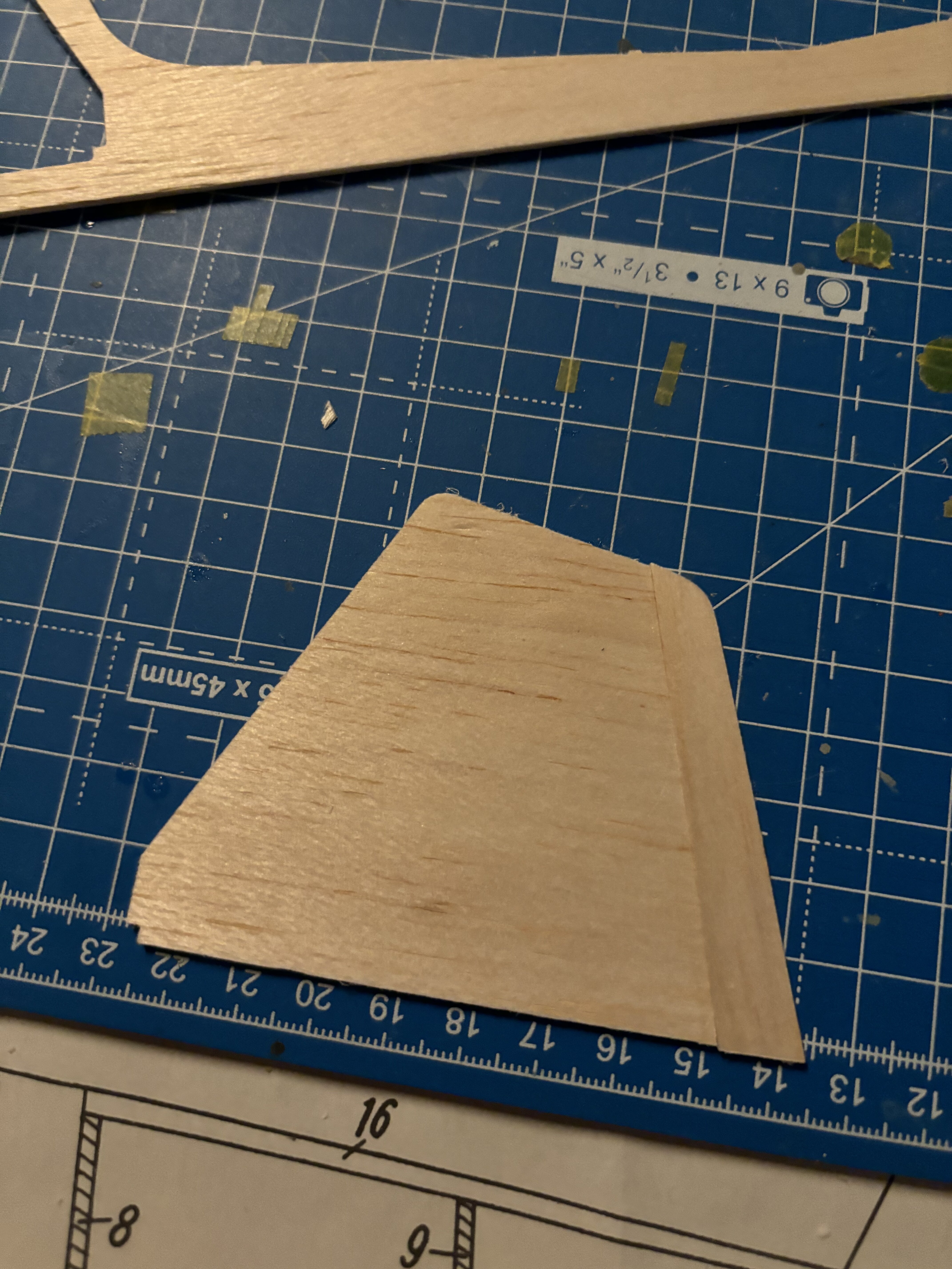

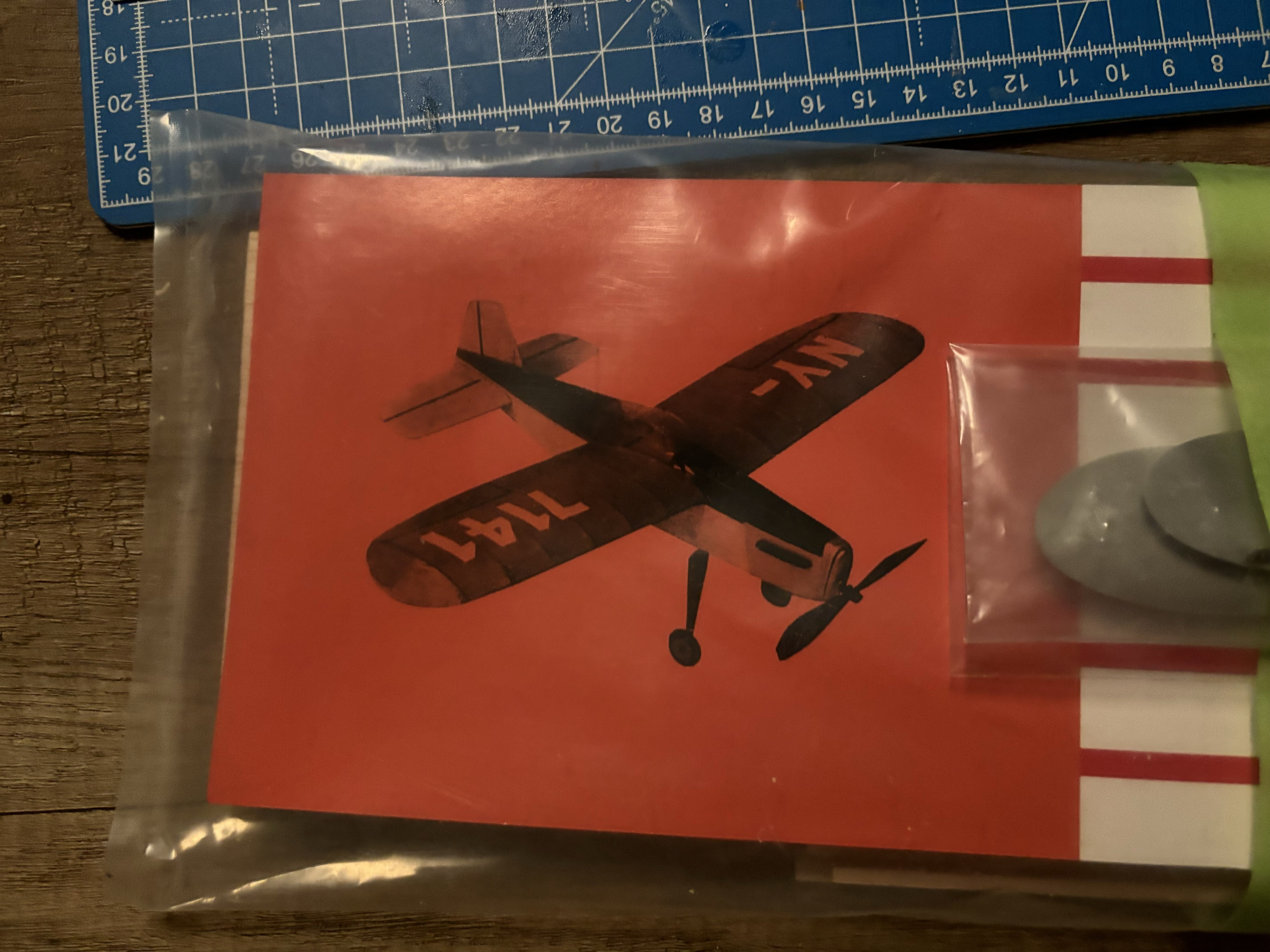

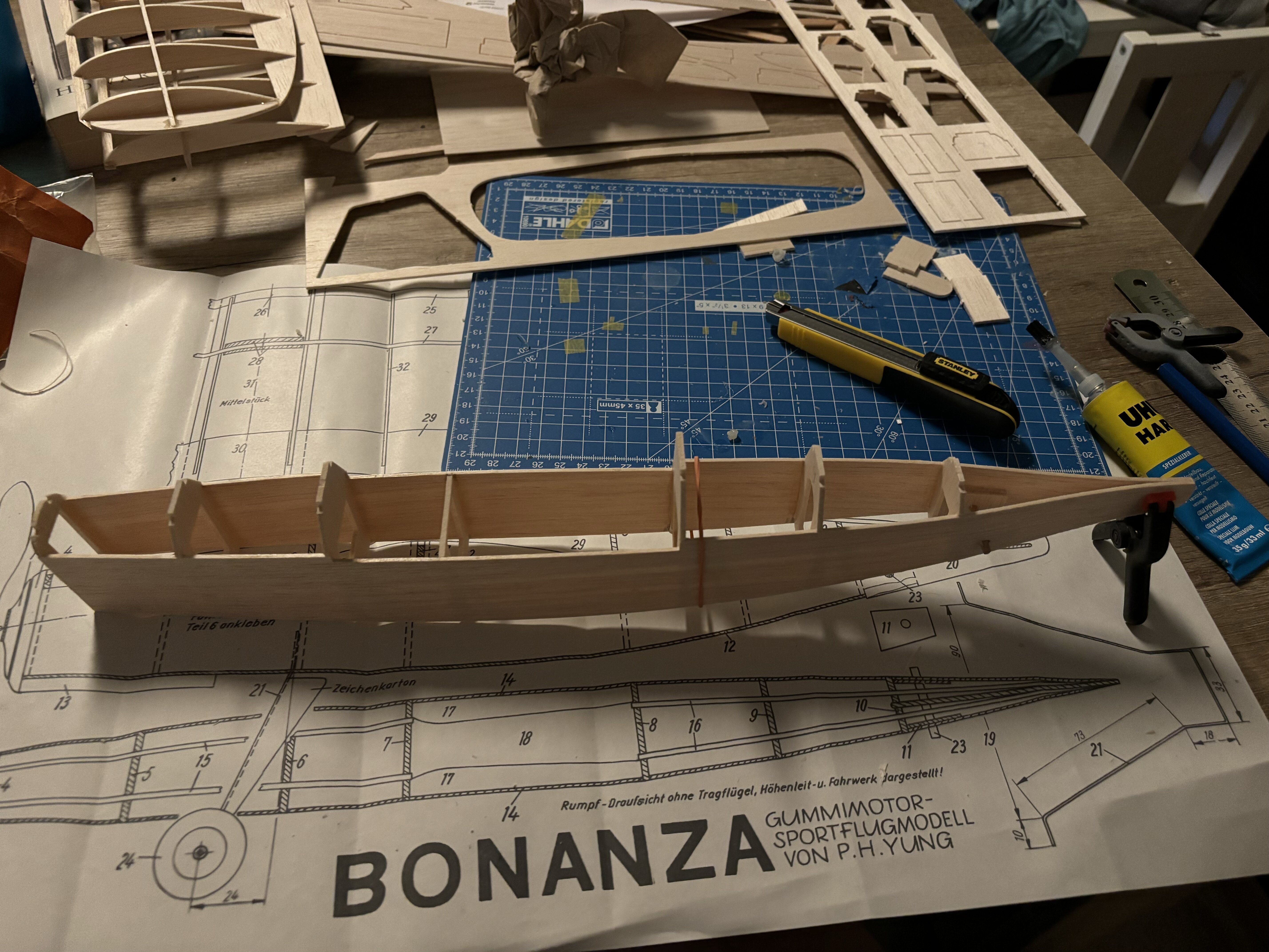

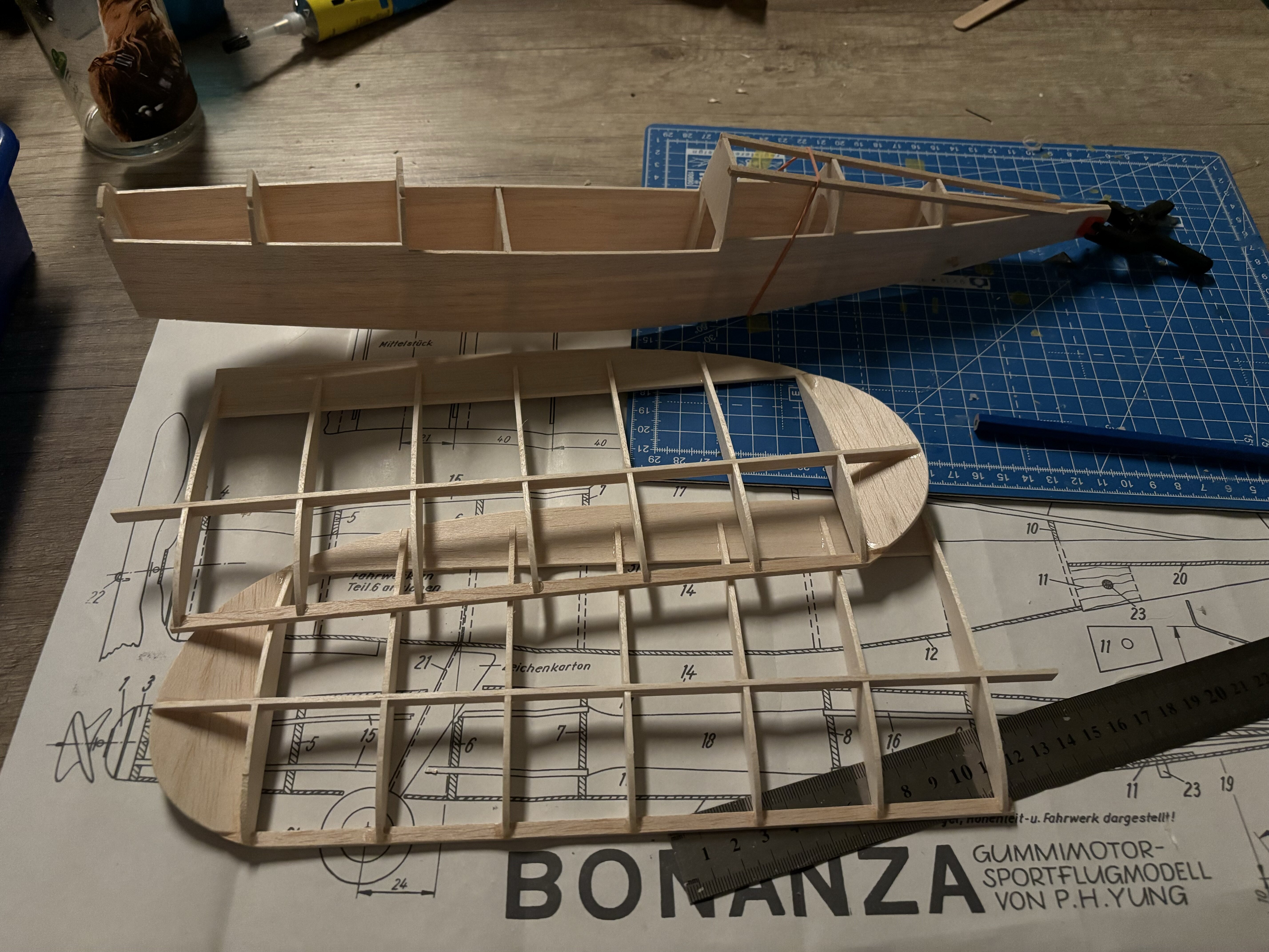

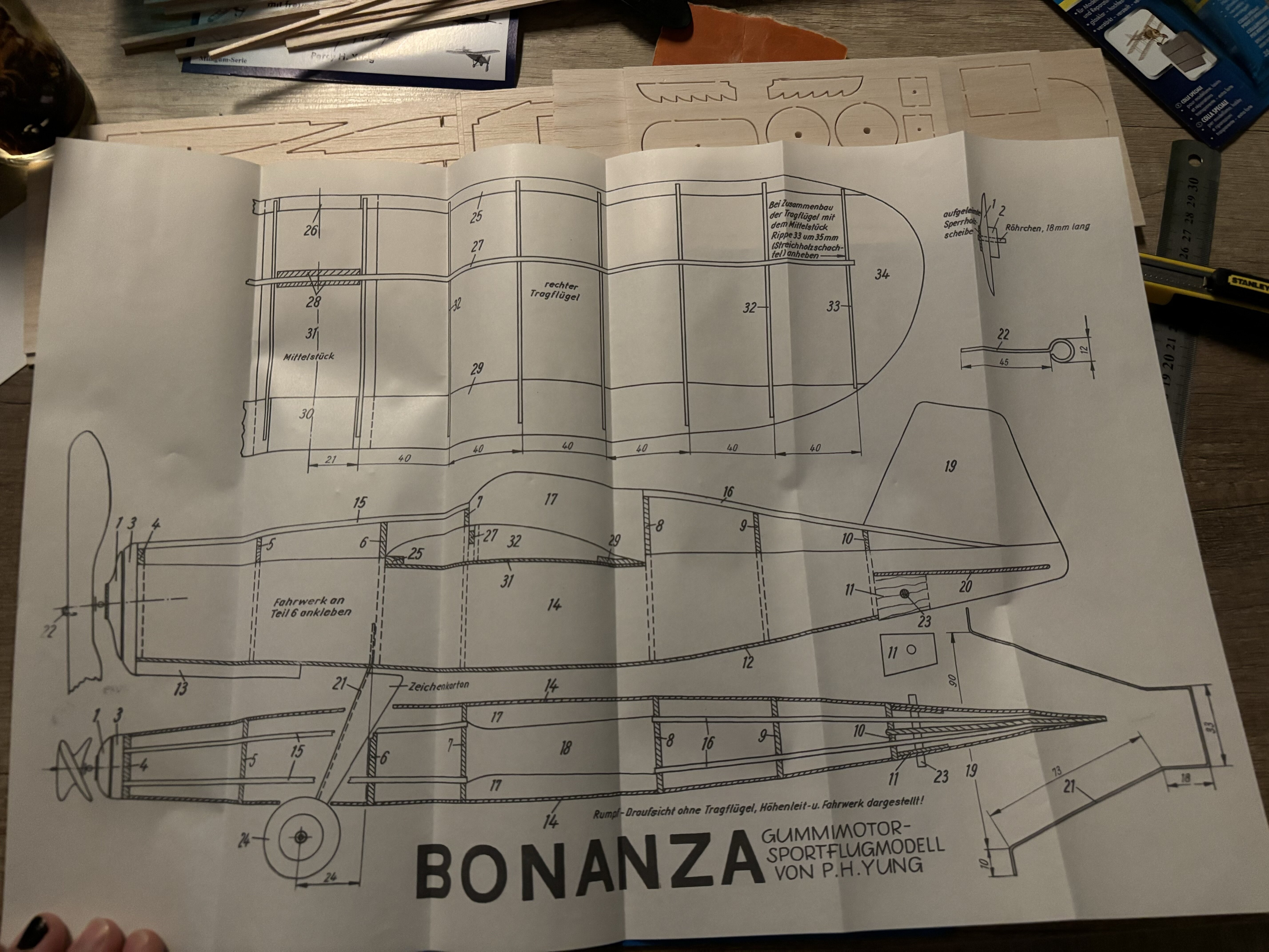

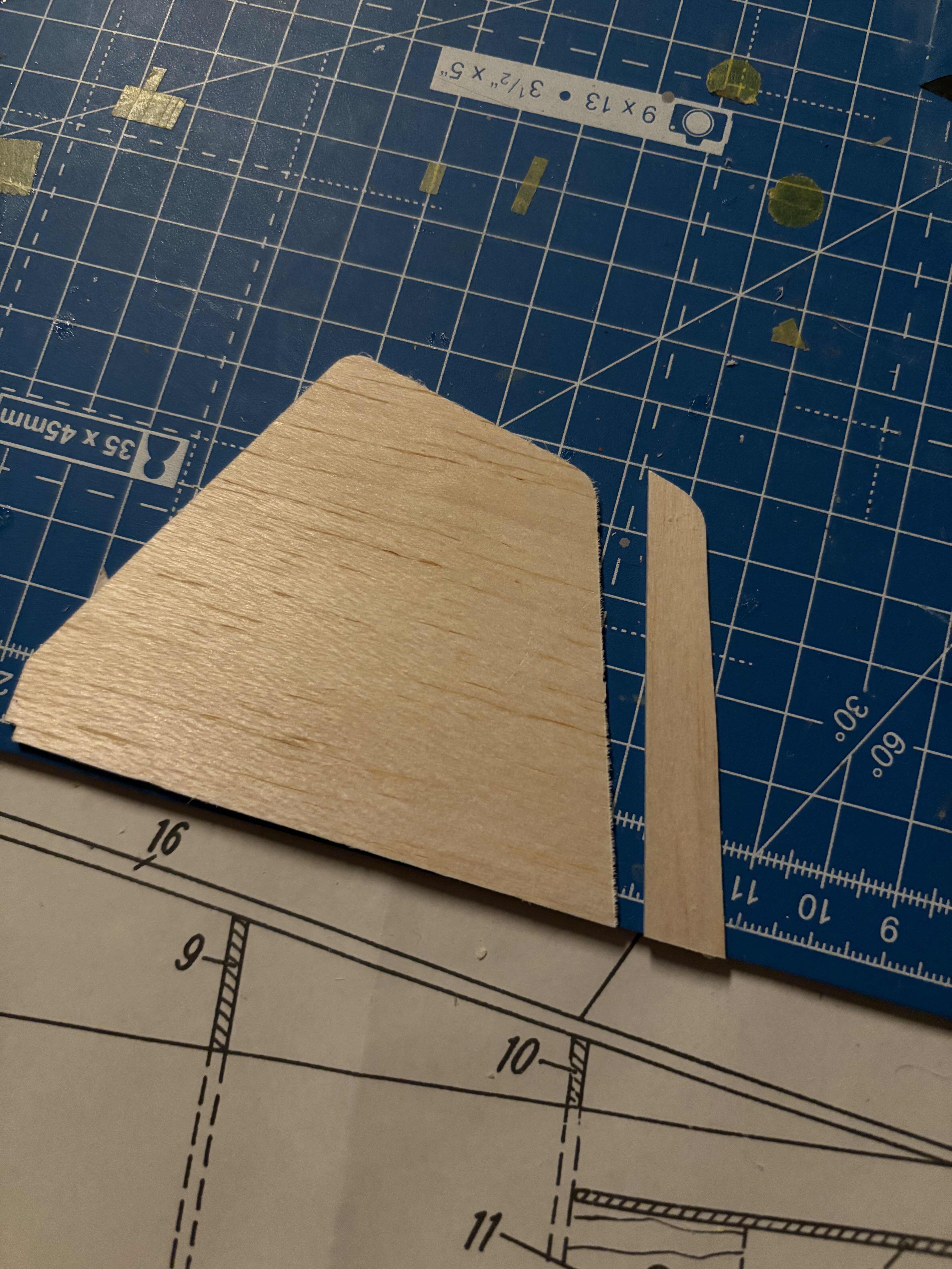

Haven‘t been posting in a while.
I started building a „re-issue“ of a modellkit from the 1970s, originating from communist Germany!
When I was a little annoyance (read hyperactive kid) I build this thing over and over again. It is run by a jolly ol’ rubberband engine. Anyway, pictures.

@Urashiman ooh!!! an actual flying model too!  Very cool vintage kit.

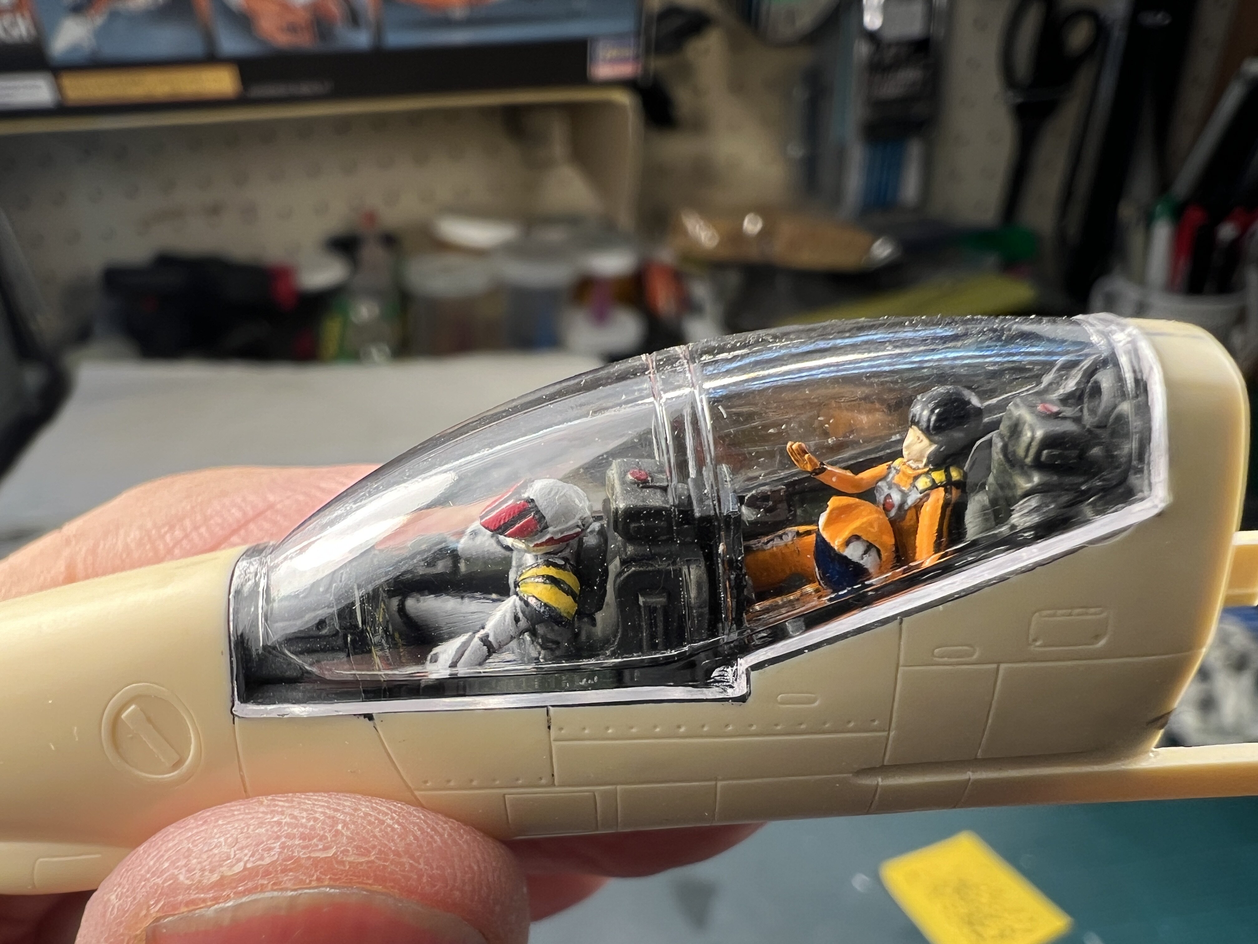

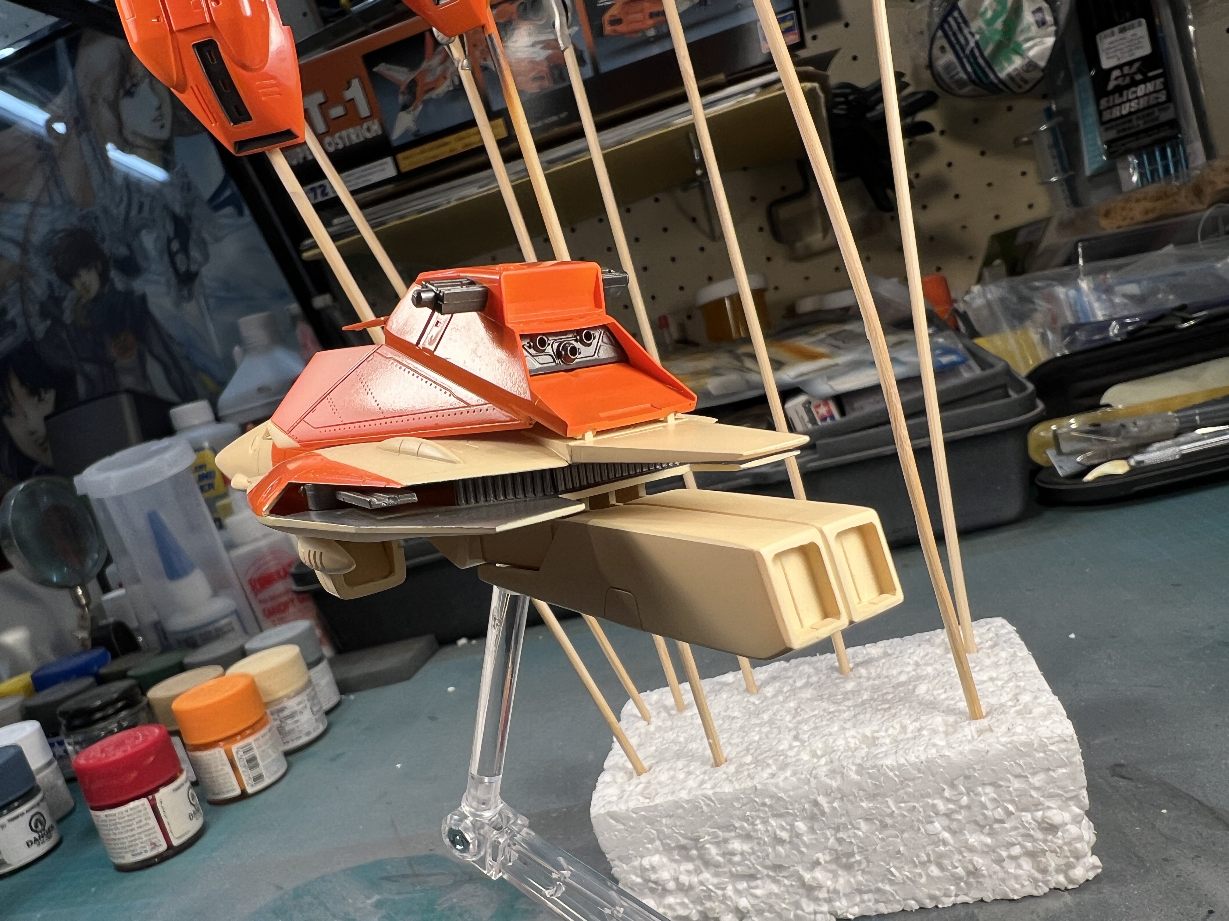

Man!  I'm so rusty at this, its been such a long while since I've built a Hasegawa Valkyrie and somehow I've forgotten a lot of "out-of-step" order of construction that would have made my painting a lot easier later on.  I'm just stuck in masking hell, without much progress to report on (I have a week left before I start work again and after I dropped off my daughter off at Uni).  I forget how much masking there is in VT-1 that the plain white VF-1s don't have 😛
Sorry so dusty!  This is just so I can finally showcase @arbit amazing figure sculpts as I've always wanted Minmay with her helmet off for this scene.IMG_2610.JPG.038cd31af66f0d08f07a60474b0bb98c.JPG
Added a little fencing to block from seeing the internals.

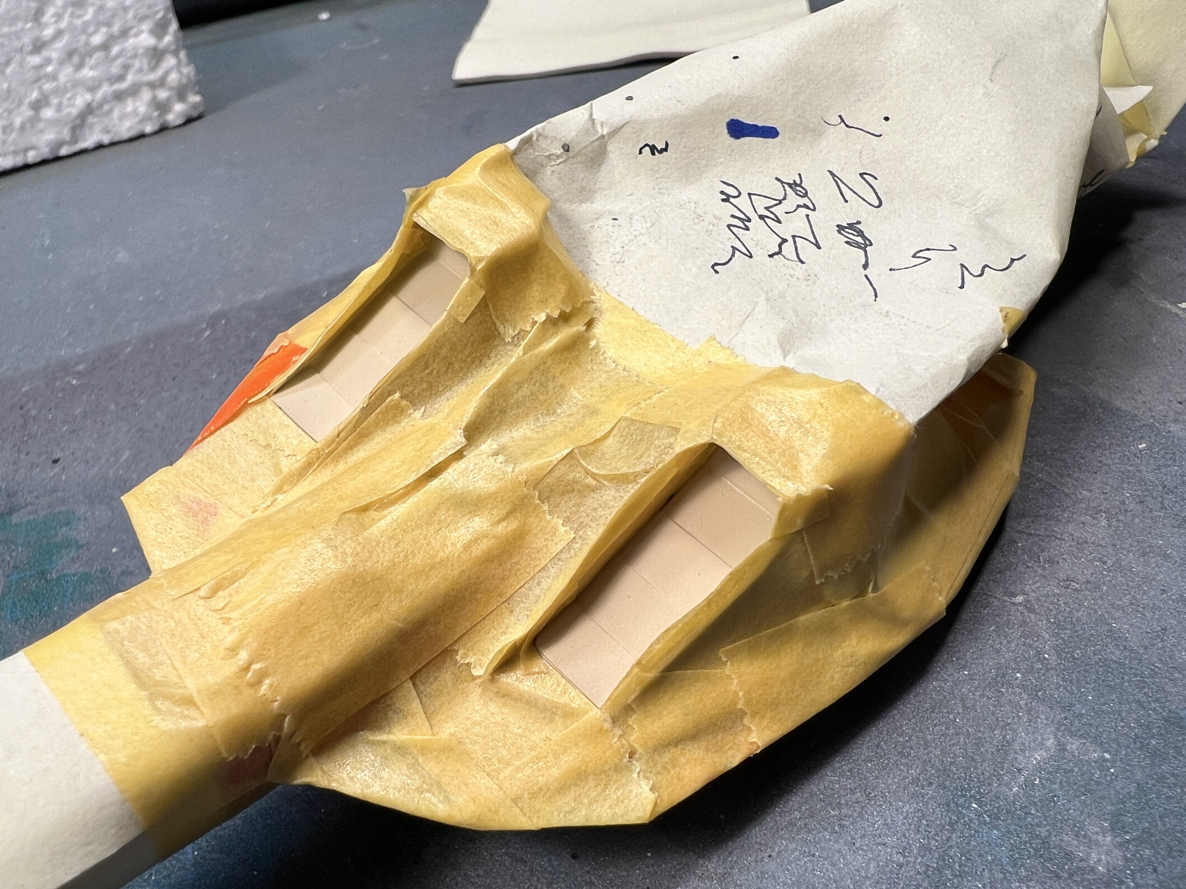

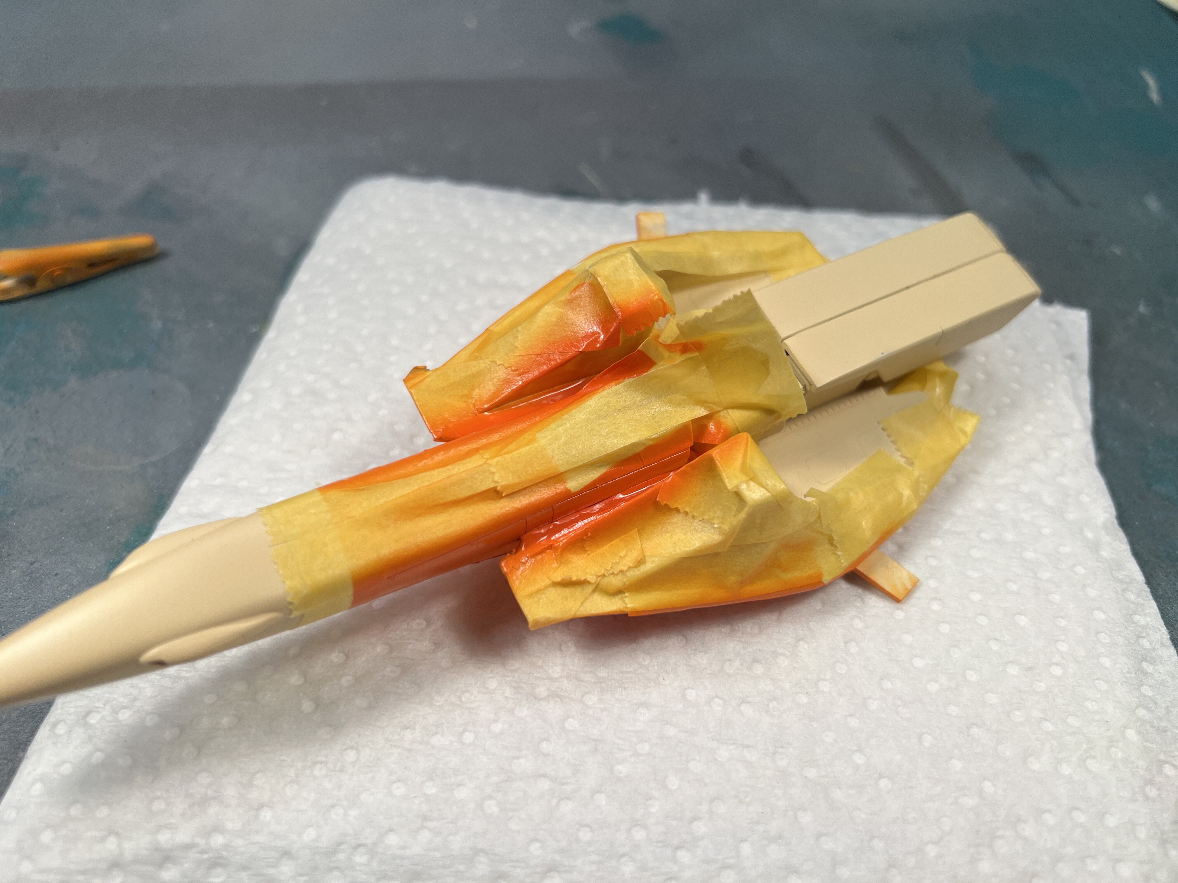

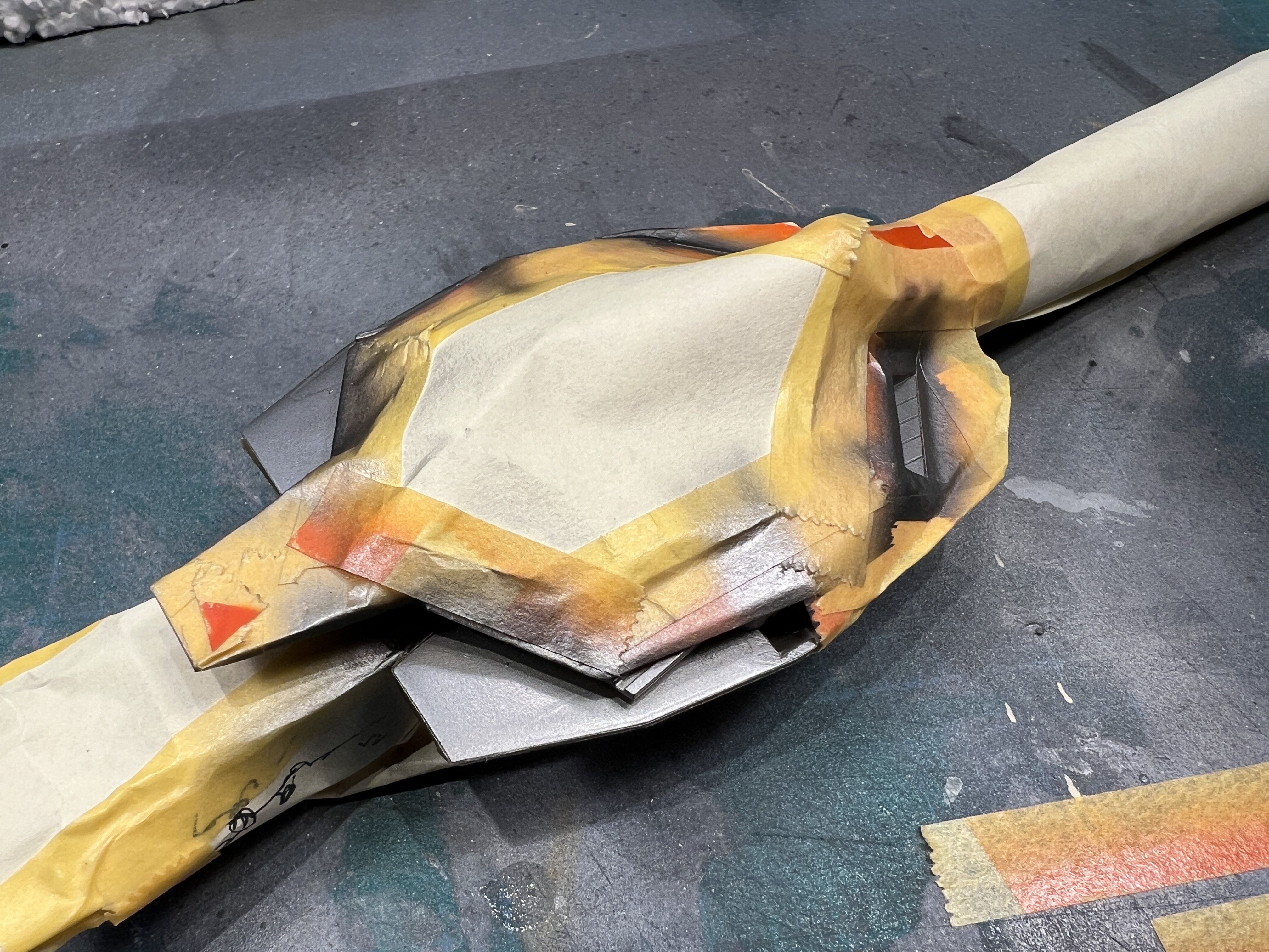

I should have been a present wrapper!  I had to glue the forward fuselage to the body to work out the seam from the forward half and the rear main section as it wasn't very clean and needed some putty and sanding - unfortunately this meant I had to spray the orange sections underneath in a very tight spot between the intakes.  Ideally you want to mask and spray the forward fuselage by itself before assembling it to the rear, but that would leave an ugly gap so its just lots of masking now.
IMG_7429.JPG.c51355aebe20c27660691d09763f55ab.JPGIMG_7431.JPG.51ea8b230bd50697b2424c1e4063d216.JPG

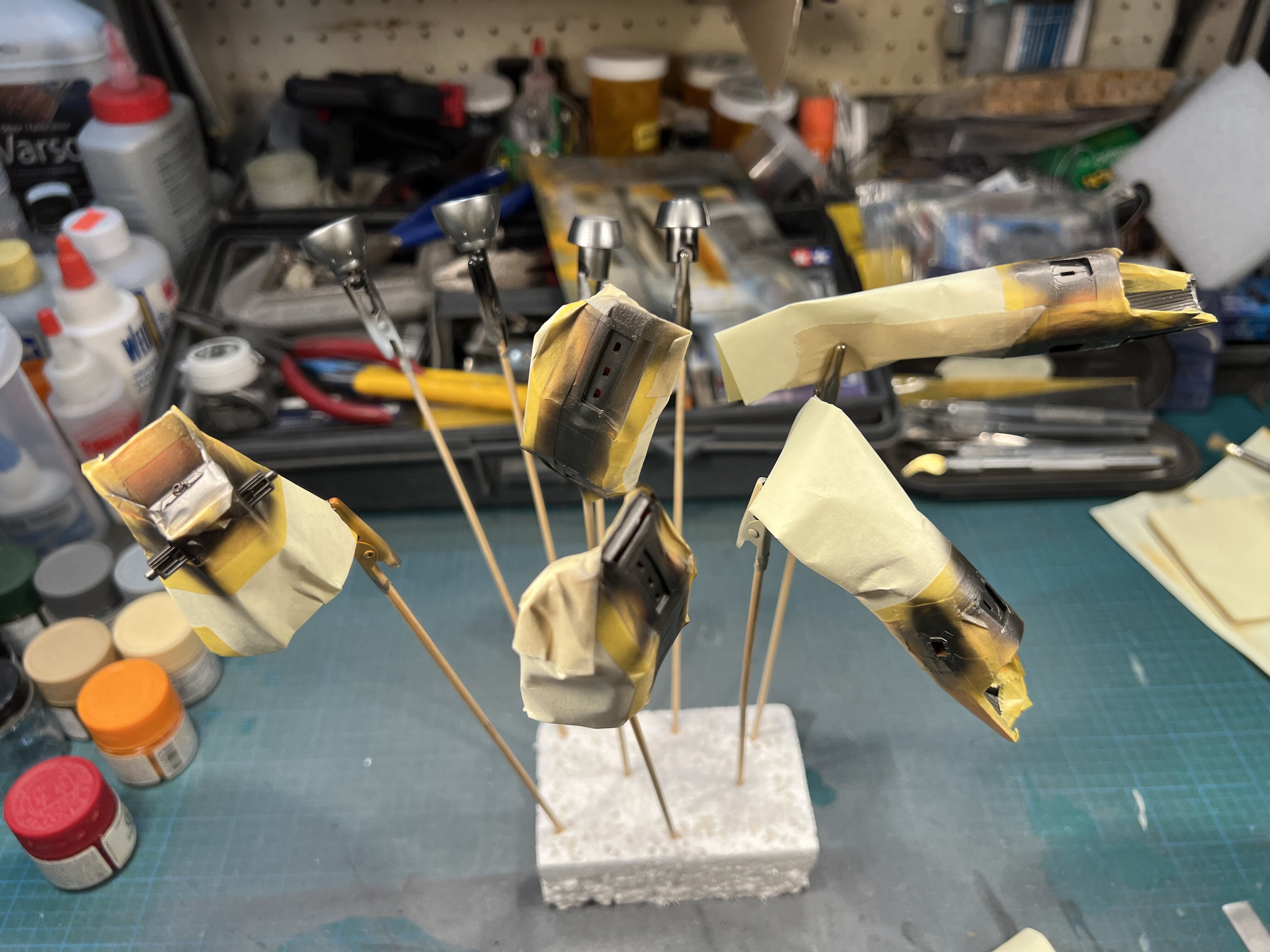

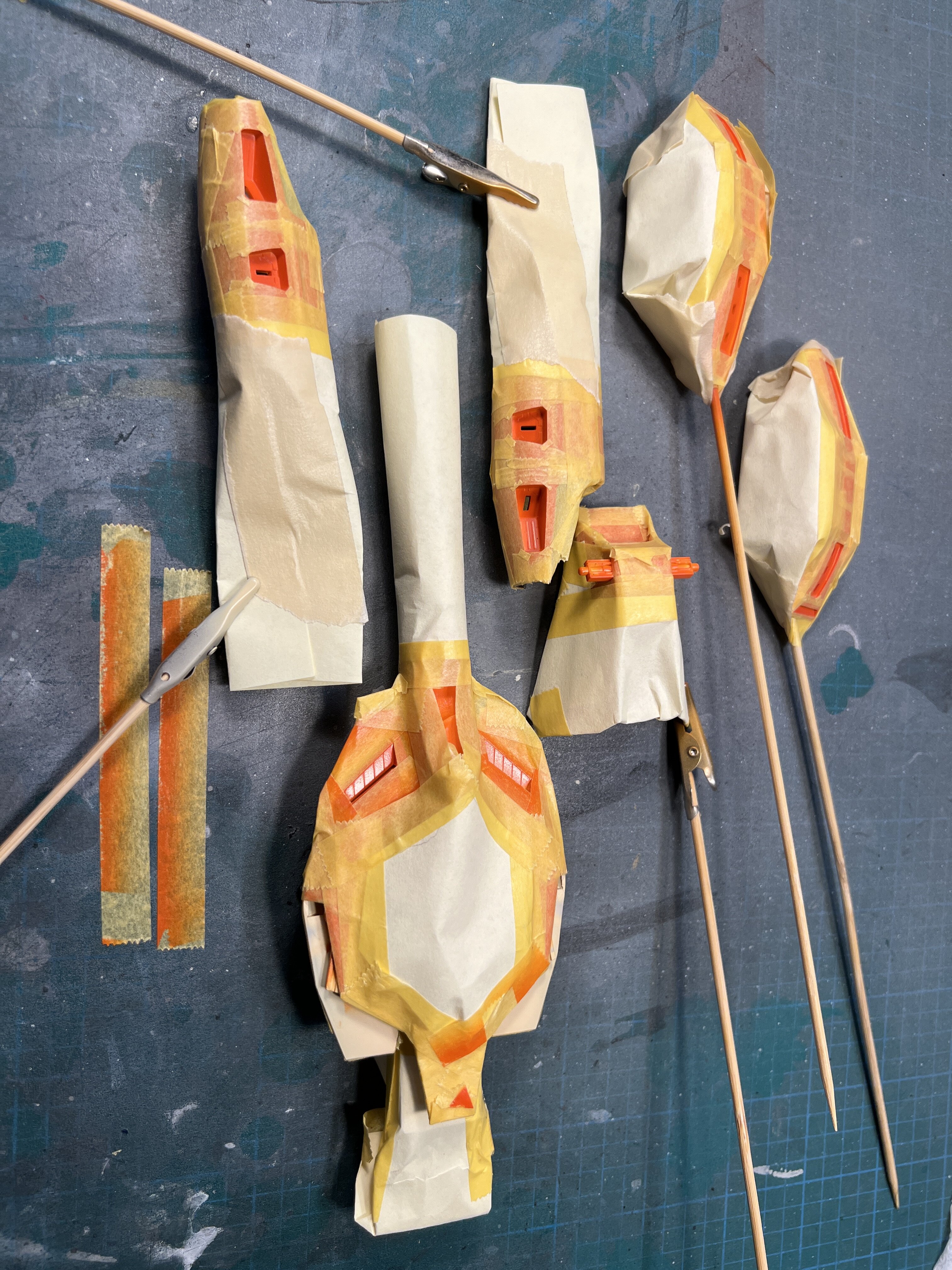

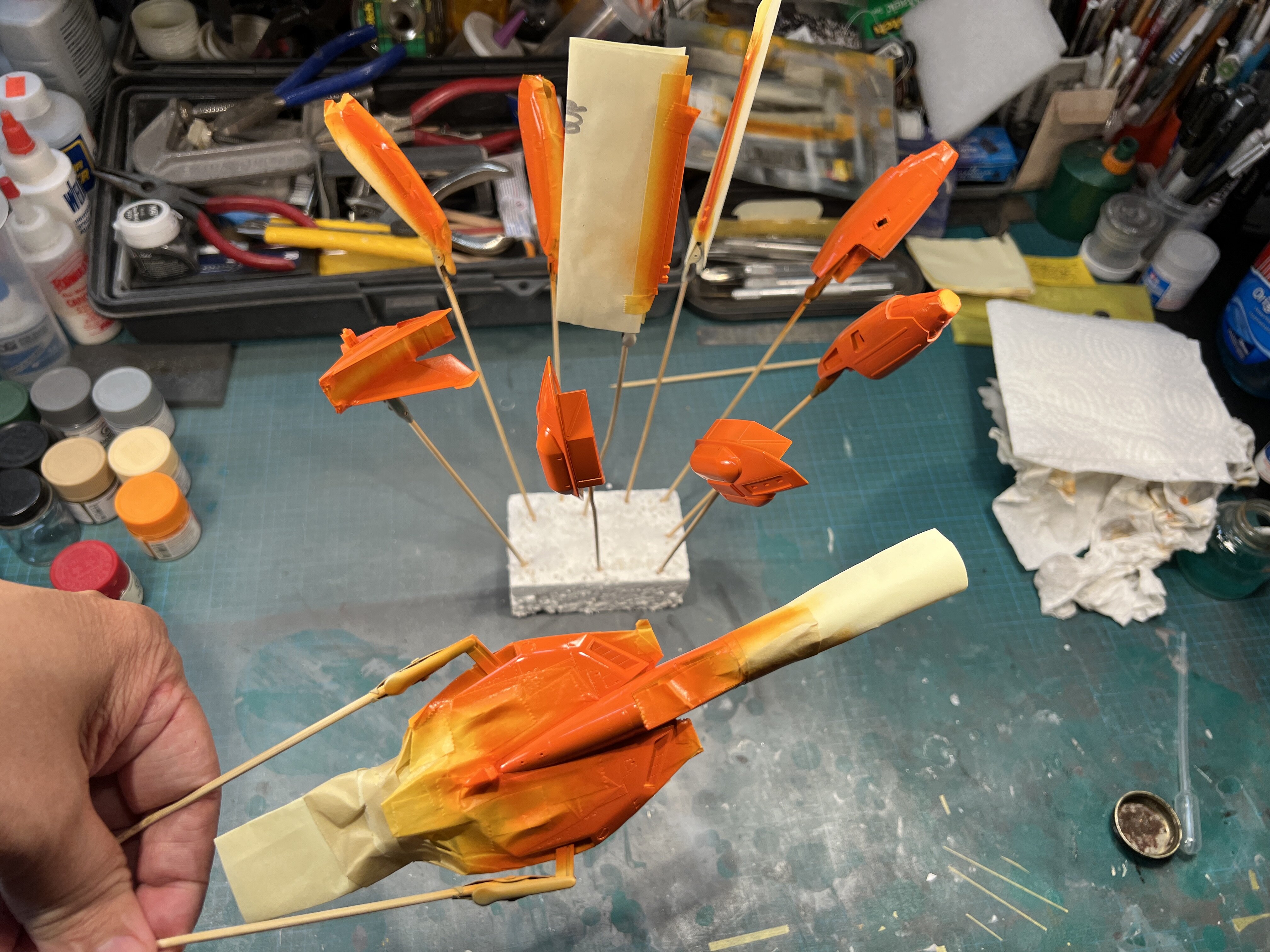

Then masking all the Alclad metals (and I forgot to glue the antenna fins while they were bare plastic to bare plastic which is a stronger bond than after its been painted - argh!)IMG_7487.JPG.7ff4b2bcc2dd6a6ff848b166b7843e18.JPGIMG_7488.JPG.d3a008cc213ca8859c66346cc02d4ab5.JPGIMG_7500.JPG.035bb993e237be3897233ac72eb36de1.JPGIMG_7502.JPG.5e1df15d1ae9a7c66a6a50aa17fe77c8.JPGIMG_7504.JPG.d781b4934672af66f45378ee37b7bbdd.JPGIMG_7505.JPG.a65e3702d46886e86b619f83214ca2a3.JPGIMG_7507.JPG.4dc1a55b337864030f1505ab7145ba01.JPGIMG_7508.JPG.1988443a89adb9e0e2bca19dddf55eb9.JPG

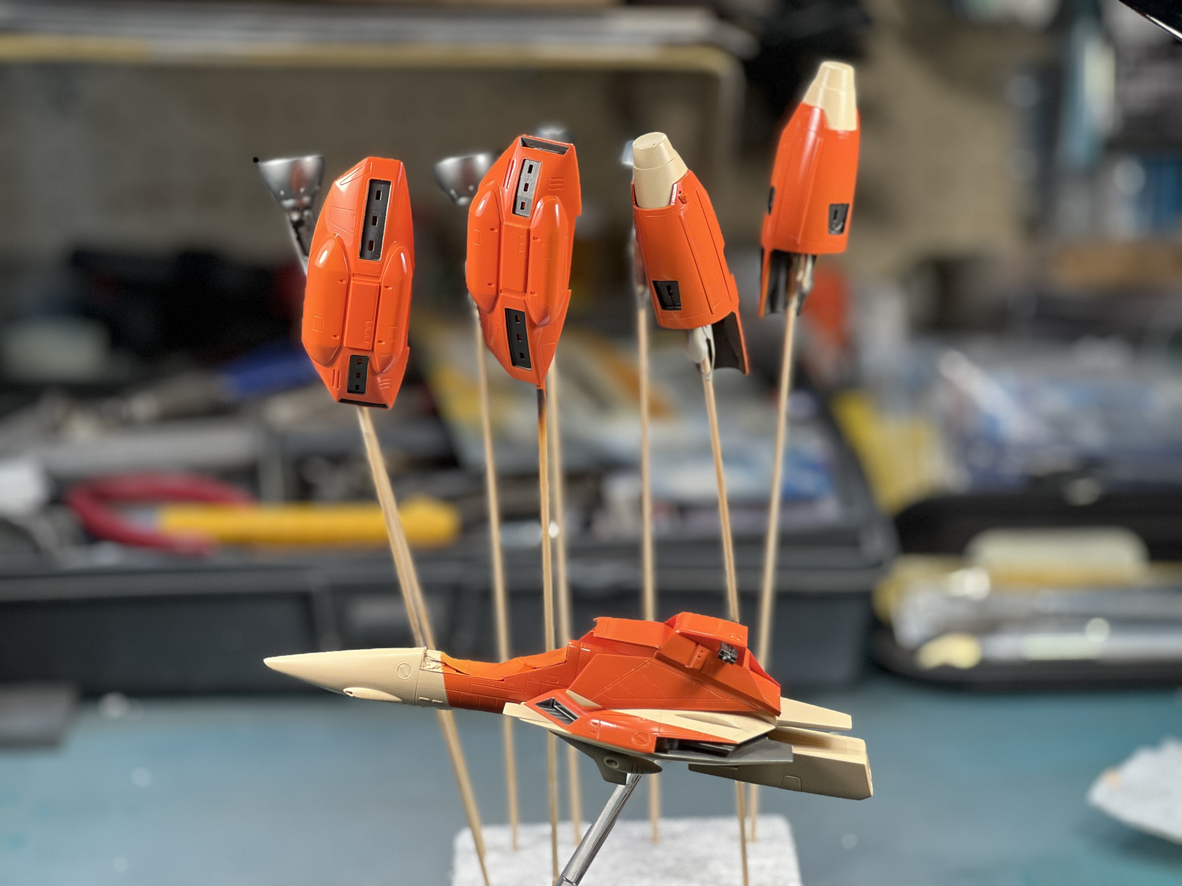

It's finally starting to look like something... (I glue two magnets inside the arms so I could attach them to the stand without a visible hole)IMG_7506.JPG.c659d6cf7991ef2d31cf9b4650396c22.JPG

@Urashiman That is so cool to see something different here on the boards. I remember building a few balsa wood kits when I was a kid. Please remember to post any progress pics!

@wm cheng The master is back to the basics! That orange really pops. It seems like masking hell but it all works out in the end.

@wm cheng thanks! and man, that ostrich looks nice. Now I wanna build mine too, but I got that F-14, the VF-171EX, and the balsa plane in the pipeline at the moment.
@Gabe Q Yeah, I do RC stuff quite often. I am a all in one model hobbyist. Plastic injection kits, RC kits and H0 trains hahaha. (and even Lego/Brick models as a quick "trip").

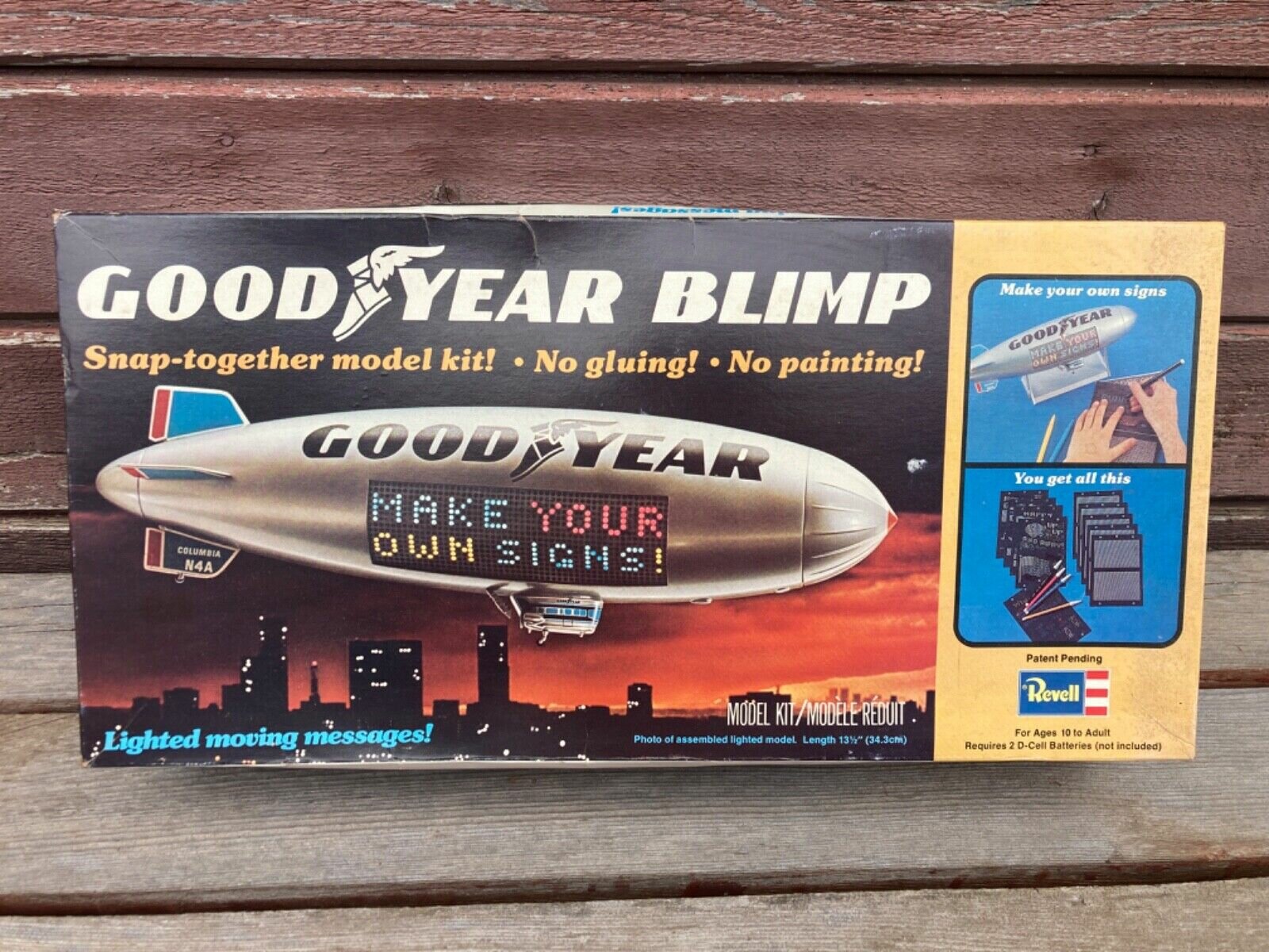

The first was a scratchbuild I was doing of the Goodyear blimp (can't afford the actual Revell one!); here's what I was trying to make my own version of:
I wasted 2 rolls of masking tape trying to make it, only to realize after finishing sealing it up (several layers of tape that cannot be cut without the model falling apart) that I FORGOT TO PUT THE MECHANISM IN TO MAKE THE MESSAGES TURN!!! Now, it's impossible without tearing it to pieces and ruining any sort of smooth finish on it (I'd have to start over).

No, it can't; the model lost structural cohesion when I was cutting the opening for the message sign and realized I had forgotten to install the mechanism for moving it.
As it was, this one was masking tape and cardboard; I'm not at all skilled in paper modeling; my hands just won't tolerate it (cannot get fine enough dexterity to do it, tried in the past and failed miserably several times) and my perception goes wonky when doing it. :(
Really wish I could get the plastic model... not gonna happen.
