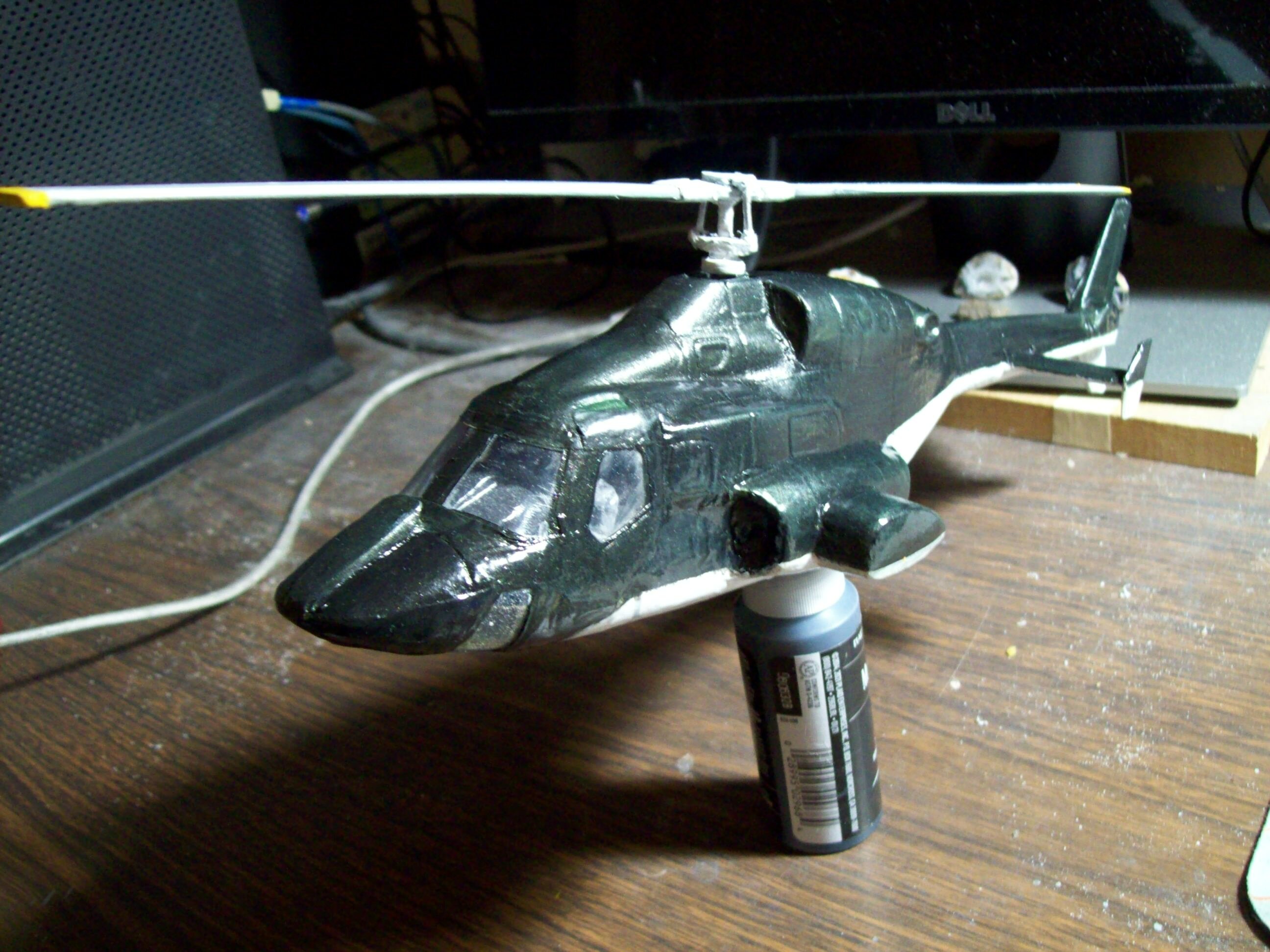

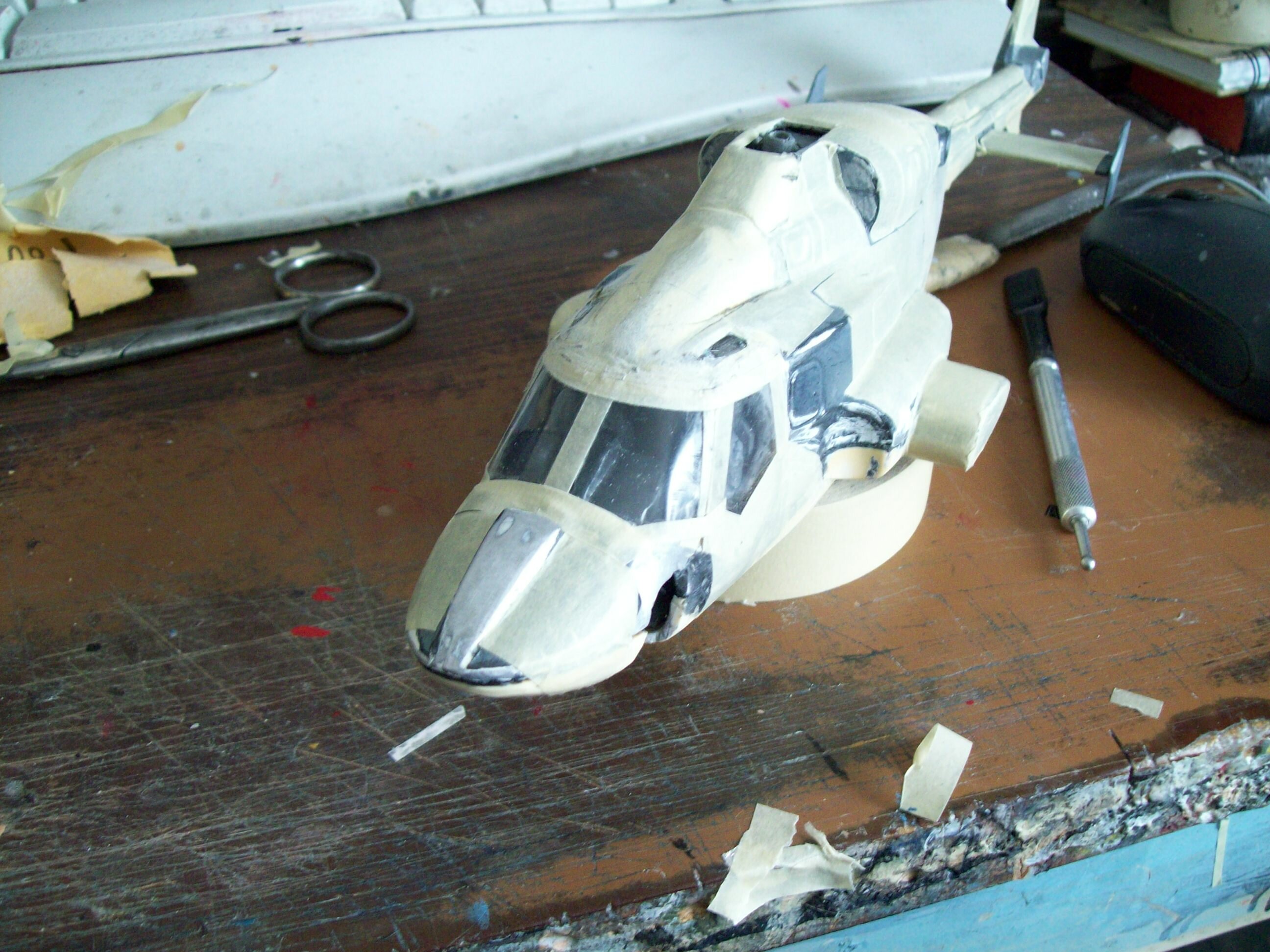

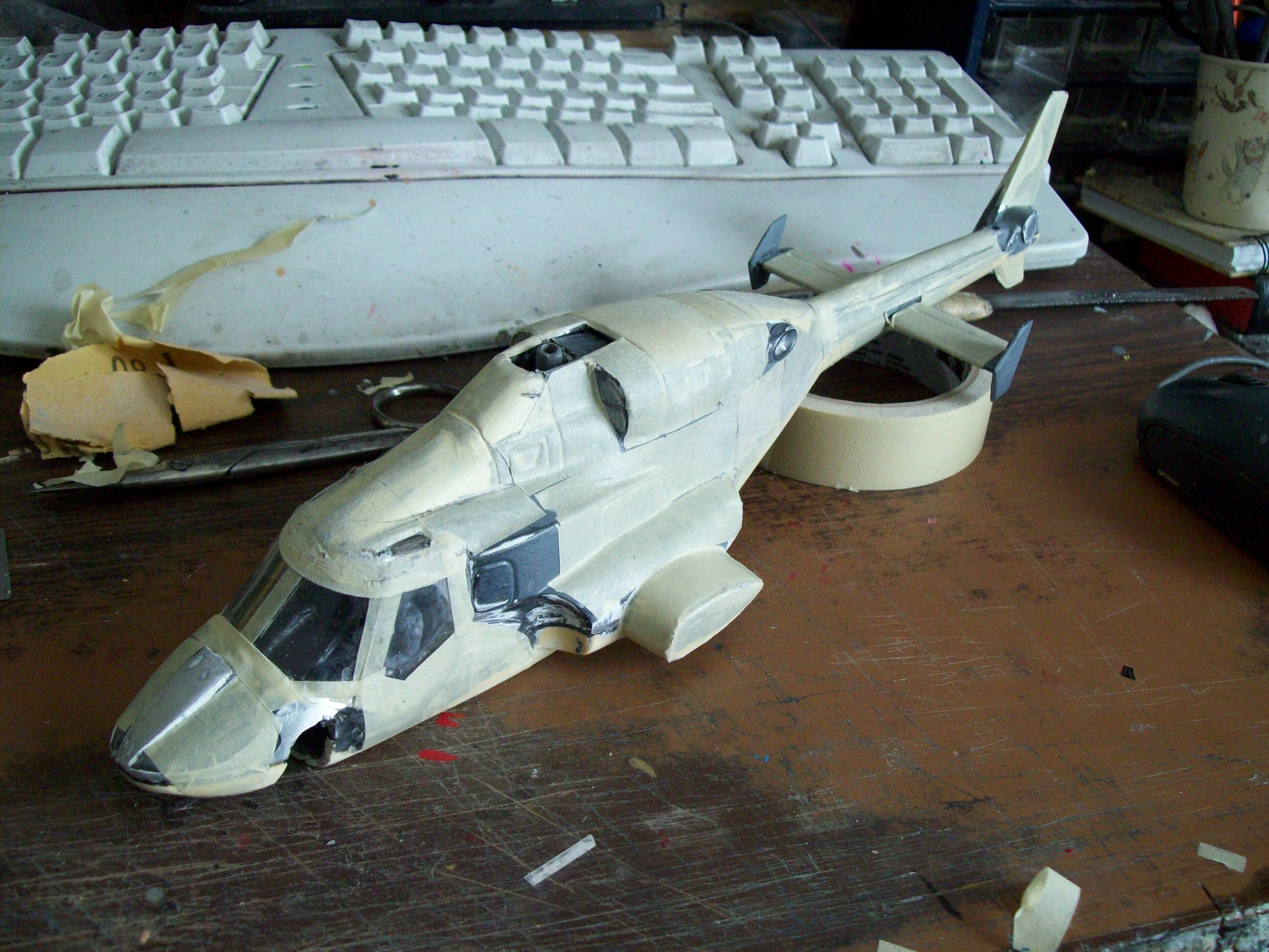

UPDATE:
While waiting on supplies for Reliant ( Plastic Welder and Purple Power to properly clean the mold release from the Reliant correction kit ), I decided to try something with Airwolf to get a windshield on it:
100_0454.JPG.441e02c36a57fead33474f90fba089a0.JPG 100_0455.JPG.3320d928697fc2194bc5fcb61444a437.JPG
It's a modification of my original idea for mounting the windscreen and windows, but using what little Plastic Welder I have left to tack the windows in place, followed by hot melt glue and tape to finish the seals. All that's left is the two lower windows at the bottom of the nose and that part is done.
Overall progress on Airwolf:
I started doing more of the overall masking tape layer, limited to one layer in most places so it doesn't "bog up" details. This will provide a uniform surface for the primer, as well as cover over the dings and dents in the die-cast. At this point, the top and bottom halves of the helicopter are sealed and the piece is now one contiguous unit. After mounting the lower windows, I simply need to make the rear rotor, cut the slots of the landing gear on the undersides of the sponsons, decide on the weapons, and mount the turbo boost nozzles aft of the sponsons and the exhausts up top.
Stay tuned.... Airwolf will be back in a moment...

@pengbuzz oh, that comes along pretty well!

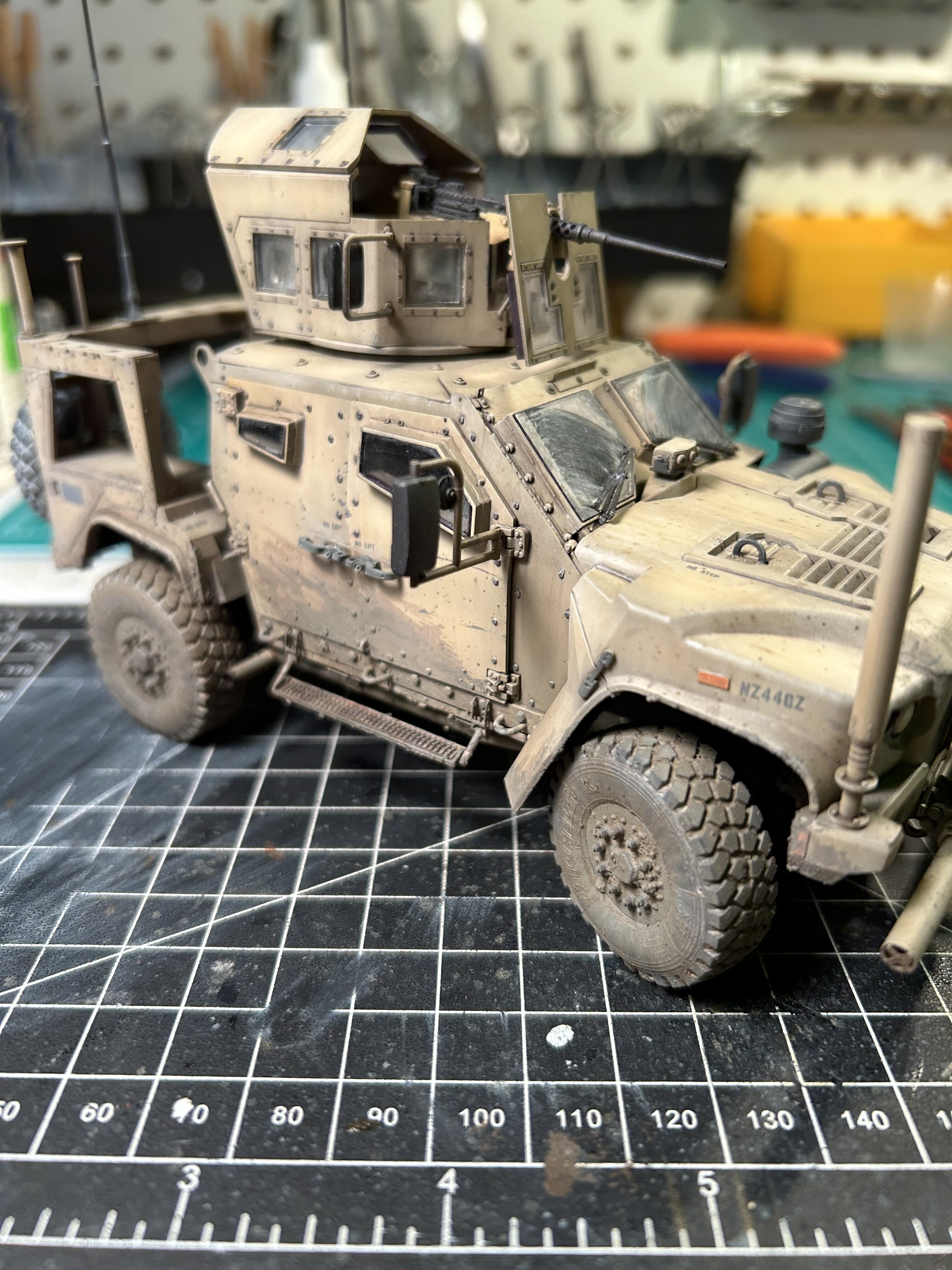

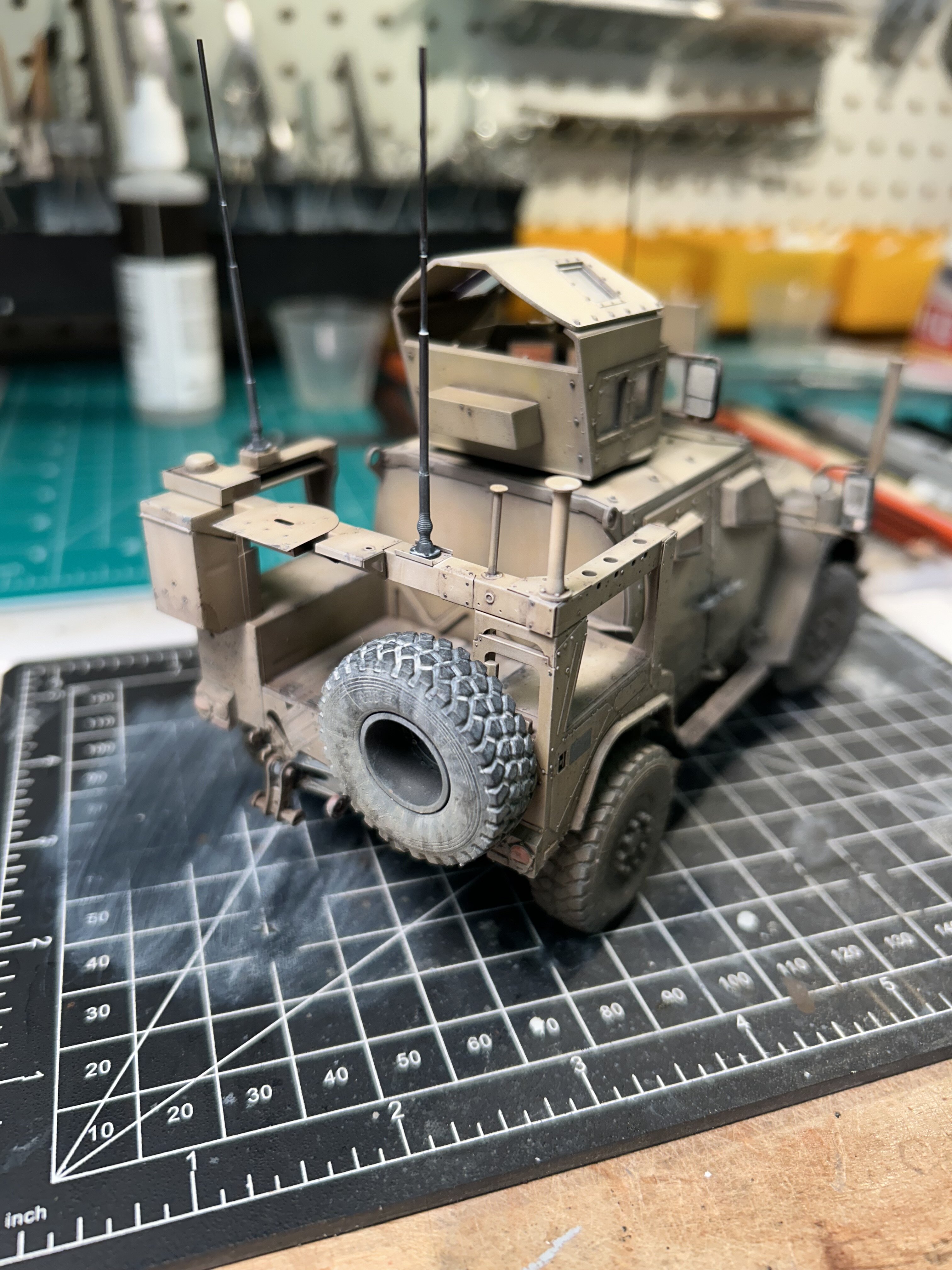

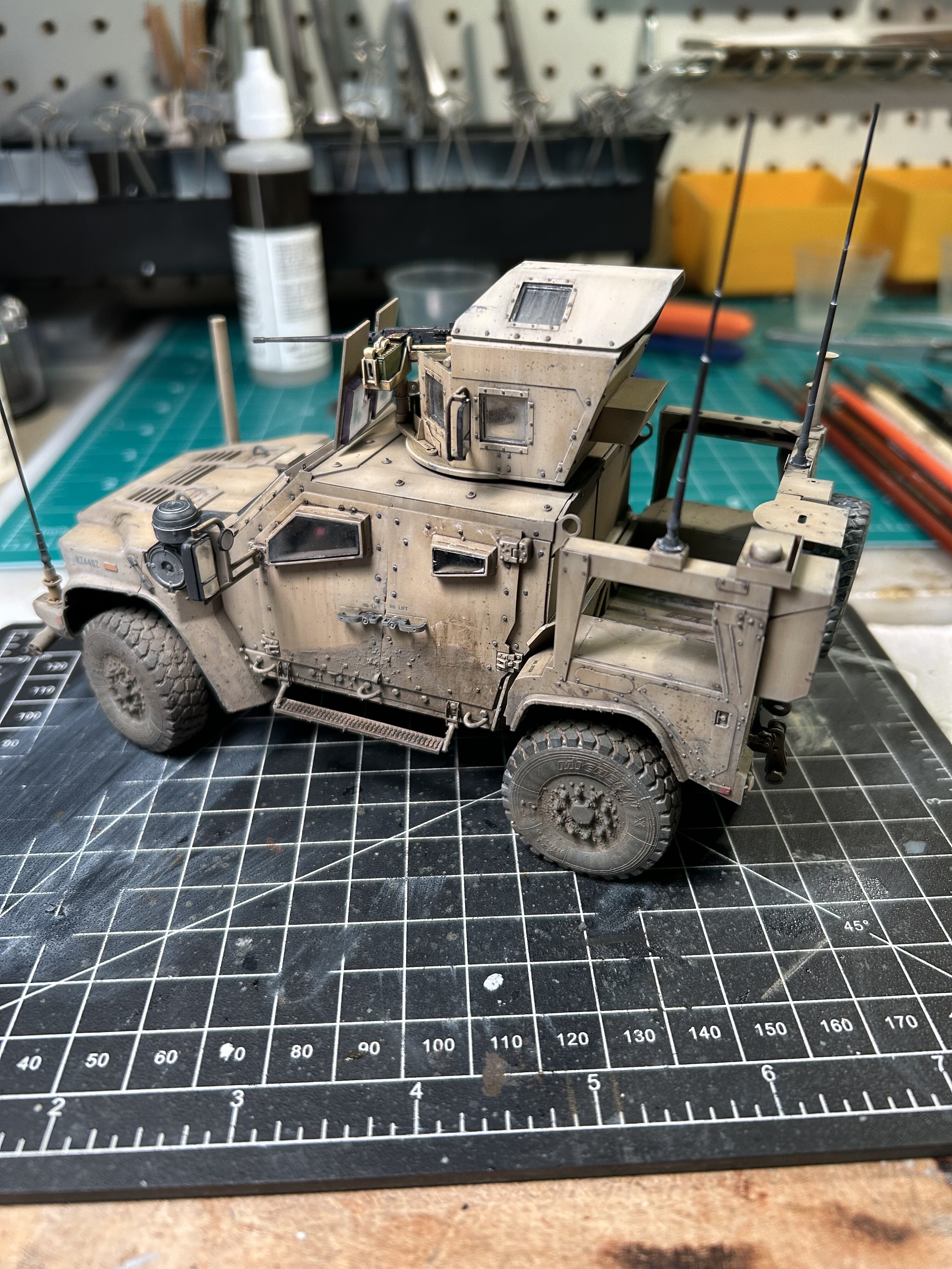

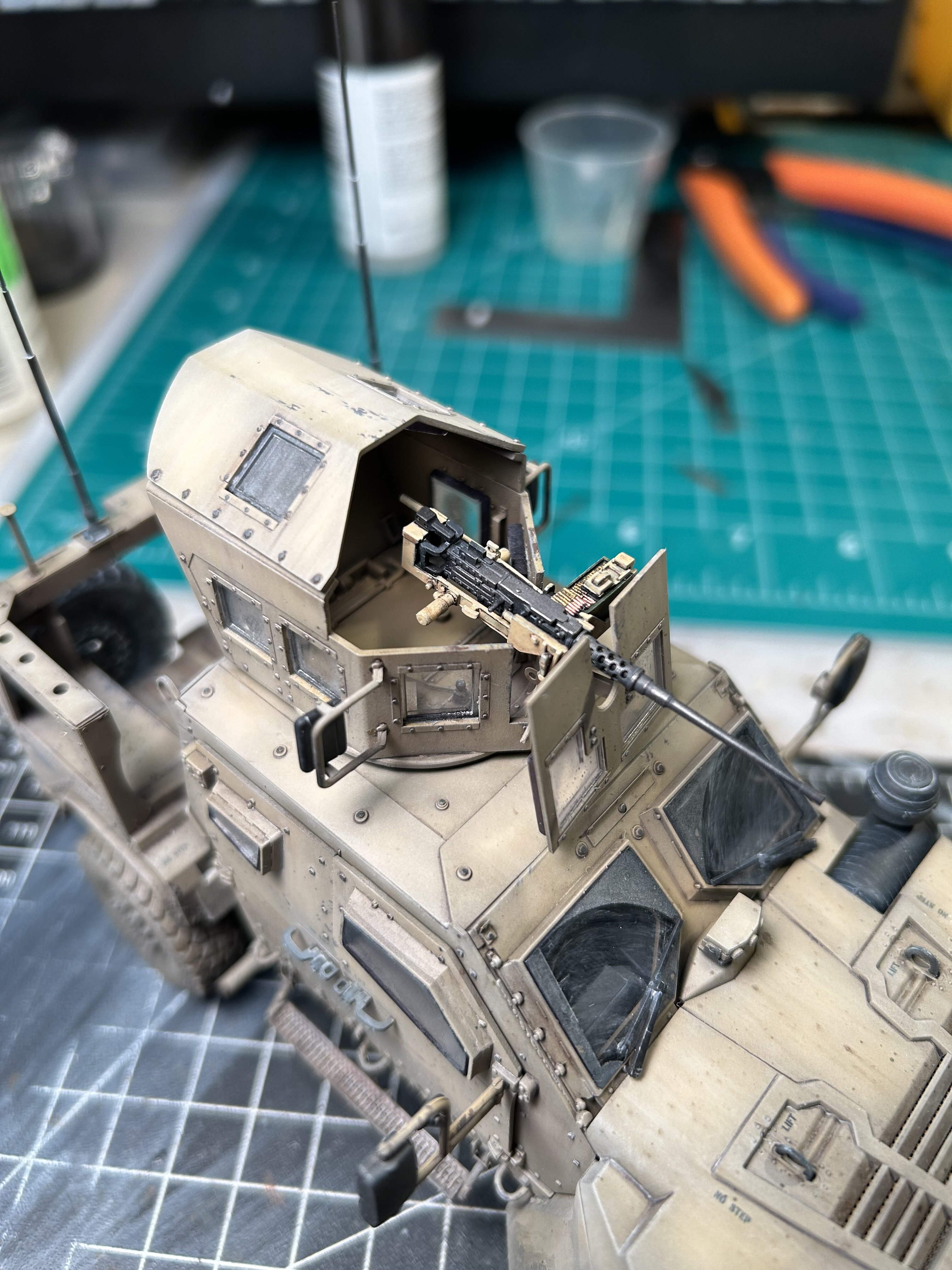

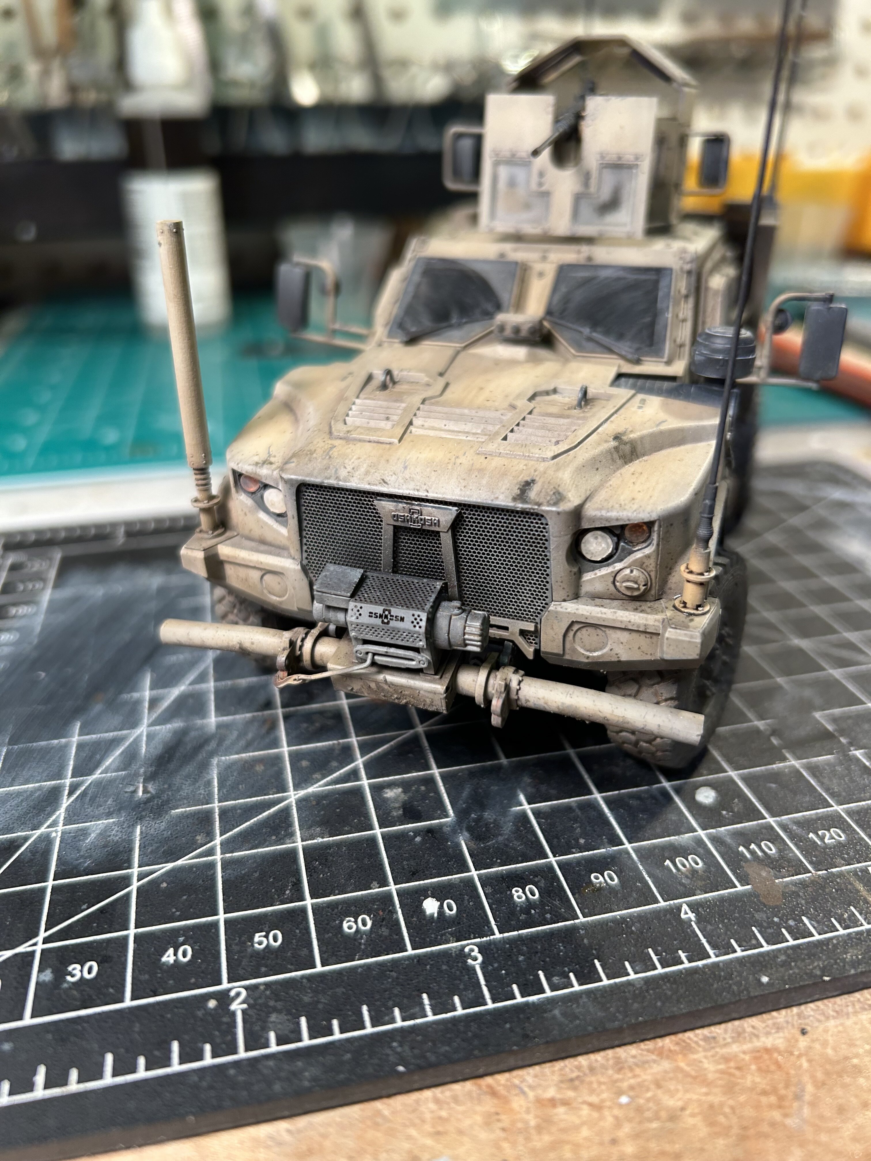

Grungy JLTV is complete. Starting to work on some stowage. Doors are not glued on. Will likely have at least a couple of them open once I settle on a diorama idea.
Had a moment of horror just before I started weathering. I was squeezing some white paint out of one of those Valejo bottles onto a pallet and had the model too close. Opening had some dried paint on it that let loose and squirted white paint on the model. I quickly was able to remove most of it, but not entirely. Had to apply some weathering a bit heavier in certain areas to hide what remained.

It turned out really great. Nice and muddy. The windshield looks awesome with those wiper streaks
@pengbuzz The theme song started going through my head the moment I saw your progress! It looks GREAT! The master of Masking Tape is back!
@Kurt That's a PRO looking paint and weathering job! You just need to Photoshop some people in their and it would be hard tell what's real and not! - MT

Wow @Kurt absolutely stunning!!!

I check in for a minute to see what's up, and all I see is a masterpiece.
Very nice dirt on that.

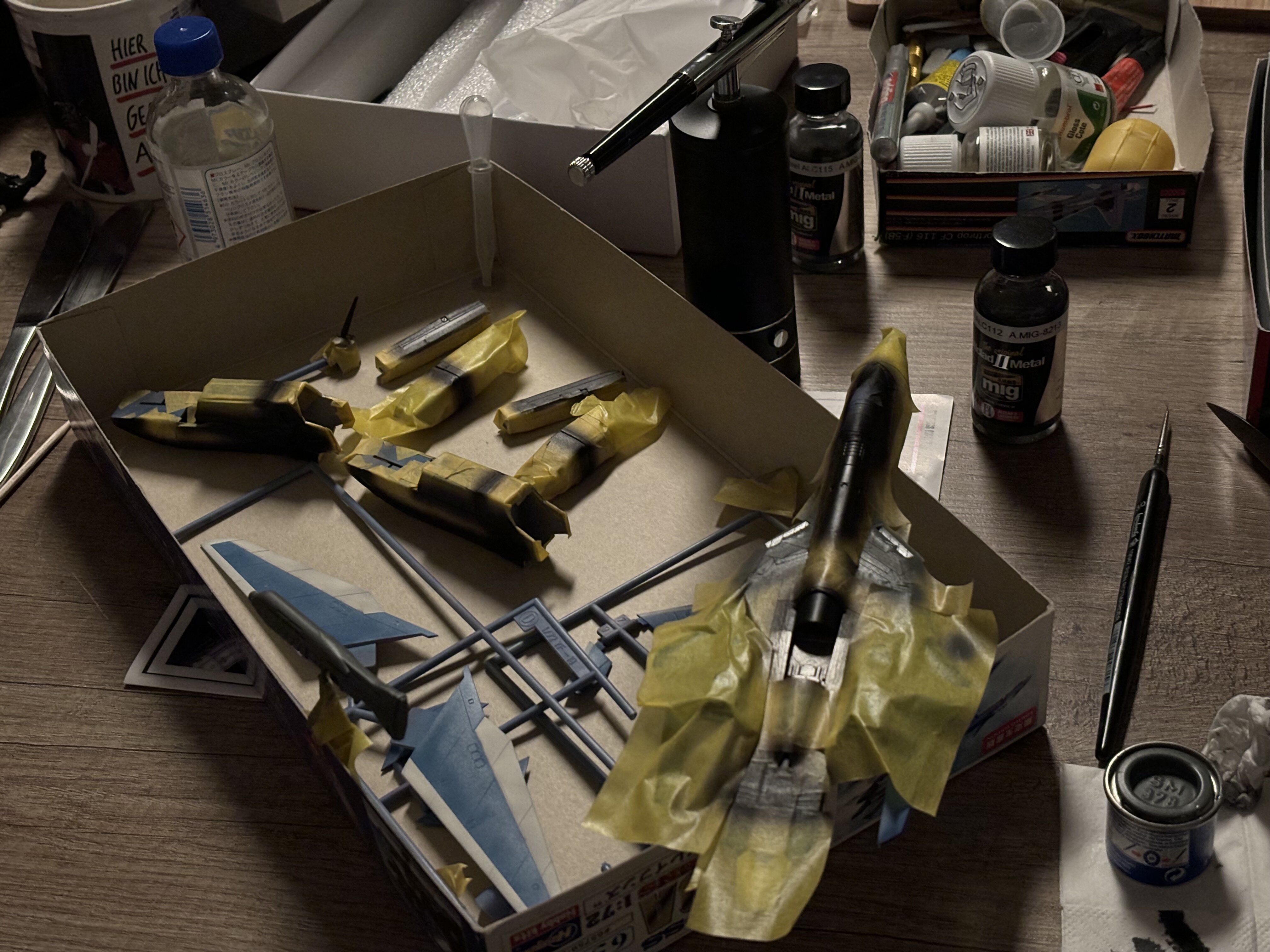

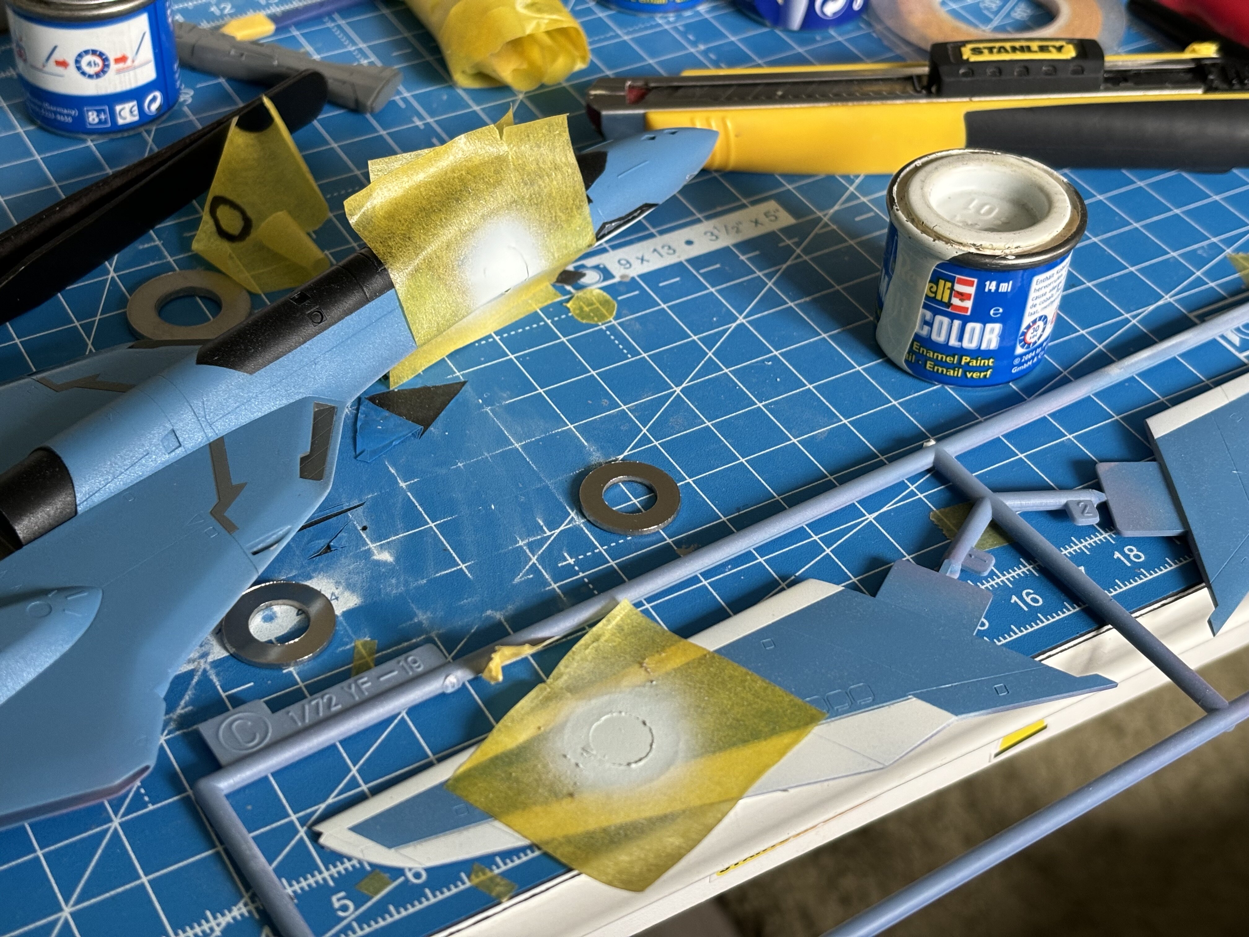

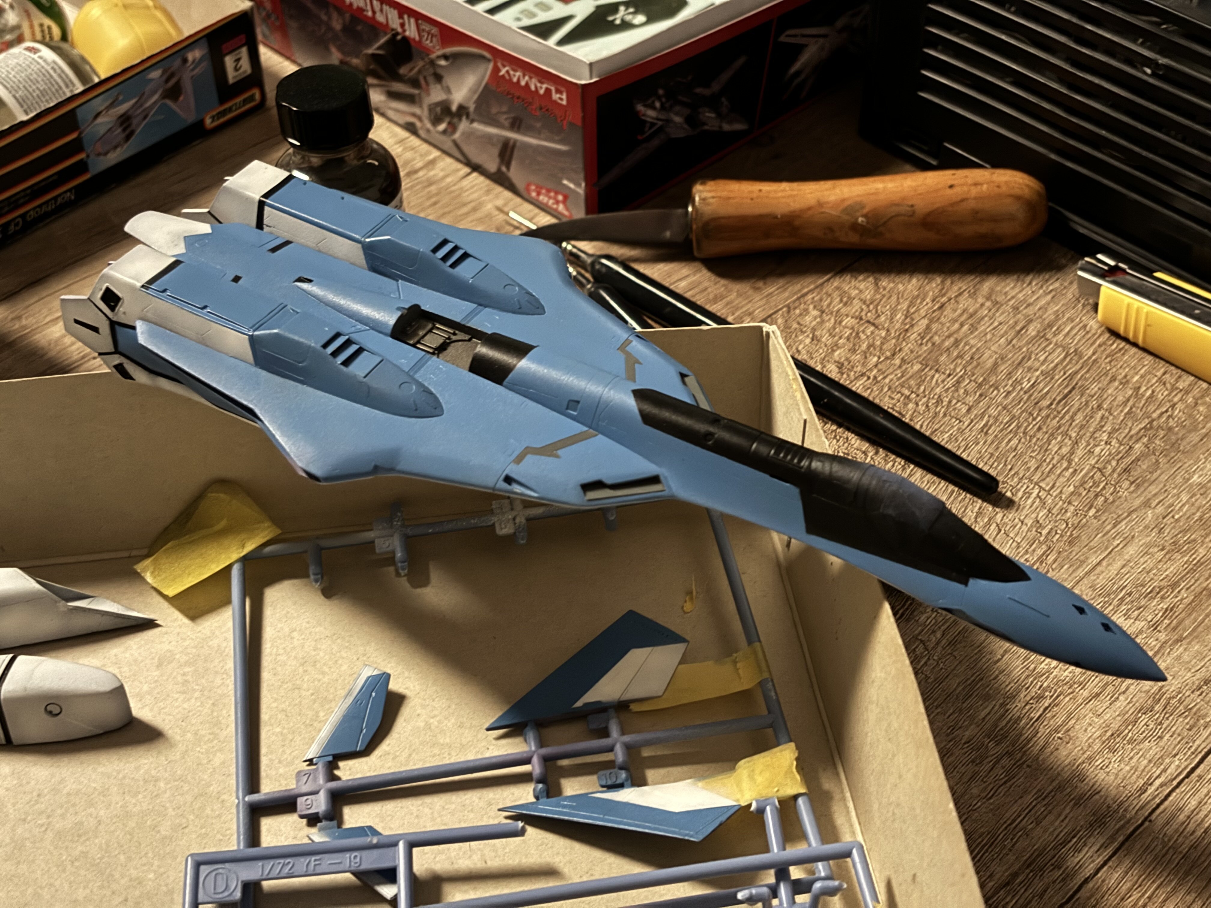

I decided to work a bit on my backlog. VF-19A.
Masking masking masking:
Airbrush airbrush airbrush:
Peeling peeling peeling:
YAY!

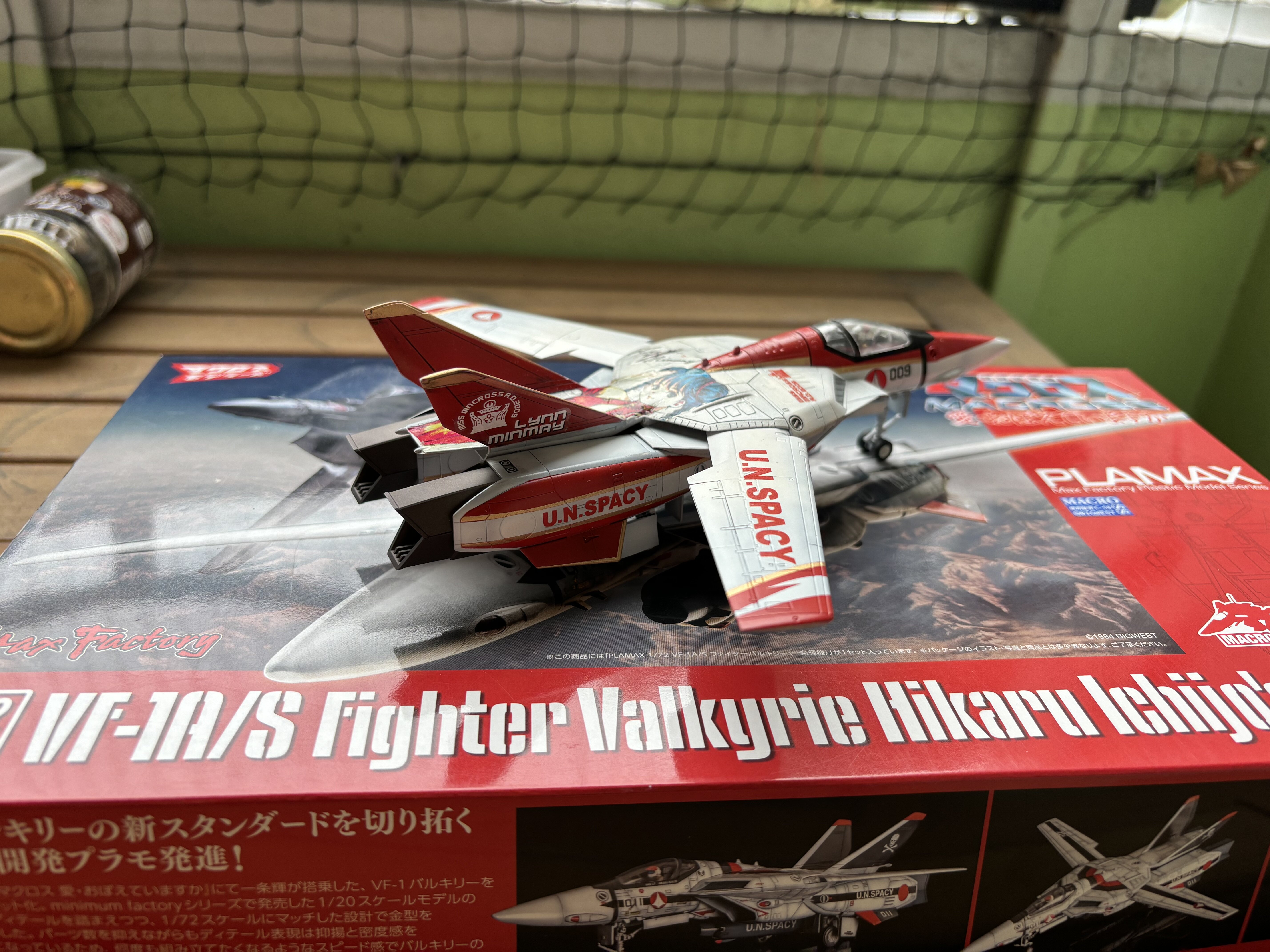

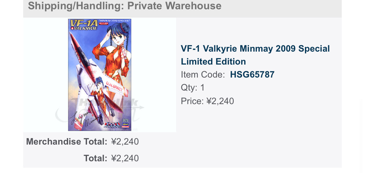

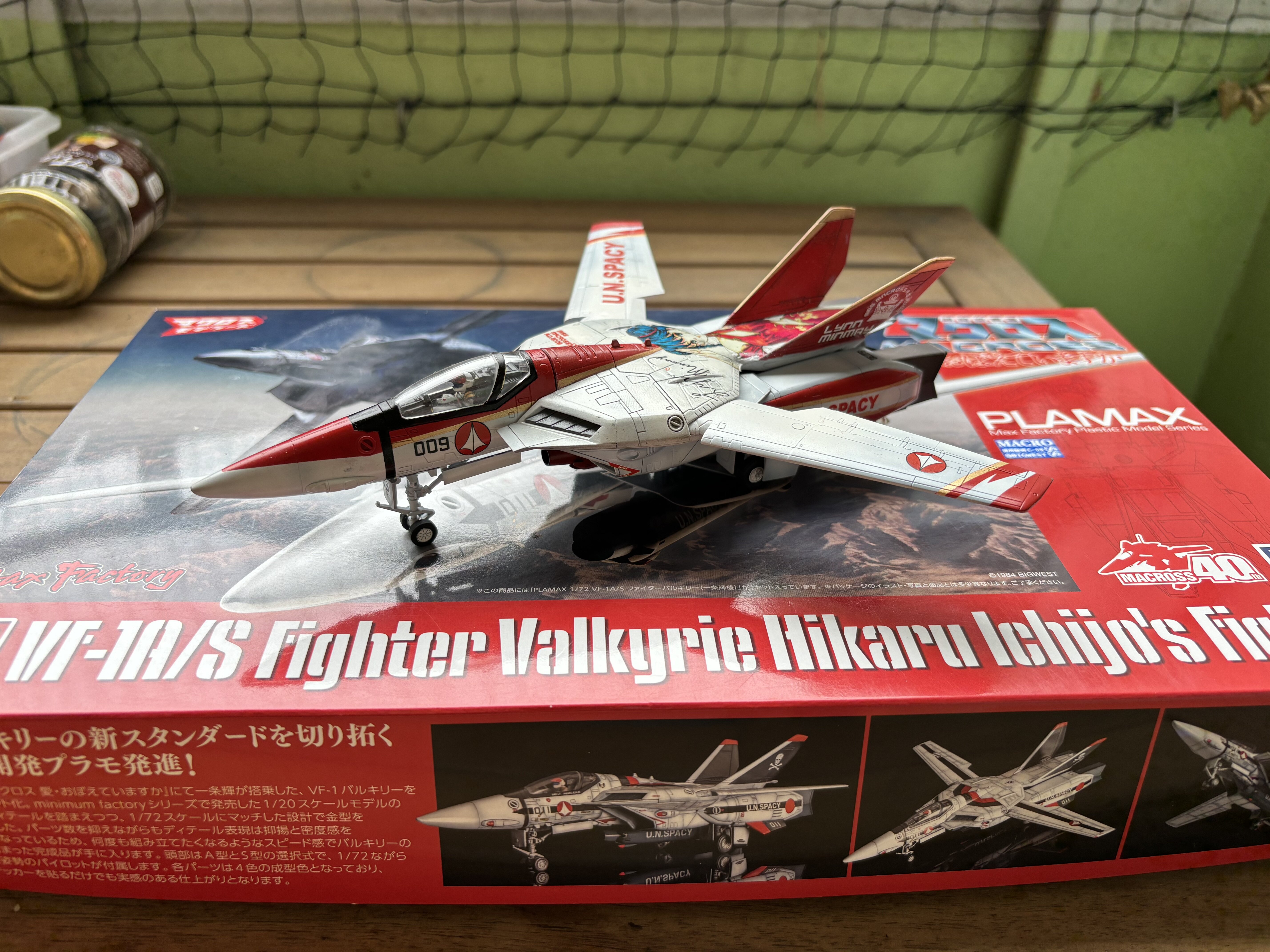

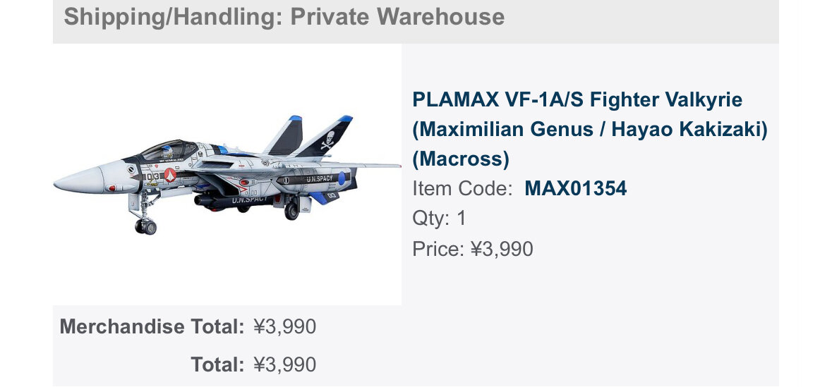

I decided that I am done with the PLAMAX VF-1. Botched… too man fingerprints and messed up paint job. I ordered a new one and will try again. No pictures as it is too embarrassing. The kid will have a new toy haha.

@Urashiman Sorry about the Plamax VF-1, but there are more out there to buy! As to the VF-19, I'm liking the blue. And that is master-masking!

Thanks a lot!
I mean, from far it doesn’t look too bad.
But I ordered more…
@Rock Your mods are a great improvement over the stock!
@electric indigo That kit has some NICE details molded into it! Mold making for that must have been a bear to do! Your painting is CLEAN as usual.
@Urashiman The -19 is coming along nicely! Your VF-1 (if it REALLY is that bad) is what we call a ten foot model. It looks good 10 feet away😁
@Thom Clean intakes! What will it become...
@pengbuzz The Lady is looking good!😉 - MT
@MechTech pictures were taken from around 1-2 feet away :)

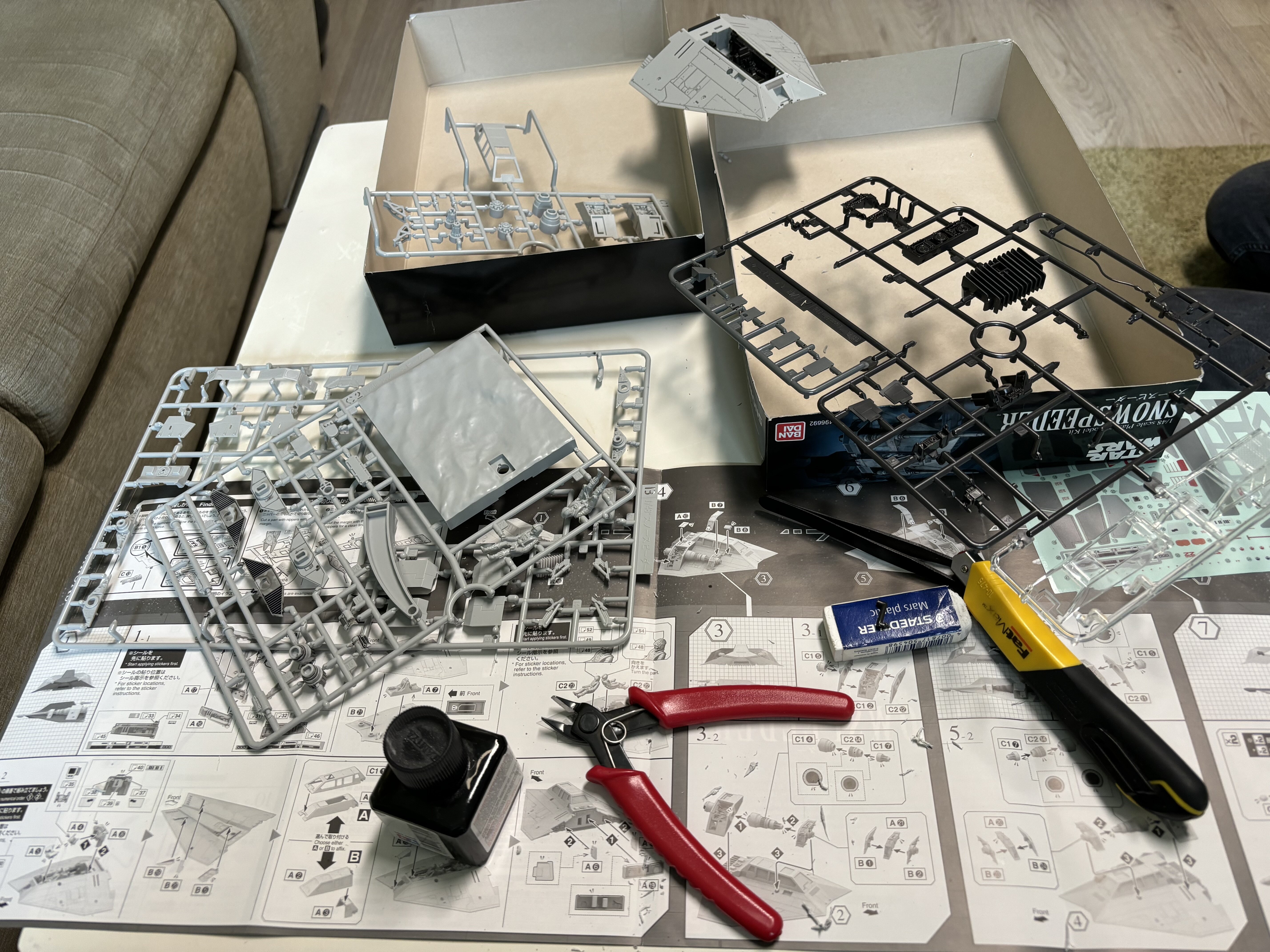

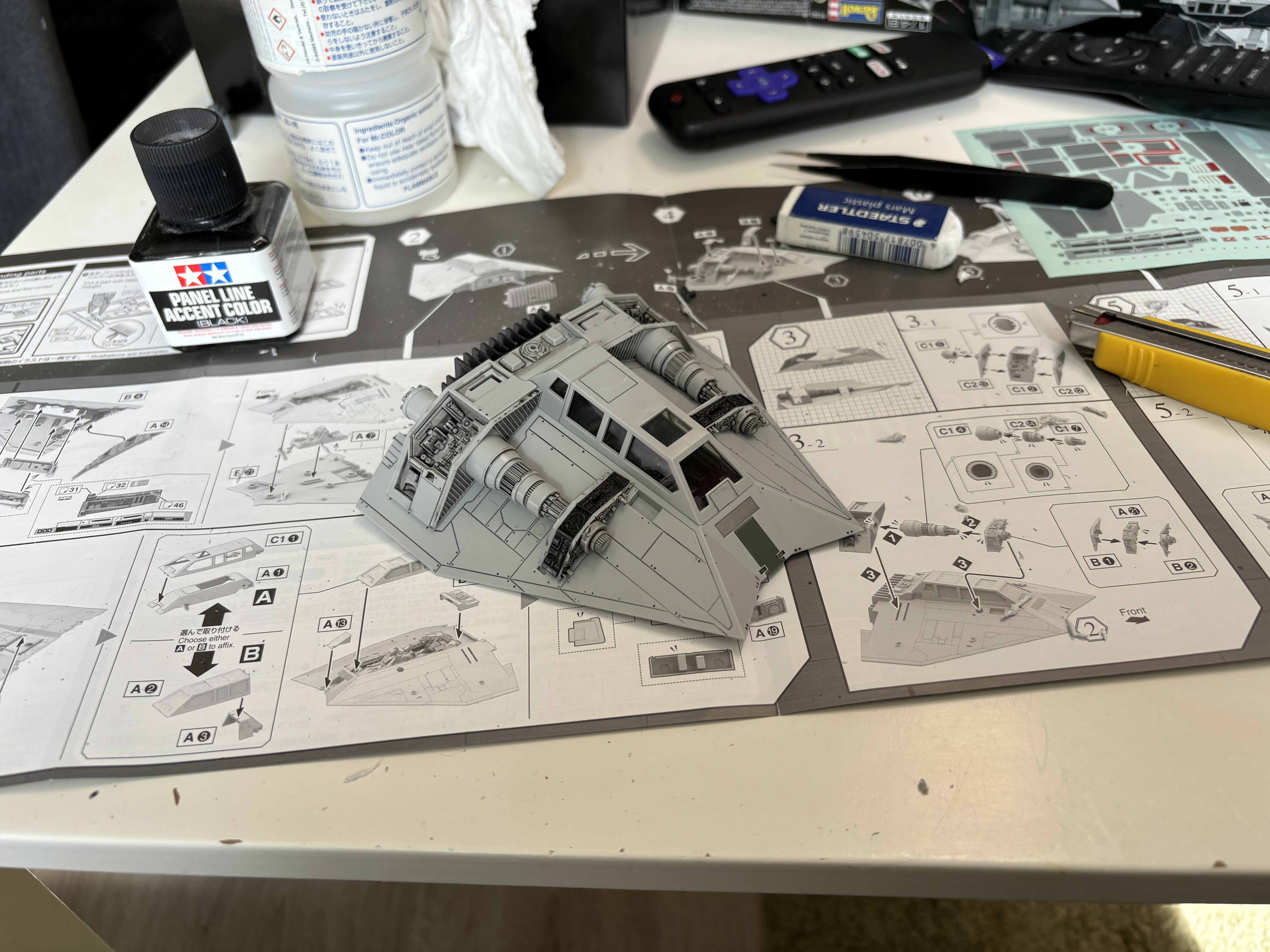

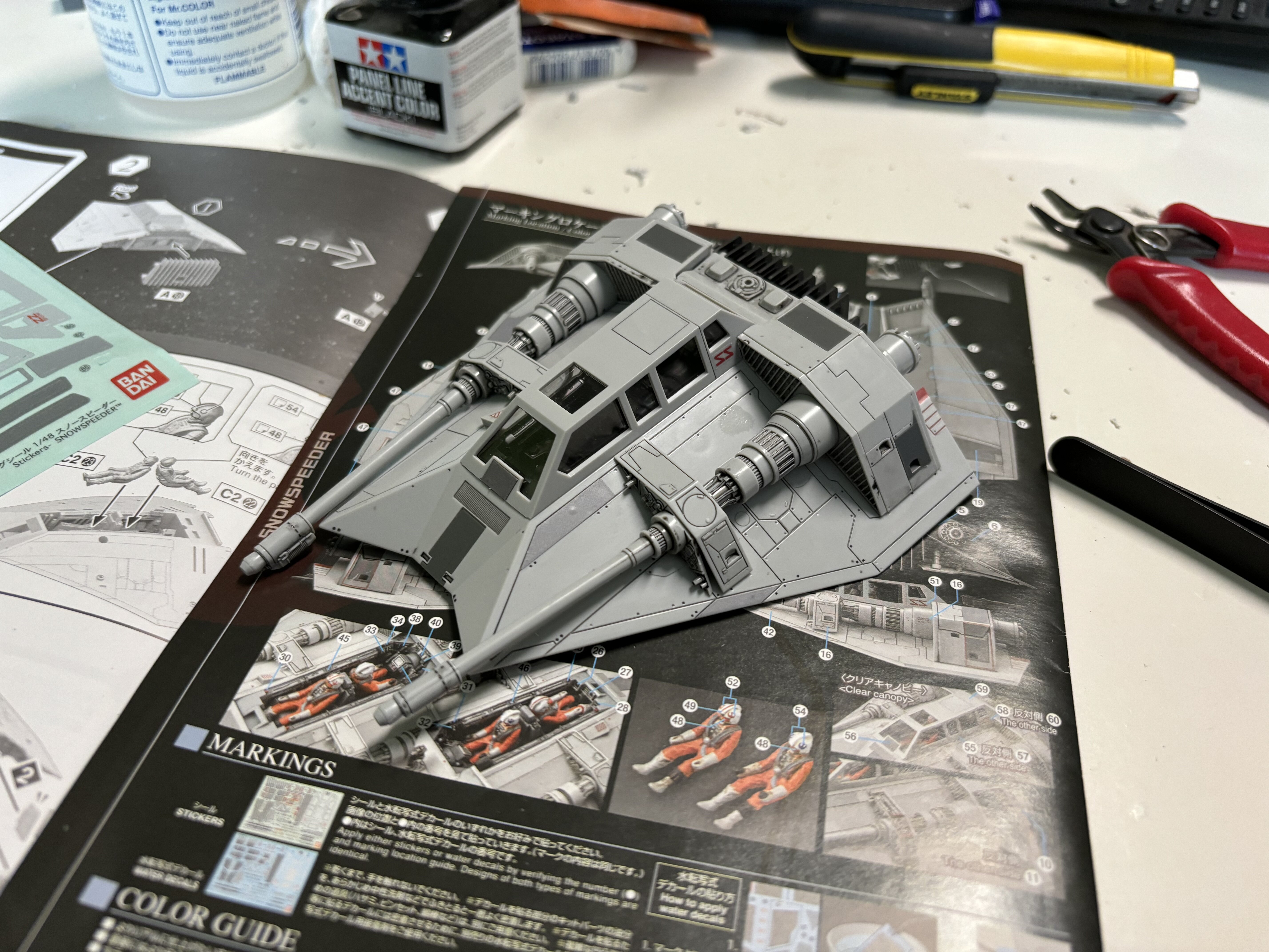

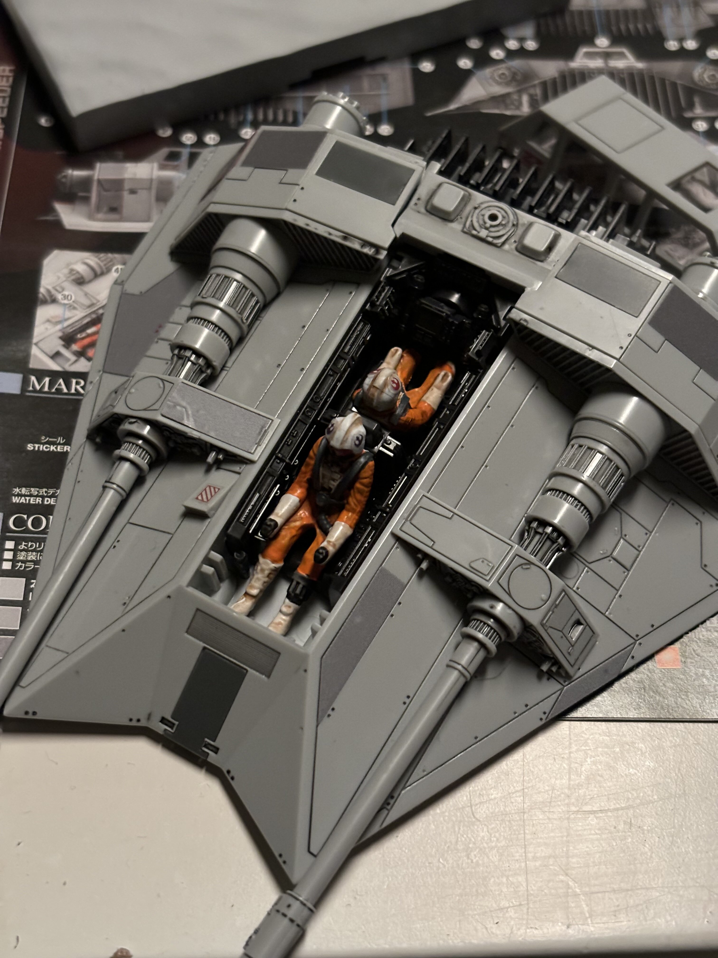

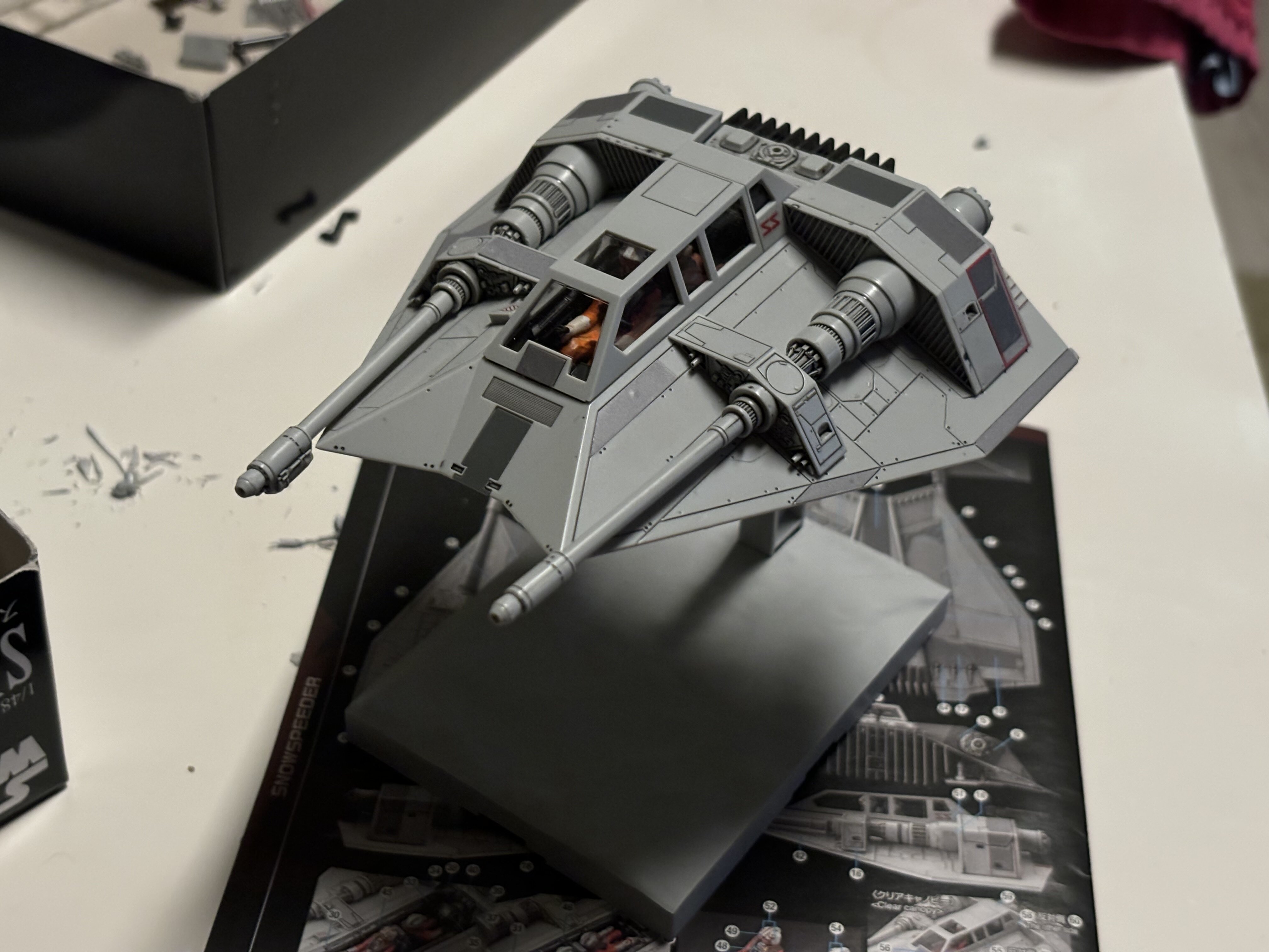

Another quick build today. I don’t think I‘ve finished that much kits in such a short time for long.
A star wars kit. Haven’t build one in years.
@Urashiman I remember! It may have subconsciously helped in deciding to build this one. I actually wanted a quick build for a model show coming up in a week. And, except for some fiddly construction, it has been.
That snow speeder is looking real nice, but don't poo-poo the VF-1 too much. She looks like she'll be a nice shelf queen.

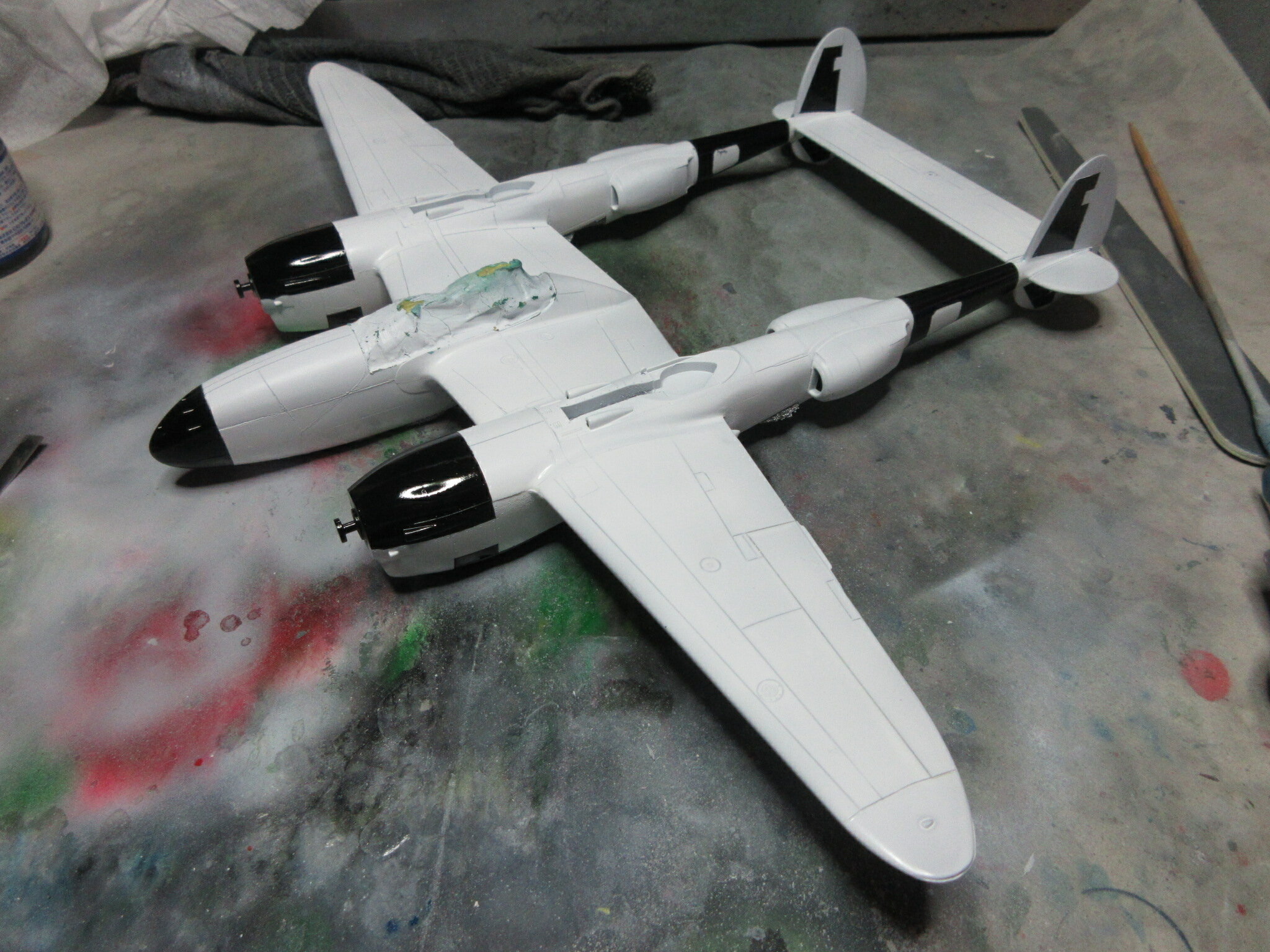

I've finished airbrushing my P-38 with gloss white with gloss black panels. When I spray the kit with a silver overcoat, these alternate panels will show through differently.

Yeah. It has been declared accessible for the scion. He likes it.

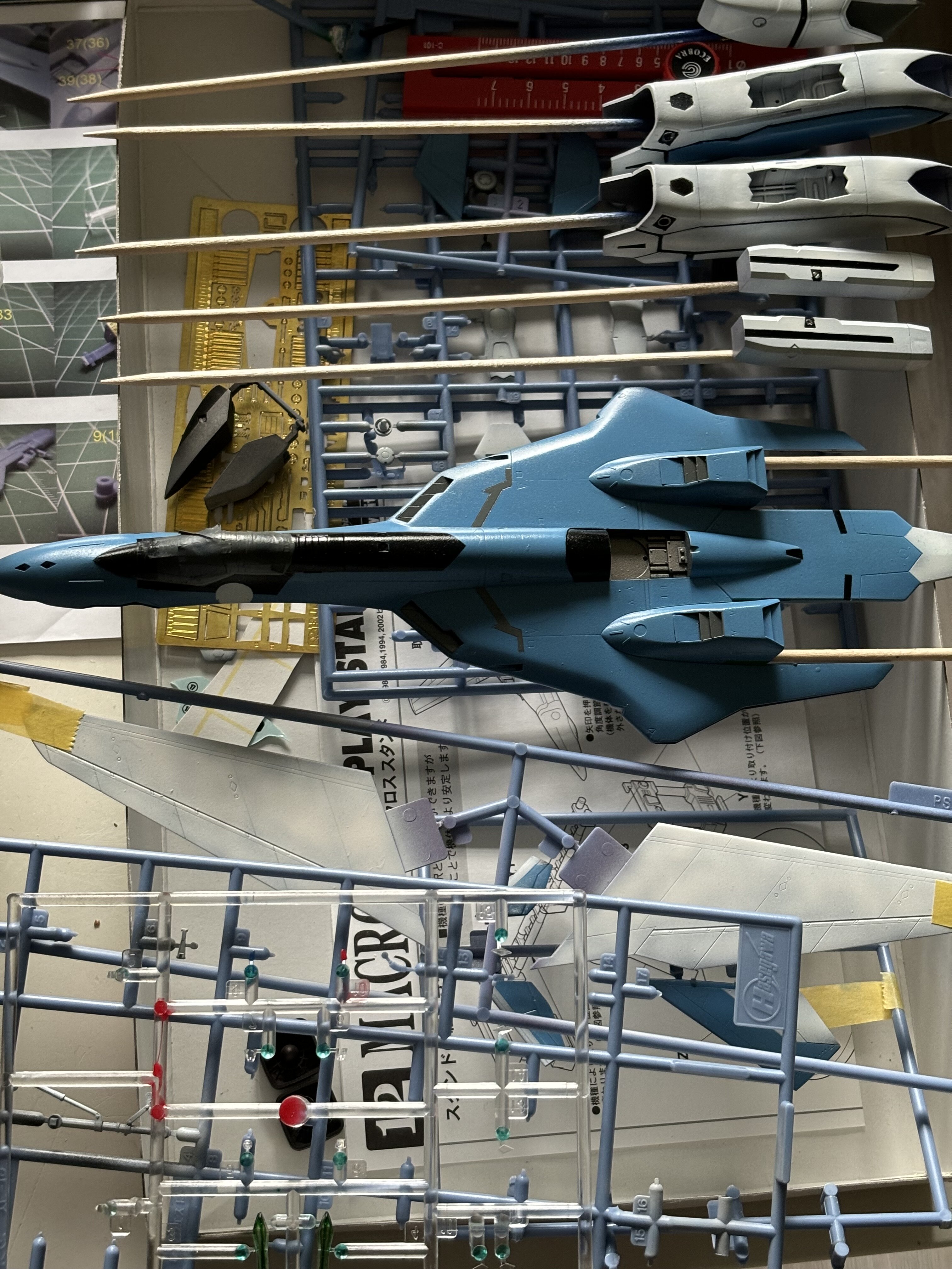

Now on to the VF-19 front.
Paintjob done, gloss coat applied. Now it needs to cure for 24 hours. Then I can oil color wash it. Then decals after the wash.

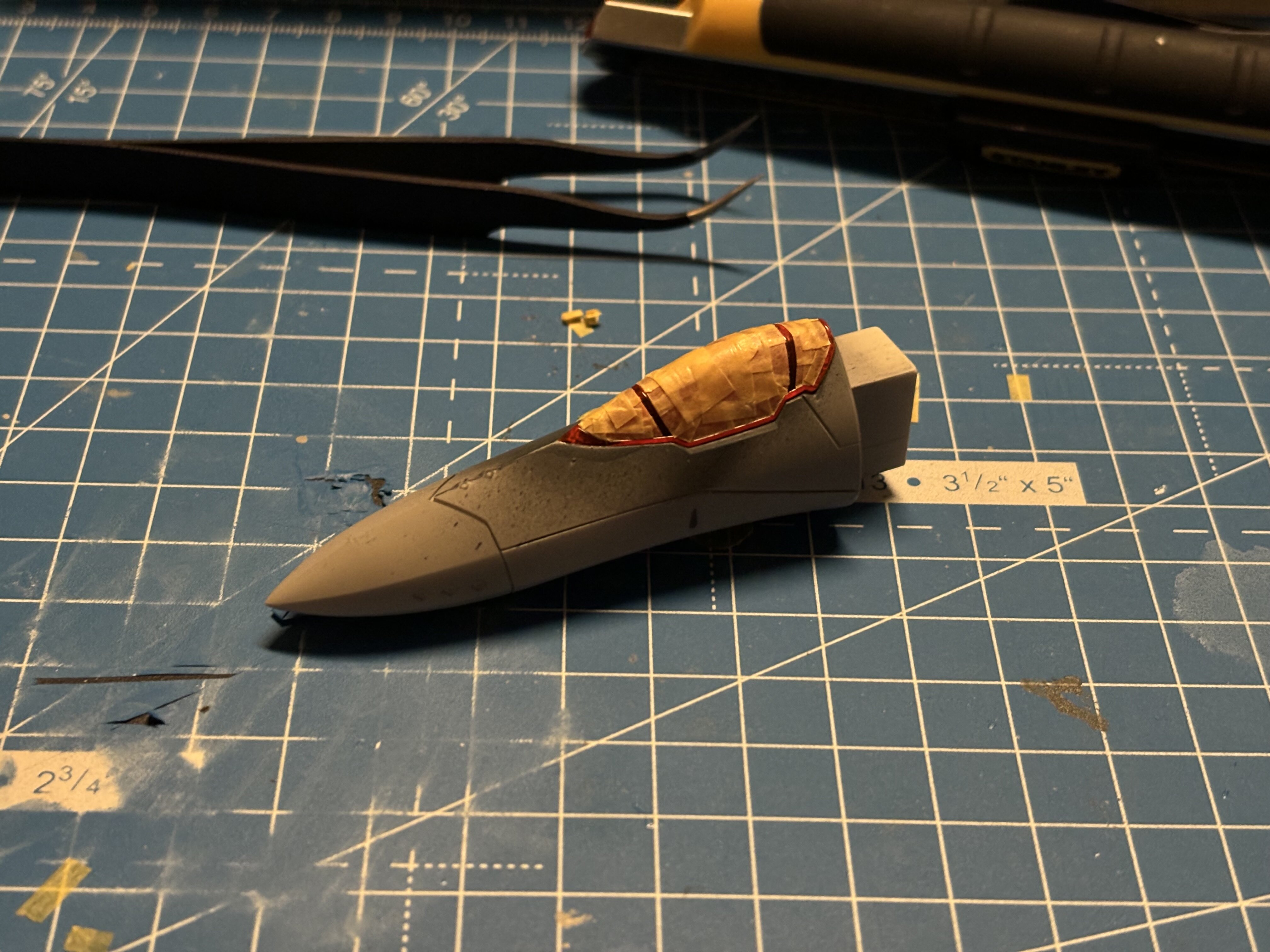

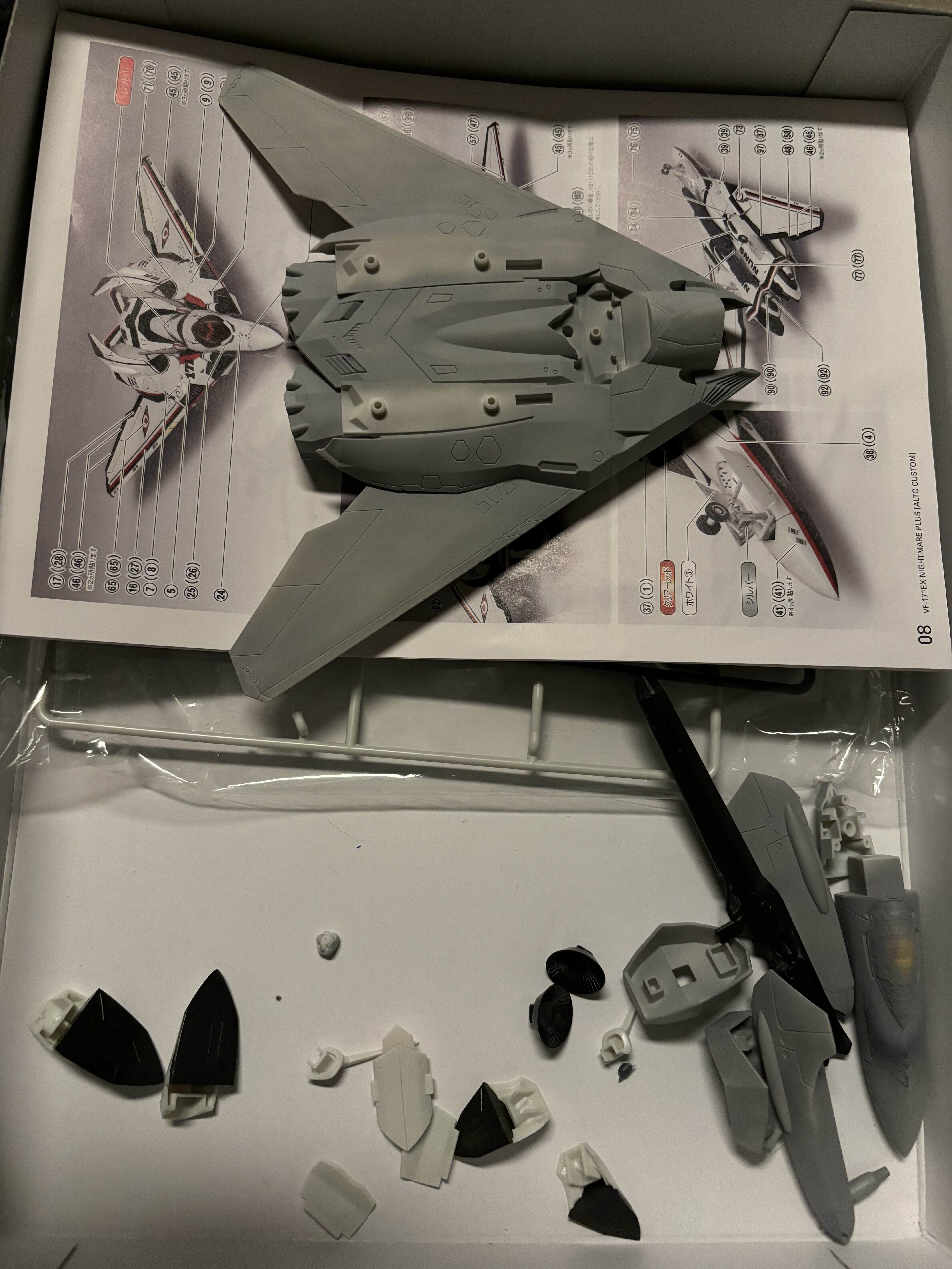

Fiddling with the VF-171 Alto Custom.
Canopy masking; All time favourite.
