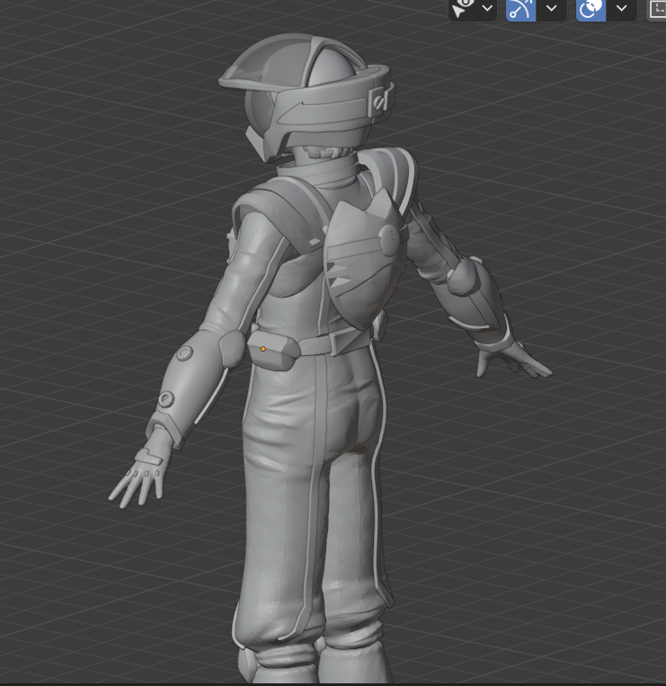

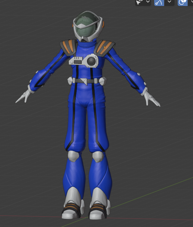

arbit Posted January 27, 2024 Posted January 27, 2024 (edited) Some progress I'm happy with. And more detail. Edited January 27, 2024 by arbit Quote

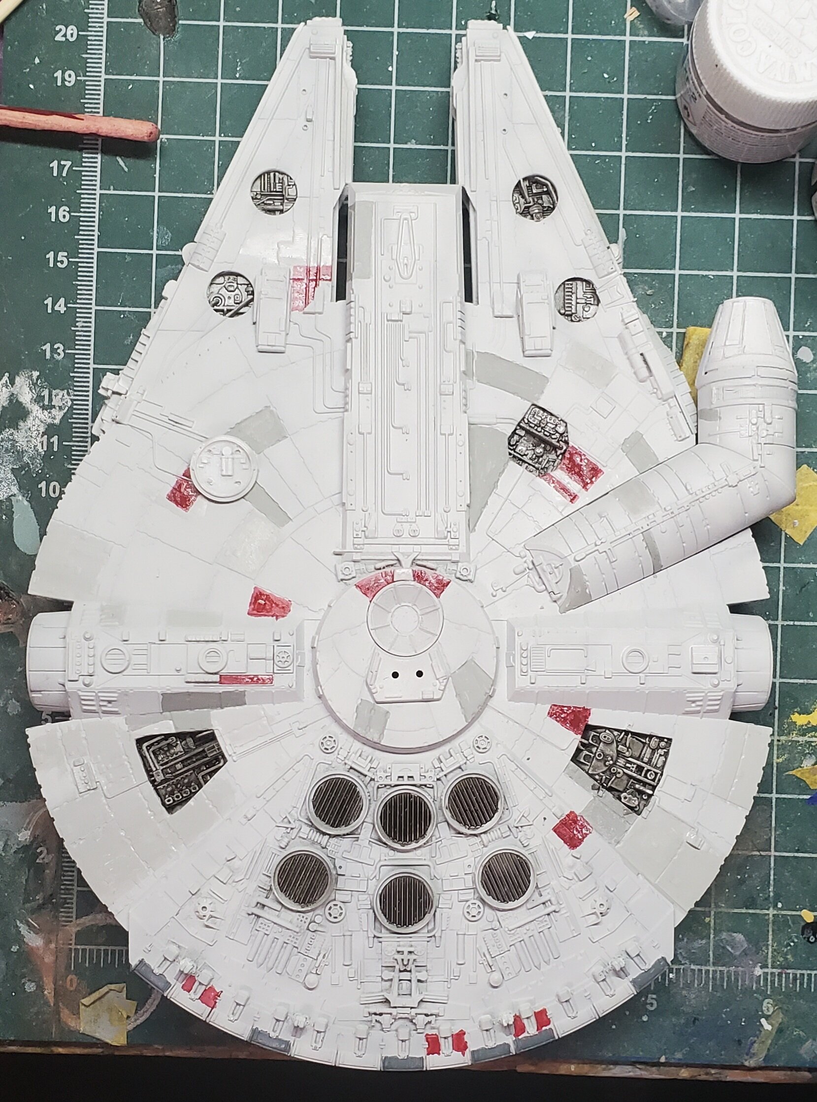

Chas Posted January 28, 2024 Posted January 28, 2024 Detail paint done ( sorry 'bout the glare, forgot to turn the bench lamp off) Gloss coat and first go at oil wash. Quote

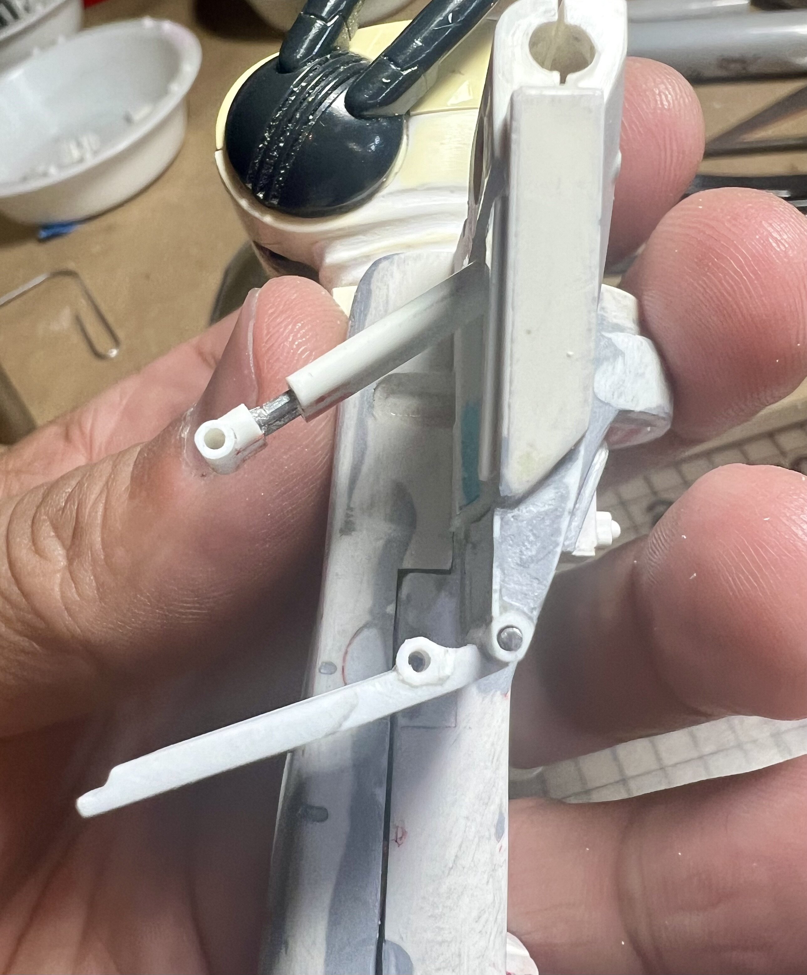

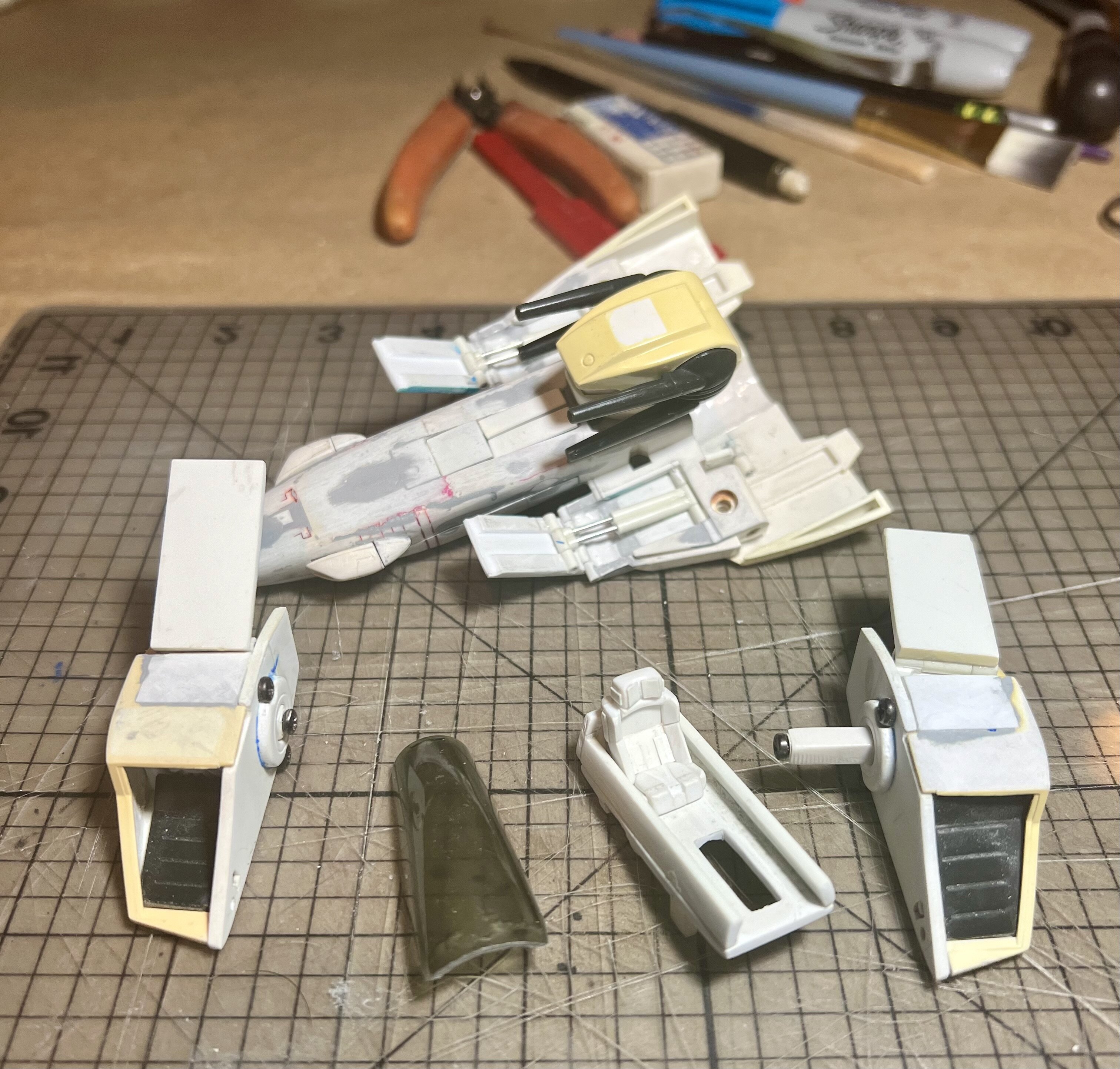

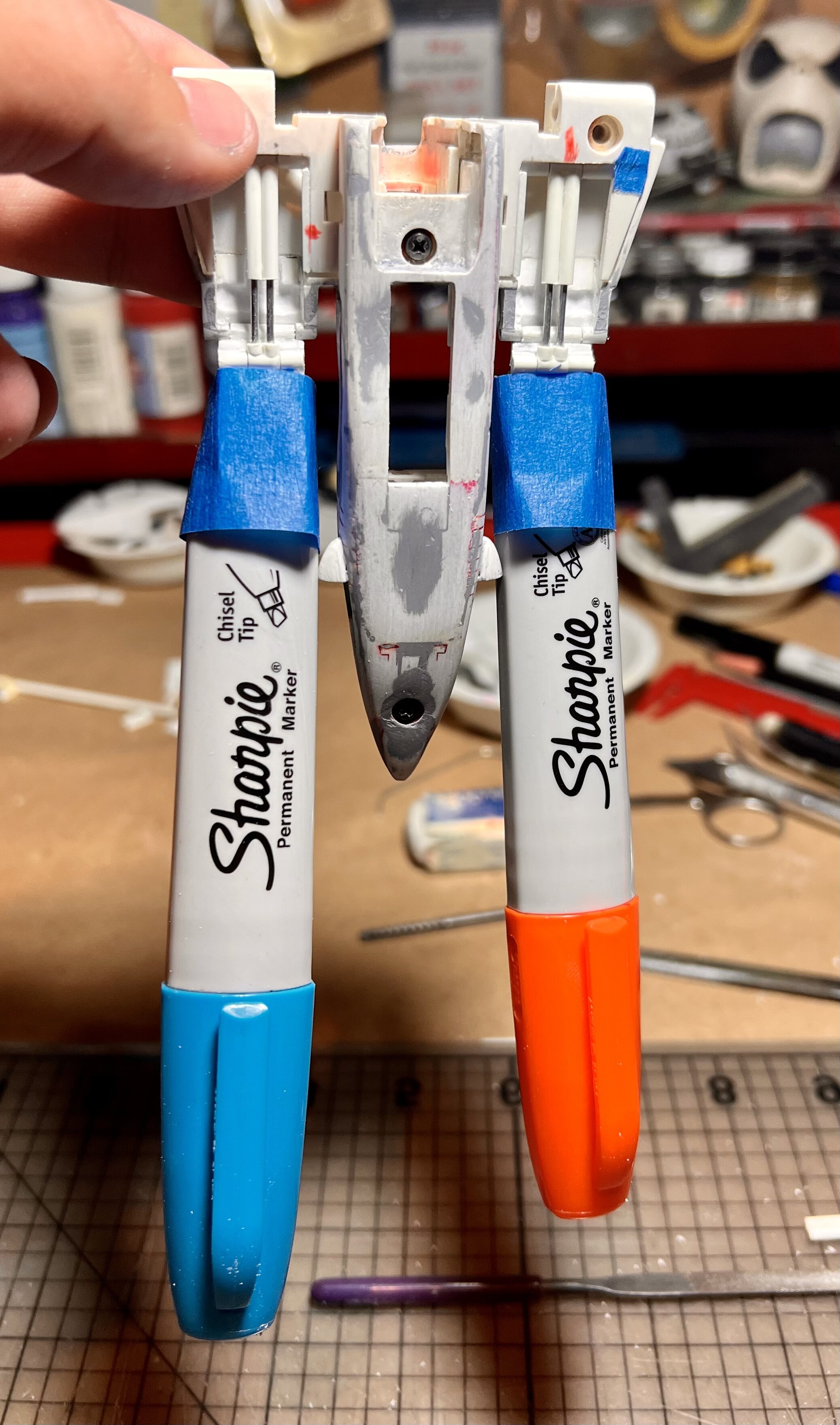

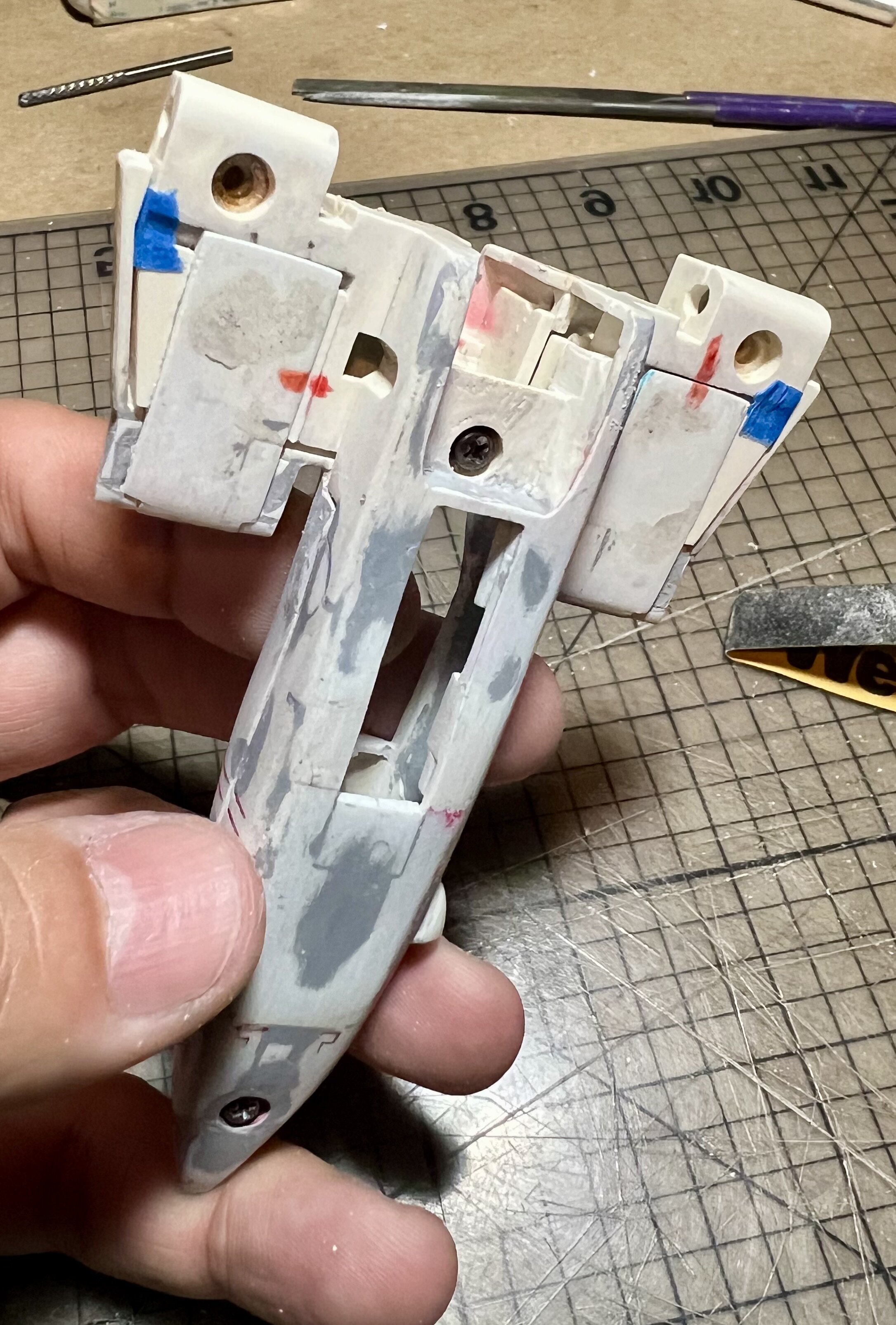

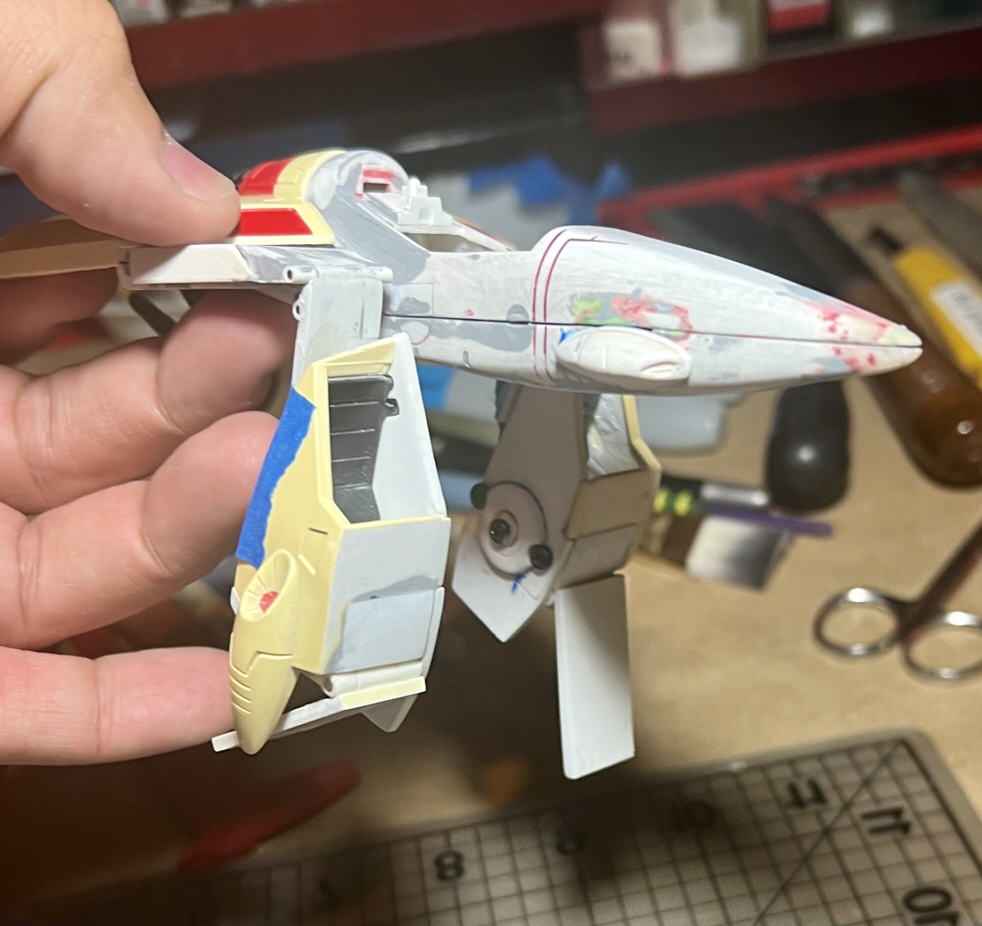

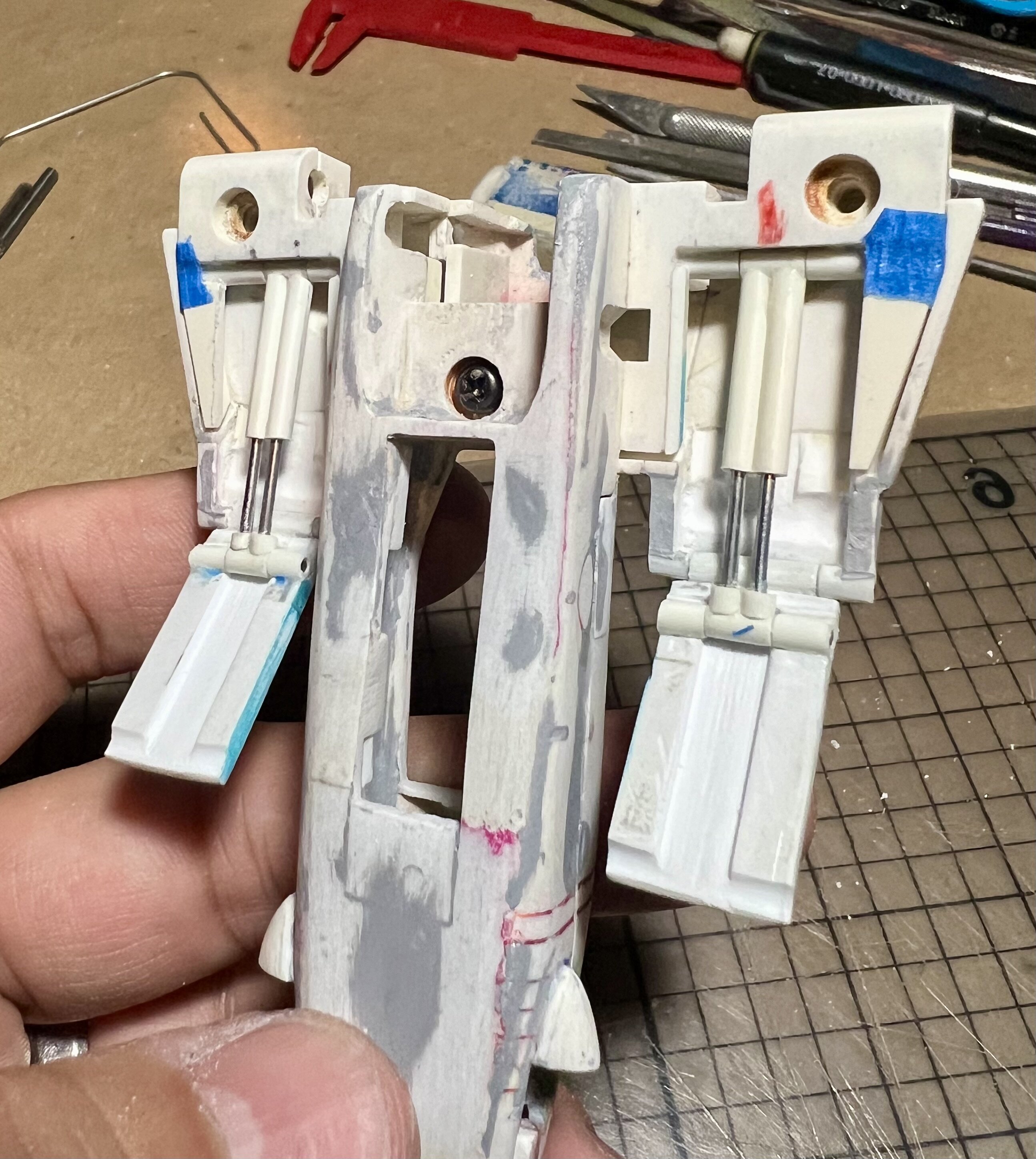

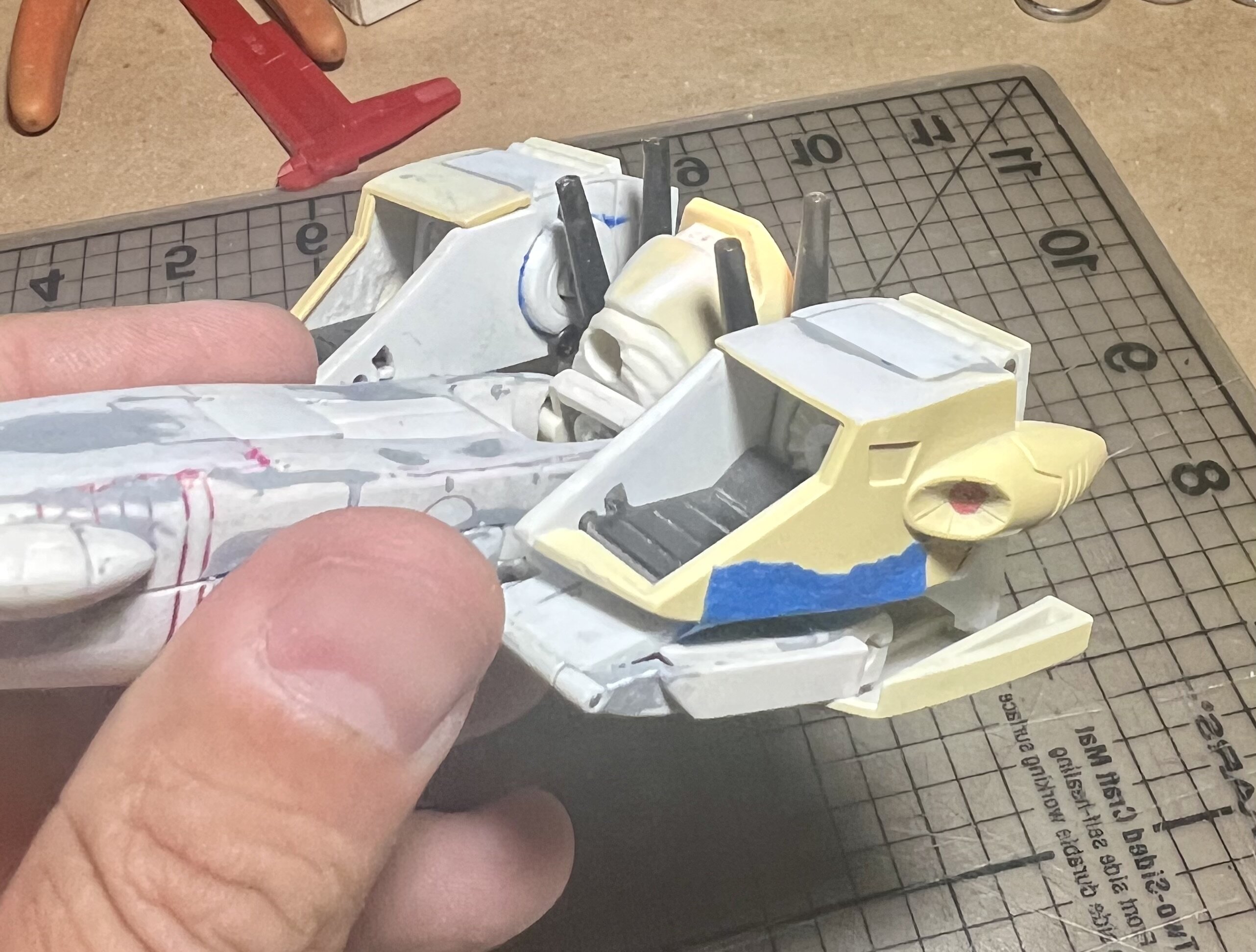

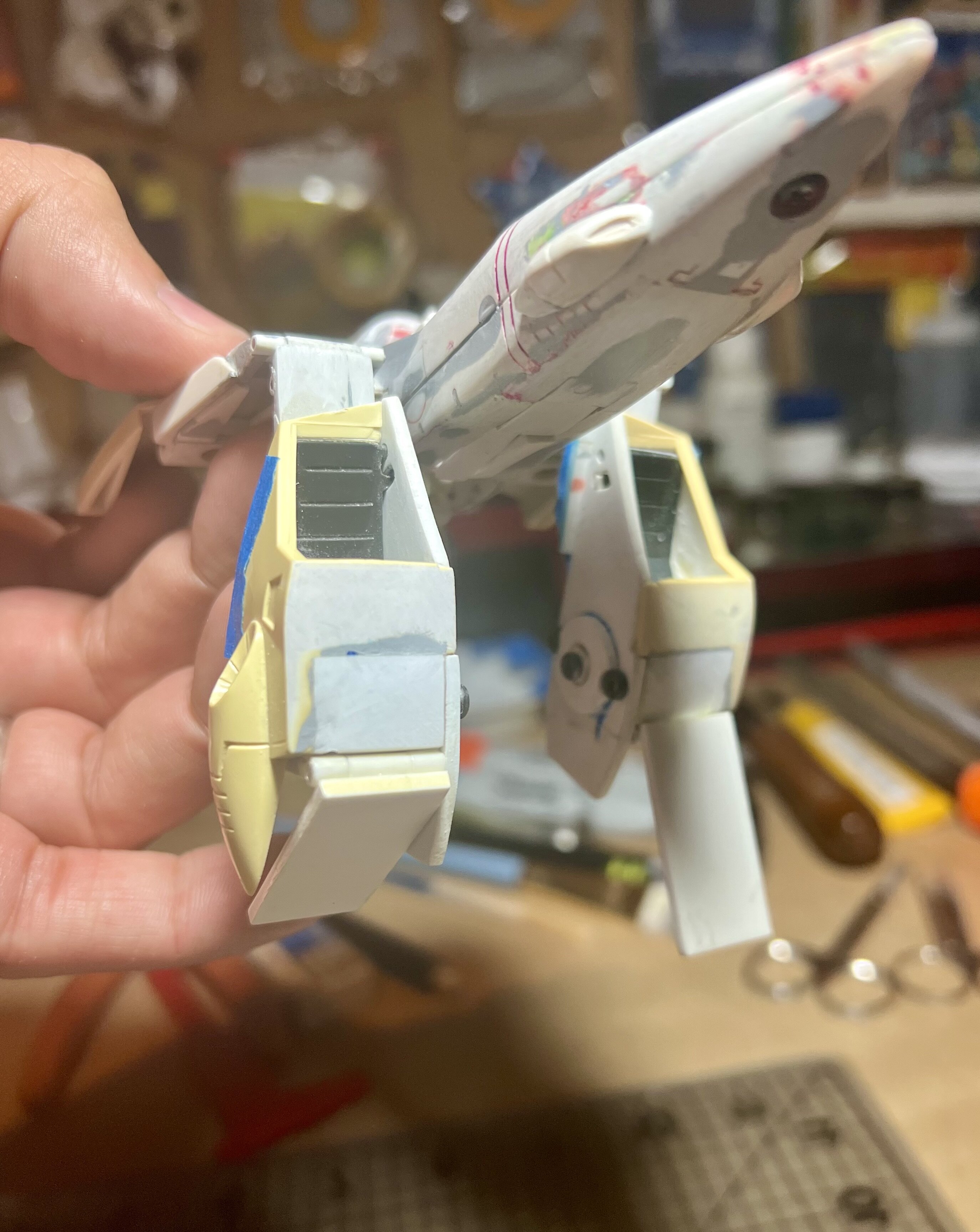

nightmareB4macross Posted January 28, 2024 Posted January 28, 2024 There are so many great projects happening. You guys are all doing a fantastic job! Here is my humble update. Quote
Chas Posted January 28, 2024 Posted January 28, 2024 Nice workmanship there NB4M. So tell, about this, are your new parts Styrene? If so are they gonna be strong enough for the weight, stress and forces involved? How are you bonding them to the old plastic of the toy (ABS?)? Quote

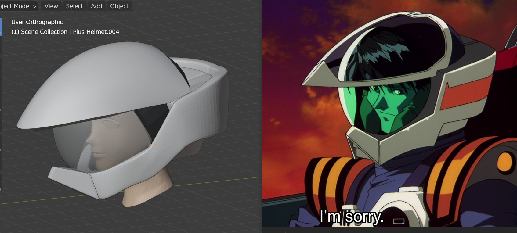

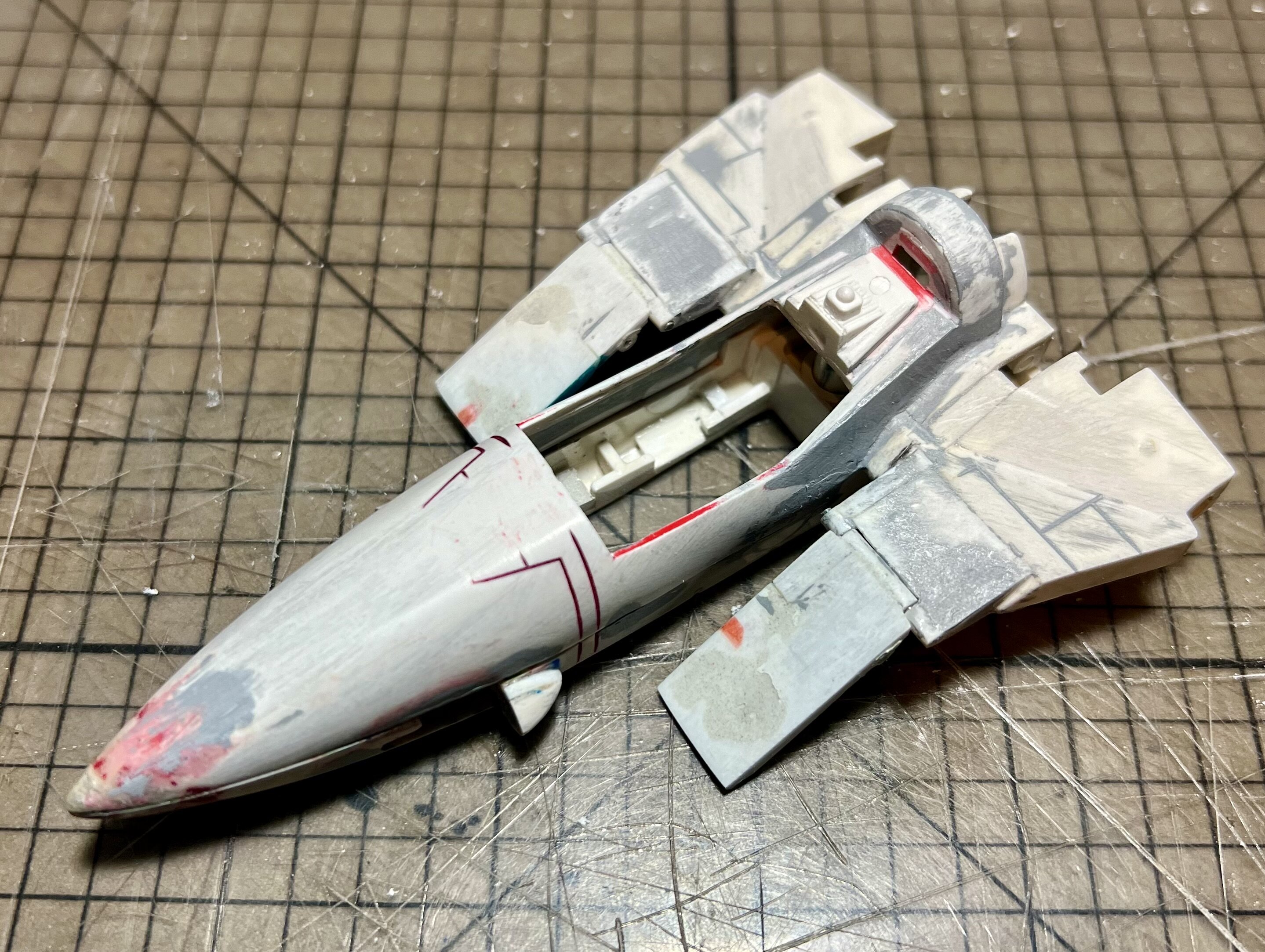

arbit Posted January 28, 2024 Posted January 28, 2024 (edited) Starting to come together. Edited January 28, 2024 by arbit Quote
nightmareB4macross Posted January 28, 2024 Posted January 28, 2024 2 hours ago, Chas said: Nice workmanship there NB4M. So tell, about this, are your new parts Styrene? If so are they gonna be strong enough for the weight, stress and forces involved? How are you bonding them to the old plastic of the toy (ABS?)? Thank you. Using nothing but styrene and PlasticWeld. The parts are plenty strong. This won’t be transformed liberally but will do the job just fine. Quote
Thom Posted January 28, 2024 Posted January 28, 2024 @nightmareB4macross Really liking that hinge/piston set up. Quote

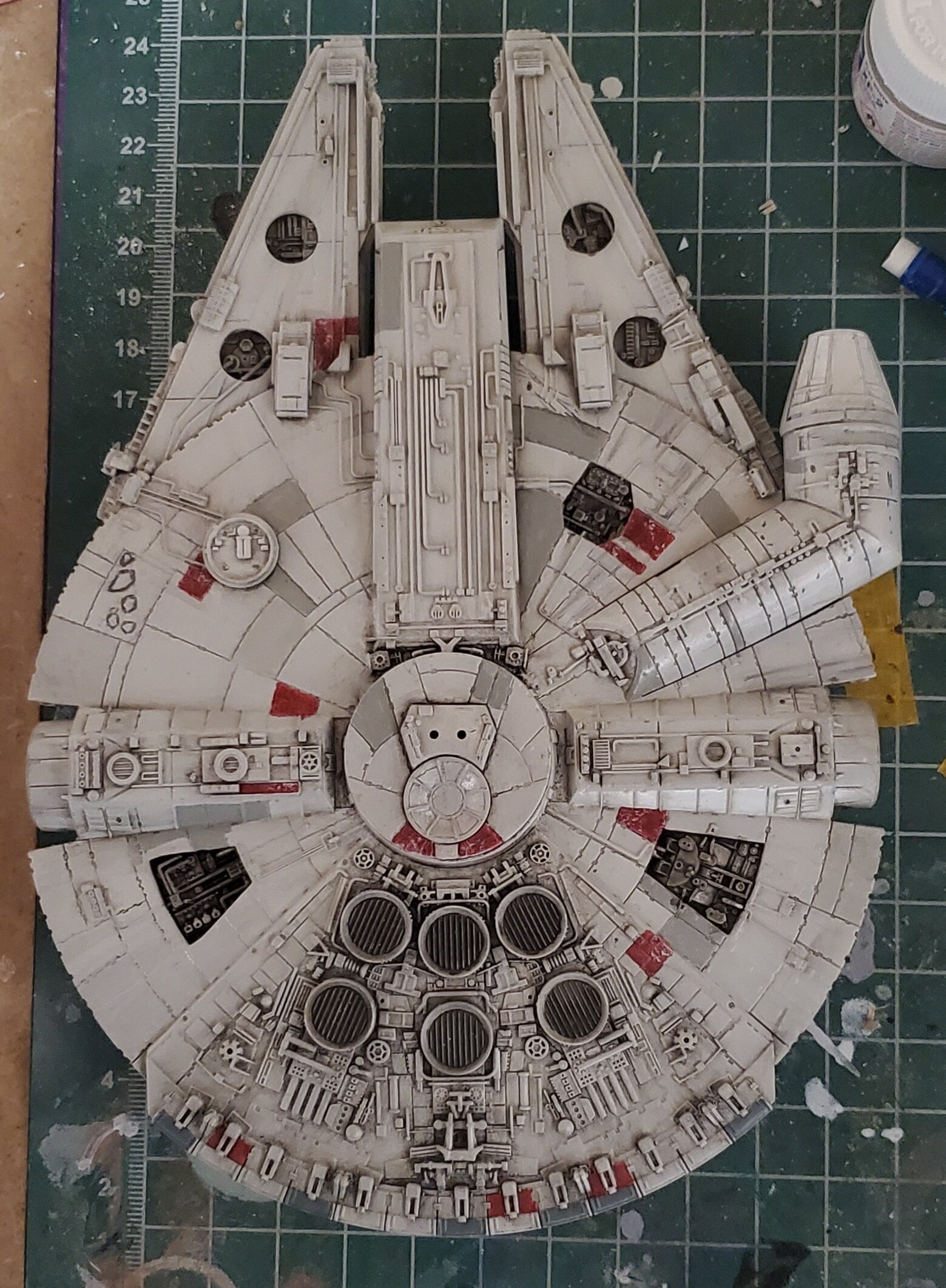

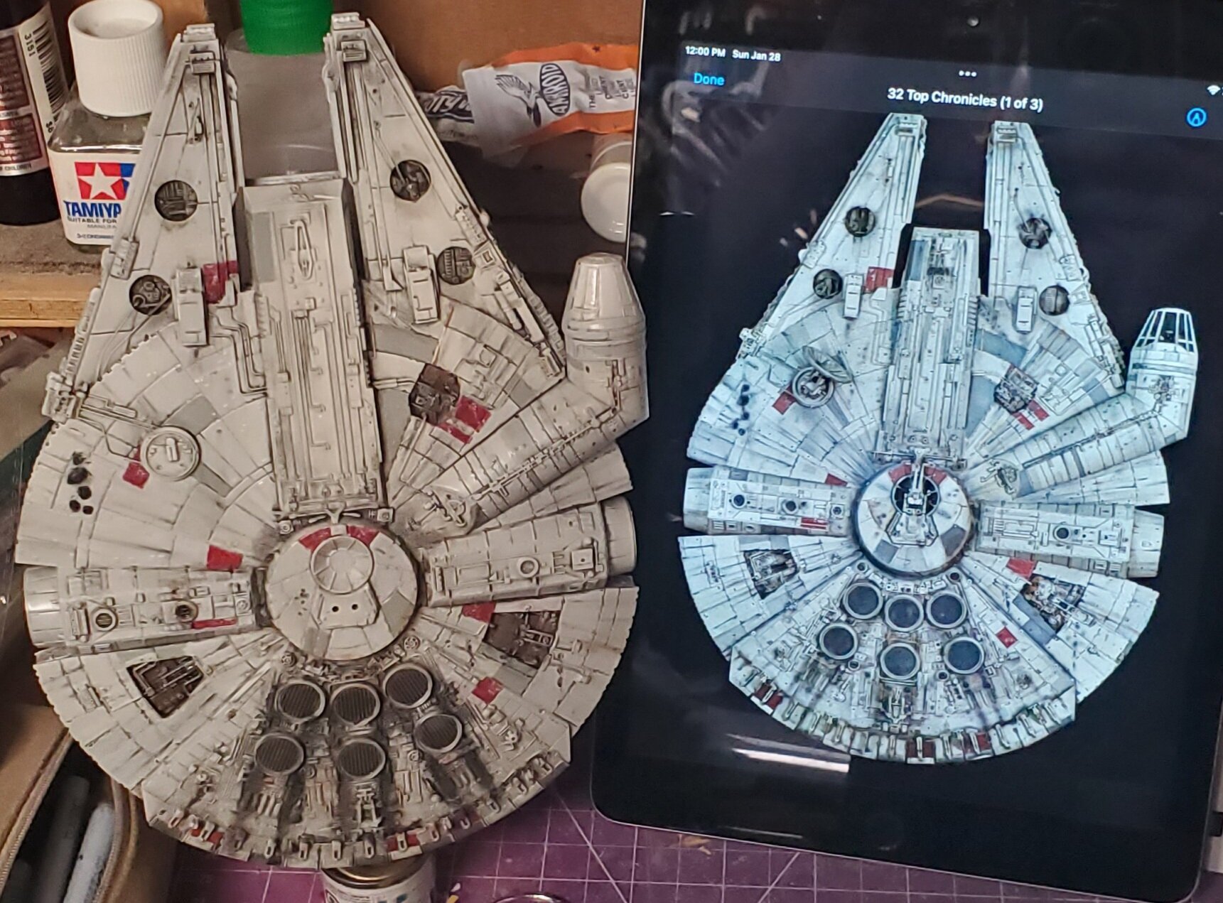

Chas Posted January 28, 2024 Posted January 28, 2024 @nightmareB4macross plastic weld? Is that MEK based ? or an epoxy? I'm very intrigued by the process of securely bonding different plastics together. Do you thoroughly scuff the two surfaces to give the adhesive some bite? I figured it wouldn't be used like a toy, but still the different assemblies that are being twisted, folded, extended and turned have some fairly good heft to them. Don't get me wrong I'm not doubting your assertion ( I'm certain you wouldn't be doing all this work if you weren't sure of your process). Just interested in learning how you work with such desperate materials being used in such high stress application. More weathering on the fastest hunk of junk in the galaxy. This time with a ref . Pic. Think I'll need to darken some of the grey panels a bit. Quote
nightmareB4macross Posted January 28, 2024 Posted January 28, 2024 3 hours ago, Chas said: @nightmareB4macross plastic weld? Is that MEK based ? or an epoxy? I'm very intrigued by the process of securely bonding different plastics together. Do you thoroughly scuff the two surfaces to give the adhesive some bite? I figured it wouldn't be used like a toy, but still the different assemblies that are being twisted, folded, extended and turned have some fairly good heft to them. Don't get me wrong I'm not doubting your assertion ( I'm certain you wouldn't be doing all this work if you weren't sure of your process). Just interested in learning how you work with such desperate materials being used in such high stress application. More weathering on the fastest hunk of junk in the galaxy. This time with a ref . Pic. Think I'll need to darken some of the grey panels a bit. Greatest Space Junk Ever! Seriously though, that is coming out great. Plastruct is MEK based. It bonds by melting the surfaces to allow for a really strong bond. For mating surfaces I increase the mating surfaces to allow better adhesion. Contouring parts to fit better makes them strong. And I typically make my own pins from metal rods. As an example, you can see how the tubing is inserted into the flat surfaces of the hinge plates and the leading edges below the intake areas. I file away material so parts can be embedded and increase strength. With tubing I do the same by shaping the ends to lay onto more curved surface of a perpendicular tube. Most times I stagger hinge joints to allow for increased dispersion of stress on a joint. Hope this helps. Quote

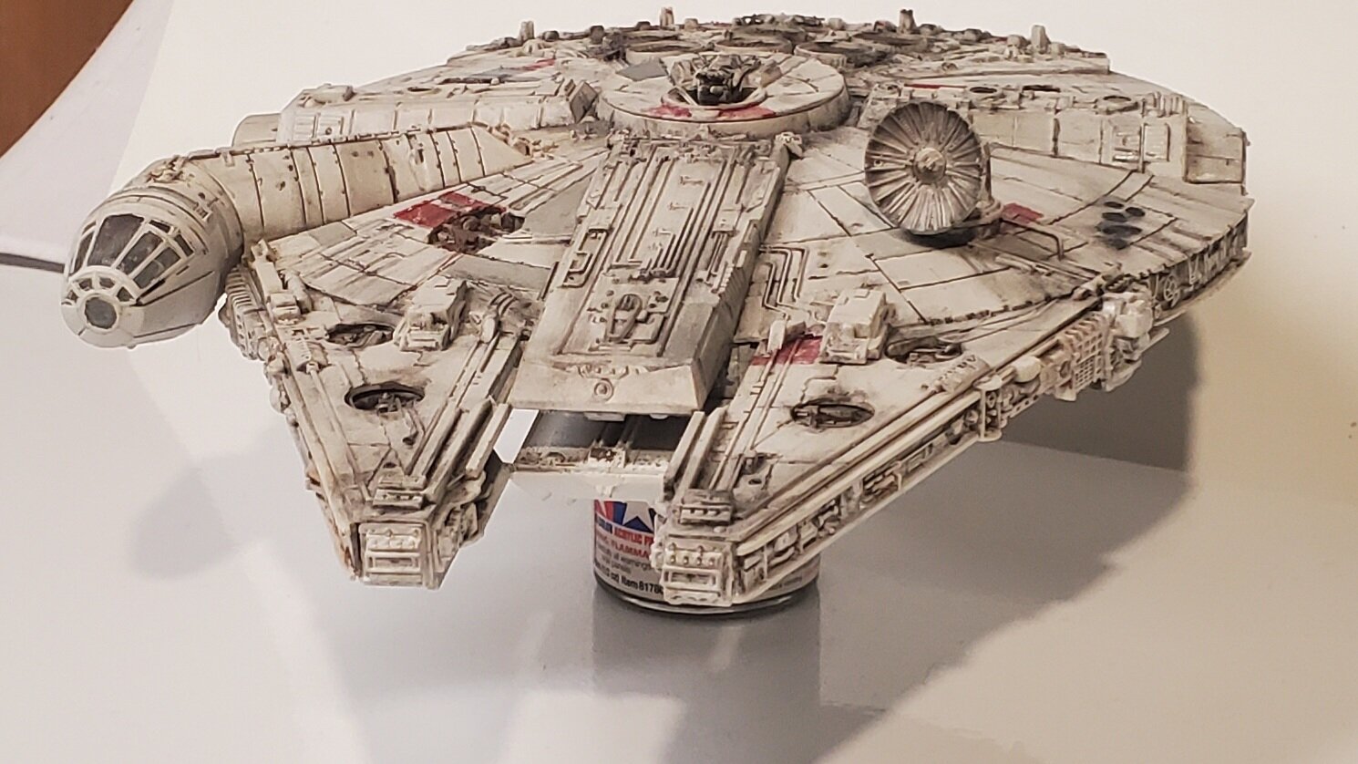

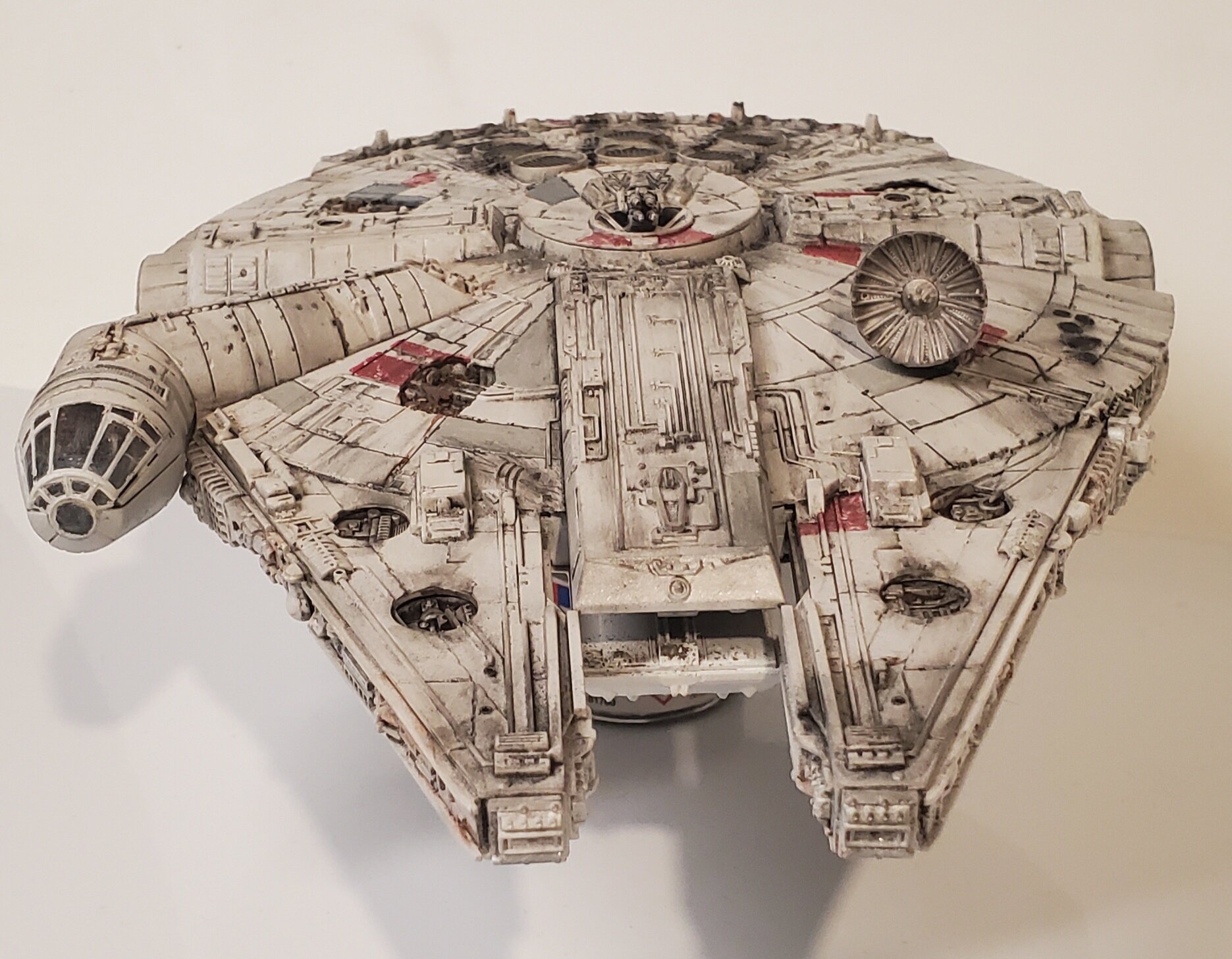

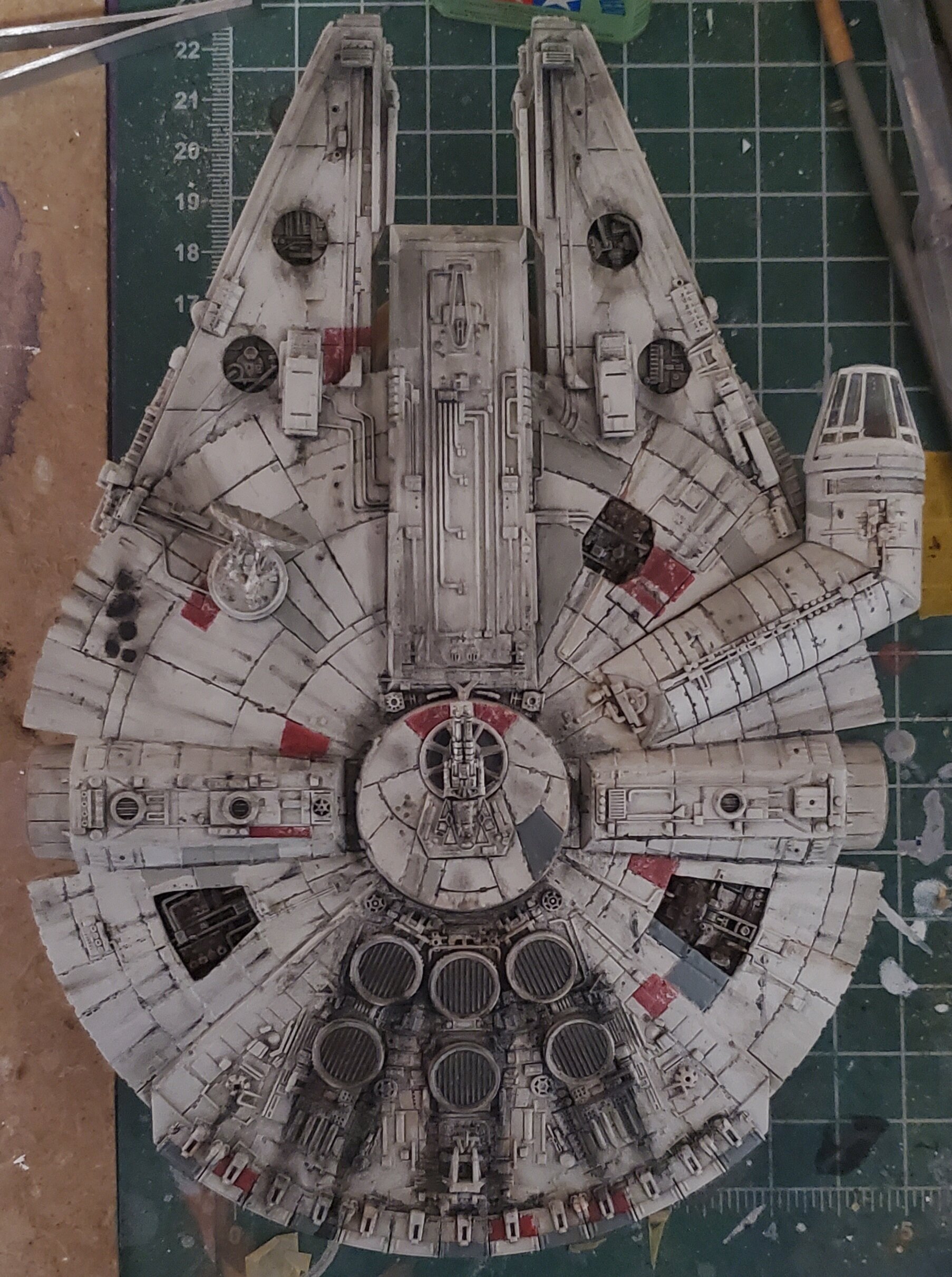

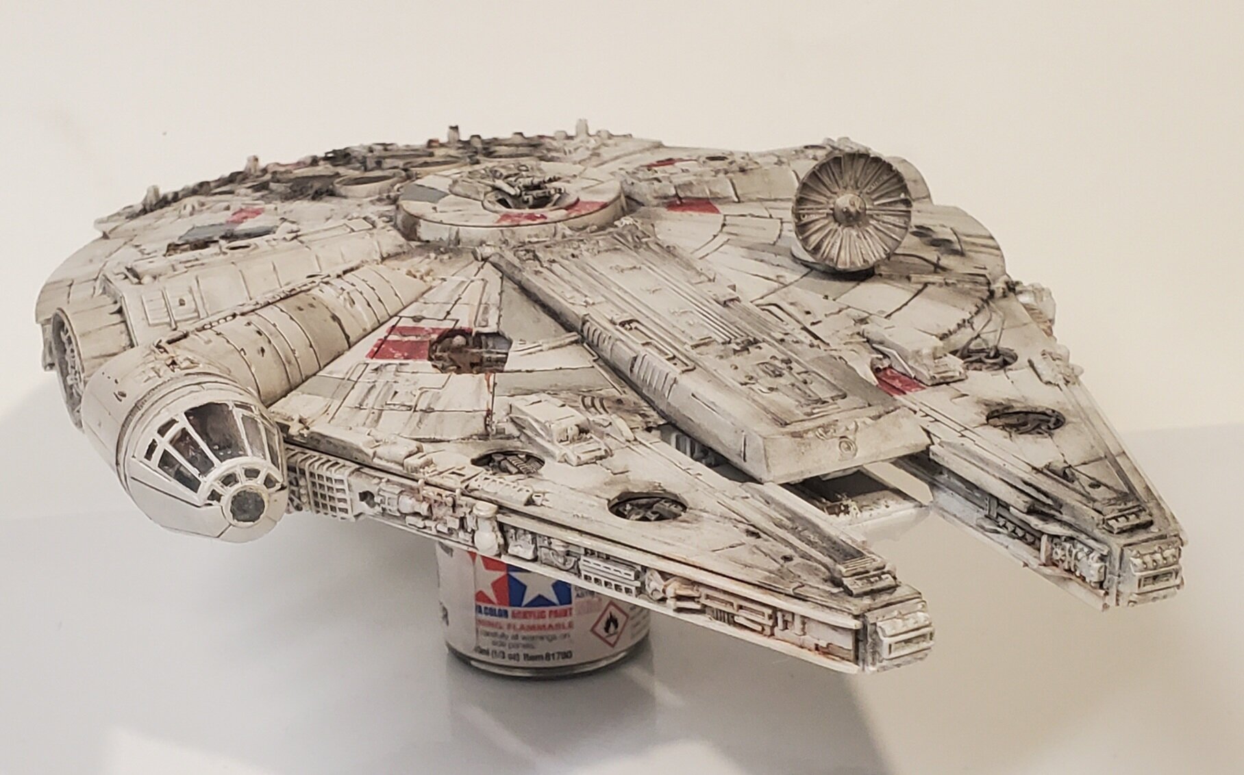

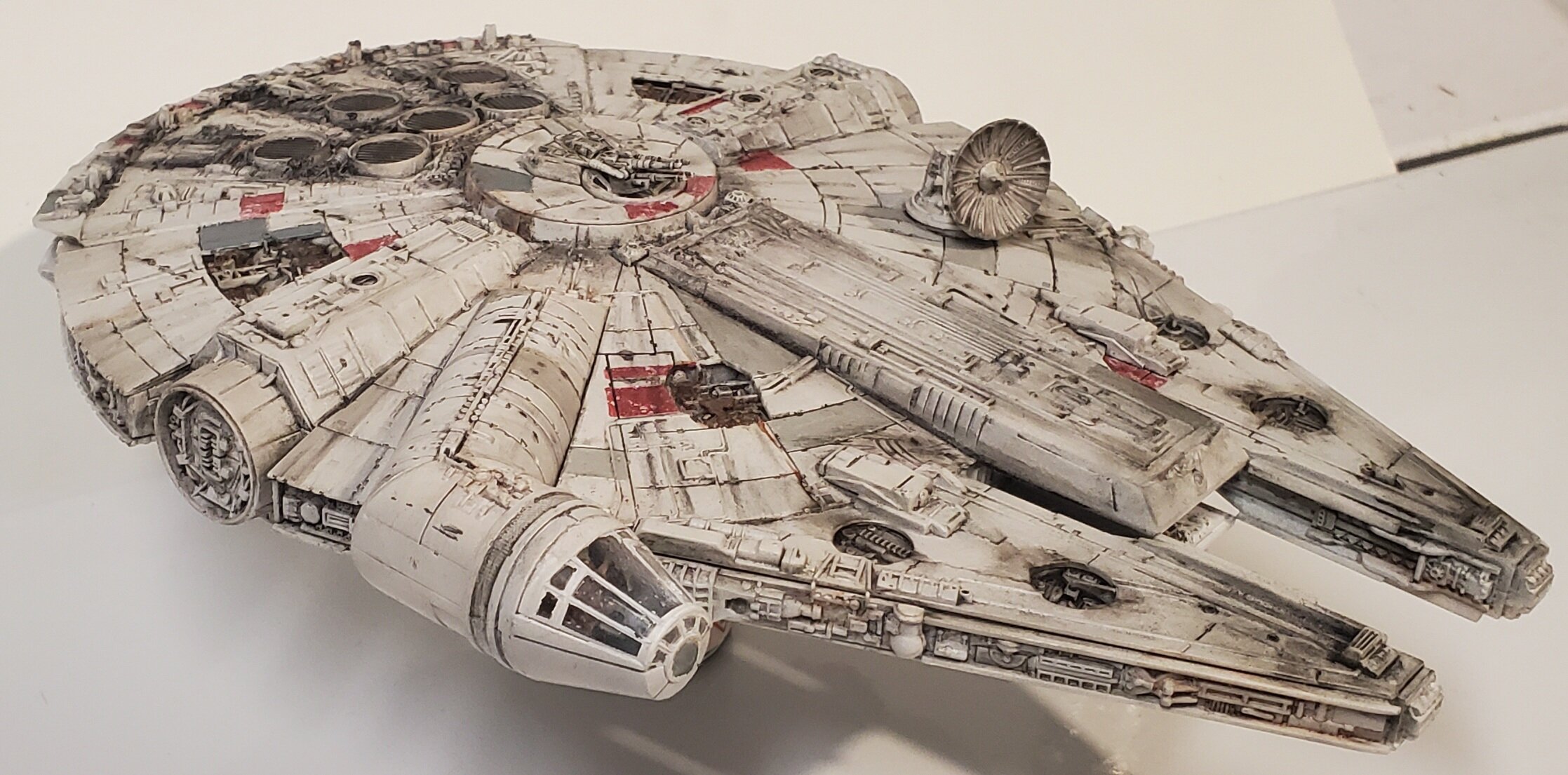

Chas Posted January 28, 2024 Posted January 28, 2024 (edited) Ahh! Very clever! Thanks for the explanation. That was very instructive and helped clarify a lot. The top and side-walls of the old girl are done and dusted. Matte coat on and window masks removed. If you hold the ship right up close you can see Han and Chewy in there, but Leia and 3P0 are nigh on invisible. Oh well. Now I gotta do the bottom and then fashion and paint some Asteroids. Here's the main ref. I used for the weathering details. Edited January 28, 2024 by Chas Quote

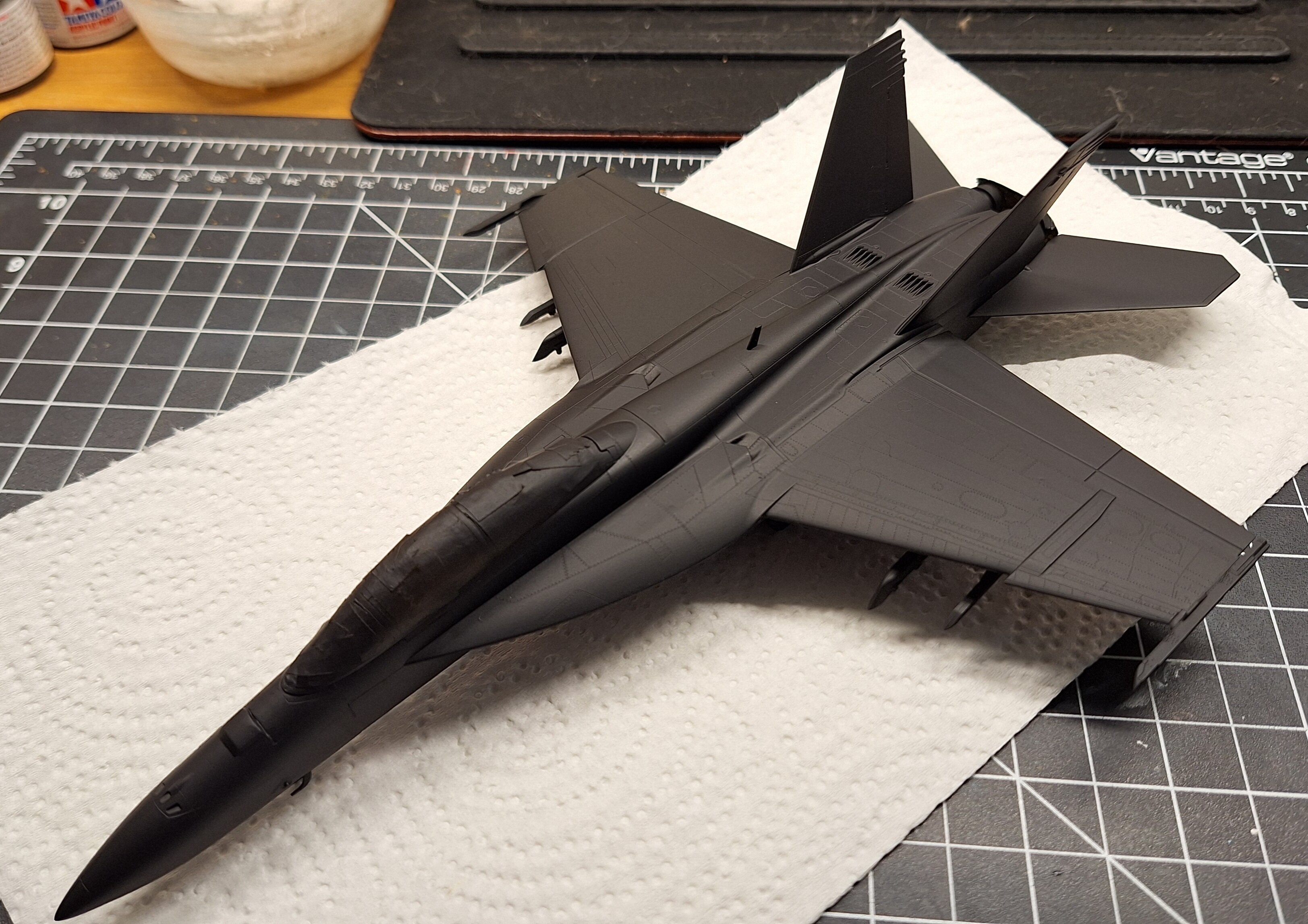

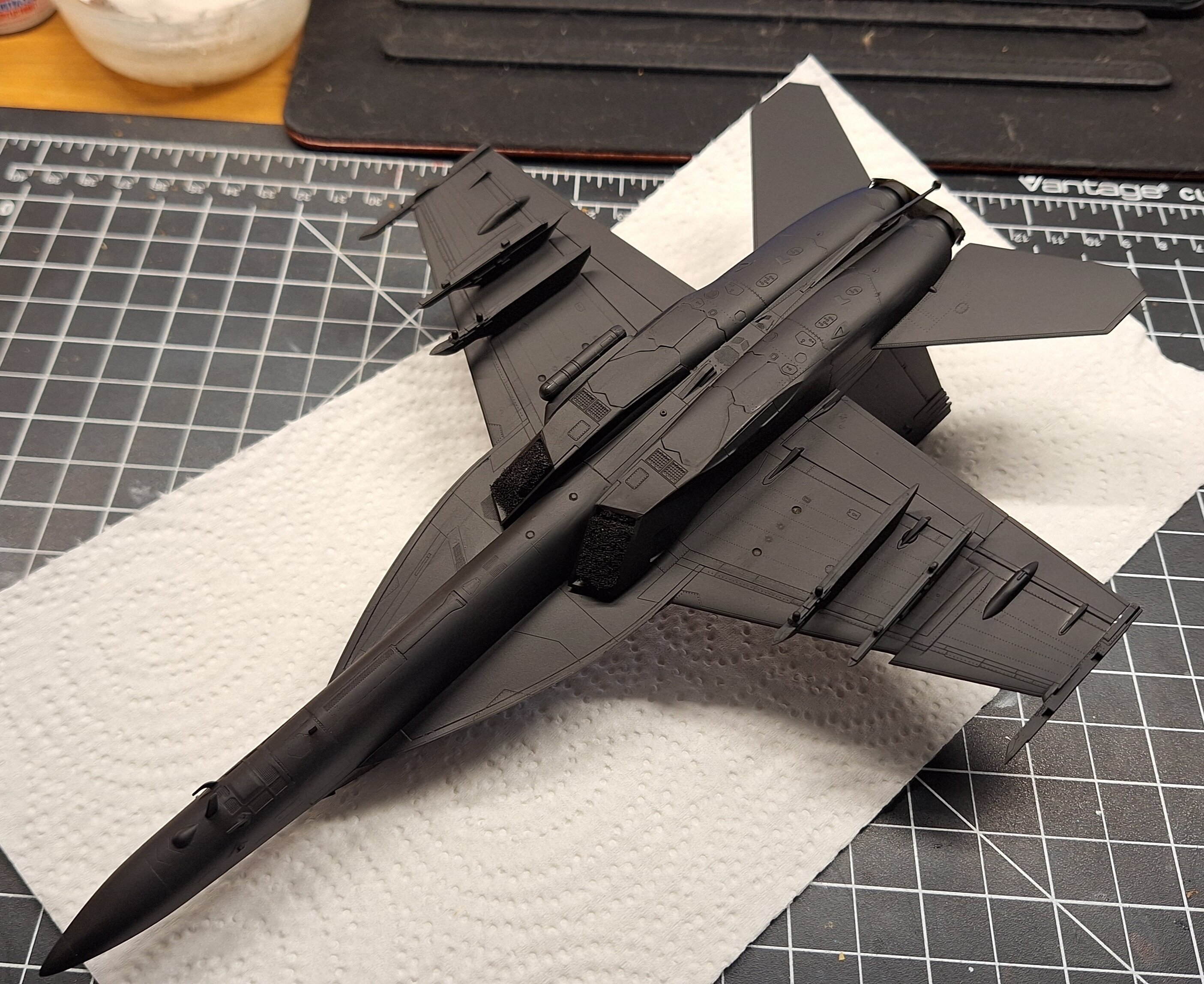

derex3592 Posted January 28, 2024 Posted January 28, 2024 Falcon looking good! Over here Mr Surfacer 1500 Black went down on the Superhornet this morning.... Quote
Chas Posted January 28, 2024 Posted January 28, 2024 (edited) Jesus! That looks soo cool! Edited January 28, 2024 by Chas Quote
arbit Posted January 28, 2024 Posted January 28, 2024 @Chas Your base coat and weathering on the falcon are really sweet. Quote
Big s Posted January 29, 2024 Posted January 29, 2024 3 hours ago, Chas said: Ahh! Very clever! Thanks for the explanation. That was very instructive and helped clarify a lot. The top and side-walls of the old girl are done and dusted. Matte coat on and window masks removed. If you hold the ship right up close you can see Han and Chewy in there, but Leia and 3P0 are nigh on invisible. Oh well. Now I gotta do the bottom and then fashion and paint some Asteroids. Here's the main ref. I used for the weathering details. Nice paint and build. Now we need some head on pictures Quote
derex3592 Posted January 29, 2024 Posted January 29, 2024 @Chas - Which kit is that? Finemolds? or Bandai ? 144? Quote
Chas Posted January 29, 2024 Posted January 29, 2024 (edited) Finemolds 144th. Got a Bandai in the wings. Thinking maybe a cloud city landing platform dio for that one. Edited January 29, 2024 by Chas Quote
nightmareB4macross Posted January 29, 2024 Posted January 29, 2024 Loving all these new features. - swing plates with actuating pistons - reworked landing gear with 3-piece bay doors - tucked head (more to come on this feature) - spring loaded FLIR connection points for hips at nosecone - extending hip connectors - turbines - hinged intake covers - A-stance joint - reworked chest hinges - smoothed fuselage to chest profile I’m sure I missed a few updates, but many more to come. 😆 Quote

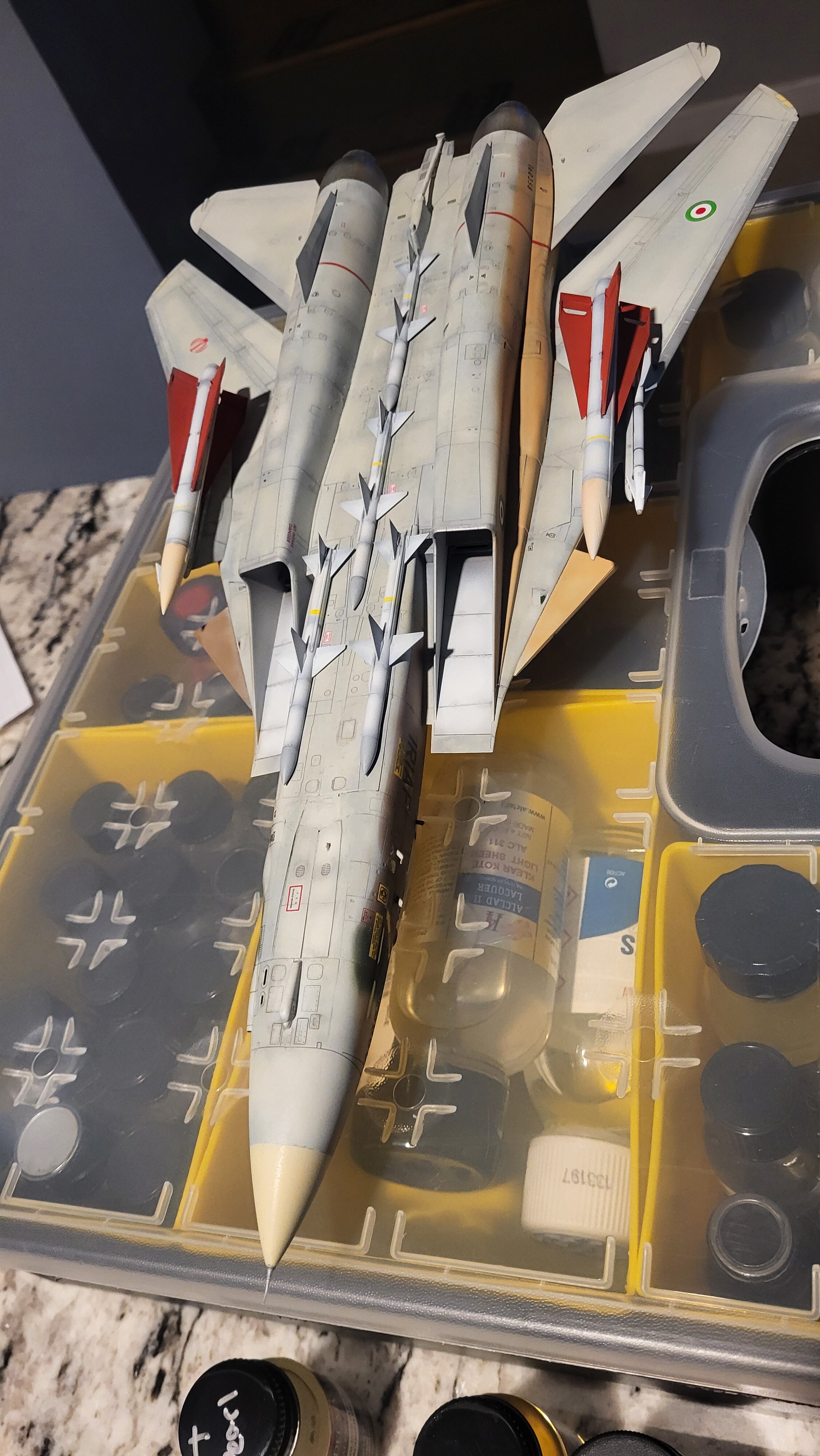

arbit Posted January 29, 2024 Posted January 29, 2024 17 minutes ago, Rock said: Home stretch Beautiful paint work. Quote
Chas Posted January 29, 2024 Posted January 29, 2024 1 hour ago, Rock said: Home stretch So clean and Smmoooth! Lookin killer! Quote

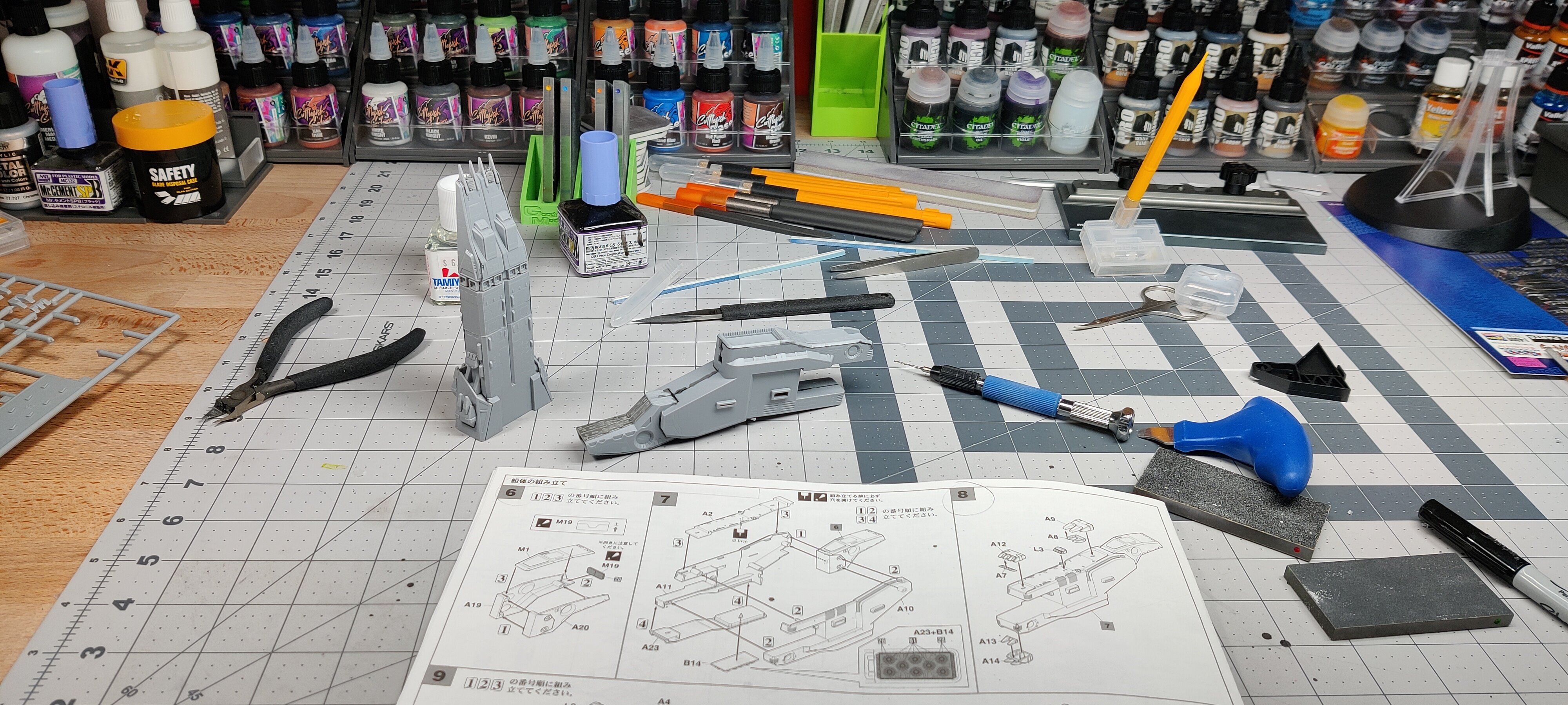

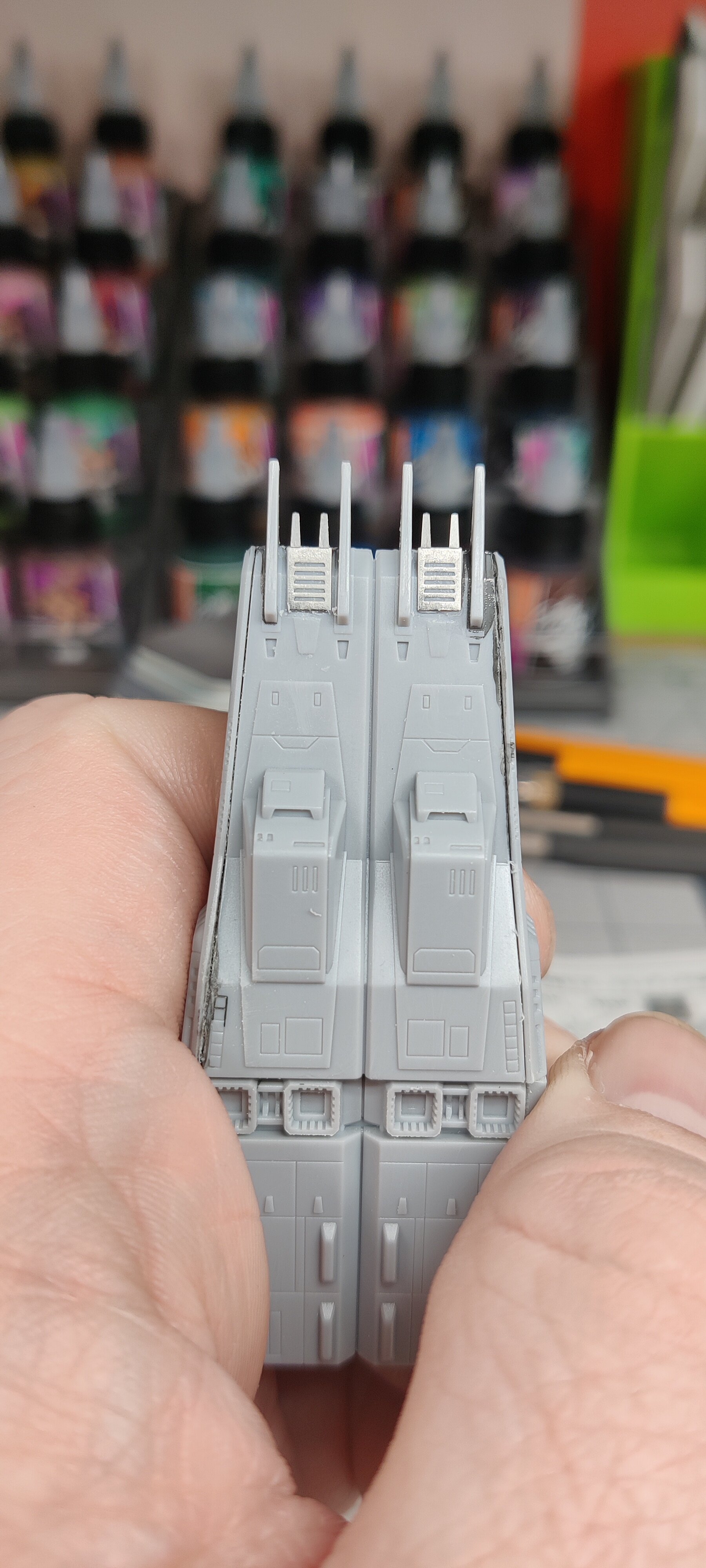

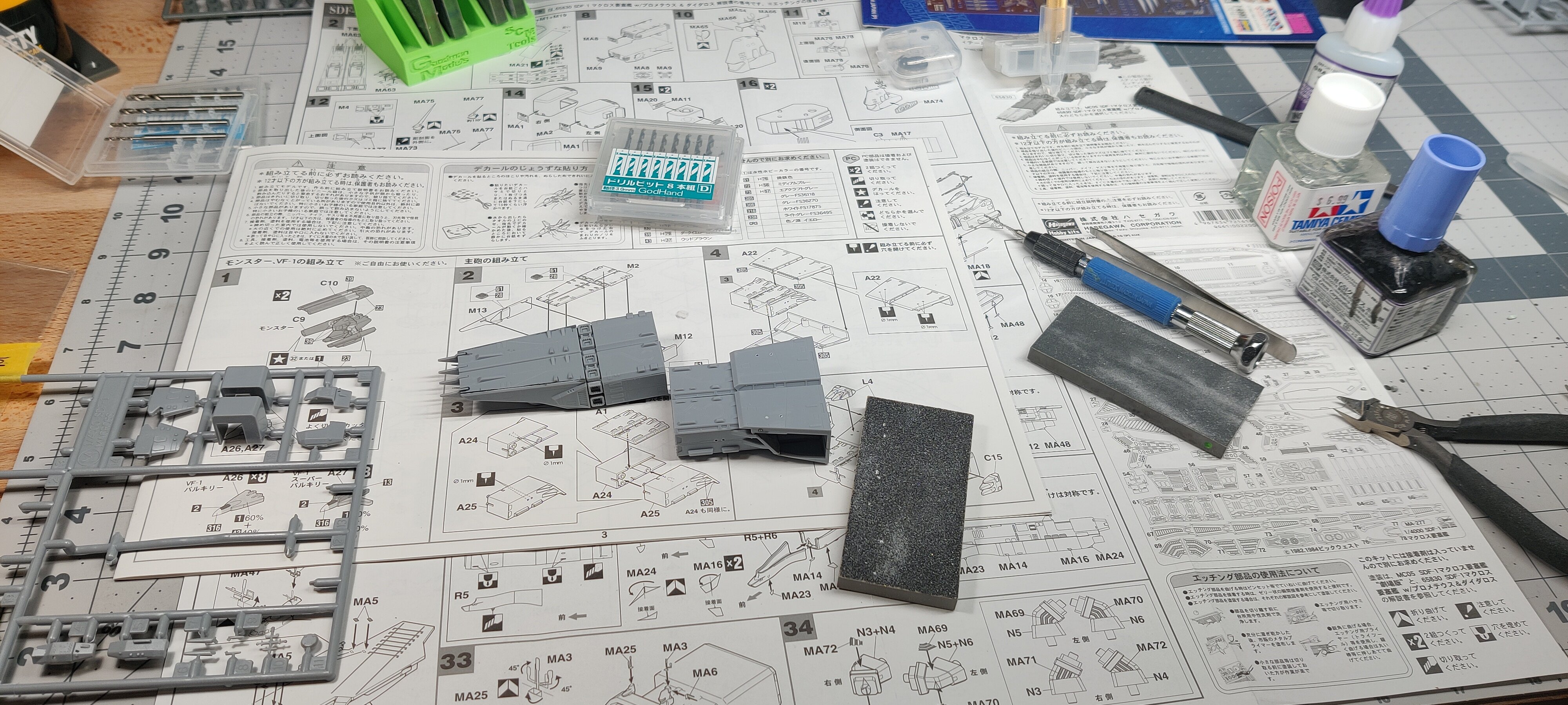

Mr Jones Posted January 29, 2024 Posted January 29, 2024 After a long while off building any models at all, started on the Hasegawa TV SDF-1 along with the PE set; TBH I'm rusty but its looking good so far ( I'll just accept most of the inaccuracies ) Quote
Thom Posted January 29, 2024 Posted January 29, 2024 @Chas That is a clean looking paint job! Nice. @Mr Jones Cool seeing a Macross on the Bench! Quote

nightmareB4macross Posted January 30, 2024 Posted January 30, 2024 12 hours ago, Rock said: Home stretch Good Lord!! That’s incredible. Could you list the primers, colors, and washes used? This is what I want to aim for once I begin to paint. Thank you. Quote
arbit Posted January 30, 2024 Posted January 30, 2024 On 1/29/2024 at 5:19 AM, Chas said: Well, not to be stingy. Chas, brilliant work. But the cockpit looks too white and clean compared to the body. Maybe a bit if weathering will do it? Quote
Chas Posted January 30, 2024 Posted January 30, 2024 Thanks arbit. I noticed that as well. Gonna balance it out a bit when I do the weathering on the bottom of the ship. Quote
wm cheng Posted January 30, 2024 Posted January 30, 2024 What a Hunk of Junk! @Chas - looking great! Nice warm tones @Rock - never seen those big ass missiles outboard before, are those their version of Phoenixes? Quote
