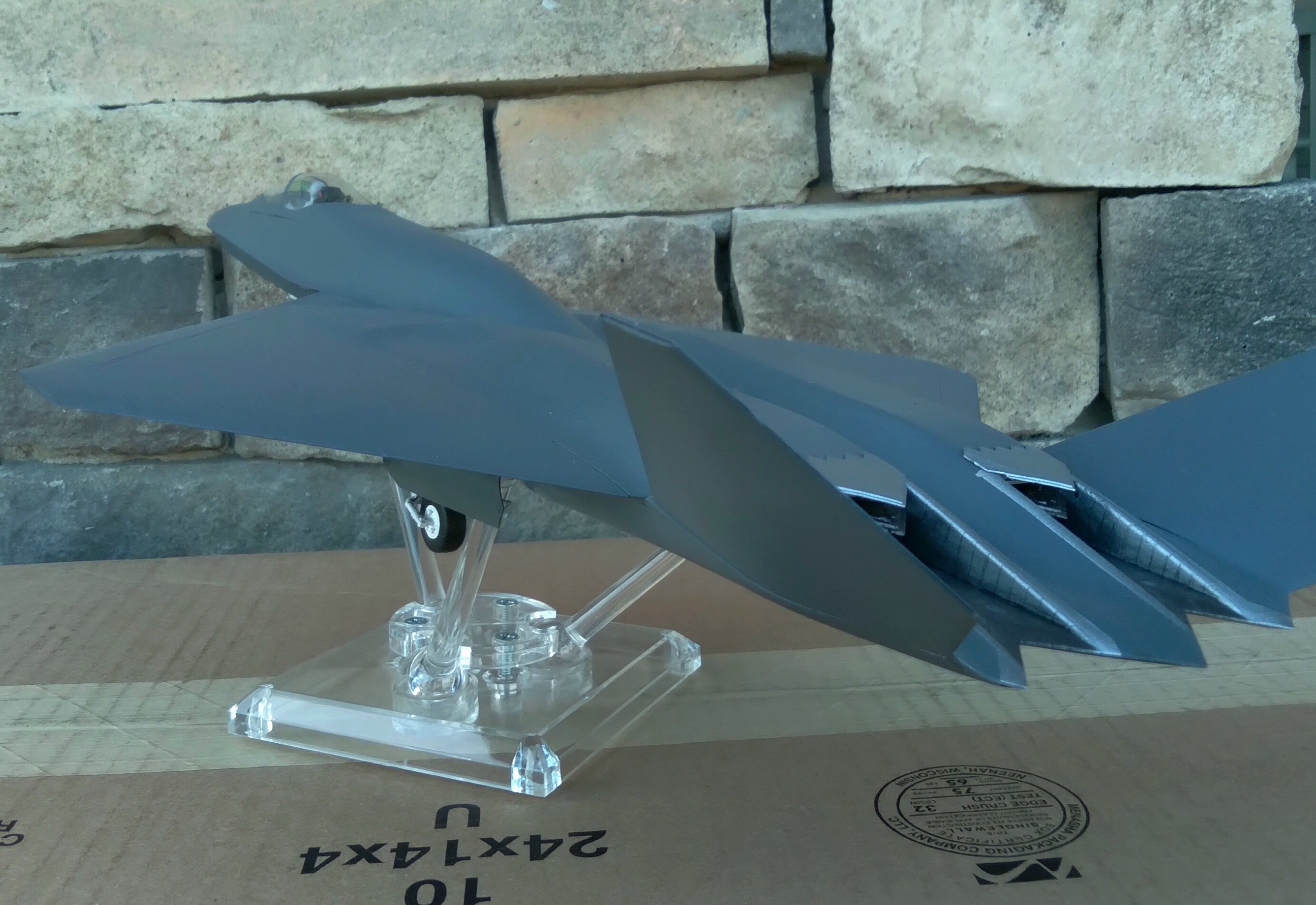

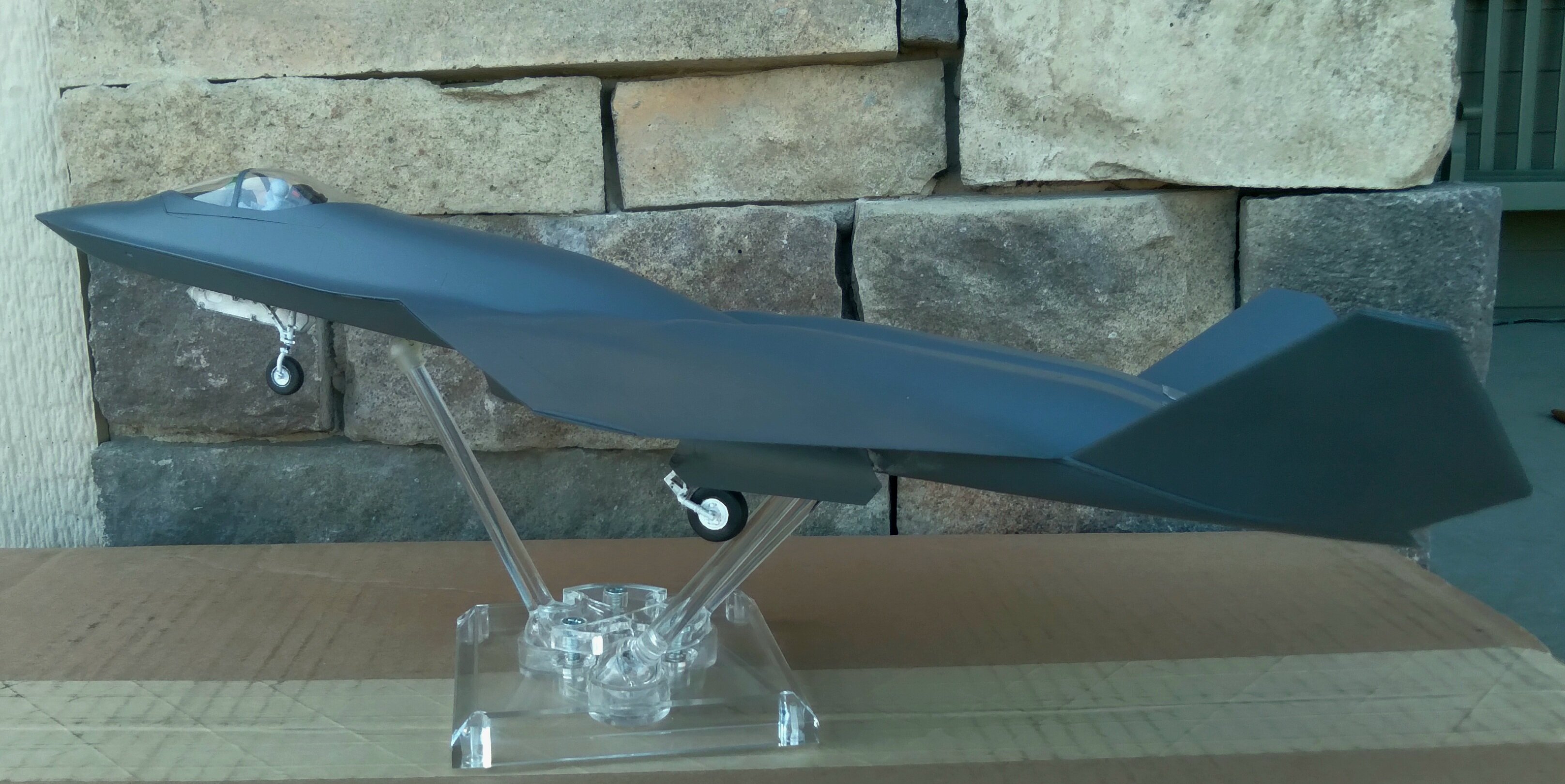

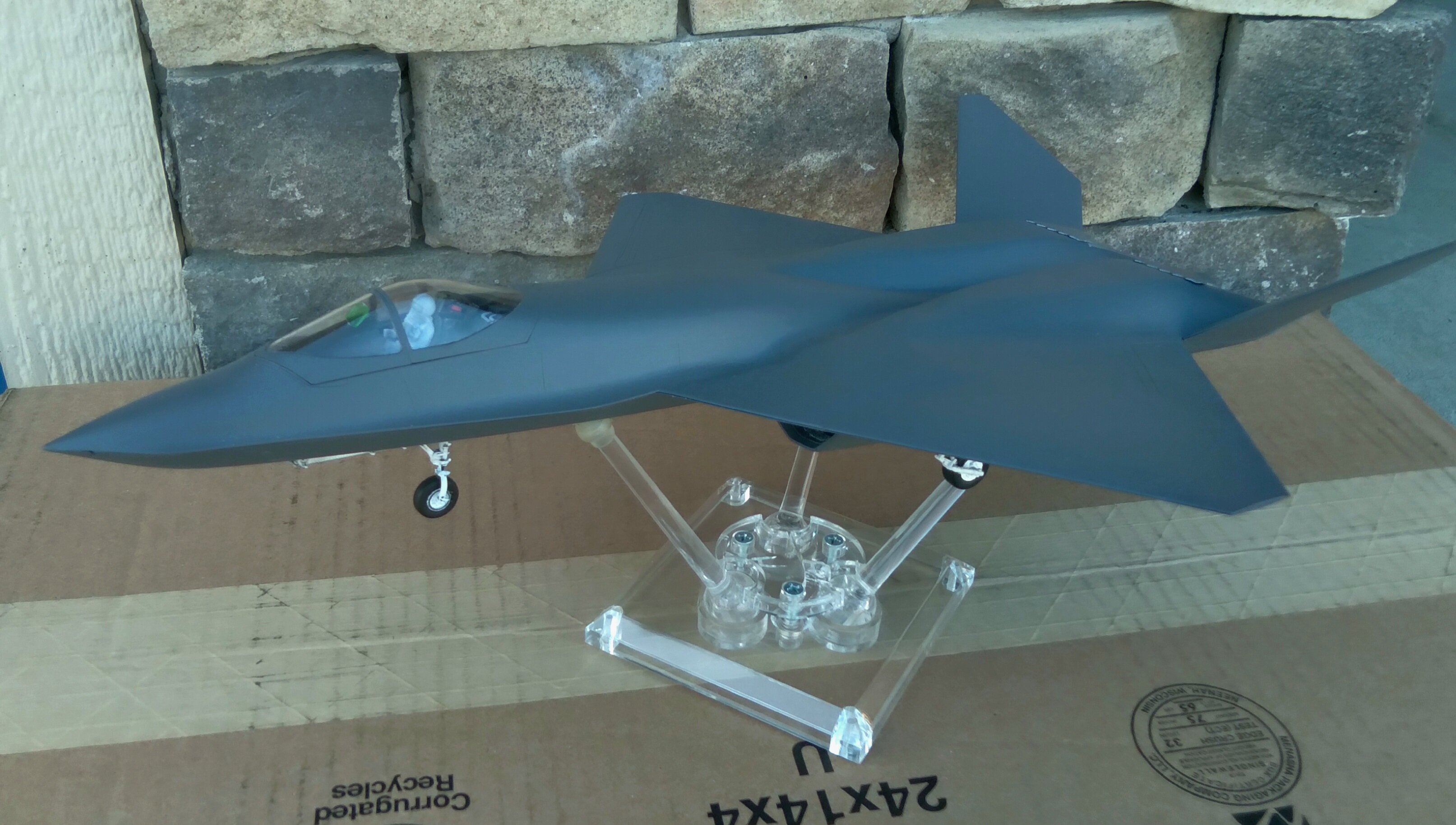

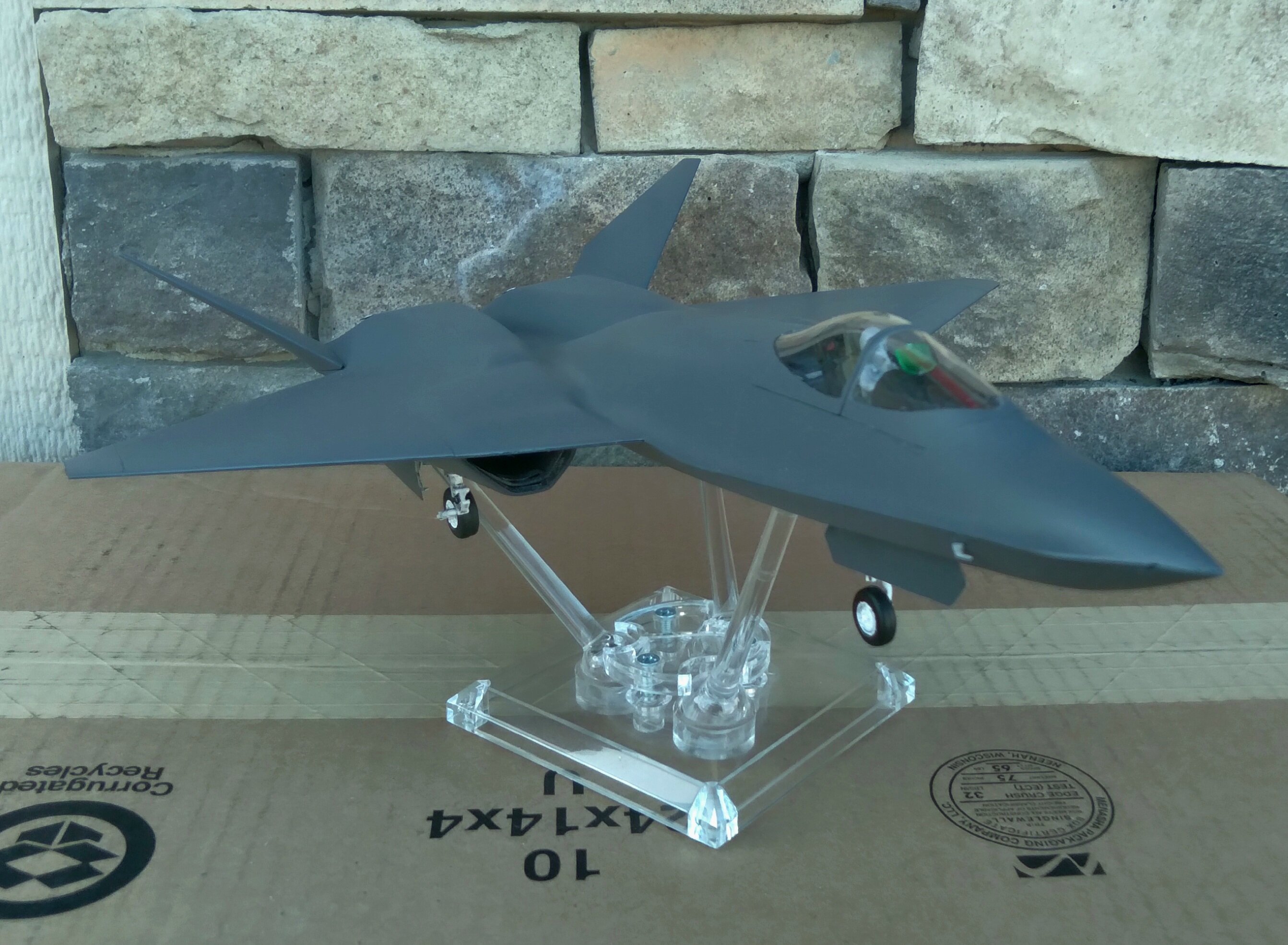

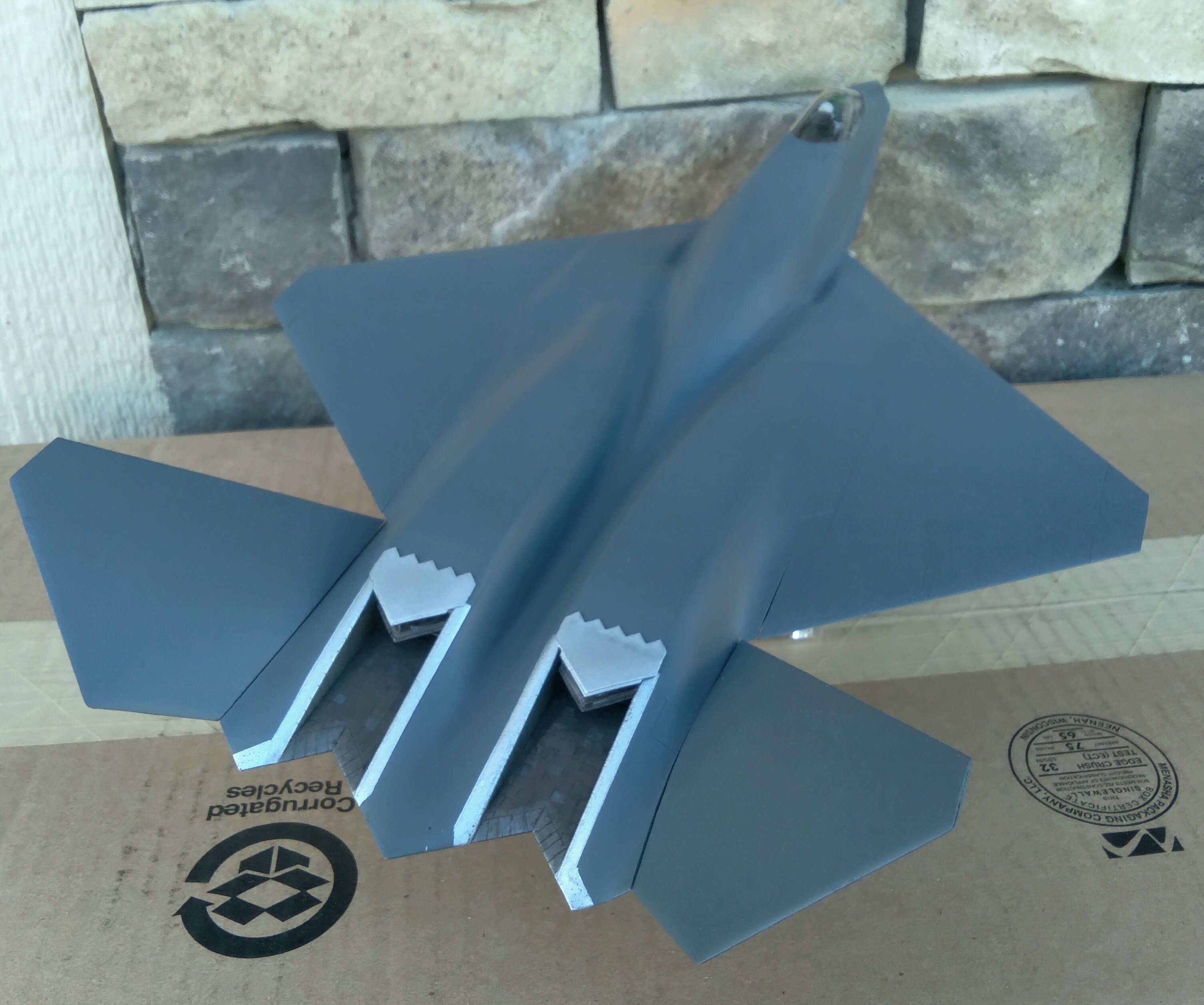

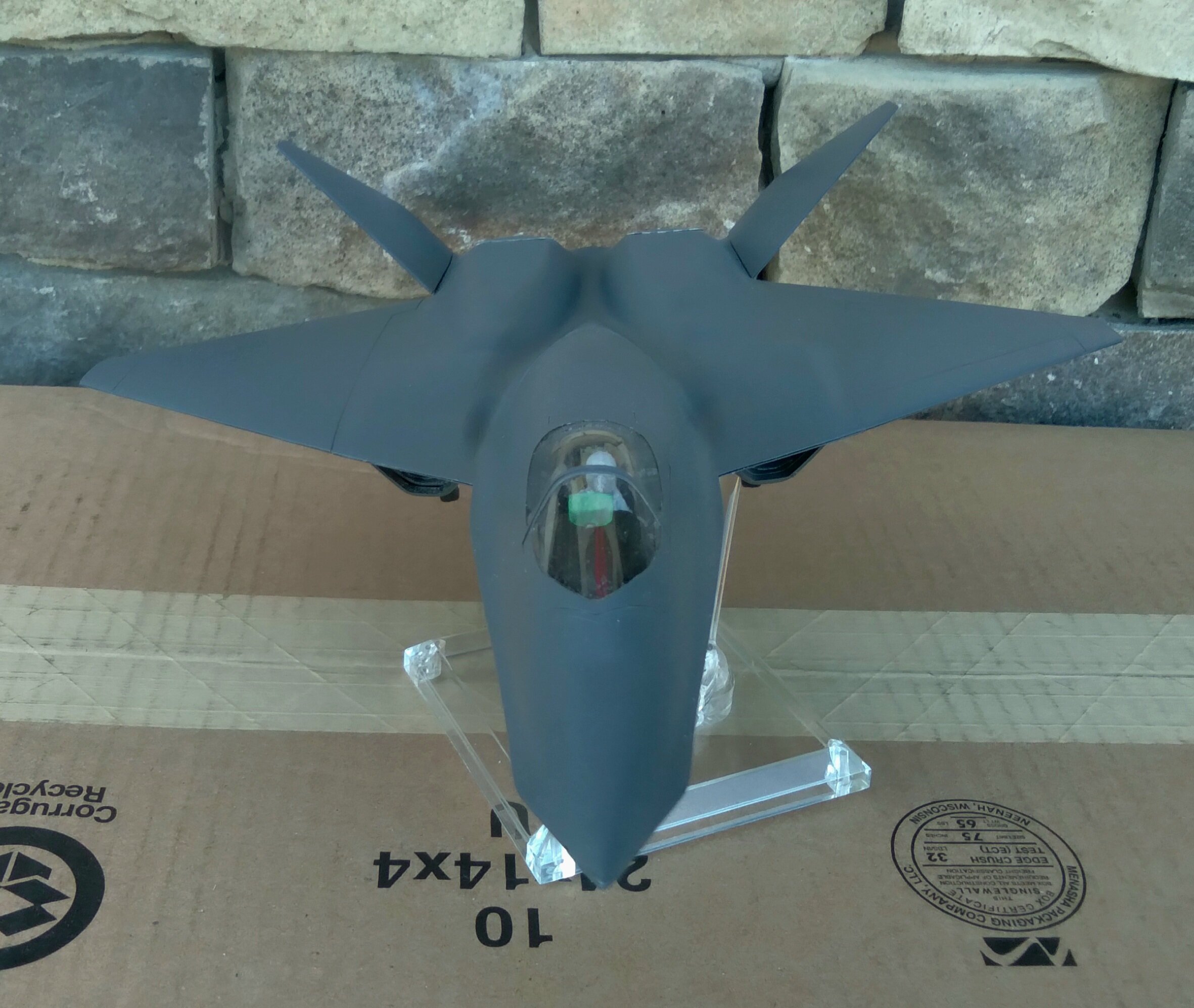

I'm making some progress with the YF-23, the landing gear which again is usually a royal pain for me actually turned out pretty good.
Very special thanks to @Chas for the Fighter pilots. 😎👍 (The kit does not include one.)

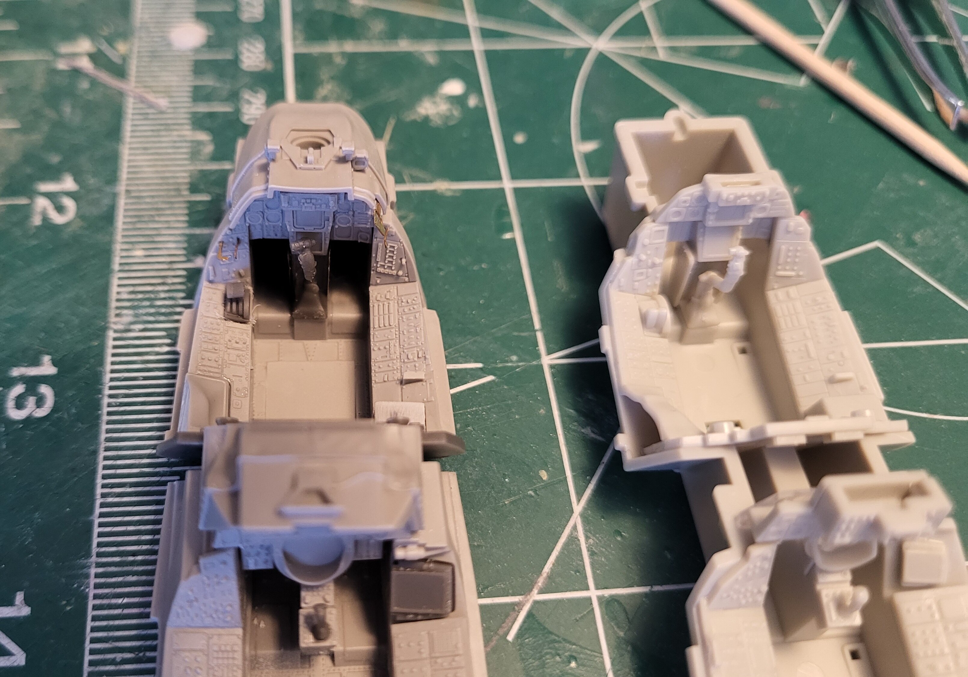

@Rock I'm assuming the Eduard is on the left. Get that painted up and it will look awesome!

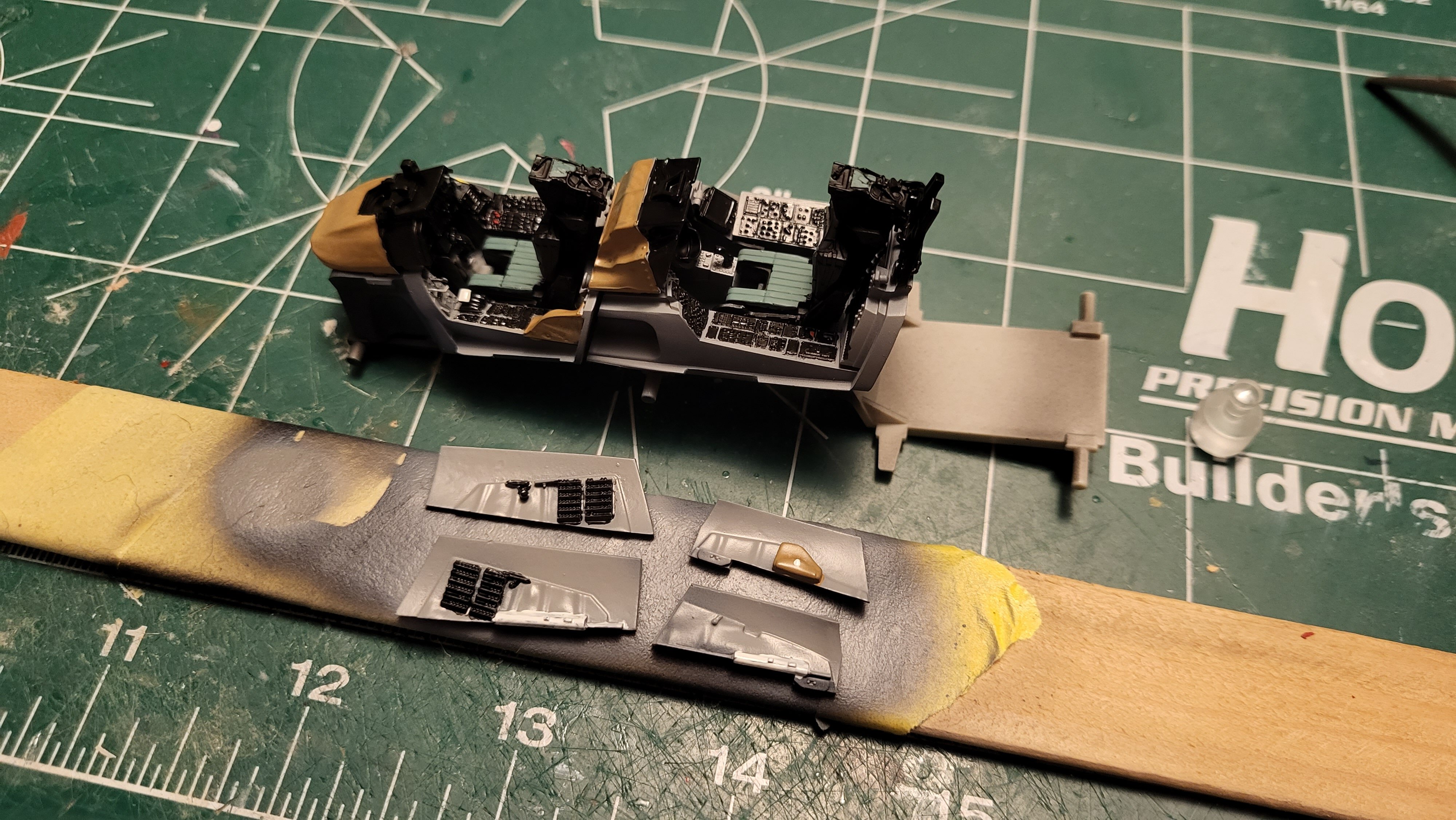

On it. Basic colors in all that is left is cleanup, detail painting and washes/weathering. Closed canopy with pilots so nothing too crazy. Just trying out different options with each Tamiya build I do.
It [Eduard] looks really nice and fits together like a dream... that being said Tamiya's is no slouch either. If you have a min look up yhe recent book, "Super Detailing the F-14 Tomcat." It just released late 2023, is dual language, and is 1000% bat-crap crazy on what you can do the the 1/48 OOB cockpit!

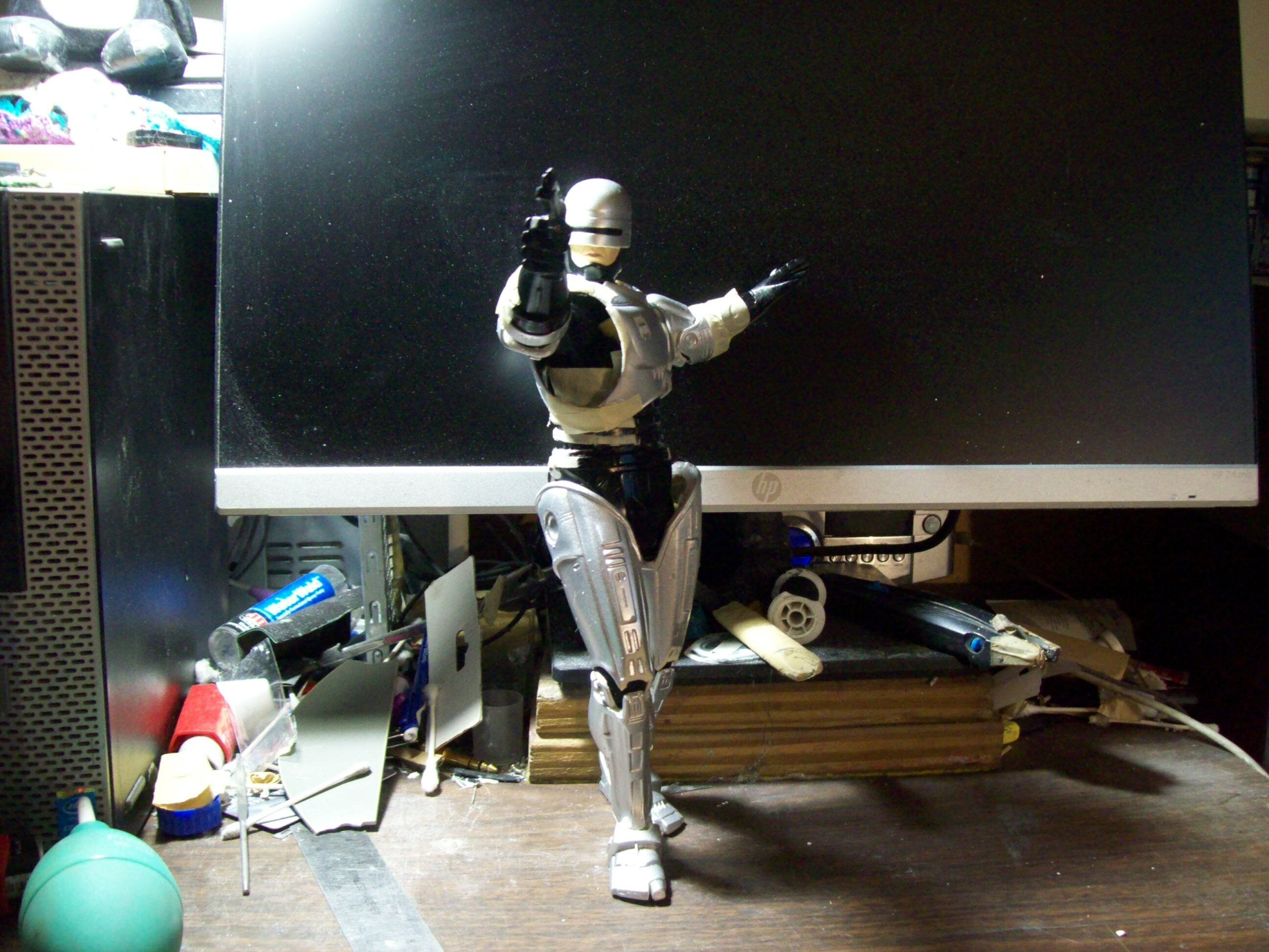

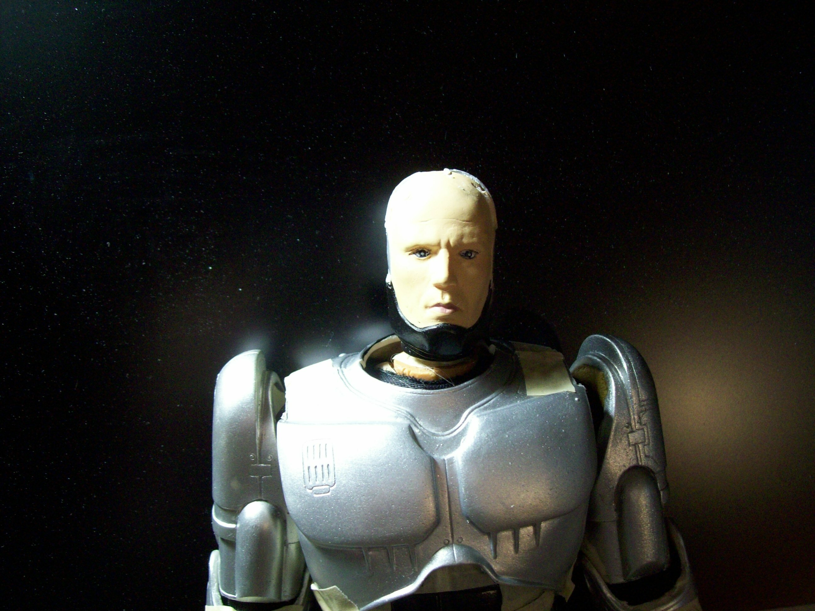

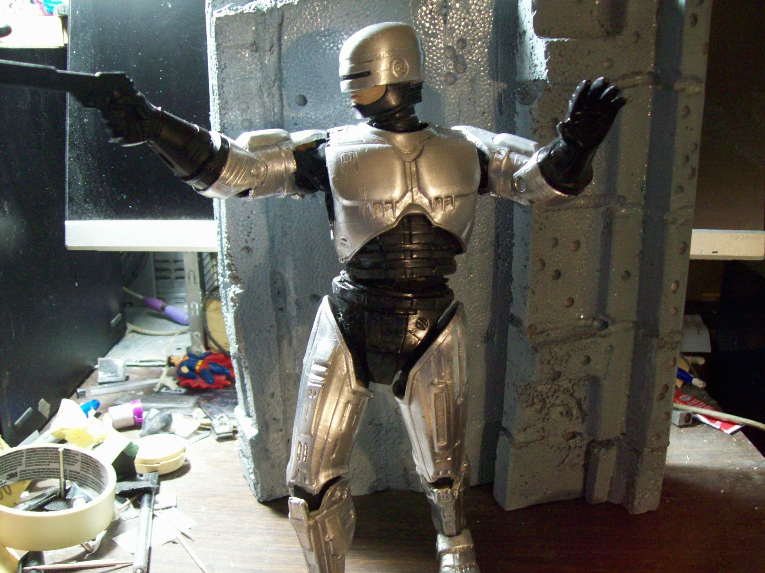

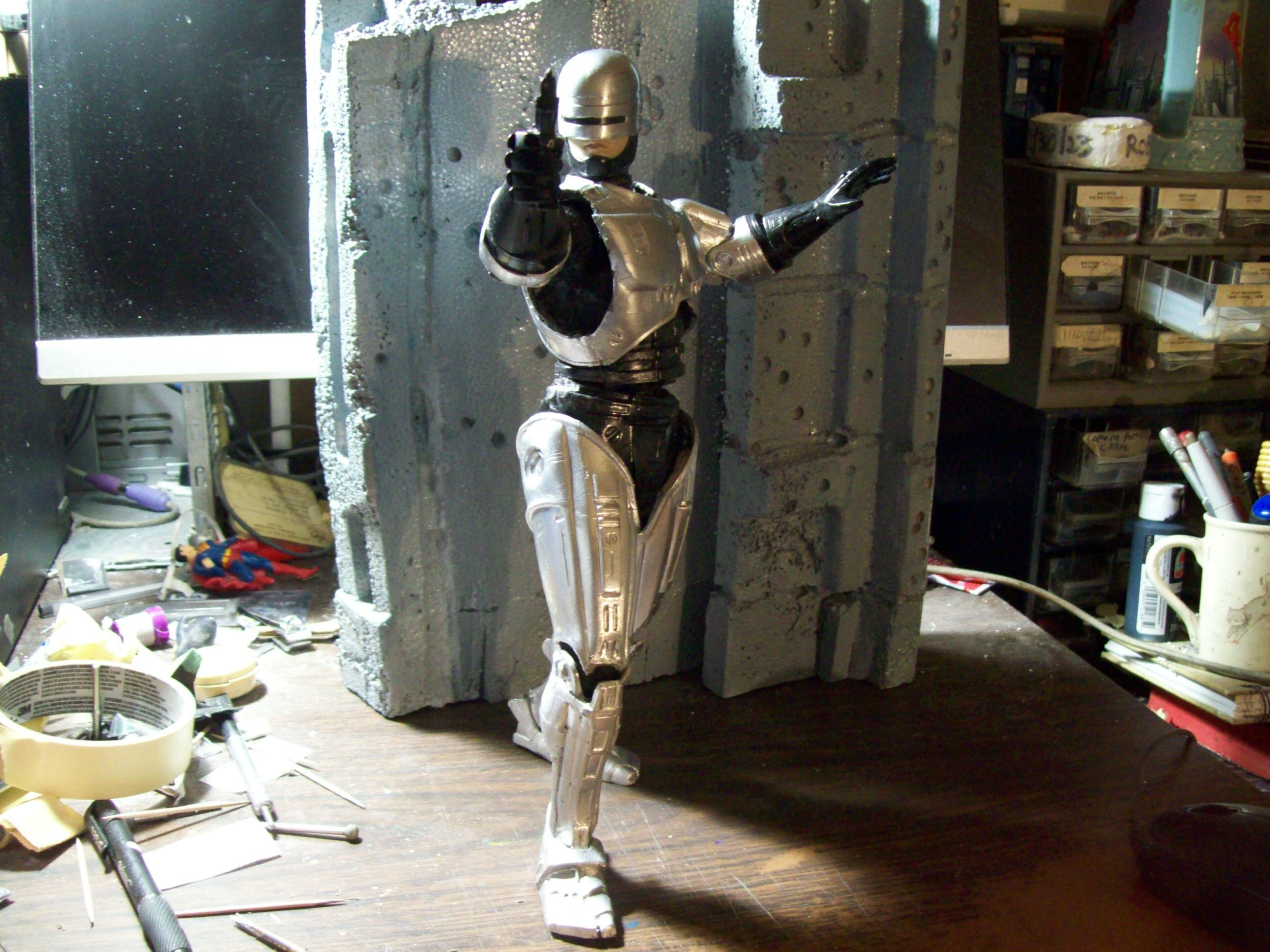

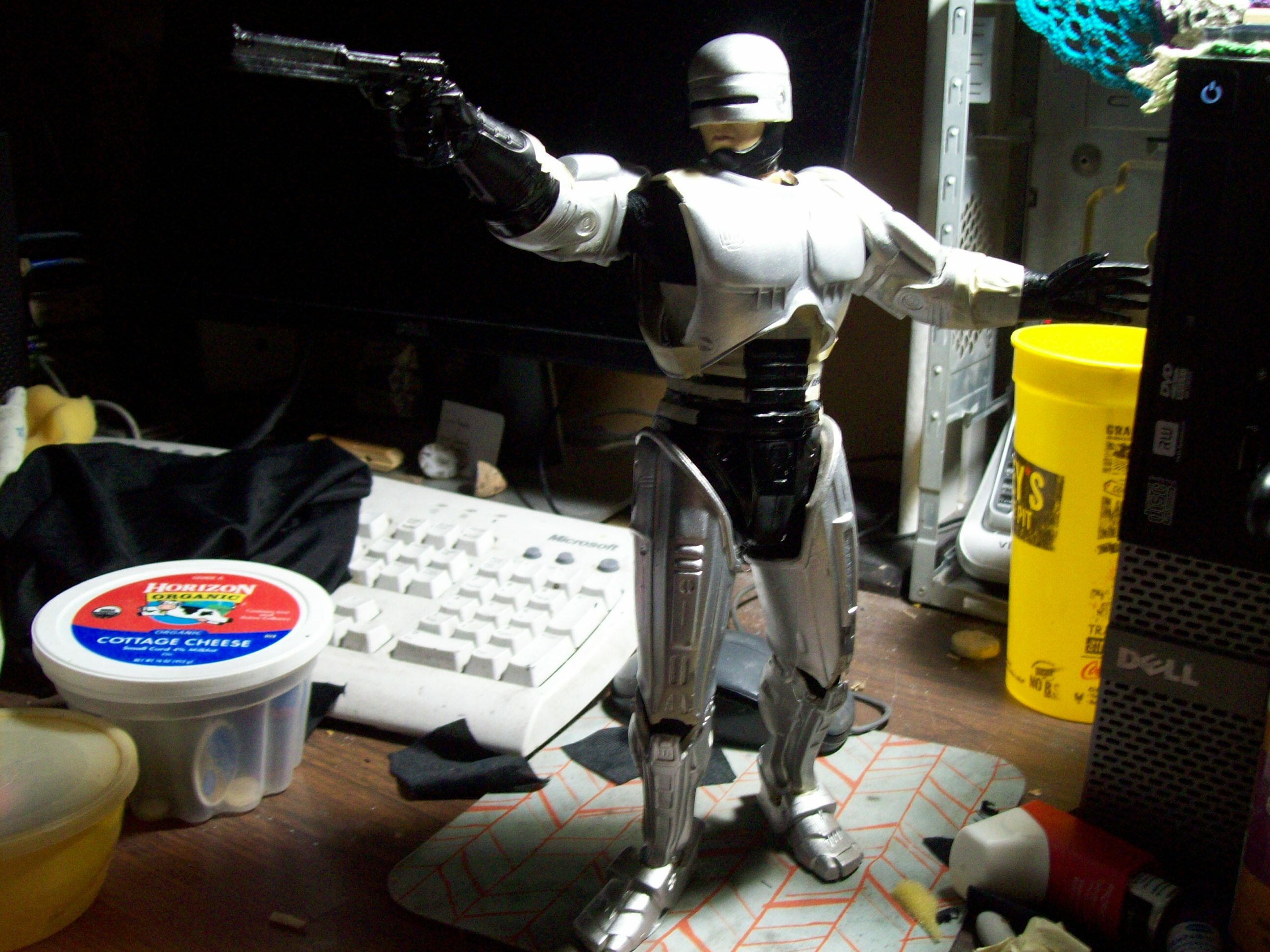

As promised, here are the pics between the last I posted and my most recent update-
So first, test poses to ensure the armor would move correctly on the figure:
100_0241.JPG.28766e4729edee1c5fb4af02881844ed.JPG100_0242.JPG.a7517ffaca744f4e725e512a60714e91.JPG100_0243.JPG.8f58df8b9112982c3b84f8c2ecfca3f5.JPG100_0244.JPG.69cfd78f96018f68bf91bcc86ea79e37.JPG100_0245.JPG.c5b1f762c61a3f0179726fa7048e0b83.JPG100_0246.JPG.973fde810109a79ddda44bf5963e8798.JPG100_0247.JPG.d657cb05a400abbc4e88ff566f426c46.JPG

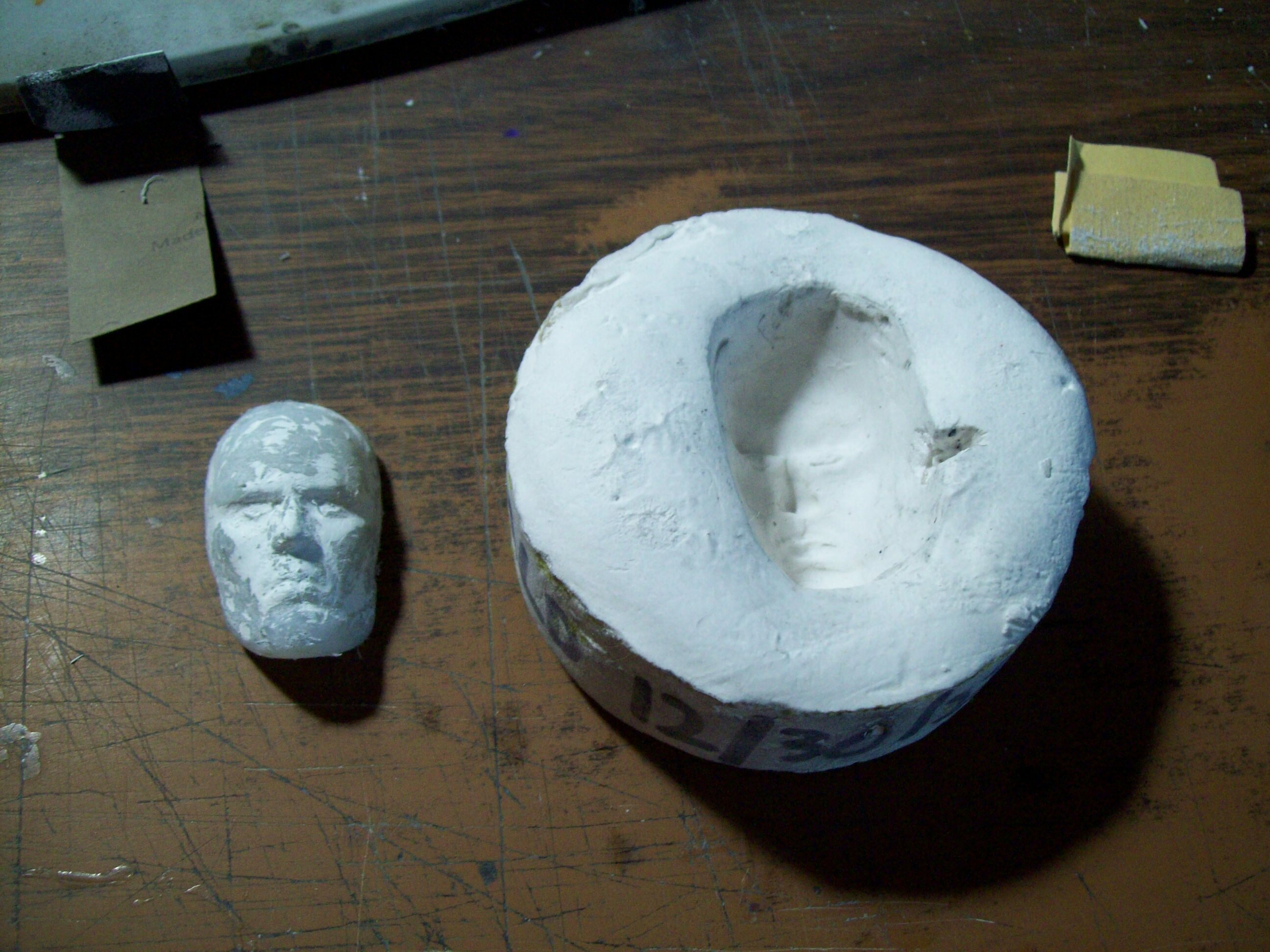

Then it was time to cast Murphy's unhelmeted face (still working on this BTW):
100_0248.JPG.89f6ce236a301a984cbc3b03e445ee74.JPG100_0257.JPG.6c827d28872ff7d424581d97afa26f59.JPG100_0259.JPG.6bc02ba148ff7ab6c489b36e859b240f.JPG
I made a mold of the face using Plaster of Paris (making sure to keep the entire thing cool until it set, so Murphy didn't end up looking like Emil at the steel factory!). I then poured Hot Melt Glue into the mold (with Vaseline as a mold release) and let that cool, then pulled it out when done.

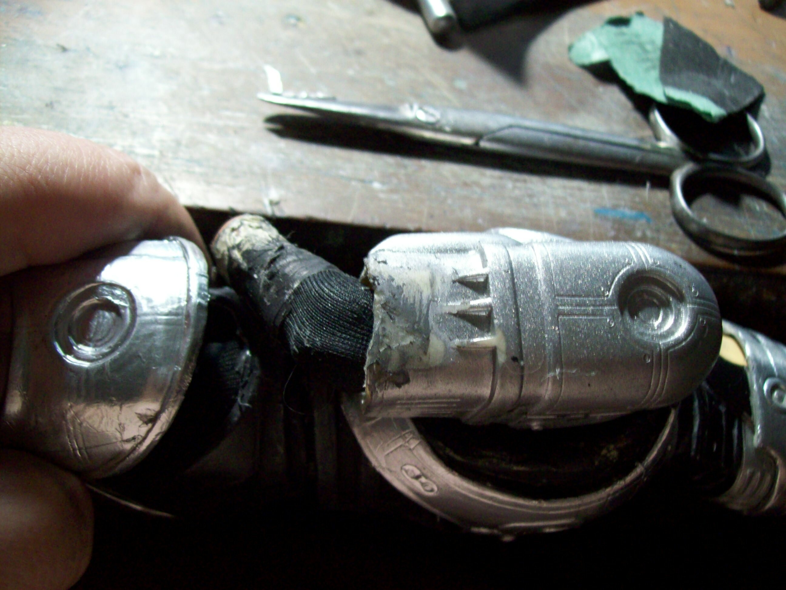

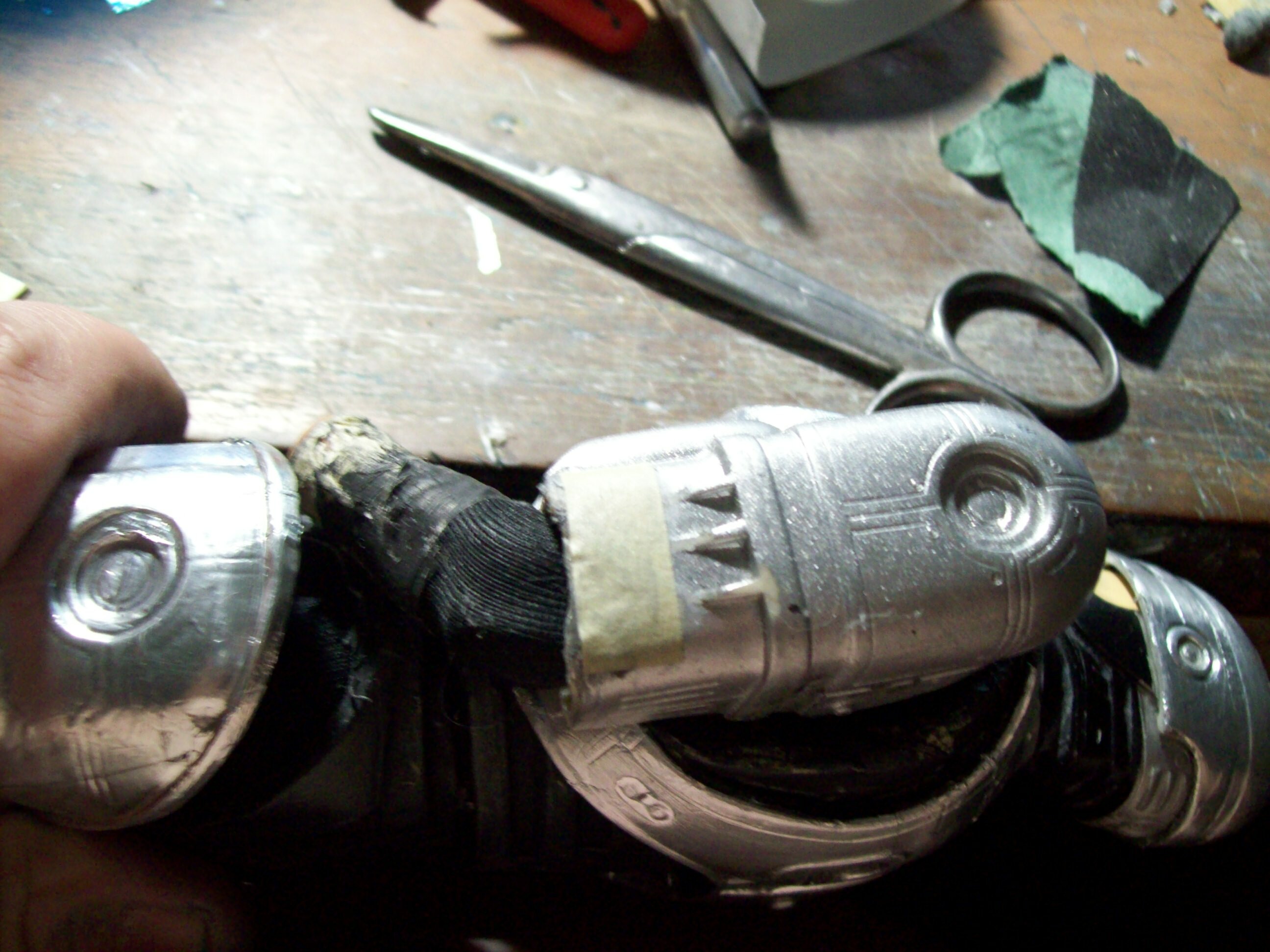

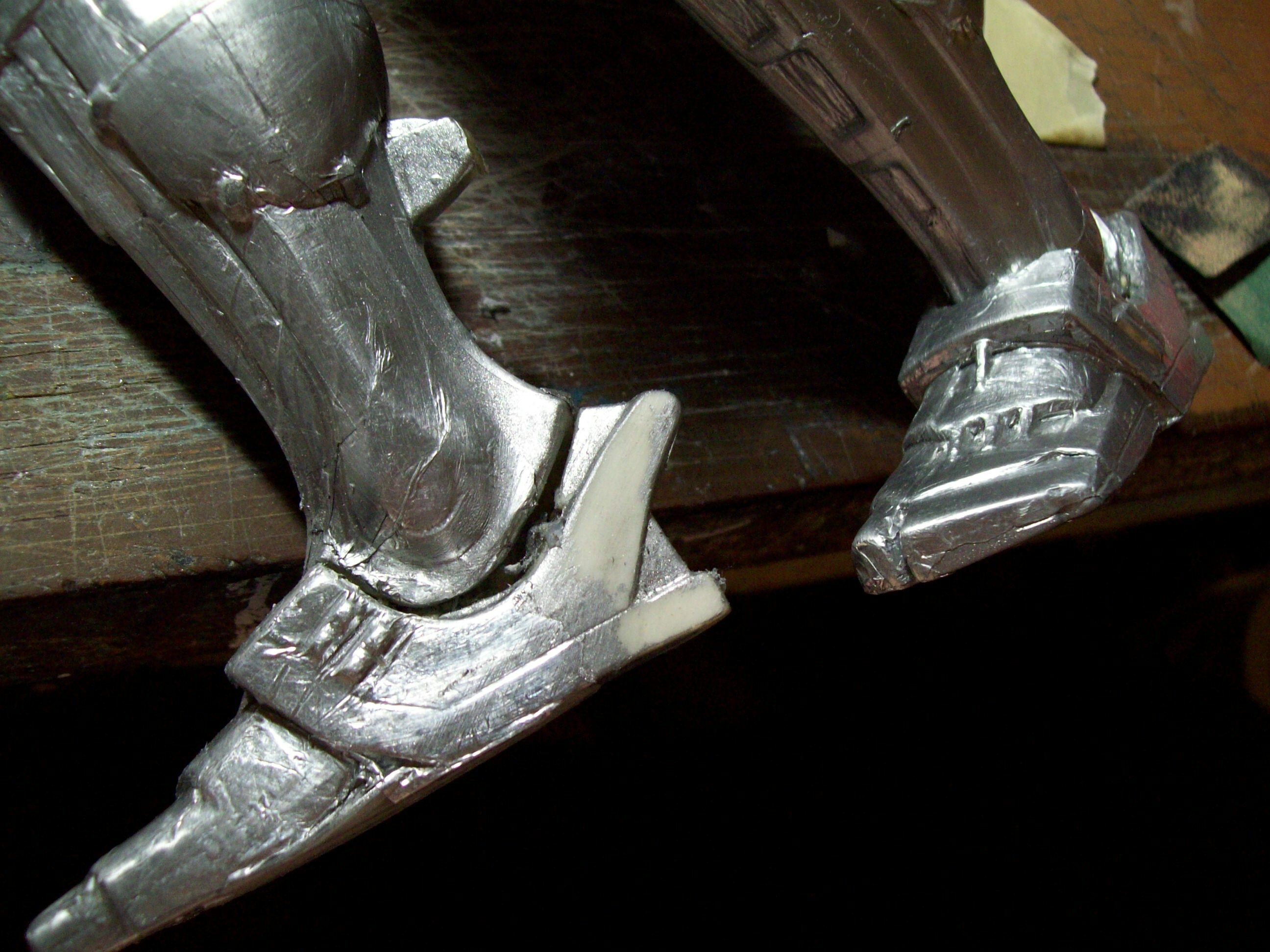

Then, filling areas on the armor that were marred when I cut the armor apart:
100_0260.JPG.c5b8a2f4bff0927a8e0c438325c9c966.JPG100_0261.JPG.eeae6685ea7a6cc50fe8517d8ae8b9f0.JPG
First: a dam made out of masking tape was applied; then, the hot glue was poured into the void and allowed to harden. After that, sanding to match the contour of the armor and a masking tape "patch" that would be smoothed down to prevent anything from making an uneven surface.
Next: foiling the armor.
Stay tuned...

@pengbuzz Your Robocop mods look AWESOME! You can tell its a work of love!
@505thAirborne Your '23 is looking great! Still hard to believe that plane didn't win the fighter competition.

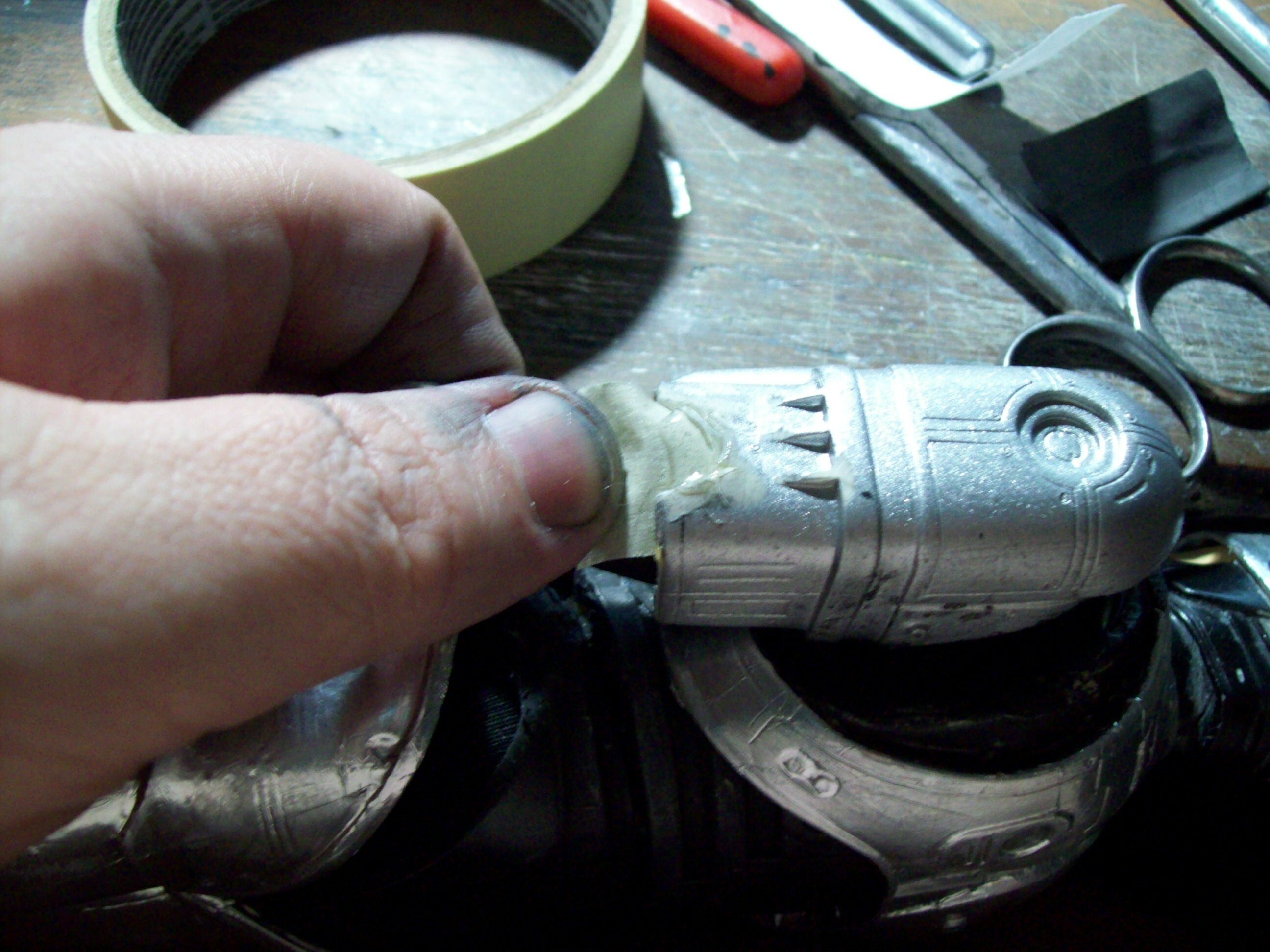

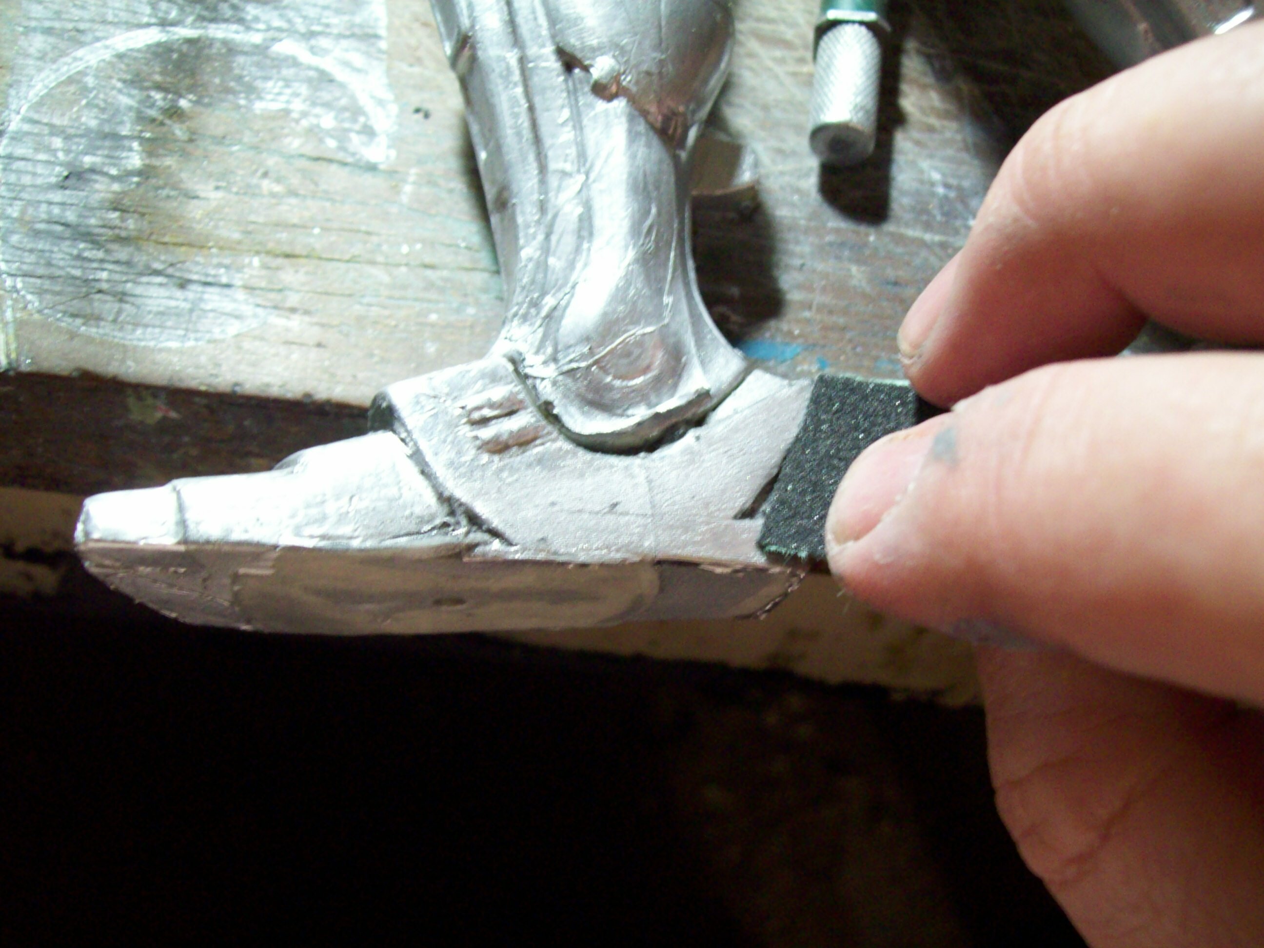

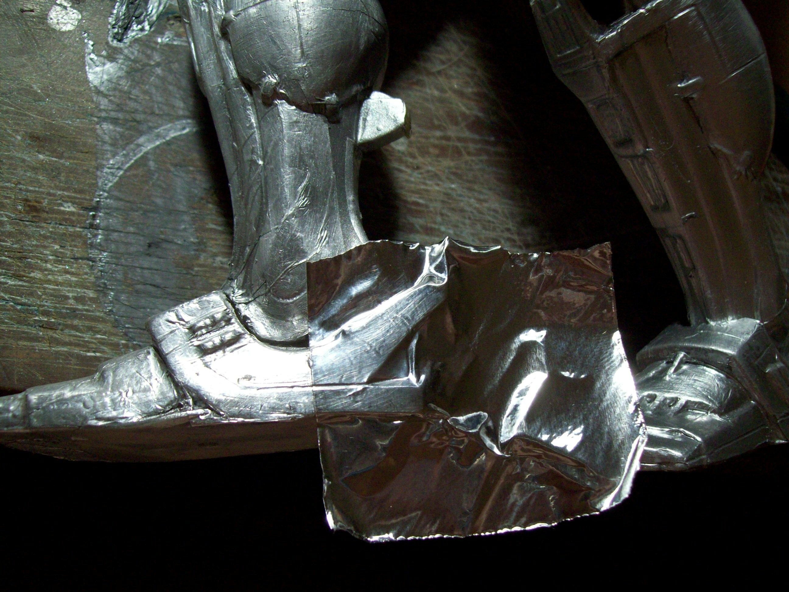

UPDATE: As promised, the foiling process I use-
1) Make sure the area to be foiled is clean; use rubbing alcohol to wipe away any debris, residual mold release or skin oil.
2) apply the foil evenly; I tend to "roll" it across the surface slowly so that it minimizes air bubbles getting trapped. Run your fingernail along the edge to "mark out" where you want to trim the foil.
3) After trimming, use a burnisher (mine is an old Xacto version with a ball on one end and a large flat plastic blade on the other) to smooth down the foil. Prick any air bubbles with the tip of an Xacto knife and smooth down with the burnishing tool.
4) Use 400 grit (or finer) sandpaper to give the foil a "brushed metal" look; make sure to go in one direction only, and be careful of how much pressure you use in sanding the foil. Too much can tear it and make a mess with the adhesive. For fine or detailed areas: cut the foil into smaller sections and burnish starting with a cotton swab. then move to using a toothpick for panel lines and finely detailed nooks and crannies.
5) After sanding the foil lightly, use #0000 steel wool to smooth it and burnish it down further.
6) After buffing with the steel wool, go over the details one more time with either a cotton swab or toothpick, re-buff with steel wool, then blow whatever debris from the steel wool off with compressed air/ hair dryer/ your breath. Wipe down one last time with rubbing alcohol, then seal with your usual brand of clearcoat (particularly if you want the "laminated titanium" look of Robo here):
Stay tuned...Murphy's law head is next....

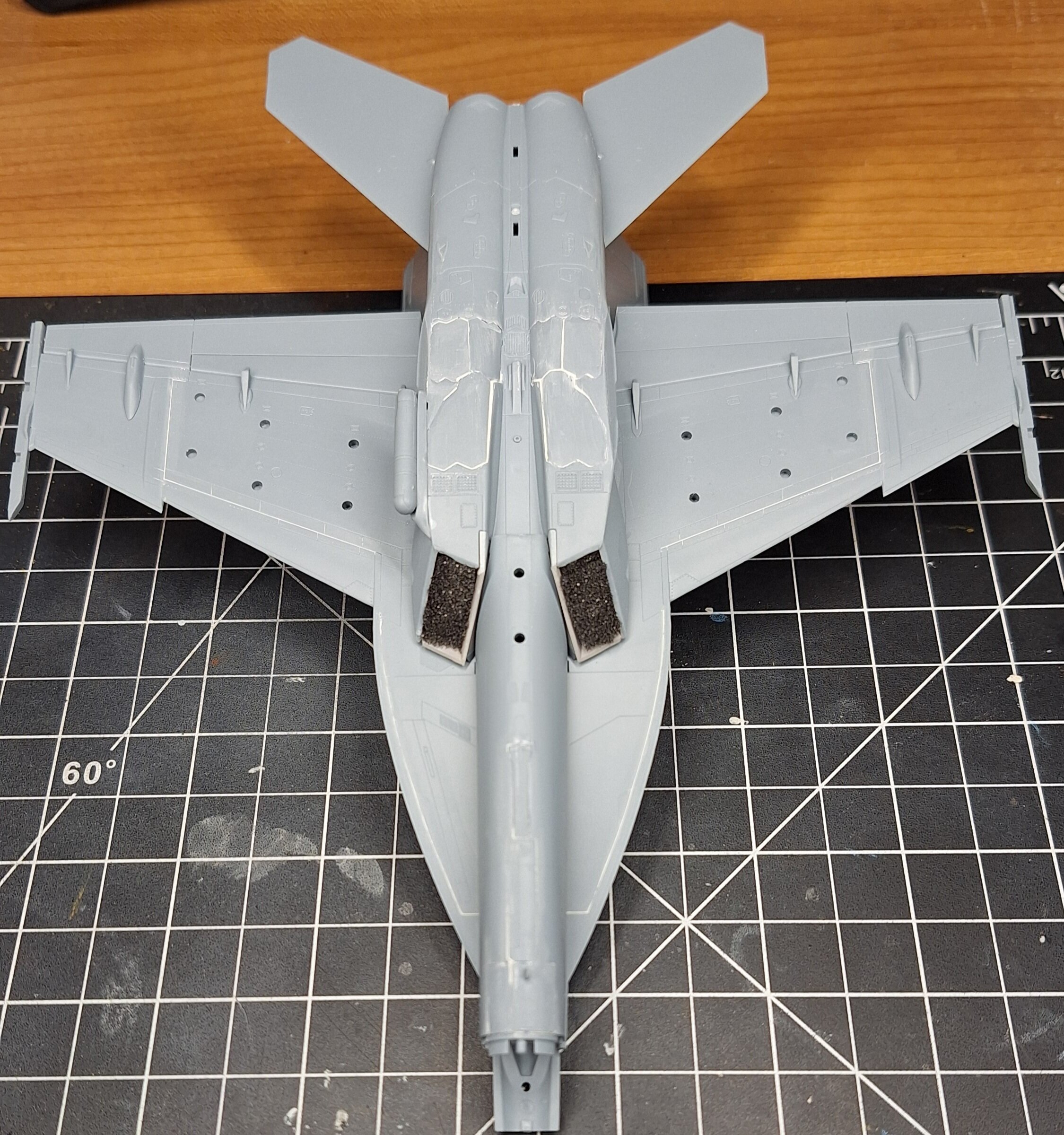

Robocop looking really good there @pengbuzz! Over here an early morning hack and cut job to get the  closed gear doors done on the Academy Superhornet.... I'm getting better at this... Since Academy can't seem to be bothered with giving you a closed door option... or pilots... 🤔 🙄
@pengbuzz He be shiney!:D
@derex3592 Nice work on the gear doors. And really, if a company does not supply closed gear doors, then the ones they do have should fit. Sometimes, it's like they have one person designing the aperture and another doing the doors and they purposefully give one the wrong dimensions.

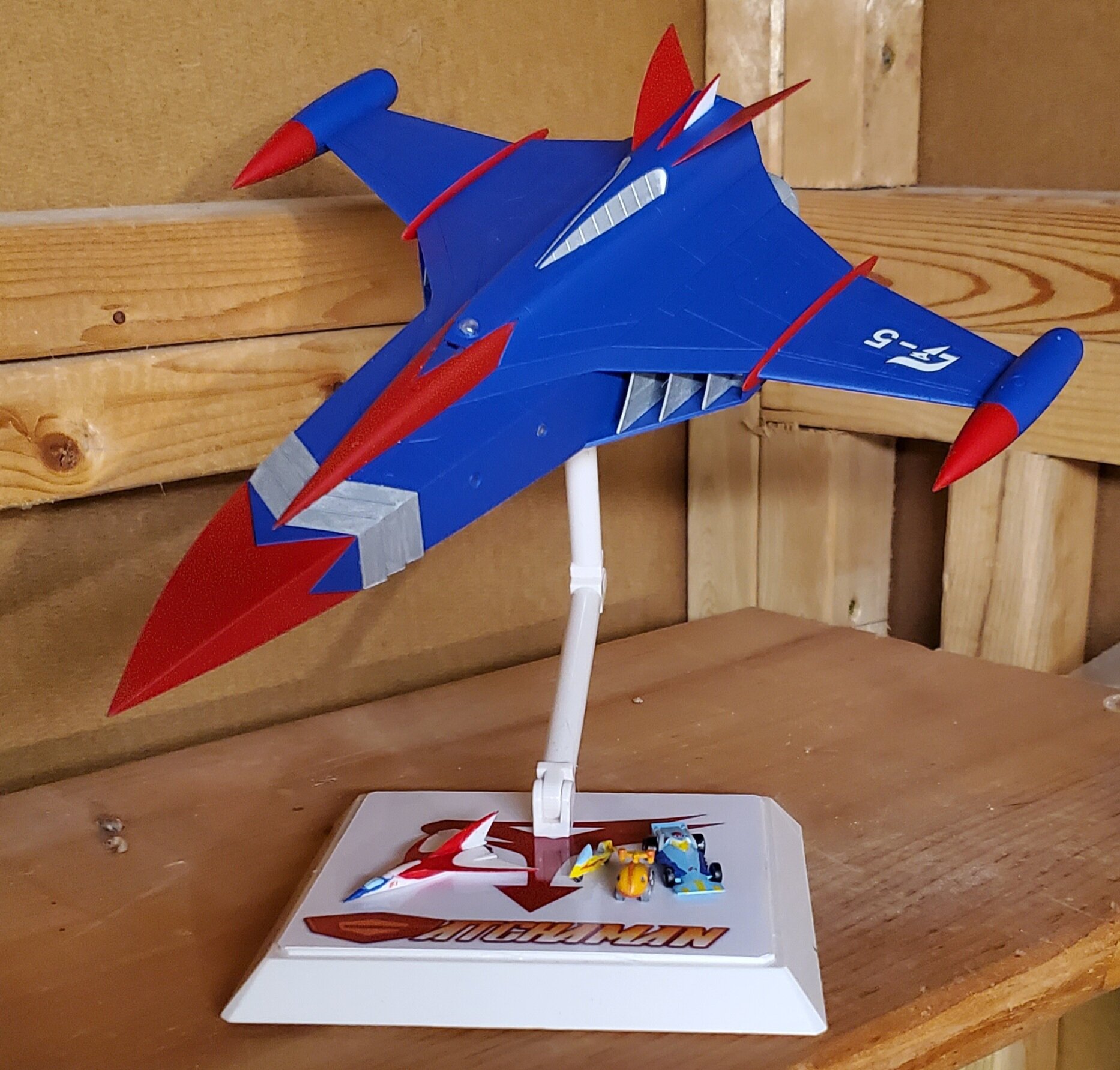

After building the redesigned Academy God Phoenix I was pleased, but still not quite satisfied so I got Wave's, screen accurate kit and, although it is smaller, I am much more satisfied with it. Unlike the Academy kit, it did not come with a stand, so I modified an old one from my spares with some images from the 'net and glossy photo paper.

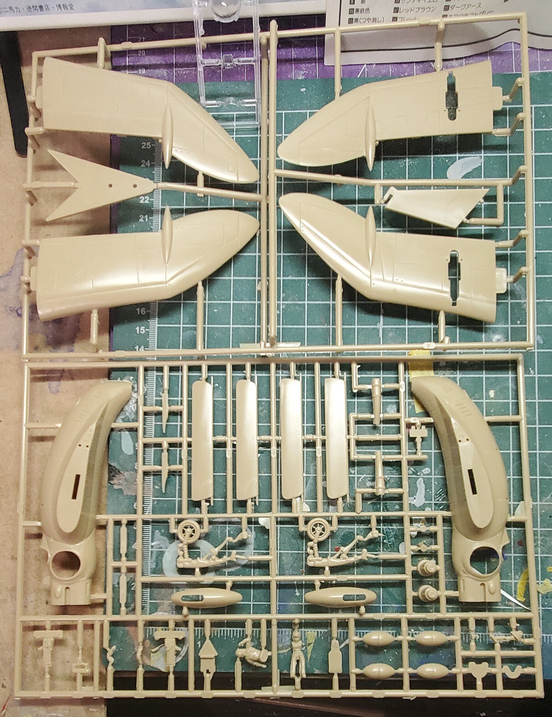

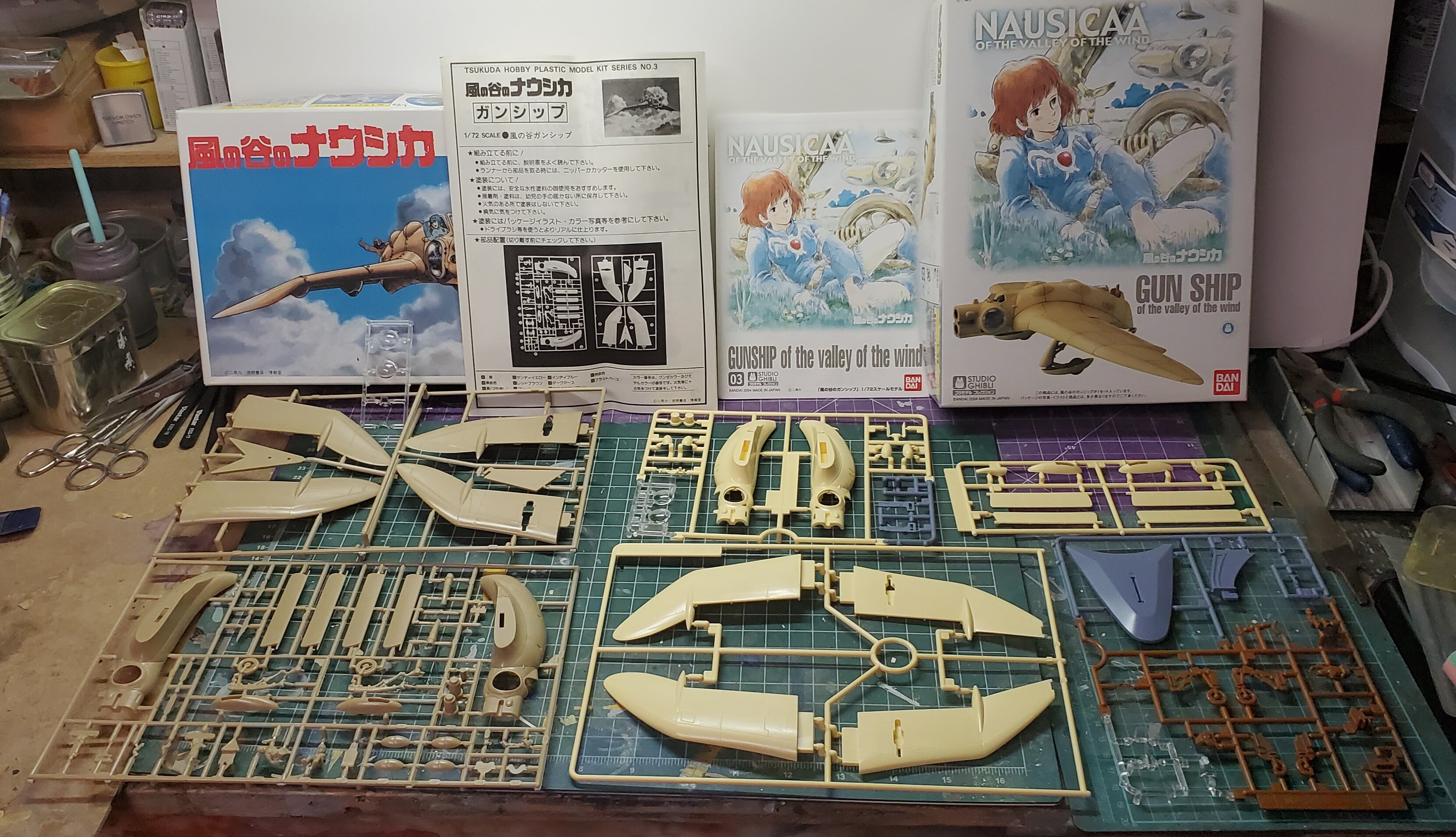

Decided to work on Nausciaa's Gunship of the Valley of the Wind for my next build. I've got two Boxings of the kit: the Tsukuda Boxing from '84 & a Bandai Boxing from 2004.
Scalemates says the Bandai is a reboxig of the '84 kit, which is what I've read and heard since forever, but my eyes are telling me a differet story. At some point Bandai engineered a whole new kit. Parts layout on the sprues is completely different, not to mention the parts themselves being different sizes and shapes with different details.
Is anyone here a member at scalemates? Thinking they might want to know their info needs updating.
Tsukuda on left Bandai on right.
Bandai
Tsukuda
Edited by Chas

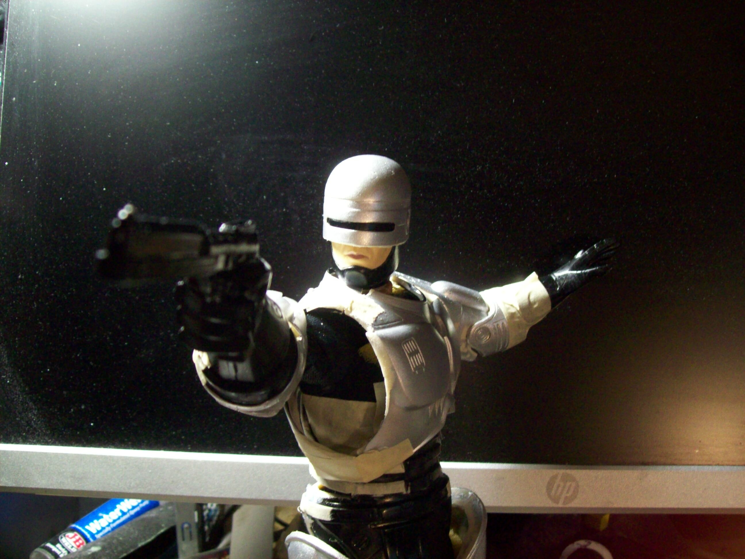

UPDATE: alternate head self-destructed on me this morning after I just got done painting it.
Threw that across the room with all my might... so it looks like there's not going to be an alternate head. Sorry folks. :(
Just going to continue on with finishing details and the backdrop for the diorama.
