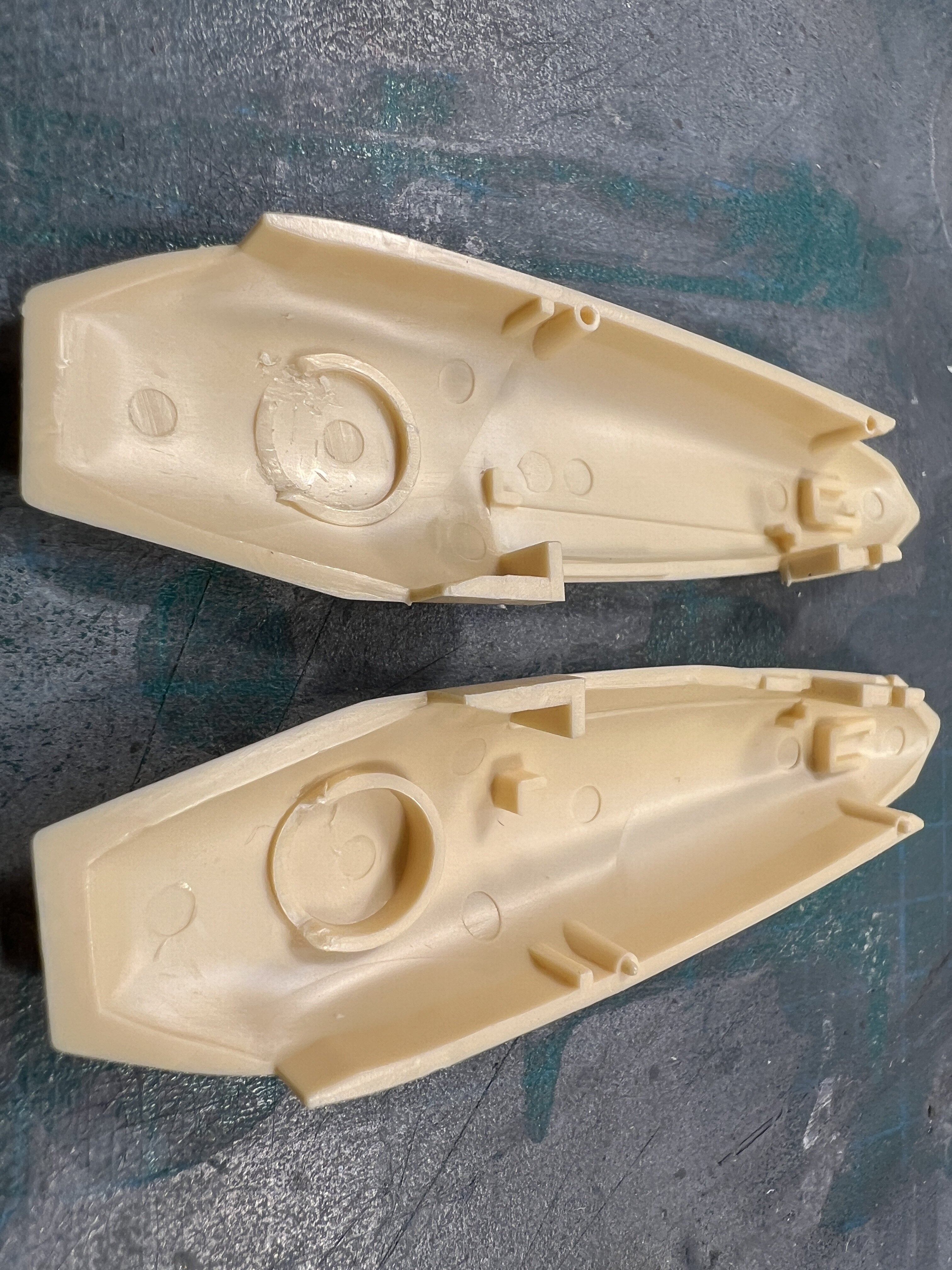

Well, I used a bit more poly putty last night. The hardener I bought will arrive Monday night. I'll take pictures of my Armored Valk project tonight.

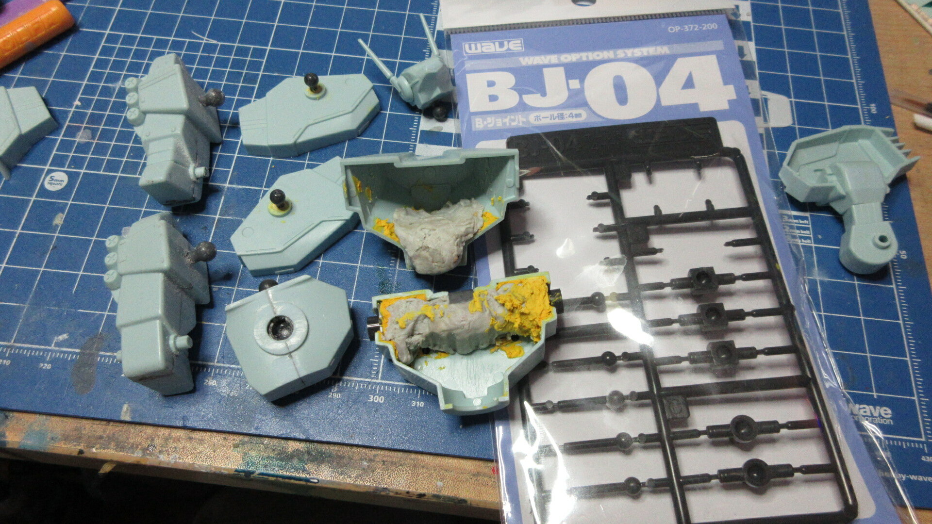

I think I am done articulating my Imai Armorded Valk. I've used ball joints by Yellow Submarine and Wave. For inside the body, I first used poly putty (the yellow stuff) and then reinforced the crap out of that with epoxy putty. I'd hate for these to bust loose once I try to pop the balls into the sockets.

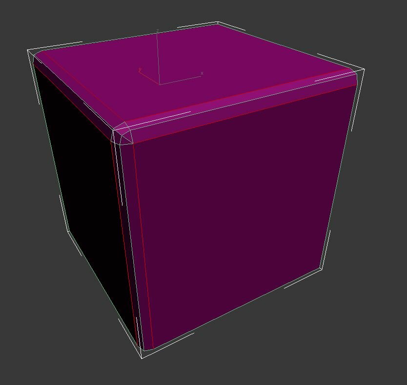

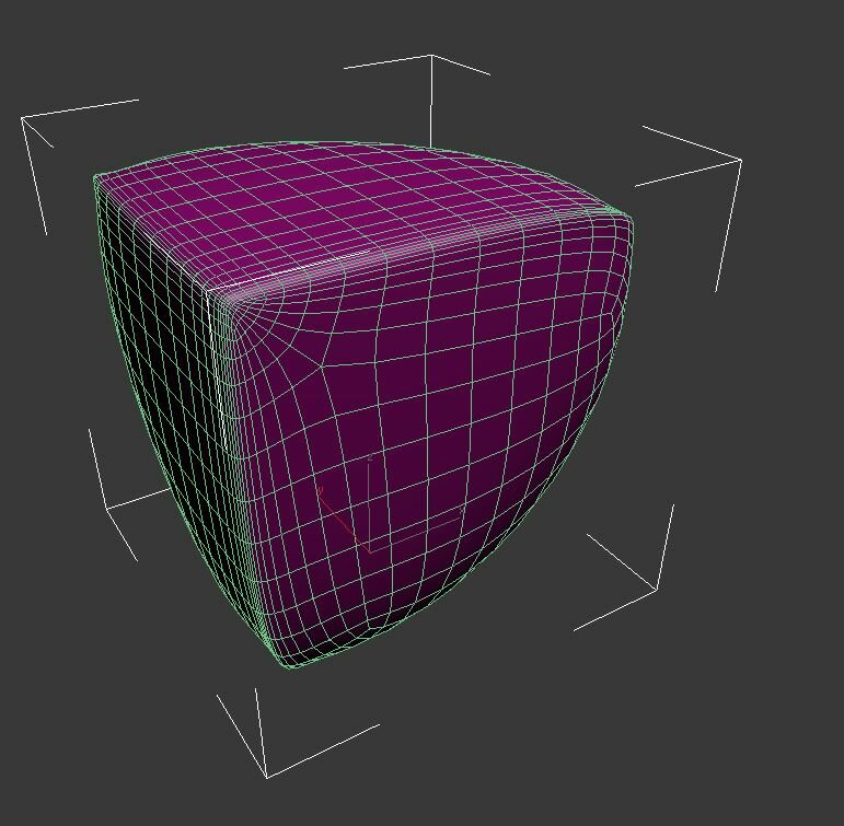

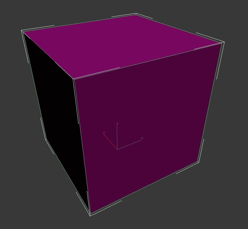

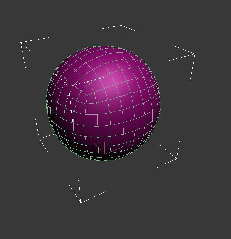

@arbit I use "chamfer" for that. Let me show you.
Let's make a cube.
Turbo smooth it with 3 iterations, you basically get a weird ball.
Go back to the base and chamfer some edges.
Then check the turbo smoothed mesh and et voilà... fun commences!

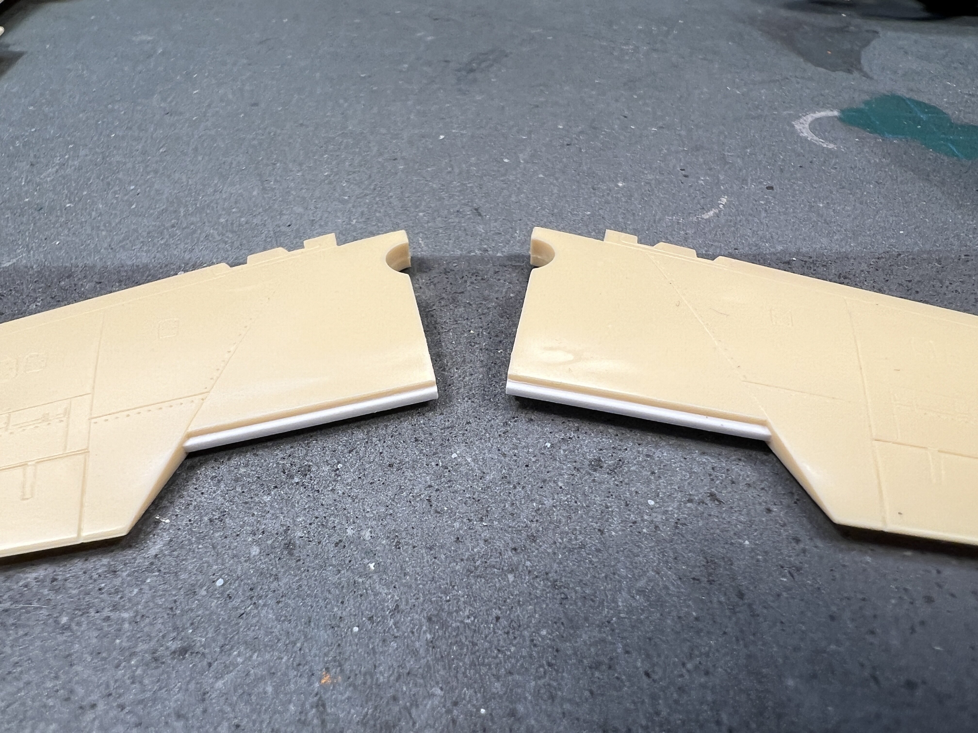

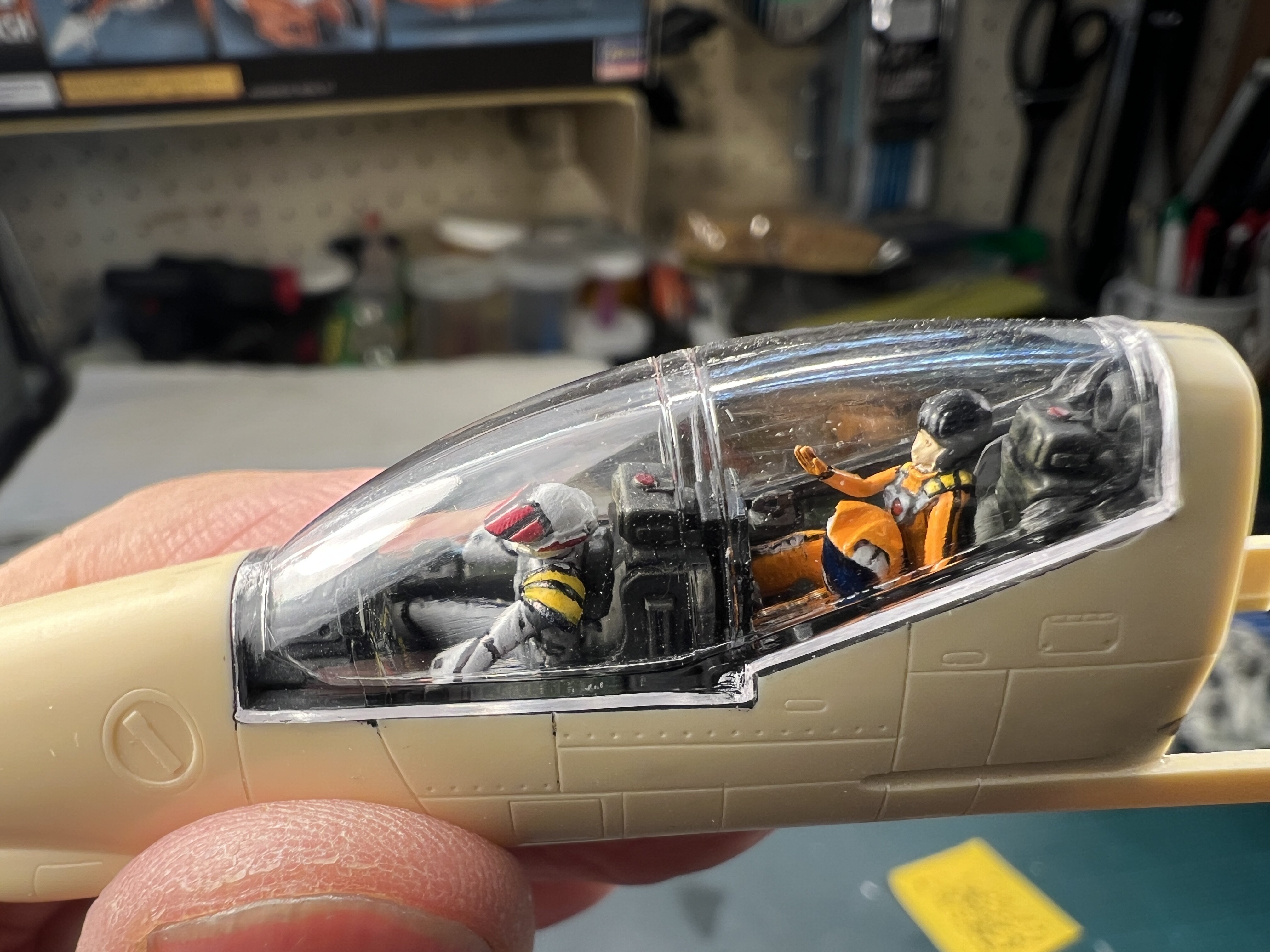

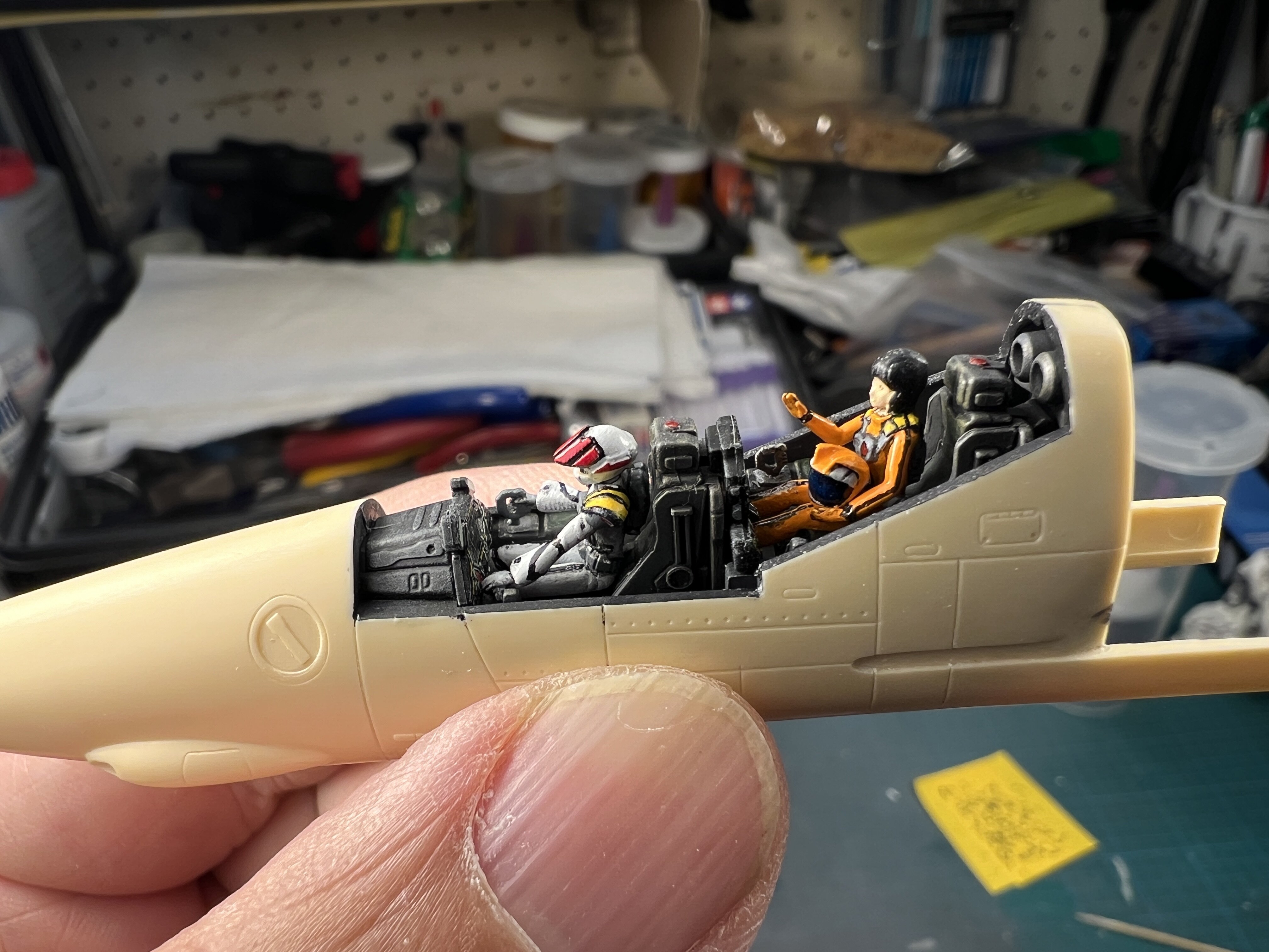

Well its been a while since I built up a Hasegawa Valkyrie.  Hard to believe its almost a 20yr old kit, still very nice, but some flash and ejector pins to fill.  Tried my best to paint up Minmay and Hikaru from @arbit's amazing 3D prints (thanks for making the helmet a separate piece it made painting her much easier). I wish I could paint in Minmay's eyes, but I just didn't have a brush small enough to lay down paint, I ended up just using a pin to make some depressions where I thought they should be.
IMG_2602.JPG.b86b9ed6dbff53f1cbefe4e78d1df1f2.JPGIMG_2604.JPG.758b5c453f117da7ed1c37e98ae58220.JPGIMG_2606.JPG.372ad1d8ceb9f932b7b7411298d5a654.JPG
With the Canopy (dry fit) on you don't see as much as I would have hoped.  (I really should have dusted before I took these photos)

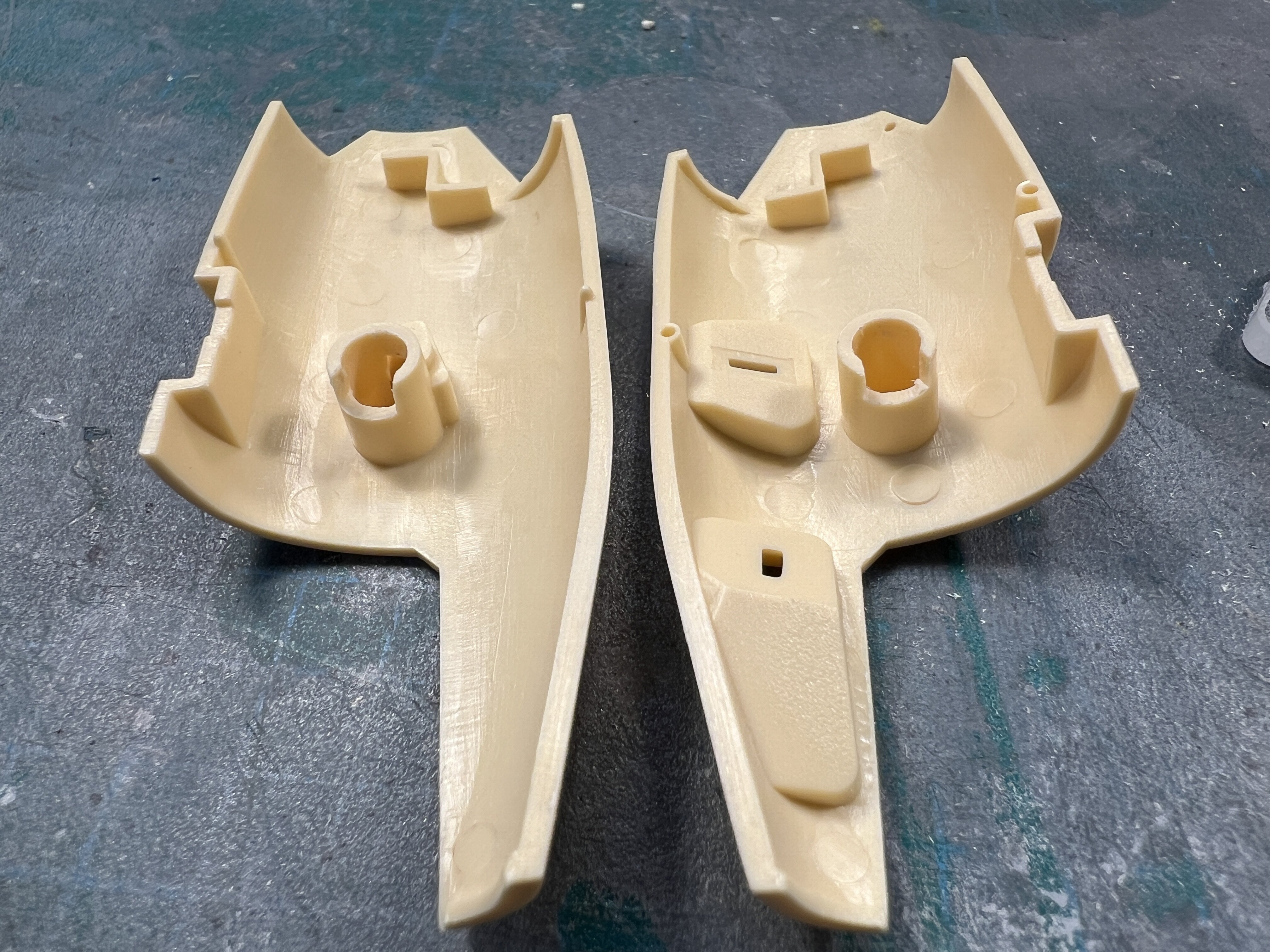

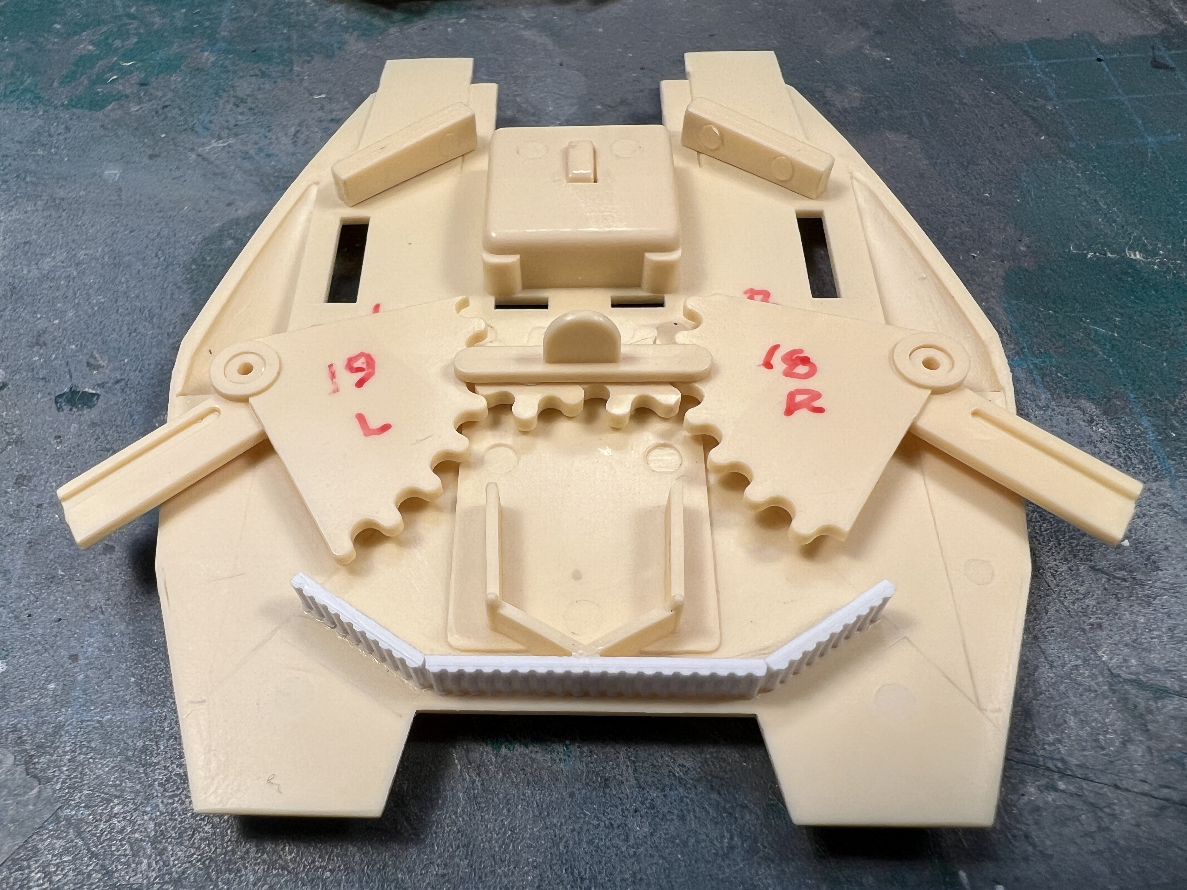

These are just some other reminders of the injection pin depressions I filled (with crazy glue) some added cut styrene and notching out the thruster pivots so I can paint them separately and install them at the end after everything is filled/sanded and painted.

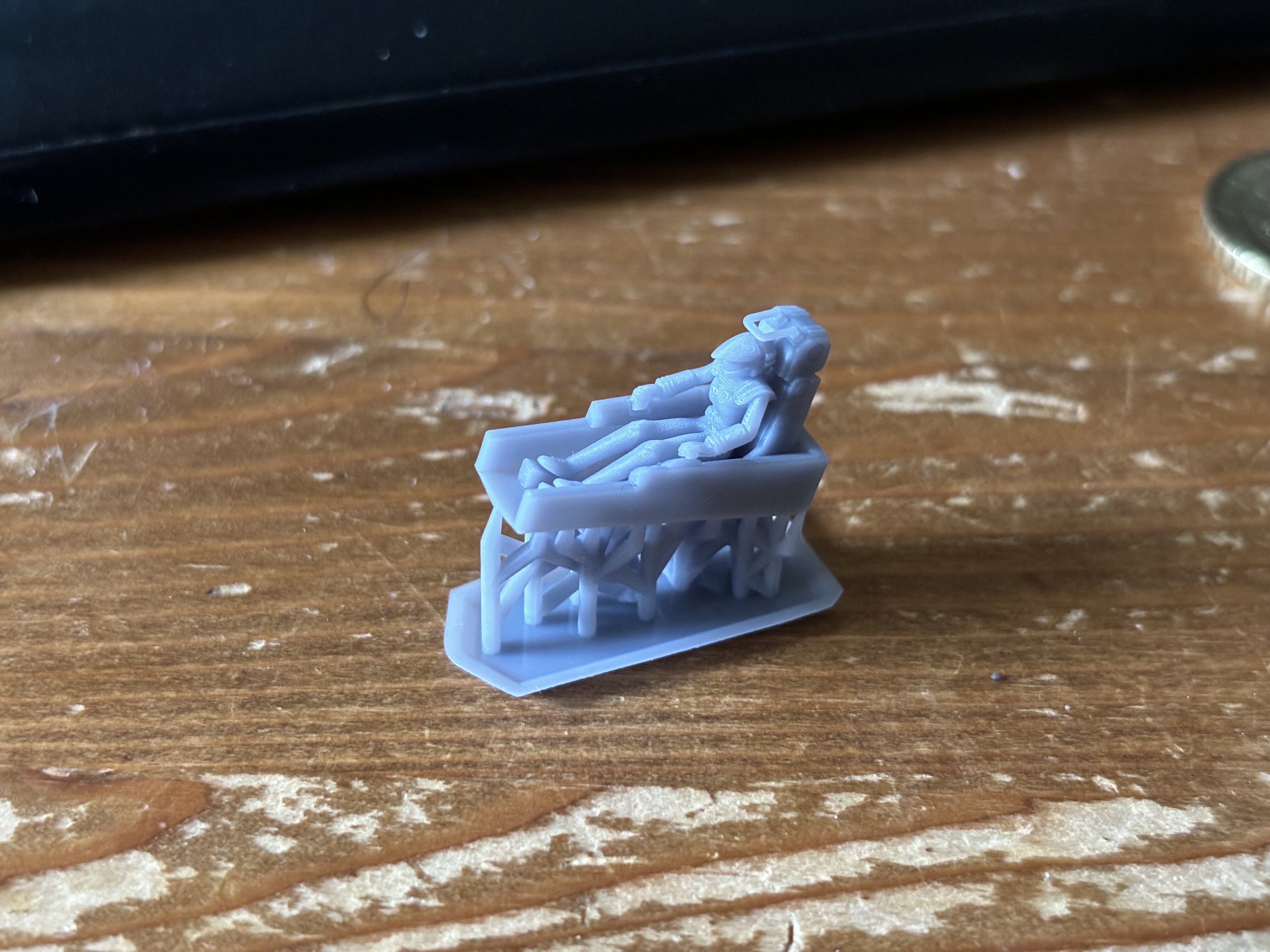

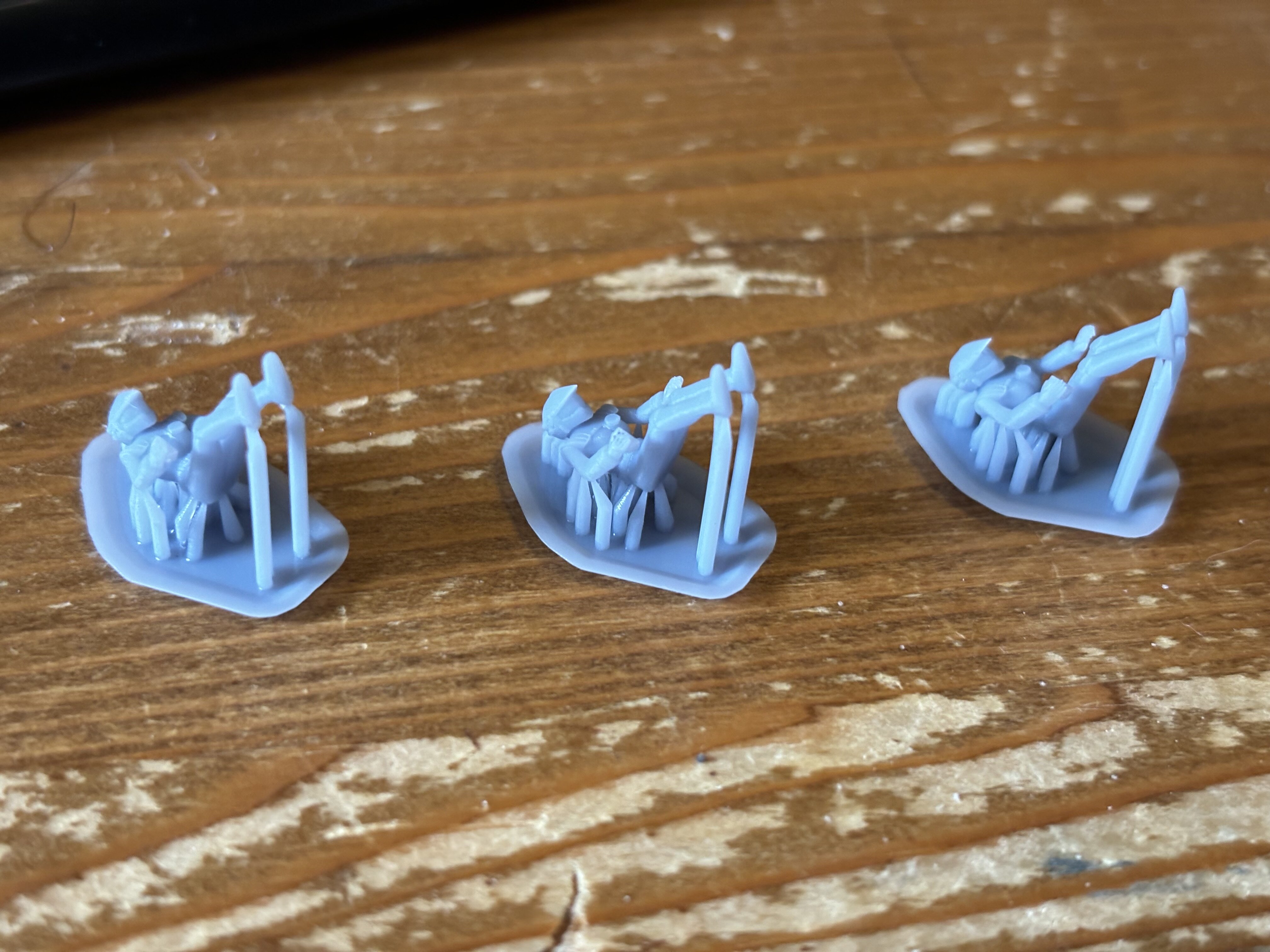

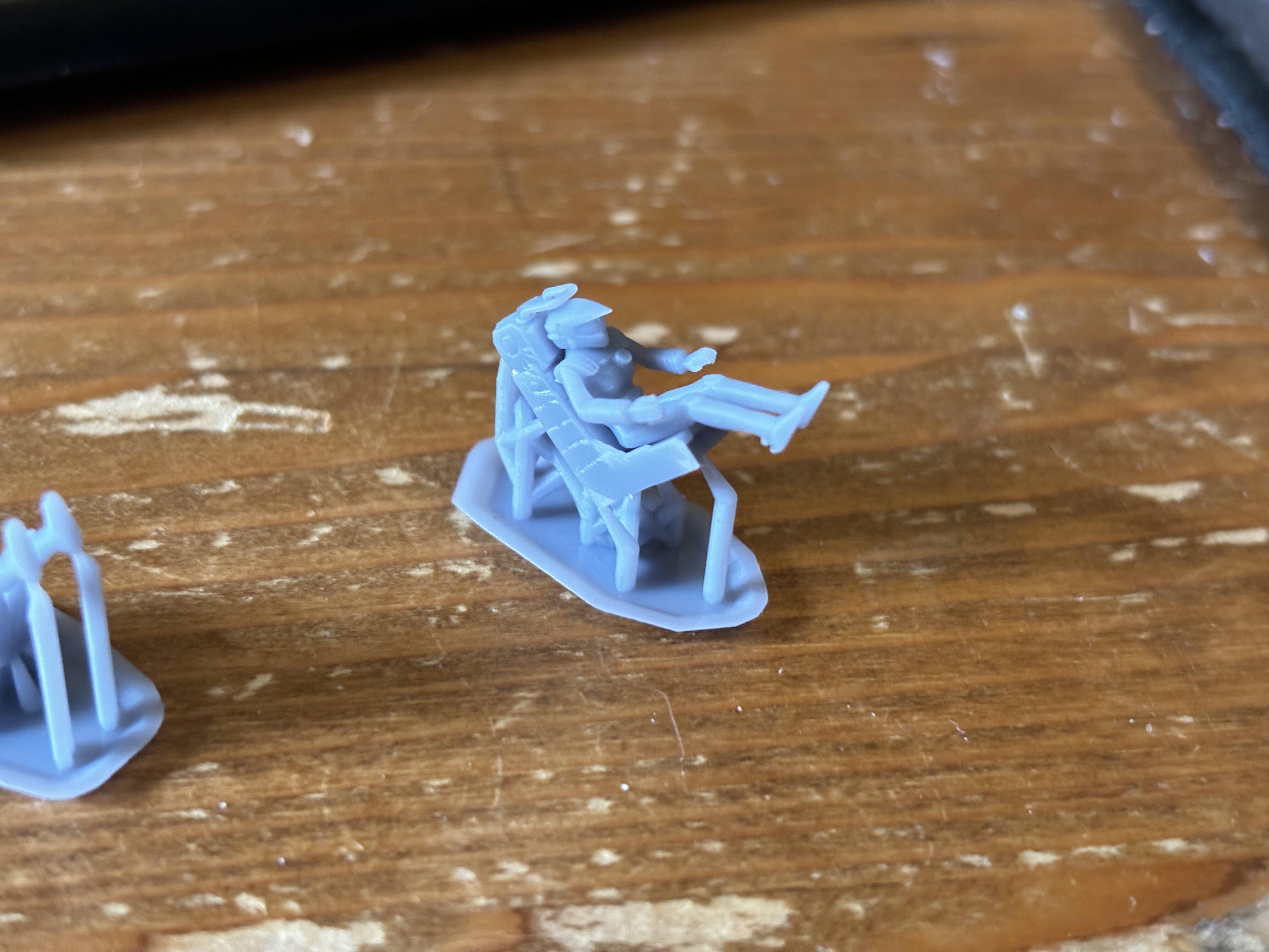

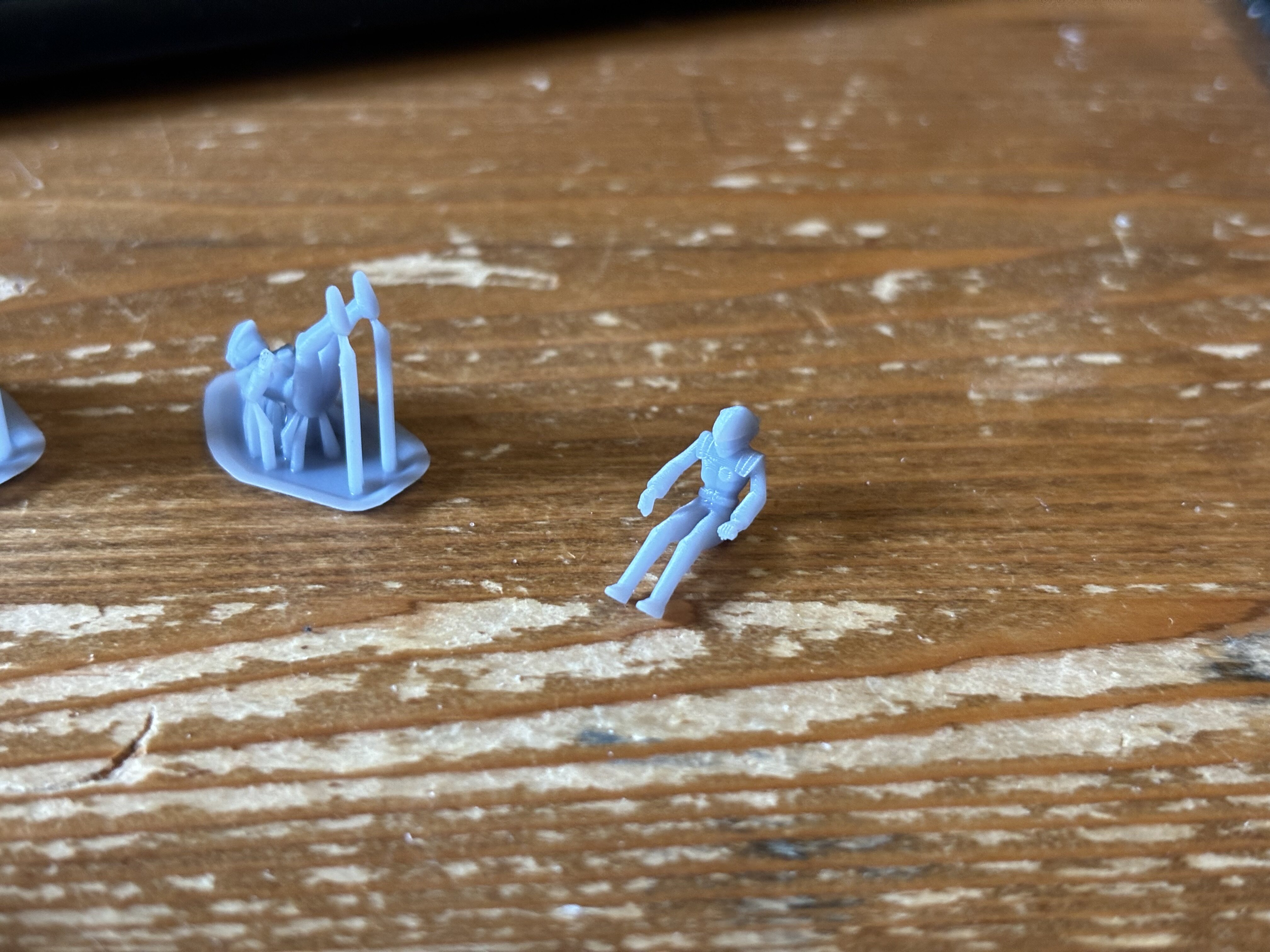

I spend the night fixing my M3 Milia. Test printed her three times and seems so work now.
detaching from the support went easily, nothing broke so it has enough strength.
and it fits the VF-9 pilot seat.
I will upload the STL later the day, so who ever wants to print an army of Milias can do that.

Looks very good. Great job!
Cool.  Little eyes are a problem, but only when zoomed in like that.  Did you consider putting some shadow on the area and going from there?
@SteveTheFish Your custom articulation will make that a MUCH better model for posing. The stock styrene joints just don't last.
@wm cheng Your Valk cockpit and figures look fantastic! I think you'll see more detail than expected. Your "pinpoint pupil was a good idea!
I'm hoping there's a GOOD tutorial on painting 1/72nd scale figures. Having "little Orphan Annie eye's" can be distracting from all the great work on the rest of the figure. I have a LOT to do in the coming months or so. Three now for my gun turret model.
@Urashiman Nice and smooth prints!

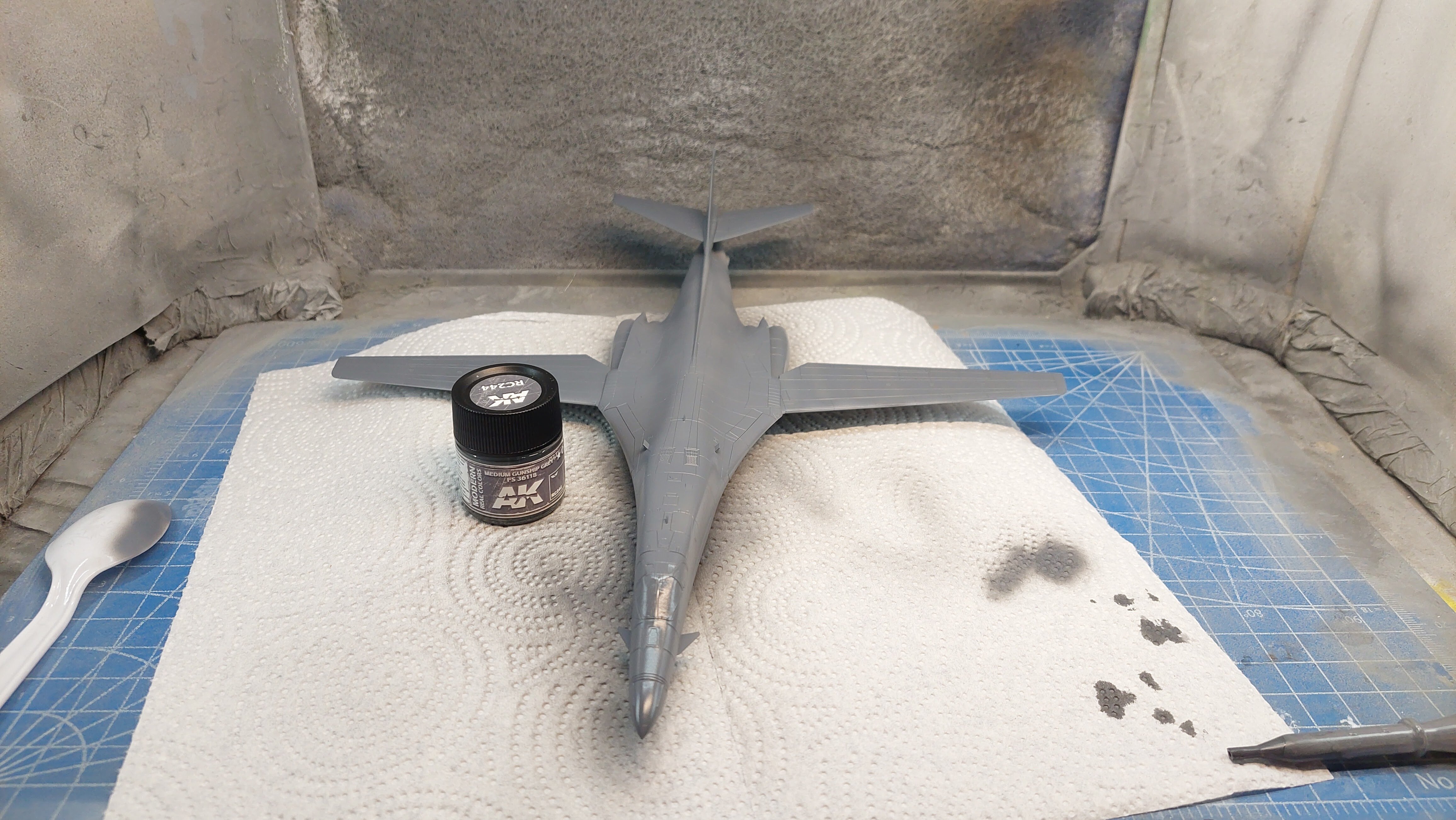

@derex3592 Clean coating! - MT

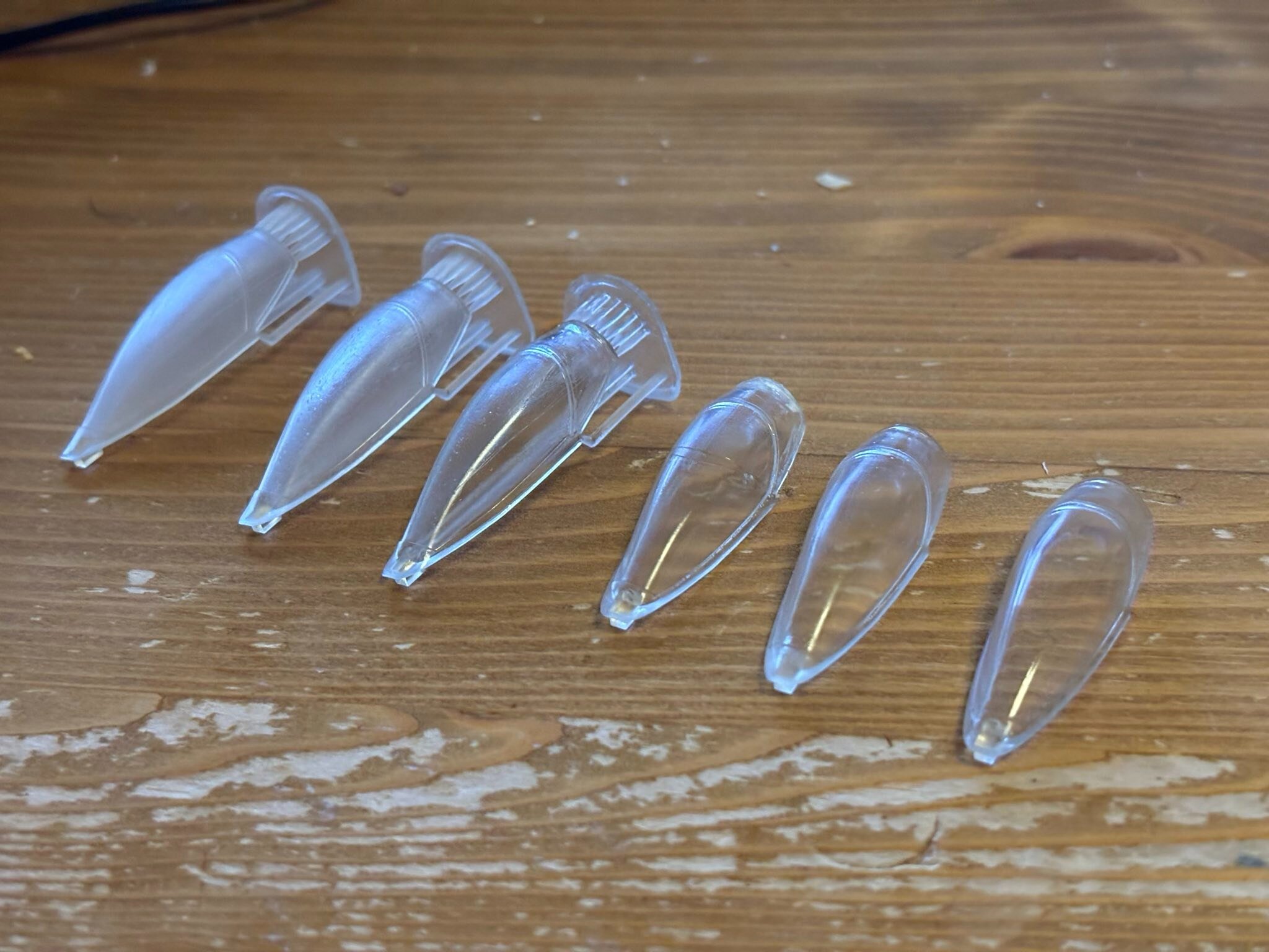

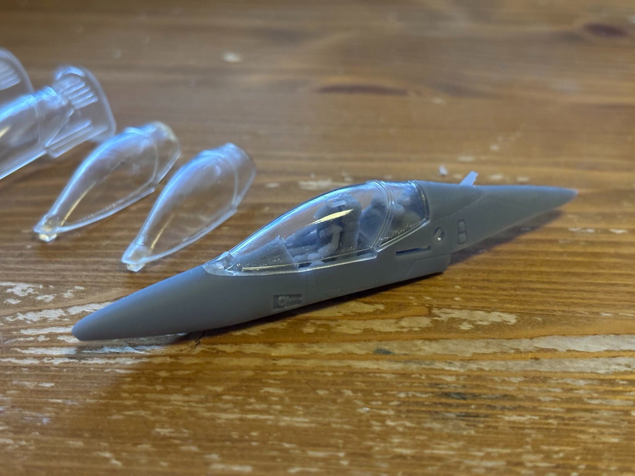

Got some stuff to show again. I have been testing around with polishing the clear resin stuff and basically came to the conclusion, that even with microfiber pads on a hobby drill to polish the stuff and using polishing compound, the canopies stayed slightly milky and never went full clear. So I went another approach.
Left to right.
  1. Unprocessed cured print of the canopy
  2. Unprocessed cured print of the canopy coated with hairspray (because someone told me, they coat their models in loreal hair spray)
  3. Unprocessed cured print of the canopy dipped in Tamiya X-22
  4. Unprocessed cured print of the canopy dipped in Humbrol Laquer Clear Coat
  5. Sanded (up to 500 grit) cured print of the canopy brushed with Humbrol Laquer Clear Coat
  6. Sanded (from 180 to 2500 grit and polished with microfiber) cured print of the canopy, dipped in thinned (mr. color leveling thinner) Tamiya X-22
The last one on the list is by far the clearest and shiniest of the canopies. I used the failed prints with the bubbles inside to test around, so no worries. I will pick one of the good prints later and start sanding and polishing, then dipping in thinned X-22. That should be good I think.

I like your dedication to the canopy-issue, but have you thought of making a solid buck and doing a plunge mold for the canopy?

hehe... I actually did, but that would be the easy way out. Imagine you want to print something clear that is a little bit more complex than a canopy... plunge molding wouldn't do for that.
I dip canopies in Future Floor Polish, but I imagine that might not be available in Germany. It isn't available here in Japan, so I asked my friend in America to bring me a bottle once when he came to visit me. That bottle has lasted a long time.
Honestly, for a self-made canopy, even the last two or three would be plenty shiny for me, that's fantastic that you can make them so clean.
My biggest concern would be how brittle they are, since my few experiences with printed resin canopies have all been extremely fragile, and would never have survived any level of polishing.
@SteveTheFish Haha, yeah. The Future Floor Polish. We don't have that here, but we have similar stuff. Unfortunately that stuff yellows over time, same as Future. As far as I know, Future is discontinued and the model kit community in the US was going nuts for the hunt of Future bottles. I think it was re-named to "Pledge floor gloss" so they get that now. Indeed, any acrylic wax can do, not just Plesge. But, instead of using that, I was going the actual "coat" approach, checking what colours are actually developed to be coats. The Revell gloss and mate coat stuff is really bad. I didn't have luck with vallejo coats as well. The Citadel Ardcoat is kinda working good, but it has to be coated on several times. I had best results with Tamiya X-22 for anything acrylic based and humbrol coats for anything lacquer based. In the past I would have used Model Master clear top coat, but they are hard to get because they have been discontinued. I haven't gotten to try the testors top coat yet, as it is super expensive. Testors is not widely available in Germany.
@Chronocidal Thanks! Well, it is challenging, but it can be done. So far no canopy broke. Just gentle sanding in steps 180, 320, 500, 1500, 2000 and 2500, then microfiber polishing and done. When I polish the next canopy I will go through each step and take pictures. The most annoying part is sanding the inside, because my fingers barely fit into the canopy.

I wonder if Caranuba wax would help at all? Maybe test a little bit on one of your spare canopies?
It could, but unfortunately it has a natural yellowish tint to it. There are processed versions of it, but they don't run as caranuba wax.
