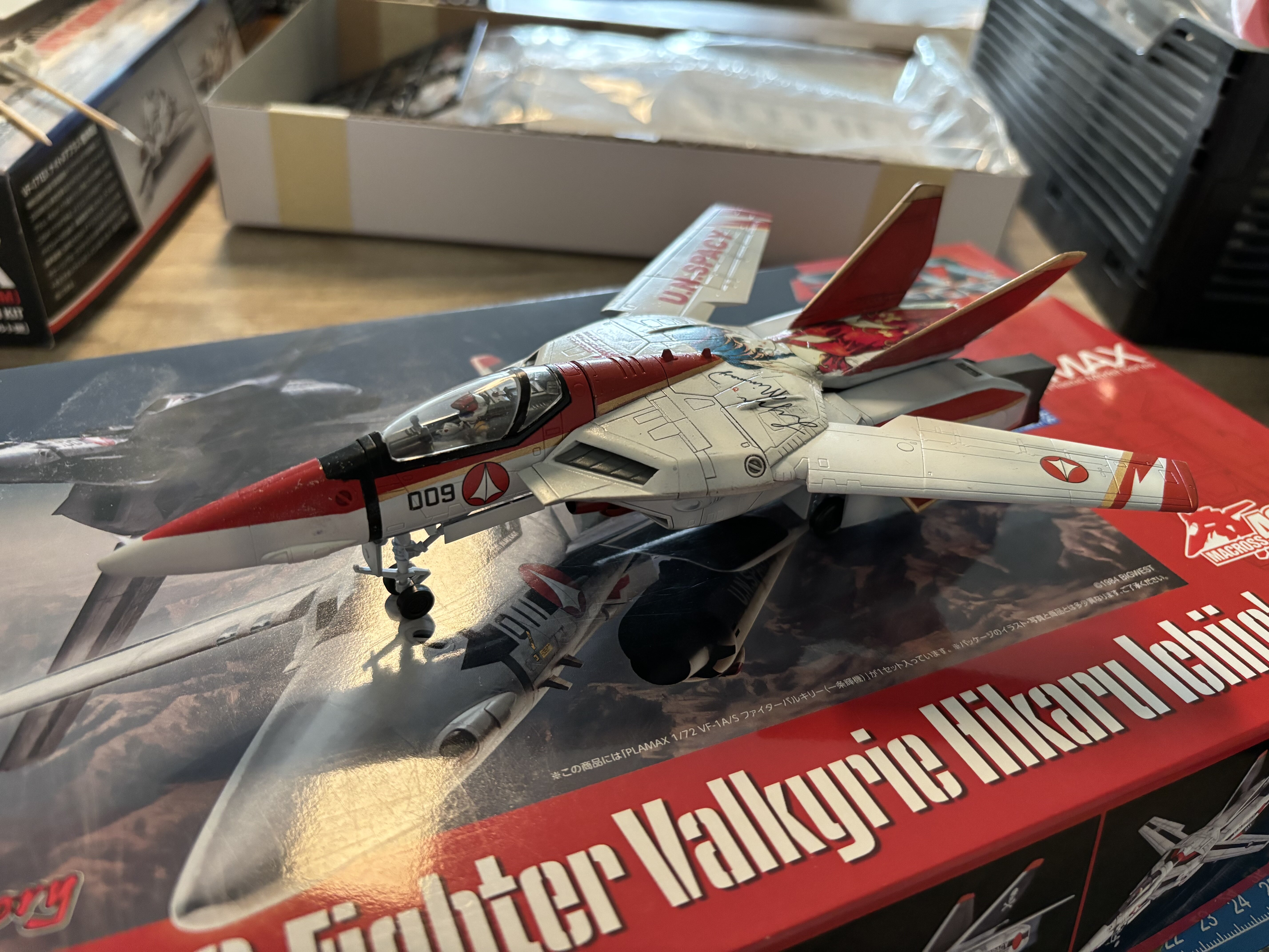

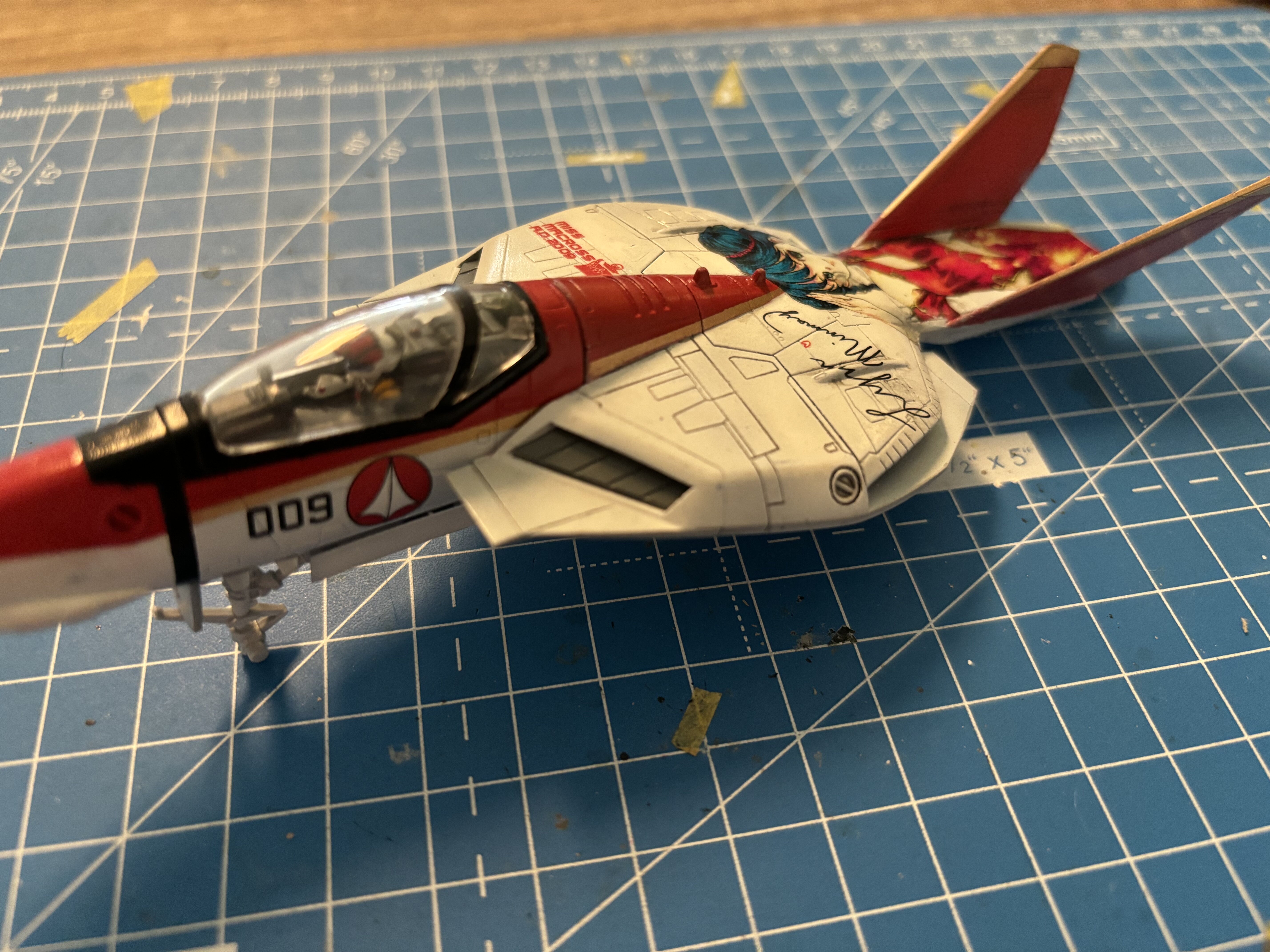

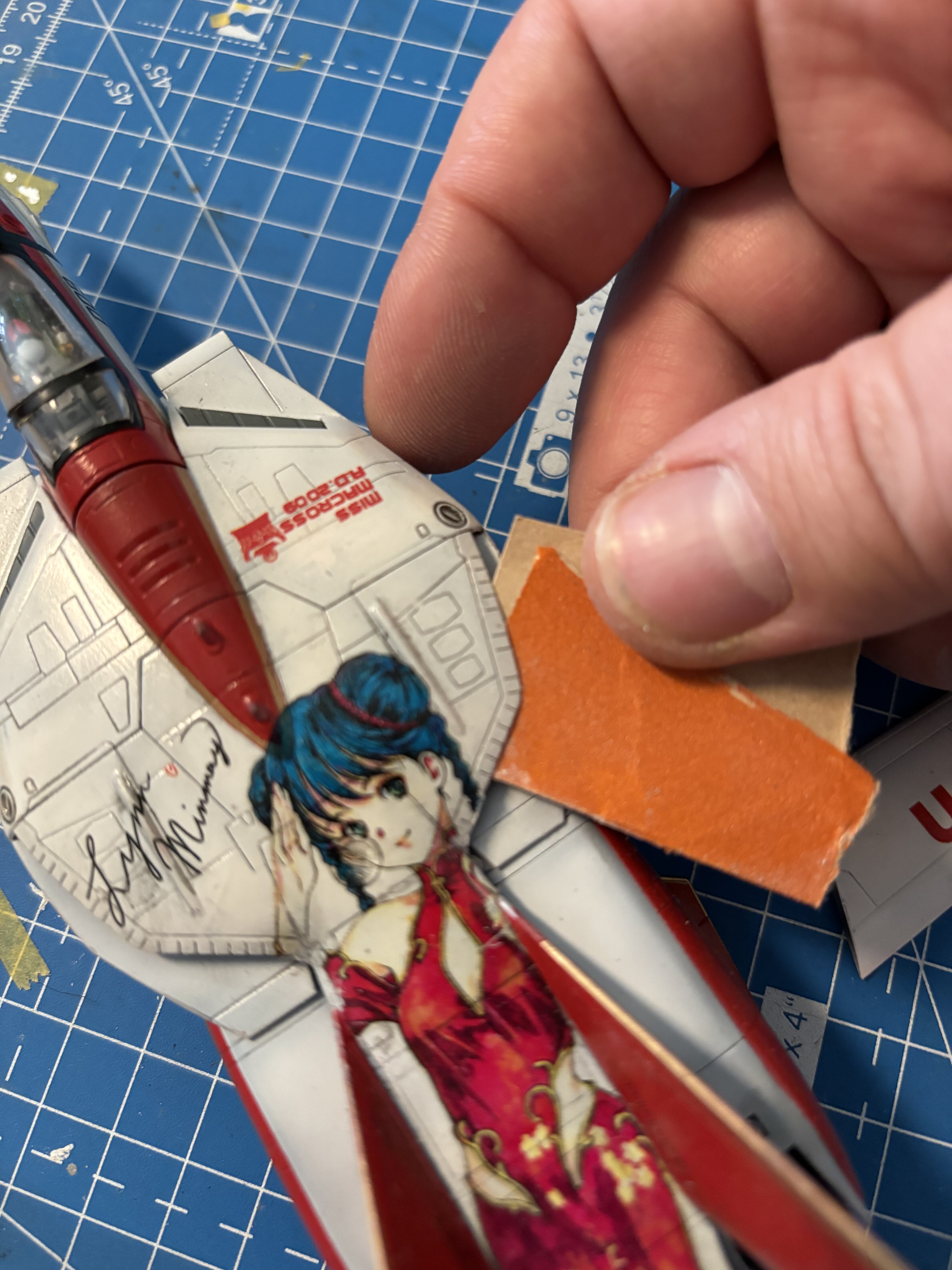

Urashiman Posted November 3, 2023 Author Posted November 3, 2023 Finally got enough willpower to force myself to fix the botched panel lining on the plamax VF-1A. still looks a bit dirty but much better than before. I tried adding the wings and noticed that the main fuselage is scratching on the paint of the wings, so I had to carefully sand down the cover. Almost there⦠I want to 3D print better wheels for this one. The ones in the box are⦠not good. I did some priming on the Alto VF-171EX. Quote

Thom Posted November 5, 2023 Posted November 5, 2023 @UrashimanĀ That VF-1 is looking great. Love the decals. Great to see your collection growing @pengbuzz, and your plans for more! @derex3592Ā The BONE sure is a sexy plane. There was a proposal in the early aughts to reengine it and turn it into a missile truck, called the B-1R (regional) Or, wait for it... BONER.š Ā Ā Quote
Urashiman Posted November 5, 2023 Author Posted November 5, 2023 5 hours ago, Thom said: @UrashimanĀ That VF-1 is looking great. Love the decals. Great to see your collection growing @pengbuzz, and your plans for more! @derex3592Ā The BONE sure is a sexy plane. There was a proposal in the early aughts to reengine it and turn it into a missile truck, called the B-1R (regional) Or, wait for it... BONER.š Ā Ā Thanks a lot! did some test printing with clear resin today. Printed the new cockpit pieces and the canopy. I think I need to polish the canopy. When still wet, it was clear and see through. Quote

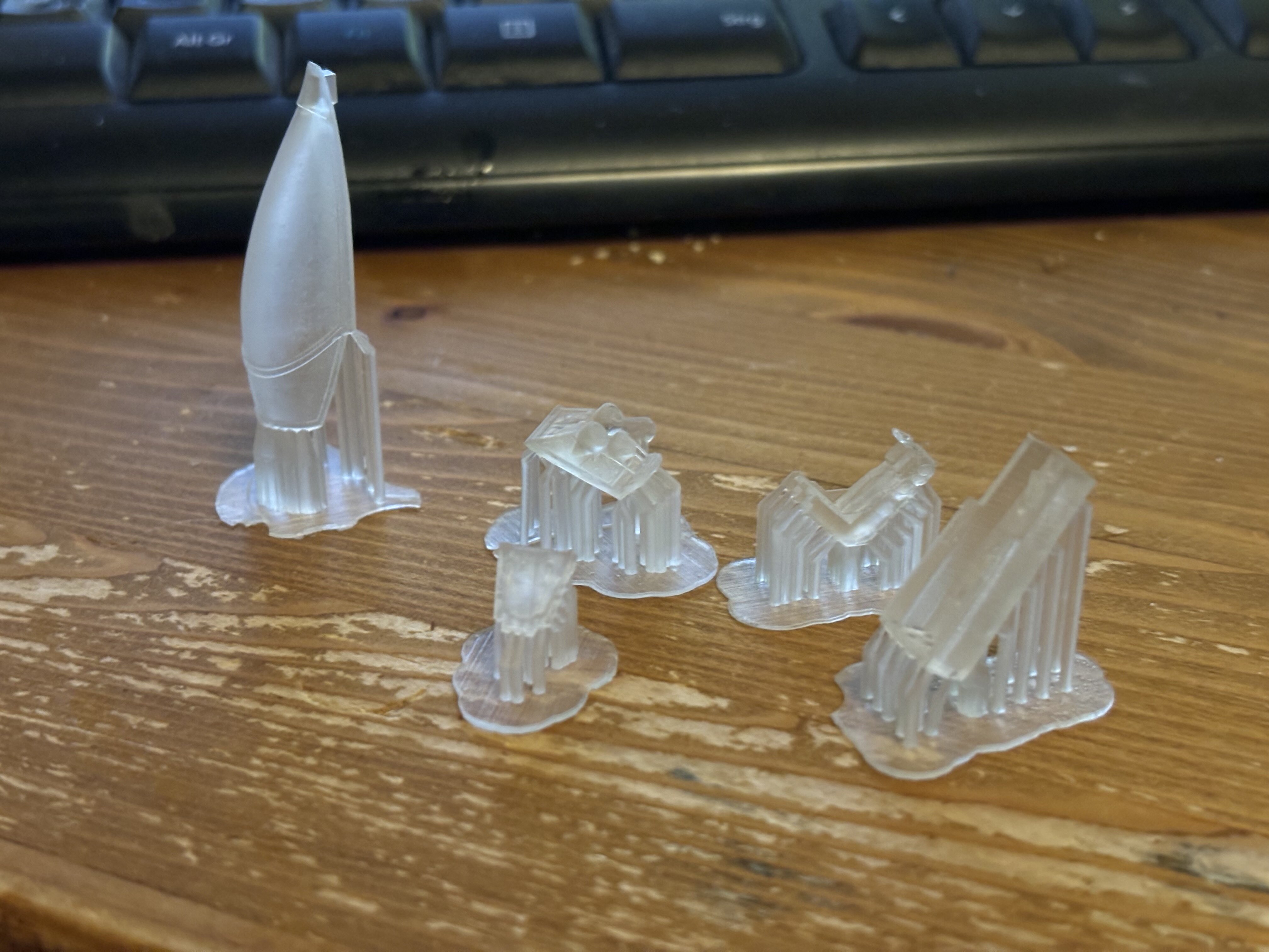

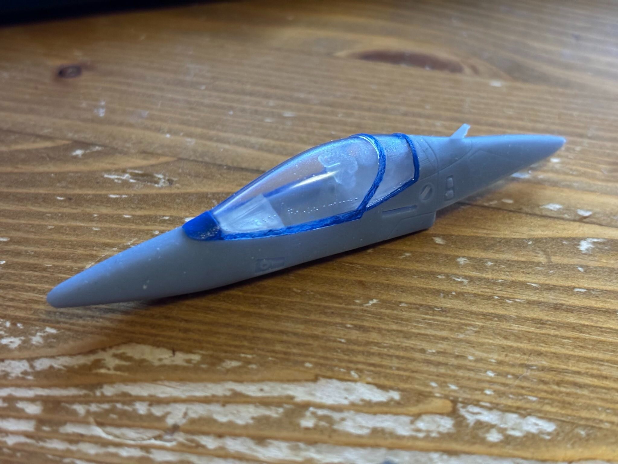

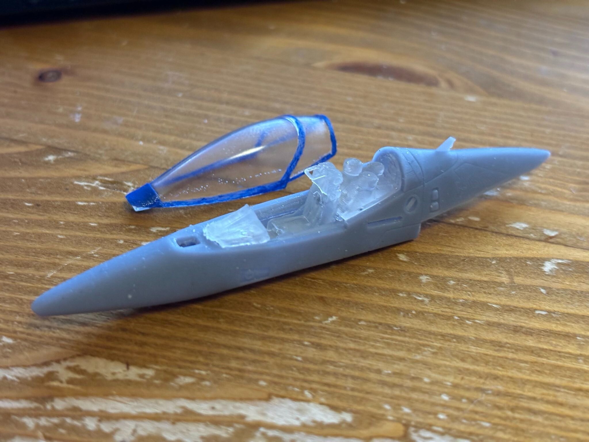

Big s Posted November 5, 2023 Posted November 5, 2023 30 minutes ago, Urashiman said: Thanks a lot! did some test printing with clear resin today. Printed the new cockpit pieces and the canopy. I think I need to polish the canopy. When still wet, it was clear and see through. A polish would probably do the trick. Maybe even a gloss coat, but with a resin print the polish would probably be betterĀ Quote

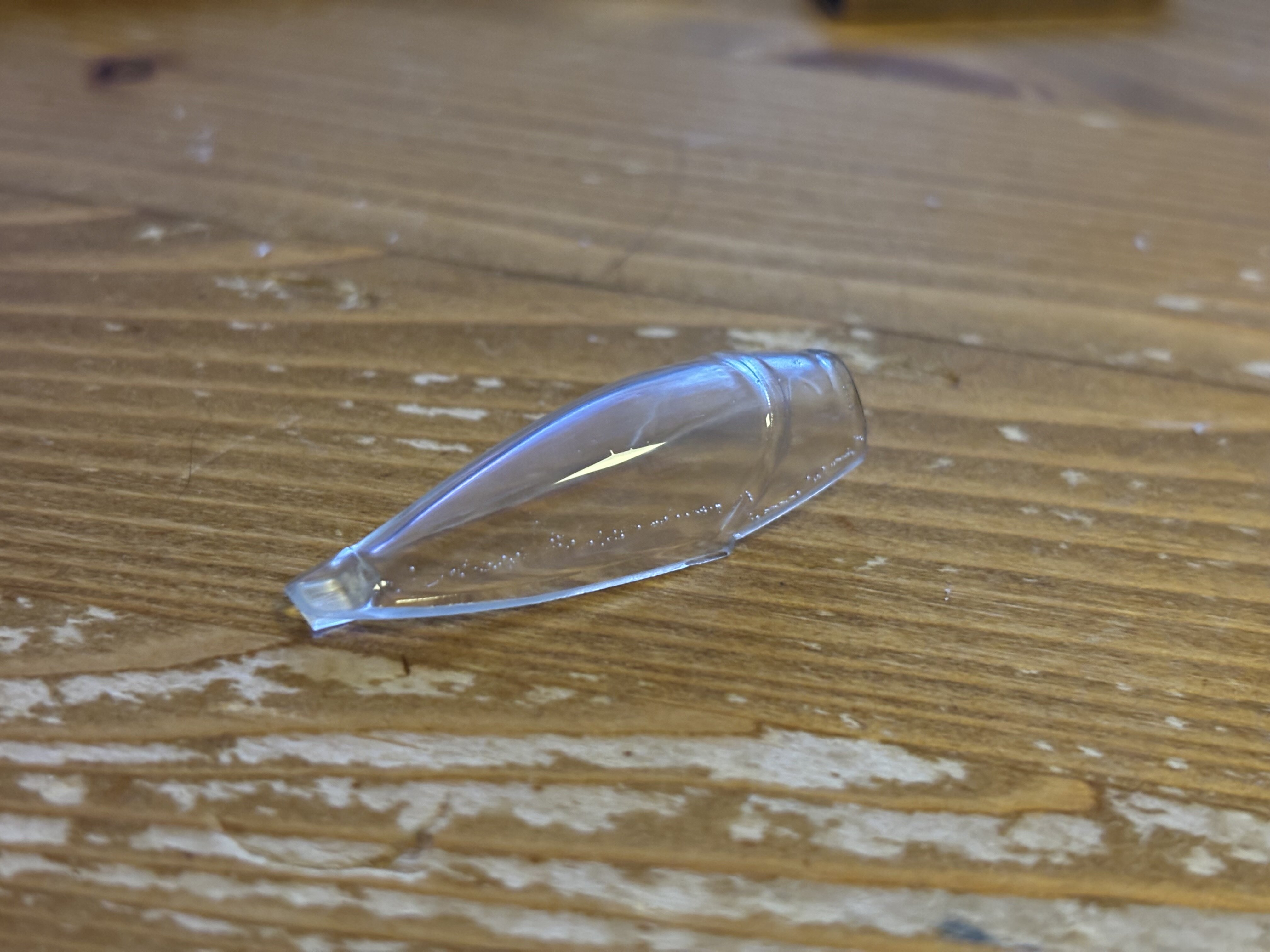

Urashiman Posted November 5, 2023 Author Posted November 5, 2023 25 minutes ago, Big s said: A polish would probably do the trick. Maybe even a gloss coat, but with a resin print the polish would probably be better Yeah⦠just tried it. Polishing kinda git me there, but I would need proper compound now, as the resin would just suck up my toothpaste. I gave it the clear coat treatment- et voilÔ:  unfortunately, the print went bad. There are some bubbles in the resin. This one was for testing anyways Quote

MechTech Posted November 6, 2023 Posted November 6, 2023 @Urashiman Your valk is looking beautiful! That is A LOT of decal work to be careful with. The details are looking great on it! Maybe dipping the canopy in Pledge floor polish will help (or whatever they call it in Europe these days). Not the bubbles, but you're next canopy. @pengbuzz Grumpy Cat looks GREAT man! You can't tell you did all that work to him - which is good! He looks like he came in the box like that. I look forward to the rest of the gang being done. @derex3592 WOW! Somebody was busy! Great looking finishes. I forgot, for the Cat's Eye, were you just trying to strip the paint off it? If so, the "LA's Totally Awesome" (Dollar Tree) is cheap, totally safe and does a great job. Tamiya's paint comes off in minutes. Enamels maybe a couple of hours depending on thickness. A scrub brush helps speed things up. You just need to clean the residue off with soap and water.Ā - MT Quote
Thom Posted November 6, 2023 Posted November 6, 2023 @Urashiman Quickly getting closer to perfection! @derex3592 You truly have a really busy table! The black on that SR-71 looks fantastic and I would love to see that Cat's Eye moving forward. Reminds me of mine sitting so forlorn on the Shelf o'Doom... Ā Quote

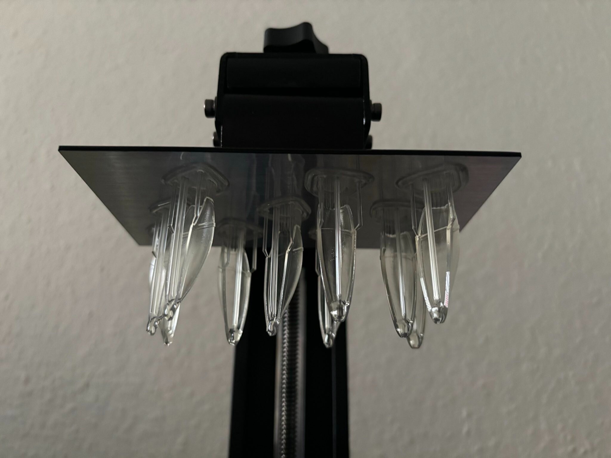

Urashiman Posted November 6, 2023 Author Posted November 6, 2023 @MechTech Thanks! Floor polish haha. Yeah no, I was thinking more of actual polishing compound going from grid 2000 to grid 10k and stuff like that @Thom Ooooh yeah! Ā Just to test, I printed another VF-9 nose, checking the fit and everything, and it works nicely. But as you can see, the canopy is rather "milky" and not full transparent. That is why I want to try with polishing compound, as dipping things in clear coat or polishing finish liquids doesn't work out fully. Quote
pengbuzz Posted November 7, 2023 Posted November 7, 2023 1 hour ago, Urashiman said: @MechTech Thanks! Floor polish haha. Yeah no, I was thinking more of actual polishing compound going from grid 2000 to grid 10k and stuff like that @Thom Ooooh yeah! Ā Just to test, I printed another VF-9 nose, checking the fit and everything, and it works nicely. But as you can see, the canopy is rather "milky" and not full transparent. That is why I want to try with polishing compound, as dipping things in clear coat or polishing finish liquids doesn't work out fully. Yeah; you're going to need to go from grits 1000- 12000 at least to get that crystal clear (I use that regularly on my canopies). Up to 10K would most likely do the trick! Quote

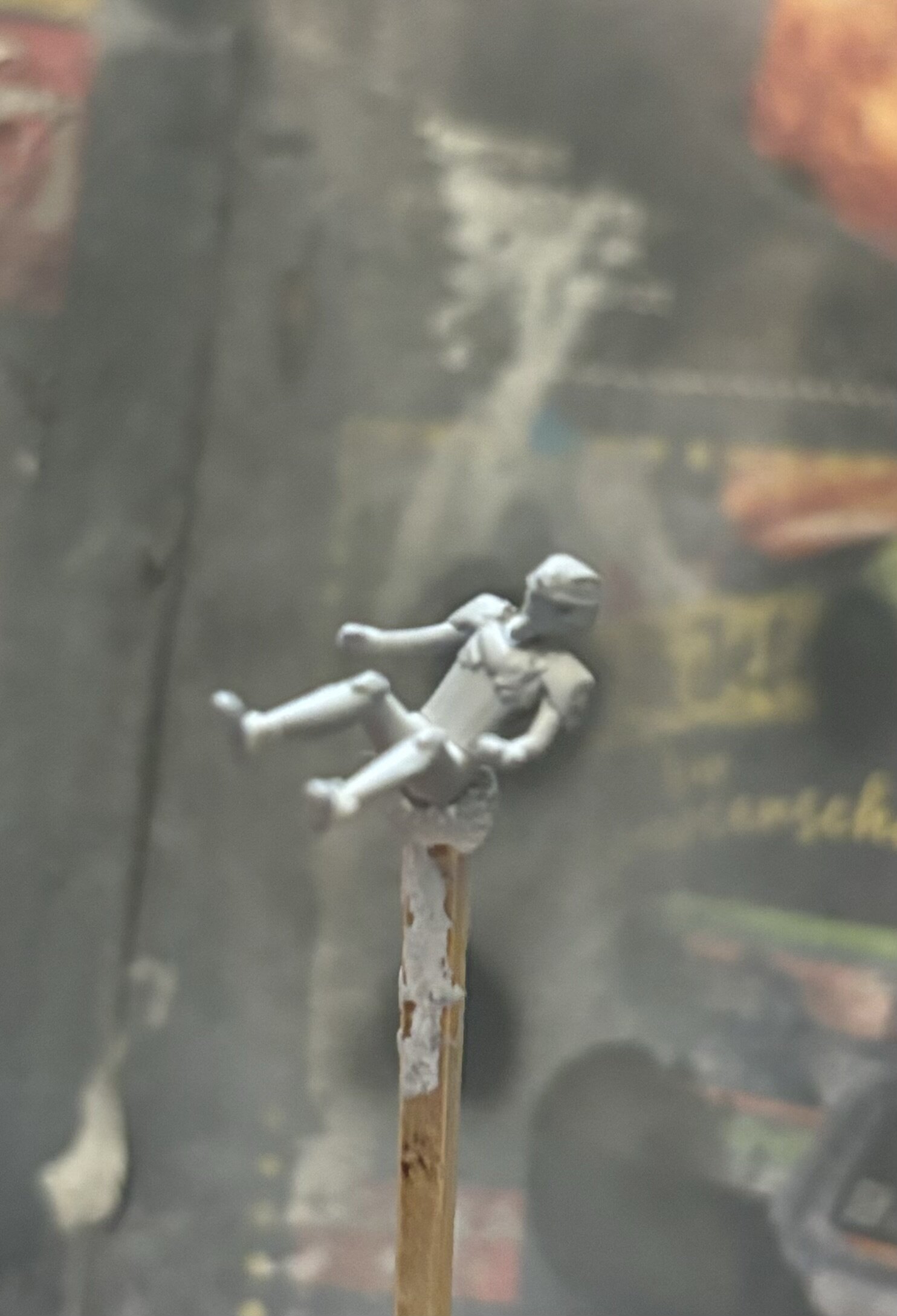

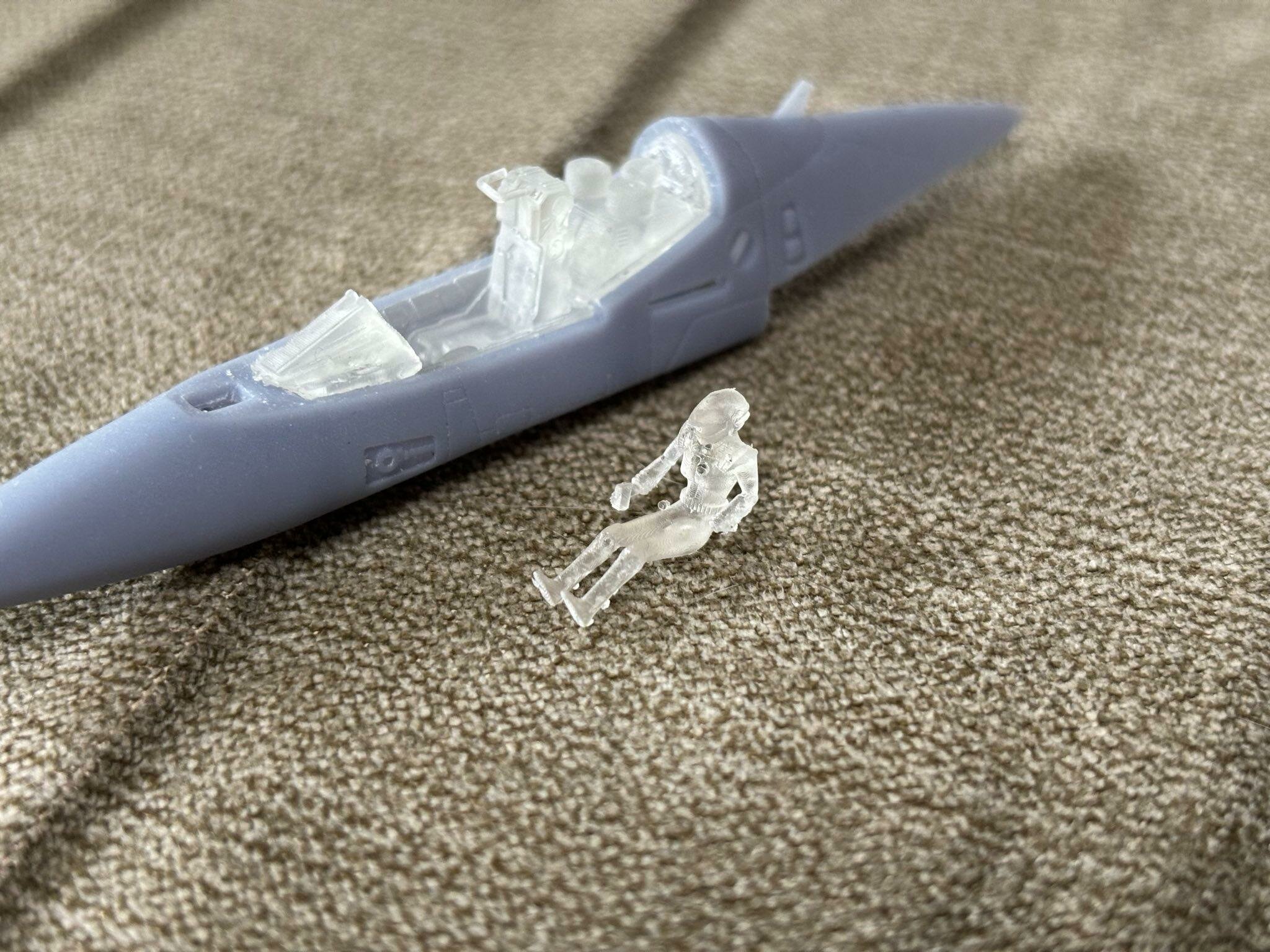

Urashiman Posted November 8, 2023 Author Posted November 8, 2023 Printed the pilot figure for testing. It is Milia in a Macross M3 pilot suit (which for some reason is body tight...). Anyway - the wrists are to small and brittle and the torso is too long. One hand came off while detaching the supports. The figure barely fits and broke the seats ejection handle. Quote
electric indigo Posted November 8, 2023 Posted November 8, 2023 @Urashiman The level of detail is amazing! _ I think I'm in the final round of putty & sanding work on the fuselage. And it's starting to look like an Invader Quote

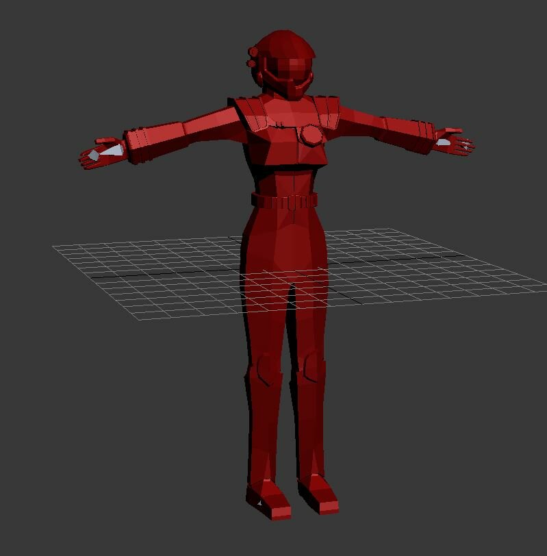

SteveTheFish Posted November 9, 2023 Posted November 9, 2023 (edited) 13 hours ago, Urashiman said: Printed the pilot figure for testing. It is Milia in a Macross M3 pilot suit (which for some reason is body tight...). Anyway - the wrists are to small and brittle and the torso is too long. One hand came off while detaching the supports. The figure barely fits and broke the seats ejection handle. Ā Where did you find the .STL files for that Milia figure? Has anyone made a female pilot figures wearing the regular pilot suits? I don't have a 3D printer, but my friend in PA does. He says he is gonna print the Hikaru and Minmay figures that are made for Hasegawa's Super Ostrich kit. Can't wait to see those. Ā Ā 4 hours ago, Big s said: Itās not universally banned, but not something that is sold in the States. There may be a few places like China, but wherever you find it, itās priced like gold and isnāt worth it. It almost like twenty or thirty bucks a tube and then you gotta cover shipping and then you donāt know the quality of it when it does arrive. Iāve given up on the stuff personally due to the difficulty finding it. I only recently learned how hard to find polyester putty is in the States from watching a video by Leona's Workshop on YT. Here in Japan it's just another hobby supply to use. I have a tube of Wave's Morimori poly putty, but unfortunately I'm already running out of the hardening agent! It comes in such a small little plastic vial and there doesn't seem to be enough to go around to use with the rest of the main tube. Tamiya's poly putty comes with the hardening agent in a seemingly larger tube. There is a hobby shop walking distance from where I work and I stopped by there to ask the shop owner if perhaps the hardening agent is sold separately, and he said that he has not seen that. I wonder if the home center "polyester hardener" can be used with my poly putty. It's only about 400 yen, so it's worth a shot. I've been using the poly putty on the Imai Armored Valk kit I'm working on. I've used it to secure the Wave ball joint sockets for the arms and the waist. It sure dries super hard! I wonder if I should still reinforce it with some epoxy putty. I'd hate to have the parts painted up and have the sockets collapse when I try to pop the pieces into place.Ā Edited November 9, 2023 by SteveTheFish Quote
Big s Posted November 9, 2023 Posted November 9, 2023 17 minutes ago, SteveTheFish said: Where did you find the .STL files for that Milia figure? Has anyone made a female pilot figures wearing the regular pilot suits? I don't have a 3D printer, but my friend in PA does. He says he is gonna print the Hikaru and Minmay figures that are made for Hasegawa's Super Ostrich kit. Can't wait to see those. Ā Ā I only recently learned how hard to find polyester putty is in the States from watching a video by Leona's Workshop on YT. Here in Japan it's just another hobby supply to use. I have a tube of Wave's Morimori poly putty, but unfortunately I'm already running out of the hardening agent! It comes in such a small little plastic vial and there doesn't seem to be enough to go around to use with the rest of the main tube. Tamiya's poly putty comes with the hardening agent in a seemingly larger tube. There is a hobby shop walking distance from where I work and I stopped by there to ask the shop owner if perhaps the hardening agent is sold separately, and he said that he has not seen that. I wonder if the home center "polyester hardener" can be used with my poly putty. It's only about 400 yen, so it's worth a shot. I've been using the poly putty on the Imai Armored Valk kit I'm working on. I've used it to secure the Wave ball joint sockets for the arms and the waist. It sure dries super hard! I wonder if I should still reinforce it with some epoxy putty. I'd hate to have the parts painted up and have the sockets collapse when I try to pop the pieces into place.Ā Tamiya used to sell the hardening agent separately, donāt know if they still do.Ā If youāre doing a joint that needs a part popped in, I recommend starting by using glue like extra thin cement first and then the putty after the glue has been sanded down and you find imperfections. Also if you want the putty a little softer, experiment with the mix of hardening agent. A little less hardener seem to make it slightly softer, but too little and it wonāt really dry right. Quote

Urashiman Posted November 9, 2023 Author Posted November 9, 2023 (edited) 12 hours ago, SteveTheFish said: Where did you find the .STL files for that Milia figure? Has anyone made a female pilot figures wearing the regular pilot suits? I don't have a 3D printer, but my friend in PA does. He says he is gonna print the Hikaru and Minmay figures that are made for Hasegawa's Super Ostrich kit. Can't wait to see those. Ā Ā I only recently learned how hard to find polyester putty is in the States from watching a video by Leona's Workshop on YT. Here in Japan it's just another hobby supply to use. I have a tube of Wave's Morimori poly putty, but unfortunately I'm already running out of the hardening agent! It comes in such a small little plastic vial and there doesn't seem to be enough to go around to use with the rest of the main tube. Tamiya's poly putty comes with the hardening agent in a seemingly larger tube. There is a hobby shop walking distance from where I work and I stopped by there to ask the shop owner if perhaps the hardening agent is sold separately, and he said that he has not seen that. I wonder if the home center "polyester hardener" can be used with my poly putty. It's only about 400 yen, so it's worth a shot. I've been using the poly putty on the Imai Armored Valk kit I'm working on. I've used it to secure the Wave ball joint sockets for the arms and the waist. It sure dries super hard! I wonder if I should still reinforce it with some epoxy putty. I'd hate to have the parts painted up and have the sockets collapse when I try to pop the pieces into place.Ā I found the .STL by navigating to the folder where I saved the exported STL. You probably haven't found one online because there is none out in the wild, I think. I created this pilot figure myself, because there are no Macross M3 suit pilots out there. I can send it to you after I fixed it. The proportions are a bit bad, as I basically created this with only little reference material (the Macross M3 intro and the back cover of the Macross M3 booklet in the disk case). She got a bit too ... "ample" as well. I am not good at 3D modelling people... I did it by low poly modelling the pilot and then running turbo smooth over it. Another thing... I wanted to print a bubbleless canopy for the VF-9, so I went by the "evolution approach". The more the merrier Here is what I did: - Filtered the liquid clear resin through a 0.05mm grid filter - Let it rest in the resin basin of the printer for 24 hours - made the print bed move really slow during printing From the visuals, it looks like at least three have bubbles inside. I will know more once I polish them all a bit. Any advice how to get rid of the bubbles? Ā EDIT: @SteveTheFish I remembered that @Xigfrid was creating a set of male and female VF pilots. You can find them here: https://www.shapeways.com/product/VJ23S29SZ/1-72-scale-pilots-for-vf-1j?optionId=299297325&li=shops Edited November 9, 2023 by Urashiman Quote
