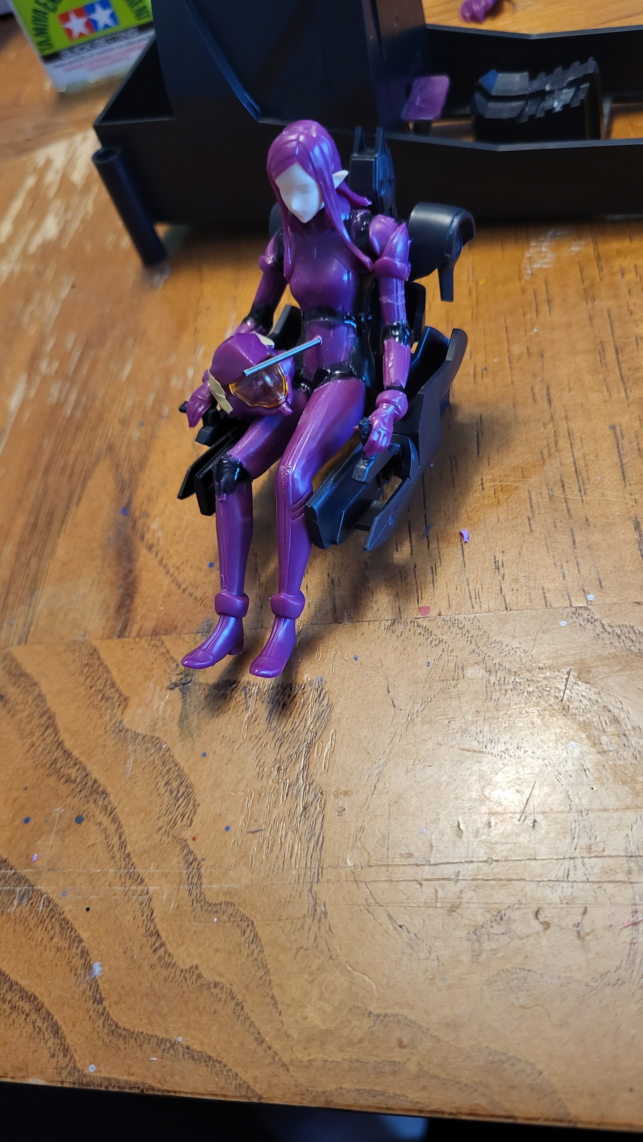

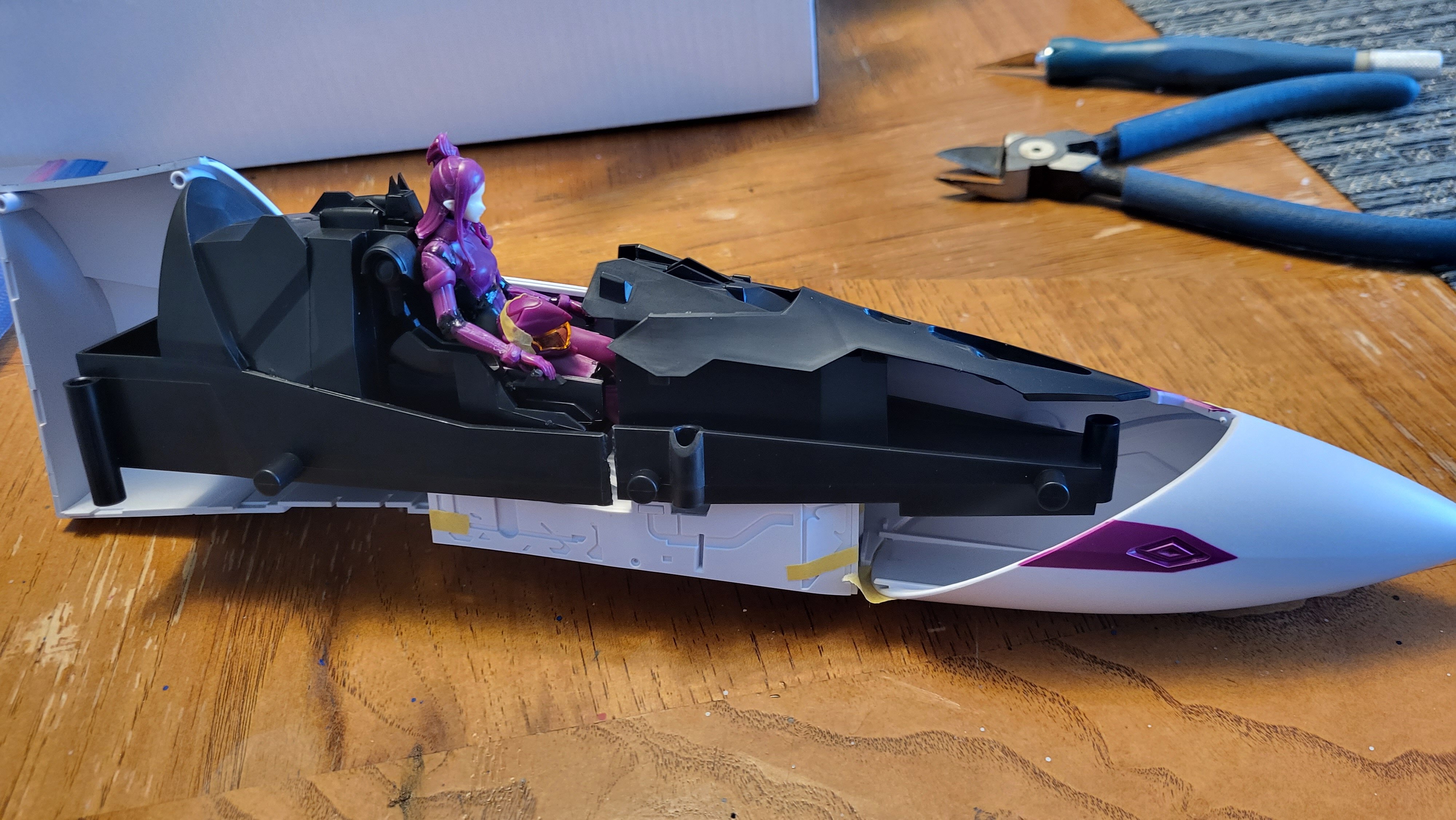

Well they do have a posable, soon to be released Alto figure that may fit in one. The issue may also be that they clearly reused the vf-25f cockpit parts instead of designing new. A few extra leftover parts on the runner confirmed it. I expect the seats i. The anime are power adjustable like a car or something, but the model has the seat base moulded to the structure and the floor of the cockpit moulded to the backside of the landing gear bay!

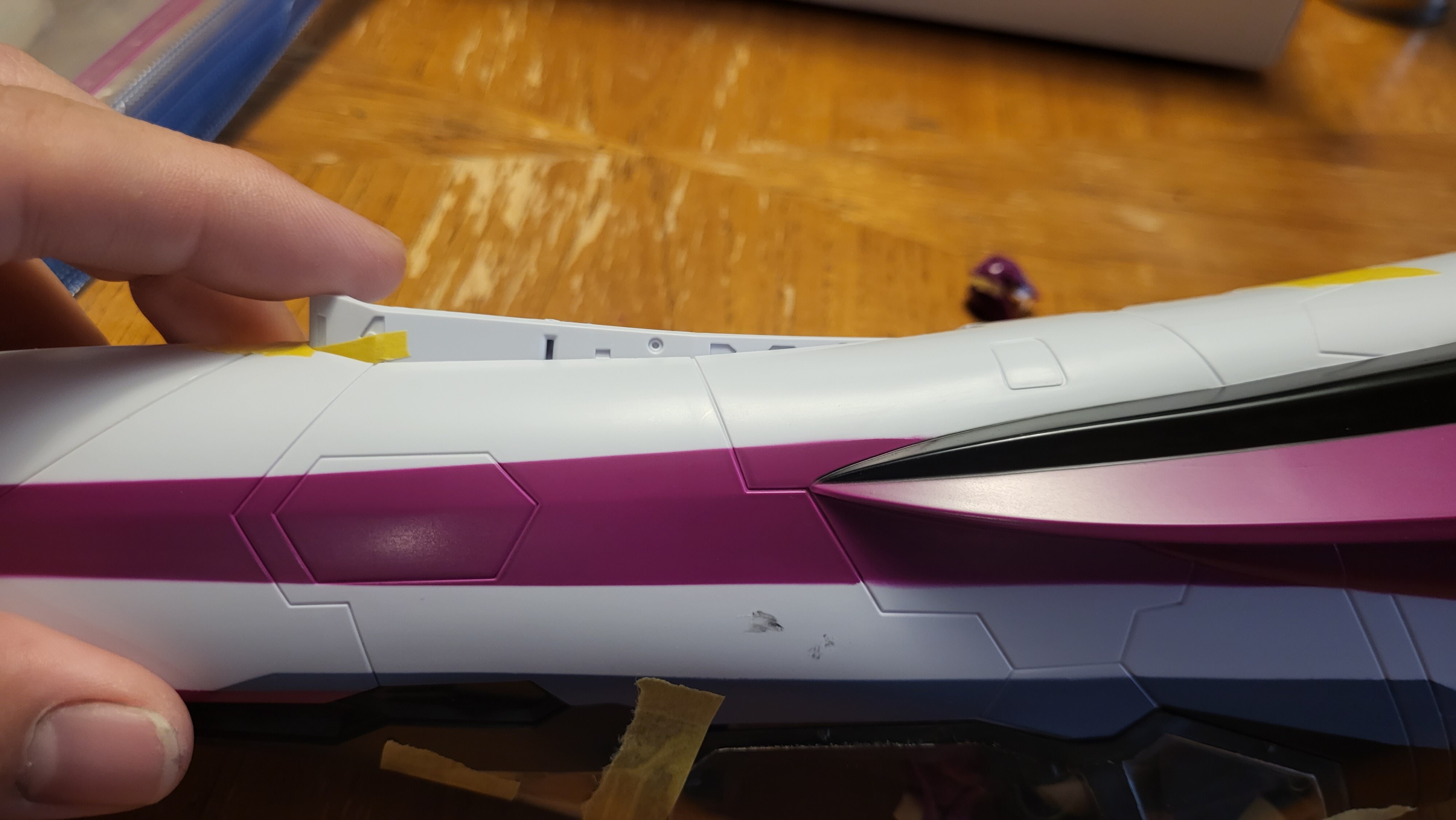

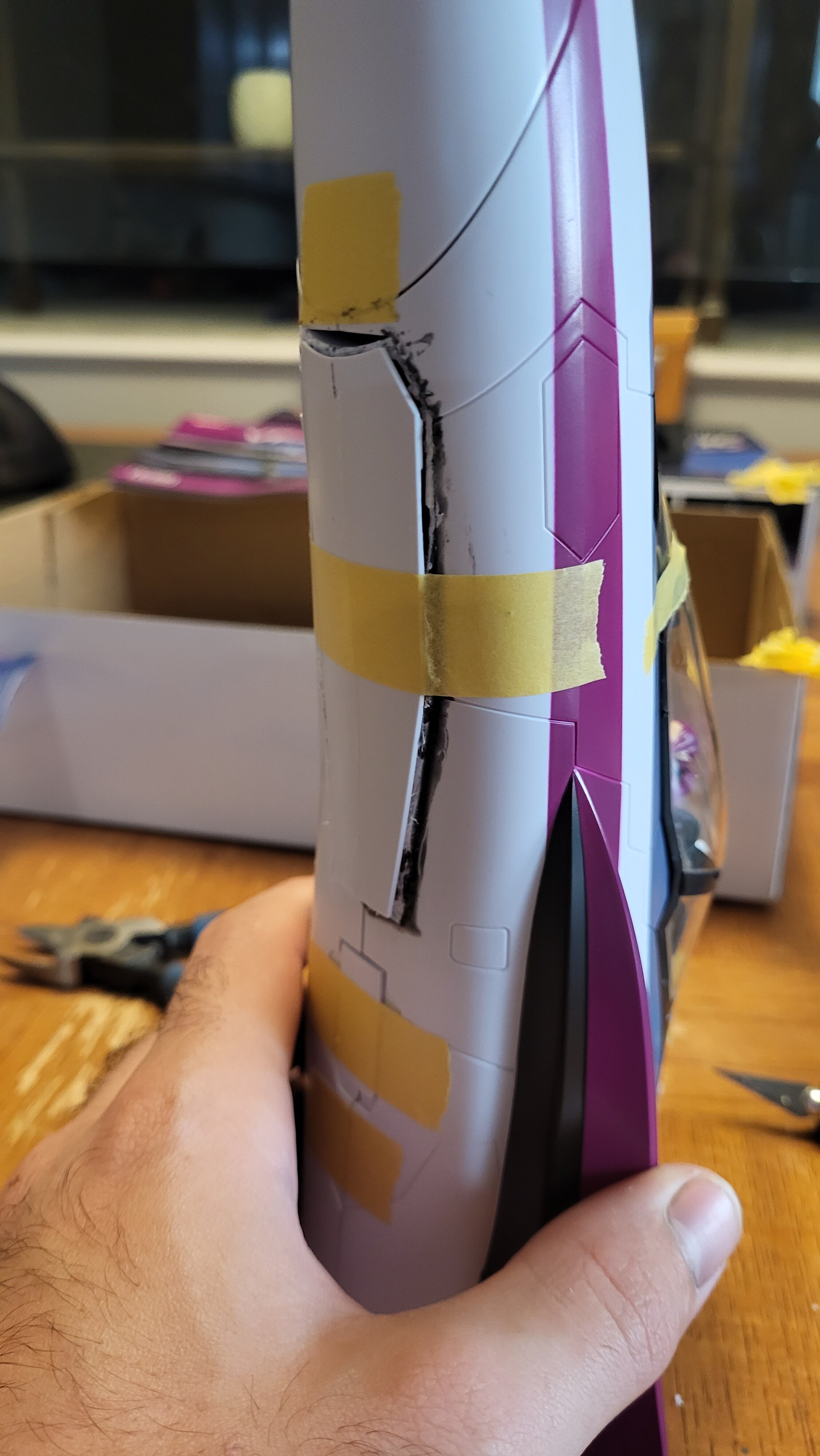

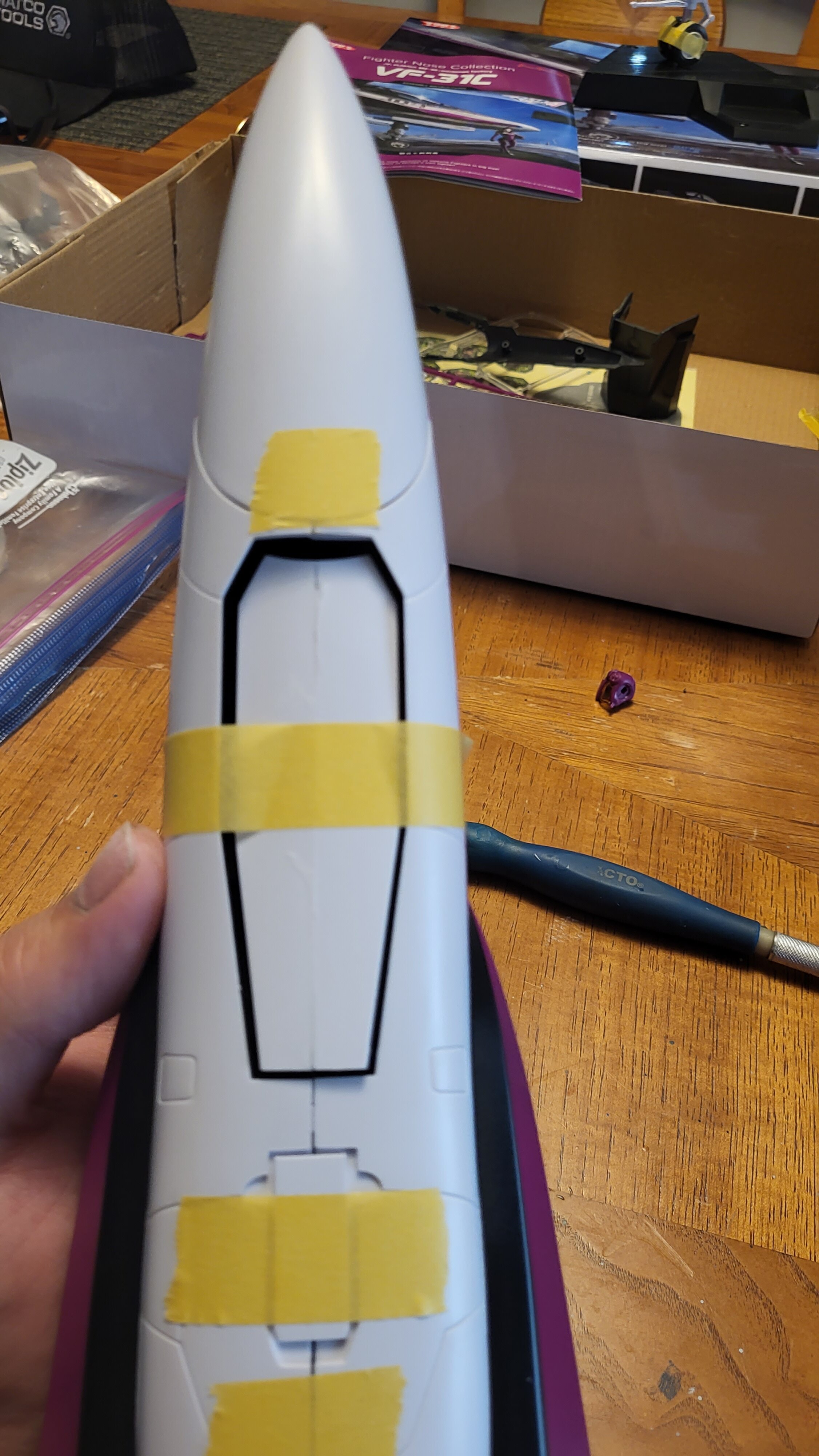

You have to remenber they use ex gear cockpits, sadly the arms don't fit into the gear and it makes her body position look way too unnatural. Compromises.
Cut out and move the front of the interior forward to clear he knees. I fee the legs look perfectly angled for some pedal controls to come.
I lowered the floor a little under a quarter of an inch so she didn't have to amputate/loose her feet too.
Shocker after cutting the landing gear doors off to close the bay... they don't fit either. Hopefully I can get them blocked off enough so a minimal ammount of filler will be required.
I have zero plans to any custom work on the exterior. Just want to detail up the insides using a few references (and some make believe.) Depending how it goes, I may try to led lighting effects, not that I'm very fond of them.

@Rock I'm glad you got her to fit in. The photo with the rod comming out of her belly is a bit disconcerting 😄 Your modes are looking good though! - MT
@Rock Sad to say, some model companies want to make us work rather than have fun with their kits!. You'd think that after decades of complaints, they'd at least have the gear doors match the opening, even if they are supposed to be posed open. It can't be that hard to do... Oh well, glad Mirage is seated now. For the gear doors, it may be easier to just make some new ones from sheet plastic.
As much as I will generally complain about gear doors not fitting the bay on almost every kit I built as a kid... I actually have a hard time faulting them in this case.
Sure it would be nice.. but I mean.. it's just a nosecone.  How else are you going to display this?  And if you're actually going to make the effort to build the rest of the plane, I feel like making the gear doors fit are the least of your worries. :lol:

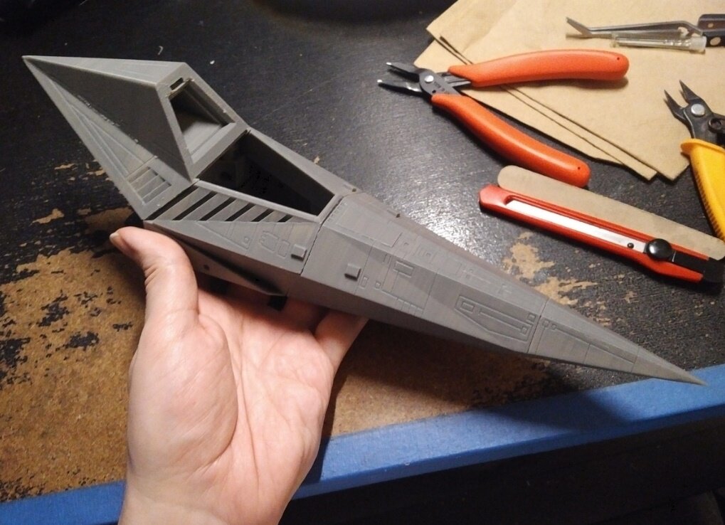

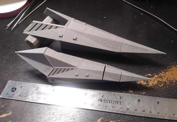

I might have slightly underestimated how big this model is going to be once I make the rest of it.... :lol:
The print failed on the smaller one due to missing some wall thickness in important places, but I think I'm going to make a new one in that size once I get a new ABS spool.  I'm debating how to give the wings a ratcheting rotation joint, and I might actually just embed some LEGO joints in the model.
Edit: Got the rest of the big fuselage printed, and fits decently, but going to take some filler.  Going to re-try the single-piece one overnight.
Edited by Chronocidal
6 hours ago, Thom said:
If I had to guess, it looks like the beginning of a Starfox Arwing (?)
Right on the money! ^_^ I had been working (very slowly) on a model of the version from Starfox 64 for a long time, but I went browsing printable models the other day, and found this one.  Immediately gave up my goal of making my own model, and decided the buy the completed one to print after I saw the author's video of assembly and features.
He made his mostly in liquid resin, so I've been modifying a few bits to make it more ABS-friendly, and it's not going badly, but the polygonal nature of the basic design is proving tricky to get solid structures.  I've had to thicken and rearrange some areas, since printing slicer software tends to have issues with perfectly sharp edges. :p
The author goes by "nerdmakerengineer" and has some incredible models on his CGTrader profile, including a Tie Phantom from Rebel Assault II, and an insane X-Wing replica kit designed for 1/12 scale figures.
Seeing how this works, I might put a couple of my own designs up for sale/download.  I still have a few tweaks to make to my old printed Excalibur model, but I'm tempted to try and make a much larger version than my original.

@Chronocidal Looking GOOD! Especially for ABS printing.

@derex3592  That's amazing, what scale is that again?  Hard to tell how tiny they are without some reference :)
@Chronocidal Cool 3D print, what is it that you're printing?  Is it your design?

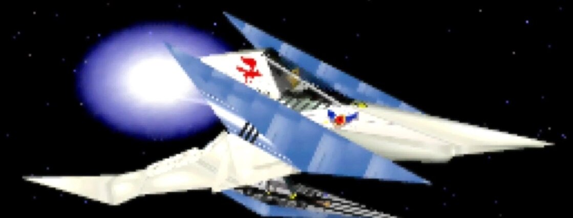

Not mine, an artist essentially gave the ship in Starfox 64 the HD treatment.  They extracted the in-game model (all 200 polygons or so of it, given it's a 1995-ish design), then rebuilt it into a kit using box art and publicity renders as a reference.
Essentially took this:
Extrapolated the details from this:
And turned it into this. ^_^
I'm going to eventually print the whole large model, which has linked swing wings, and several optional parts attached with magnets, but for the moment I'm more focused on a more manageable model that's about 60% of that size, and without some of the fancier features.  I still want to make the wings swing though.
The nerd in me seriously wants to build a stand that mounts into the engine, and will slowly roll the model while playing the menu music. :lol:
