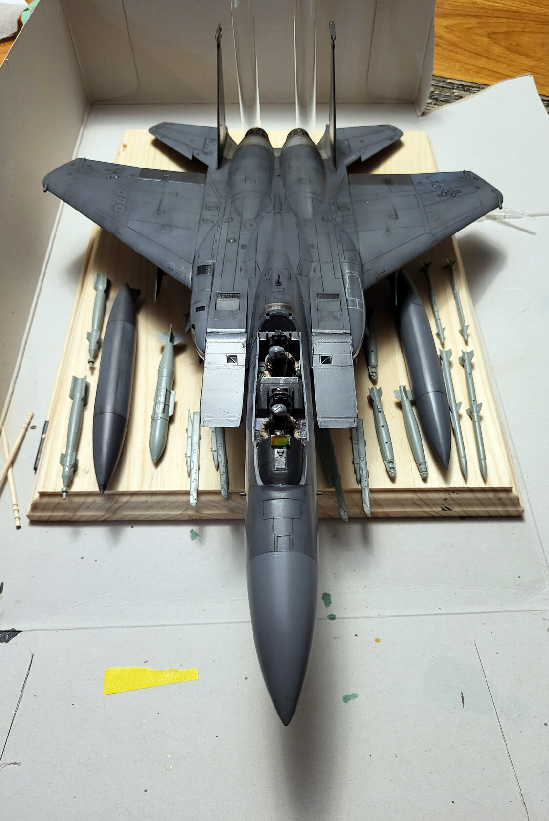

Thom Posted June 7, 2022 Posted June 7, 2022 @MechTech I think the base is looking really good. Love the bullet! @Rock Really liking that inverted display. Very unique, as I've never seen a model displayed like that at any modeling show. Although, you probably know already, but your port engine burner is a little separated. Quote

MechTech Posted June 8, 2022 Posted June 8, 2022 @Rock Your paint is looking really good! The engine discoloration is a nice touch! @pengbuzz Thank you! I'm trying. @arbit Thank you! Yes, more weathering and layers to come with the paints. Aluminum doesn't rust, and active military aircraft are not -usually- allowed to have corrosion on them. So I'm trying to get the right looking wear on them. Usually the paint chips off the zinc chromate (green) layer like you see or off the skin altogether - which quickly gets patched up. I have to create the patching up and weathering now. The masking technique is actually not masking. You paint decal paper and apply it as normal. I used glue because of some thin areas. This technique allows you to work with the material and no worries about paint bleeding or leftover residue from masking. Its not for everything, but was great here and for windshield frames. - MT Quote

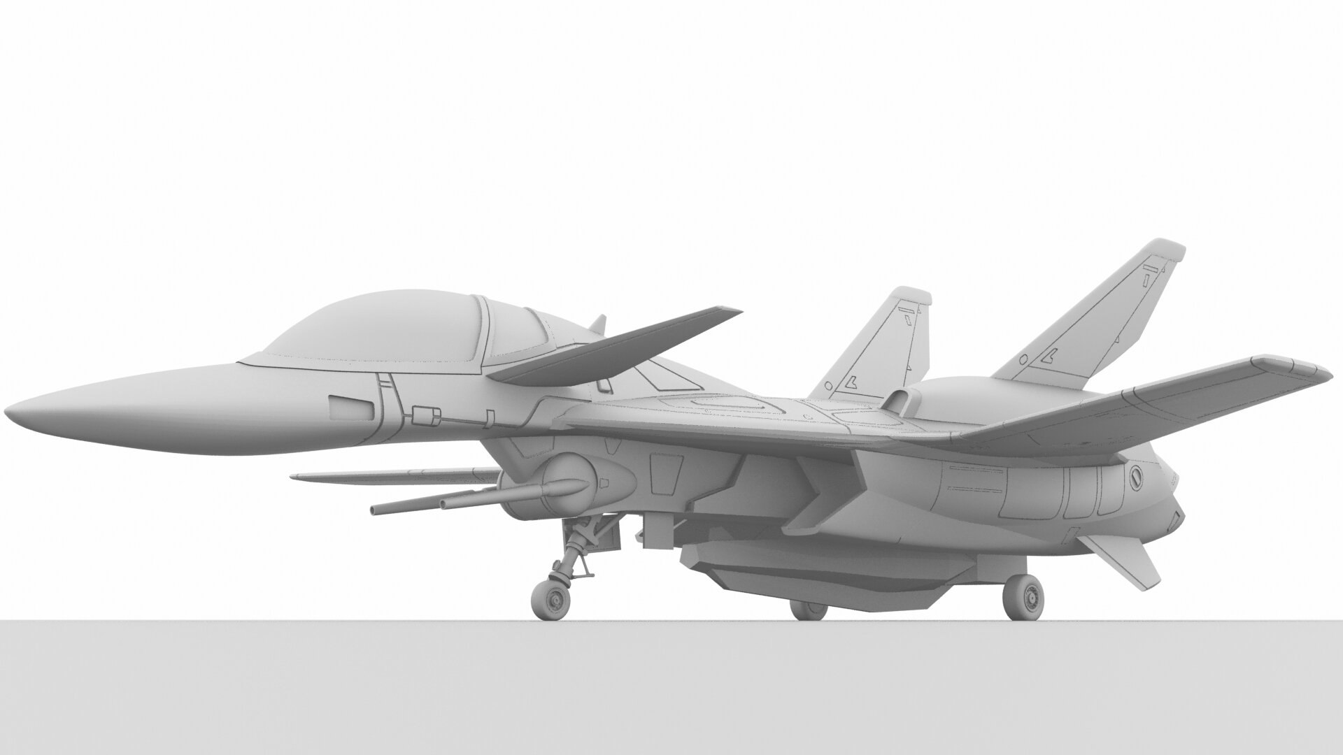

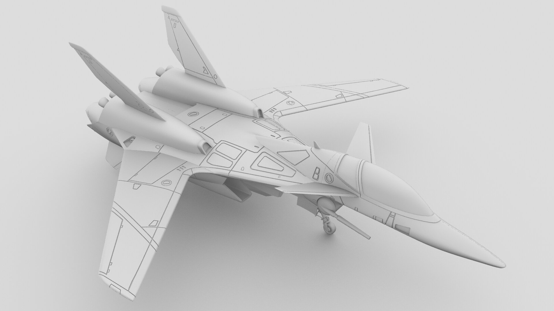

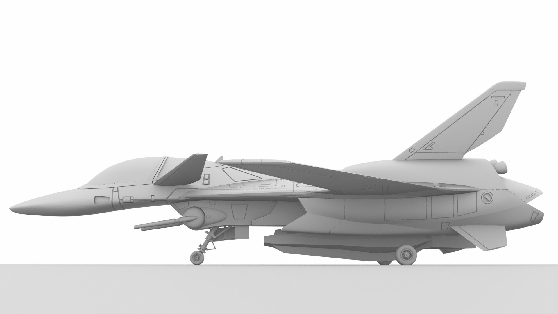

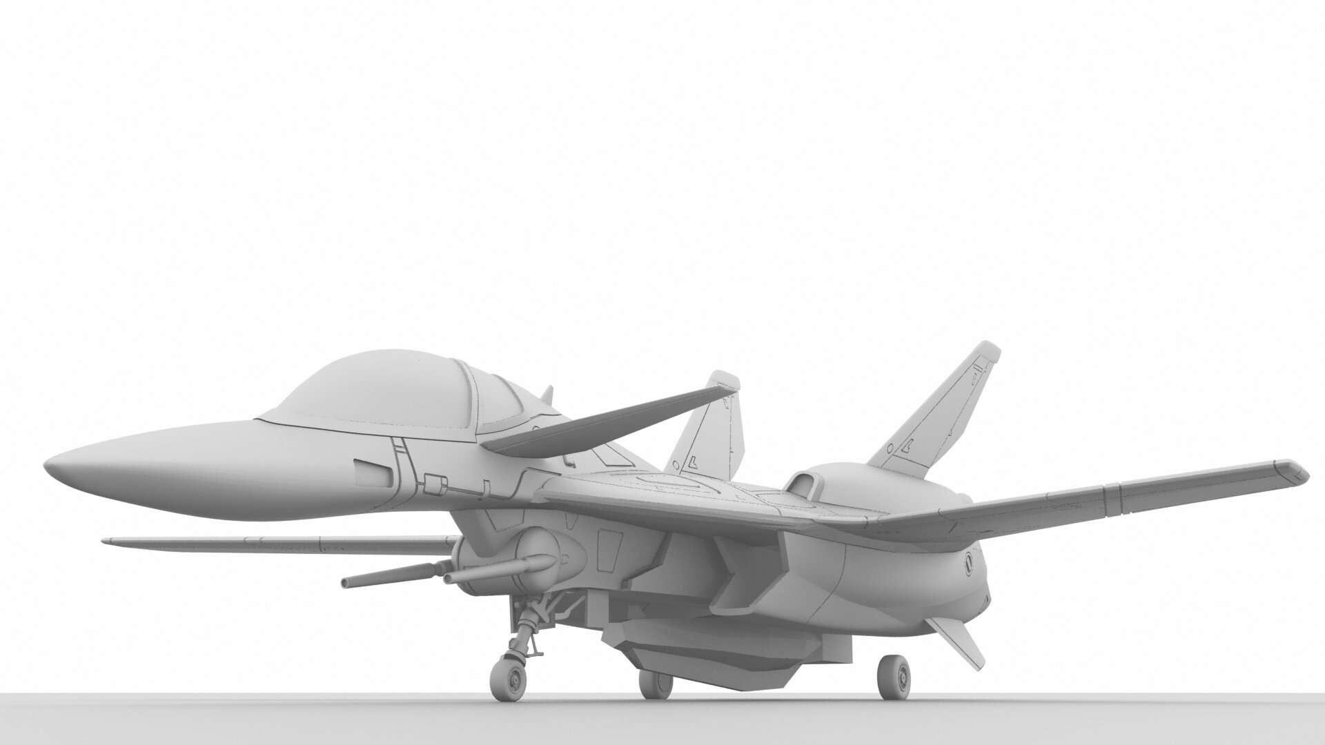

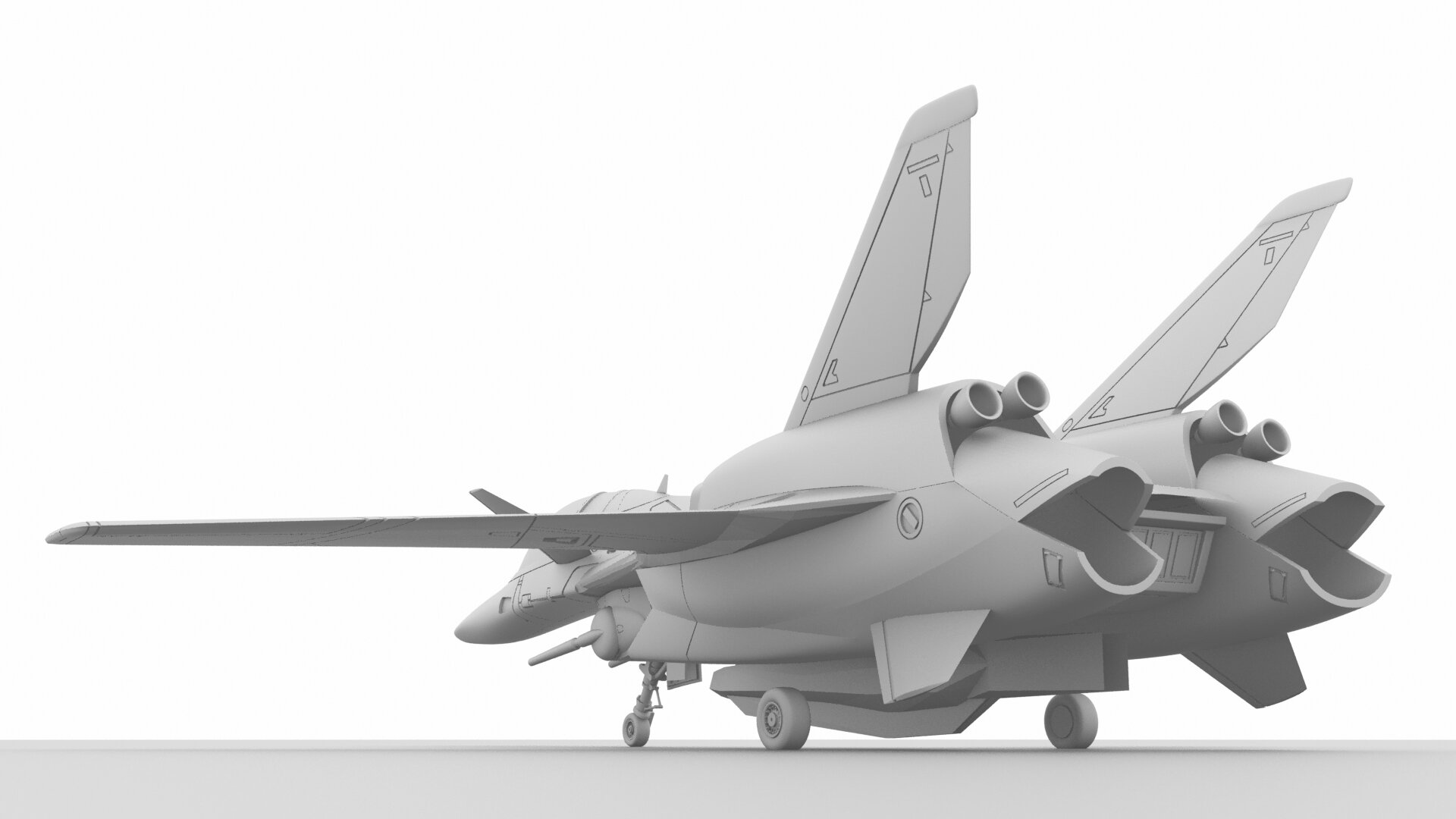

Urashiman Posted June 10, 2022 Author Posted June 10, 2022 I made some progress on the VF-9's new legs and wanted to share some renders, because sharing is caring Feedback is welcome. Quote

pengbuzz Posted June 10, 2022 Posted June 10, 2022 1 hour ago, Urashiman said: I made some progress on the VF-9's new legs and wanted to share some renders, because sharing is caring Feedback is welcome. Nice work on the new legs! Quote
Urashiman Posted June 11, 2022 Author Posted June 11, 2022 6 hours ago, Thom said: XD well, in this case, the engine bay. 6 hours ago, pengbuzz said: Nice work on the new legs! thanks! Quote
electric indigo Posted June 11, 2022 Posted June 11, 2022 @Urashiman I know the forward landing gear strut angle is canon, but structurally, it doesn't make sense to me. Is there any real world example of this? Quote

arbit Posted June 11, 2022 Posted June 11, 2022 23 hours ago, Urashiman said: I made some progress on the VF-9's new legs and wanted to share some renders, because sharing is caring Feedback is welcome. Whoaa, that image with the rear exhausts looks amazing. I like the organic lines of your overall shape, very reminiscent of the anime line art style. My opinion may be an outlier, but Hasegawa and Arcadia/Yamato valks are more "real world", and never remind me much of Kawamori's key frames in the anime. Quote

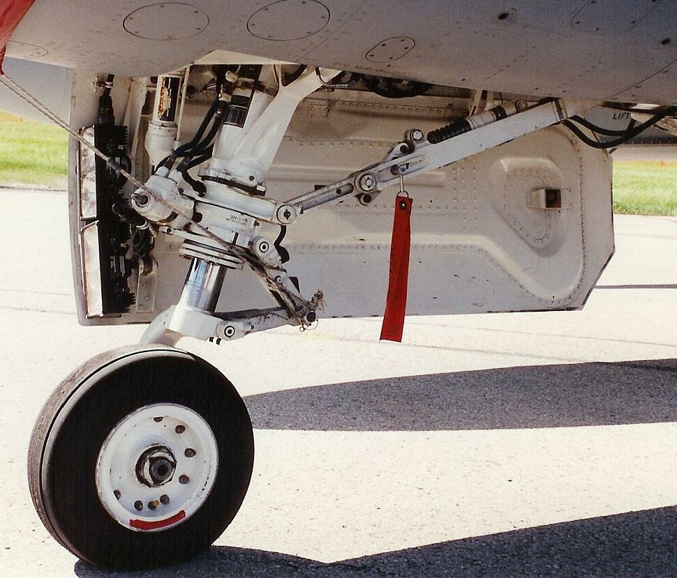

Urashiman Posted June 13, 2022 Author Posted June 13, 2022 (edited) On 6/11/2022 at 11:36 AM, electric indigo said: @Urashiman I know the forward landing gear strut angle is canon, but structurally, it doesn't make sense to me. Is there any real world example of this? The Airbus A320 as a slightly tilted front landing gear. Maybe 5° or something, but yeah. Nowhere else I saw this. Appart from looking fancy (adding to the already fancy VF-9), there isn't much I can think of, why they decided on this type of gear. Oh look, the F-16 has that as well. Not at an extreme angle like the VF-9, but from the gear configuration, it seems the VF-9 took inspiration from the F-16 nose gear. Edited June 13, 2022 by Urashiman Quote
electric indigo Posted June 13, 2022 Posted June 13, 2022 Interesting, I wonder if it is fit that way to have some degree of caster (Nachlauf) or to prevent the gear from collapsing to the back in case of failure. I guess you won't see that on a carrier bird. Quote
Urashiman Posted June 13, 2022 Author Posted June 13, 2022 4 hours ago, electric indigo said: Interesting, I wonder if it is fit that way to have some degree of caster (Nachlauf) or to prevent the gear from collapsing to the back in case of failure. I guess you won't see that on a carrier bird. Yeah, F/A-18, F-14 and F-35 all have straight 90° angle nose gear. Might have asked that already, but are you German? Quote

Chronocidal Posted June 14, 2022 Posted June 14, 2022 20 hours ago, electric indigo said: Interesting, I wonder if it is fit that way to have some degree of caster (Nachlauf) or to prevent the gear from collapsing to the back in case of failure. I guess you won't see that on a carrier bird. This actually makes sense, because the inside of the gear well is on the opposite side of the intake ramp. I imagine gear collapsing into the well could possibly break through and throw debris into the engine, turning a hard landing into something much worse. Quote

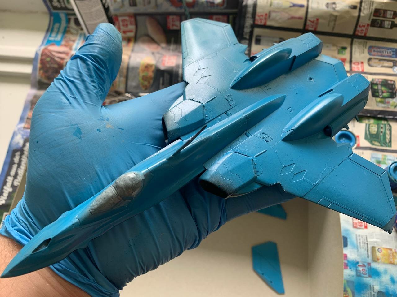

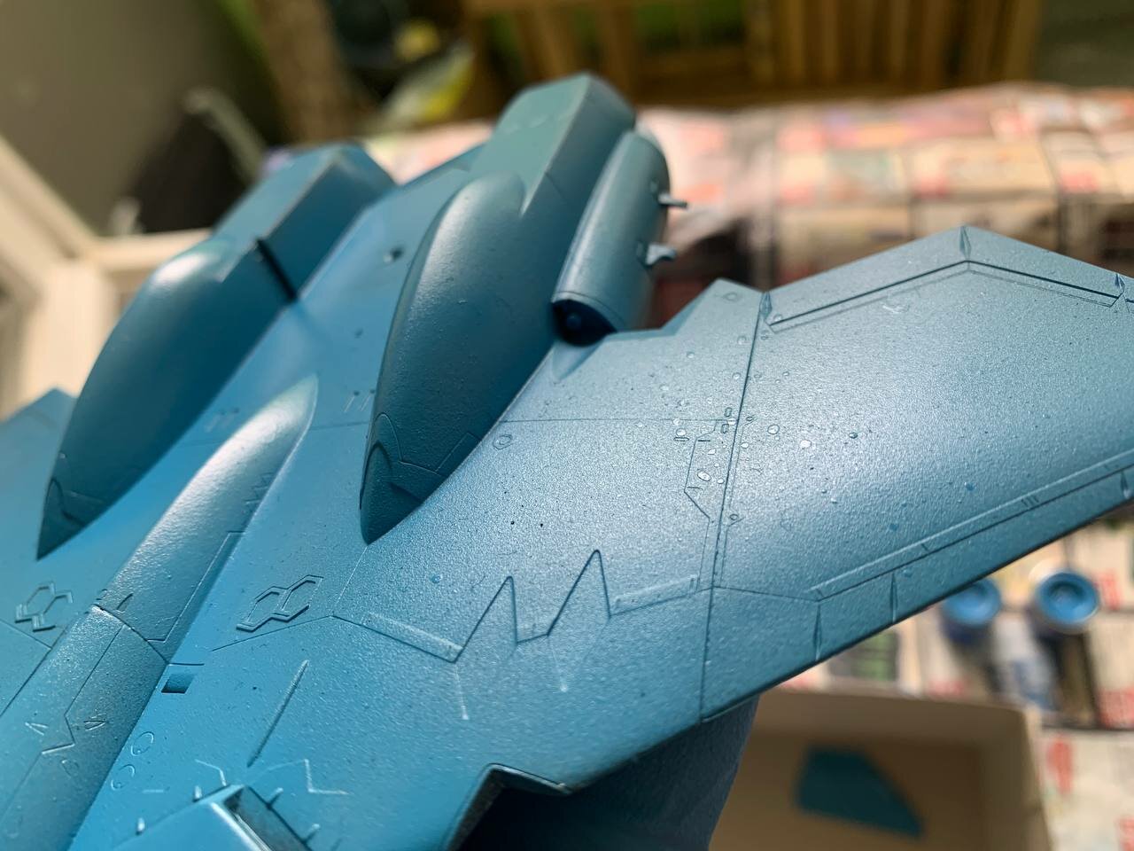

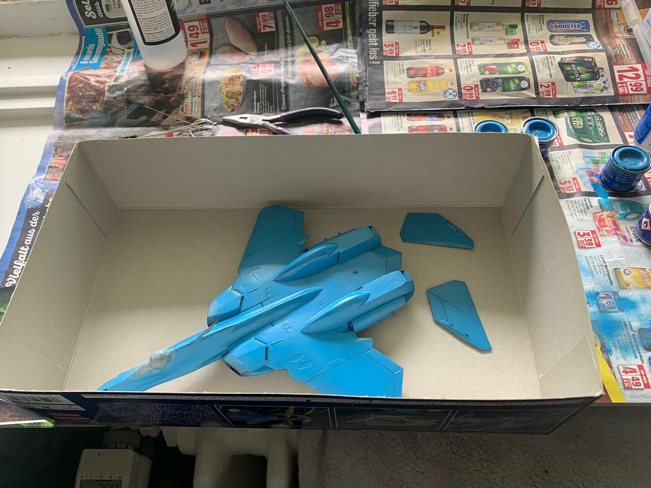

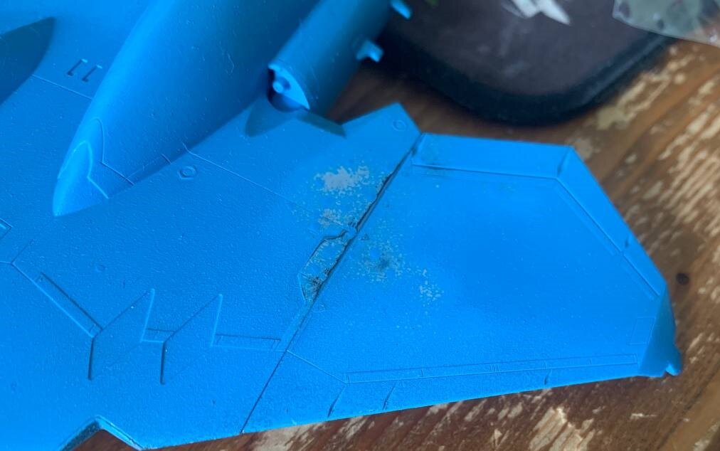

Urashiman Posted June 16, 2022 Author Posted June 16, 2022 A modellers horror story in three pictures. I hate it when my airbrush burps onto my stuff I decided to leave it like that now, but stilll it annoys me. Quote
Thom Posted June 16, 2022 Posted June 16, 2022 @Urashiman I feel your pain! I have three moisture traps on mine, which helps, but it'll still throw up occasionally if I am spraying for too long. Give it a light sand back with some fine grade and touch up. Nice color though. Quote
Urashiman Posted June 16, 2022 Author Posted June 16, 2022 (edited) 1 hour ago, Thom said: @Urashiman I feel your pain! I have three moisture traps on mine, which helps, but it'll still throw up occasionally if I am spraying for too long. Give it a light sand back with some fine grade and touch up. Nice color though. I'm not a careful sander ... I'd probably sand through the primer, the ground color and shading. Hahaha. It dried a bit more, and isn't that much visible anymore, so I'll just leave it like that PS: Revell Enamel blue 50. Fits the VF-22S Max version without any need to color mix something together. Edited June 16, 2022 by Urashiman Quote
MechTech Posted June 17, 2022 Posted June 17, 2022 @Big s You get productivity out of yours?! You must share your secrets😅 @Urashiman That TOTALLY sucks! I guess you're not going to strip it down? My spitfire paint job did that too. I used a very fine sponge sander to get it smooth, then buffed it out with a rag. You may still be able to help it along. If you can save that F-5, you can save this. - MT Quote
Urashiman Posted June 17, 2022 Author Posted June 17, 2022 15 minutes ago, MechTech said: @Big s You get productivity out of yours?! You must share your secrets😅 @Urashiman That TOTALLY sucks! I guess you're not going to strip it down? My spitfire paint job did that too. I used a very fine sponge sander to get it smooth, then buffed it out with a rag. You may still be able to help it along. If you can save that F-5, you can save this. - MT Went over it with 1500 grid tamiya sanding sponge. Not too sure if I like this. Defo have to air brush again. Quote

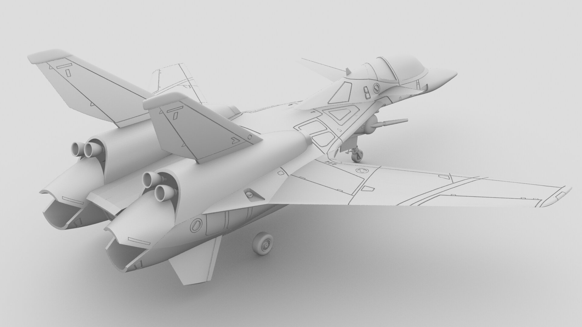

Urashiman Posted June 19, 2022 Author Posted June 19, 2022 Okay, did a bit of panel line work on the VF-9 again. It is so annoying, and super hard work. You start to cut an then it looks weird. Then you go back to an older version of the object and do it again and again and again until you have something that you a bit satisfied with and then rework it again. At least I am getting progress. Slow but it is there. Quote

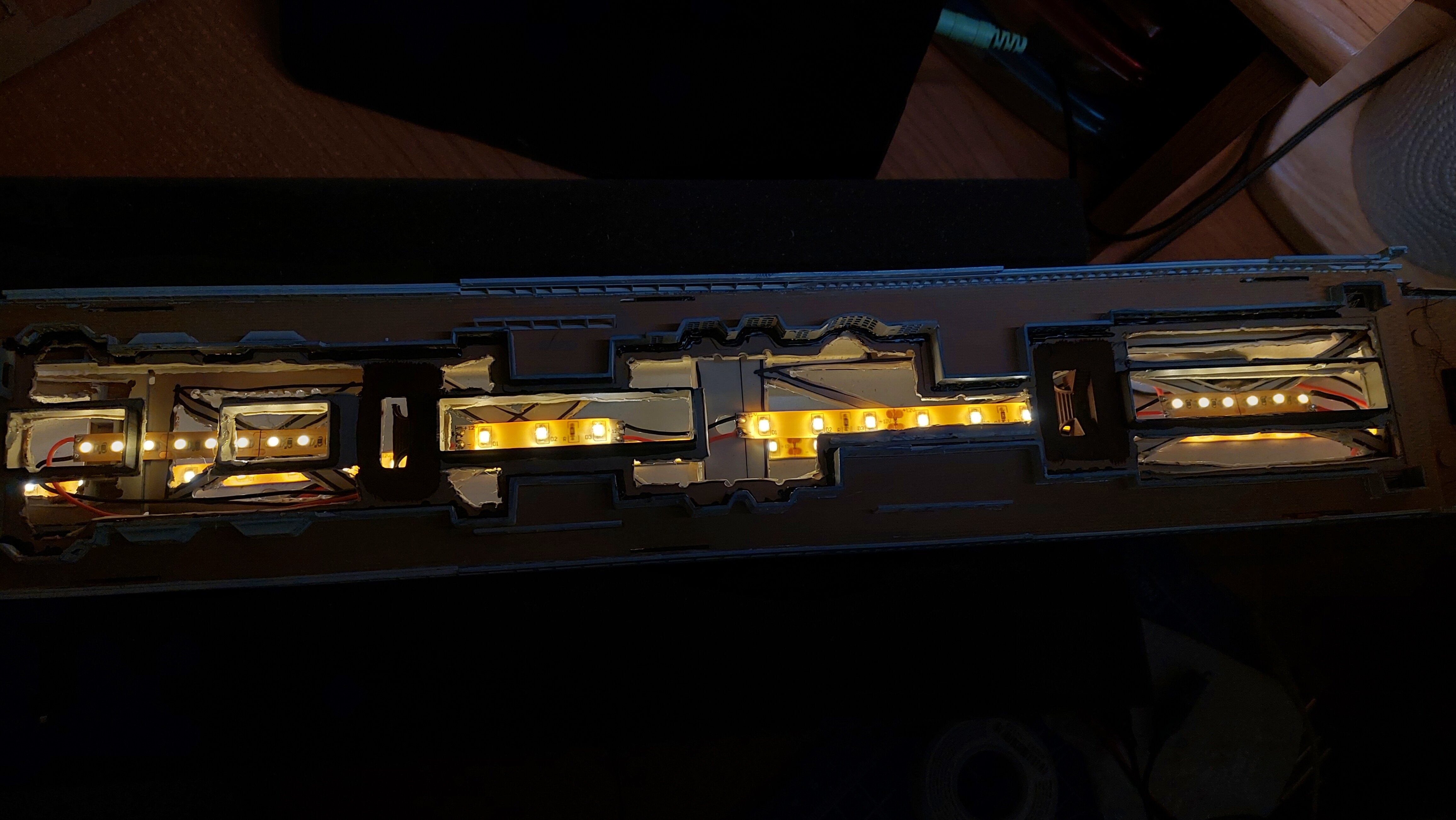

derex3592 Posted June 19, 2022 Posted June 19, 2022 I decided the upper decks needed more LED's, so this morning I used my spare power wires and made it happen utilizing a combination of two kinds of LED strips I had lying around. Lighting is now as complete as it's gonna get! Quote
