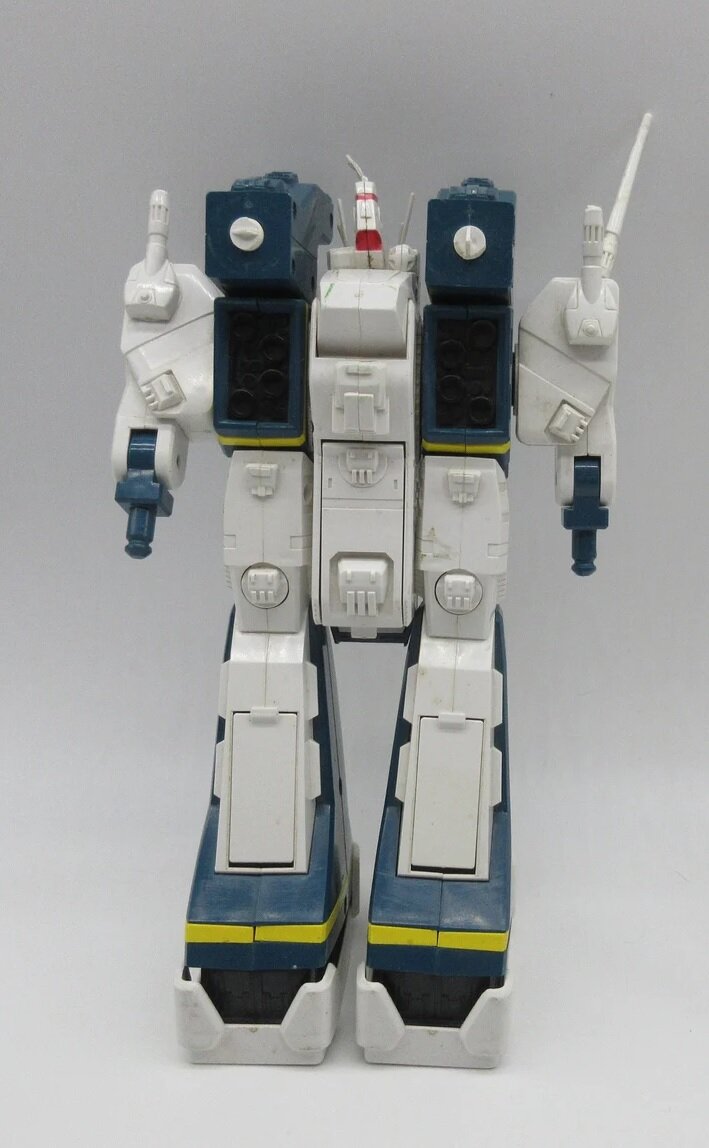

An SDF-1 in 1/3000 scale. Not the best condition of course, but enough there to being with.
Here's what I bought:

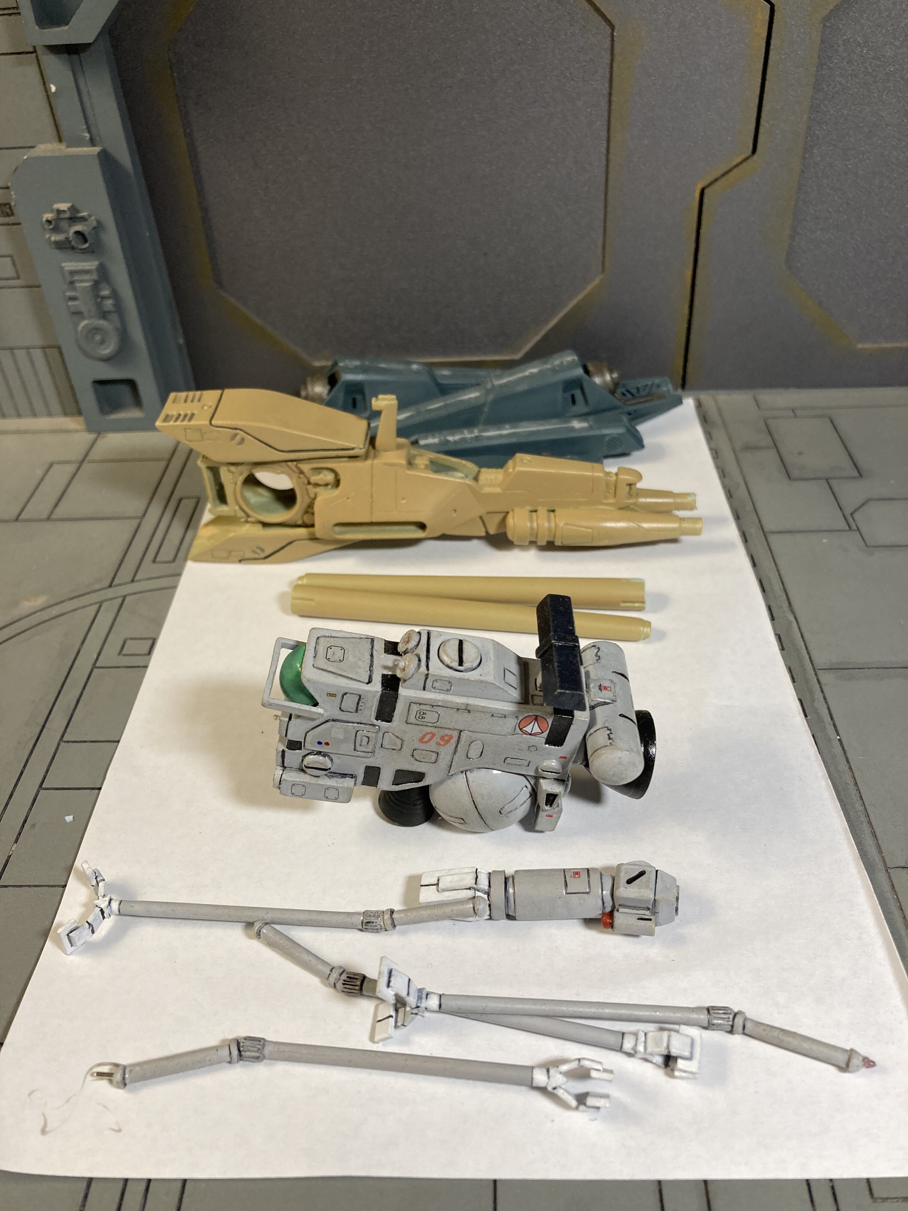

Booms were broken off at the lower rotational joint, the antennae are all loose and in poor shape, the rail guns (save one) were missing, and Prometheus and Daedalus were gone as well.
Get it out of the shipping box, and 30 or so minutes later:

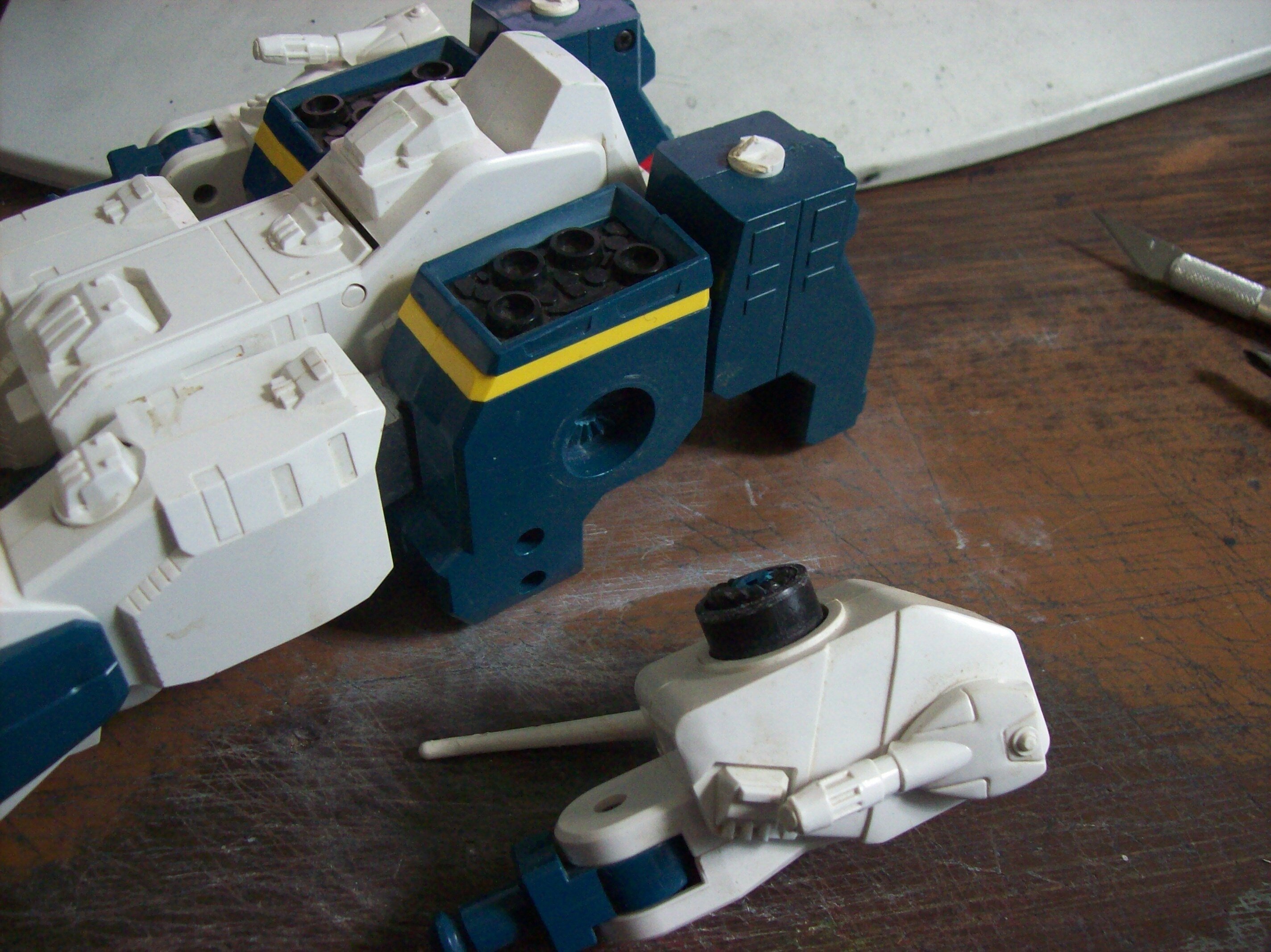

Yes, the shoulder joint let go. This was followed in short order by the right shoulder.
All I did was sit there in disbelief. I wasn't going to blame the seller; with the age of these, this can happen at any time without warning. And even if I were to get my money back, what good would that do me? I'm lucky to be able to buy anything before an unexpected bill or another stupid "family need" eats up the money and my wife just buries her head in my shoulder in tears.
This was my birthday gift (B-day is next month but we had the money now, so don't wait for March to inflict more bills!), and its' first act was to fall apart.
After about 2 projects that pretty much tried to end themselves, this was the last straw.

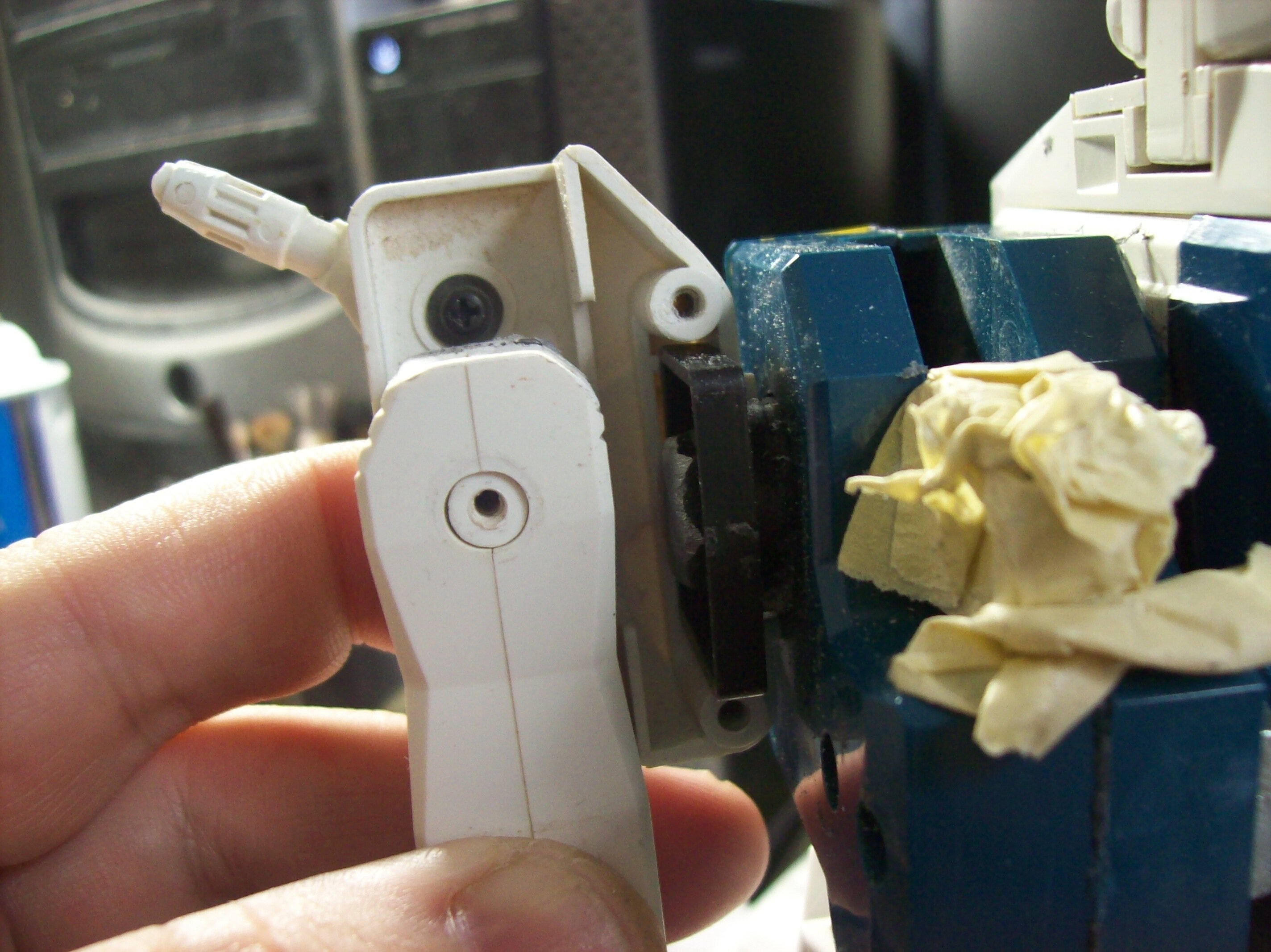

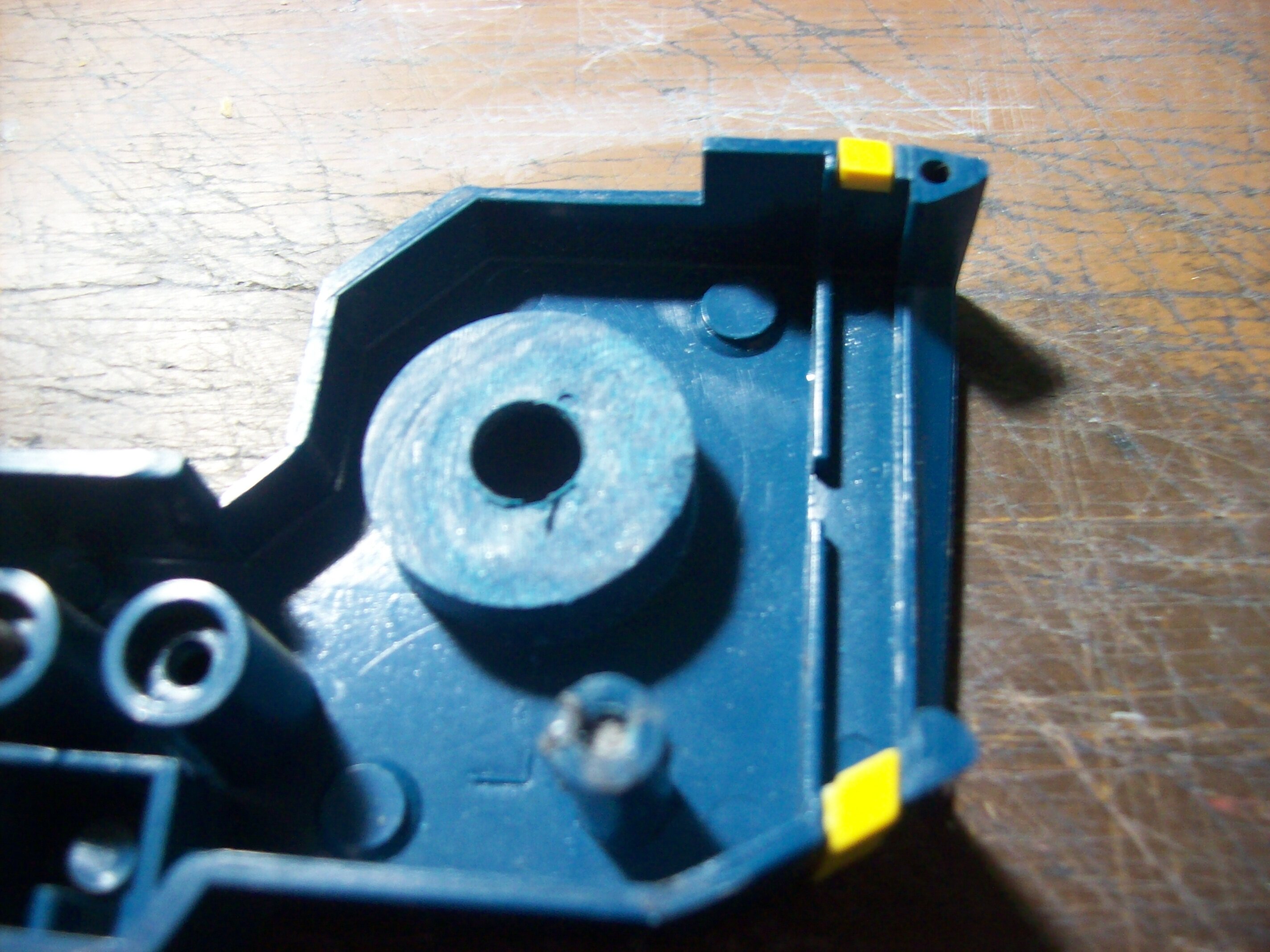

I began by tearing the ship down and removing the shoulder boxes. As confirmed: the plastic was brittle from age and cracked posts were inside. I promptly removed and cleaned these, and set them aside. I then disassembles both chest/ boom parts into their respective components:
I promptly took all the blue pieces, and put them in boiling water for one minute. Before any objections accrue: this is a technique that RC races use for their car shells when they get brittle. By placing the plastic parts in boiling for just one minute, the plasticizers in the plastic redistribute throughout the piece, removing the brittleness and restoring at least some level of functionality.
But I was far from even started.....
My next act was to redesign the shoulder/ boom joint. The peg for the shoulder and the peg for the boom are slightly skewed from one another, making any sort of repair nearly impossible under normal circumstance.
With a pengbuzz, "normal" never applies....

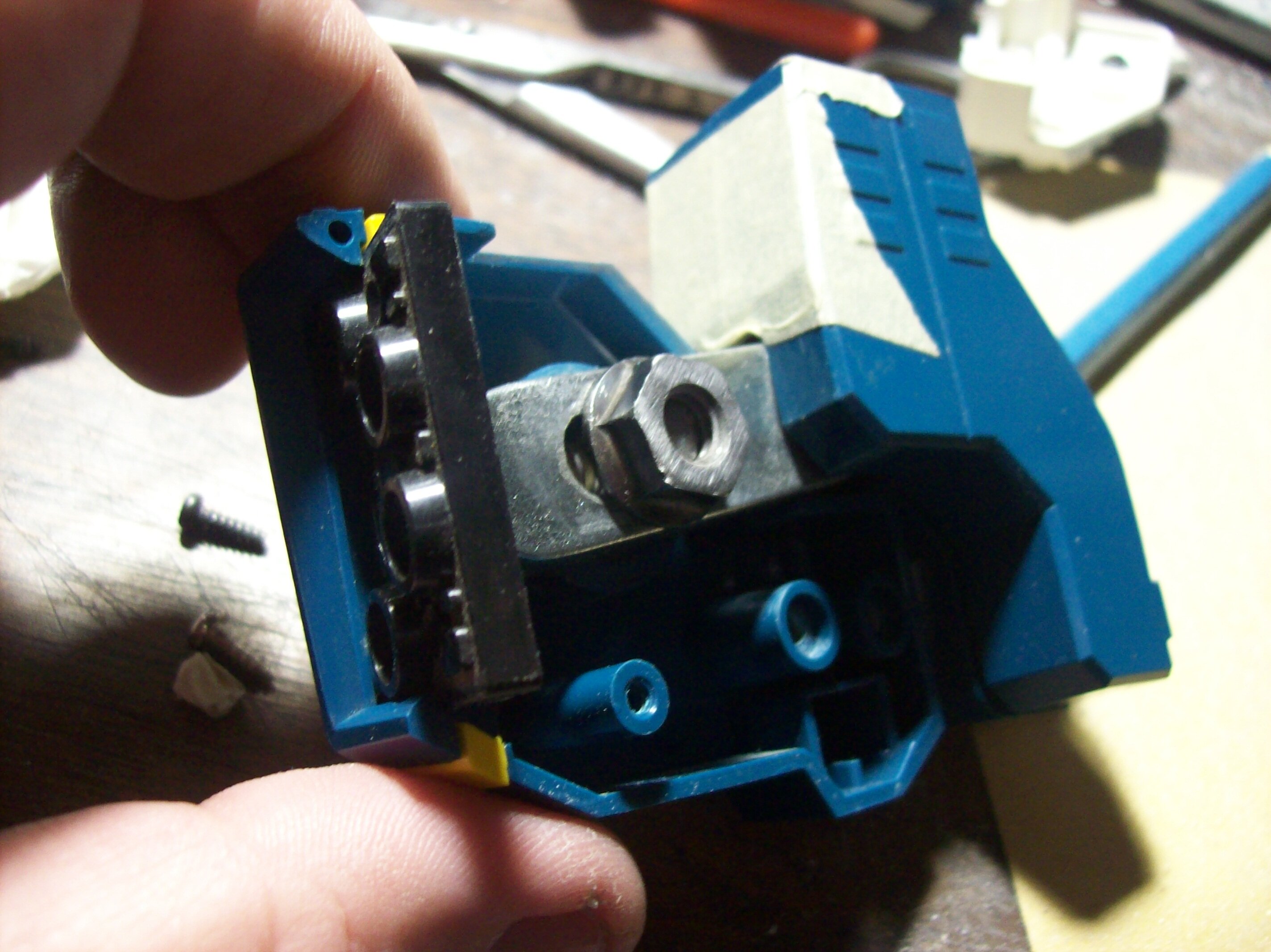

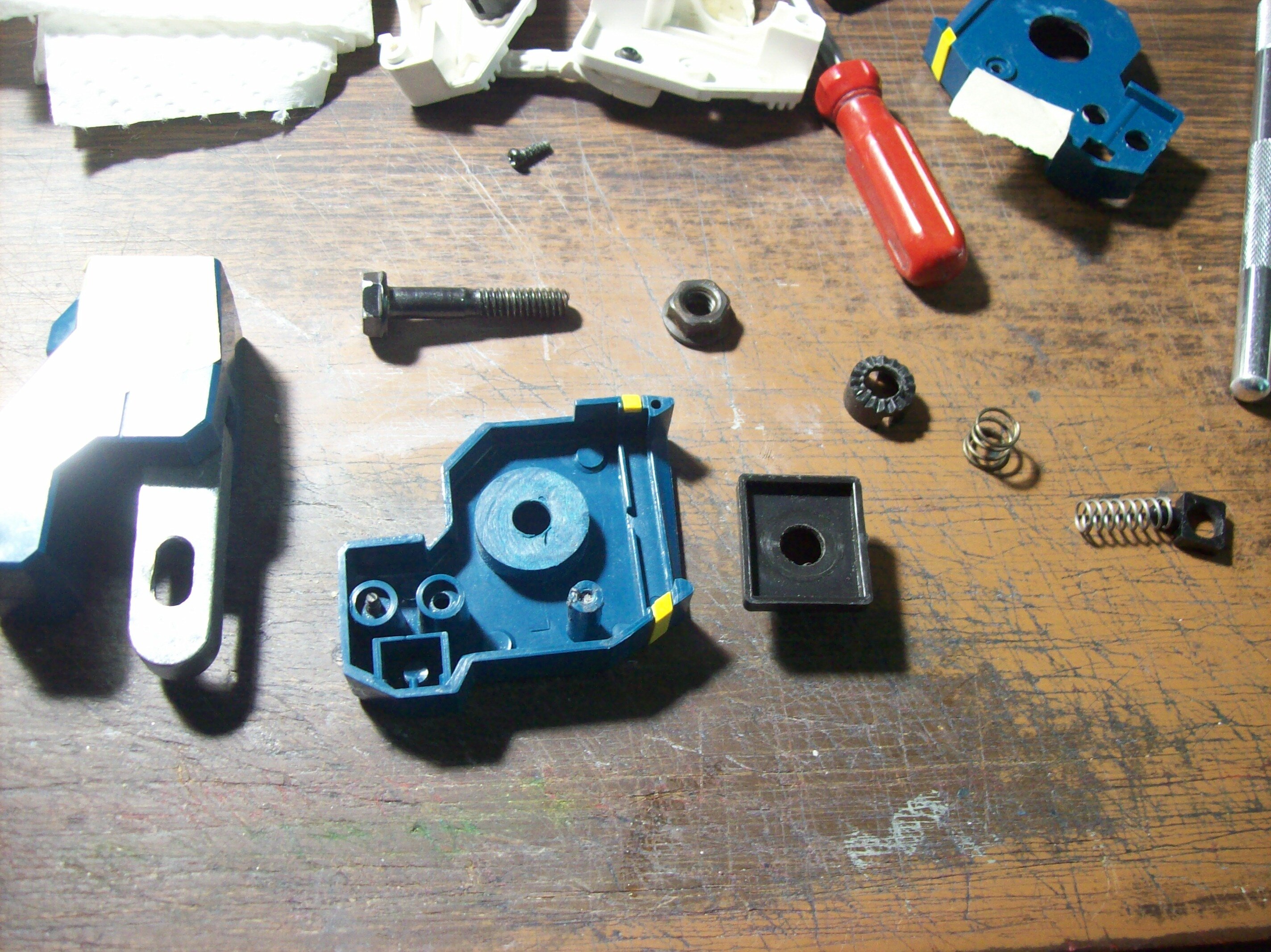

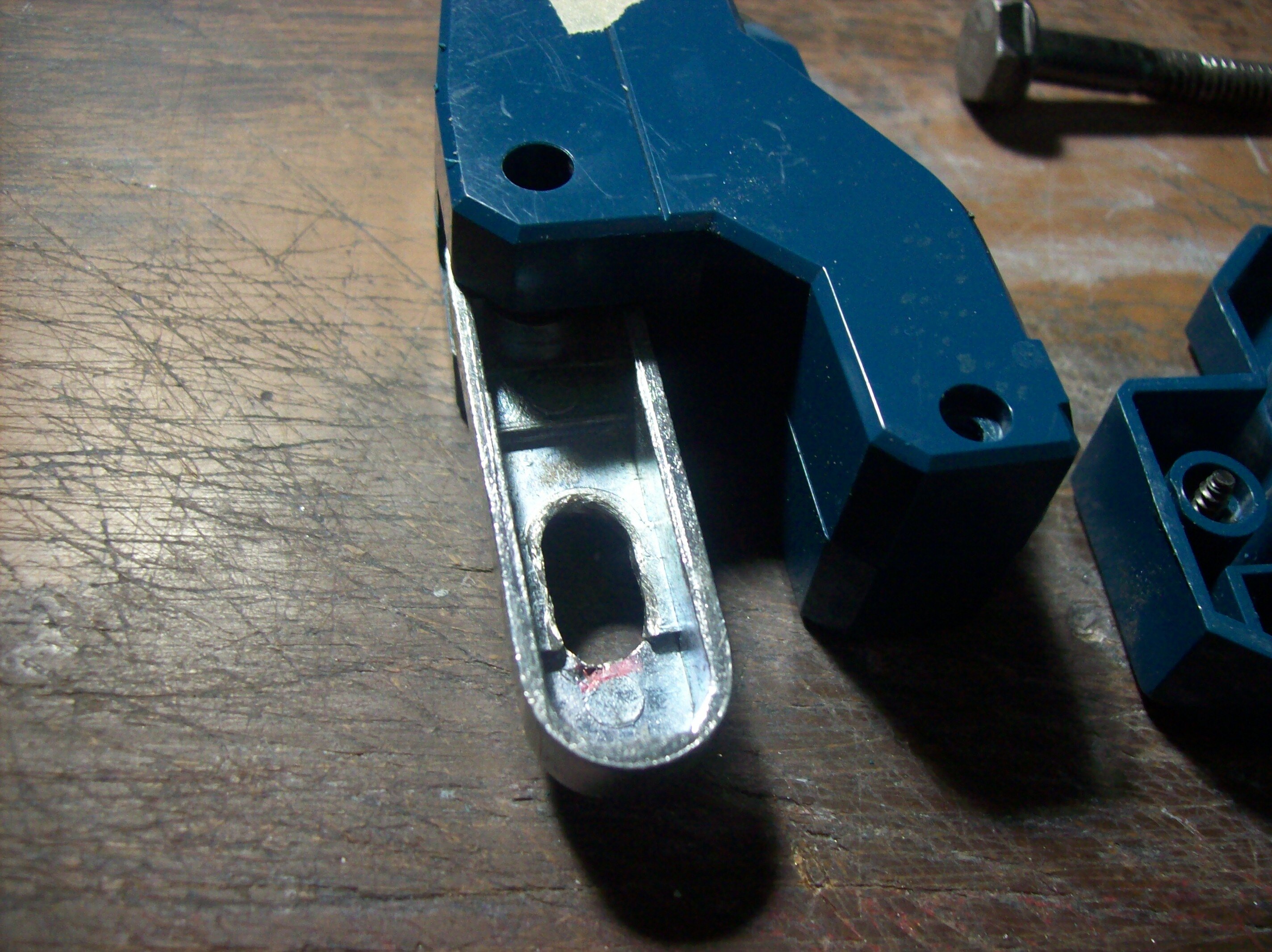

I took a look at the setup for the boom joint: a metal part that was hollow on one side and had a slot cut into it, with a spring and part to connect to the internal peg:
So, I removed the other stupid peg from the inner chest:
Sanded it flat so anything that needed to slide could do so unimpeded. After this, I  took the metal boom joint, used a file to widen the slot a tad, and slid a nice, hefty 1/4 inch bolt into place to hold it.
With hat done, here is my setup:
101_0102.JPG.4c6bed1d17810294b2839e2c6e159865.JPG 101_0100.JPG.d9aab9630e41be2c39dd9bcc17482041.JPG101_0101.JPG.c650f7b6b4f60101b3f3bc4ec771633d.JPG

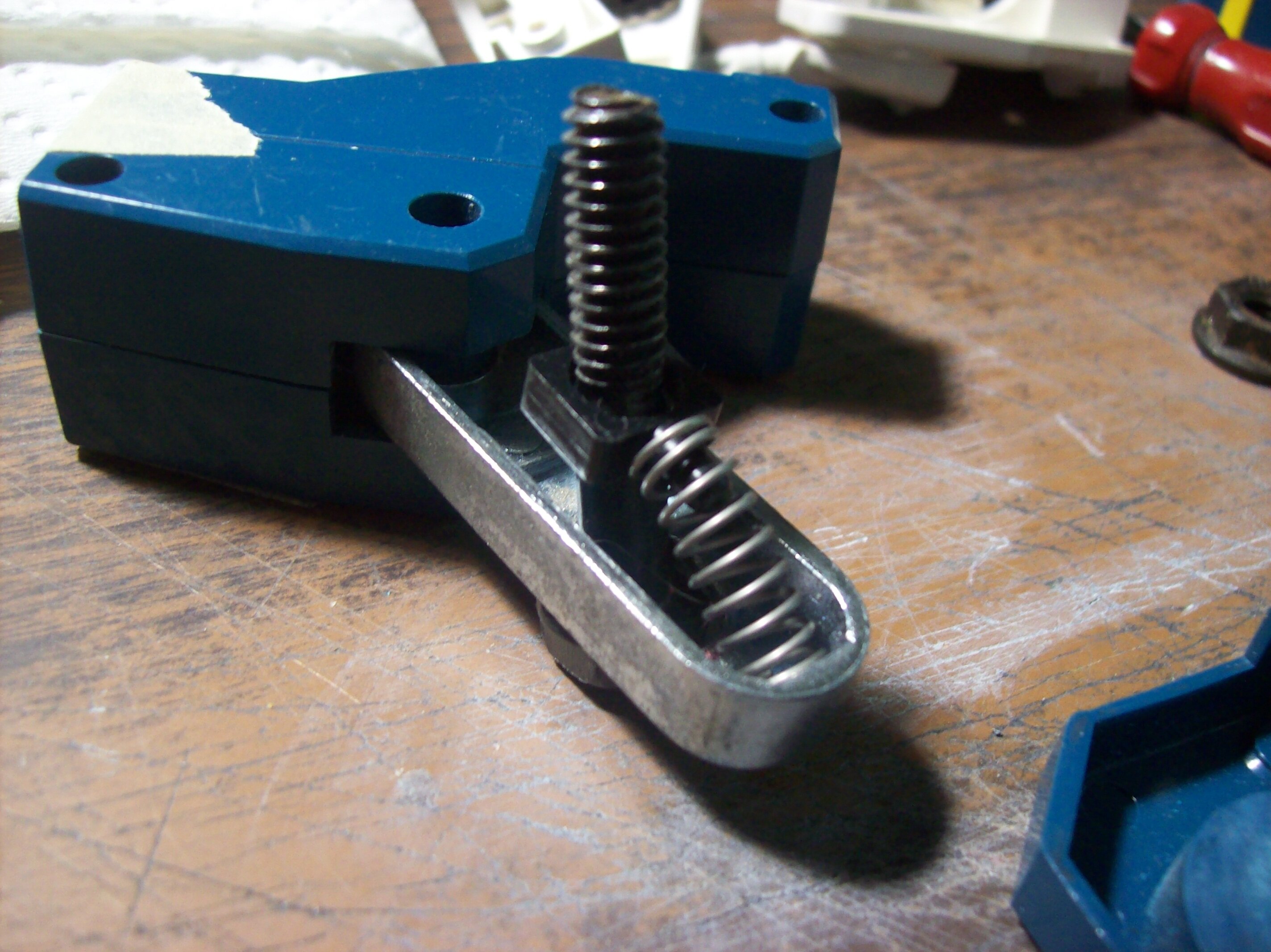

The nut for this remains on the inside, plastic-welded in place so it won't work itself loose in any way. Meantime, the head of the bold ends up in the actual shoulder, where the rotational forces aren't able to affect it. I had to grind down both the nut and the head, but they fit respectively where they are. Meanwhile, the boom slider slides just fine on the bolt (the threaded end goes past where any parts are located), with the spring tensioner part in place.
One metal bolt acts as the shaft for both, and the stupid "staggered post" is GONE.
The spring tensioner and the bolt:
Once the plastic welder was cured, I ground a "hollow" into the metal piece that the legs and chest connect to (to make way for the bolt head, which now protrudes through the inner blue housing via a hole that I had Dremeled into it). This is so the bolt could be glued to the spar and further secure it:
(Yes, that was quite a bit of metal dust. My mask came in handy!)
And since I don't use the "splay the booms out to the sides" feature that is built into this, I could simply plastic weld and screw the chest boxes back onto the figure:

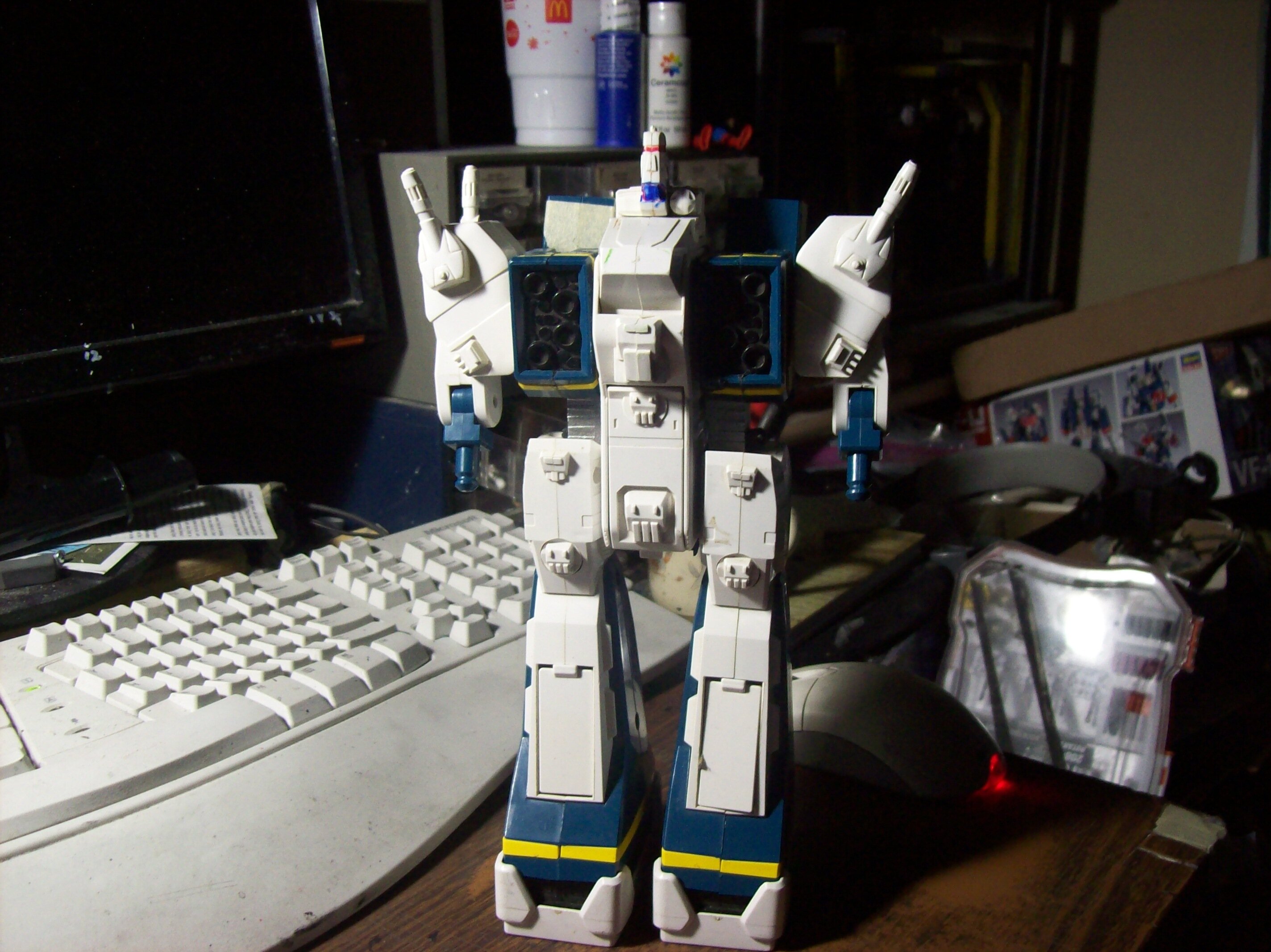

So now, my SDF-1 is back to it's old self:
Only this time, it has drop-forged steel bolts running through each shoulder, which could probably take getting plowed by a linebacker and ask for seconds!!!
The shoulder joints ratchet and click as they should, and no sighs at all of any stress or anything coming loose is even remotely showing. All stresses now reply on the bolts, which are connected directly to the metal frame, as are the boom joints.
So, the "impossible shoulder repair "has been made possible.

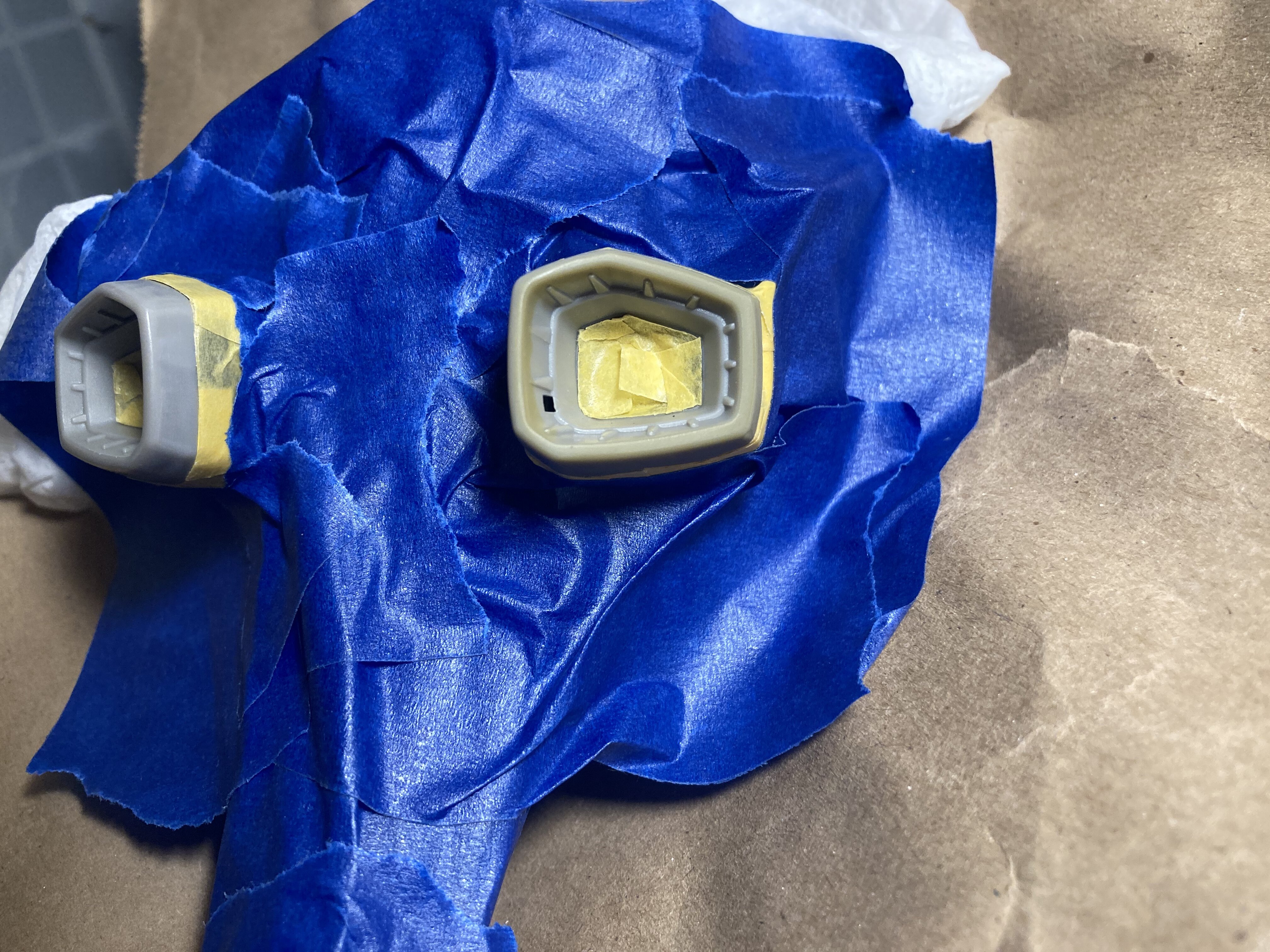

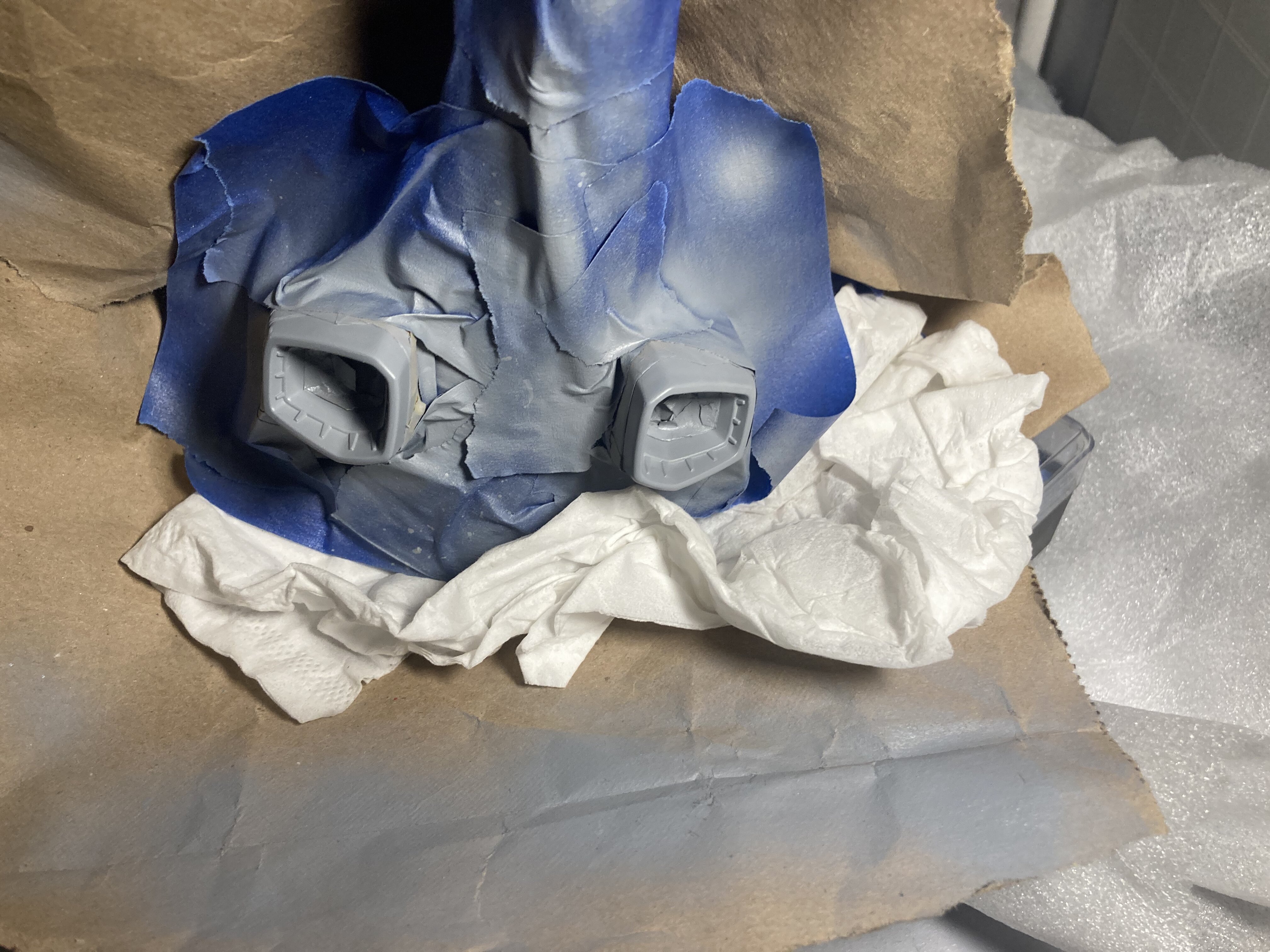

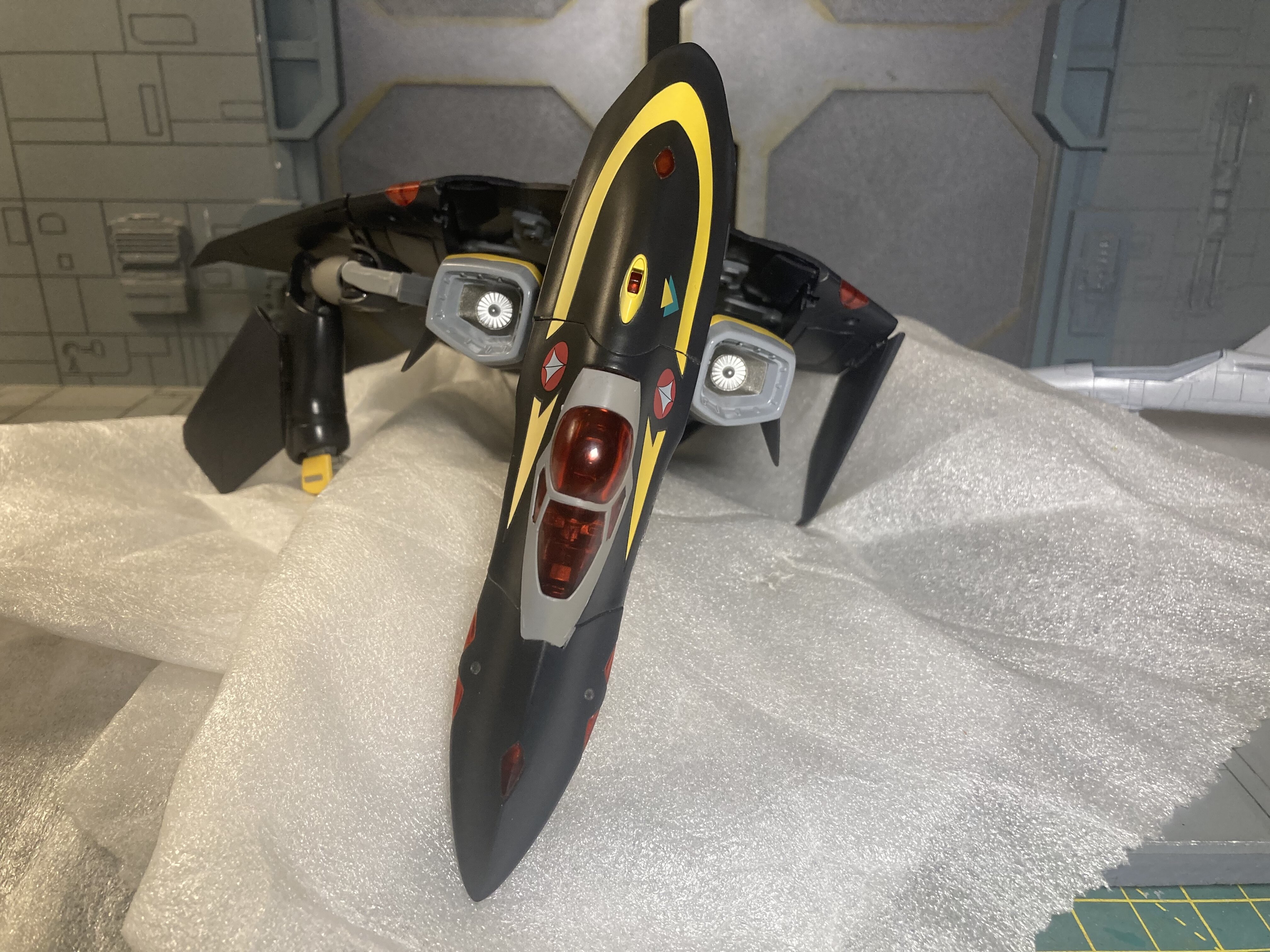

So i had to clear the workbench this weekend for an emergency patient. Pulling out Valks to sell and found this. The yellow strikes..!A59E6F85-8E97-4E7E-B279-9CFA0A100955.jpeg.1b4c7705608695a7e8276fd229133daf.jpeg
Awww, Shazbat !! I wept, but mostly because I'm letting her go. So , not to be deterred, i put the patient into "the position ."56B6C826-FAB7-4EB8-9511-EAE6683BEEFA.jpeg.054ecaa4c468590cbf75908e9e9233fb.jpeg
And began masking. First Tamiya tape , for the detailed edges. Then blue tape and paper..11ED8E52-487A-40D0-8CF4-6DC759138AF6.jpeg.13d79665963800db085b02c016bc7c24.jpeg
The inside of the  intakes were an exorcise in patience.C8DE47D8-6D31-4E61-9C4C-451C9DDDB0C3.jpeg.1083d8fcd65a15f8fb5c650bfb1e6479.jpeg
I did go ahead with some light wet sanding and wipe down with a damp cloth, then..Some color mixing and some airbrush time..DFBB6756-96E1-4382-BFDD-2BF9DF1C9B5C.jpeg.c6fb72bbdadd49cbcafeb4c46ee384e1.jpeg
A few coats of matt clear and then off with the masking.  ADD46382-3C57-4181-AA61-19F1BFCF3F08.jpeg.f6640e7af263004c4ad2aba41fb5a0fc.jpeg46B8994F-5245-4996-9550-CCBFEAD5F425.jpeg.d294cc78027aae36a68ef804fe03da4e.jpeg
 I believe the yellowing issue with that is solved. I hope..
See ya'll next Deculture.

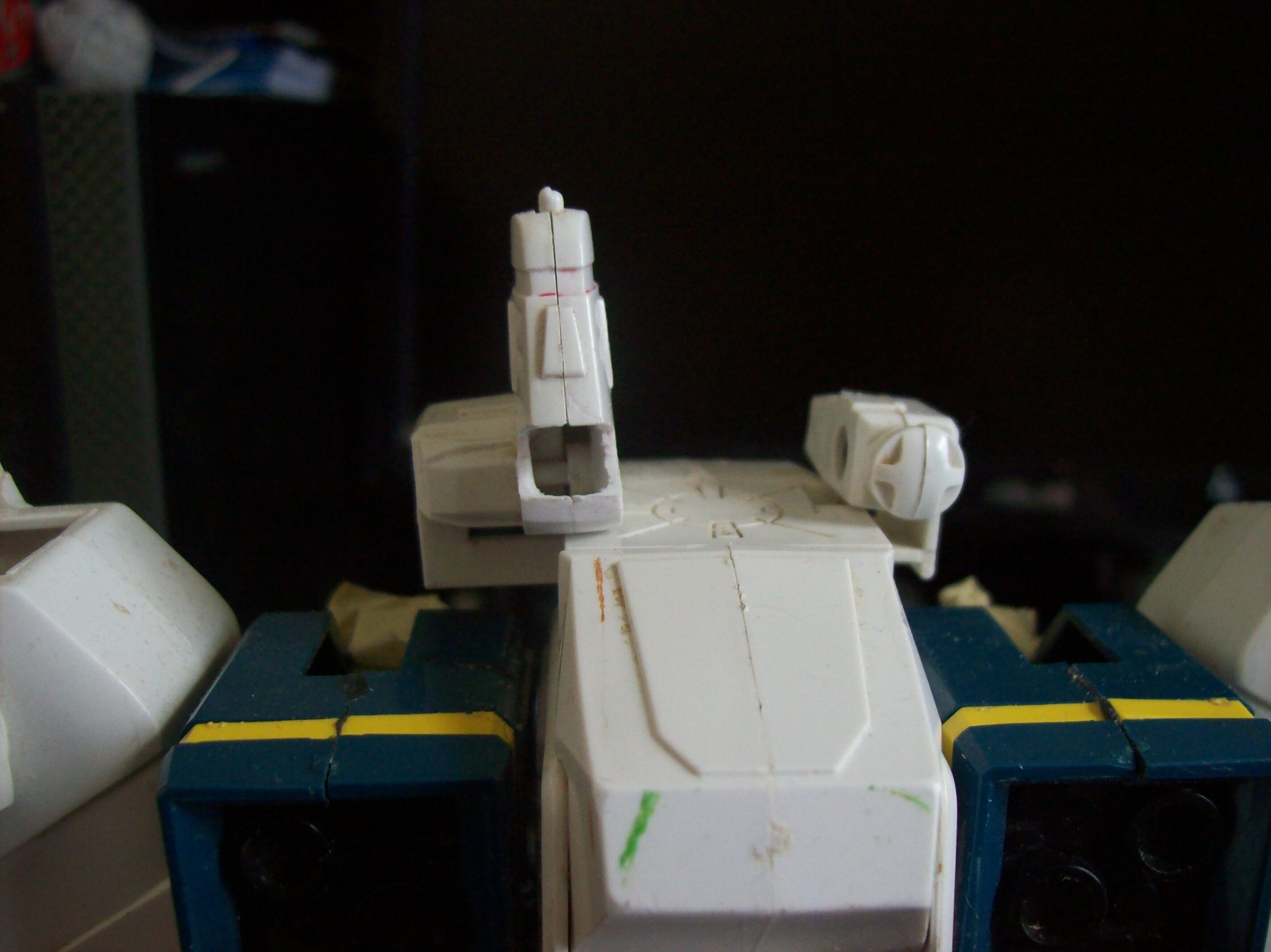

Minor update: removed the main "canopy" from the SDF-1 Bridge; going to scratch build the interior of it with a transparent canopy. But for right now, I'm on hold pending possible parts coming in.
Stay tuned...

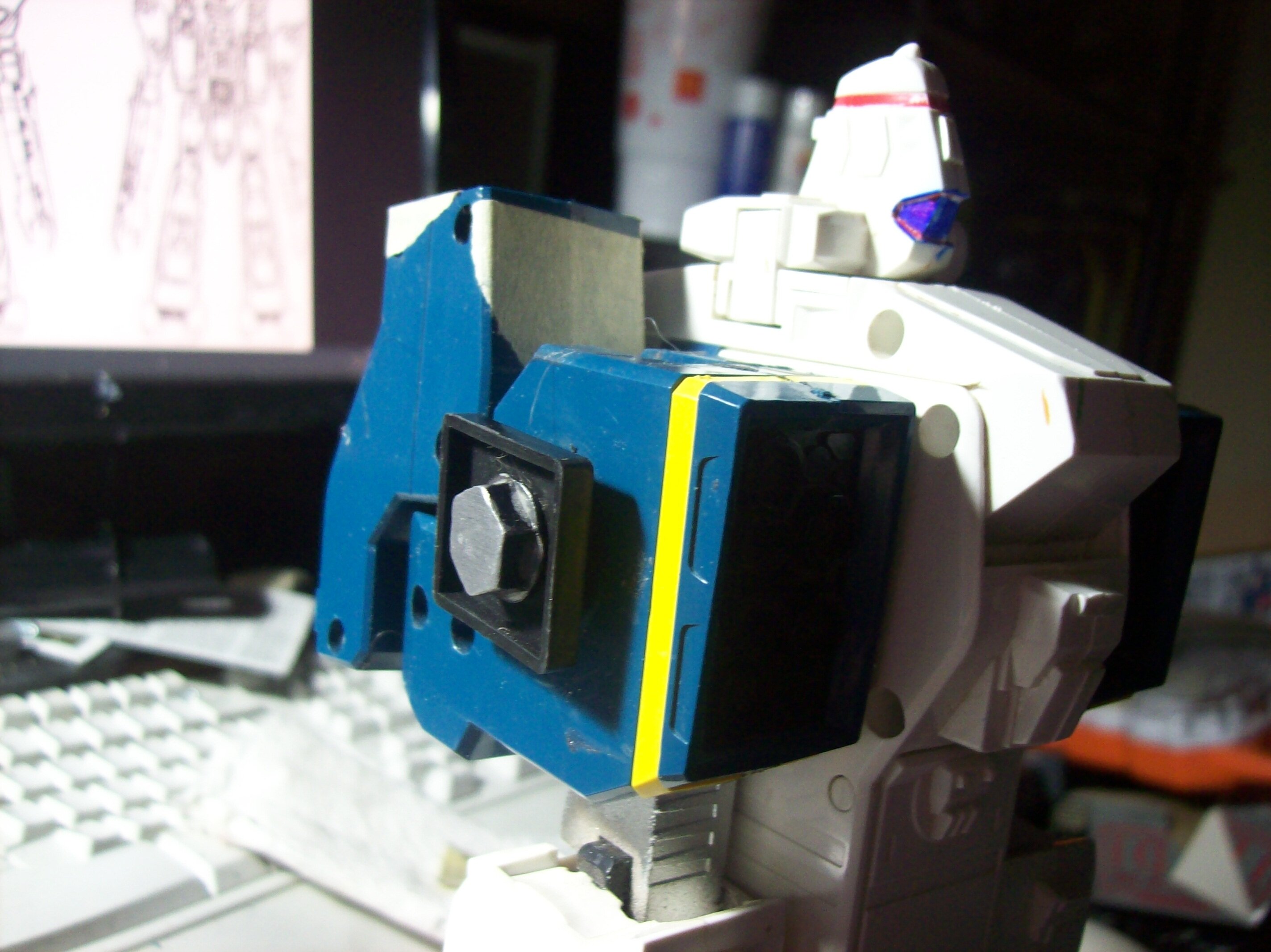

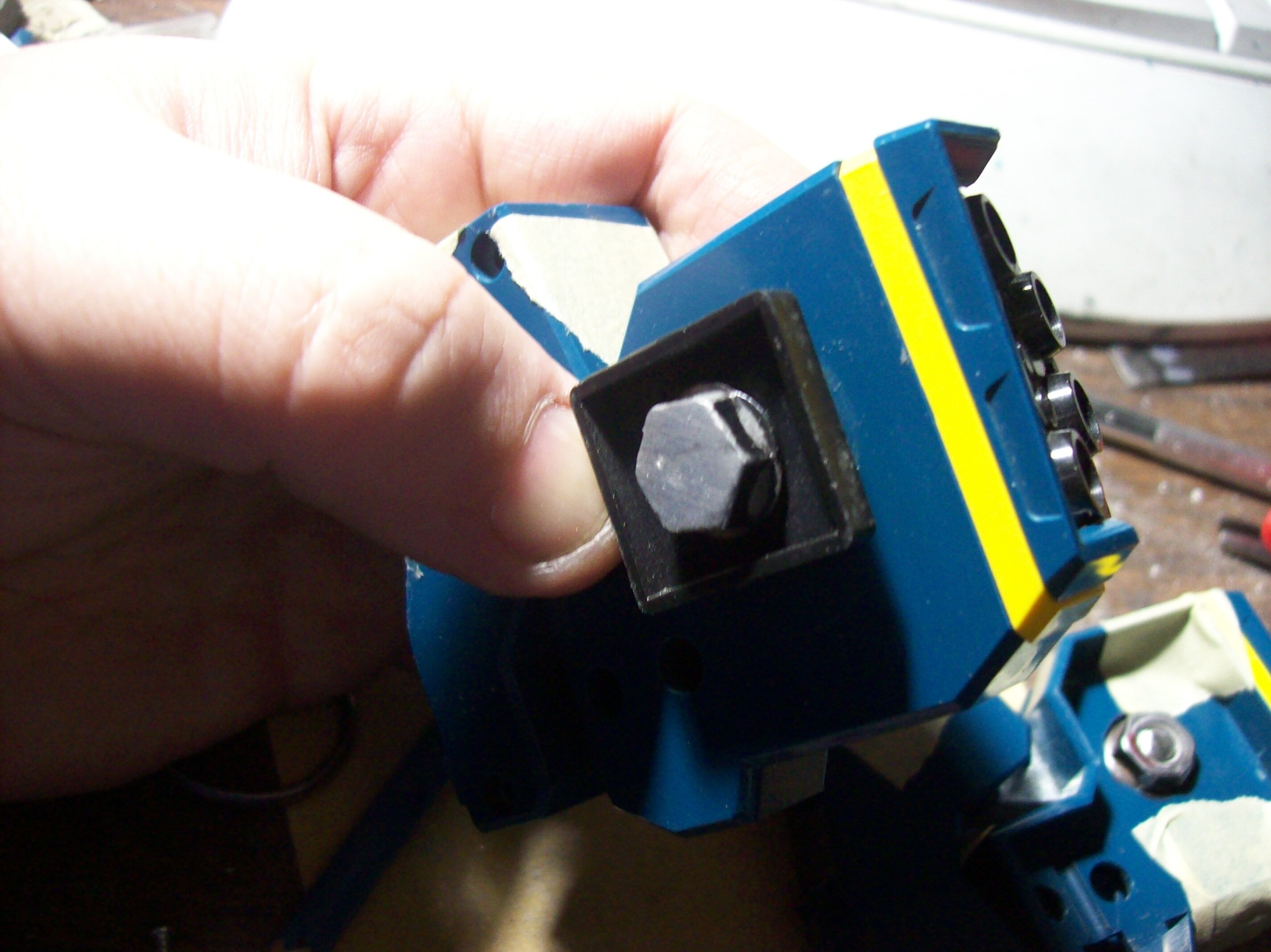

So @pengbuzz, the shoulder bolt fix doesn’t impede the arms from rotating between cruiser mode and attacker mode, right?
I know that was an issue when I was making a similar repair.
Not one bit: I ground down the bolt head to allow clearance for the arm to rotate.
I did my best to get the bolt head about level with the black piece's upper edge all around; a dremel tool and a grinding stone should work. You don't need the absolute hardest steel (even aluminum bolts will do), but metal is preferable to plastic here. On that note: make sure the upper shaft is smooth about 1/4 of an inch from the bolt head before the threads start! This will prevent the shoulder from "riding" the thread and trying to undo itself.
Since I'm modifying mine anyways, I also took the precaution of grinding down the top of the bicep slightly and beveling the "squared-off" edge on it, so there would be no issues with the shoulder. But yeah: the shoulder ratchets ("clicks" ) with no issues whatsoever and is very stable.
I'll try to get an internal pic of the shoulder with housing in place in a bit.

As for the bolt: that's the idea! The bolt is now adhered via plastic welder (adheres metal too ast3500 psi strength according to the package) to the metal frame, so it won't transmit shock or stress to the plastic chest "boxes" on either side.
This project has been a distant dream that only now came true; I paid as much as I did because the arms were not broken off of it, only to have it happen out of the package! But returning it would have just put me back at "zero", and any of these are going to be vulnerable anyways. Hopefully, I can get the one derex is offering (waiting on him to check shipping for me) and then I can proceed.

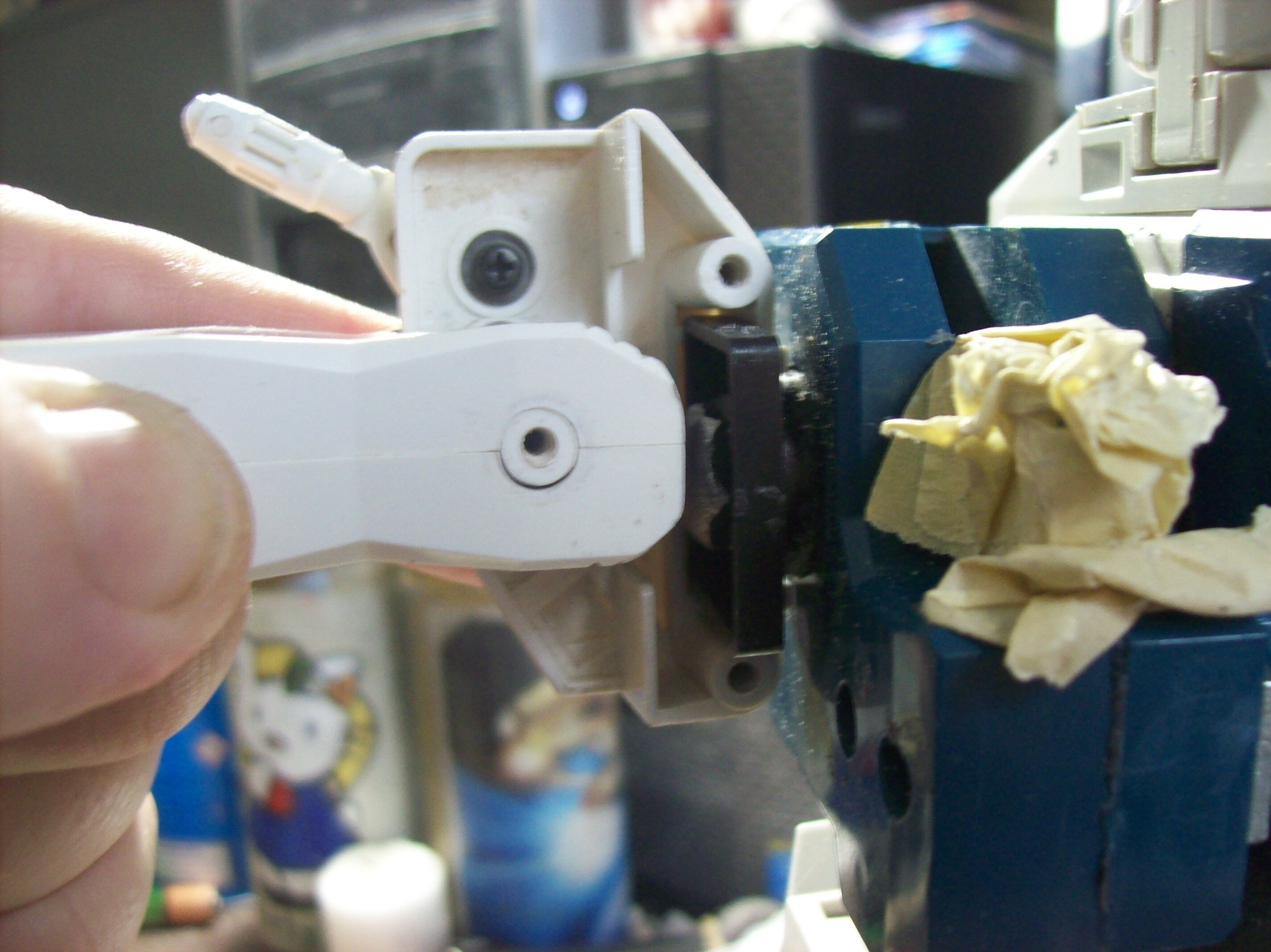

Mog, I wanted to revisit your post; I promised you some internal pics, and here they are:
 101_0113.JPG.cb38badf41346b181d167d197c71030f.JPG  101_0112.JPG.923e0f3eace9f0d61c91e02ef783b5a9.JPG
As you can see here, the bolt head is nearly flush with the black plastic collar for the shoulder. But to make sure the bicep cleared, I took off a little of the top of it and beveled the "square" end of it (had to hold it in place manually for the photo, as the spring socket for the bicep kept popping it off the shoulder block!)

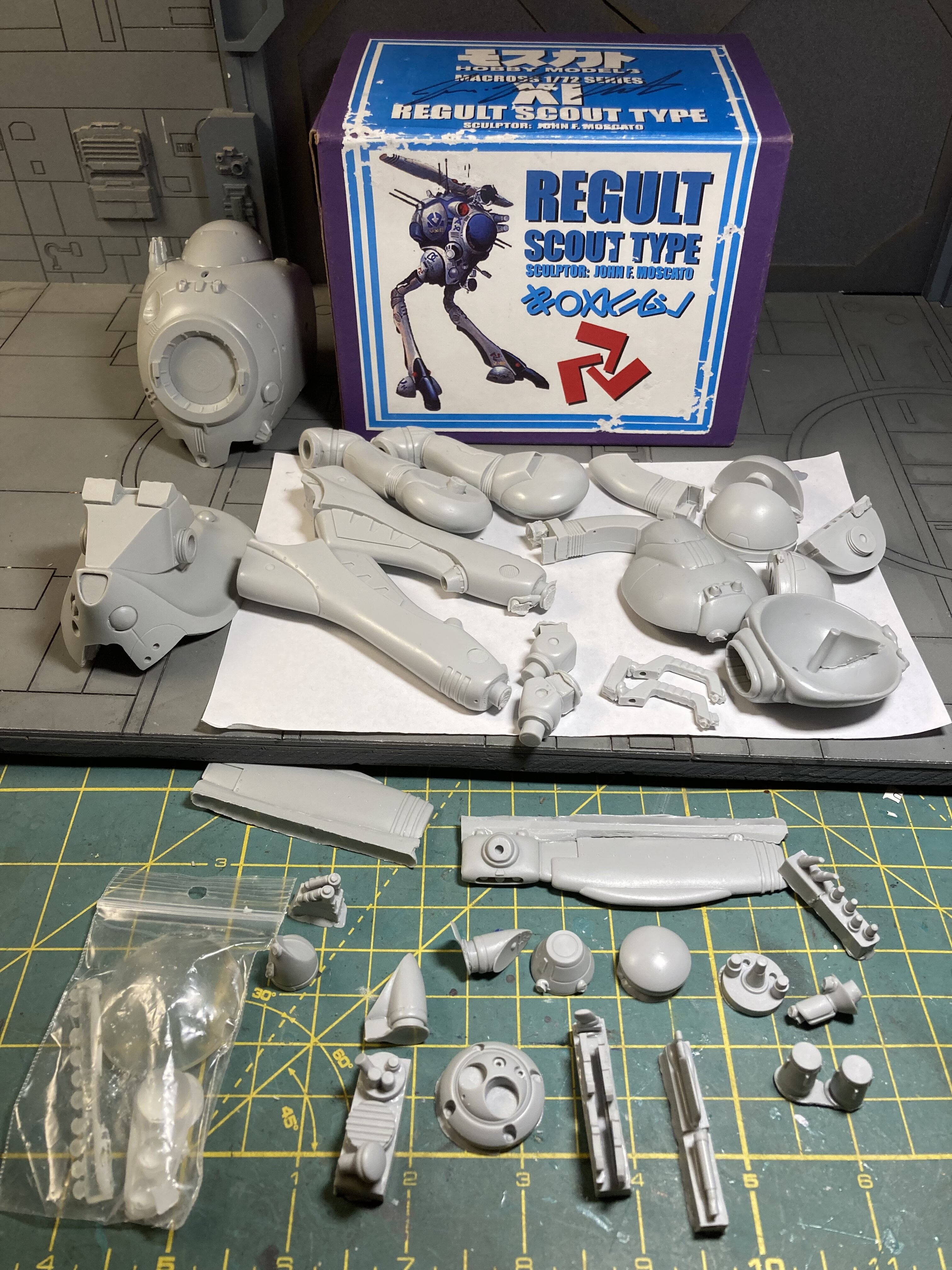

This just showed up.2186B77A-FEA1-46DF-B957-A66D4B5DBCAF.jpeg.be89a717a611f2dec9746cd03b270f8e.jpeg
I'll be cleaning it up in between airbrush time on other stuff . I've looked around a bit for instructions (didn't come with any) , I'm very familiar with the base Regult and i can reference pics for this project . But i like to have instructions. Does anyone have a set they can post or can point me in the right direction?
Cheers
Cheers

Thanks @pengbuzz i saw that. It's just the basic model. I need for the scout. Way more going on with it. Like I said, I could reference my pics, but prefer to have the legit instructions.

@Bolt The Spider bug is looking ready for service soon! I look forward to your pod build too!

7 hours ago, Bolt said:
Thanks @pengbuzz i saw that. It's just the basic model. I need for the scout. Way more going with it. Like I said, I could reference my pics, but prefer to have the legit instructions.
