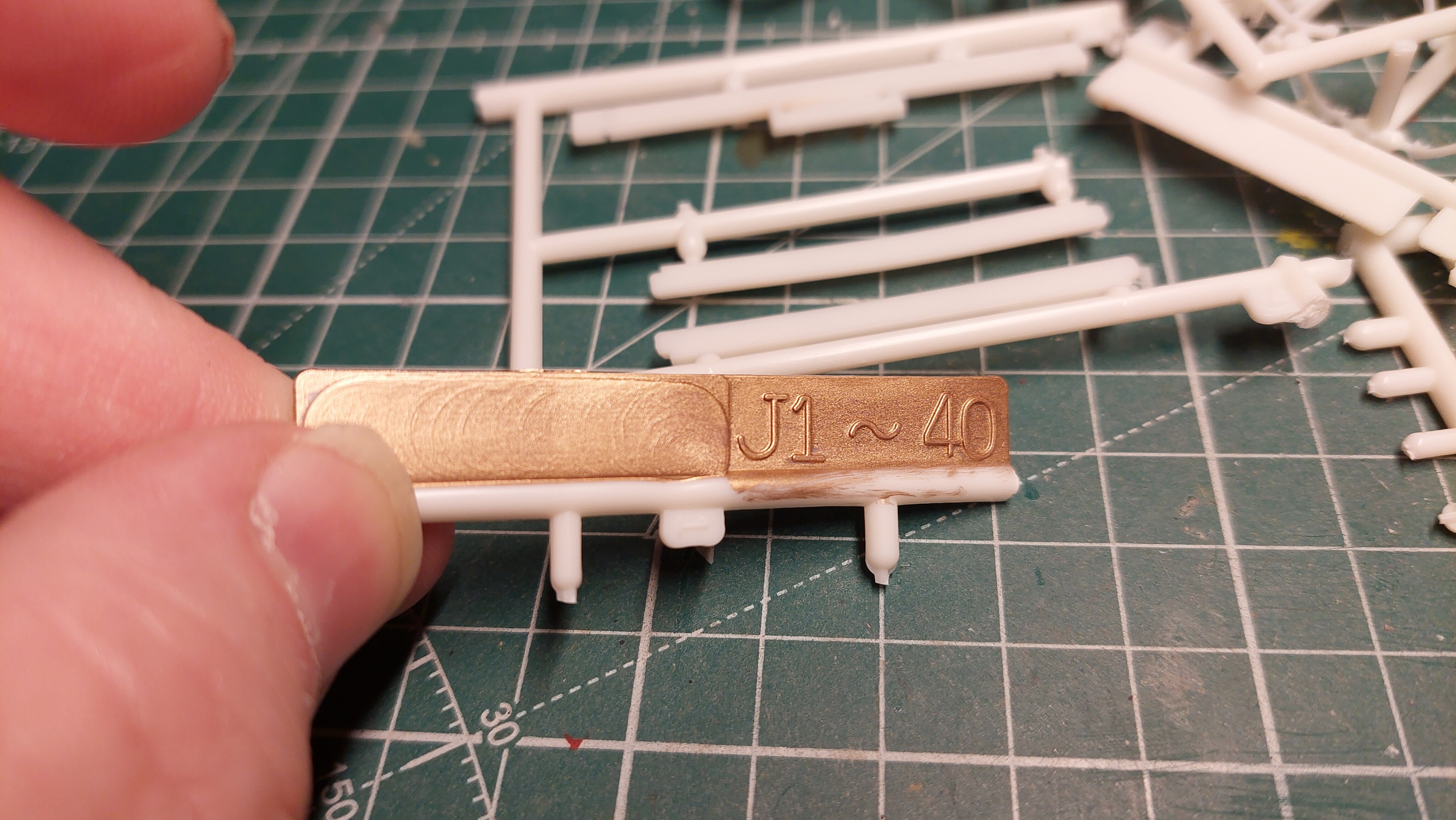

MechTech Posted February 4, 2022 Posted February 4, 2022 @pengbuzz If the area is tiny, you can also use a chisel and roll it side to side to etch too. I rarely have the right size chisel, so I'll sharpen an old Xacto knife blade with a file or sandpaper. I've used other softer scrap metals too like from can lids. That's the cool part about styrene, it's soft and blades last a while. @derex3592 Thanks for sharing! That paint has been around for decades!!! I remember my mom using that stuff back in the 70's. I always see it and ignore it because I don't do anything gold for some reason - always chrome colored if anything at all. - MT Quote

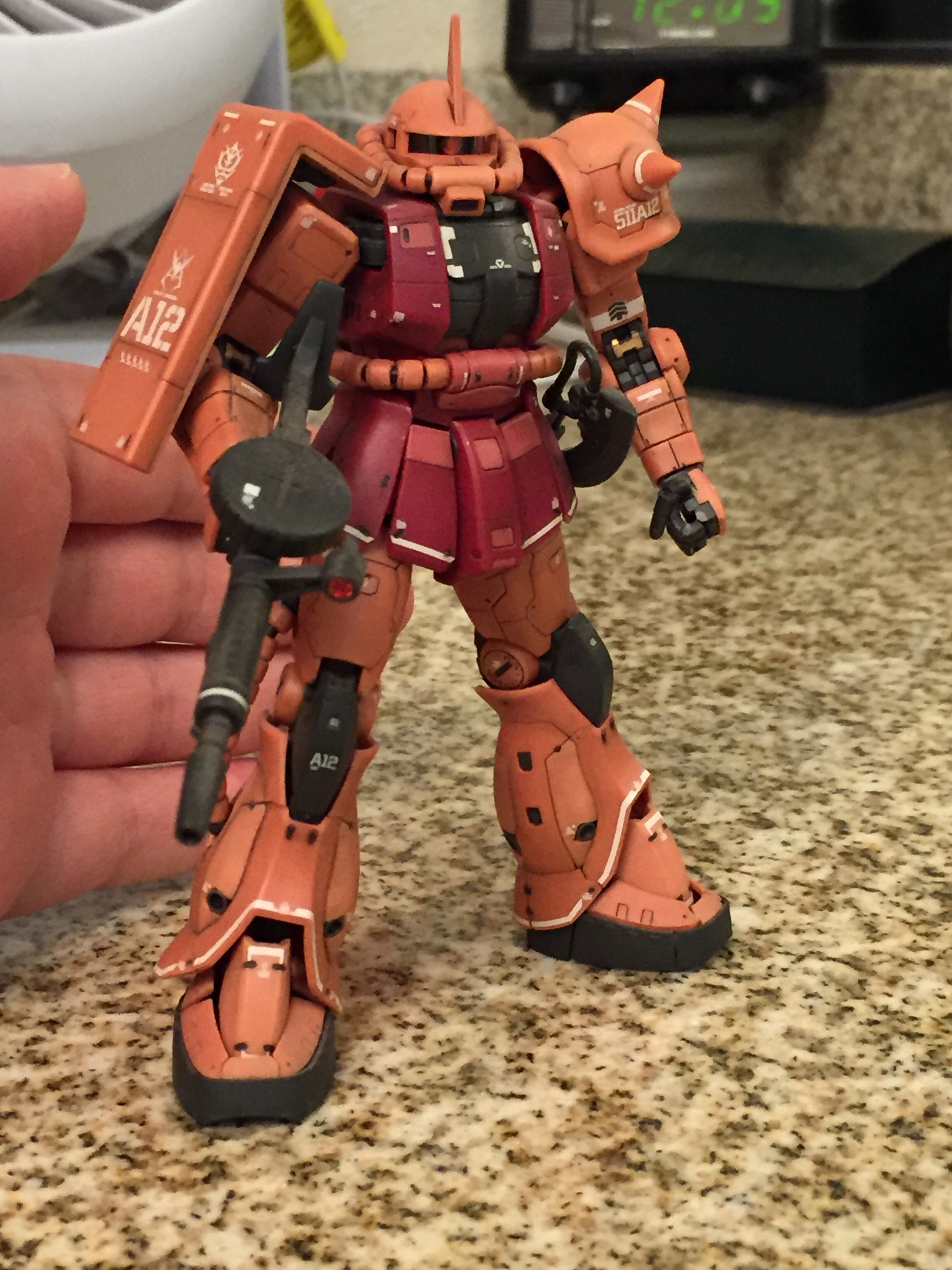

Big s Posted February 6, 2022 Posted February 6, 2022 I think MechTech was making a simple joke. The smiley faces show. And my Char ‘s rg Zaku is a pretty good example and honestly I think I even described it as a lazy build. No seam lines to remove, some decals, an oil wash and the only thing out of the ordinary was some chrome paint behind the lenses and then covered with clear red. Even though I consider it a lazy build, someone else could have put in the same amount of work and thought of it as a masterpiece. Everyone has a different skill set and amount of free time and if it takes a few hours straight out of the box or a couple years adding parts and custom lighting, I appreciate what people are willing to show of their hobby life and I hope people keep uploading their work success or fail. Quote

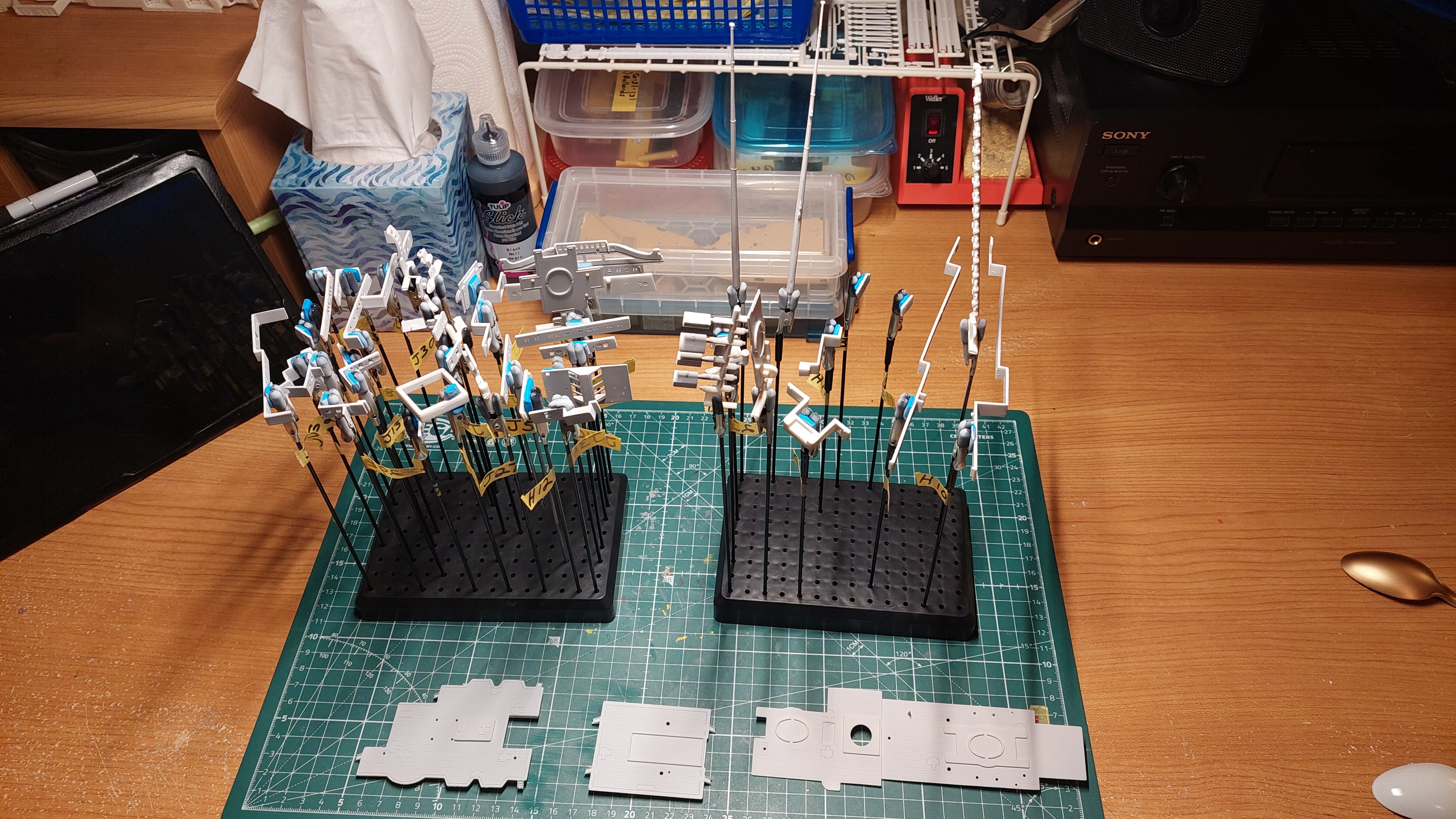

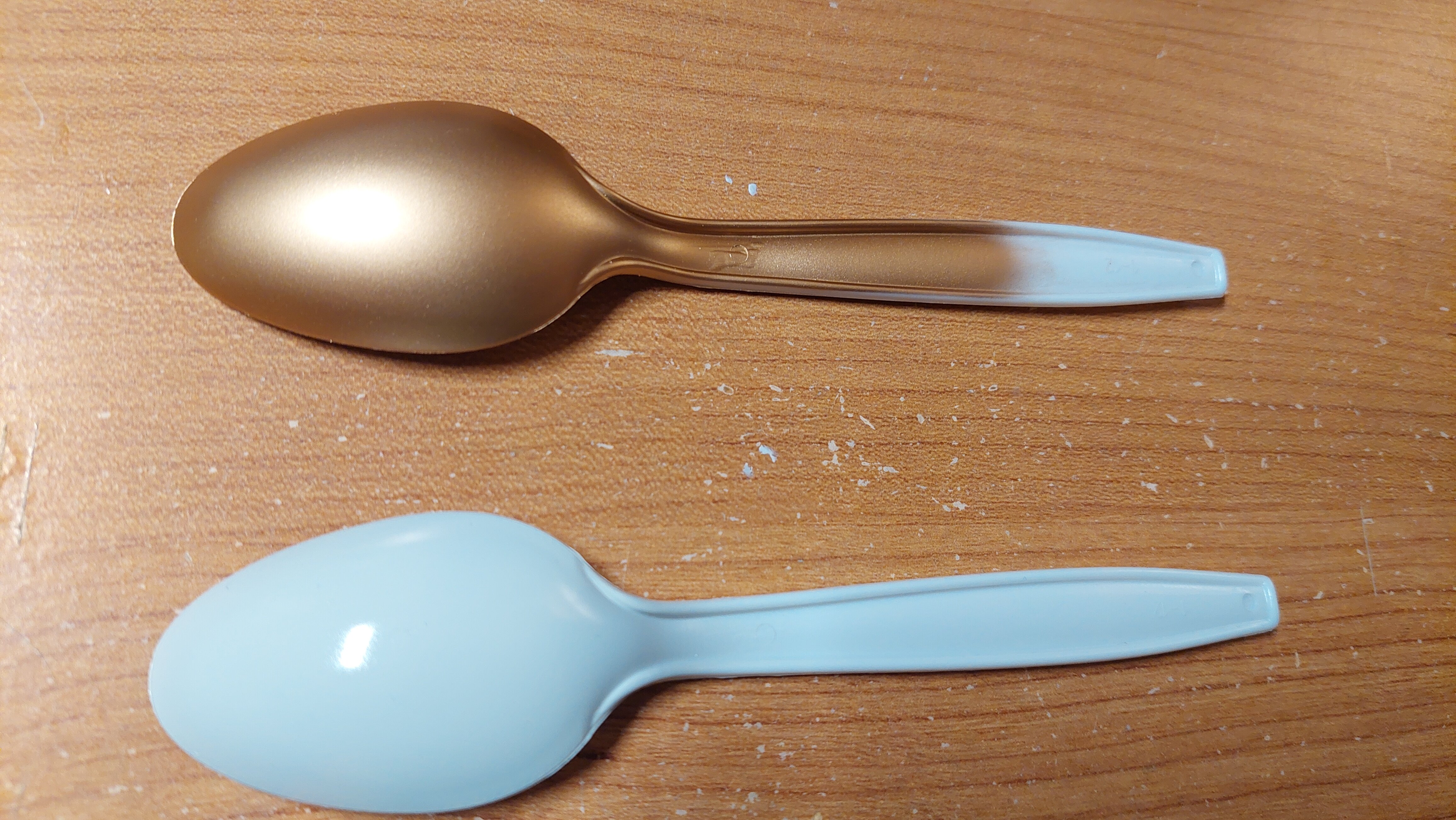

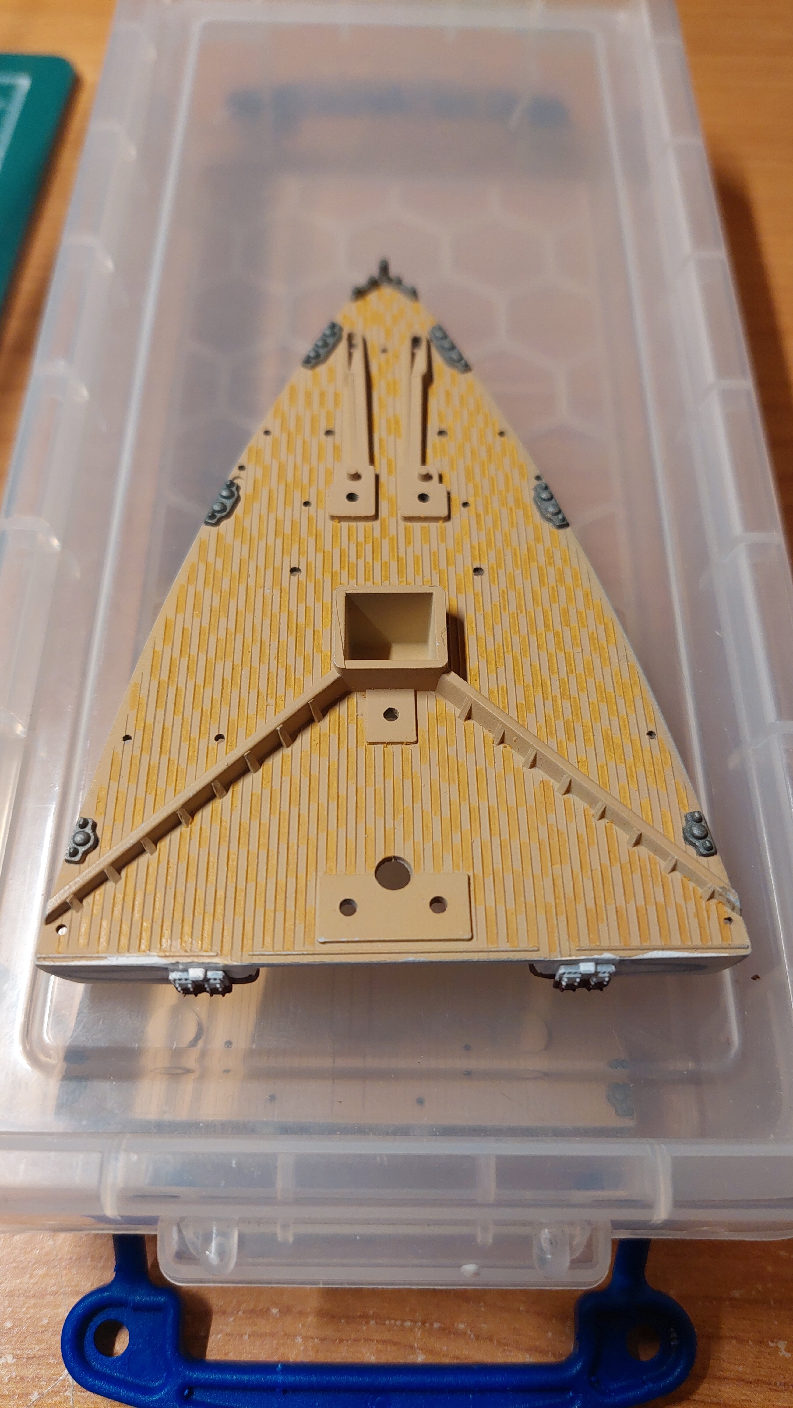

derex3592 Posted February 7, 2022 Posted February 7, 2022 Titanic Upate... Spent yesterday afternoon at the new spray booth airbrushing Mr Surfacer 1500 primer onto a million little parts. Thinned about 70/30 with Mr Color Leveling Thinner. You go through quite a lot of it I must say. Also front deck coloring is finished and a little hand painted details are there now. Also remember the gold craft paint??? Yuppers..airbrushes like a dream, thinned 50/50 with Mr Color Leveling Thinner. It lays down like an old Model Master Metalizer. Beautiful. The white spoon is my 1st try with Tamiya Lacquer Racing White again thinned 50/50 with Mr Color Leveling Thinner. Lays down extremely well. This will be the color I use on all the upper deck parts. Stay tuned! Quote
MechTech Posted February 8, 2022 Posted February 8, 2022 @derex3592 Now that's a "Golden Spoon"! The deck detail adds a lot of realism to the model. - MT Quote

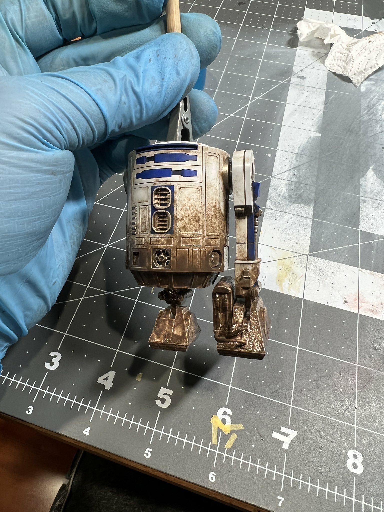

anubis20 Posted February 11, 2022 Posted February 11, 2022 Friend wanted a muddy R2. First time trying to weather a model 😅 Quote
Big s Posted February 12, 2022 Posted February 12, 2022 A muddy R2 he wants , a muddy R2 he gets. You could add a bit of flavor by adding a light dry brush over the higher areas with a lighter color to show places where the mud may have dried Quote

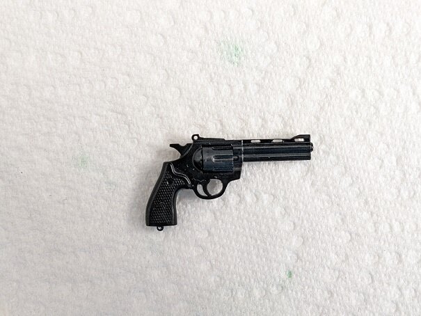

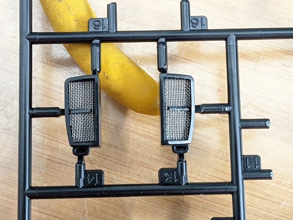

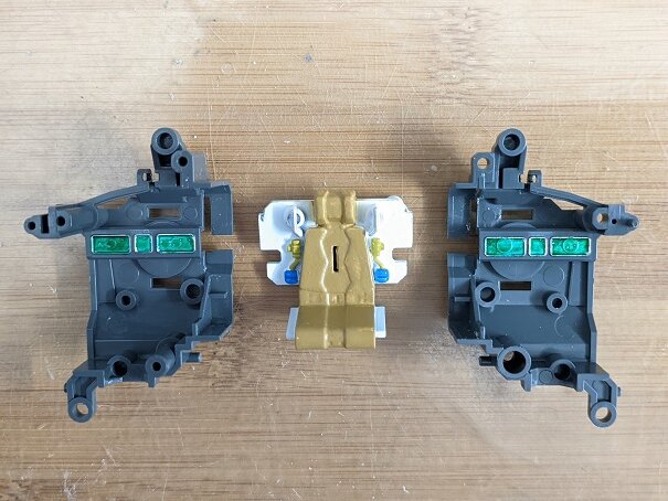

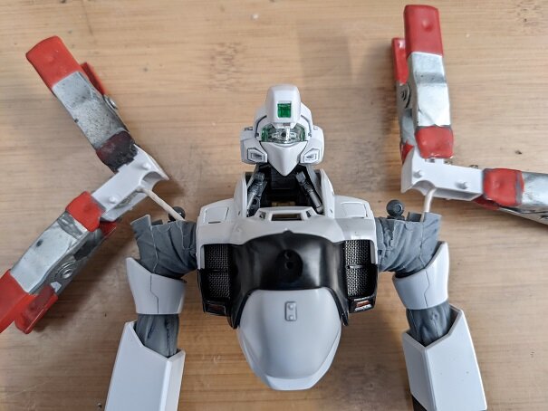

MechTech Posted February 13, 2022 Posted February 13, 2022 (edited) @anubis20 Great job on the mud! It looks muddy alright! I got some more work done on the Ingram. The pistol looks cool, but I thought the frame would look better with the rails and other parts actually cut out. The barrel was also bored larger too. The original slide molded muzzle was cool, but too small to go with the cylinder hole sizes. Here's the back with everything installed. It's a tight squeeze, but its all there. Now you know why I'm NOT a surgeon! The black cable going up to the head is for the LED in the "eye". That's new too. I actually lathed an LED to fit in the "eye" socket. A few things. I had a BEAUTIFULLY green tinted visor for the head. I used Mop N Glo with some Tamiya paint in it and dipped the visor in it a few times. Looked just like tinted glass. Then it got scratched during assembly. So I re-tinted it again. Its much lighter, but does have a slight tint to it. The top head sensor maintains its green tint. The shoulder lights are finally glued together. I used cement to hopefully get no seam lines when sanded. The "eye" piece is coated in chromed paint and the eye socket hollowed out to take an LED. The LED was covered with scrap Bandai decal foil to light-proof it. The windows in the chest were carefully cut out and opened up. All the details on this kit and they made them solid? That's it for now! Hopefully this will be assembled soon. The Spitfire should be fully cured by now. Thanks for checking in! - MT Edited February 13, 2022 by MechTech Quote

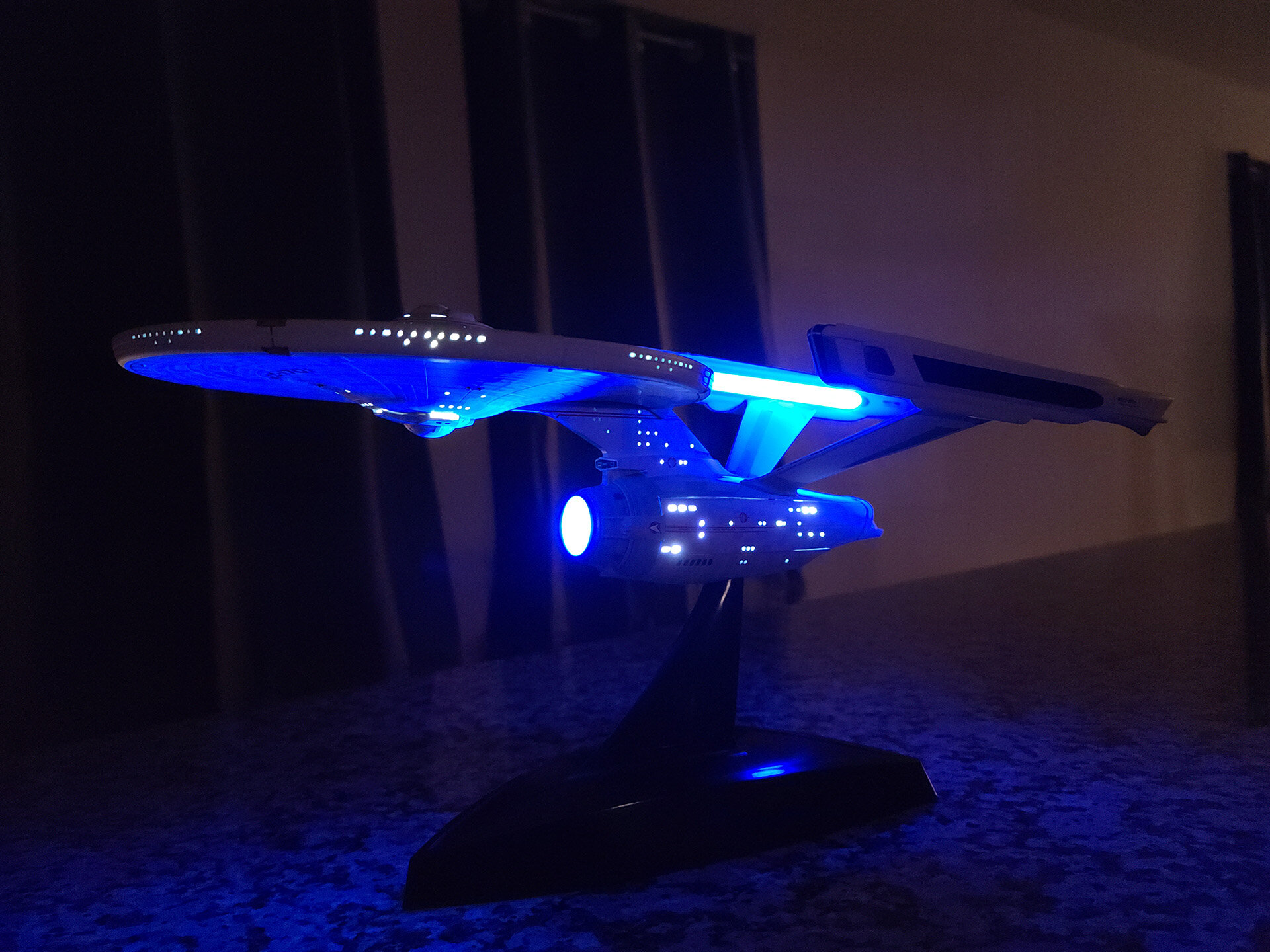

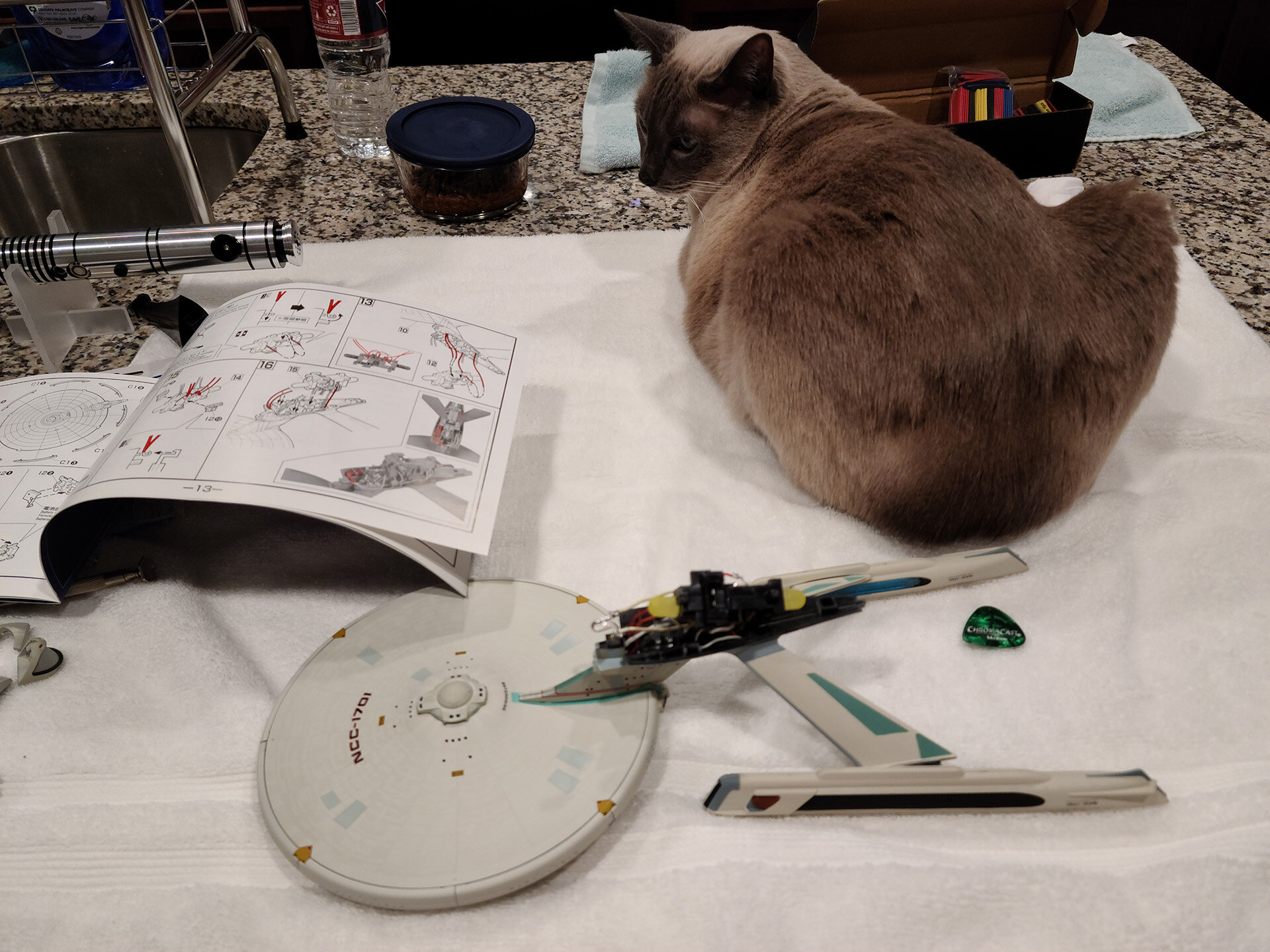

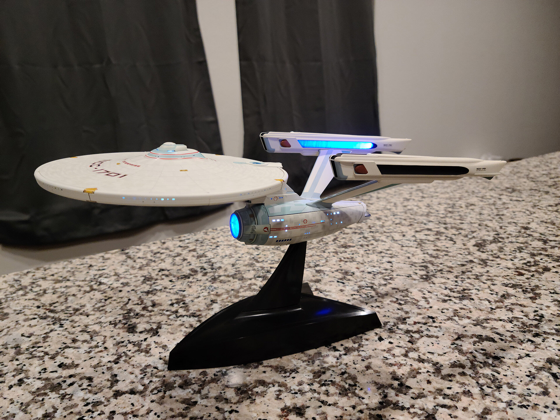

Lolicon Posted February 14, 2022 Posted February 14, 2022 My old Bandai Enterprise kit's lights have been on the fritz for years, so I spent all Saturday afternoon resoldering and fixing the wiring on this old kit. I was actually quite sick when I did this build years ago and kinda half-assed some of it. I also don't recommend handling a soldering iron when you are struggling to maintain an upright position. The Enterprise was attacked by some unknown space creature during its refit. The original crappy stock incandescent bulbs were replaced with blue and white LEDs. So despite fixing up my original shoddy wiring job, I still couldn't get the lights working properly. After much trial and error, I found the reason: the poorly designed metal conductors Bandai designed for the inside of the secondary hull. They're held in place solely by friction and over time they shift out of place and won't stay put, which of course breaks the electrical connections. Like many of Bandai's design flaws, it was fixed with a generous dab of super glue. She's fully operational again! Of course now I have to fix a bunch of light leaks. Quote
derex3592 Posted February 14, 2022 Posted February 14, 2022 Looks GREAT! Gotta watch out for those giant space creature attacks! SHIELDS UP! RED ALERT! Quote
