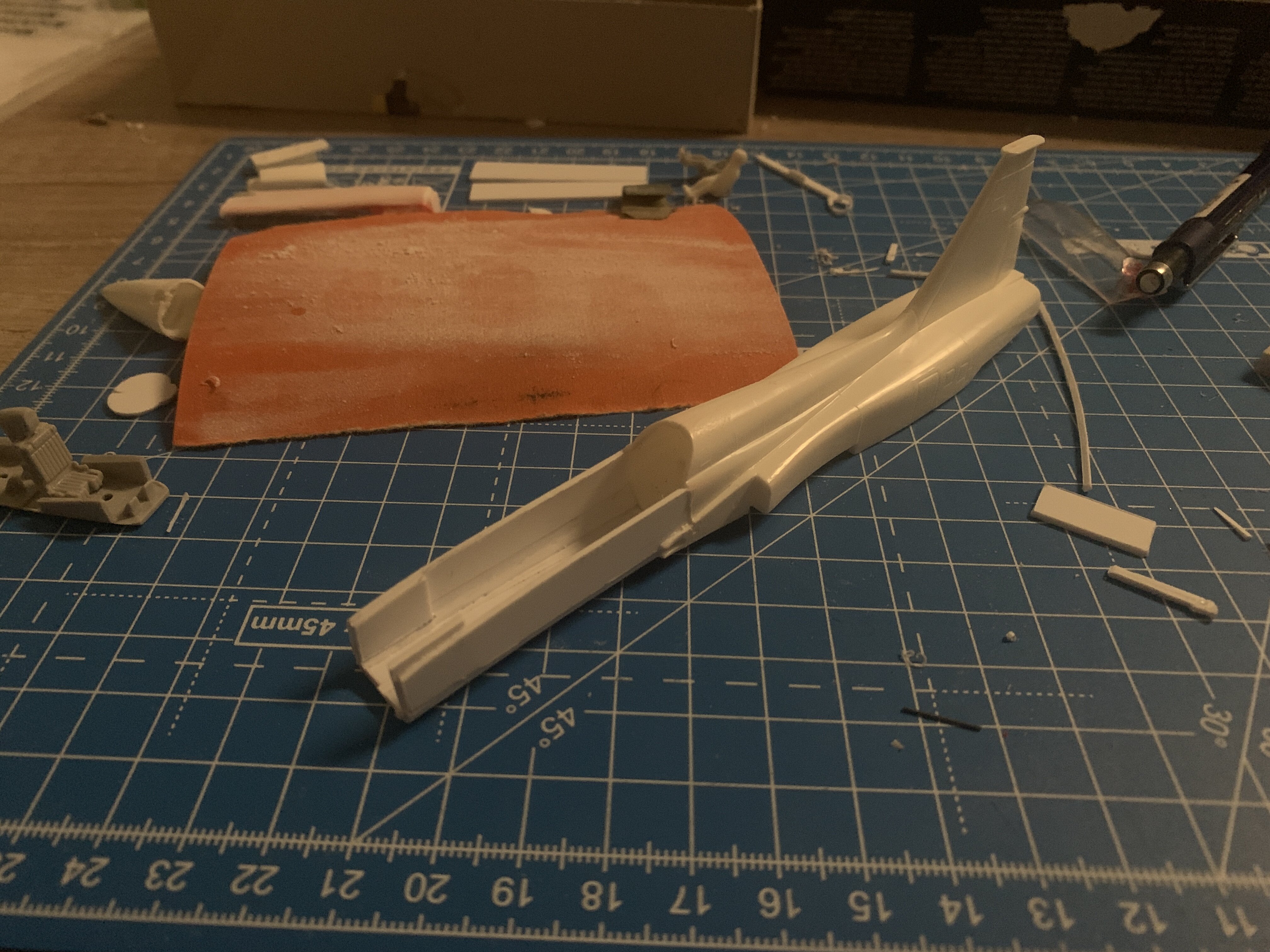

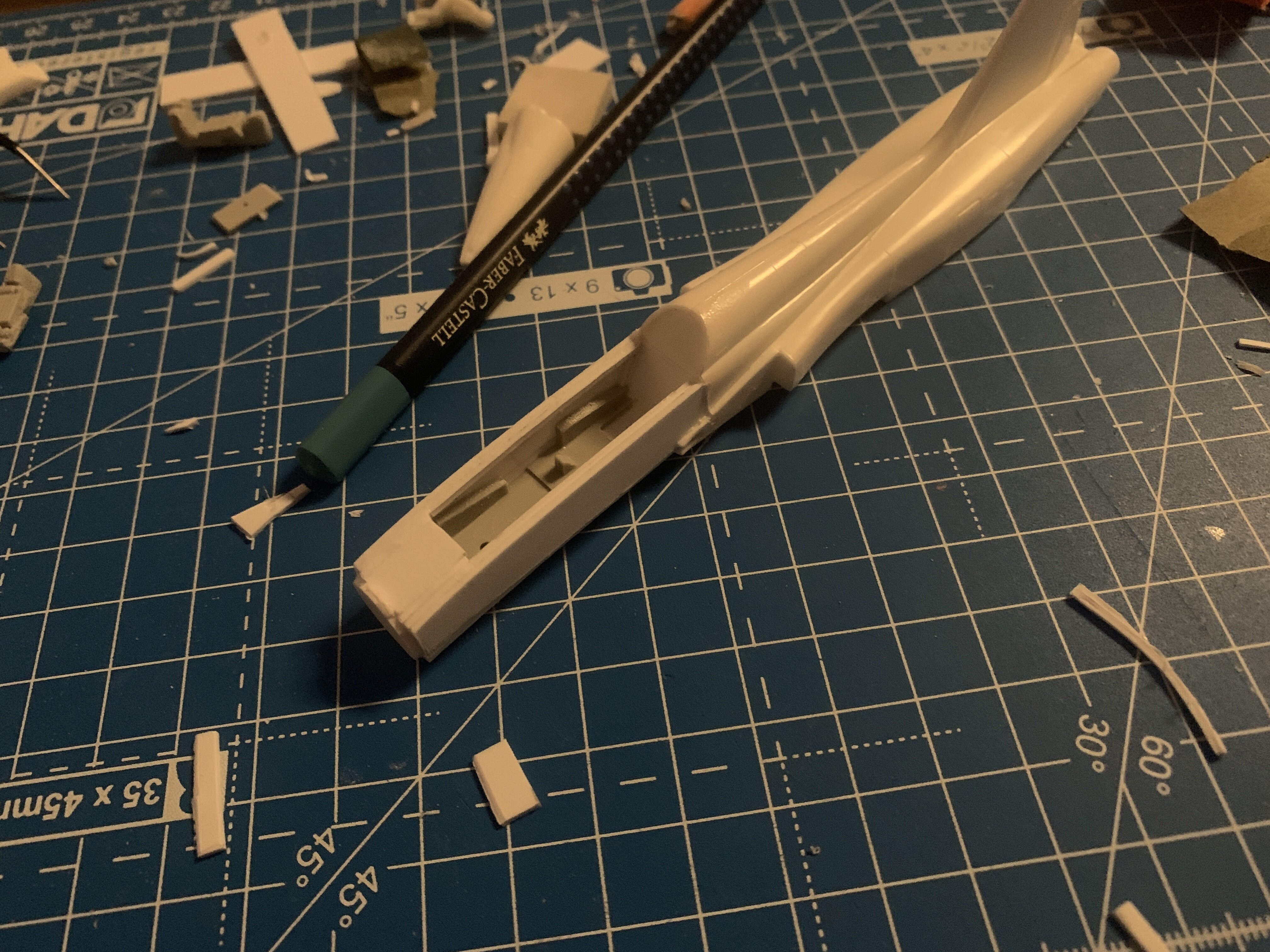

Okay, next phase on the F-5B cockpit section finished.
I’ll have to do a lot of sanding now, and then, the good old panel line scribing. YAY!
A bit better lighting today, so the “detail” is showing better.
On 11/18/2021 at 5:05 PM, Thom said:
Dude, Perfect Plastic Putty!
I squeeze a bit out and apply with a toothpick along the seam or gap, and then wipe with a wet q-tip. Not meant for big gaps obviously, but for wing roots and such it is pretty perfect. And it's water-based, so just add more water to reactivate it.
Thanks @Thom  I'll have to try that out.

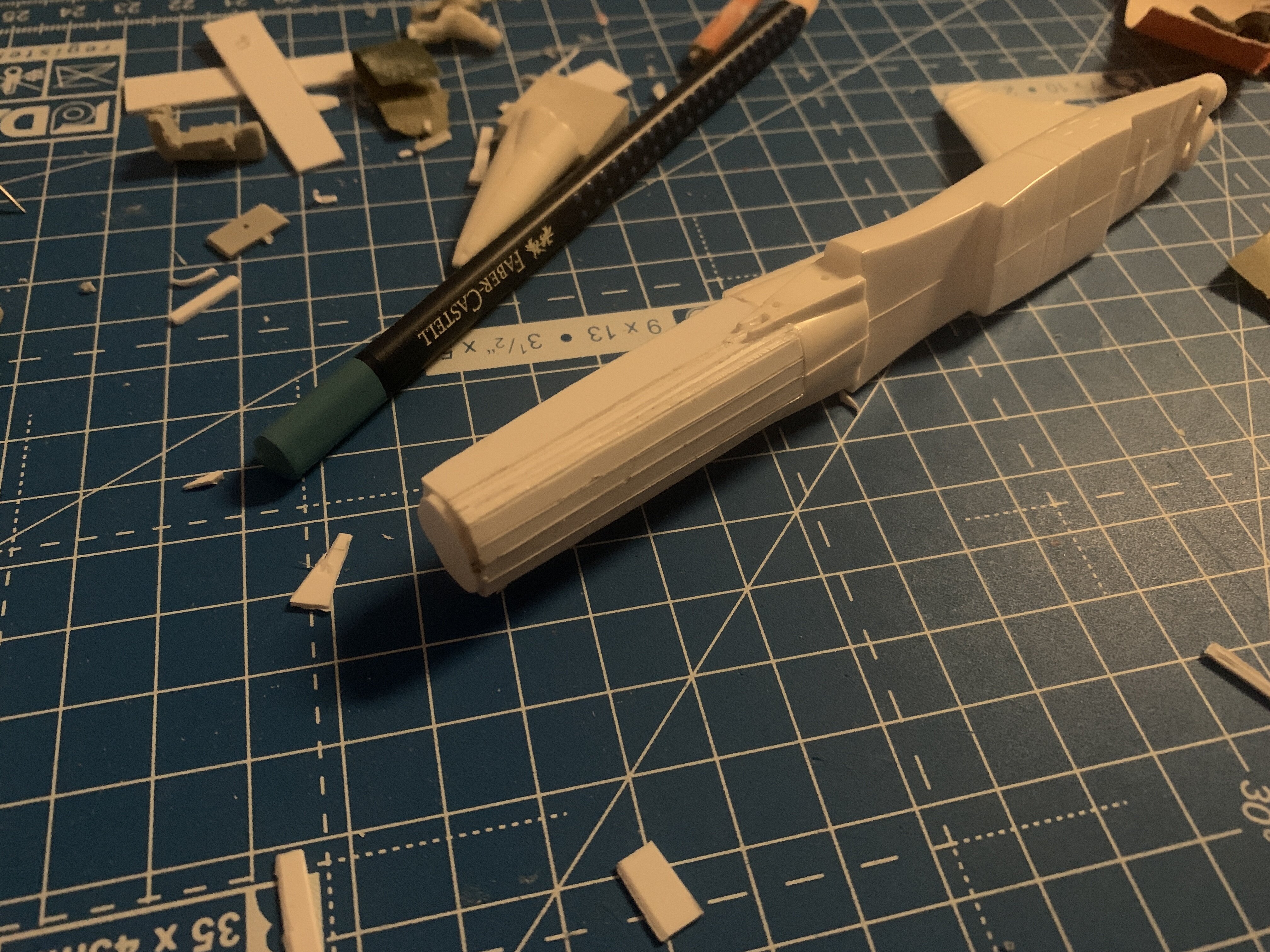

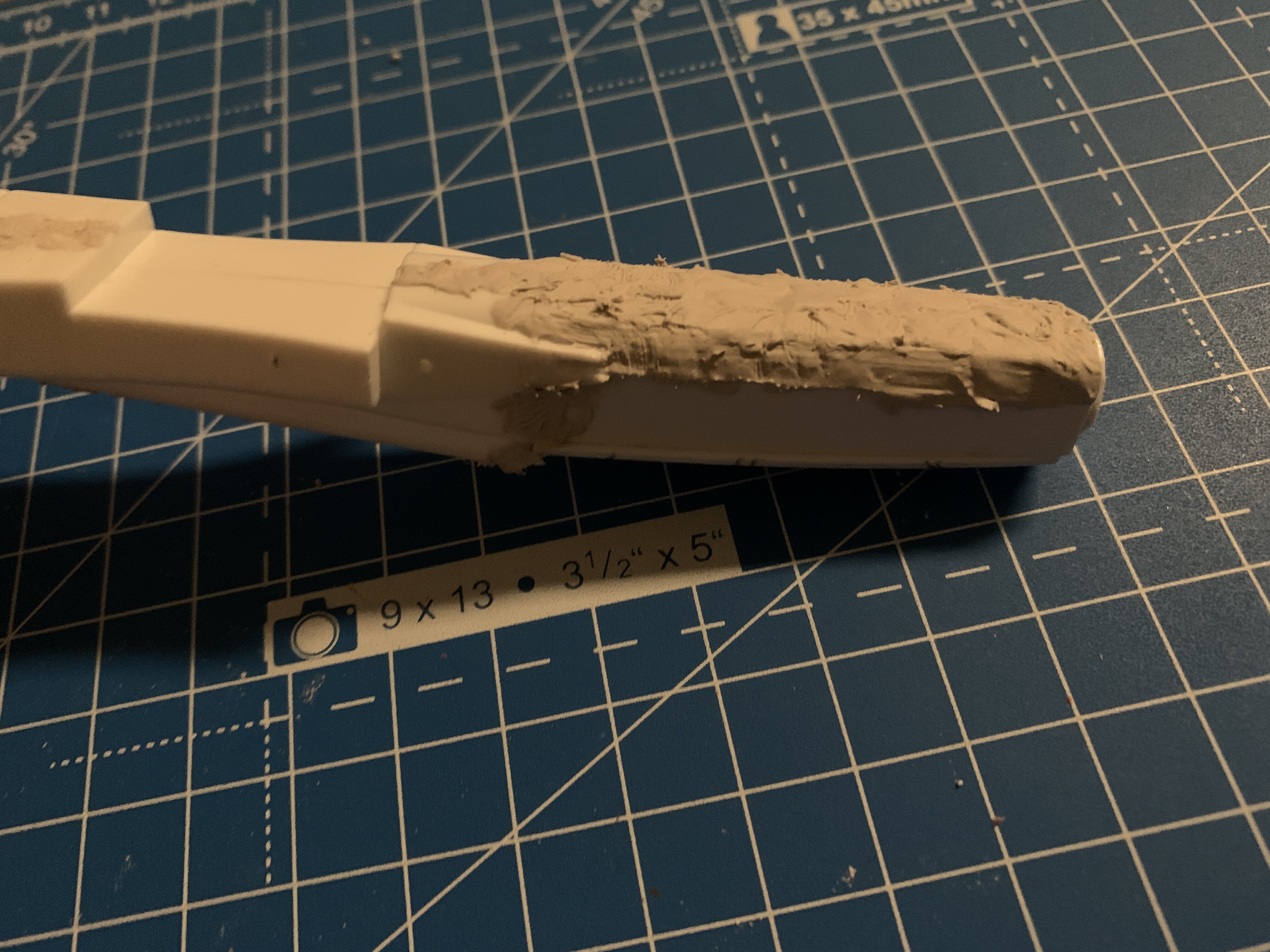

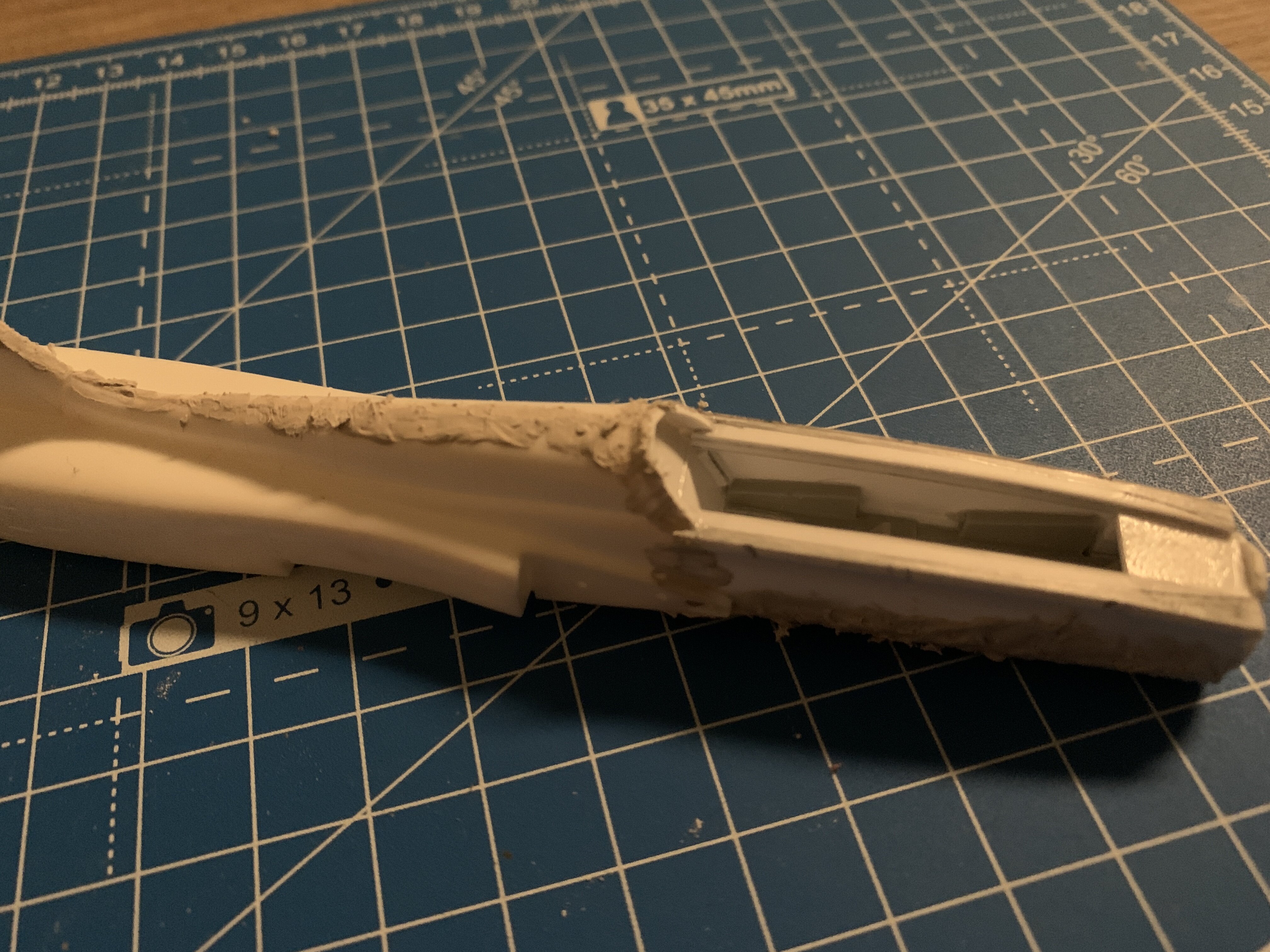

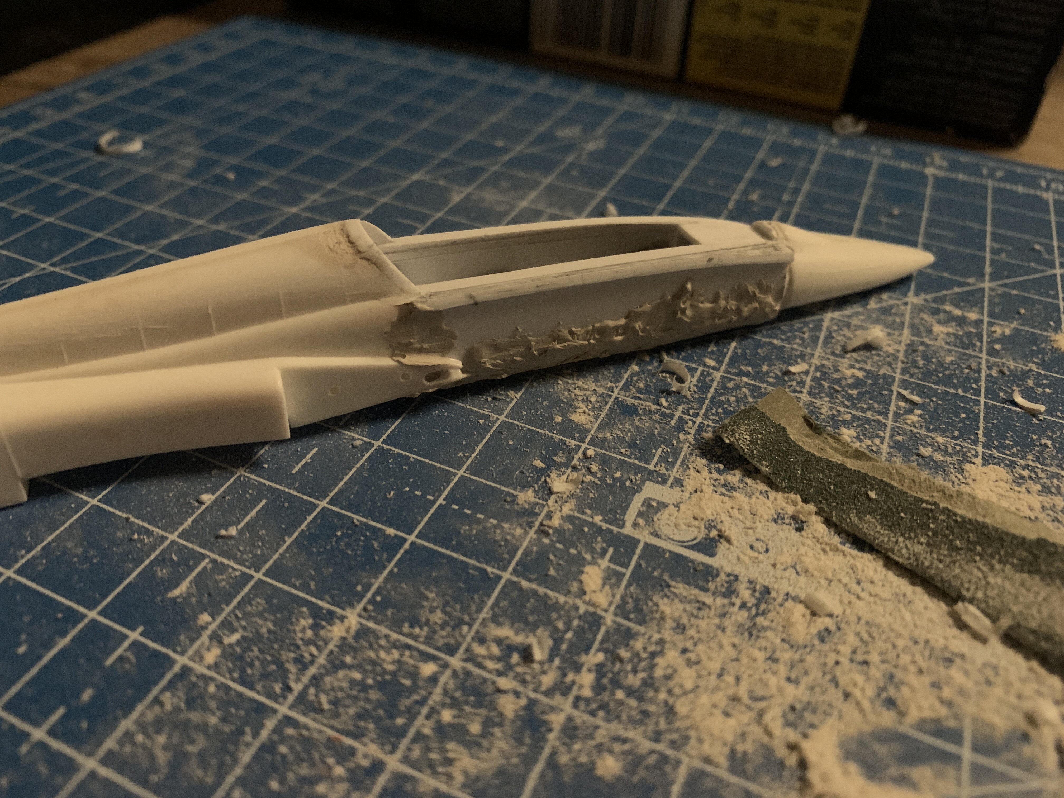

Okay, update on the F5B.
I basically drenched it in Revell putty yesterday and let it dry for ~24 hours.
and today I started to sand away on this like crazy. Uh!
So this is where I am at now.
One side almost done, the other still needs so sandpaper love.
I think I am on a good way here fixing this crappy kit. Lets see how it‘ll turn out.

You're getting a GOOD workout sanding and a good looking fuselage too. -MT

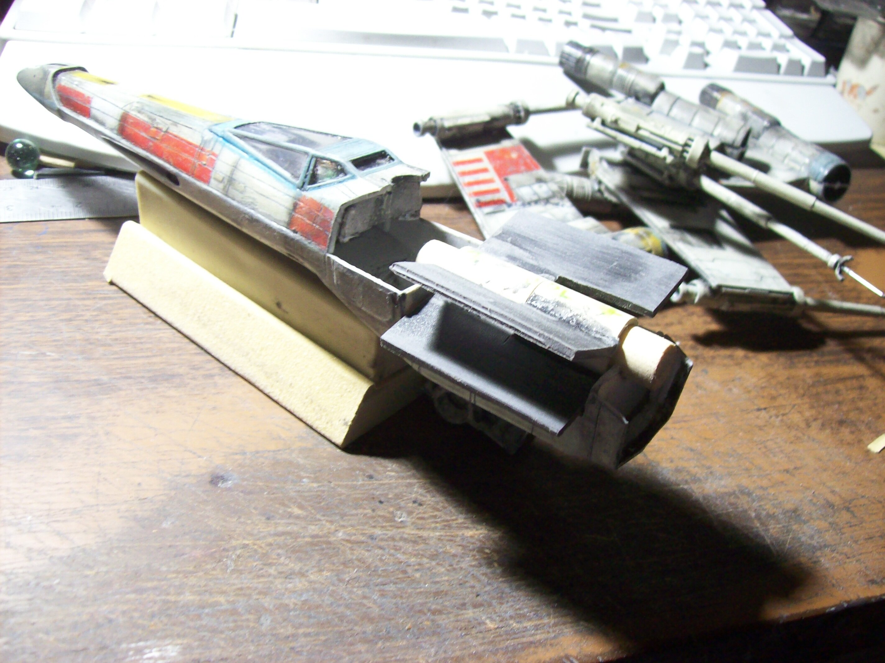

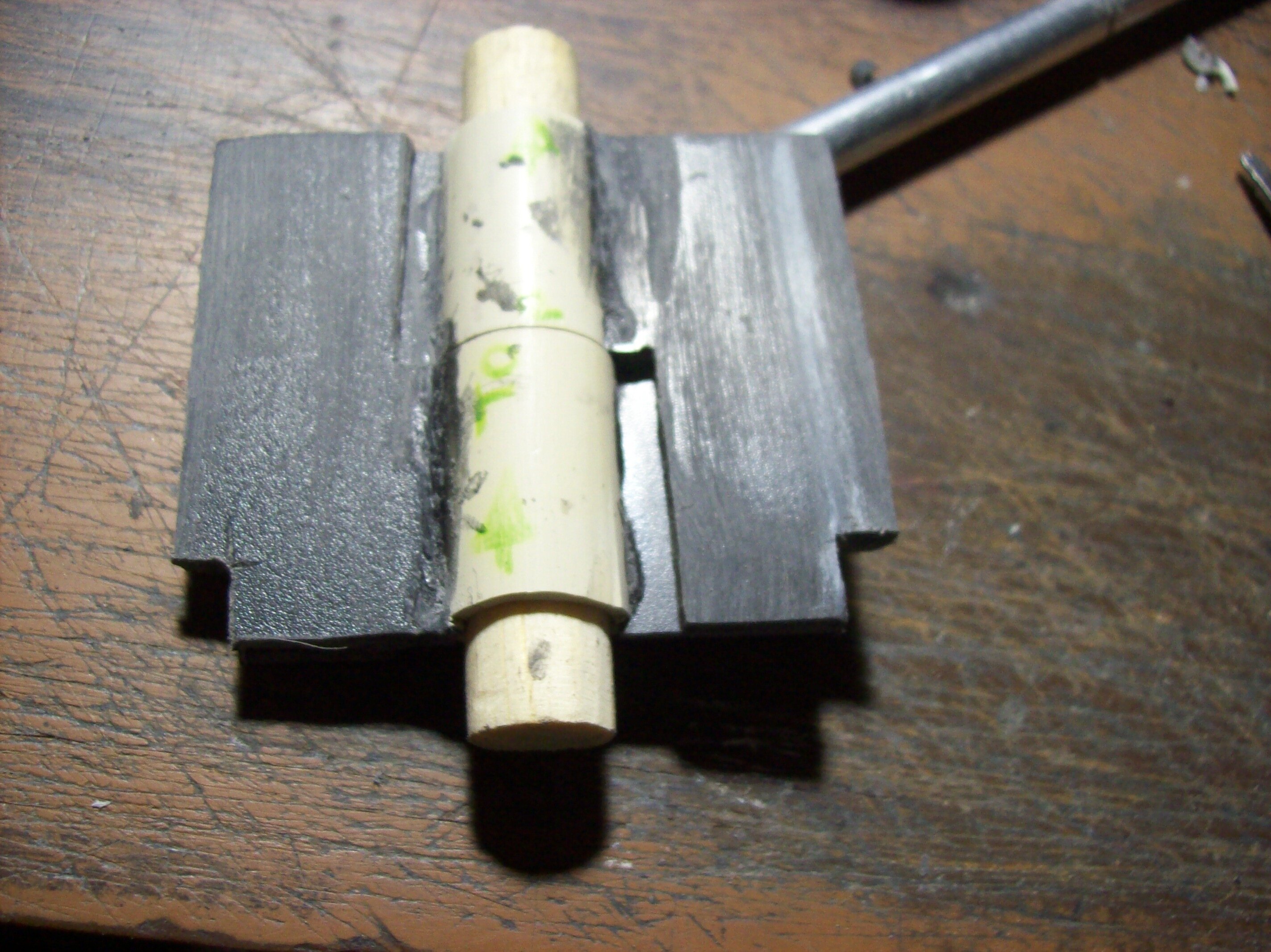

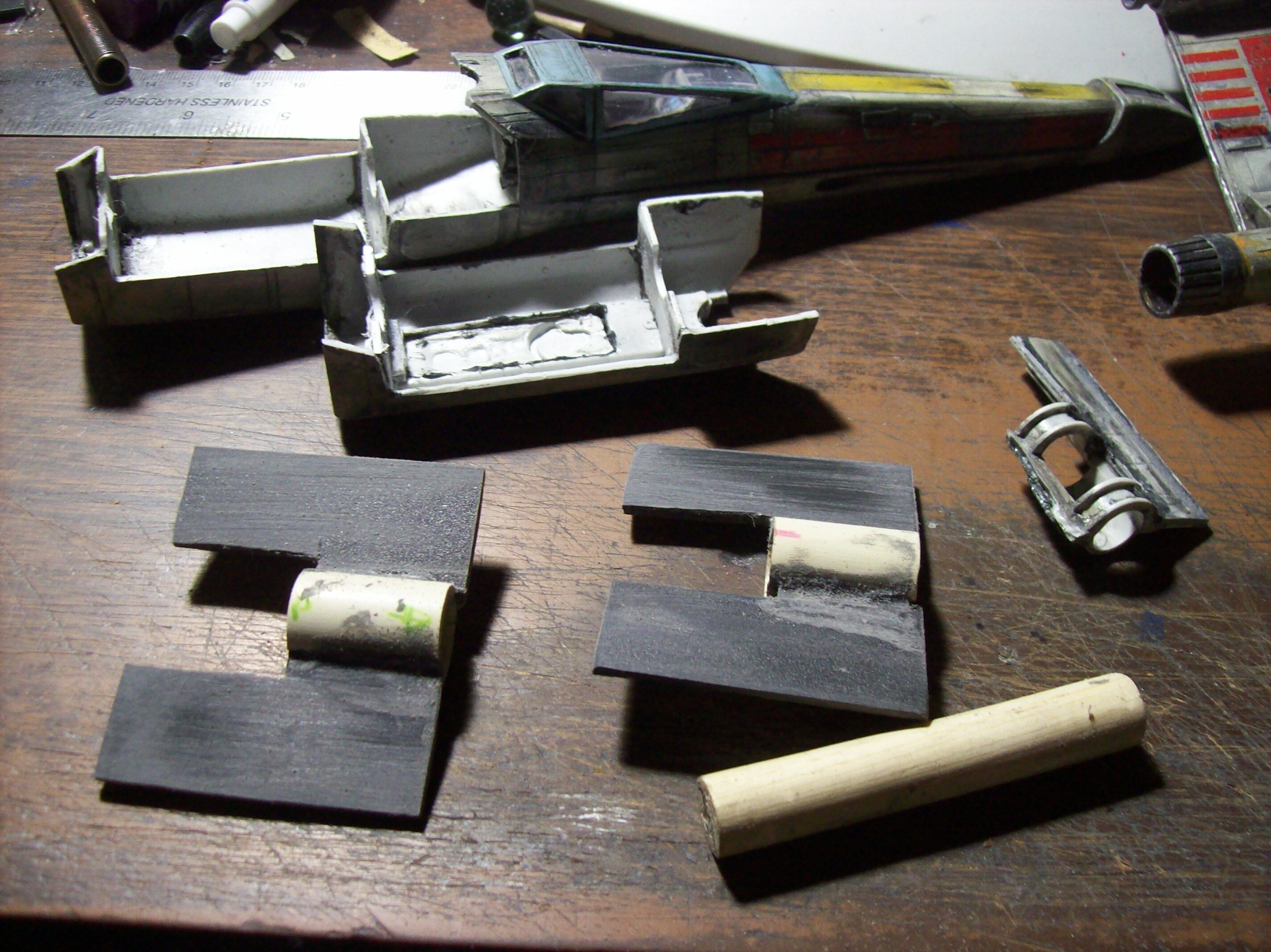

Well... I guess we're going to start 2022 a little early here-

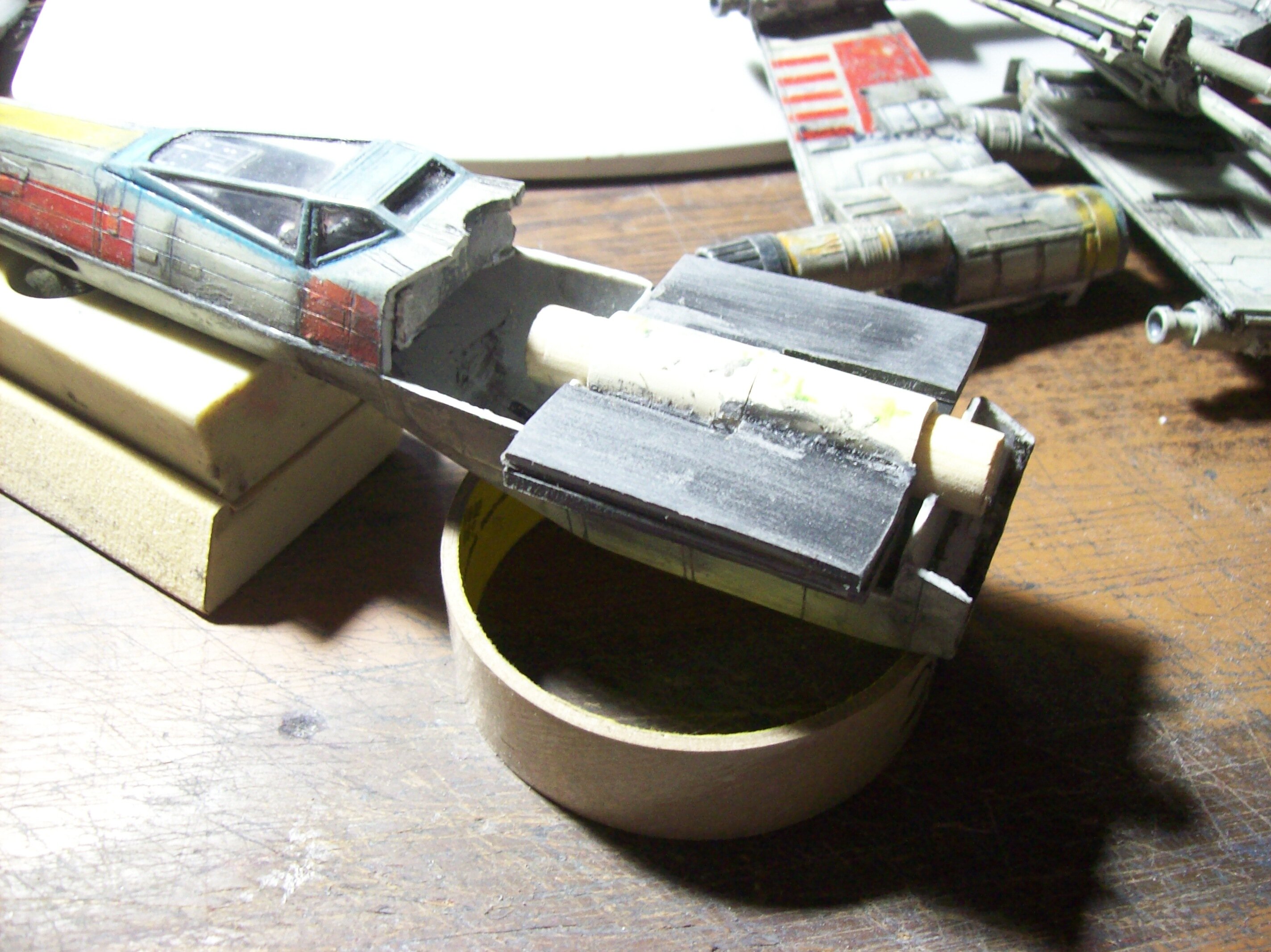

I used High-Density Polystyrene (HDPS) that I culled from an old printer,to make the new wing attachment roots; thwe

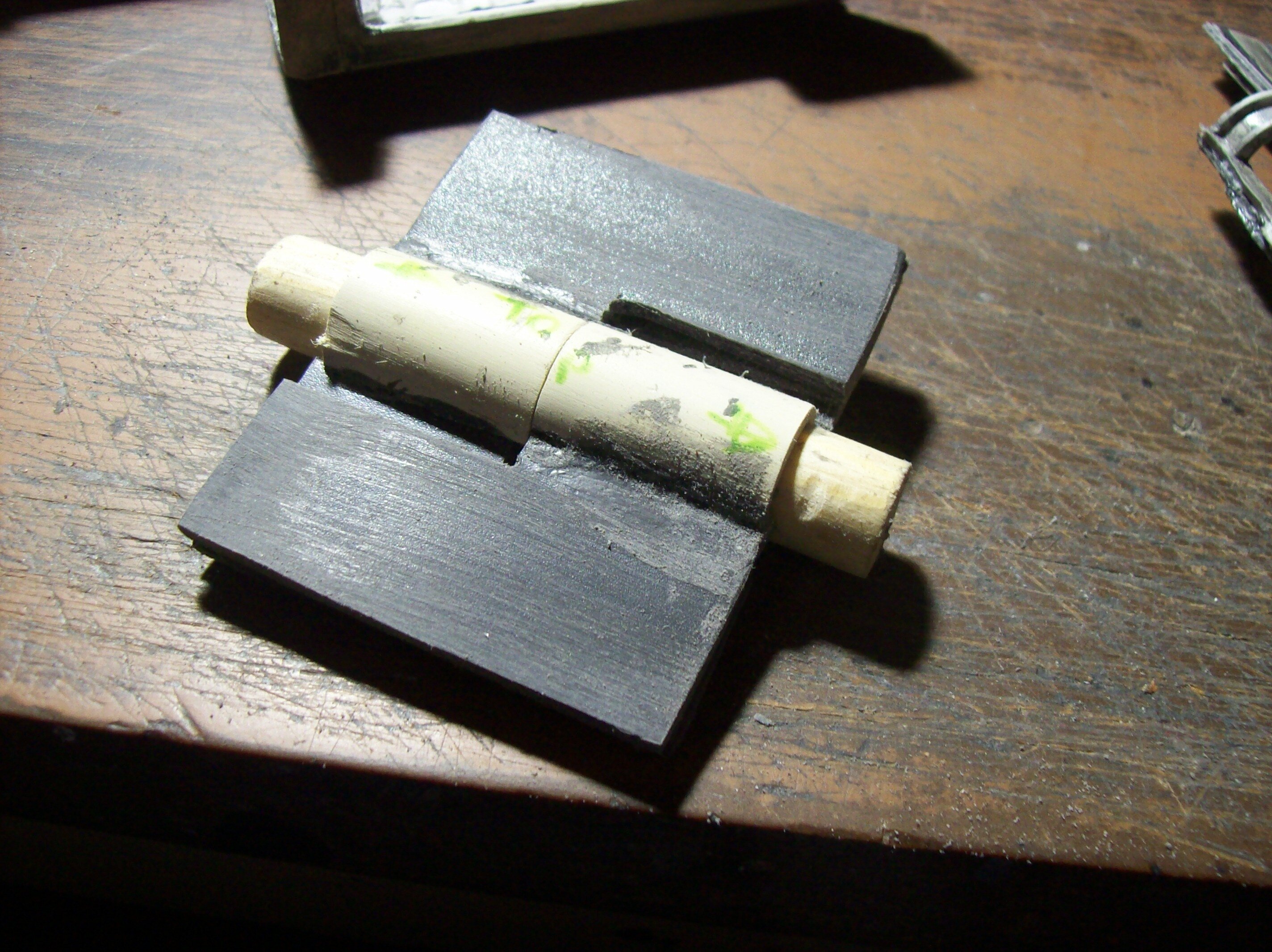

For the main joint, I got a piece of PVC tube and measured and cut it to the length of the entire joint (back interior wall to front interior wall). I then cut it in half and glued each half to a staggered set of wing roots:
The main pin is a hardwood dowel; this was chosen so that instead of splitting the tube (a real possibility, due to the fact that I had to cut slots in either side to accept the wing roots), it would compress instead:

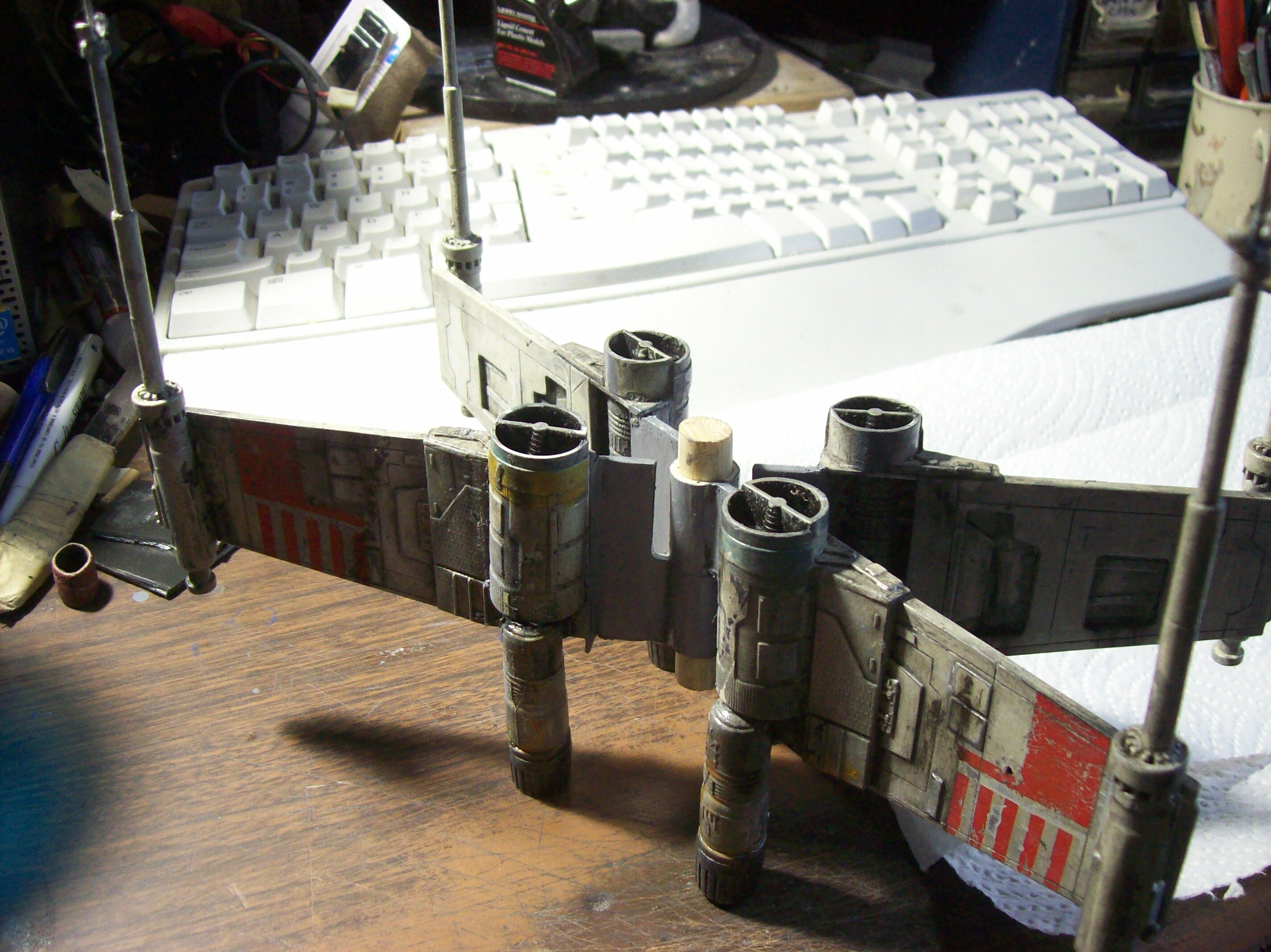

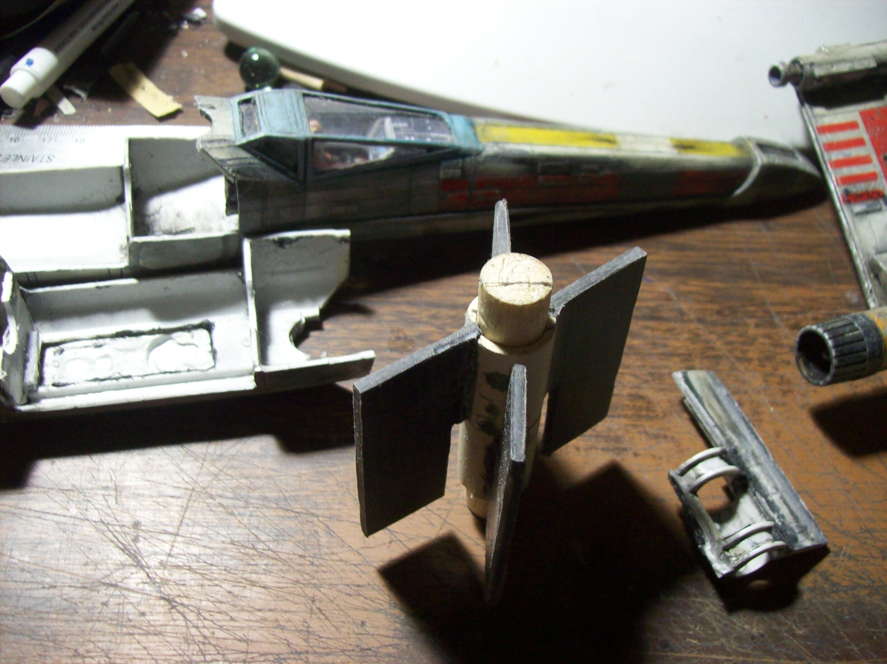

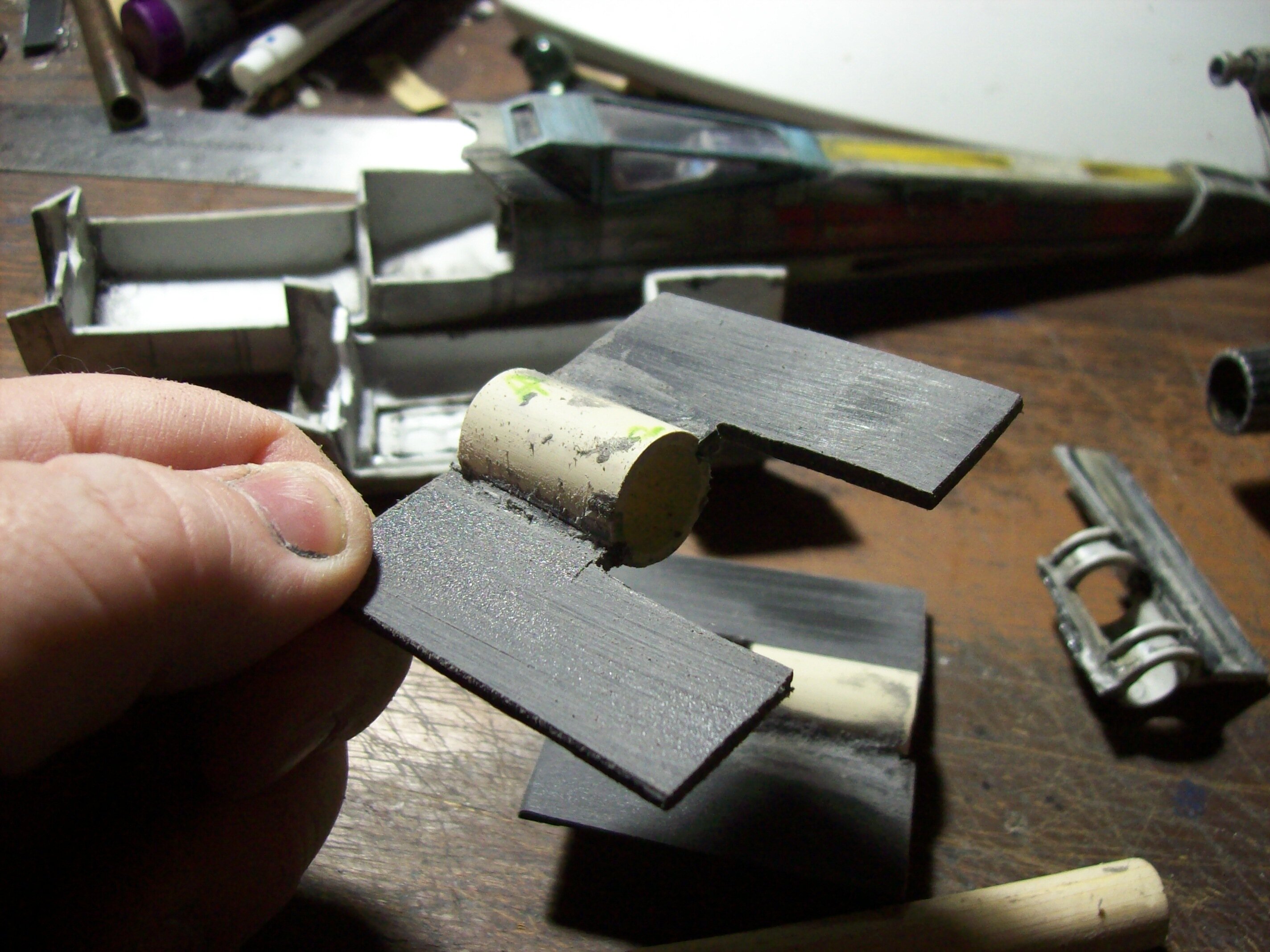

Testing of the new pivot in "X" formation:
Testing of the new piece in both deployed and closed positions (sorry about the washed-out lighting):
100_0689.JPG.40e72a7ac07ac9992f638a3ad4c95b88.JPG   100_0690.JPG.eaf2c9e433a4a1ddb96d52408dd7a3f6.JPG
I then cut slots into the rear of the wing roots to properly mount the s-foils; I had to cut a sizeable chunk out of the area where the wing originally mounted and replace it with a better plastic:

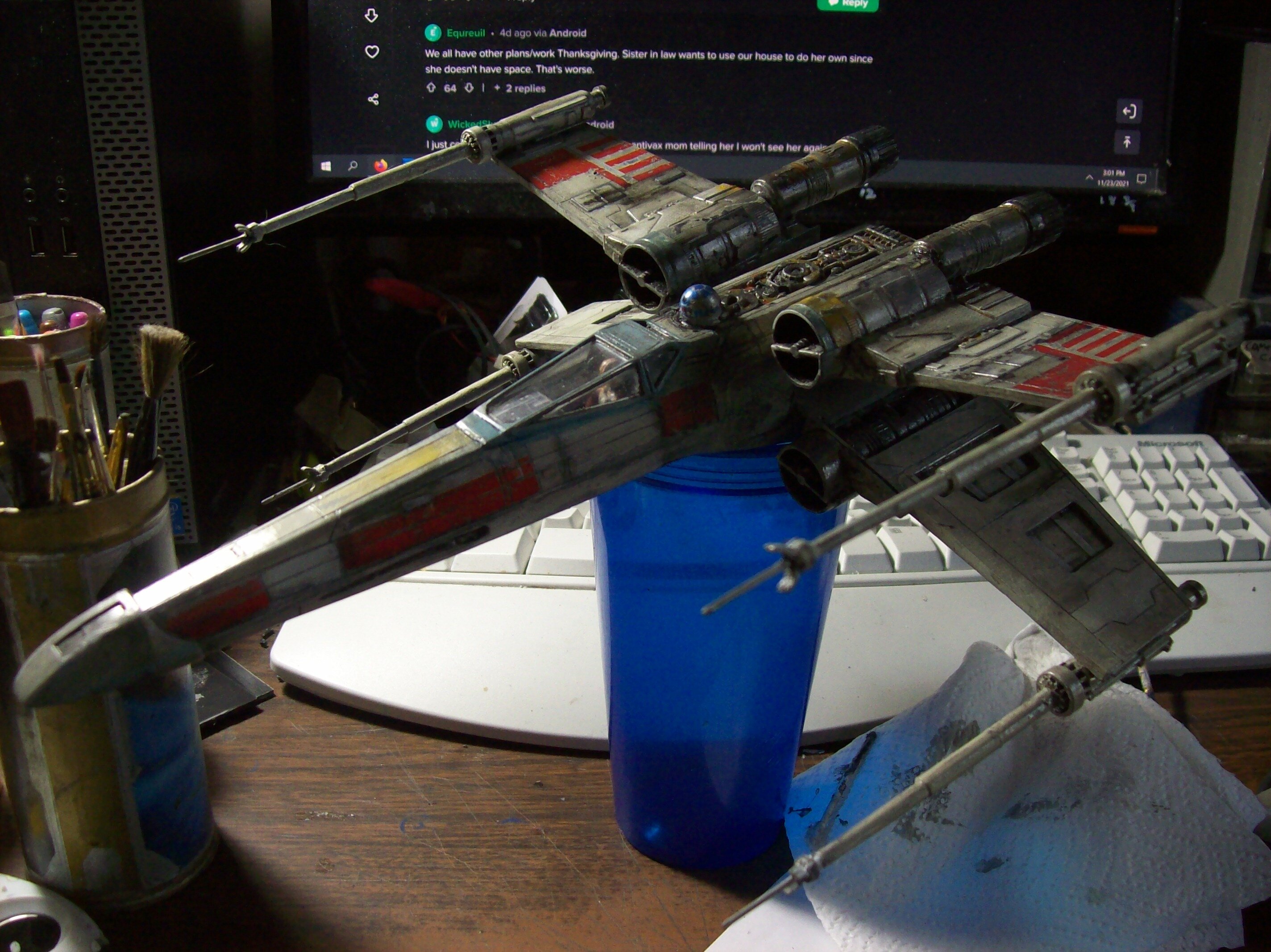

Finally, finished:
The wings cant inward and downward slightly; that was unavoidable, given the work I had to do. The softness of the plastic determined for me that I had to male a few concessions in order to preserve the structural integrity of the craft as a whole. But, at least it's together now, and I'm sure the filming models weren't 100 percent perfect either!
Now: to get Darth's TIE X1 Advanced, and make a diorama...
Stay tuned.
@pengbuzz GREAT save! That was an ingenious fix and creative with the materials too! The force is strong with this one!😁 Now you have a beautiful model for your collection. - MT

@pengbuzz Nice save at the 2021 Buzzer! Just proves you can't keep a good modeller down!

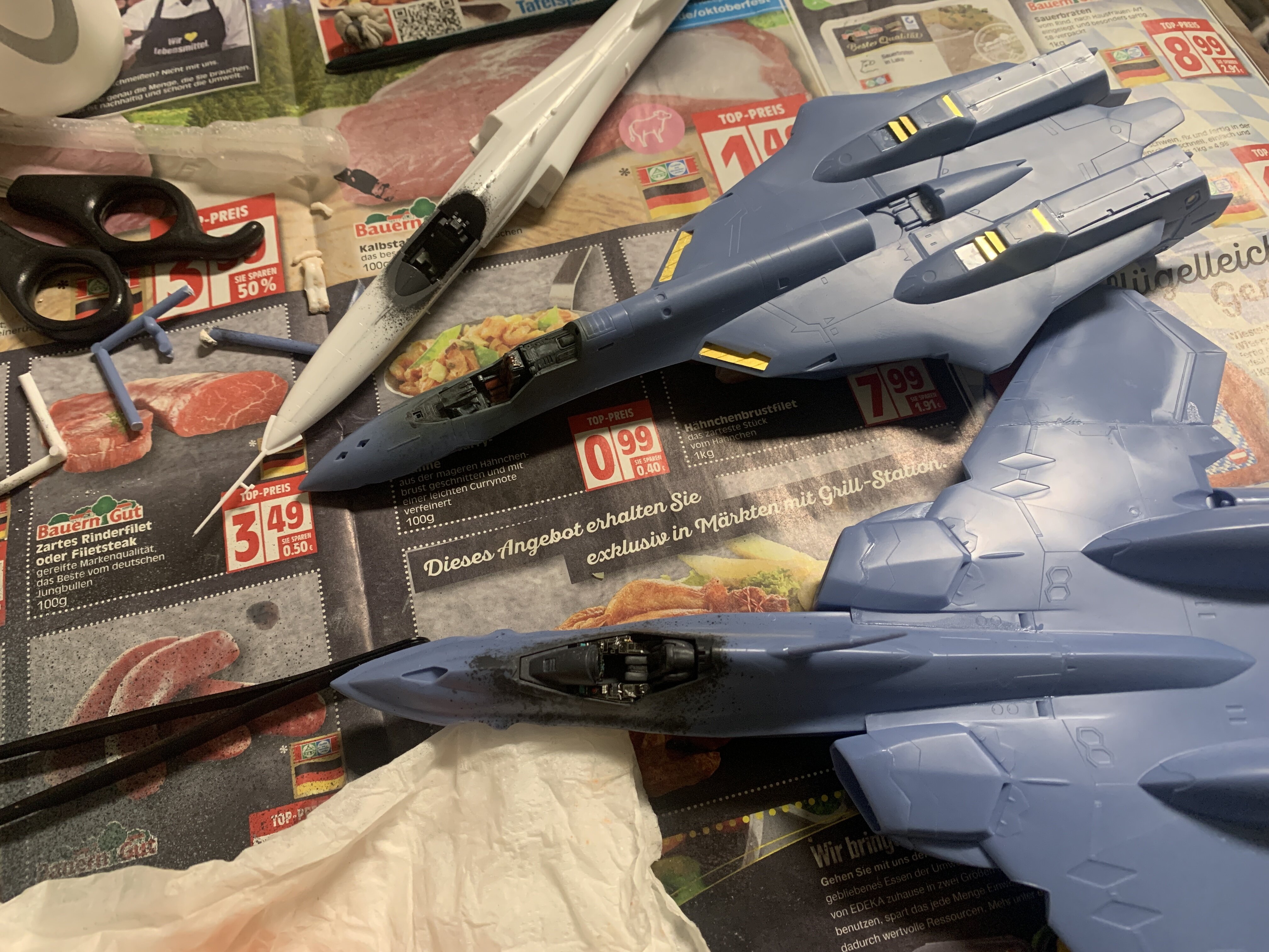

I felt, that I needed a break from the F-5B. So I started building something I have on my kit pile for years now.
I got that VF-19A when it released the first time almost two decades ago. I also got the photo etched set from jasmine models, which is so awesome. I really like it.

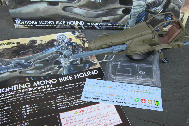

Putting my first HOUND together today. This is the first time I have ever built a kit made by WAVE, I must say I am very impressed of how every thing fits together, locks in places, only one little part was a royal pain otherwise a pleasure to build. B))
Painting & Decals to follow plus some pics.
Fingers crossed a Hiro figure becomes available.

@Urashiman Yes, mental health is important!😁 That is a great looking photoetch set!
@505thAirborne What series is that from? I'm not familiar with it?

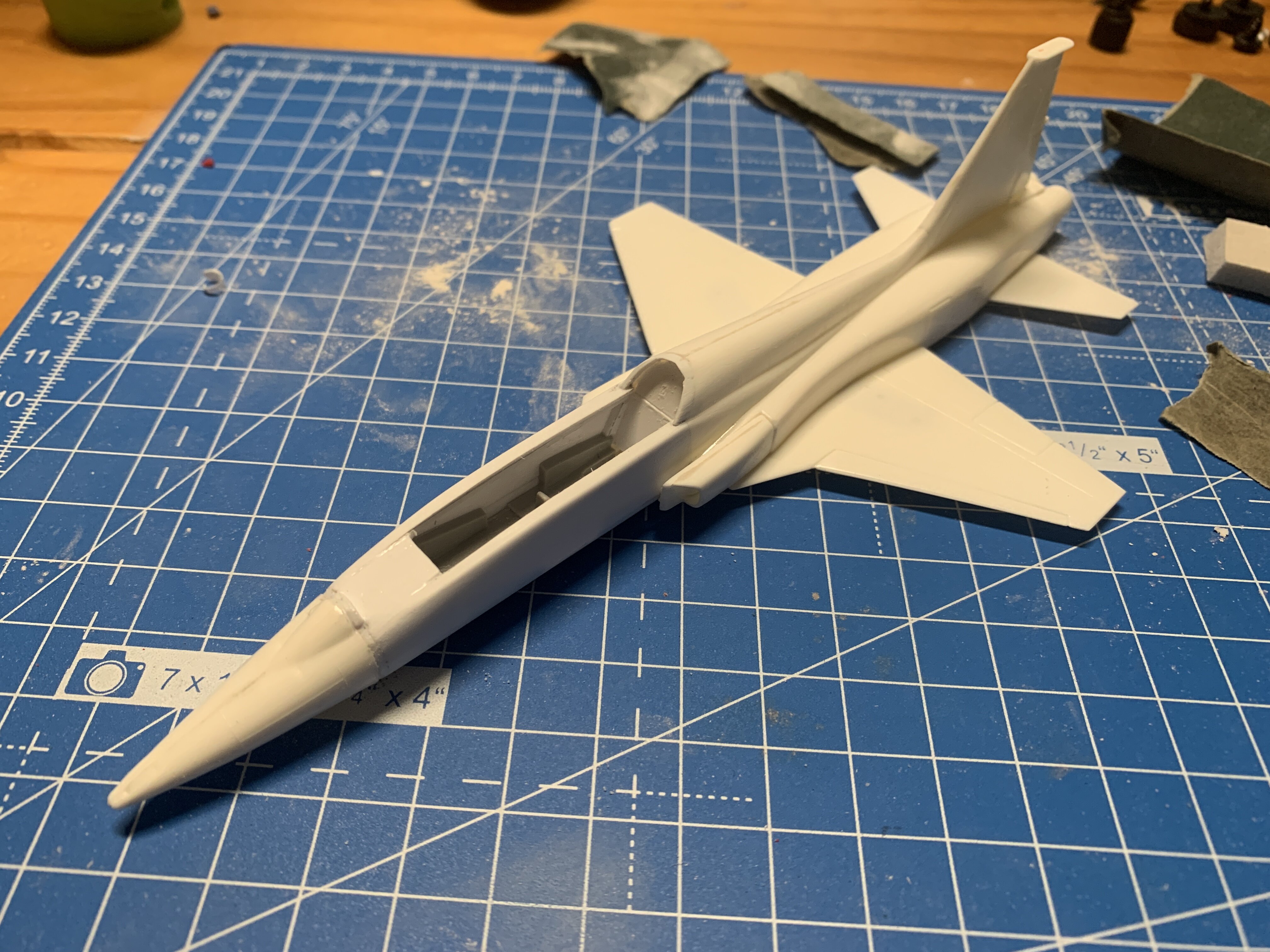

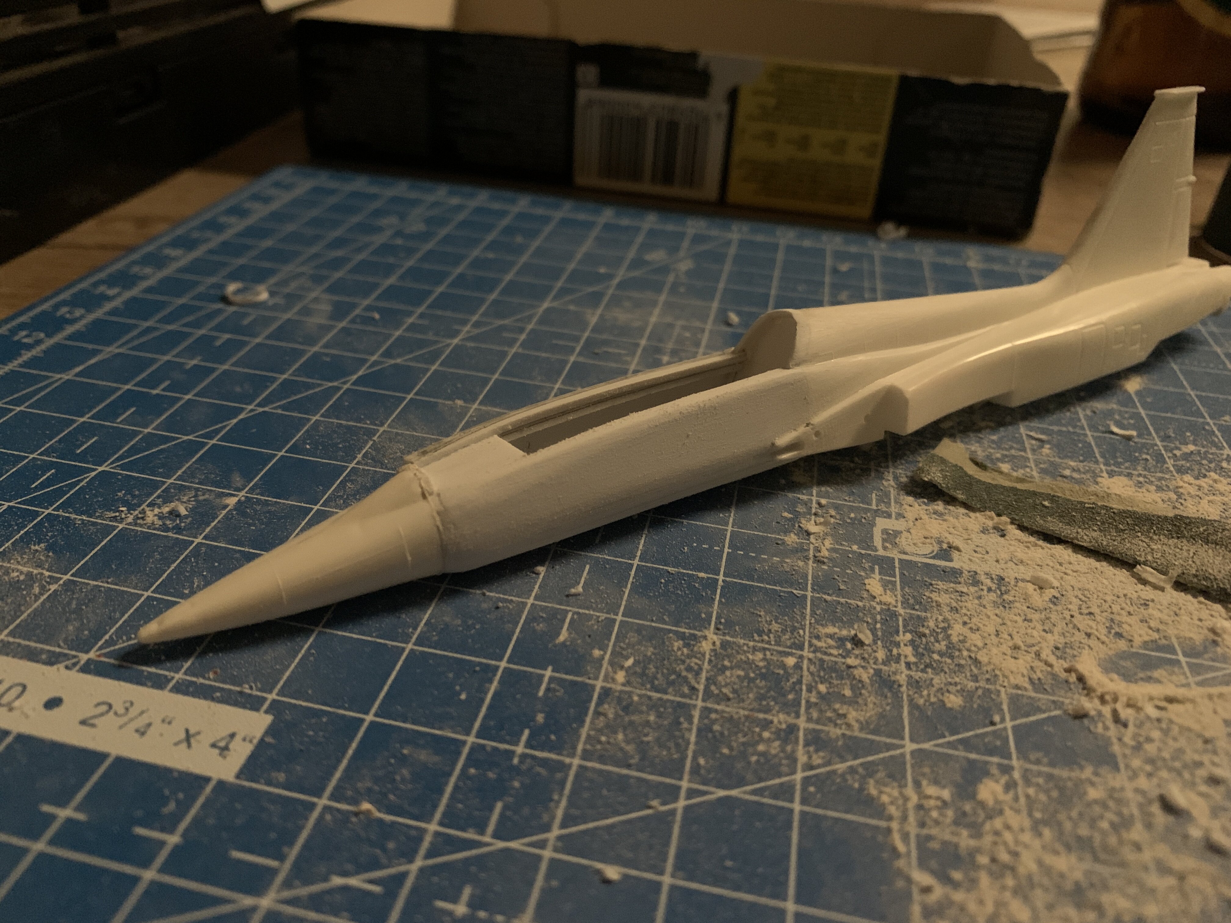

IT‘S ALIVE!
Okay… I think the F-5B is alive and kicking again.
Still need some panel line scribing but, it looks okay now.

@505thAirborne That bike looks so cool, I'm drooling. Wave does have good quality, I have enjoyed building a couple things by them. I also really like their plastic, it is totally different than other model brands. Kind of hefty.

@505thAirborne Ah yes, "Venus Wars". I loved the organic looking vehicles from that in lineart I saw. I don't remember if I saw the movie or not. That is a COOL looking model kit! It almost looks like it would be a possibility today. - MT
