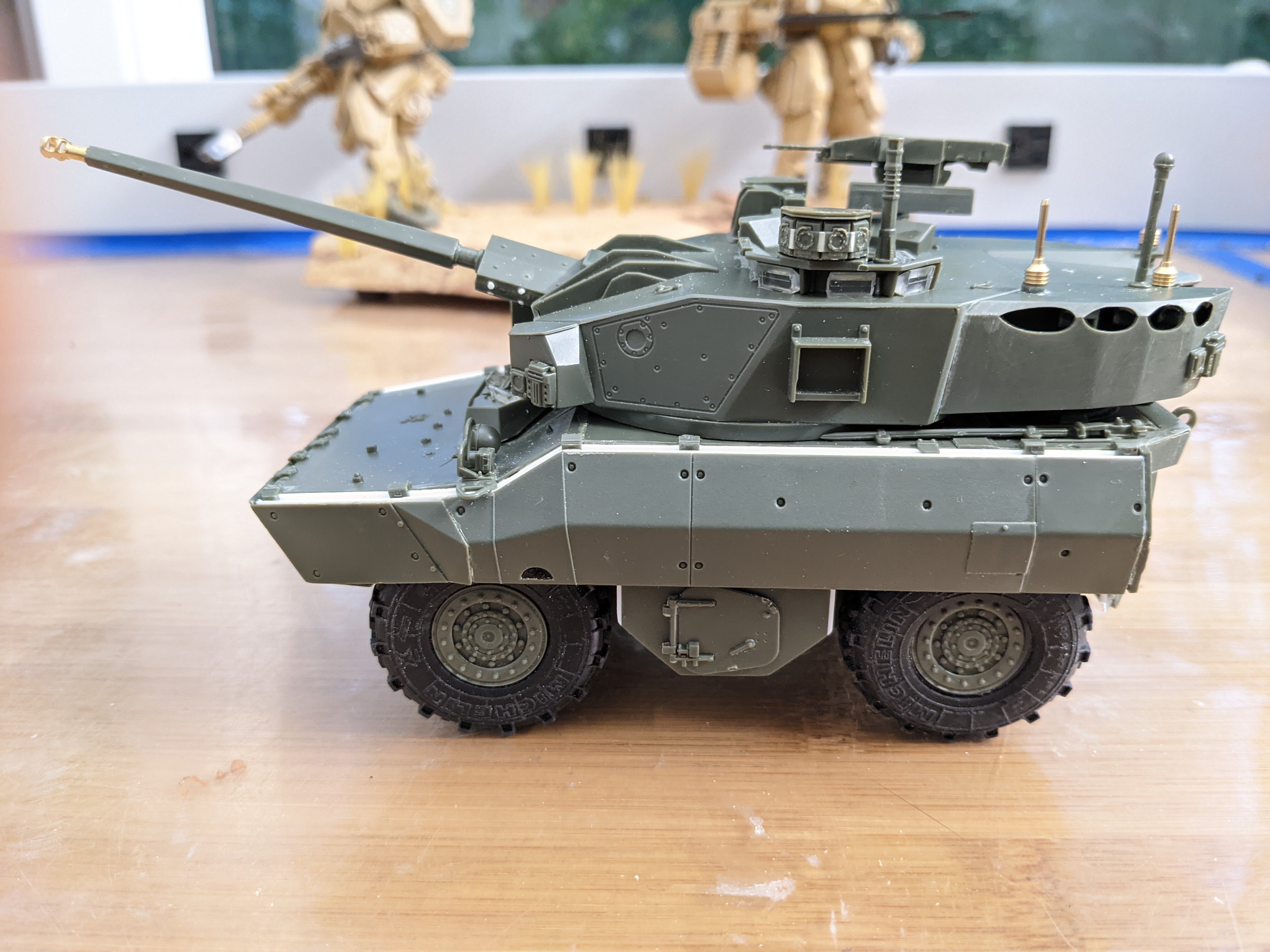

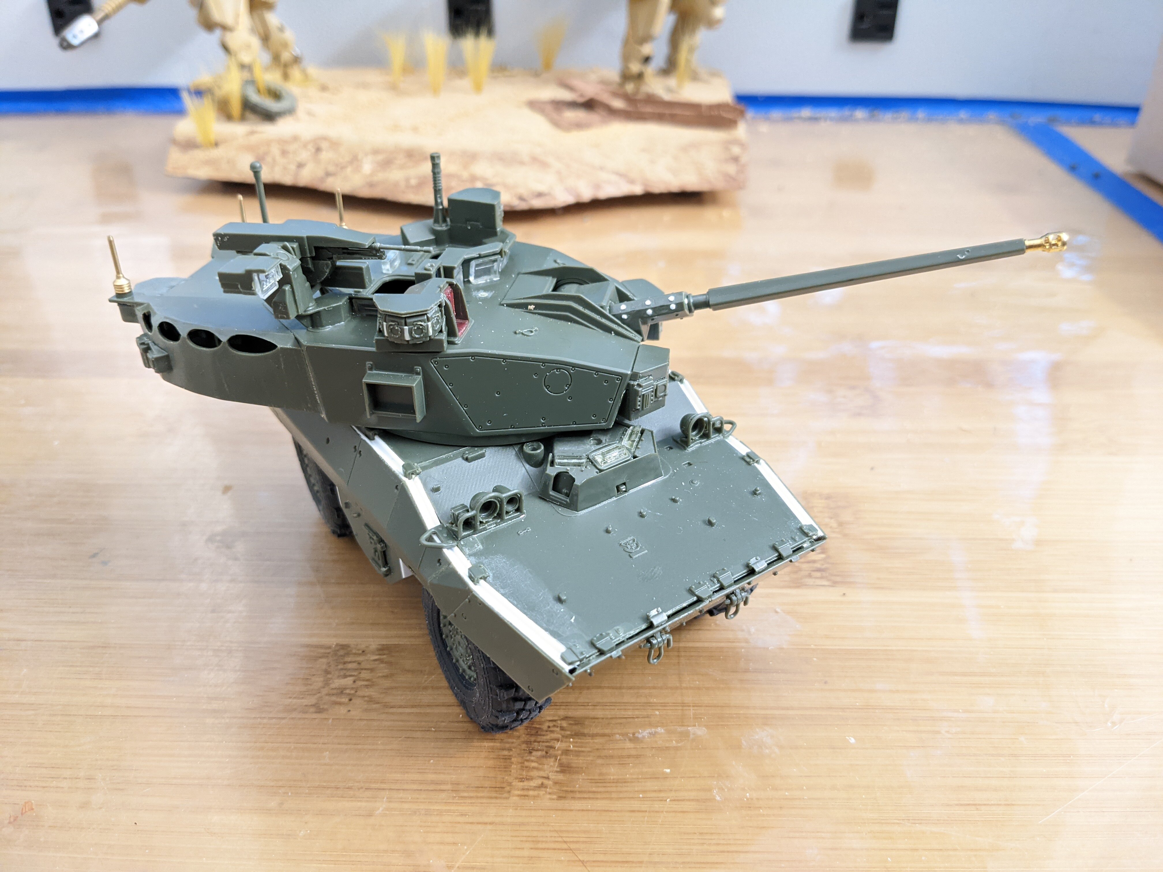

electric indigo Posted October 31, 2021 Posted October 31, 2021 @MechTech The turret looks a tad large for the body. But I don't know anything about tanks... _ I collected my photos of the V-Siren Mortar Headd in a new Flickr album: V-Siren Quote

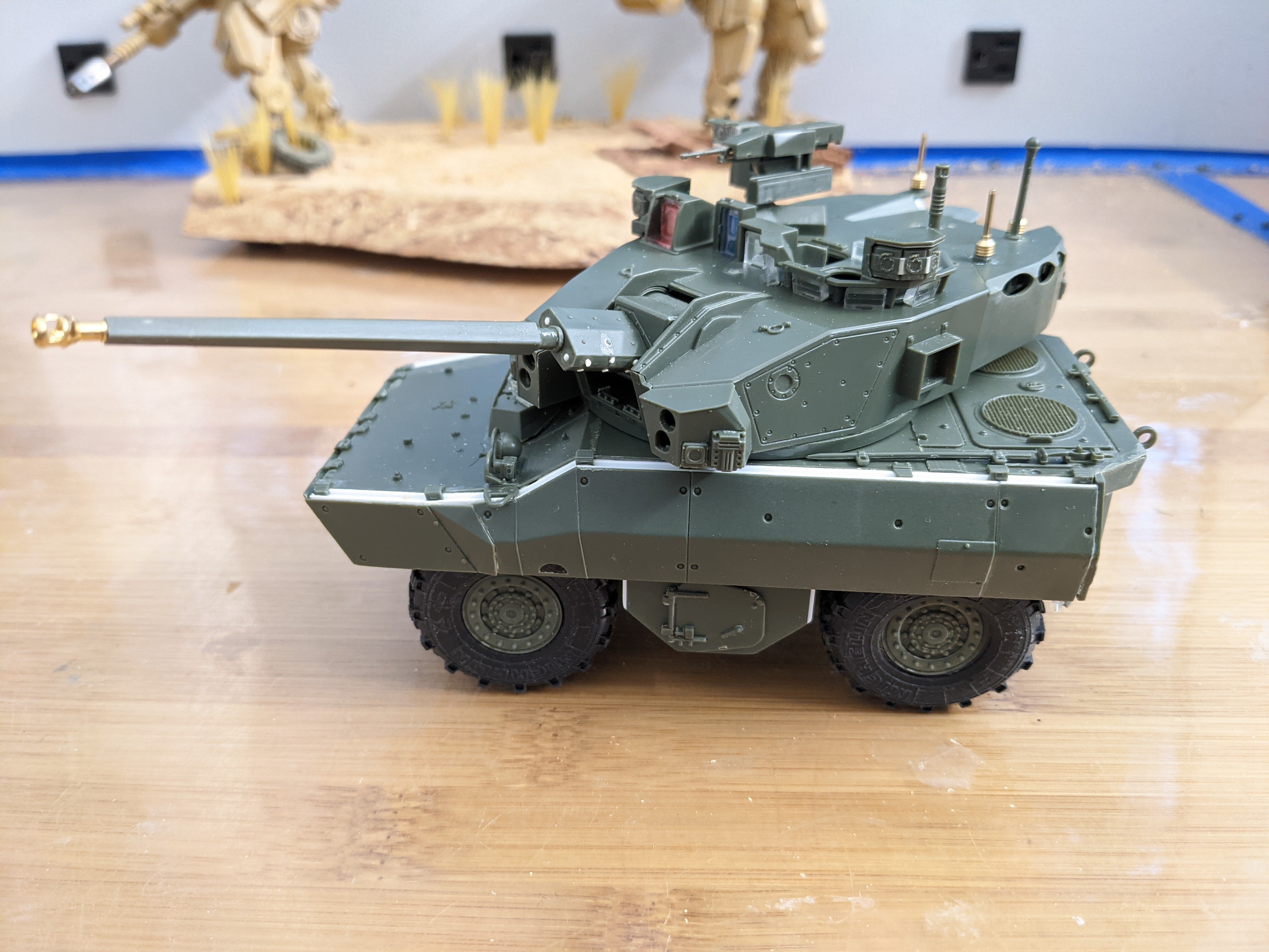

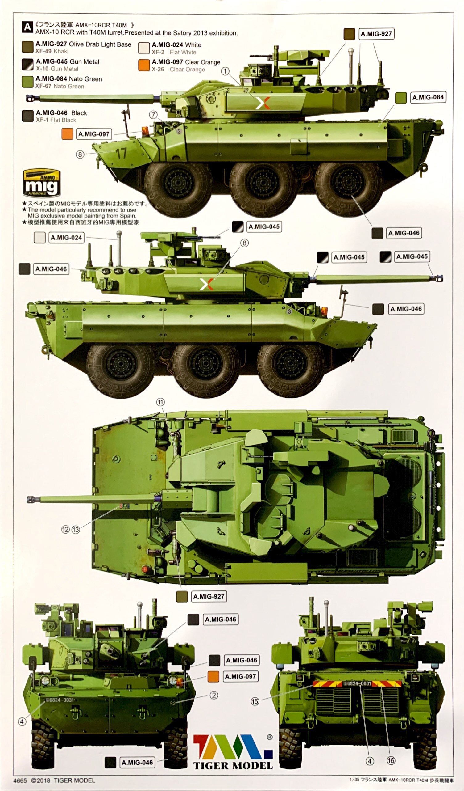

GMK Posted November 1, 2021 Posted November 1, 2021 @MechTech - quick one, what kit is that French 4x4 vehicle you’ve got there? TIA. Quote

MechTech Posted November 1, 2021 Posted November 1, 2021 1 hour ago, GMK said: @MechTech - quick one, what kit is that French 4x4 vehicle you’ve got there? TIA. It is actually the Tiger Model AMX-10RCR T 40M (pictured) after I chopped and channeled it to reduce the size. It's about the same dimensions of a light tank. I made it closer to the width of a LAV-25, but shorter. This vehicle never went into production, it was a demo vehicle. A similar turret was used on the new French armored cars. @peter A Mercedes with a light turret huh, interesting.  My model is armored with a lightweight turret. So it looks bad, but not as bad as it looks. Would I take a corner with it at high speed? Thankfully its not real, so no one has to worry about it!🤣 - MT Quote

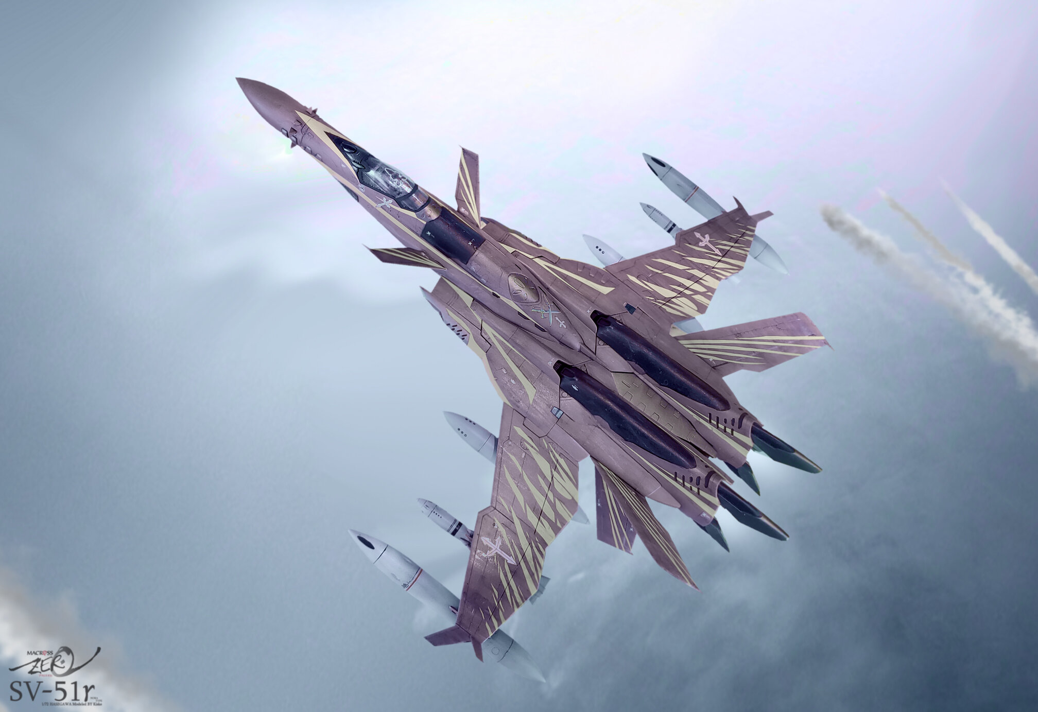

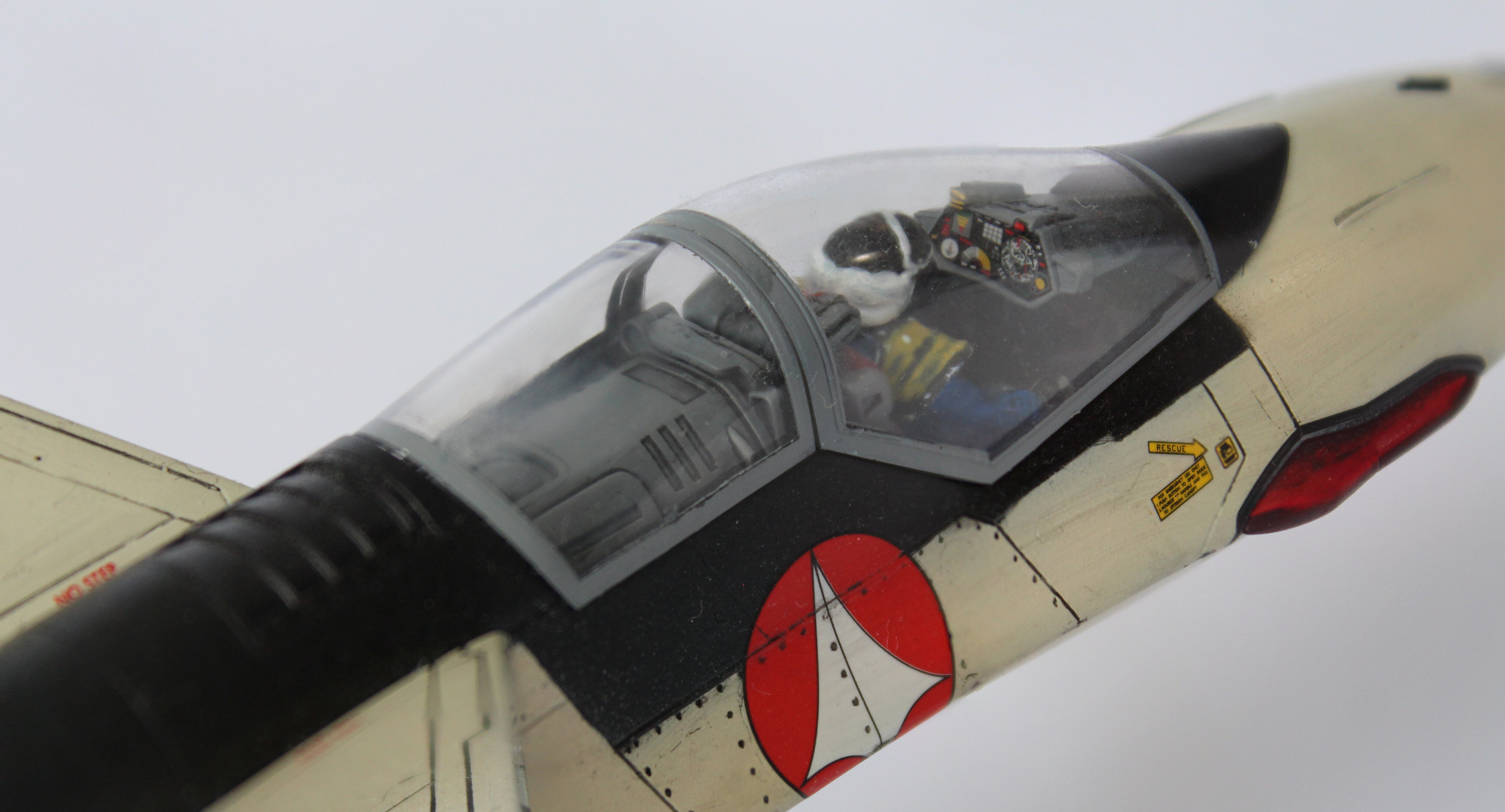

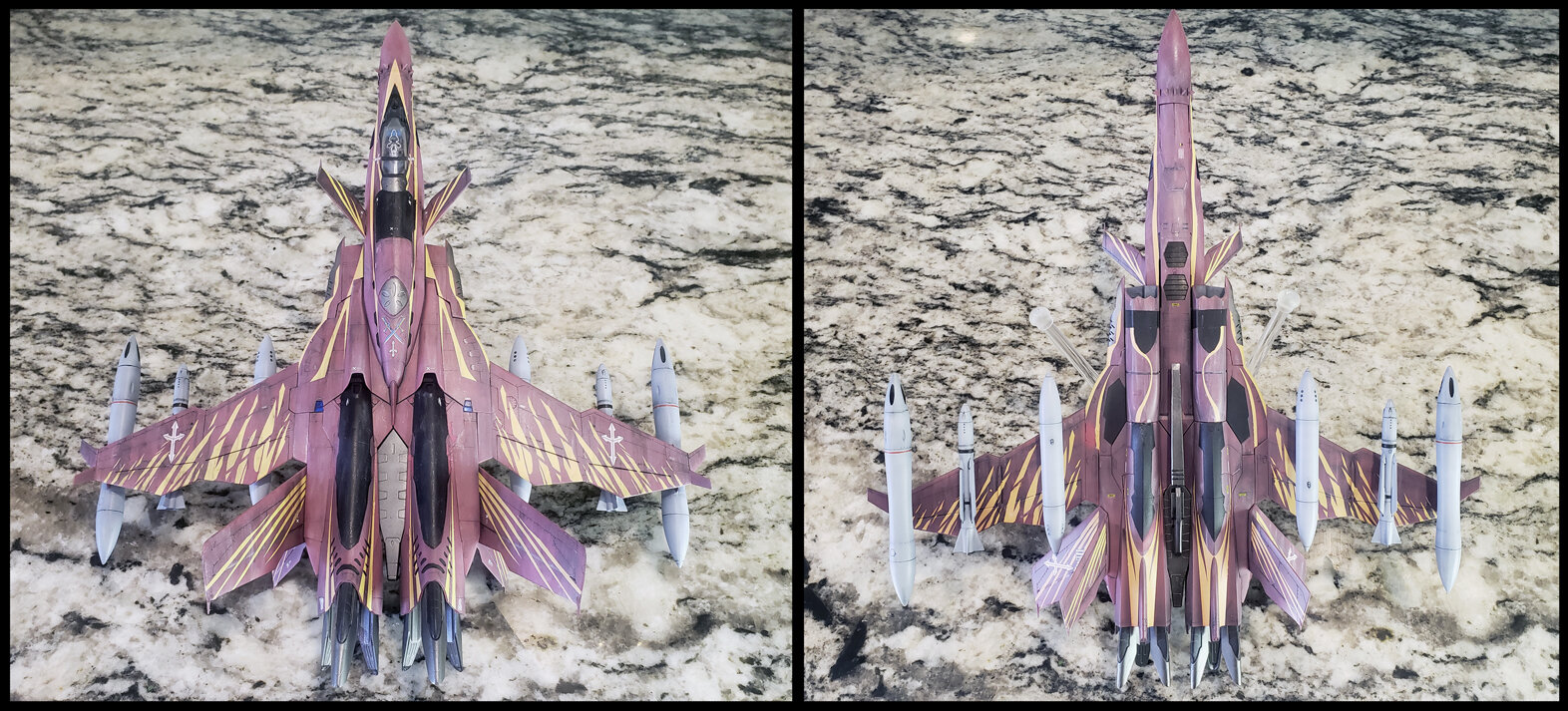

Rock Posted November 6, 2021 Posted November 6, 2021 Officially OFF the workbench! Many defect but, I think I did alright in blending them together with the weathering. See if you can find the 30+ painted yellow touchup on the decals I had to do after chipping them when removing my masking. 😮 Difficulty in making the canopy clear on this on after the decal's application. Tried the Testors "Wet Look" Lacquer... had horrible issues with bubbles forming on the parts during curing. Back to poly urethane clears for the next one. Quote
CrossAir Posted November 6, 2021 Posted November 6, 2021 18 minutes ago, Rock said: Officially OFF the workbench! Many defect but, I think I did alright in blending them together with the weathering. See if you can find the 30+ painted yellow touchup on the decals I had to do after chipping them when removing my masking. 😮 Difficulty in making the canopy clear on this on after the decal's application. Tried the Testors "Wet Look" Lacquer... had horrible issues with bubbles forming on the parts during curing. Back to poly urethane clears for the next one. I don’t see any defect, only a damn good looking sv51 in fighter mode! Quote

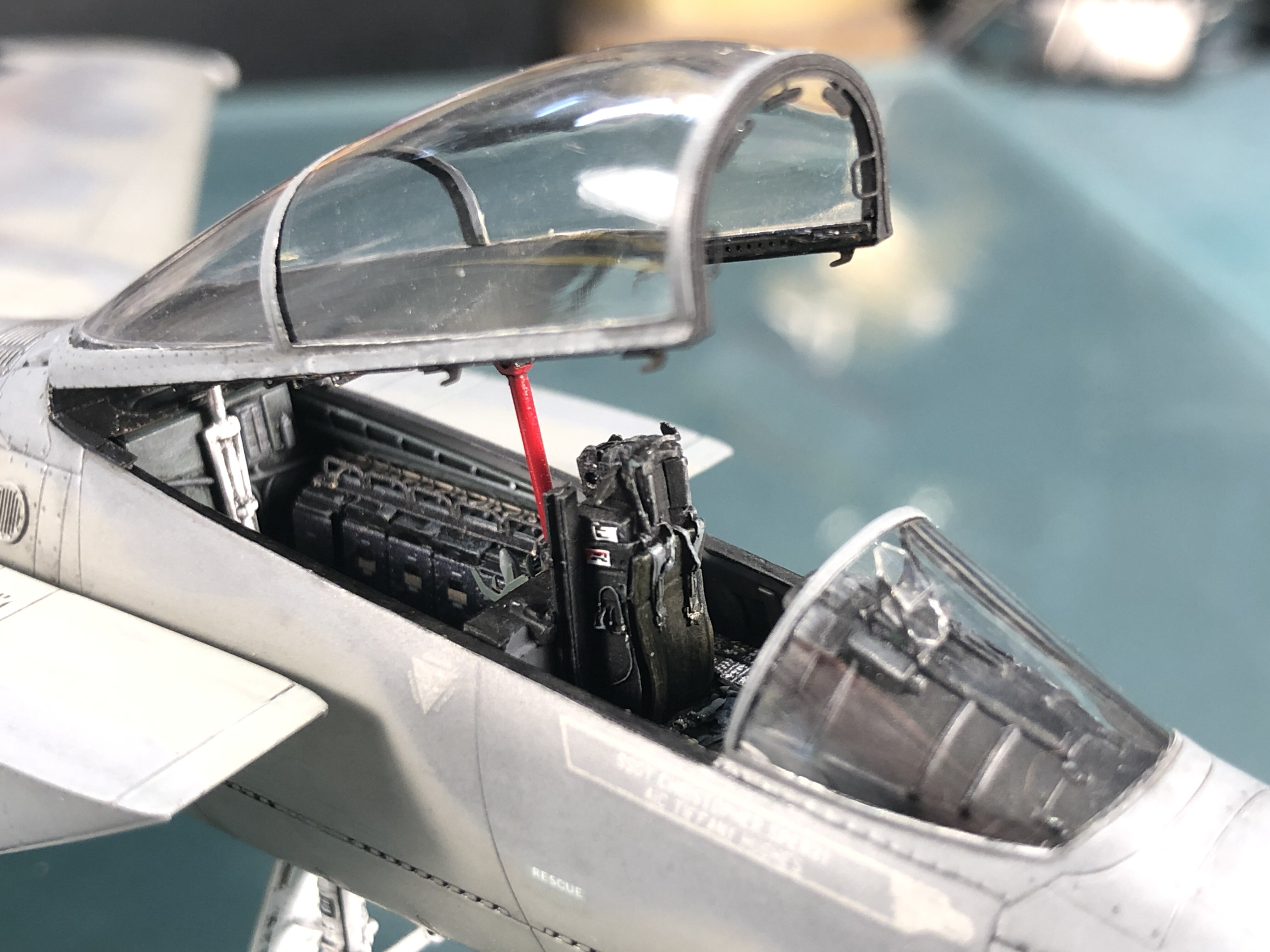

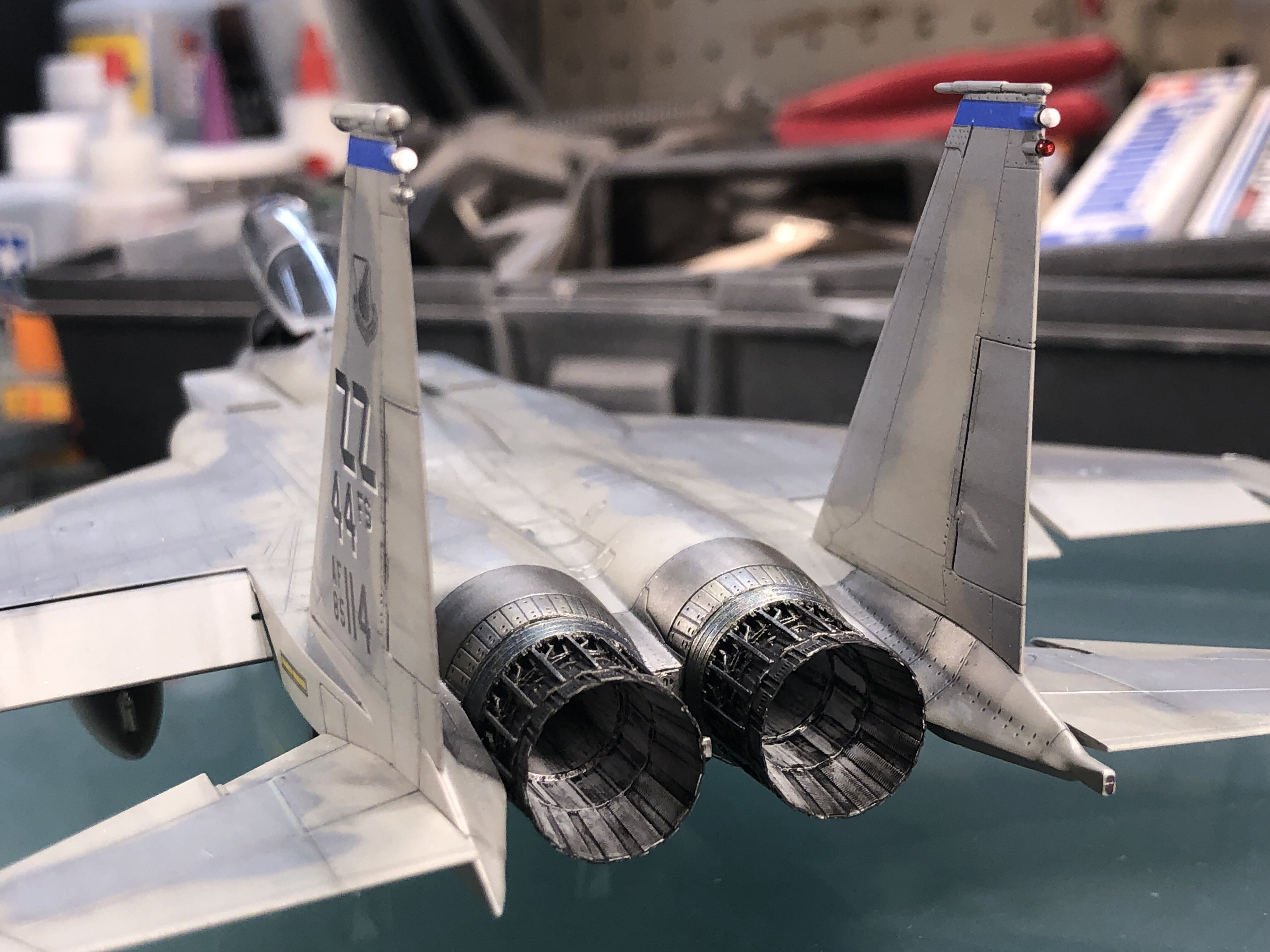

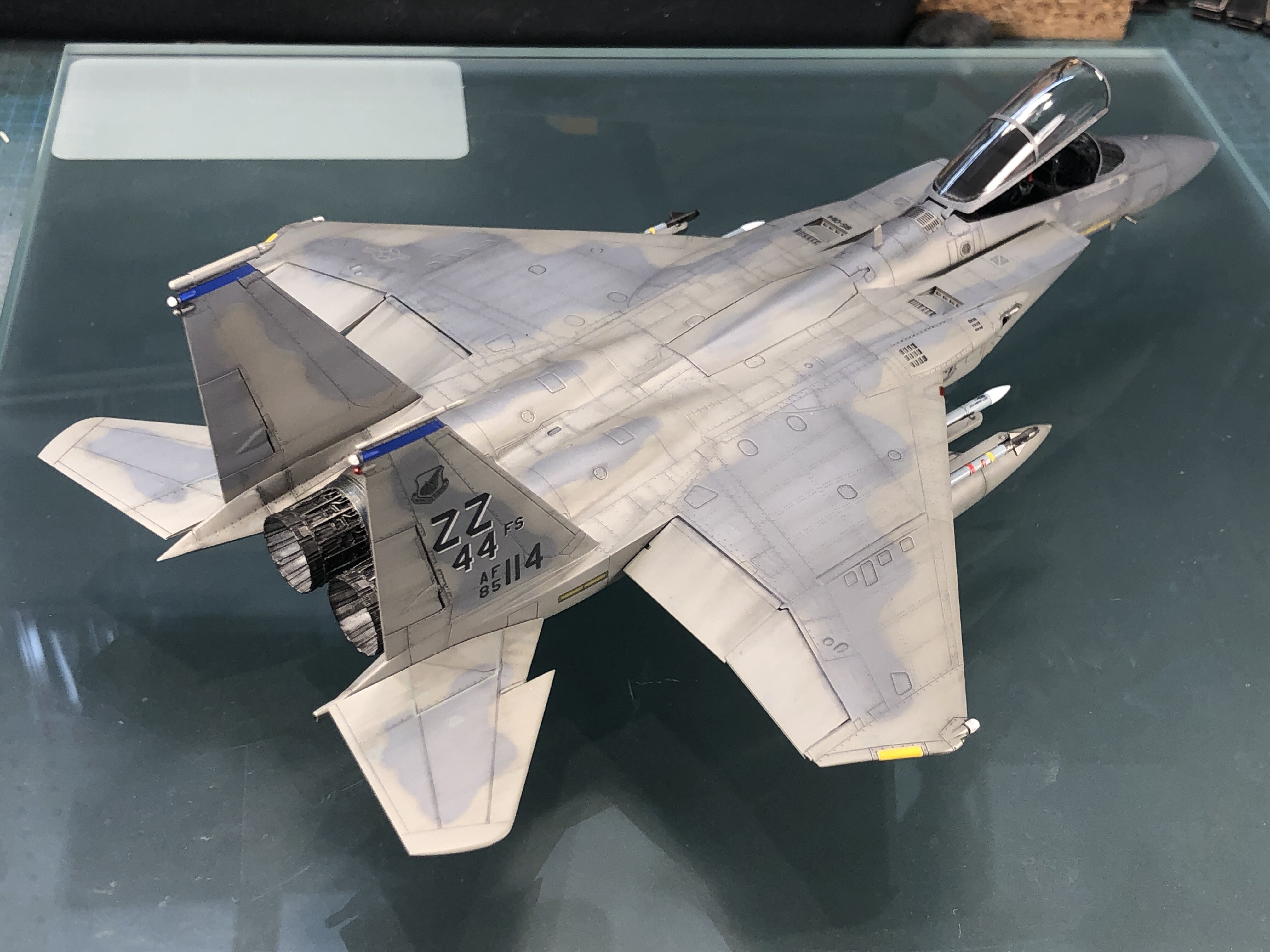

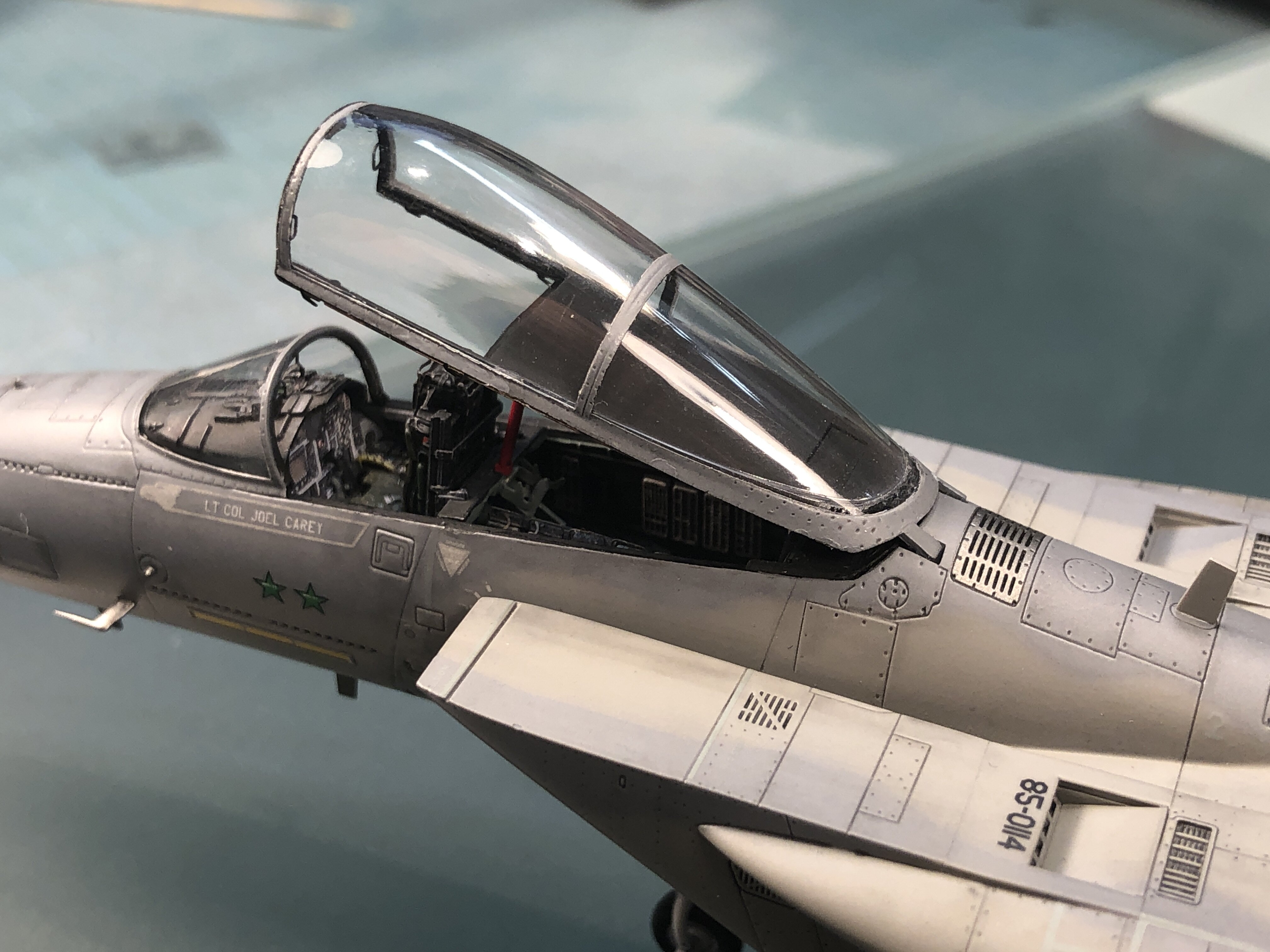

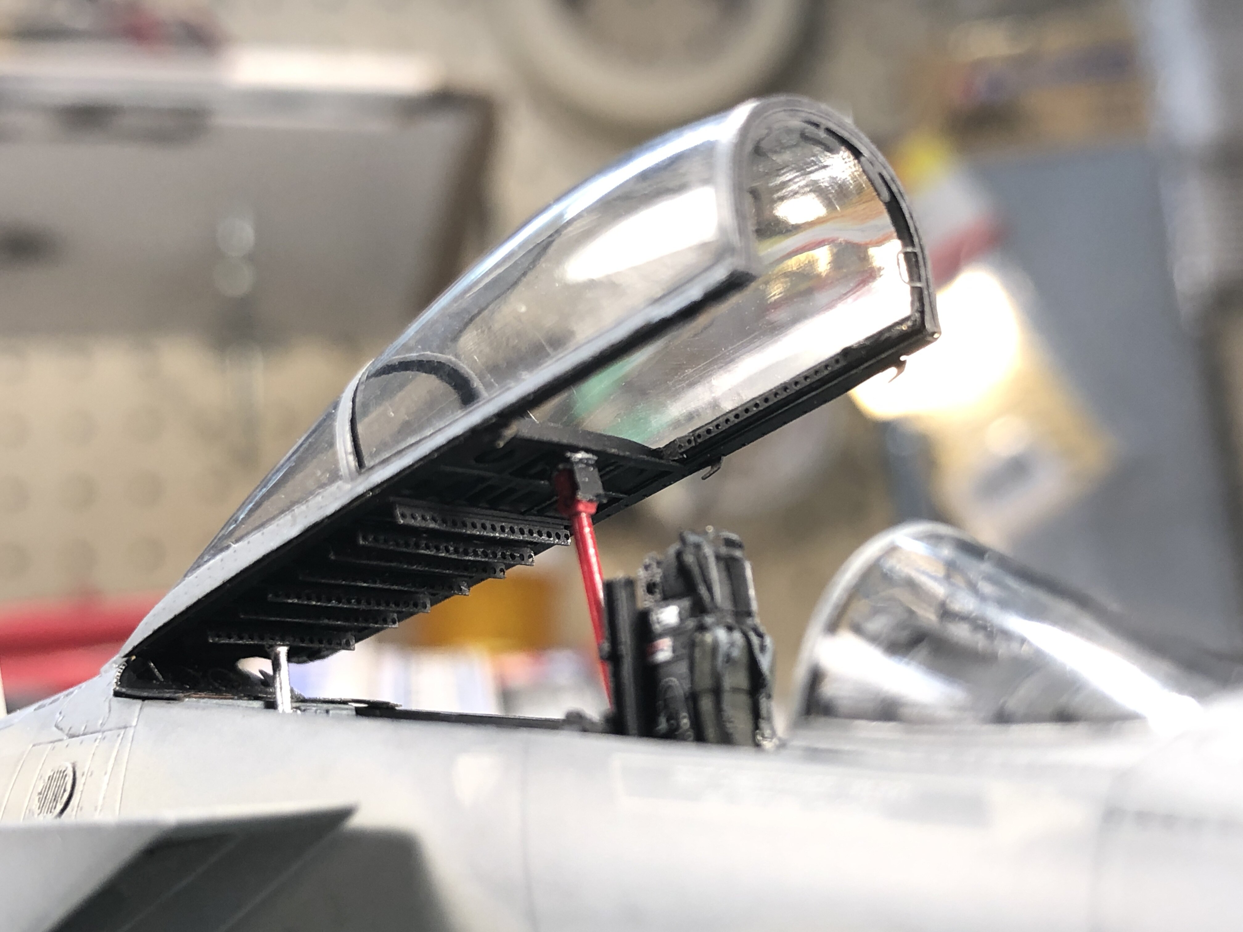

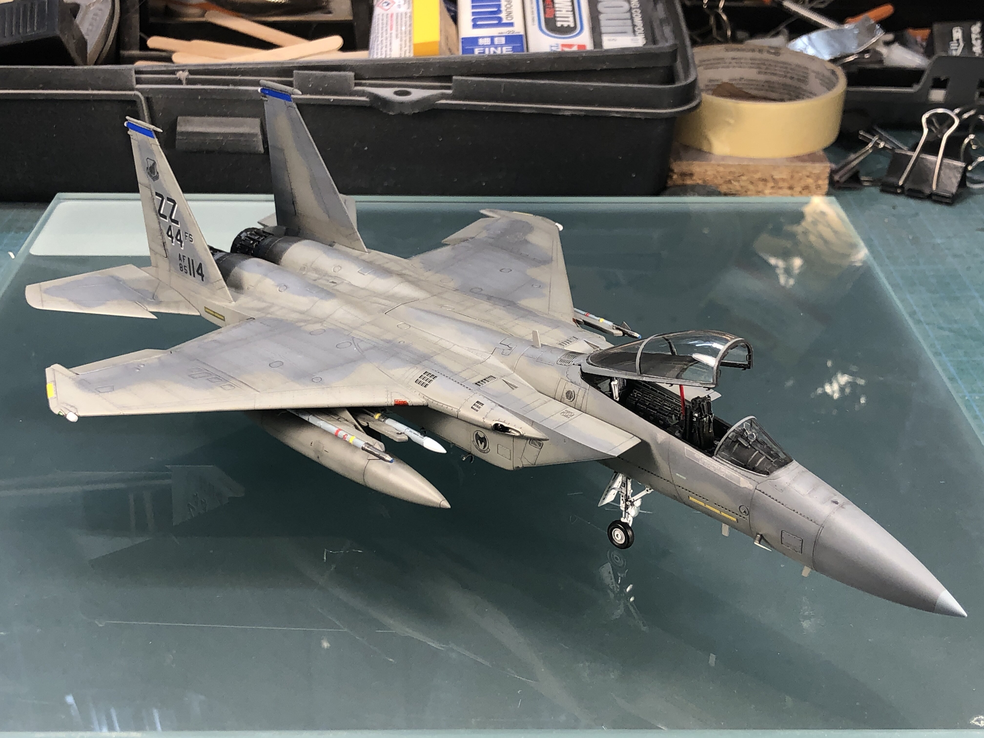

wm cheng Posted November 6, 2021 Posted November 6, 2021 Woohoo!!! Calling this puppy done. After so much went wrong on it, I'm just happy I actually finished it. Sorry about all the dust on the canopy, at 1/72 scale, it looked clean to my old eyes until the photos magnified the dust. Love the Photo-etched canopy details, but can't recommend the AK paints, they don't seem to adhere very well (lifts with Tamiya masking tape) and a tad on the dark side compared to the FS color fandeck. Highly recommend the Eduard Photo-etched set and KA 3d Printed exhaust nozzles though.  Quote
derex3592 Posted November 7, 2021 Posted November 7, 2021 @wm cheng OHH MY!!!! That Eagle looks amazing!!! GREAT job! @Rock Your 51 looks great! I can't even imagine painting and decaling that kit! Quote

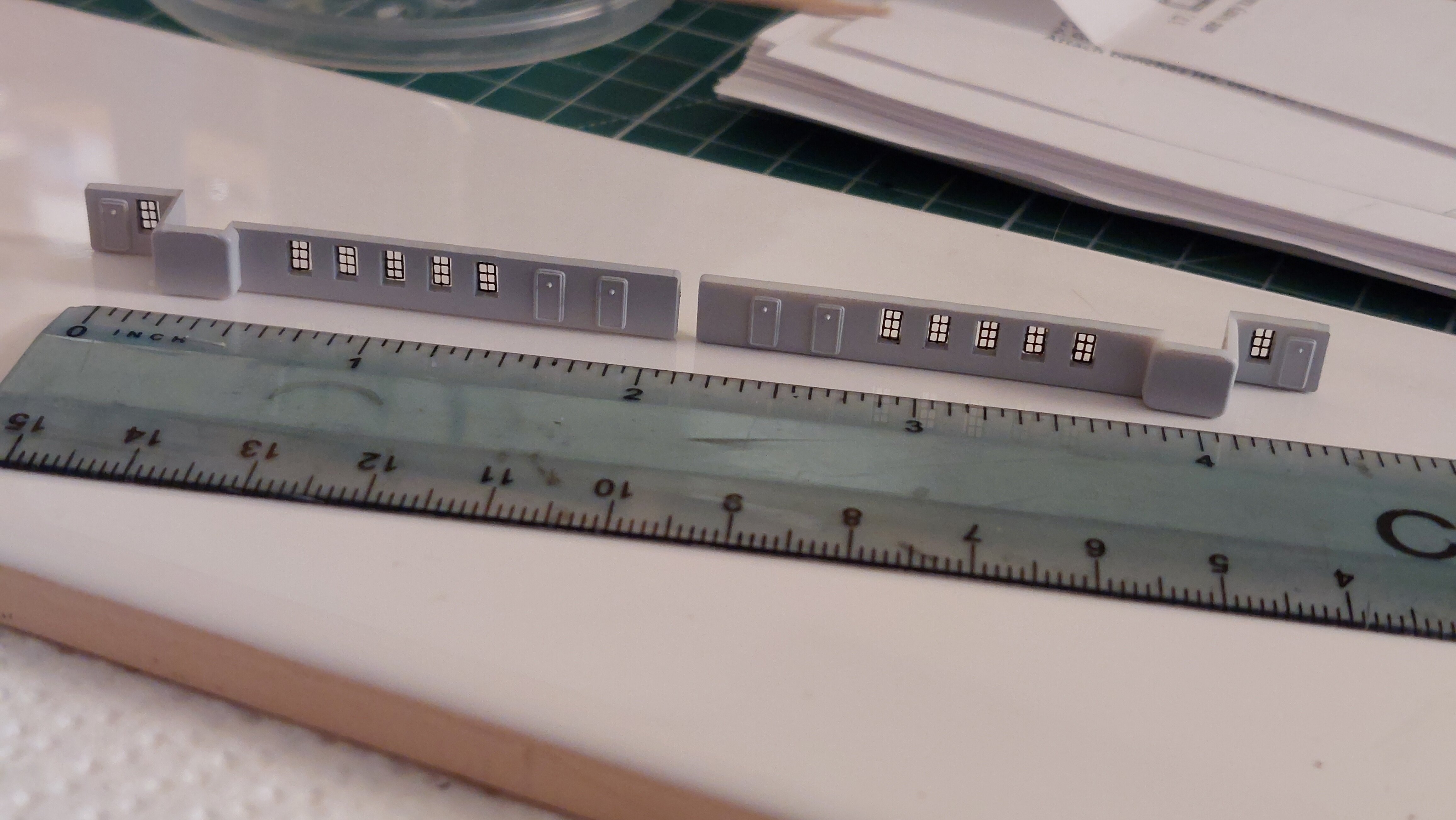

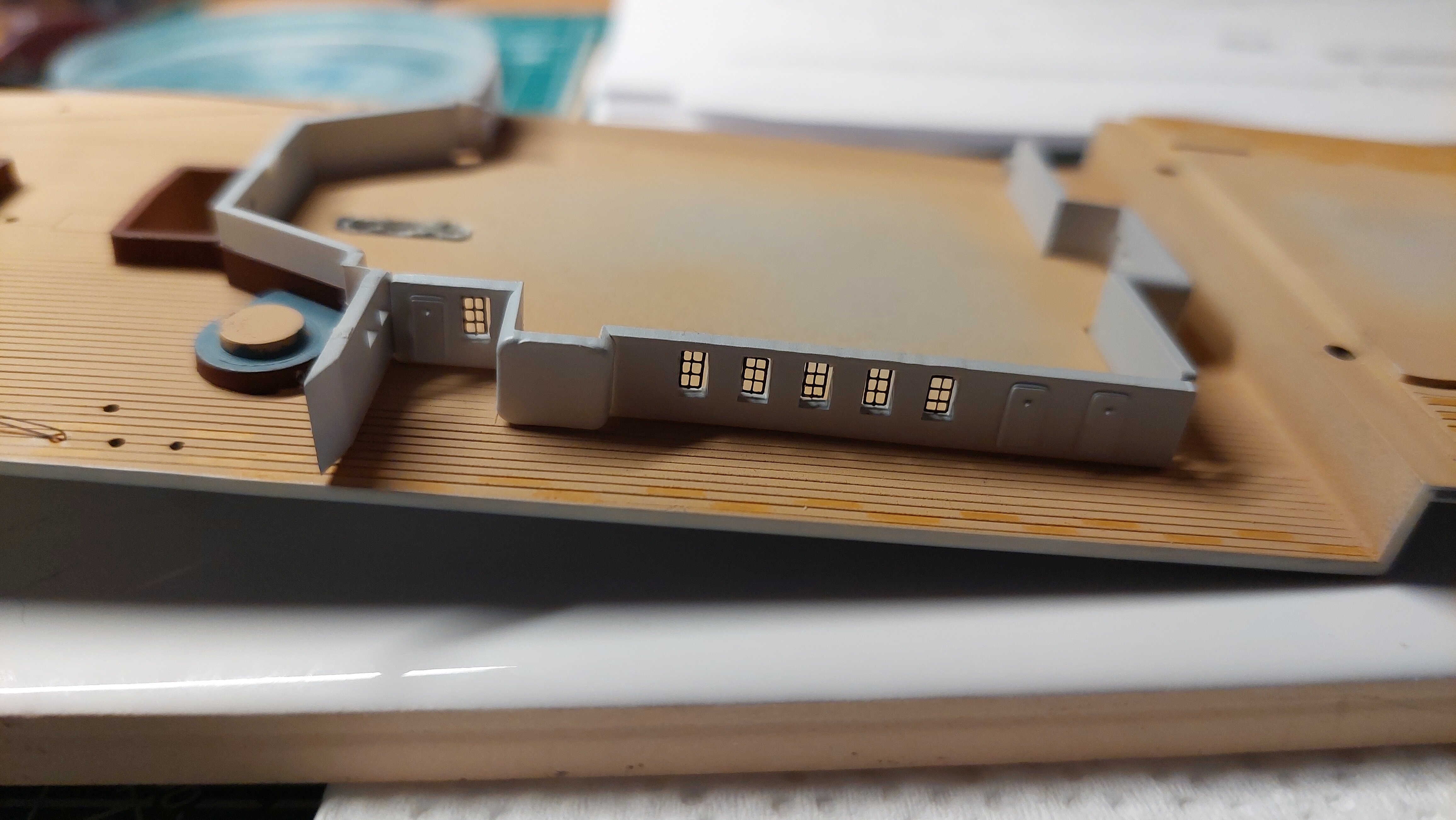

derex3592 Posted November 7, 2021 Posted November 7, 2021 This morning I proved to myself that I CAN do microscopic Titanic photo etch window frames....and these are some of the smaller ones... Took about an hour to do these 12... But I like the result! Painted brown on the PE tree before installing. Onwards! Quote
Salamander Posted November 7, 2021 Posted November 7, 2021 @wm chengNice 1/48 model. 😄 Seriously now, can't believe that's 1/72. Looks great!  @derex3592That looks doable, the photo-etched parts are larger than 1x1 mm... Quote
Thom Posted November 8, 2021 Posted November 8, 2021 @arbit Some really cool work on that dio and all the figures. @wm cheng Damn! I hope my F-4J looks half as good as that! And here's hoping I have better luck with the AK paints I'm going to try... @derex3592 Those are some tiny ass PE windows! I could probably loose one of those under a finger nail! Too bad they don't just print the window frames onto some clear plastic sheet that could be glued in from behind. Â As for me, I'm finally getting the fuselage together on Showtime 100. Quote
wm cheng Posted November 8, 2021 Posted November 8, 2021 @Thom what F-4 is that? Is that the new F-4 1/72 from FineMolds? I just got my kit (next one maybe next year) and waiting on aftermarket to get their acts together to get some detail sets for it. It helps if you primer the entire plane. I use Alclad grey primer, but I only spray the areas where I glued or filled or sanded to see any mistakes or need for further sanding - I usually don't primer the entire plane because I'm afraid that sometimes the finer engraved detail might get lost. It seemed to only lift in areas where the AK was on top of bare plastic. However I did primer the canopy and it lifted both the AK paints and primer from the canopy frames - don't know what happened there. Quote

MechTech Posted November 8, 2021 Posted November 8, 2021 @derex3592 Those windows look good! About 5 minutes per window, what a drag. @Thom Your Phantom is looking good so far! What is it with Phantoms this year? There are multiple new kits out on the market for them. It looks like Tamiya's 1/48th is the best fitting from what I've seen. - MT Quote

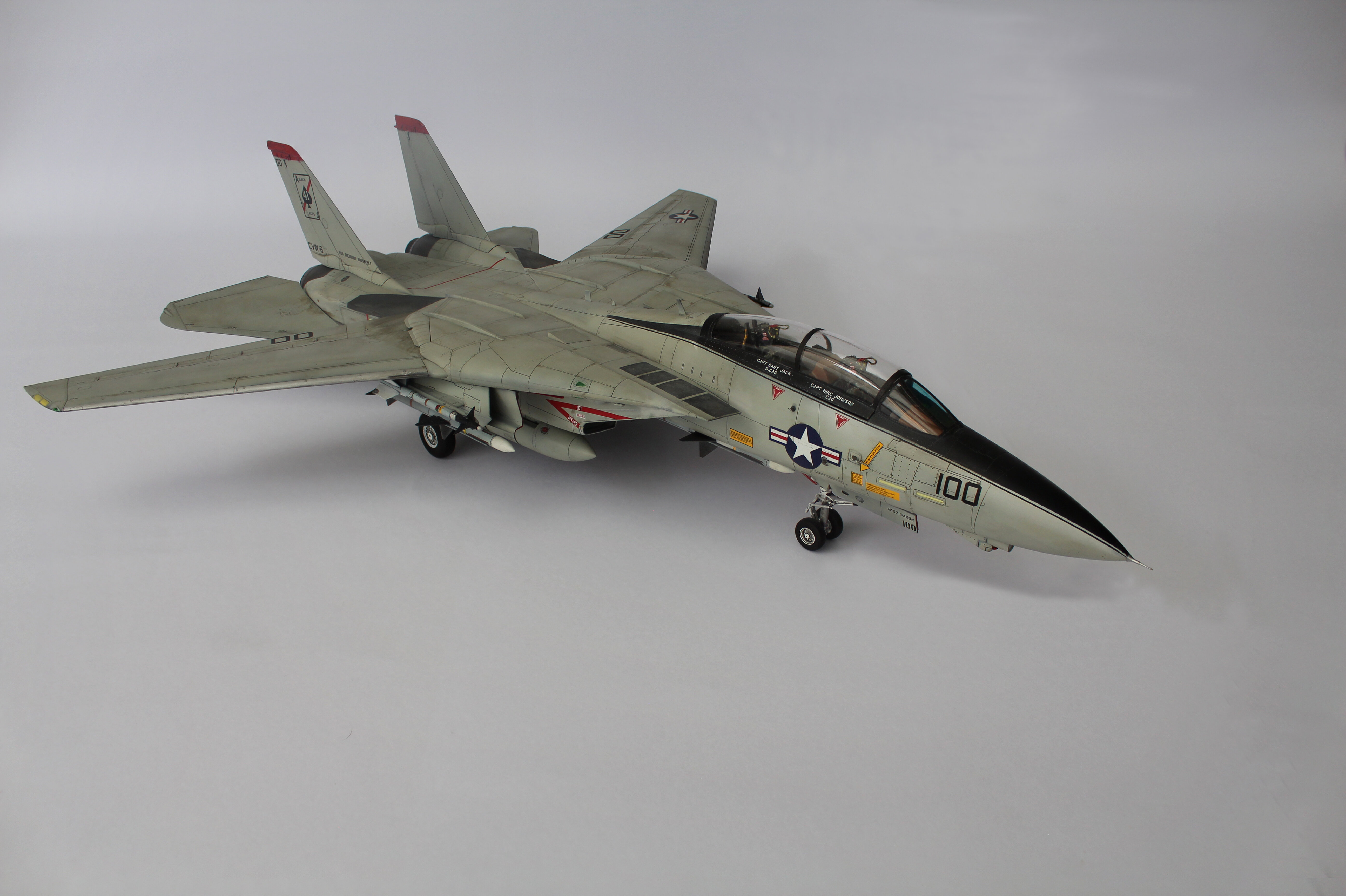

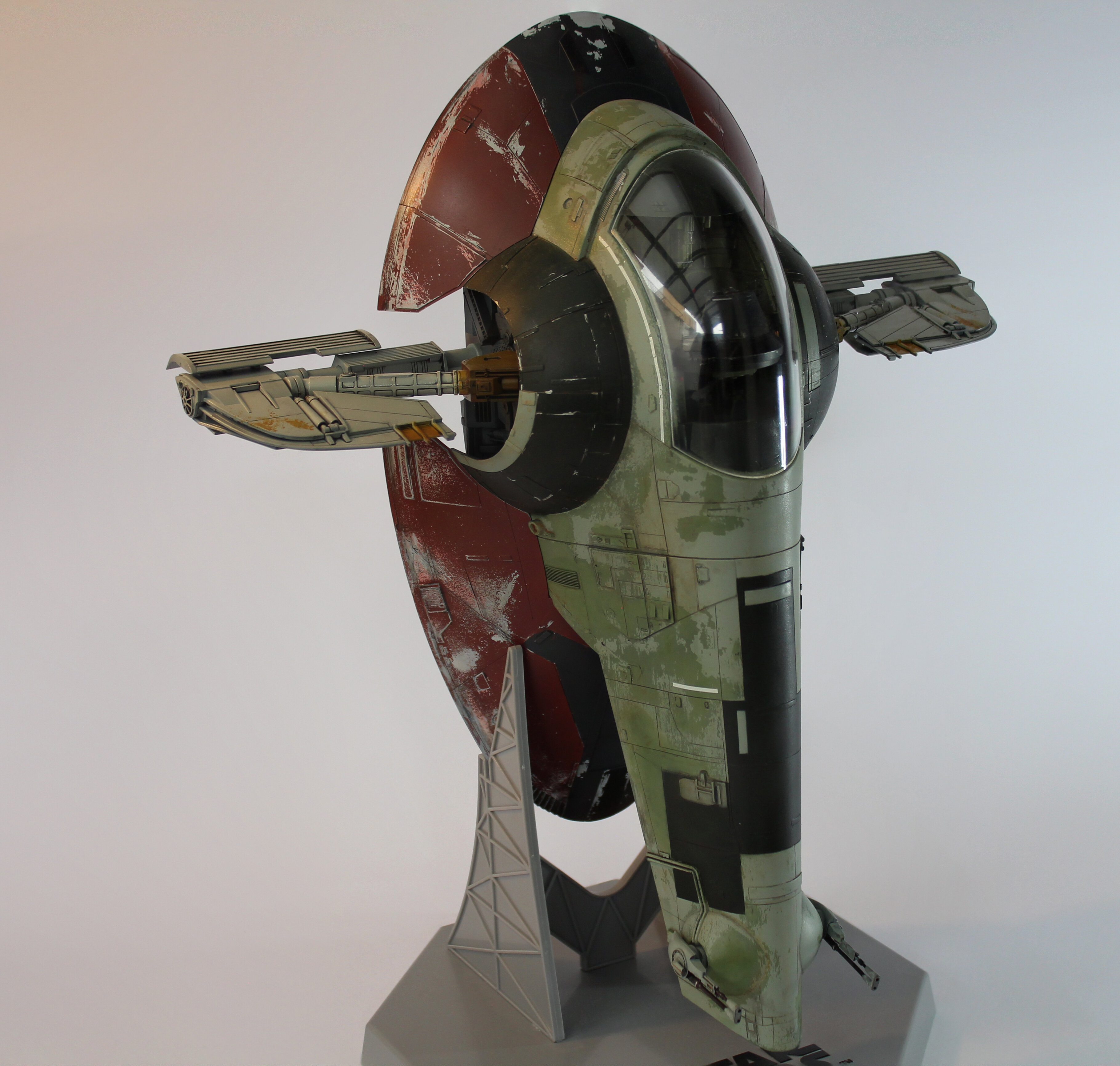

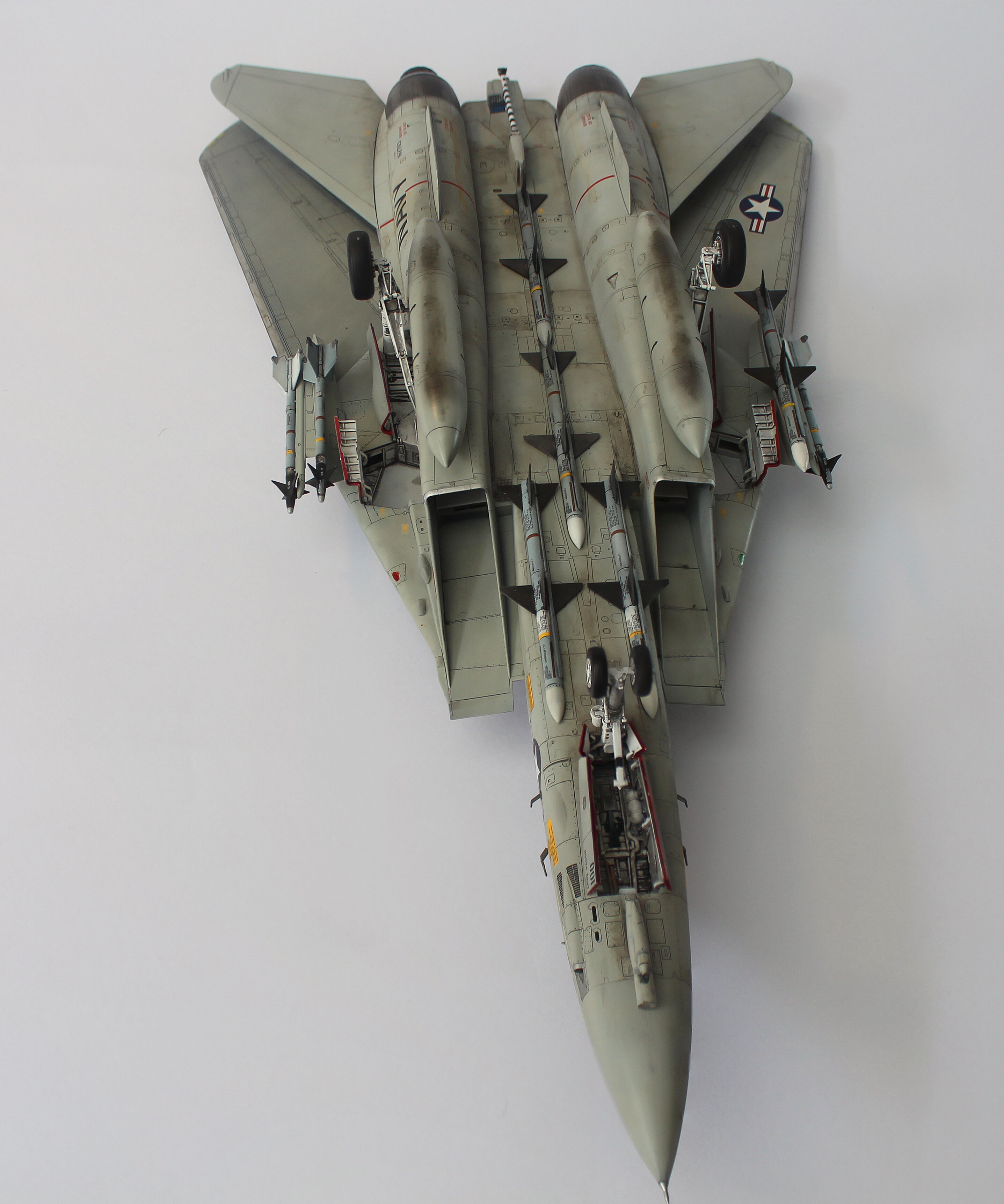

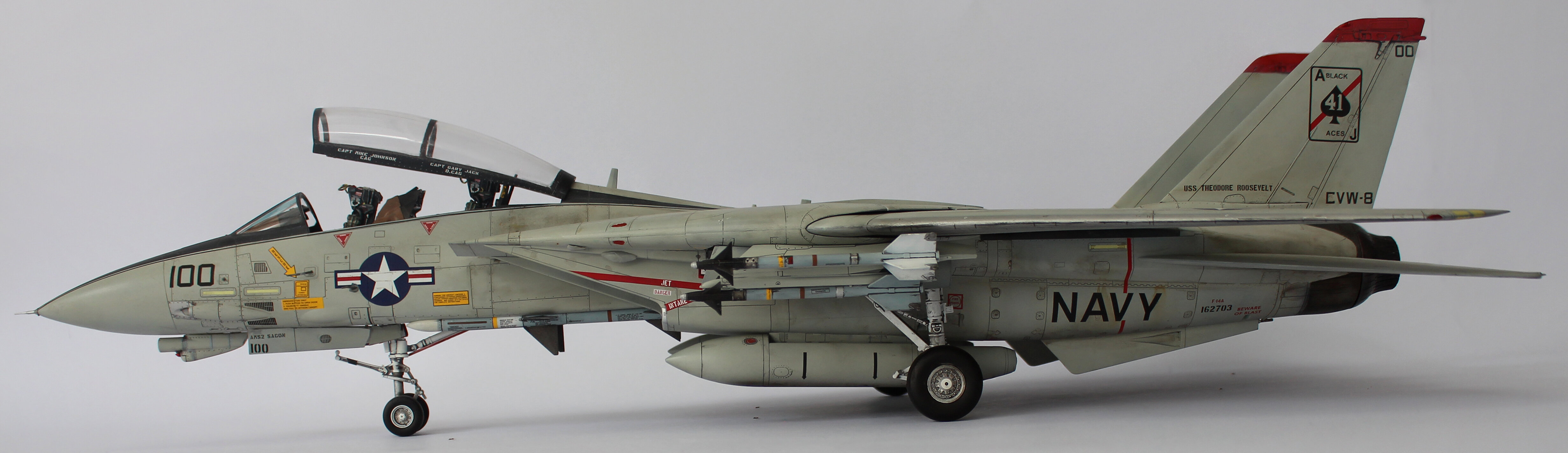

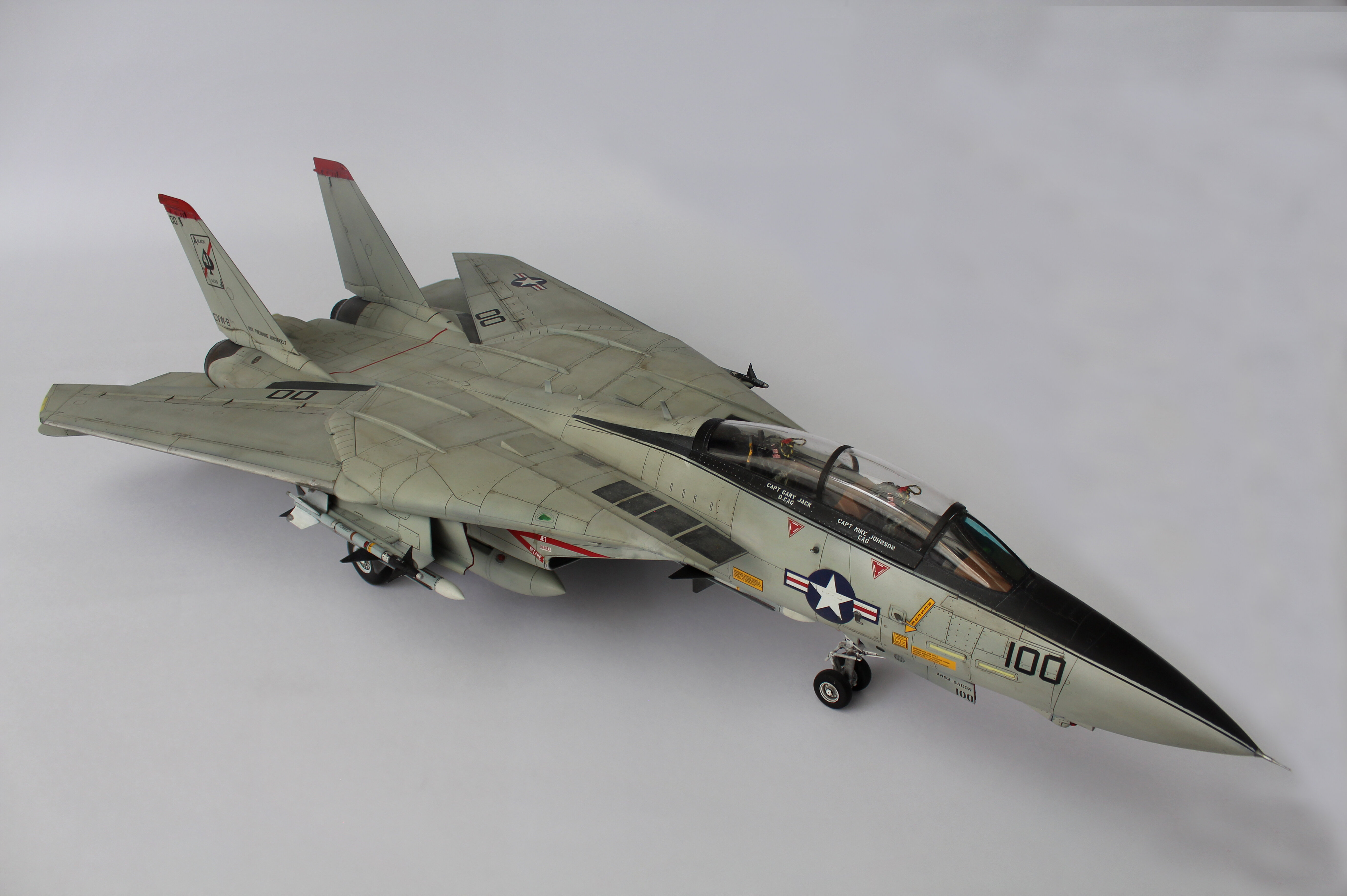

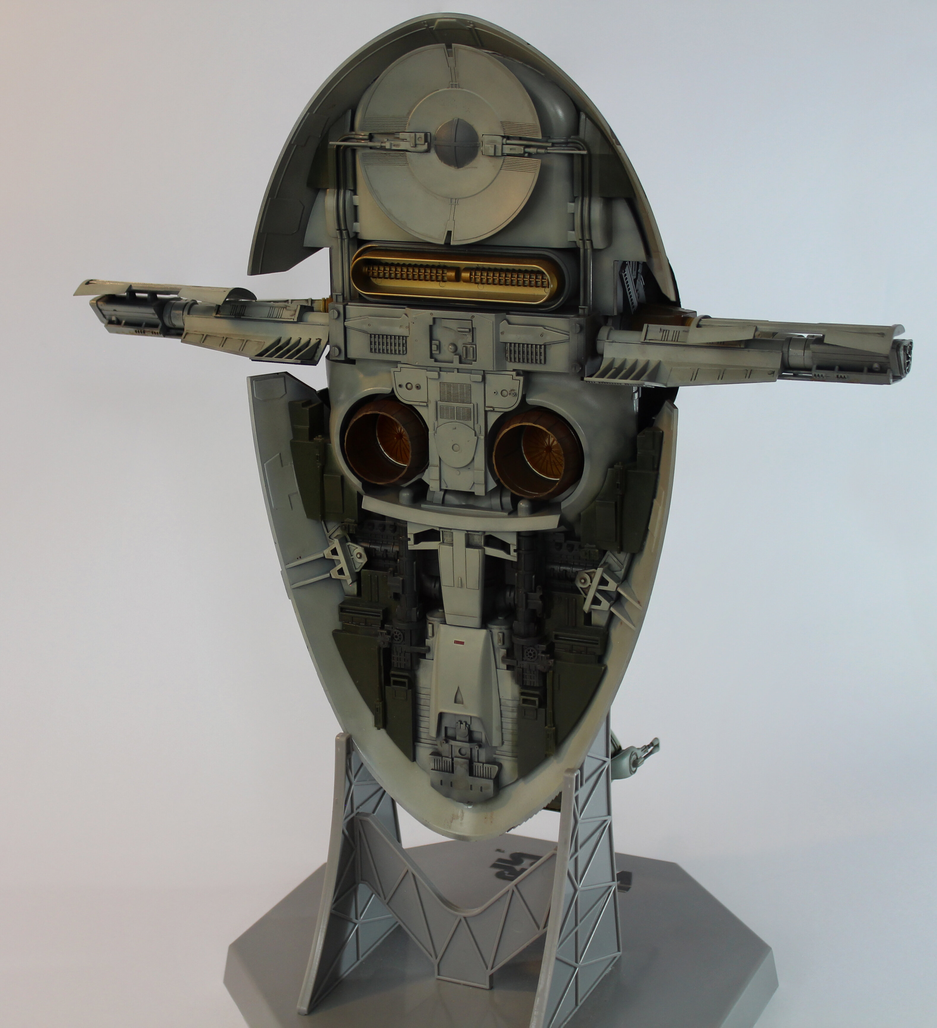

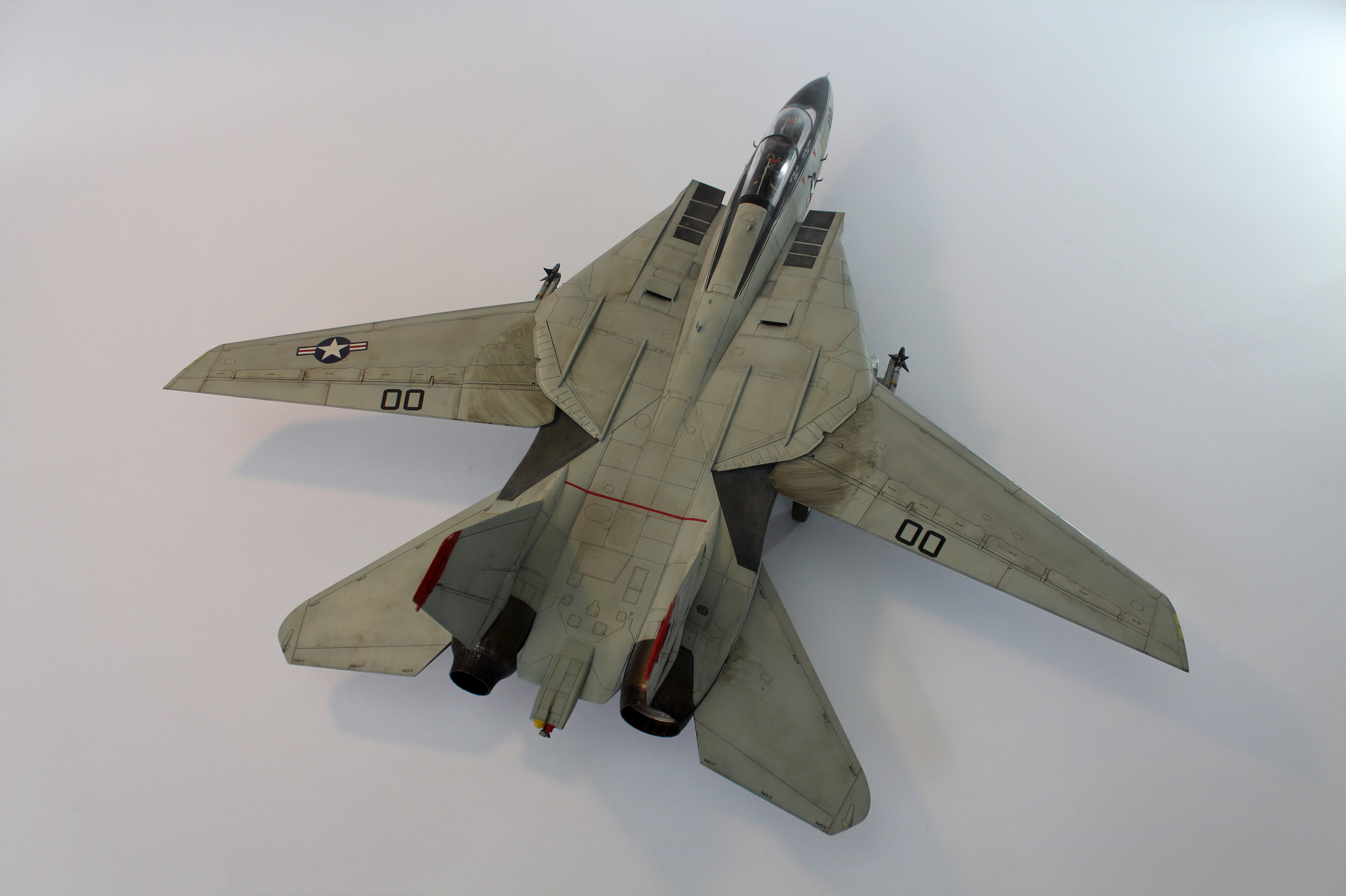

Thom Posted November 9, 2021 Posted November 9, 2021 @joscasleThat's quite the impressive line-up of models! And though I'm not normally 'into' Slave 1 that one is fantastic! Quote

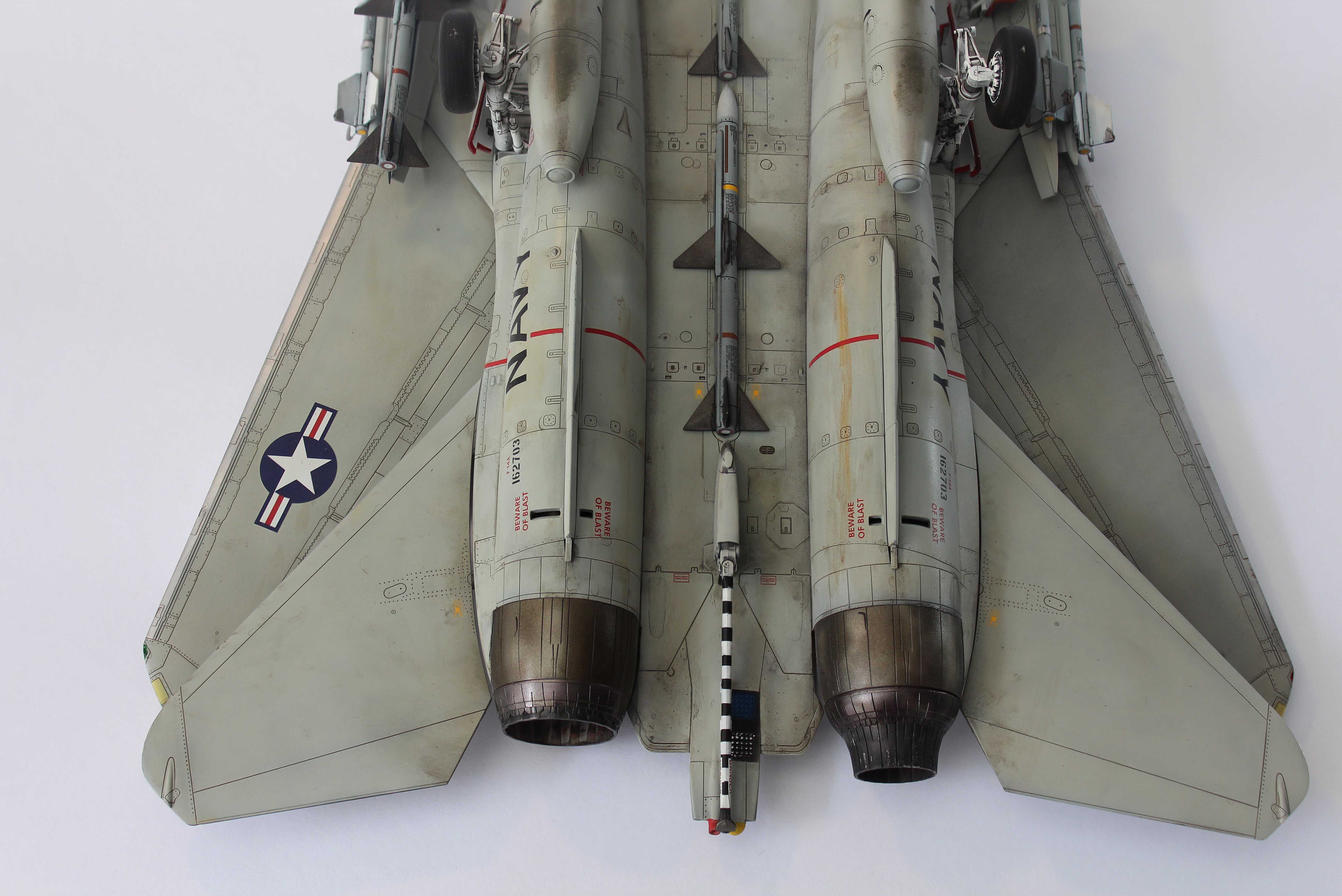

wm cheng Posted November 9, 2021 Posted November 9, 2021 Beautifully done @joscasle - are the aircrafts 1/48? Is the Tomcat the Tamiya kit? Quote
joscasle Posted November 9, 2021 Posted November 9, 2021 3 hours ago, Thom said: @joscasleThat's quite the impressive line-up of models! And though I'm not normally 'into' Slave 1 that one is fantastic! Thanks 2 hours ago, wm cheng said: Beautifully done @joscasle - are the aircrafts 1/48? Is the Tomcat the Tamiya kit? Thanks! Yeah, it is a Tamiya 1/48 F-14A with some resines to updated to a mid late (seats, chin pod, tail reinforcements and ECM blisters. The Y-19 is in 1/48 too. The Slave One is 1/72 from Fine Molds Quote

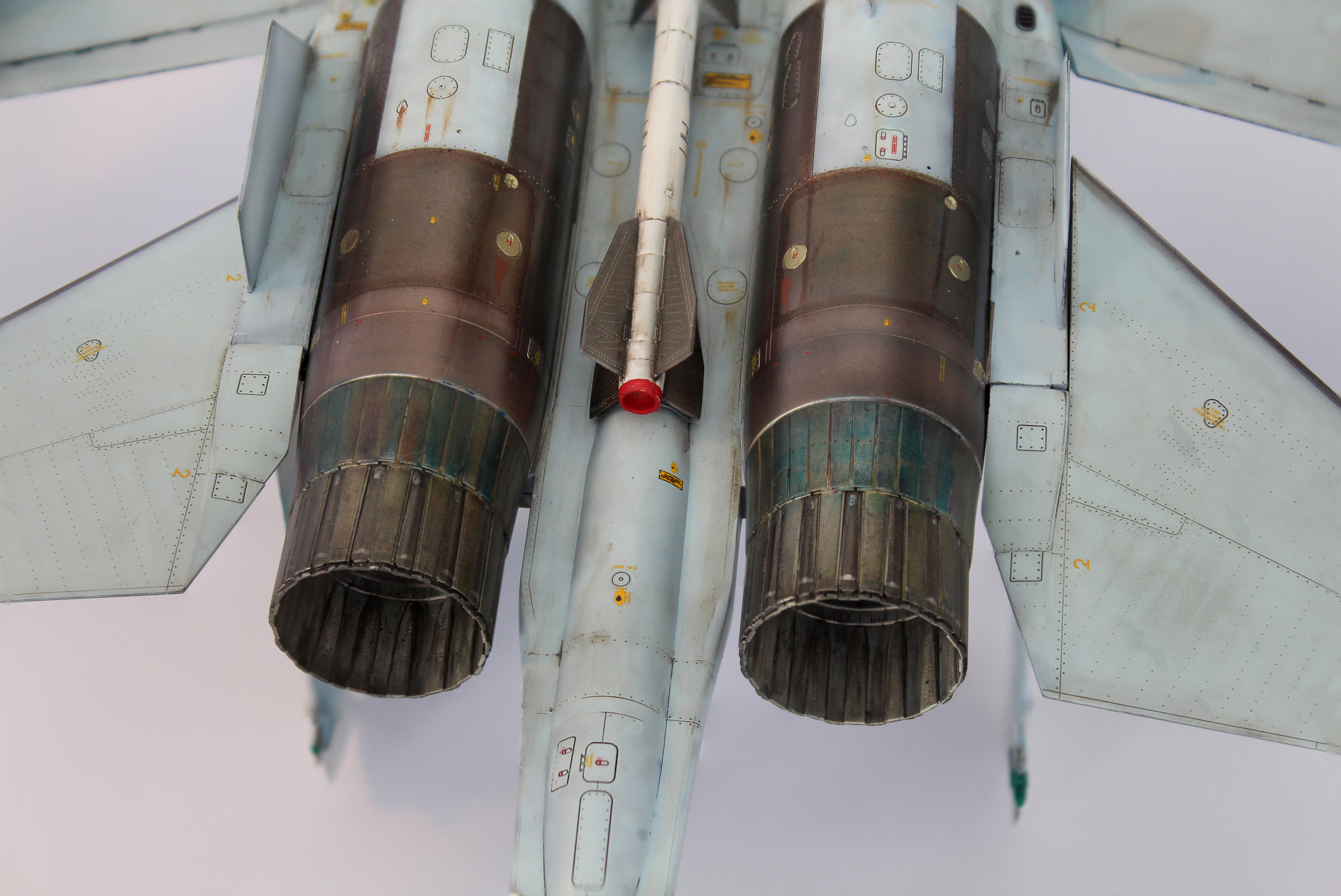

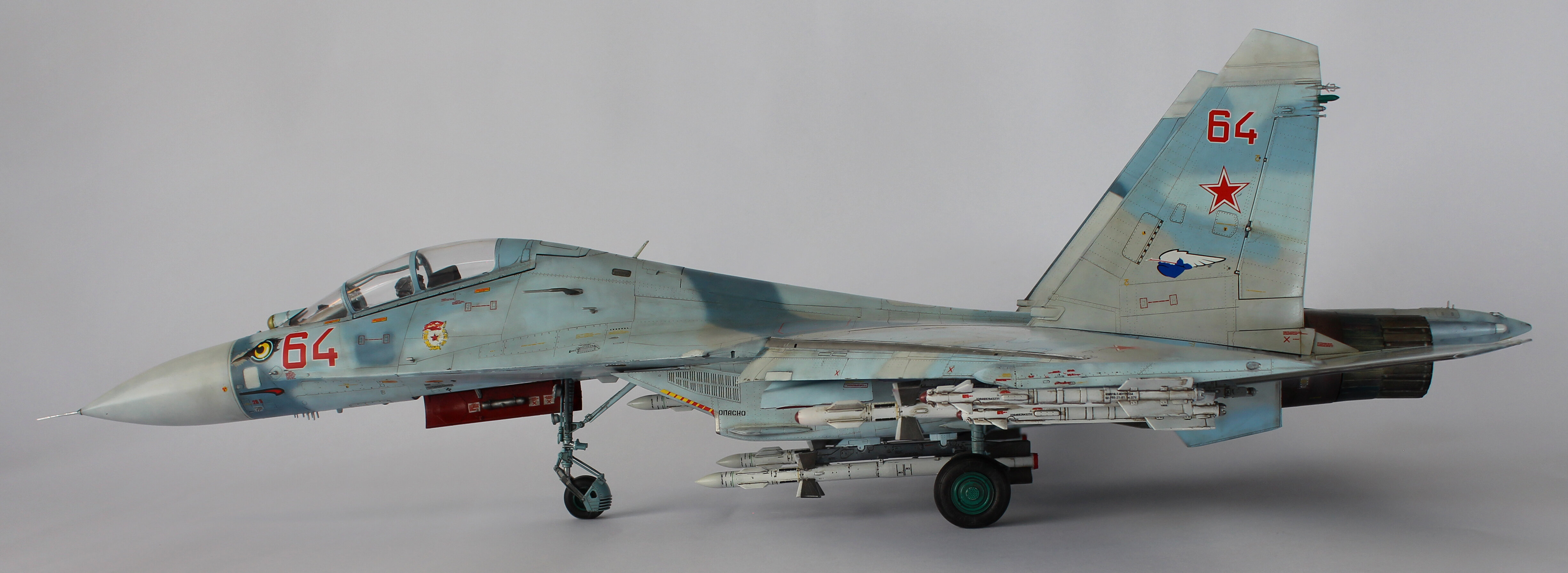

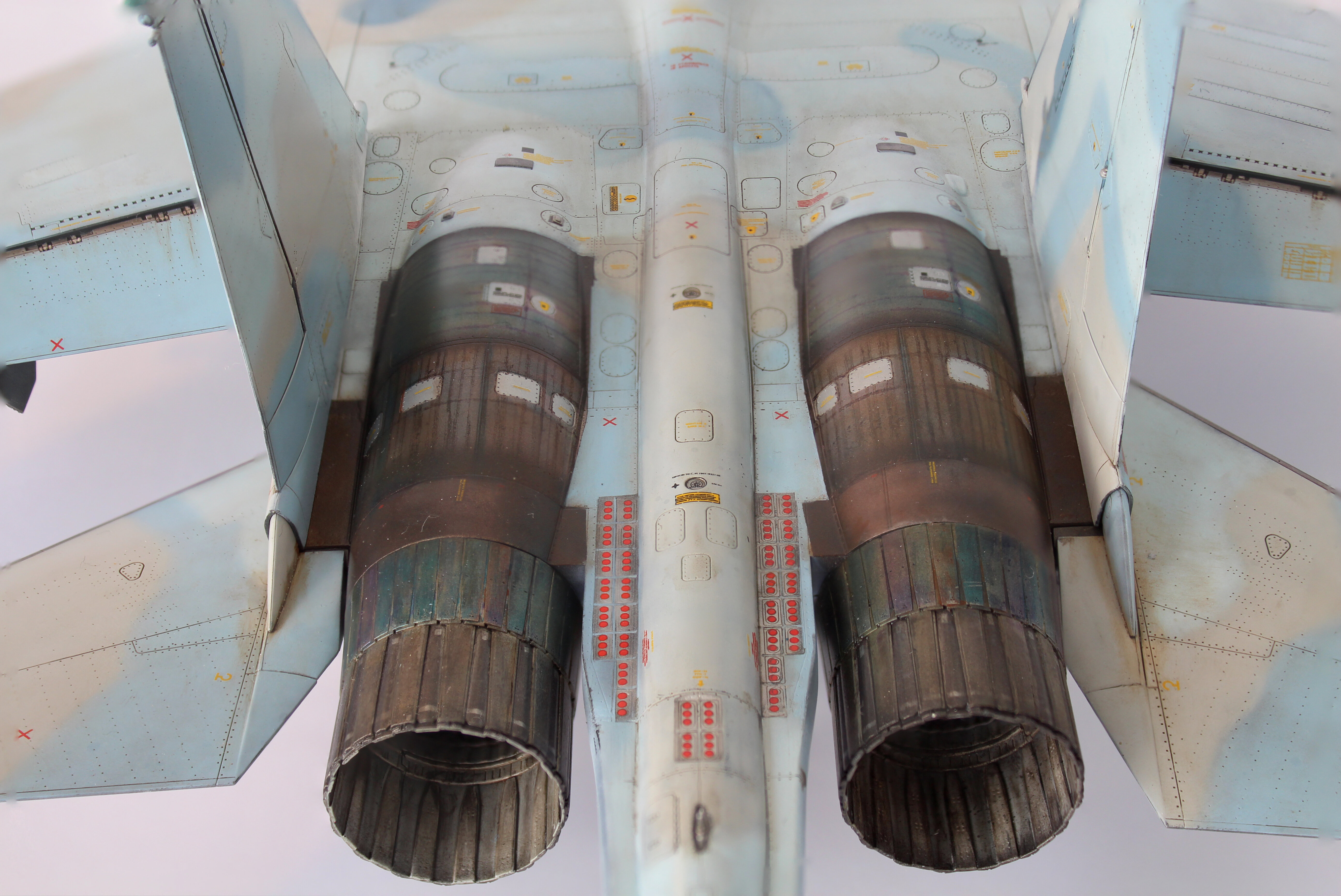

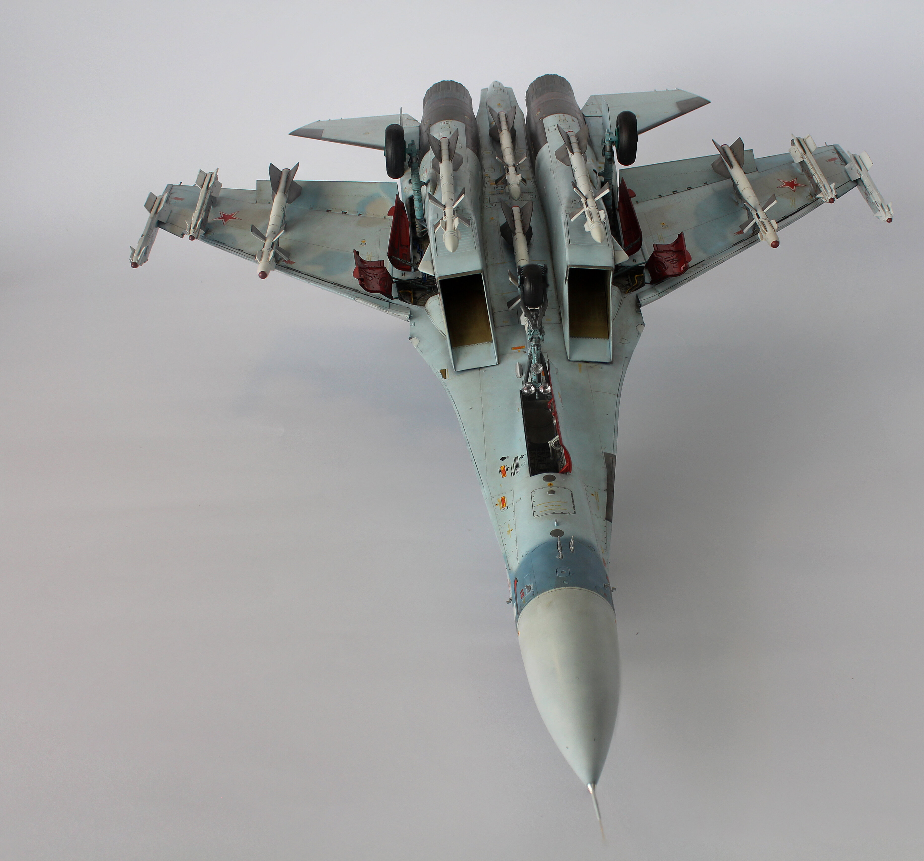

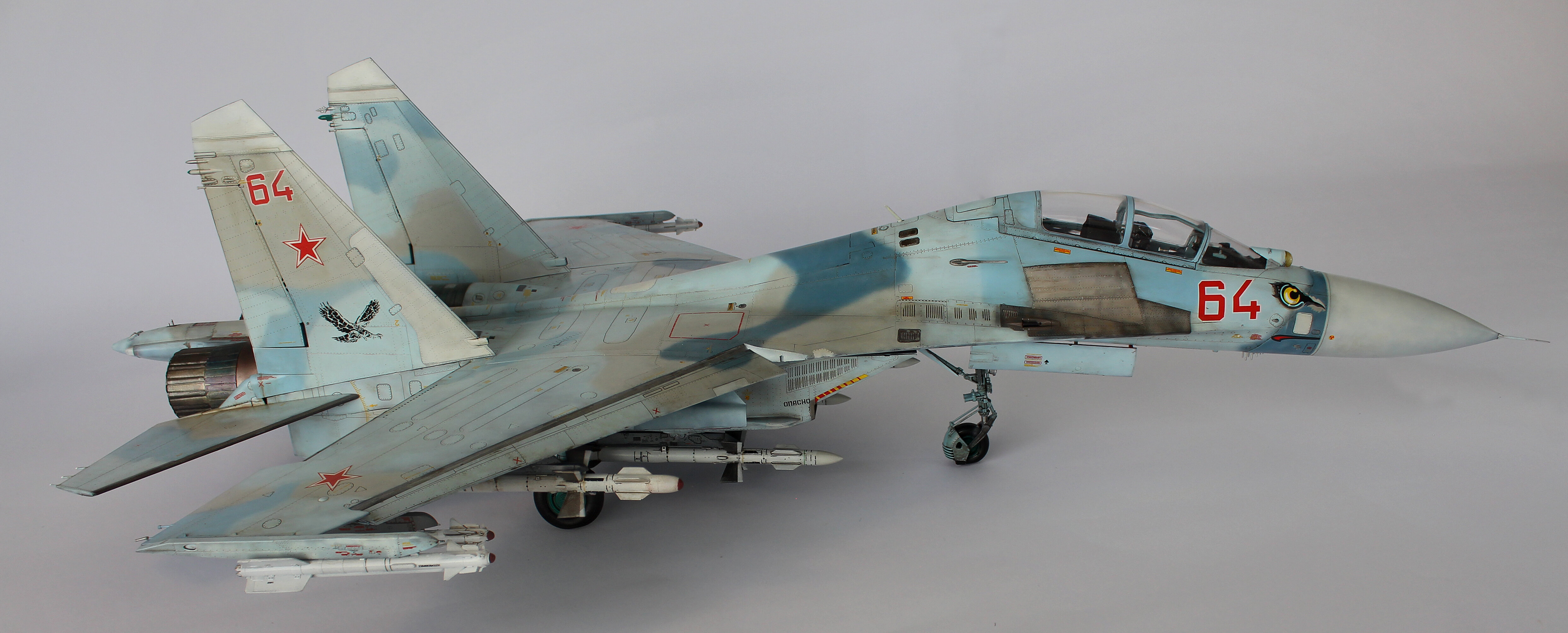

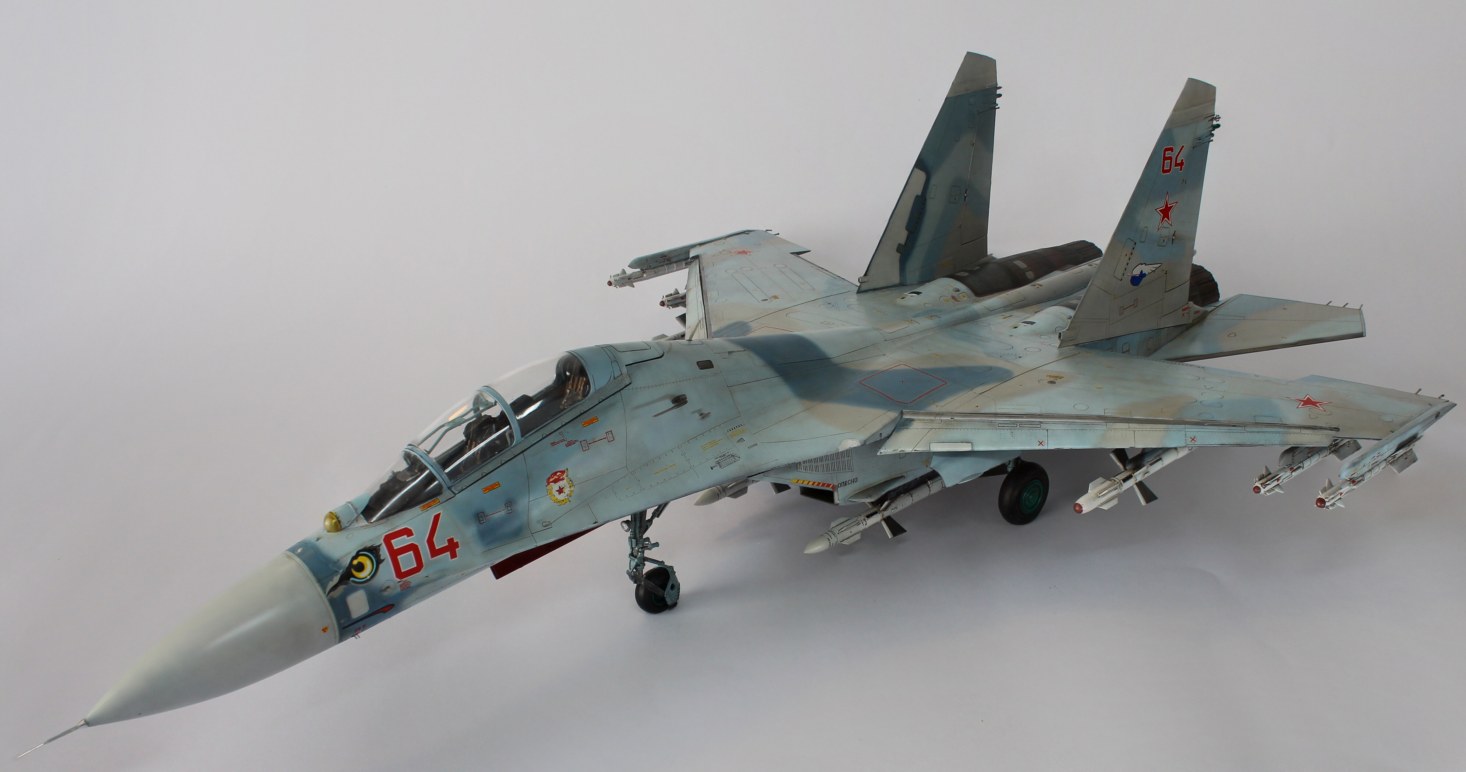

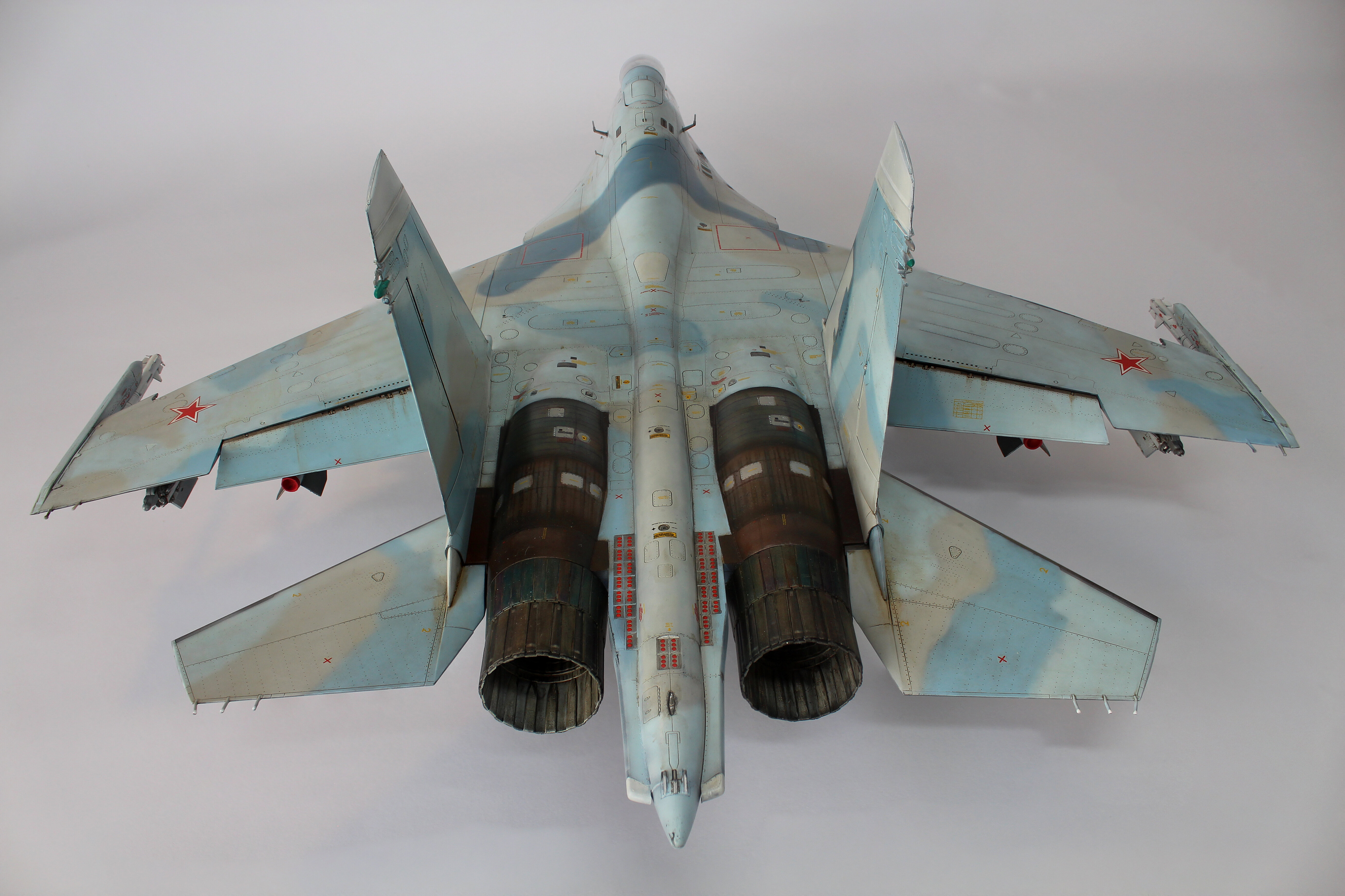

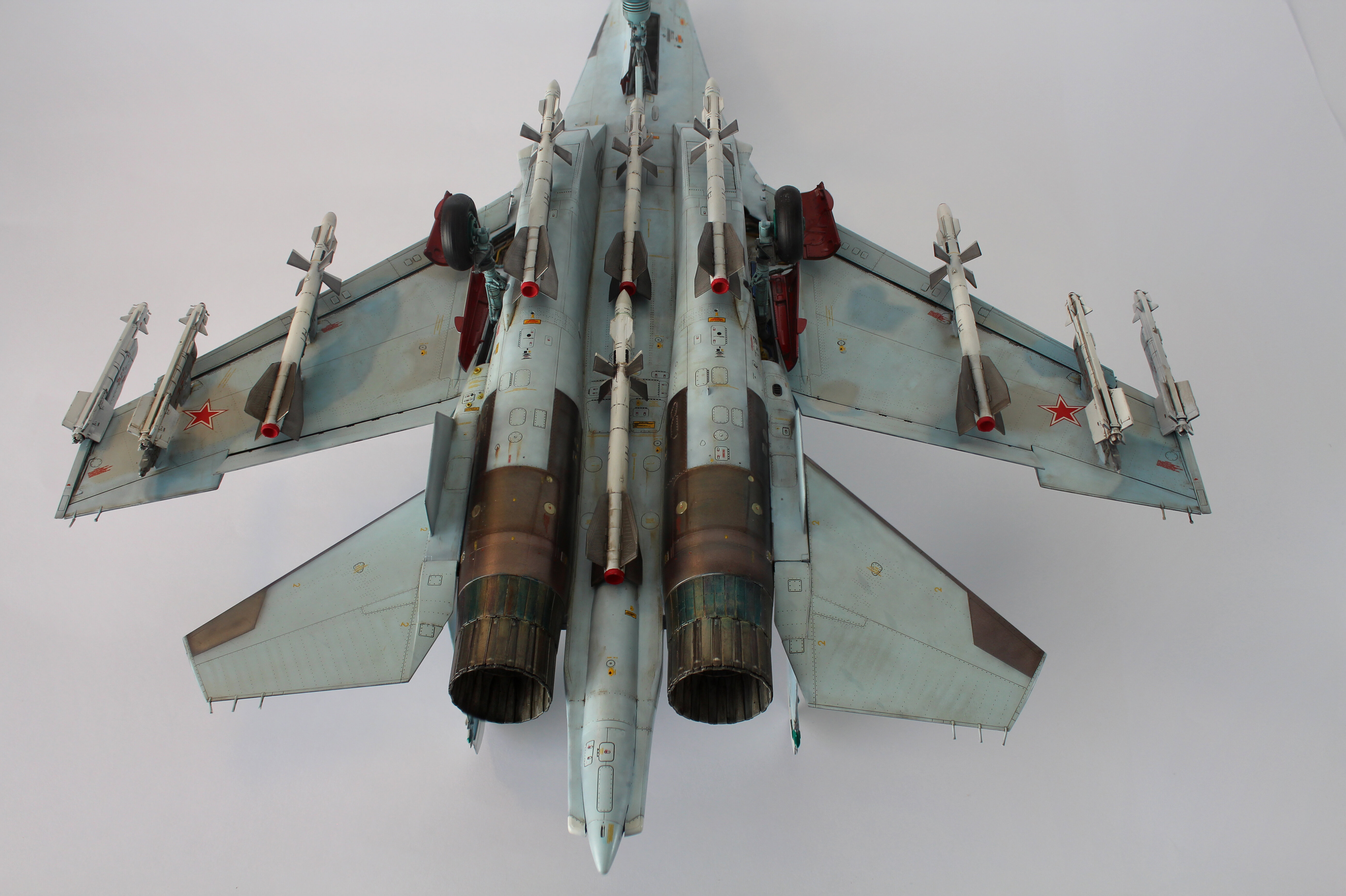

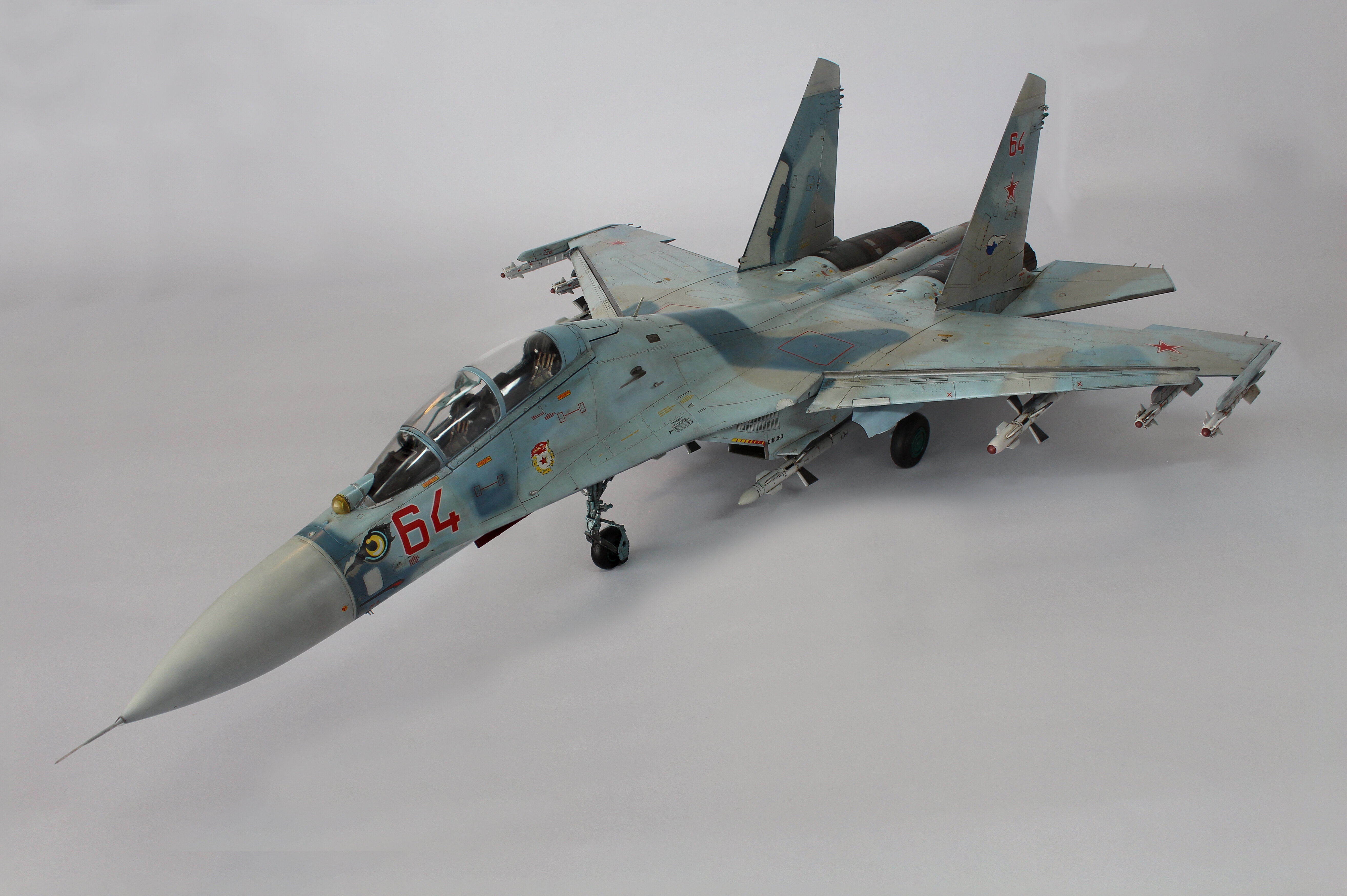

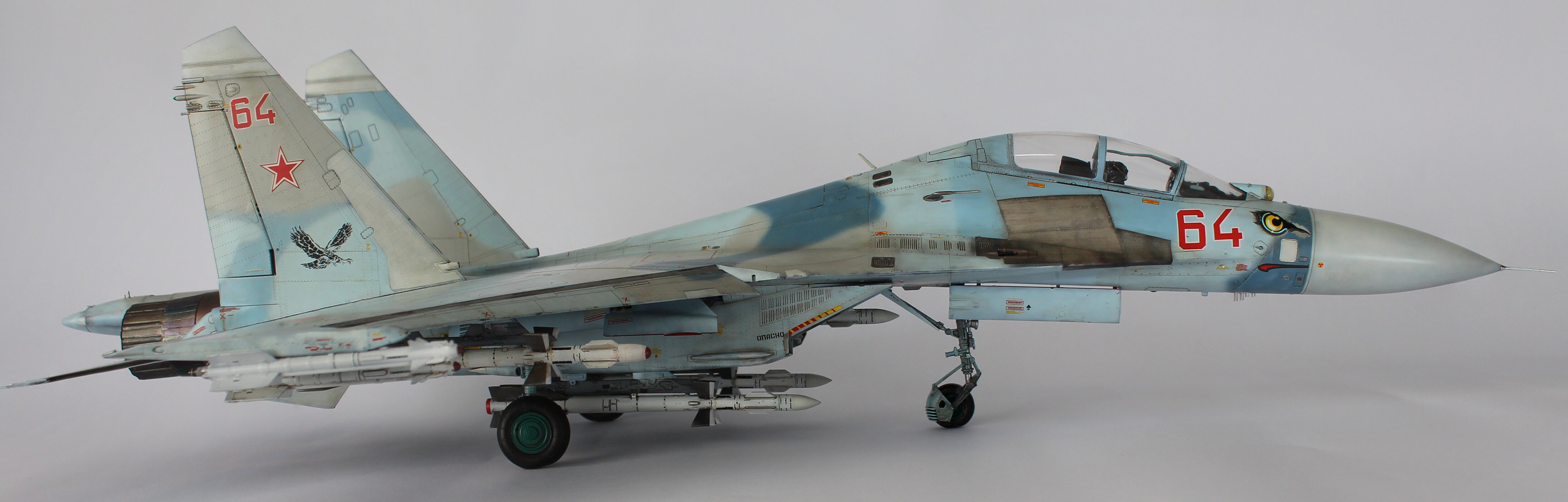

joscasle Posted November 11, 2021 Posted November 11, 2021 ok, the last of this year. GWH 1/48 SU-27UB, grreat great great kit. Â Quote
wm cheng Posted November 11, 2021 Posted November 11, 2021 Absolutely gorgeous @joscasle!!! Love the burnt metal on the engines. Did you freehand the camo pattern? The soft edges are perfect! Quote
