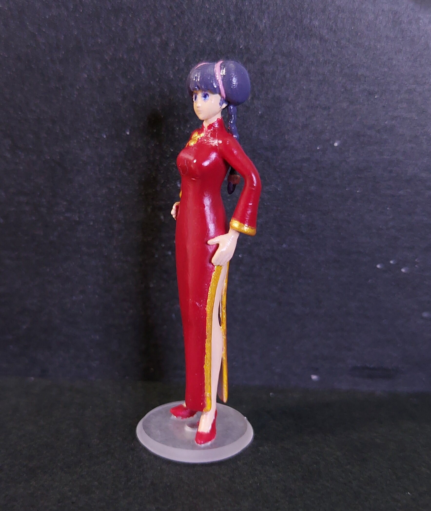

I really enjoyed seeing this thing built. Very nice colors and details. For a monster, he is a cute little guy!
On my workbench are 1/48 Anime Eye Decals. Yechk, what a nightmare. These things are less than 0.4mm in size.
First I had the trial and error to print on Hayes White Decal Paper at home on my Ink Jet. Settings must be Glossy Photo Paper, but my POS printer will only print small photos at that setting. I may have lost some quality for rescaling, but I am not sure.
Then you need to gloss them several times with an acrylic spray, that means do not use Japanese hobby lacquer sprays, or they will fall apart in water.
Then I found that these decals really don't like Mr. Mark Setter and Softer.  The only way to apply them without falling apart and color bleeding is with water, and after they are dry, just a jot of setter.  I really need to try another brand, because Mr. Mark Setter reacts with everything badly, doesn't work well on Future, fogs it up, and melts these Ink Jet decals in seconds.  Seems to work fine with pro decals though...
Then I had the challenge of cutting out these little suckers. I found the best way was to gently graze the surface of the decal with a detail hobby knife, while rotating the decal sheet in a circular pattern, but not really moving the hobby knife except to reset.
After many disheartening fails, I finally got some decent results.
A satin coat will be next for final.
I've been trying to paint a mouth line, and some face/jaw shadows, but it is just too small, can't figure it out so far.
I'm a proud papa, but any painting advice appreciated...

I totally get your frustration with small figures/kits
I think Mr. Mark setter might be a bit too harsh for those new thinner decals. I read somewhere their chemical components were stronger than Microset. So i started using this other brand since. So far they haven't failed me but it takes longer and bigger amounts of the liquid to set the decals.
if the decals haven't set well if the spot always re-wet before wiggling it and then gently apply a paper towel or Q-tip to bloat the excess water off before it dries.

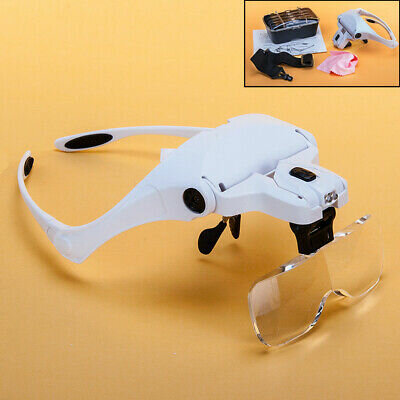

Another things you might want to invest in on a magnifier lamp glasses. They do help a lot with small things.
Your Minmay looks good and hopefully is a learning curve to make the next mini figure better.

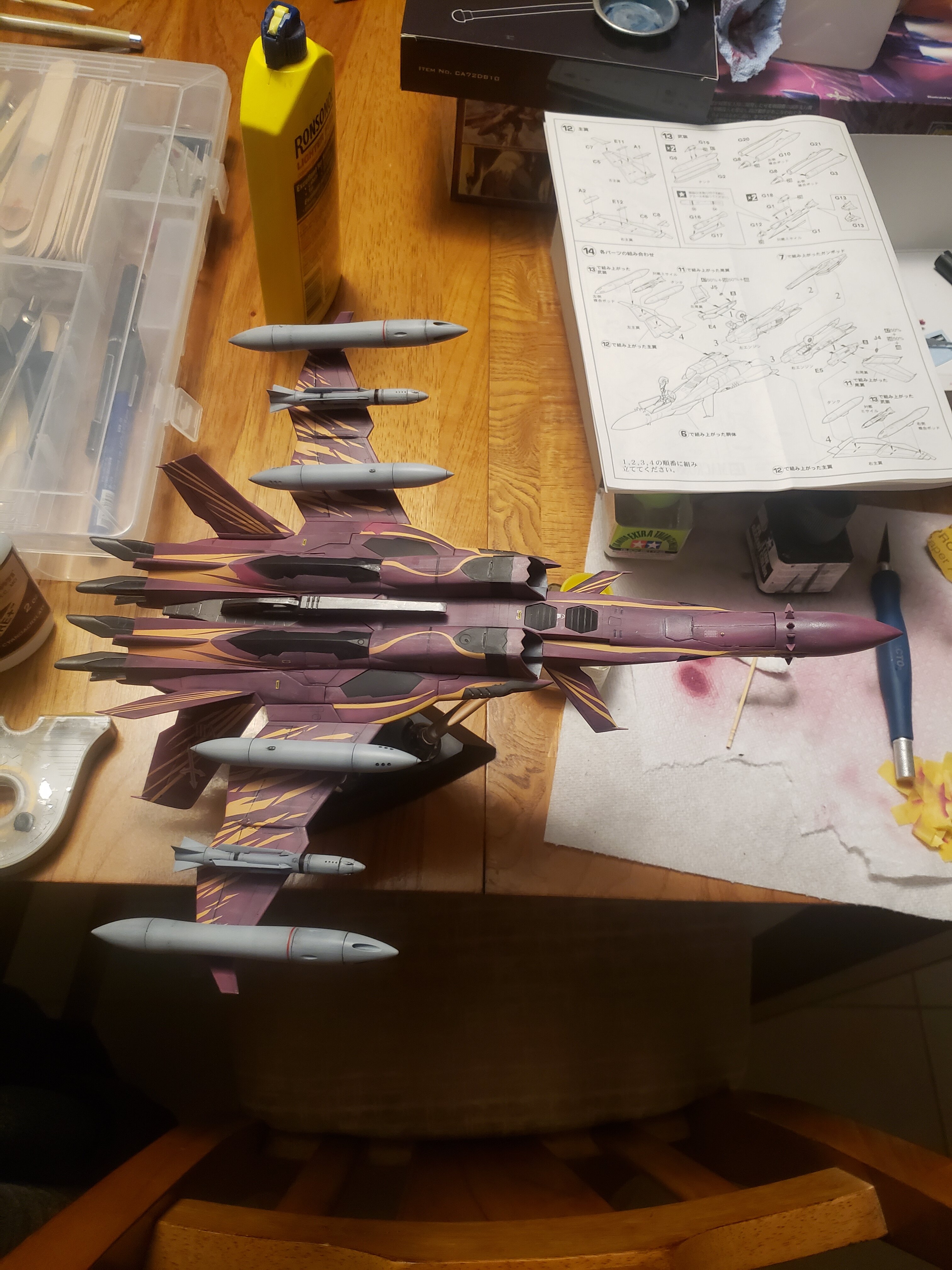

Few personal weeks off. Back at it.
Ordnance on. One big mistake I didn't catch it until mounting... oh well. Canopy is all that is left, then onto touchups.

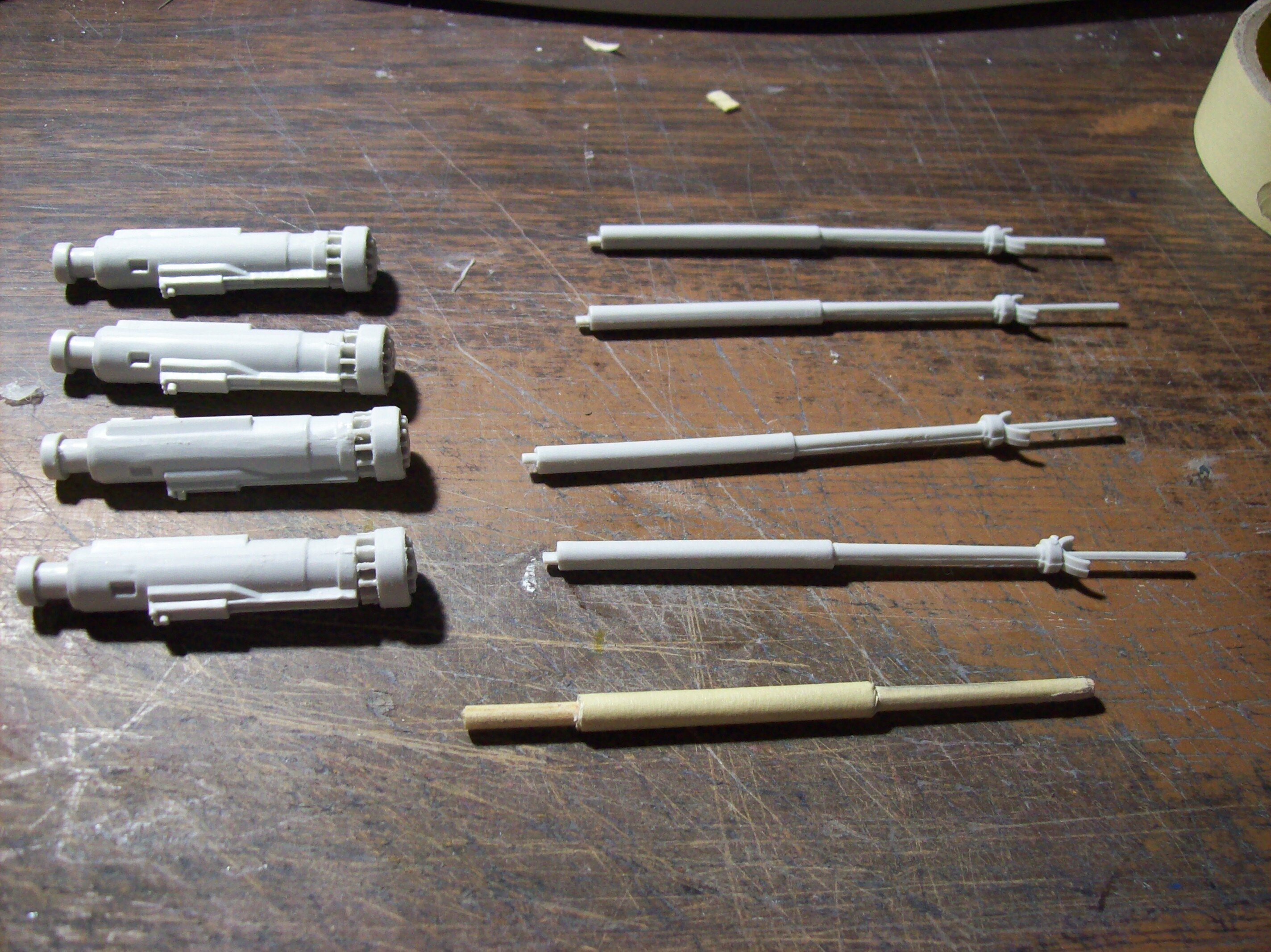

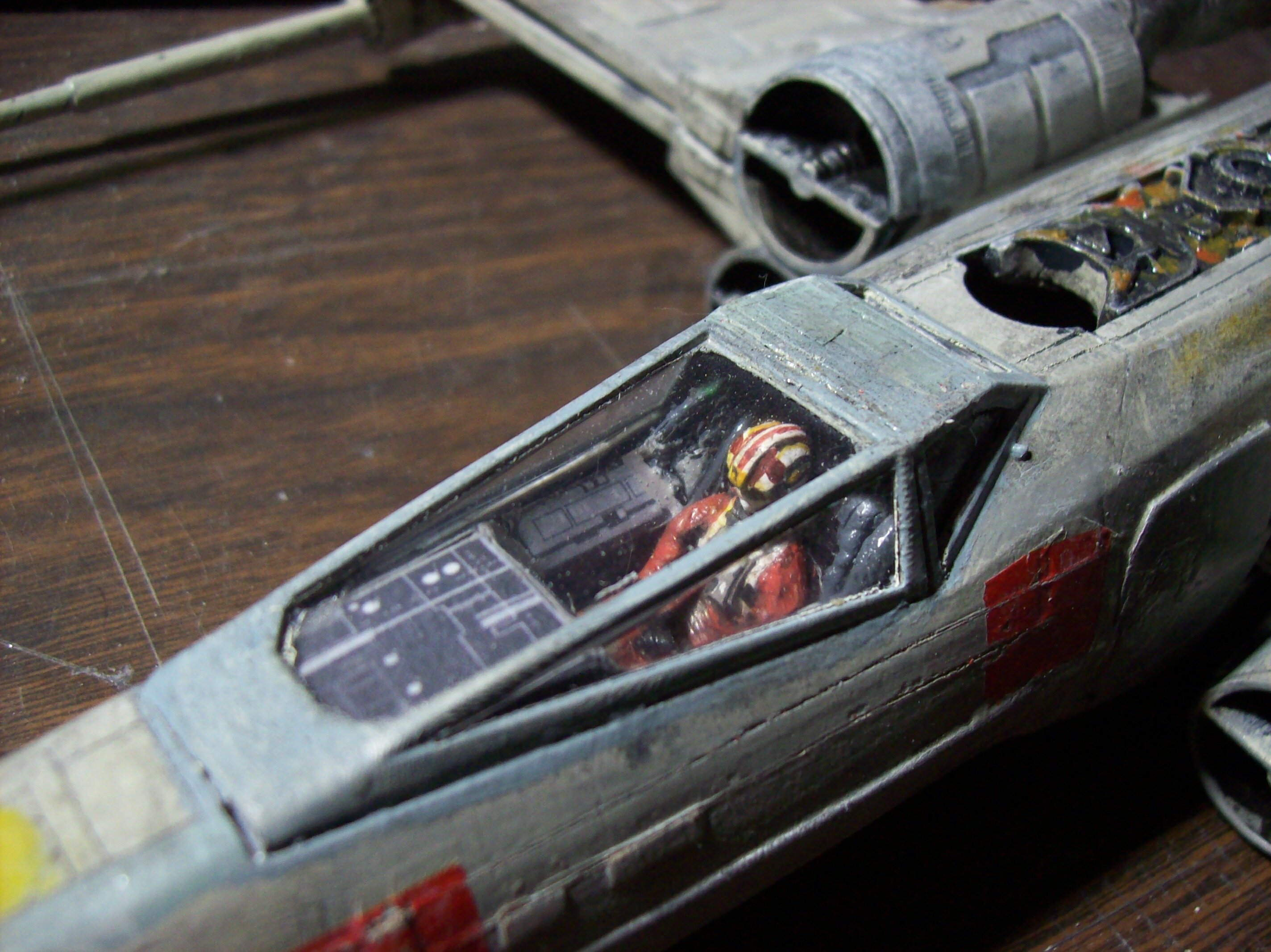

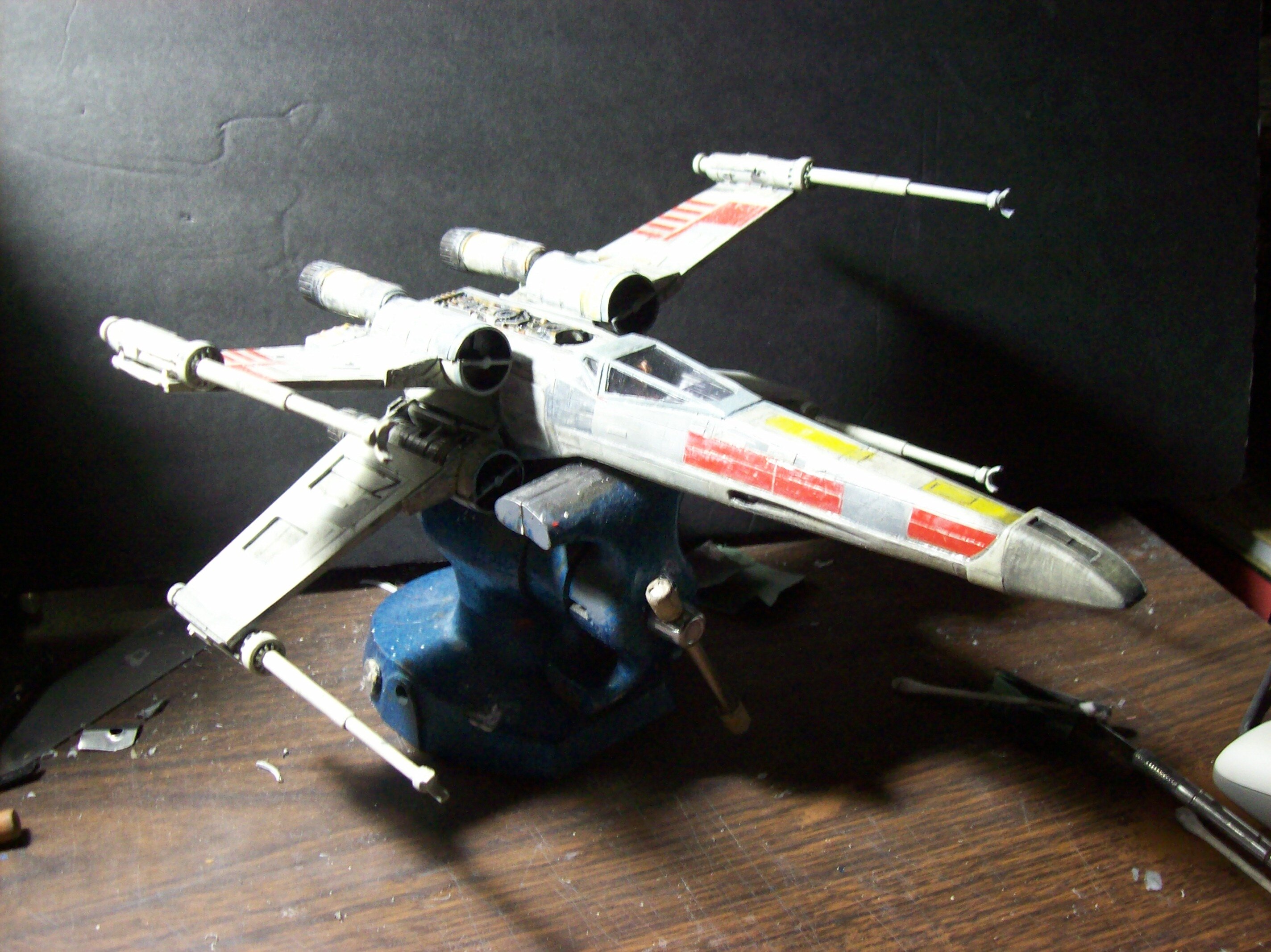

Thanks: I really couldn't get over how that pilot looked. As it stands, I forgot to post my progress lately, so we'll take it in a few chunks:-
1) I redid the barrels on the laser cannons, as I recall a sneeze could snap the plastic on them! Wooden dowels, which are then covered with masking tape. serve as the new barrel, with the old tip glued into place:
100_0610.JPG.8841f22a526cee7acb5e305e31c5af9c.JPG100_0611.JPG.cdfef85508802109895cac2c2b3f7397.JPG100_0612.JPG.fa9b70645ecb198e00ff3101d52ef389.JPG
100_0613.JPG.6fc806a3e832f2a9c2726d5ccacb7870.JPG100_0614.JPG.cf3cf271880e660fd76106466f432a22.JPG100_0615.JPG.73ba80eb2a6f63580ab9c8e89655162b.JPG

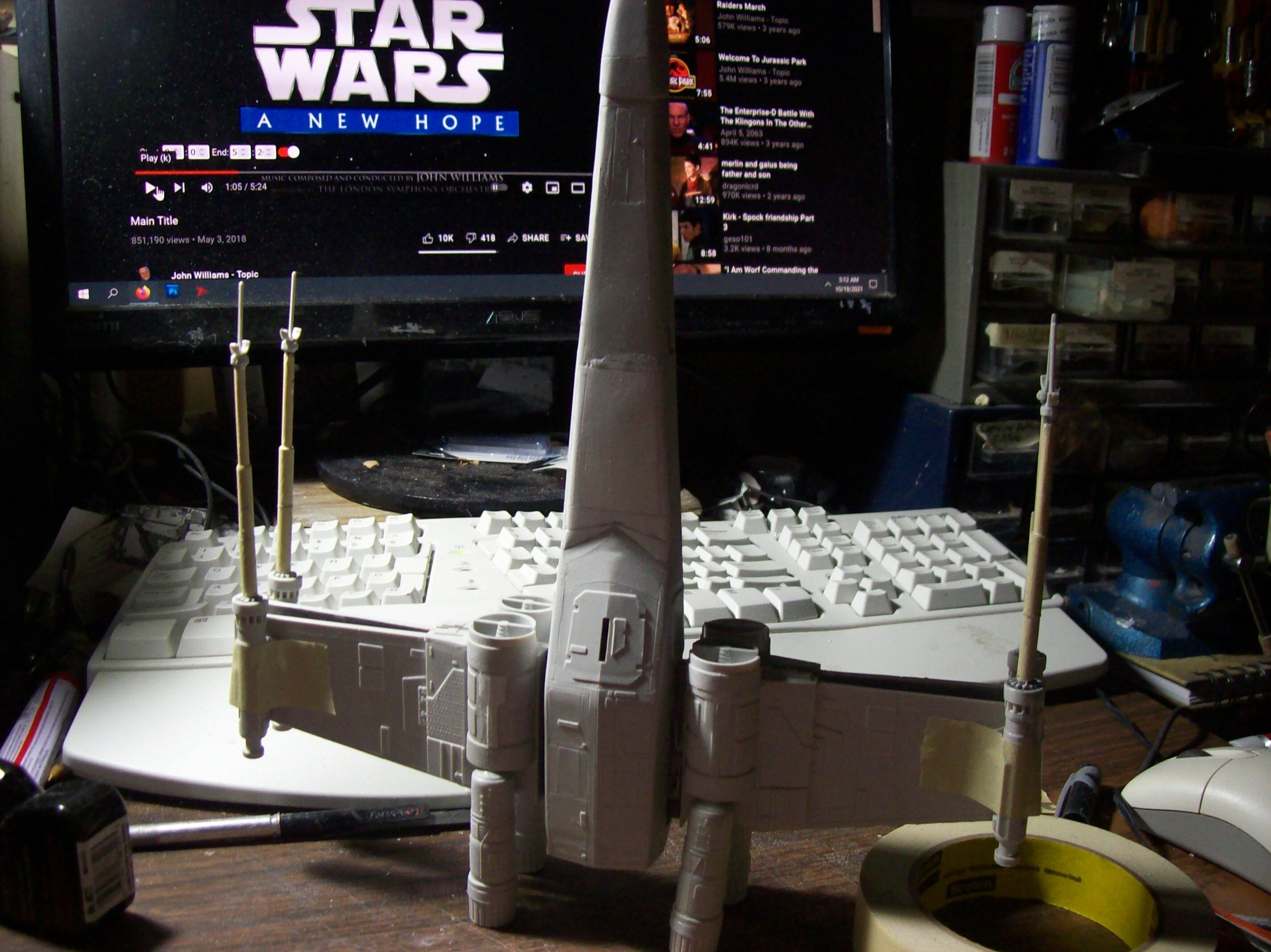

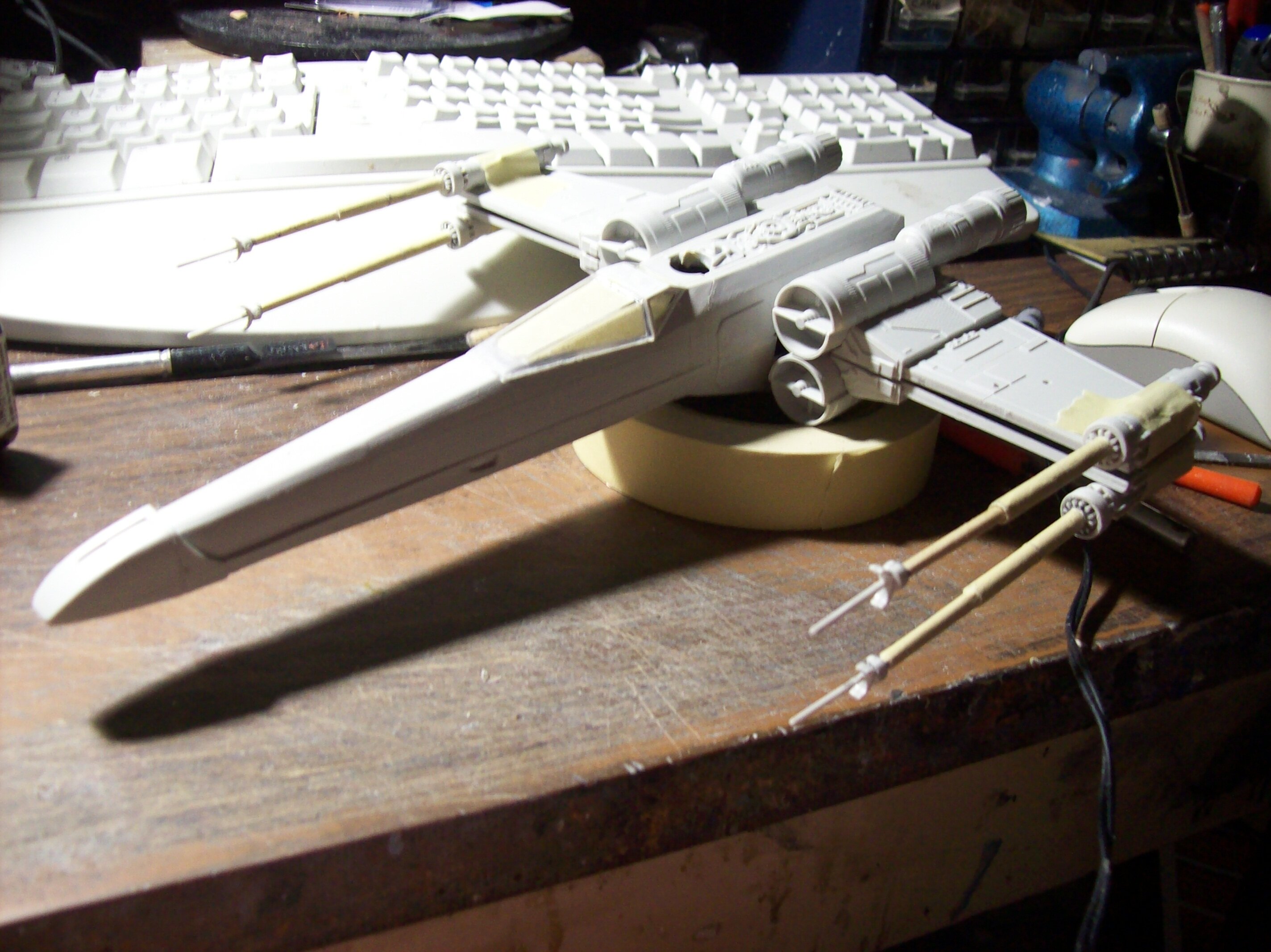

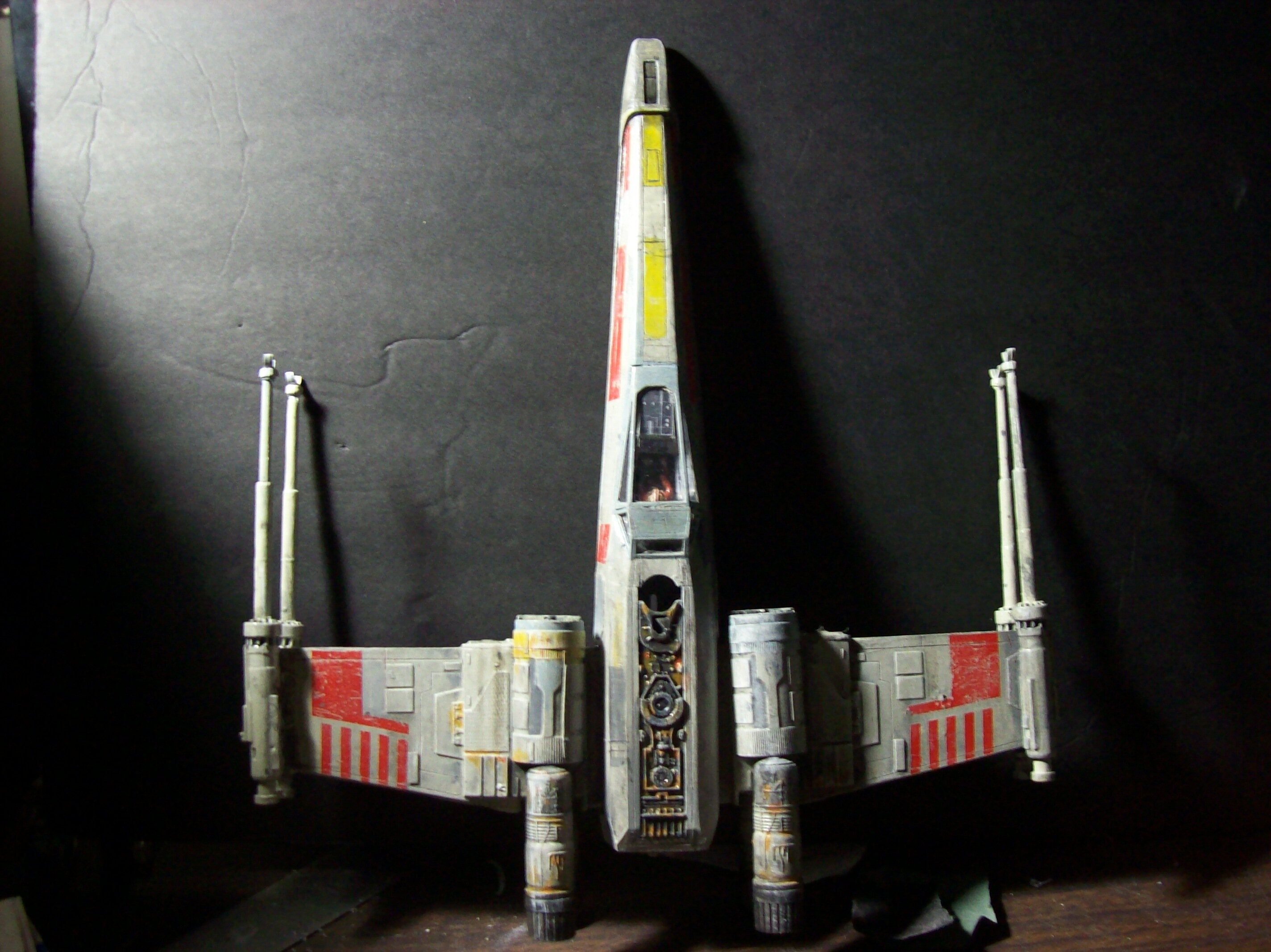

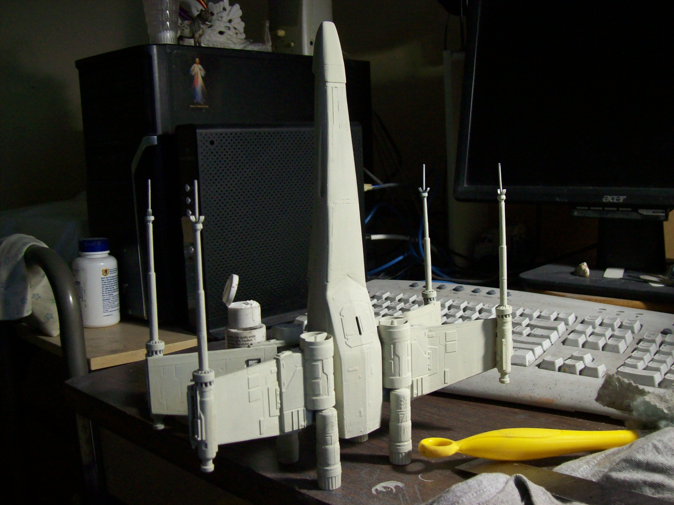

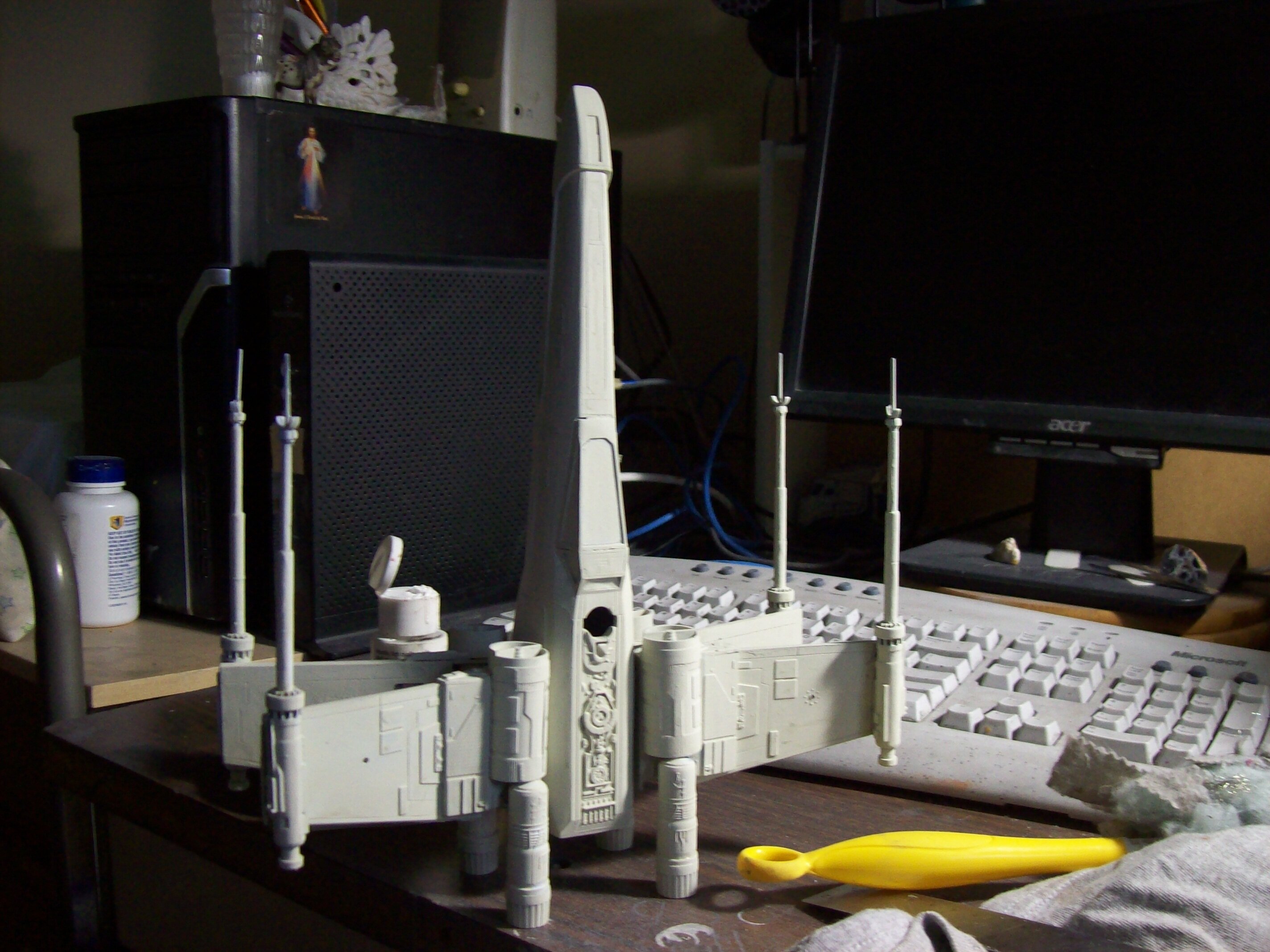

2) Now, the X-wing before painting:
100_0616.JPG.771b5ec7f1ced728e6ae8167ce2558f1.JPG100_0617.JPG.4d0246551d3ee1382d536b3e0870a87d.JPG100_0618.JPG.e316948fd65d21e42892e8b5ce4de143.JPG100_0619.JPG.bc292f2c97c3d43ac8d96cf2087ceeba.JPG100_0620.JPG.2f3cbb67832f78e38859384e426fcb26.JPG100_0621.JPG.ab723f4e30442205f88cd8fa601d6cda.JPG100_0622.JPG.102ecc03c2c00bd75f683a6a04d32a89.JPG100_0624.JPG.a735c03c2e28ae2c1393255227482719.JPG 100_0625.JPG.58408894d6ec3deadd8ab89f5db139a9.JPG

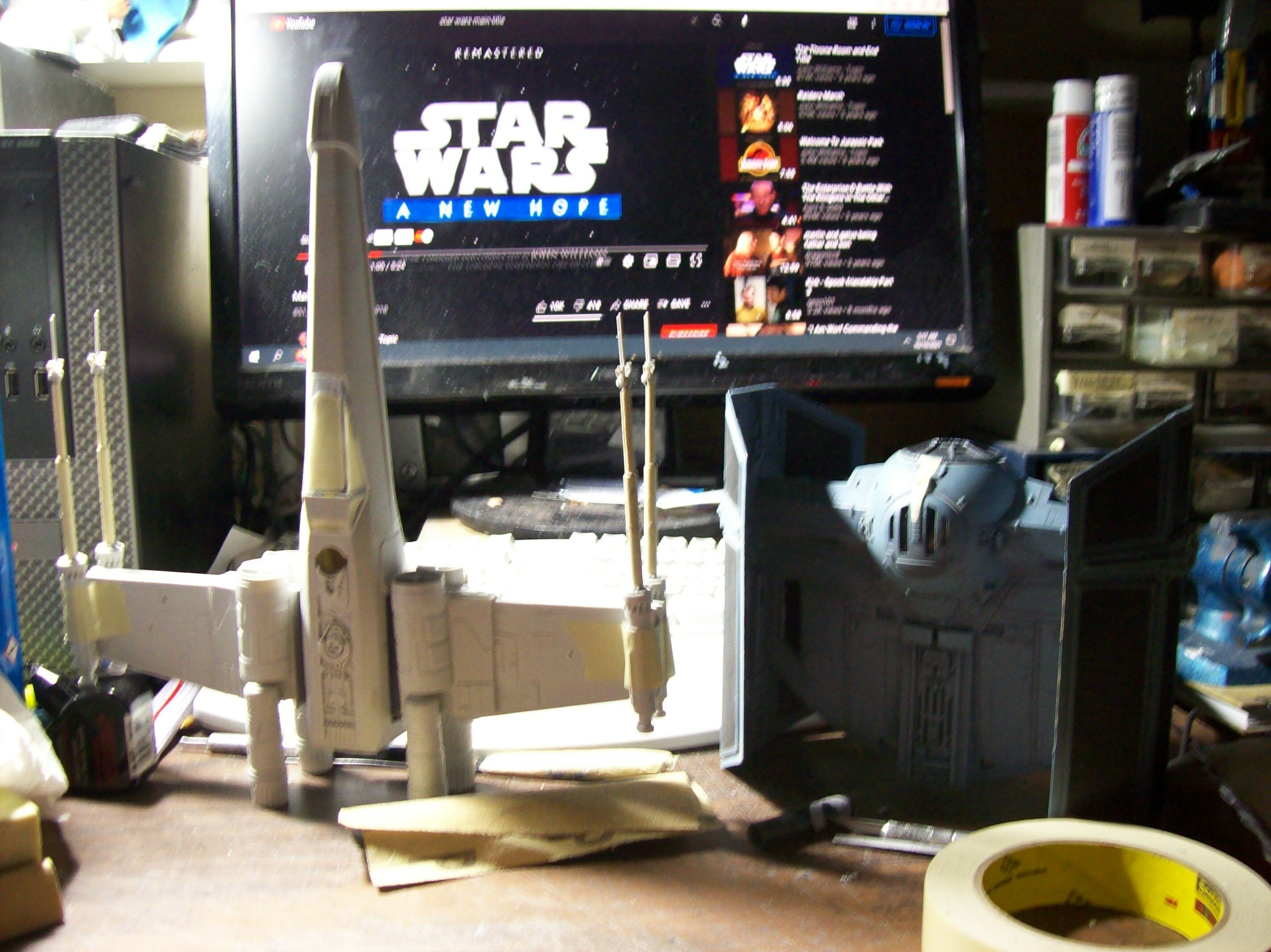

3) Also have Darth Vader's TIE Advanced (it just needs a Darth Vader figure, as it was missing it when I rescued it from the thrift store)...thinking of a possible diorama when the X-Wing is finished:
4) Painted up (missing R2 at the moment):
100_0626.JPG.74d416e08a83a18dc281c68a1867259b.JPG100_0627.JPG.62a37a0cc0f63eca11d5c8fc03ff7836.JPG
100_0628.JPG.b90935cda7bba0806e8393f0037b97bf.JPG100_0629.JPG.584ba86806d798e700f9c0f5579bb2ee.JPG
I know: the paint job sucks; I'll be working to refine and fix it. I still need to do post-shading,m panel lines, panel lightening and a whole bunch of other stuff.
Stay tuned...

@Rock Looking good! Those narrow wings look like they'd never hold that ordnance in real life😧
@pengbuzz Your paint still looks good and your pilot and cockpit work make it that much more realistic! The laser cannon mods were a good idea! They look like how model propeller blades are - always breaking if you just look at them! - MT
Thanks @MechTech
@pengbuzz Some great work on that X-Wing! Can't wait to see what you do for the Vader figure!
And @Rock Nora's fighter is looking aces! Love the paint job.

Thanks, I've been meaning to try Microset.
But Minmay came out good enough for me. Very pleased with her.

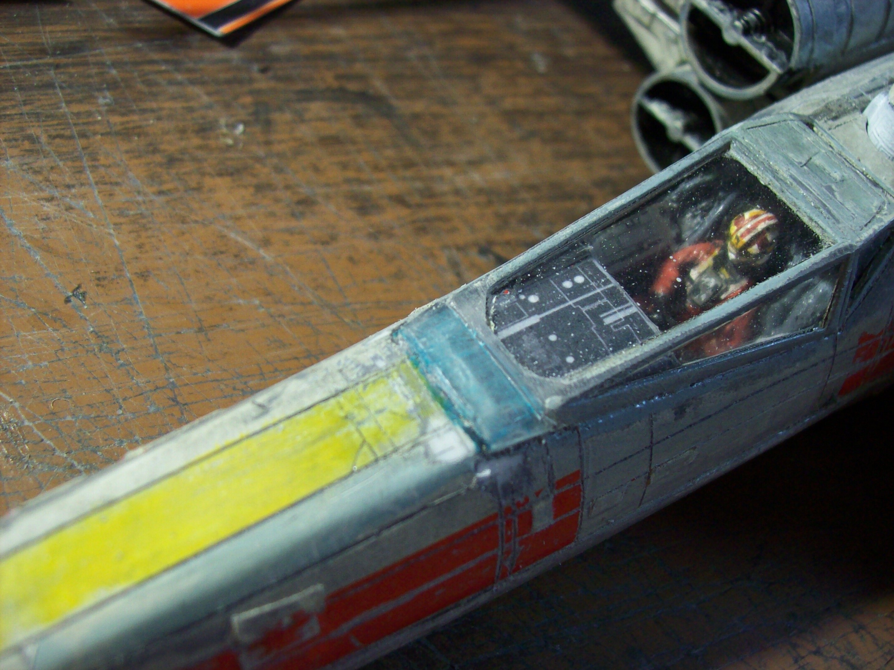

Thanks; I just need to keep working on the outer hull until it meets my expectations. Last night, I went and re-scribed the panel lines on the fighter, and ended up adding about 20% more that were missing (per the blueprints and screenshots):
At the front end of the canopy (where it meets the main body), I found they messed up and moved detail a little further down, throwing off the look of the entire thing. So, I re-scribed the canopy-parting line:
1872350427_100_06291.JPG.93b1b5d6464162d6db66242f13d8d5cd.JPG      418887617_100_06301.JPG.8b671481f76b736a30f5852ac6340799.JPG
Before                                                                      After
The blue magic marker is temporary (so I can see what I'm doing on the clear plastic); a new panel line is inscribed, I just have to hit it with paint.

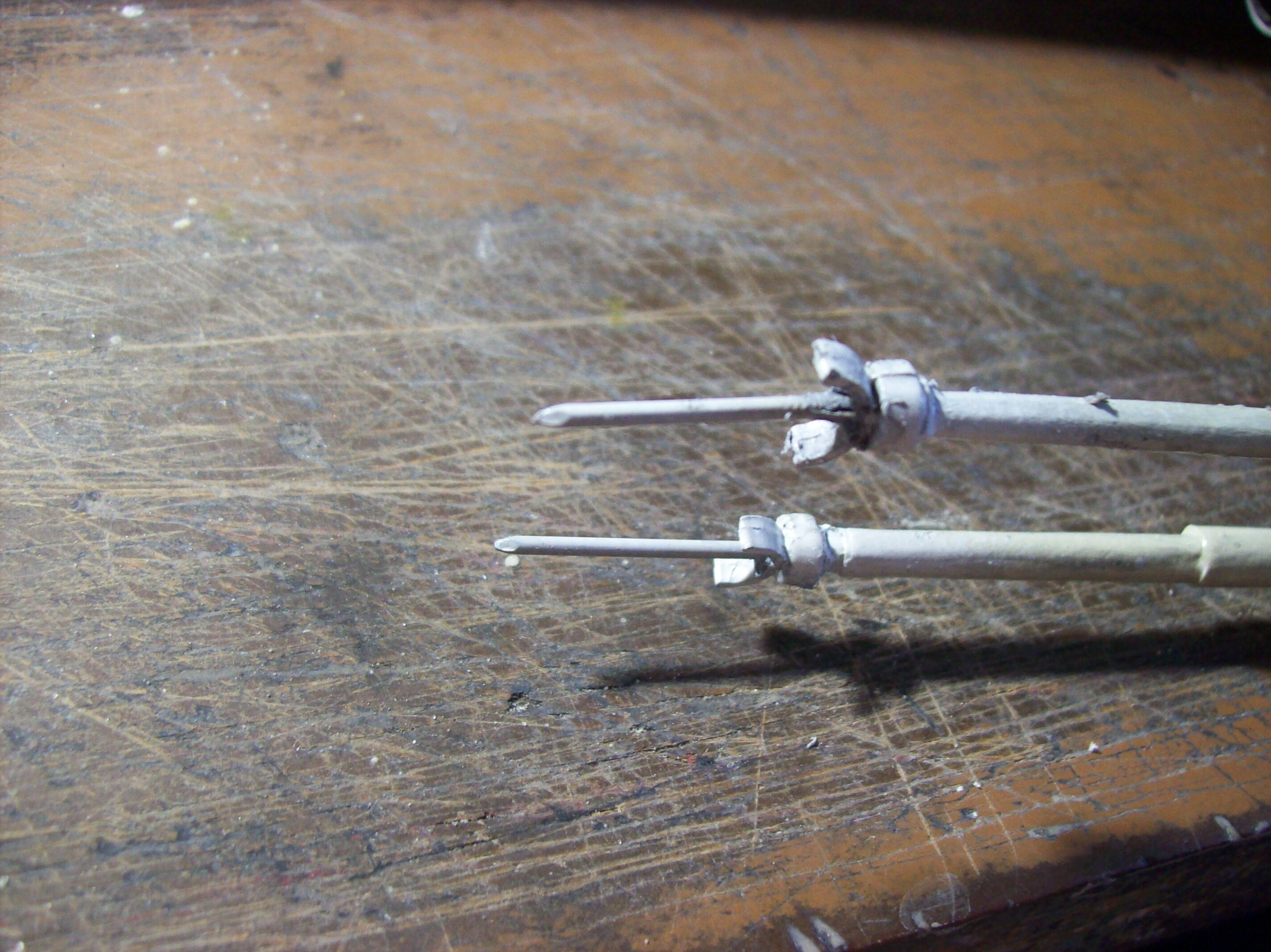

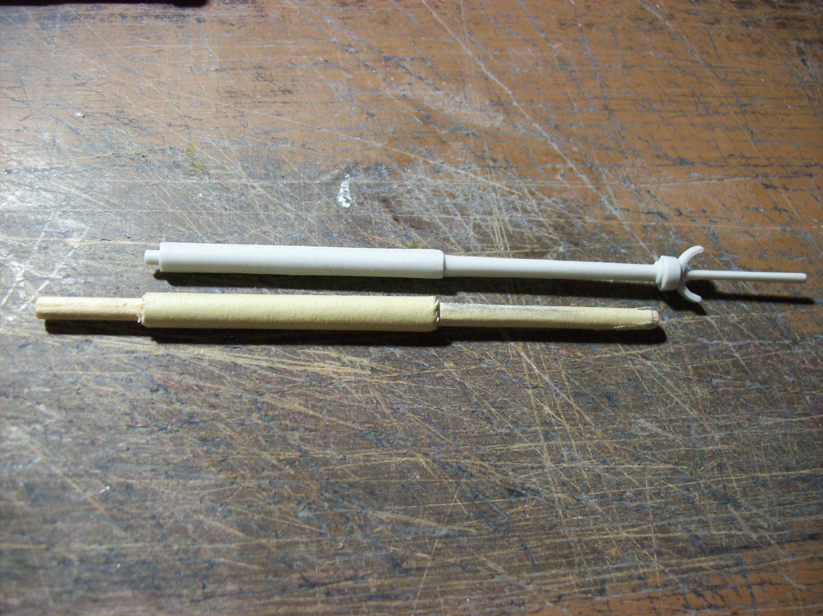

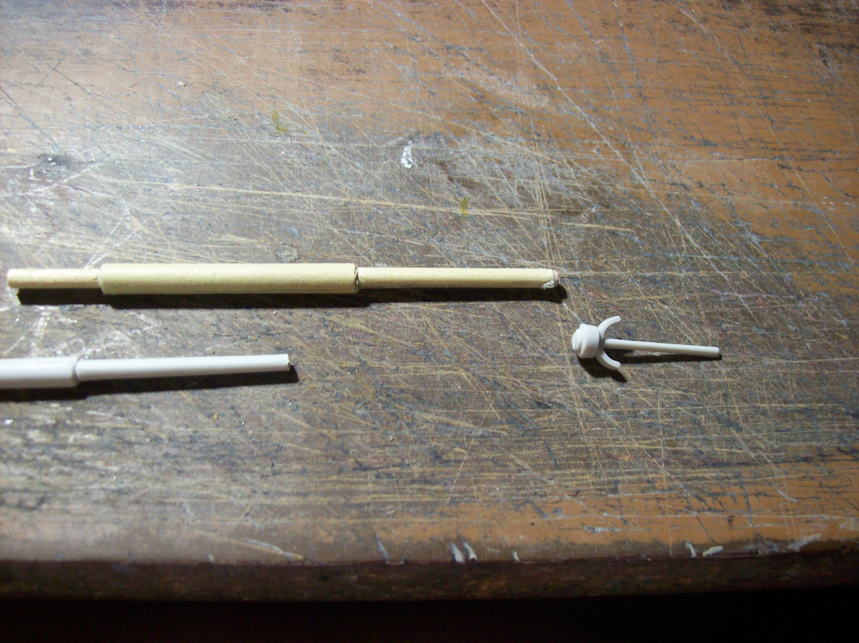

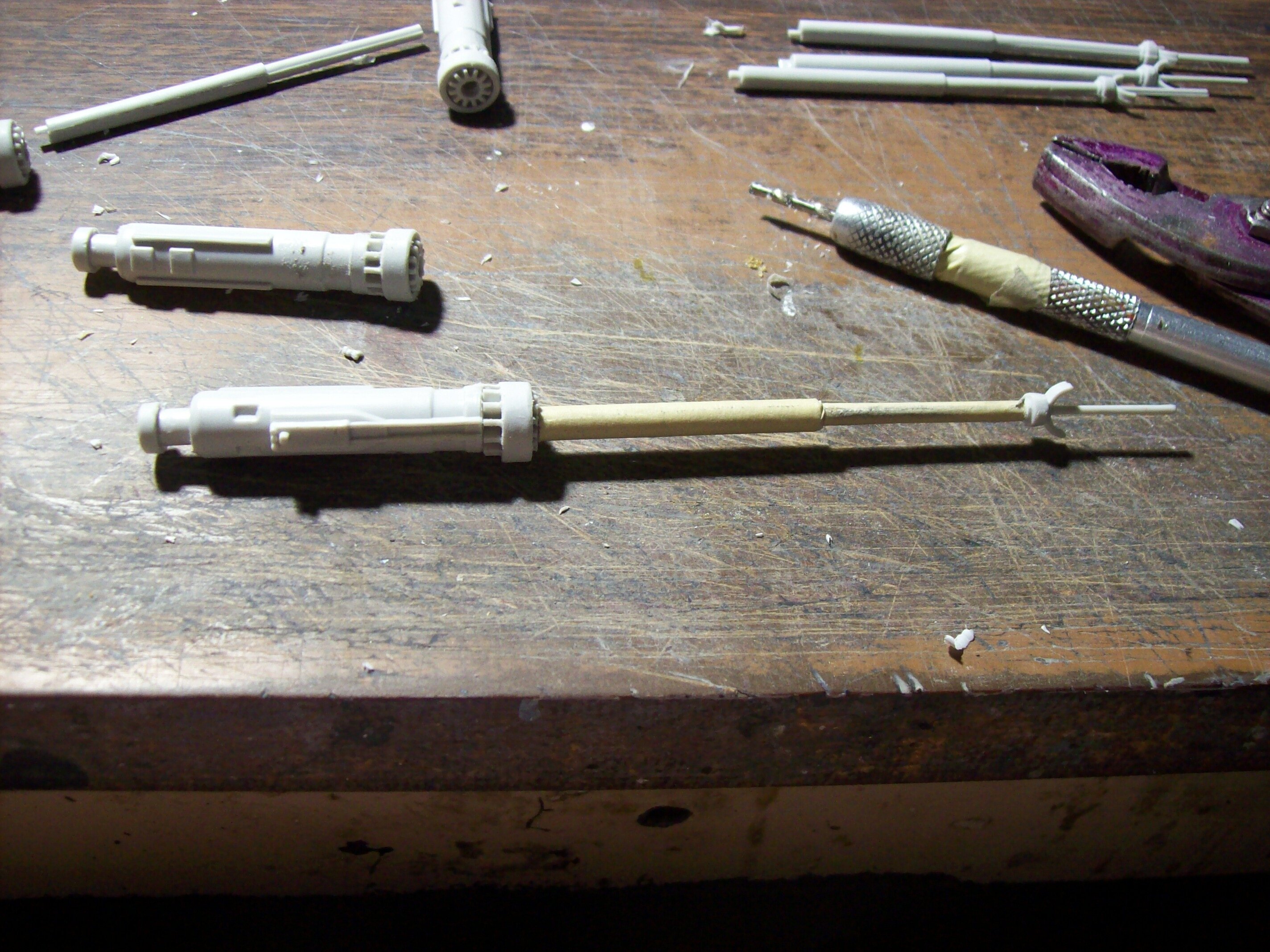

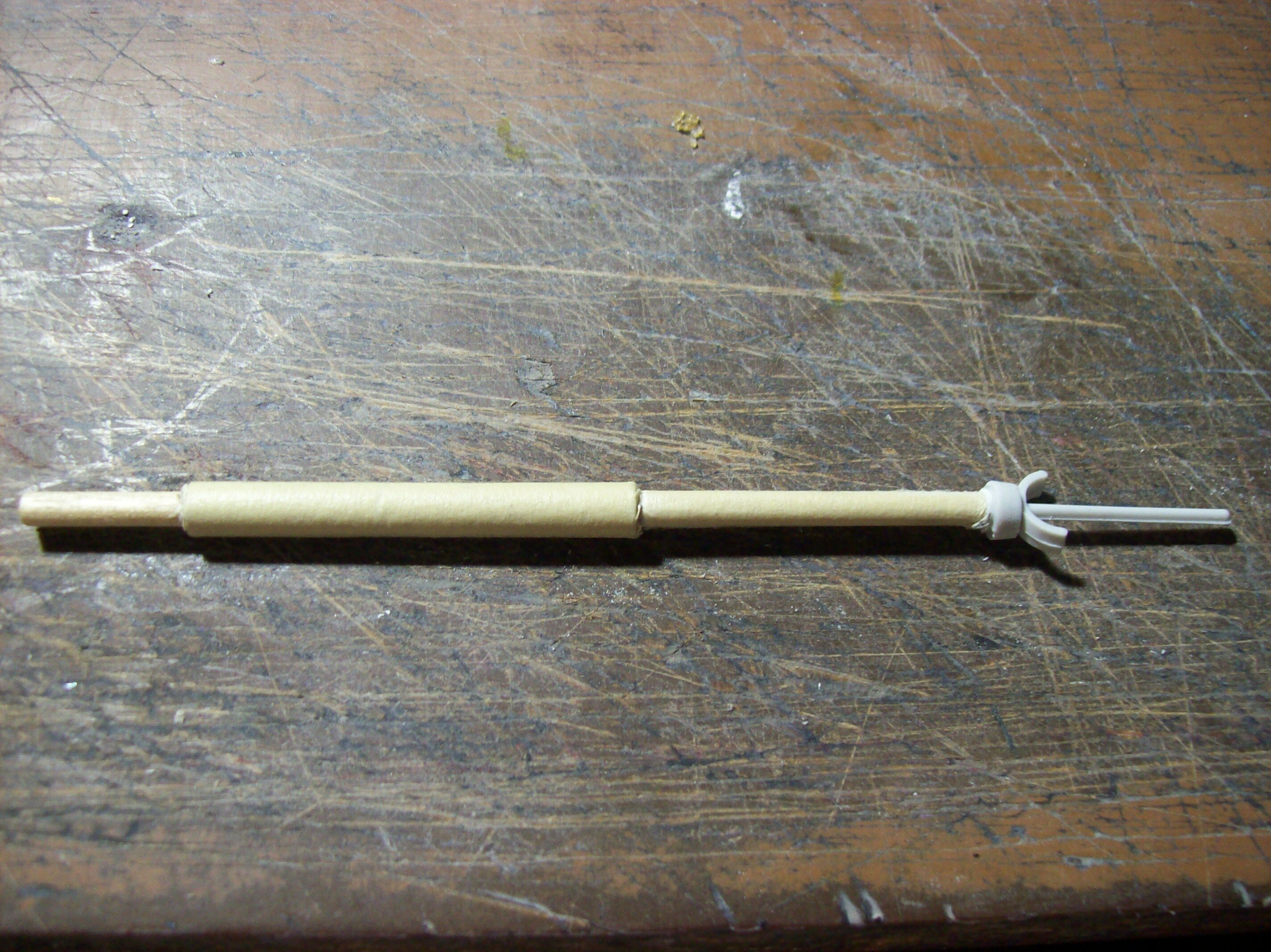

The new replacement laser tips on the S-foils:
Small, wire-nails that I clipped the heads off of, drilled a hole into the remaining laser tip/ flashback suppressor head and glued into place with plastic welder. As a testament to their durability, I accidentally dropped a roll of masking tape and it hit the entire laser cannon dead-on, only to find they were perfectly fine.
The old ones would have left me with a shattered barrel and dust for the tips.
On another note, I got some detailing one with rust on the fighter:
At this point, I'm also working on R2-D2, but I'll go into that in more detail in a future post very soon.
Stay tuned... and pick up your visual scanning folks!

@pengbuzz Your fixes are a HUGE improvement over the stock parts! It looks much better!

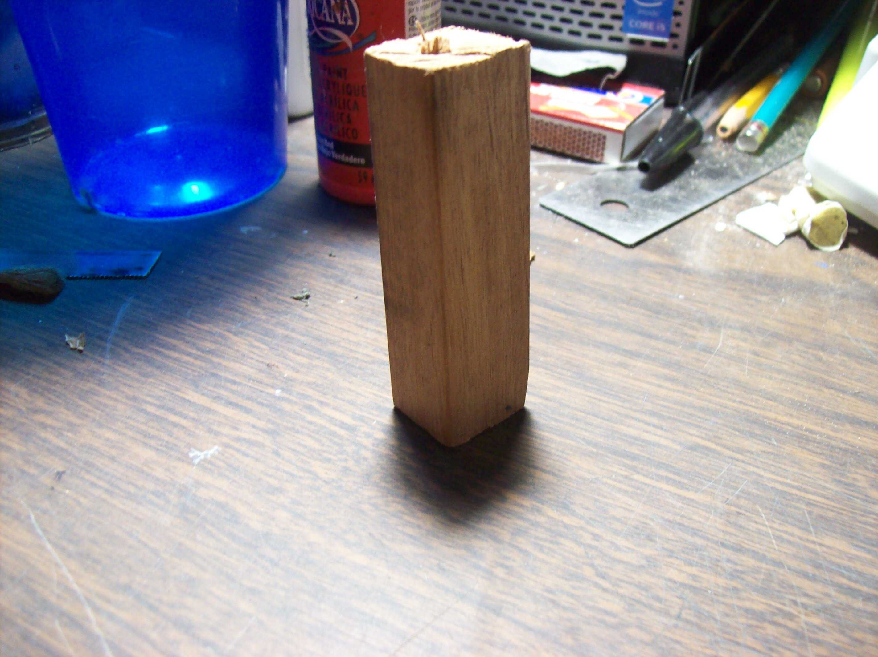

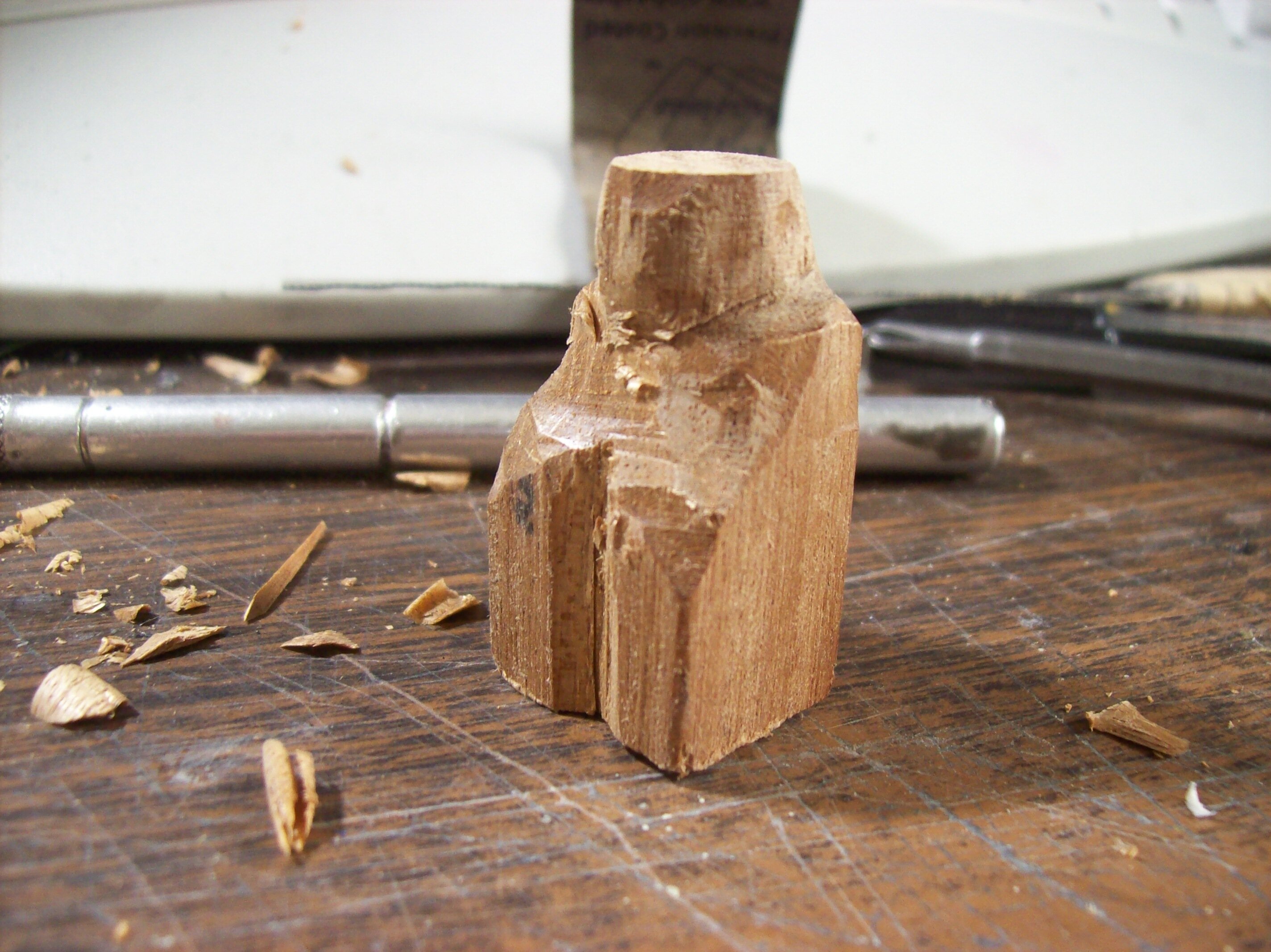

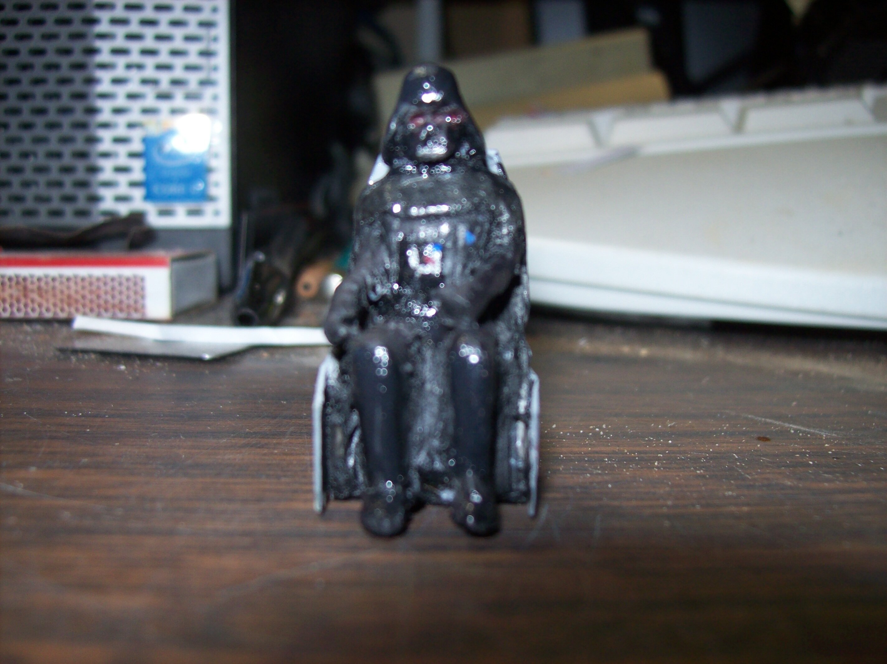

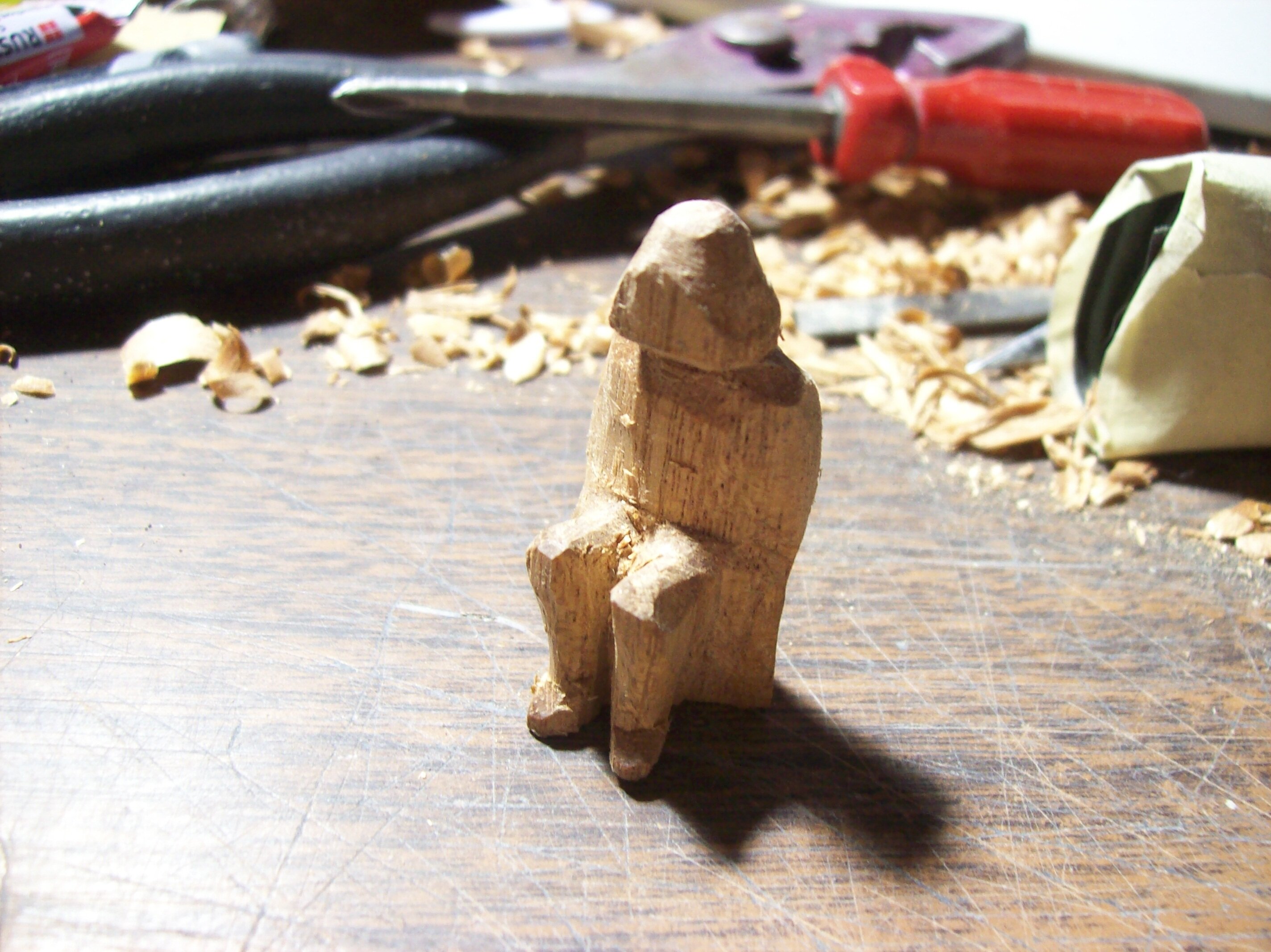

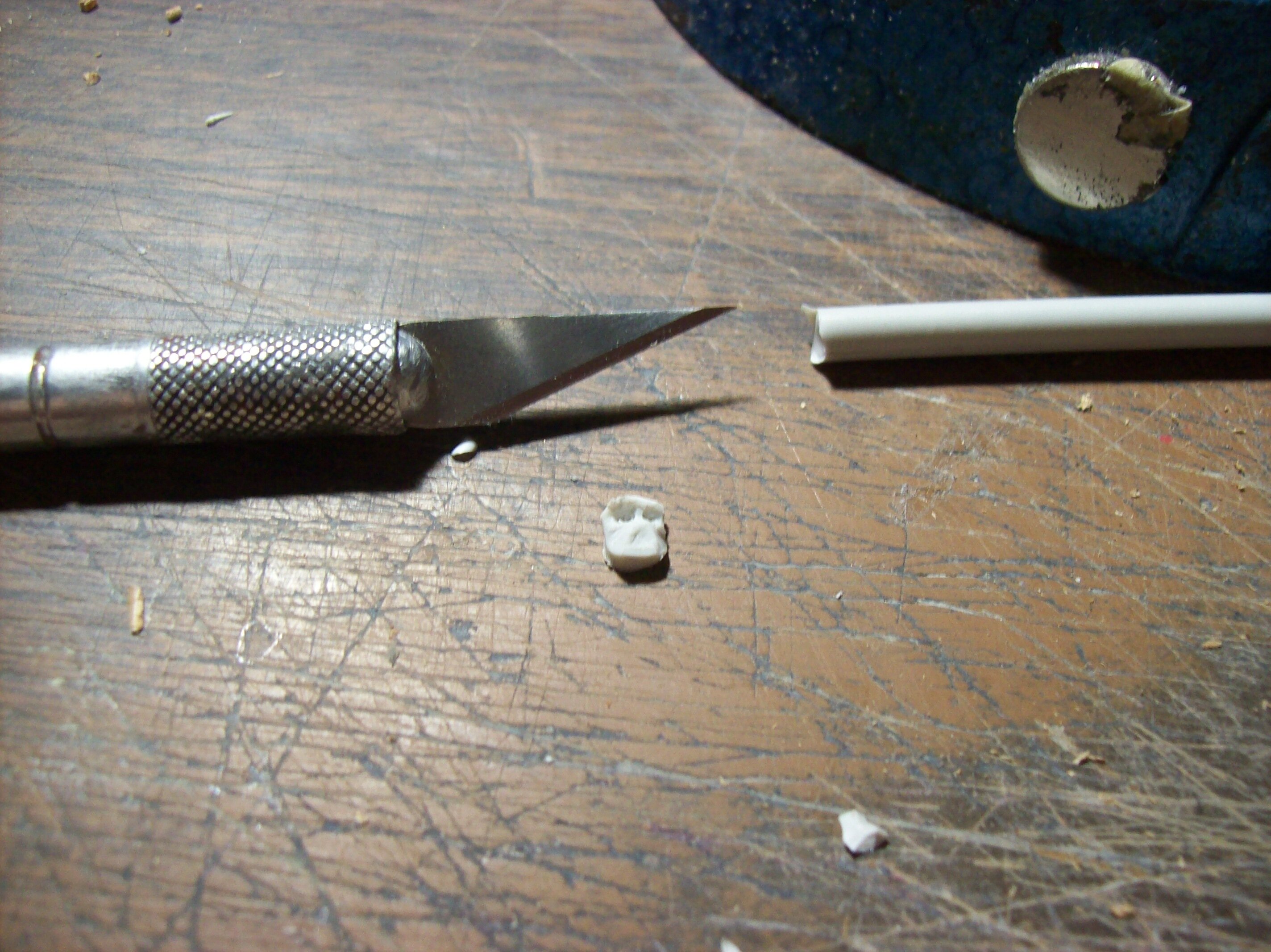

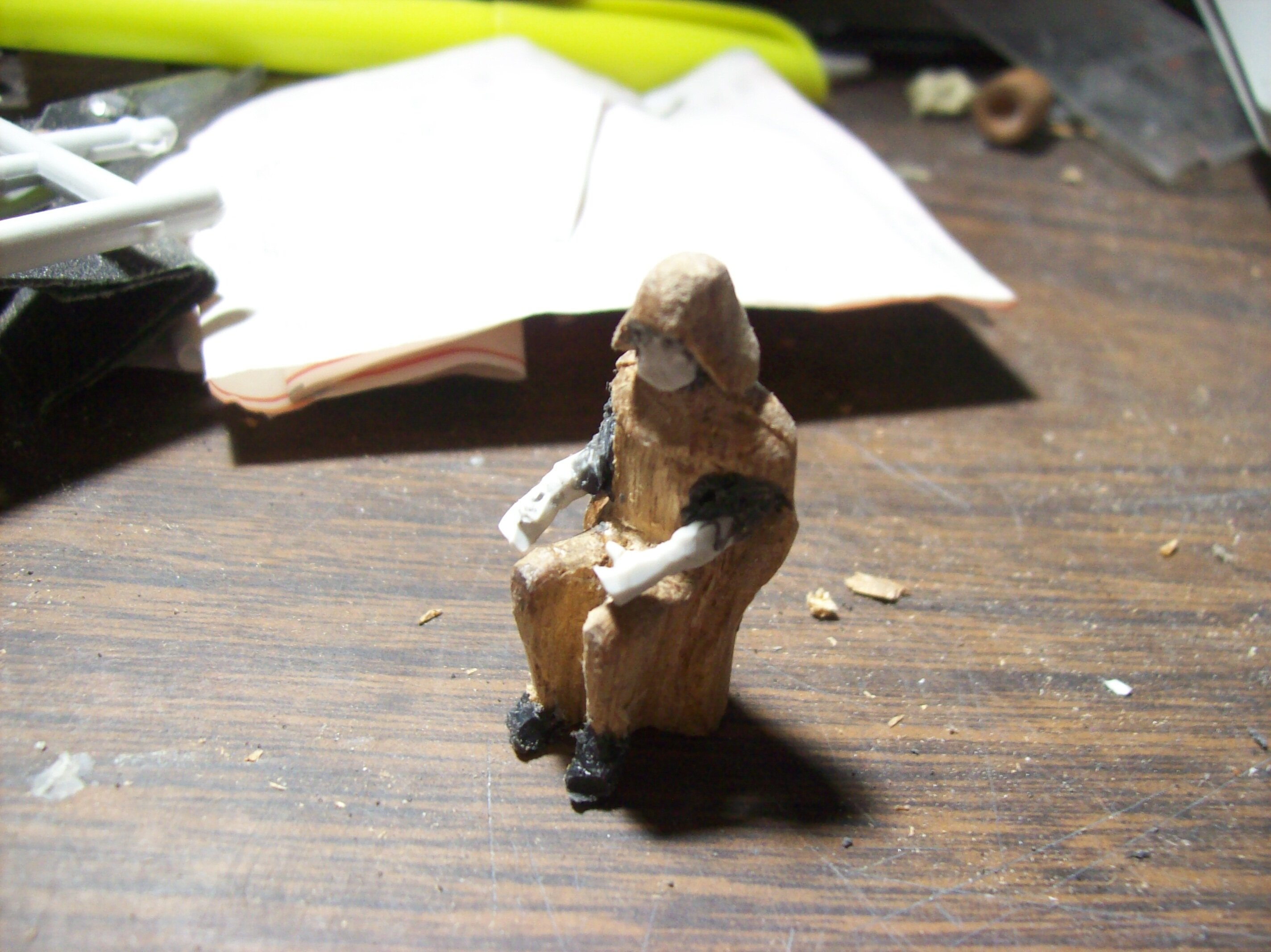

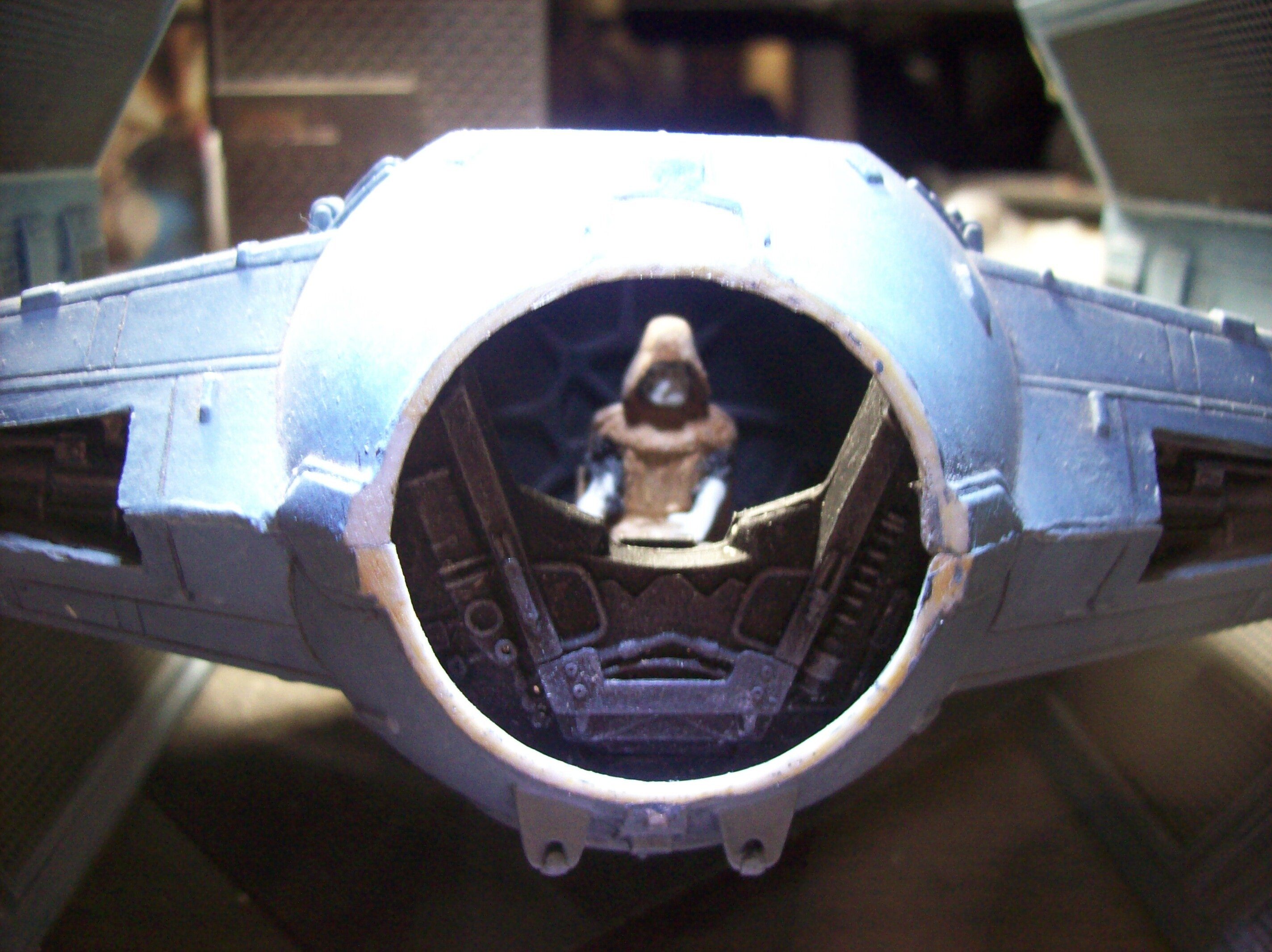

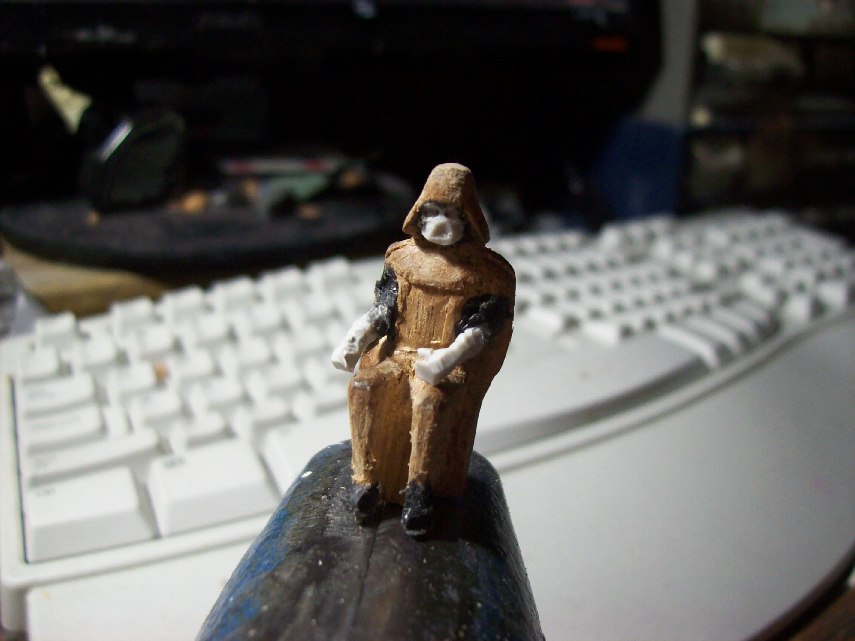

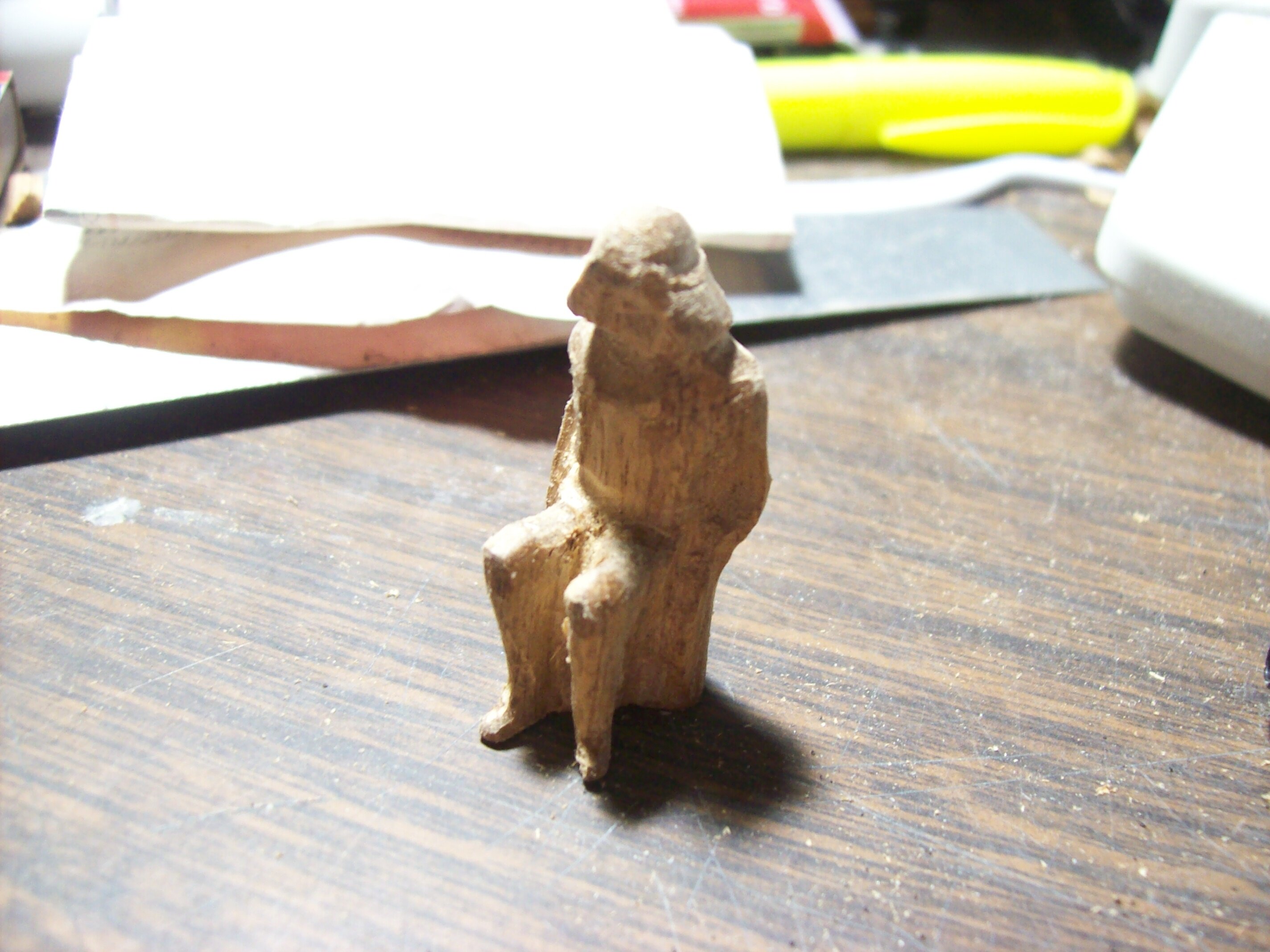

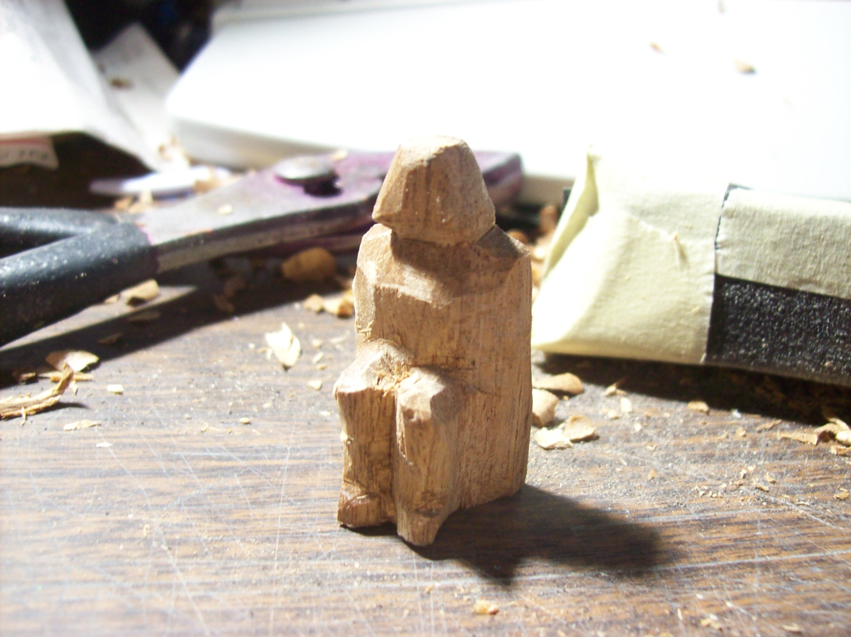

UPDATE: how to make a Sith Lord-
Primary body-shaping:
100_0634.JPG.fa7ccf489c49cb53a38640472234e486.JPG100_0635.JPG.dc10bc9b35449ed5f2c80fe5bbea355c.JPG100_0636.JPG.32deabc66a153b6f4ccfa65640b2f836.JPG
100_0640.JPG.929ae9cd68fb670196948f41bc10ddd8.JPG100_0643.JPG.ad986f2fe14e821b739644f91f4c8b2a.JPG
Making Darth Vader's mask:
Addition of face, arms and front view so far:
100_0647.JPG.42d1114ef06adaa71714ed32e5147eac.JPG100_0648.JPG.667184faf35a0709eb8d9d5cfd6d0234.JPG

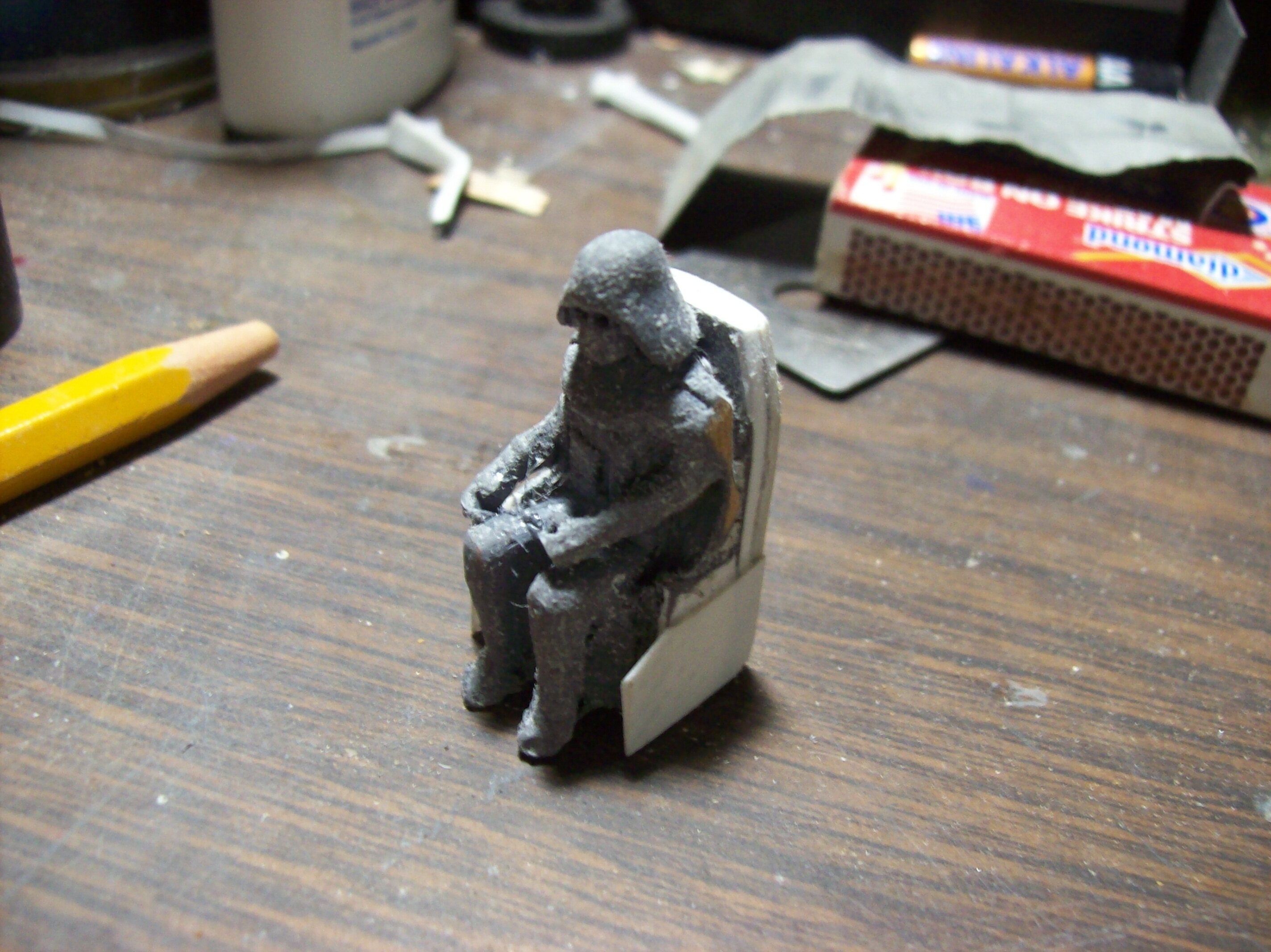

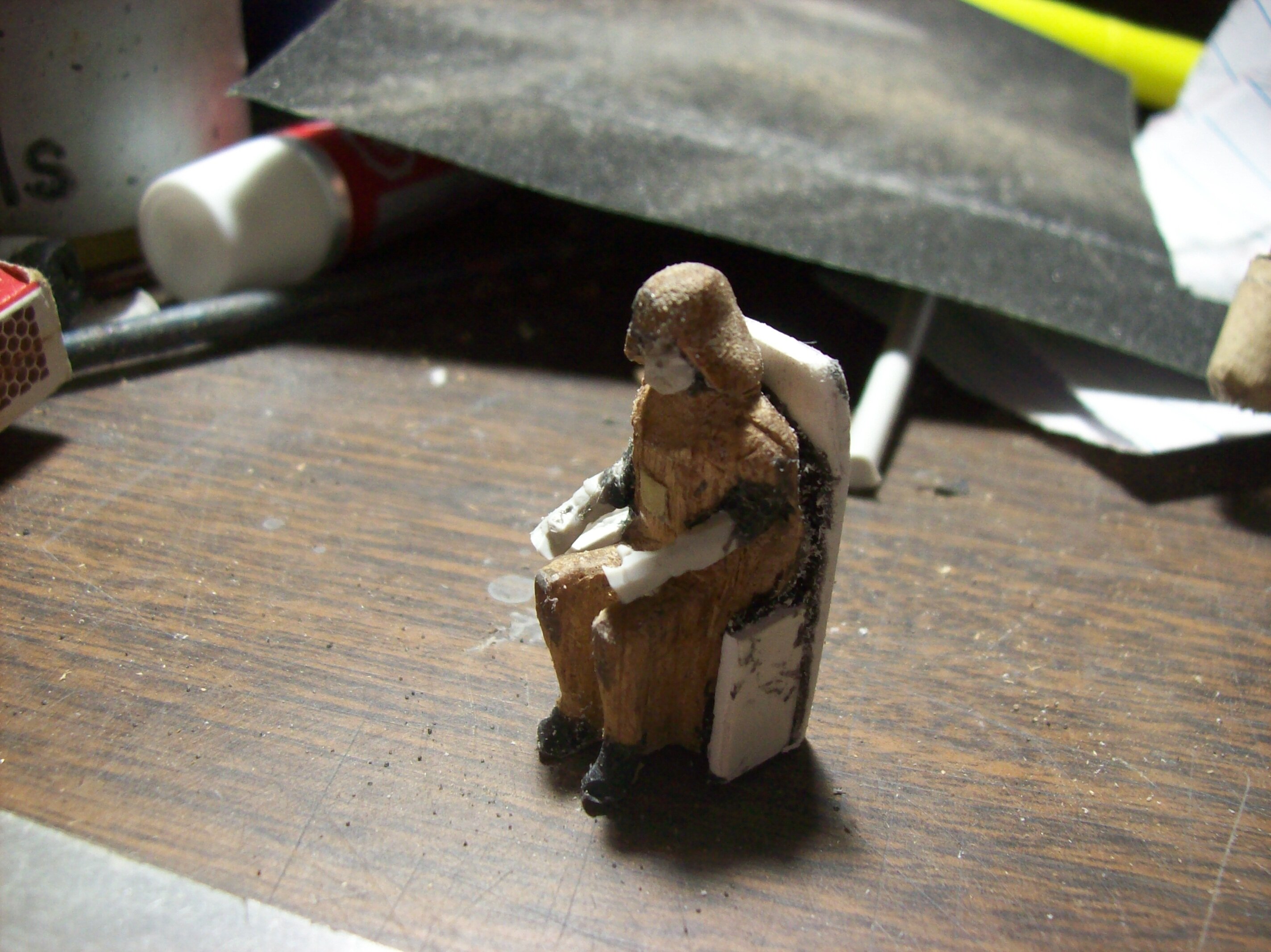

TIE Advanced X-1 Cockpit test fit:

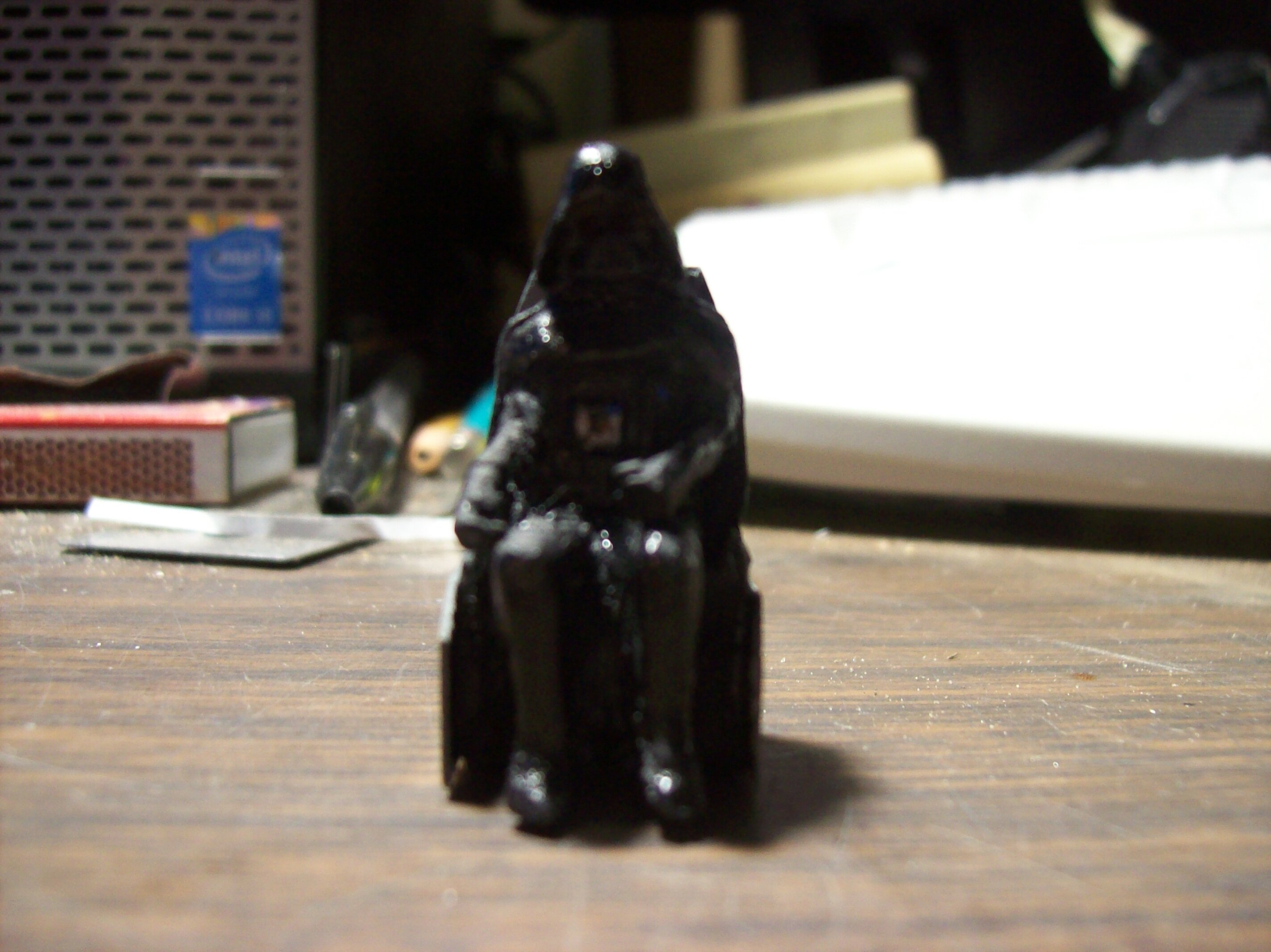

Final refinements, chair building and paint:
100_0650.JPG.f644e92293916802862ee1cf506fe0f0.JPG100_0651.JPG.d76c67215279a41fdef8de256514787a.JPG100_0652.JPG.6f5ca1a4bc14efdb38a249f727997be1.JPG
Front view without and with camera flash:
100_0653.JPG.e9e3502eb8ef86aa15829cd68450c766.JPG100_0654.JPG.eb5393f61e0682f51136a337cef6e764.JPG
As of right now, Vader has been installed int eh cockpit of his TIE Advanced. Pics to come very soon...
Stay tuned...

@pengbuzz Who needs a 3D printer when you got Pengbuzz!!! That is an AWESOME sculpt!!! And better than what probably would have come with the kit!

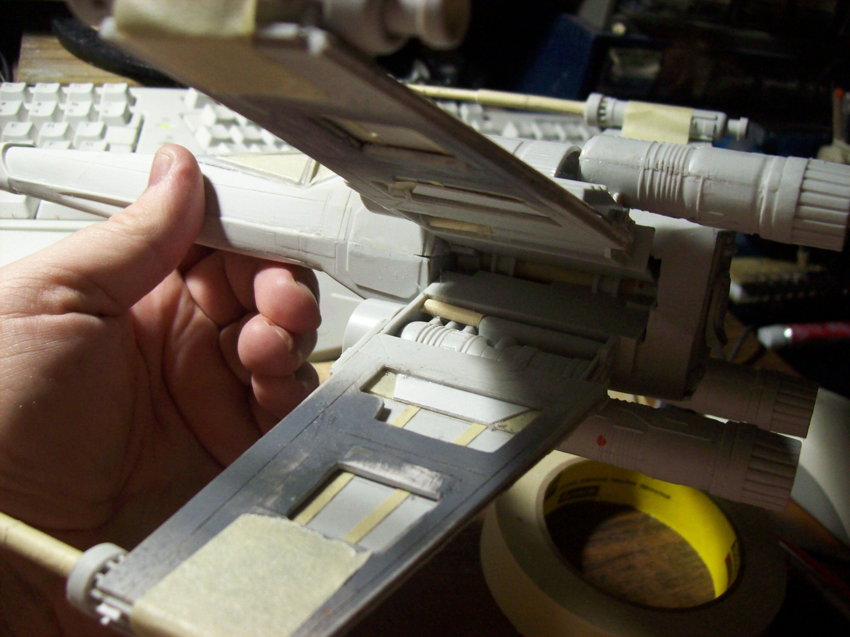

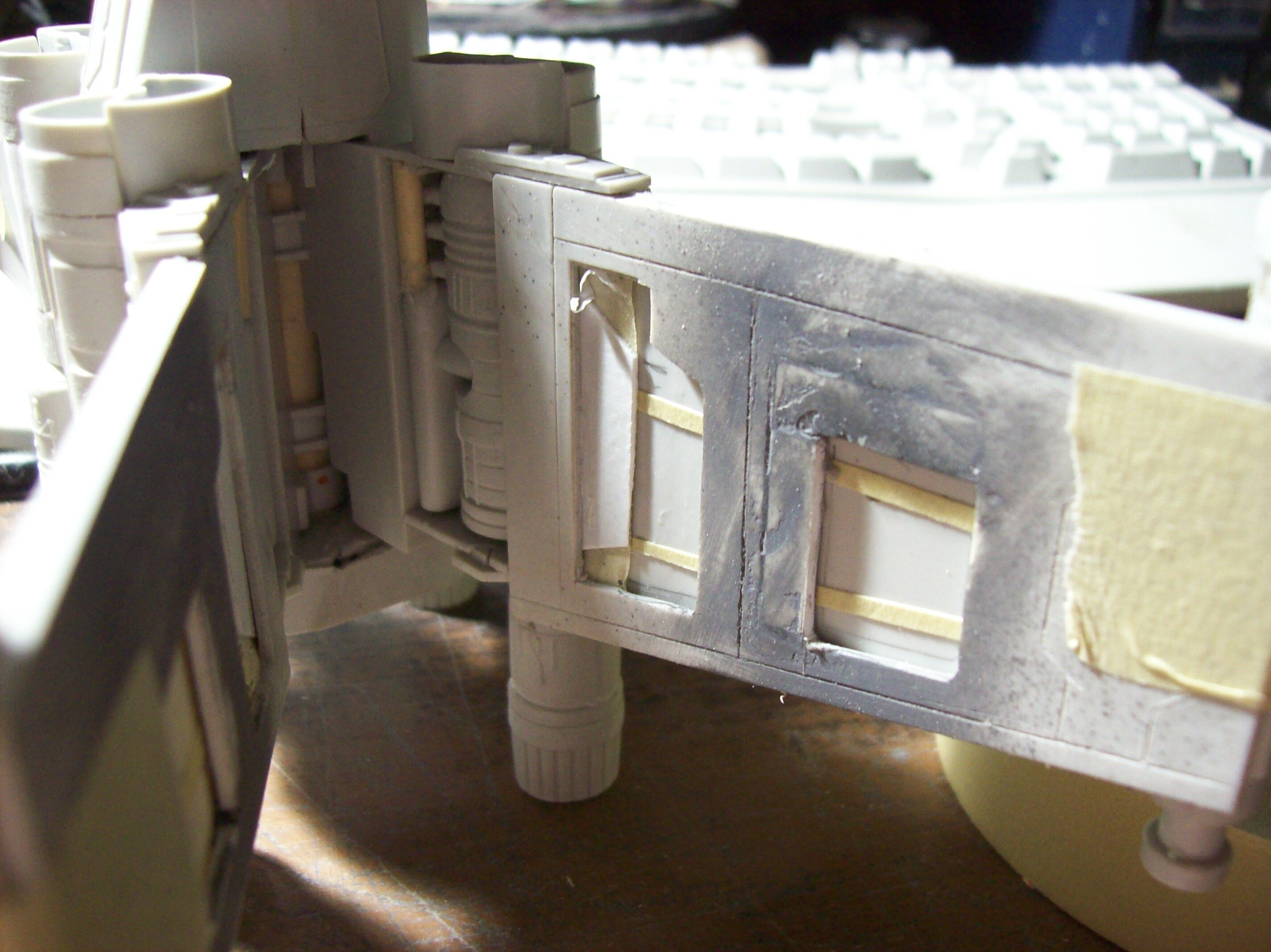

Thanks folks, but I'm not that blasted clever: I had a MAJOR setback tonight on the X-Wing:
The area right next to the pivot for the wings is very flimsy; one thin layer of plastic attaching at two points is all that holds the wings to the pivot roundels. Even reinforcing with Plastic Welder leaves them too flexible for my tastes. And I had gone through great pains to try to ensure any sort of weaknesses would be addressed before I sealed the main body up.
So instead, I had to cut along panel lines and break open the work I did sealing the main pin into the extra walls I had built. I truly hope that the wings firm up with addition of more plastic welder; at 10 bucks a tube, that's my modelling budget for the month right there!
Redesigning/ rebuilding the pivot and wing attachments would be a howling nightmare,  and "just gluing them into place"...
...I would just as soon smash the thing to bits with a hammer.
Anyways, more to come...
@Thom I got you! Yep, we know its in there!
@pengbuzz Whatever you do, don't toss all that great work in the trash! That joint is hardly visible anyhow. You could probably paint those areas all flat black and no one would be the wiser. If you can scratch build an awesome looking Vader, you can fix a battle hardened X-wing! - MT

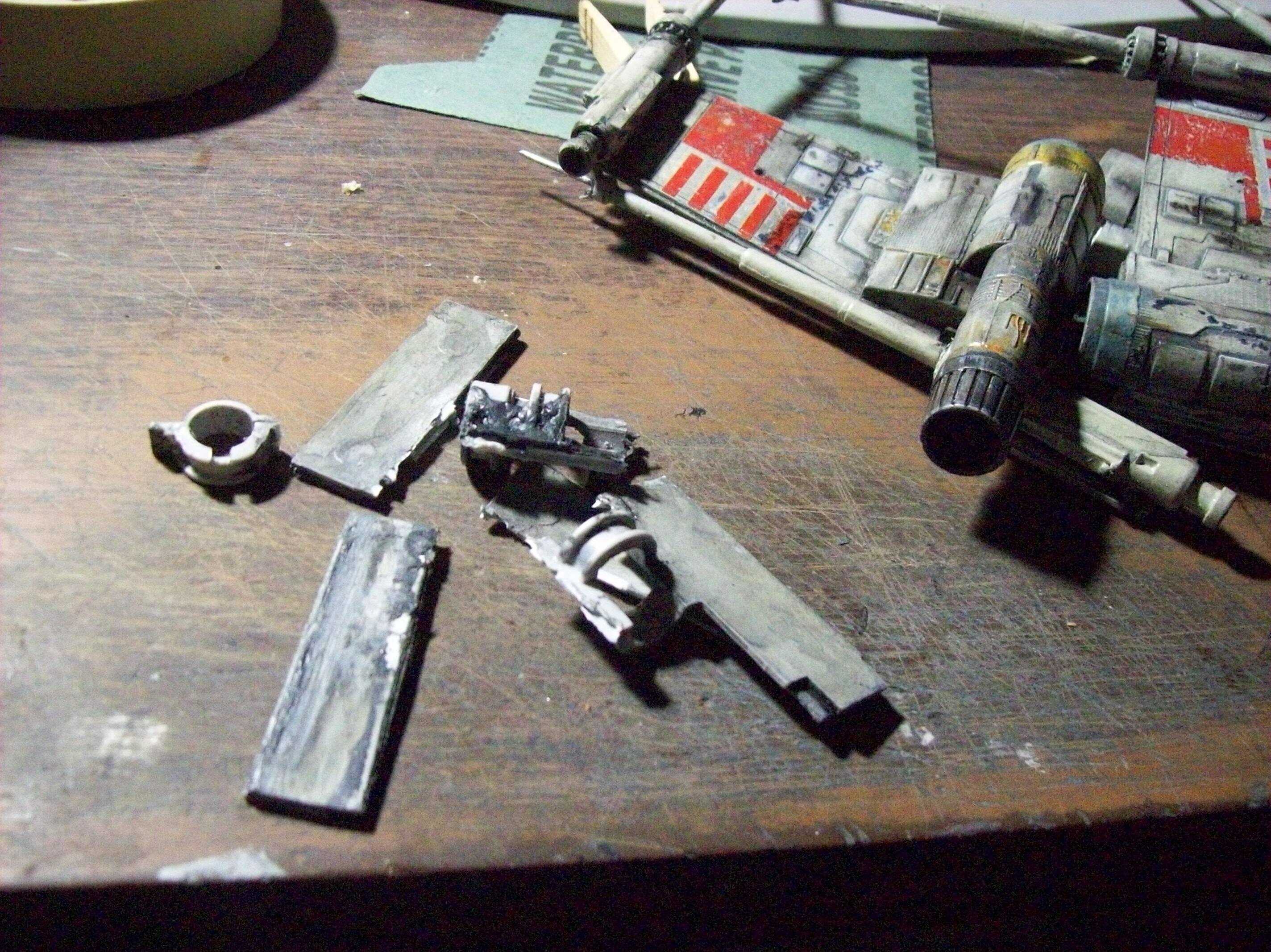

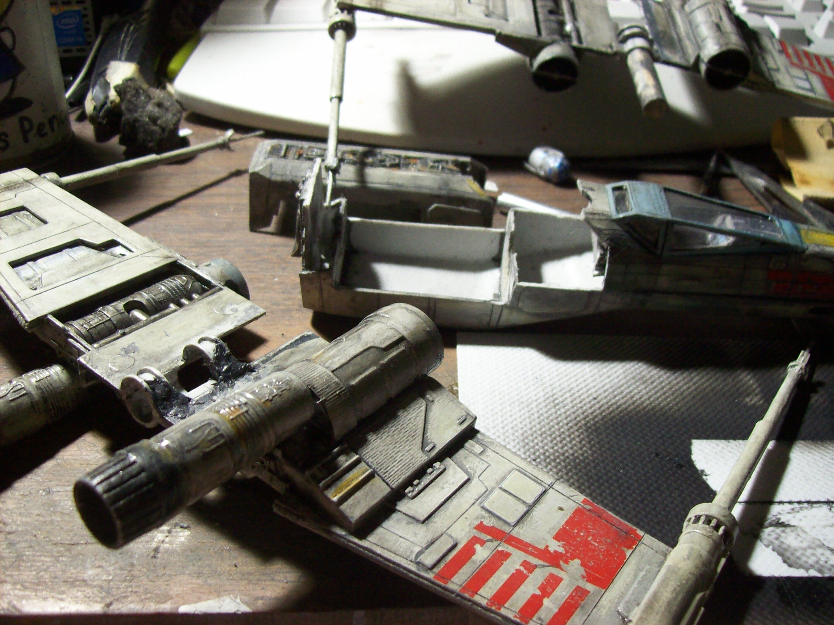

Thanks, but the wing joint completely shattered this morning:
However, I have no intention of tossing it all in the garbage; my comment about "smashing it" was in relation top the fact that I do not want to simply glue the wings into place.
My plan now is to completely rebuild the pivot, and then re-mount the S-foils to it. It will require drilling into the wing-engine mount and removing a slight bit of detail to fasten it securely in, but I'll use the opportunity to correct some inaccuracies on the inner engine detail that I missed prior.
WARNING TO FELLOW MODELLERS: On the MPC/Ertl SW kits (1979 originals -2008 reissues), the plastic can be quite soft. If you have any kits that have major weight-bearing components made of this, do not use those kit parts. Instead, use them as a guide to build your own parts from heavier plastics (such as ABS, which I plan on using).
Save yourselves some considerable grief.

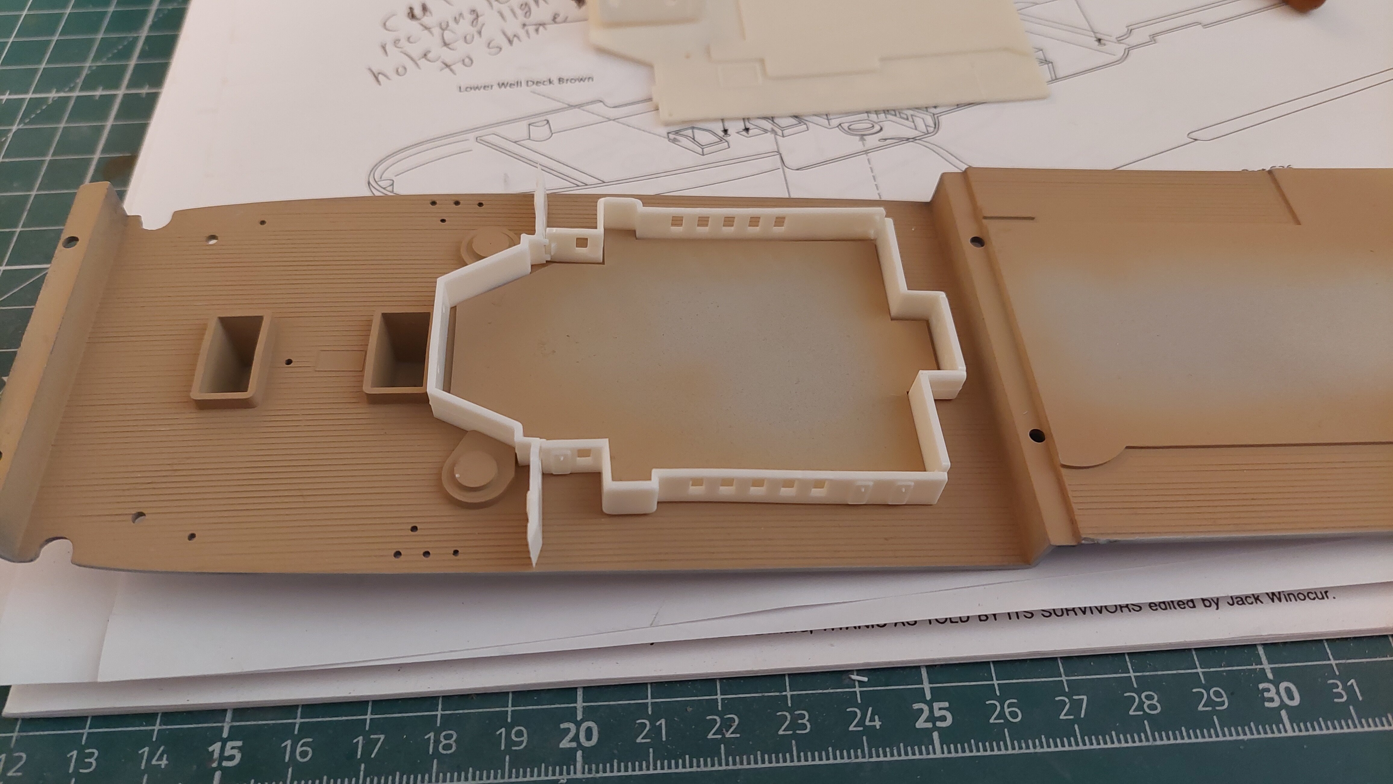

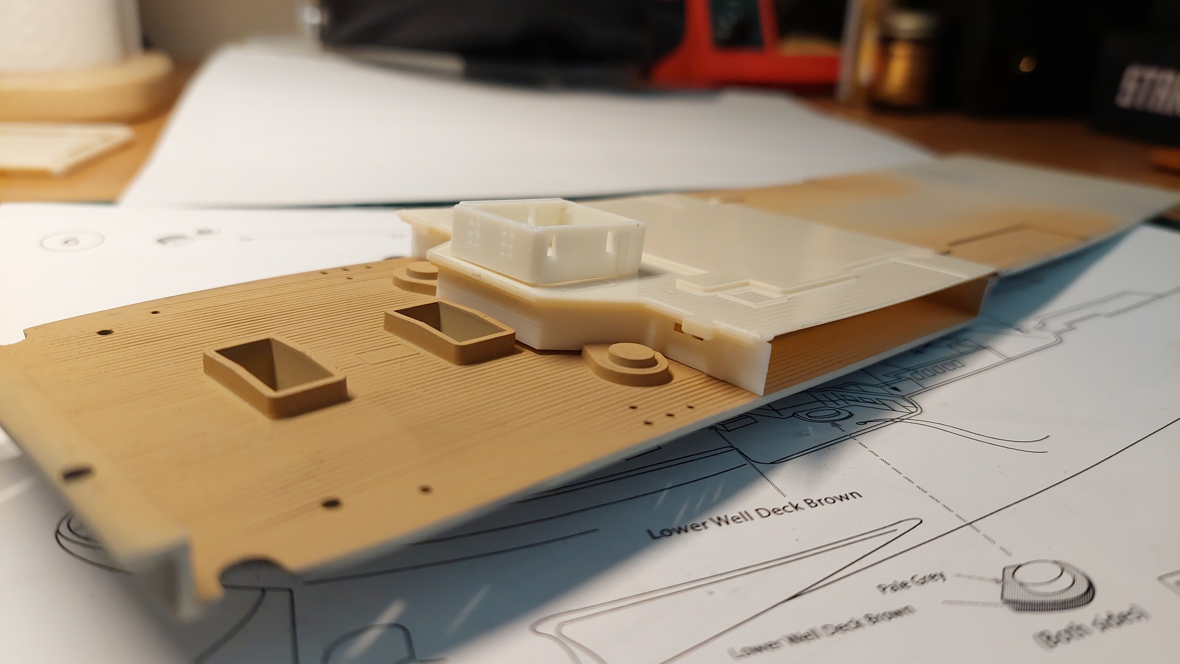

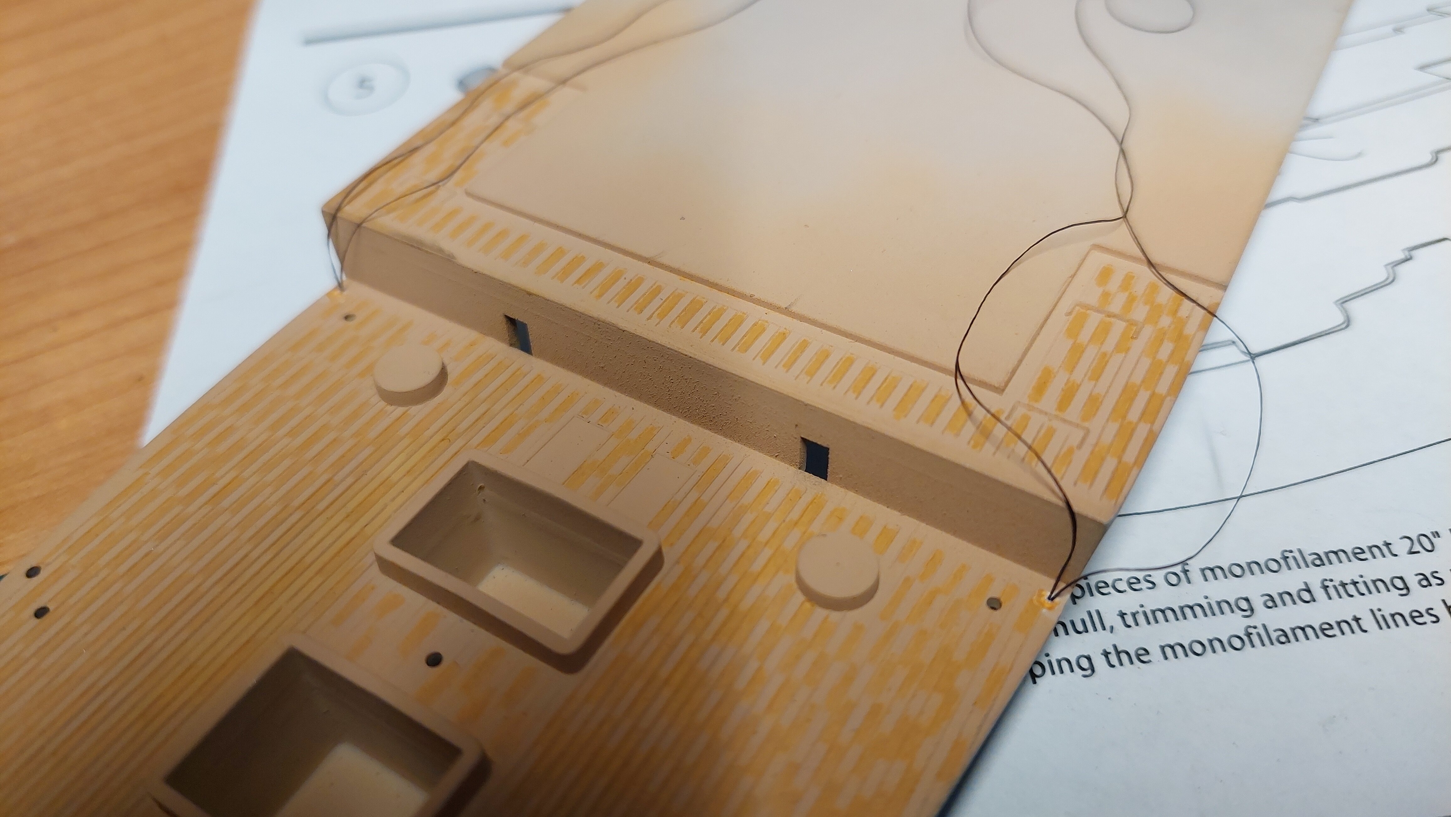

Small Titanic update:  Decking coloring continues slowly and painstakingly.  This morning I attached the first four rigging lines to the main deck utilizing my E-Z Line before I attempt to permanently put it in the hull.  Also began some small deck assemblies.  This model is true old school. There are no sub-assemblies, no snap tight Bandai goodness, tabs that DON'T line parts up right and have to be snipped and sanded then glue the parts together.  And for me, before I go to far, I have to look 3 steps ahead because of the lighting.  It's kind of like driving an old muscle car, without power steering or brakes or any modern comforts... it's looks good, but you have to DRIVE it. No modern BS to help you out!

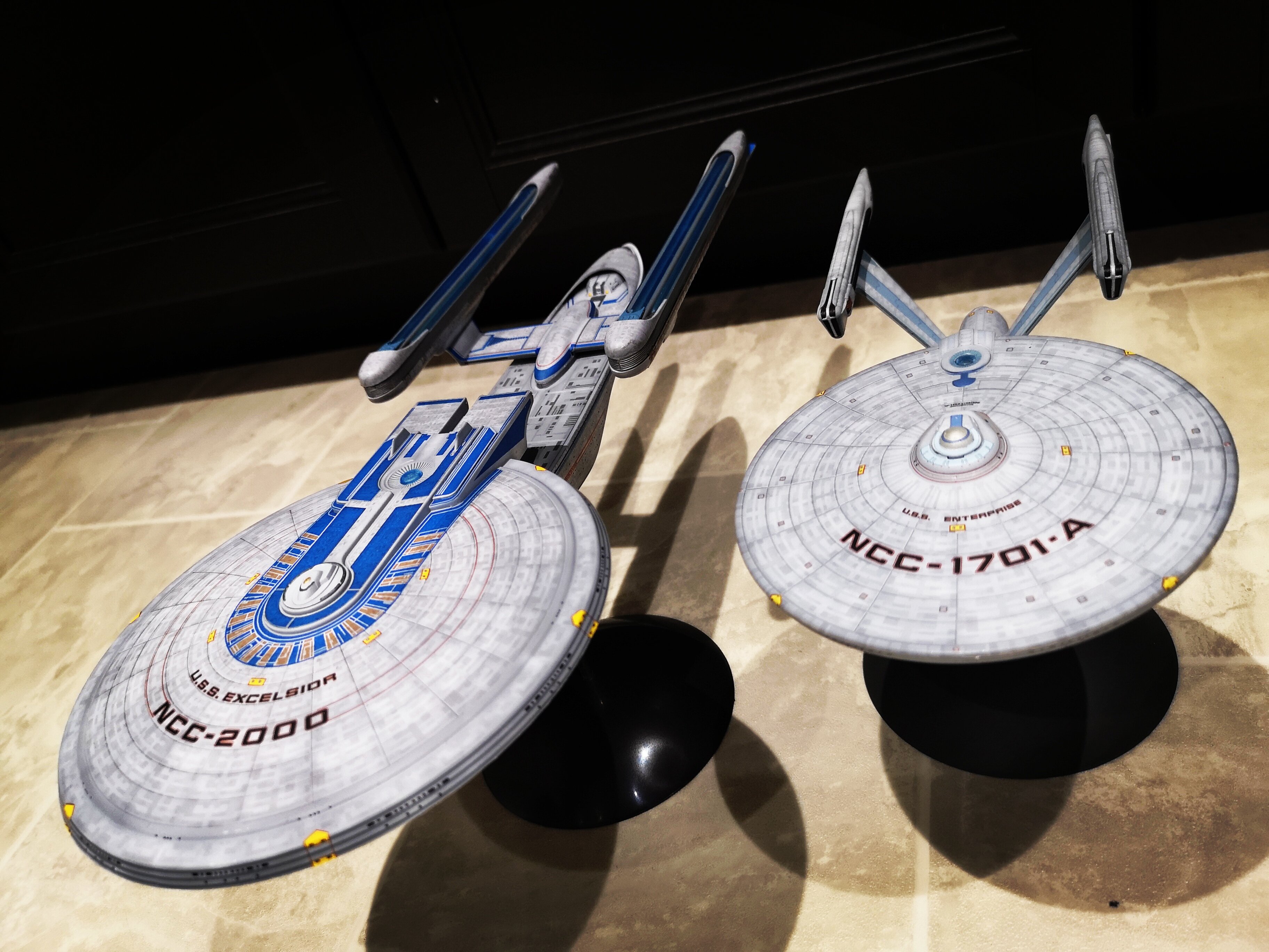

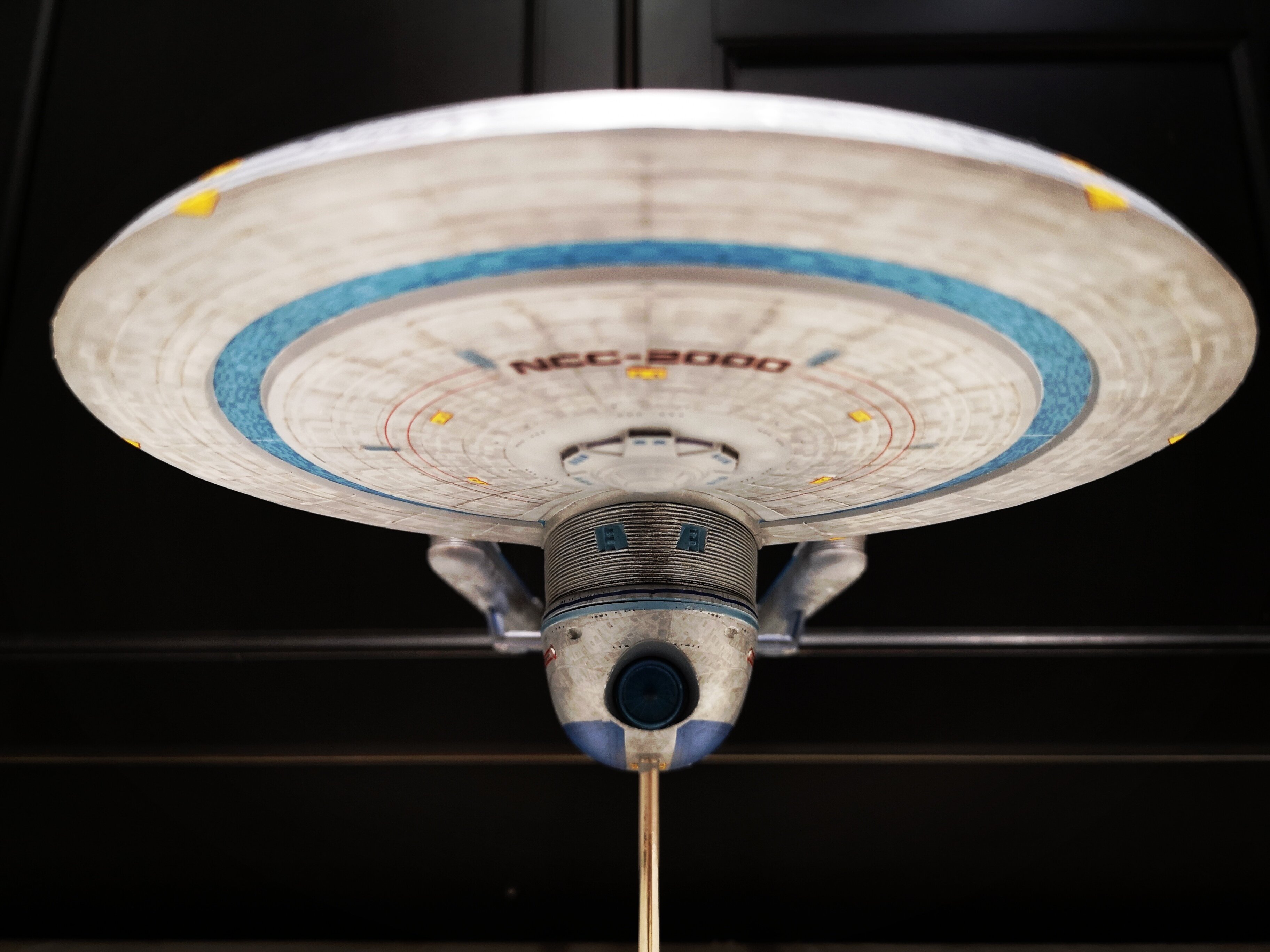

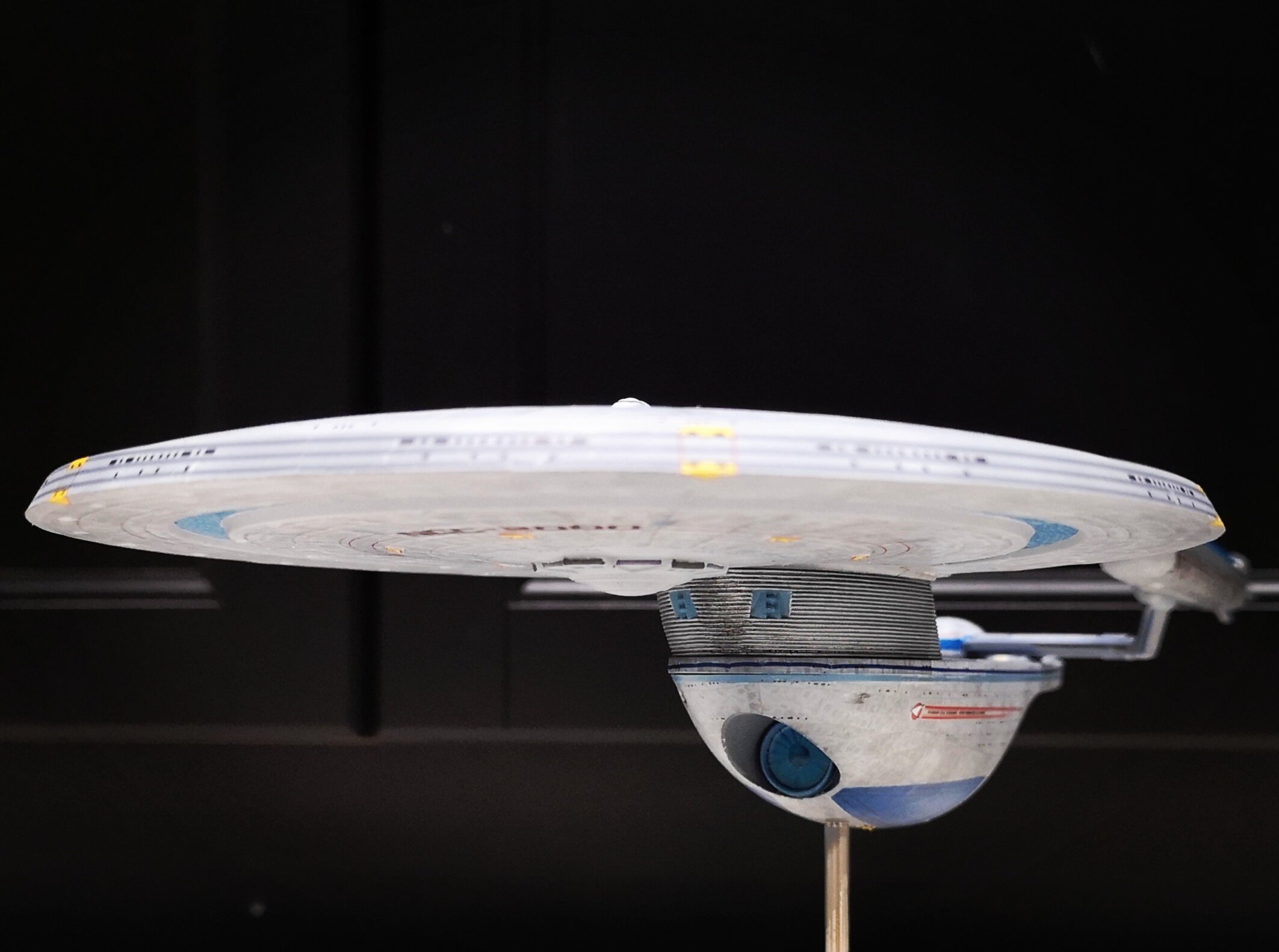

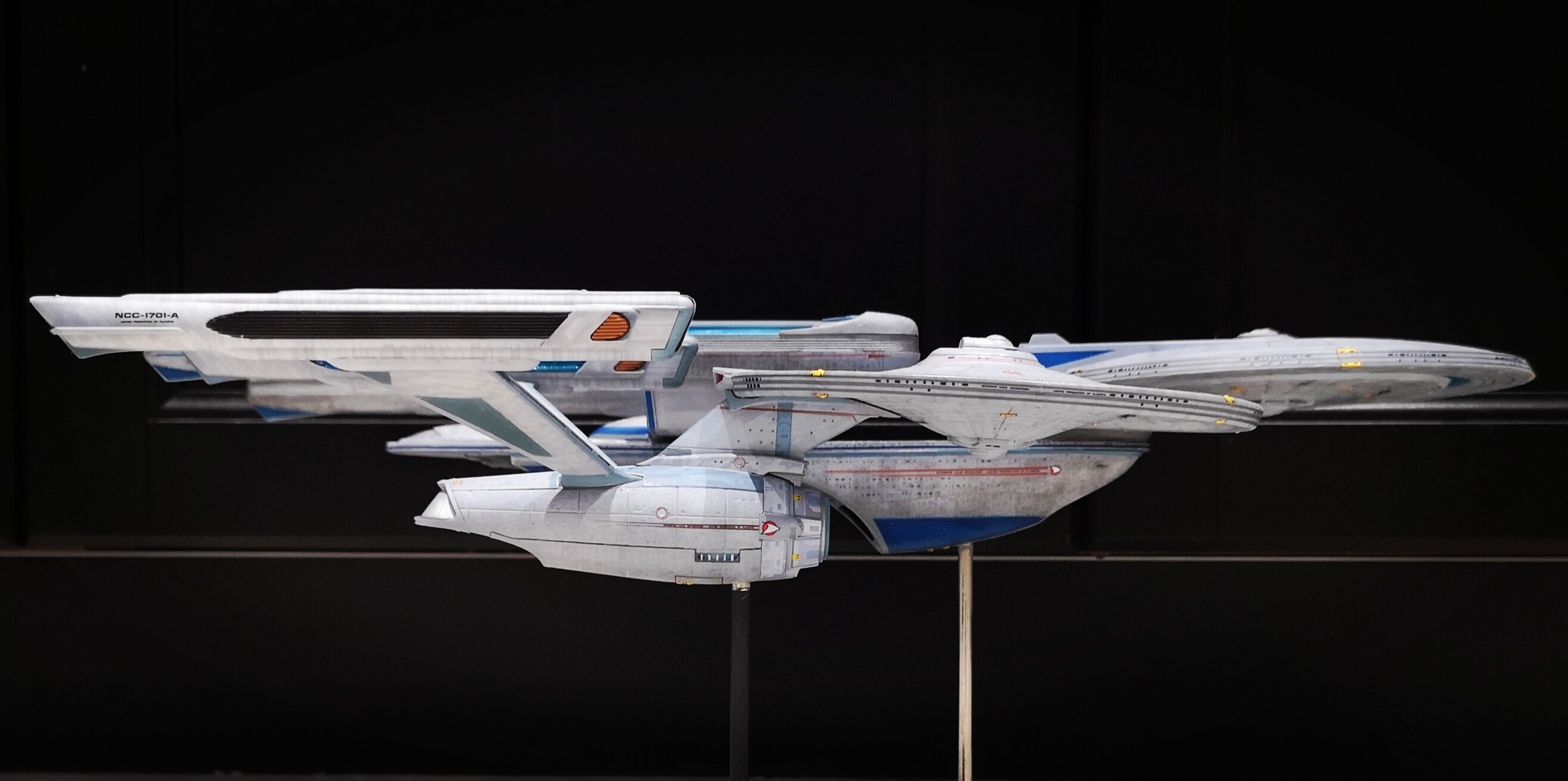

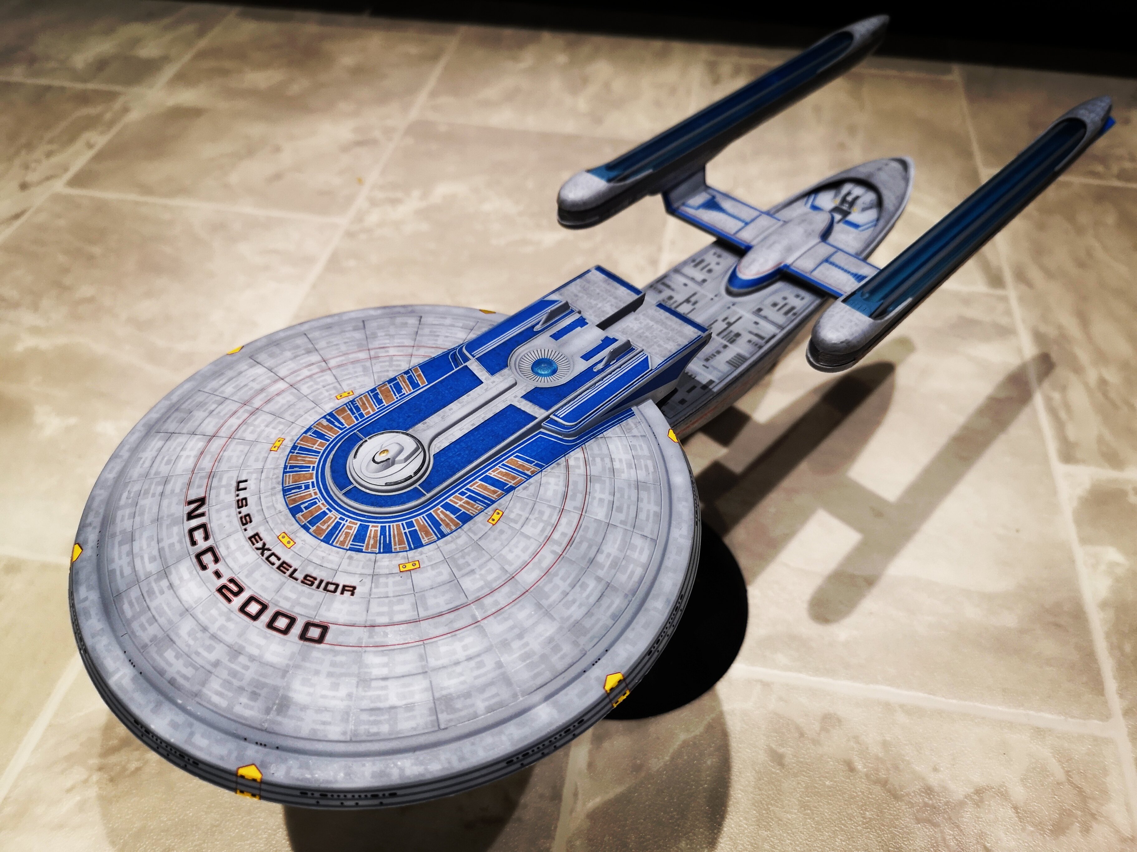

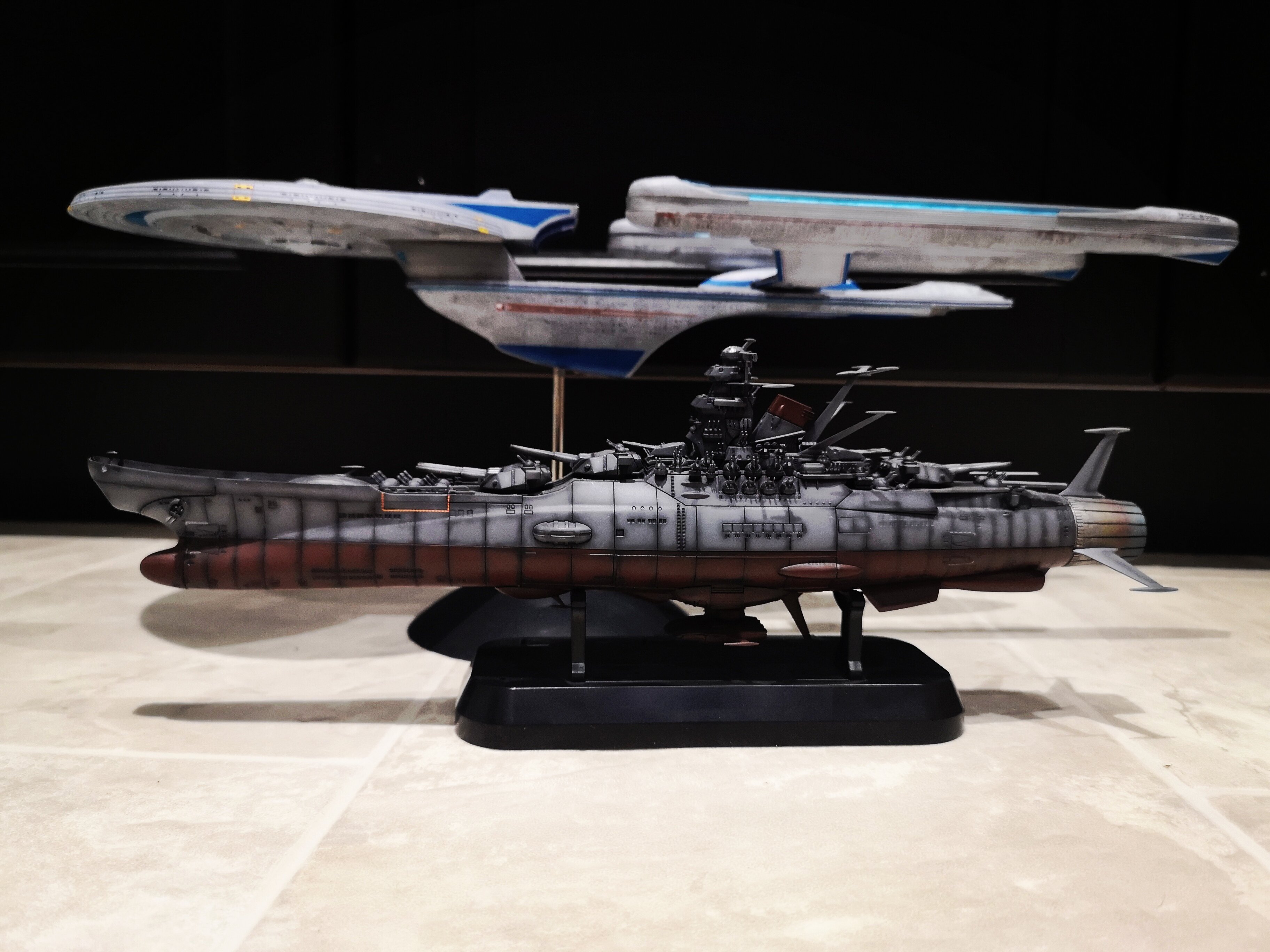

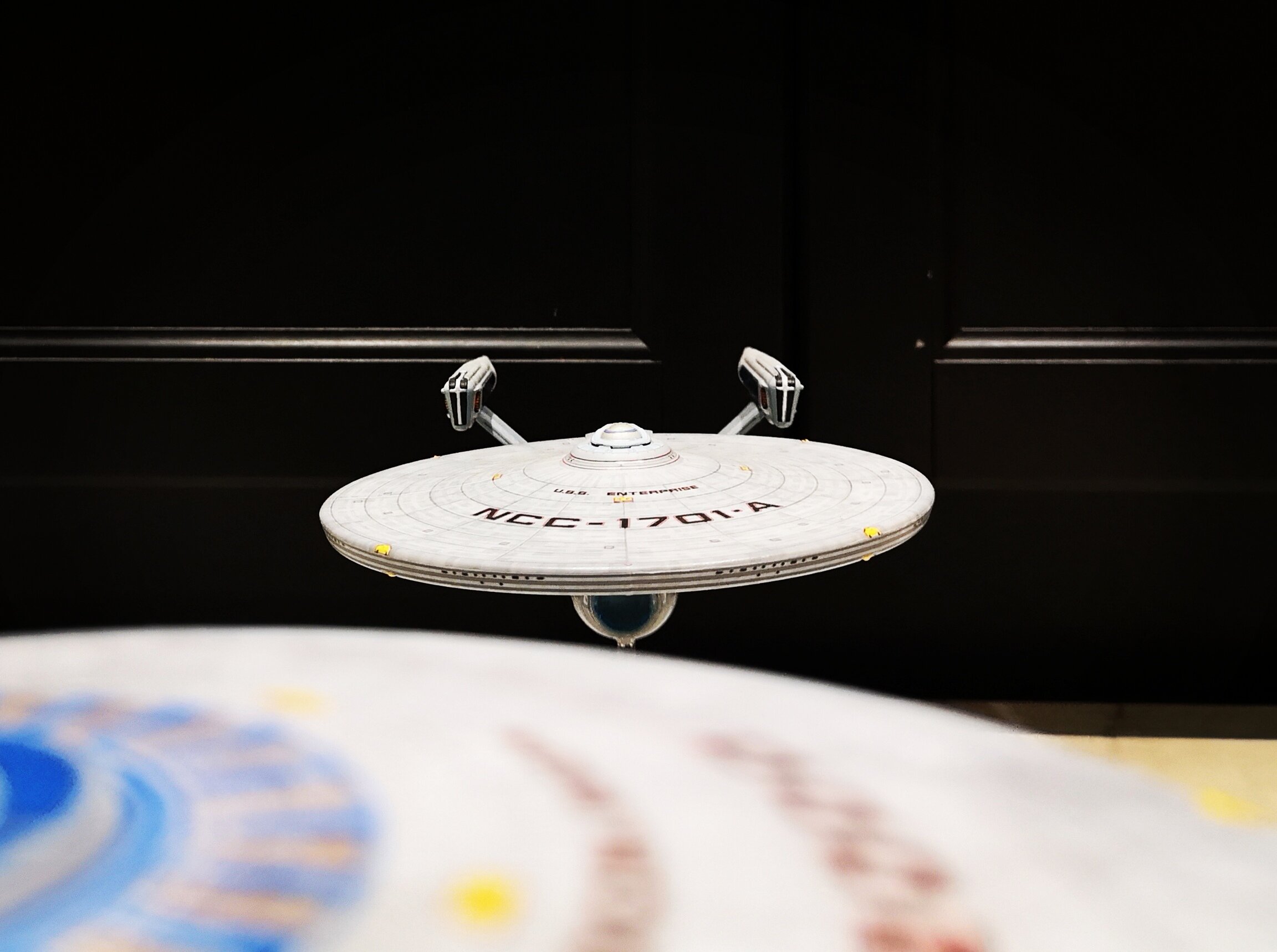

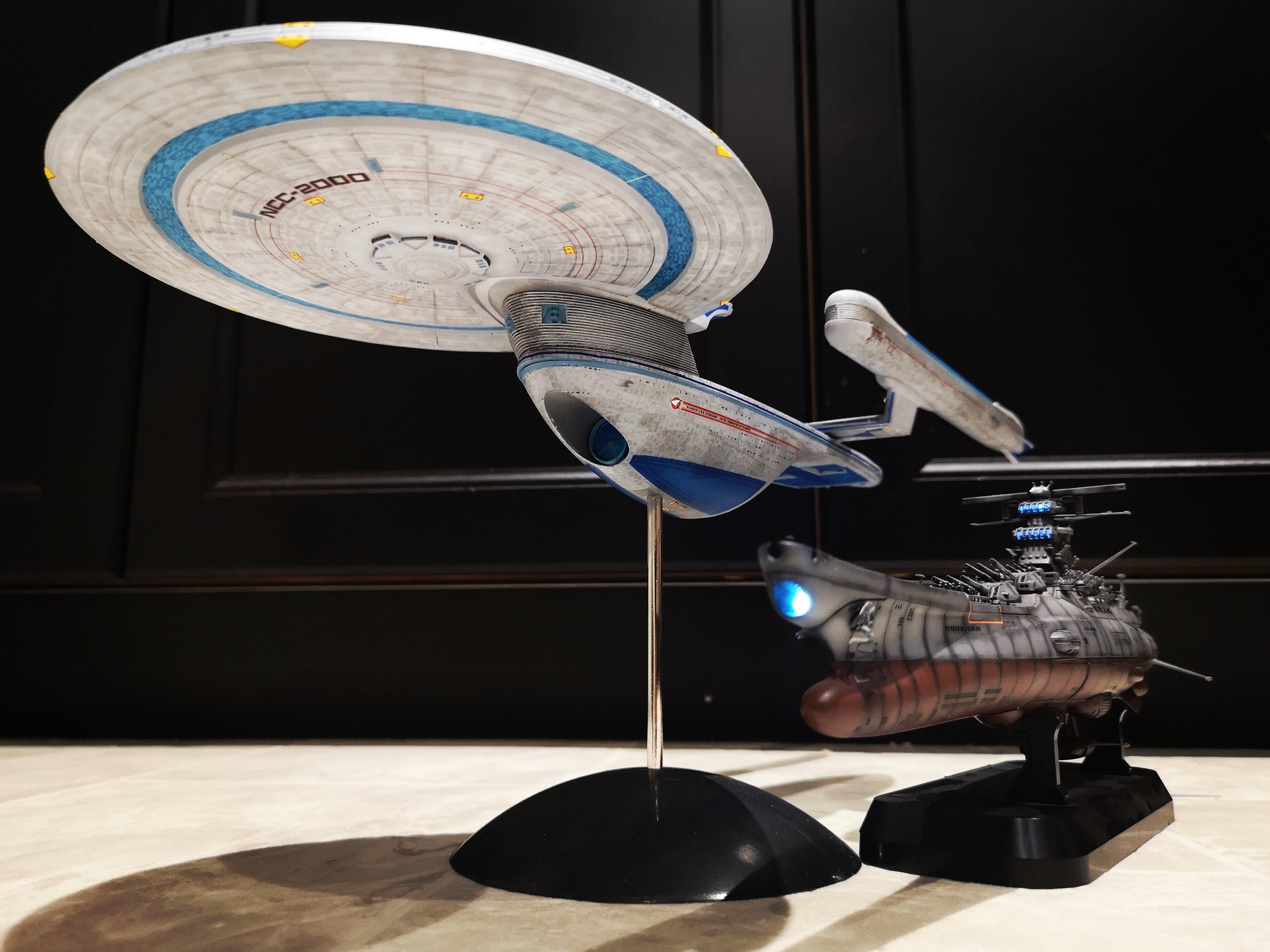

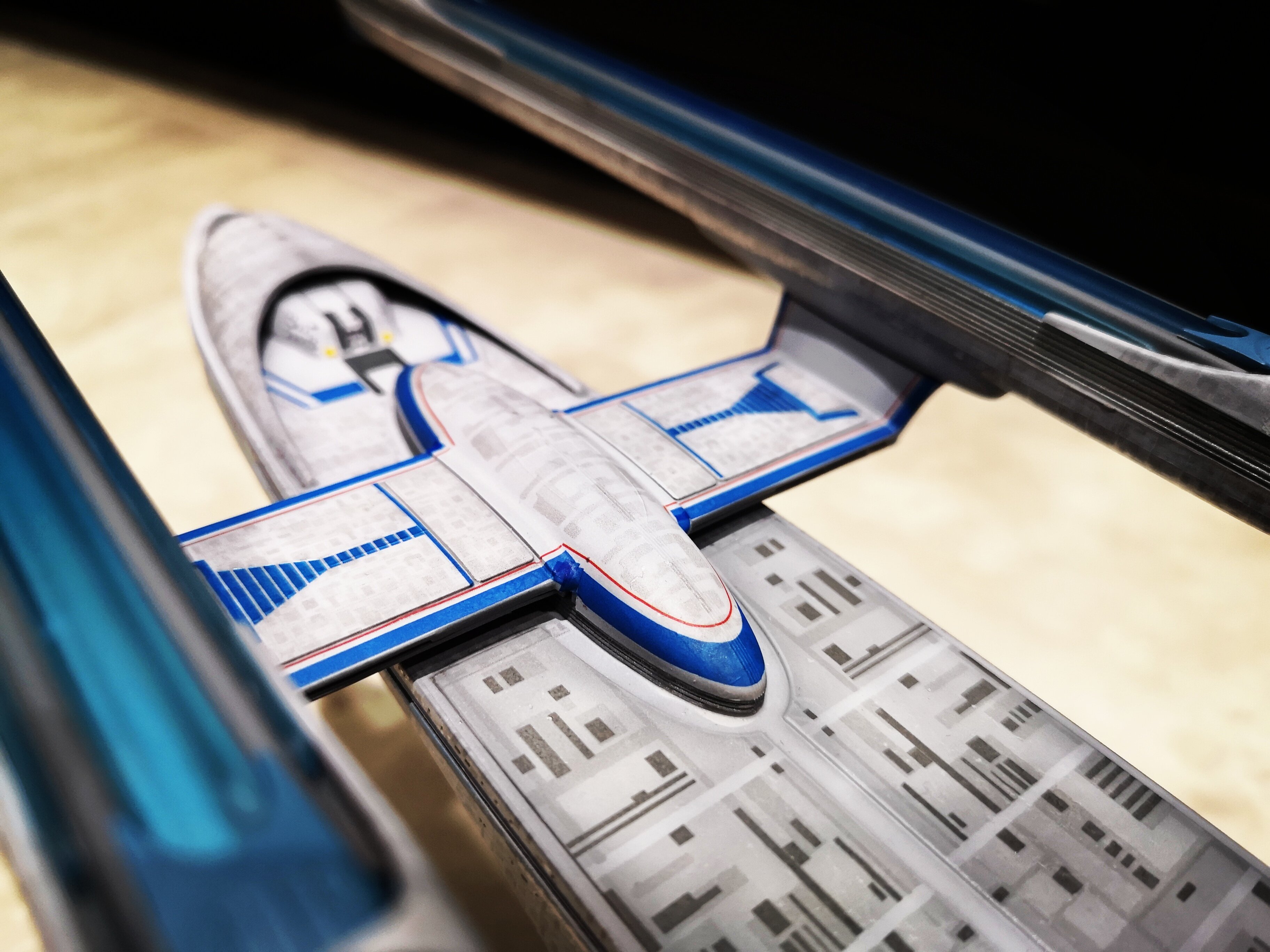

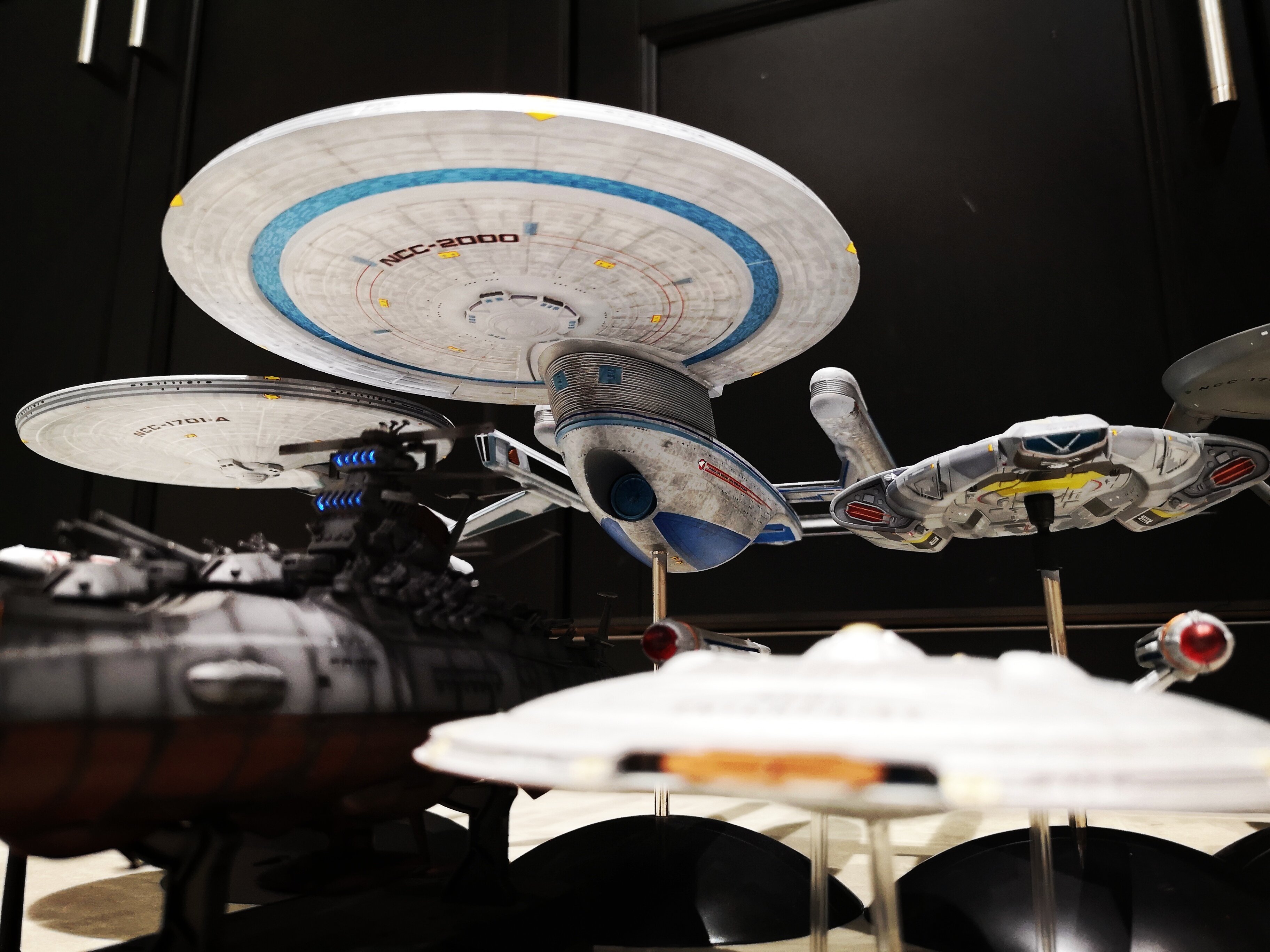

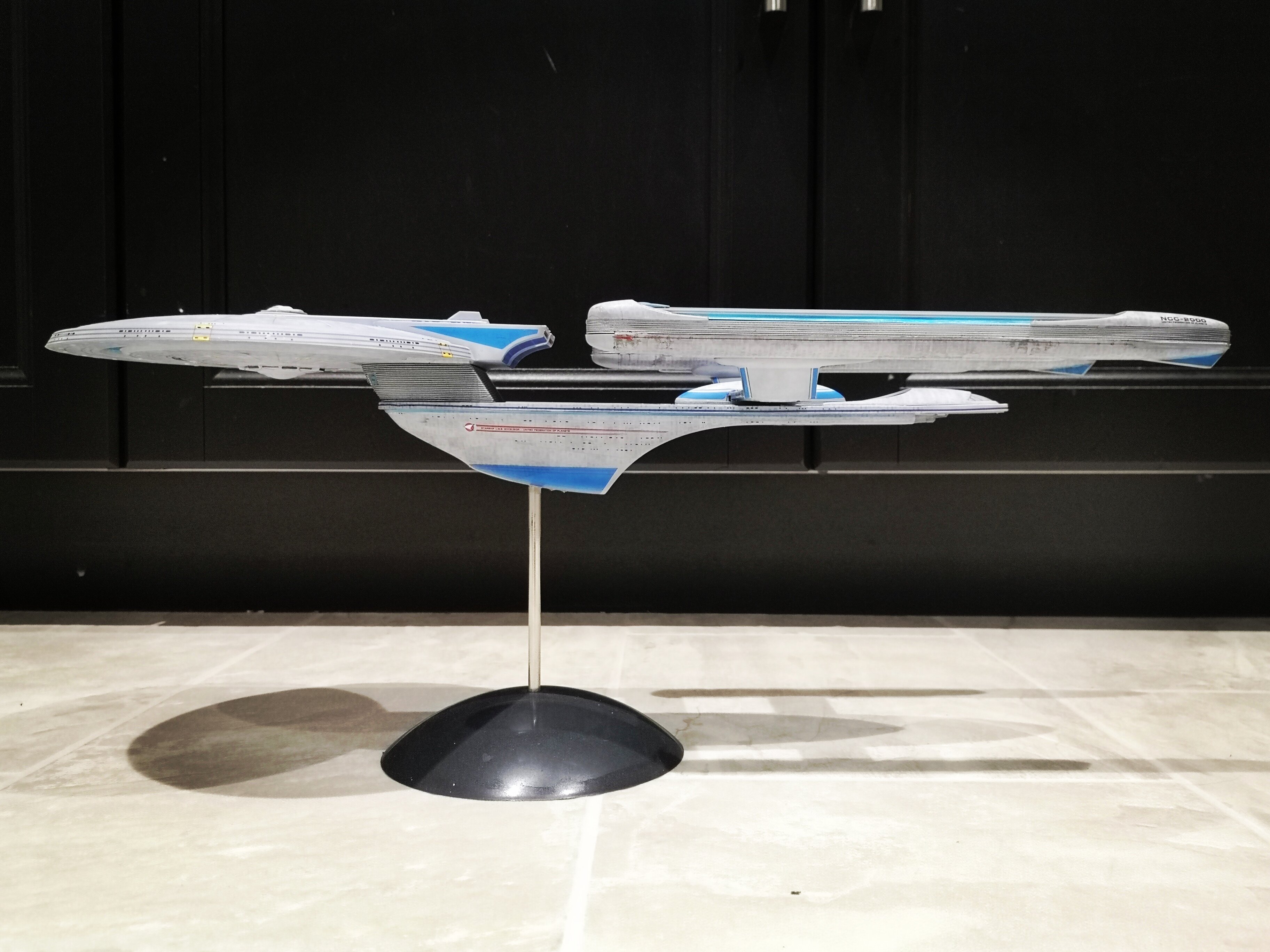

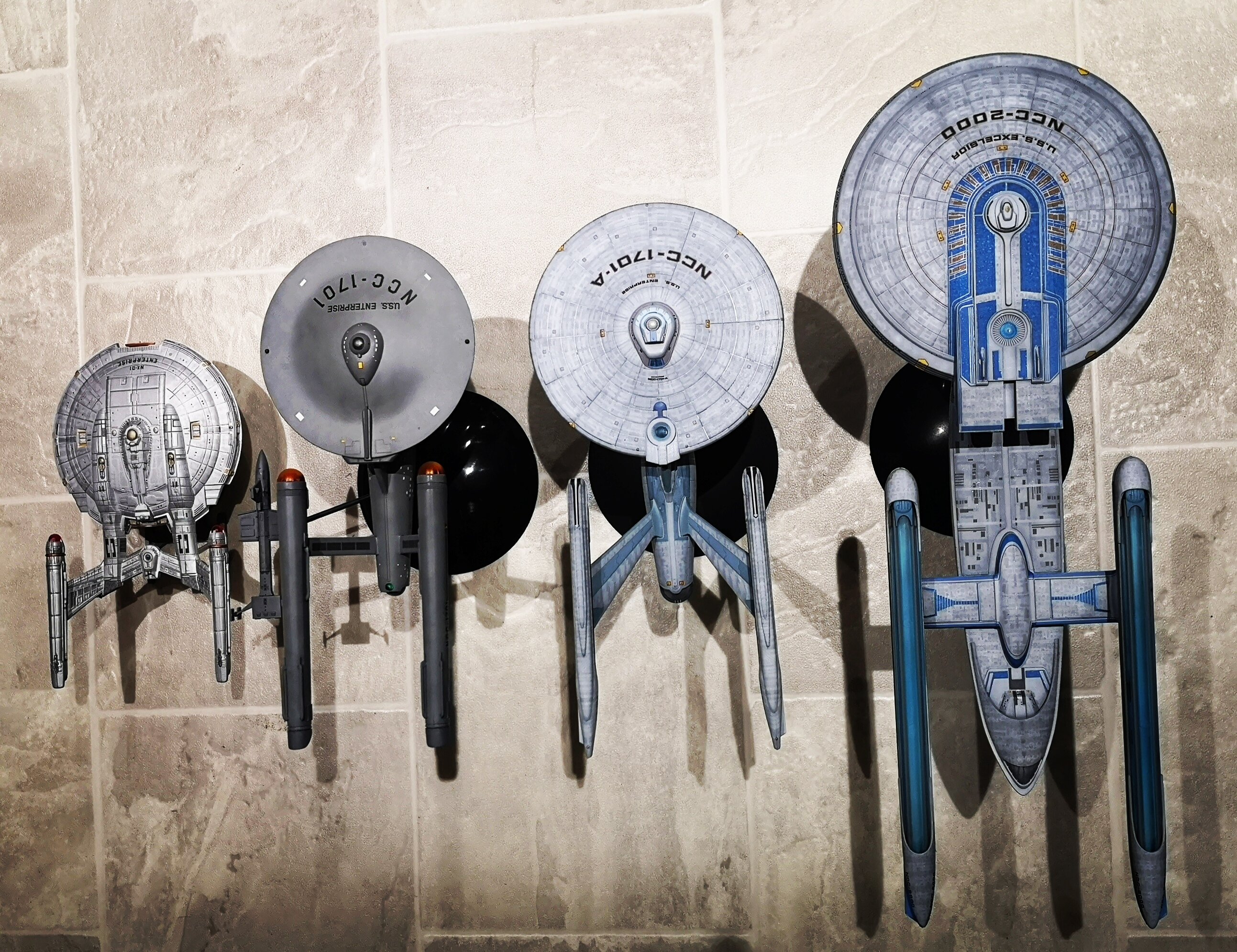

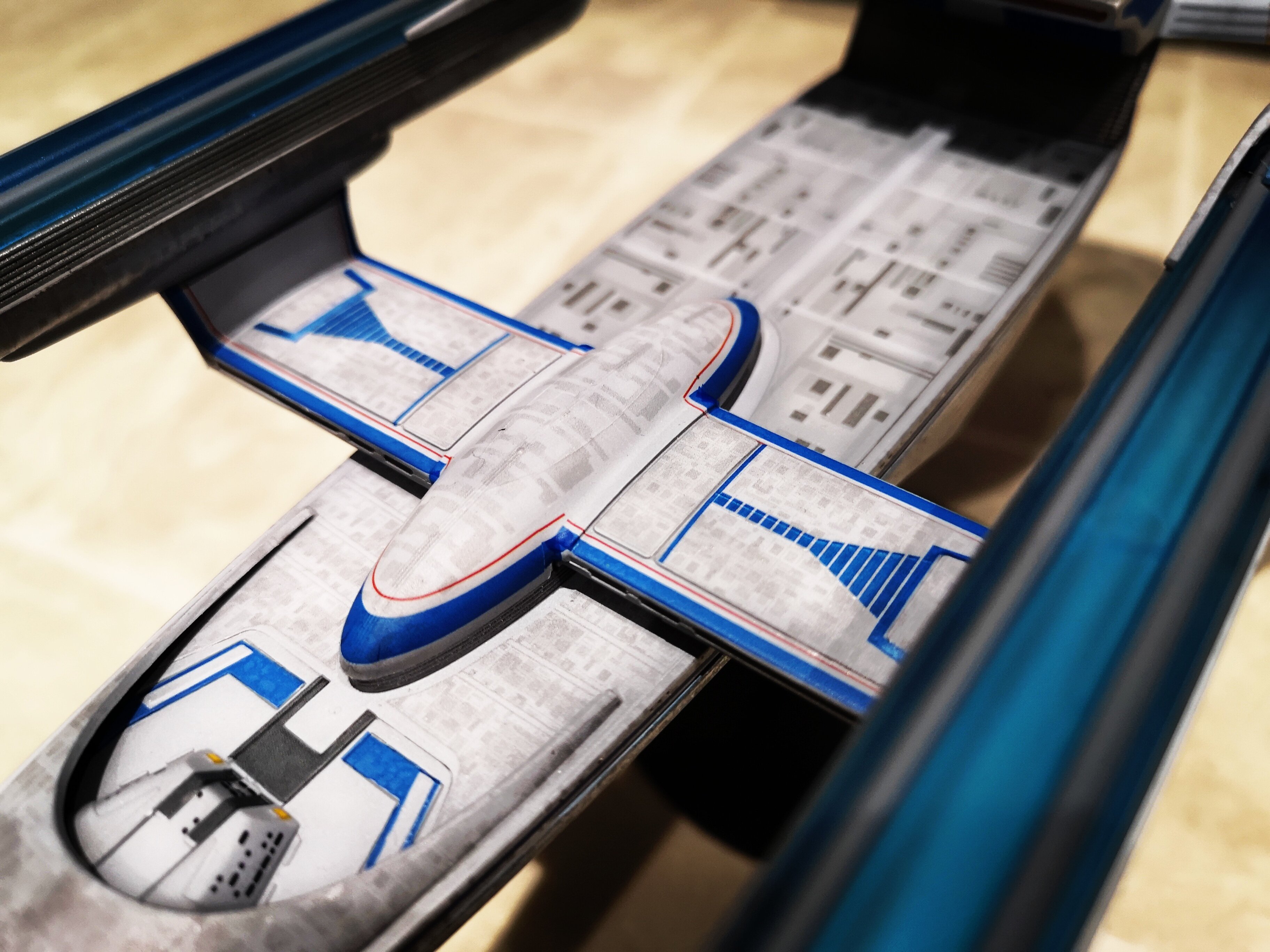

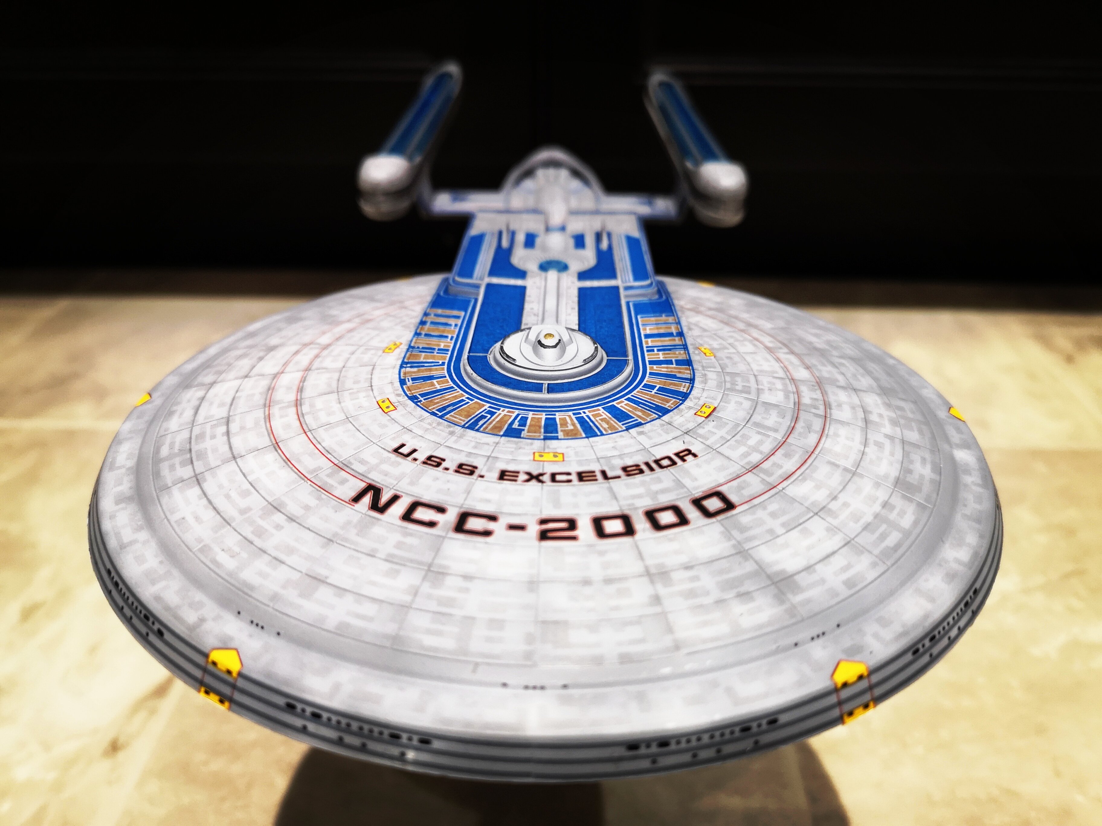

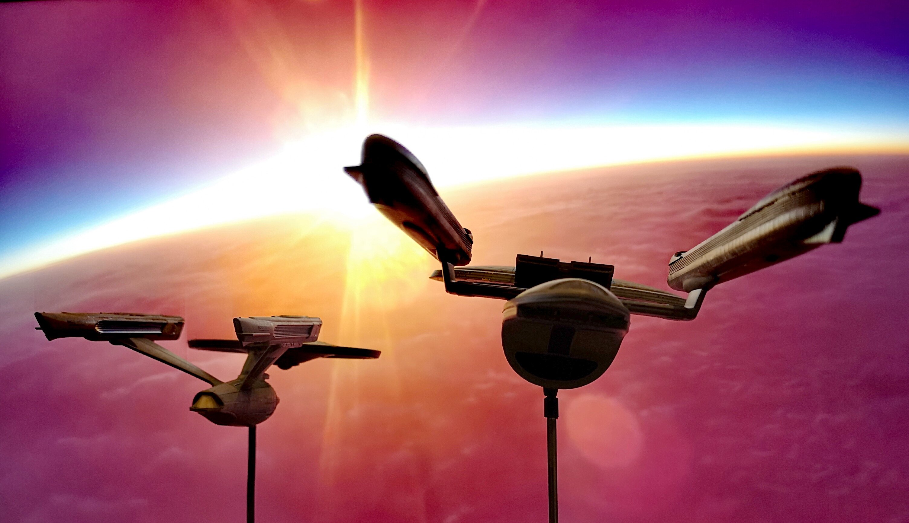

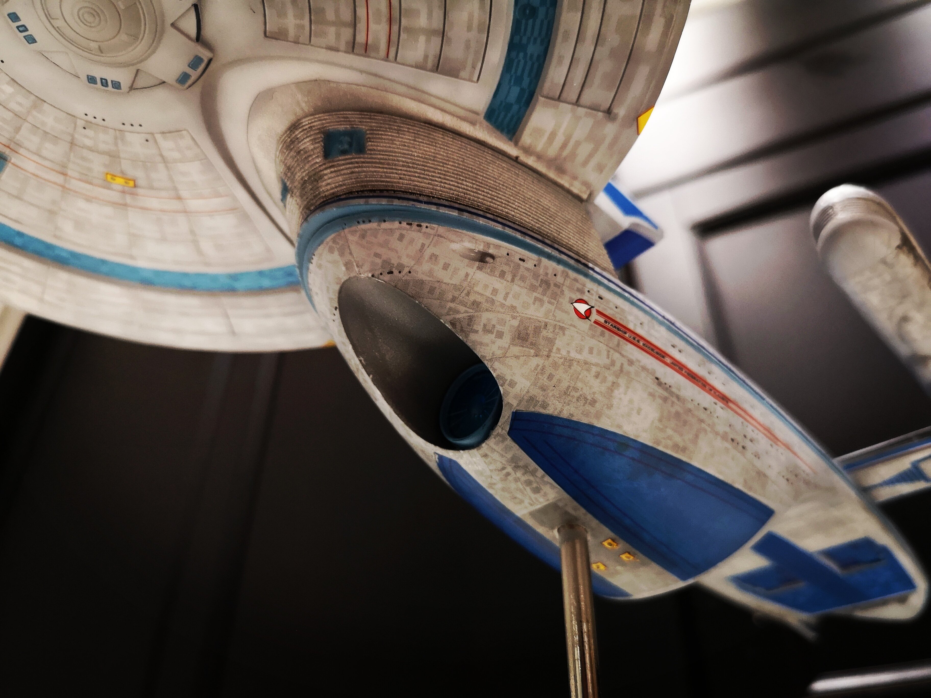

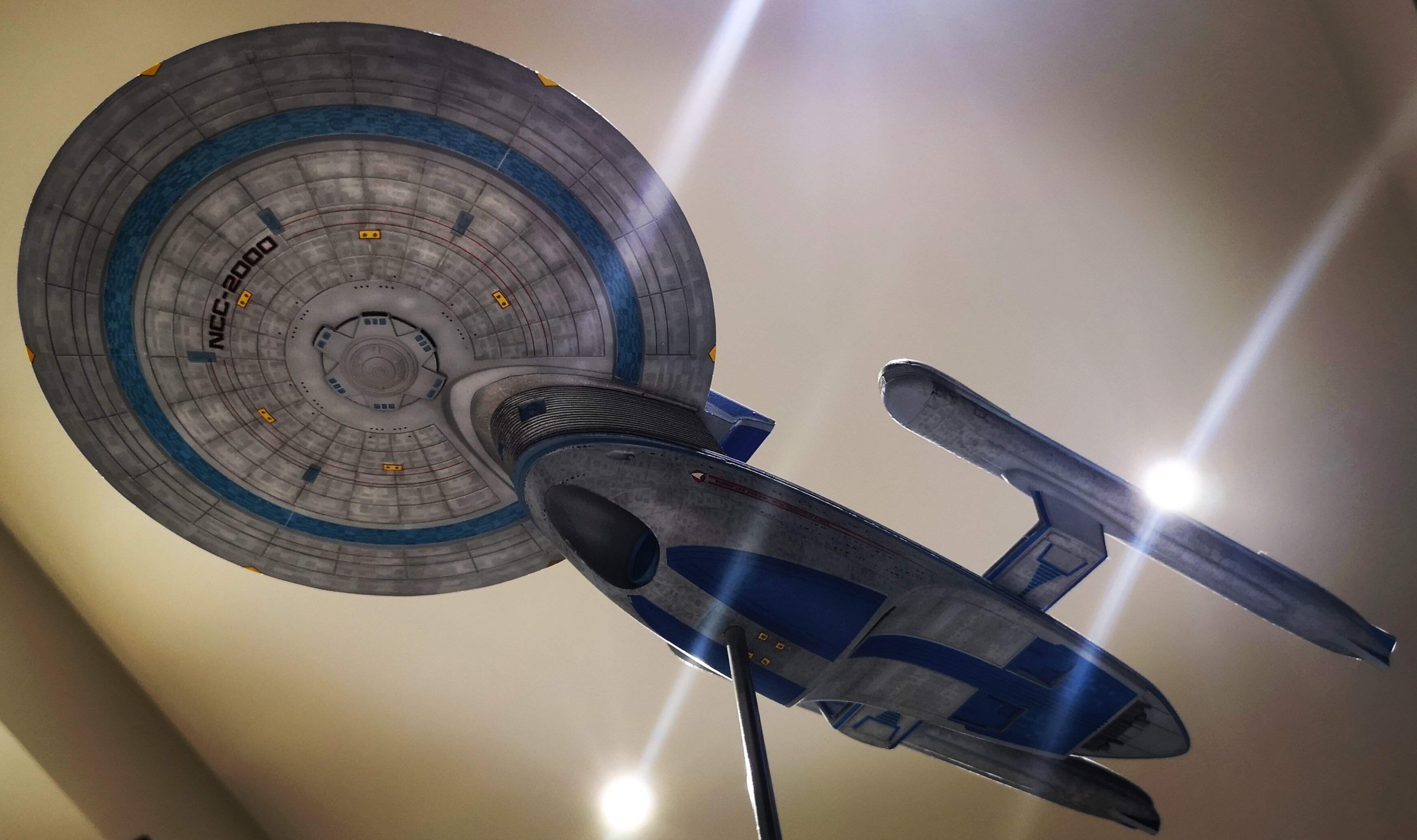

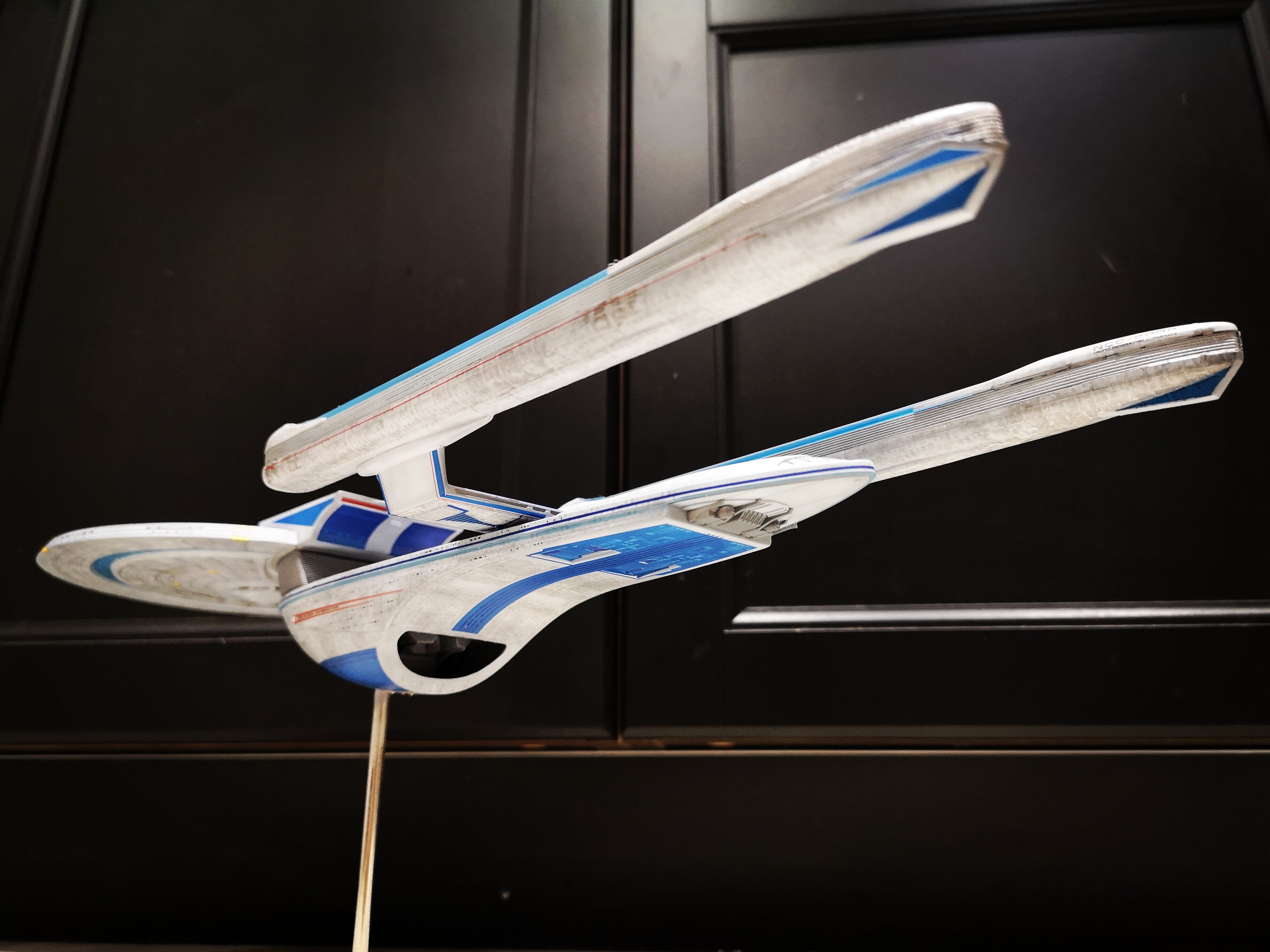

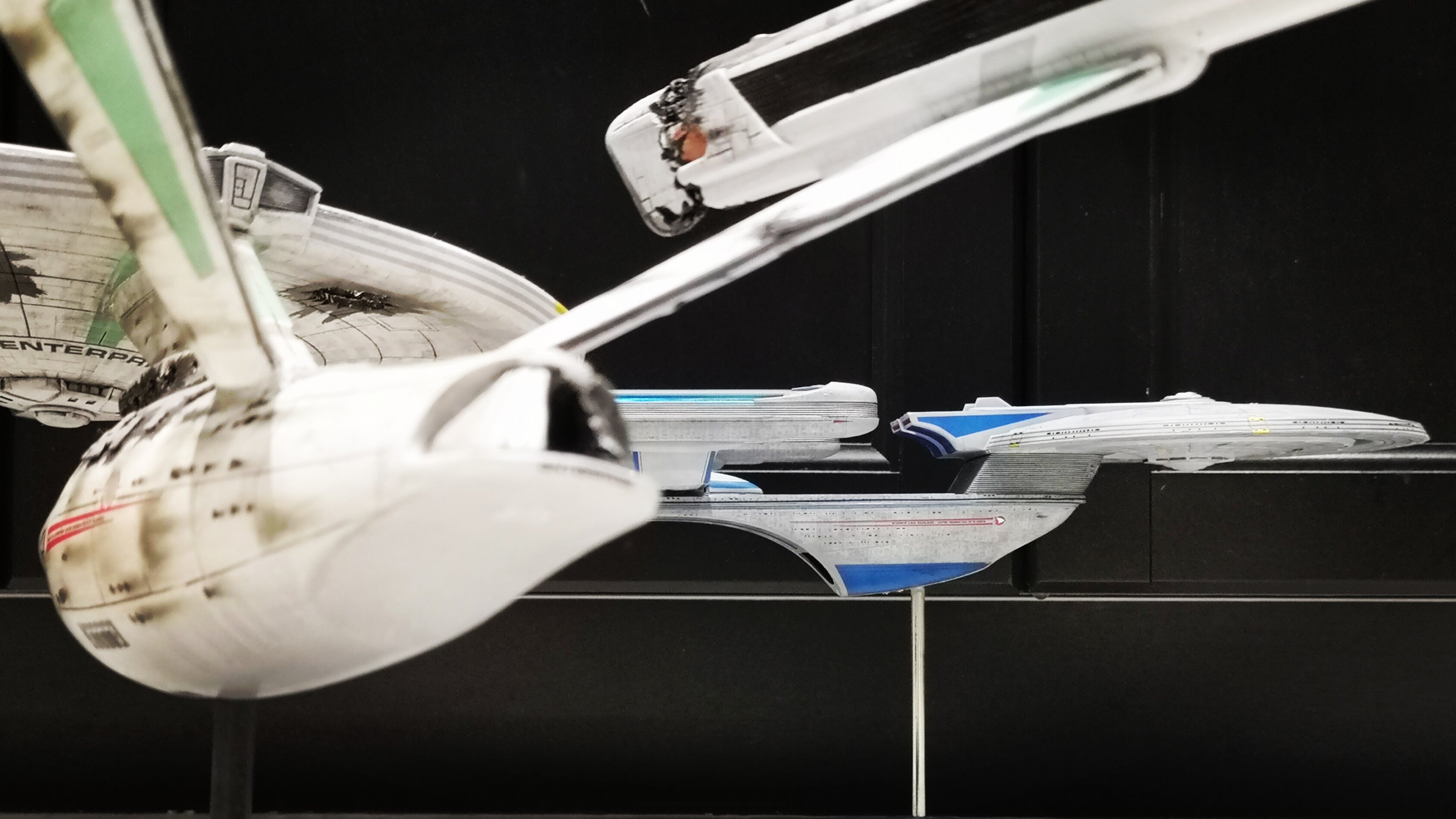

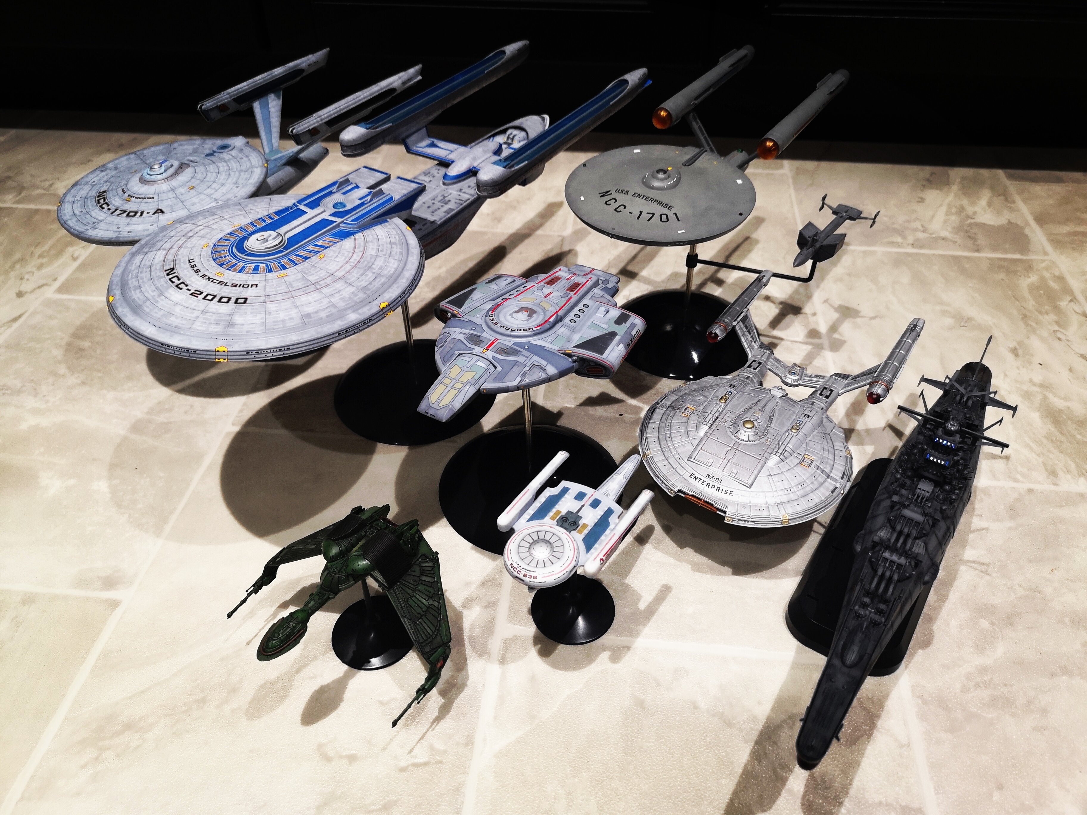

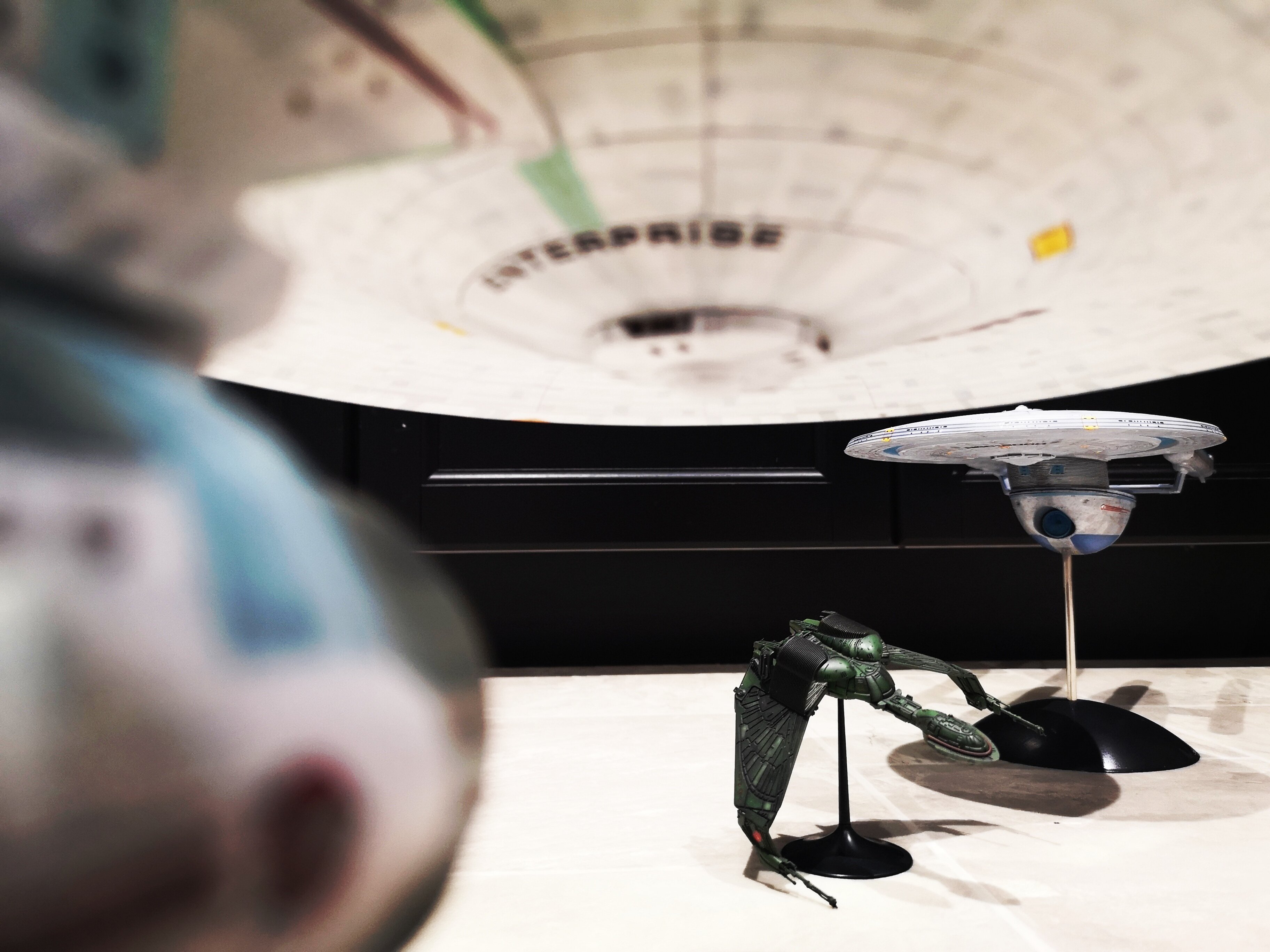

AMT 1/1000 USS Excelsior done.
Finished with GCal Aztec Decals meant for the Enterprise B, and a hodgepodge of parts from both NCC2000 and NX2000 versions, so not screen accurate by any means.
The kit was hard for me to build, lots of gaping seams, lots of filling and sanding.  I built this model entirely without magnification so there are a lot of errors, please do not zoom in, lol!
Glad it's finished, don't think I would ever build another one, hahahahaha!
Few shots with other 1/1000 ships.
Just need to figure out Photoshop so I can delete the stands, lol!

@peter That is an EXCELLENT Excelsior! Great shots too. Make me glad I'm not a Klingon!
I zoomed and I REGERET NOTHING!! Outstanding looking Excel!
