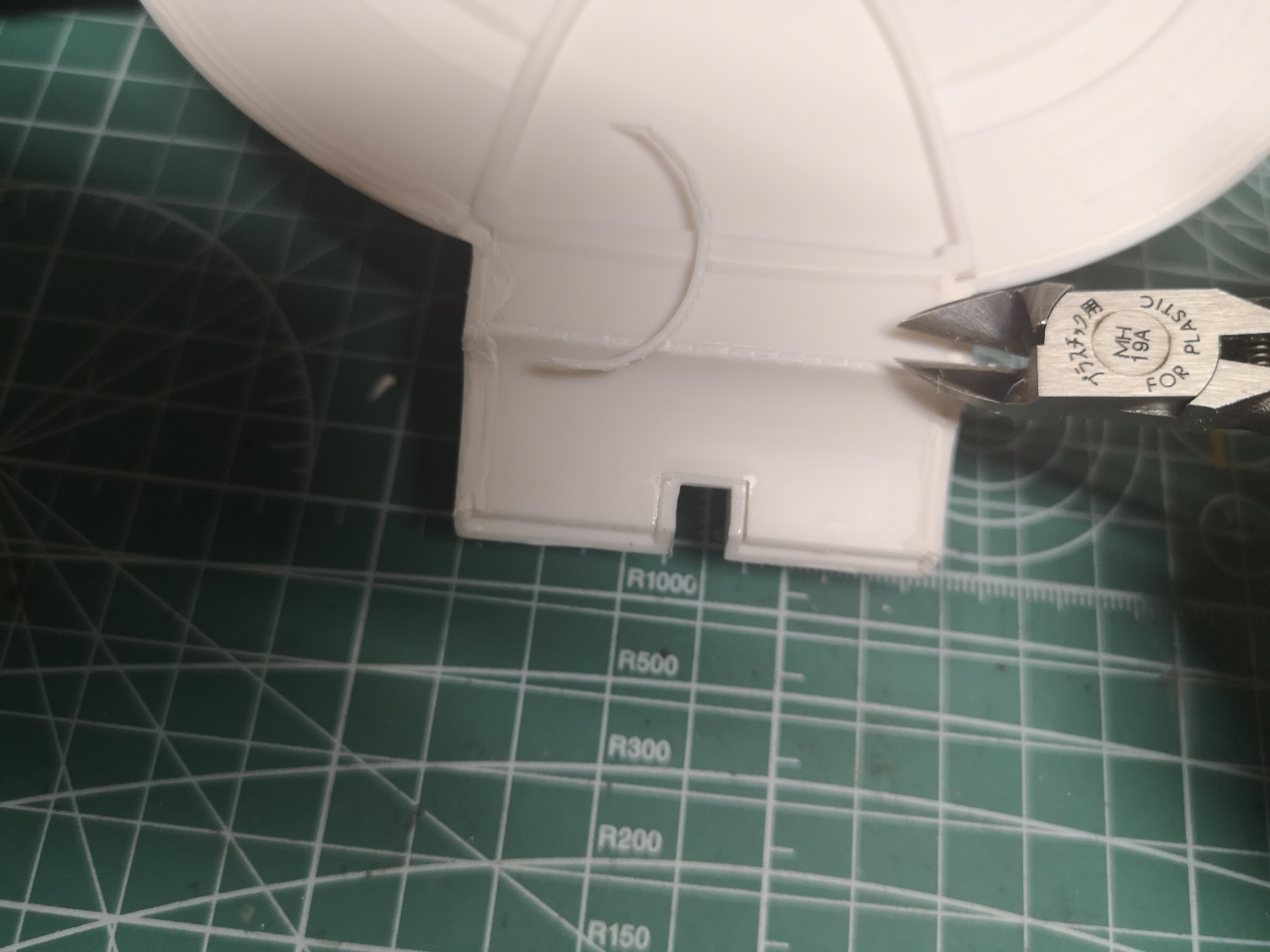

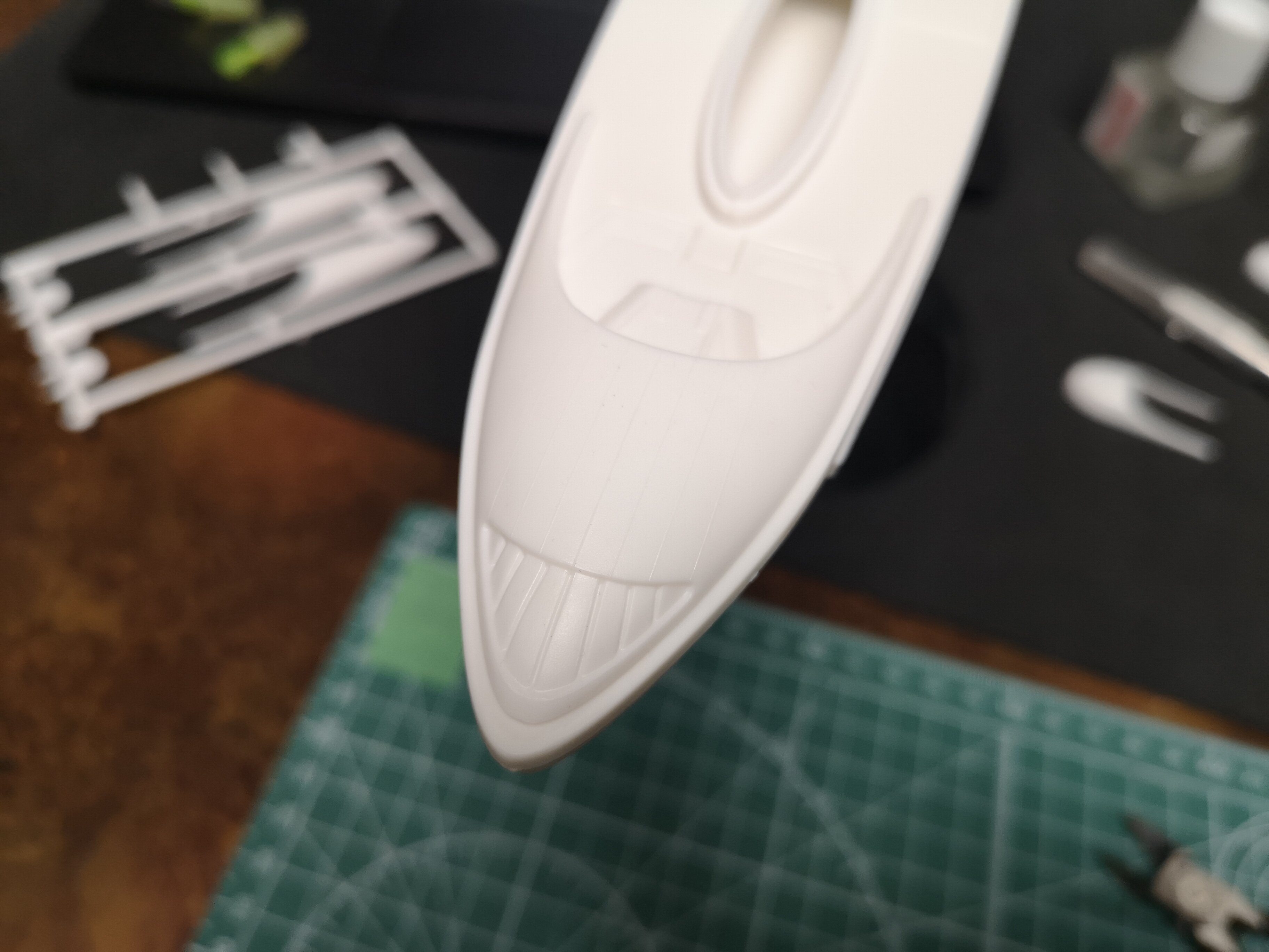

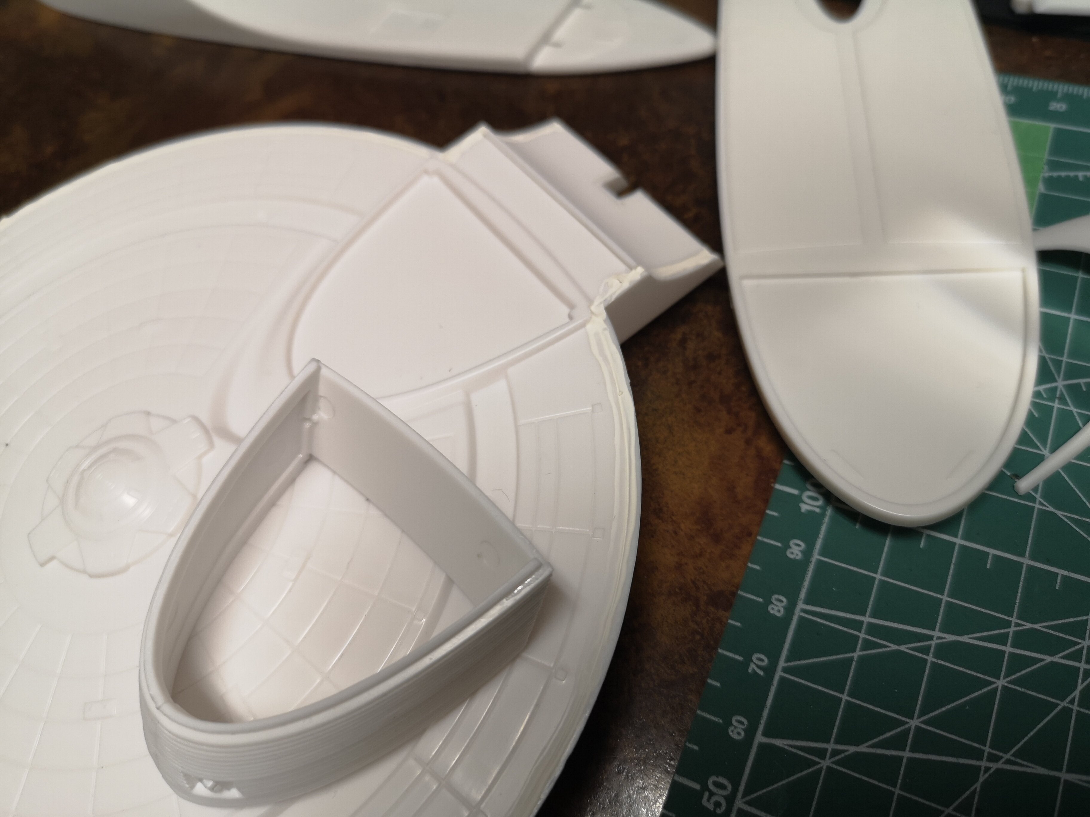

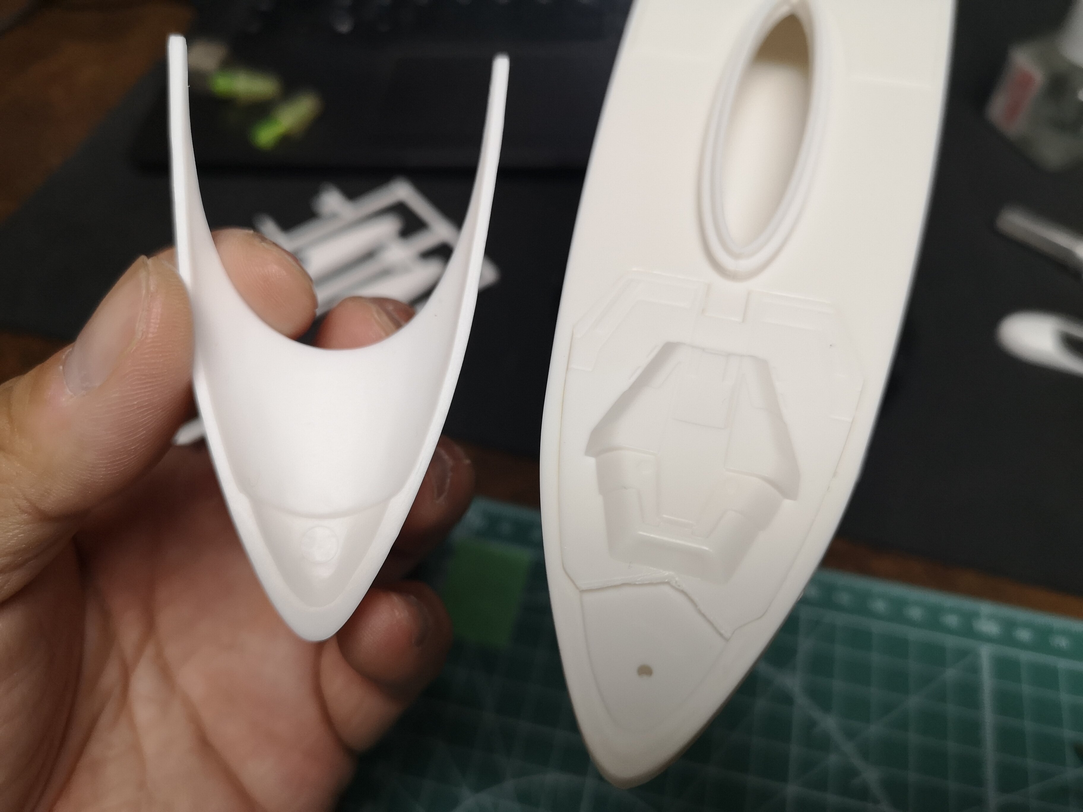

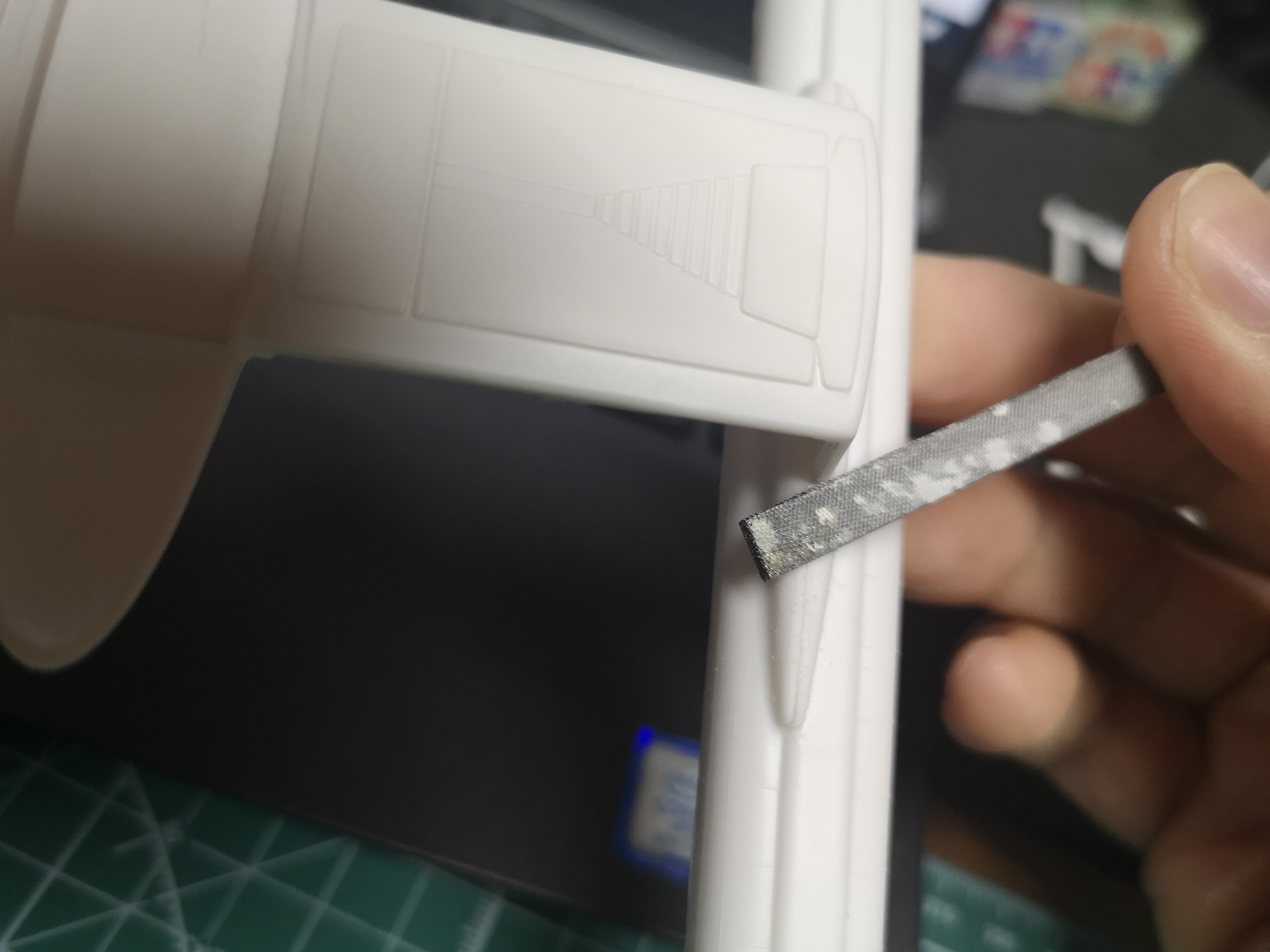

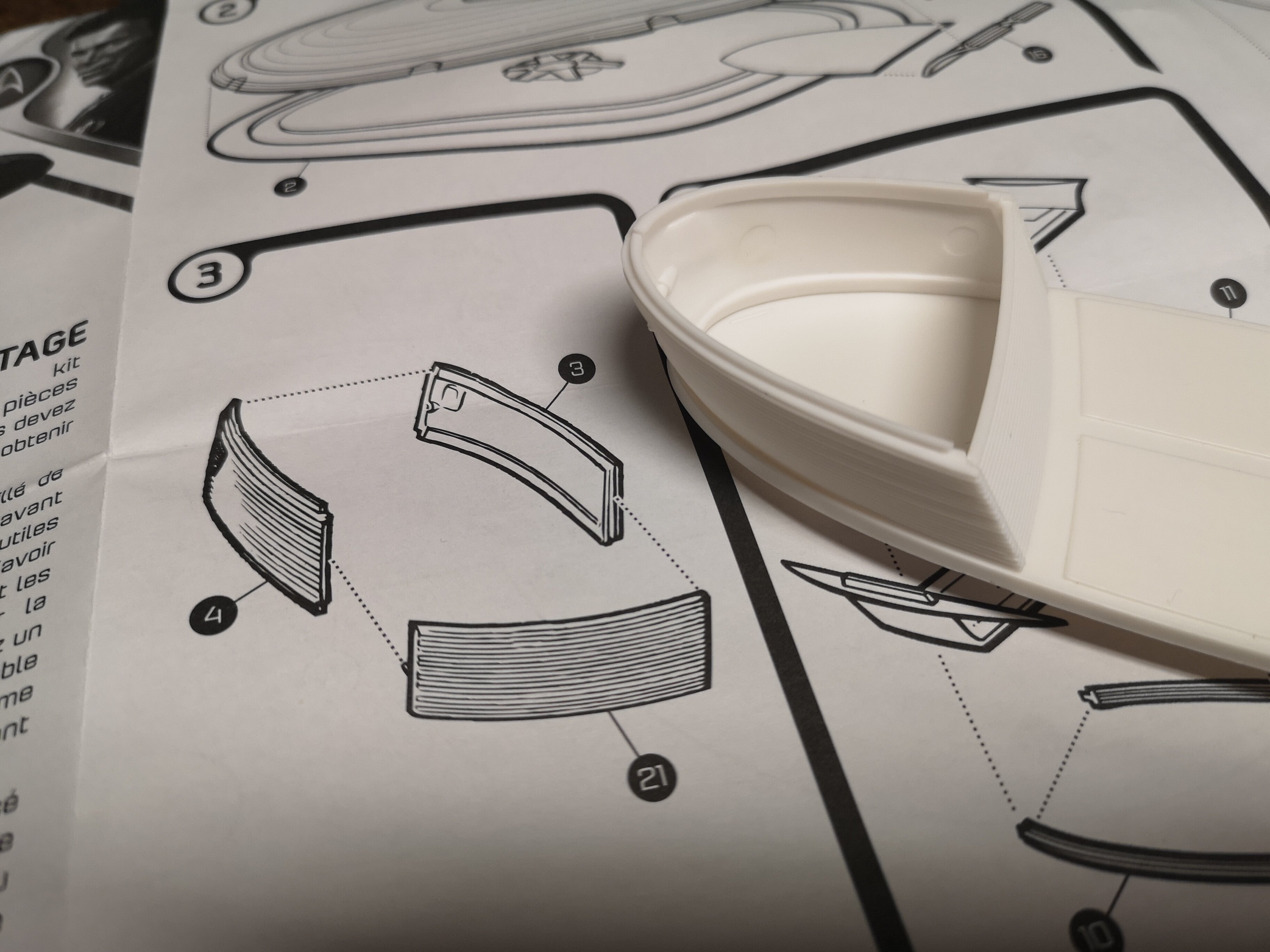

This three piece neck is the only thing attaching the saucer to the secondary hull.  Sounds like a job for super glue or epoxy.
There is nothing marking the alignment of the shuttle bay doors.... Just going to have to eyeball it and hope for the best.
It's a bit off but close enough.
A little trimming, and maybe a bucket of bondo.

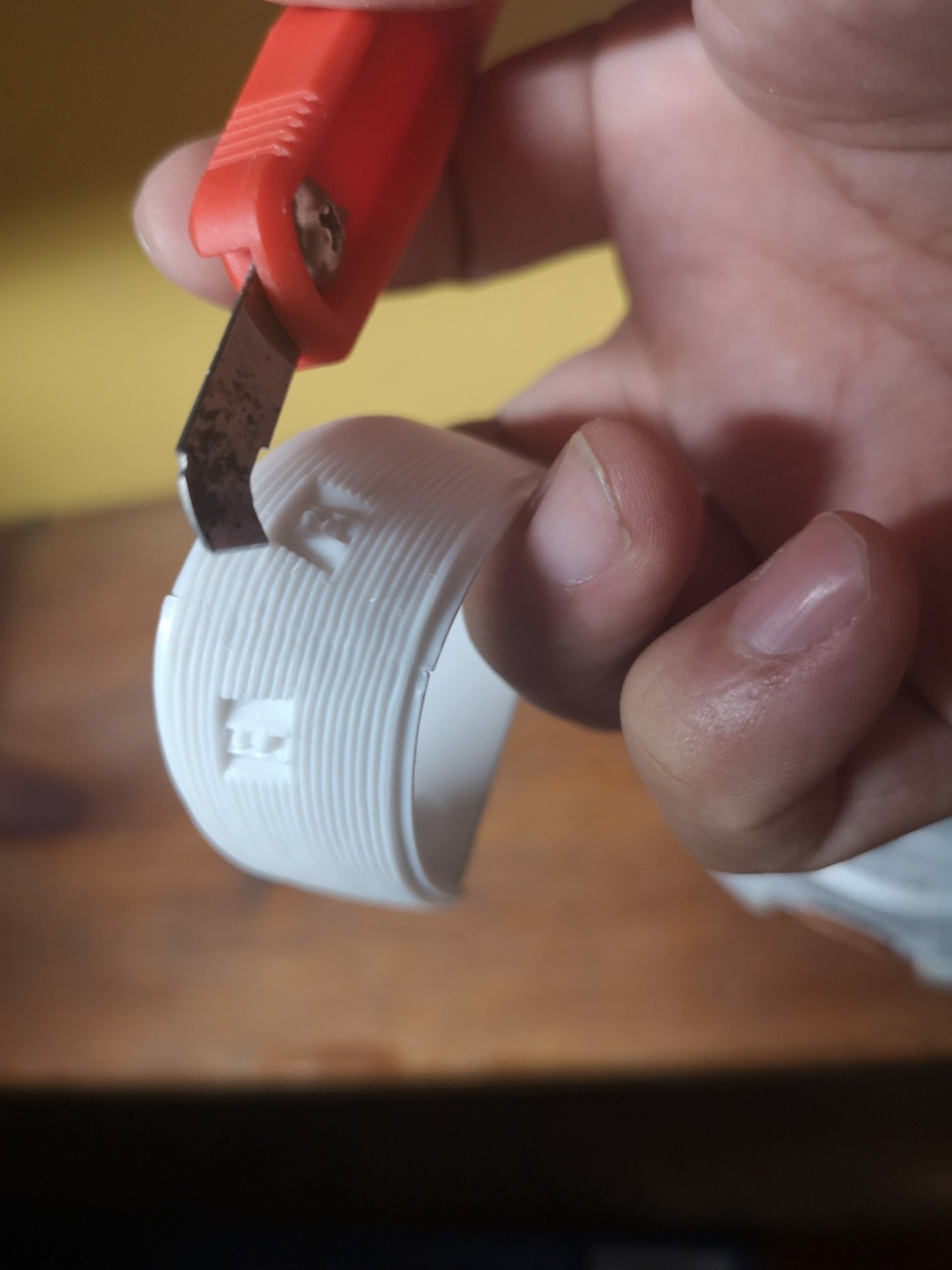

Good place to put a seam.... Took forever trying to make it less obvious.
More filing and sanding.....

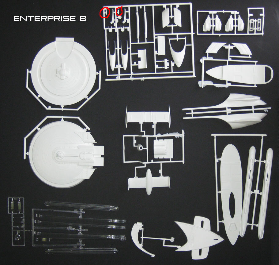

Something that 99% of people miss, on the standard Excelsior vs the Refits:
The outboard nacelle fins.  (not the new ones, the ones that are ALWAYS present on ALL versions).   The refits, have longer fins there.  They're extended rearwards a bit, so that their rear edge now lines up with the rear edge of the new fin that was added on top.   (the original fins would otherwise stop ahead of the trailing edge of the new fins---this way all the fins "end at the same spot")   Or to put it another way---the original fins do not extend rearward beyond the rear end of nacelle itself.  The Refit's do.   (I believe the "new" Excelsior model built for the Voyager episode got this wrong---it has the extended fins)
It's basically a small parallelogram-shaped extension.  The original Ertl kit of the 1701-B included the extensions as extra parts to add.  (no tabs/slots or anything, you just had to butt-join and putty them on).   But I think like every other model/toy/diecast just gives the Refit version the same "rear outboard fins" as the regular version.

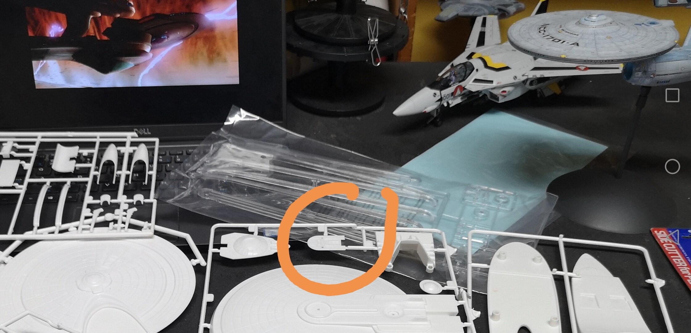

:;edit:;  Found a pic of the kit's sprues, I circled the fin extensions (they're right next to the all-new fins)

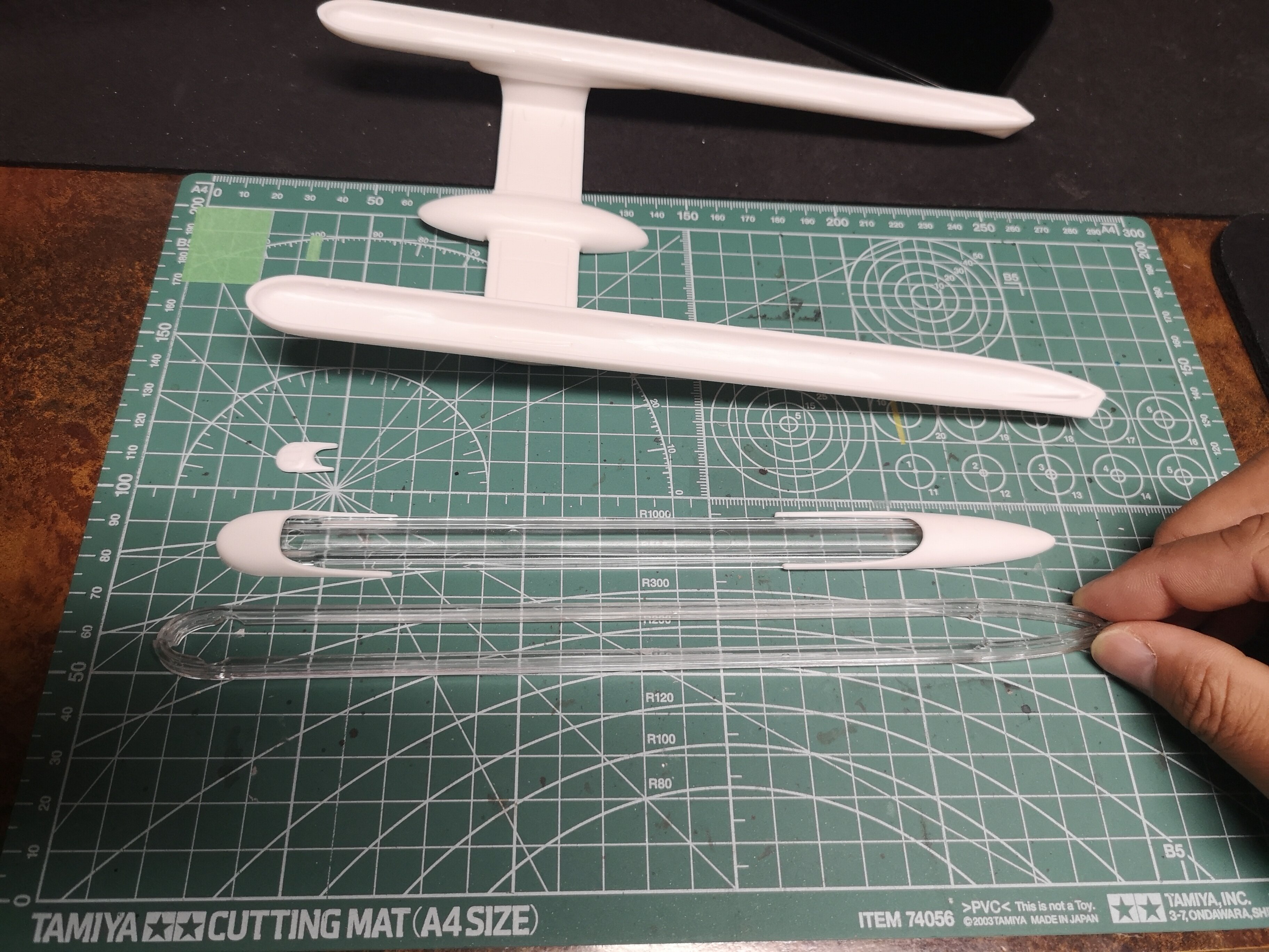

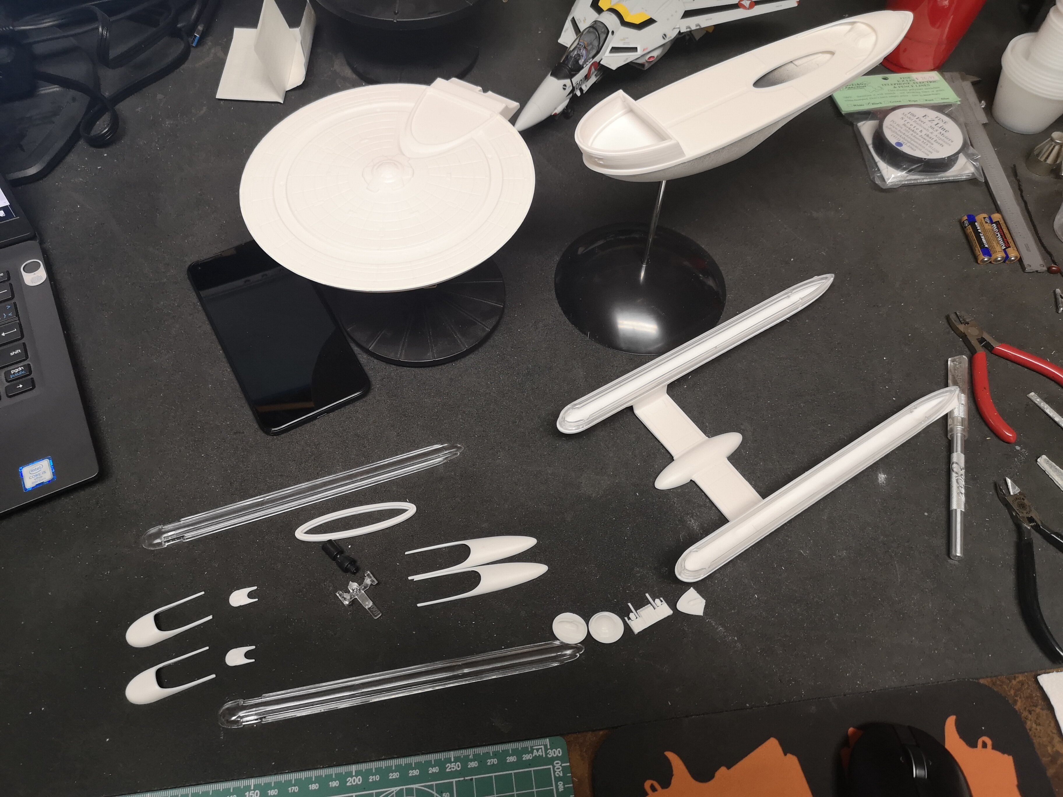

Interesting.  The instructions for this version don't call for them, but they are in the parts pile

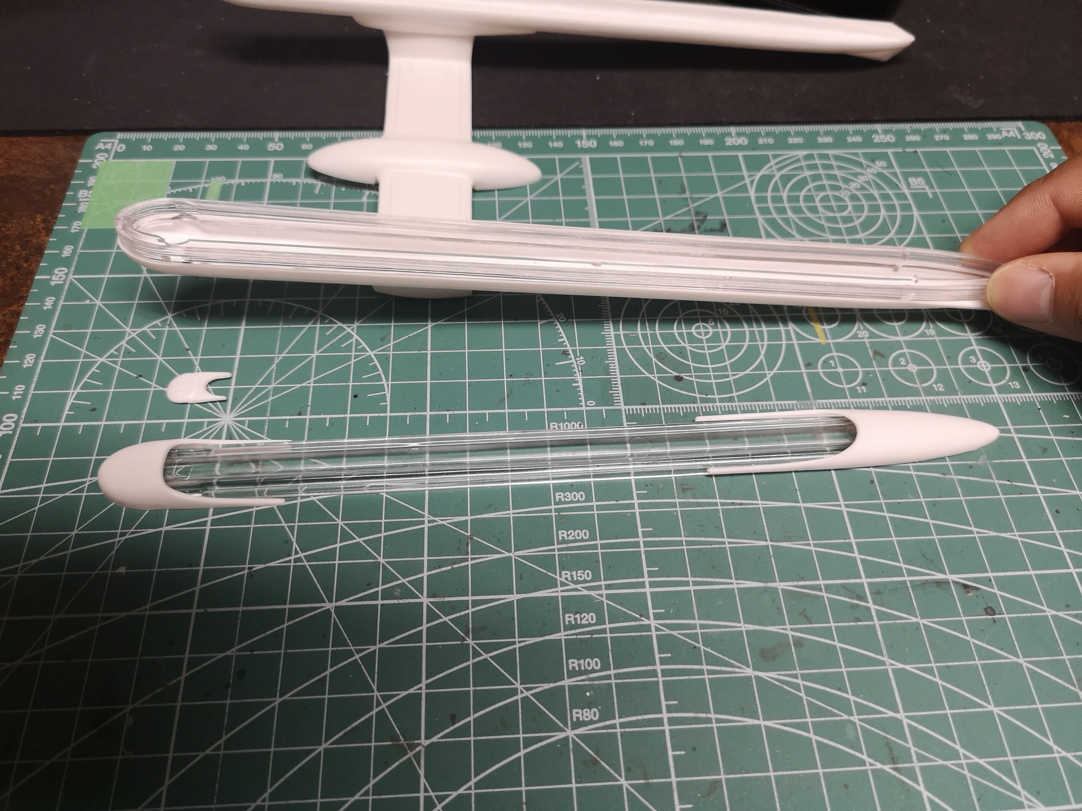

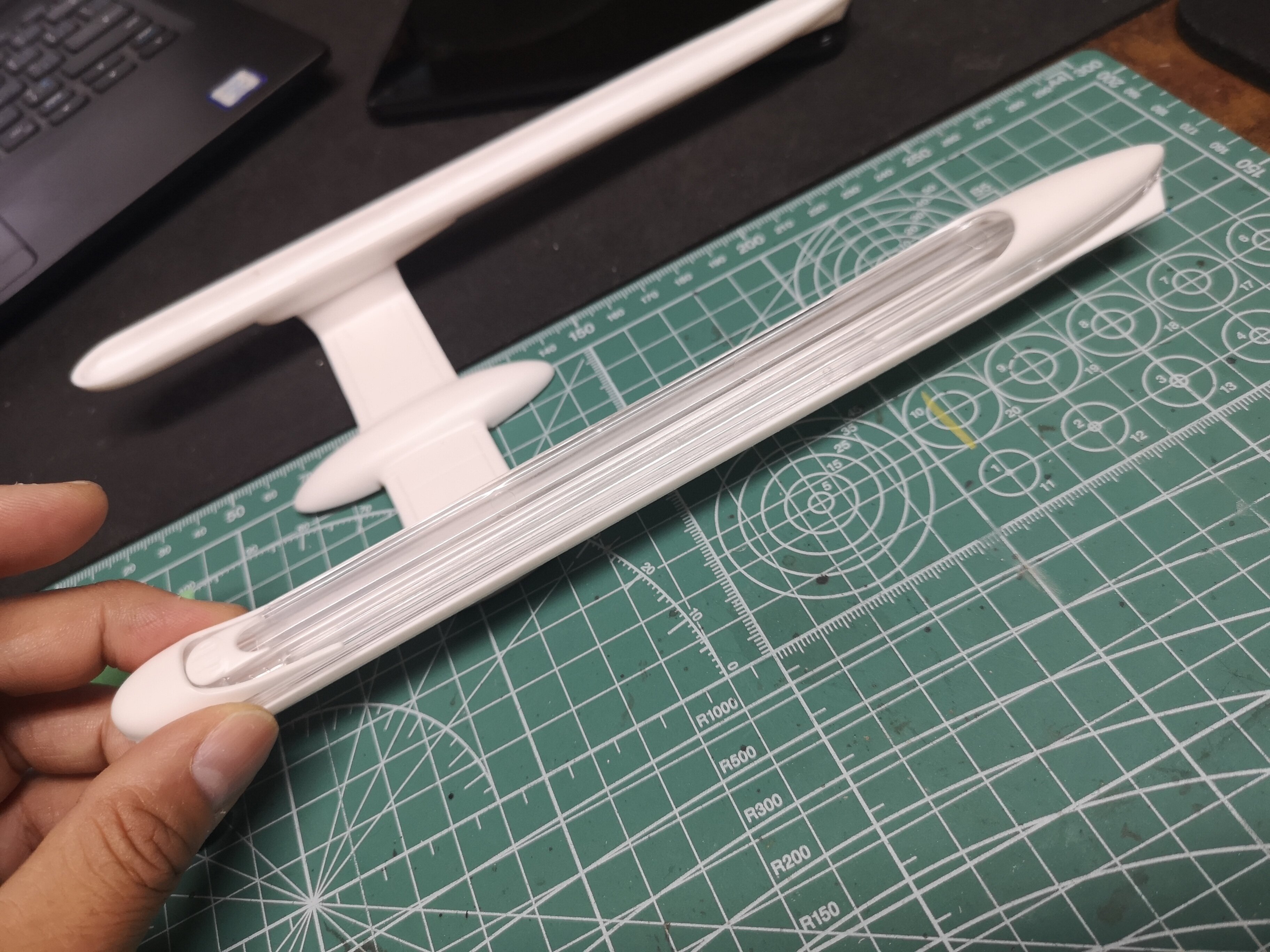

The nacelle assembly is bonkers just like the rest of this kit.
There are no reference tabs of any sort for these parts.
The chillers have small pegs, but that's it.  My hats off to anyone who not only builds these but lights them as well.
Mocked it up, but there is nothing locking down any of these parts, they're just sort of free floating and I have to eyeball whee to glue them down.
I don't feel a tremendous amount of motivation to finish this thing, lol!
I'll git 'er done though eventually.
Lots of filling.... Lots.

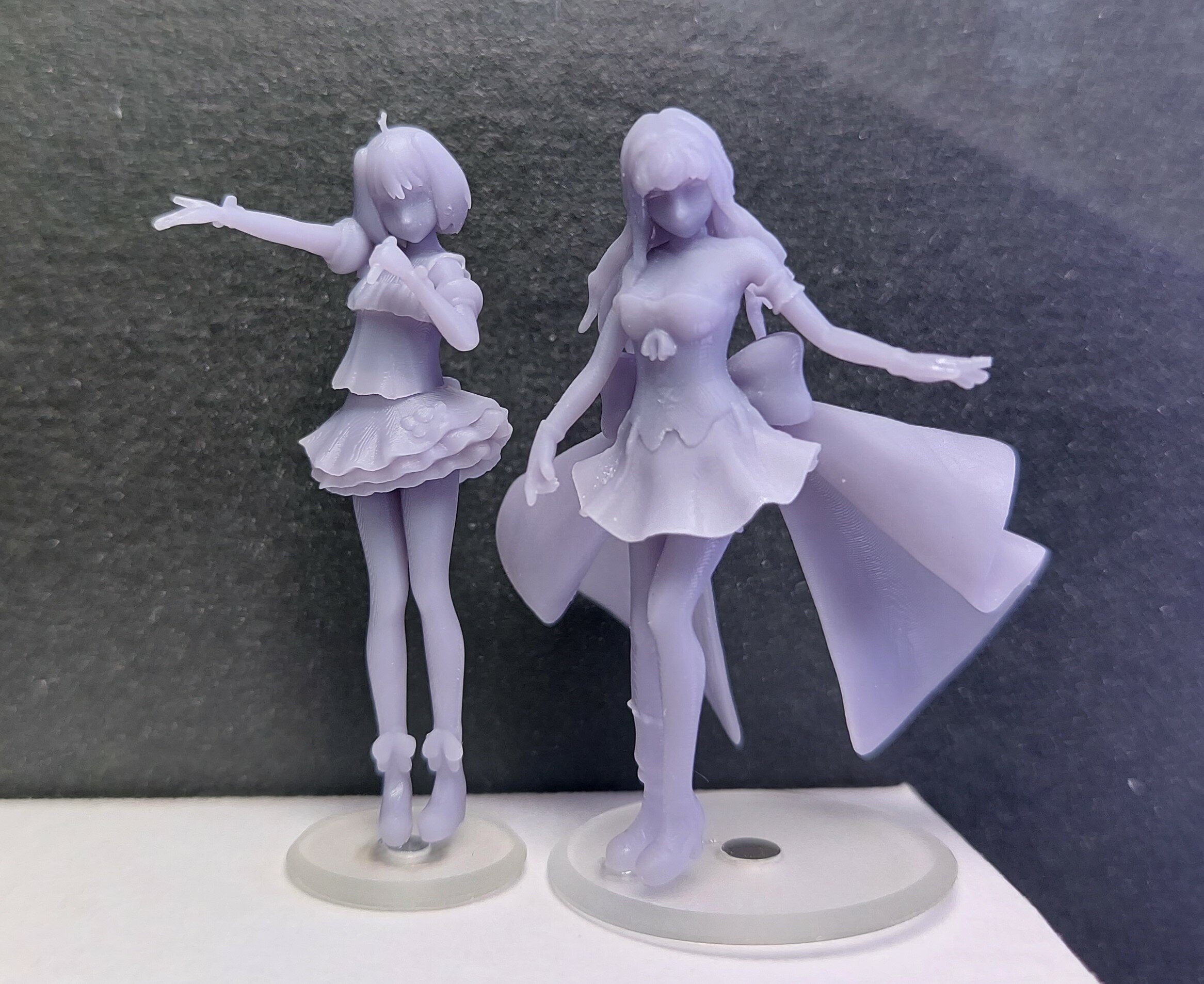

I don't want to turn this into a 3D Printing thread, and I am also fearful that people will try to monetize Macross intellectual property. The pandora's box of 3D printing is open, anyone can search the web and learn how to do this.
But if you want to know more about the process, I will try to give some details with each figure, because the process always differs.

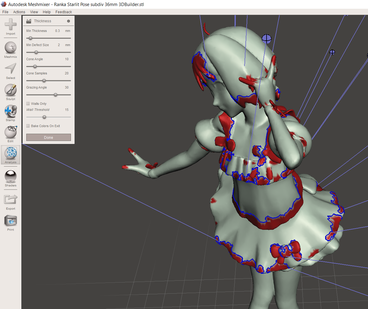

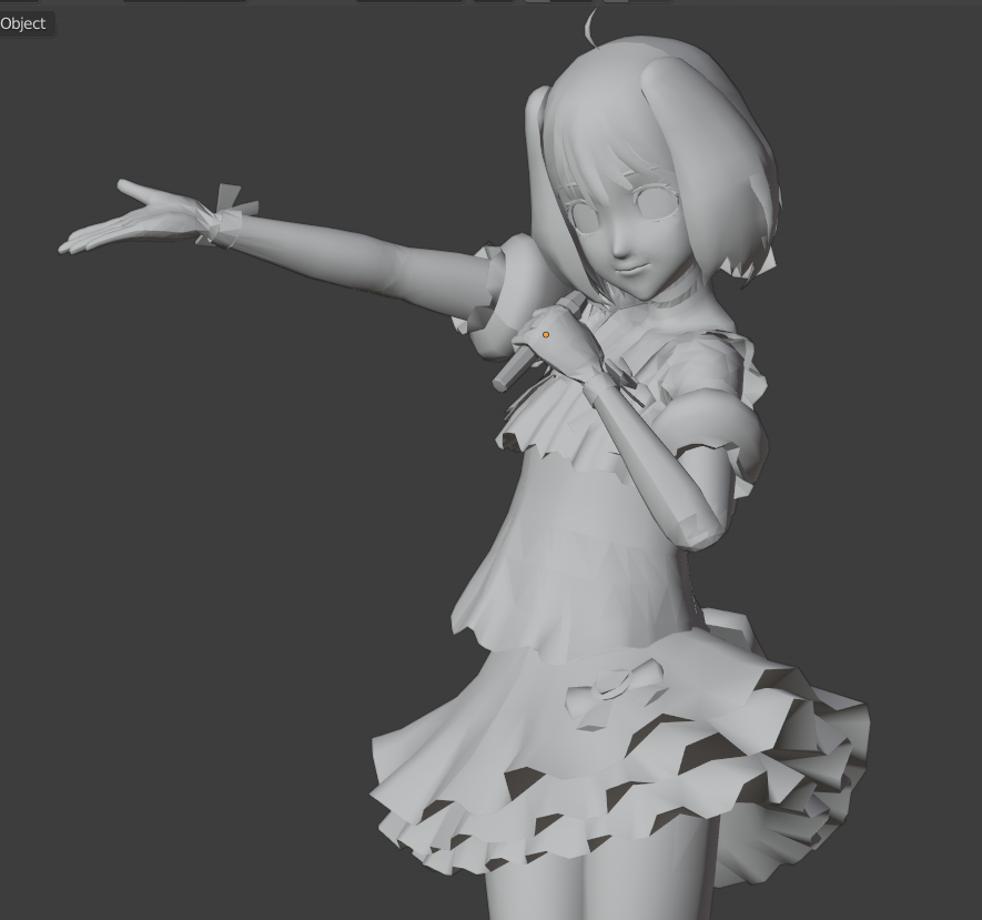

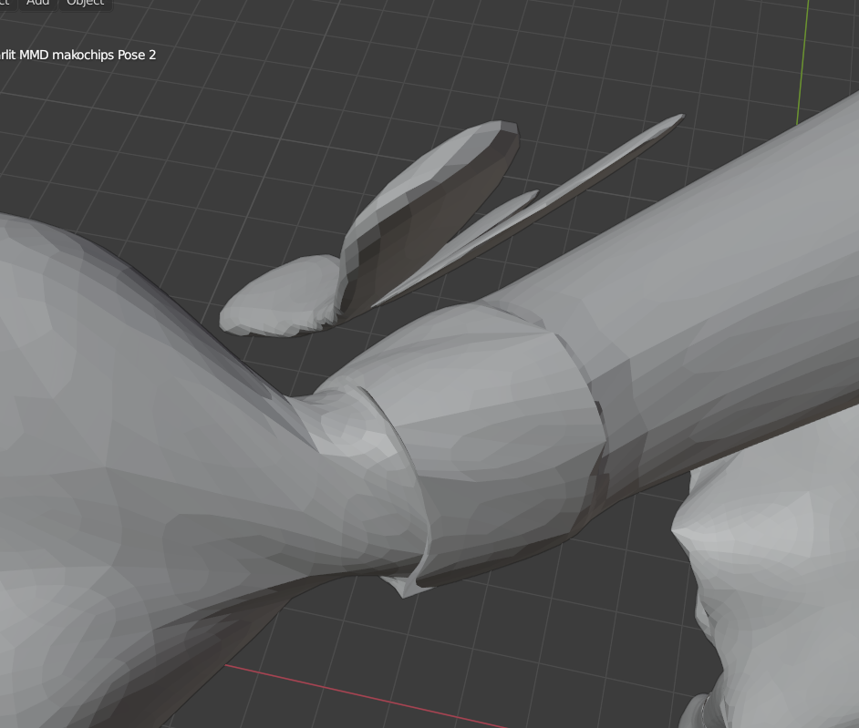

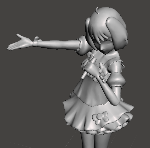

To start with, I will give some steps on my next Ranka figure to go with Sheryl.  Keep in mind that my 3D Design skill level is zero, so any feedback is welcomed.

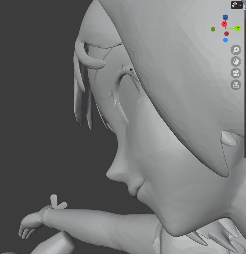

Ranka is an MMD file. This is how she looks before processing. With MMD  files you can apply pose libraries, because MMD files use standard bone armature naming. Other files like STL and XPS, you have to pose yourself with an armature or posing app like Mixamo. But those tend to cause a lot of deformations that need to be resculpted later. With MMD pose libraries, the poses are cleaner and require less work.
With this pose, I needed to consider how it will print, so I put the fingers together as much as possible to make solid objects for printing, and avoid very thin parts that will easily break off. I also changed the pose to hold a microphone, and imported an UTA Macross mic.
Ranka is still low poly, and at some stage I will smooth the surface. When depends on if I get any distortion, if I do, I delay processing to a later stage.  The same goes for all my processing, the order depends on a visual check of results.  There is no set order.

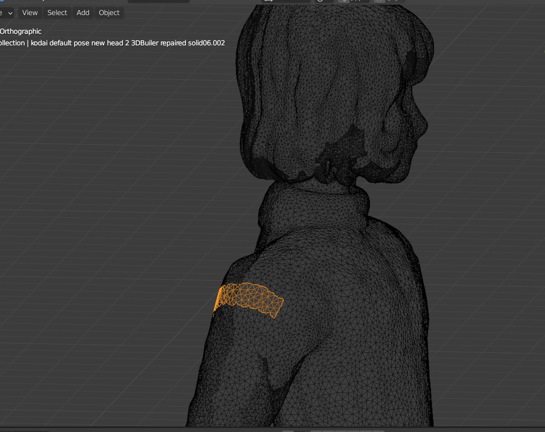

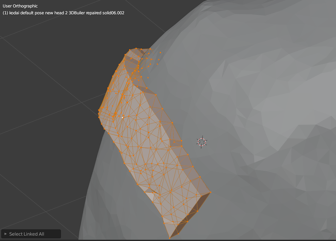

I scale the figure to my size of 3.6 cm, then I run a thickness inspection to see where I have problems. I want most parts to be at least 0.2-0.3mm thick. The red parts don't pass the test, and I will try to thicken them. Some edges will remain too thin and not form during printing, but that's okay with me.
Visual inspection shows that the hair bangs are too thin, so those need thickening. As do all the little ribbons she is wearing.
Checking this ribbon on her wrist we see that many of these details are not actually attached to the model, so I need to push them in.
After exporting the model to STL and repairing in 3D Builder, a lot of the thickness problems are already solved. Every 3D model needs to be repaired to make it manifold and printable, you can do this with Netfabb, Microsoft 3D Builder or Microsoft 3D Repair.  Ranka is one simple model, so I had to repair her only once. Other models made out of disparate parts kitbashed together may need to be repaired separately then brought together.
Before Thickening Parts:
After Thickening Parts:
These Before and After shots show the results of thickening her hair, ribbons and dress parts.
I also made the object "solid" in Meshmixer, which further prepares it for printing and adds some thickness everywhere, it has the drawback of also losing small details like on the face, as you can see.

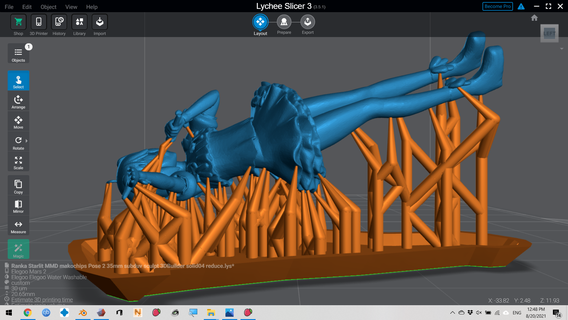

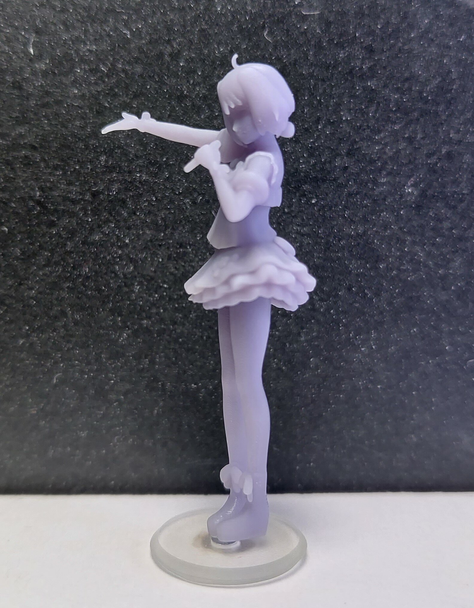

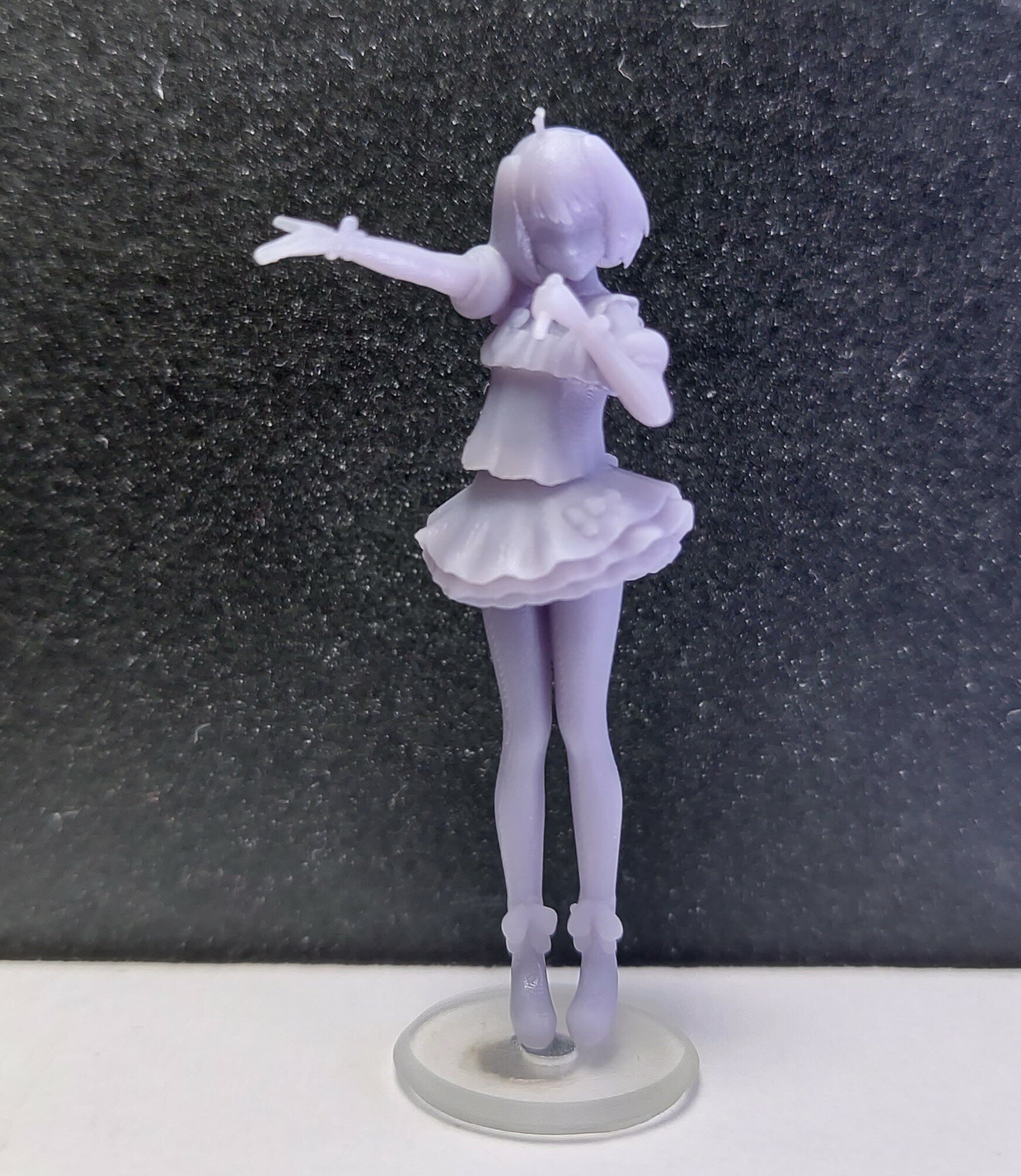

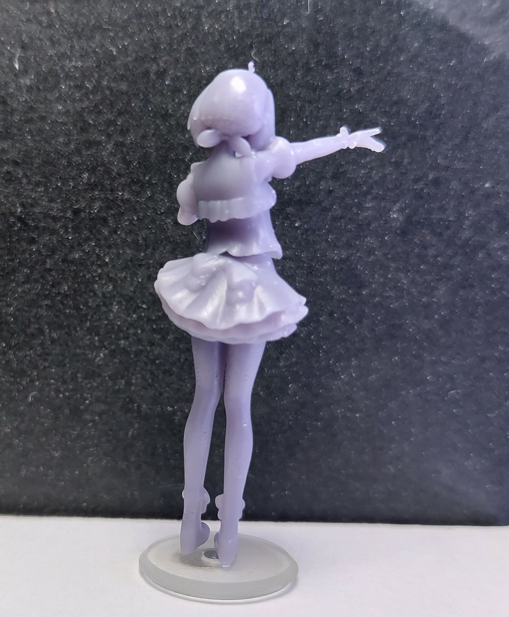

She is ready for supports and printing at this stage.  But these designs are very delicate, so you have to be very careful removing from the sprues, I don't rip them off like on large prints, I snip each one off carefully with nippers and model blade and magnifier to avoid causing any tension.
Years of hobbying experience helps me get them off without damaging weak thin parts, but I always lose a finger or two that need remolding and sculpting.
For this size figure, I use 0.3mm support contacts points, which are strong enough to anchor the model.  For thin parts like fingers, hair and delicate dress edges, I use 0.2mm-0.25mm contact points to not damage the features, but I have to be sure to anchor them with a 0.3mm support very nearby, or they will rip off during printing and result in a failed print.
As you can see above, my biggest concern is the fingers and ribbons and dress edges. Due to good pre-planning, each hand only needed two supports to print correctly, without each finger needing a support. I angle the figure to build on itself, and avoid any supports on the front of the figure.
The final result after postprocessing and curing. No sanding involved with these two, I will deal with imperfections after priming.
Credits: Models by DeNA and PON. Conversion and edit by makochips. Pose by snorlaxin. Resculpting, posing, editing, printing by me.
This is fan art for personal use, not for sale or distribution.

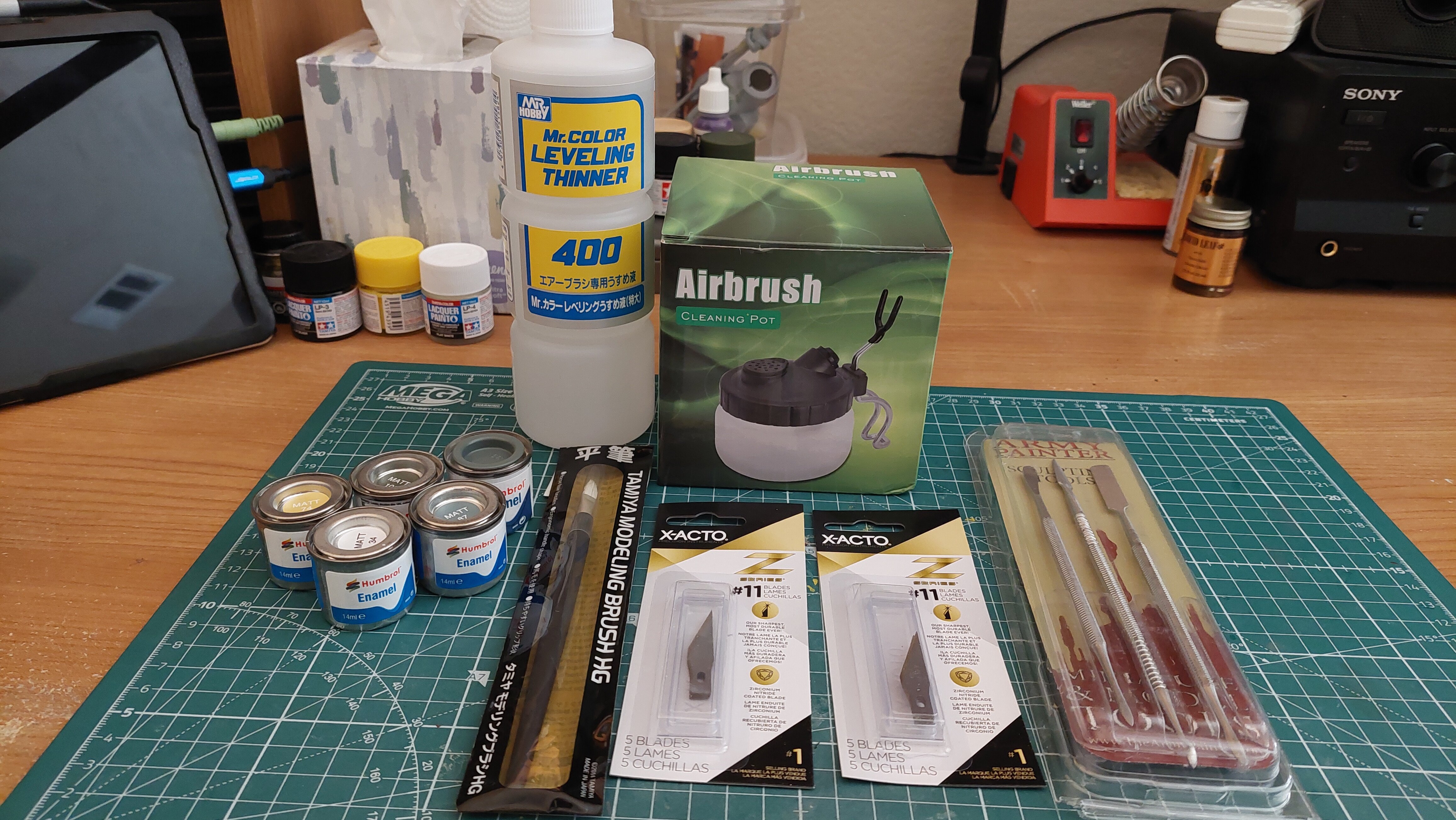

BDay haul of hobby stuff came in! Still waiting for my Mr. Surfacer 1500 Black. Trying Humbrol enamels from good ole England land for the first time, see if they brush paint worth a crap....
Oh, now those I remember.. my dad had a few of those from ages ago, and if my memory serves me correctly, they should brush beautifully.  Those old metal pop-caps bring back some good memories. ^_^
I've still got a fair stash of Model Masters and normal Testors paints to go through, but you're right, my brushing experience with Tamiya acrylics hasn't been anything impressive so far.  I might have to start importing more enamels.
Well @Chronocidal, I can report that my absolute favorites are still Model Master enamels for brushing, I picked up a jar of Brass the other week at the hobby shop, one of the few colors left, and it just lays down absolutely beautiful with a brush. Just like I remember it doing. The Humbrols, with just a quick 5 minute brush on a plastic spoon test I can report are pretty good...depending on the color....oddly the yellow and white did the best! Go figure. The grays and greens not so much, (and yes, I did stir them up adequately).  I know I'm gonna have to try Tamiya enamels at some point, just so hard to get at the moment unless you pay stupid prices for shipping from overseas.
@derex3592 Heh heh, Humbrol! I hope they work for you. Some need some thinning.

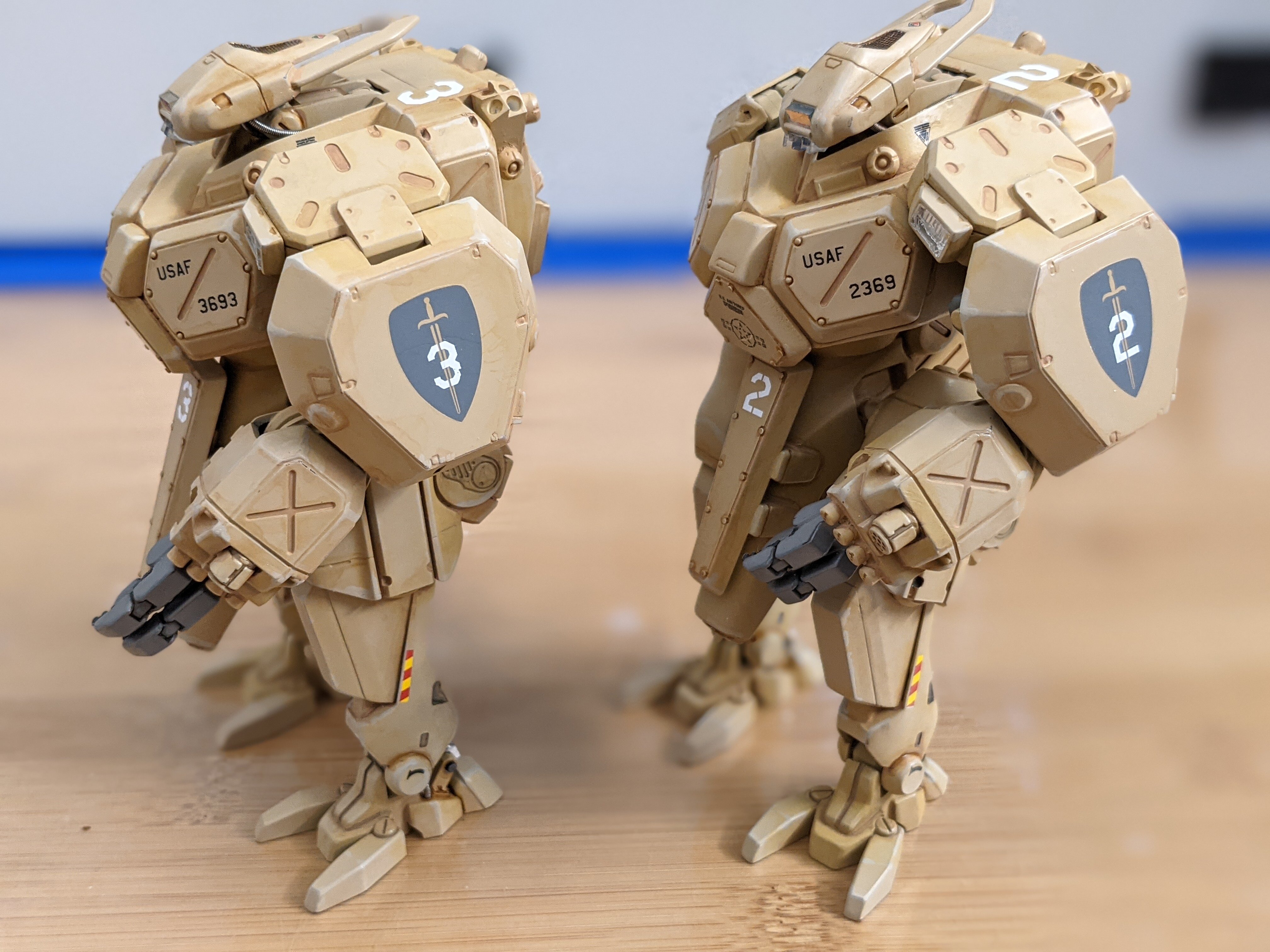

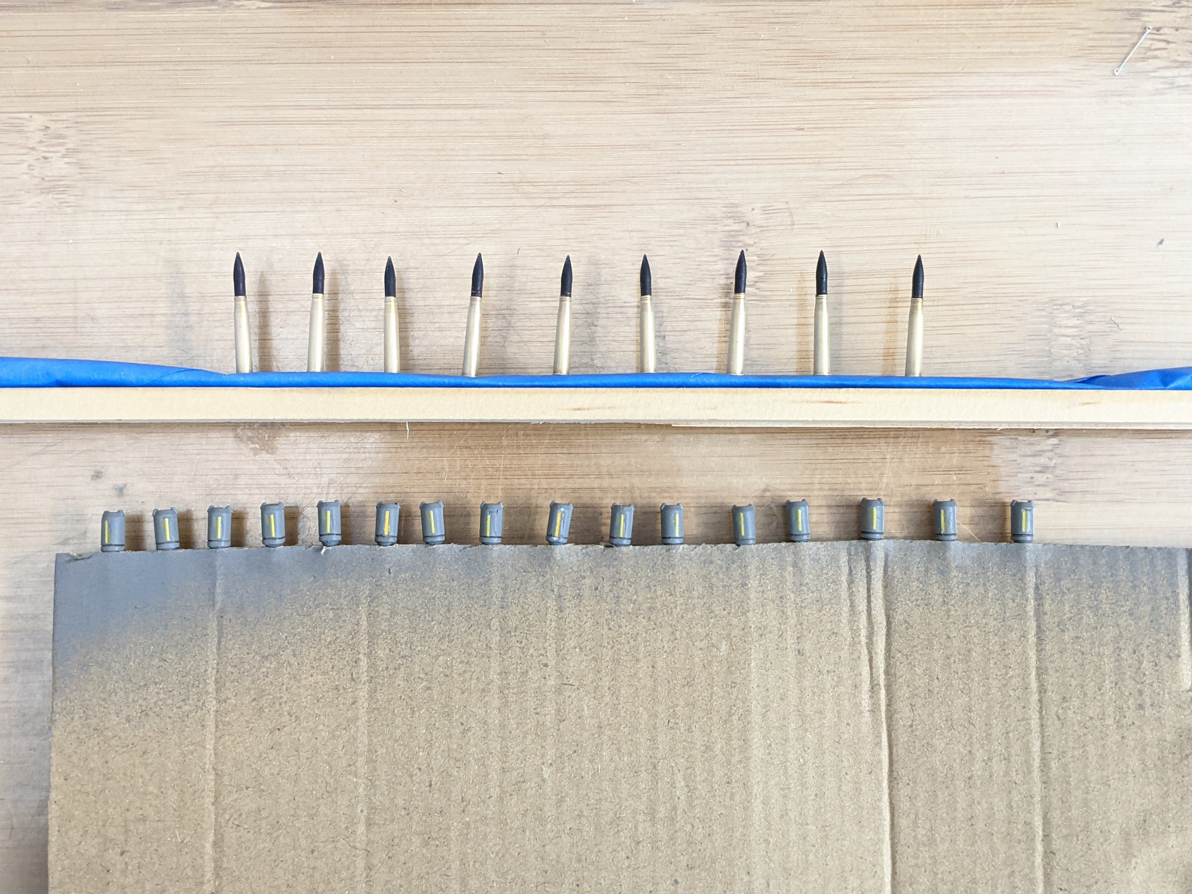

Ammo - Check! The 75mm brass is painted and coated. The defensive units are decalled and painted (two decals each, one on each side - I don't know why!).
Yes, Air Force! OK, I may be slightly biased, but who had the first robot dogs? https://www.af.mil/News/Article-Display/Article/2551037/robot-dogs-arrive-at-tyndall-afb/
These of course are a manned design. Thanks for checking in! - MT

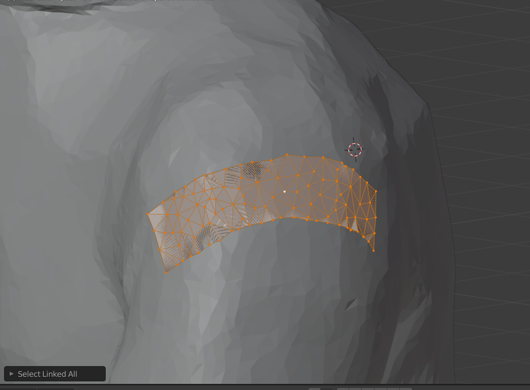

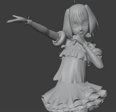

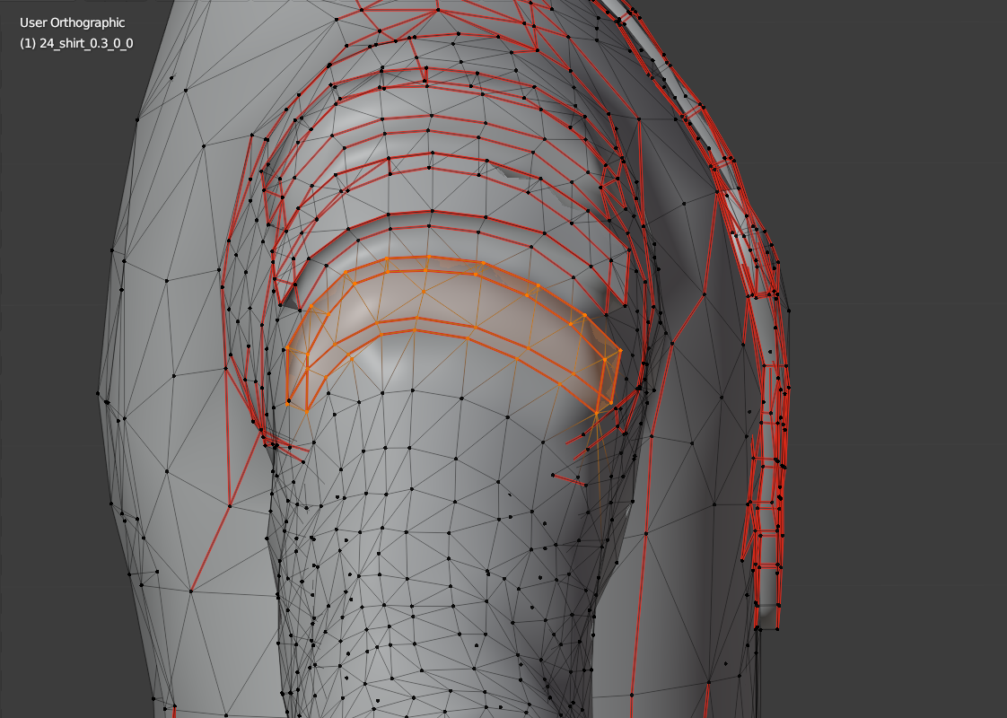

 @MechTech You had asked me if I can add detail to clothing to make painting easier. I just figured out a method based on traditional scultping. I'm not sure how pros do it, but this is simple and effective.
First I draw the shape I want directly on the figure's pixels.
Then straighten the lines.
Then I fatten or extrude the section to get a body hugging design detail.
Then we smooth everything out to get a better shape.
Now it looks like it will be a ton of fun to paint!
I have a lot of ideas for Macross figures now that I can add some details.
