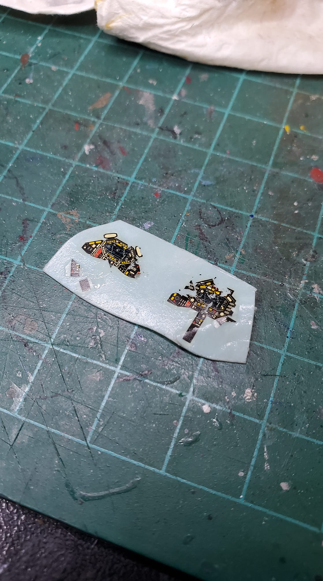

Well, something happened to the decals.
THEY WILL NOT slide off the paper.
they seem COOKED right on. its hard to see, but they are also very yellowed.
I've worked with yellowed decals before, but i've never seen a waterslide that wouldn't come off.
This project is garbage without the fine details.
The white strioes and such i can paint, and i have spare UN.SPACY logos but none of those details are paintable.
Heartbreaking, and the kit ws expensive.

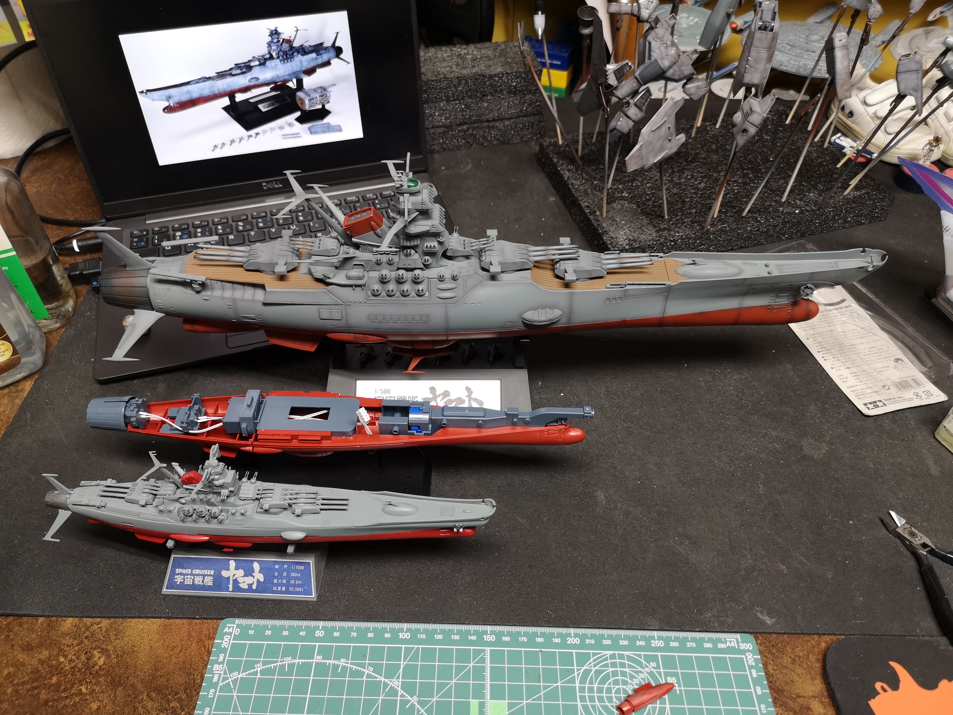

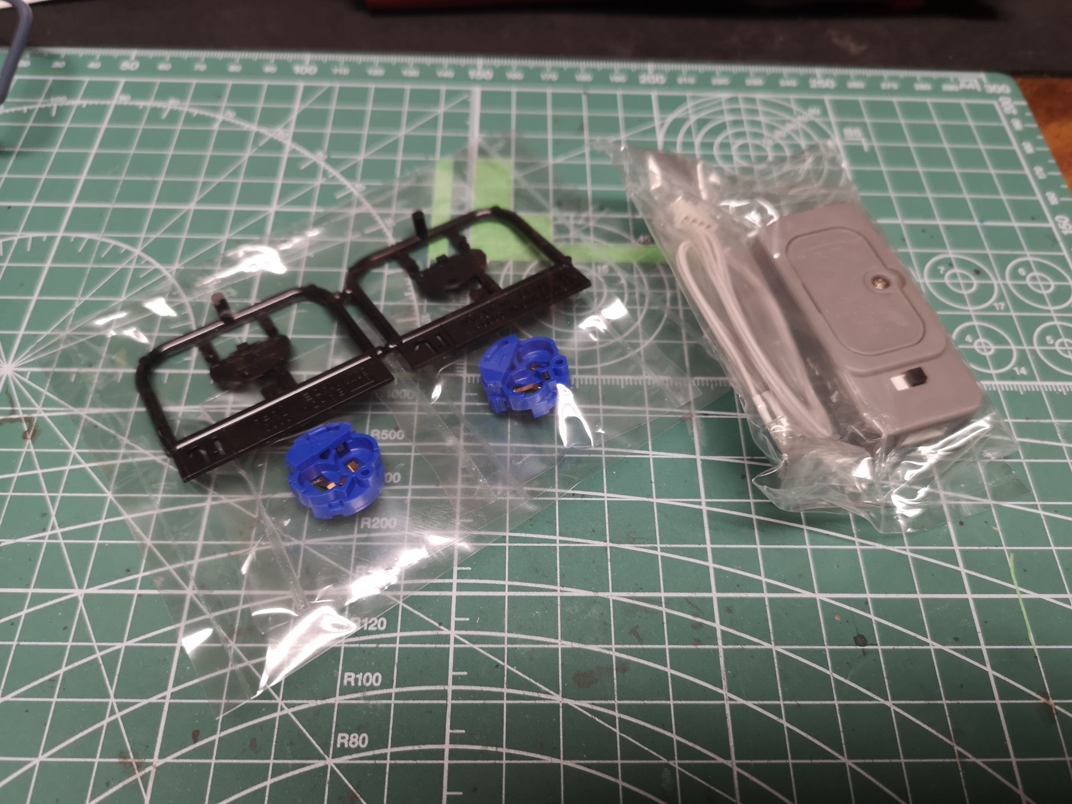

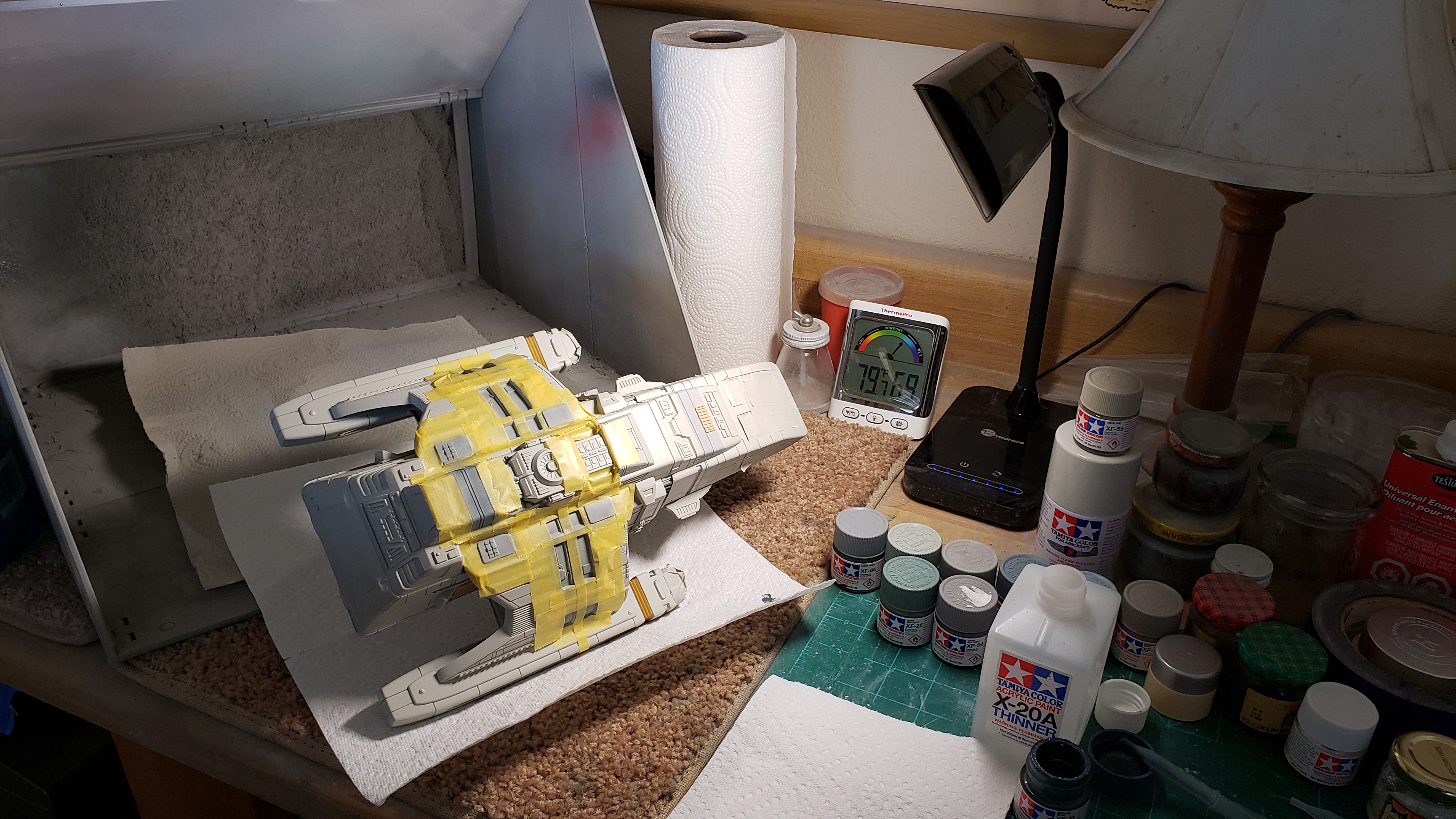

Not a lot to report..... The 1/1000 kit came with a bunch of spare parts, looks like the aircraft hangar or something, no instructions to build it inside our out of the model.
I know the Yamato 2199 version had this option, but this one is the 2202 version and there are actually some differences I noticed. IMG_20210521_010703.thumb.jpg.b9d78554173a994408c77ad01ba71442.jpg
The front end is actually wider than the older version.

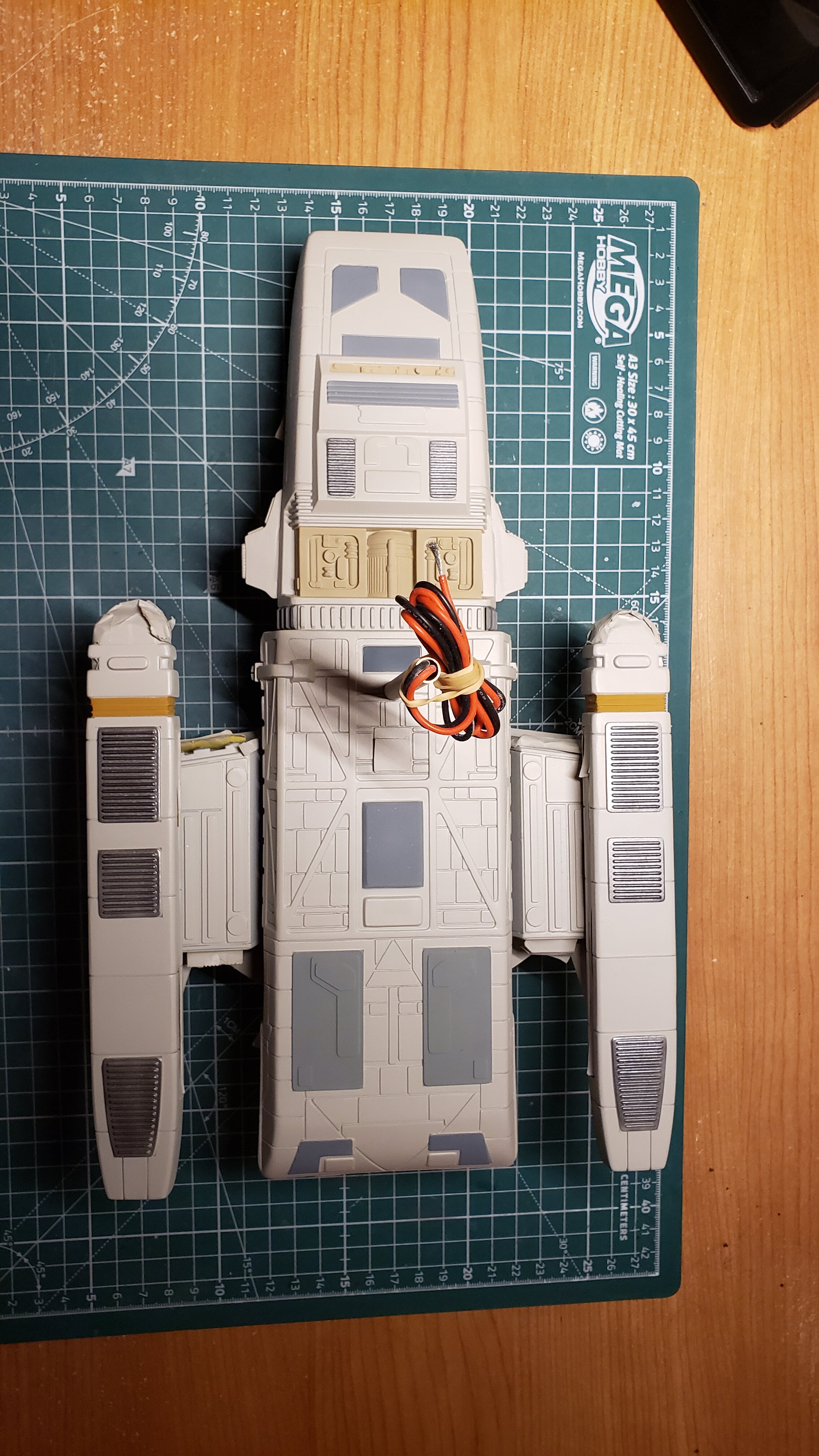

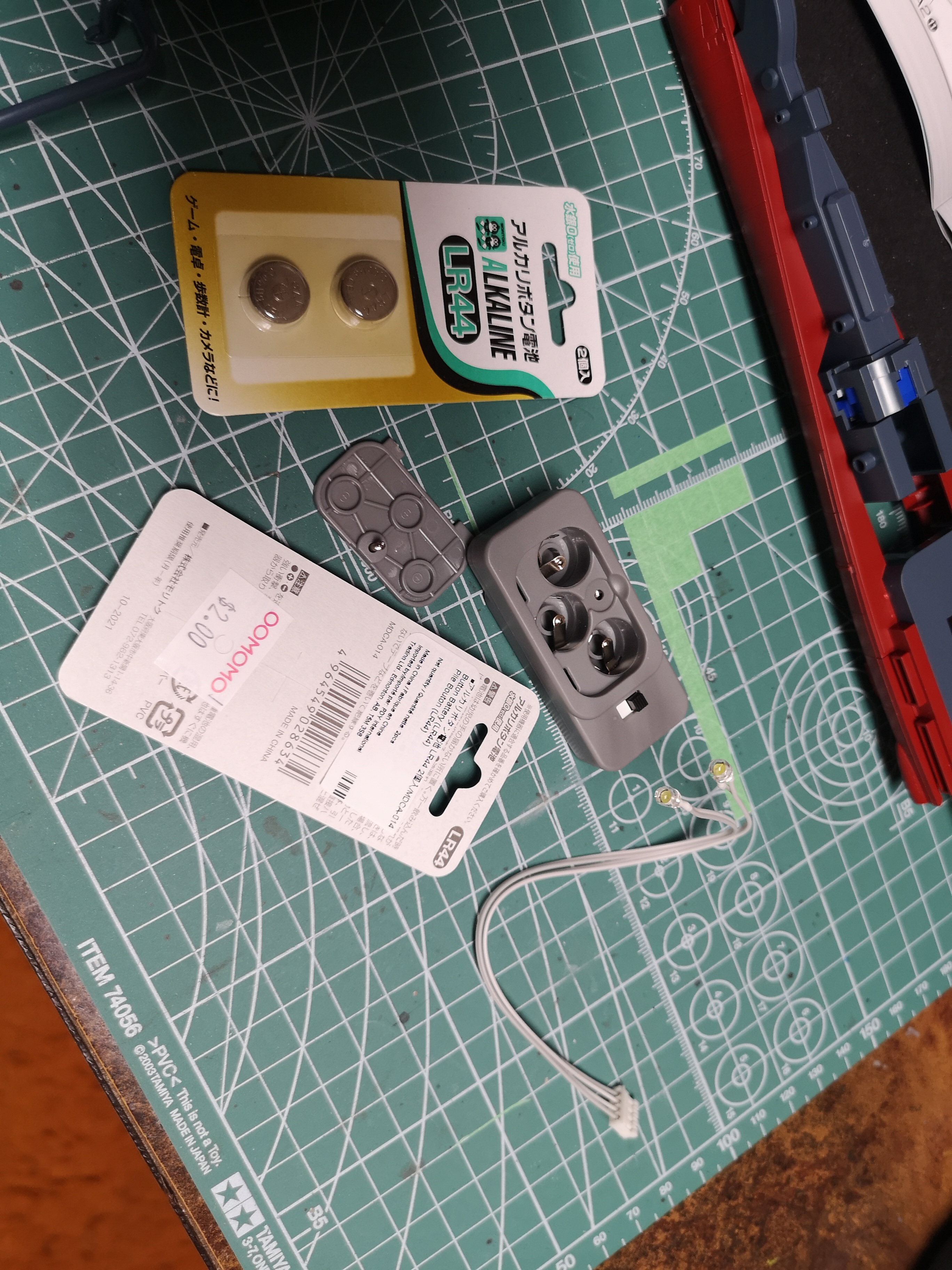

Lighting kit for the engines.
What the kit calls for to light it.
Sandwiched between the old 1/1000 kit, and older 1/500
Just working on the Yamato while the Pledge dries on my Chunky Valk
Once the Pledge cures, decals and weathering.

Yea, i'm thinking the glue was activated somehow, and they're stuck down. i tried soaking them up to 15 minutes, and they still wouldn't budge.
The damage you see in the photo is me actually picking them with the tip of my blade.

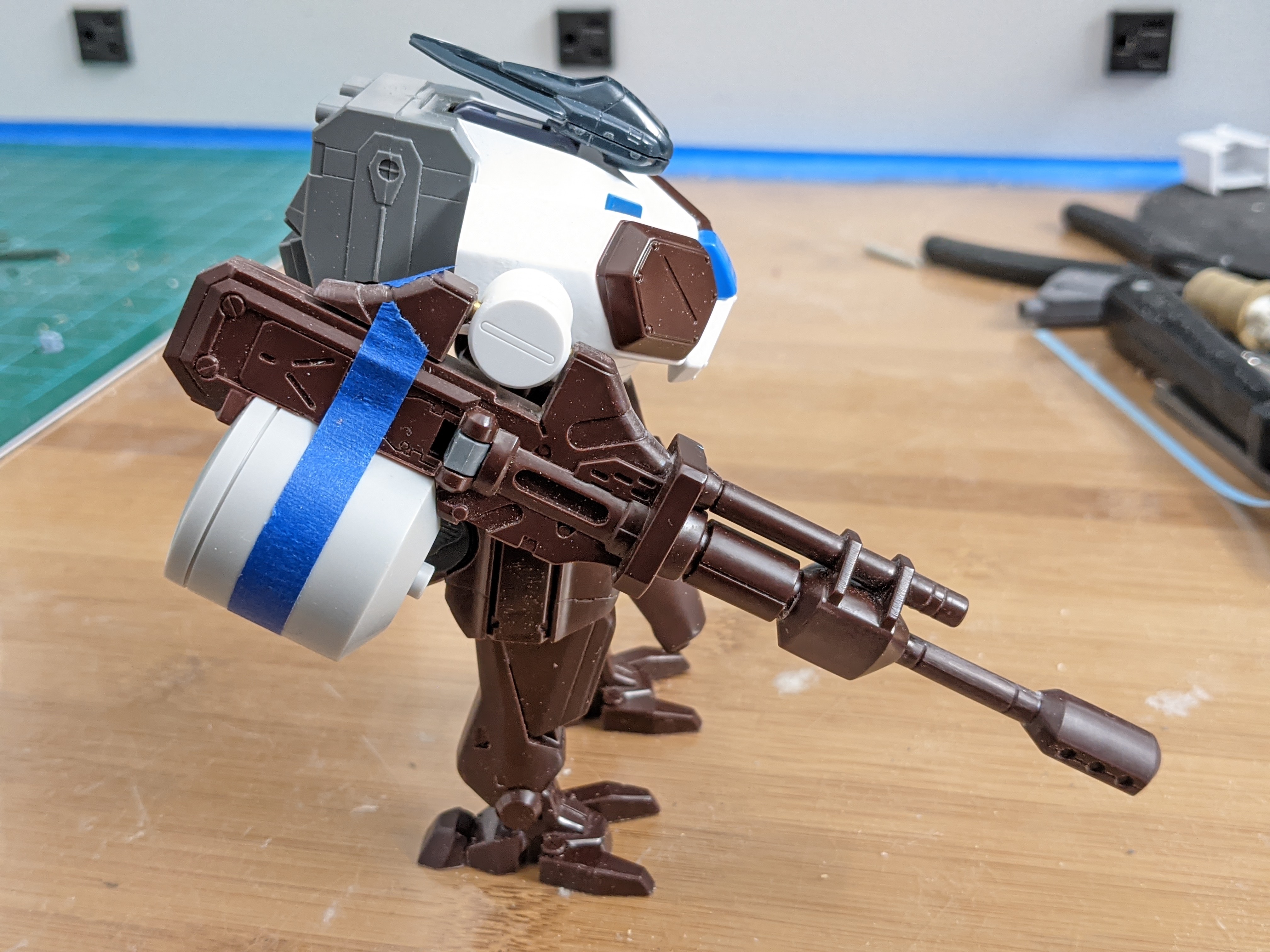

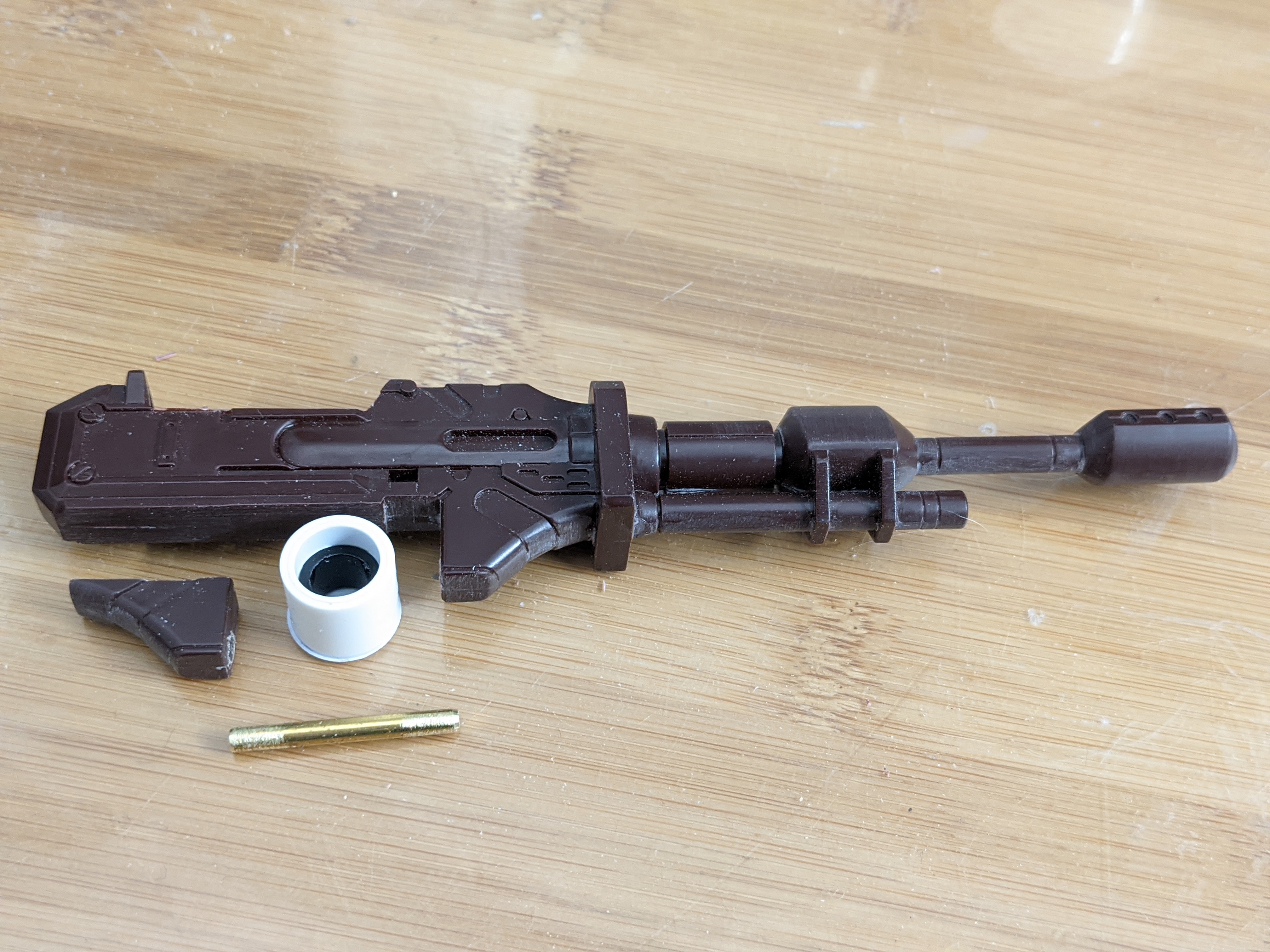

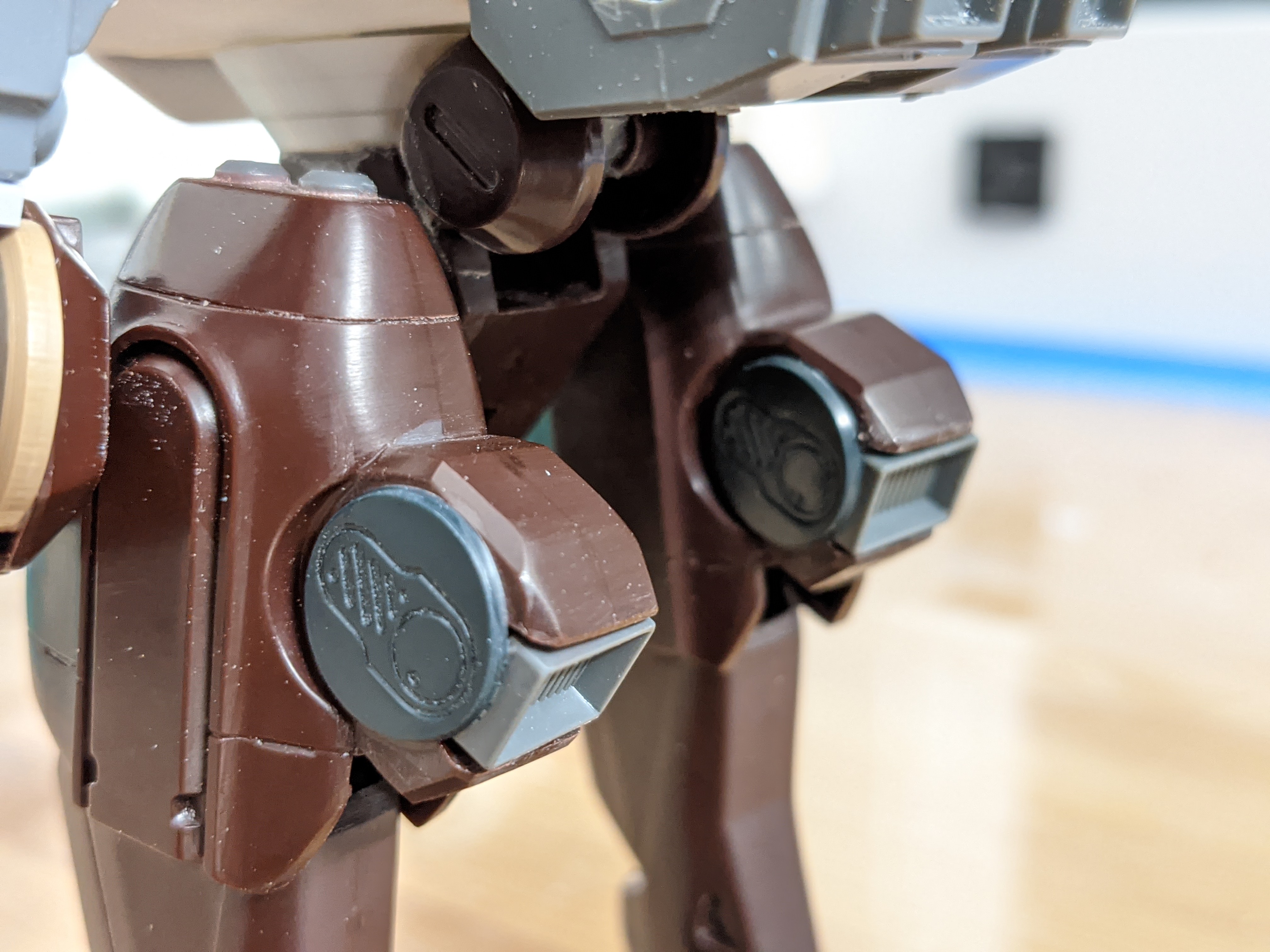

Time to bring out the BIG gun - really! I highly modified the stock cannon to accept the polycap joint and a canister for use as an ammo drum. I sat there for hours trying to figure this one out. Thank God a solution came to me. The polycap in the joint is so large, I just drilled a hole in it for a brass rod to go through. The brass is needed for strength. So the polycap is working on two axis at the same time now. The photo perspective makes the cannon and chest look larger than it is - smart phones are not too smart sometimes.
35-19.thumb.jpg.b02a2a4a3e4be946a65770b968825963.jpg35-20.thumb.jpg.e0fdd283fd8f239cc5c4fa5d18a6f7e7.jpg

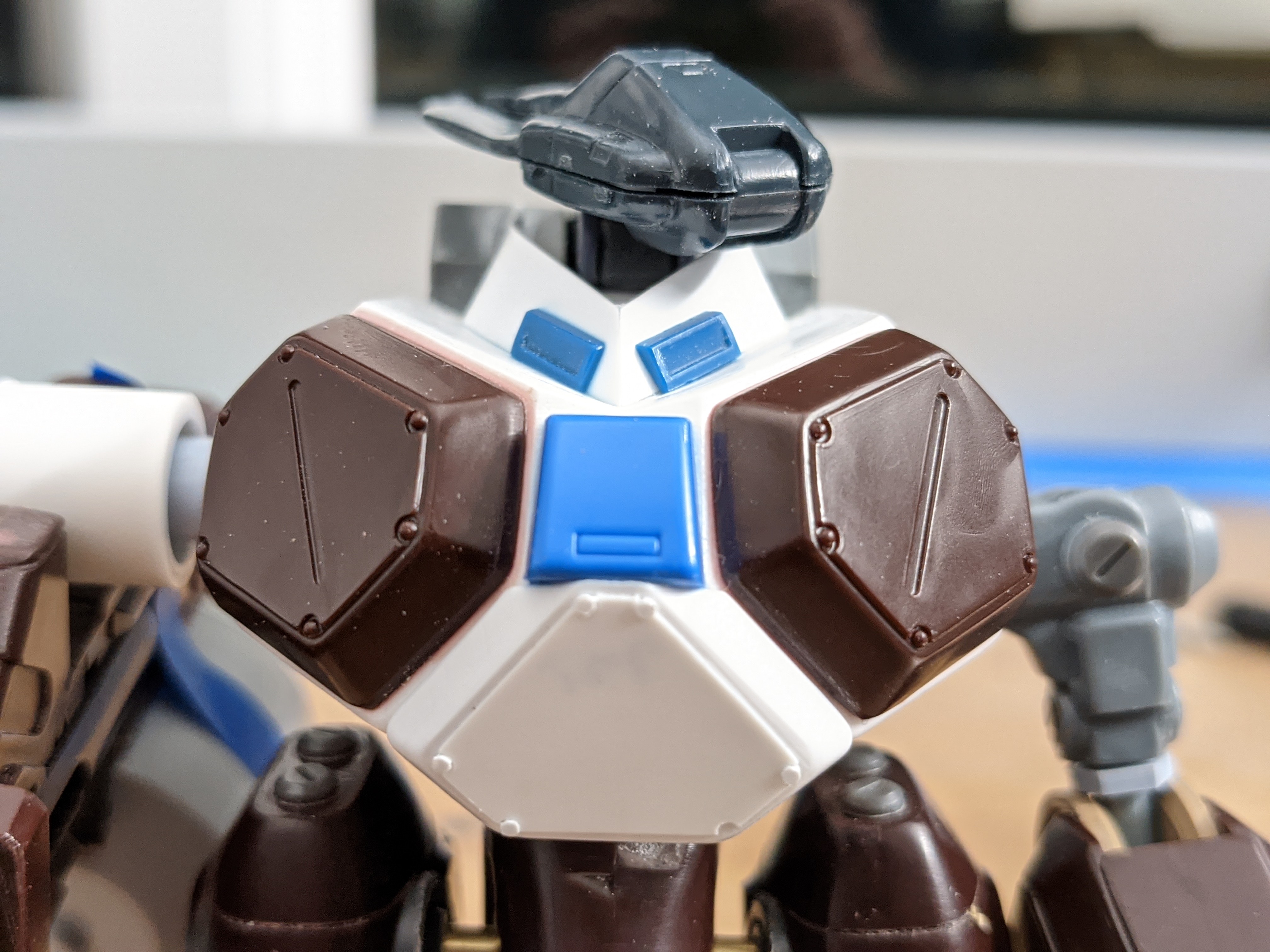

Then I created a plate to closely match the brown armor plates on the lower chest and added vision slots to the collar area.
Have you ever done something and it turned out wrong in some way? After I say this, you won't be able to unsee it, but the chest looks like a frog's face right now! I'm hoping a coat of paint and decals clears it up.

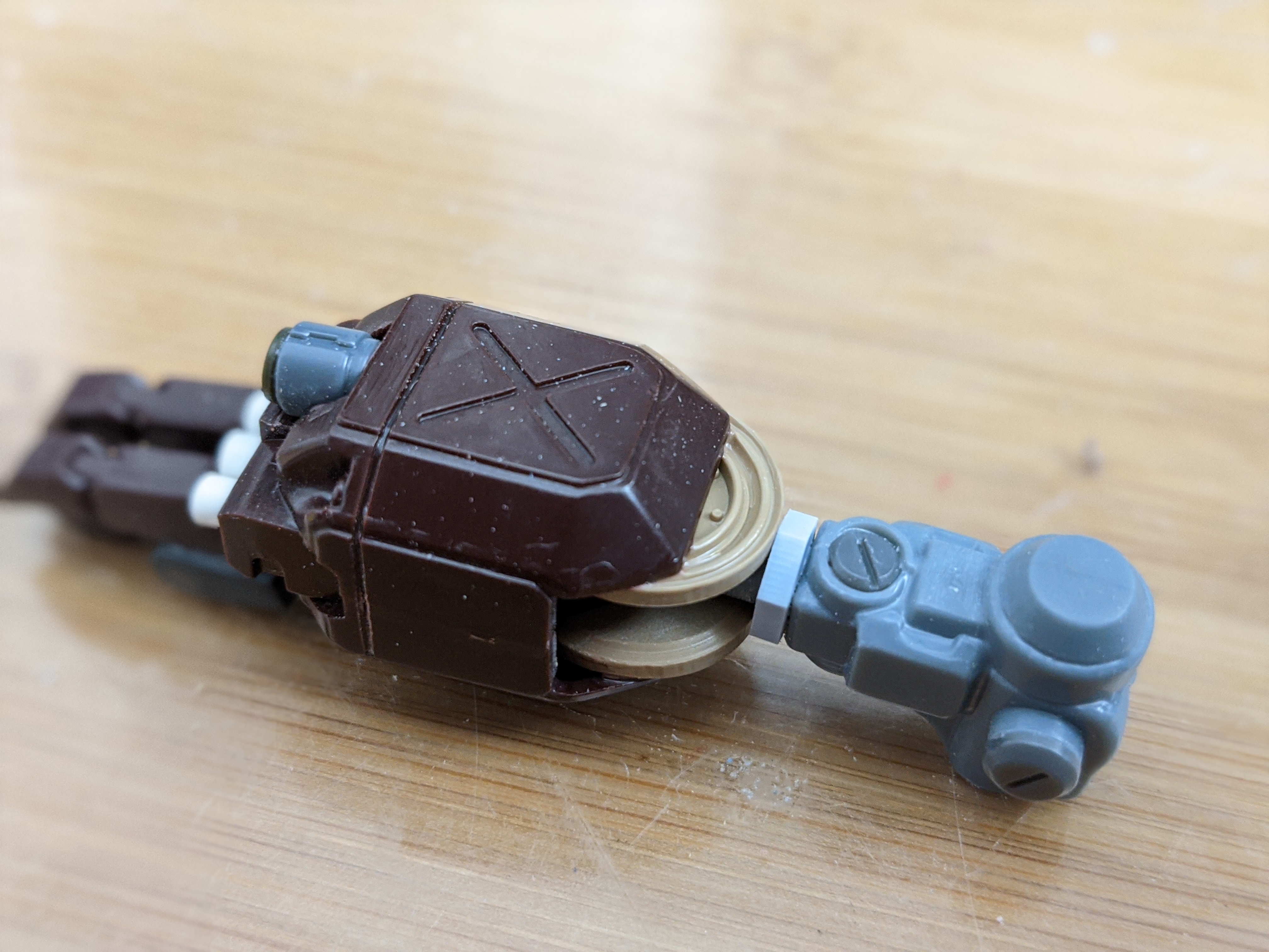

Next, I machined discs out of old wheels to cover up the joint area in the forearm. There is also a hexagonal piece added for detail and to space the arm pieces out on the joint.
35-21.thumb.jpg.0be9167af32689d18cf3c534e4e8b168.jpg35-22.thumb.jpg.5ca40e518def1904b6bbf00f4caa48aa.jpg

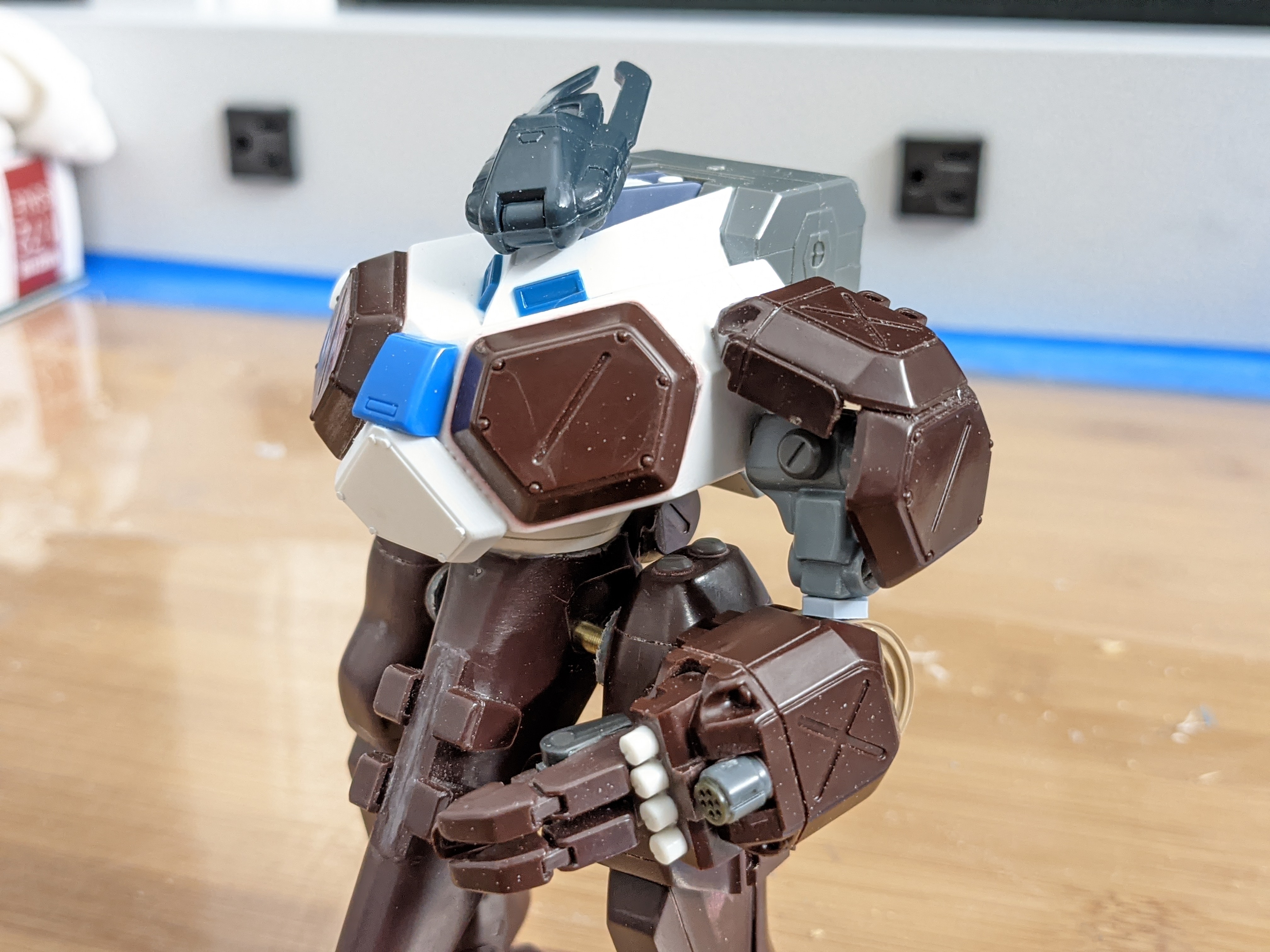

These are either going to be cooling systems or generators on the back of the legs. At least that gaping area is filled in now. And an oblique perspective shot to put it all together so far...
35-23.thumb.jpg.0db6d769ea72206c0d7e1af221574fb6.jpg35-24.thumb.jpg.4b0ad56cfb60ed67fe2bf3e48b7bebe5.jpg
Thankfully, everything is starting to come together - except that frog face thing:ph34r: Thanks for checking in! - MT

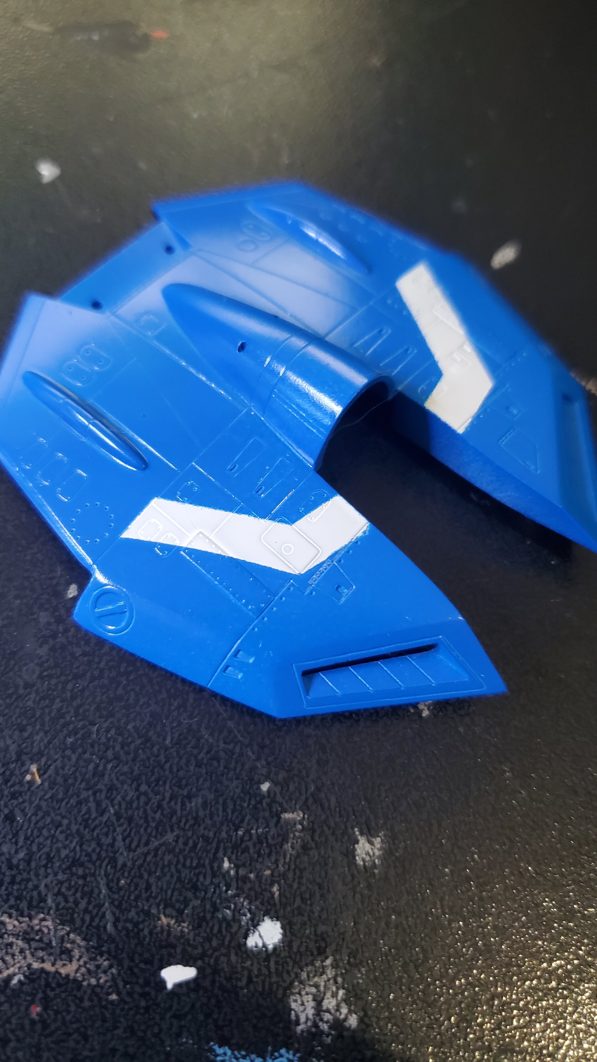

HAAAA!!

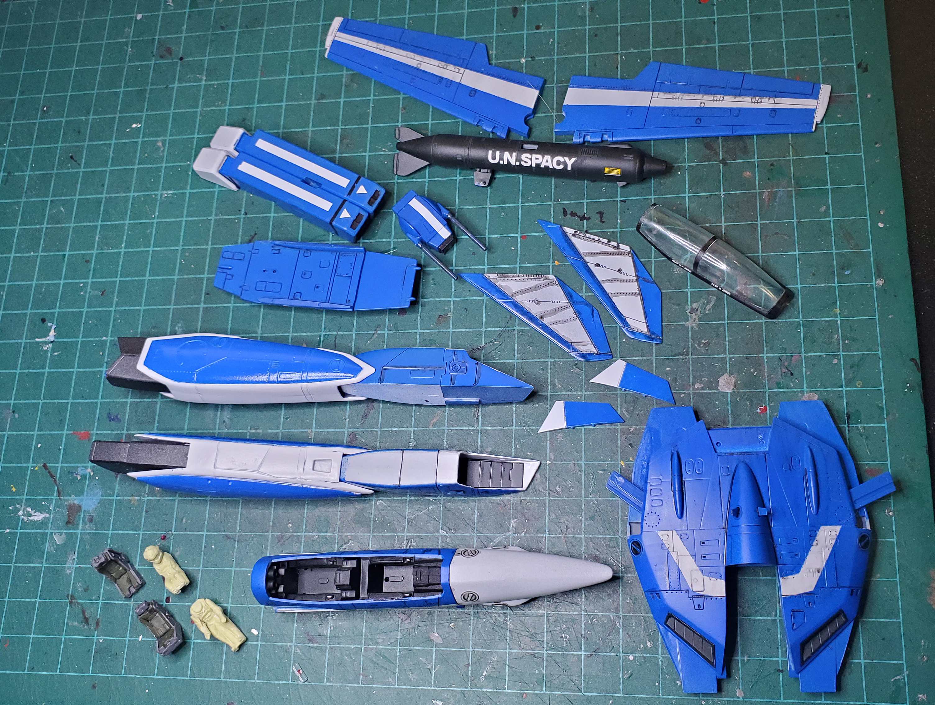

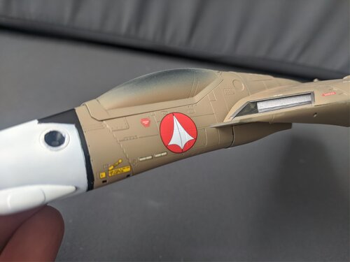

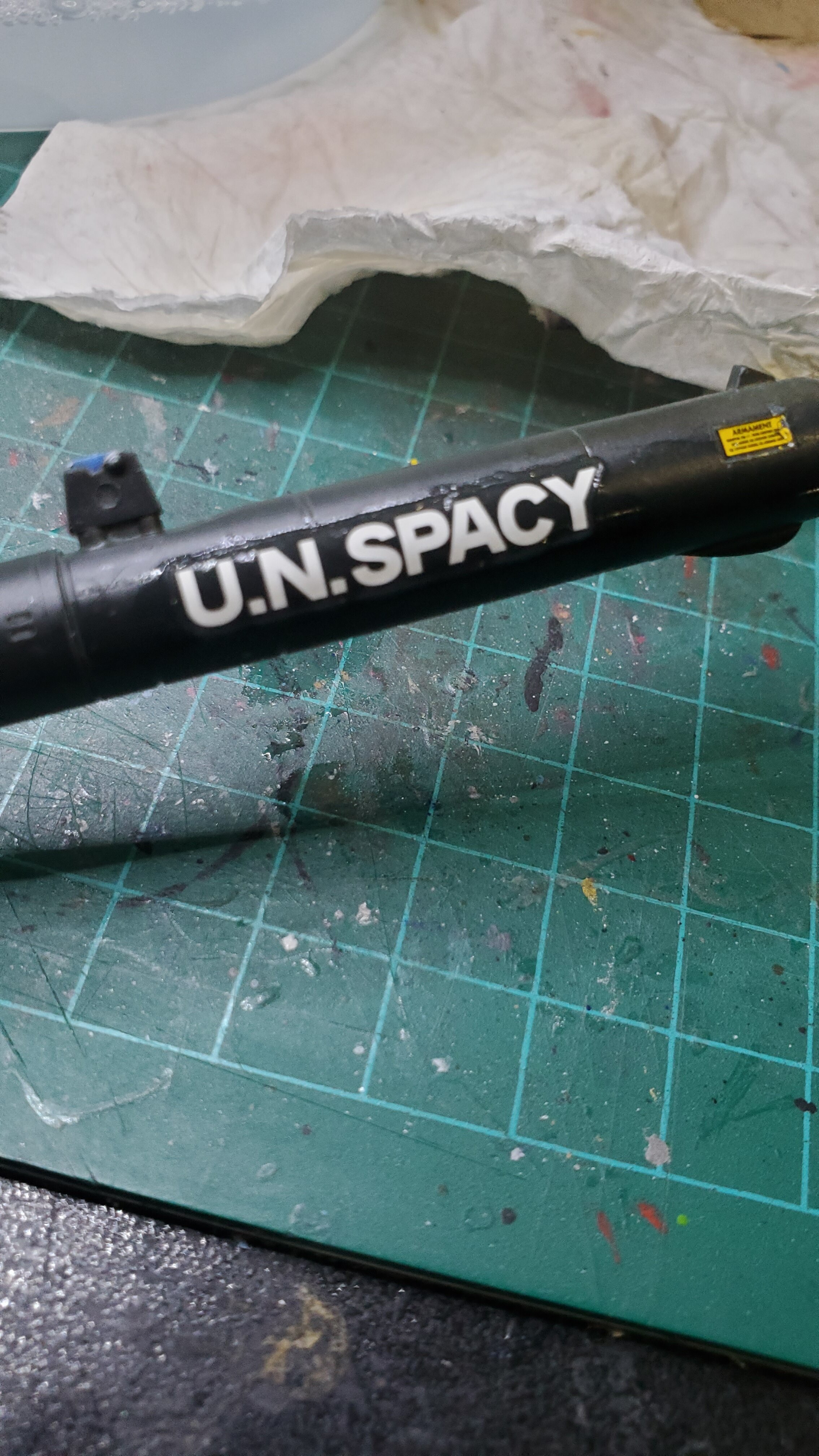

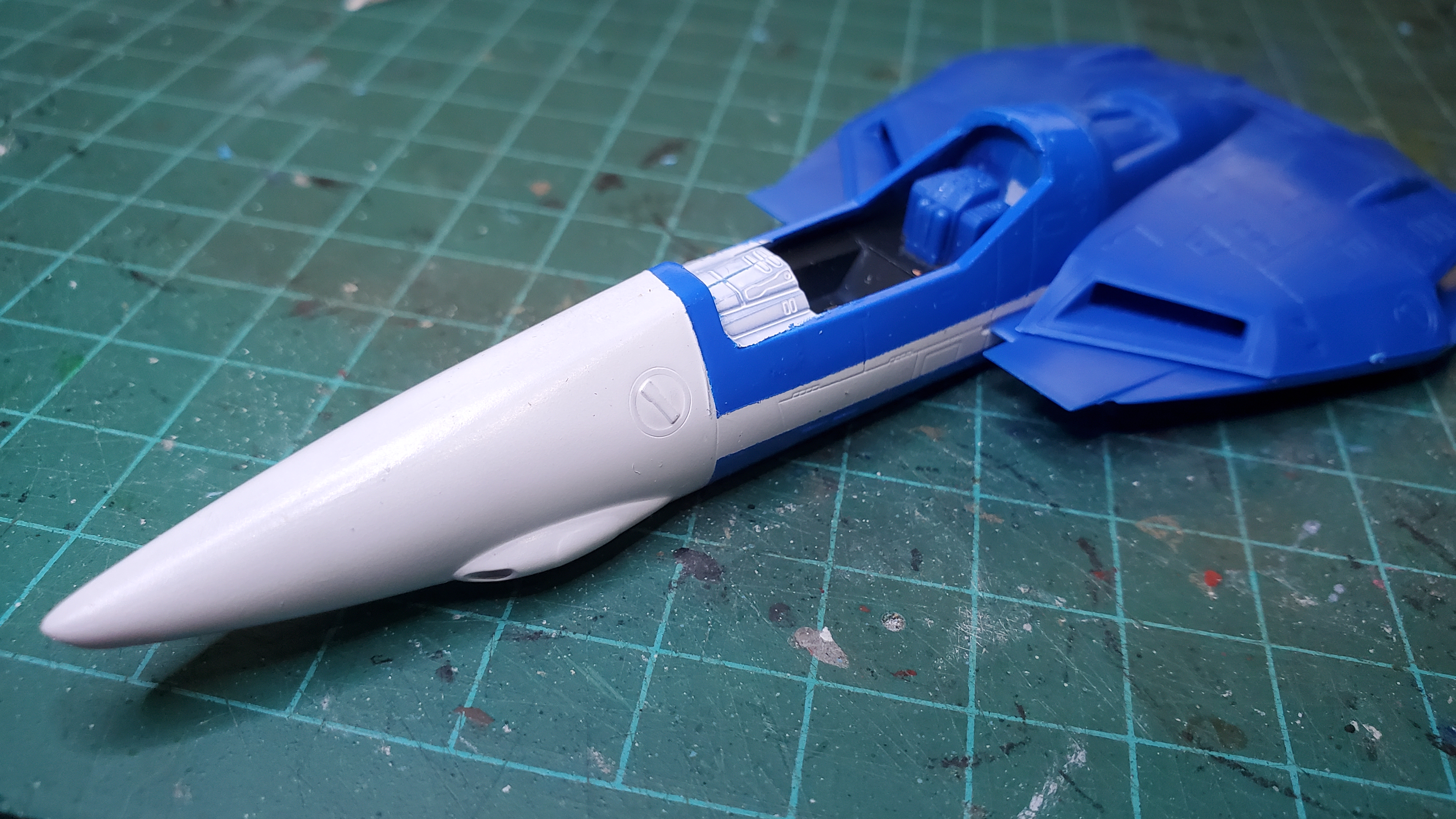

i tried the light coating of clear last night, and let the decals soak in near boiling water for a while, but they still fell apart.
I tried again today but only just dipped them in for a minute, and got this result.
the UN. Spacy decals were OK, but the warning decals were still a bit iffy.
but they went on.
There is a balance i have to find. if you look at the decal sheet in the right light, its not an even level of "damage" so some decls may be salvageable, and some not.
I'm already out 6 or 7 important decals on failed tries.
Also, the seller on ebay i bought the spare decl sheet from canceled my order because HongKOng post won't ship to Canada due to Covid.
FFFffffffffff.

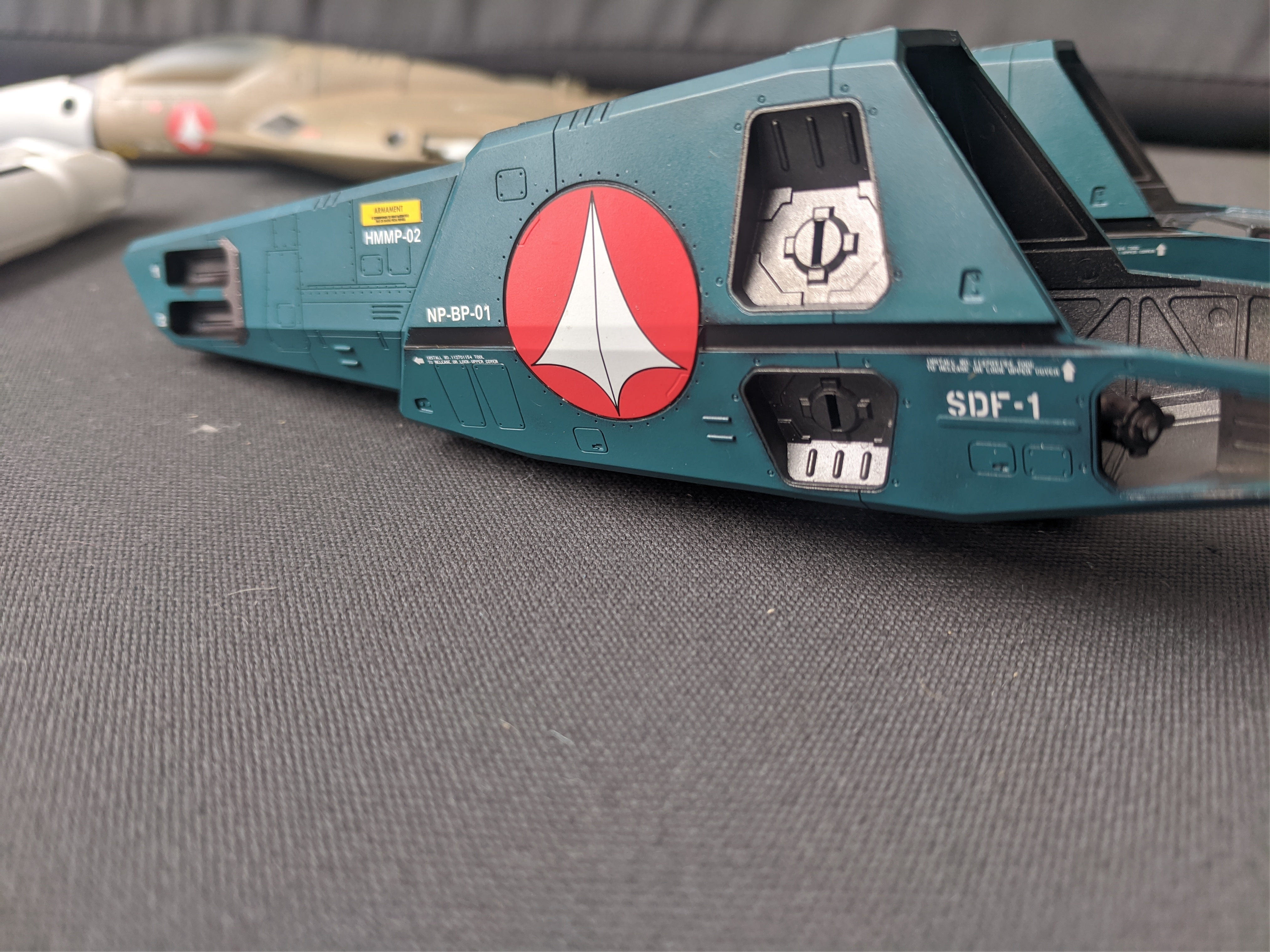

Since the Virgin Road kit was an afterthought, the kit was molded first as a VF-1A/J/S. The special D parts were on an added sprue, so, had they included two canopy glass and head options, this could have been made as any model, so there was a nose cone, and main fuselage spare.
Thats what i built up here as practice, to see how white would go over the blue, and if i could mask off to make the white stripes since the decals were toast.
I am happy with results, and will now get on to the kit proper.

Ya, but i decided that since later in the episode, max is in his flight suit, and Milia is in hers, with a yellow helmet, that i can just recast the pilot that came with the Gerwalk kit, and just have the plane from after the wedding, LOL.
I;ve decide to modify the kit with gear up, so that its in flight mode, and that takes some careful alignment and sanding.

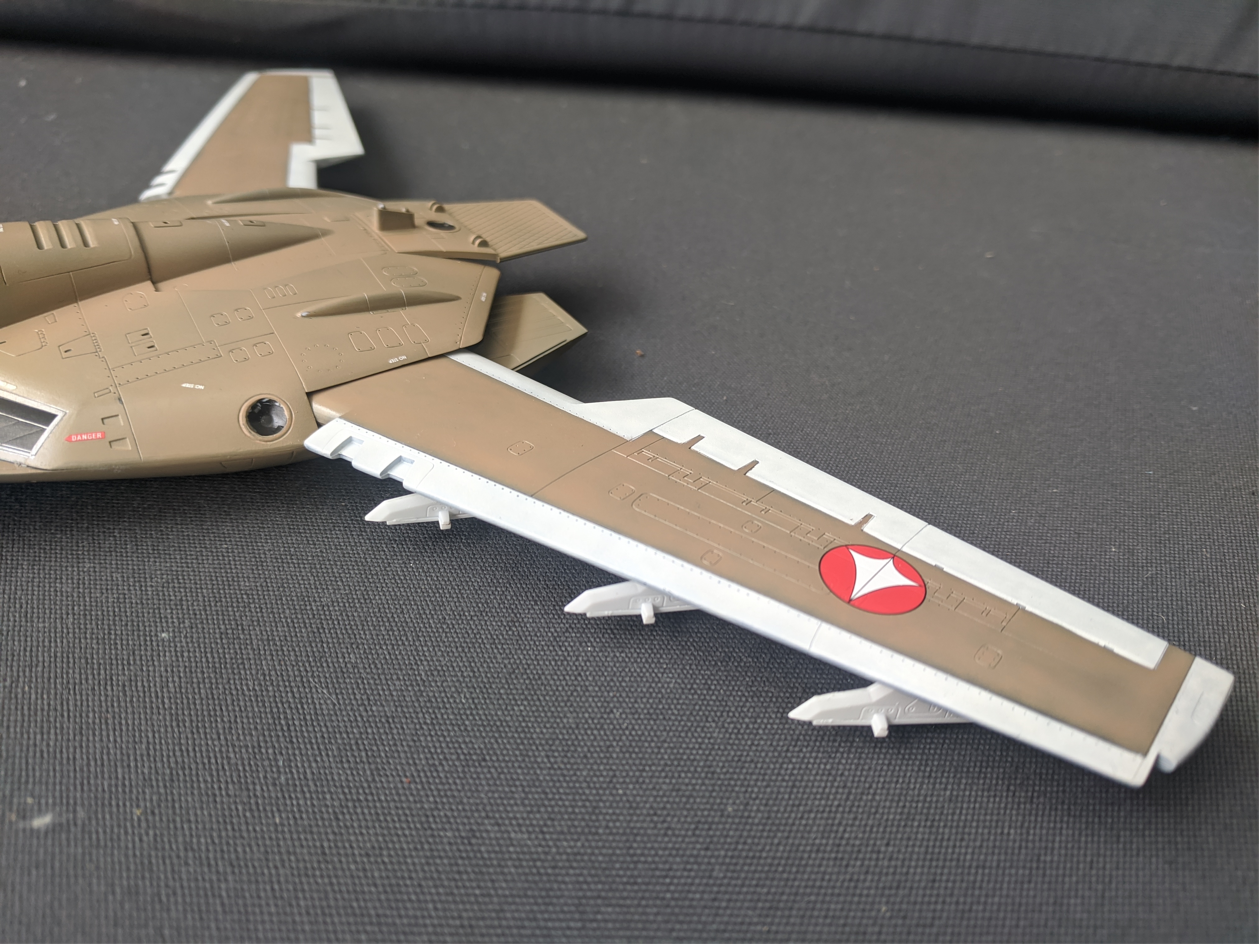

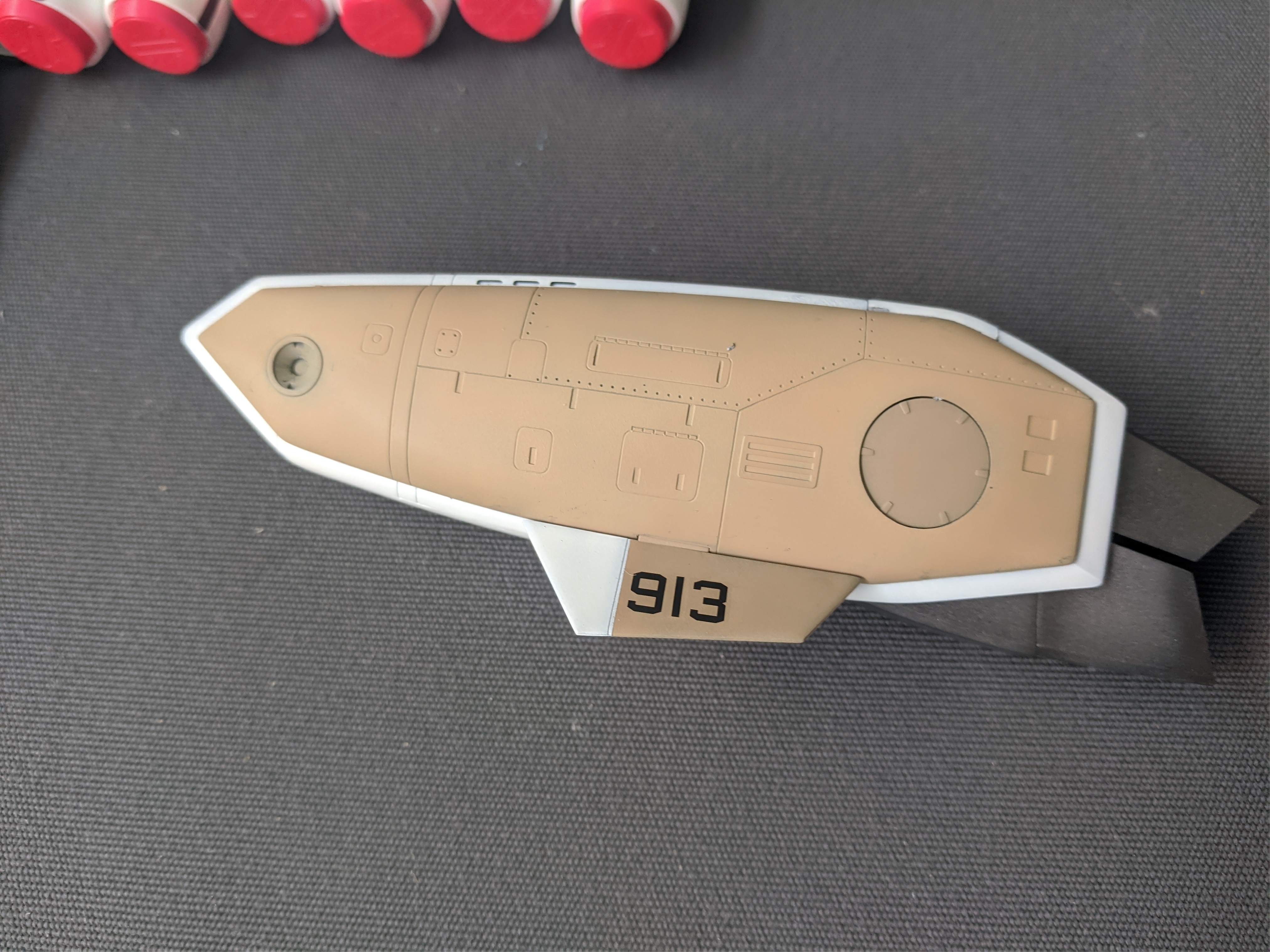

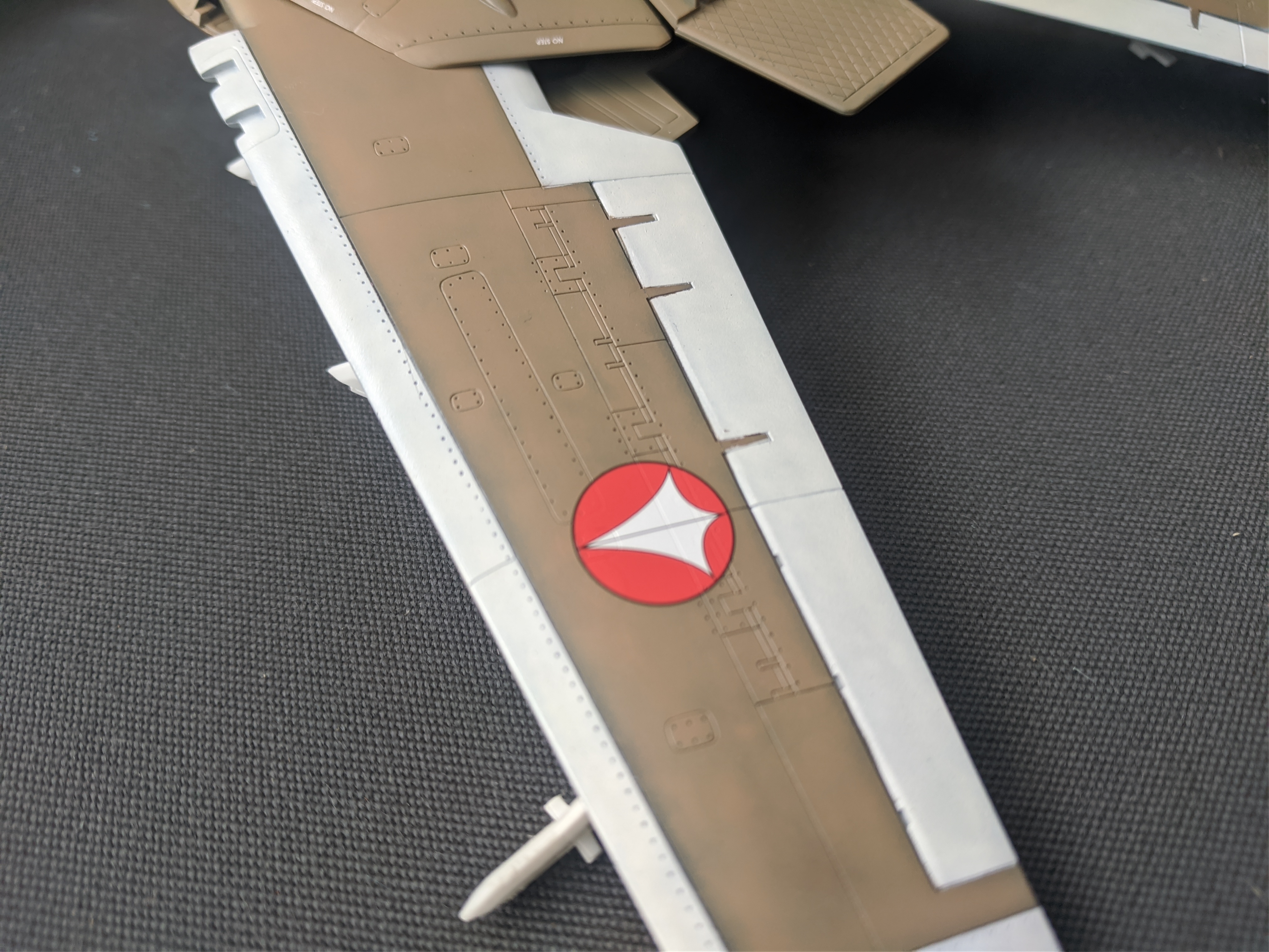

VF-1A SUPER MASS PRODUCTION CONTINUES

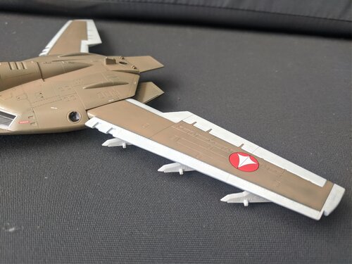

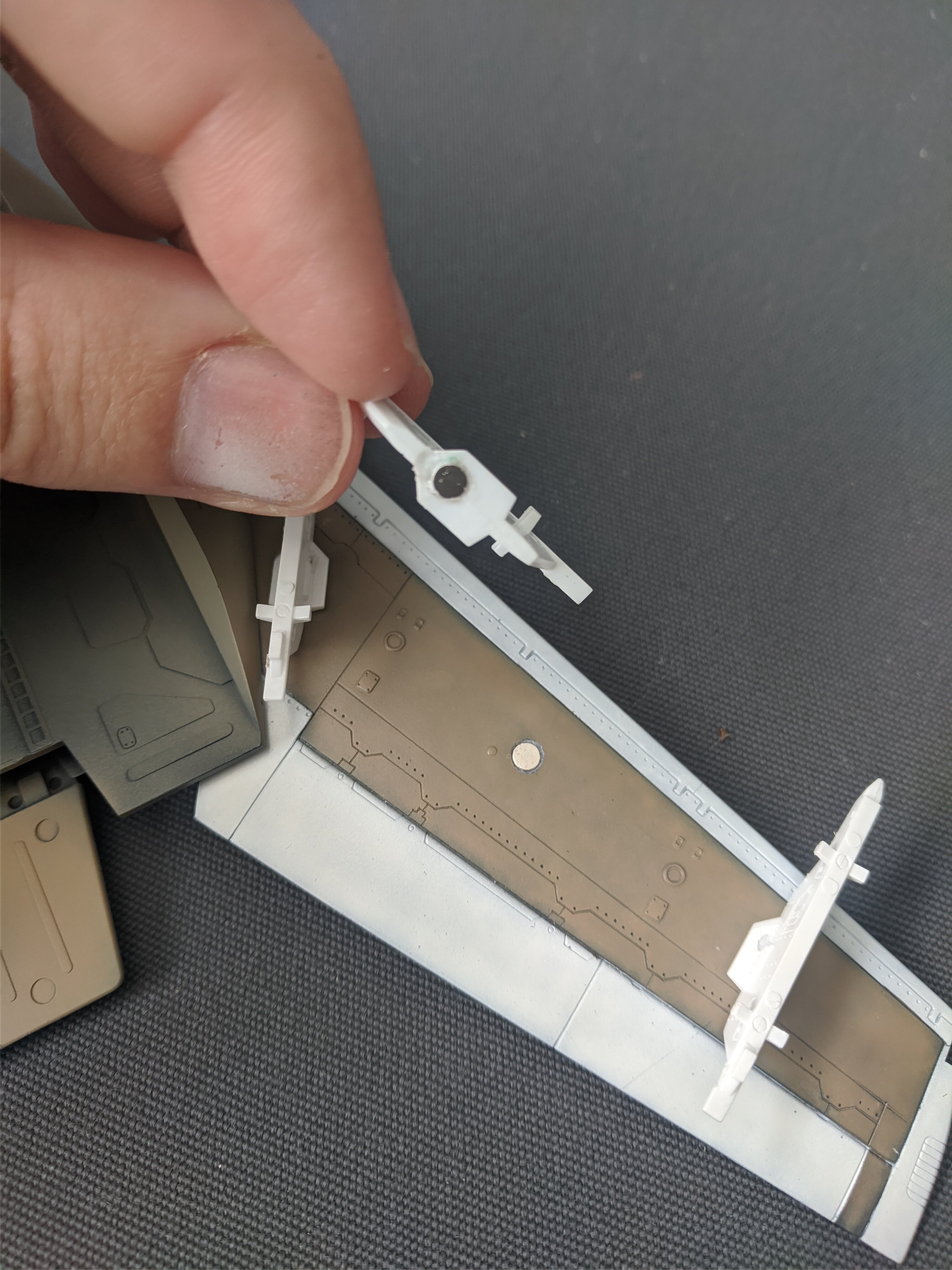

Started to apply some decals, use magnets for the weapon pilons, bad idea to do that after you glue the wing pieces, but works
Use a random number for the Valk.

Looks great so far, love the use of magnets! B))
I'm also working on a VF-1A CF with Fast Packs. Just curious, what shade of paint did you use for the light brown?
Expand
Hi!  aflter a lot of tests, I use for main colo Tamiya LP-76, with a marble coat of varios shades os light brown, LP-77, Gaianote 201,204, deck brown and sandy yellow. The top coat was LP-76.

Just a quick shot of what I have going on, this is my first 1/48 VF-1 kit and so far I am very happy with how it assembles. I'm sure when I eventually get a Weapons Set kit I'll change my tune, for now this thing is pretty awesome. B))

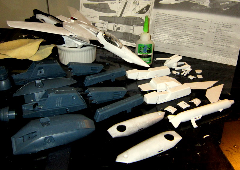

Yeah, not much hope, eh? lol Anyways, progress pics on some of the VF-1J parts:
The major pain was that the VF-1J was molded in red, and I redid it as Hikaru's in white. So now, I have to re-prime it and ensure that I can successfully recapture the "magic" I got when I first repainted it. I have to make sure I get every crevice on it, or it's going to look like crap.
I left one arm red for the shot so folks can see what color it was before the repaint.
The fighter nose is going to be "fun", since I don't want to repaint the cockpit tub or pilot! Sigh...
Edited by pengbuzz

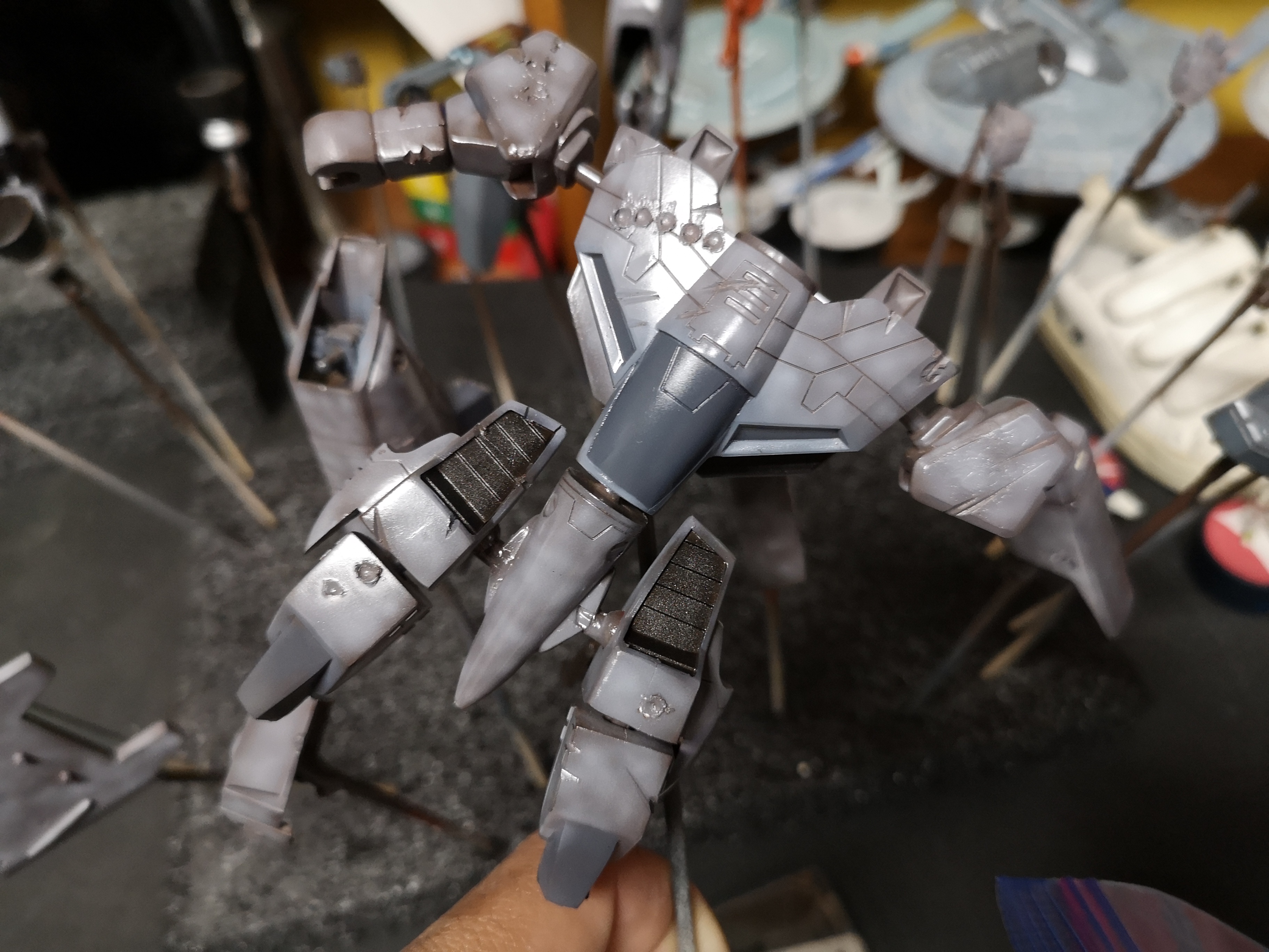

I'm still stuck in prep hell with the V-Siren. Checked the pose for the 100th time and adjusted the shoulder armor layers.
One more go at the angle of the feet...
I also want to add a piece of additional head armor that's in Nagano's illustration
Expand
Nice job!

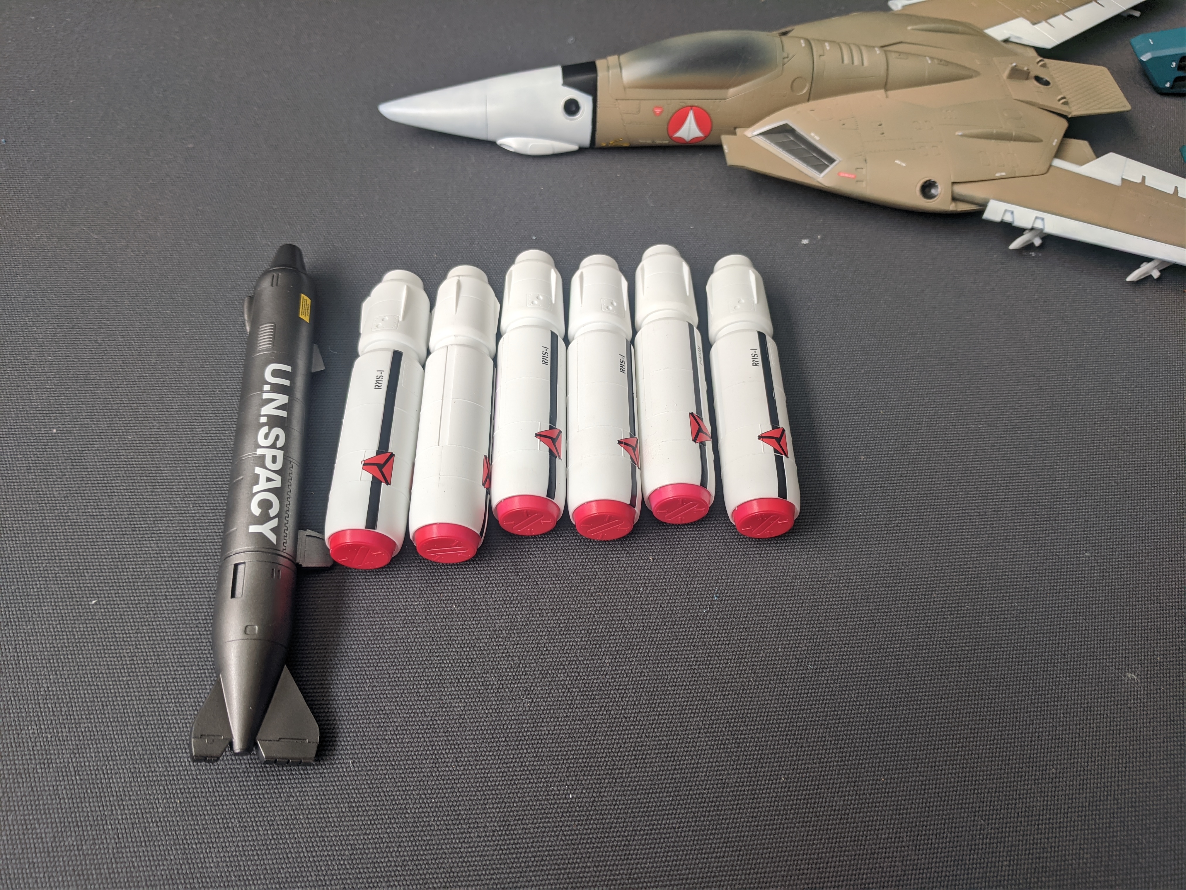

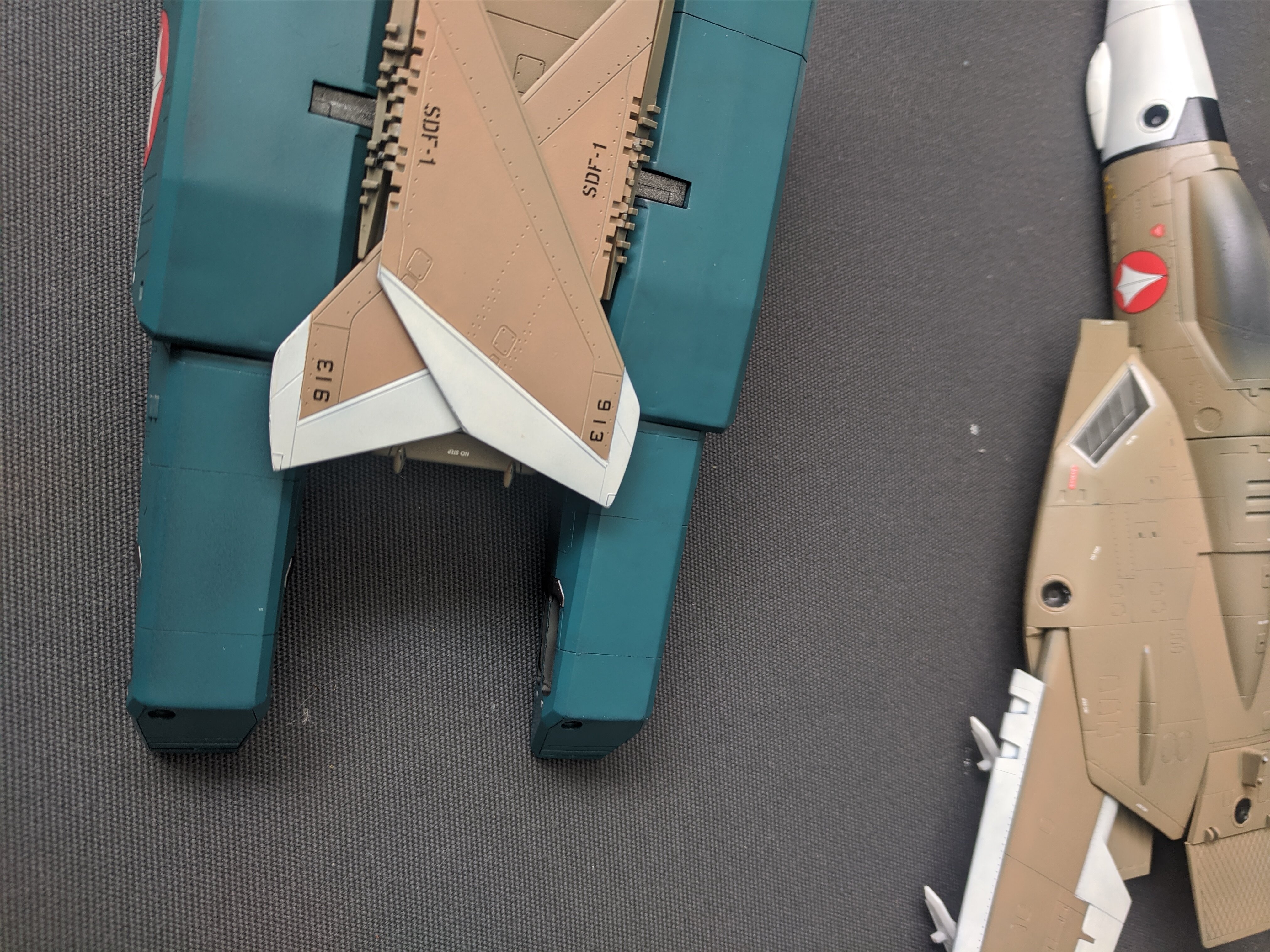

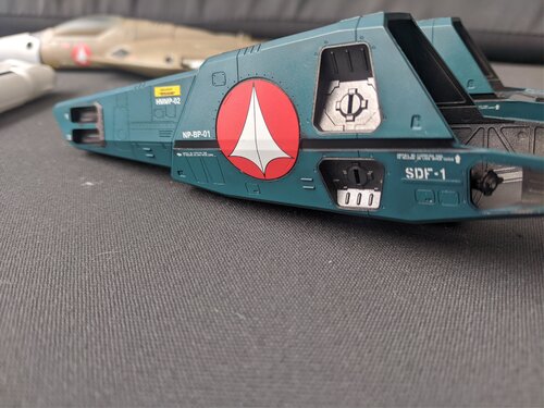

progress update.
some lines need to be cleaned up, but for the most part, its worked out.
Made some learning points for the next build.
managed to get 3 out of 4 pilot names on the canopy. 4th one disintegrated, so i'll pretend thats battle scuffing.
going to go for it tomorrow with the rest of the decals, and see what i can get on from the damaged sheet.
the UN.Spacy you see on the gun is from a Battloid kit sheet.
worst case scenario i need to wait a few weeks for a 3rd party detail sheet to arrive in the mail.
I can't wait to woooooosh it around the apartment with the soundtrack playing.
Other people do that right....??
