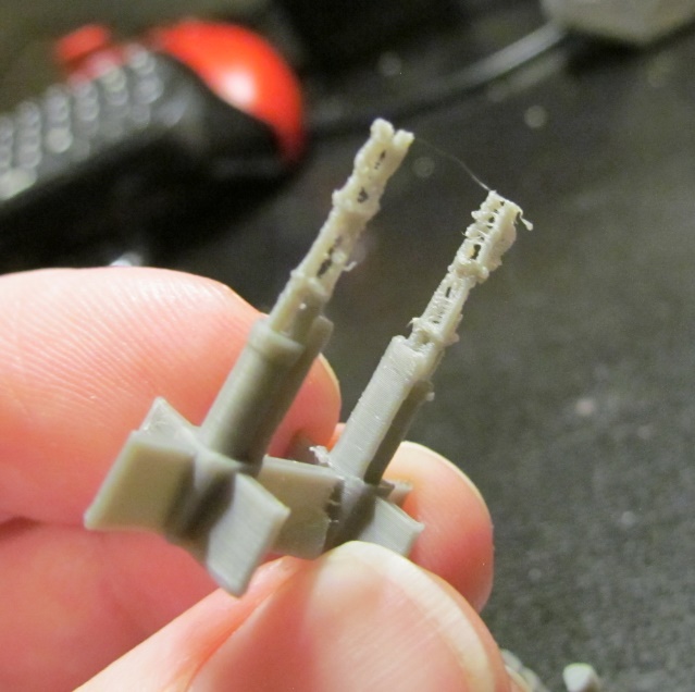

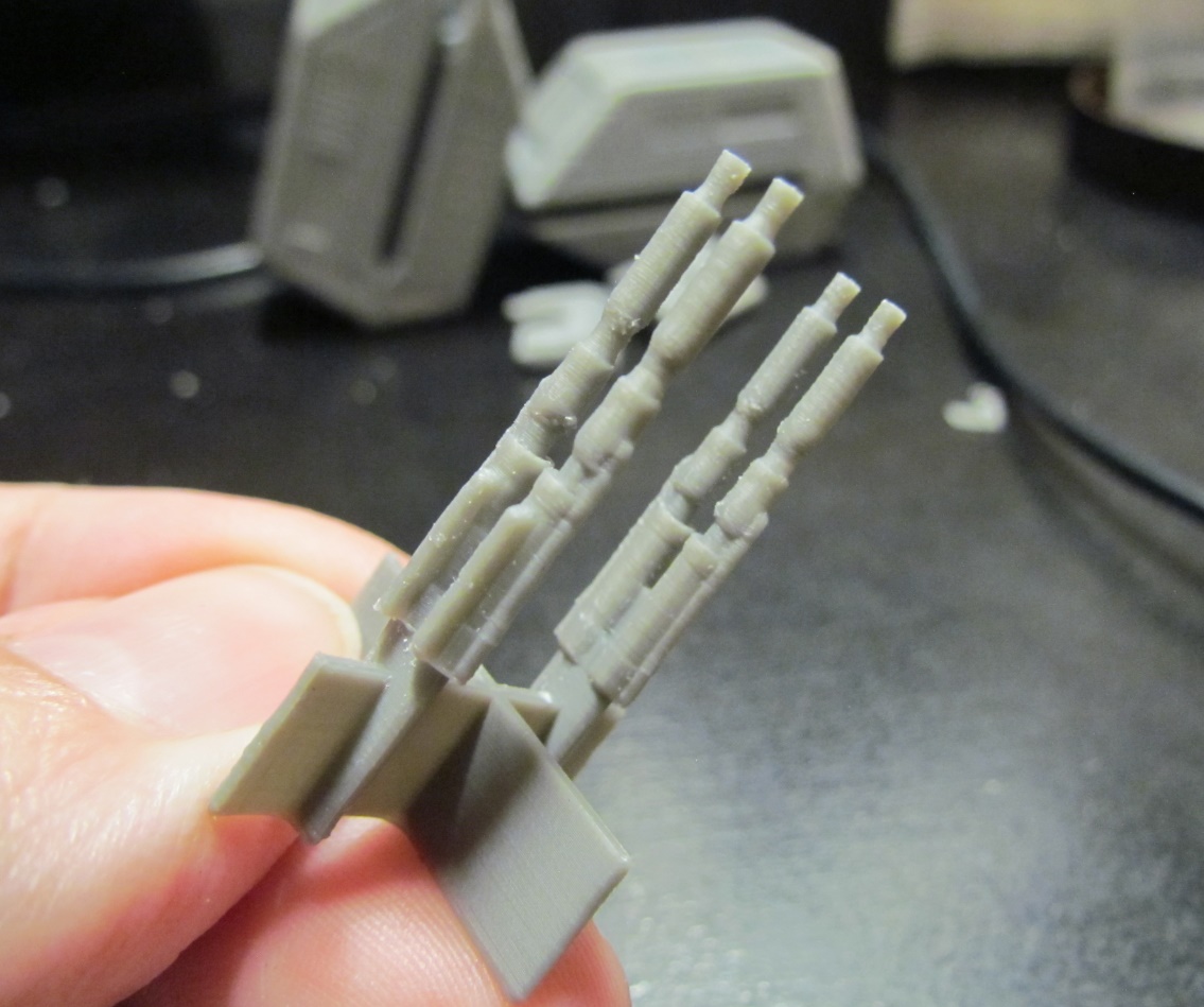

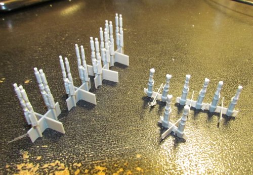

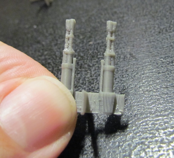

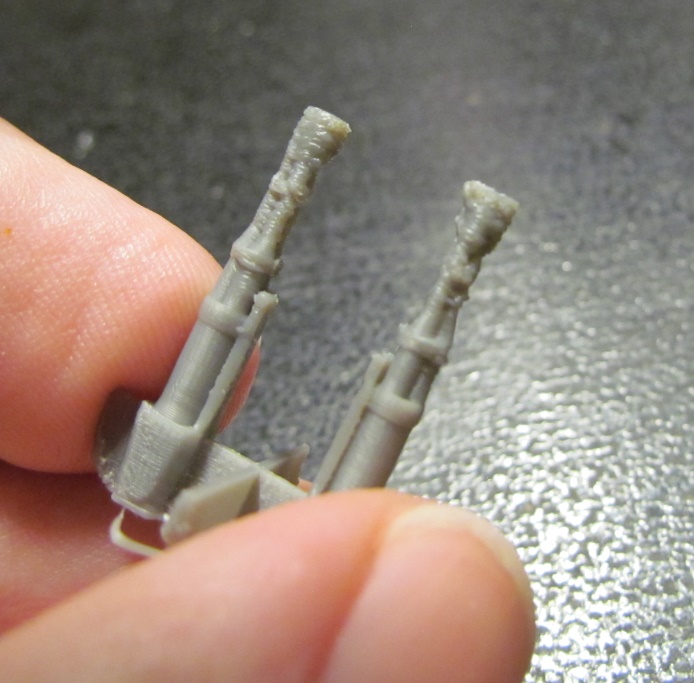

The big challenge was printing some of the tiny weapons mounts that this ship has.  I debated whether it would make sense to just make them out of small metal rods, or even out of toothpicks, but I'd need some kind of microscopic lathe to get the shapes right. :lol:
The biggest issue with parts this small is getting the ABS to cool enough between layers so that each new pass from the print head doesn't deform what's below it.  Took me a few attempts, but the best success was when I printed a whole batch of them at once so the print head had more to do.  They're all mounted on small mouting blocks with a flat support structure to give them more stability.
I went through a few iterations of diameters on these to get something stable.  The smaller guns on the right are actually a tri-barreled design, and that got insanely fragile before I just let the barrels grow and merge into a sort of triangular shape.
A lot of them came out rather blobby from the print head just re-heating lower layers and messing with the shape.
Finally had some good success with both sets when I batch printed a few.

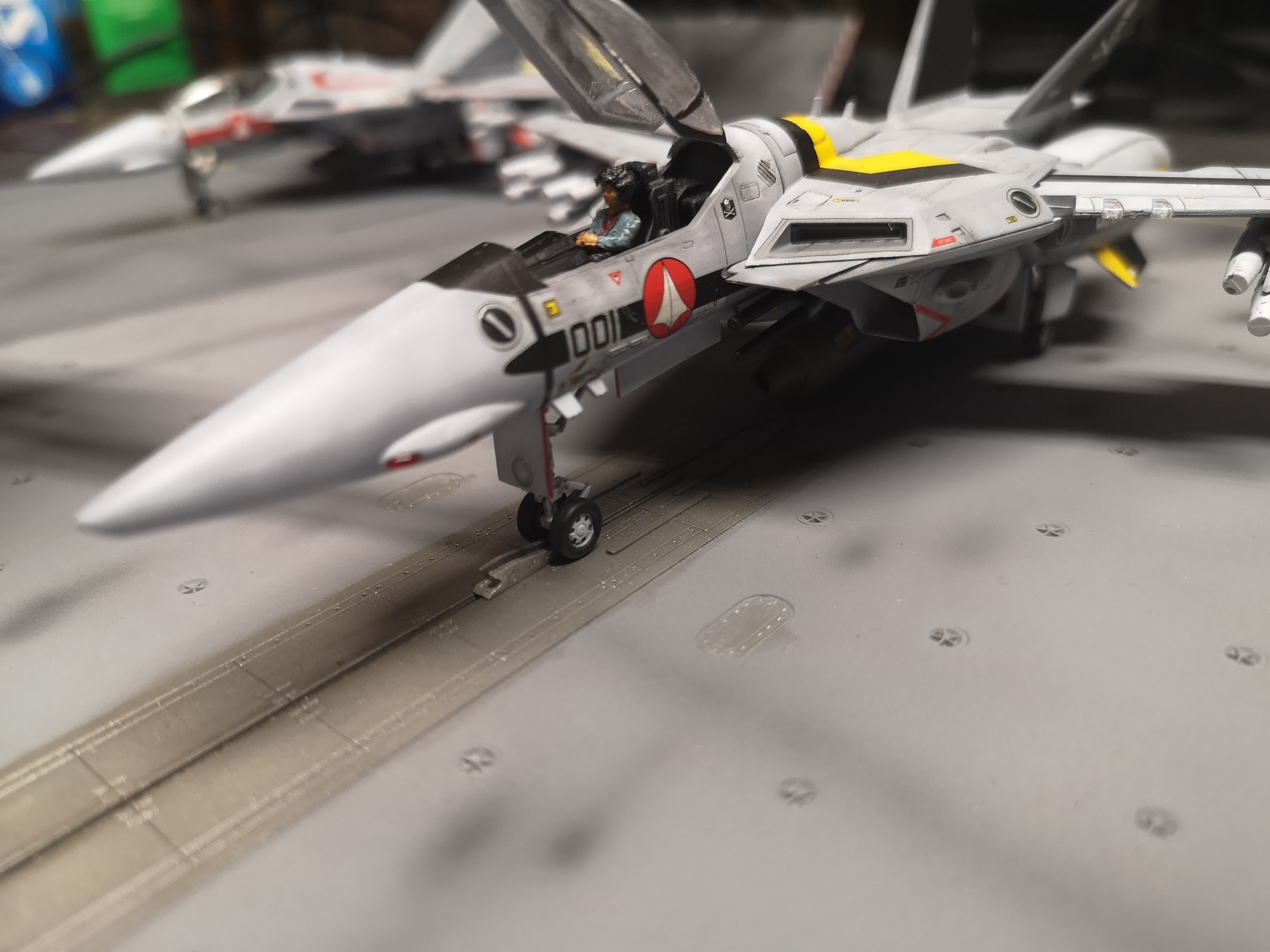

@derex3592 I love the lighting color. It looks warm and realistic. Looking good!

@peter Looking good on the assembly line! That Tamiya weathering stuff looks so much like makeup:ph34r::lol: I'm actually going to get some when it's back in stock at the local Hobby Lobby. REAL dust has made some of my mecha look more realistic:D - MT

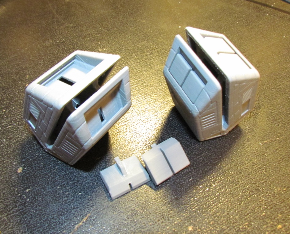

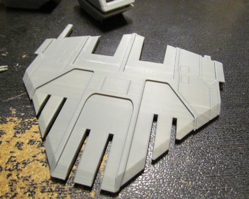

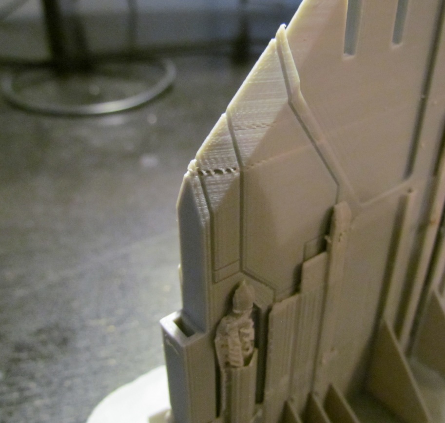

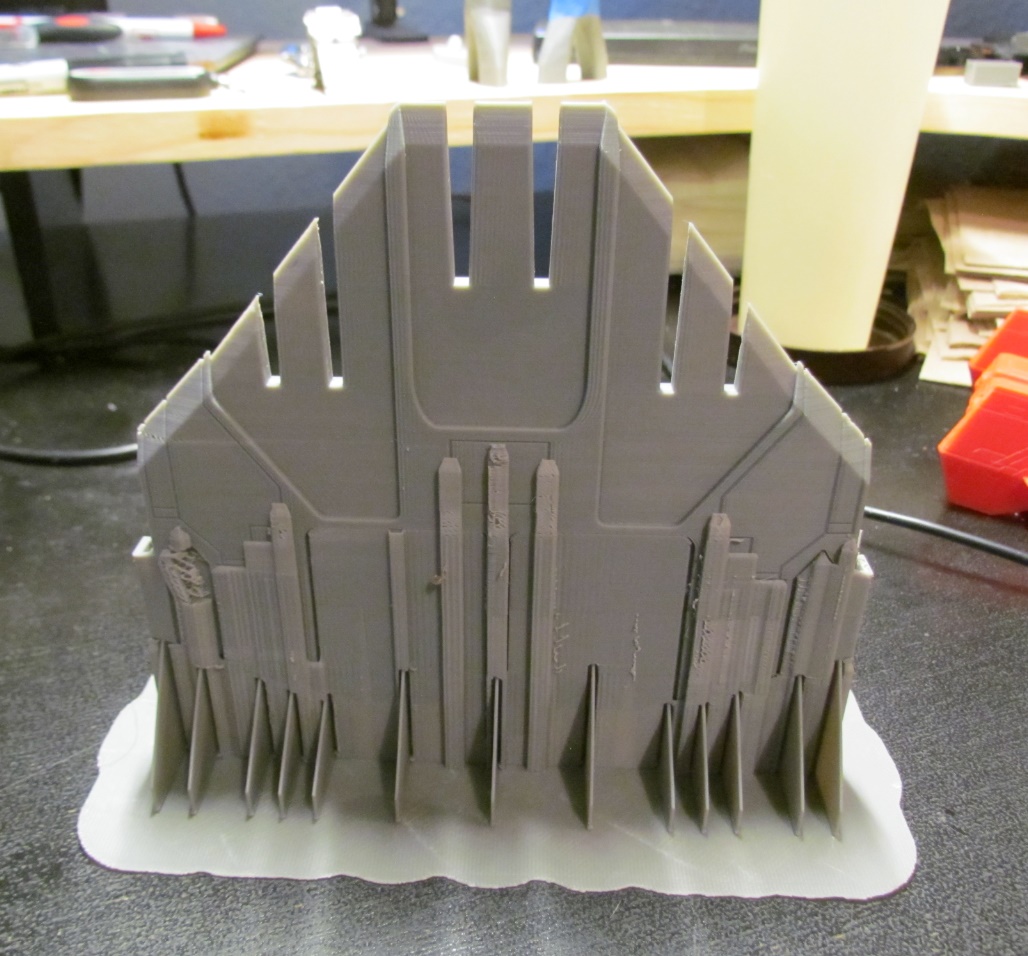

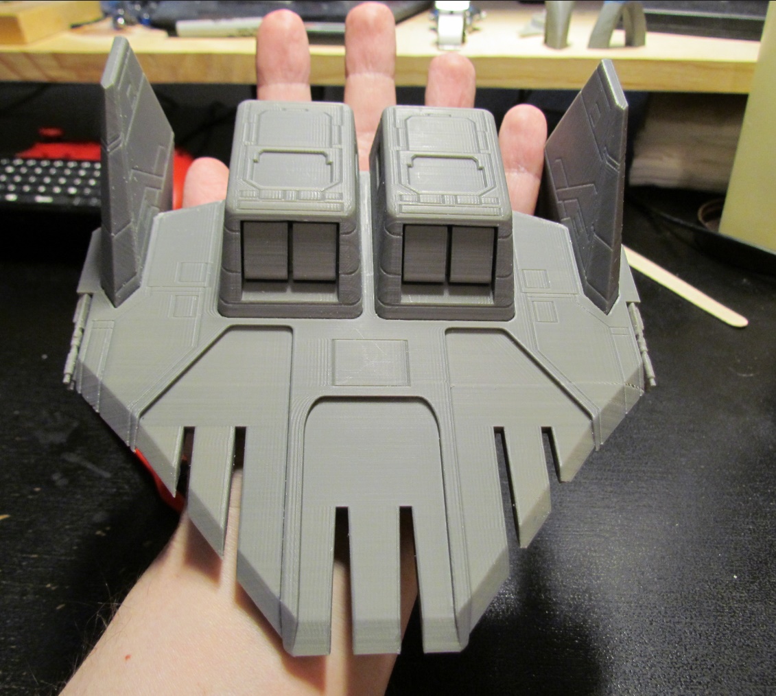

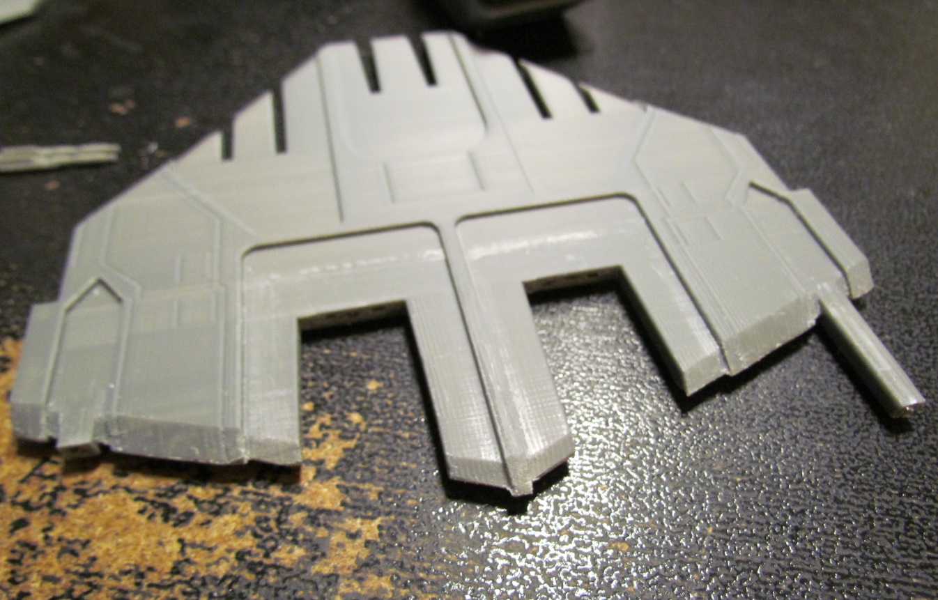

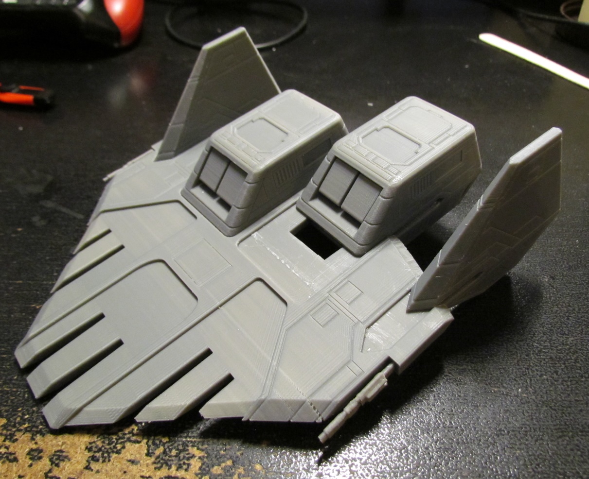

Progress continues, and after two false starts and about 22 hours..
The first two prints failed within about an hour of starting, so no massive losses on that end, thankfully.  It took me a couple of revisions to get the support structure laid out in a way that would stay solid.
Only major flaw I see is where there's a random band of what I can only assume was a bad segment of plastic in the spool, where it just left a few bubbles on one surface, and a lighter strip across the wing.  Will be easy to fill in and sand smooth.
I wound up making a couple of little mistakes in the cleanup, but as it turns out, they were things I didn't need anyway.  I over-built the model significantly, and some of the interlocking tabs I built in were not necessary.  The one long tube on the back of the wing was meant to support the tail, but the other side doesn't need it at all.
Back edge is naturally a bit rough from printing downward, but I intended that.  I learned a while back to add a thin tab of plastic to support any sharp edge I wanted to preserve, and I just clipped them off, and sanded the edge smooth.  Still will need a little filler and finer sanding in some spots where the layers flaked away, but nothing bad at all.
1467745188_ss(2021-04-12at05_23.18).thumb.jpg.06bf0884ba5c4cecfbcec8acb9907fef.jpg1709798741_ss(2021-04-12at05_23.28).thumb.jpg.c4bcfe2dca655a4740039919253bea01.jpg
Far as fit goes, I'm just grinning until my face hurts.  Everything just slots together like a finely cut jigsaw puzzle.  Was actually funny, the ruffled nature of the plastic print gave a slight "wheeee" sound as it slid together... and I almost couldn't pull it back apart.  I had to sand things down slightly just so I wouldn't break it from repeated test fittings.
1048318274_ss(2021-04-12at05_23.51).thumb.jpg.616290ff6a2804dcd98f73548dc8a8b1.jpg305902211_ss(2021-04-12at05_24.36).thumb.jpg.c88b596d7450c5eaaa0e6a8dd39b5ca2.jpg
I've got four main components left, and I'm expecting three to take between 10 and 15 hours each, with the final part being probably an hour or so for the canopy.  All told, the parts shown here have taken about 60 hours to print, not counting restarts and failures.
Next up is looking like the nose.  Keeping fingers crossed, but that's a more straight-forward blocky shape again, so hopefully less trouble staying stable on the print bed.

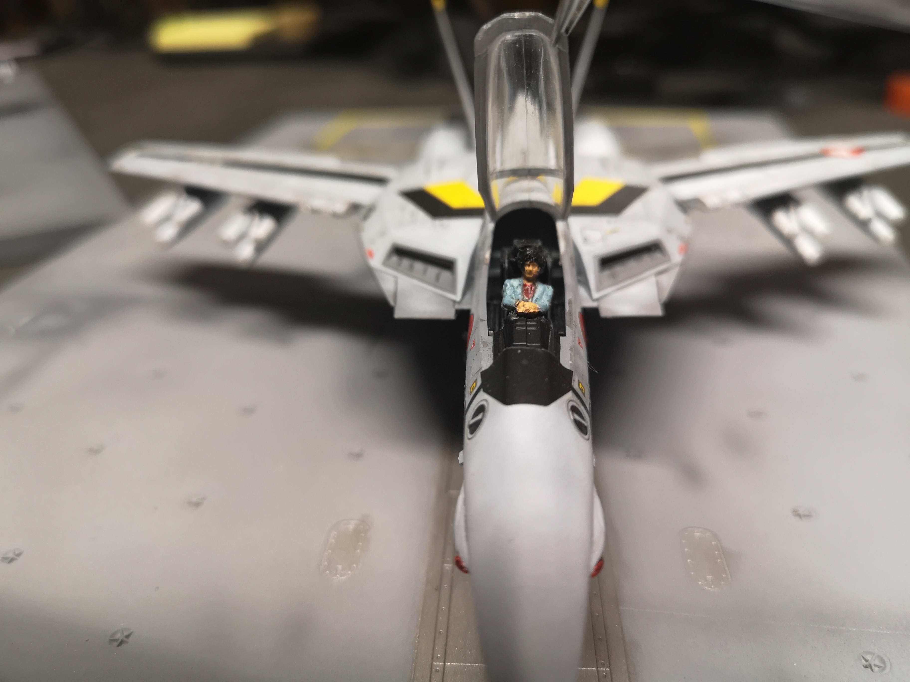

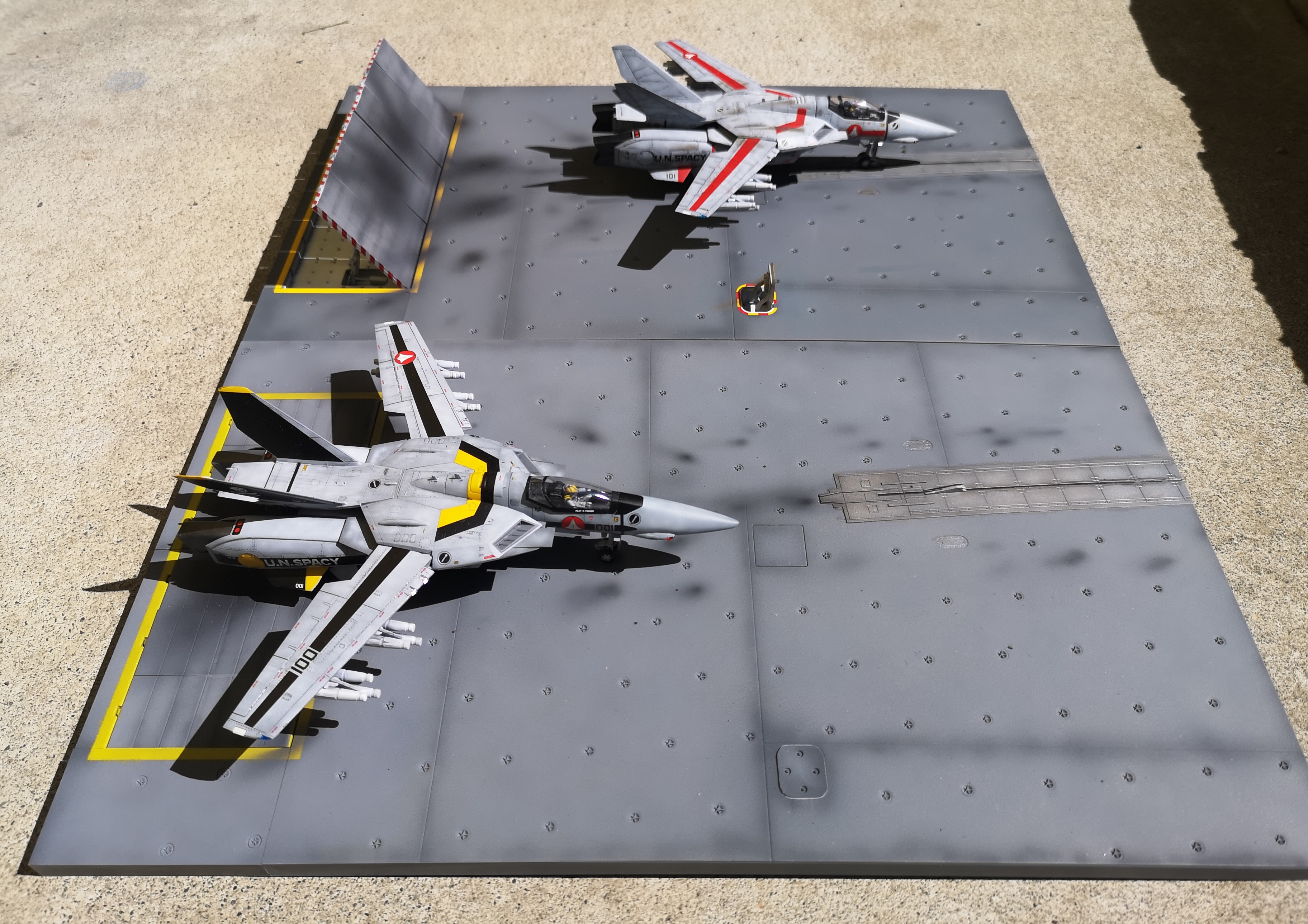

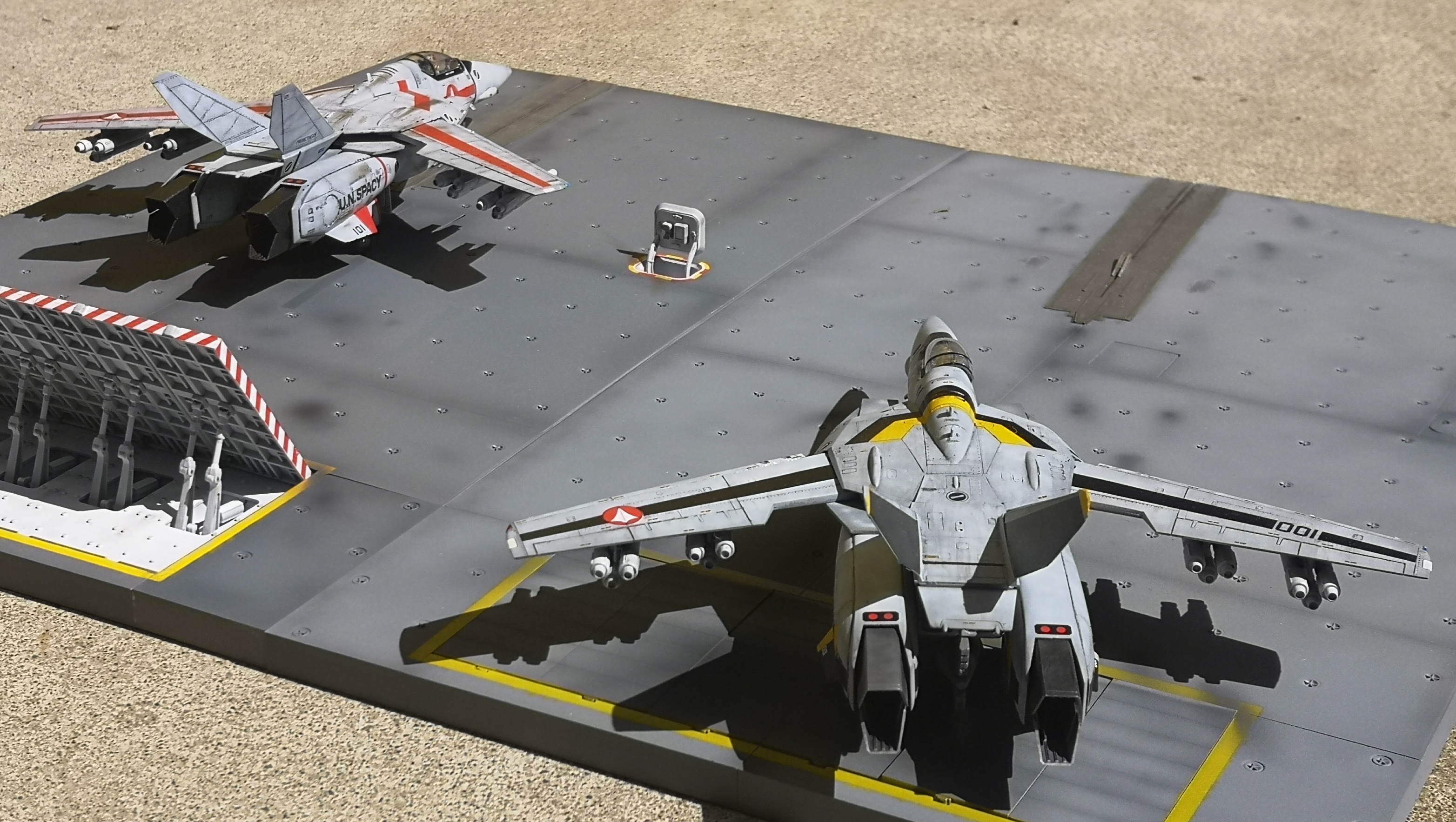

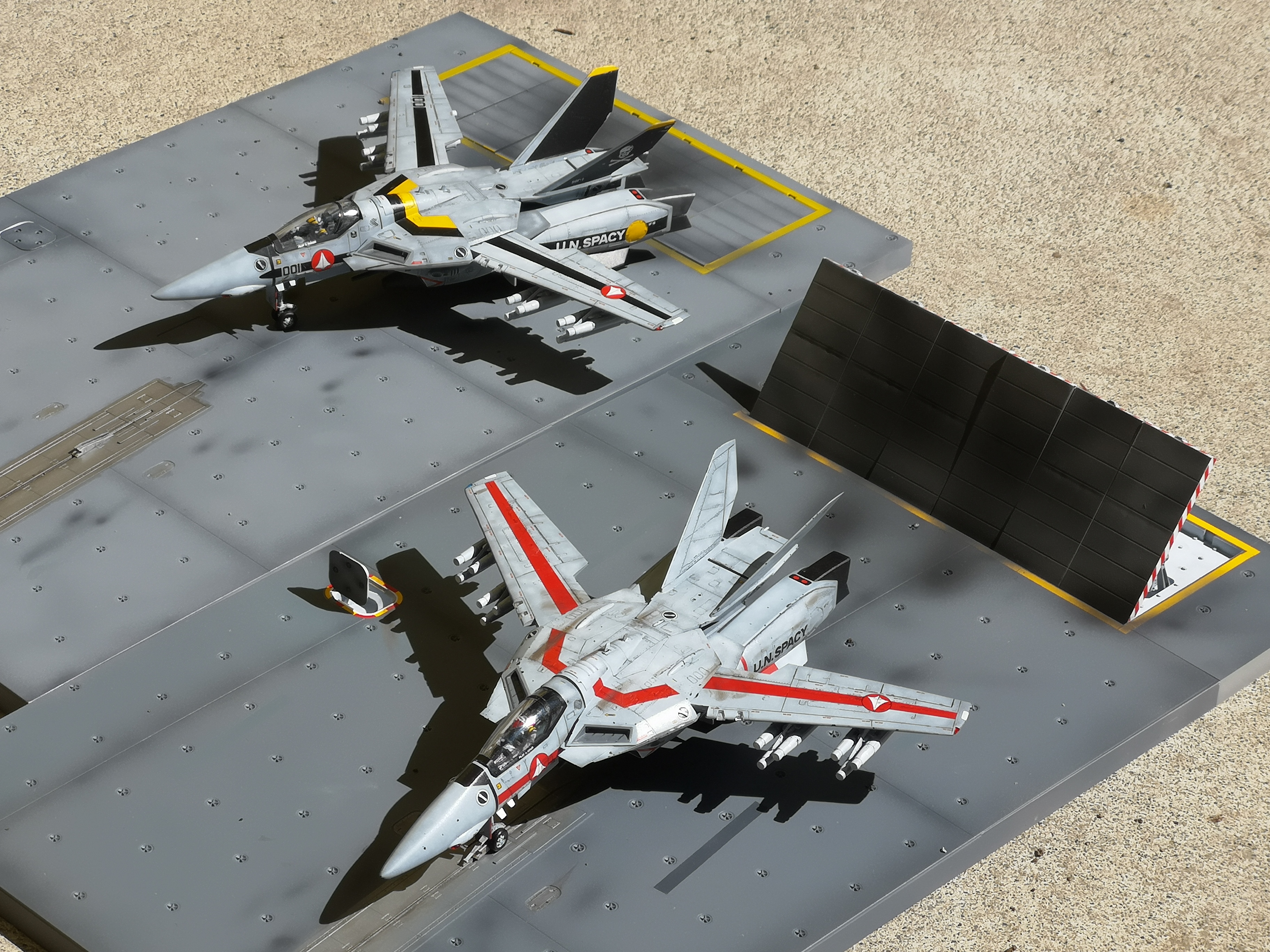

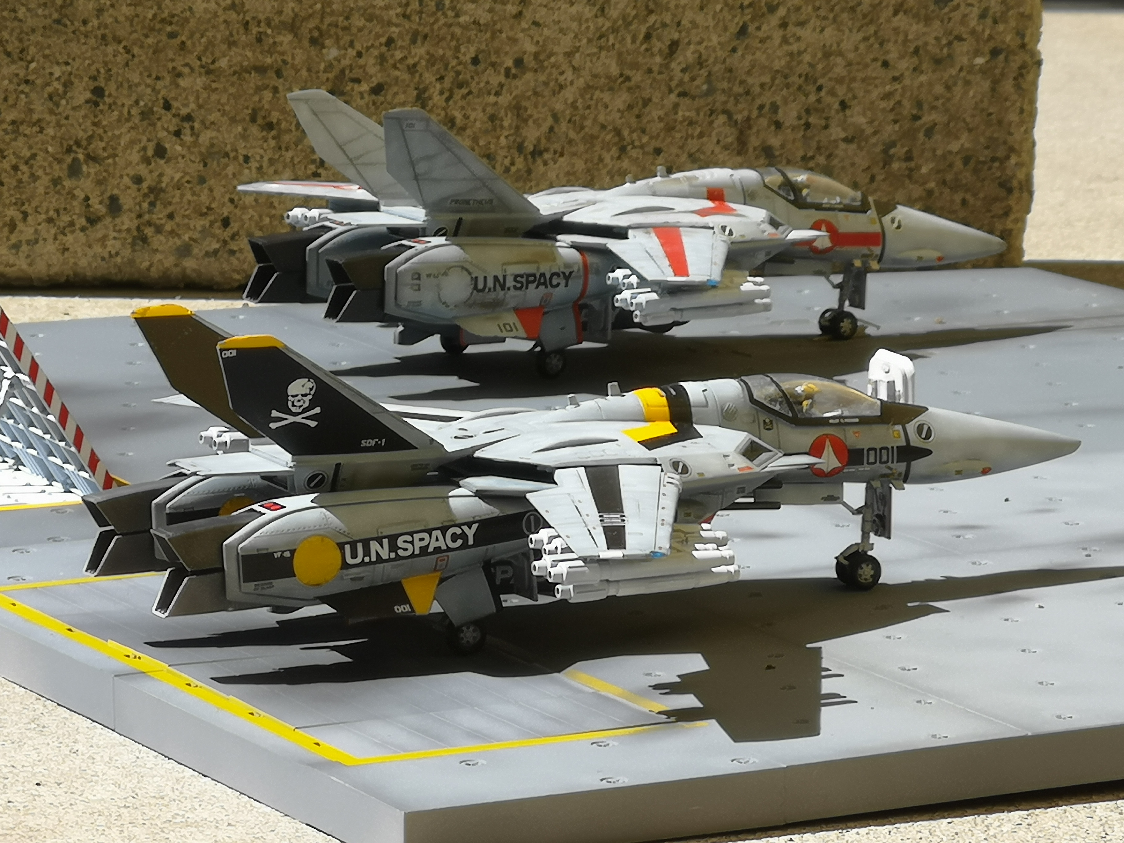

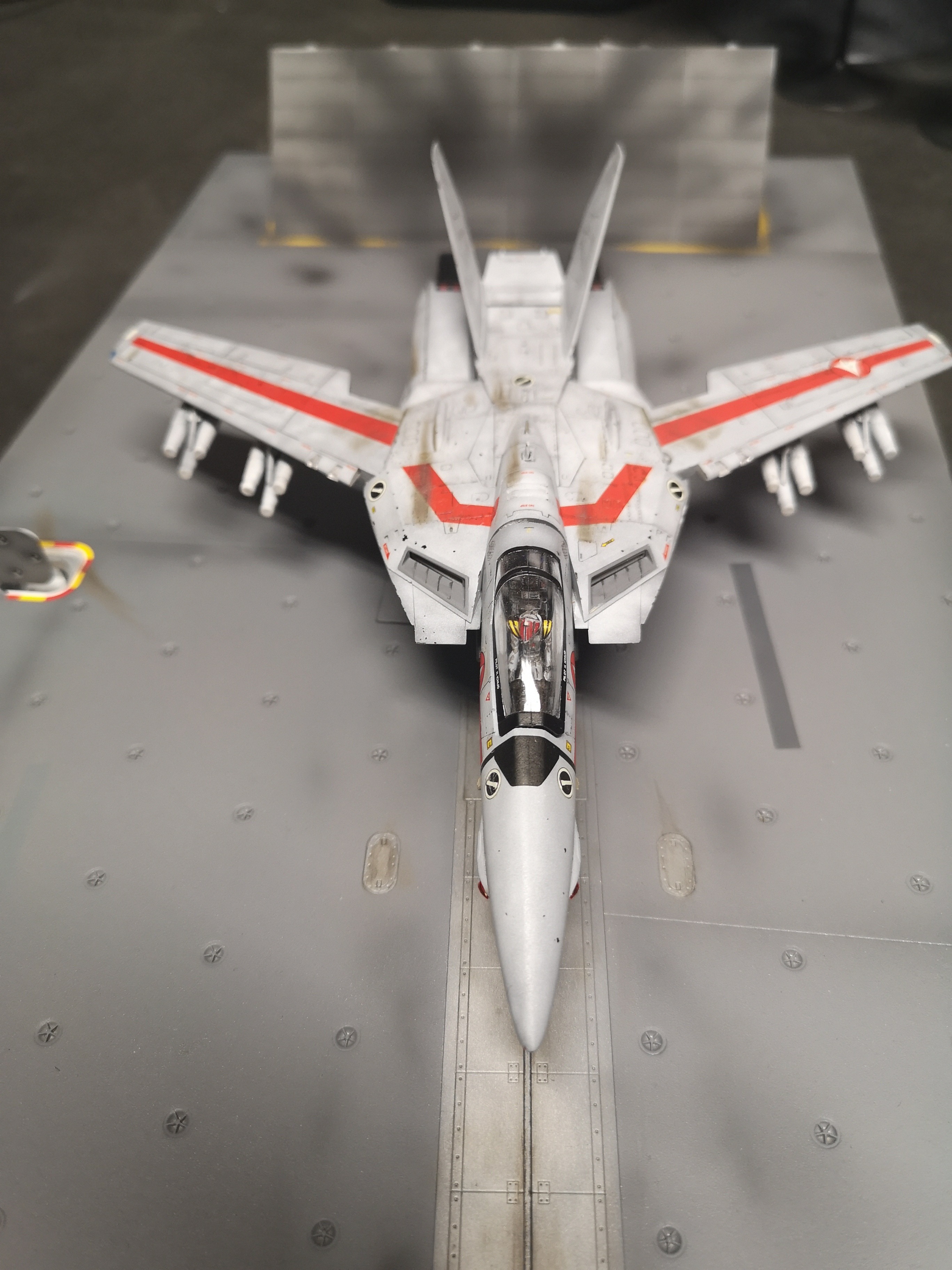

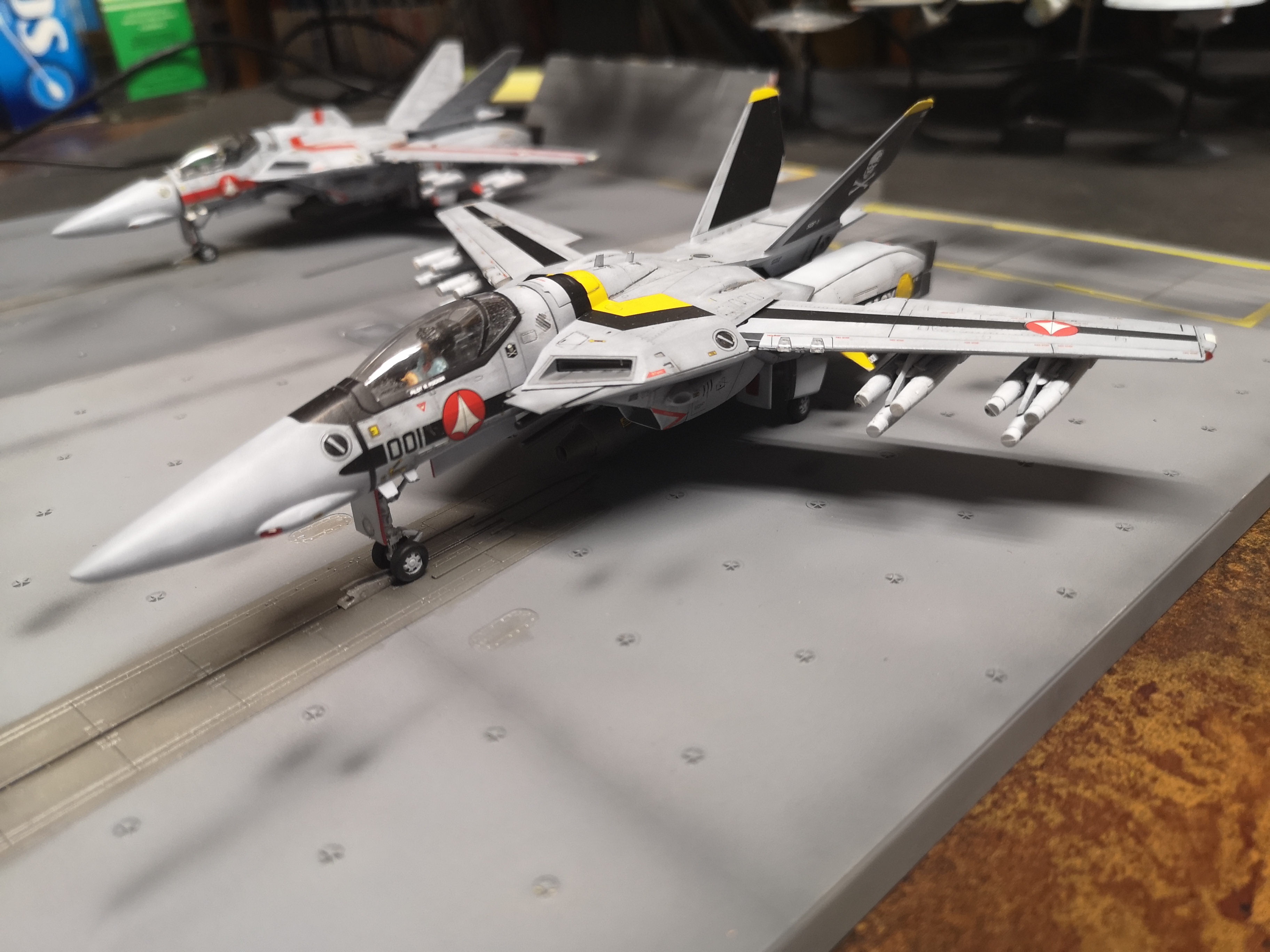

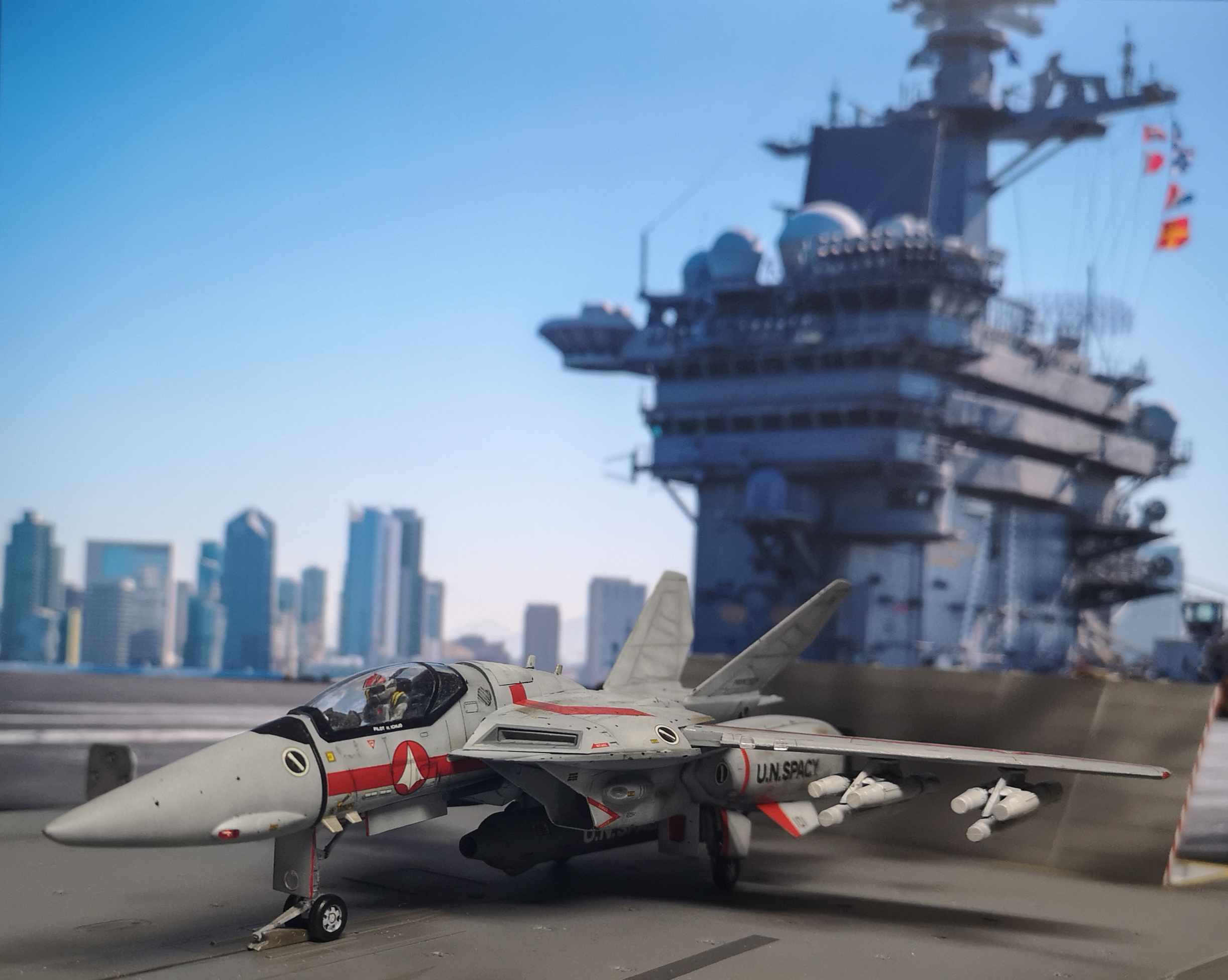

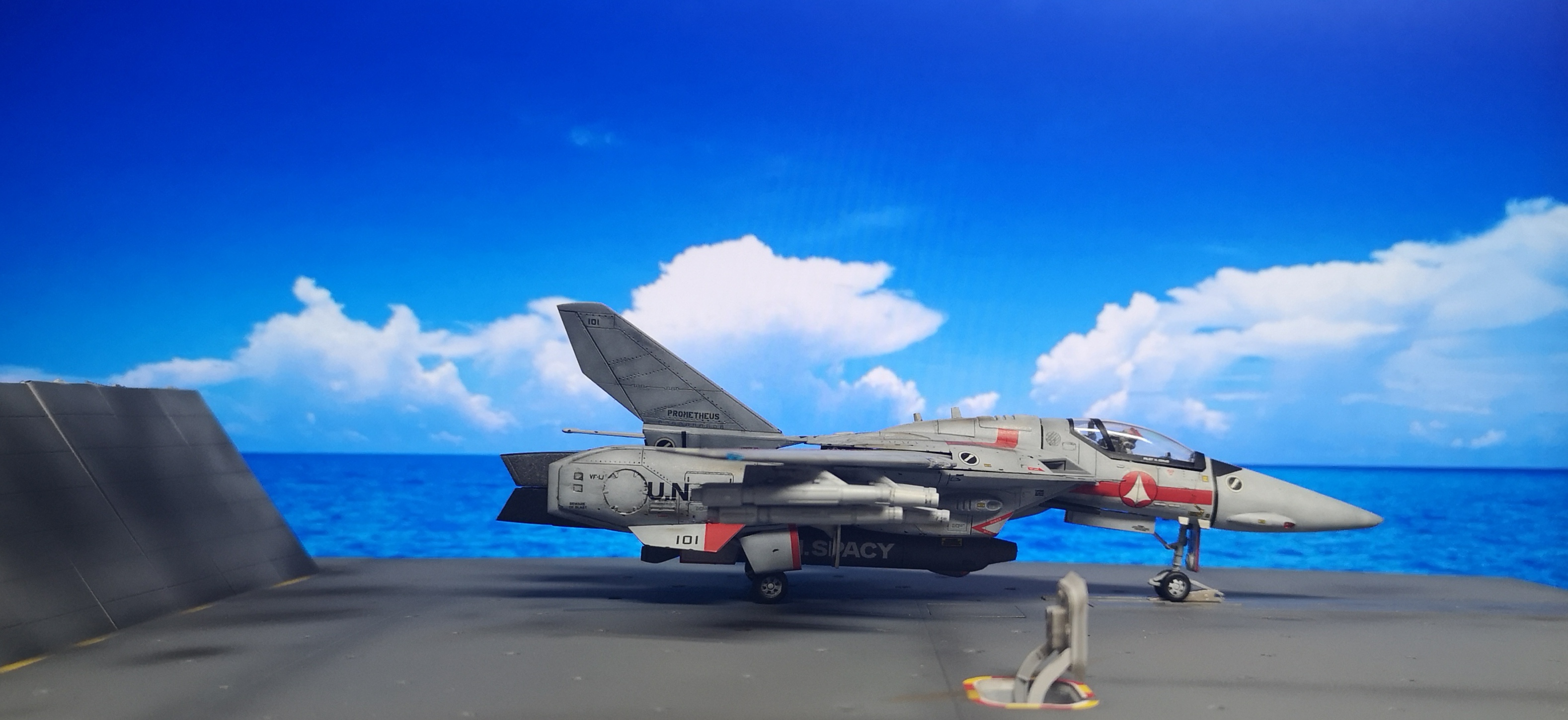

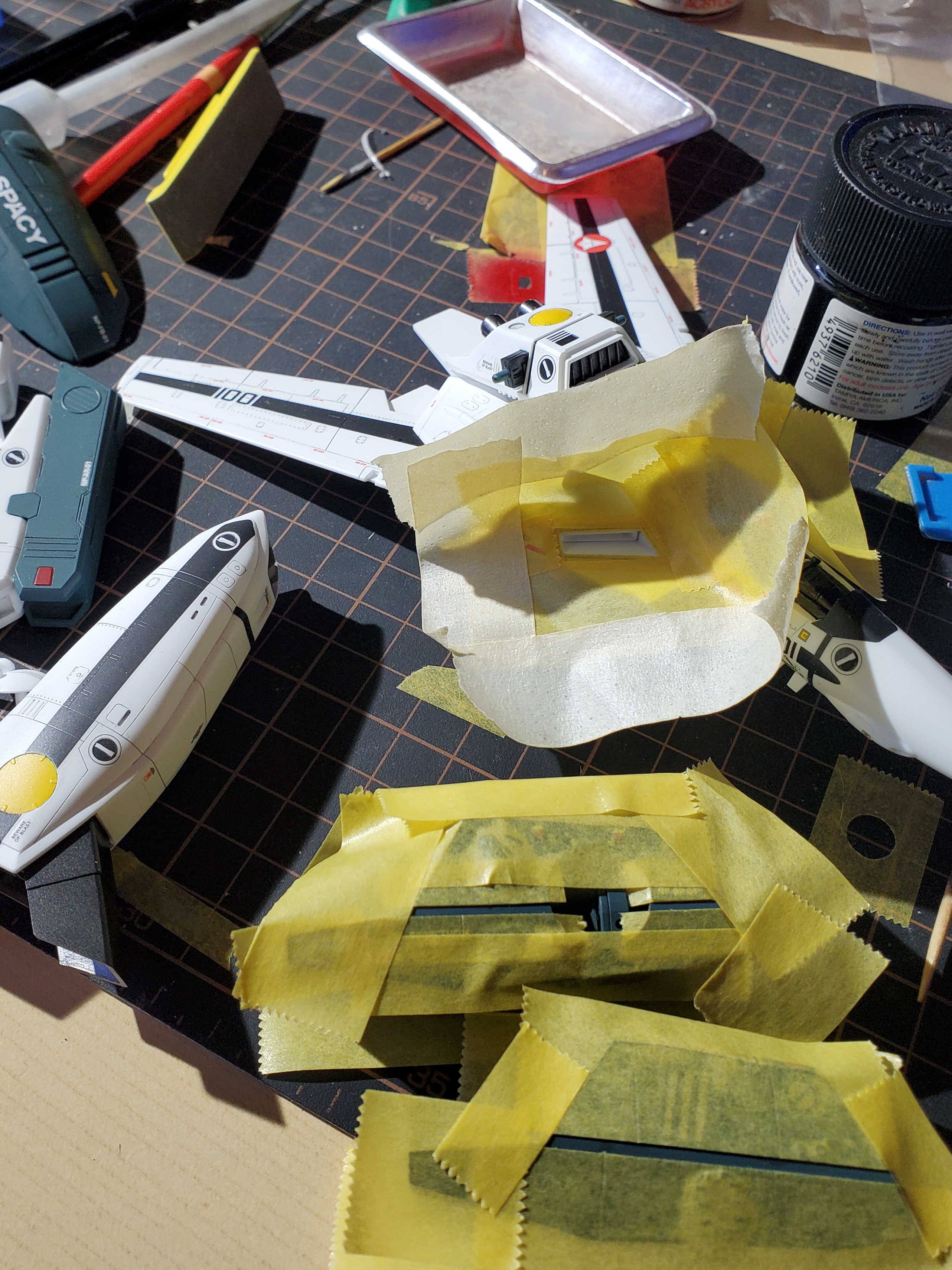

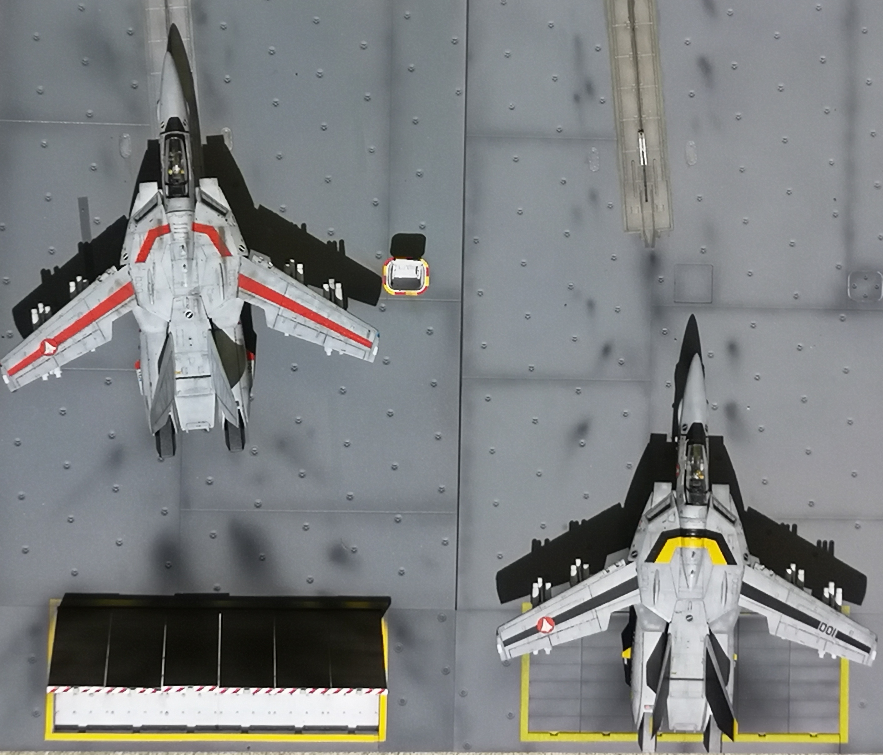

Basically done.  The two bases are slightly different colors because Hikaru's base has an extra coat of Pledge and Tamiya Flat Clear.  Might remedy that later.IMG_20210412_130827.thumb.jpg.18e469c7f9760149c4235d096af64669.jpg
Far from perfect, but was nice chance to practice different techniques.

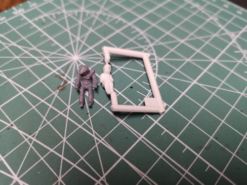

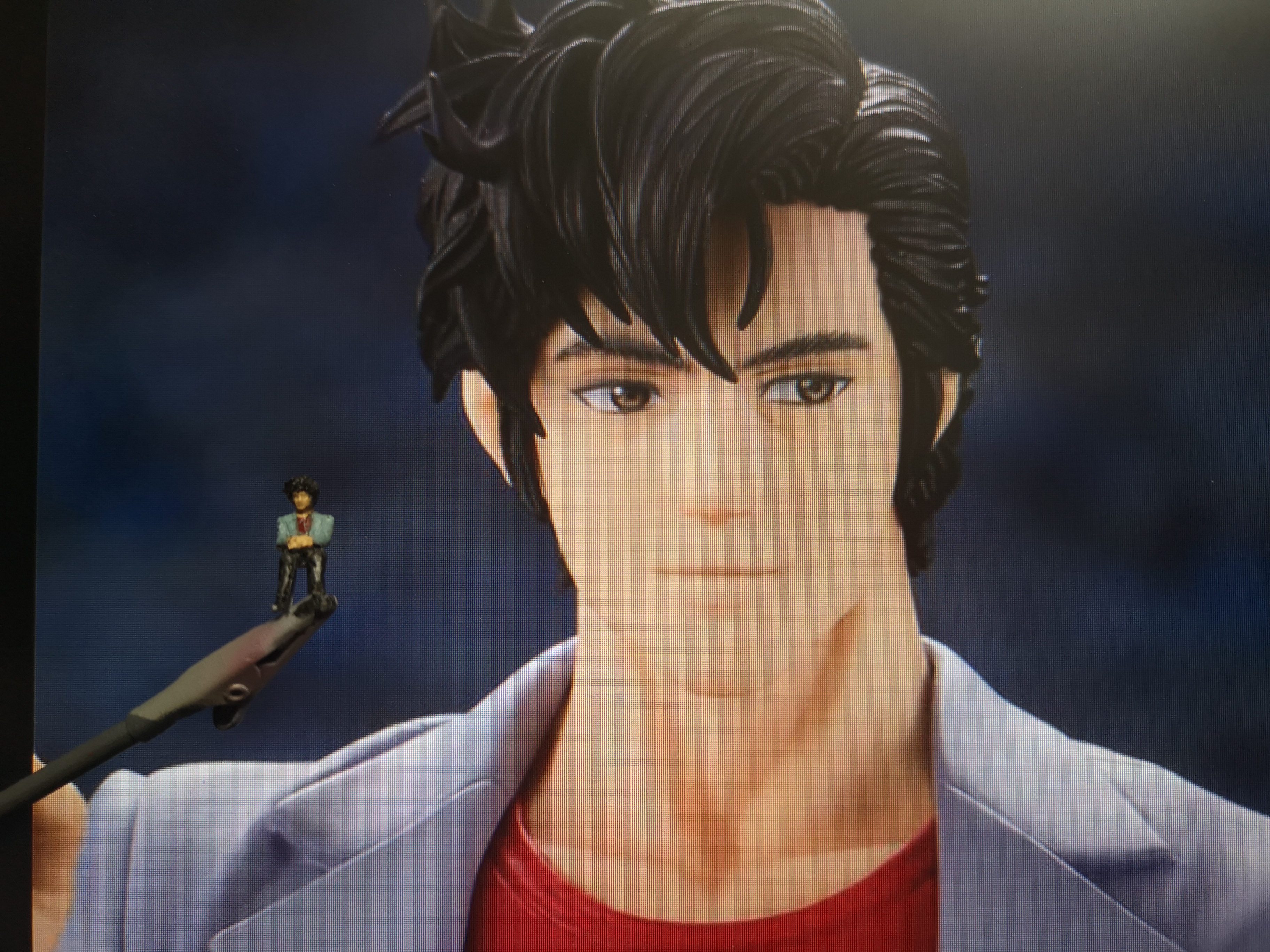

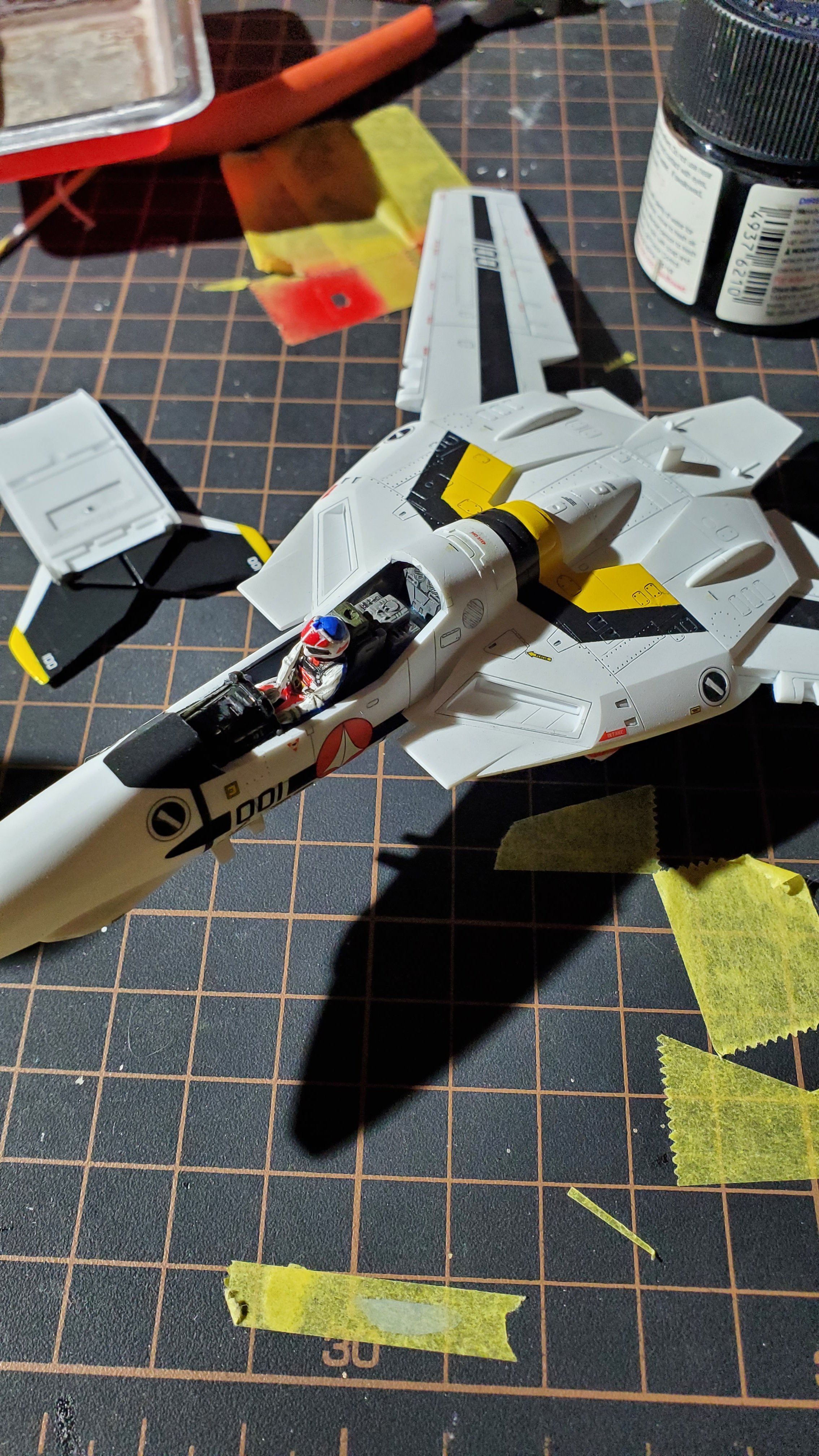

Any City Hunter Fans here?

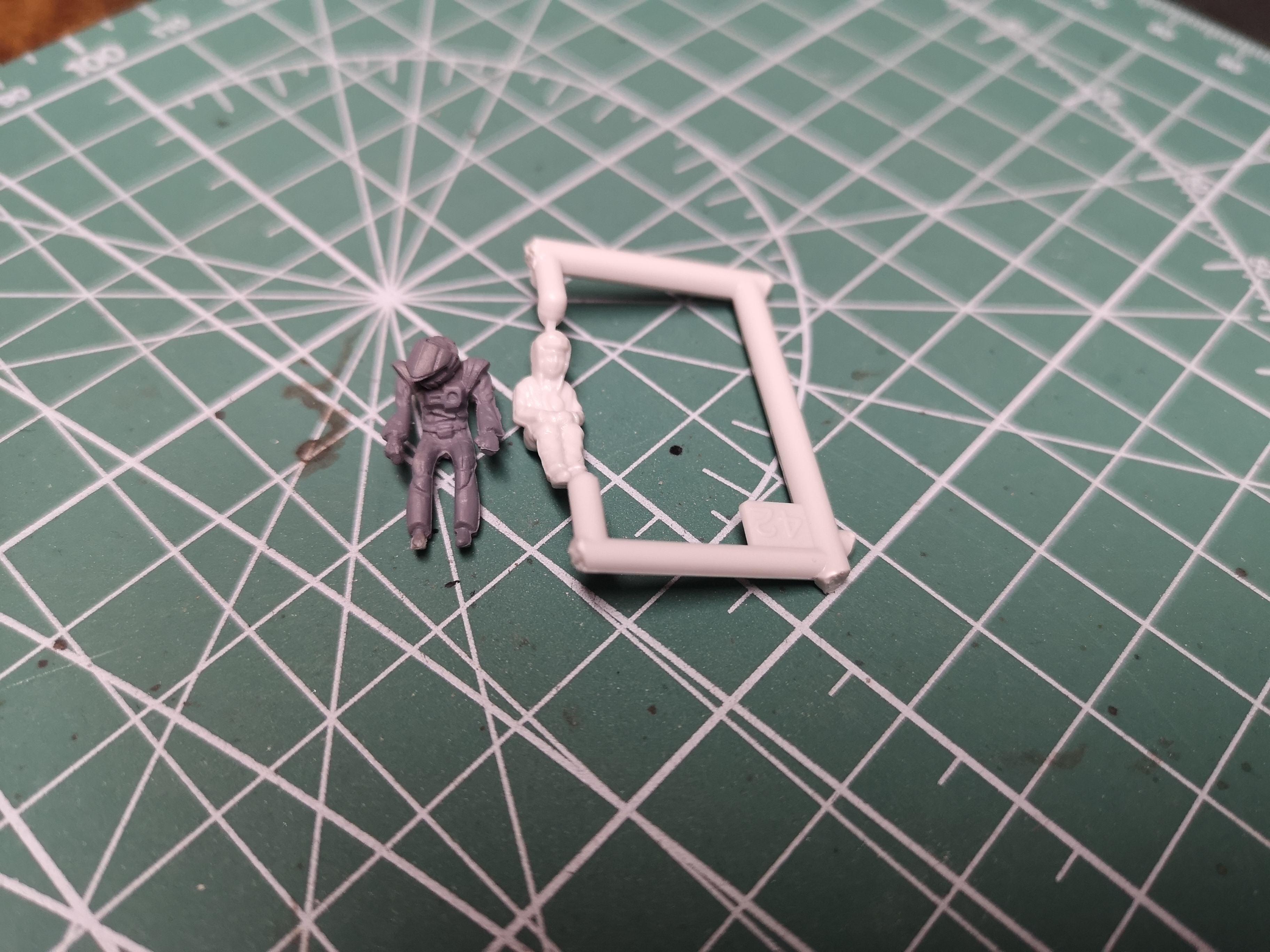

Bandai 1/72 Valk pilot on the right, Hasegawa DYRL pilot on the left
Took the Bandai pilot, trimmed his flight suit, added 80's shoulders and Ryo's sweet hairdo.
Not exactly a spitting image, but my first time mucking around with Vallejo plastic putty and sculpting anything.
Saeba Ryo is apparently impossible to kill, Roy thinks about Pineapple salad and dies.

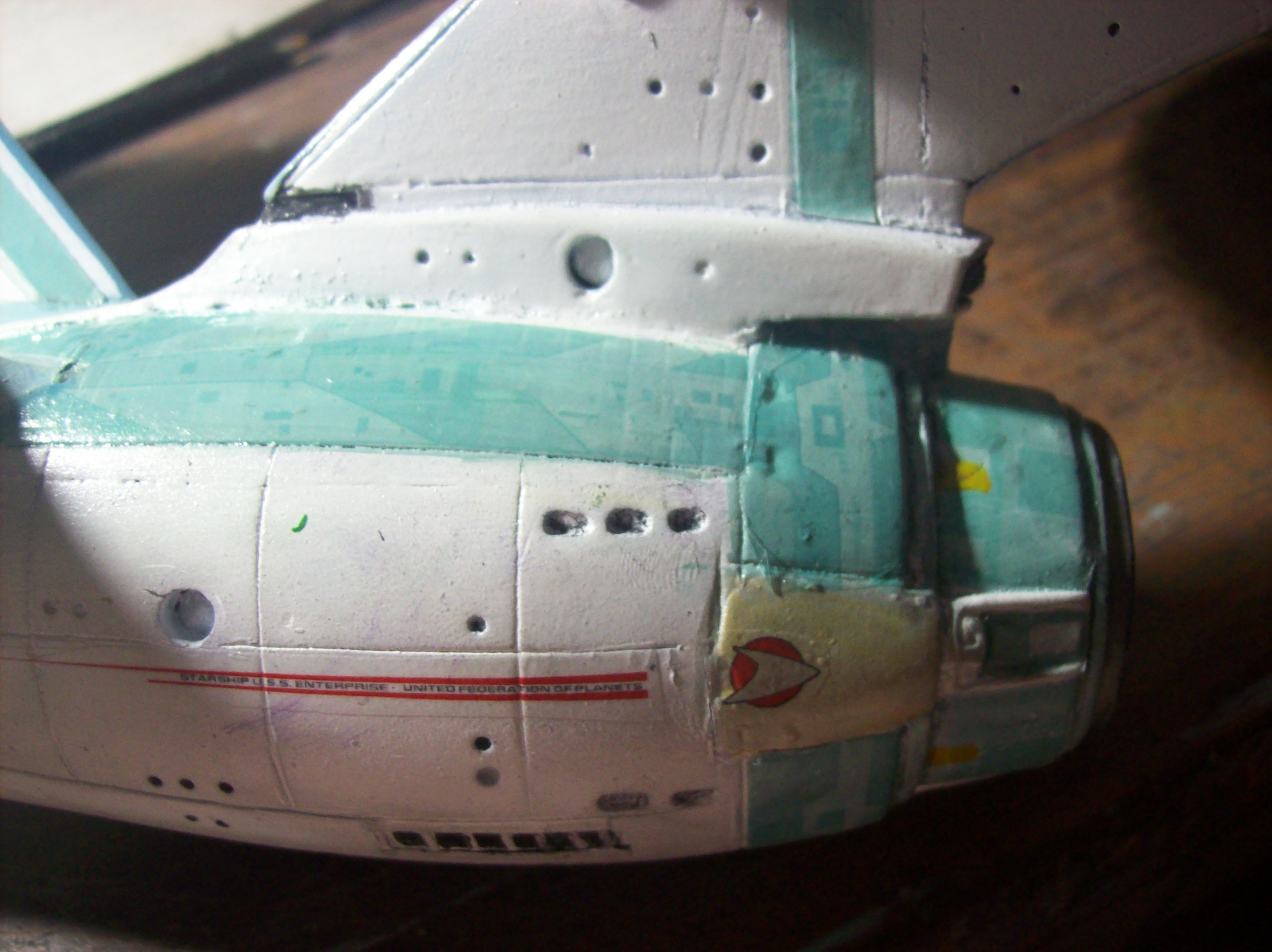

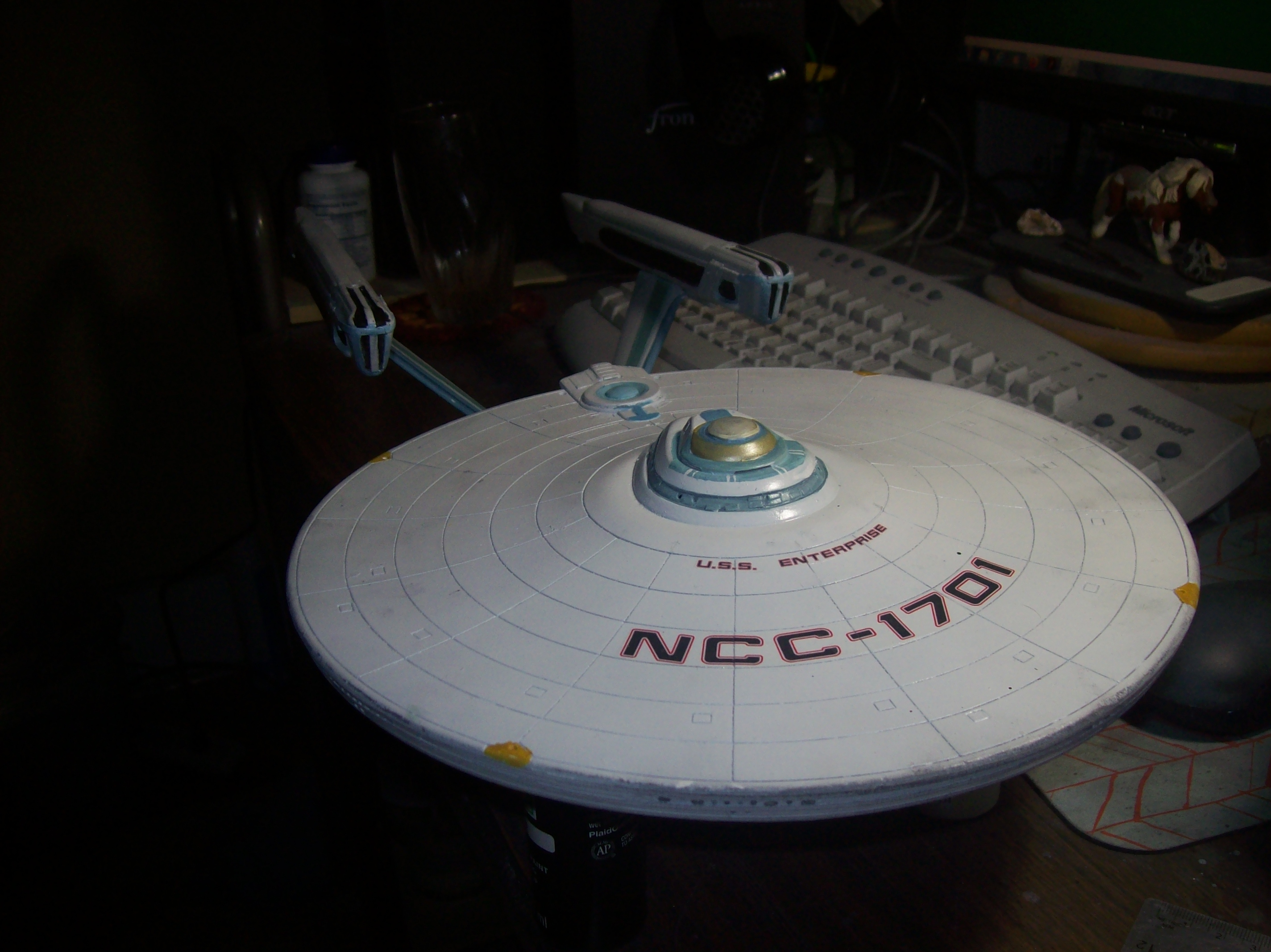

UPDATE: got some decals printed up-
1179337917_100_01221.thumb.JPG.bcad629653ab3a4ef3b4daeed70b5c00.JPG258198412_100_01231.thumb.JPG.048ba2dd6b219770786ab32d505f934d.JPG
Still have some rough patches to clear up here and there, but nothing too hard. Stay tuned...

@peter Great finish on your models! They look realistic on deck and out in the sun. All that hair (and shoulder pads) on a pilot are just wrong!:lol:

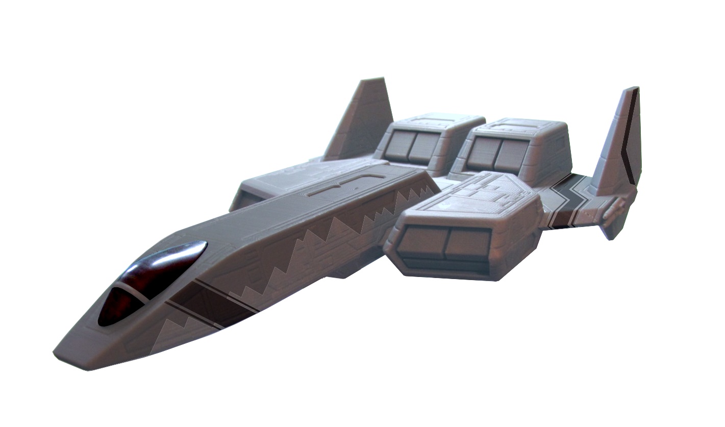

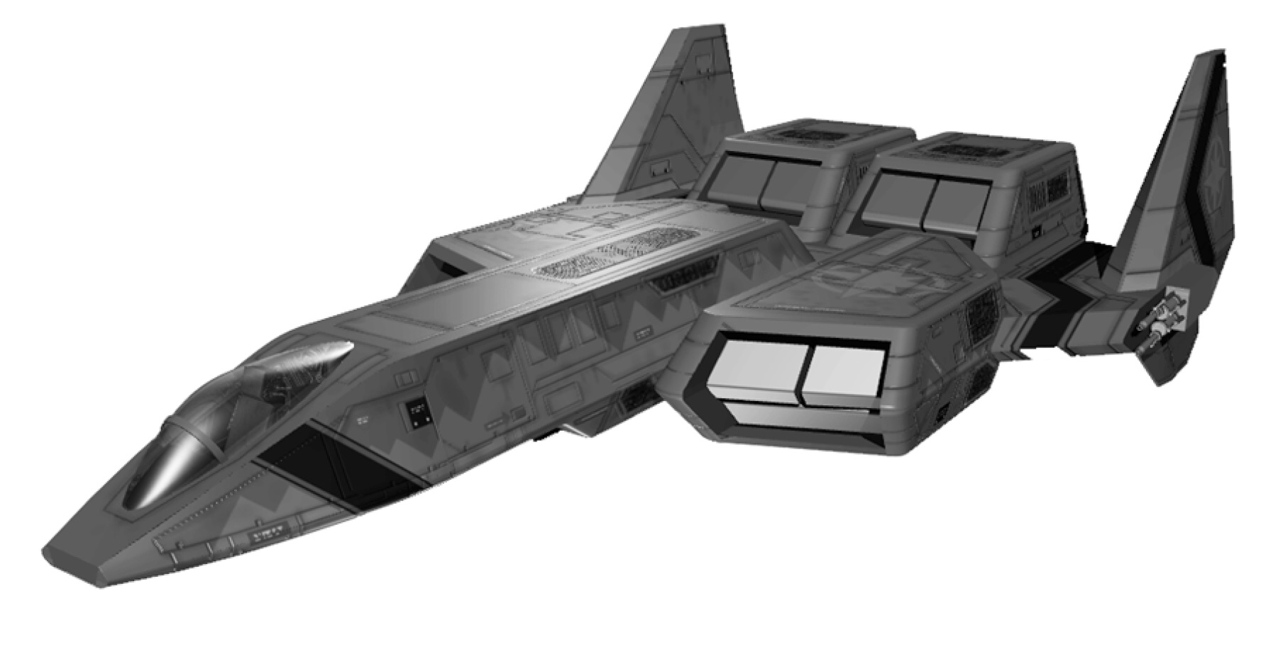

Fun would be the WC IV "Dragon" fighter....
BTW: I just realized which fighter you're building! One of the most famous in Wing Commander...the Excalibur-
https://wingcommander.fandom.com/wiki/F-103_Excalibur_Heavy_Fighter
And here I thought it was the Hellcat! lol
Edited by pengbuzz
Oh, they're all fun to think about doing, but I'm probably not attempting another project at this scale without some proper CAD software that can do variable features.  Cutting panel lines in this model was incredibly annoying, because they're physically cut into the solid model, and can't be adjusted if I ever wanted to make a bigger version, and needed to shrink them.
I did make a point to save the model at multiple points so I can just re-cut the panel lines at another size if I really want to, but some actual proper CAD software (that is, not 3D Studio Max :p) would have better tools to draw panel line paths, and just dynamically change their depth and profile on the fly.

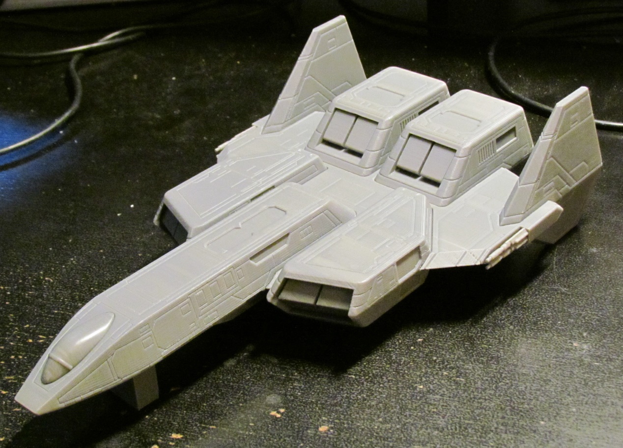

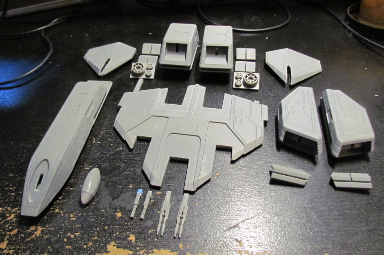

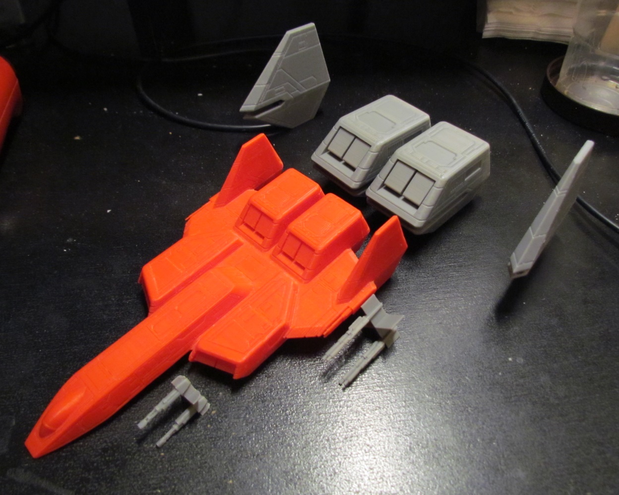

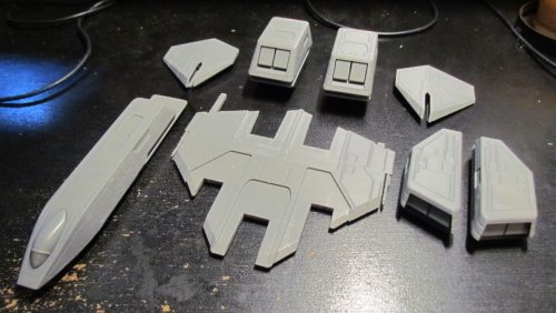

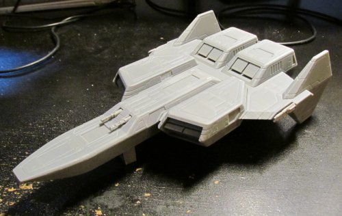

Boy, I can't even call this "done" yet, but does it ever feel like an achievement.
1657611654_ss(2021-04-14at03_22.00).thumb.jpg.37b8bfacbddff1a9bb1e5b79e743aa19.jpg1347683013_ss(2021-04-14at03_22.10).thumb.jpg.7a4f5d801e1ca6fb162c500218a5aecb.jpg
Twenty-one pieces all told, with a total of about 112 hours in print time.  I definitely over-engineered the interlocking tabs, and failed to account for how difficult it was going to be to remove the support structures from inside some of the parts, so I just broke out the smaller middle teeth from the wing section.  It didn't have any affect on how sturdily it goes together, with absolutely no need for glue.
16535480_ss(2021-04-14at03_22.34).thumb.jpg.236ef519dfcc4097ee13d78aae8aef72.jpg1936439525_ss(2021-04-14at03_23.00).thumb.jpg.9bd2ecf5c041cfcd16cfb6af17df677d.jpg
1761046315_ss(2021-04-14at03_23.13).thumb.jpg.81e7d9b9d0552ceb27f4dbb875b7b380.jpg210723873_ss(2021-04-14at03_23.43).thumb.jpg.ca7dc05609babce67608991df10a8cbe.jpg

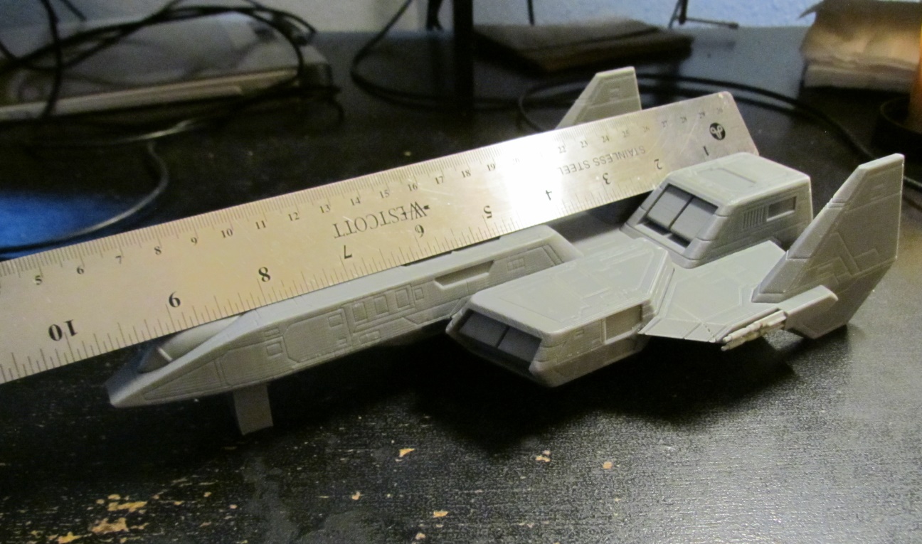

Length looks to be almost ten inches even, which puts the scale at something like 1/125 or so based on the game's quoted length of 32 meters, but I think that's always felt a little inflated, and I think a 1/100 pilot would fit inside the cockpit if I made one.  One project at a time, though. :p  I still have some potential detail parts to make for this that would go in the recessed panels scattered around the ship, but I'm not sure I made the spaces deep enough to be useful for that.
I did sand and polish up the canopy, so I know the plastic will shine up nicely if I decide to do that.  For the moment, I'm just having fun making spaceship noises and swooshing it around the room. ^_^
Fortunately, with the way it's built, I can probably assemble the components after painting.  That will make it a lot easier to pull this off.

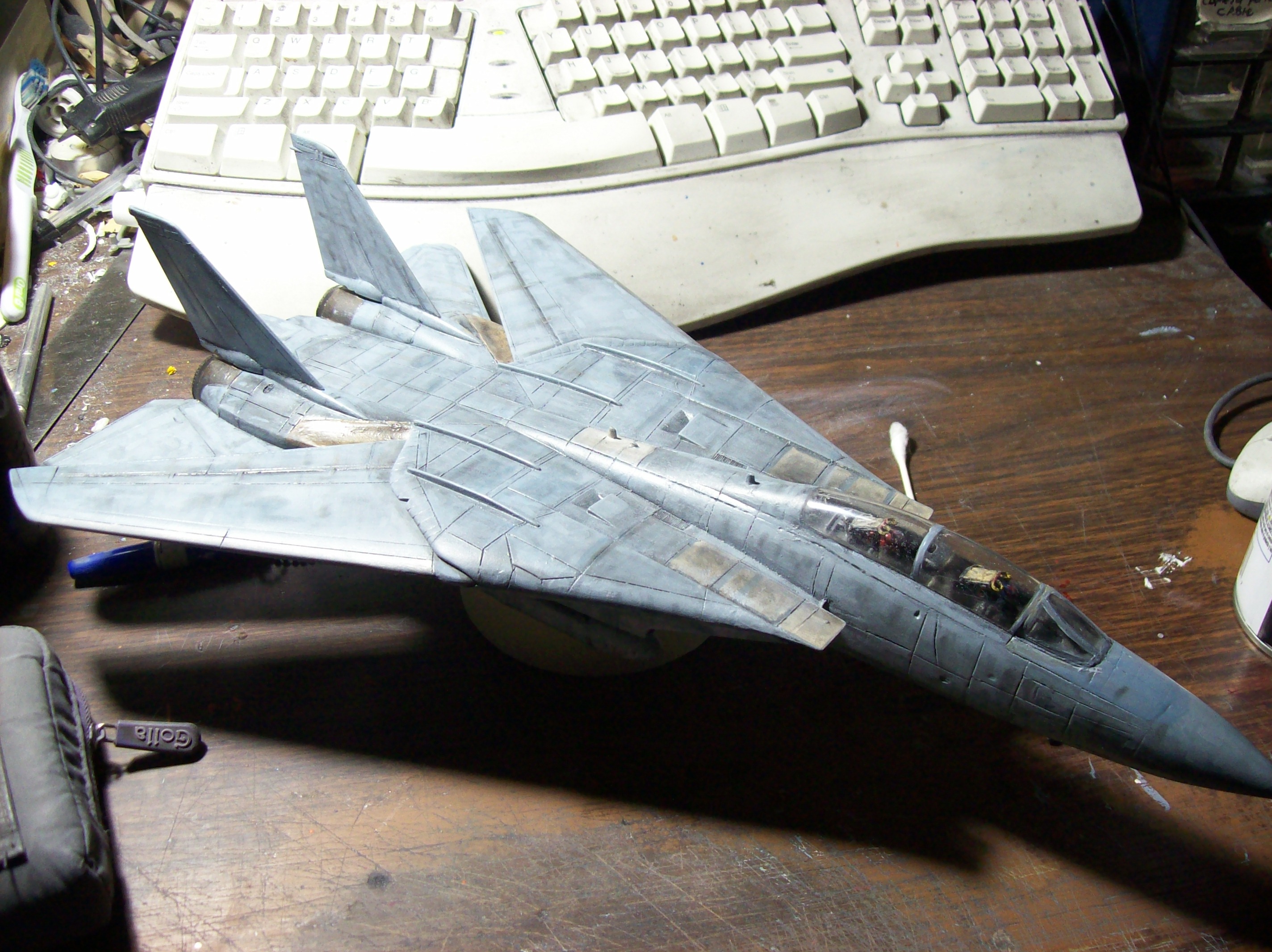

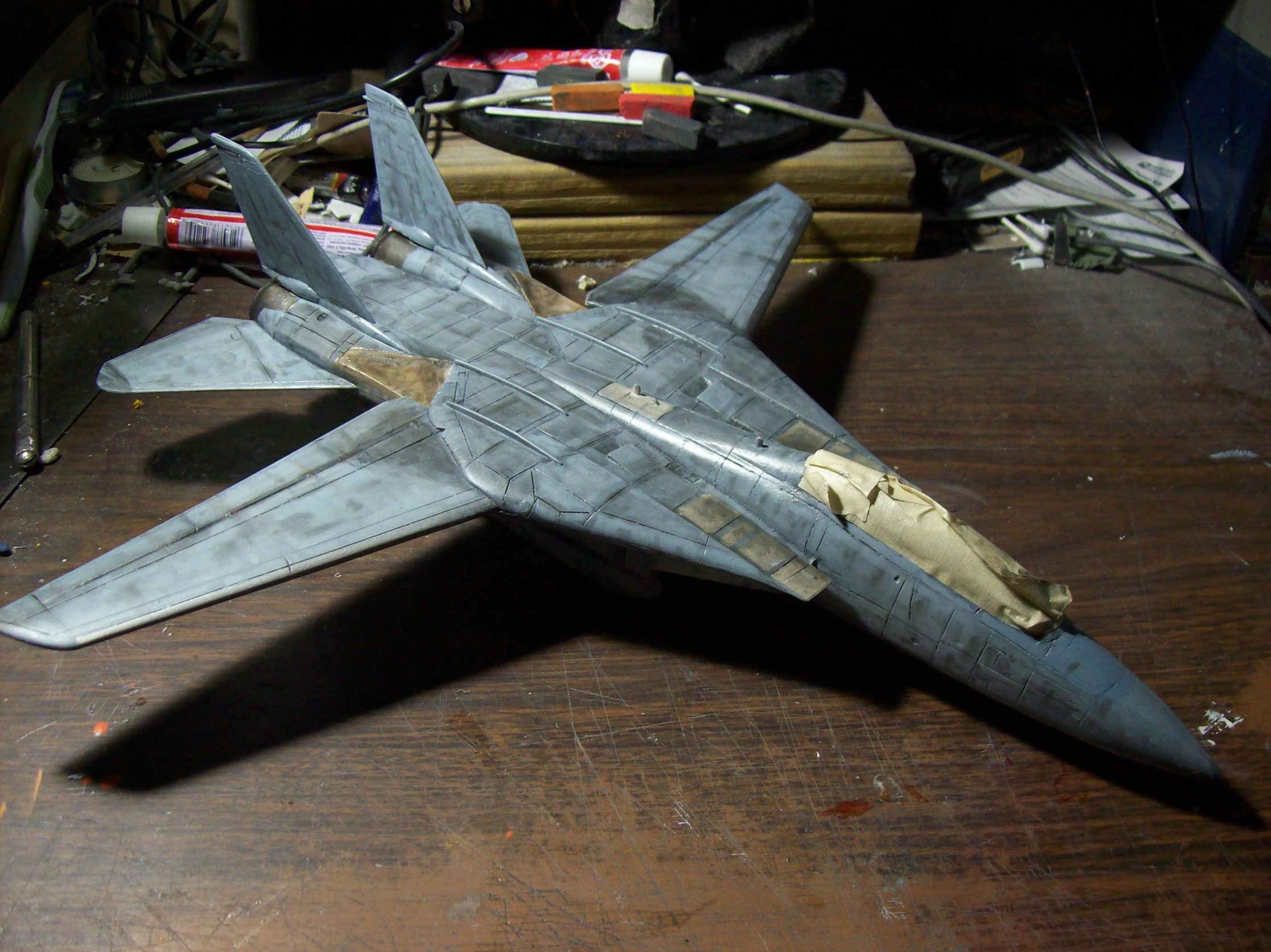

UPDATE:
Some paintwork done on the Tomcat ( Corrosion-control painting weathering):
001.thumb.JPG.bc69f04805494ec1ac87acdfa798a186.JPG002.thumb.JPG.7395ad11cc3390dd9ac3546faa274178.JPG
Soon, I will be moving into attaching weapons rails and tanks (need to check the movie for whether these are on Maverick's bird during their time @ Miramar); before that, need to check specific references from the movie on any distinguishing different-colored panels and whatnot on the plane.
On another note, before I knew that we were going to obtain a new printer, I had put in an inquiry with Round 2 about the cost of obtaining the decal sheet for the refit; on their re-pop of the kit they had redone the decal sheet, correcting the old markings and adding additional ones as well. This was about a couple of weeks ago or so.
Being that I had misprinted some of the markings (I didn't use them, such as the hull registry numbers on the nacelles and such), I was preparing for another round of resizing and reprinting. Lo and behold, to my surprise, I got an email from them stating that they were sending me the decals!
O.o
So, just going to hold off on printing replacements here, and thank those at Round2 who seem to like me an awful lot!
Stay tuned...

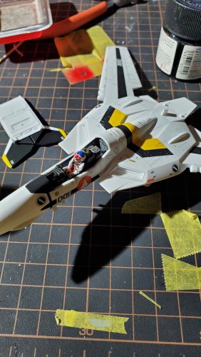

I just put a flat coat on the last few pieces of my super gerwalk build. It's still early so I may post a follow up pic when I'm all done later.

@pengbuzz Looking really nice there, Pengbuzz! Really liking the shading.

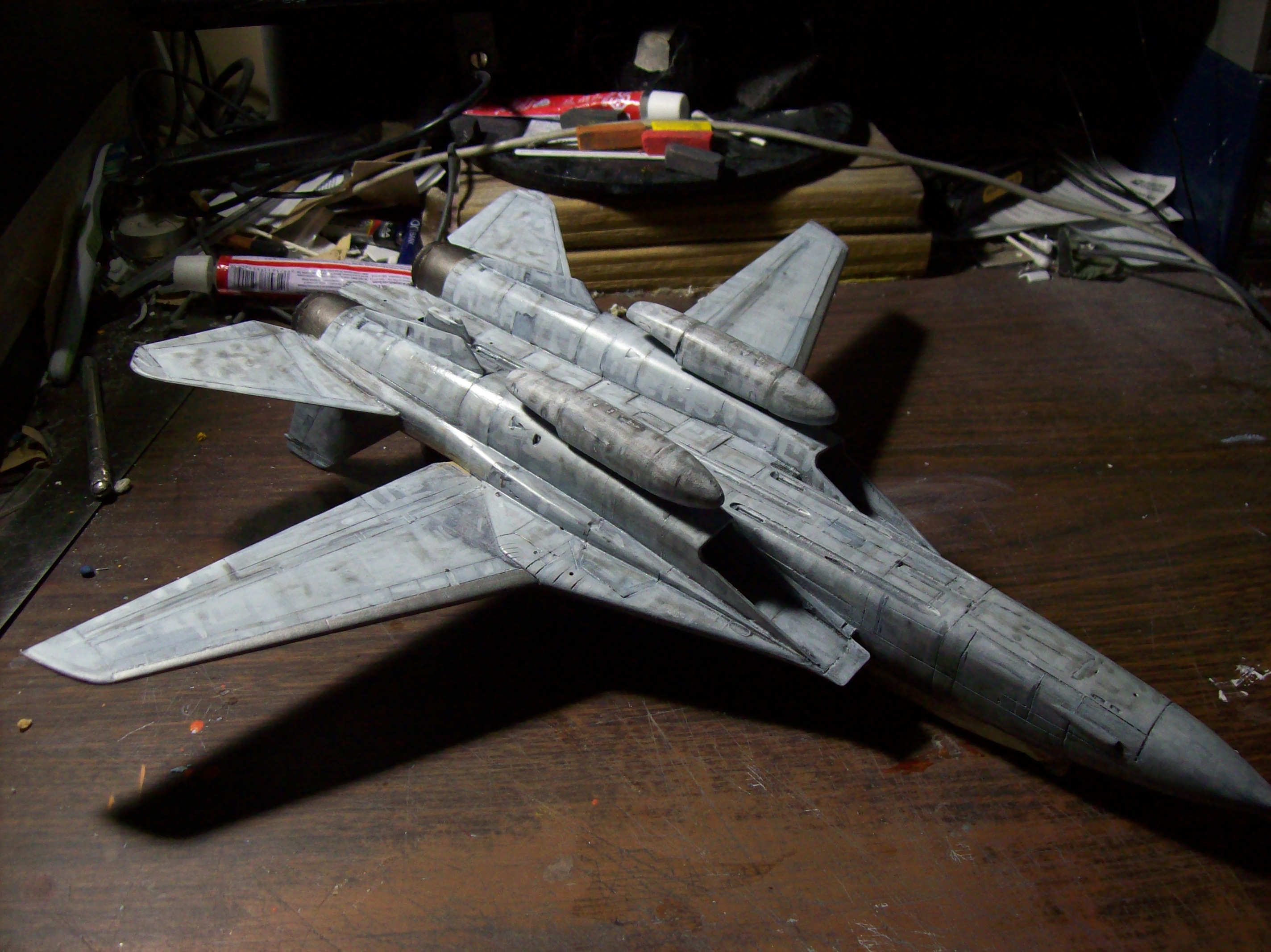

Thanks Thom; more to come on this, as I went over the DVD and picked one version of maverick's Tomcat (I counted three versions of Mav's Tomcat, each with a different modex) to replicate. The weathering's going to look a little heavy, but that's how it appears in the film (to me, anyways):
1349156829_100_01401.thumb.JPG.9bac80aaa9cf693bd1a5dcb13c47b4f9.JPG394091597_100_01411.thumb.JPG.a2b75f3e80740b63e54572ec7e16256d.JPG
Added the underside fuel tanks; just need to add in the underwing missile stores.

@Chronocidal Congrats on a cool kit! That came our great! lot of 80's square goodness.
@pengbuzz That is one dirty cat! If you want the full effect, put some greasy hand prints around some access hatches. Like from a cut out eraser tip to stamp them on. Some friends that were maintenance said there were always hand prints around! We'd never let our aircraft get that dirty in the Air Force:ph34r:

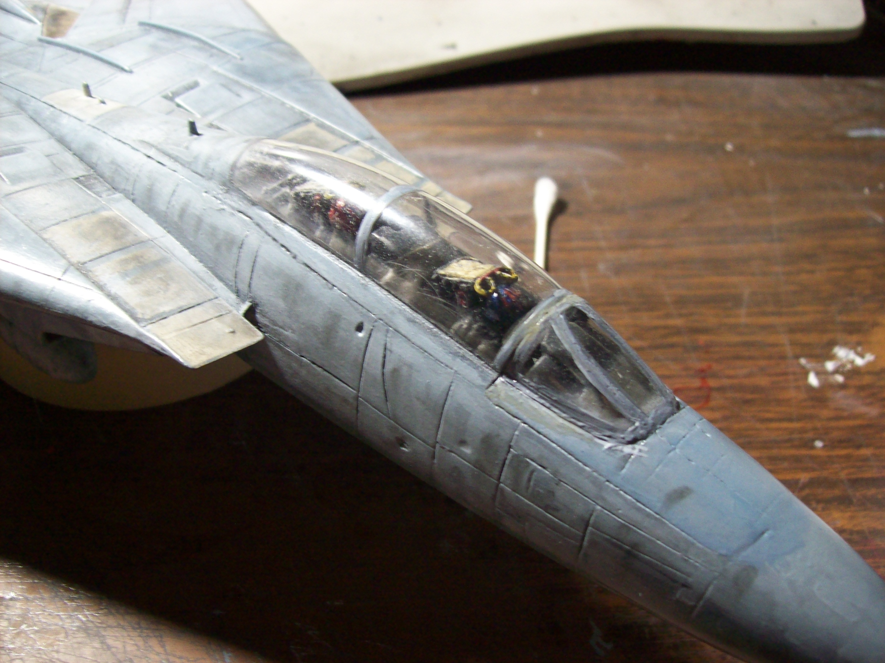

Thanks guys! I did have to walk it back a bit though, as the dark areas looked more bluish than "dirty"; was trying to go for a multi-layered paint and repaint job here! lol
Current results so far:
I finally finished the framing on the cockpit, which is hard for me to get my head around, because the canopy came from a different model!
Stay tuned...
I don't know what ship this is, but it's cool.  3D printing technology is amazing.
