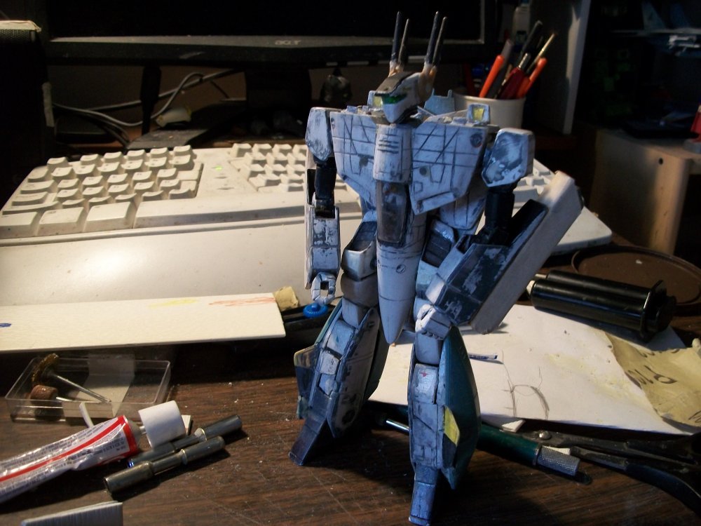

Pengbuzz - The weathering looks great on that! The nozzles are cool. I don't think I've seen a valk with discolored nozzles (besides the fast packs) before which is an overlooked idea. Is that the fully transformable valk you built a while back? If so, what did you do for the leg joint connections? I searched our boards and found an old post for it, but the photos are no longer linked.

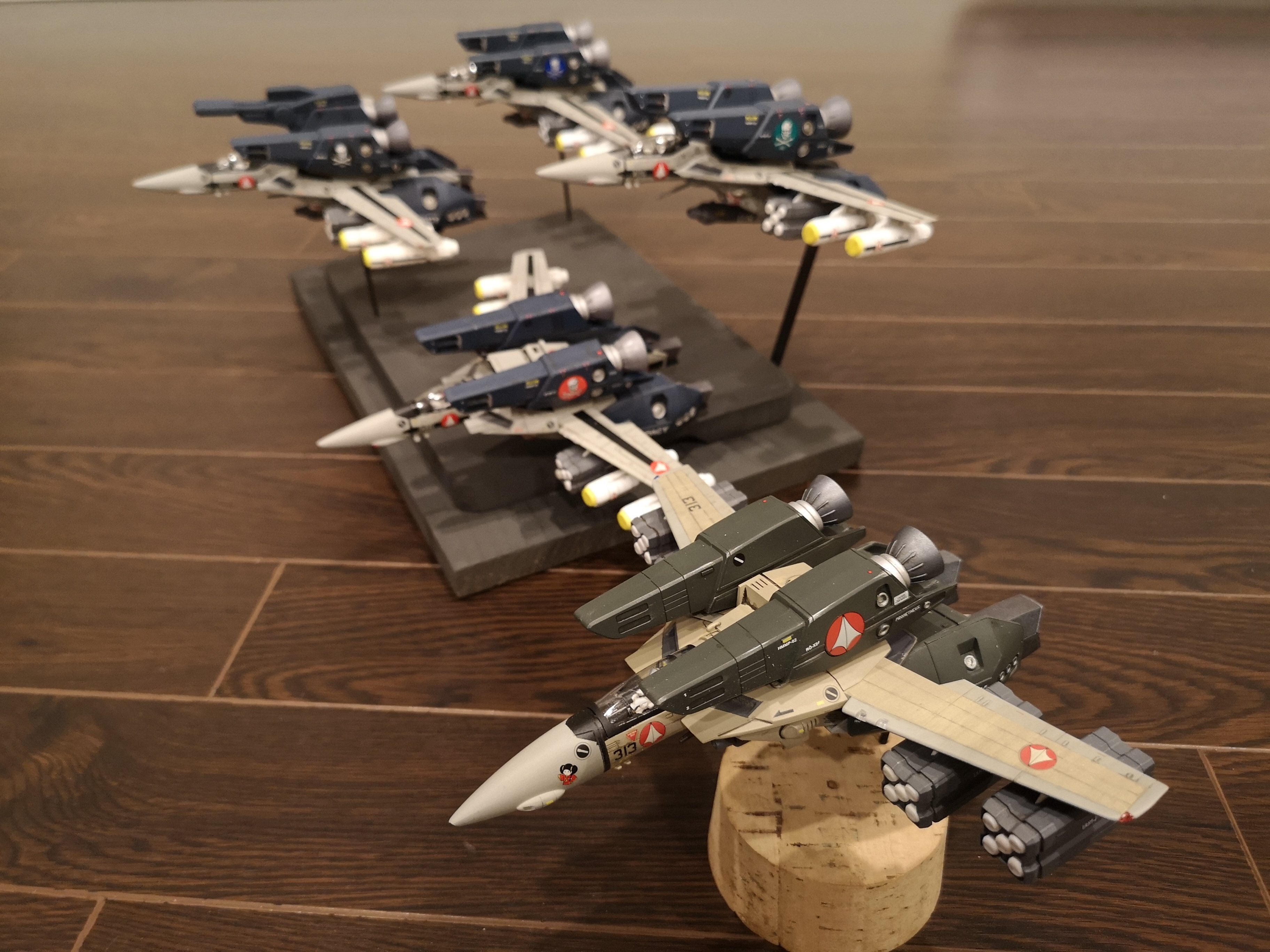

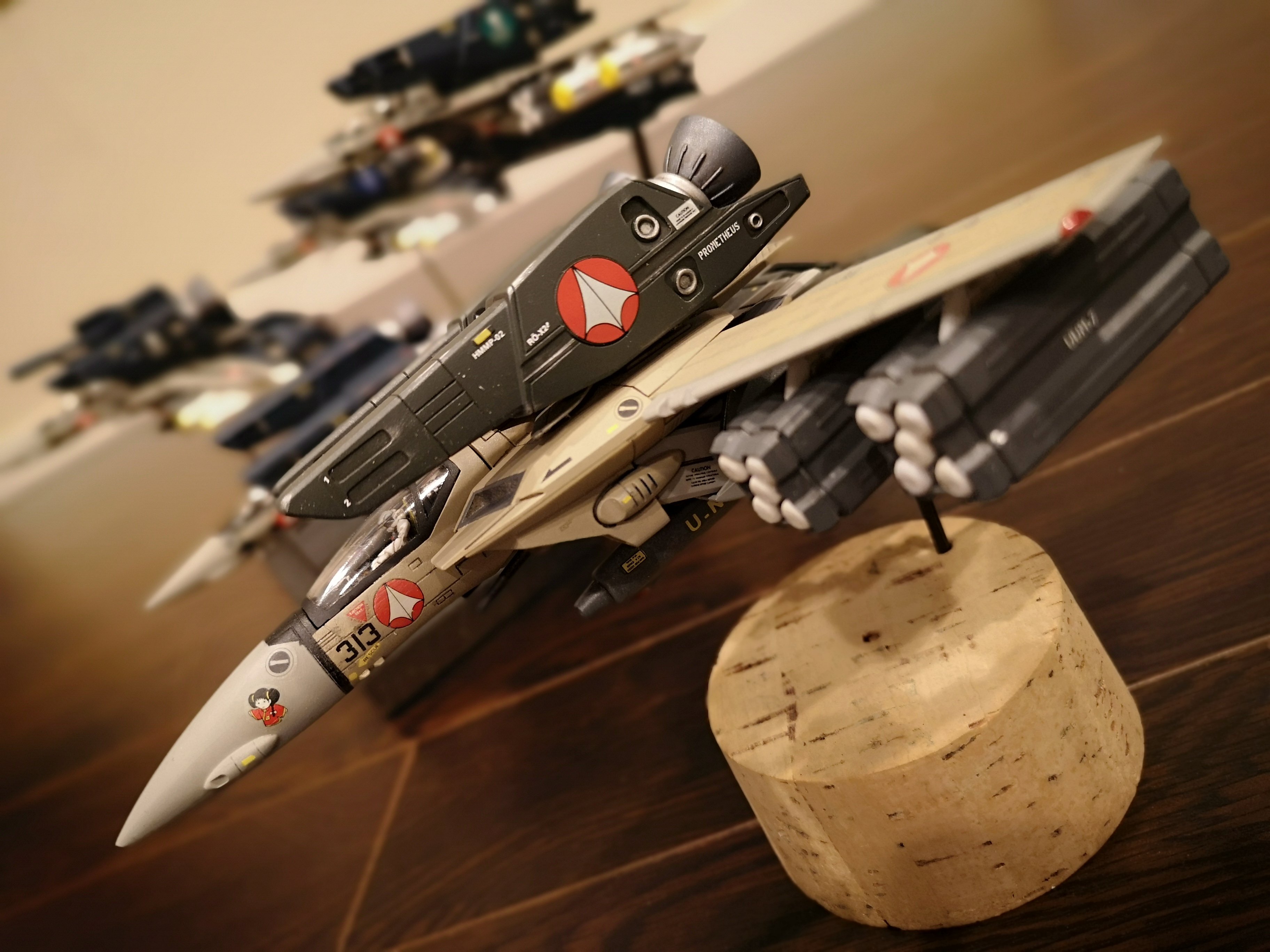

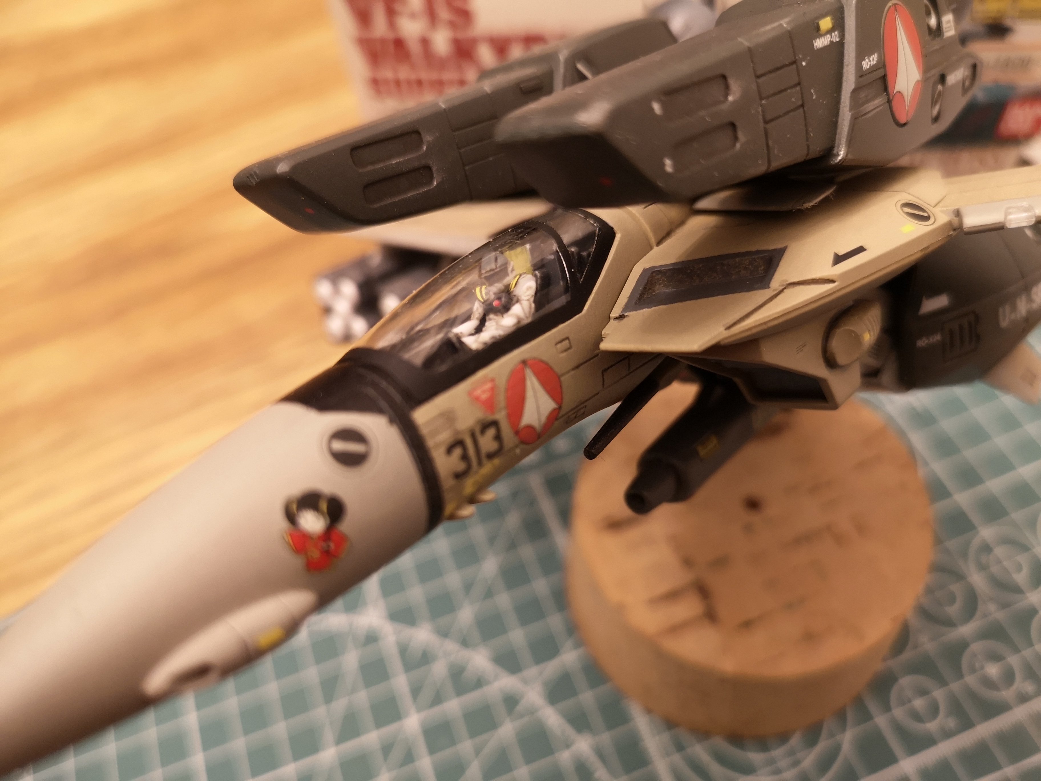

Thanks MT! This is just the Imai VF-1S I built a while ago (not the FAST pack modded one), with interchangeable noses. I still have the other one, but I had to borrow it's gun pod (the IMAI one met a tragic end when I dropped it and accidentally stepped on it! O.o).
Speaking of which: sometime soon, I have to post pics of that one, as well as the custom-designed valk I built some years ago.

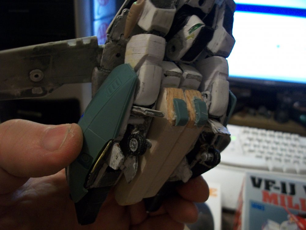

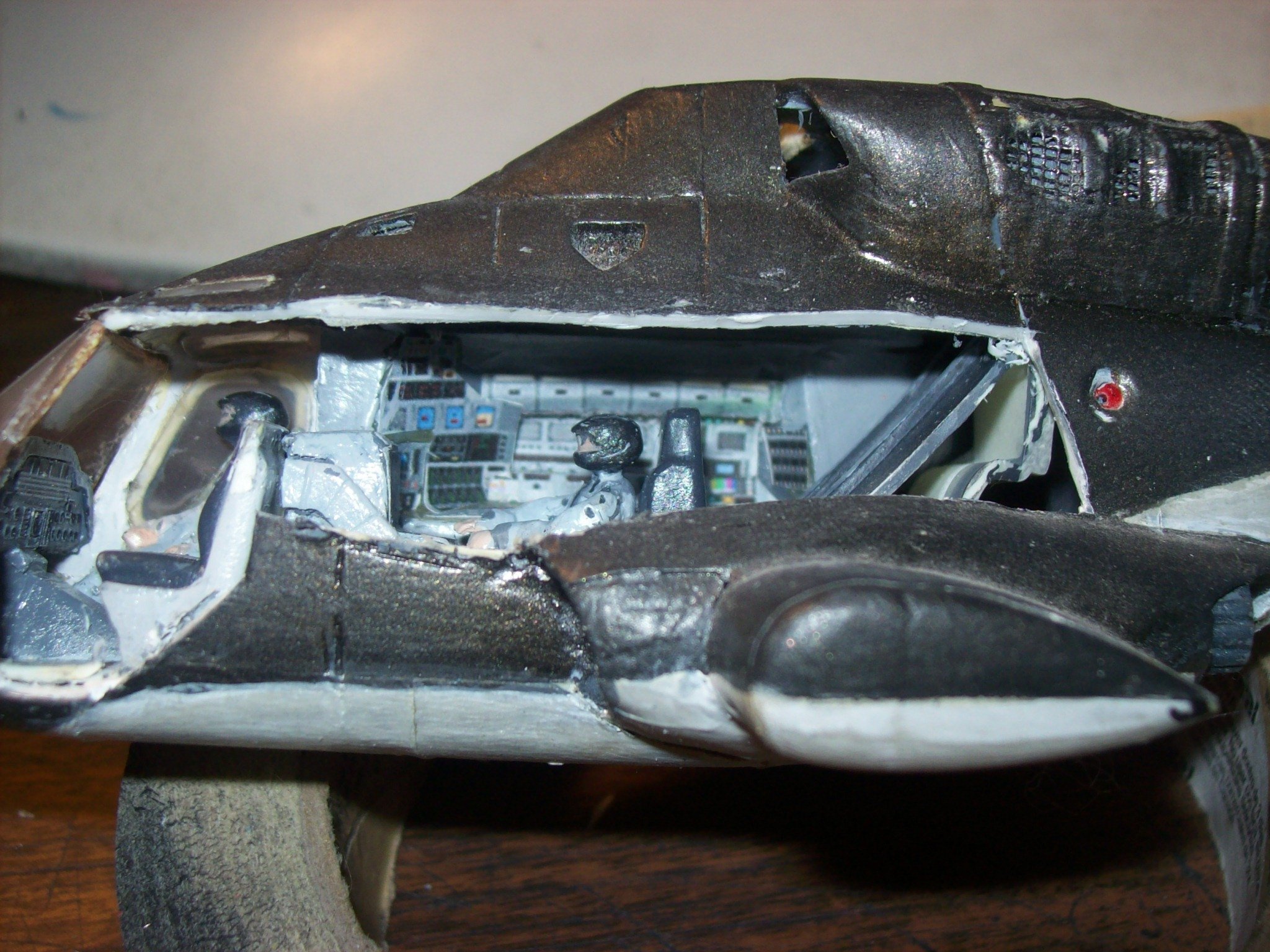

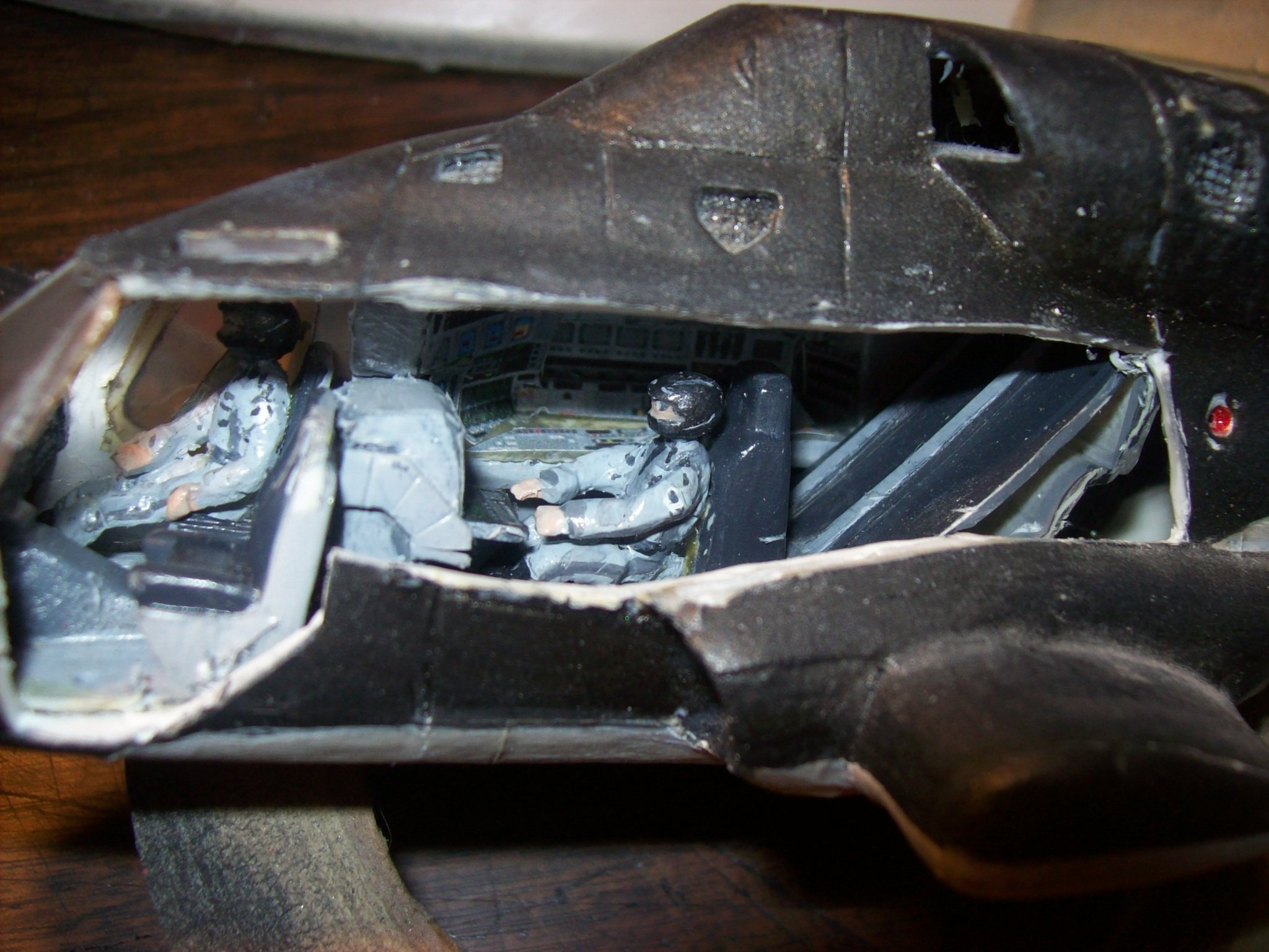

While waiting to find repair parts for another project, i dug up an old one from 2012-2013:
100_1057.JPG.b0118d6c3c3643d82af8c527582d6d08.JPG100_1052.JPG.c783b162aa4a222d290afc18e21915c5.JPG100_1054.JPG.6c17e0087398fe8cd5ad76e32c5656f5.JPG 100_1056.JPG.cc926ae0b8c7e5d07168cc0d1b6b720b.JPG
I found an AMT Bell-222 1/48 scale kit. While it wasn't the "Airwolf" version, it was the base model for it. So, after some outer mods, I did a complete interior using sprue and printouts of all the controls for the CIC (Dom's "office" aboard the lady). Then in a genius moment of stupidity...I glued it all shut.
So, after finding this in my stuff, i did an experiment, and was able to open her up to show off the interior. Don't worry: I still have the outer panels! I cut them carefully along panel lines and am working on tabbing them so they can pop back into place. I'll just need to rework it slightly to make sure the fit is as seamless as possible. But after remembering the work I did, I think gluing it back would be just wrong!
My paintwork isn't all that great in there, but this was nearly a decade ago! Classic pengbuzz work here; see what you think!
Love it @pengbuzz! I wish some company would make like a 2020 new mold Airwolf in like 1:32 scale with removable side panels to reveal the inside and swap the weapons out for the "closed" position when you wanted. That would be SO an instabuy!

Great job,Pengbuzz! Looks like time has shown the error of your younger days. Also looks pretty neat in there. I wonder if you could salvage the interior and put that into a newer kit, including the removable panels from the start?
I built the AMT Airwolf kit back in the 80's. And as it came with the original CIC stations, I glued the cabin shut, too. So the whole work on the interior was for nothing.But was even more worse, I "painted" the entire exterior with a black paint stick from Tamiya. What can I say, it looked horrible and a short time later I scrapped the whole helicopter - though I really liked the design. I wonder if I could have "saved" it with my "improved" skills of today <_<

I like that idea, Thom! I would love to find a newer kit (preferably an actual Airwolf kit) and put the internals into it. The figures were scratched up from sprue (and admittedly, this was before I learned that glasses would help my vision!); i would want to revisit them and detail them out a bit better. The exterior of the helicopter is crap because it was just a Bell 222 that I had to mod into Airwolf and do the add-on turbines and armor myself.
Another reason for wanting an actual Airwolf kit: the white plastic on the Bell 222 is quite soft and easily bent/ broken. I recall the black plastic on the Airwolf kit (I had it some years previously to this project) was a bit more rigid, so it wouldn't be such a pain to work with. Only issue is that they are currently pretty hard to come by, and money is always an issue around here (groan). If I ever happen to come across one (unlikely) at a flea market or such, that would be nice.

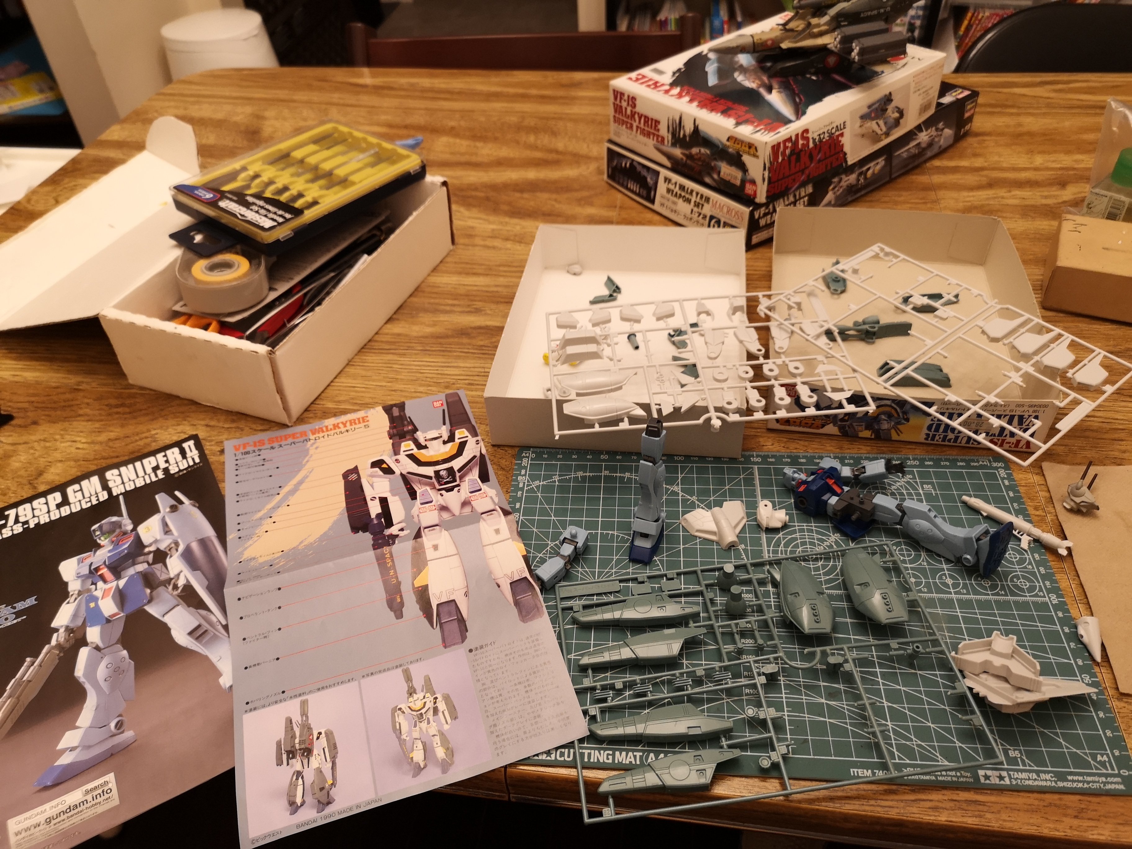

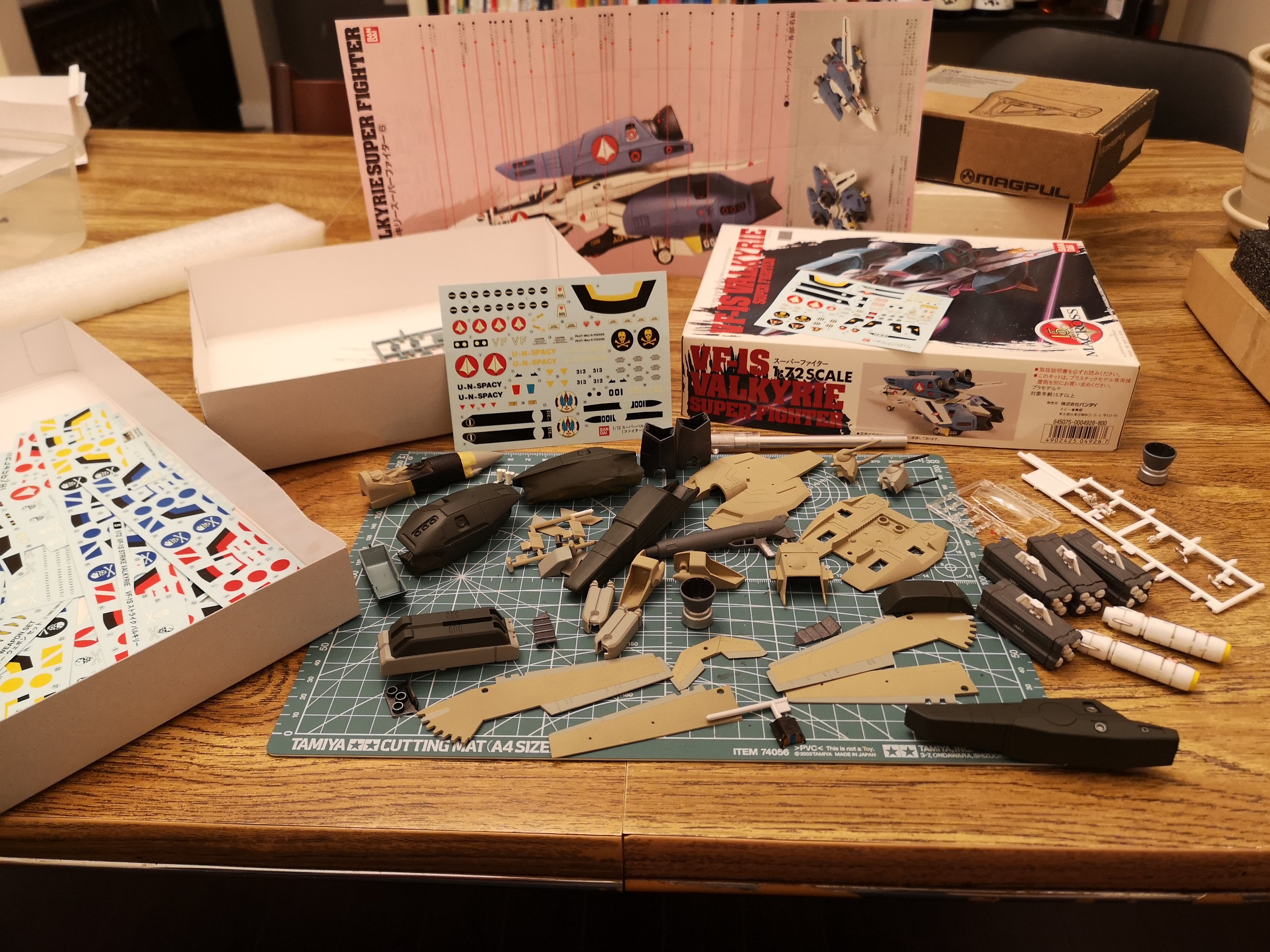

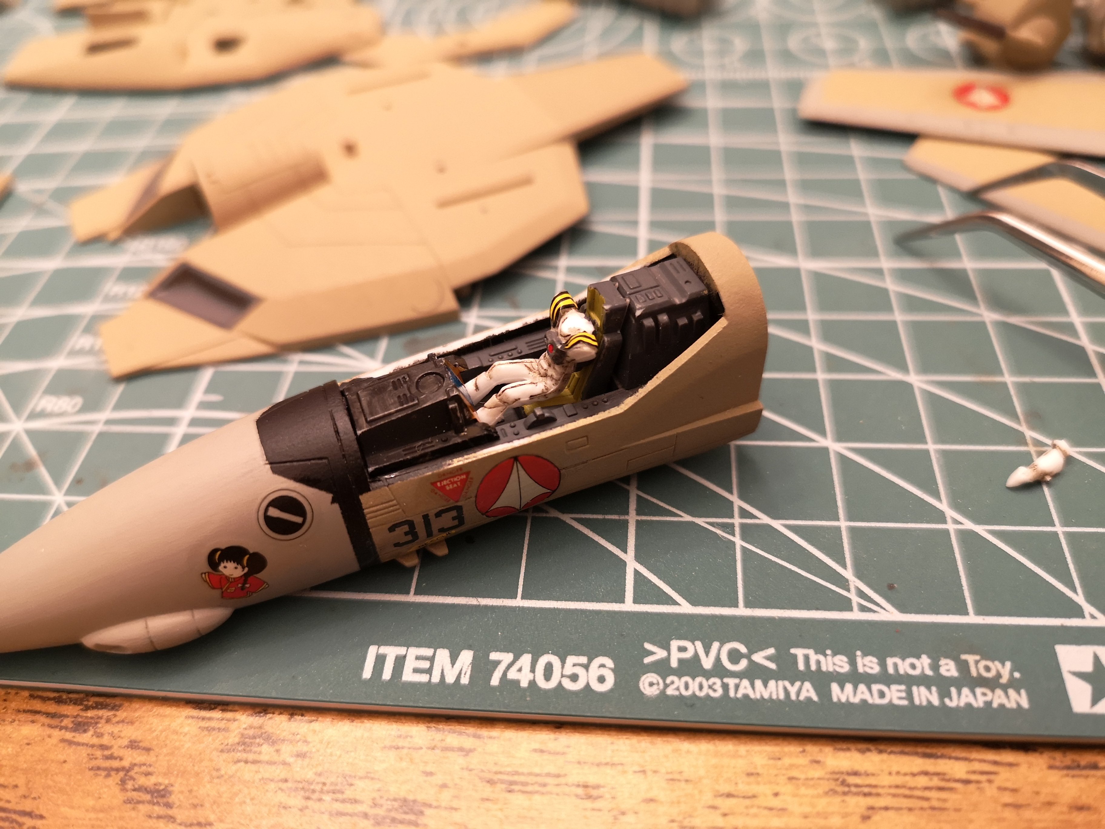

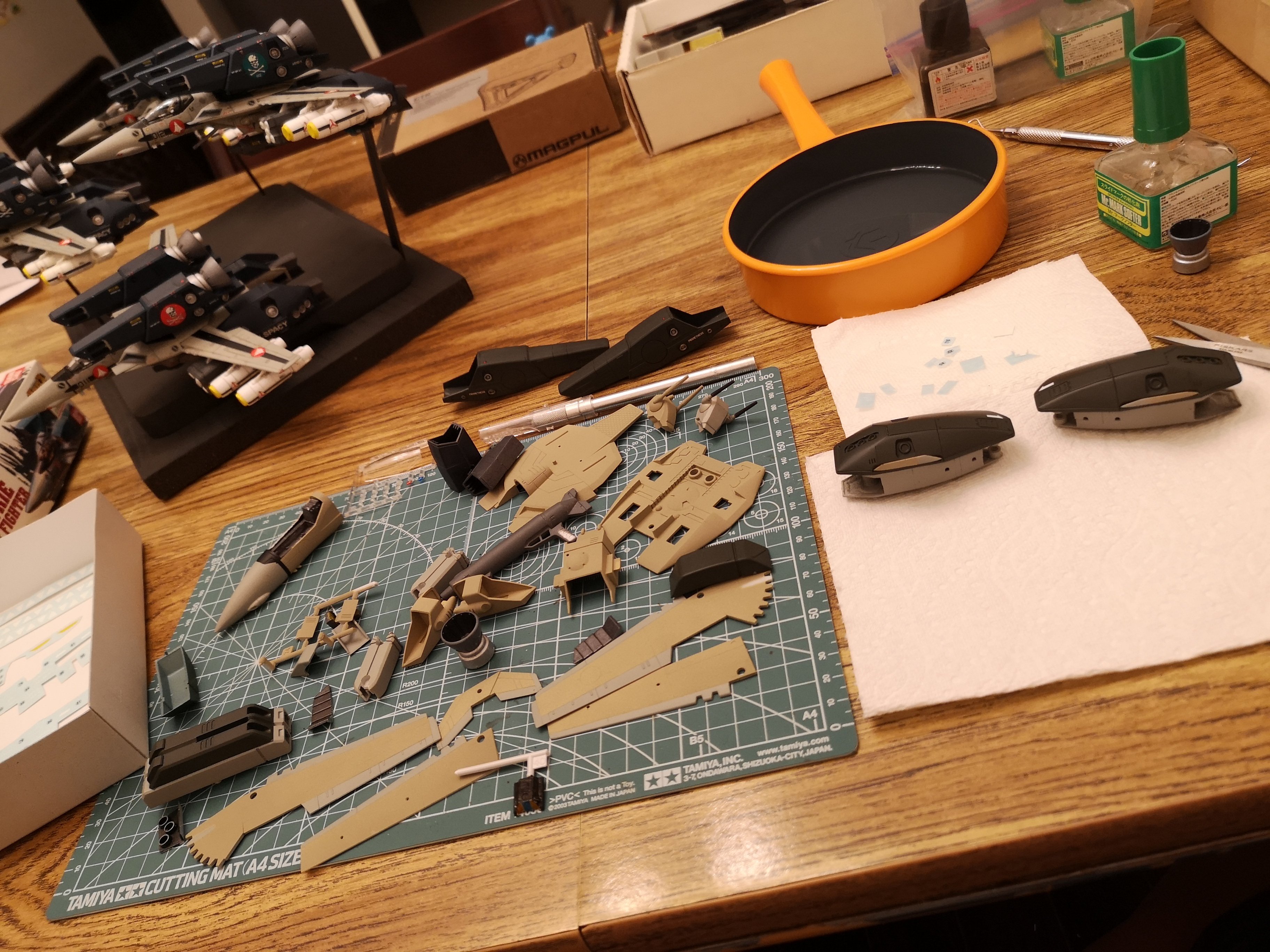

I finally finished off the Hasegawa 1/72 VF-1S Strike Valk I started 17 years ago.  Also built three more Valks right after.  Started a thread about it here:
Anyway, after building 4 Hasegawa kits (plus weapons kits), I decided to slap together a Bandai 1/72 Super Valkyries kit I stole a 1A head from.  Long story short, I needed to build one Strike 1S and three Super 1A but I didn't have enough 1A heads so I got one from the Bandai kit.
I had a few spare weapons, pilots and decals from the previous builds so I'll try to spruce up this old kit.
Be gentle guys, I don't know what I'm doing.
Since I already built a Hasegawa Roy, I decided to turn this one into a brownie.
Edited by peter

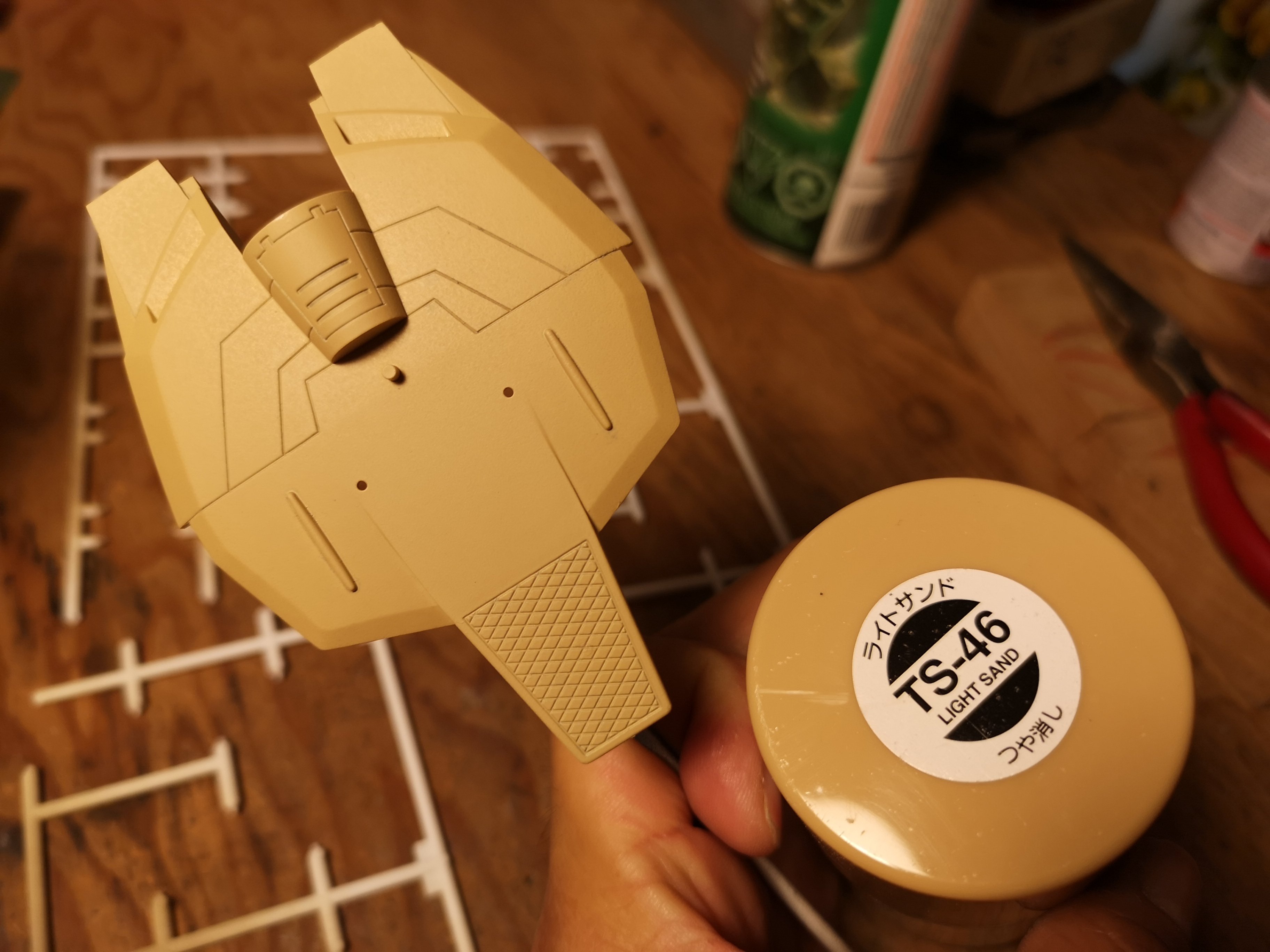

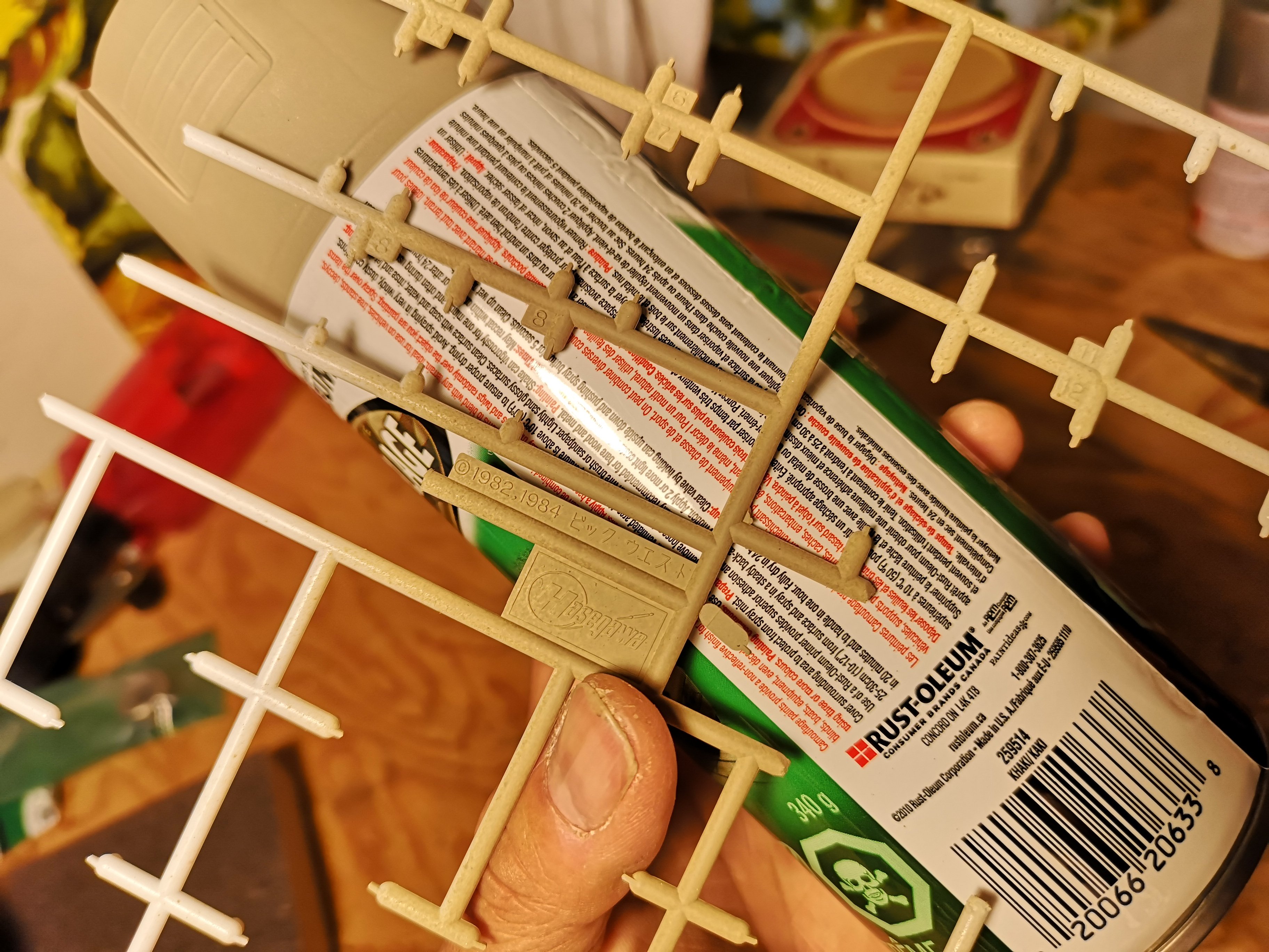

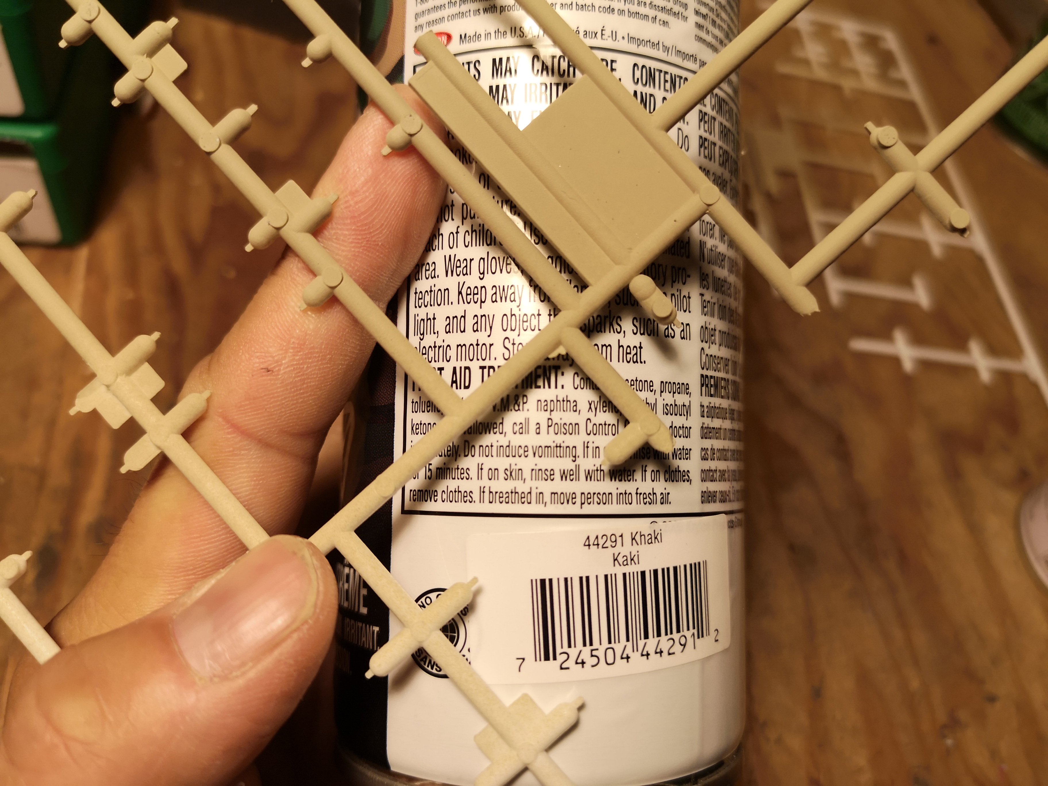

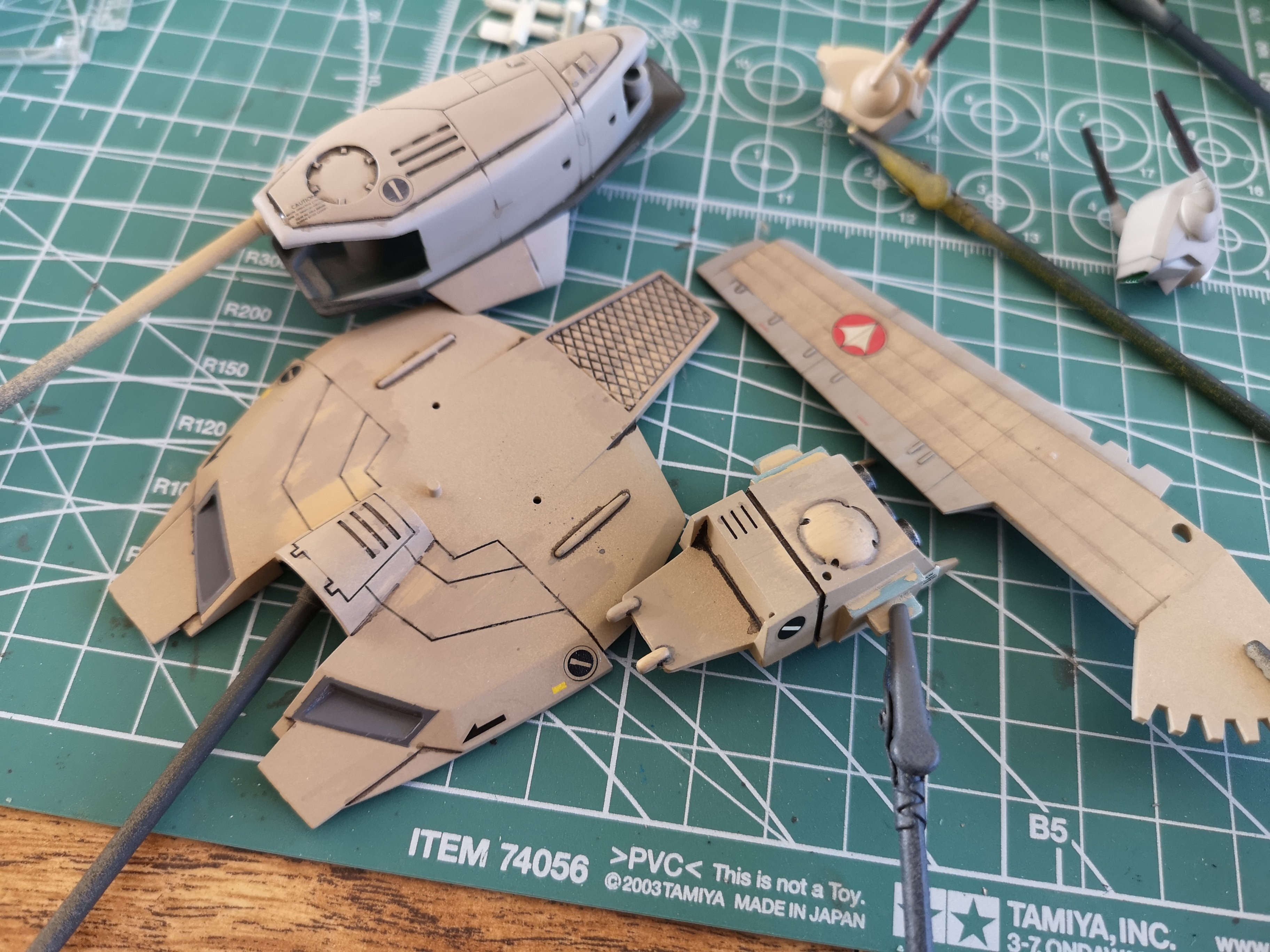

So, since I sort of took my time and was mostly careful to build my Hasegawa kits, I relaxed a bit with the Bandai.  I originally rattle-canned the brown bits with Tamiya Light SandIMG_20200703_191338.jpg.d731e67a80d953feb632c84aa838e5fe.jpg
But then I ran out in the middle of the night and didn't feel like waiting until the next day to buy a new can to finish the model.  So what did I do?  I went to my shelf and found two rattle cans of Khaki I used to paint a few of my rifles, one from Rustoleum and one from Krylon.
I did a test spray to see how they would turn out and ended up going with the Krylon because it seemed to go on smoother.
The color looked ok, it's a real world military color (albeit rarely seen on aircraft).  My mistake was going in the cheap, skipping the sealing process and assuming it would be resistant to thinner as quickly as Tamiya paint.  I did the decals then straight to the panel lines with Tamiya Panel Line like I did with my Hasegawa kits.  When I cleaned the panel lines, the Tamiya paint was solid and didn't come off against the thinner, but the Krylon came right off, lol!IMG_20200705_085545.jpg.7237a9ae9ad15e05cb607c42998523b0.jpg
Anyway, I already put more time into this kit, have to go play with the kids and get some work done so I'm just going to matte coat the thing and slap it together the way it is, lol!
Krylon Khaki on one of my rifles after a few years.  It's bee abused, but doesn't look that bad considering.  But it didn't quite feel completely dry to the touch for a few weeks, something I completely forgot about when I painted the Bandai.  It went in smooth, but I should have waited, or at least sealed it before doing the panel lines.P9030714.JPG.6a2e7662ff550f9b6490aa85eb37014f.JPG
IMG_20200705_093440.jpg.a19f42d5b14e2e69a35c8efad12dcef6.jpgIMG_20200705_093505.jpg.bf2386f78a774120d3a4f615b75aab61.jpgBtw, building models at 0300 when you're sleep deprived is probably not the best.

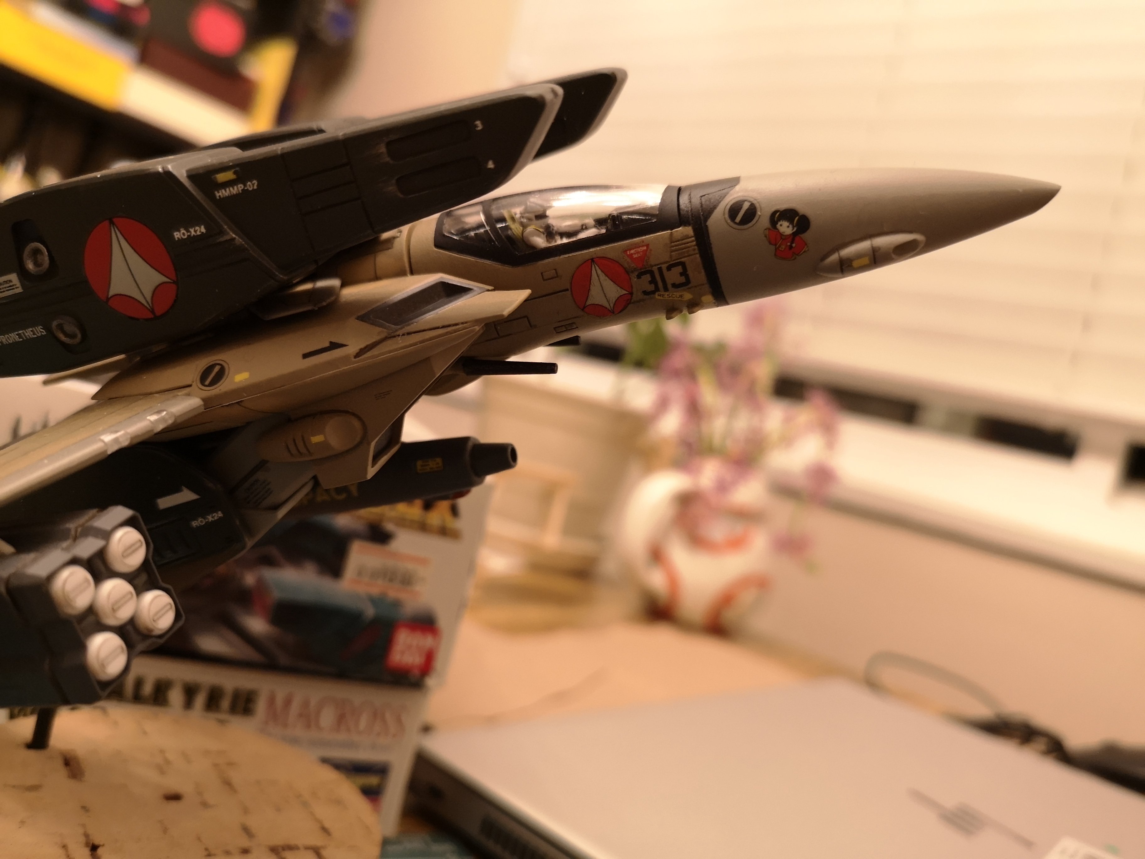

I got Tamiya glue mixed up with Mr. mark Softer when I was doing decals for the Bandai and splashed a bunch of glue all over the nose decals.  I was lucky the decal had already set and the matte coat hid the gloss from the glue so it's not that noticeable.
You can also see I sort of tried to fix Bandai's nose.  I've seen at least one example of someone resculpting the nose, but I wasn't brave enough to experiment.

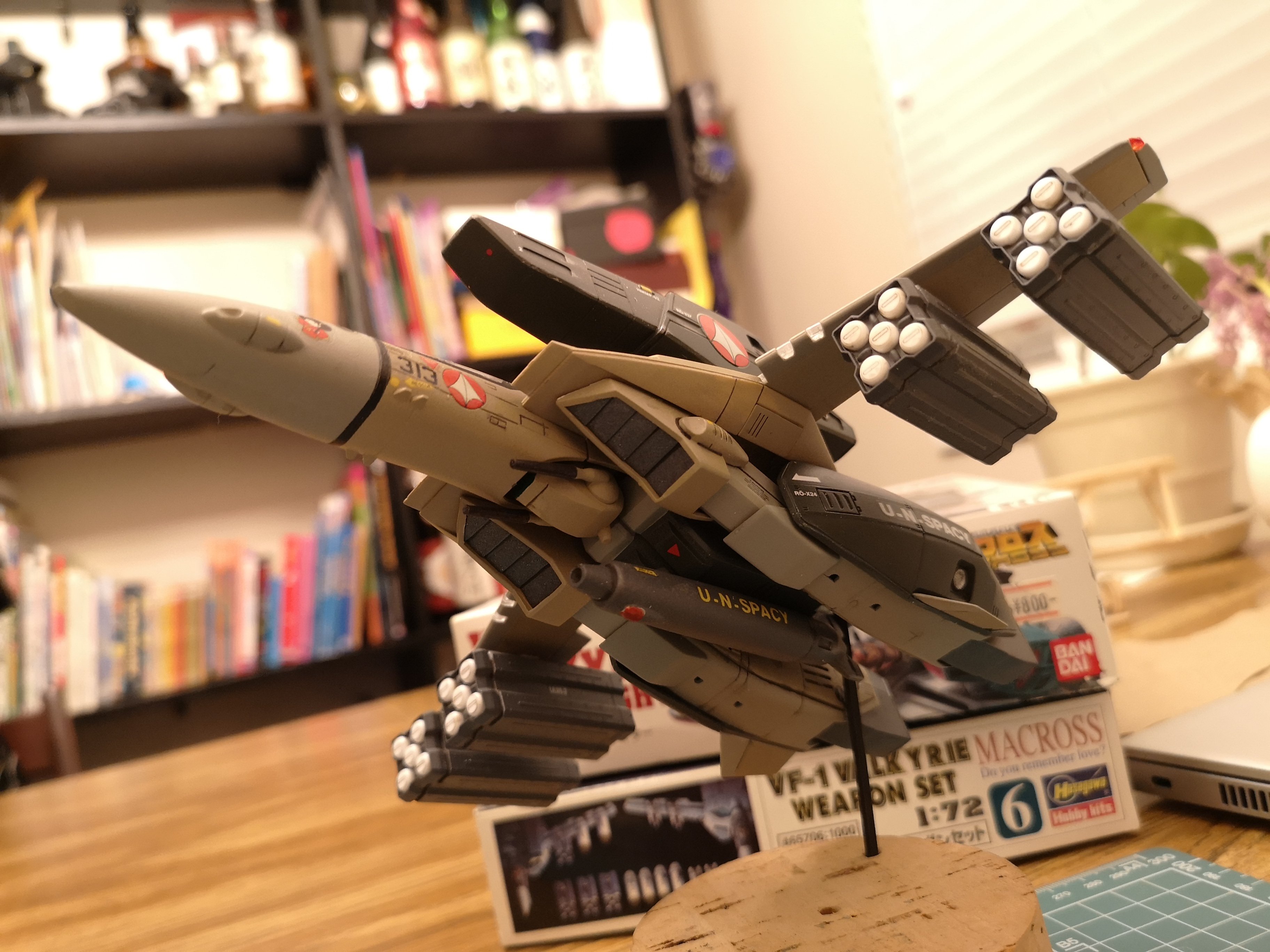

One more comment about the Bandai.  The kit came with almost enough parts to do a Super Gerwalk.  The only thing I could tell that was missing was the arm armor.
6 hours ago, Gabe Q said:
I agree about the nose on that thing. I hate it. Looks like you're doing a great job on the build tho!
You could always cut the nose end off and glue it on upside down. :p
Seriously though: yeah, the nose is just misshapen to all heck. I'd resculpt it or something.
I ran into that as well on my project: I ended up using a couple of pieces of very light wood and just cutting them to the proportions I needed:

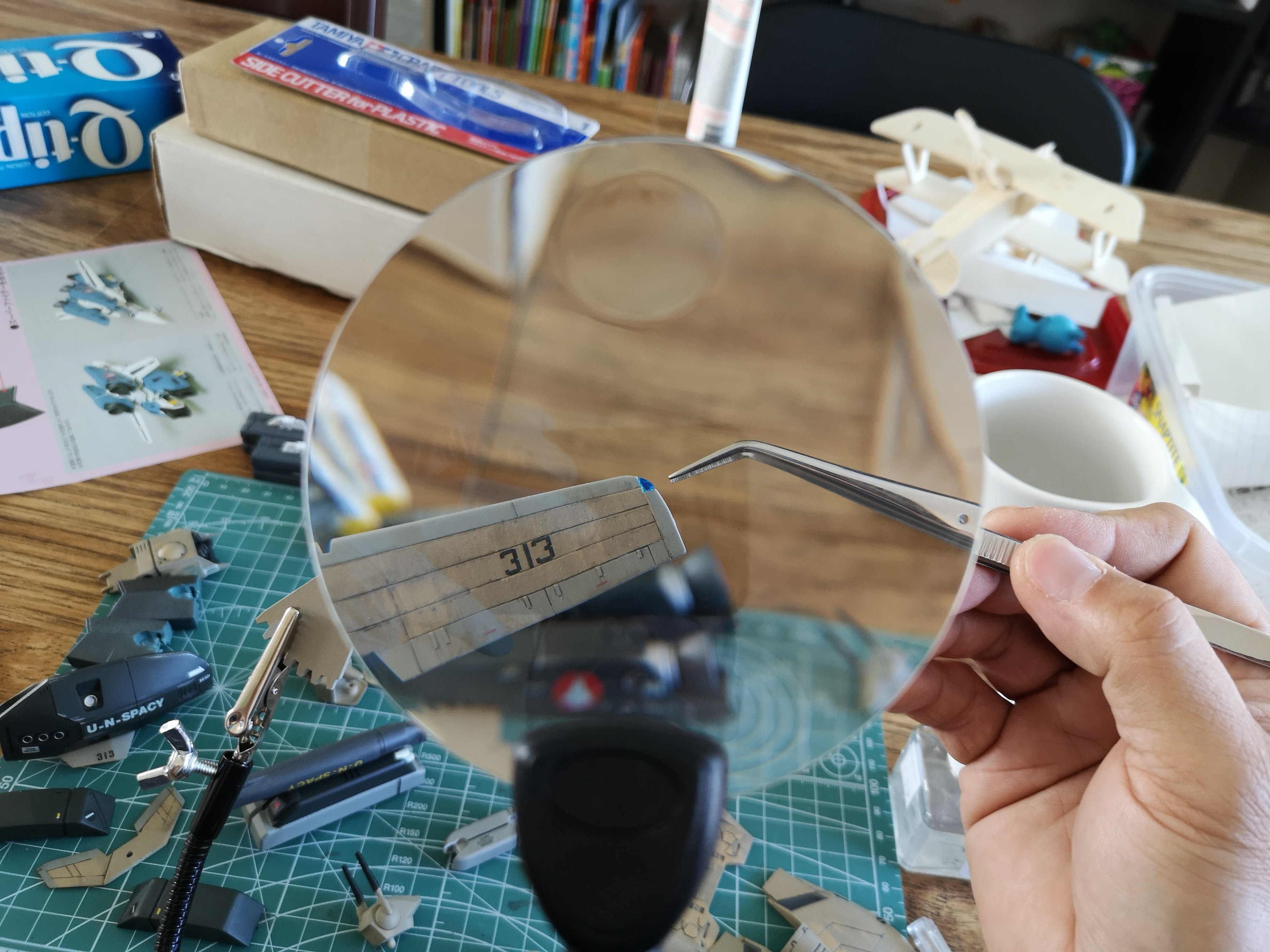

I thought I was done with pieces so small I could barely see.....
While I'm waiting for my Bandai super cannon fodder to dry, I'm sitting here wondering how feasible it would be to fit the GM Sniper (I don't even watch Gundam) inside of the Bandai 1/100 Super Battroid......IMG_20200705_222115.jpg.7f6257d90180079390033c4fcdd22791.jpg

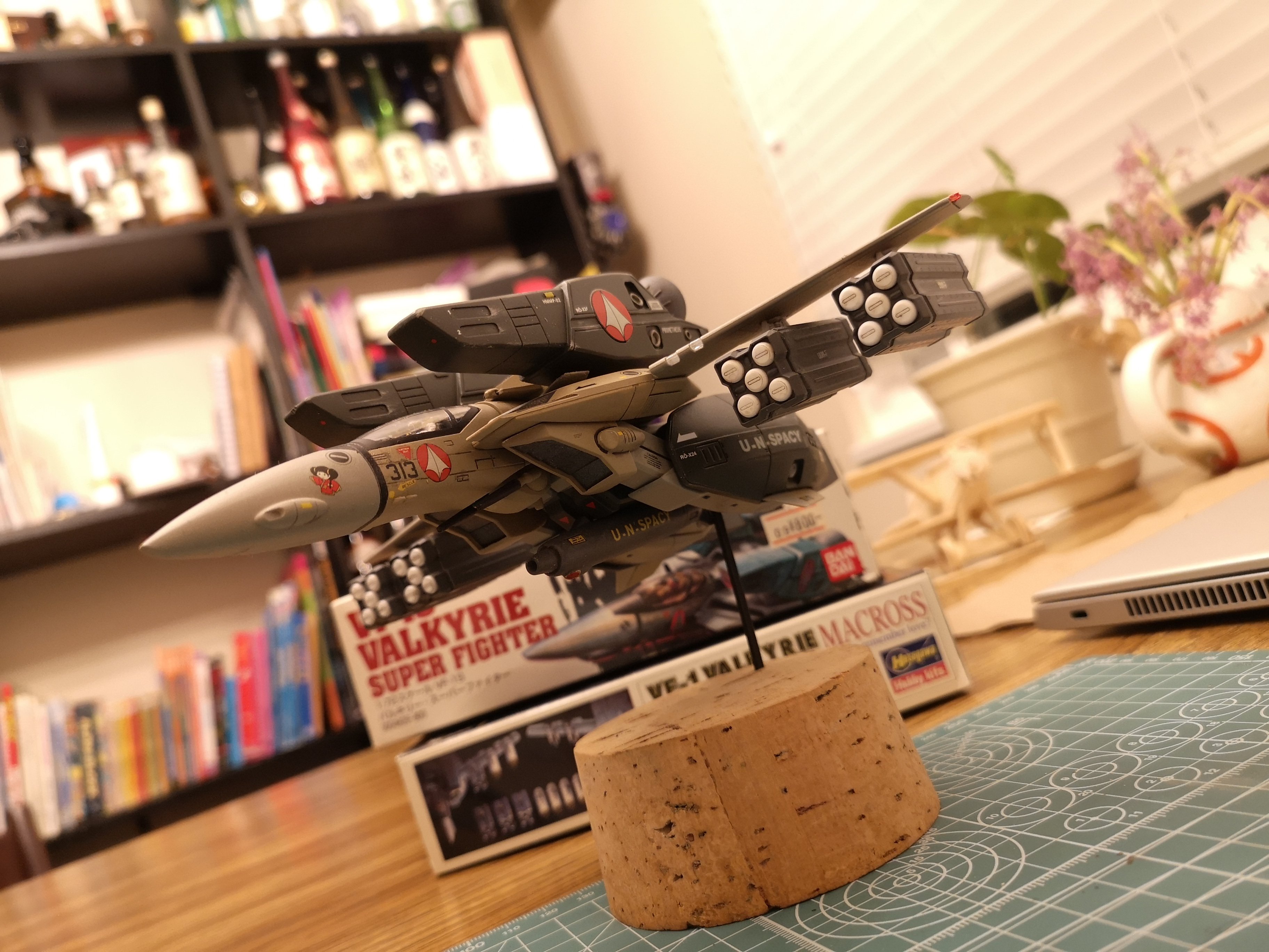

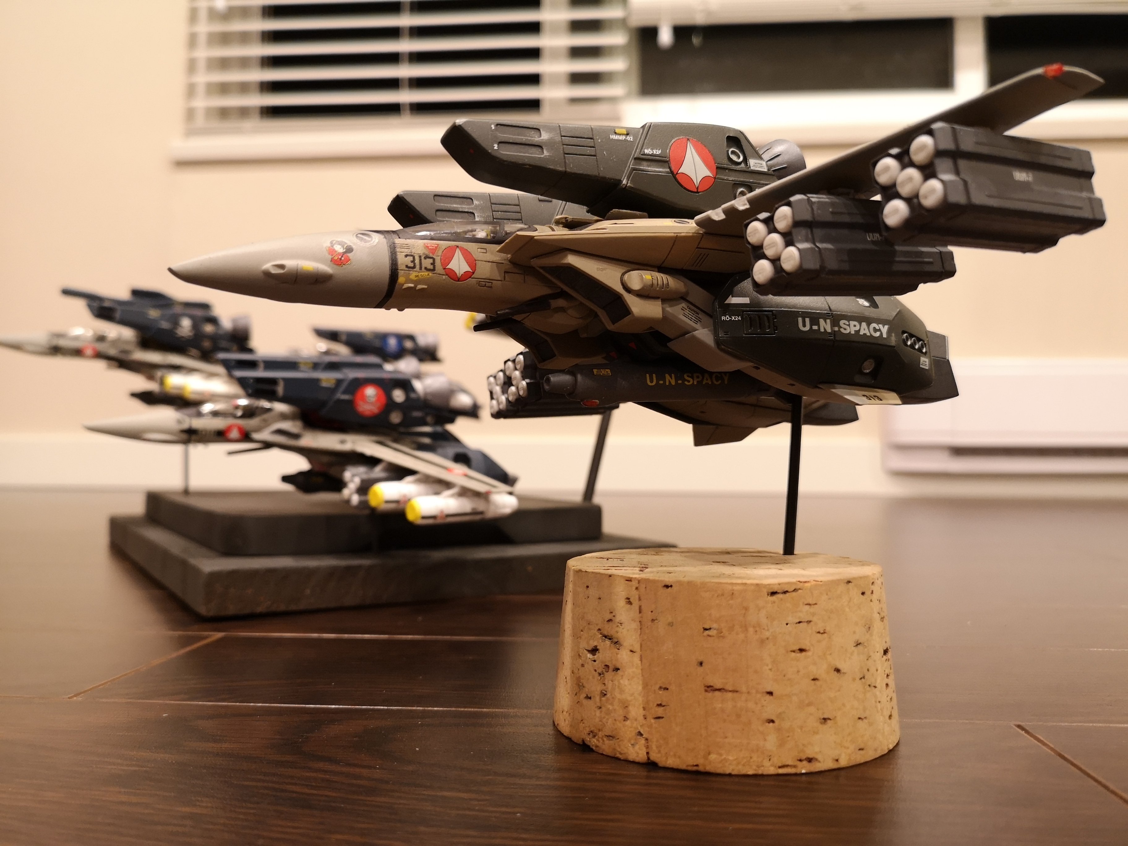

Bandai 1/72 Valkyrie Super Fighter done.  I already built Roy's Strike in Hasegawa, and I stole the 1A head from this kit to complete the squadron, so I figures I'd do a brownie VF-1J.  I probably would have done a 1A if I had enough.
I didn't follow the paint and decal instructions that came with the kit, instead, I loosely followed my previous Hasegawa builds, which was loosely based off my Yamato 1/48 toys.  Threw on whatever leftover Hasegawa decals I could find that would sort of work.
Most of the decals that came with the kit look way too cartoonish.
Leftover weapons from previous builds.
Leftover DRYL pilot leftover from previous builds.
Sort of sanded the tip of the nose a bit....any more and I would have completely butchered this kit.

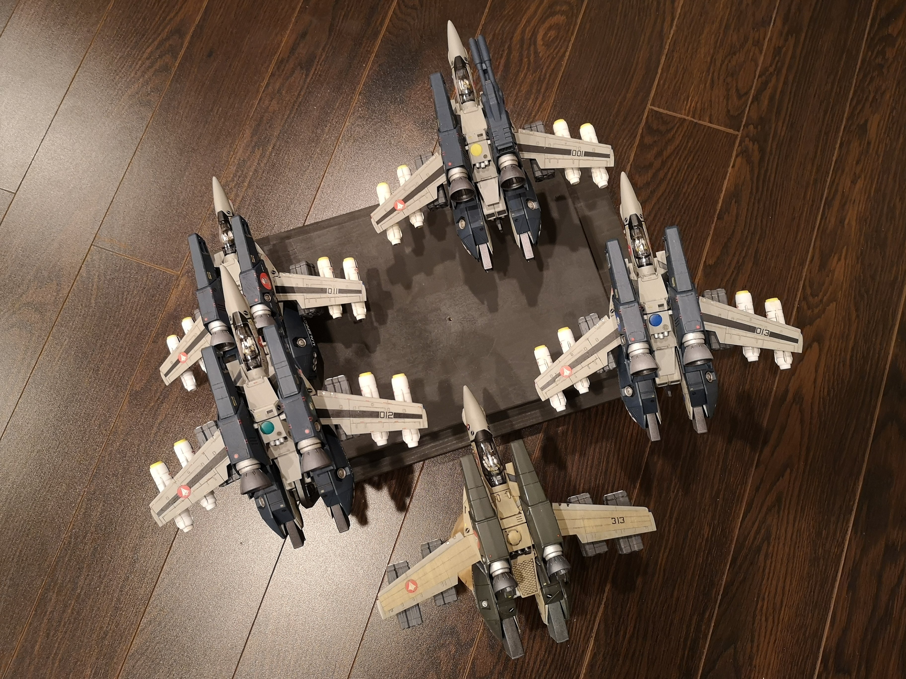

The Bandai kit wants to hang out with the coop Hasegawa kids.
I know this formation doesn't make any sense in the real world.  Photo is just for comparison between the Hasegawa and older Bandai.
