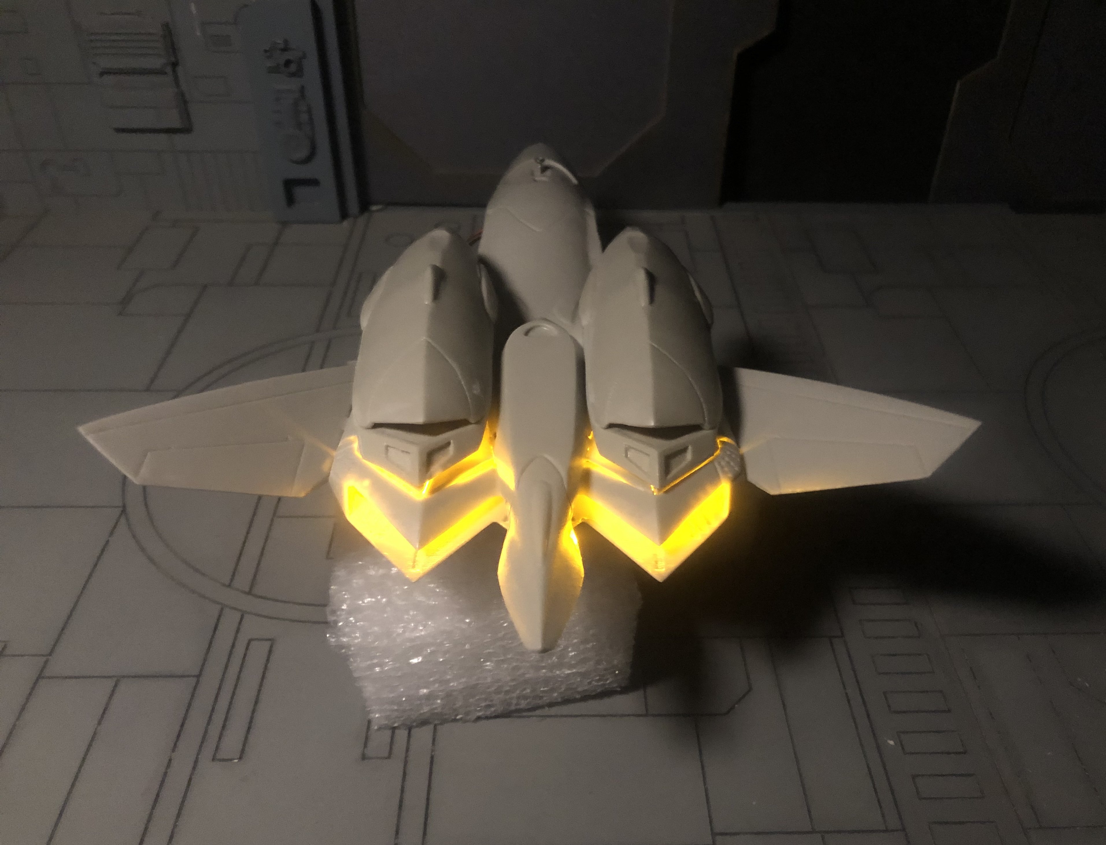

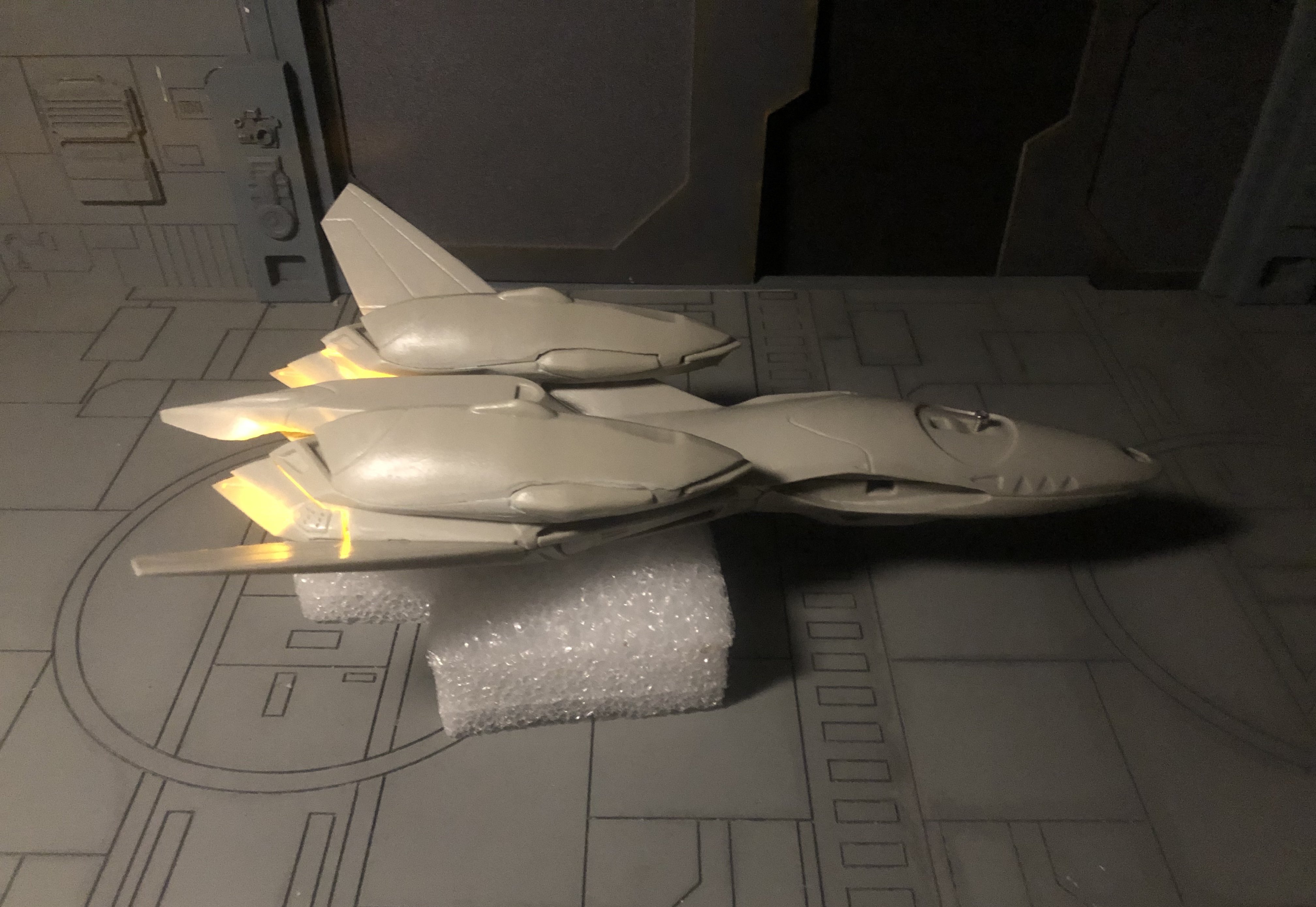

Did some more test lighting, decided to try yellow. With super parts on..1E1E07E3-ADDC-4EEC-B8AA-3F89A3E965A4.thumb.jpeg.8e96c19008ade1b3e8e7f217e50b66b9.jpeg4DF19967-104A-4F49-AA30-D5EE901CE832.thumb.jpeg.b92085f57d51a1a750ee173a300ef09f.jpeg

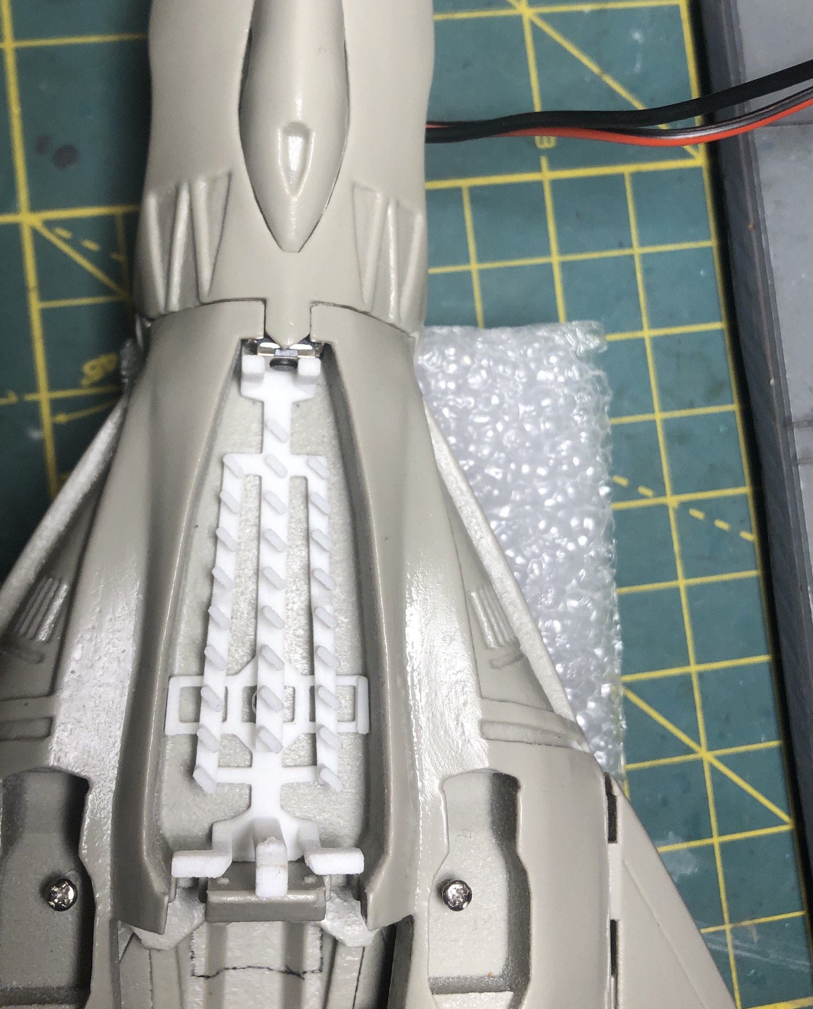

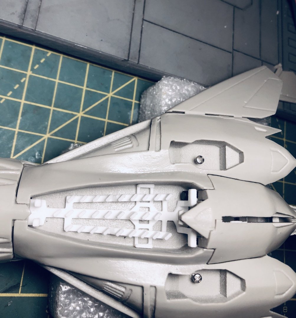

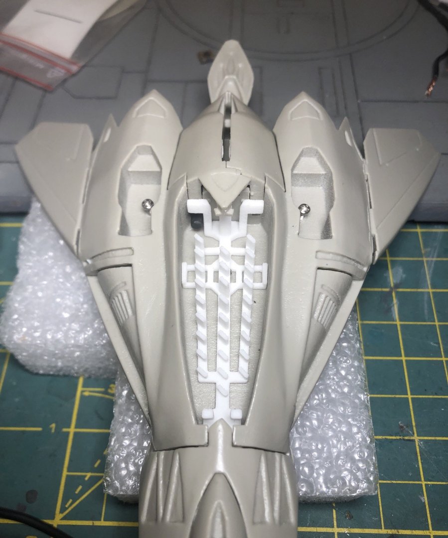

There's a few seams i would seal to better concentrate the light. And some seams I wouldn't, for that glowie Tron look:D Also worked out switch locations. I decided to use both switches. Powered separately. It actually saves room on wire runs to and fro..Yep, there's room. One switch for the eye and one switch for jets.  I've already worked out battery locations and will show those once I've fabricated the battery clips and installed them. But here's the switch locations mounted on either end of the underslung missile bay. Both are tucked neatly out of the way. Will be accessible with a small tool and won't be in the way of the mini HMMs. The mini switch located on the fore of the bay is for the eye and the switch aft is for the jets..
Fore (top center)A287A136-6D83-4F05-ADCC-036ED751549B.thumb.jpeg.fbf11179605de93316e1c4a609910280.jpeg62B6F670-7FD5-4BFB-BC53-0FEED7FC4D03.thumb.jpeg.c3285869b35d6e9dce037dfc680d81a6.jpeg
Aft (upper right/ upper left)-E78F1034-E086-4987-A849-740862BAEC88.thumb.jpeg.a9c338bae71597e149cf493b33f7d2df.jpeg4A58564C-C965-439C-8E4F-99C27DBB49CA.thumb.jpeg.20679a7461fbe5c347b8d0f3525b9e52.jpeg

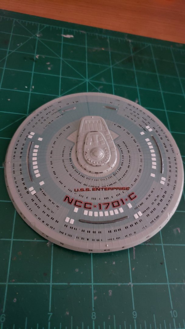

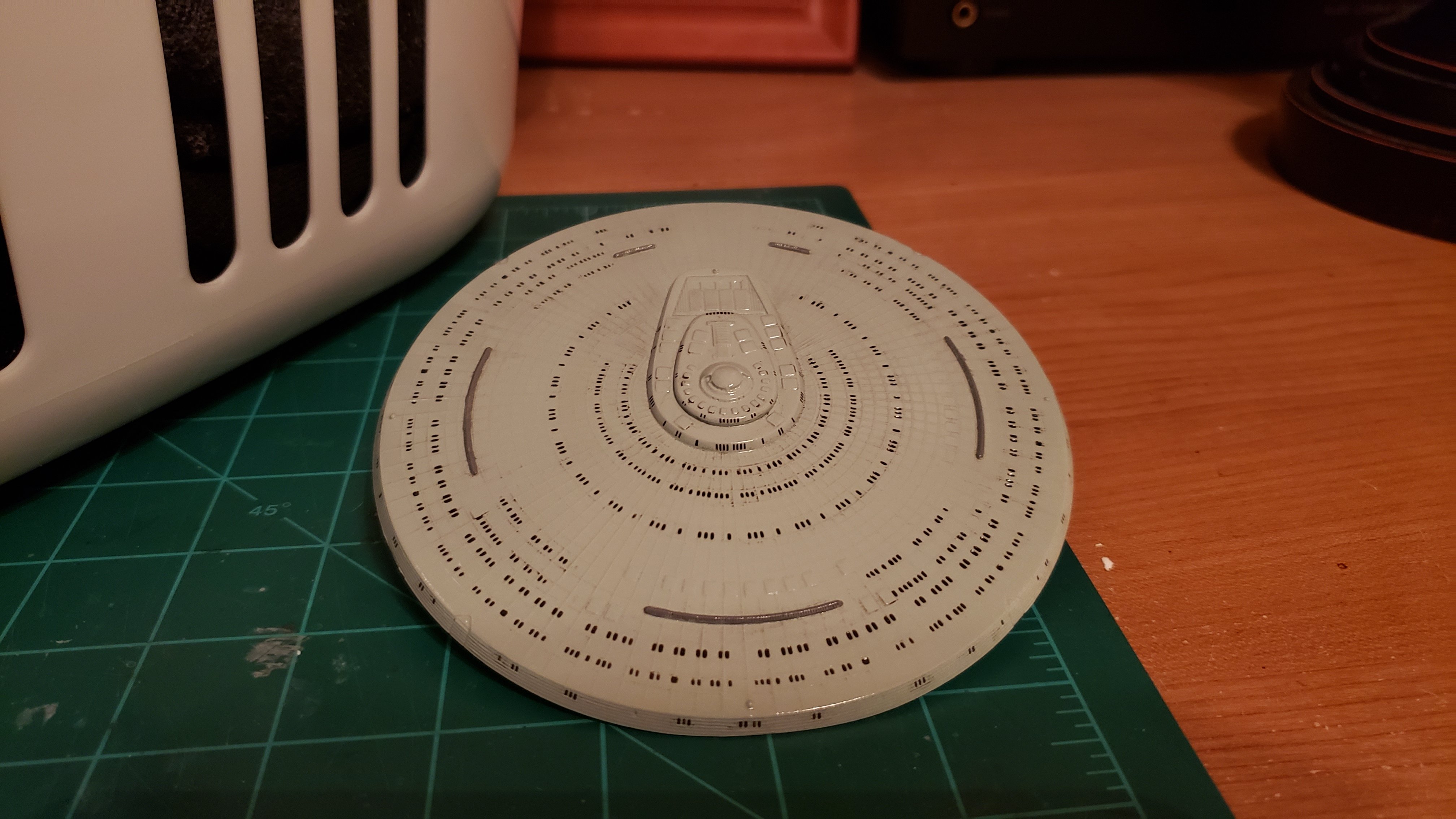

Honestly, that went better than I expected it to.... LOL. I cut the giant saucer sections up into 7 parts. Not perfect, few hairline cracks and microscopic wrinkles, but whatever. I ran out of Microsol so I guess I'll call it a day.
The YF-21 and Enterprise are looking great so far!

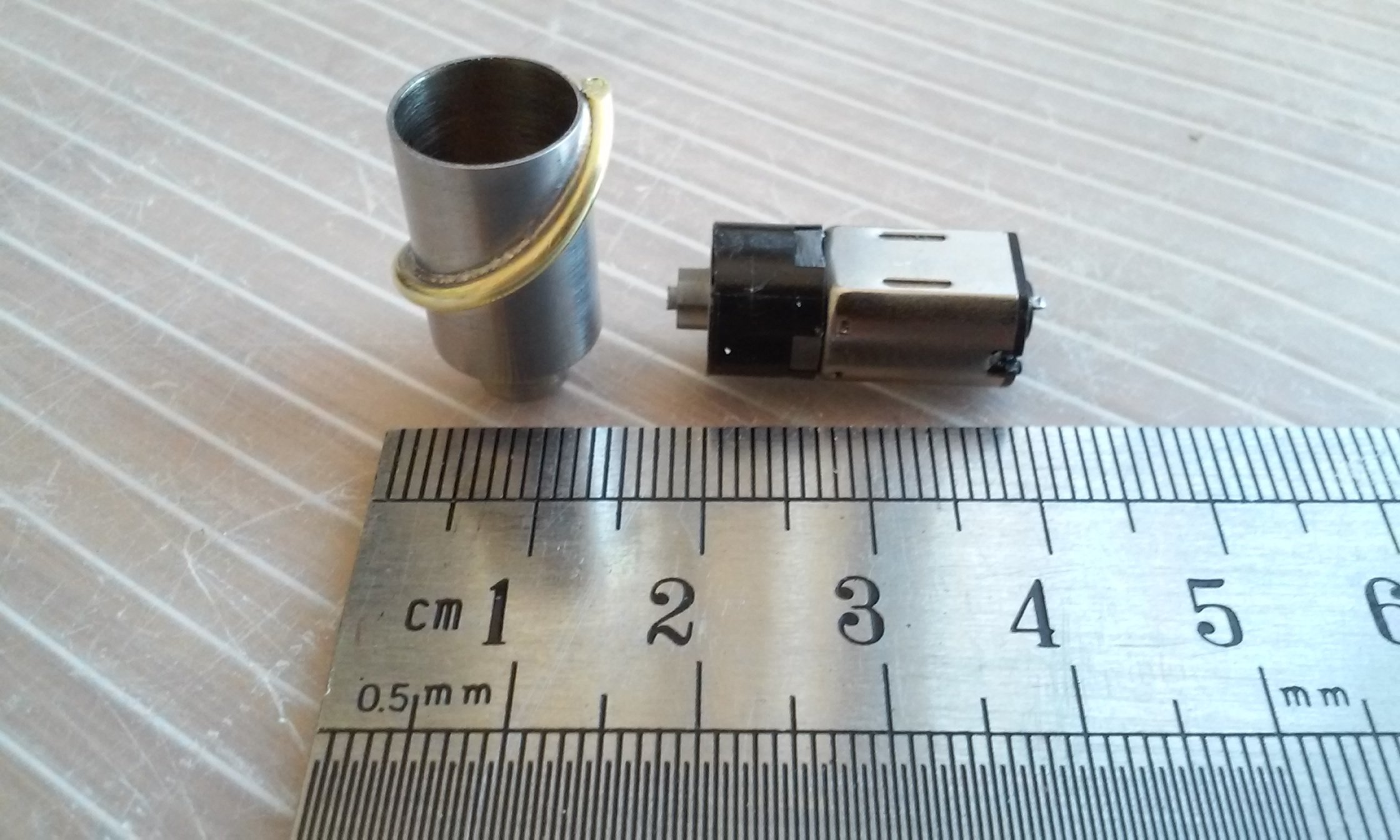

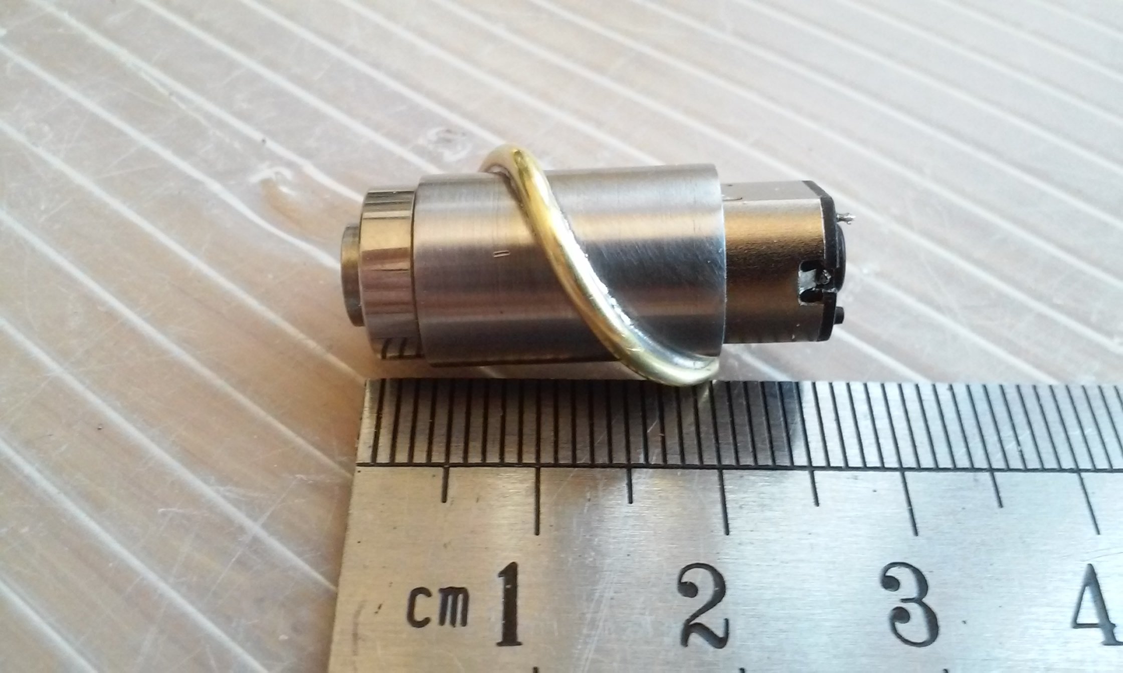

I was having trouble trying to fit the old cap gun mechanism into the turrets I built. Hopefully this is the start of one that WILL fit. So far this is a steel sleeve with a helix soldered around it. A bearing fits on the front to support it. The planetary motor fits into the sleeve for compactness. This mechanism drives the bolt forward and releases it on the cap gun. - MT

Mechtech, Interesting set up. I look forward to seeing it function.

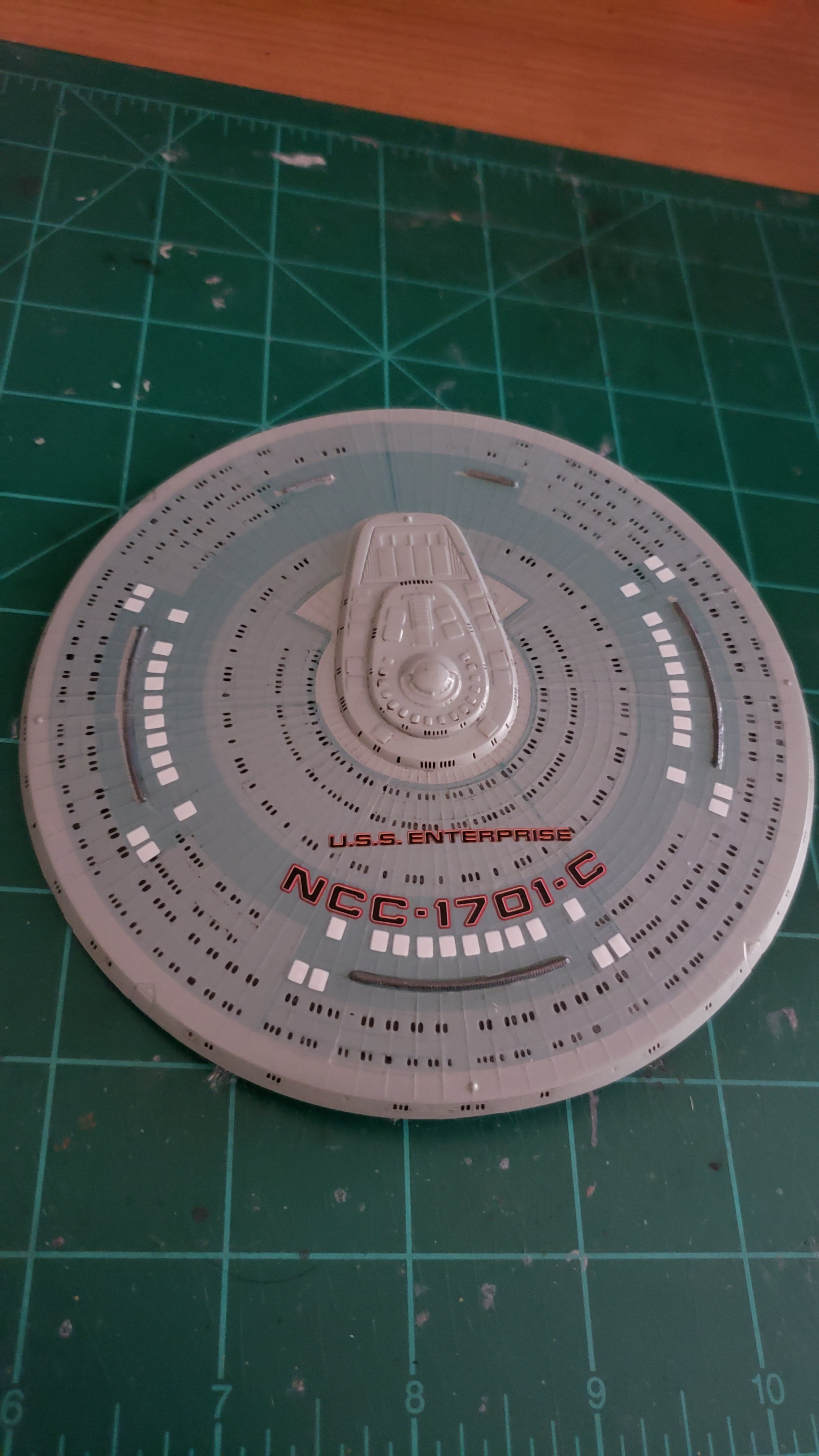

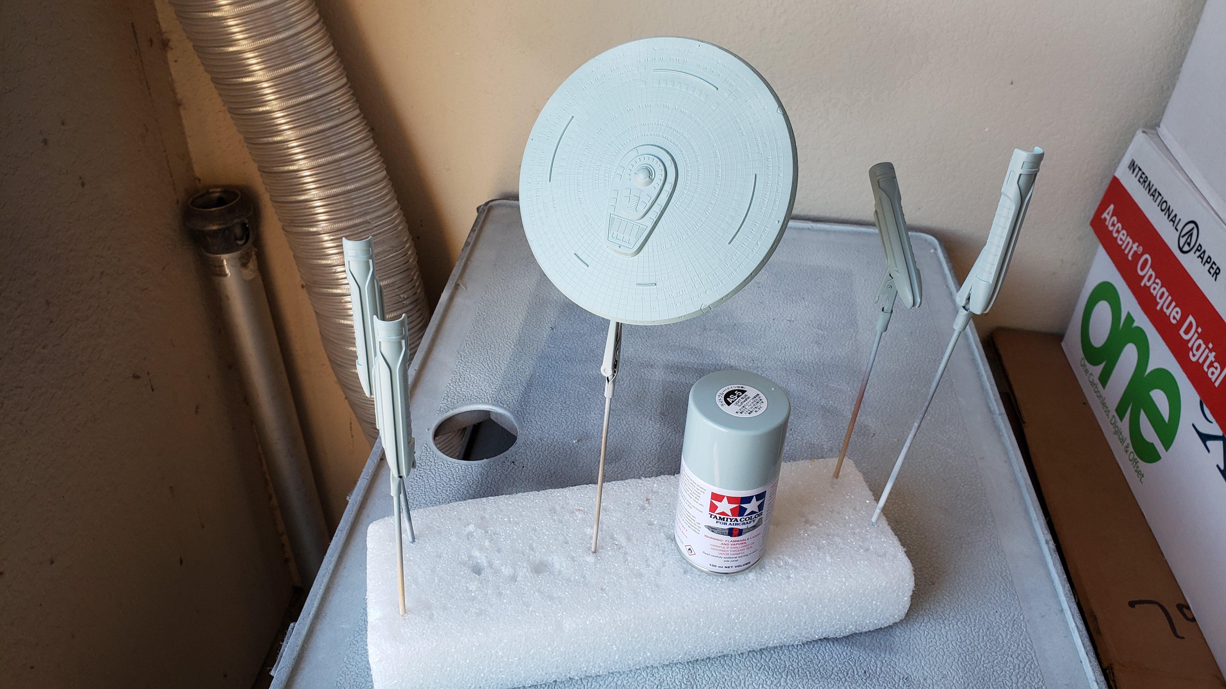

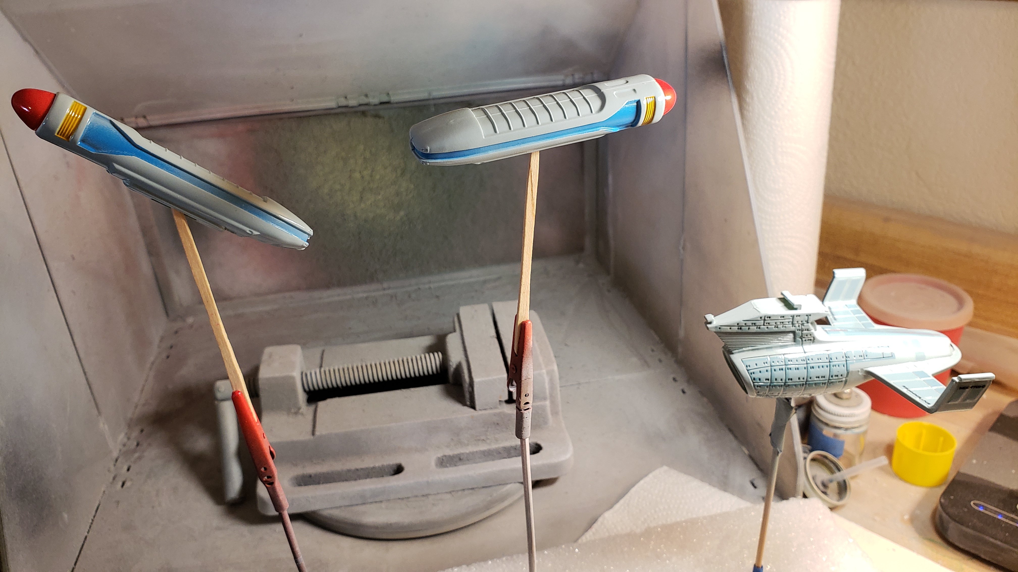

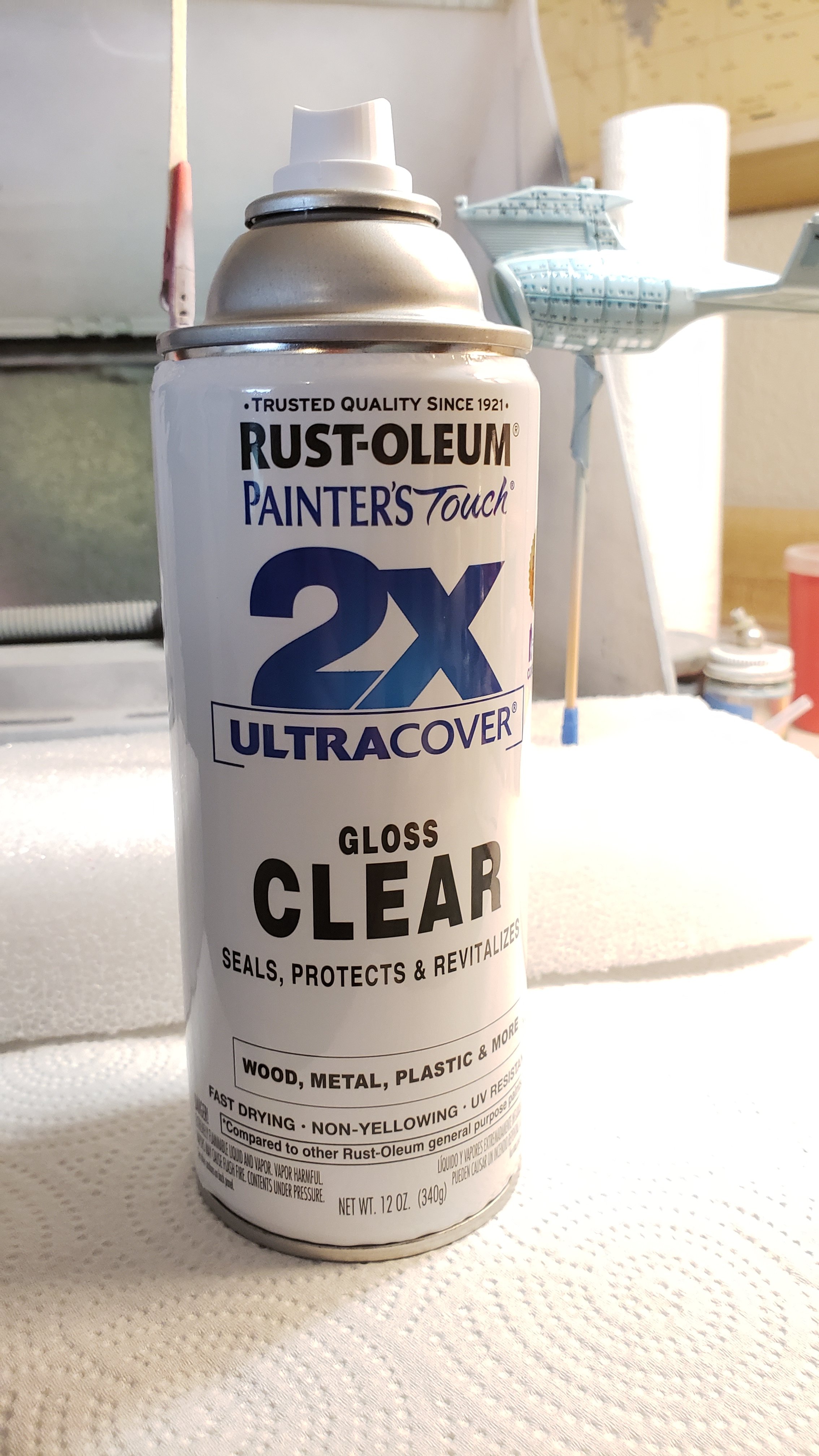

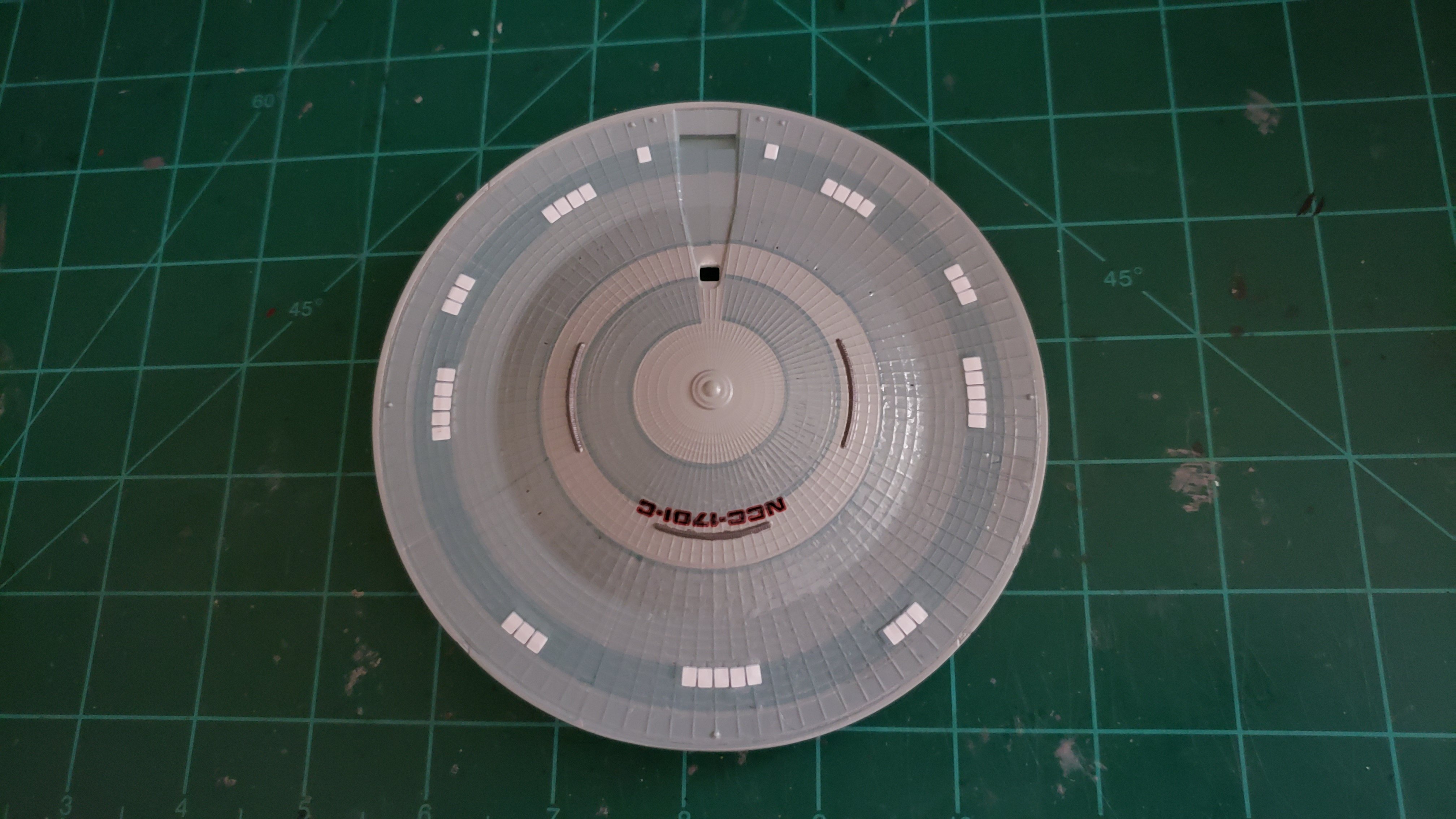

Looking good Thom. Over here decals are 100% done on the drive section, engines are painted and together and gloss coat is going on before I decal the engines later today. I switched to cheaper gloss coat from Home Depot instead of Tamiya... I just can't afford it anymore. Nothing bad to report so far.. Just gotta spray it carefully, it's much easier to lay down to much if you're not quick.
Interesting...last I checked, Rustoleum couldn't be used on plastic as it would craze and melt it. Now they have a version that can?
Pengbuzz, Rustoleum for metal is hot towards plastics. This stuff is great. I use the primer for most of my models.

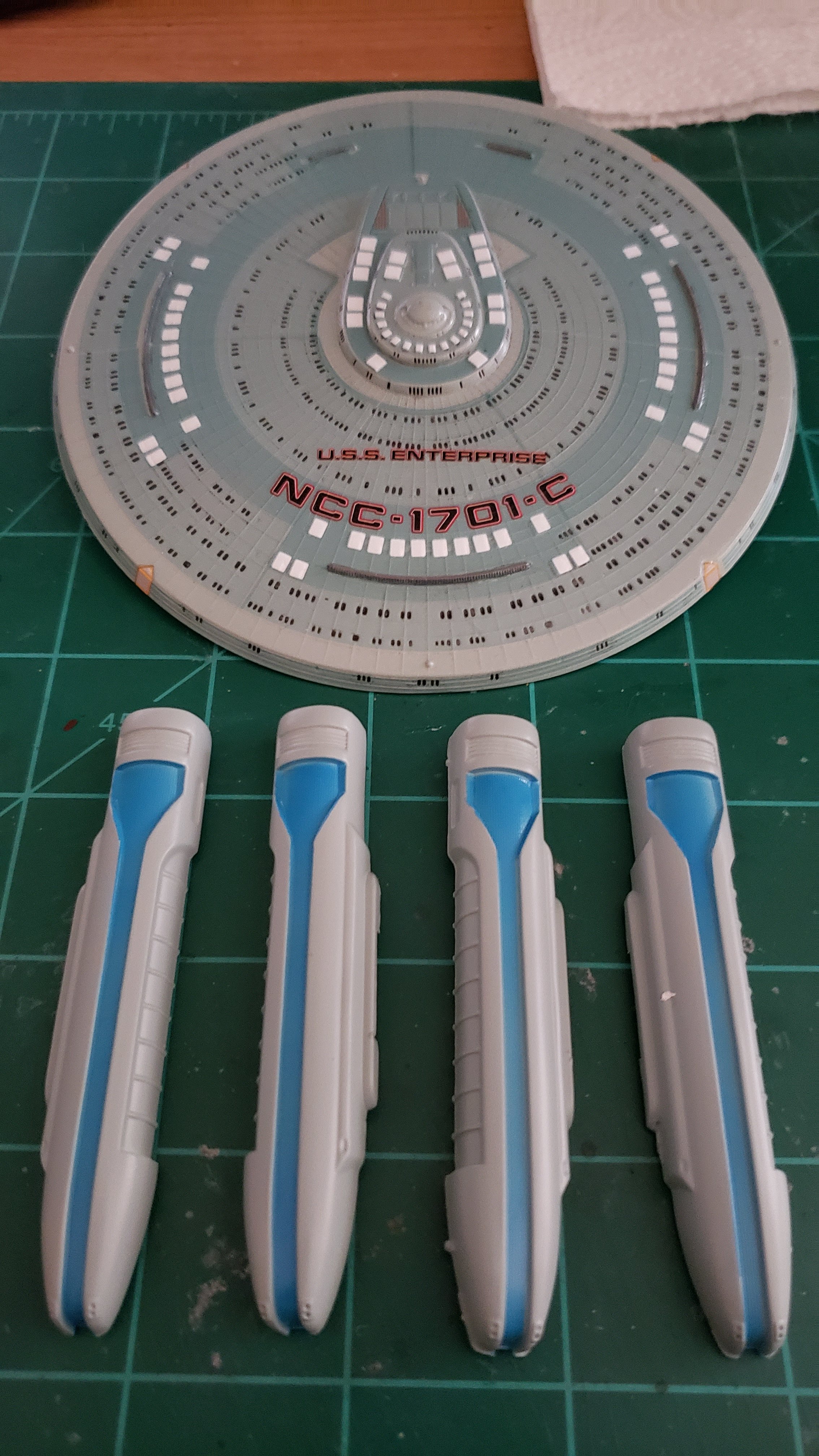

Well....as per usual, things were going a little toooo smoothly..LOL. I jinxed myself thinking "Oh, I'll be able to finish up the Ent C today!" Yeeeh.... right.  So I can't actually tell you what happened, but I think I need to press PAUSE on that new Home Depot Gloss clear coat over Tamiya Acrylics.  Lacquer Tamiya TS sprays aren't affected at all by it. However the blue for the warp nacelles was airbrushed Tamiya Acrylic Sky Blue.  After I brought it in from the garage I noticed it looked like I had lightly misted grey over the blue somehow. Now the blue was painted 7 days ago and not touched until today when I hit with the Gloss coat, so I'm assuming some kind of funky chemical reaction happened to the Tamiya Acrylic when the gloss coat was applied.  You can actually  see it in the picture above on the left one.  Anyways, ok, whatever, remask and respray the blue, no biggie. Did that, then went to decaling. No, I didn't seal the blue this time, because I didn't want a repeat of that. So the top engine decals were a little to big and the extra film folded down onto the blue Tamiya later in the afternoon and stuck down without me seeing it happen. UHHGGG. So now I've scraped off the excess decal and will now have to RE-MASK and RE-SPRAY the blue for the nacelles a 3RD EFFING TIME. But not today. I'm out. :help:.
P.S. The warp engine decals for the C are by far the hardest yet. Uhhgg... Hindsight being 20/20 I should have cut them into a million little itty bitty bits and trimmed them all to fit but for F*CKS sake, you don't KNOW that they aren't going to fit and lay down right until you have them on the fracking model and then it's to late!
