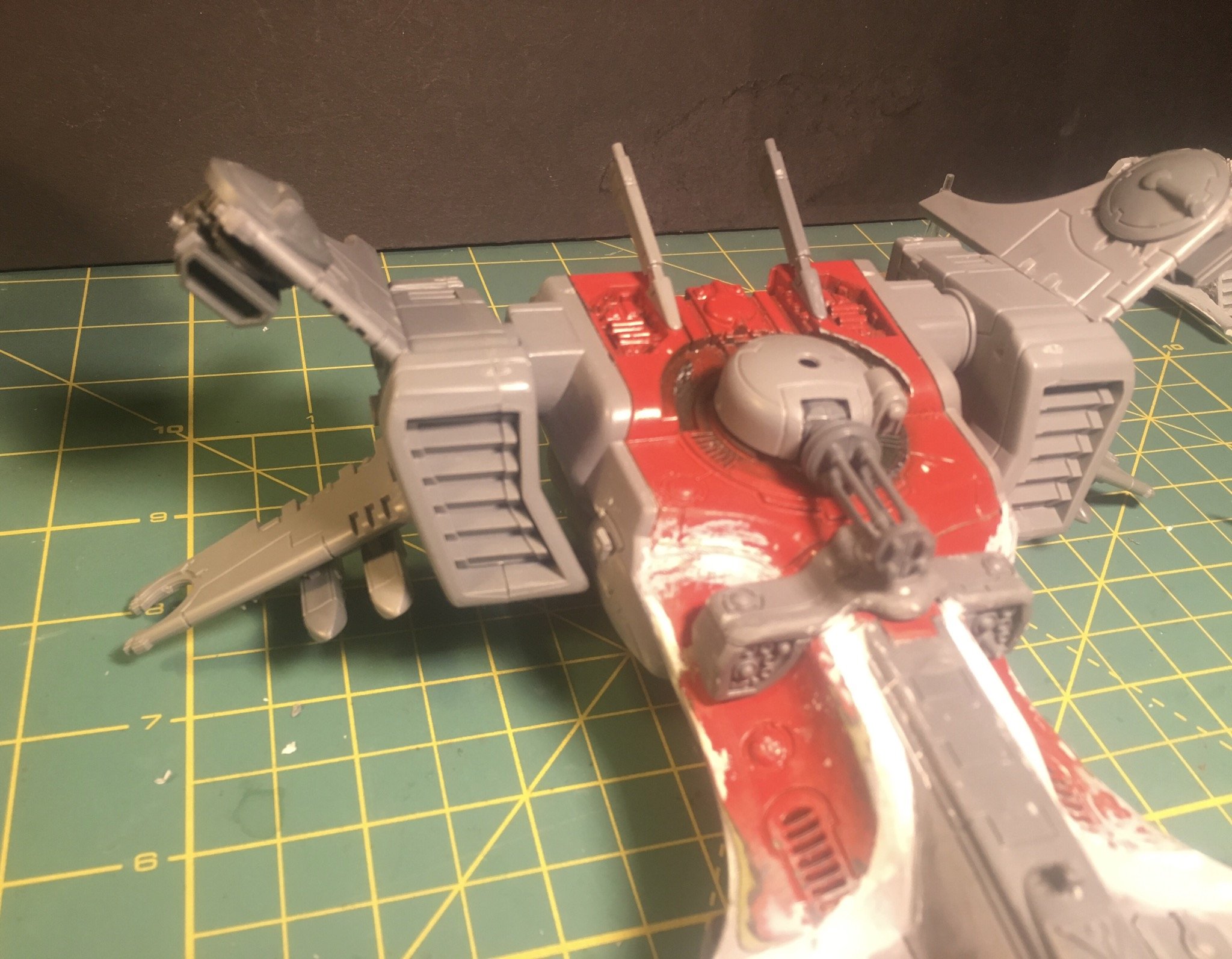

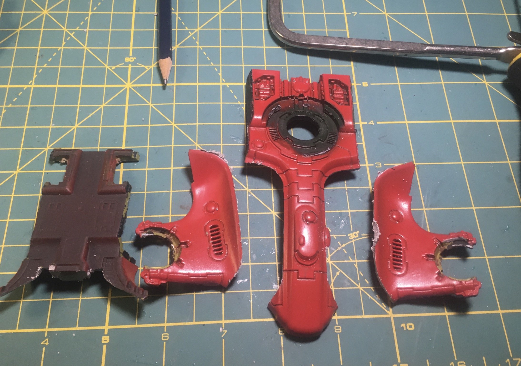

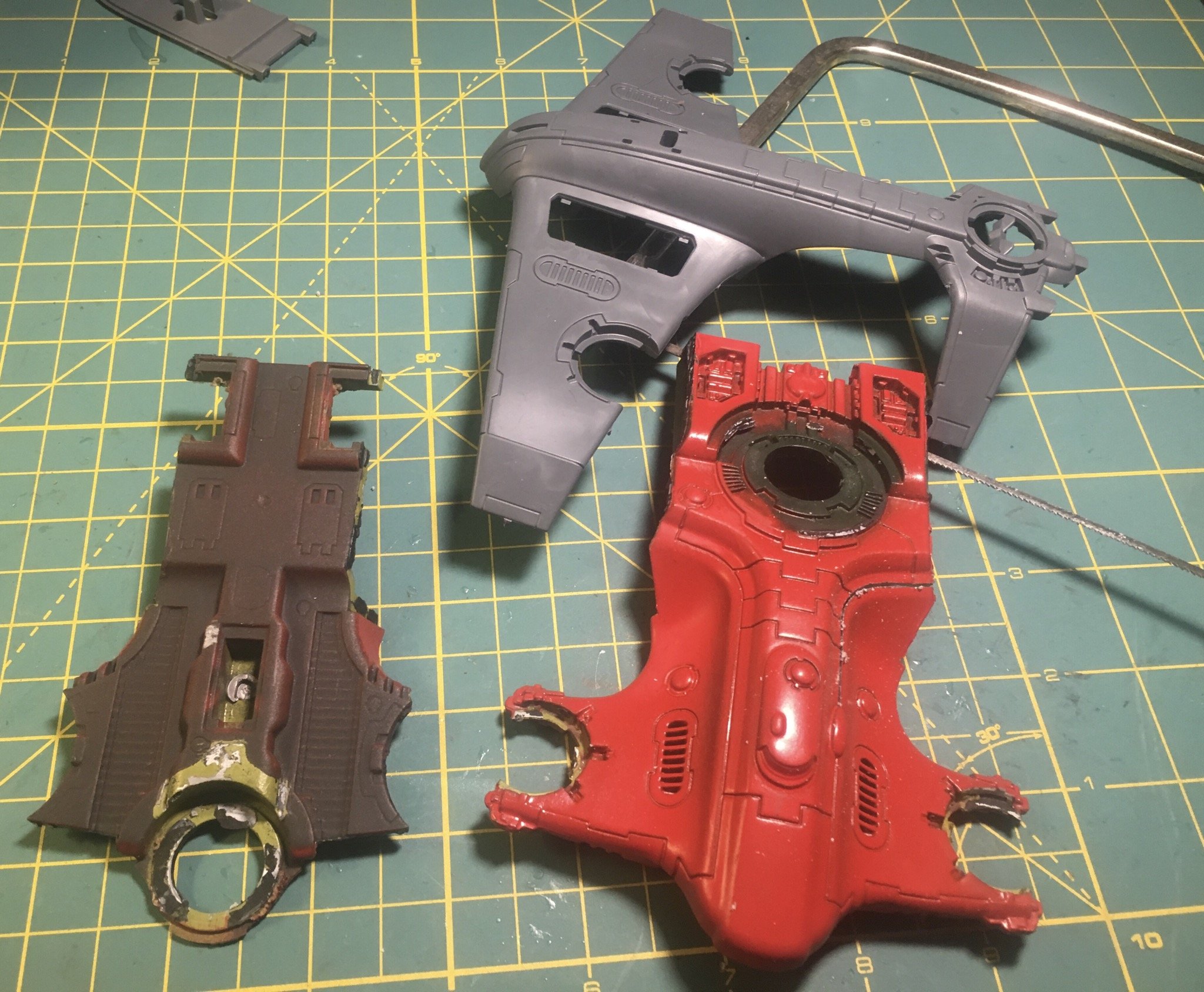

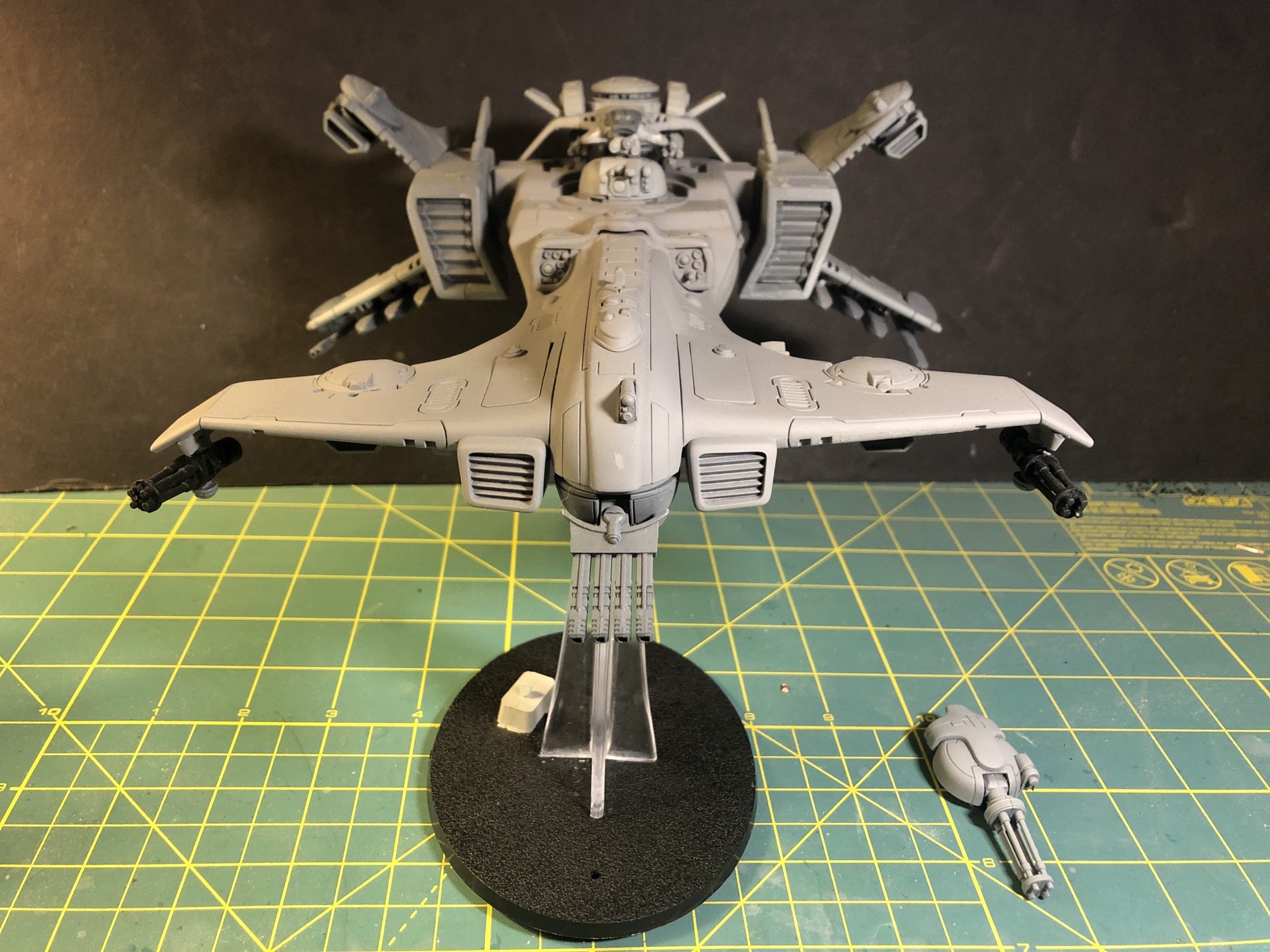

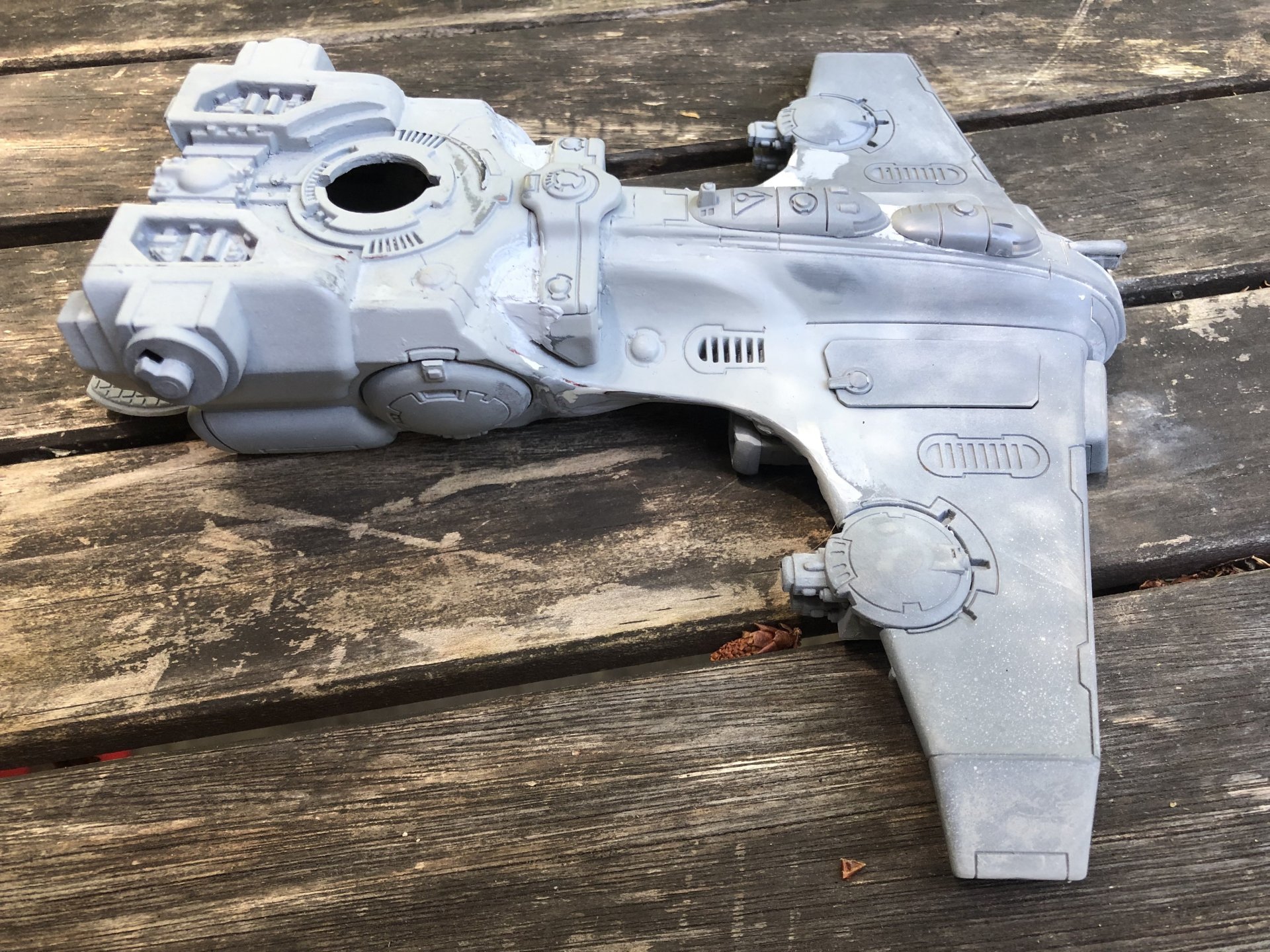

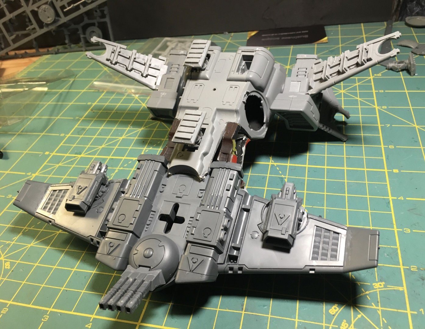

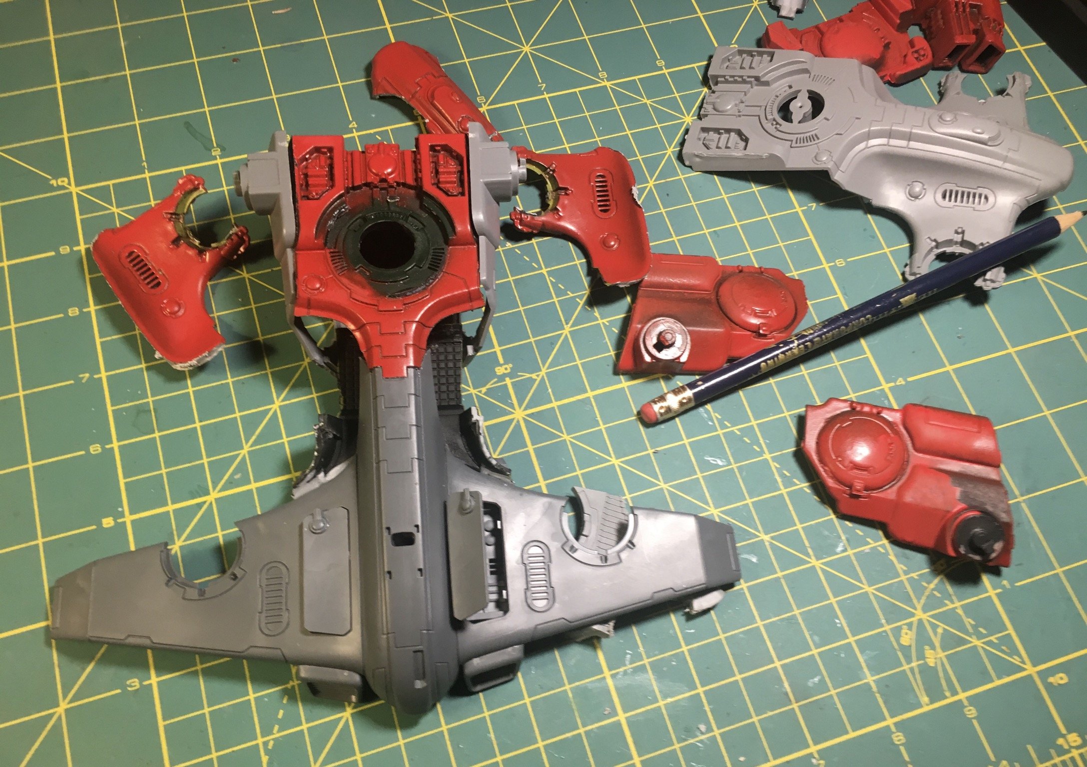

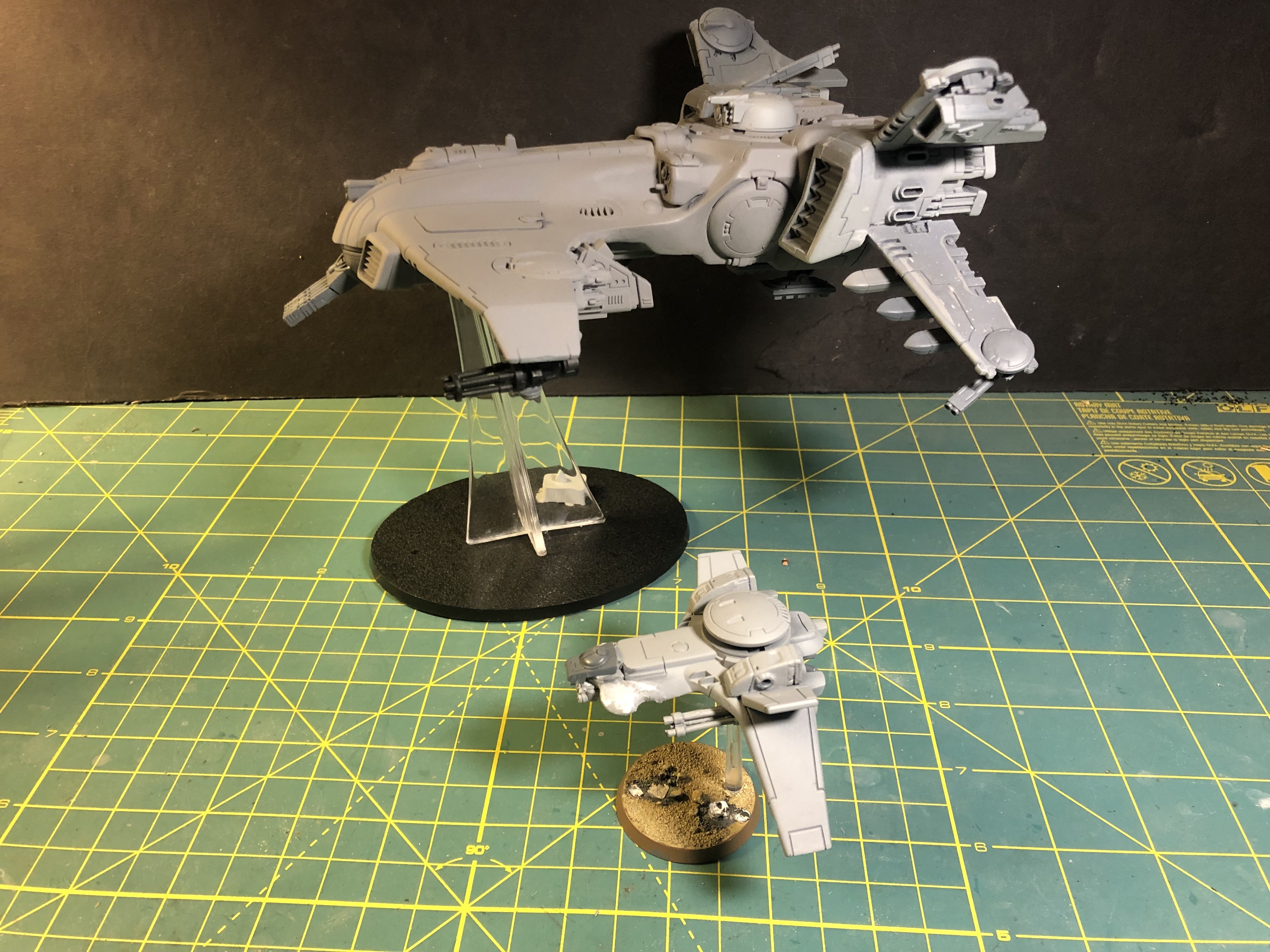

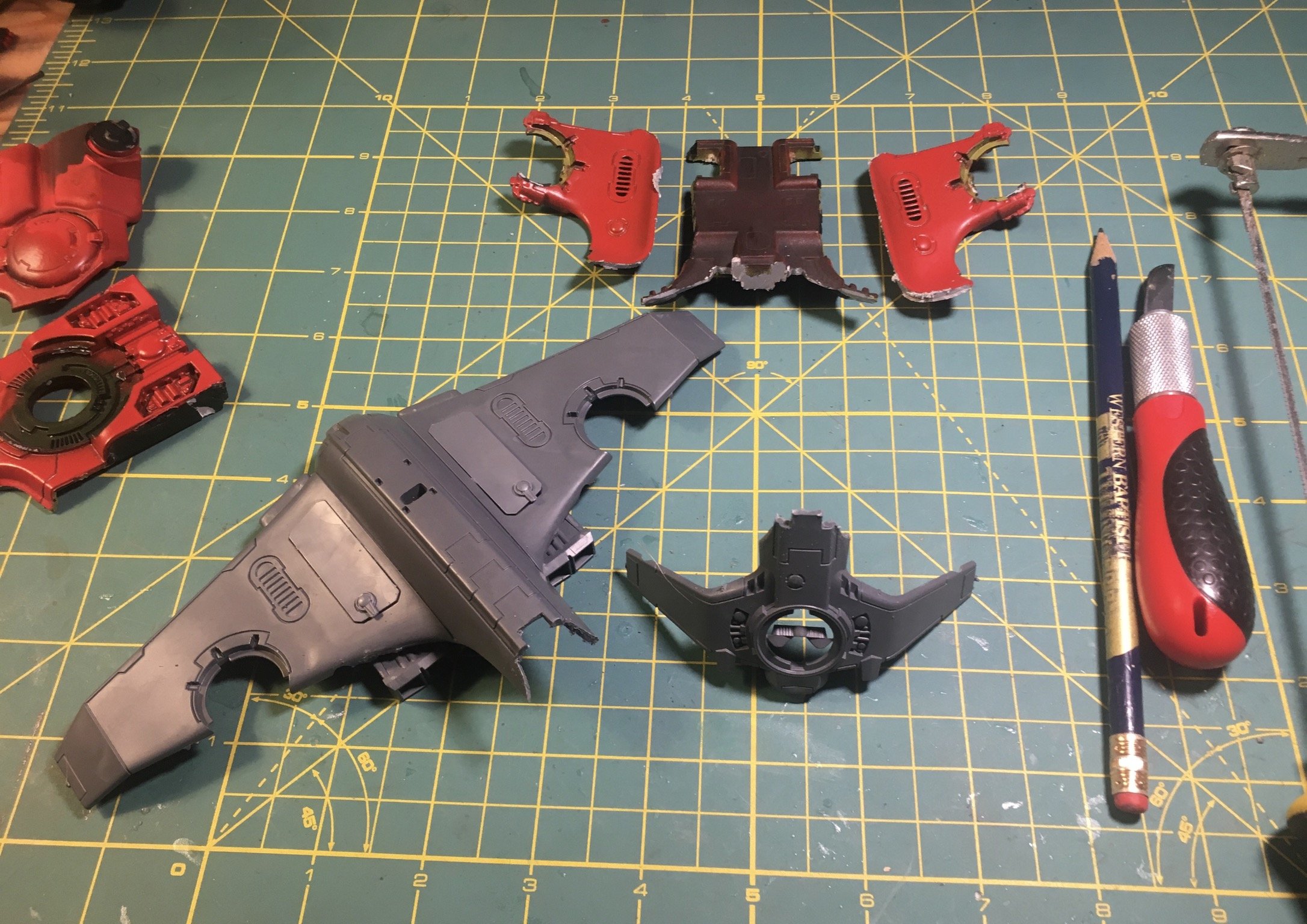

Bolt Posted July 14, 2019 Posted July 14, 2019 Thought I’d add this as I’ve taken a renewed interest in this project since I started it last December. It’s a custom conversion for my Tau ,Farsight enclave. In response to the Deathwatch Corvus Blackstar (which I love). For air superiority,It’s a fast attack drop ship . Heavily armed and intended to carry 6-9 elite jump troops. Basically I took a Tau Sunshark and a devilfish and hacked them together. Modified the main VTOL thrusters ,added more , fabricated turret mounts for multiple load out options. At some point, I had gravitated toward the “D” style cockpit with 2 pilots but the more I thought about it , the more I thought that was wrong. As the Tau employ a ton of AI in there war machines (and everything else) and they would design this to only need one pilot and let the fighter also run on AI. It also saves on space for the jump troops and extra features. changed the rear by adding a detachable AI Remora style drone I fabricated from the hacked tail end of the Sunshark. Also added smaller swing down VTOL to the front end to balance it out. Also added magnetize burst cannons for the wings, which I may switch out for the larger BC’s. Since the wings are magnetic, there will be many load out options, as well. still a WIP but it’s comong along.. Quote

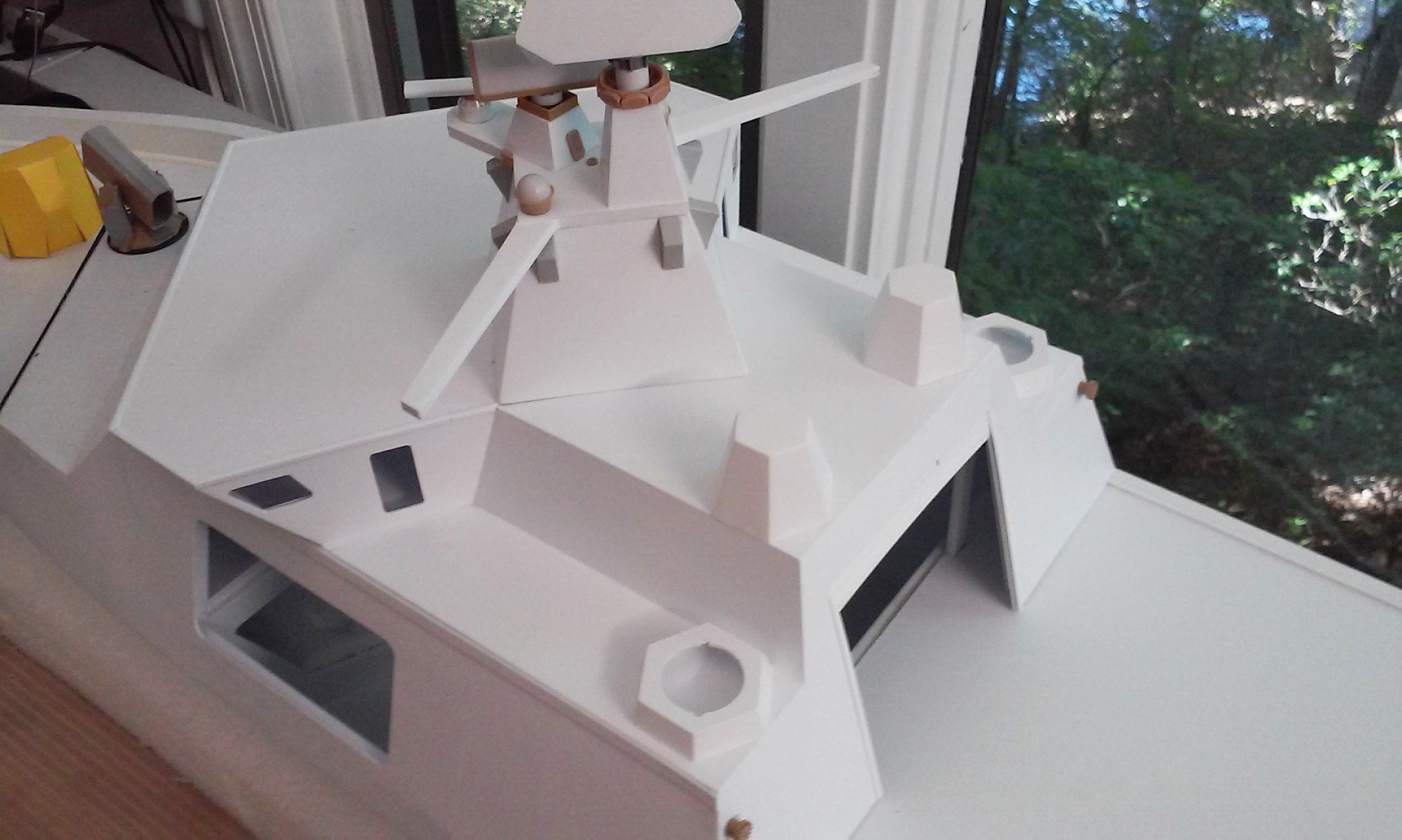

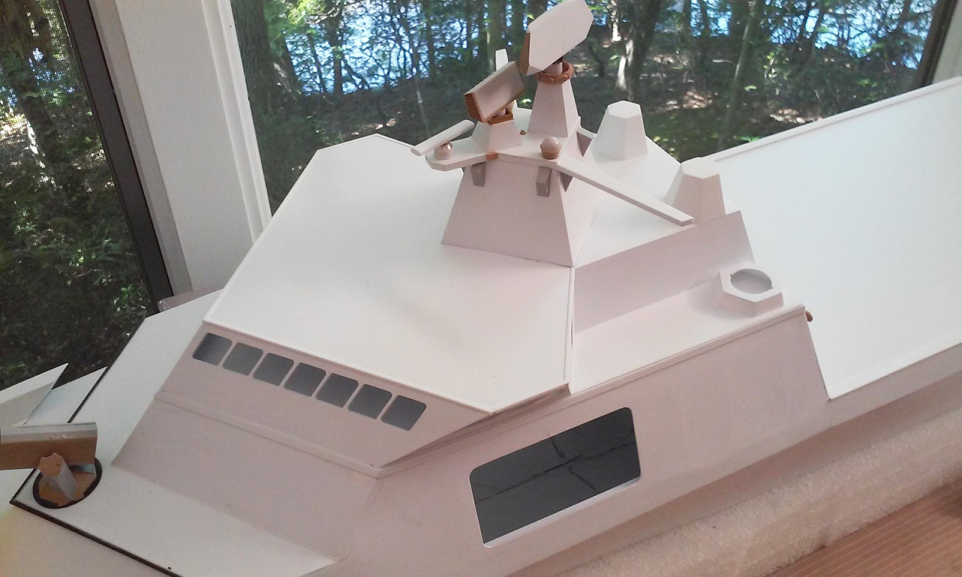

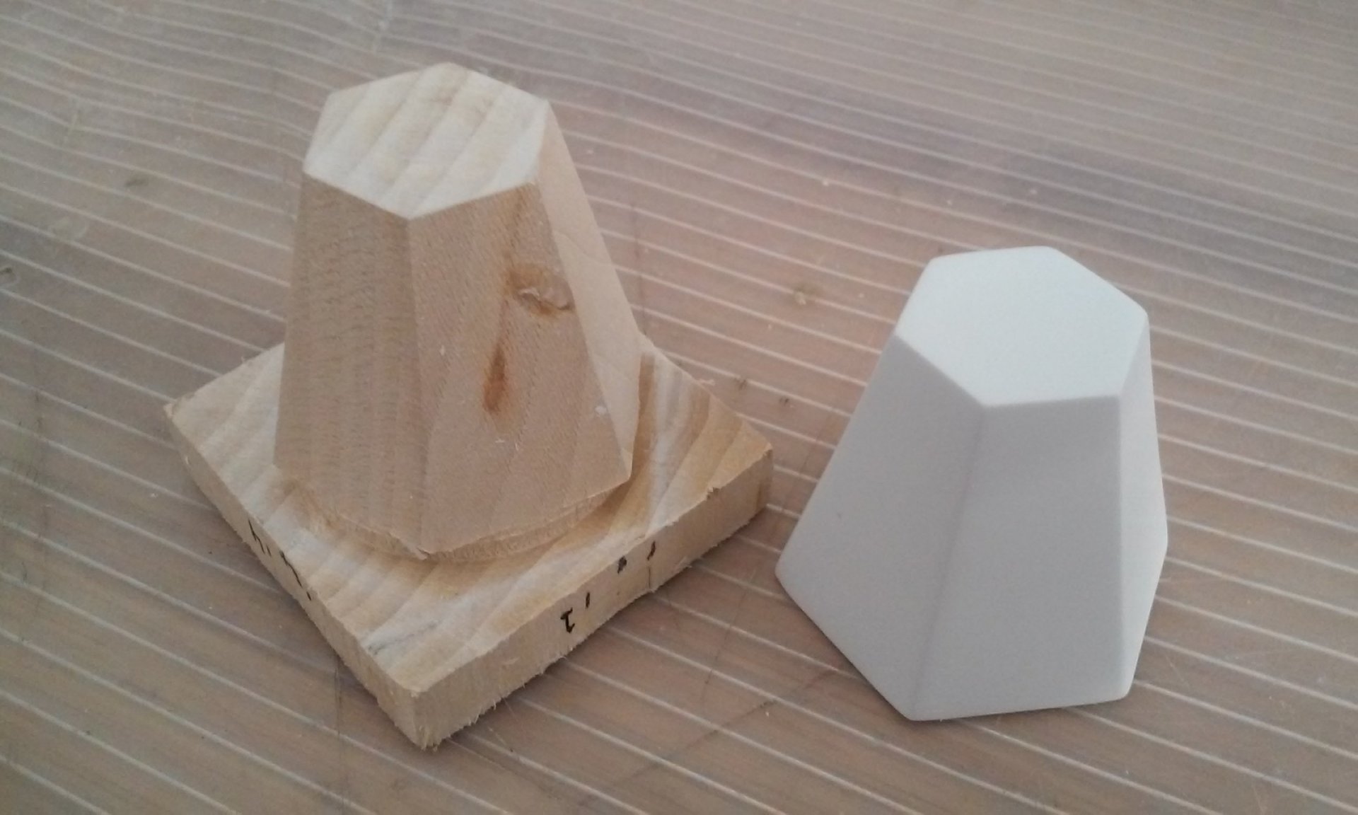

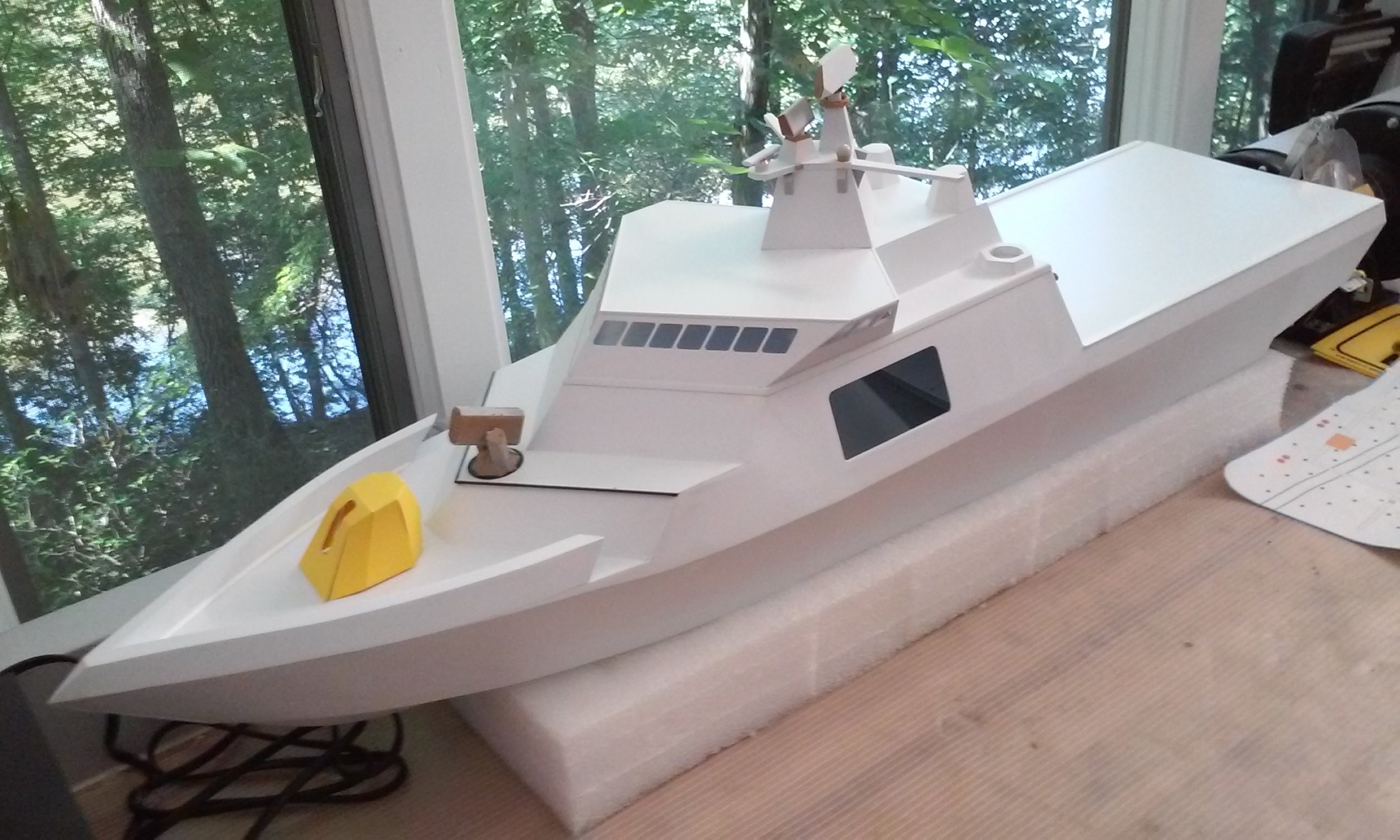

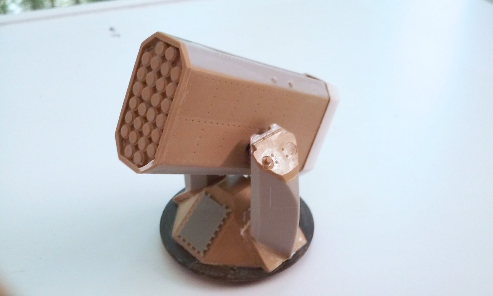

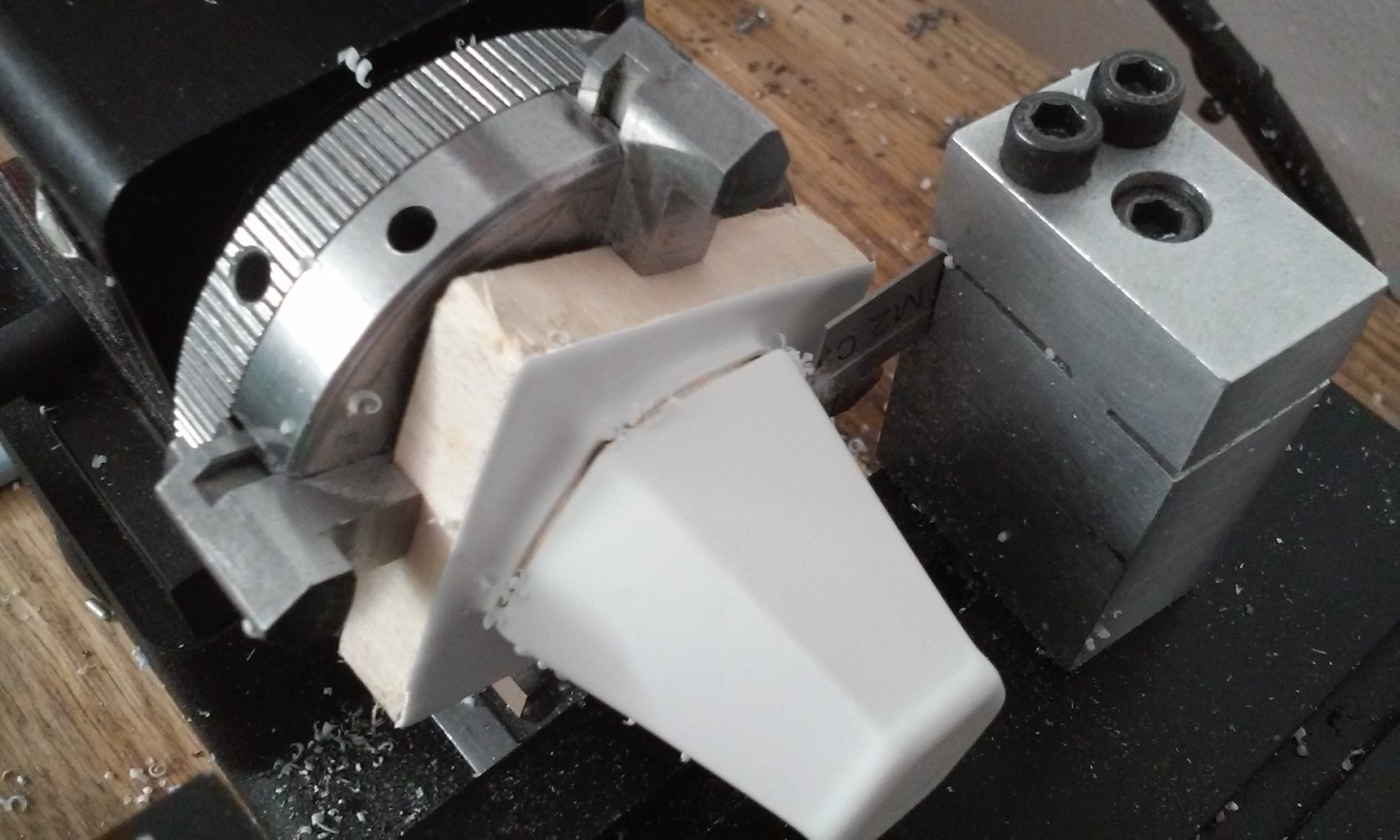

MechTech Posted July 14, 2019 Posted July 14, 2019 AWESOME Arbit!!! Once upon a time there was this guy asking about wiring up motors. Now you OWN IT man! You're Crushing that Crusher Joe fighter Electric Indigo! (Sorry, just had to pun it) That's cool Bolt! My son is thinking of getting some Tau stuff. Had a productive weekend! I machined a buck for both the SATCOM antennas and the bottom got cut off for the gun turret bases with a new top glued on for the turrets. I machined the buck on my mill in the same chuck that fits on my lathe. After each vacu-forming, I threw it on my lathe to cut the base off uniformly. It saves trying to sand a level base with flimsy plastic sides. The SATCOM antennas are above the hanger (not glued on yet) and the turret bases below it. Lost the small navigation radar antenna and had to make a new one. Also added small link antenna globes below the spinning radars (also covers screw holes). The radar tower comes off and the bridge roof hinges upward to open up. Covered all those seems with angles and other shaped styrene extrusions. The long strip going around the base of the bridge / top of the hanger covers the seem where that top piece also comes off to allow maintenance access. The yellow paper turret and missile turret are all still hypothetical and still under development. - MT Quote

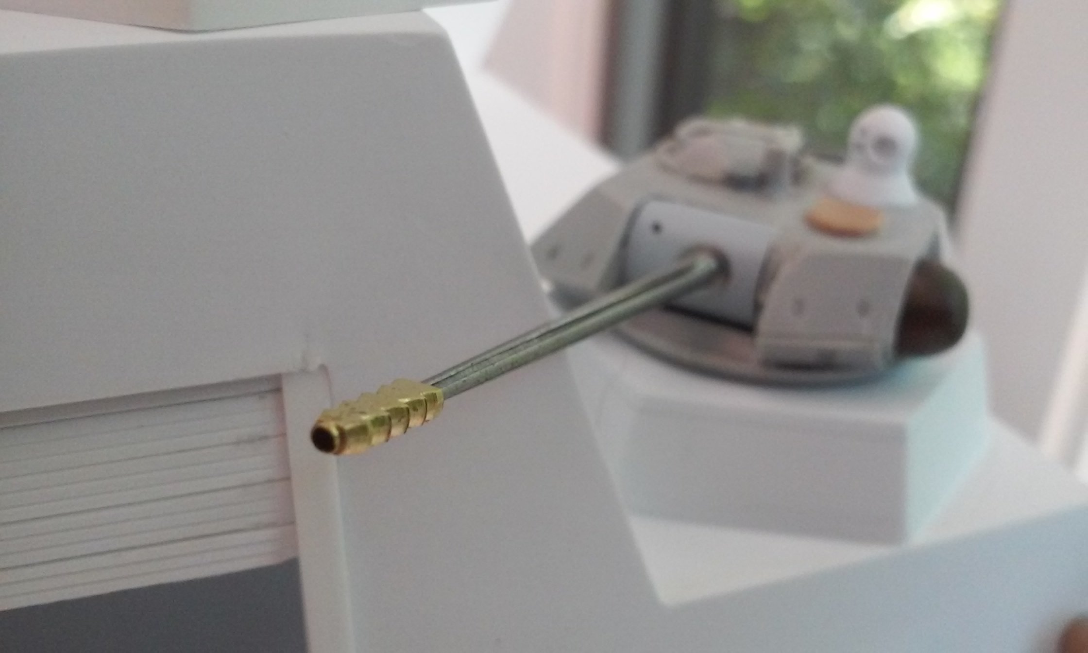

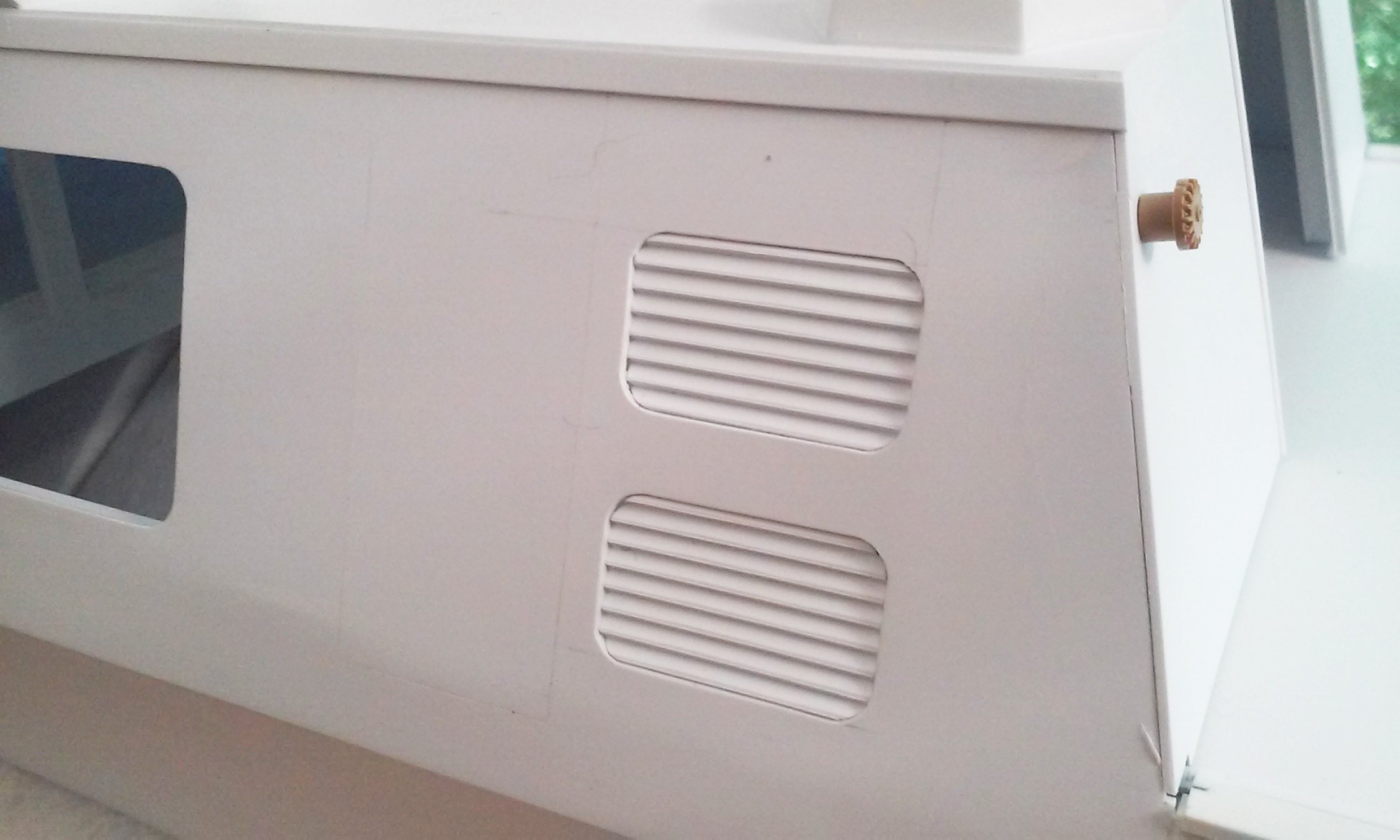

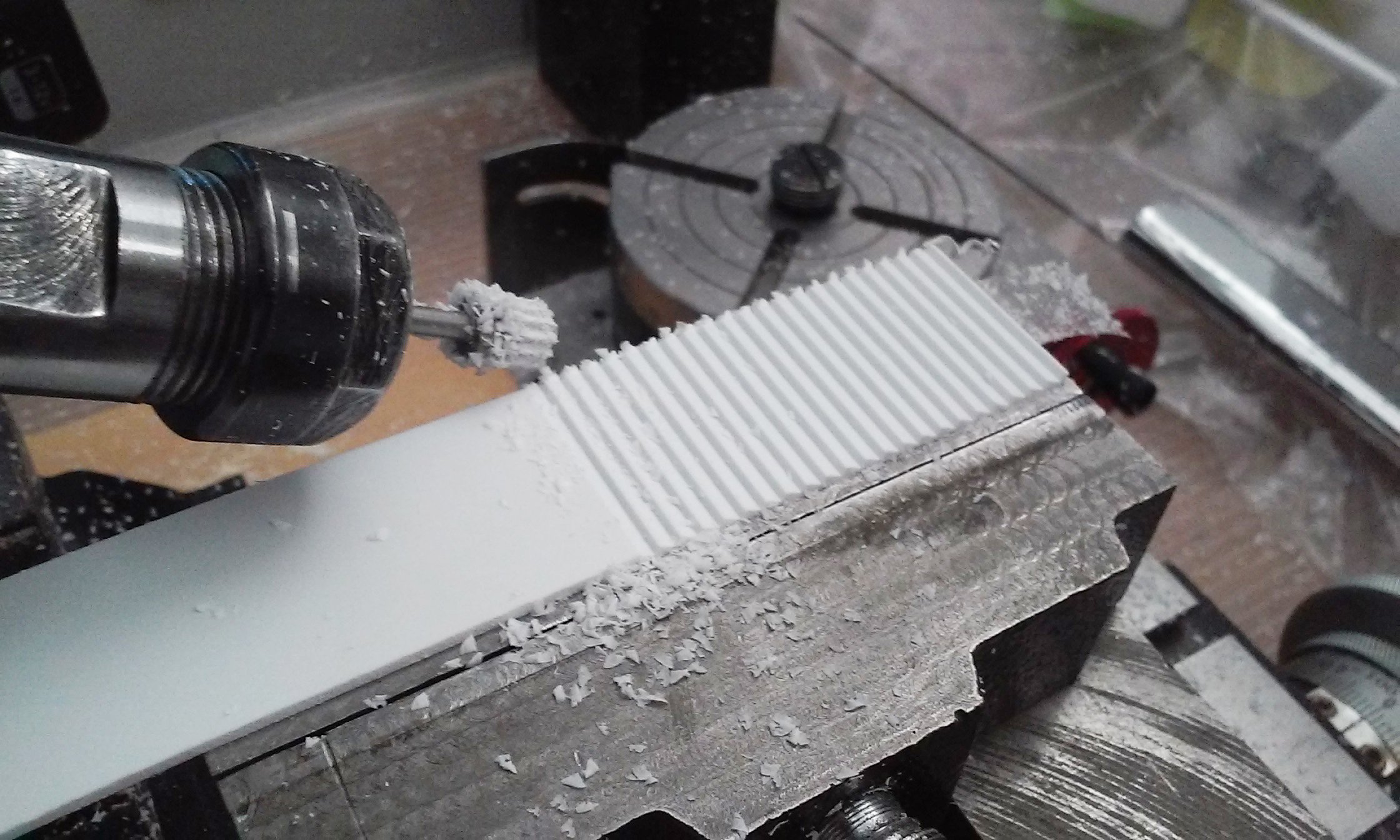

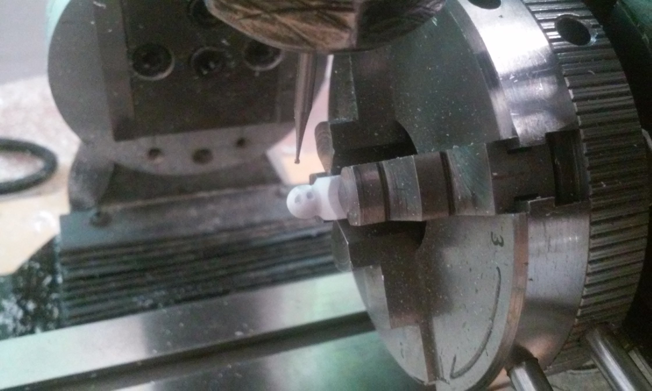

MechTech Posted July 21, 2019 Posted July 21, 2019 That's looking great Thom! I got some details done this weekend. The first was the louvers for the air intakes. A strip of styrene was milled to simulate the louvers. Then a template was made to etch the four openings and louvers were cut to fit. A thin strip will go between the louvers and the opening. Next, the tough part. I always loved the look of the fluted barrels on the Oerlikon 35mm. Those are what will be the secondary turrets. The tough part is machining them. I tried a lot of methods and materials. Aluminum, too soft. Brass, too hard, but not strong enough. I finally found steel could be lathed thin enough (with a live chuck holder on the other end). Next, I carefully milled the length of them with a special, thin saw blade. The slots were then hand widened with hobby files. I milled some muzzle brakes to go on them, but not sure they are convincing enough. They are shown in their turrets (modified Bradley turrets under construction). Then the RAM launcher was finally completed. Its an enlarged and stealthy version I made up. Next step will be making the tie-downs in the decking areas and other deck related details. - MT Quote

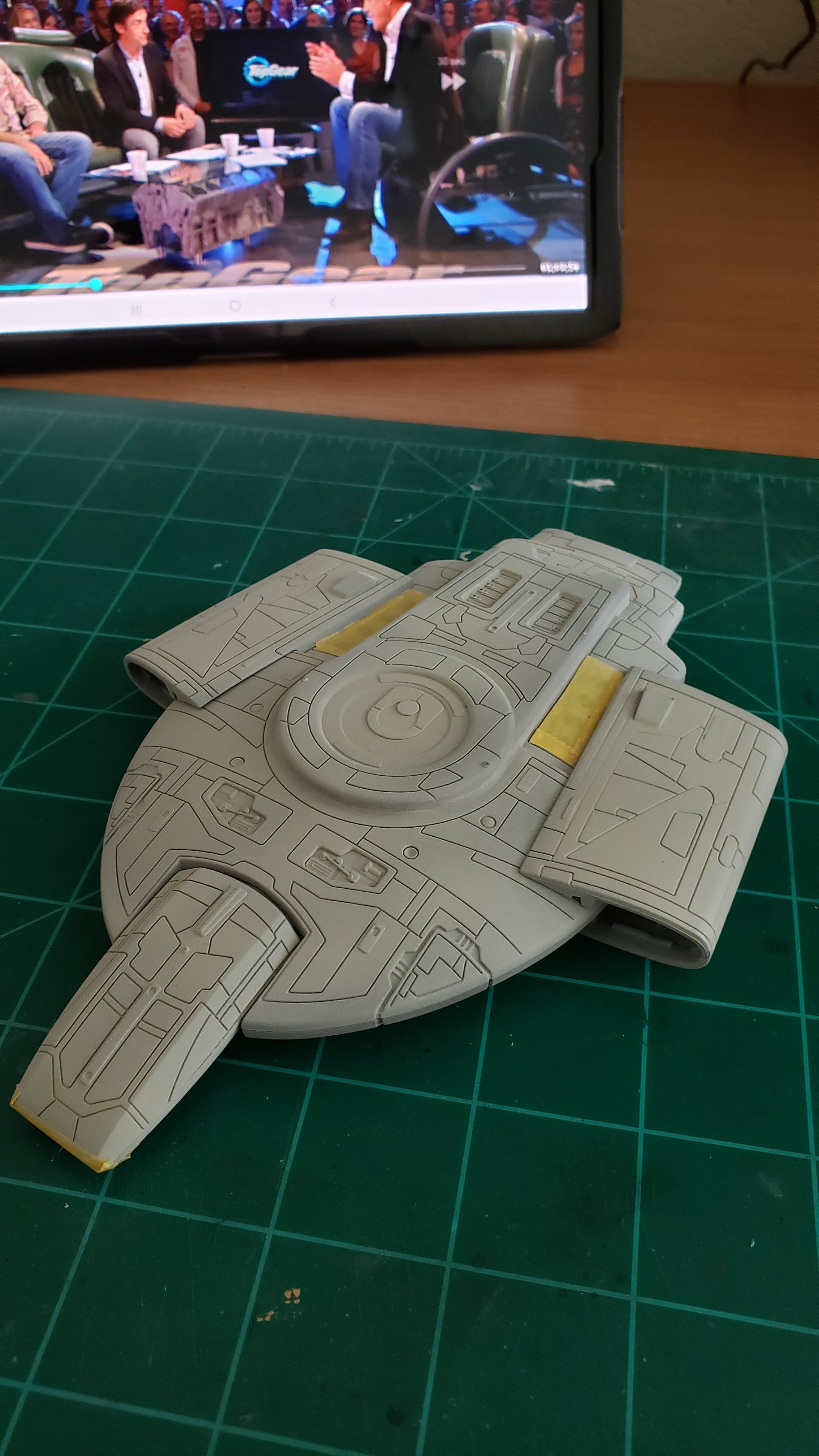

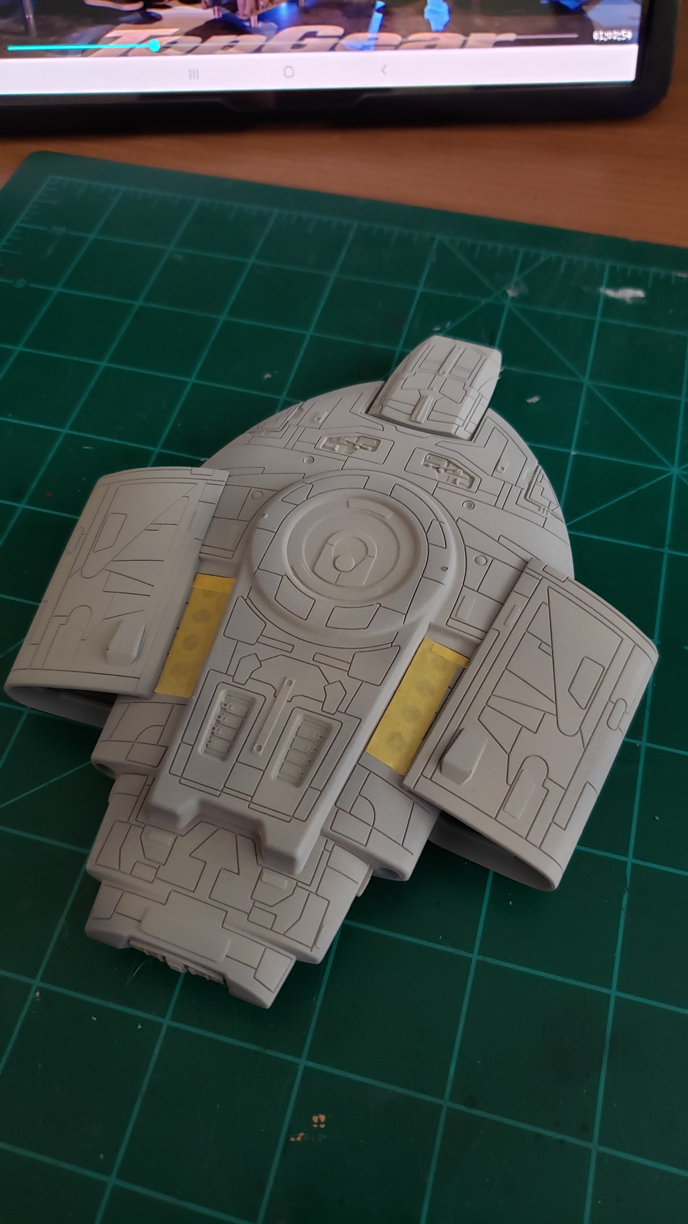

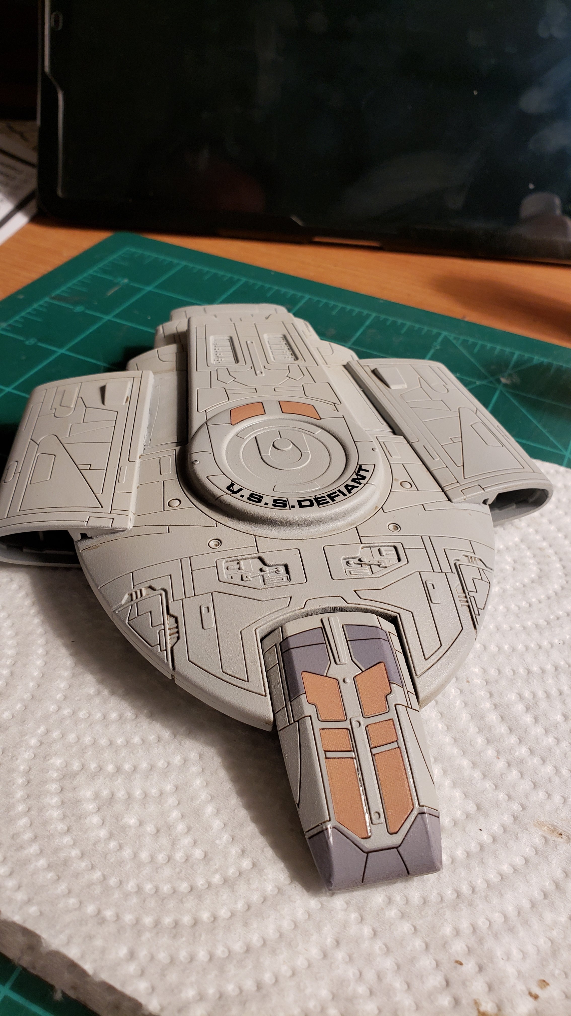

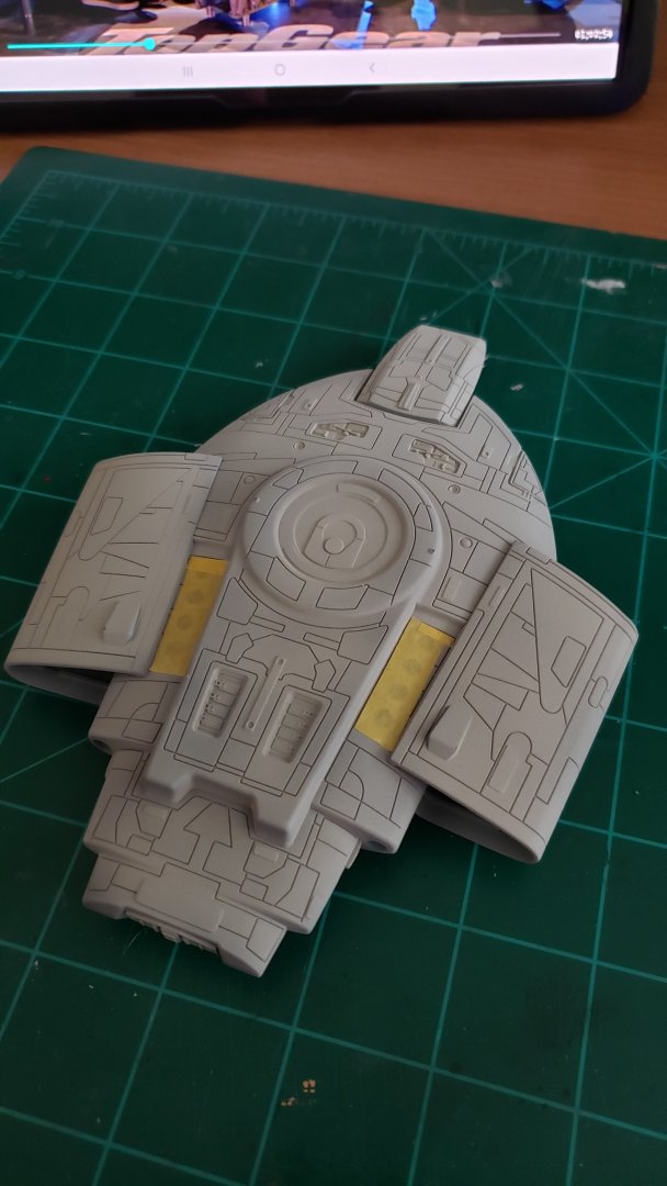

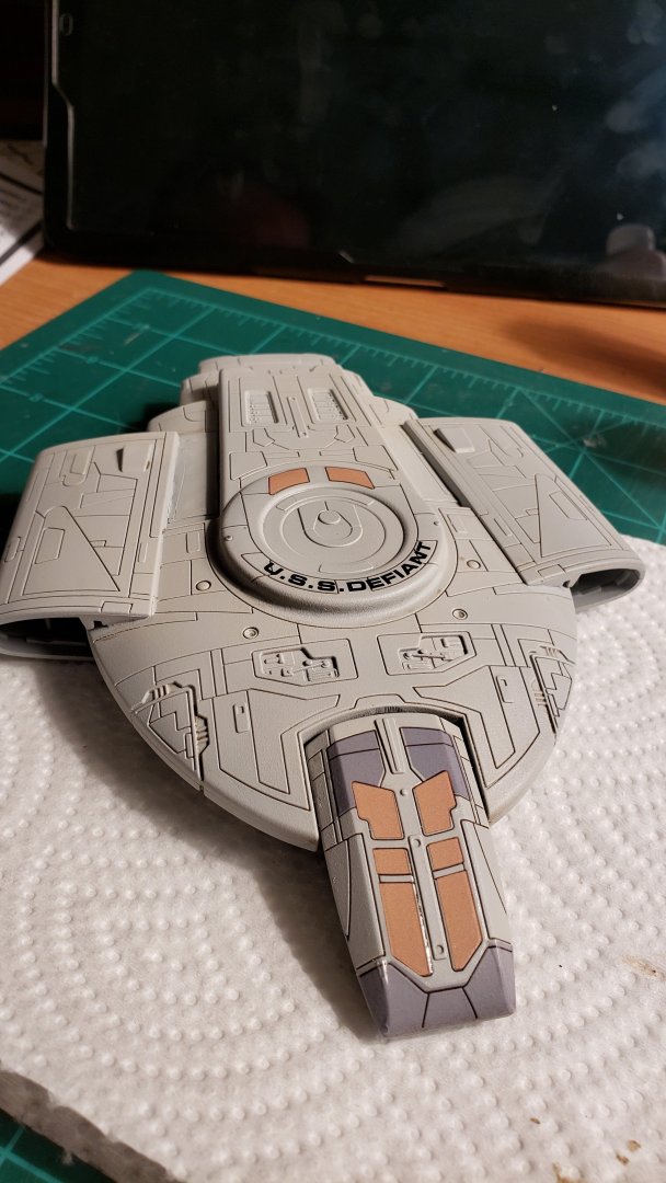

derex3592 Posted July 21, 2019 Posted July 21, 2019 Some painting and actual assembly has happened! Quote
Thom Posted July 22, 2019 Posted July 22, 2019 Thank you Bolt, and right back at yah, MechTech! The louvers look great, but those guns are outstanding. Derex3592, that Defiant is really coming together quick. Very nice. Quote
derex3592 Posted July 22, 2019 Posted July 22, 2019 (edited) @Thom, thanks, I was hoping to get away with a quick snap together and paint build, but it's not a Bandai kit....LOL...I had to bust out the Perfect plastic putty for some seam filling and some sanding of nubs. But overall, I think it's gonna look great. Just a little slower build than anticipated. Went back to primer bench this morning before I left for work. @MechTech Your metal work is just amazeballs! Those guns look fantastic! Can't wait to see the finished product! Edited July 22, 2019 by derex3592 Quote

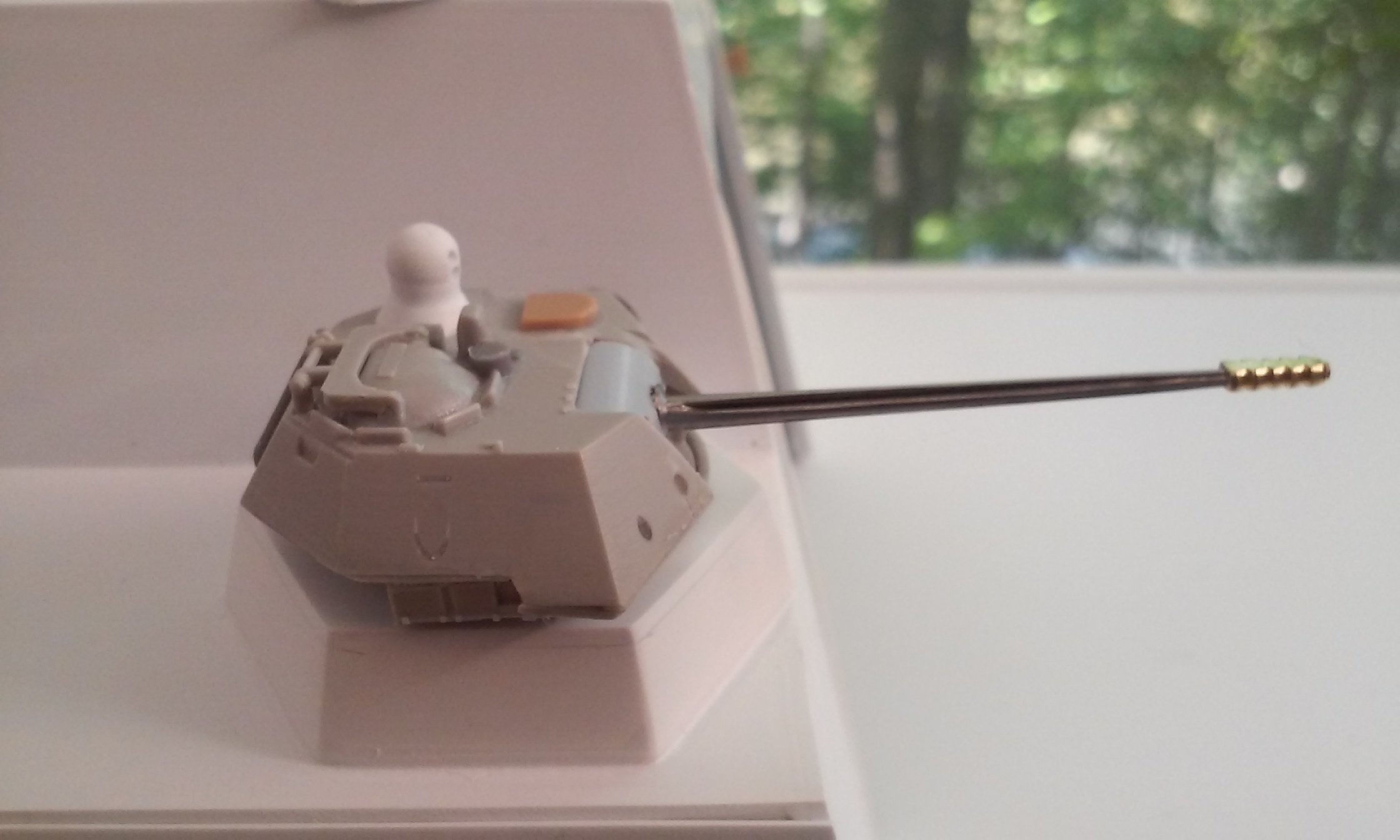

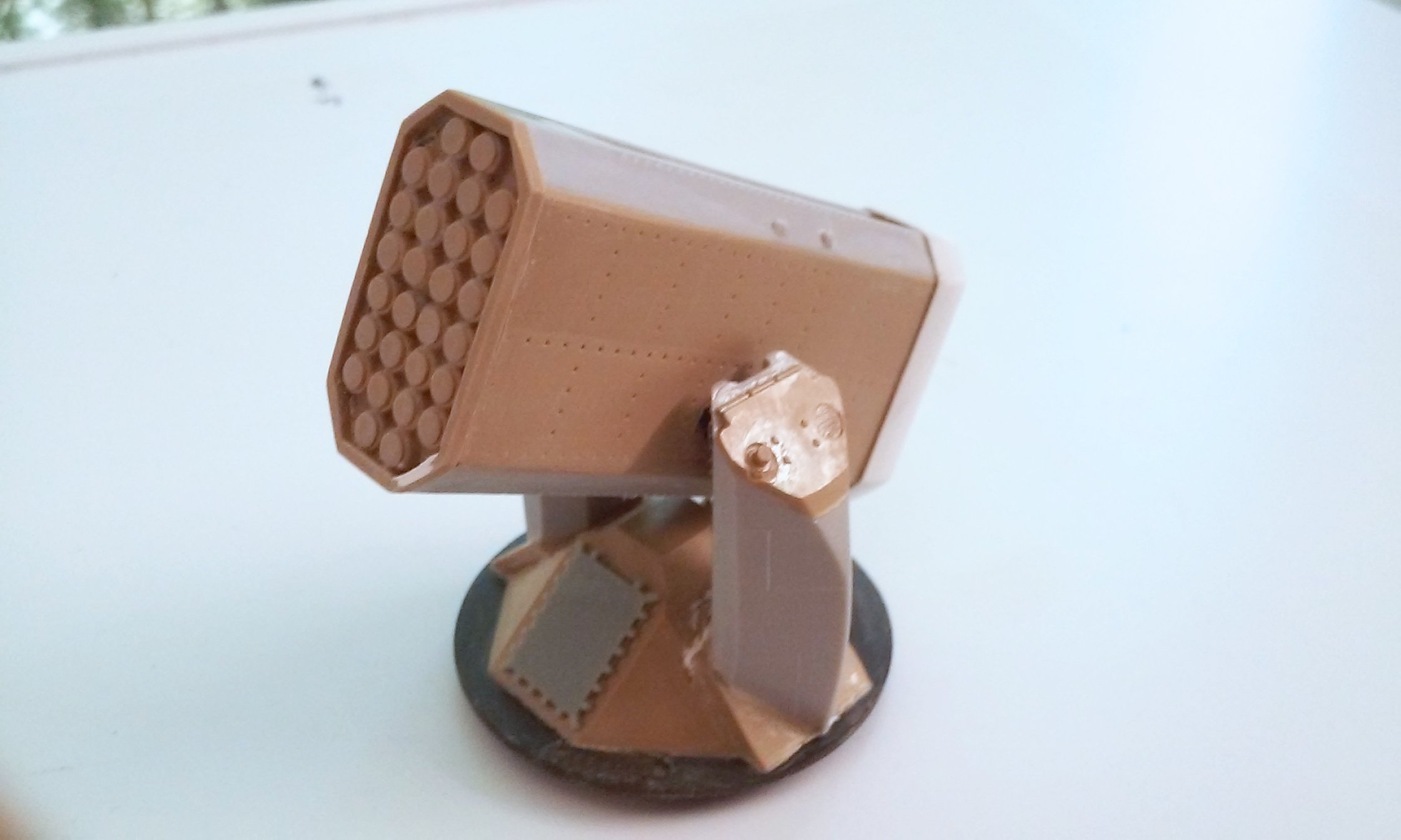

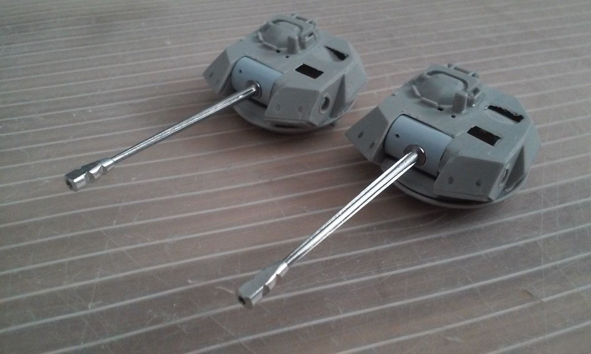

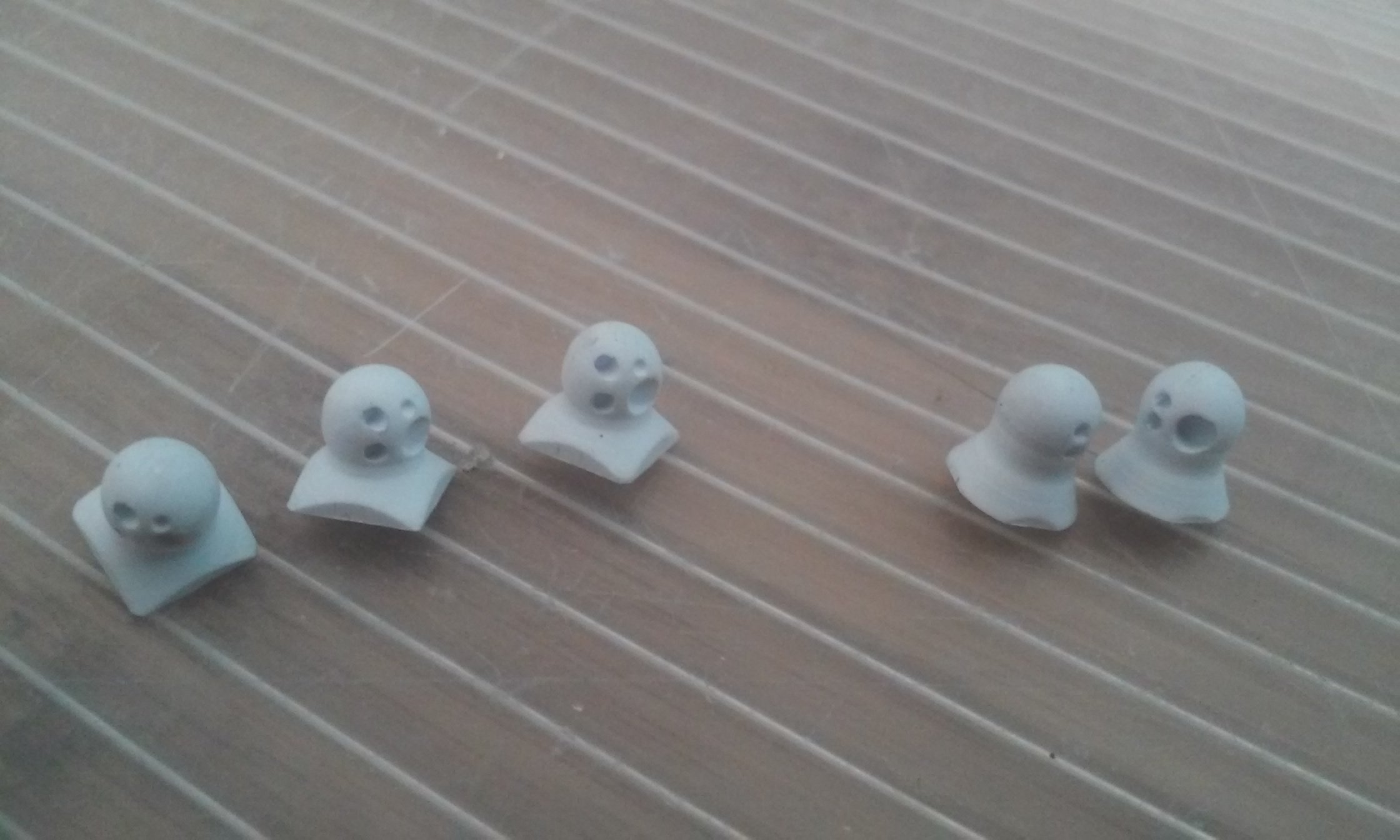

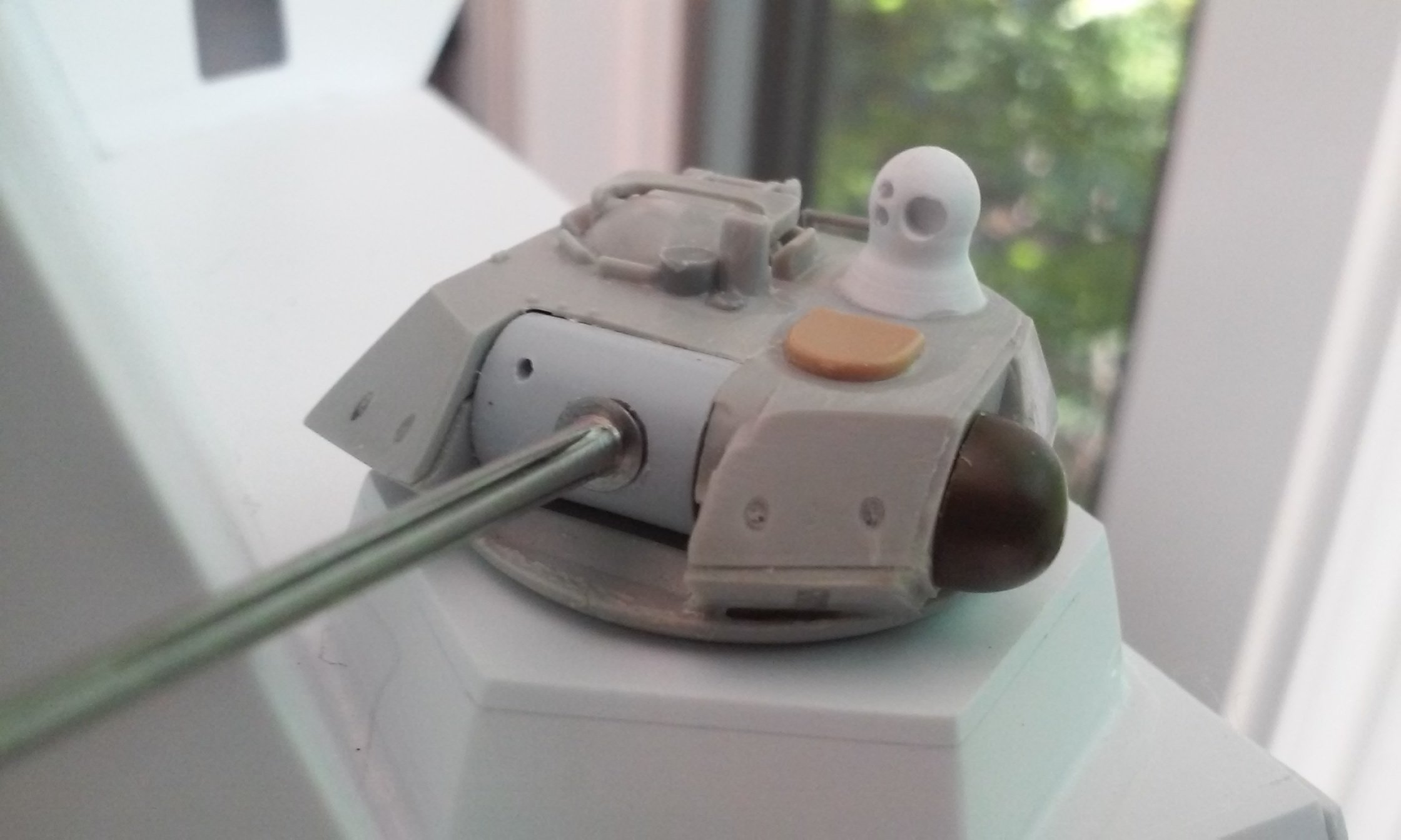

MechTech Posted July 28, 2019 Posted July 28, 2019 Nice n clean Derex. That thing almost looks the size of the Chrsitmas ornament Defiant we have. Thank you guys! That was the first time I've cut flutes into barrels like that. "Does this muzzle brake make me look fat?" I thought the first muzzle brakes looked awkward, bulbous at the end so I made something more modern looking in brass. The turrets are nearly done now too after adding details. I wanted optics turrets for the ship and turrets so I turned some radii (balls) on my lathe and then milled "lenses" into them of various sizes to simulate lasers, IR cameras and cameras. I just need to clean the dust out of the cuts. Long story short, I rechecked the main turret size and am going to redo the cap firing mechanism to make it smaller. Right now the mechanism sticks out of the turret where it should and has no room to cycle in either. Hopefully it won't take me another month like the last ones did each. - MT Quote
505thAirborne Posted July 28, 2019 Posted July 28, 2019 Your attention to detail is phenomenal MT, those gun turrets & cameras... damn! Quote
