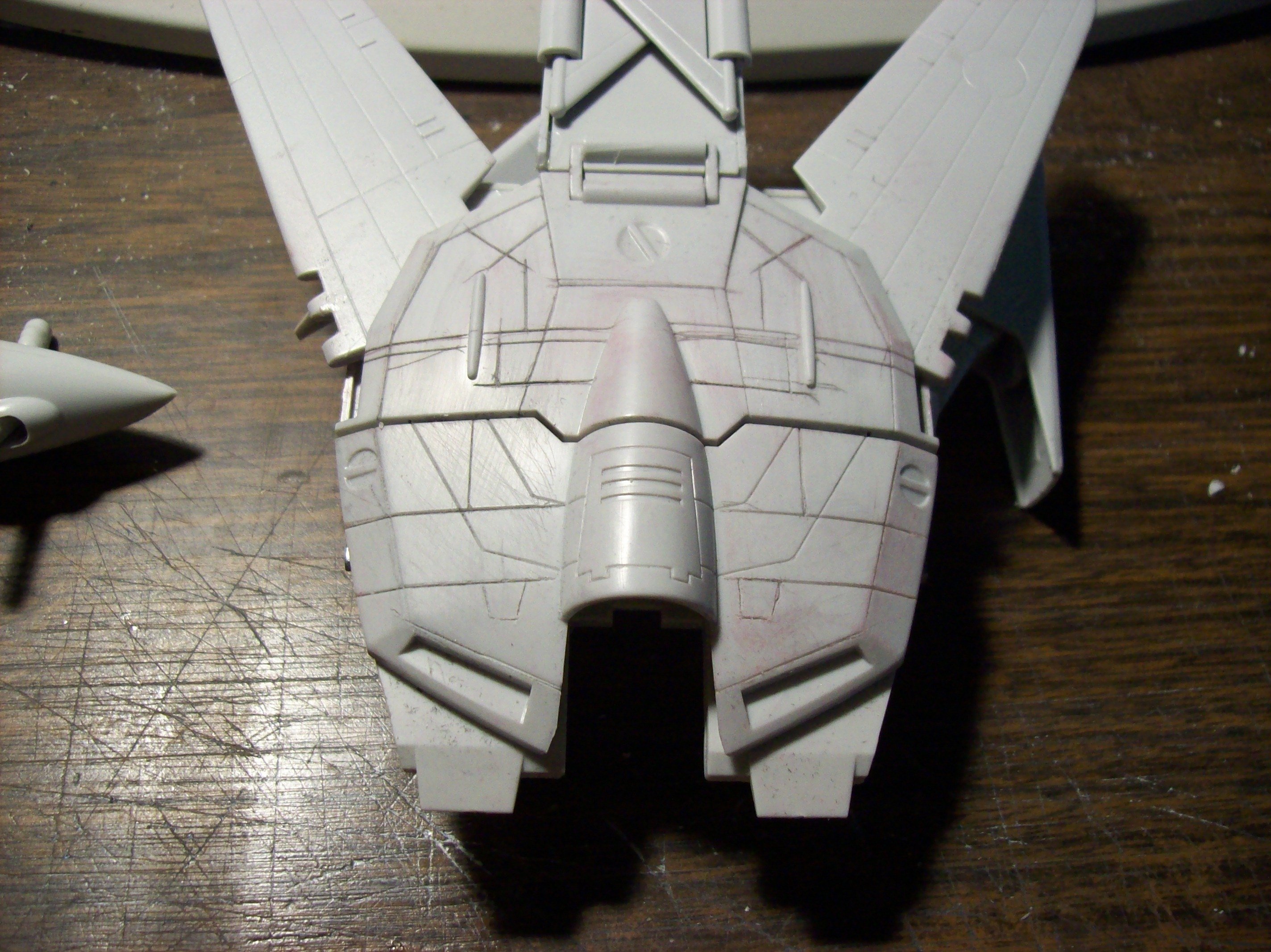

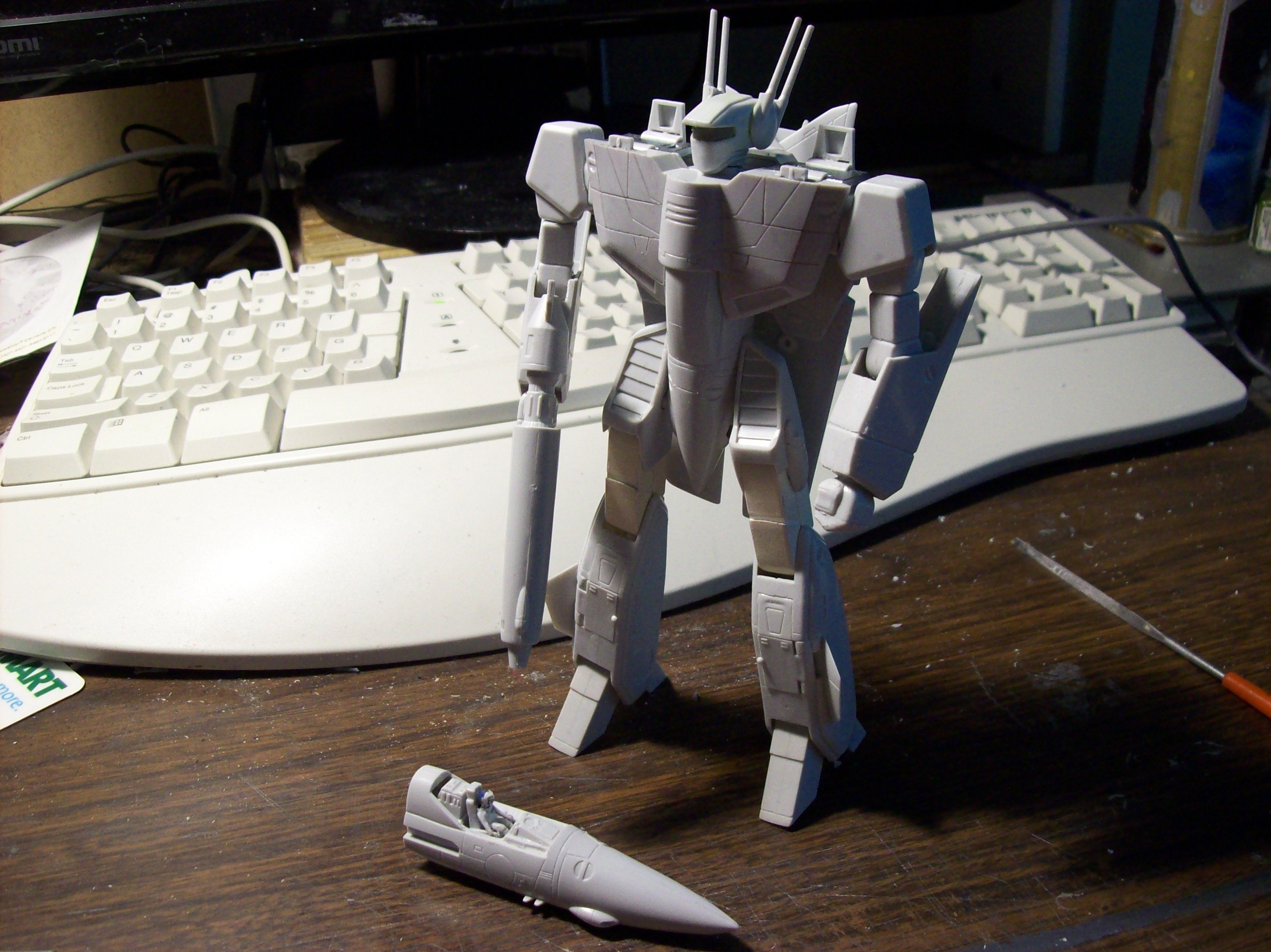

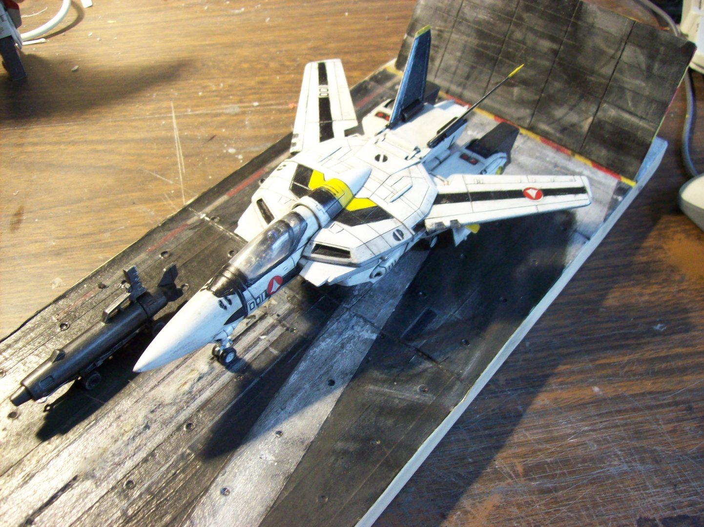

pengbuzz Posted May 15, 2019 Share Posted May 15, 2019 (edited) On 5/14/2019 at 2:05 PM, derex3592 said: Thanks Pengbuzz, I decided a tacky 70's gold stand kinda went with it.. haha. Now you just need the "Disco" version of the Star Wars theme and a small disco mirror ball Death Star! lol Anywho, some progress on my VF-1S: I did some panel line work on the Battroid Nose/ cockpit so that it looked like the Fighter/ Gerwalk Version. A closer look here: I also found a spare pilot from my first build of the VF-1S and did some reworking on him. I didn't really care for the "I hope no one hurts me" near-fetal pose he was in (sorry about the blurriness, my camera doen't like it's own close-up mode): I also reworked the cockpit a bit; I plan on redoing the side panels in the "tub" with greeblies added for throttle and control sticks. I'll also see about a transparent HUD as I go: I also did some panel engraving on the topside of the fighter: after the VF-1J, it just looked a bit too plain to me. I may go back and redo the 1J at some pint with a blade and some darker paint to contrast the panels, but that's for another day when I feel brave: Battroid mode: I rounded the fronts of the thighs/ intakes a bit as the felt a bit boxy: I don't plan on going "overboard" on this one, but just touching up a few things that often bothered me about the Imai VF-1 Variable kit. I may also revise the tail and add a bit to the ailerons (they seem a bit skinny to me). Stay tuned... Edited May 15, 2019 by pengbuzz Quote Link to comment Share on other sites More sharing options...
Bolt Posted May 15, 2019 Share Posted May 15, 2019 Nice job on the panel lines! Quote Link to comment Share on other sites More sharing options...

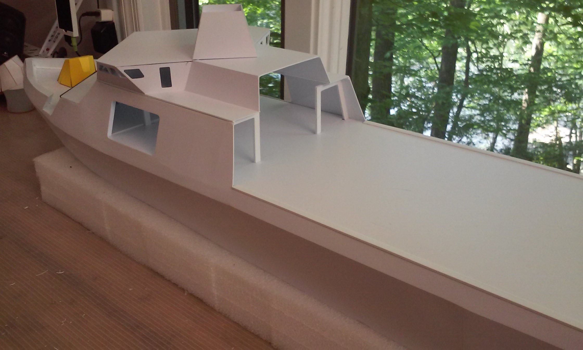

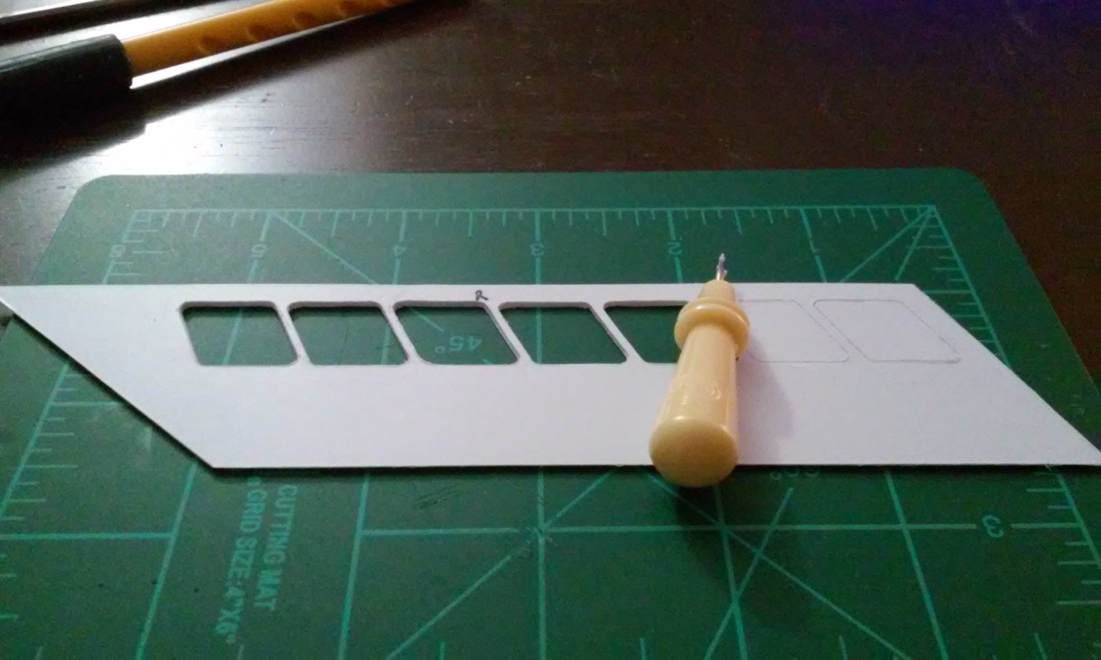

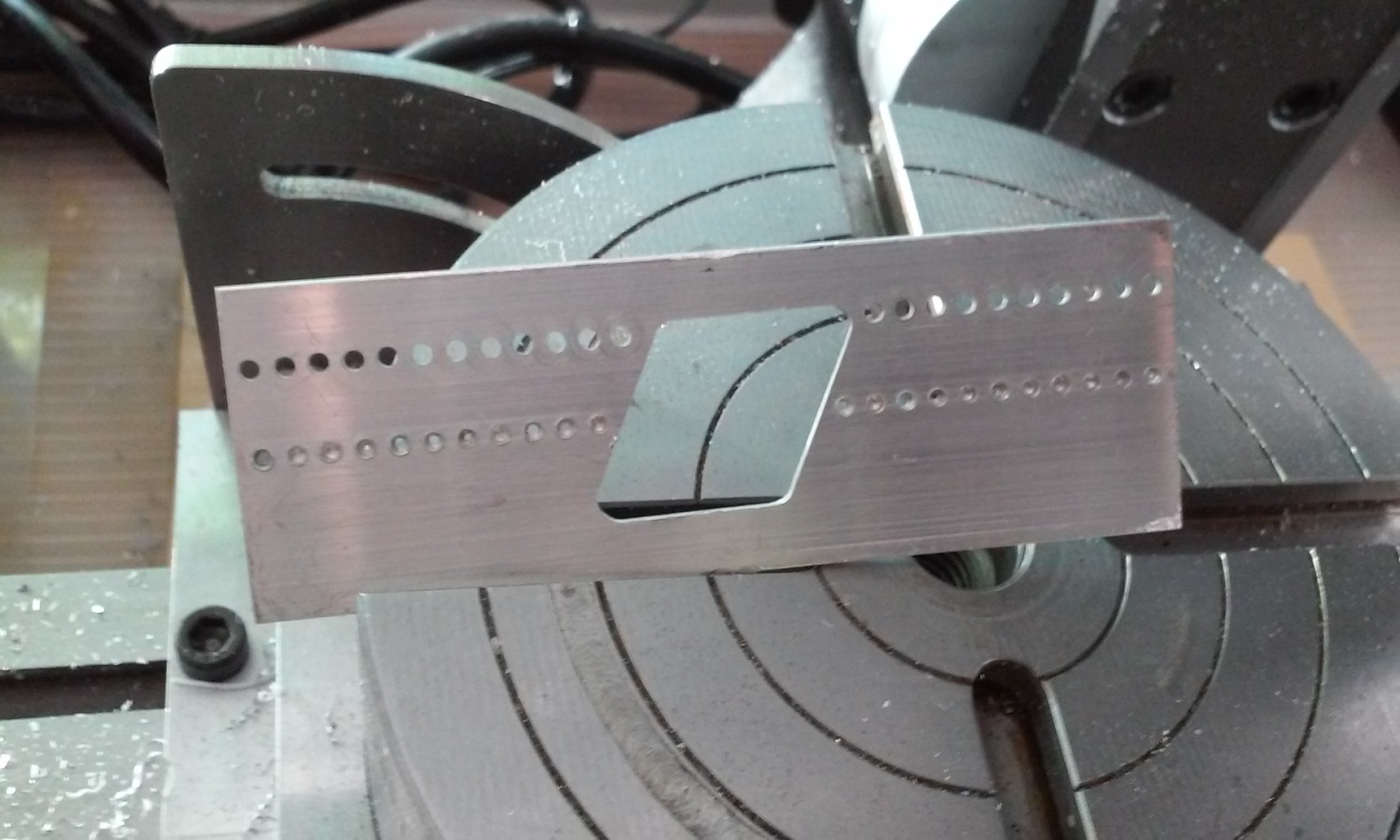

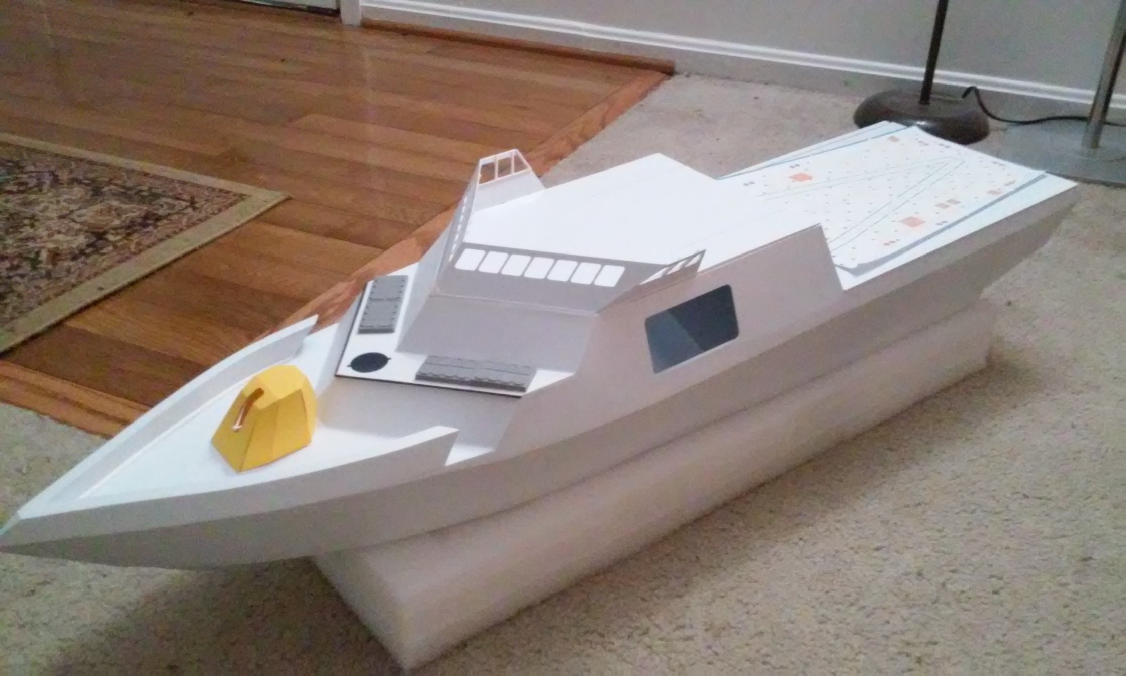

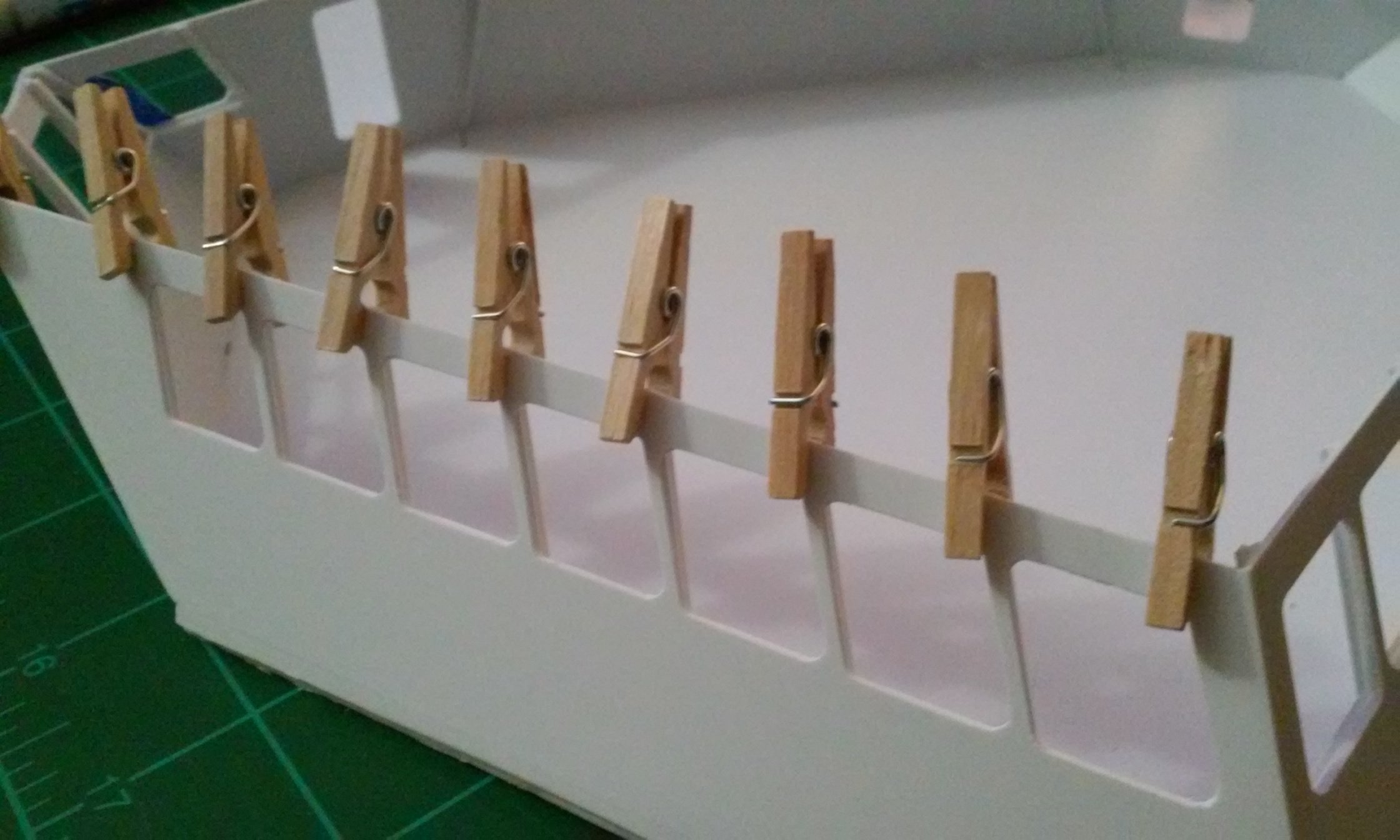

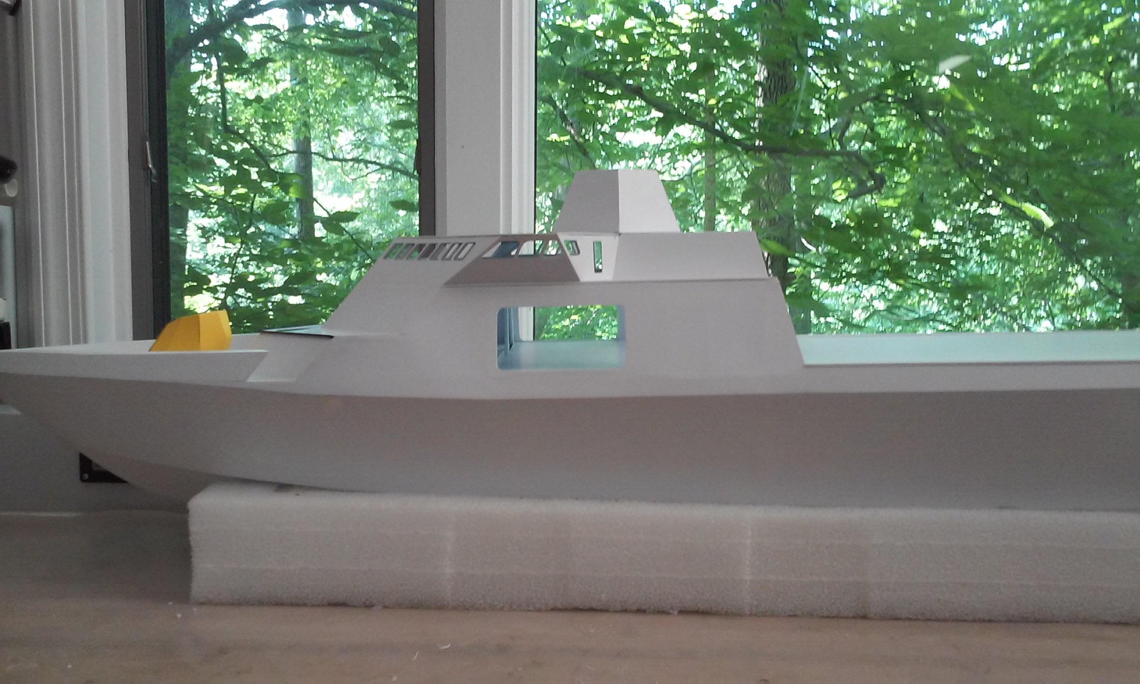

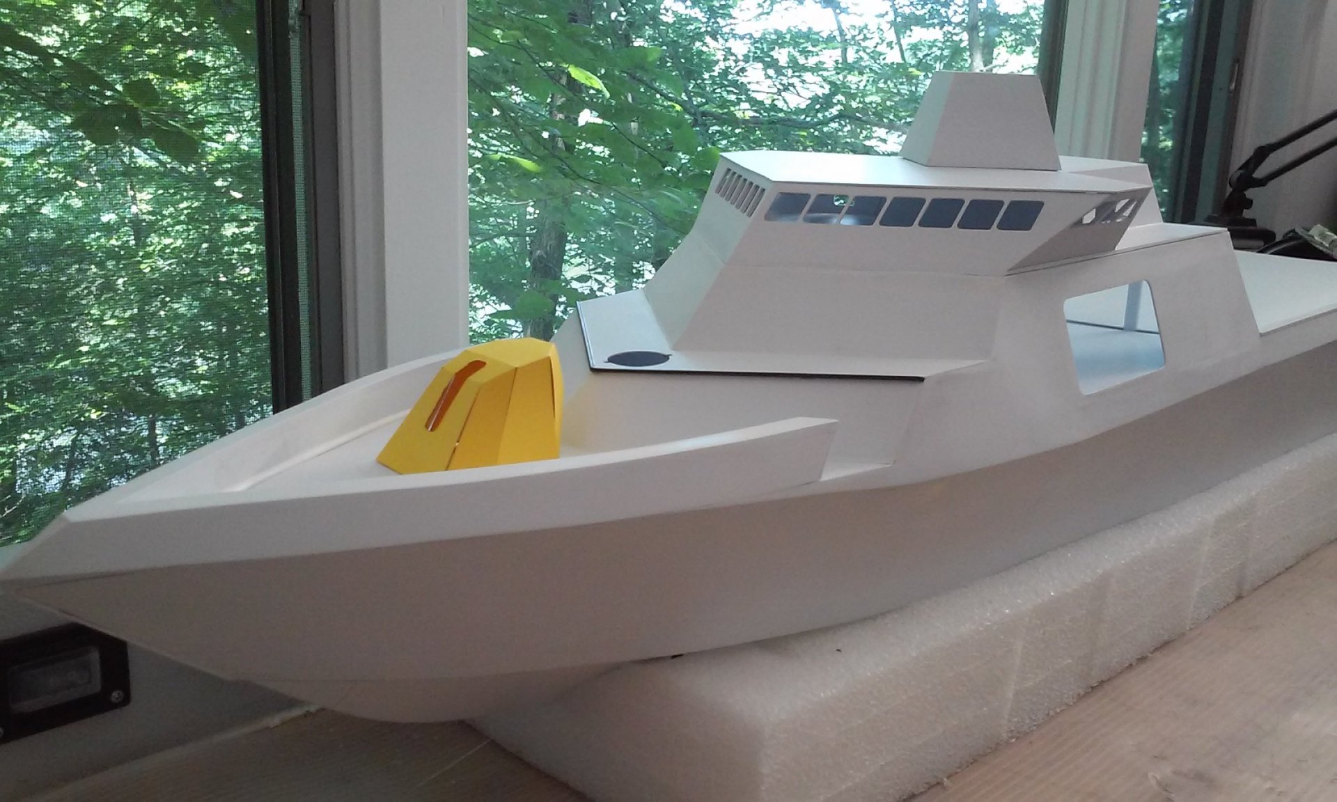

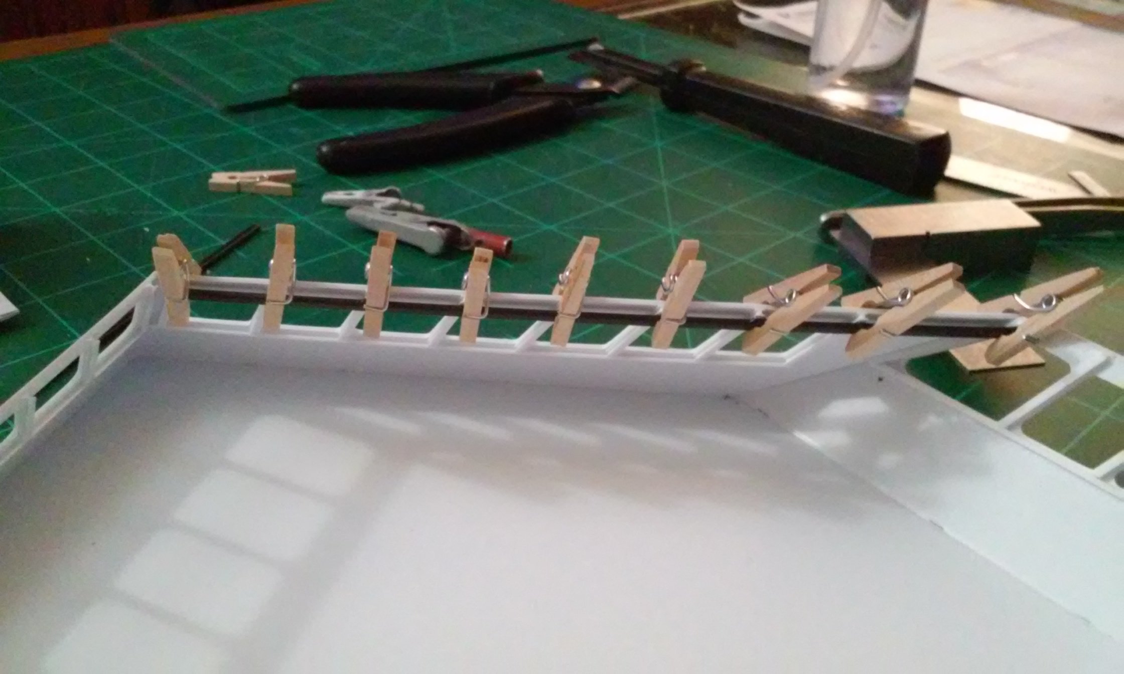

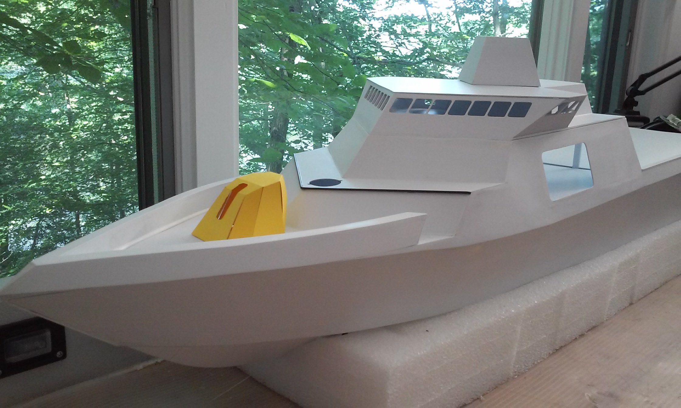

MechTech Posted May 19, 2019 Share Posted May 19, 2019 (edited) Alright, I forced myself to get on the computer and finally download my camera. Here's what I've got done so far. Hasegawa's Tri-Tool was the inspiration to make the aluminum jig for making all the windows the same. Each one was scribed to make them the same versus just cutting on some lines. More work, but better accuracy (unless you have a laser cutter). All the cutting for the windows created bowing, carbon fiber rod was used on various areas to stiffen it up and straighten it out. Actual ships have girders between the windows in some cases, so I used Evergreen I beams and did that. Then they will double up to hold the windows when painted - no masking them off - YEAH! The clothespins are tiny craft ones, not full sized ones. Its starting to look like something now. - MT Edited May 19, 2019 by MechTech Spelling Quote Link to comment Share on other sites More sharing options...
Bolt Posted May 19, 2019 Share Posted May 19, 2019 Wow beautiful work! Is that a coast guard or Navy vessel? Quote Link to comment Share on other sites More sharing options...
mickyg Posted May 20, 2019 Share Posted May 20, 2019 Looking amazing MT! If you hadn't mentioned the scale of the clothespins, I'd have thought this thing grew! Quote Link to comment Share on other sites More sharing options...
Thom Posted May 20, 2019 Share Posted May 20, 2019 (edited) MechTech - Great work on the windows! Suddenly got a real sense of scale. For meself, my latest build is DUN. USS Defiant returning triumphant to DS9 after a battle during the Dominion War. Edited May 20, 2019 by Thom Quote Link to comment Share on other sites More sharing options...

MechTech Posted May 21, 2019 Share Posted May 21, 2019 Thank you guys. This will be a light frigate, but similar to the littoral combat ships - just better armed. Hopefully the three water jets will get it going quick when done. Your Defiant came out great Thom. It looks very similar to the way the battle damaged the show models. - MT Quote Link to comment Share on other sites More sharing options...

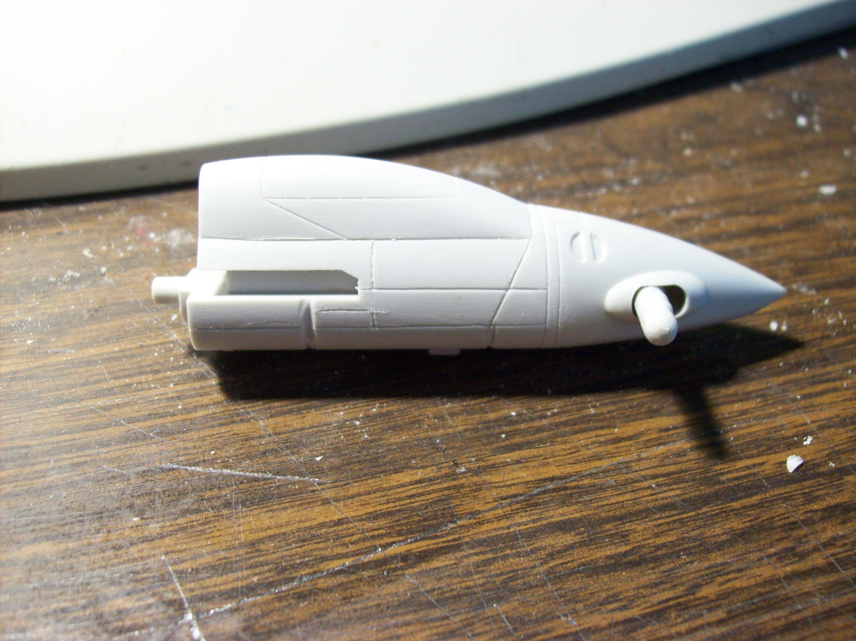

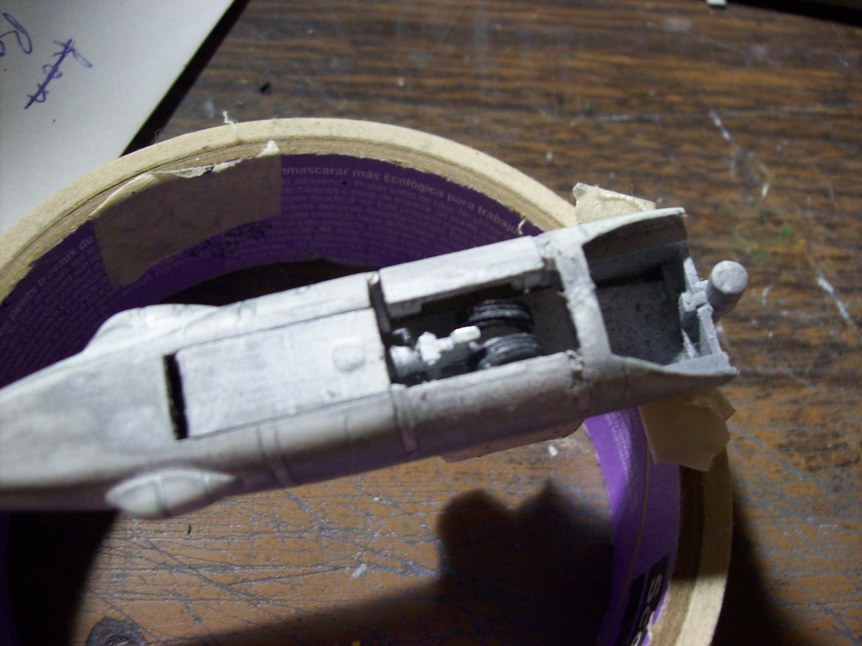

pengbuzz Posted May 28, 2019 Share Posted May 28, 2019 Progress report: picked up the cockpit to work on it, and instead managed to snap the landing gear doors right off the nose- This really pisses me off. This $#!+ always happens when I try to build Skull-1. Anyways, needing to repaint the nose after stripping it (long story) and I really would like to finish this model someday. Half-tempted to just glue the damn landing gear shut and add a plate over this section. Stay tuned folks. Quote Link to comment Share on other sites More sharing options...

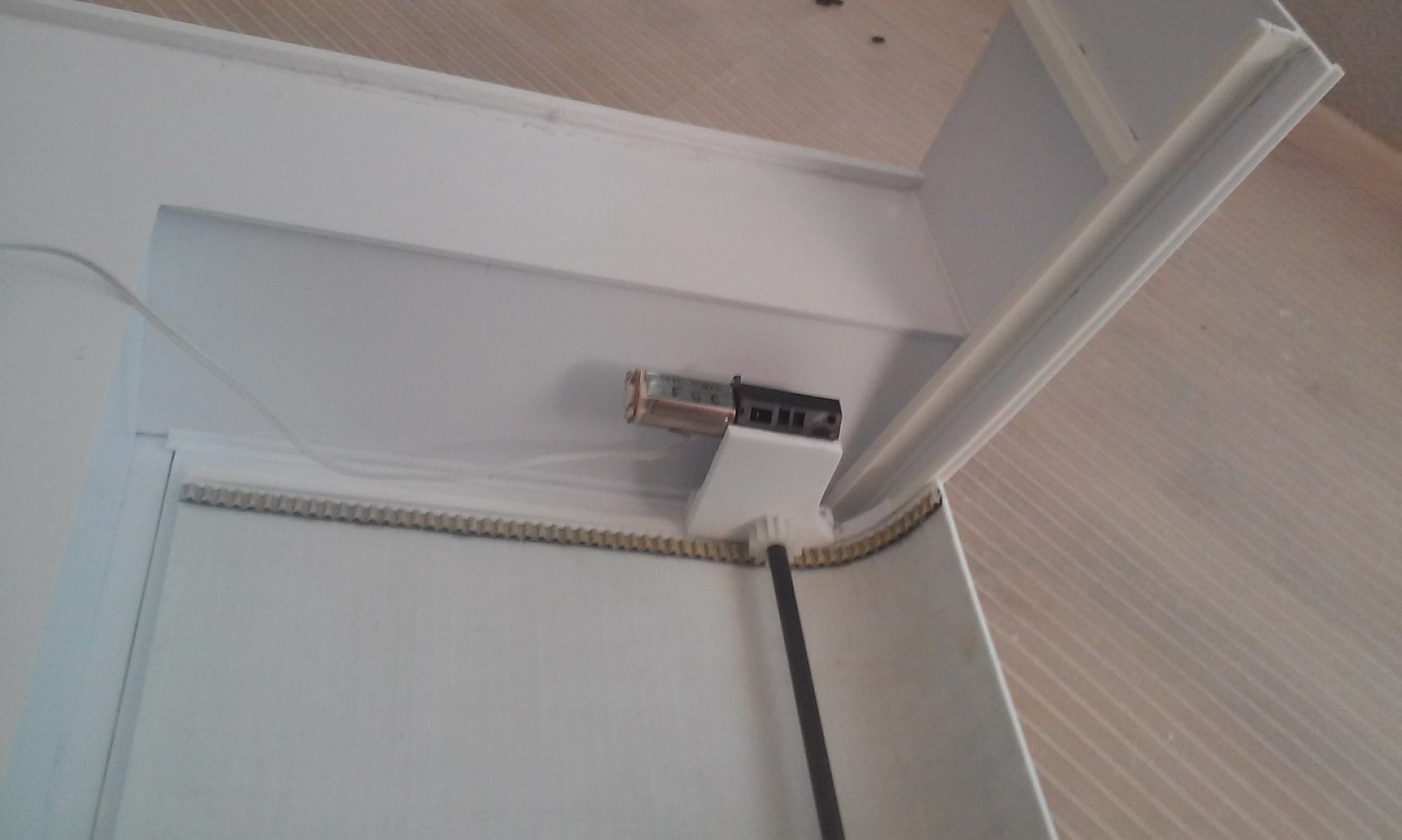

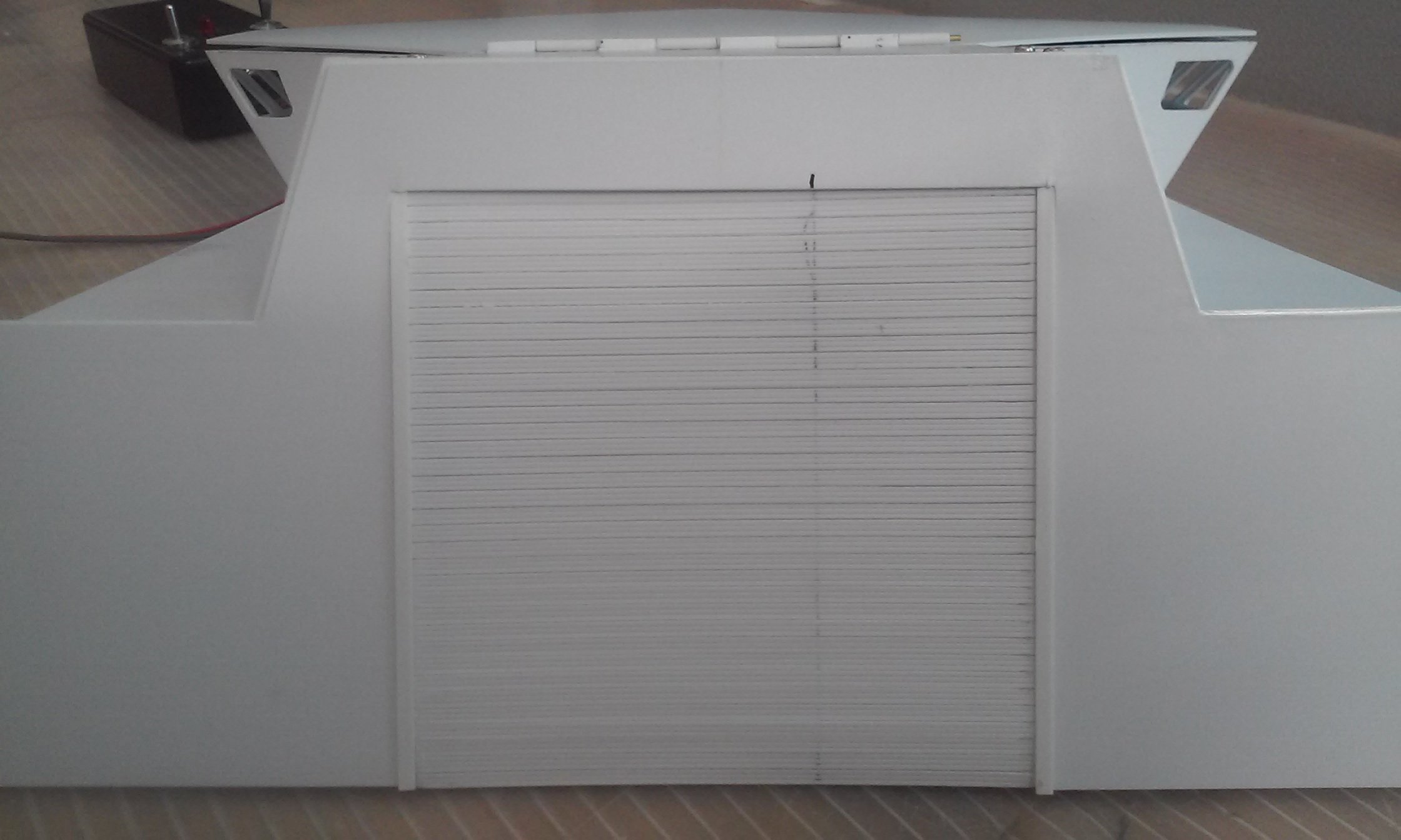

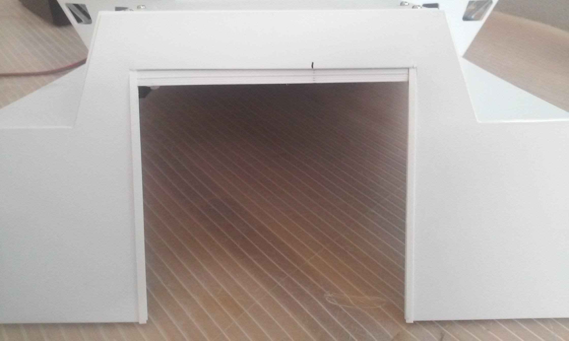

MechTech Posted June 1, 2019 Share Posted June 1, 2019 Sorry Pengbuzz, I'm familiar with those delicate doors. I know you can fix it! No way Tom, that's EXACTLY the same thing I'm working on now! Except mine is the hanger bay door! I cut plastic slots too (smaller and thinner). But then I glued them together with a thin mesh on the back as a giant hinge. Not sure of the drive, but I'm thinking of using belt and cogs to drive it. That's what I've been testing. - MT Quote Link to comment Share on other sites More sharing options...
arbit Posted June 1, 2019 Share Posted June 1, 2019 1 hour ago, MechTech said: Not sure of the drive, but I'm thinking of using belt and cogs to drive it. That's what I've been testing. - MT Im not following. What is it you're going to drive? Quote Link to comment Share on other sites More sharing options...
pengbuzz Posted June 1, 2019 Share Posted June 1, 2019 3 hours ago, MechTech said: Sorry Pengbuzz, I'm familiar with those delicate doors. I know you can fix it! Well, my solution was to remove the doors from the other valkyries as well, seeing as those also had cracks that were waiting to open up. I'd rather just leave the tires exposed a little on the bottom than wrestle with this. Quote Link to comment Share on other sites More sharing options...

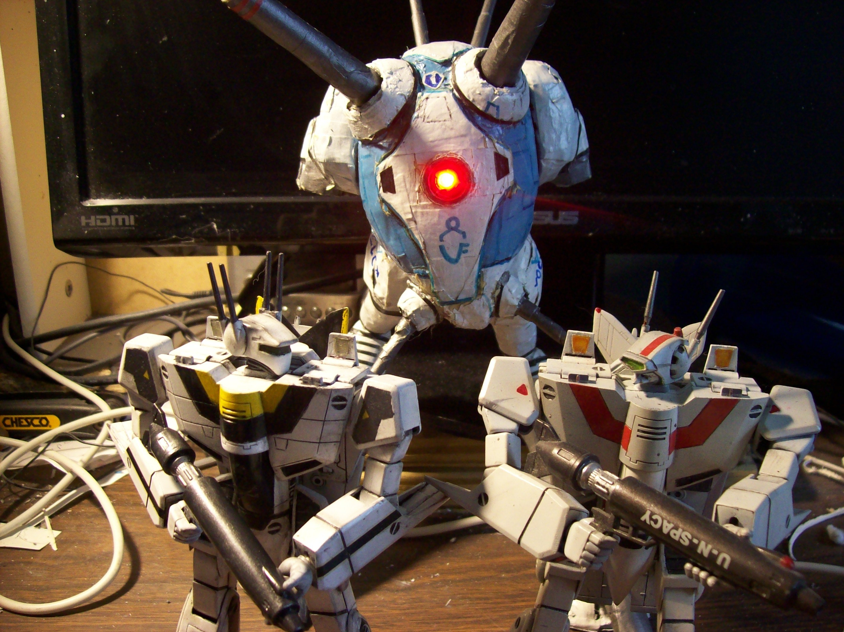

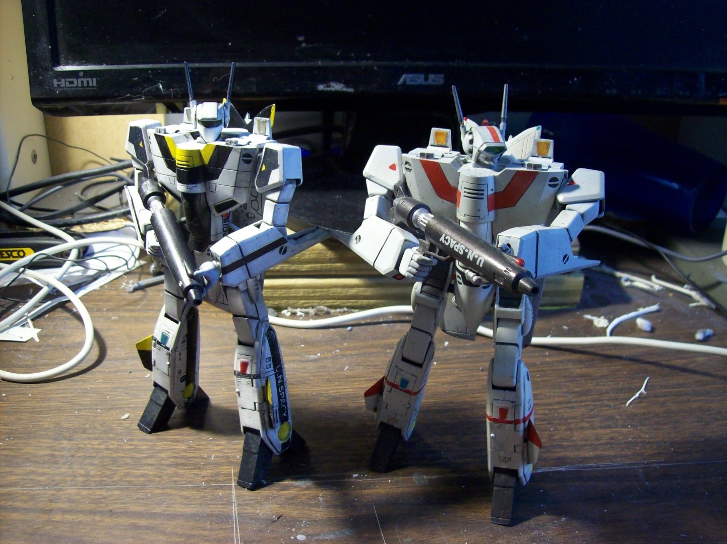

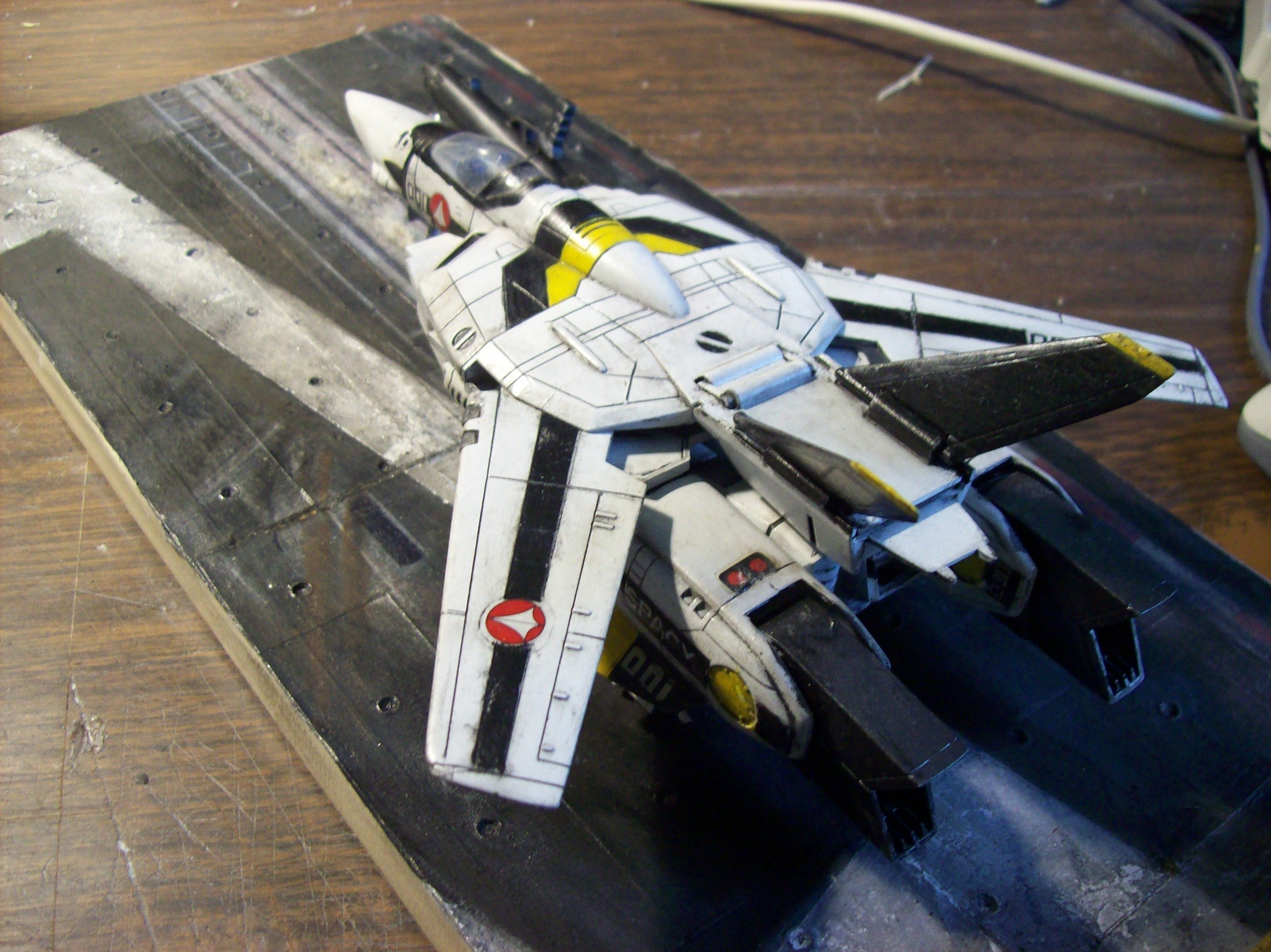

pengbuzz Posted June 5, 2019 Share Posted June 5, 2019 (edited) Well, for what it's worth, i finished the VF-1S (FINALLY): Panel lines are a bit heavy, weathering a bit too much, nose gear doors broken off, but I really don't care. I finally finished it, and it's done. It looks halfway decent and that's what matters. Hikaru and Roy enjoying a bit of hunting. Hikaru: "Roy, I get the feeling that something's behind us...." Roy: "Hikaru, I'm NOT turning around.; YOU don't turn around either. If we don't turn around, then we're safe..." Hikaru: "Um...not to question your logic sempai, but that...er...doesn't sound like a very good plan." Roy: "Yeah, well I'm all out of rum back at base so getting 'liquid courage' ain't gonna happen this time around, little brother." Hikaru: "We're screwed..." Roy: "Yup. But look on the bright side: at least you don't have to listen to Misa bitching at you for being late getting back to base." Edited June 5, 2019 by pengbuzz Quote Link to comment Share on other sites More sharing options...
Thom Posted June 6, 2019 Share Posted June 6, 2019 16 hours ago, pengbuzz said: Well, for what it's worth, i finished the VF-1S (FINALLY): Panel lines are a bit heavy, weathering a bit too much, nose gear doors broken off, but I really don't care. I finally finished it, and it's done. It looks halfway decent and that's what matters. That looks awesome. The Robotech intro is playing in my head right now! Quote Link to comment Share on other sites More sharing options...
Gabe Q Posted June 6, 2019 Share Posted June 6, 2019 Pengbuzz! That's a great job. You really brought it to life. Loving the group shot! Quote Link to comment Share on other sites More sharing options...
MechTech Posted June 9, 2019 Share Posted June 9, 2019 Congrats Kenny on the silver and GREAT looking Viper! The hard work was worth it. Great finish Penbuzz! Your job came out great despite the doors hangup. I like the base you have it on too. I always loved that model. You never forget your first Valk! As you probably saw in the video above, the guy made a roll-up style bed cover for hid R/C truck. It was funny because I already made a similar door for my ship's hangar. This weekend I finally finished the drive for it. So just imagine a roll-top desk or a roll-up styled garage door - that's what I made for my ship. I cut slivers of grooved styrene and then carefully laminated them together with very fine mesh for the glue to adhere into. This made a highly flexible roll-up garage / hangar bay door. I then attached strips of cogged belts (from an old printer) on the left and right side of the door. Then I used an old focusing geared motor from a dead camera and motorized the door drive. A carbon fiber rod goes from the camera geardrive stretched across the door with a gear on both sides to drive into the belts. Styrene "I" beams make up the sides of the door / rails that the door rides inside of. The first photo shows one side up close. Gears on both sides of the door drive into the belts on the door making it move. Really simple, but it was fun to make it work smoothly. Sorry, no video yet. - MT Quote Link to comment Share on other sites More sharing options...
