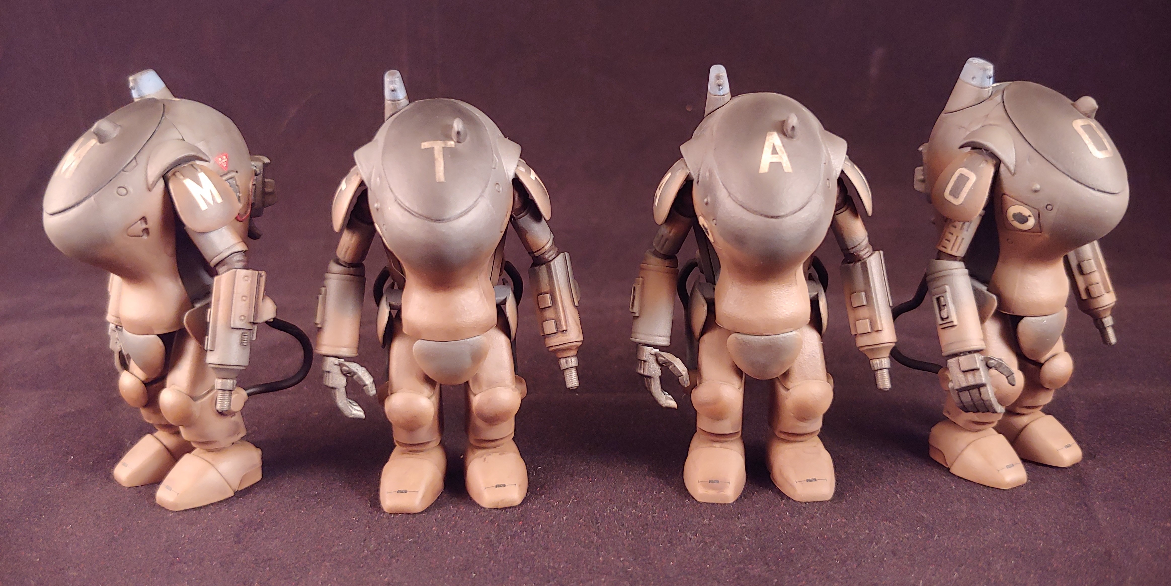

nightmareB4macross Posted March 3, 2019 Share Posted March 3, 2019 On 2/28/2019 at 4:38 AM, Duymon said: Man I wish I had enough room in my place to build big stuff like that Boat mechtech's got. if I did I'd fill it with more Safs :0 Been on a maschinen krieger bender. Just made a new squad from those 1/35 gachanen kits. Never thought I'd have so much fun doing little 2.5" tall egg soldiers. Looks like you spent a lot of long fun nights building these with Jimmy KImMeL. Quote Link to comment Share on other sites More sharing options...
Duymon Posted March 3, 2019 Share Posted March 3, 2019 (edited) On 3/1/2019 at 3:53 AM, pengbuzz said: Now, have them do "YMCA"! I prolly should try that. Will just need to do some cutting to mod these mono-pose figs 2 hours ago, nightmareB4macross said: Looks like you spent a lot of long fun nights building these with Jimmy KImMeL. Other than the air-brushed base-coat and the final flat-coat everything was done during night-shifts at work haha I managed to churn out another 4 Safs units but decided to try a 2-tone paint scheme. Should have the series 2 figs in soon so the 5th in this squad will be a racoon type safs. I prolly need to adjust my lighting setup because the M on the fig on the left looks like it has a super bright-white M even though in reality it's a dirty brown-ish Edited March 3, 2019 by Duymon Quote Link to comment Share on other sites More sharing options...

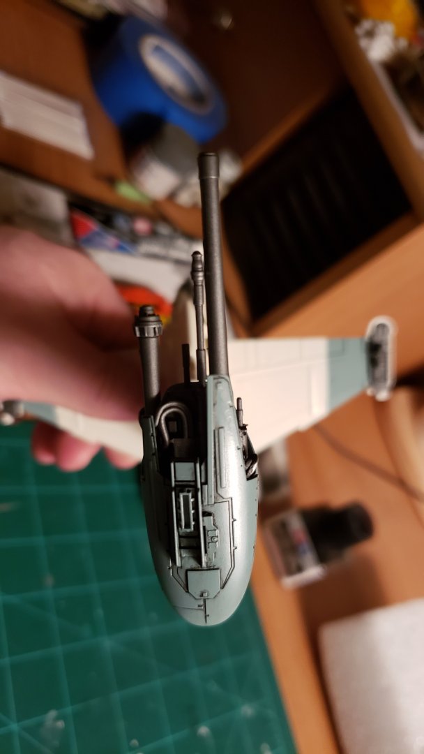

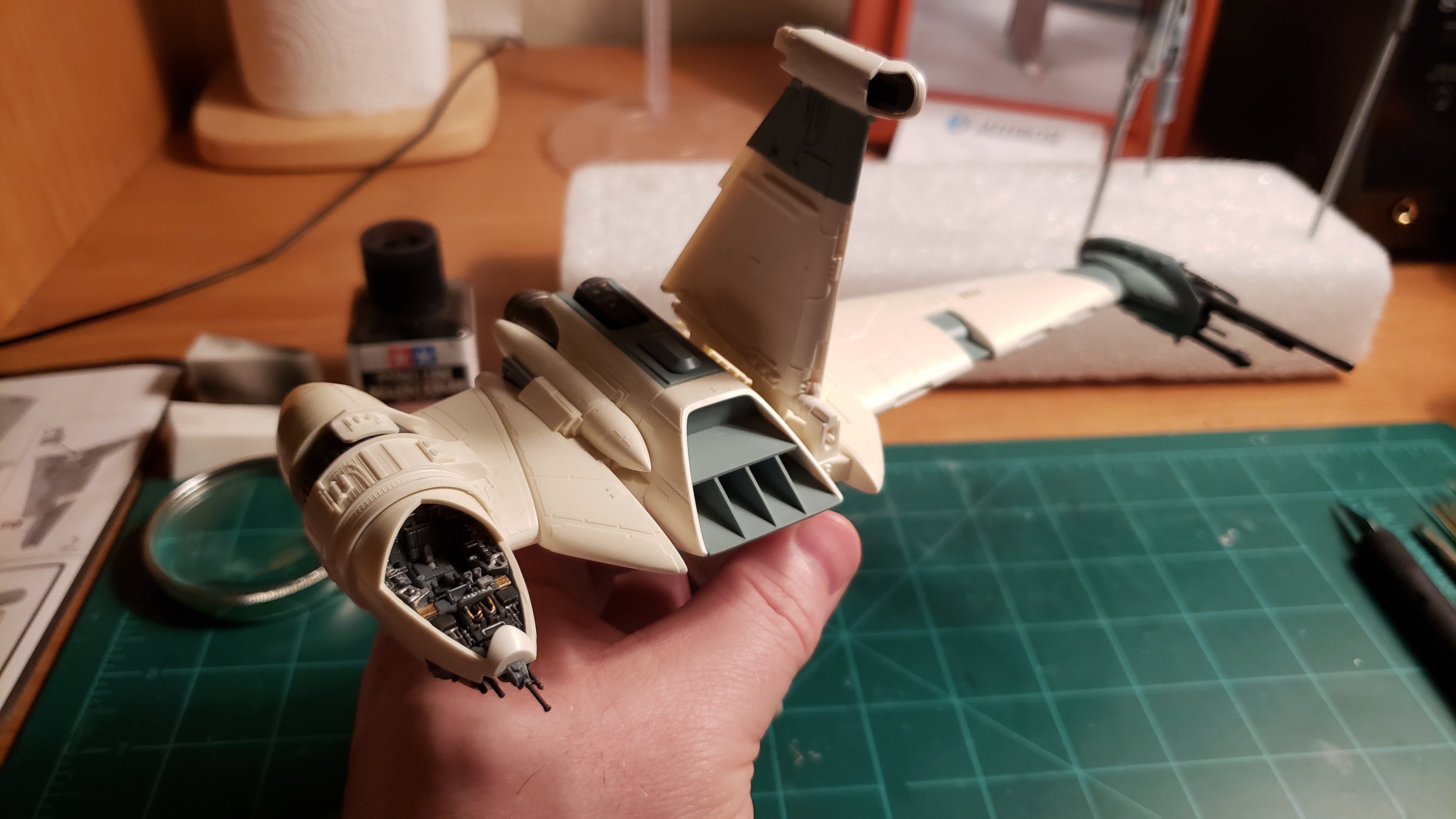

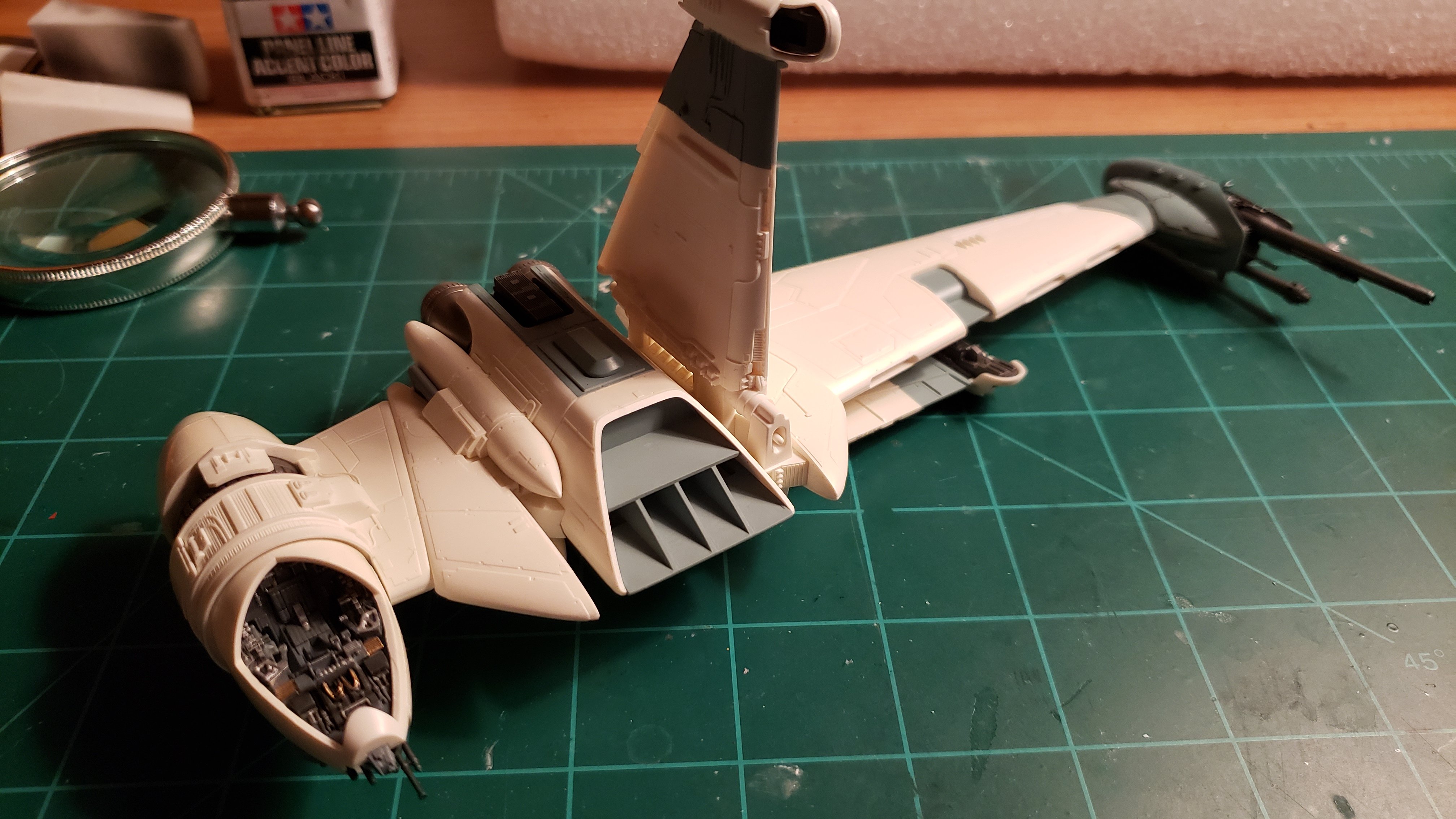

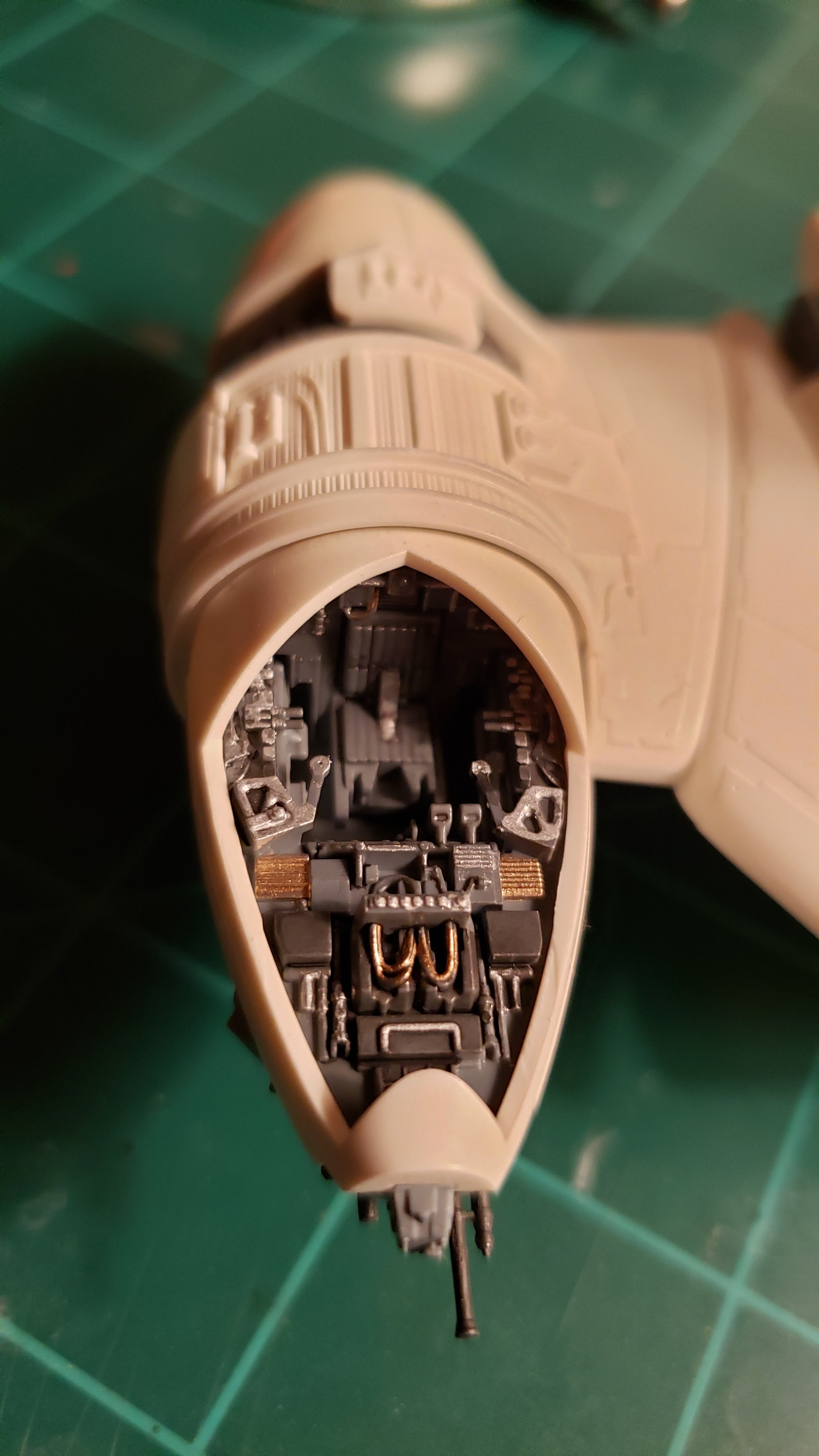

derex3592 Posted March 4, 2019 Share Posted March 4, 2019 Actual progress was made today! Cockpit detailing done and all major painting and assembly complete! Quote Link to comment Share on other sites More sharing options...
slide Posted March 4, 2019 Share Posted March 4, 2019 Just now, derex3592 said: Very Nice! Quote Link to comment Share on other sites More sharing options...
derex3592 Posted March 4, 2019 Share Posted March 4, 2019 thanks! Quote Link to comment Share on other sites More sharing options...
MechTech Posted March 4, 2019 Share Posted March 4, 2019 Yeah, Duymon, Y-M-C-A-! By the way, I waited nearly 25 years to get my own shop, so it didn't come easy. A little here and there saved up... Derex, I'm givin' your B Wing an "A"! Nice n clean. - MT Quote Link to comment Share on other sites More sharing options...

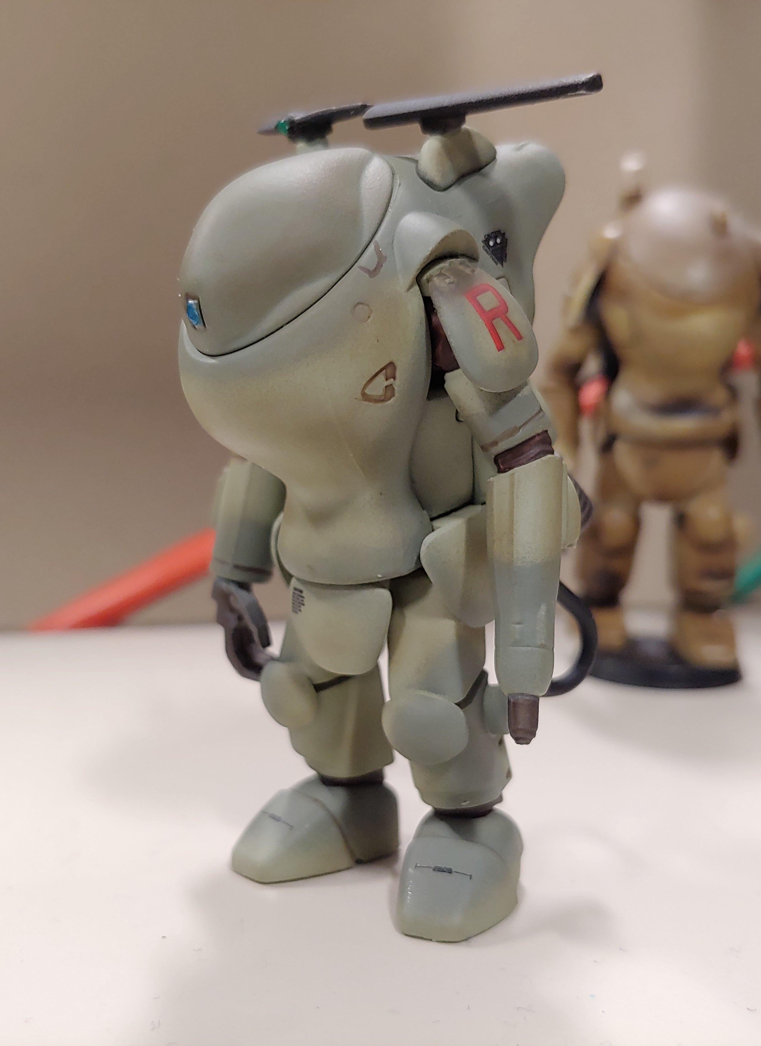

Duymon Posted March 6, 2019 Share Posted March 6, 2019 Worked on some Ma.k Snake-eyes on my last few days off from work. I'm addicted to these 2.5" tall egg soldiers :0 They have been great practice for doing free-hand two-tone camo / blending. Just a touch of tamiya weathering powder was used to add some dirty-ness and break-up some of the solid colors. Quote Link to comment Share on other sites More sharing options...

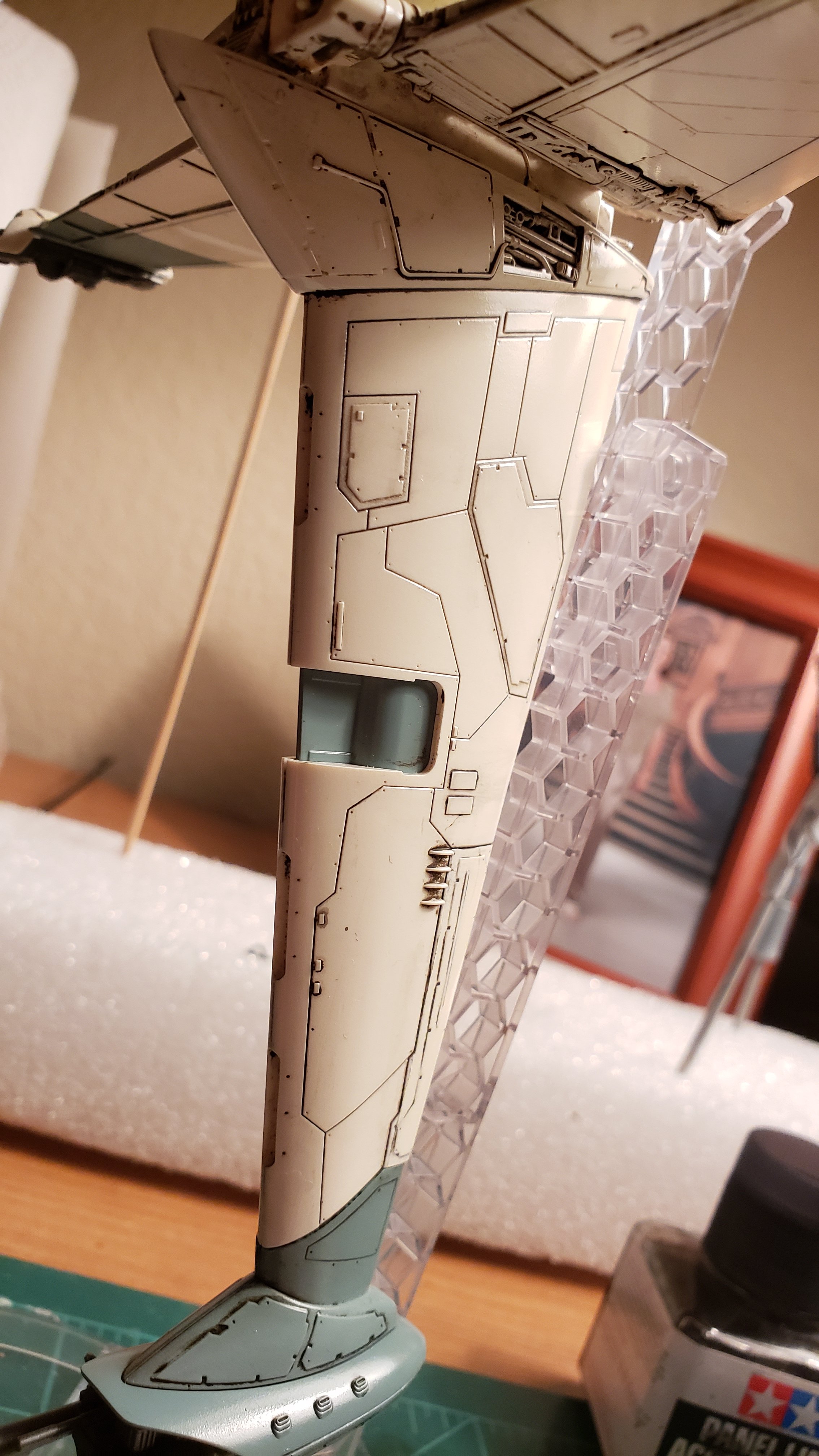

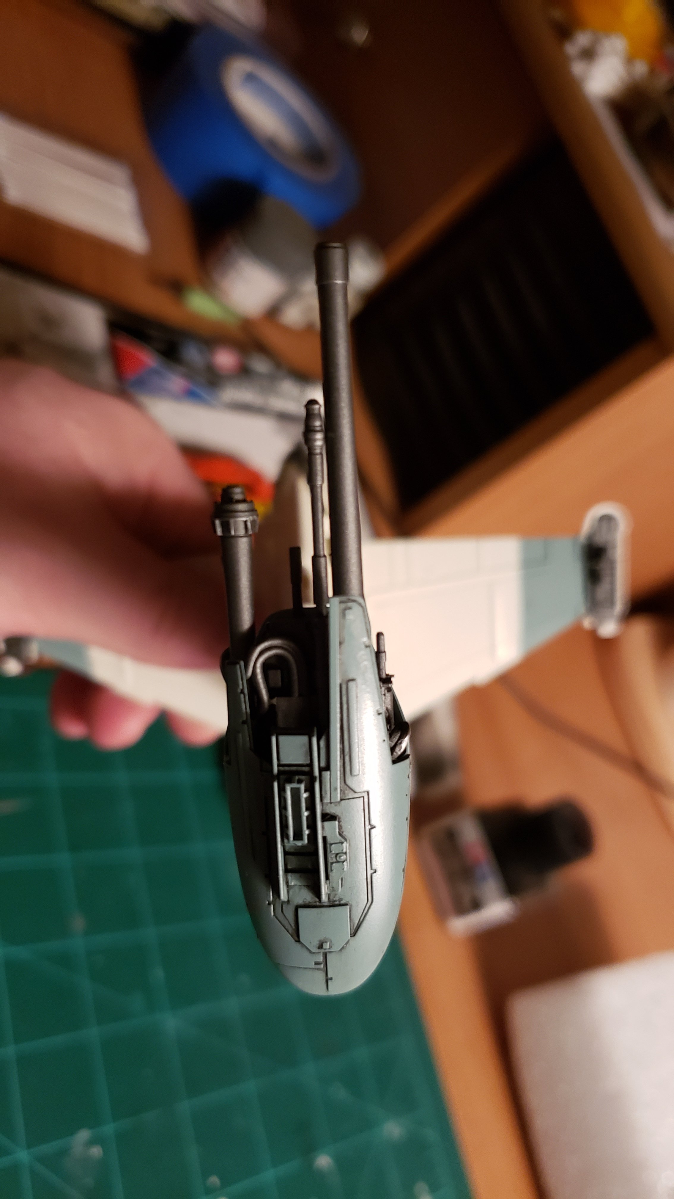

derex3592 Posted March 11, 2019 Share Posted March 11, 2019 Soooo here's a head scratcher for you guys... @electric indigo I'm looking at you buddy, cause you're paint schemes are SO pretty, Bandai B Wing - Decanted and airbrushed Tamiya TS Racing White for the main white color..ok. Fine. Paint dried and cured for a week at least whilst I worked. Gloss spray can coated two good coats of Tamiya TS Gloss coat onto model. Dried for a good day or two. Ok. Fine. Went to get the EFFING Tamiya panel line wash knowing FULL WELL from previous experience to stay AWAY from any moving parts or joints. Ok. Fine. Went to do panel lines on wing. Ok. Fine. Let Panel LIne wash dry. Ok. Fine. Qtip with just a hint of enamel thinner on the end to clean up panel line wash aaaand.....my white paint UNDER the gloss coat starts coming off. WHAT THE ACTUAL F*CK? The ONLY thing I can think of that happened this time was that I neglected to wash the parts with Dawn before I laid down the base white coat, and somehow the mold release stuff reacted badly with the paint and then the clear coat didn't seal it?????...(Never had a problem with Bandai kits having icky mold release on them to the touch)....That seems like a stretch to me, but that's all I got.. Other than throwing Tamiya Panel Line wash in the garbage and just calling it quits with that stuff as it DOESNT PLAY WELL AT ALL WITH BANDAI PLASTICS. Quote Link to comment Share on other sites More sharing options...
Duymon Posted March 11, 2019 Share Posted March 11, 2019 Wow that sucks to hear. Washing the parts is always a good idea, as well as using a good primer. I've had so many weird reactions to tamiya panel line wash that I always use flory's. Clay never killed anything. :0 Quote Link to comment Share on other sites More sharing options...
Sanity is Optional Posted March 11, 2019 Share Posted March 11, 2019 Wash and prime, and lay down a gloss topcoat before lining (especially something aggressive like Tamiya), then topcoat matte after. Quote Link to comment Share on other sites More sharing options...
arbit Posted March 11, 2019 Share Posted March 11, 2019 Thats weird Derex. The enamel wash shouldnt react with the acrylic that way. It sounds like your base coat hasnt adhered to the model. Or you used an enamel base by accident. Is it the pressure from your q-tip, or the enamel wash itself thats making the base coat come right off? Personally I cant get any wash to work cause I can never get my varnish to be glossy and smooth enough. It usually just seeps into the acrylic. But that's a different story... Quote Link to comment Share on other sites More sharing options...
derex3592 Posted March 11, 2019 Share Posted March 11, 2019 (edited) The TS spray paints are lacquer based, which should be hard as a rock and especially with the TS Gloss over it (twice). Wasn't the pressure of the q-tip, I was verrrry lightly swabbing. I agree with the above statement that the base coat didn't adhere to the model properly, probably because of lack of proper washing. I have never primed Bandai SW kits, just never saw the need, not to mention the parts are molded in the color that they are supposed to be, so adding paint on them is super easy without having to worry about shade changes over primer. Not to mention Tamiya Fine Surface Primer is like fricking gold press latinum $$$.. I have used Flory's on most of the model, I was just trying to touch up the finer panel lines with the Tamiya stuff. Will post some pics later tonight. EDIT -- It must be said, I've done this method before on my Republic Star Destroyer and it worked fine, but I DID wash AND PRIME that kit....hmmmm Edited March 11, 2019 by derex3592 Quote Link to comment Share on other sites More sharing options...
derex3592 Posted March 11, 2019 Share Posted March 11, 2019 (edited) EDIT II -- From Tamiya's Website -- sooo..it's a "synthetic lacquer"...ya gotta wonder WTF that actually means... Also you gotta love the statement "NOT affected by acrylic or enamel paints"...uhhhh...riiiiggght... TS These cans of spray paint are extremely useful for painting large surfaces. The paint is a synthetic lacquer that cures in a short period of time. Each contains 100ml of paint, which is enough to fully cover 2 or 3, 1/24 scale sized car bodies. Tamiya spray paints are not affected by acrylic or enamel paints. Therefore, following an overall base coat, details can be added or picked out using enamel and/or acrylic paints. By combining the use of these three types of paints, the finishing of plastic models becomes simpler and more effective. Edited March 11, 2019 by derex3592 Quote Link to comment Share on other sites More sharing options...
electric indigo Posted March 11, 2019 Share Posted March 11, 2019 True bad luck, man. I always try to stay on the low end of complexity. Washing the kit just before paint application is always a good idea; in most cases, it's not the ominous mold release agent, but the residues of our own greasy fingers that gets us into trouble later. If the kit's plastic already has a fairly homogenous color and you're going for a weathered paint job anyway, skip the primer. If you're not applying decals with large transparent areas, skip the interim gloss coat. I prefer water-based washes like Floquil or artist gouaches to anything solvent-based. Add a drop of dish-washing detergent to the water if you're using gouaches to make the paint flow better. Quote Link to comment Share on other sites More sharing options...

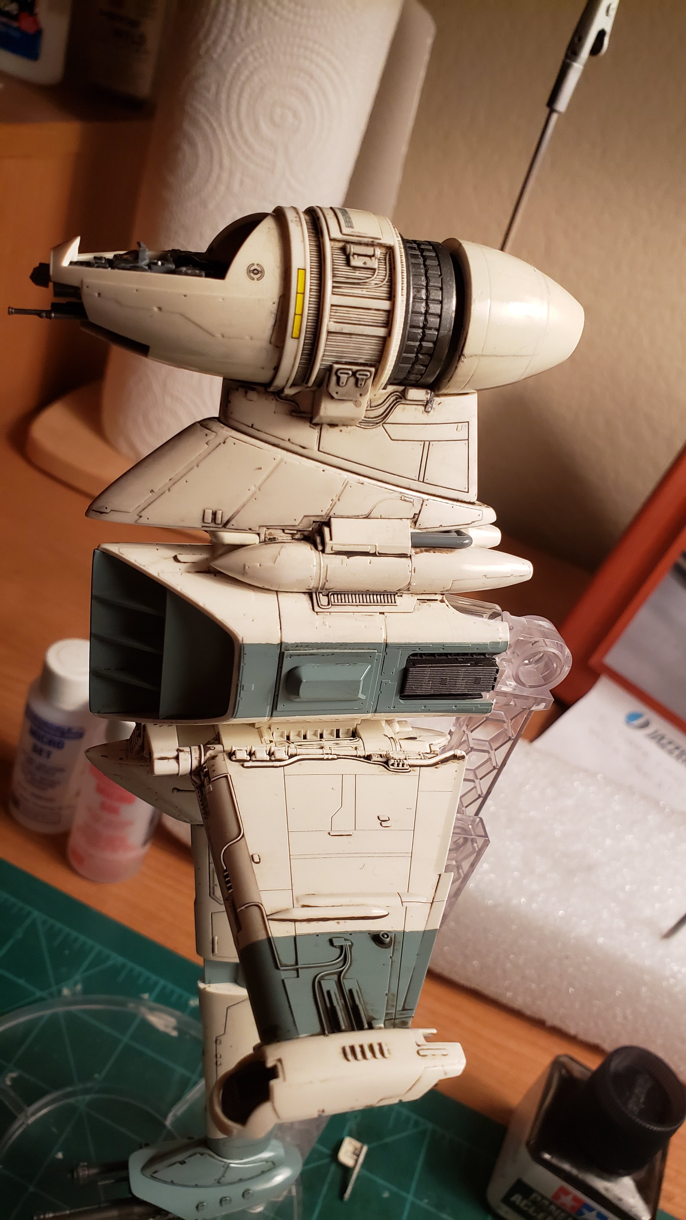

derex3592 Posted March 12, 2019 Share Posted March 12, 2019 Thanks for the tips @electric indigo. Sometimes I think I do over complicate these things under the guise of "But I saw it on YouTube and it looks super easy!" Anywhoo.. I've remasked and repainted /repaired the damaged areas... mostly I think and hit it with the Florys again, here's how things look so far... Quote Link to comment Share on other sites More sharing options...
arbit Posted March 12, 2019 Share Posted March 12, 2019 Derex. I think your dirt thumbs are to blame here. Quote Link to comment Share on other sites More sharing options...

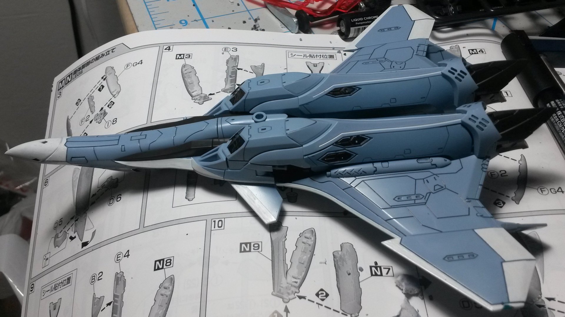

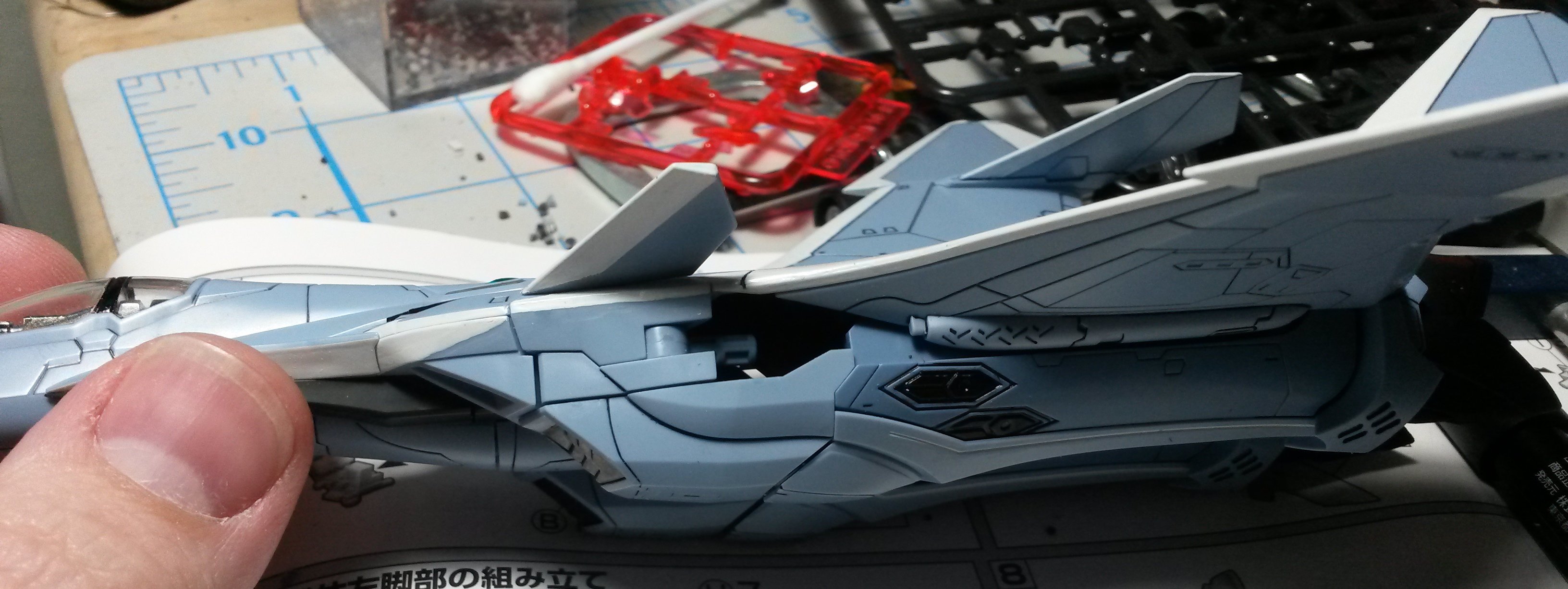

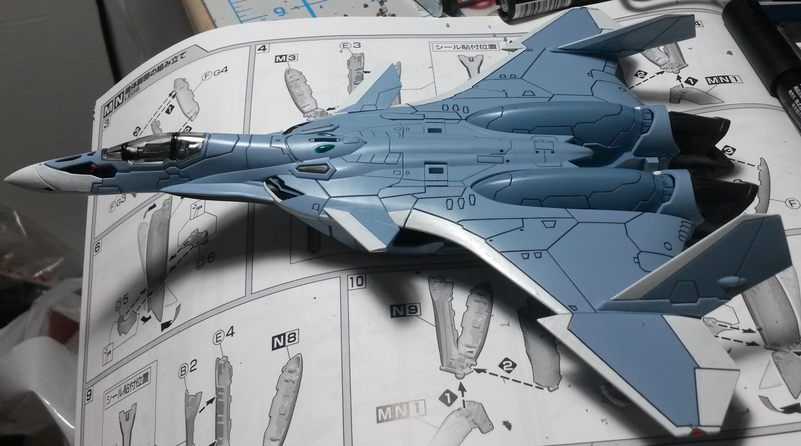

Sanity is Optional Posted March 13, 2019 Share Posted March 13, 2019 Been building the Aoshima VF-31a. Haven't started on the Catgirl yet, more interested in the VF. Paint's a bit sloppy, since entirely done with gundam markers (and a 1mm Molotow Liquid Chrome pen). I'm a little annoyed that the panel lines are so much deeper on the wings than the rest of the kit. Quote Link to comment Share on other sites More sharing options...
