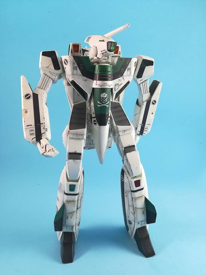

electric indigo Posted November 22, 2018 Posted November 22, 2018 (edited) Belly of the dragon Decals are flat coated and misted over with light grey to bring down the saturation. Edited November 22, 2018 by electric indigo Quote
slide Posted November 22, 2018 Posted November 22, 2018 (edited) 4 hours ago, electric indigo said: Belly of the dragon Decals are flat coated and misted over with light grey to bring down the saturation. That's gorgeously done Indigo! Query: were they simply too saturated off-the-decal-sheet? or did you do it for weathering purposes? if the latter: would the underside roundels really fade like that [being on the "dark side"of the plane 90% of the time]? I would assume the paint they use for hi-viz national markings like Sweden is pretty vivid out-of-the-can. Edited November 22, 2018 by slide Quote
Gabe Q Posted November 22, 2018 Posted November 22, 2018 2 hours ago, electric indigo said: Decals are flat coated and misted over with light grey to bring down the saturation. Your builds are always so clean and professional looking! I always enjoy everything you post. Quote
electric indigo Posted November 22, 2018 Posted November 22, 2018 Thanks, guys, alway a pleasure to entertain you. Slide, I have seen photos of faded roundels on the underside of the plane, I guess they pick up a lot of dirt from the runway. But I mainly dusted them to tie them into the overall color scheme, I like to approach my builds with a baked-in atmospheric haze in mind. When I was younger, I noticed that my aircraft kits always looked more realistic in color after a thin layer of dust had settled on them, so now I try to get that look from the beginning. The Hasegawa kit is absolutely awesome, btw. Quote

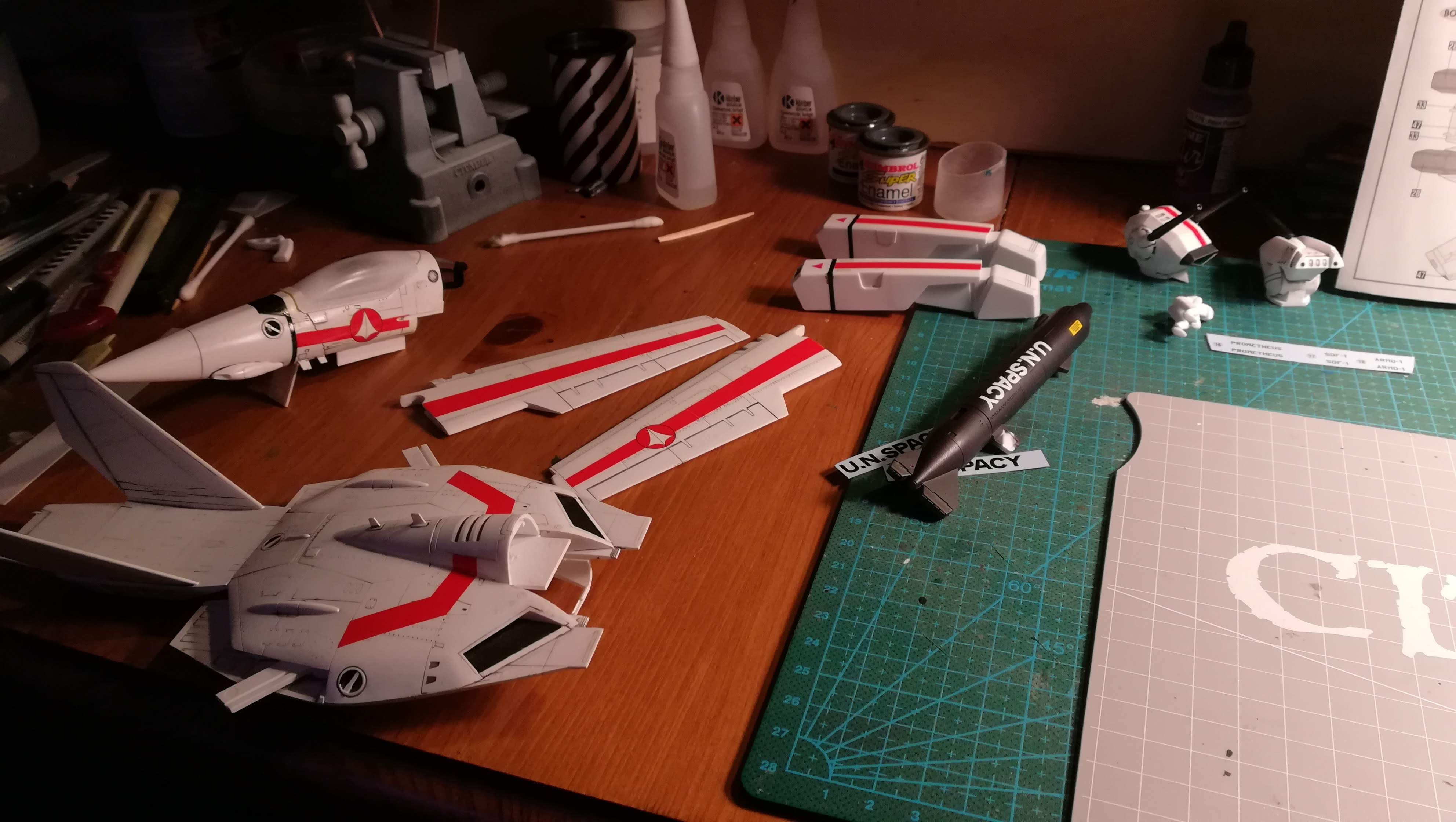

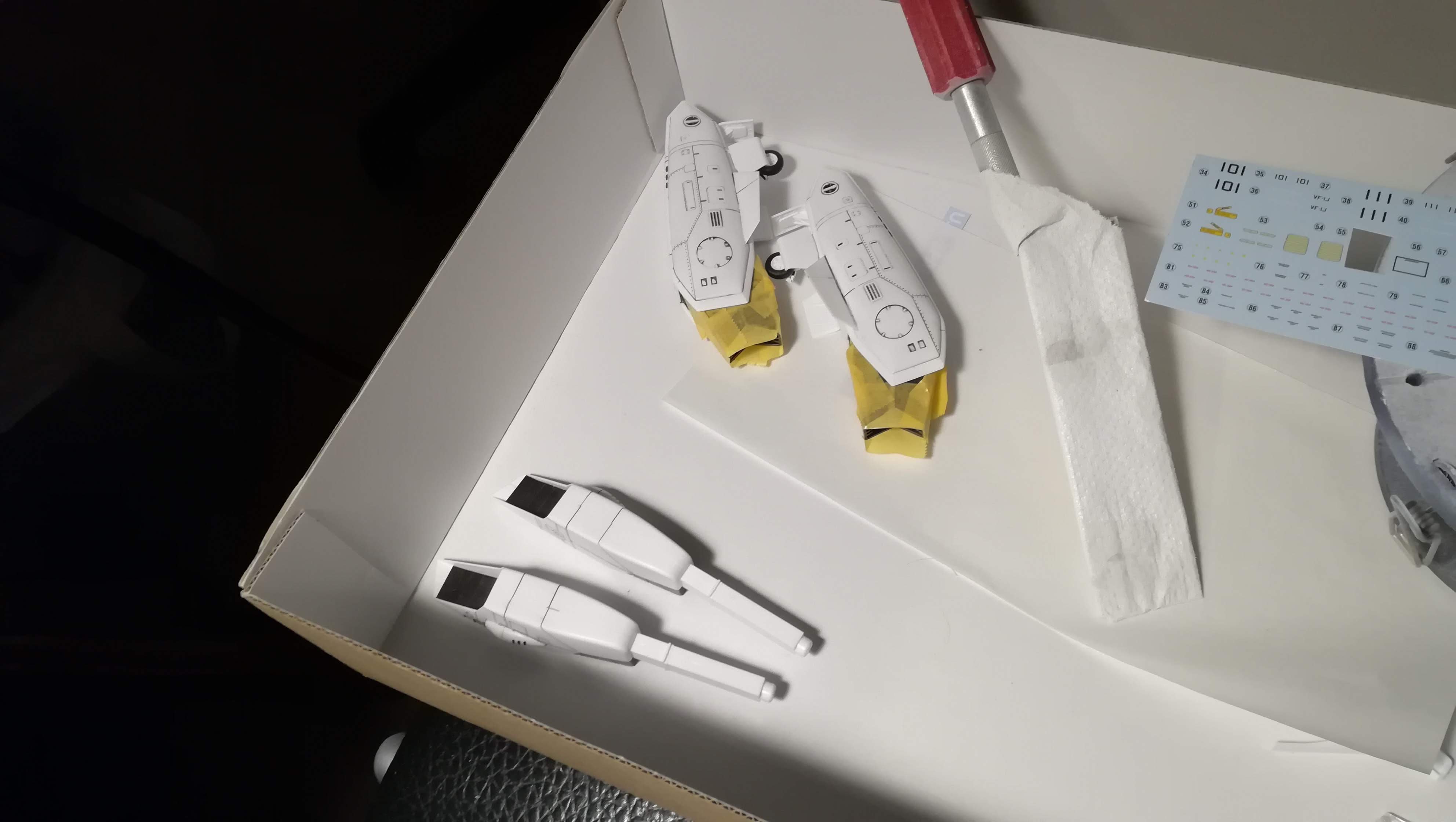

valkyriepm Posted November 28, 2018 Posted November 28, 2018 Hi guys! Long time since I built a Macross model. I have like 15 models to build, so it was about time. Anyway, working on Kakizaki's super battroid. Working on fast packs and gun pod right now.... Martin Quote

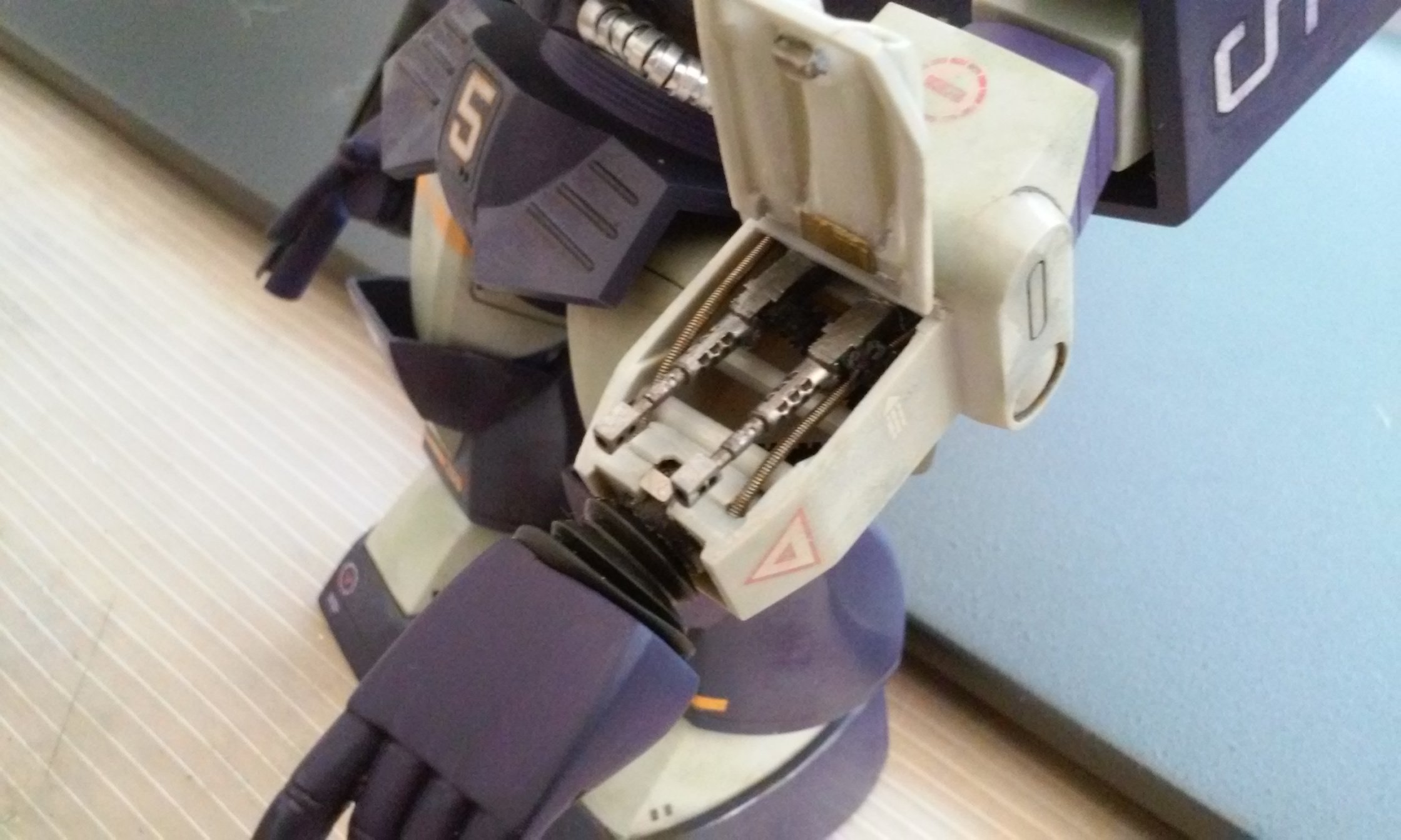

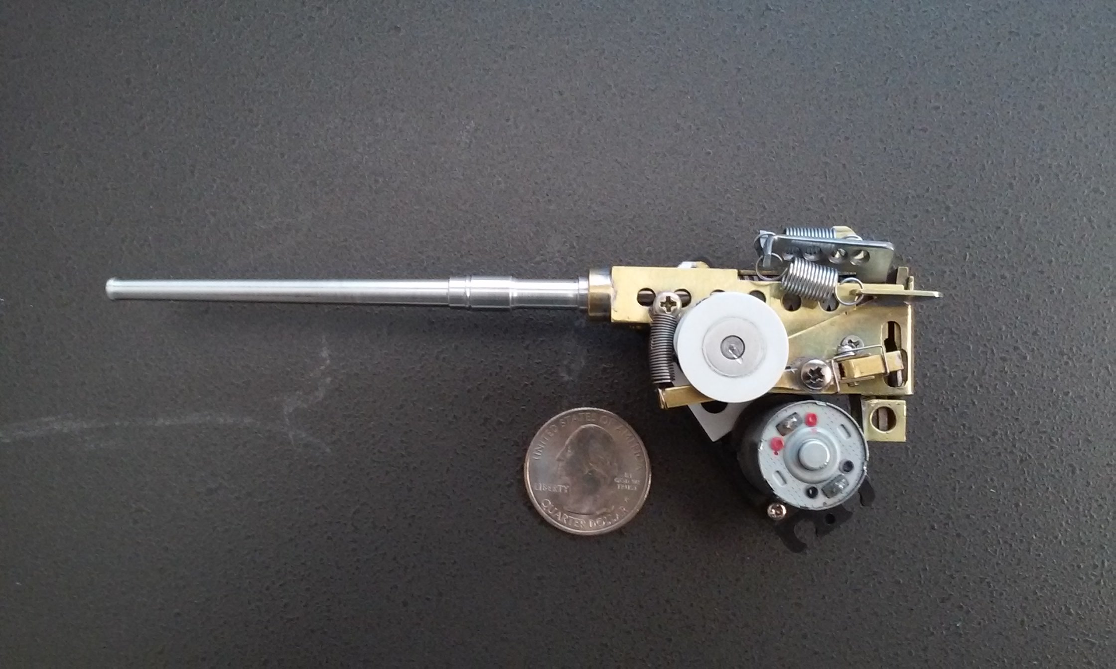

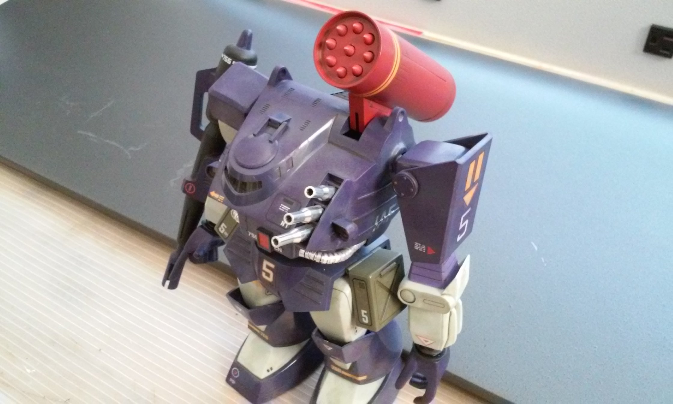

MechTech Posted December 2, 2018 Posted December 2, 2018 Brett and Pengbuzz, I love the creativity you both took with your projects. Brett, that was cool going with a Vietnamish-era looking paint scheme. Pengbuzz, that was great taking an F-15 and bashing it with a Transformer! Electric Indigo, I love how you treated the decals to make them look more realistic. That is the next best thing to decal setting solution. Both together look very realistic! Valkyriepm - You're still alive! Good to see Kakizake getting some love! Great paint effects. Long work hours and the commute has cut my "fun" time down. So sorry I don't chat with you guys more. I'm glad to see the great work being posted here though! What have I been doing? For the past several months, bits and pieces as time (and family) allows. I'm calling the Dougram Ironfoot done. The right knee joint broke and I can't fix it due to the wires running through it. So any more handling like further painting could permanently damage it. Sorry, my camera needs to be replaced! Lathed down the old rocket ends and fitted them into styrene tube to extend them and make them more white painting wise. Too much paint will get scraped off if they are removed. What has taken up my hobby time the most is an upcoming ship build. I want to build a large and fast R/C ship. A modern corvette or light frigate which of course there are no large kits of in 1/72nd scale or similar. I think a cool idea would be to have the cannon fire caps! There are no electric cap guns that I have found, so I had to engineer one (actually two). The first design is small and lightweight. It uses a rotating cylinder to pick-up a brass tube piece with a cap on the end from the spring-fed magazine below it. One end of the cylinder is a helix that simultaneously cocks the hammer back and releases it at the right point. PROS: Lightweight, fast and small. CONS: Jams easily, caps don’t always sit right on the tube despite a tight fit and caps have to be cut-out and refitted each use. Only holds 8 rounds. First cylinder auto-cap-cannon photo, at rest. Second, cocked. The second design uses a bolt that is hollow. It has gear teeth on the bottom that are engaged by a pinion gear that cocks it back. The bolt has an insert that strikes the cap as it is released backward when the pinion gear’s teeth run out (similar to some airsoft gun mechanisms). The same shaft also turns a cam that drives a feed arm to advance the cap strip. PROS: Highly reliable, louder (caps and striking force). Can fire several strips inter-locked as a belt. CONS: bigger, heavier, slower, needs more power to run (also making it heavier). First auto-cap-cannon photo, at rest. Second, cocked. Third, loaded with a cap strip. The second design will be used because I can trust it to not jam and it is louder. Next step is to create the turret. It will be the Leonardo (ex-Oto Melara) 127/64 light weight (5 inch/127mm) gun. The barrel is already turned to match its appearance. The barrel only weighs 1 gram by the way. Its hollow to allow smoke and effects to pass through it as a real cannon. That’s it for now. Chat with you guys later! - MT Quote

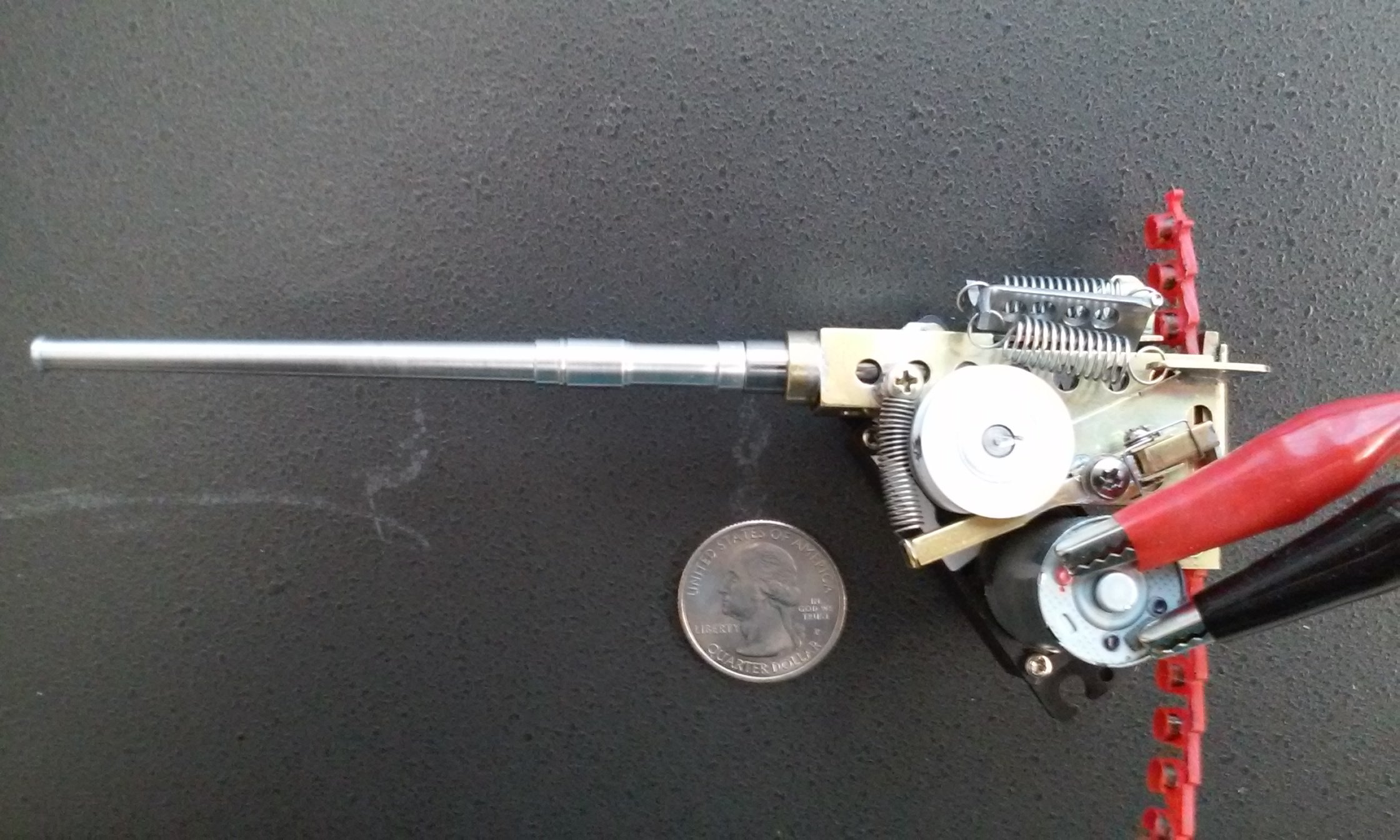

electric indigo Posted December 4, 2018 Posted December 4, 2018 On 12/2/2018 at 10:24 PM, MechTech said: Amazing work! But won't you run out of space when the "ammo belt" advances? Quote

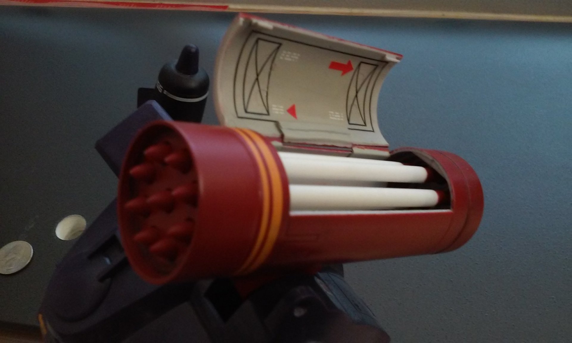

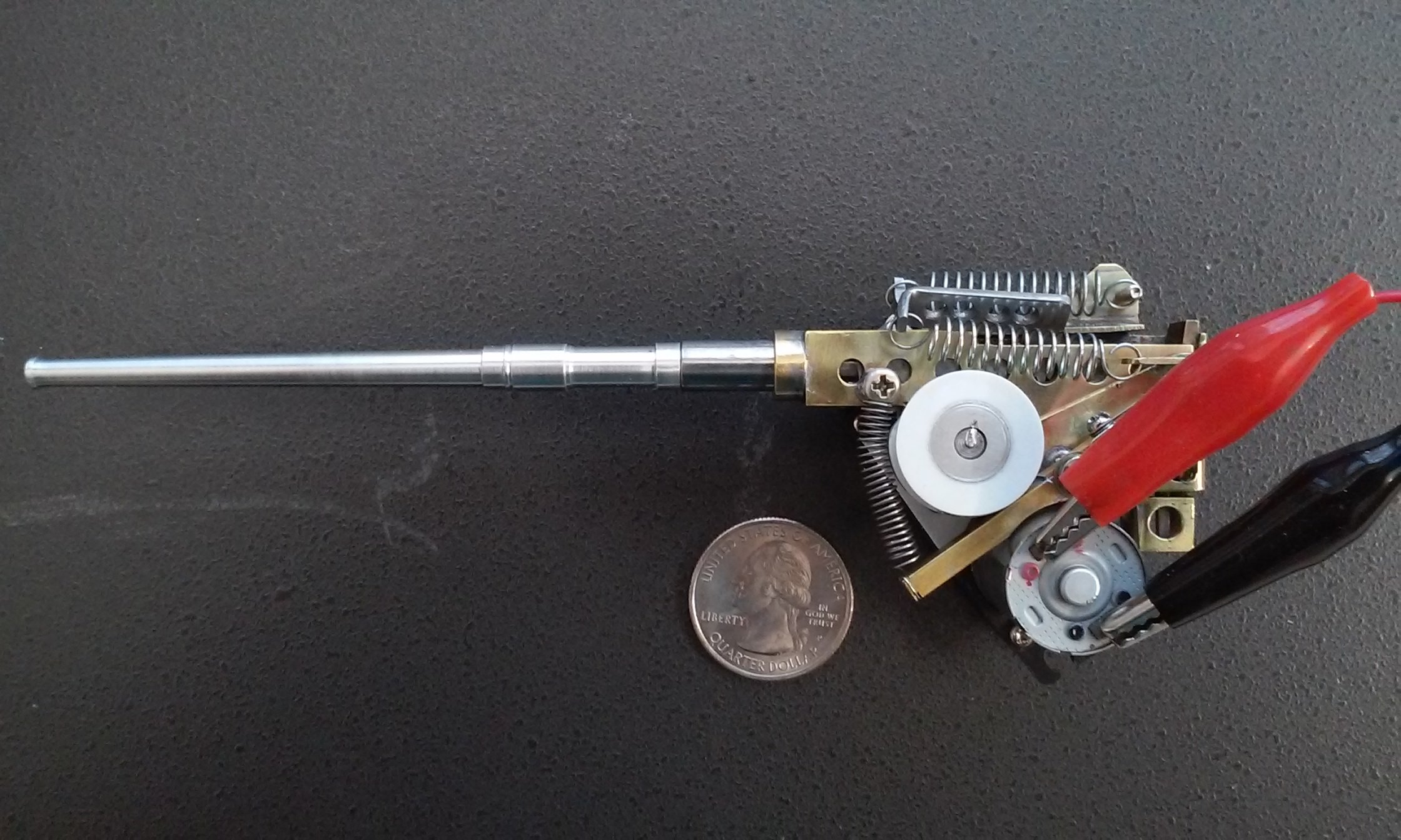

MechTech Posted December 4, 2018 Posted December 4, 2018 Lt. Zombie, that's a great change to the engines! Electric Indigo, Thank you! The belt will actually bend into a loop inside the turret. The strip caps can link together so it will be a big loop inside the turret and into the base. - MT Quote
arbit Posted December 5, 2018 Posted December 5, 2018 valkyriepm, really nice weathering on that valk. I've been watching TONS of weathering tutorials. Now I need a subject to work with. Lt. Zombie, great scratch work there. I follow Ken Spriggs amazing detailed scratch work step-by-steps. Check it out! Mechtech, your lathe hobby continues to shock and awe me. As for me, I really like making my models move, so I have been studying how to control stepper motors with different Arduino driver boards and CNC conrol boards. I've never used steppers yet in my builds, only servos and DC motors so far. Since I have no programming knowledge, it's always months of study and research till I figure things out and find codes and wiring diagrams that work for me. I'm really excited about micro stepper because they don't need limit switches and are as small as 6mm. But so far I've found that micro steppers have too little torque to be useful in our models, unless I learn how to gear them up or design nearly weightless moving parts with low friction. Big Nema steppers are very powerful, but of course they don't fit in my scale models. Quote

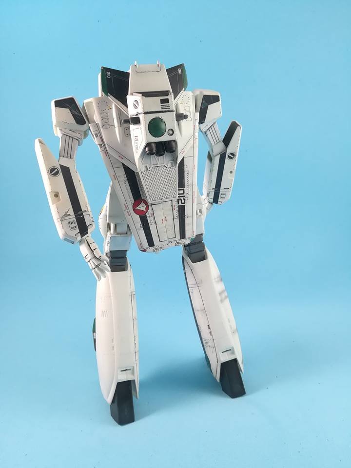

electric indigo Posted December 6, 2018 Posted December 6, 2018 Final steps on the Draken. For the cockpit, I made the two small struts inside the canopy from stretched sprue. And we have liftoff I have to paint & install the pitot tube and the position lights. Also, a set of missiles is on order. Quote
wm cheng Posted December 6, 2018 Posted December 6, 2018 30 minutes ago, electric indigo said: Final steps on the Draken. For the cockpit, I made the two small struts inside the canopy from stretched sprue. And we have liftoff I have to paint & install the pitot tube and the position lights. Also, a set of missiles is on order. WOW!!! I absolutely love your builds Electric Indigo - they are so clean and flawlessly smooth - your paint is just so awesome that it really gives the tiny model a real sense of scale. Plus I love the subject matter you always choose. Thanks for posting because I can get my fix by living vicariously through you - I have such little time to model anymore and trying to go through a basement renovation means I won't have a workbench for at least another year Quote
