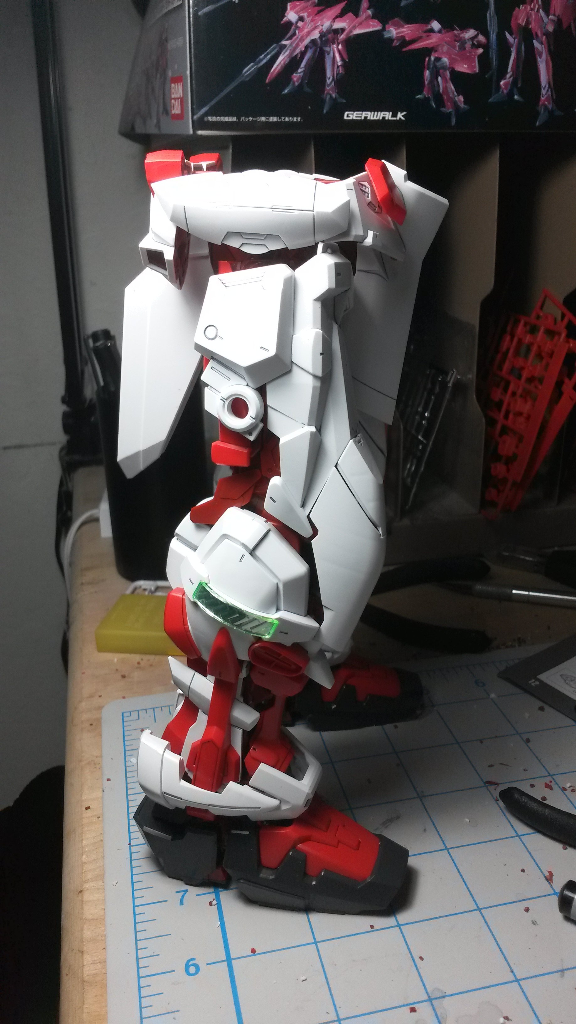

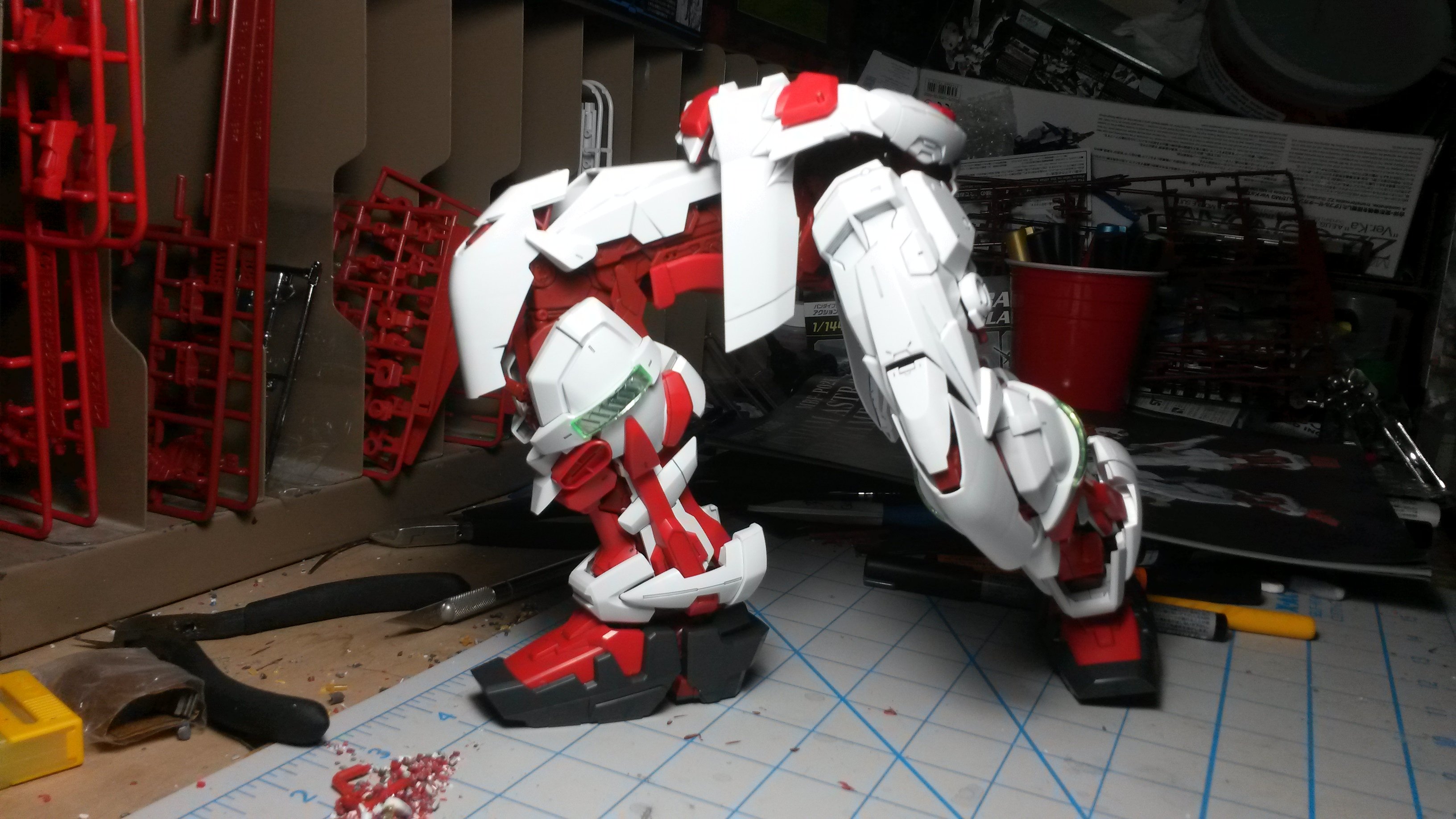

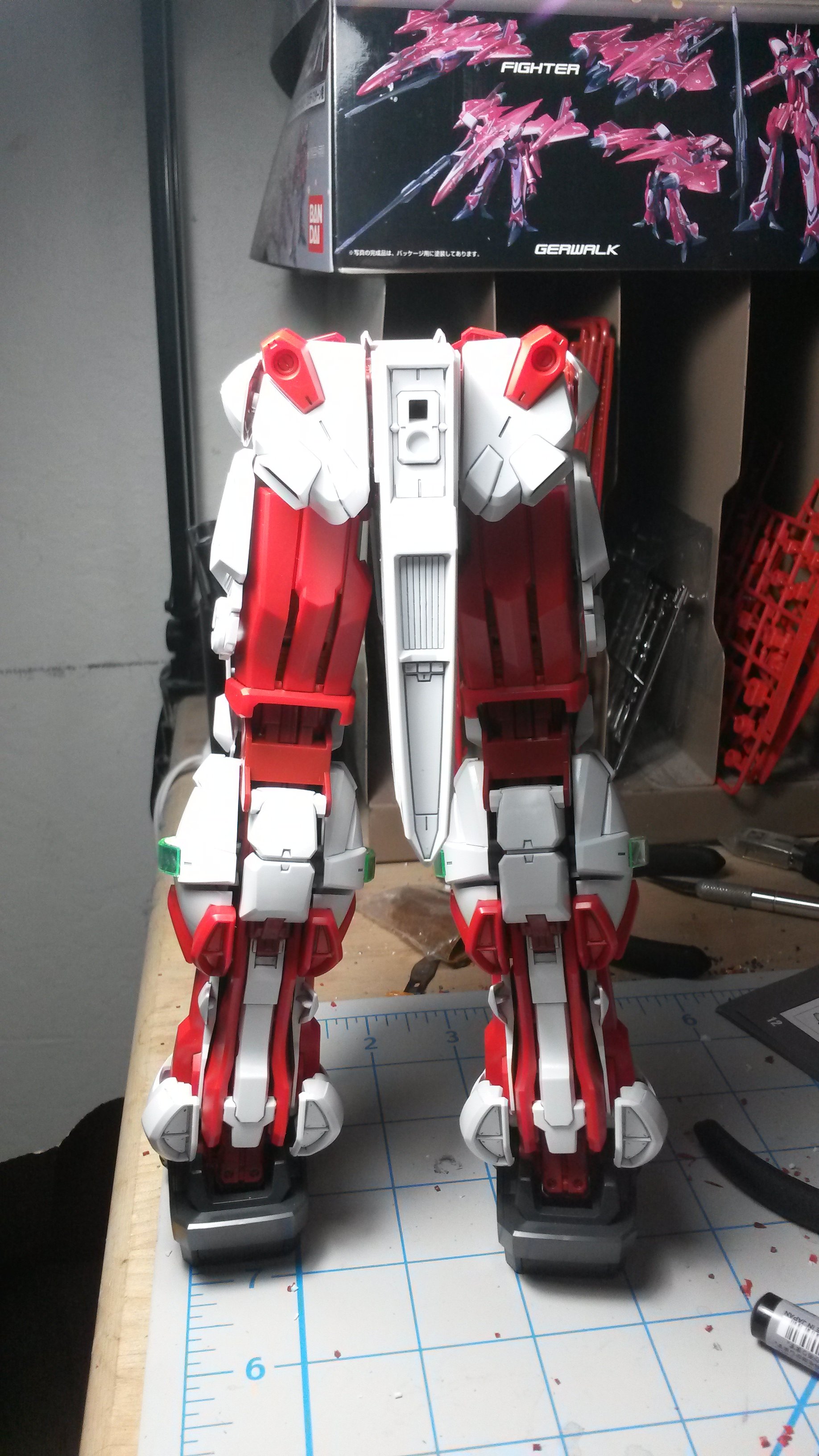

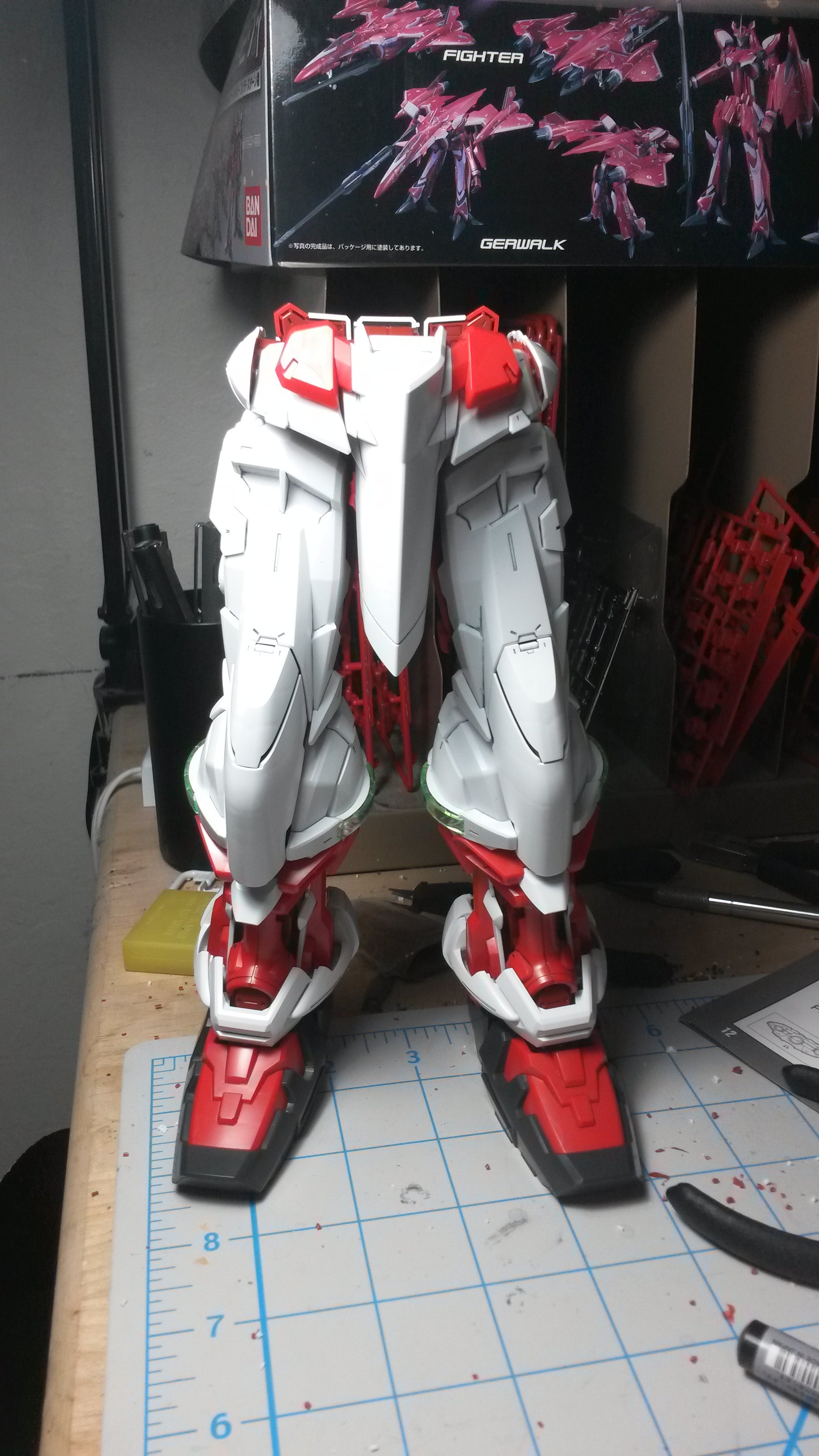

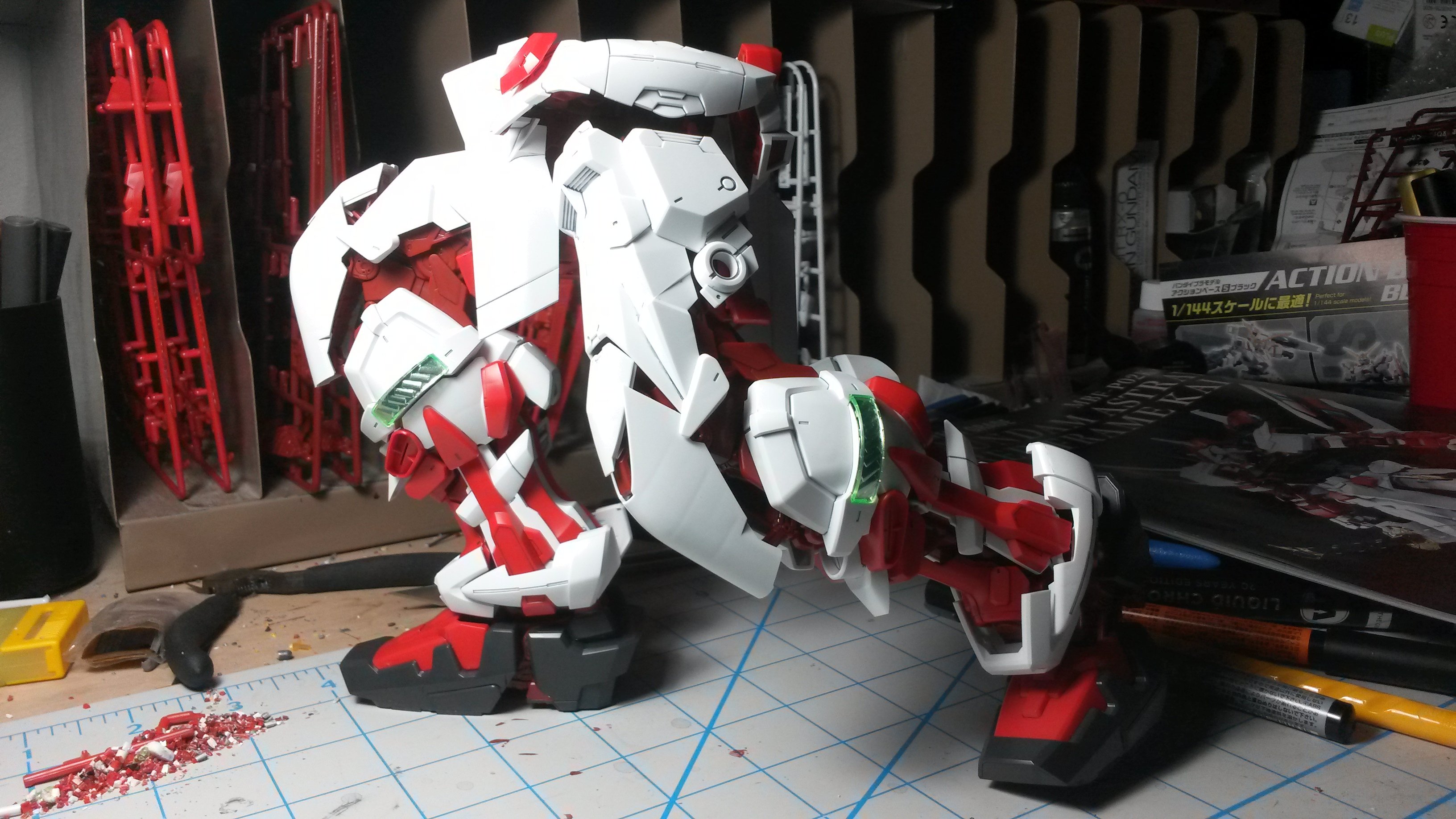

Sanity is Optional Posted August 14, 2018 Posted August 14, 2018 (edited) Decided to tackle one of the larger boxes in my backlog. Nothing that requires too much skill, but it's satisfying none the less. Perfect Grade Astray Red Frame Kai. No other plastic kits I have ever seen beat Bandai's Gundam kits for sheer mechanical intricacy and moving parts. Edited August 14, 2018 by Sanity is Optional Quote

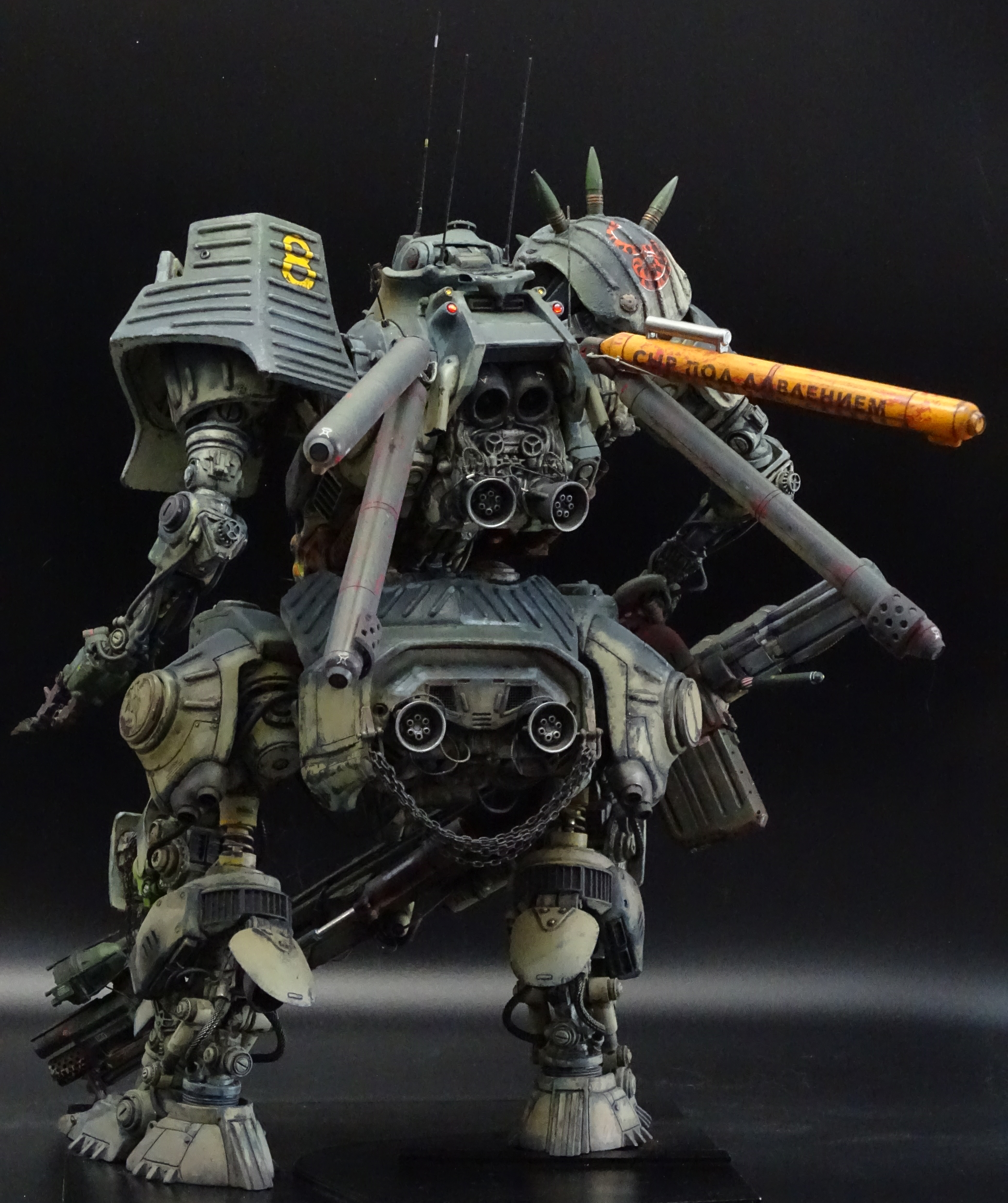

SuNDuK Posted August 14, 2018 Posted August 14, 2018 (edited) On 7/2/2018 at 6:37 AM, Kylwell said: Industria Mechanica's production of Kallamity's Breigel. Scratched a new gun, vents, smoke launchers. tanks, and right shoulder armor. Fantastic looking! But why texst says "Cheese under pressure"? And my under costruction: Spoiler \ Edited August 14, 2018 by SuNDuK Quote

Kylwell Posted August 18, 2018 Posted August 18, 2018 On 8/14/2018 at 4:23 AM, SuNDuK said: Fantastic looking! But why texst says "Cheese under pressure"? Reveal hidden contents \ It's a running joke. Can't remember why exactly but large containers of pressurized cheese just seem funny. A friend is going to have a largish pipe running to a spaceship he's building that'll be labeled 'Warning Pressurized Cheese". Quote

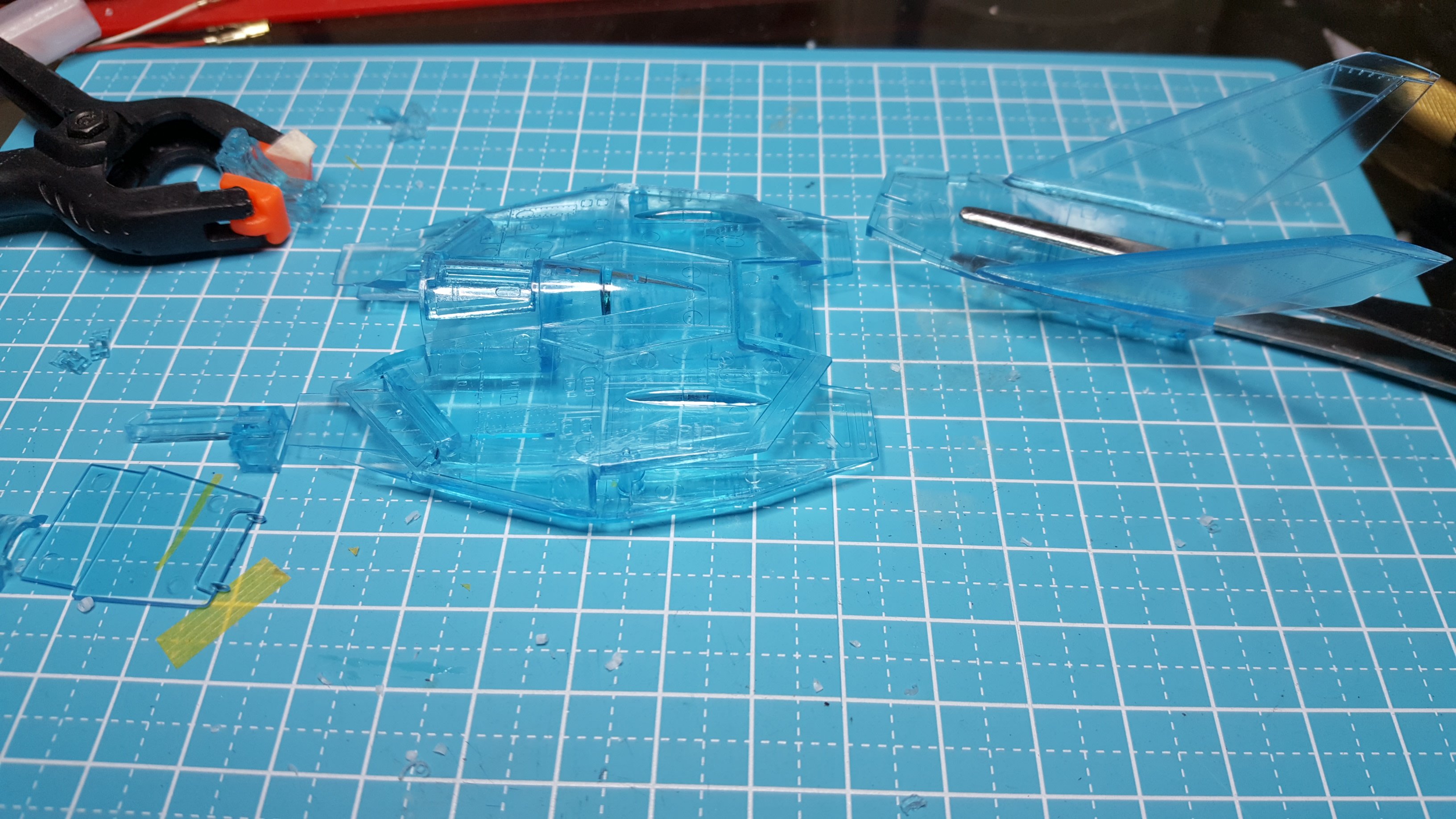

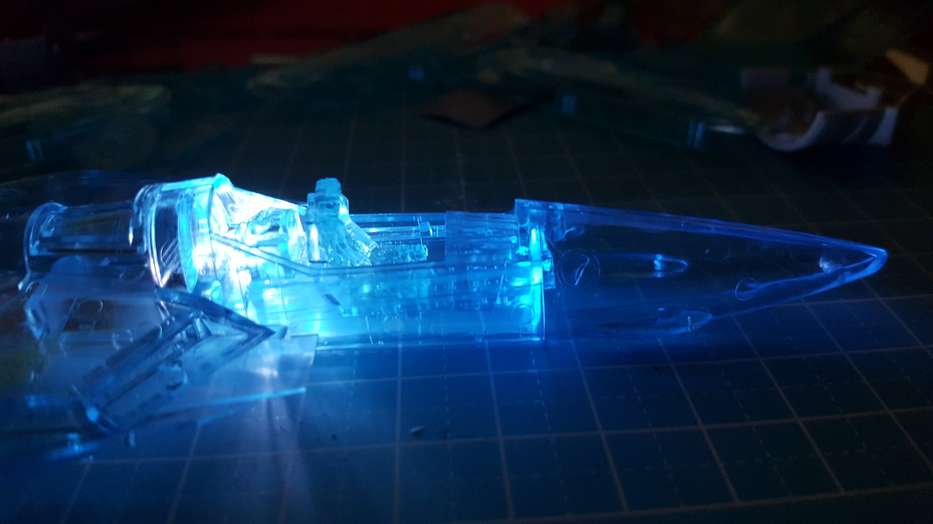

arbit Posted August 18, 2018 Posted August 18, 2018 Working on this clear Hase Vf-1J, I ordered by accident. I really don't know what to make of it. It's all brittle like a canopy and difficult to work with. I'm definitely building it clear, so testing white glue and clear canopy glue. I've even tried a bit of normal cement to see how it looks. But what do I do with seam lines, especially the nose cone? Can't hide those. Because I have to build this basically without any sanding so I don't ruin the clear cast. One idea is to treat it all like a canopy... micro sand and dip in clear. But that nose cone isn't going to be pretty. On the positive side, some lighting would make good use of the clear cast, but all those wires will show through... Maybe a good thing? Not sure. Or do I keep lighting to a minimum, under the cockpit and engines, and maybe the wings. And then in the end how will decals look on it. It's a bizarre thing.... but it is a nice challenge to build a clear valk without messing it up. Quote
arbit Posted August 22, 2018 Posted August 22, 2018 I learned some tricks for cutting and polishing clear parts here. But still not sure how to hide seam lines on the nose cone with clear parts. I plan to do some tests on spare parts to see if I can glue the seam with a non-corrosive glue and repolish to a glass finish. Quote
Grayson72 Posted August 22, 2018 Posted August 22, 2018 (edited) Arbit, just for kicks see if you can glue the parts together with future floor polish. I have no idea of this will make those seams disappear but I have glued photo etch together with Future and it worked well. Edited August 22, 2018 by Grayson72 Quote
Chronocidal Posted August 22, 2018 Posted August 22, 2018 I think the thing to keep in mind, and what will make that kit really difficult, is that even if you can polish the seams, you will have seams on the inside too. I'm thinking that the only way you'd ever truly be able to get rid of seams would be to physically melt the parts together, and then polish the seams on both front and back. Quote
arbit Posted August 22, 2018 Posted August 22, 2018 (edited) 2 hours ago, Grayson72 said: Arbit, just for kicks see if you can glue the parts together with future floor polish. I have no idea of this will make those seams disappear but I have glued photo etch together with Future and it worked well. Good idea. Definitely will do that for the small parts, because even with canopy glue, while it dries clear, it does not level very well and you can see its texture through the part. 13 minutes ago, Chronocidal said: I think the thing to keep in mind, and what will make that kit really difficult, is that even if you can polish the seams, you will have seams on the inside too. I'm thinking that the only way you'd ever truly be able to get rid of seams would be to physically melt the parts together, and then polish the seams on both front and back. Agreed. The seams cannot be hidden as far as I can tell. The trick is to put minimum glue, so that the glue doesnt run on the reverse side, which shows through the top layer, and to at least get a glossy clear seam (after a canopy style polish). Edited August 22, 2018 by arbit Quote
arbit Posted August 23, 2018 Posted August 23, 2018 5 minutes ago, Grayson72 said: That looks really cool! Glad u like it. I'm just trying to figure out what to do with it. Realistic lighting seems out of the question. Quote
