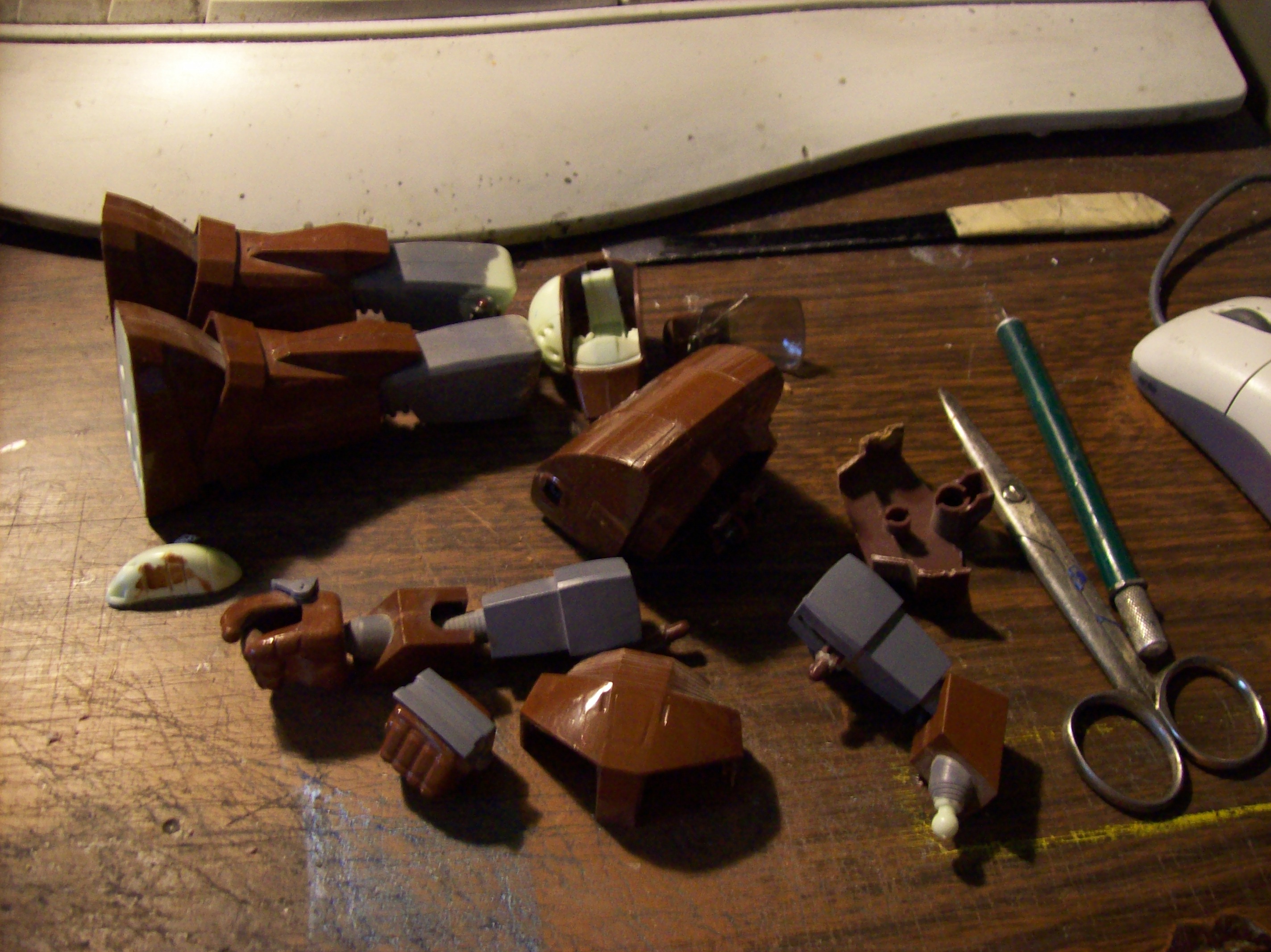

Okay, got this today:
It looks like "Condar" from the "Robotech Defenders" line (Fang of the Sun Dougram's "Bushman" if memory serves).
So...who thinks this model is doomed, and who thinks I can save it? Bets anyone?
Update: I apparently have most of the actual "Dougram" model as well (will take photos in a bit); just missing the head and weapons amongst a few other things.. I'm going to see if I can scratchbuild the missing parts on each.
Stay tuned... :D

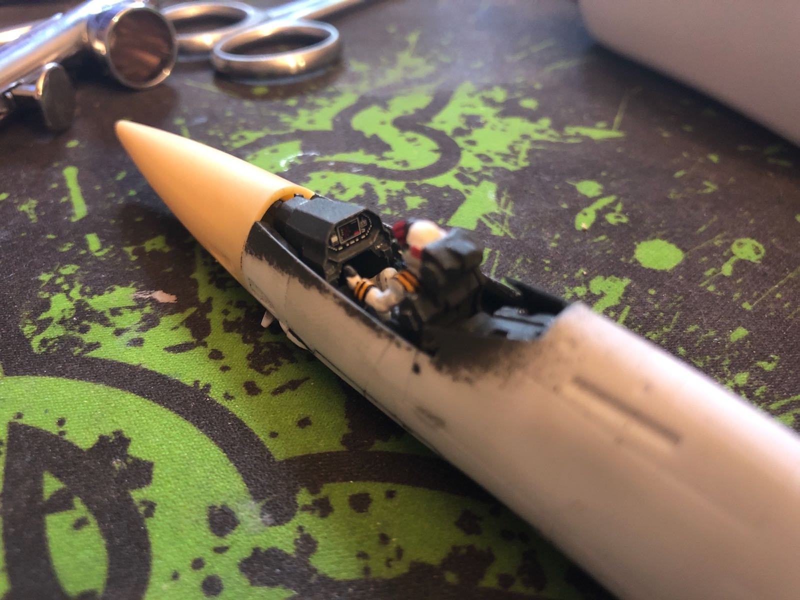

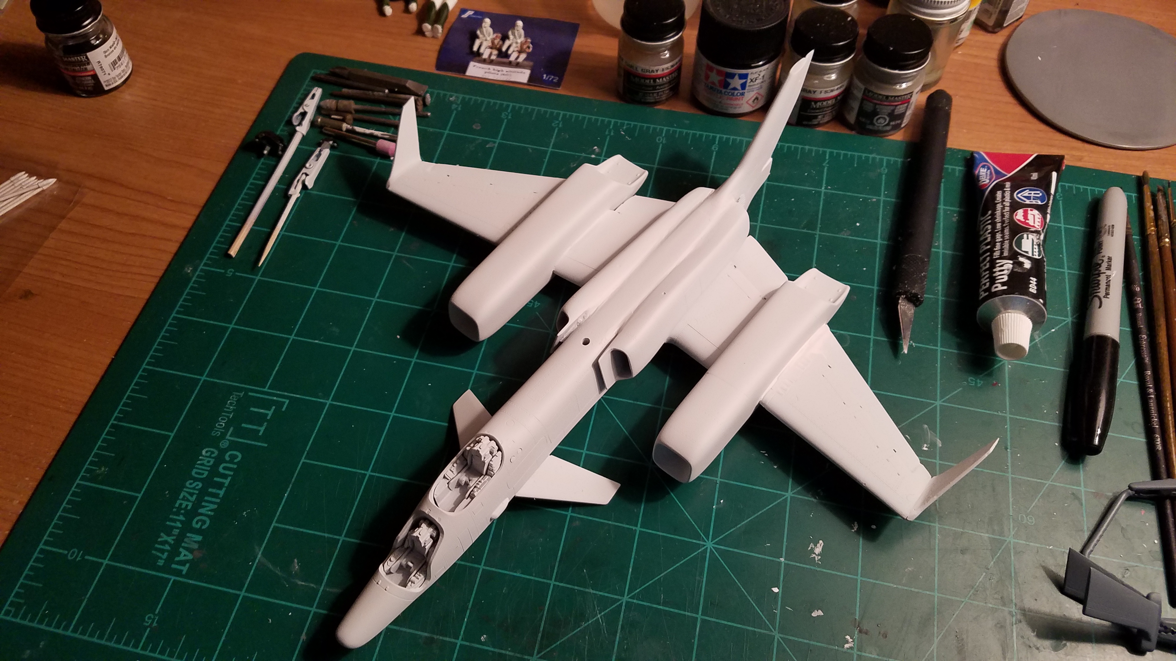

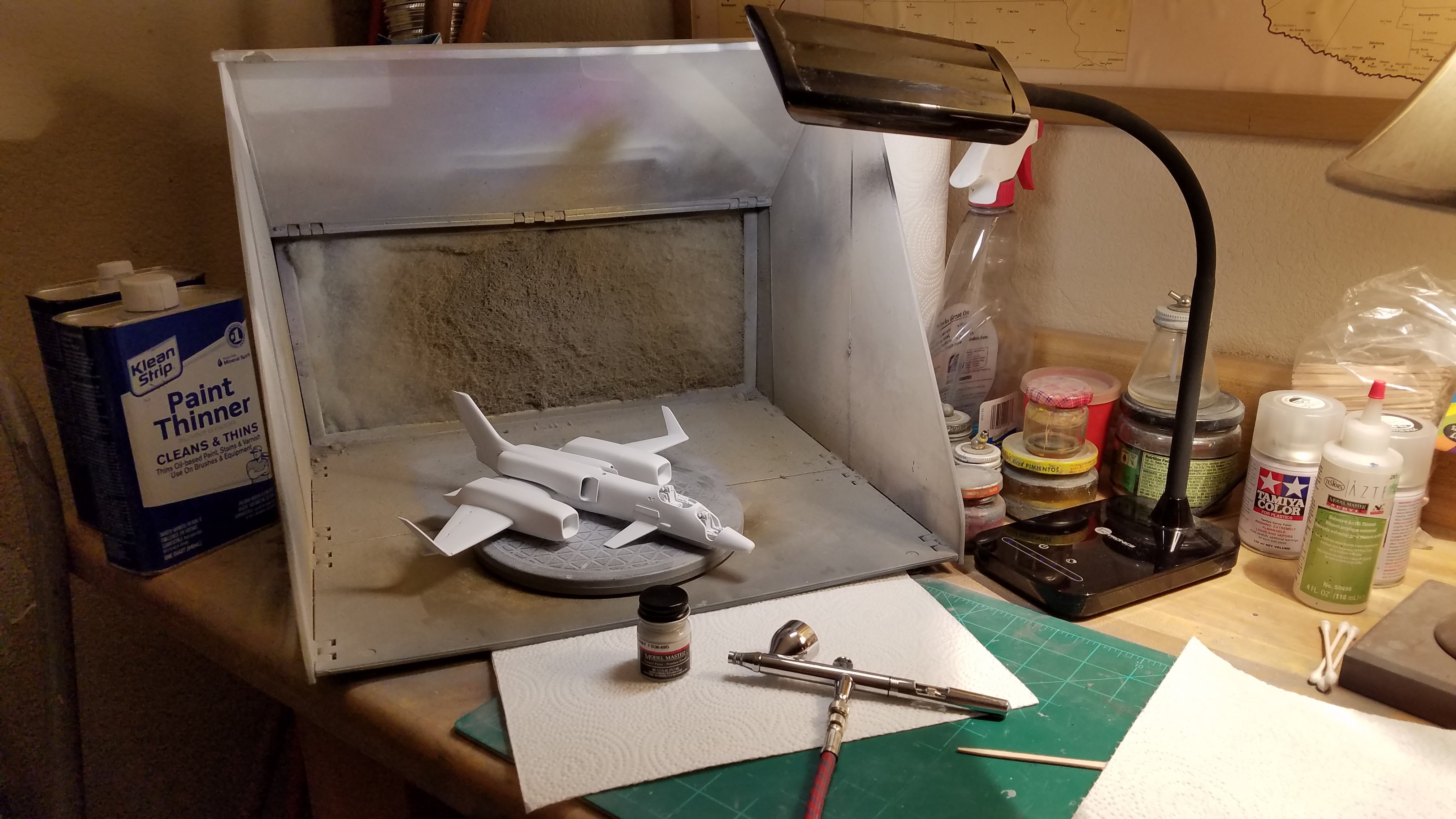

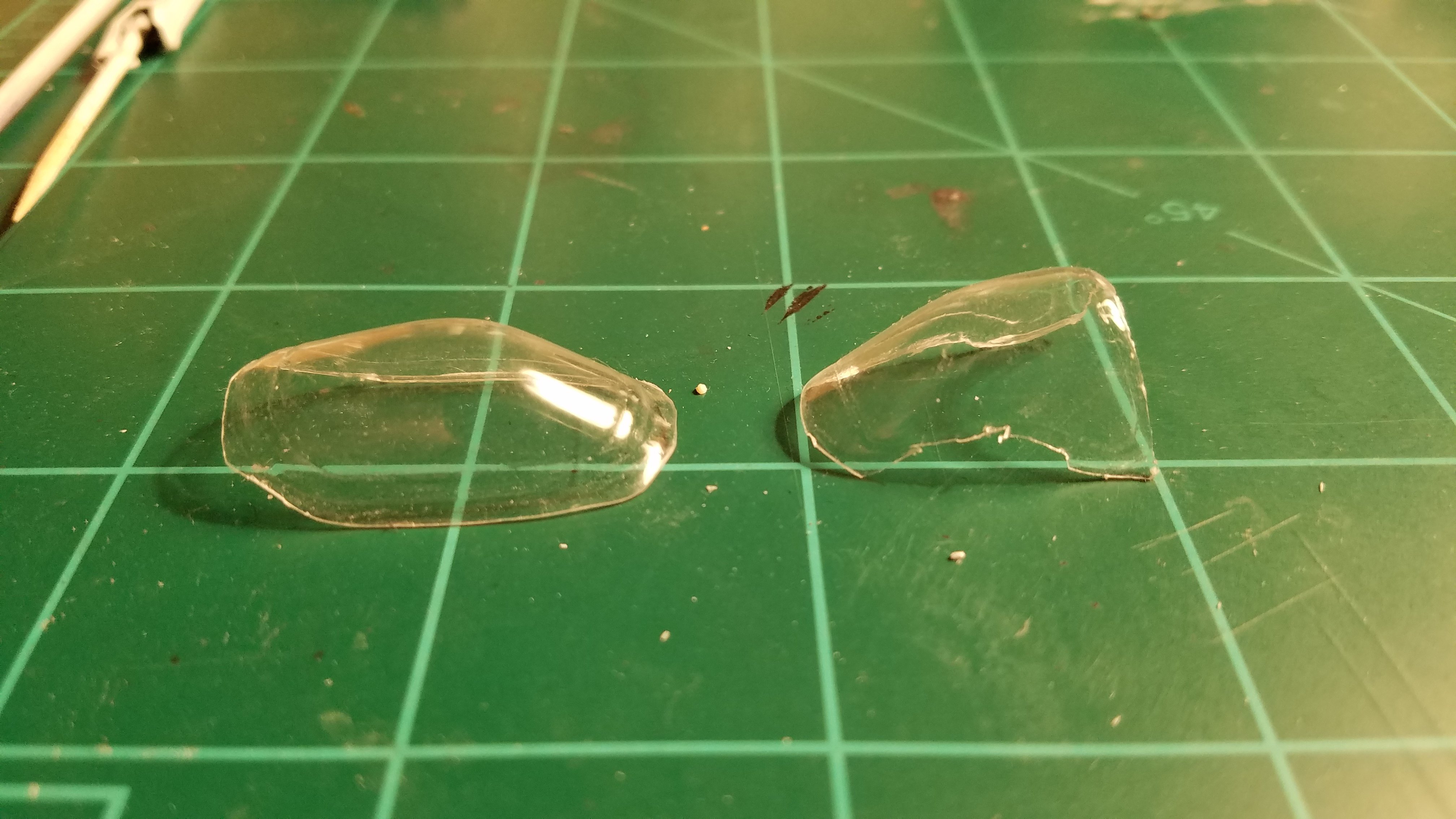

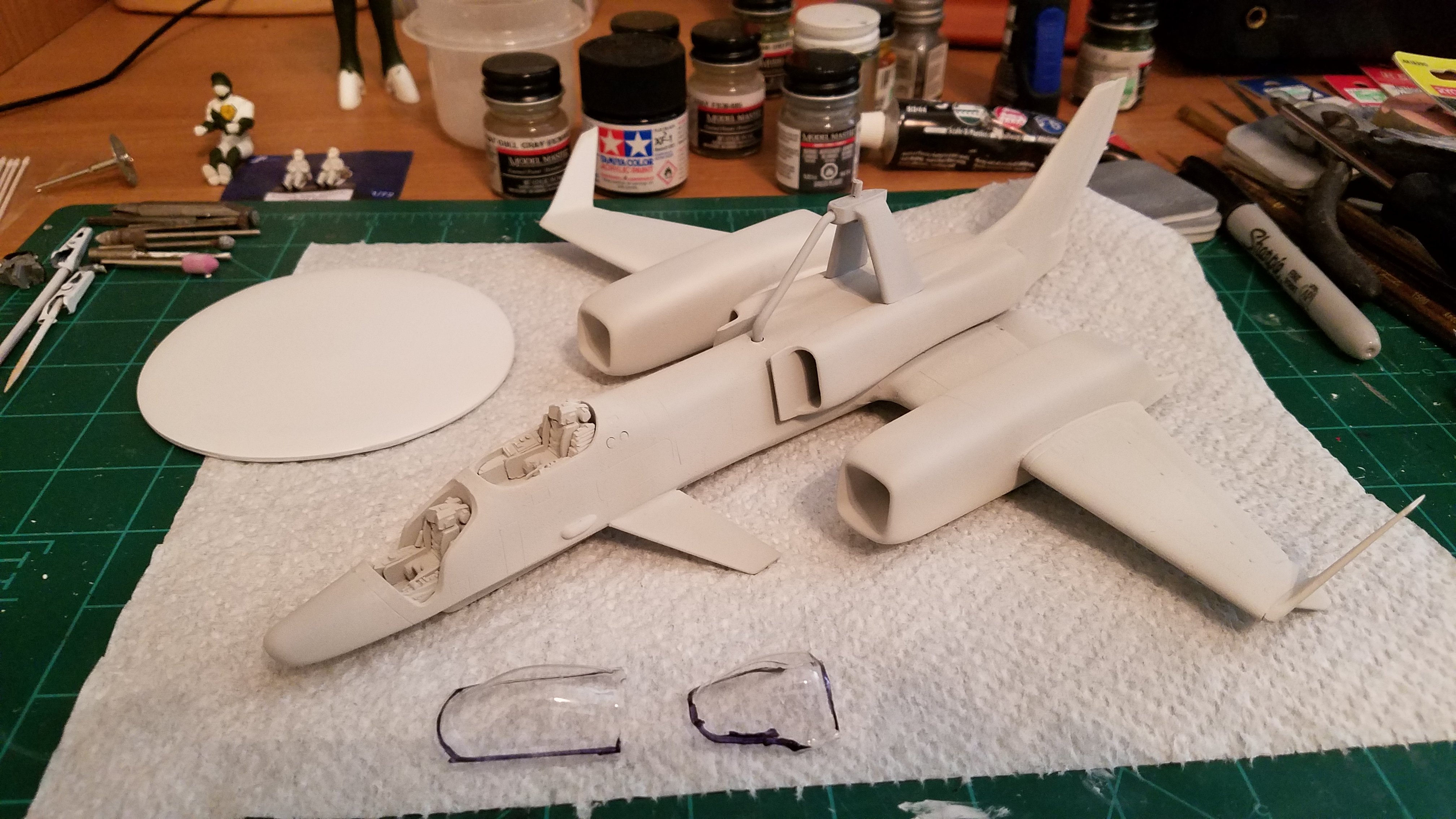

In today's episode of "what seems like the longest build in the history of the world".. we have a light grey base coat going down. Also attempted to cut out the cockpit clear parts yesterday.. I got soooo close, and then trimmed a bit to much... LOL..I have one more set to go..then I'm screwed and this will go up on the For Sale forums.. LOL?
Surely its not the longest build in the world.
Were you using an Xacto to trip those canopies? Looks bad, but I wouldnt give up on it just for that. I'm sure someone who has the kit can recast it for you, maybe even the Captain himself if you ask him.  Check out how well the recast Fan Racer canopy came out by one of the members here. It has its own thread.
I'd cut close to the canopy edge with a rotary saw tool for your dremel and the sand away the rest with coarse sandpaper or a file. The rotary cutter is very comfortable since you don't' have to apply much pressure when cutting.
Yeh, that's what I used this morning to try on round 2, but this time I drew a "safe" outline in black sharpie before I went to work.  Attempt 2 came out better, so now I just have to VERY carefully file or sand down the parts to fit...which is easier than it sounds.  I dunno...I have a bad feeling about these cockpits looking right..to bad I already sealed the gear doors and sent the landing gear to NZEOD in New Zealand or I would seriously reconsider doing open canopies! :lol:

I know how you feel! That's why mine is sitting on the shelf half painted. I knobbed up the canopy real good, and I only had one set to play with.
I really should check SSM store if replacements are available...

Is there any way you and Derex could carve up wood bucks and do a "heat and smash" of the canopies?

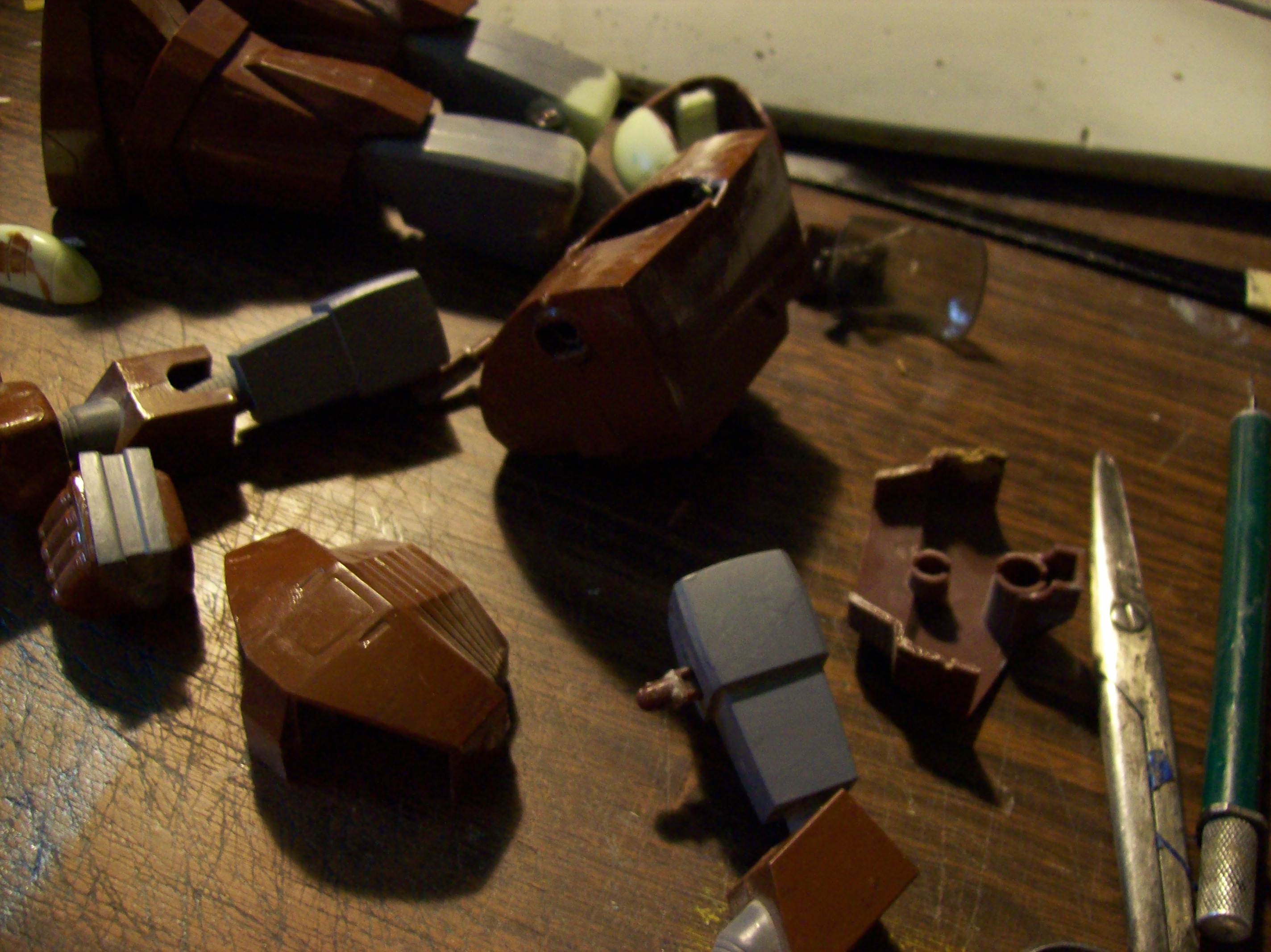

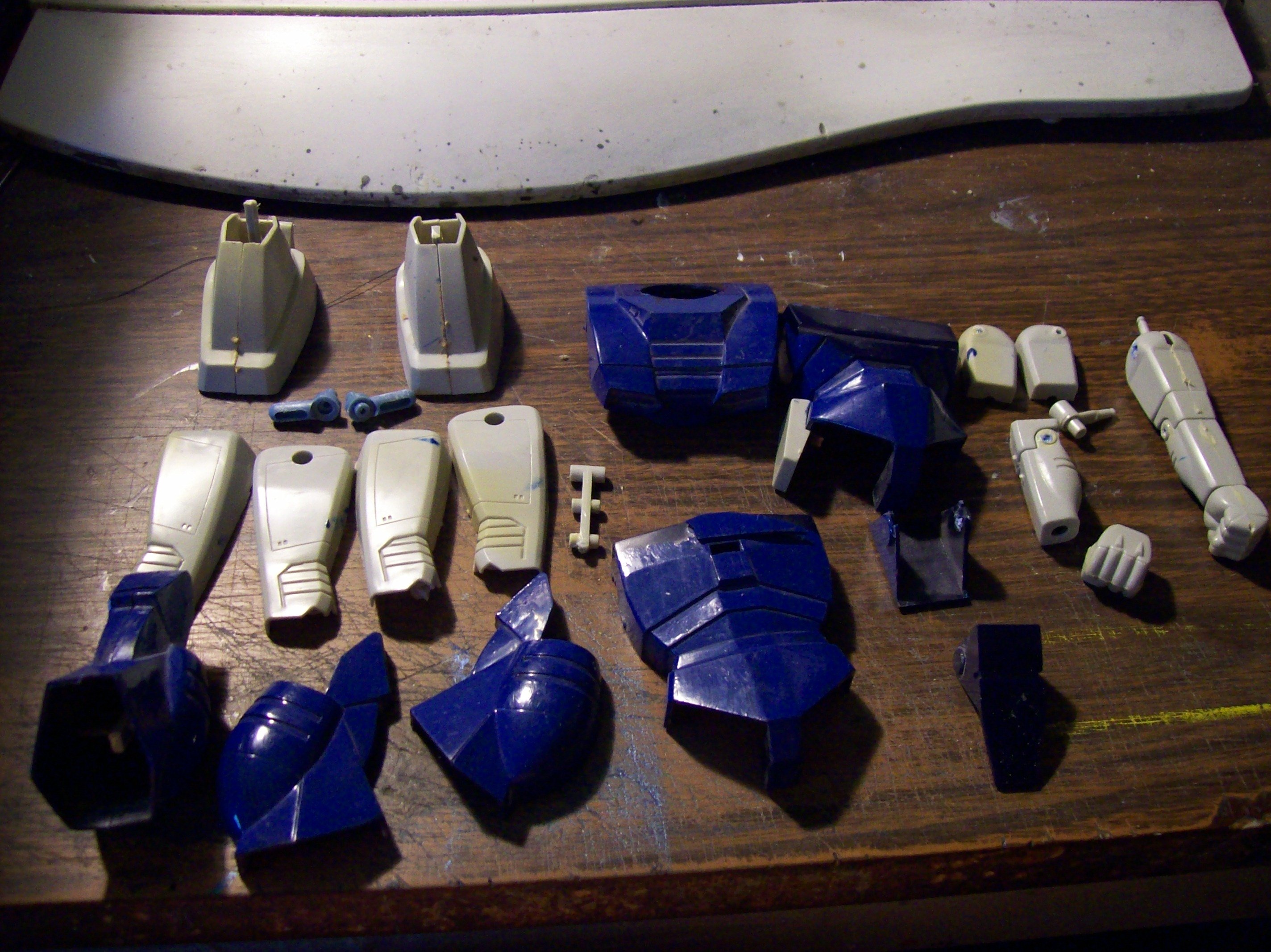

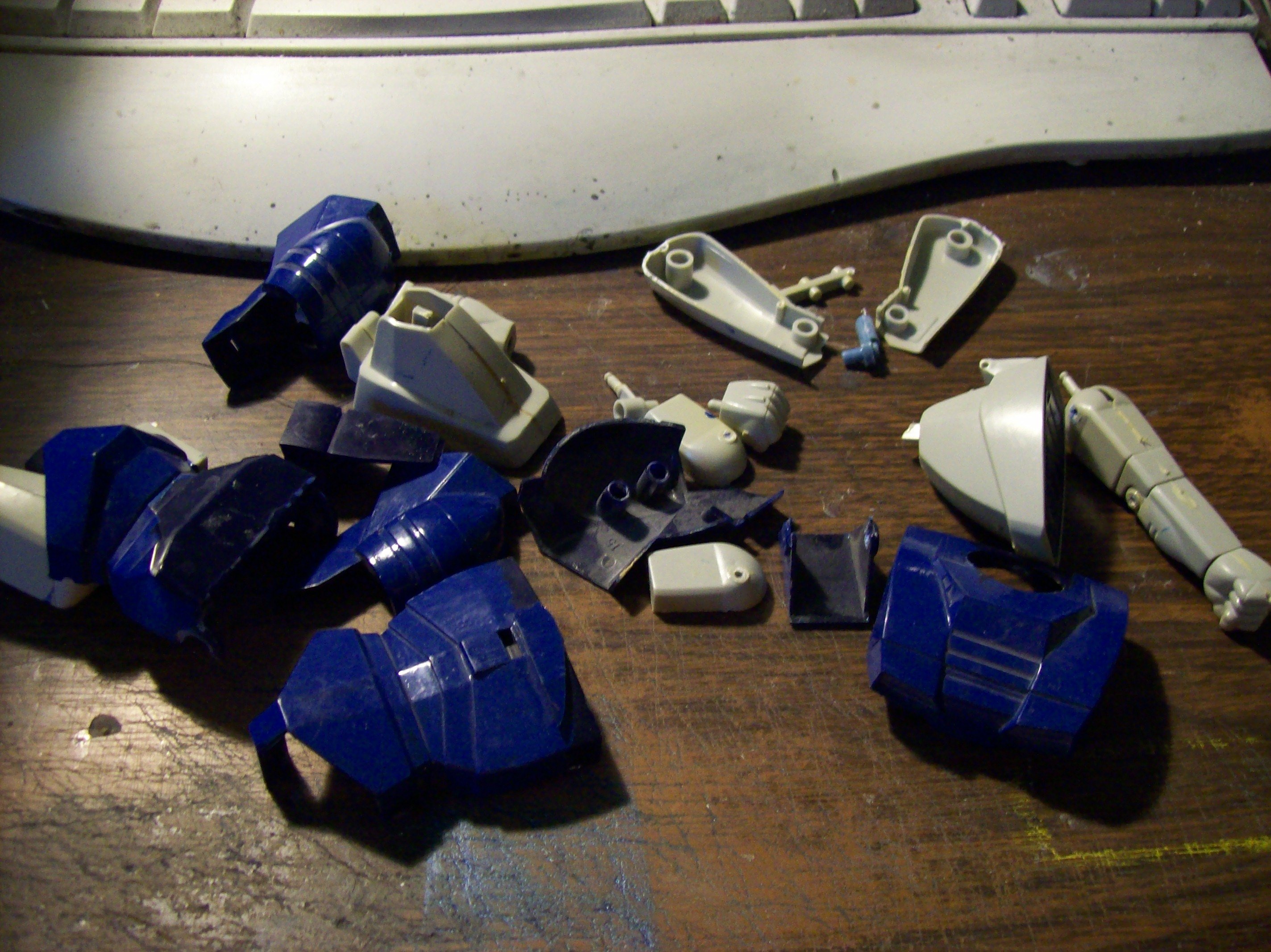

As promised, pics of the Dougram as I got it:
After doing an inspection on this and the Bushman, I decided to save the Bushman for later and focus first on the Dougram. It needs duplicates of the shoulder and arm armors, hip block, a new cockpit, backpack, weapons pods, pilot and new knee and ankle joints. Also, one shoulder was snapped in half, so I reworked that.

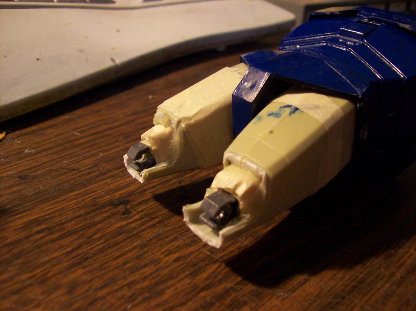

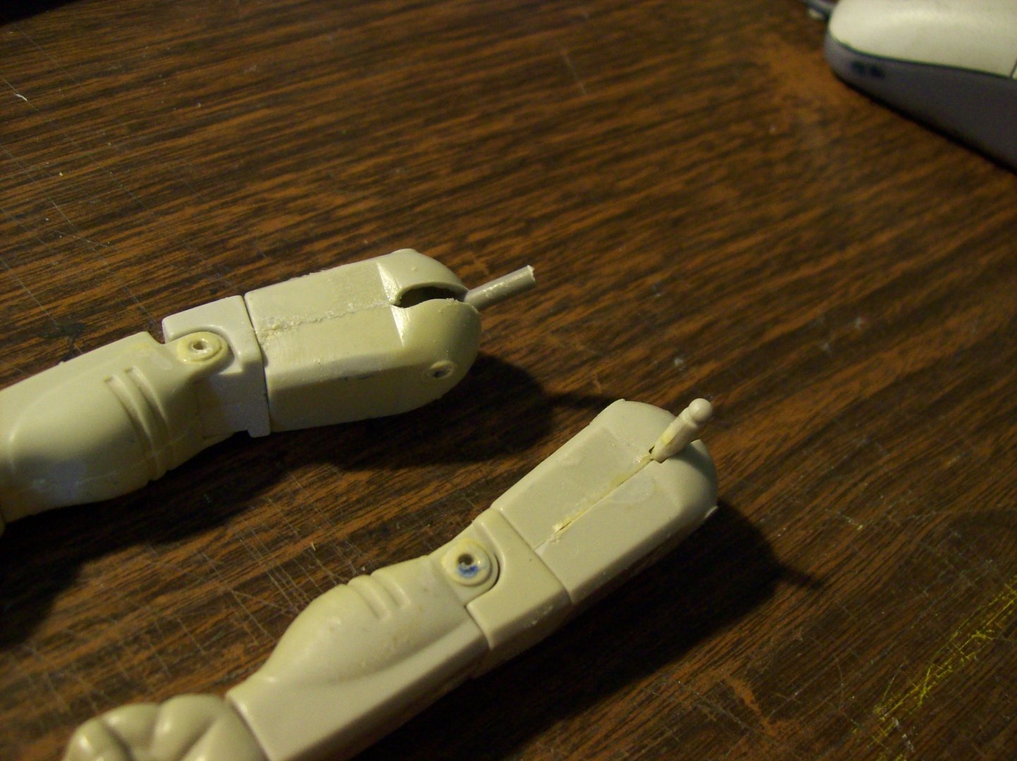

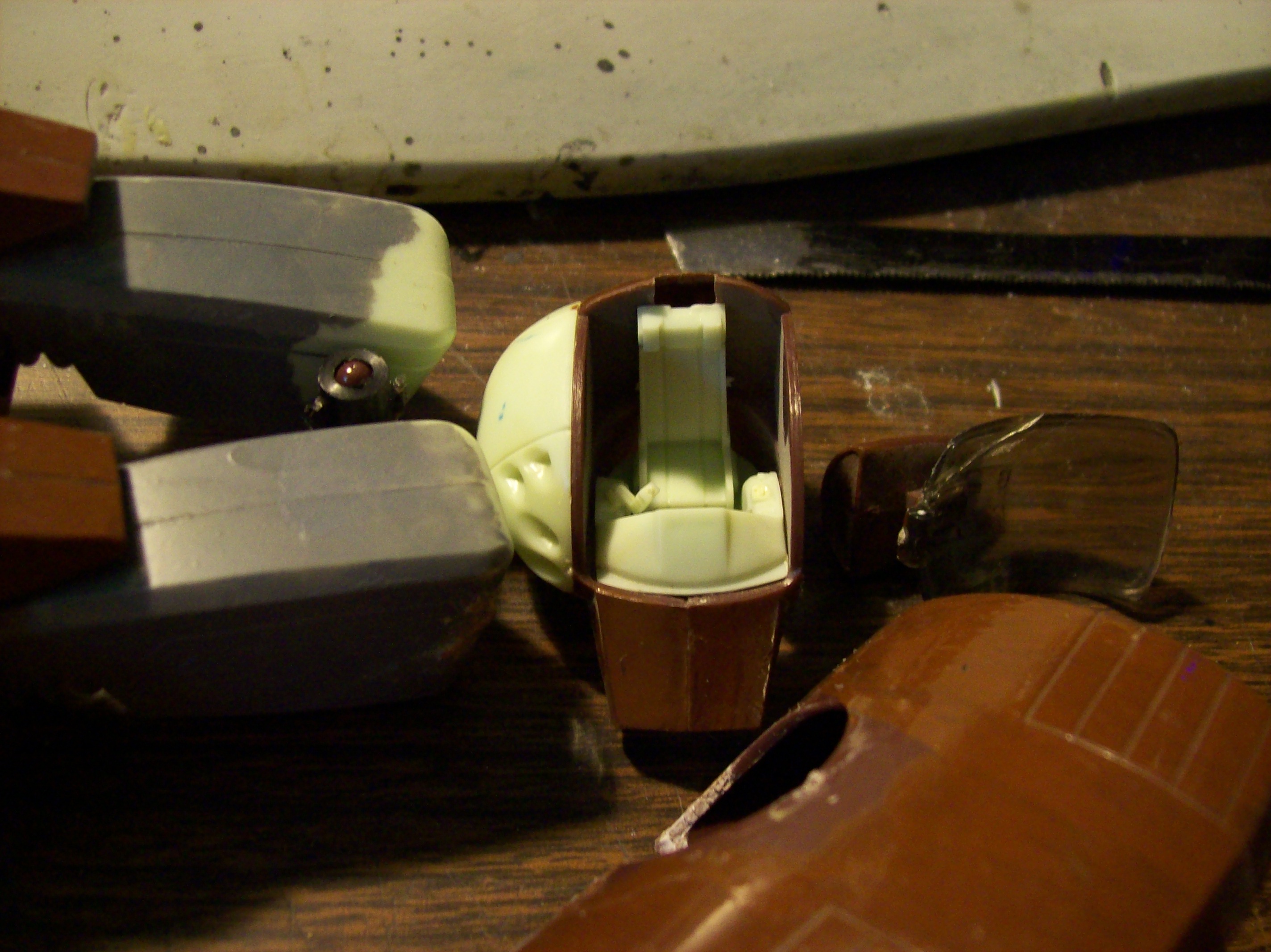

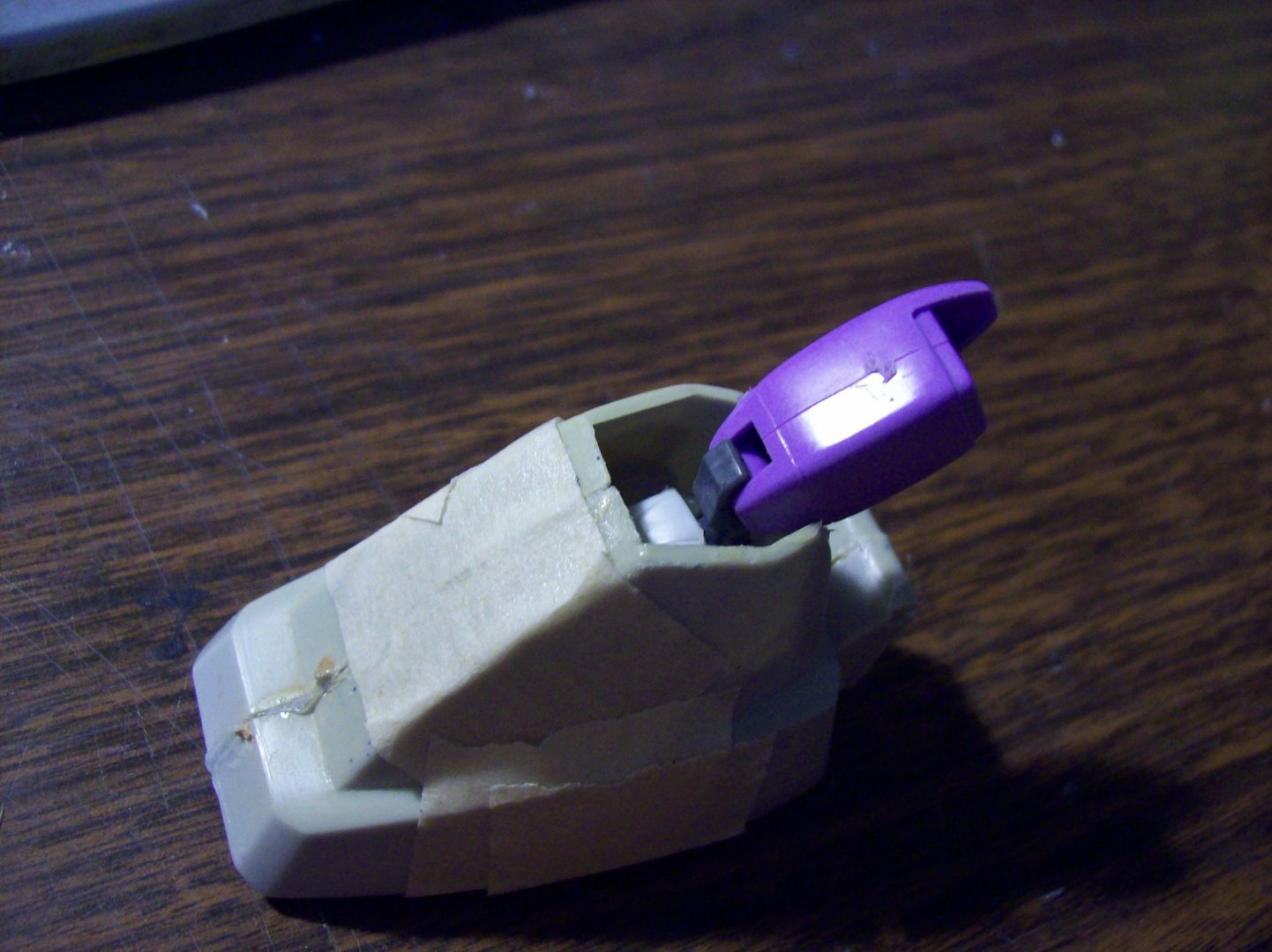

Pics of current work:
With the age of the plastic, trying to salvage the snapped linkages on the old parts was a major waste of time, so i removed them. I opted instead to replace them with clip joints from 1/144 Gundam kits (leftovers I scored at a thrift store) that would last longer and allow for disassembly without prying apart fragile glue joints. I took apart the remaining pieces that were glues, sanded and re-glued them, and will wash components when they are assembles as module units.
The cockpit: while normally, scratching up a cockpit is a major hassle, the flat plates of the Dougram make this a lot easier:

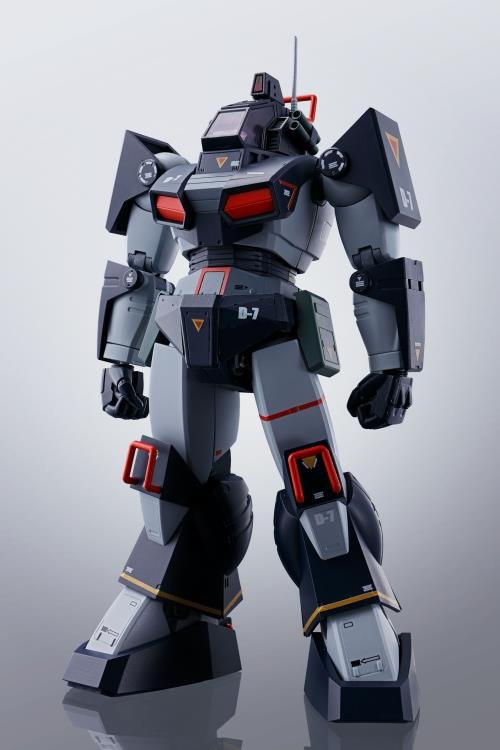

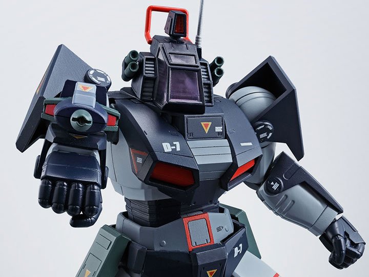

It's nice to have reference pics:
(Pics courtesy of BigBadToyStore)

No model should languish on the Shelf of Doom. :D
John used to provide a copy of the buck as a cutting template. Does your kit have that? If so and you are willing to send it down to me I can vac form replacements for anyone who wants them. I had to vac form visors for the Gnerl pilot and have some left over thermoform clear plastic.

I know mine didn't come with anything like that to my knowledge, and I got mine straight from John a couple of years ago. Great to have the offer though!!! I still have no earthly idea how I'm going to make the ones I have work, the 2nd set is better, but still very no-fitting at the moment, and not to mention a few other minor issues. :(
Turns out I do have the resin bucks the canopies were formed in. I'm still hoping to get word about replacing them, but if not I'll have to give press-molding them a try. Another option is to find misc canopies that fit, and since I'm building mine as a later, modified version that could work too.

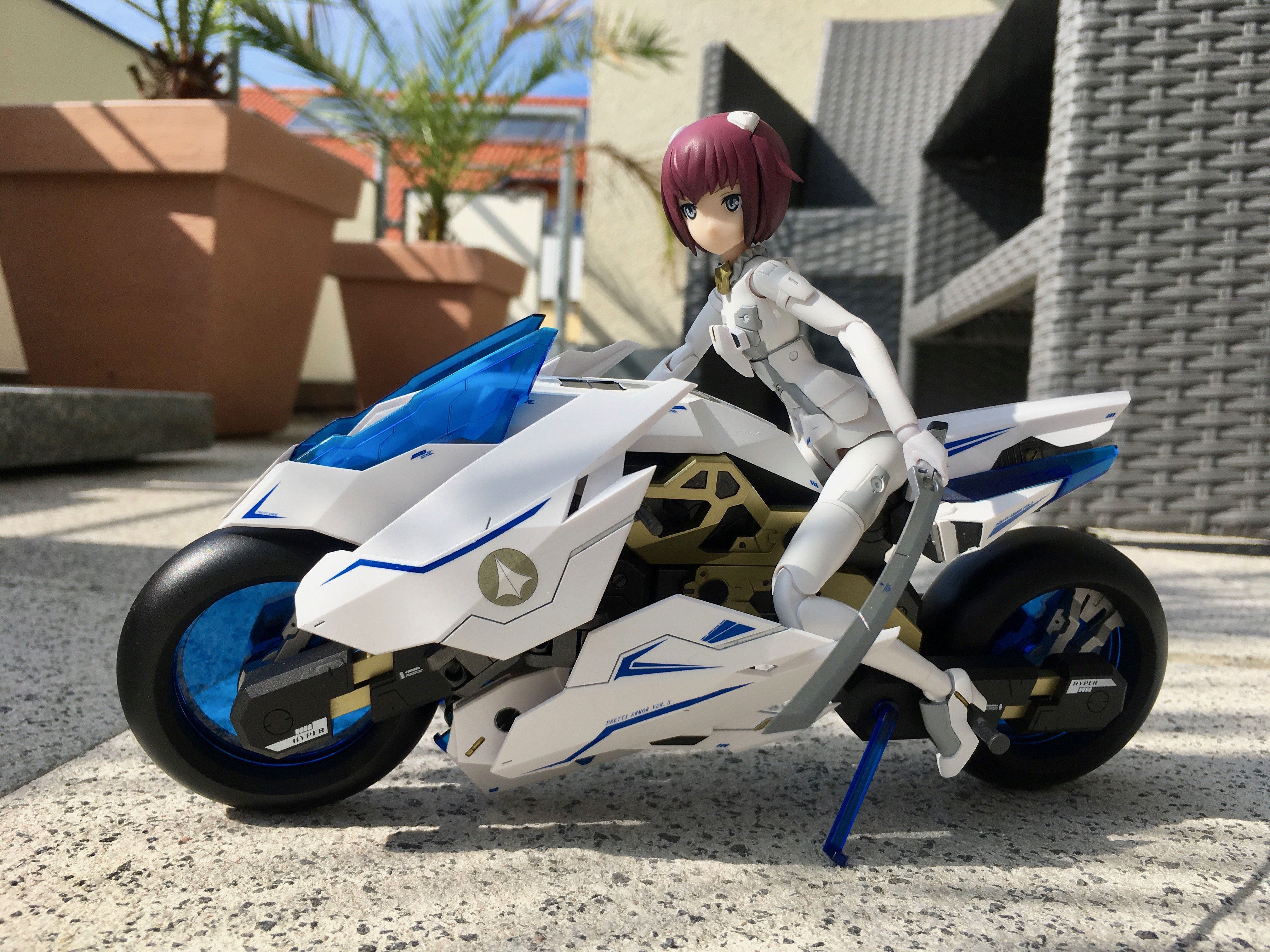

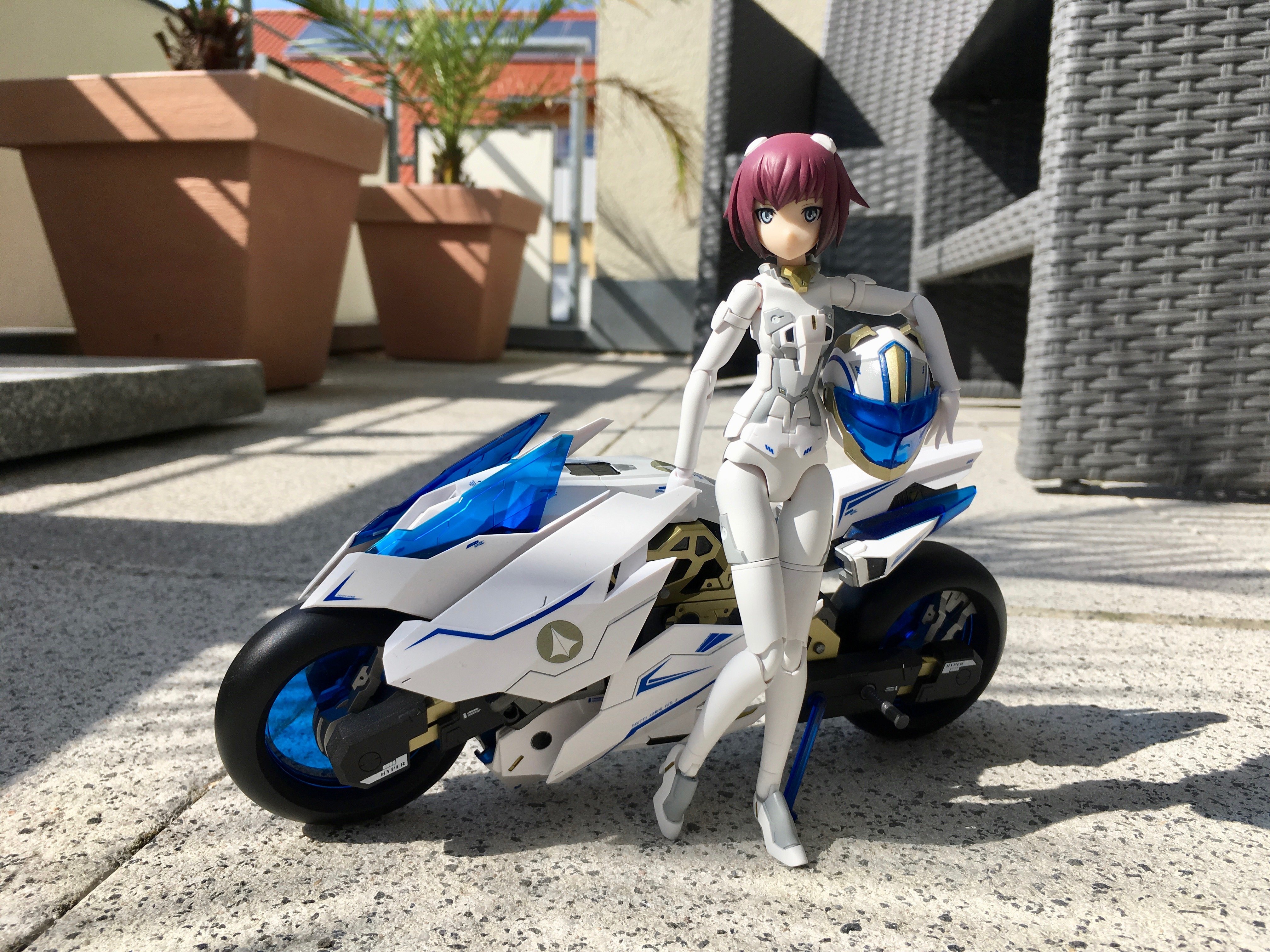

After several weeks I just finished my latest kit: Pretty Armor Ver. 3 White Version (a Chinese Fram Arms Gurl bootleg kit). Despite I did not plan to build more of those girls anymore ;) I was taken by the white/blue design of the jet bike and I gave this kit a try (Damn, wished to ride such a bike for real :rolleyes:). Did some minor changes towards the original design in adding golden frame and suspension parts and the grey Macross UN Spacy logo of course! (Leftover from a VT-1 decal set). I didn't like the provided 6-edged star decals, as these look really boring in contradiction to the logo with flames on the kits' box art. Also the girl got an enclosed biker suit in white/light grey color to match the UN Spacy logo :D.
Unfortunately the bike can not do a complete transformation into an armor for the girl. Attached on the bike you can fold out the cover parts to "burst mode" but to use it as an armor on the girl you have to detach them. But as for me the normal bike mode looks best, I don't think I will transform it anyway.
CrossAir, That's some superb paint finish. I think you're on a roll.

Thanks guys!
1 hour ago, electric indigo said:
I never cared much for these kits, but with your paintjob it looks pretty sharp.
Yes, that's enough feminine touch on the shelf by now. Next has to be some kind of mecha again! ;)

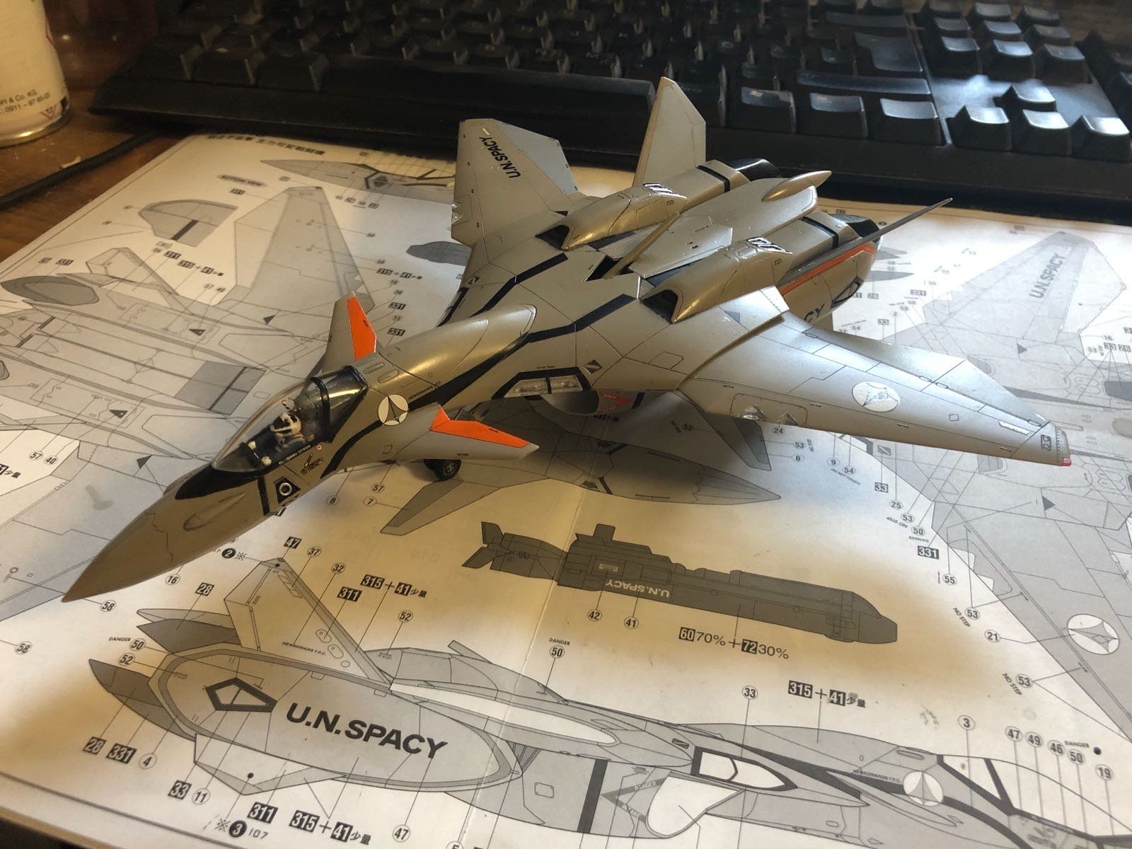

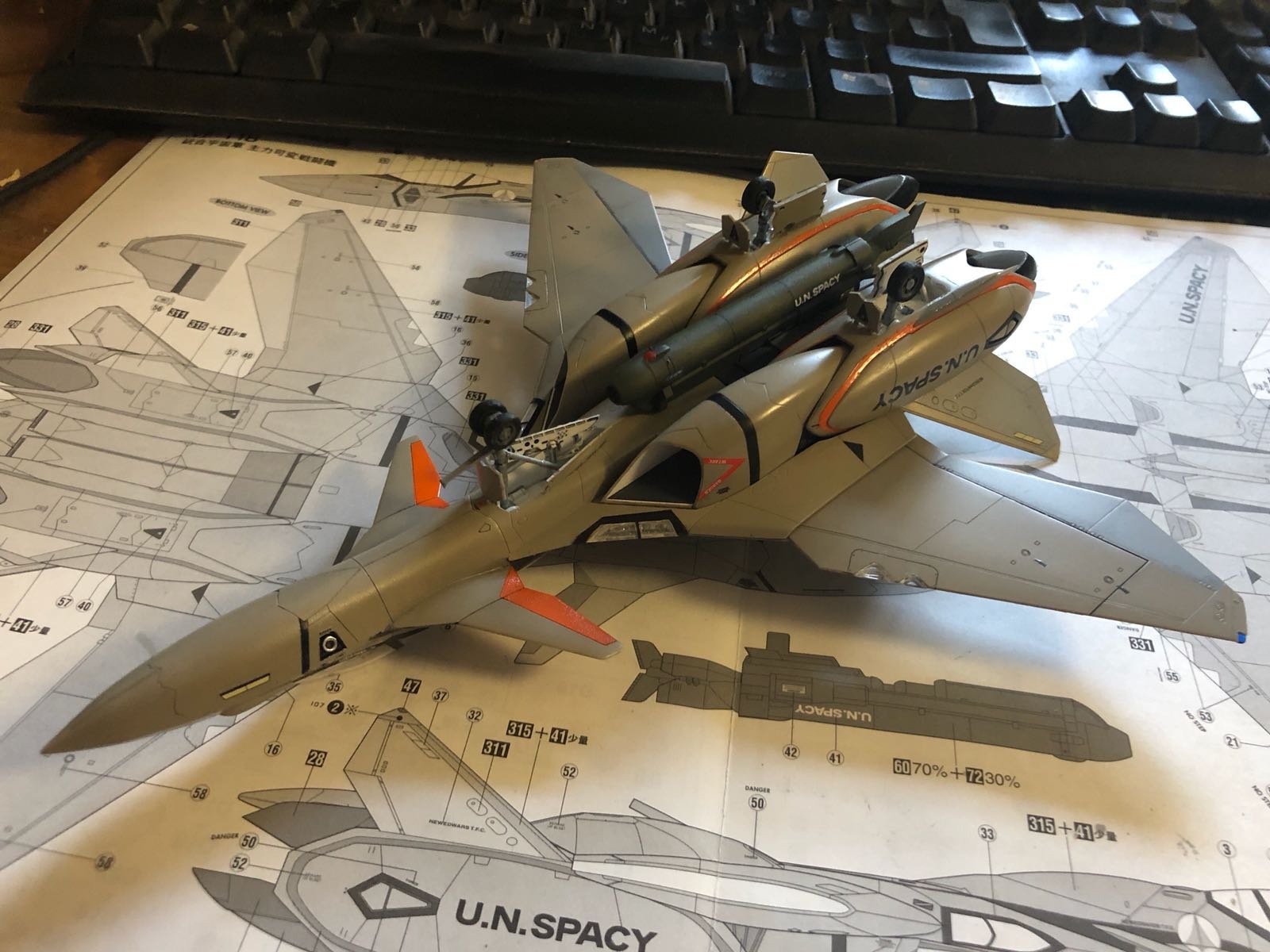

Finally finished my VF-11B from Macross Plus.
1566169083_WhatsAppImage2018-07-28at19_14_58.thumb.jpeg.e6524ab877a74e19f1f672f01f342bdd.jpeg1082329553_WhatsAppImage2018-07-28at19_14.58(1).thumb.jpeg.fd30115f90c6b54122cd3d53bf45bdb6.jpeg
Sorry for the bad pictures. I really need to build a lightbox or something. The washing turned out a bit dirtier than I wanted it to be. I was also watching through Macross Plus to get the colors right, as the colors provided in the Hasegawa manual didn't seem right. Sadly, during build up the main body seams ripped open. It seems that due to sanding works they became a bit too thin...

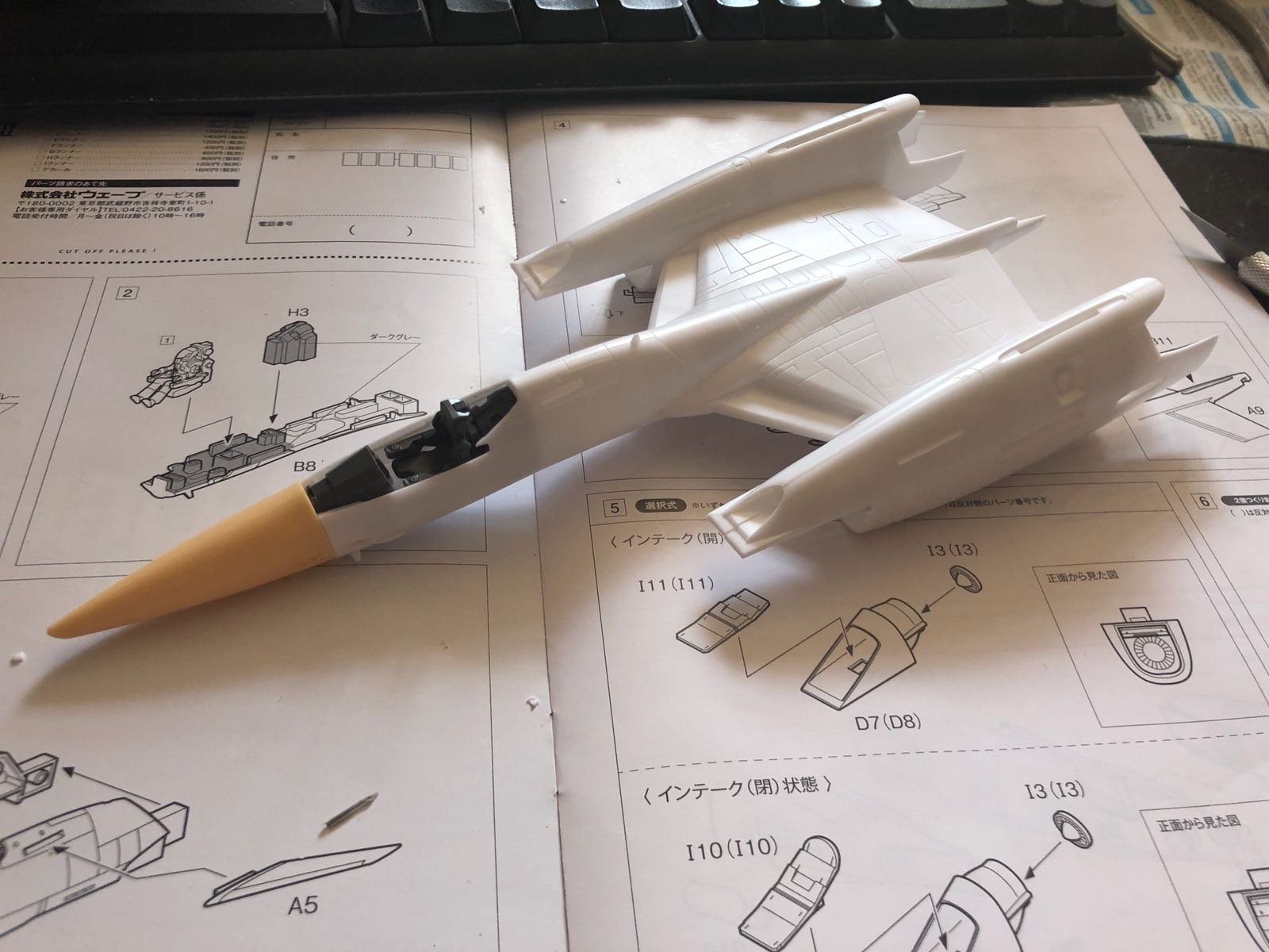

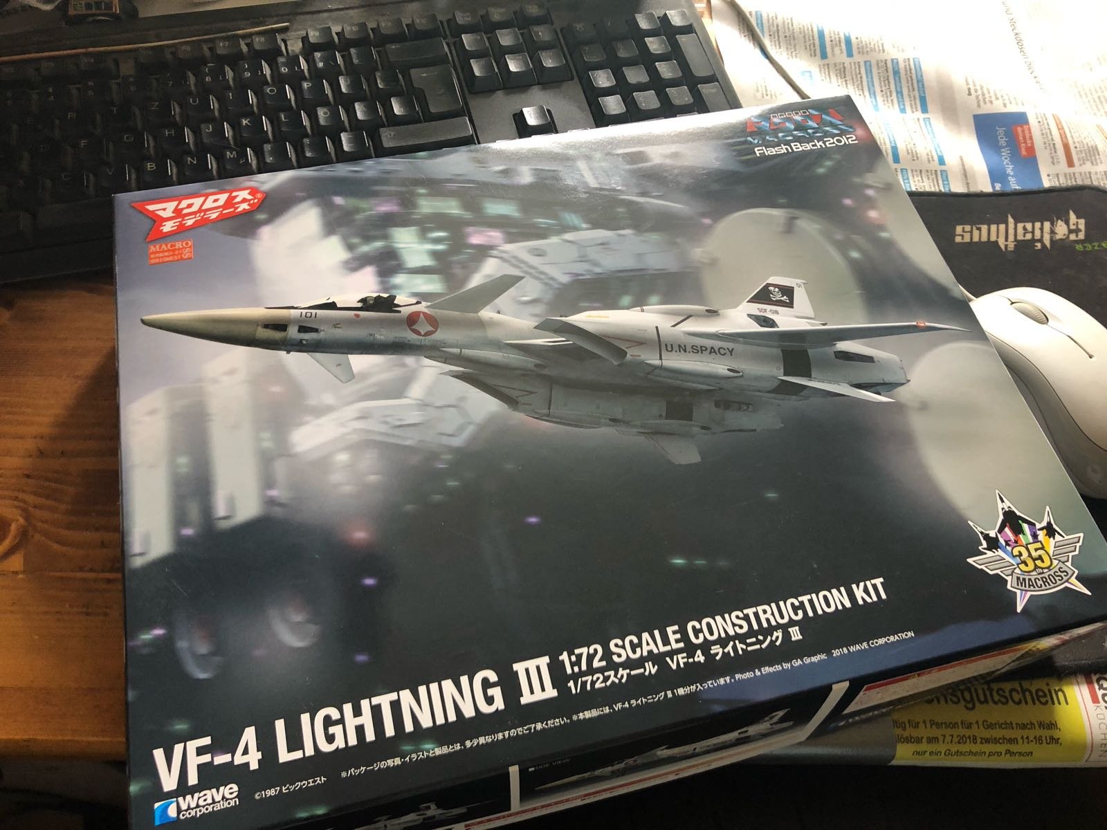

Next Project:
729054970_WhatsAppImage2018-07-29at09_24_49.thumb.jpeg.d12e8409f9de18d19255f797e7ac3fc0.jpeg
My first Wave kit :D
1836290794_WhatsAppImage2018-07-29at13_31_50.thumb.jpeg.b89c24d4234669d775f307fa6ef3c5b3.jpeg1777260258_WhatsAppImage2018-07-29at18_54.30(1).thumb.jpeg.888e8ebd548691deb4860b5d1e631d04.jpeg486473532_WhatsAppImage2018-07-29at18_54_30.thumb.jpeg.e55b7d0fd4d845cb38368389170c0e1b.jpeg
So far everything fits nicely. No idea how to to the main engines exhaust yet. If I airbrush it before glueing it together I'll probably have some issues with color rubbing off during sanding. Maybe I have to tape everything first. I'll come up with something.
Wow, you nailed the classic scheme. What were your ratios for the gray and orange?
(I really need someone to teach me how to improve my painting. I get a grainy finish, and my gloss is useless...)
