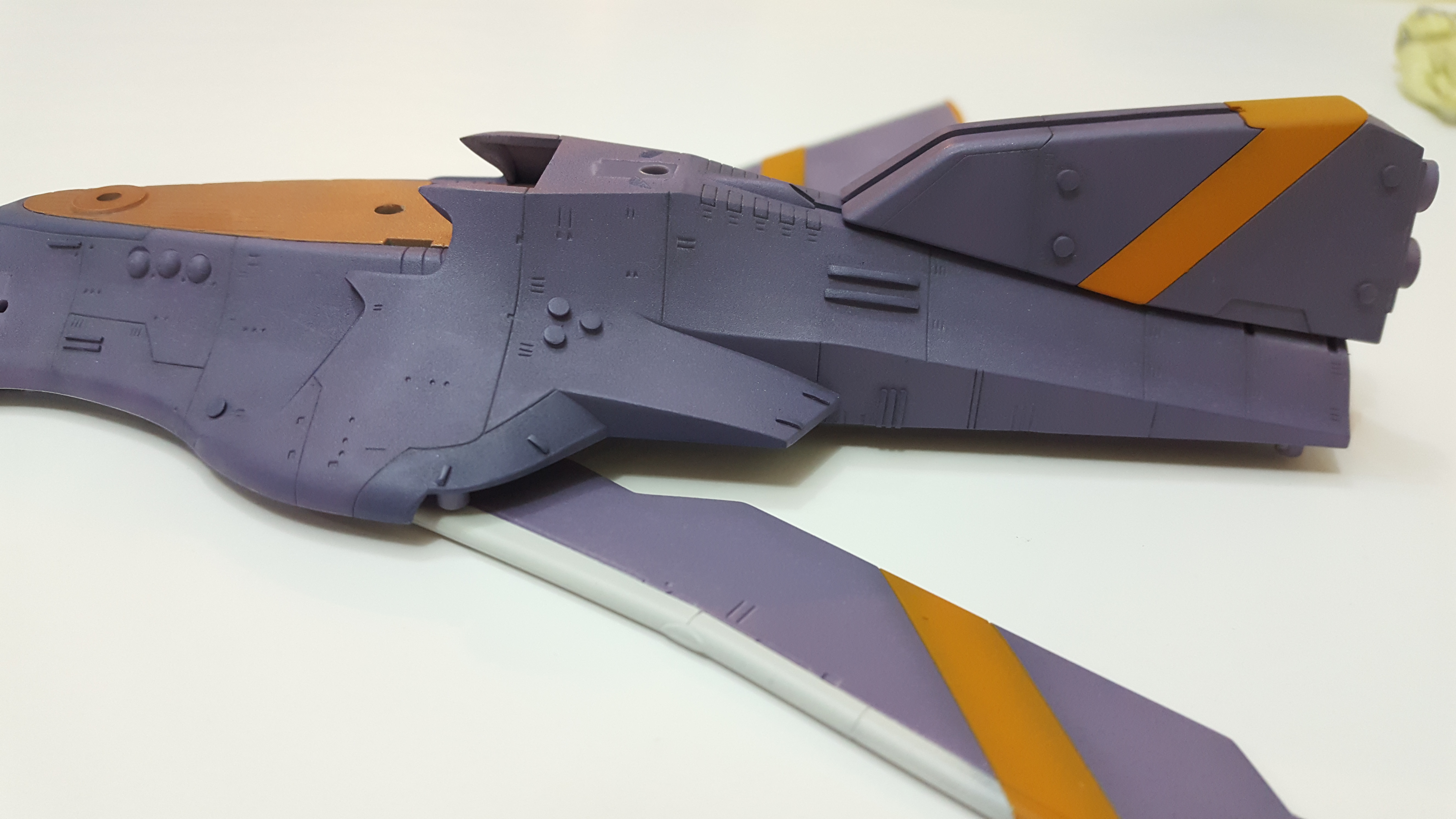

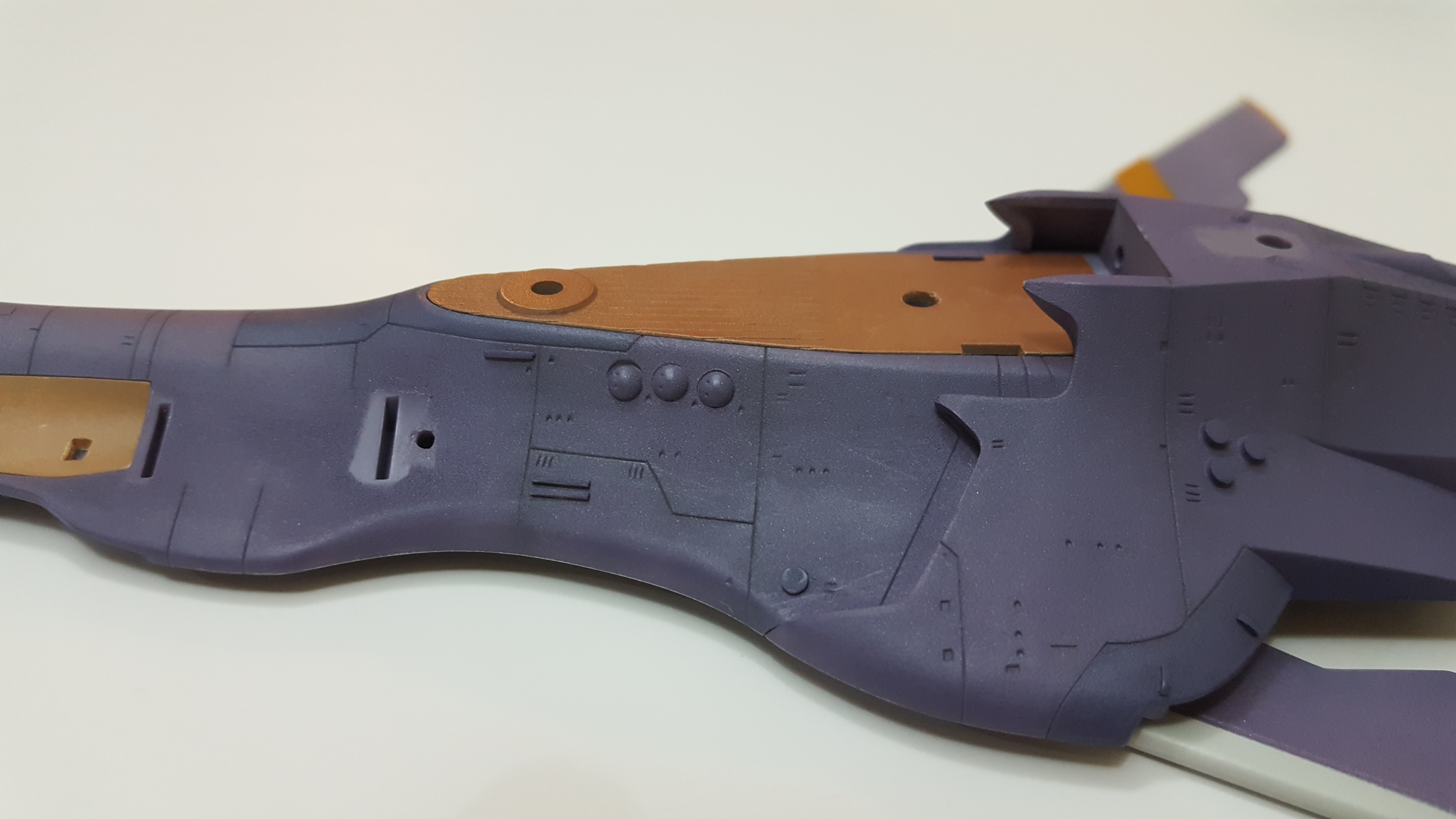

Got my panel lining on. The Humbrol Clear doesnt seem to give a strong gloss after two light coats, so the enamel wash seeps a bit. It either needs a lot more coats next time, or it just doesnt work. For my standards its okay.

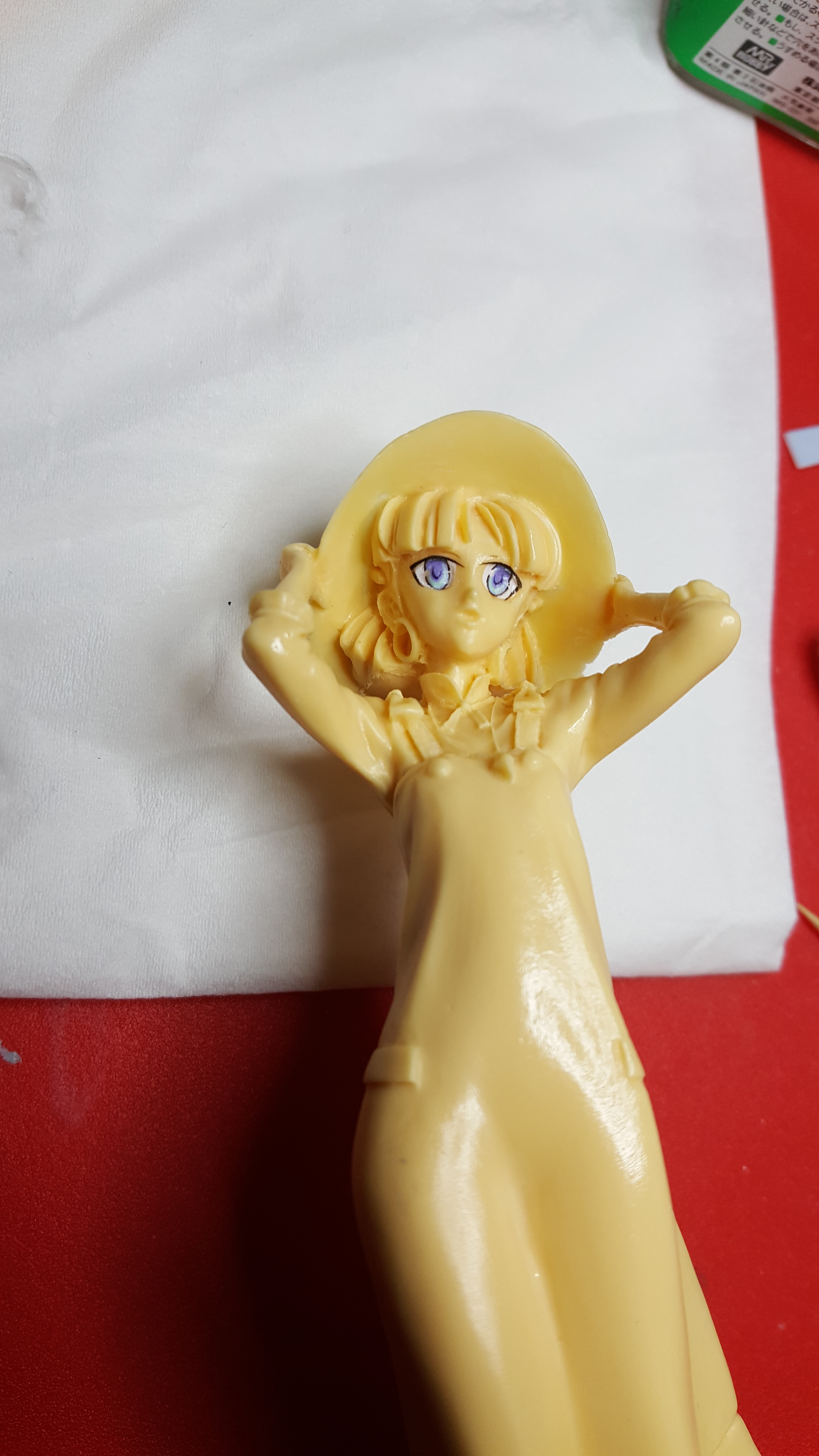

Eye decal fit test looks good. These look about 10% too large, but I will take that over my neanderthal hand painting any day. The eyes are the most important and most difficult part of a figure. Without these decals, I would never even try it.

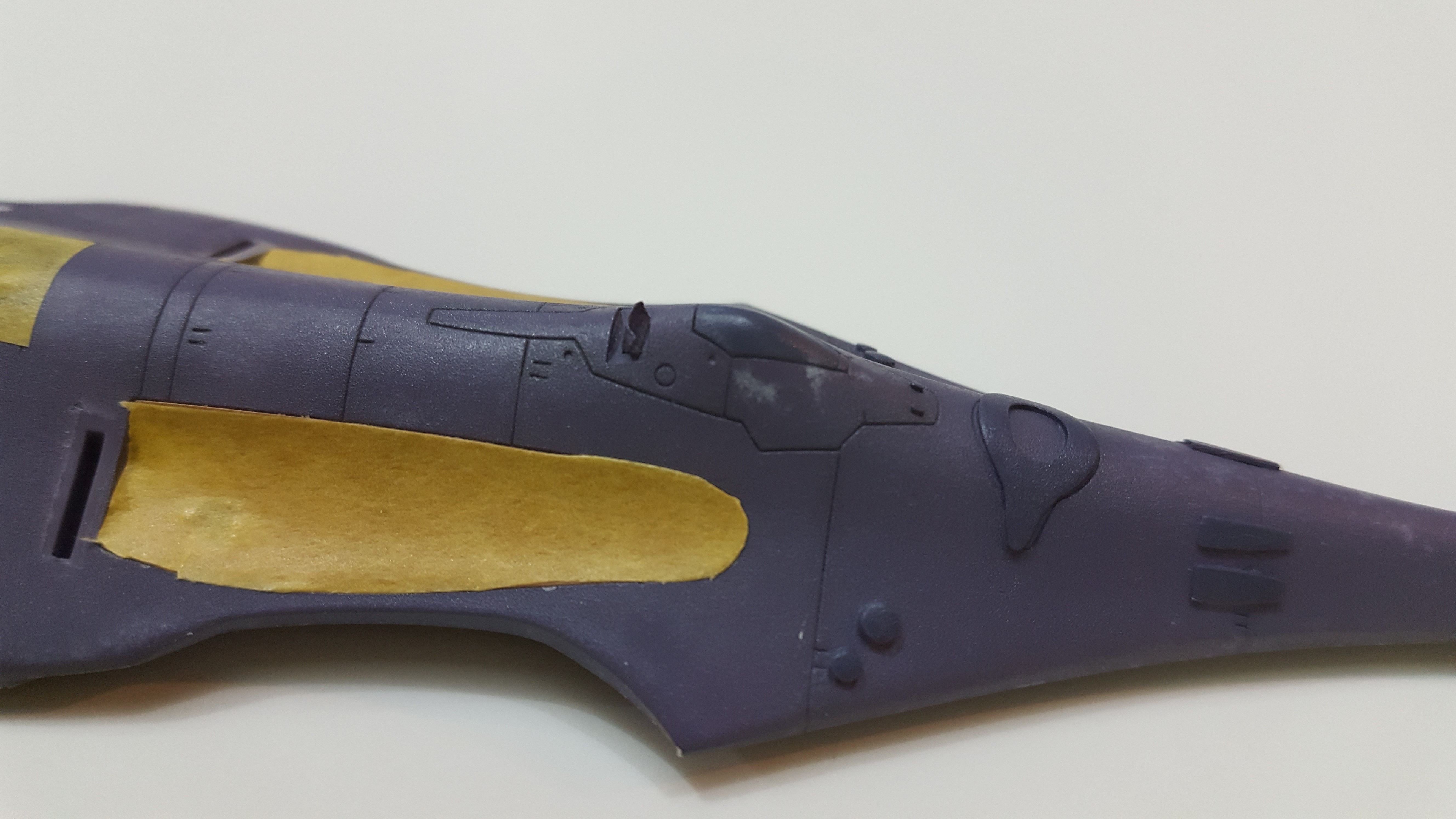

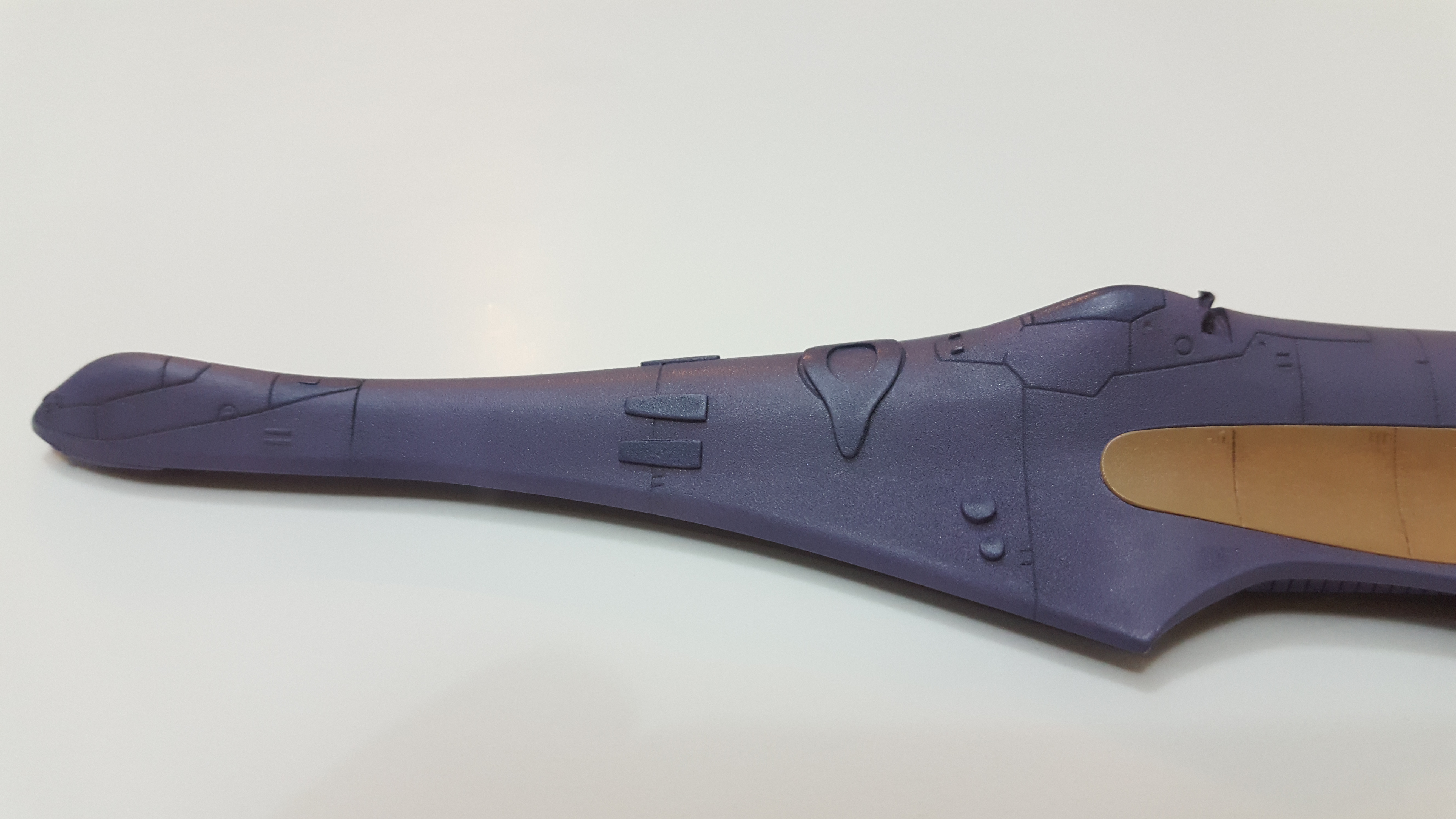

I need some painting advice to correct a mishap.
I got this white flash after adding a medium coat of gloss. (It may be from humidity or my skill level. I dont know...)
I've masked it off. Can I add another light layer of color on top of that to correct it? Thanks.
I would try gently removing the flash with a little bit of toothpaste, water and a soft cloth first so it doesn't wear the paint away. If that doesn't work, then try a bit of color to it.
I have had the same thing happen a few times with various acrylic matte coats.  I would try dabbing a bit of Future over one of the little marks and see if the Future "fills in" the frosting.  The frosting is the matting agent that disrupts what would otherwise be a gloss coat.  If you can get it to "soak up" a bit of Future, it will get at least translucent, if not transparent.  Failing that, you can try popping off the little flakes with a piece of a plastic cotton swab shaft.

I have seen this when I try matte on mettalic.  But this was actually with a gloss, not a matte coat. Maybe I flooded it? I dont know what I did. It didnt form till it dried.
What scale are the figures? For figures larger than 1/10 scale I usually hand paint my eyes. You can exercise on a sheet of plastic, it's not particularly hard to paint decent eyes with a good tutorial (I used one found in an old issue of Hobby Japan, but there are also good ones to be found online). My main issue seems to be that the brushes used by Japanese figure painters are impossible to find where I live in Europe...(no sharp lines for me)
Sorry!  I totally read "medium coat of gloss" as "matte coat of gloss" and assumed you meant you were making matte coat out of a glosscoat with a matting-agent.  I would still test the Future on an inconspicuous area.  I have accidentally frosted a glosscoat by unintentionally shooting a bit of 99-percent ISO onto cured Future before - the ISO was left over inside from cleaning the airbrush.  I figured Future clears CA frosting on canopies, maybe it would work on cured Future...and it did.  I airbrushed on a couple of light coats and the frosting disappeared.

What I meant by "medium coat of gloss" is that I sprayed it just a little wet.
Maybe I need to apply multiple thin layers and let them dry until i build up a strong glossy coat for the washes.
Now I'm scared to death of the wet gloss coats people use.
For now I gave her a new coat of color and she looks fine.

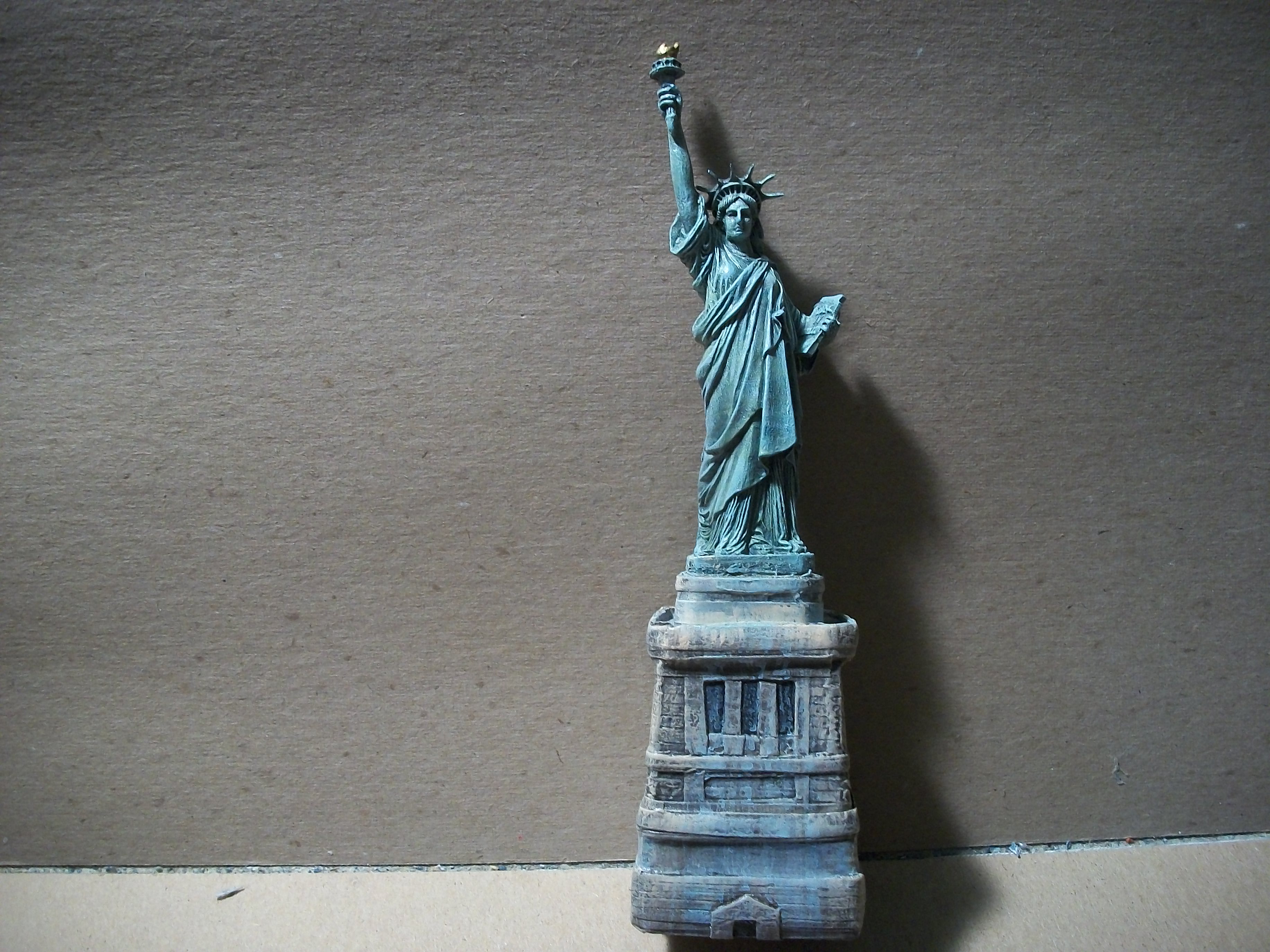

Same foam slats that went into making the launch arm served to replicate the full pedestal. My plan for this is to make a scale model of the entire complex the pedestal stands on. I might go as far as the whole island, depending upon space and materials (and size!).
