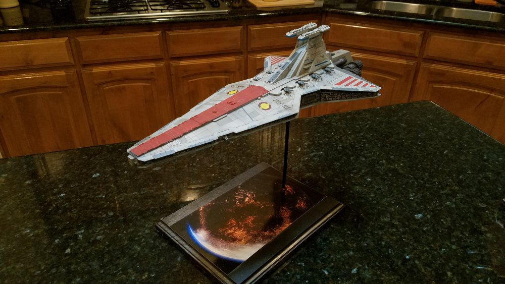

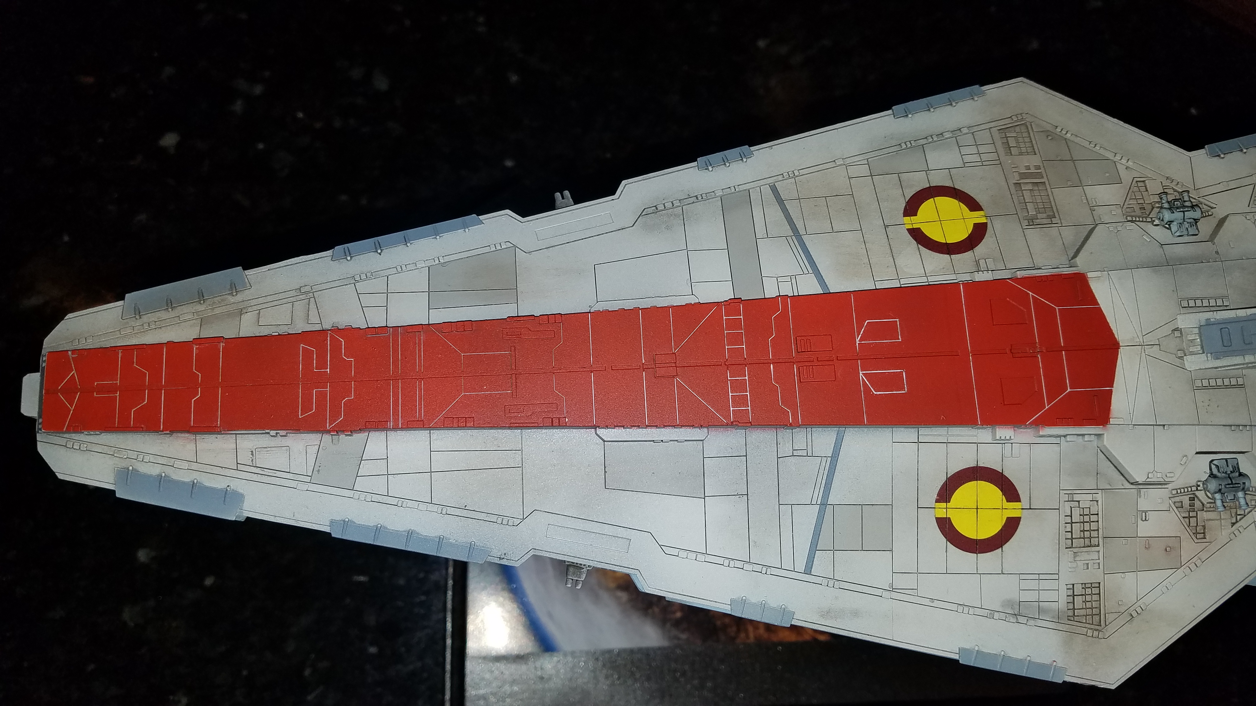

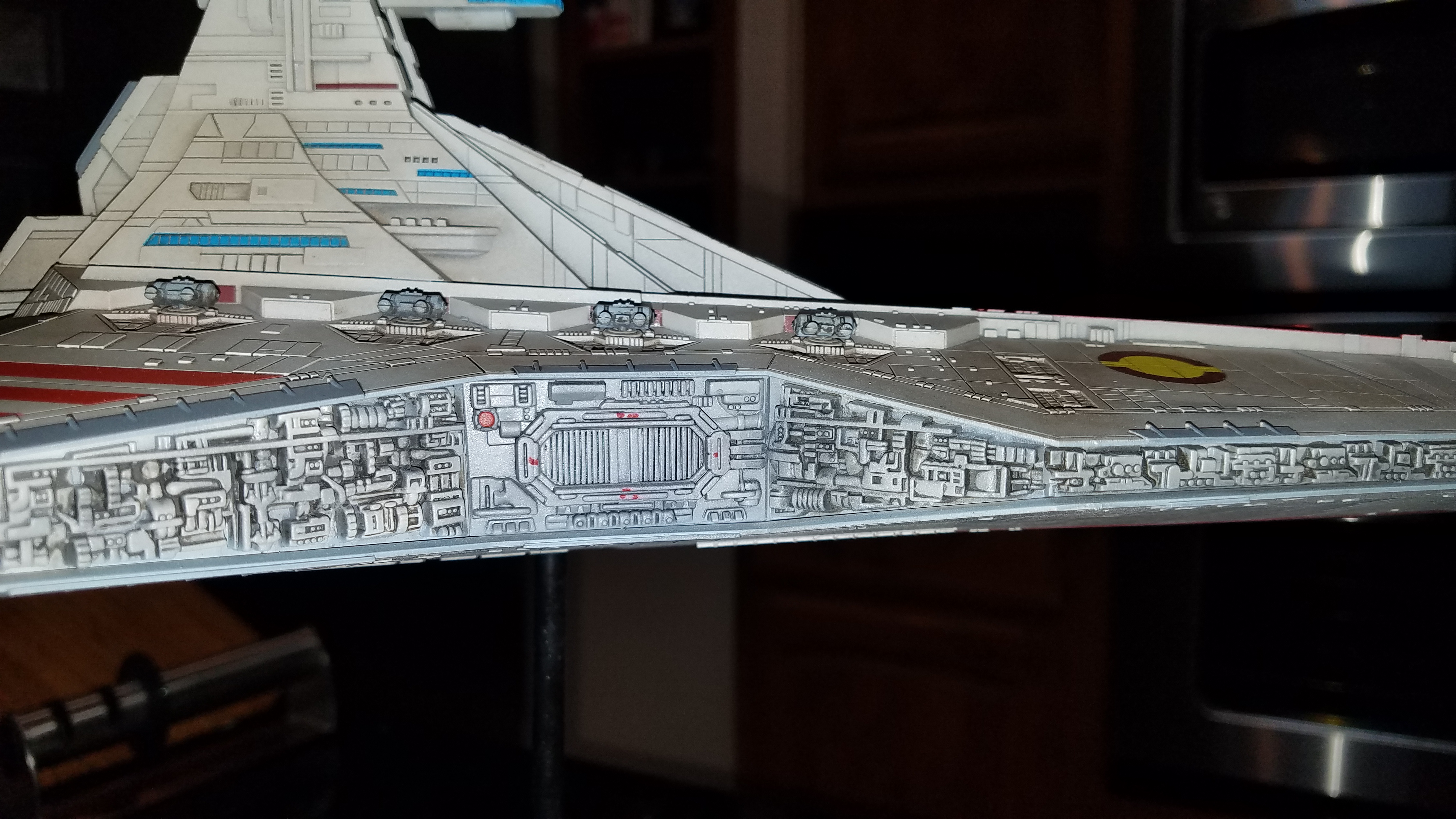

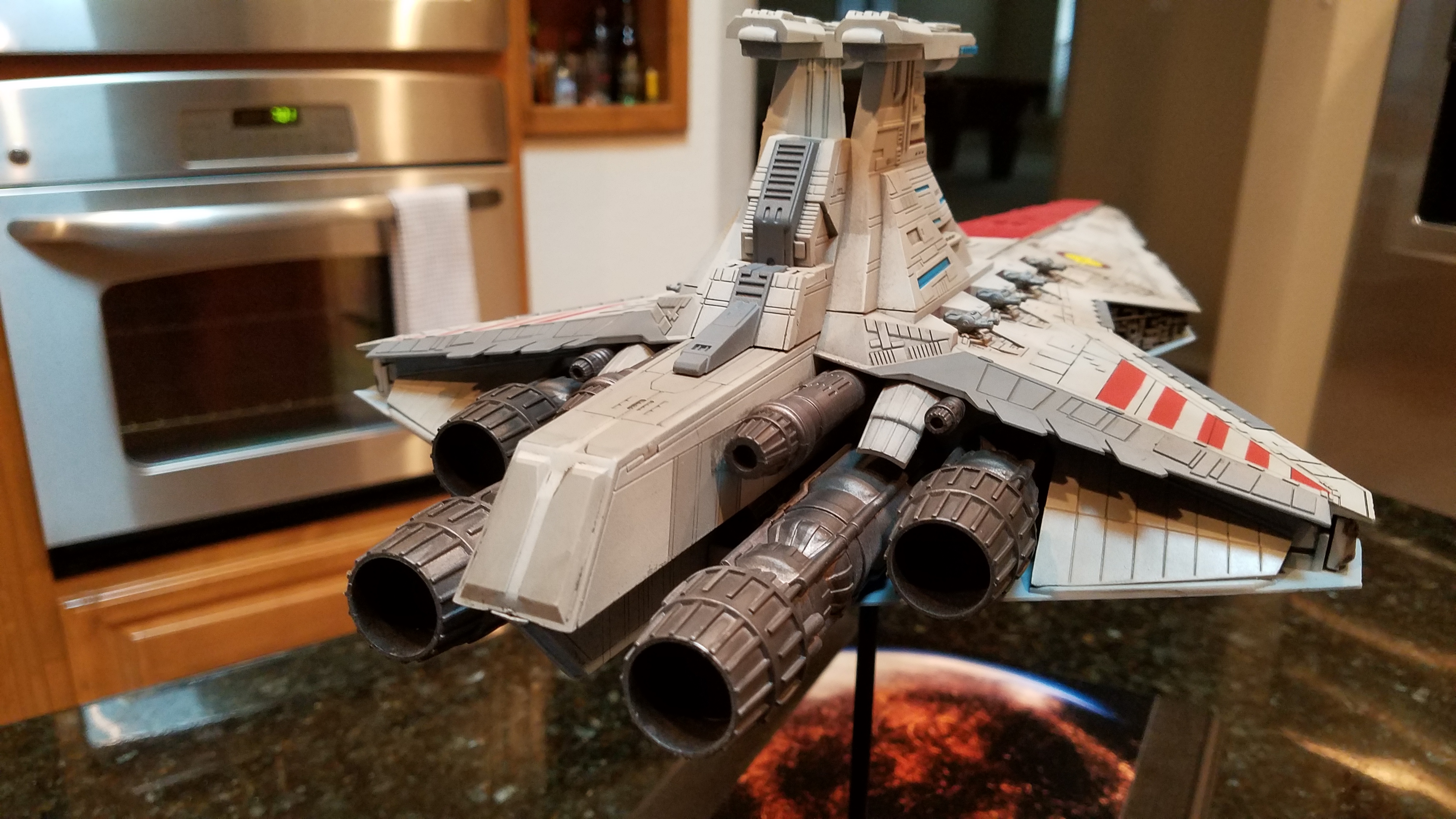

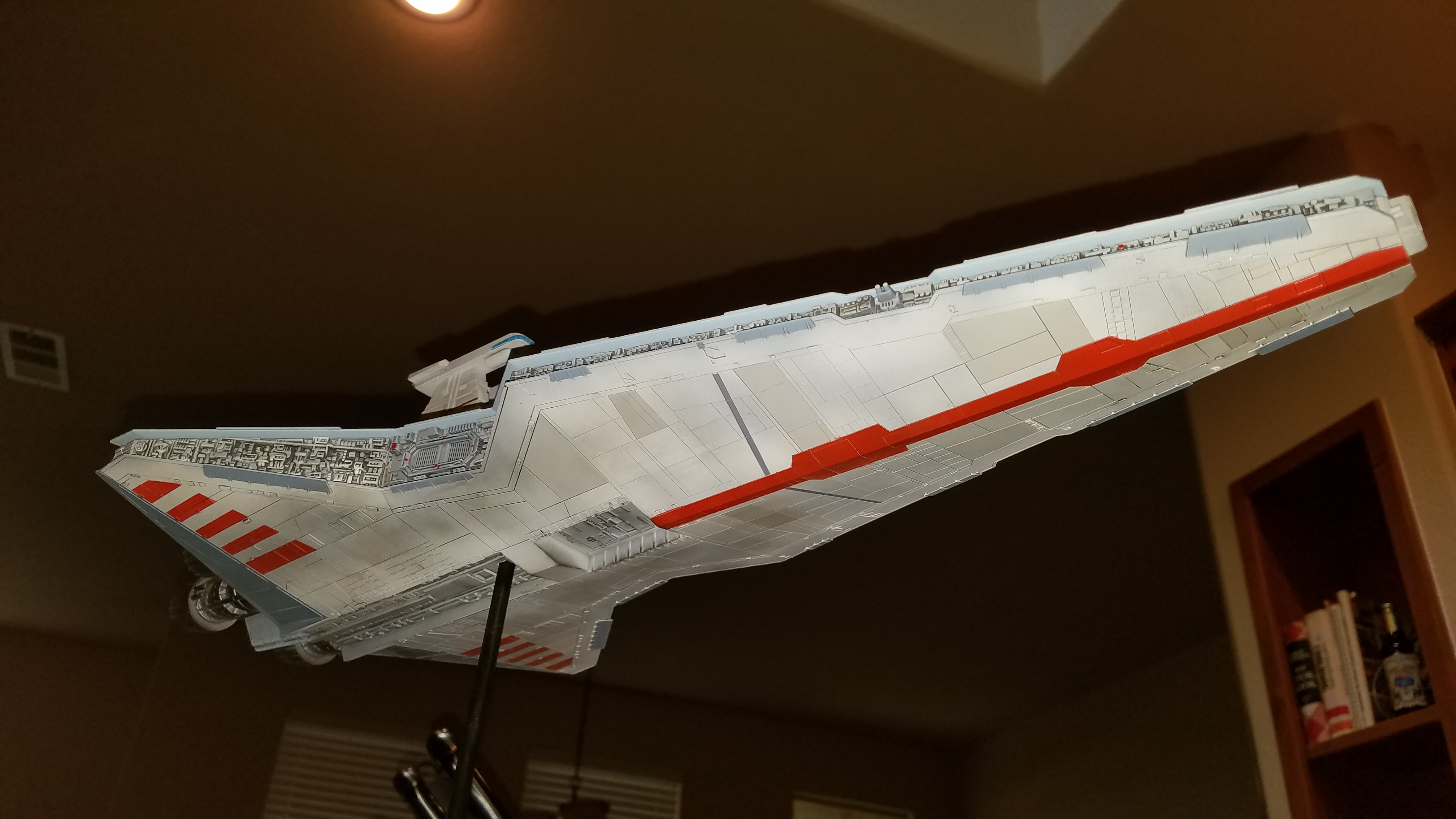

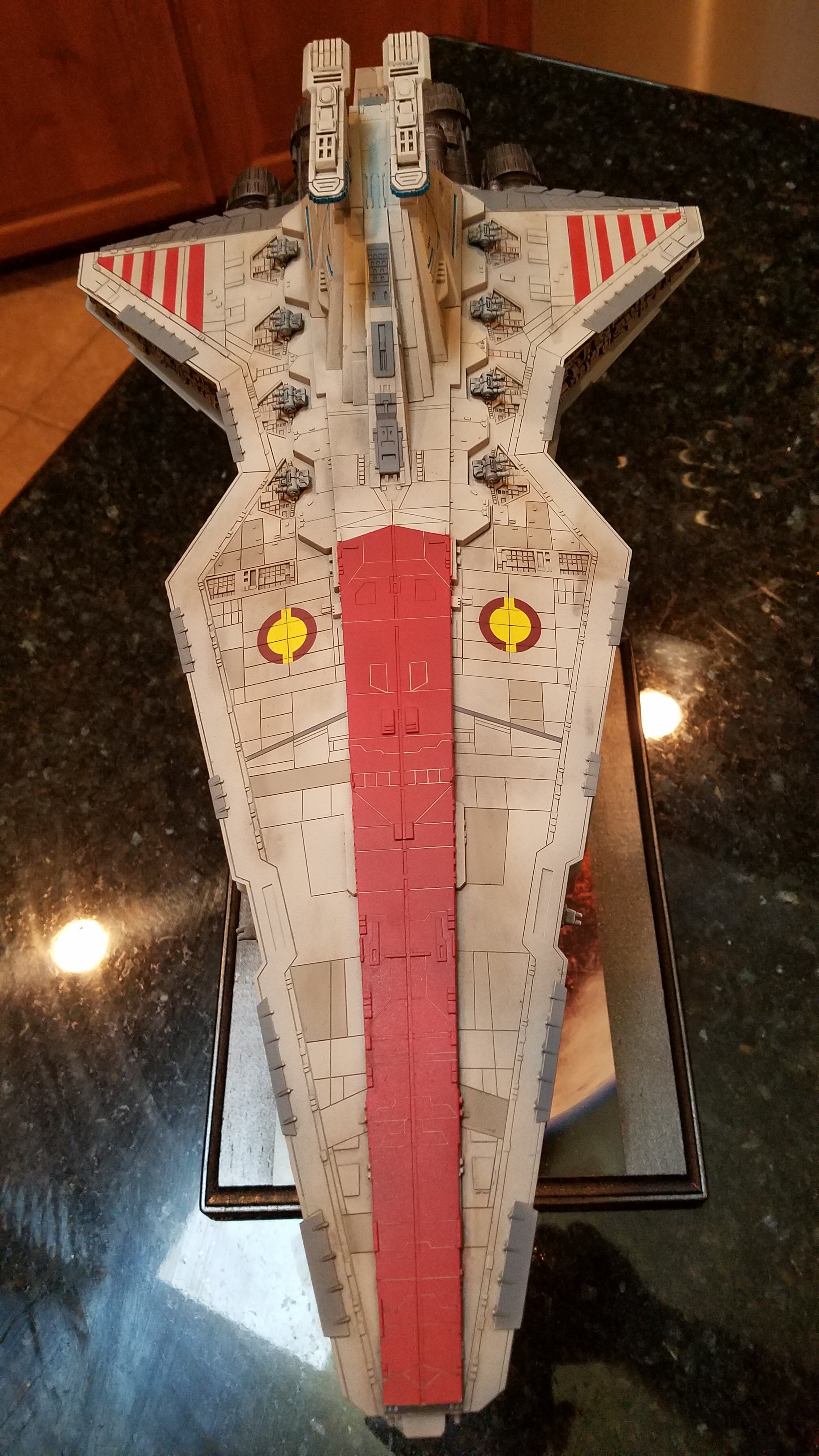

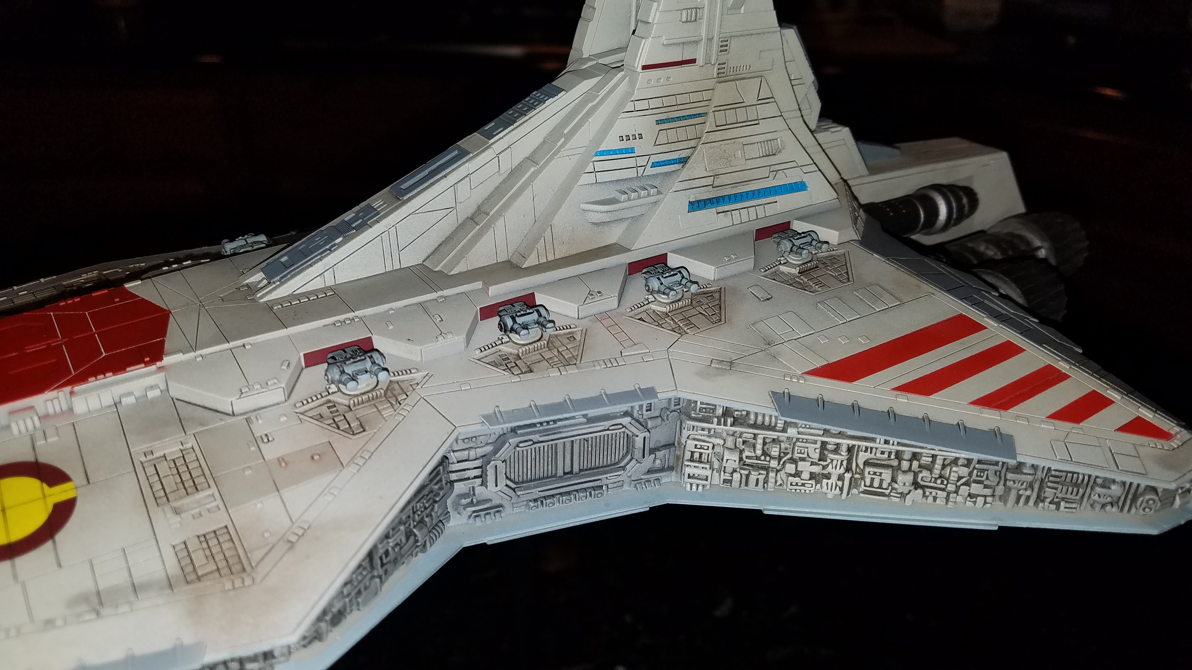

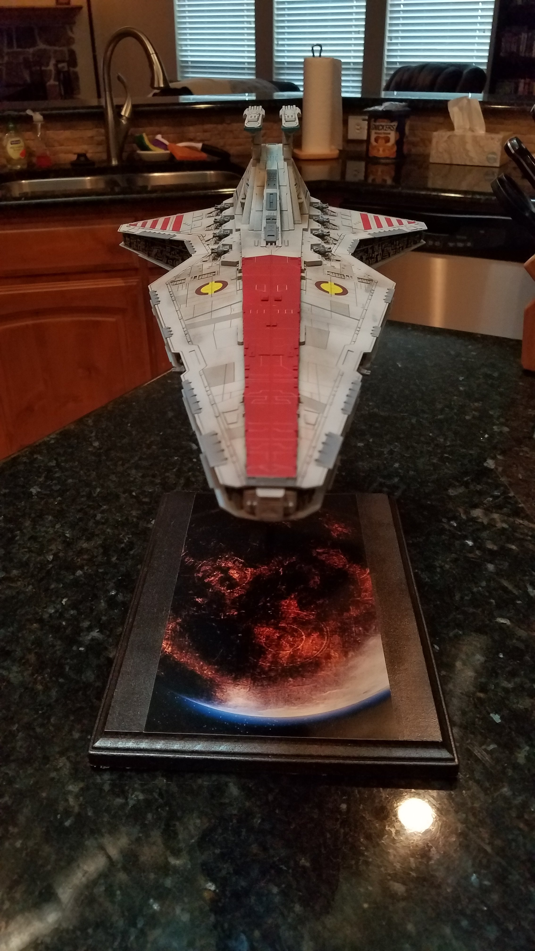

derex3592 Posted May 17, 2017 Posted May 17, 2017 Revell 2005 Republic Star Destroyer finished, good kit really, no problems, fun and easy, lots of masking and weathering. Had fun practicing on this getting ready for the upcoming 1/500 Yamato project! Quote
Xigfrid Posted May 17, 2017 Posted May 17, 2017 Nice job Derex! What is that greyish (metallic ?) color you used on the sides (the tube-like details)? Quote
arbit Posted May 17, 2017 Posted May 17, 2017 Amazing job Derex! The weathering and paneling is just perfect! Is it just me, or have you taken your painting to another level? Quote
derex3592 Posted May 17, 2017 Posted May 17, 2017 (edited) Thanks for all the compliments guys! I really appreciate them! @Xigfrid -- I black coated the entire model after primer, then base color, then black Tamiya panel line wash and Flory's Dark Dirt on the side panels, very randomly, then a very thin coat of base coat color again back over everything on the sides with all the greeblies and randomly on other parts of the ship, came out giving a cool dirty recessed effect I think! @Arbit -- I've been really trying to up my game with my airbrush and painting skills, been watching YouTube builds of ModelChili and others. what I did do this time around was seal in EVERY layer of things I did with Tamiya Gloss Clear out of the spray can, which can get $$$, but that stuff SEALS each layer and then you can build the layers up as you wish and always know you can cleanup if need be layer by layer. For example, lacquer base coat, SEAL, enamel panel line wash, SEAL, then acrylic panel paint details, SEAL, Then finally Flat Clear at the end. Edited May 17, 2017 by derex3592 Quote

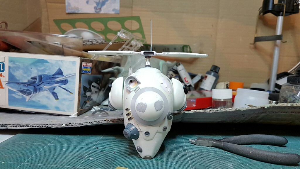

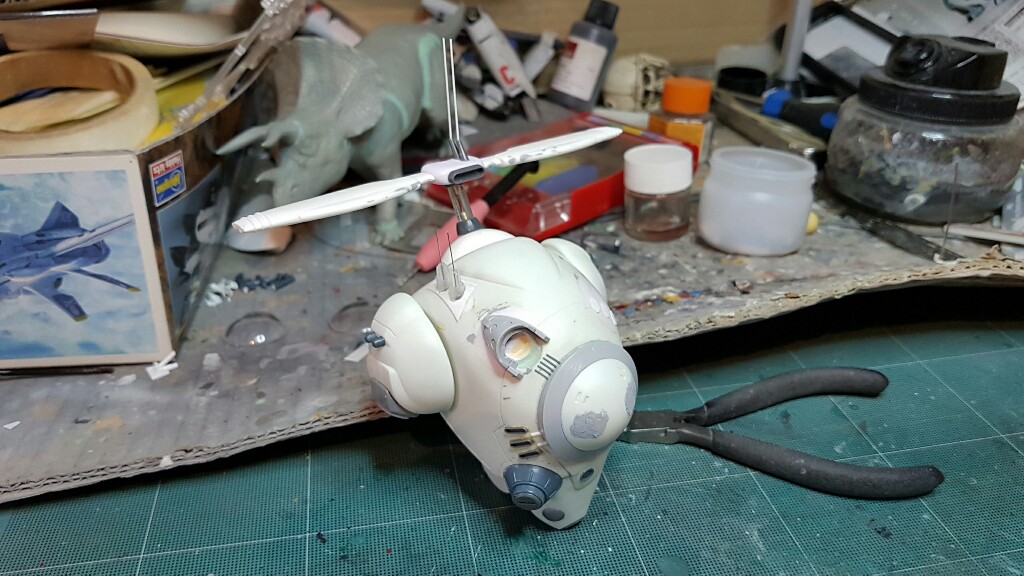

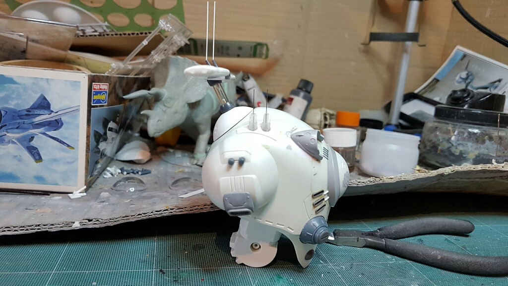

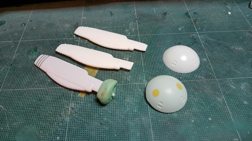

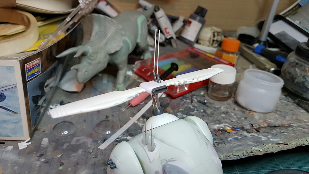

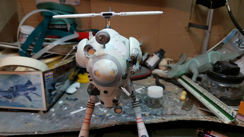

Cesar Enrique Posted May 17, 2017 Posted May 17, 2017 (edited) I sculpted the antenna for the head of my custom regult scout and then I casted it in resin, now I'm doing a test fit, what do you think guys? The lenght of the supporting pole is OK? Or should I make it shorter? Edited May 17, 2017 by Cesar Enrique Quote

pengbuzz Posted May 17, 2017 Posted May 17, 2017 12 minutes ago, Cesar Enrique said: I sculpted the antenna for the head of my custom regult scout and then I casted it in resin, now I'm doing a test fit, eBay do you think guys? The lenght of the supporting pole is OK? Or should I make it shorter? The length of the support pole looks fine to me. Nice work so far! Quote

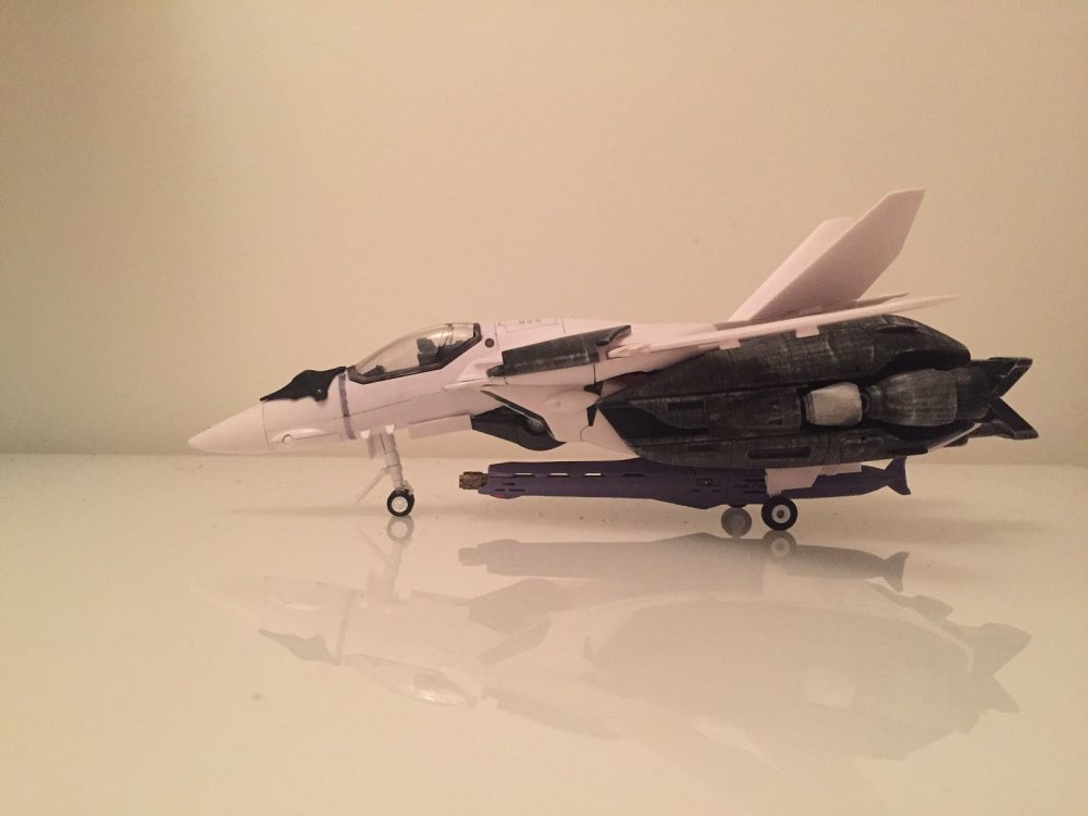

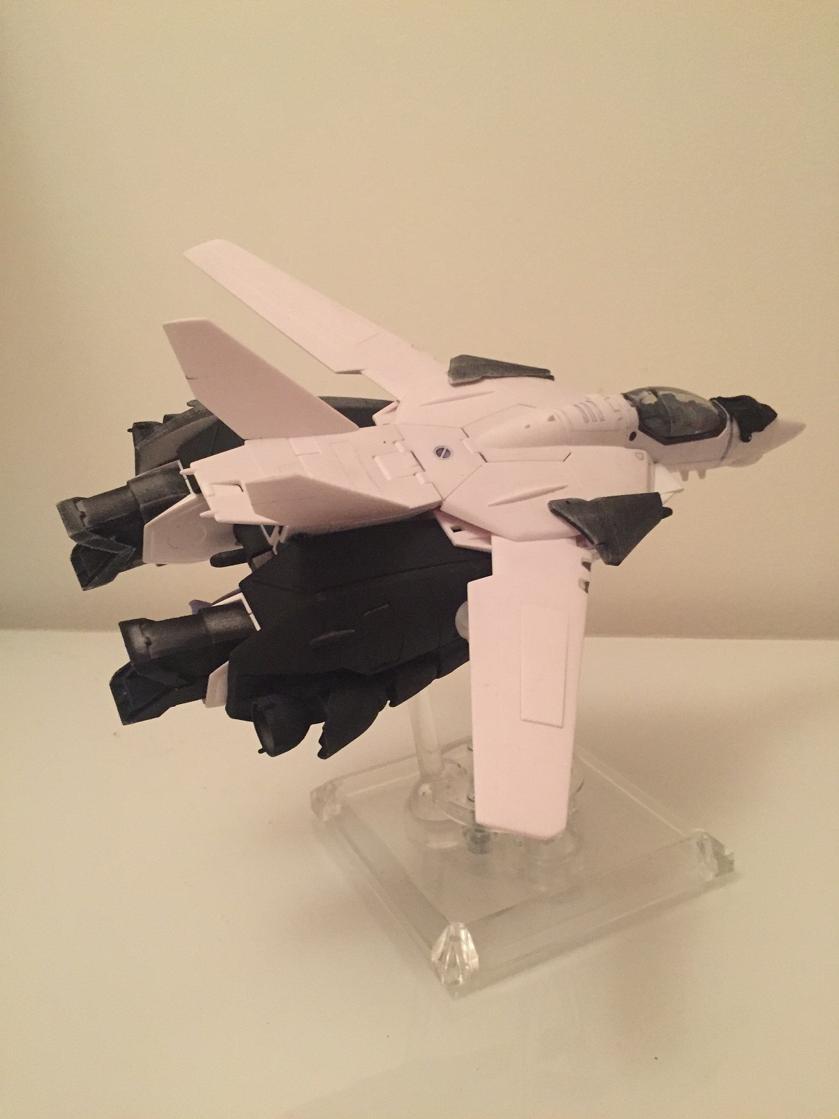

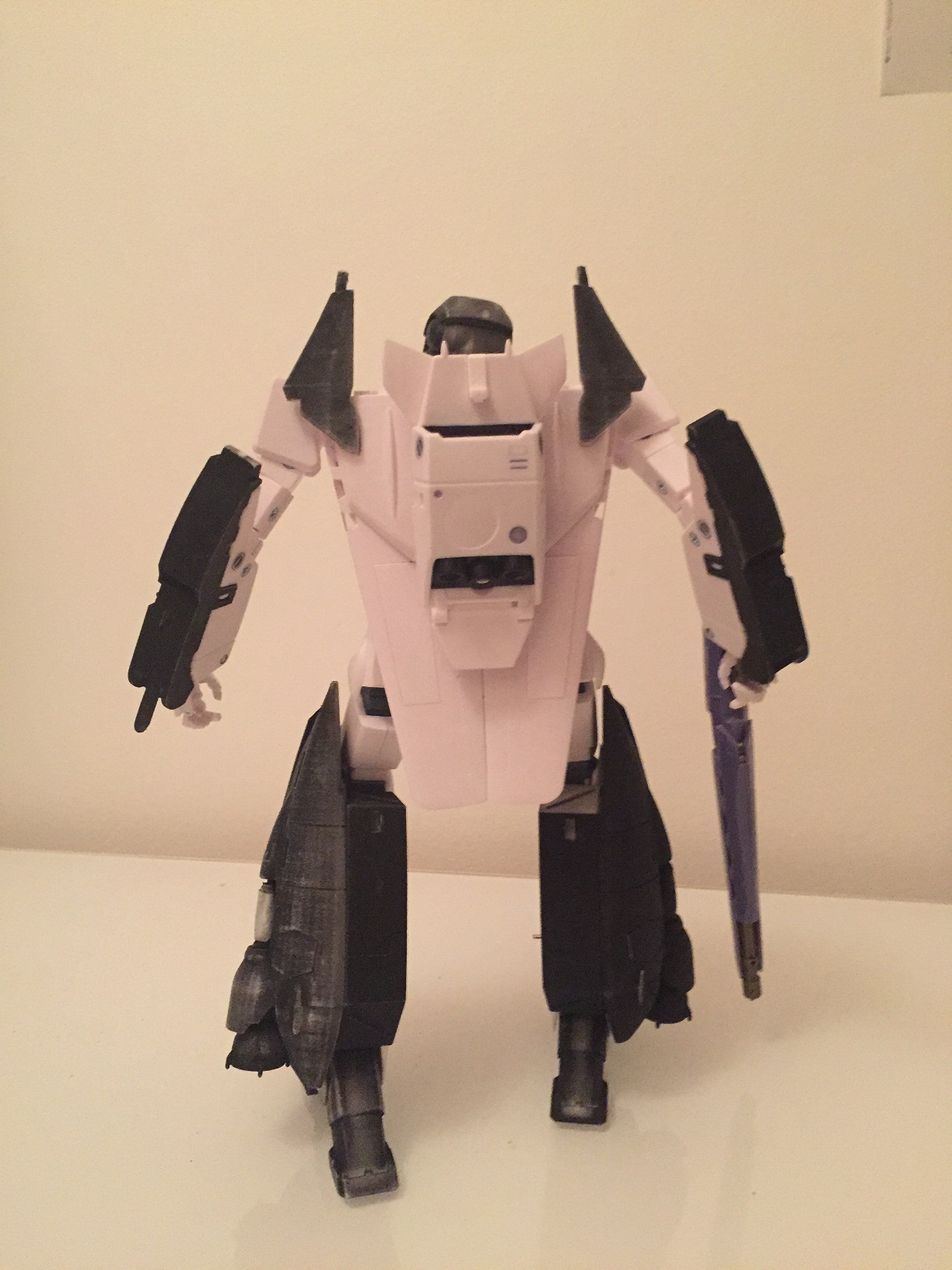

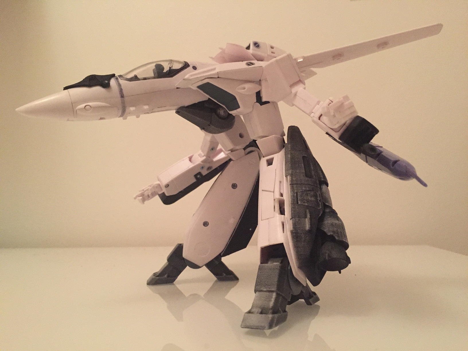

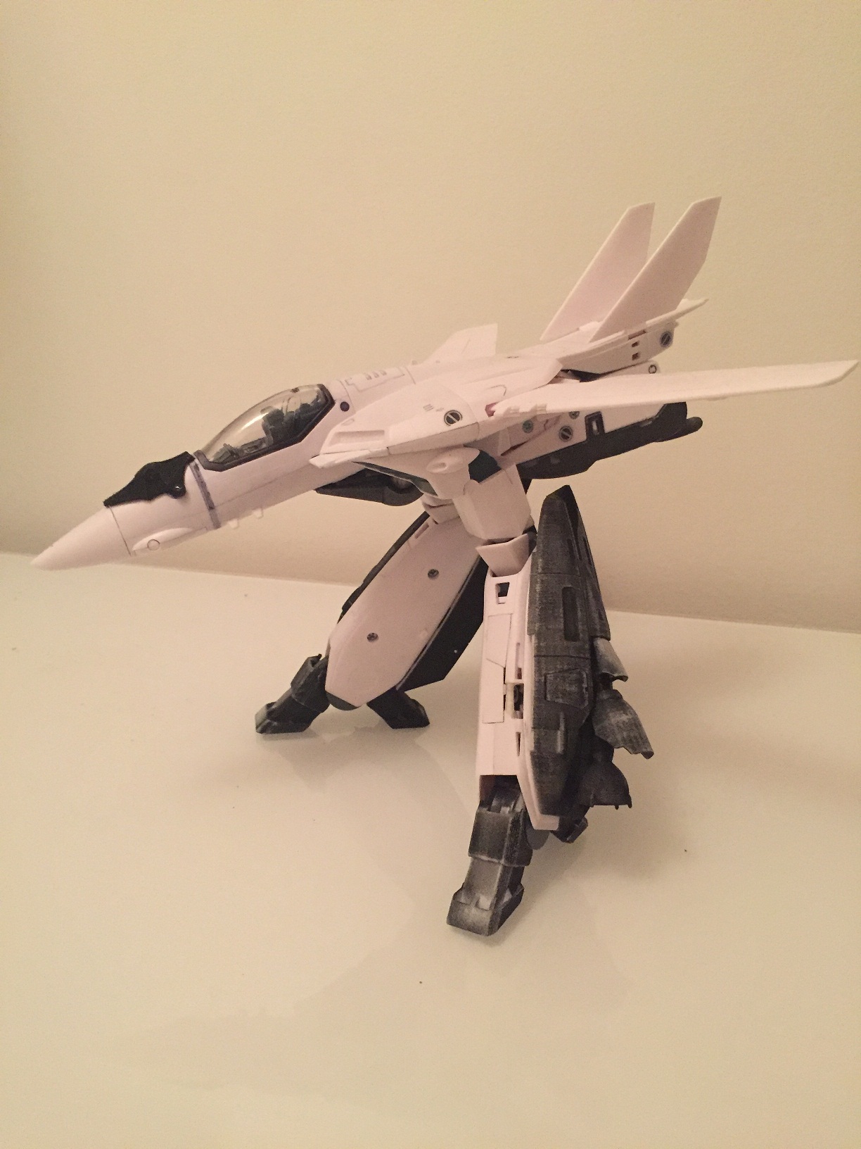

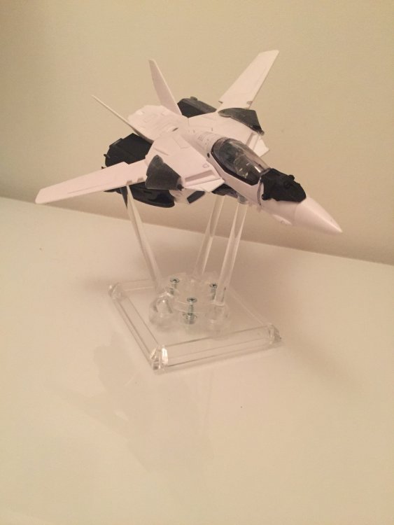

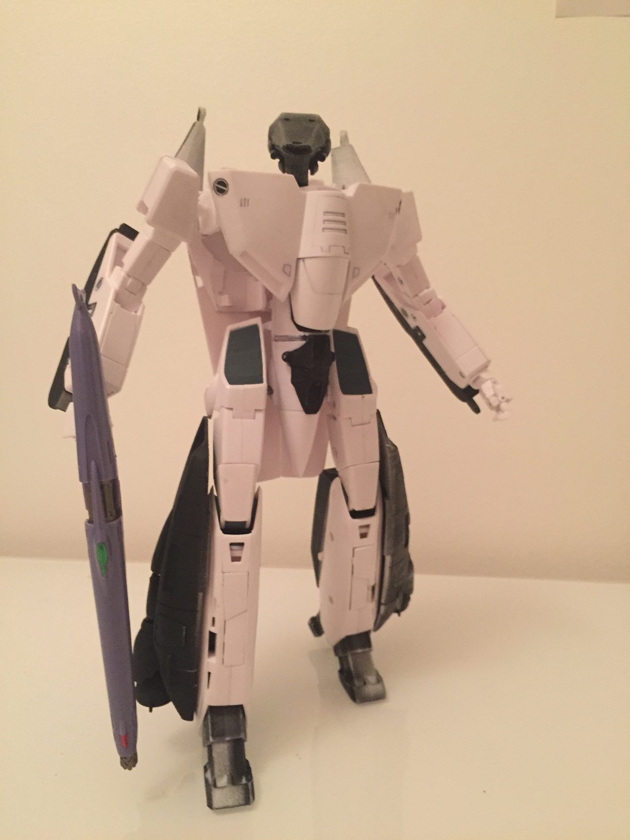

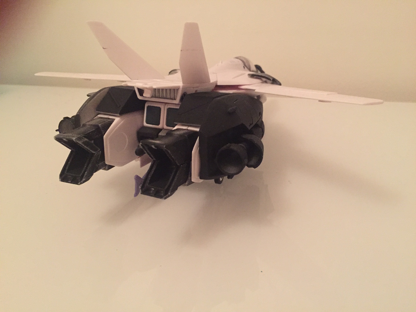

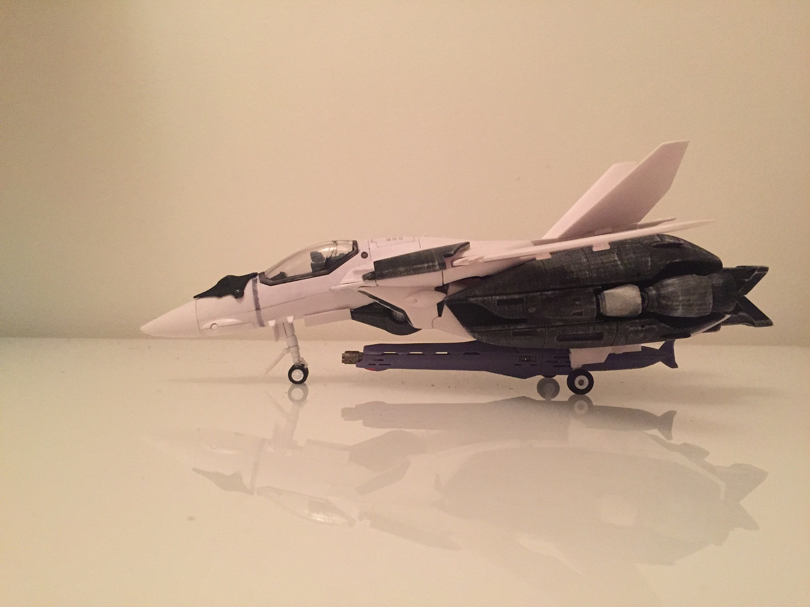

Xigfrid Posted May 17, 2017 Posted May 17, 2017 @derex3592 I have continuously had strong chemical reaction between Enamel paints (even dry for 2 days) and gloss Tamiya Spray TS-13... Perhaps I should give a try Tamiya's, any advices ? The VF-1X++ is almost finished now! I have put all the upgrade parts for sale on my Shapeways shop, except for the shoulders plates. I think I should open a new thread for this upgrade parts if there is some interest. Anyway the parts are just as I wish and I am pretty happy with it. Everything clicks hard and close firmly. Quote

derex3592 Posted May 18, 2017 Posted May 18, 2017 (edited) 5 hours ago, wmkjr said: @derex3592 So the Tamiya Clear spray would be safe to use on Tamiya acrylic paints given enough cure time? Got some custom colors mixes in Tamiya acrylic but wanna seal them in the Tamiya spray clear if possible. shouldn't be a problem. Use it all the time over acrylics. Edited May 18, 2017 by derex3592 @pengbuzz the scout looks perfectly good to me!!! Quote

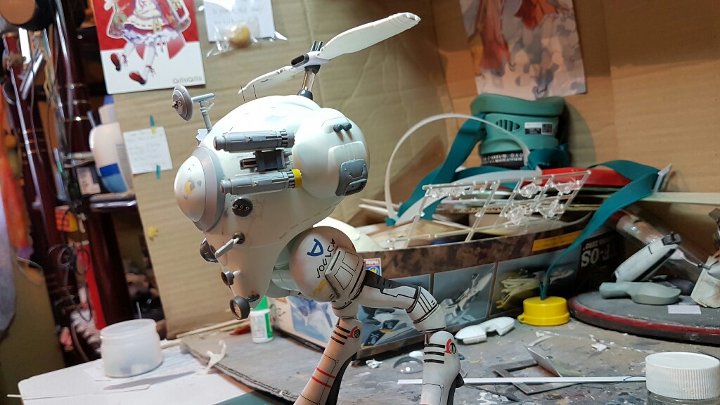

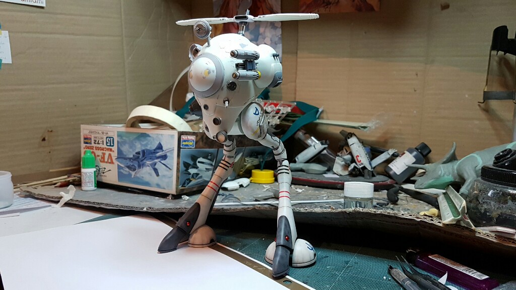

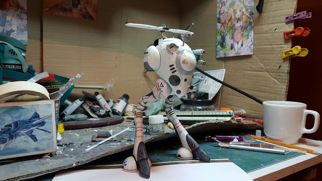

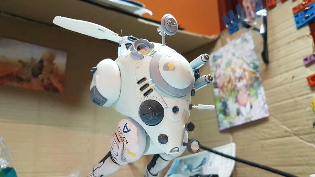

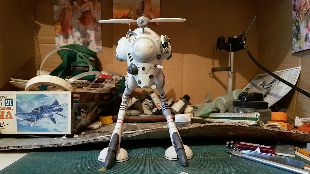

Cesar Enrique Posted May 18, 2017 Posted May 18, 2017 (edited) 23 hours ago, pengbuzz said: The length of the support pole looks fine to me. Nice work so far! Thank you. My custom Scout is almost done. I started this project almost 2 years ago and finally it's almost ready to be painted. Here is a test fitting of all sensors, they're not glued, just pinned, so some of those might look misaligned. What do you guys think? Should I add, adjust or change something? All critics are welcome. Edited May 18, 2017 by Cesar Enrique Quote

Thom Posted May 19, 2017 Posted May 19, 2017 On 5/17/2017 at 6:23 PM, Xigfrid said: @derex3592 I have continuously had strong chemical reaction between Enamel paints (even dry for 2 days) and gloss Tamiya Spray TS-13... Perhaps I should give a try Tamiya's, any advices ? The VF-1X++ is almost finished now! I have put all the upgrade parts for sale on my Shapeways shop, except for the shoulders plates. I think I should open a new thread for this upgrade parts if there is some interest. Anyway the parts are just as I wish and I am pretty happy with it. Everything clicks hard and close firmly. Looks fantastic! What's the link for the Shapeways page? On 5/18/2017 at 4:12 PM, Cesar Enrique said: Thank you. My custom Scout is almost done. I started this project almost 2 years ago and finally it's almost ready to be painted. Here is a test fitting of all sensors, they're not glued, just pinned, so some of those might look misaligned. What do you guys think? Should I add, adjust or change something? All critics are welcome. And that's an awesome looking scout! Nice work and well worth the effort. Quote
arbit Posted May 20, 2017 Posted May 20, 2017 On 5/19/2017 at 0:12 AM, Cesar Enrique said: Here is a test fitting of all sensors, they're not glued, just pinned, so some of those might look misaligned. What do you guys think? Should I add, adjust or change something? All critics are welcome. What is the line art you are using for this custom? Give us a screen cap. Quote

Xigfrid Posted May 20, 2017 Posted May 20, 2017 10 hours ago, Thom said: Looks fantastic! What's the link for the Shapeways page? And that's an awesome looking scout! Nice work and well worth the effort. Thanks, the VF-1X++ parts are all in this section: https://www.shapeways.com/shops/xigfrid3dshop?section=VF-1X%2B%2B&sort= Quote
Convectuoso Posted May 20, 2017 Posted May 20, 2017 On 2017-5-18 at 4:12 PM, Cesar Enrique said: Thank you. My custom Scout is almost done. I started this project almost 2 years ago and finally it's almost ready to be painted. Here is a test fitting of all sensors, they're not glued, just pinned, so some of those might look misaligned. What do you guys think? Should I add, adjust or change something? All critics are welcome. That Scout looks awesome! Congratulations! Quote
