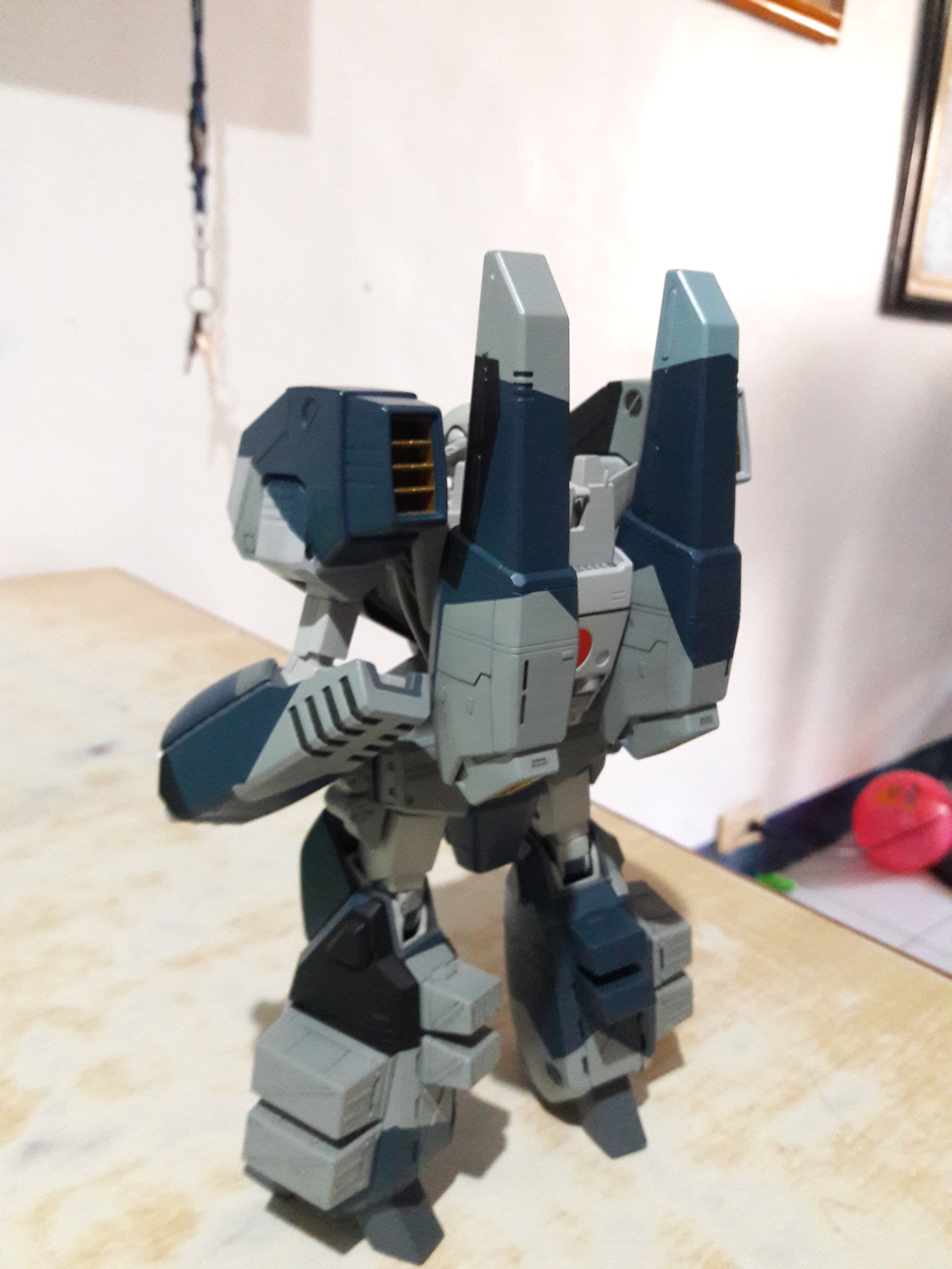

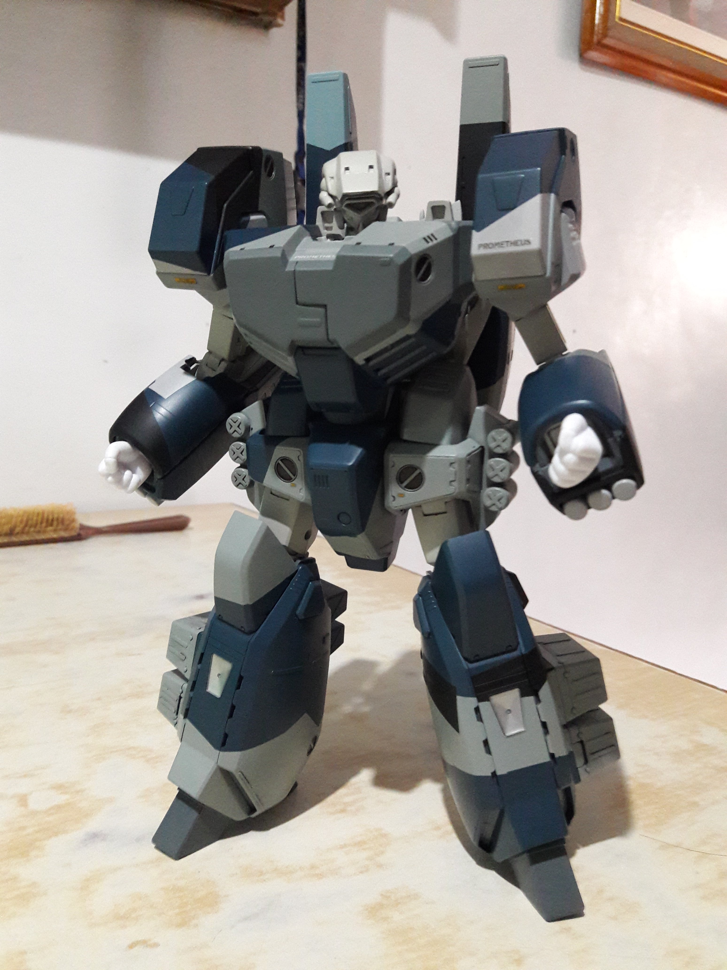

chyll2 Posted January 31, 2017 Posted January 31, 2017 Another update. Almost done with the armor. I can now focus on the VF-1 and redo some parts. The thigh that got seam fixed opened up again. Quote

Xigfrid Posted January 31, 2017 Posted January 31, 2017 3 hours ago, chyll2 said: Another update. Almost done with the armor. I can now focus on the VF-1 and redo some parts. The thigh that got seam fixed opened up again. I liked both the previous and this schem, this head is really nice, the more I see it the more I want to make the complete upgrade set... i still got an unpainted version lying around Quote

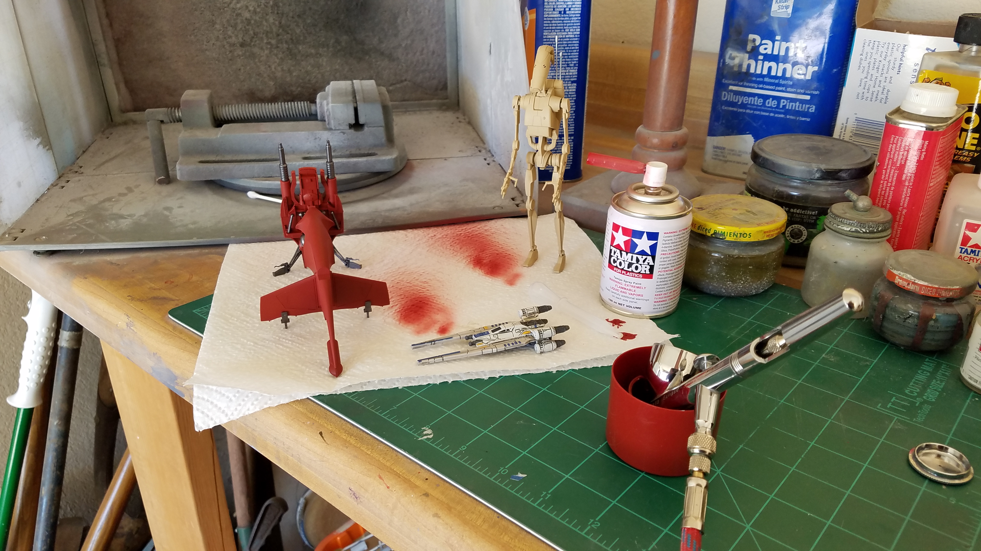

derex3592 Posted January 31, 2017 Posted January 31, 2017 (edited) Off work early on an absolutely gorgeous day, so I'm at the bench with many things getting done! p.s...I have a new favorite color .. Tamiya TS Gun Metal..it is just the business! Edited January 31, 2017 by derex3592 Quote
chyll2 Posted February 1, 2017 Posted February 1, 2017 @Xigfrid just go do the complete upgrade set. @derex3592 just a trivia, Gun-metal color is really popular in Gunpla painting, it is pretty much the de-facto inner frame color. Quote

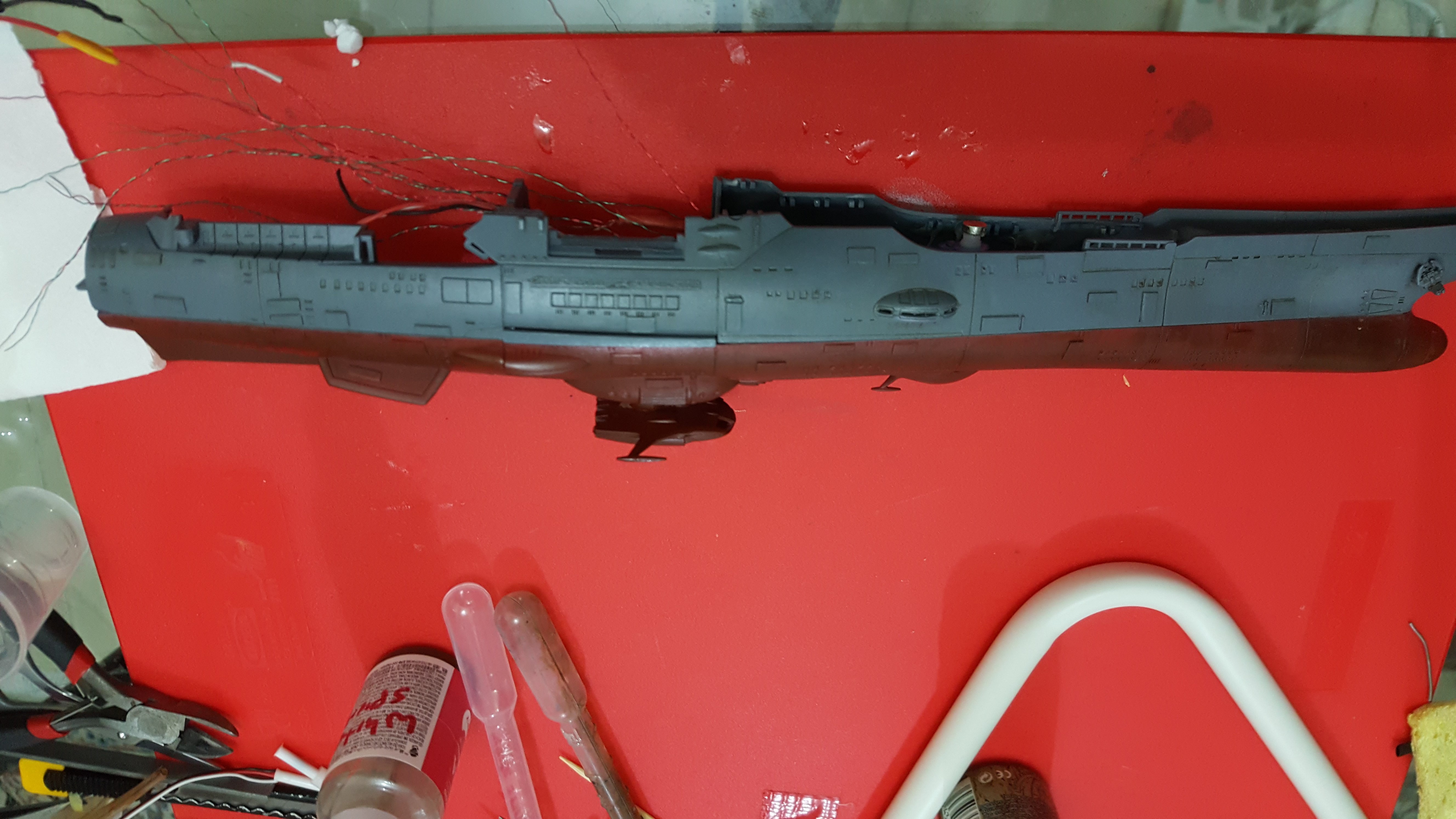

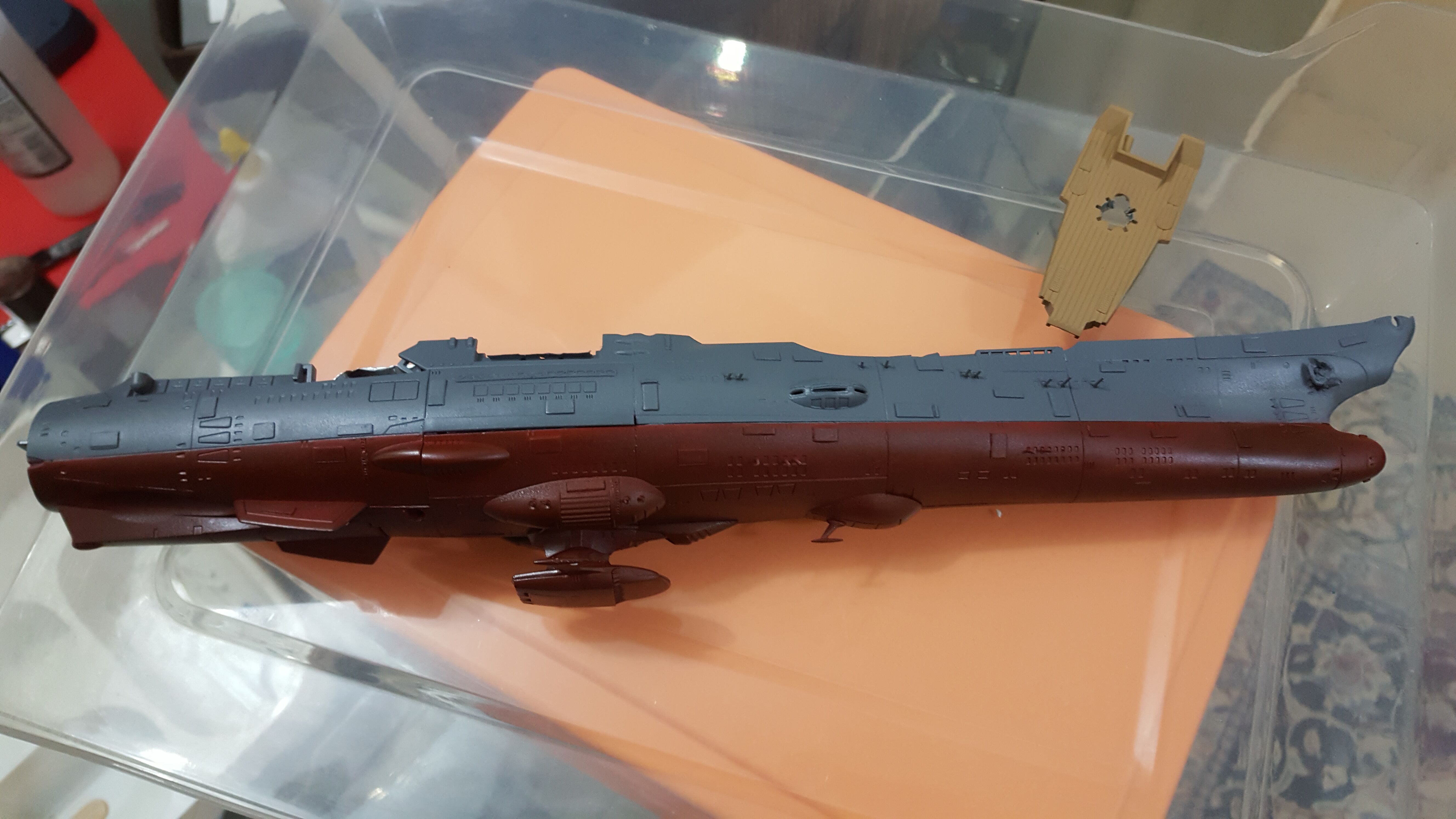

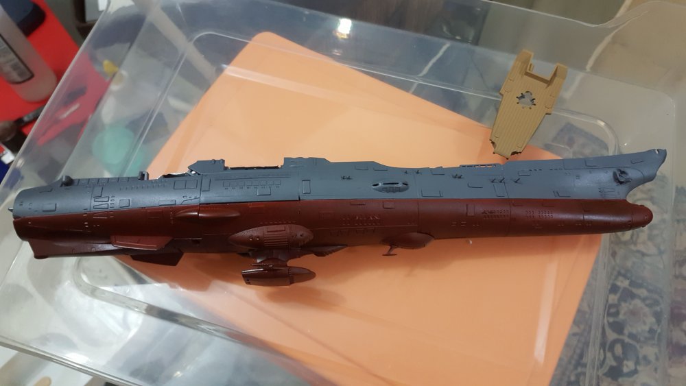

arbit Posted February 1, 2017 Posted February 1, 2017 Its not a work of art, but got the paint and gloss done. Now the fun begins. Quote

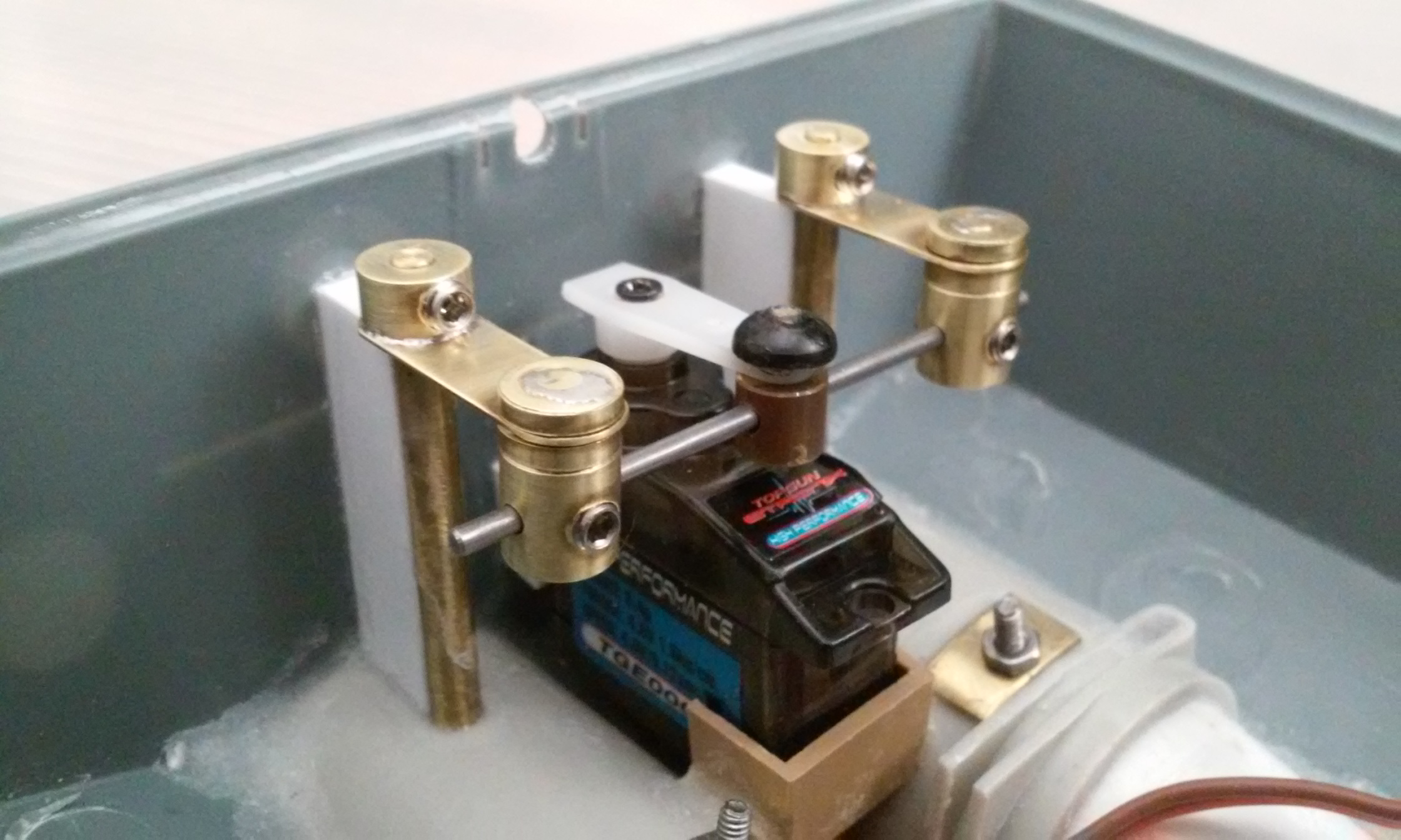

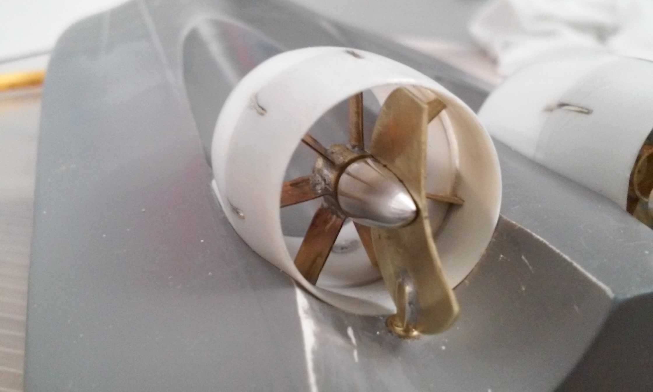

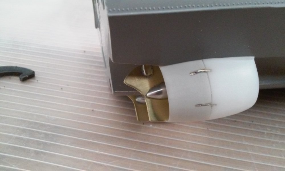

MechTech Posted February 1, 2017 Posted February 1, 2017 That scheme looks good Chyll! It adds a modern touch to it. The Yamato is coming along Arbit! Hopefully you have a safe place or case to put that in. The rudders are finally done - except for the tear drop shaped fairings that will cover the hole in the middle. The photo is deceptive, but that's a micro servo. I tried to build everything so there is no play in the rudders. The rudders sit in the jet flow so any slight moves equate to big course changes. The rudders are also nearly round to fit right up into the nacelle jets for extreme deflection. A water jet drive style nozzle wouldn't fit here so the rudders were the next best thing. - MT Quote
mickyg Posted February 1, 2017 Posted February 1, 2017 Looking amazing MechTech! I especially love all the simple ways you have of making micro adjustments to the alignment on the rudders. I'm guessing you may need to fiddle with them a bit before you lock them into place? Can't wait to see how this performs on the water. Also makes me wonder how something in 1:1 scale does with this arrangement. Looks like a really great way to make and direct thrust in the water. Quote

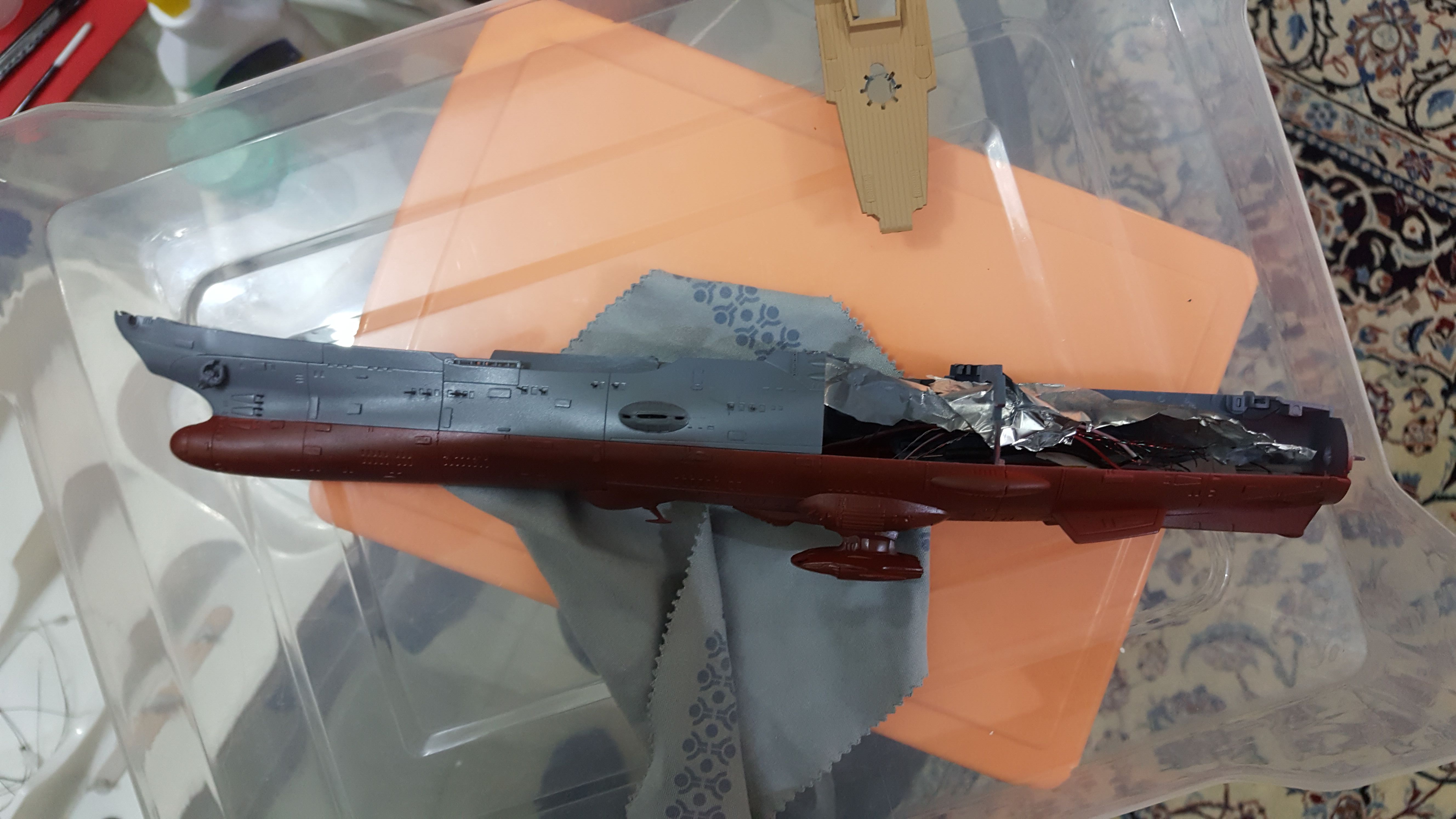

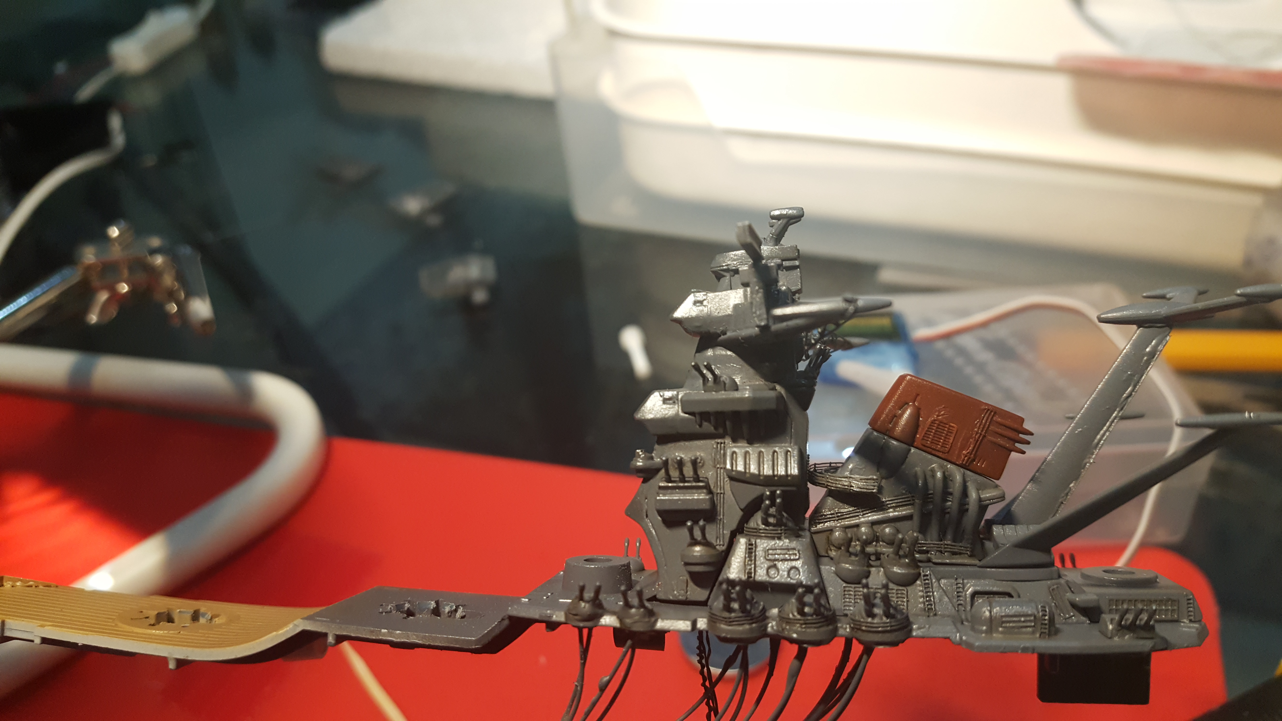

arbit Posted February 2, 2017 Posted February 2, 2017 Udon soup break. I've been soldering for 5 hours. Tonight we know if she flies. Quote
arbit Posted February 3, 2017 Posted February 3, 2017 She lists a bit to port, but she is sea worthy. Enjoy. Quote

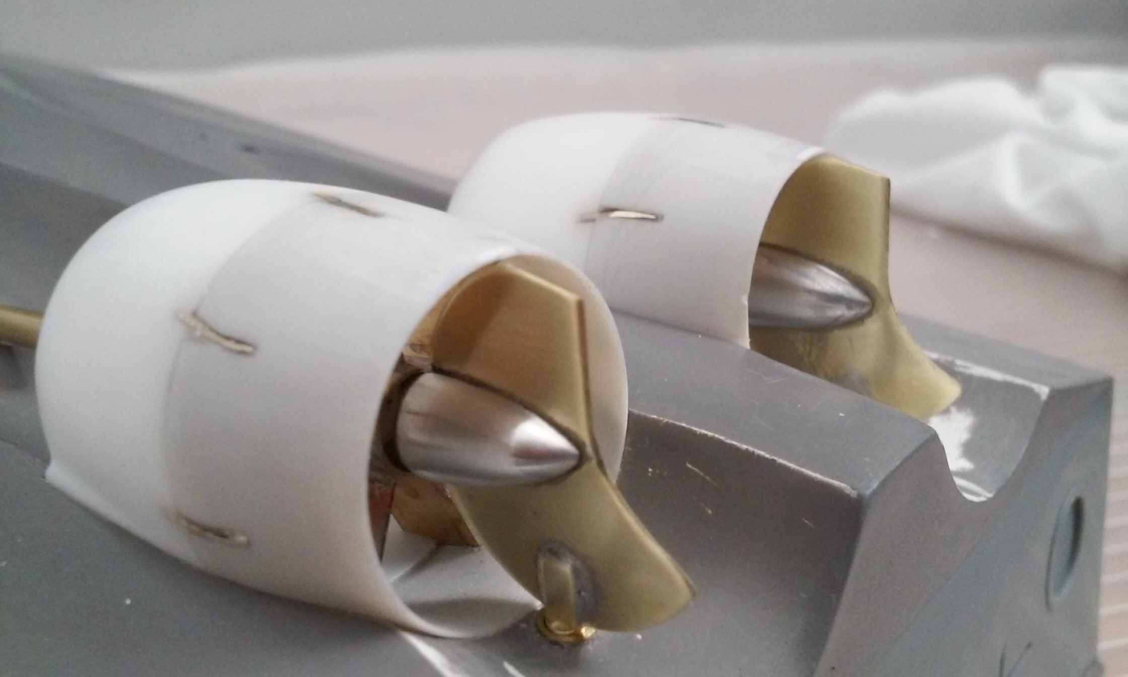

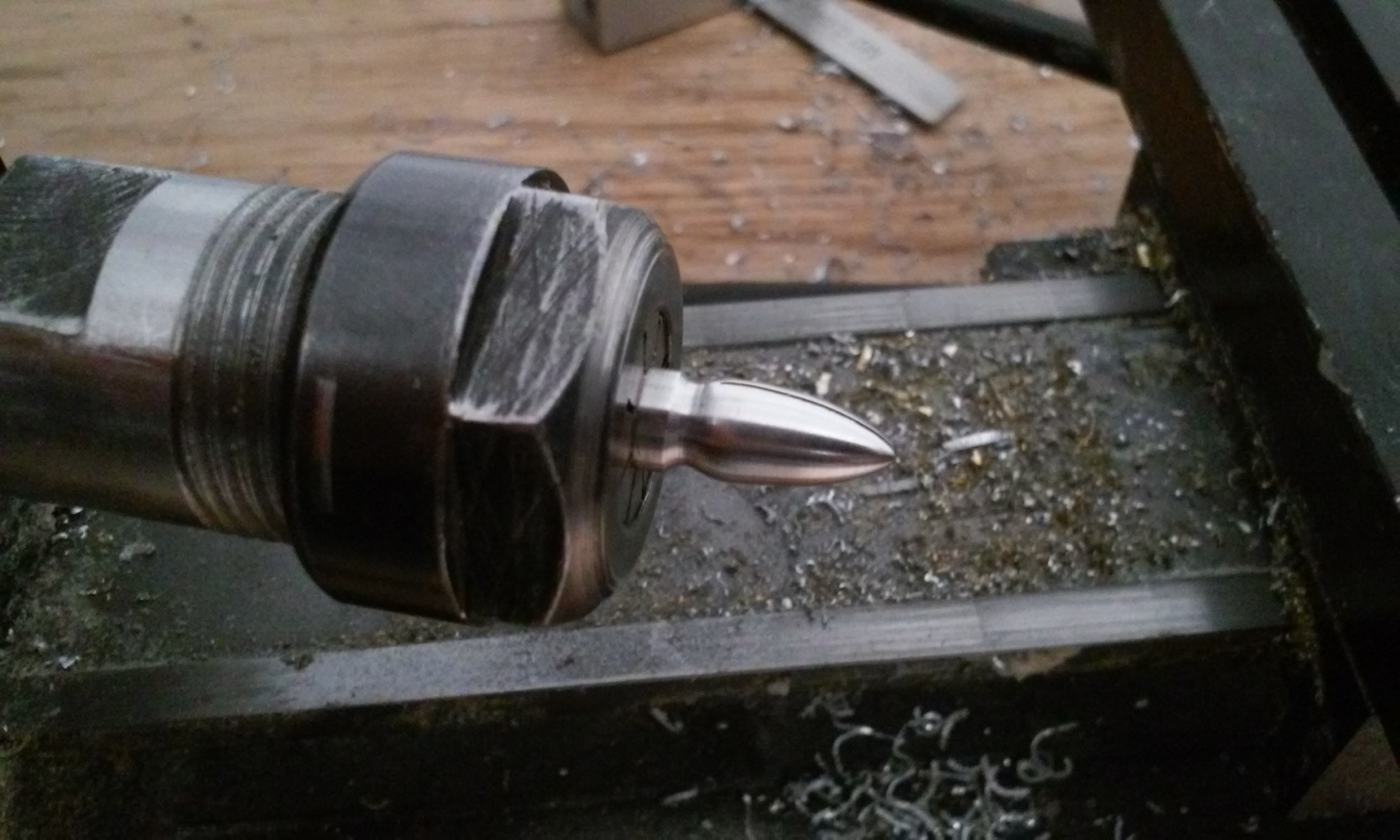

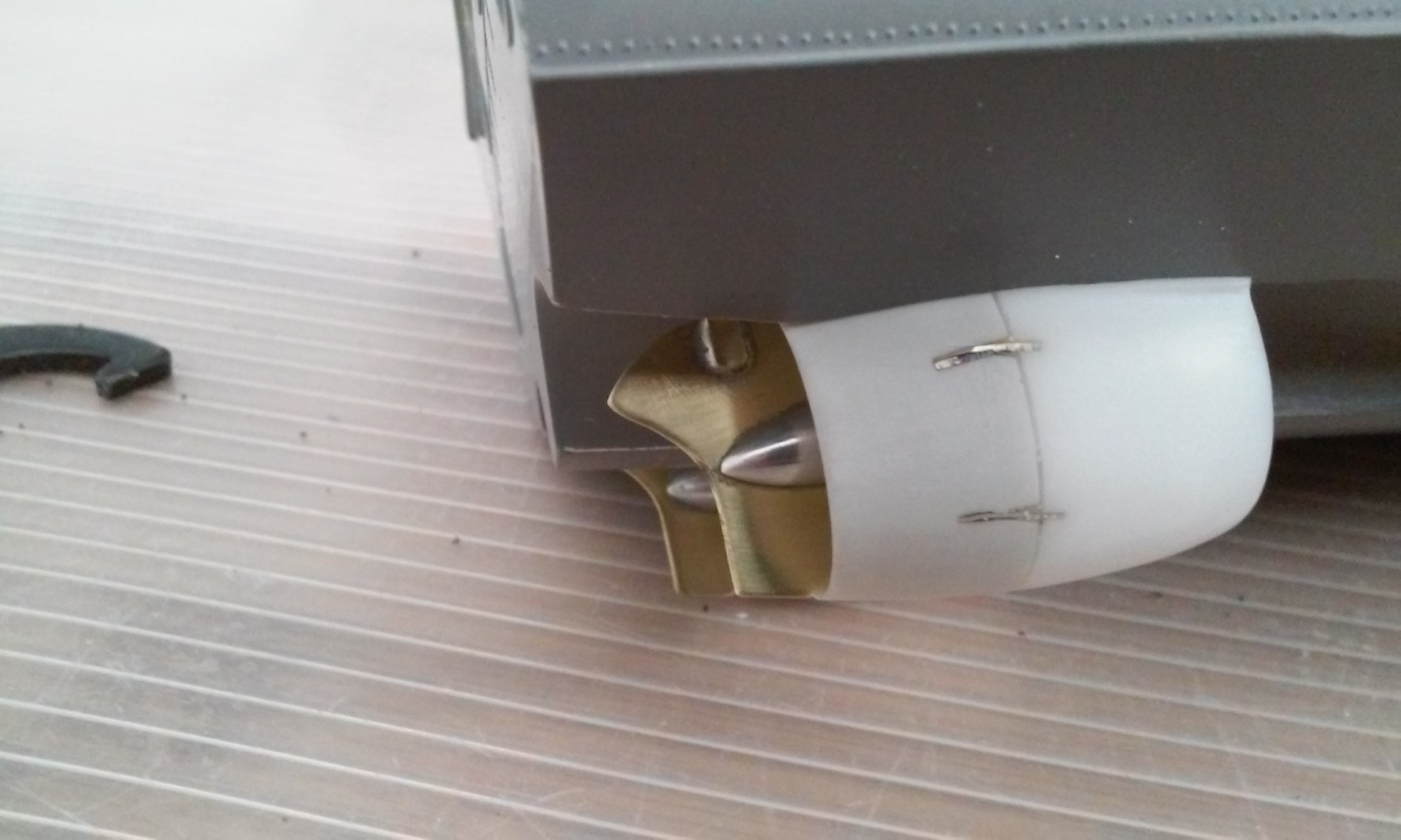

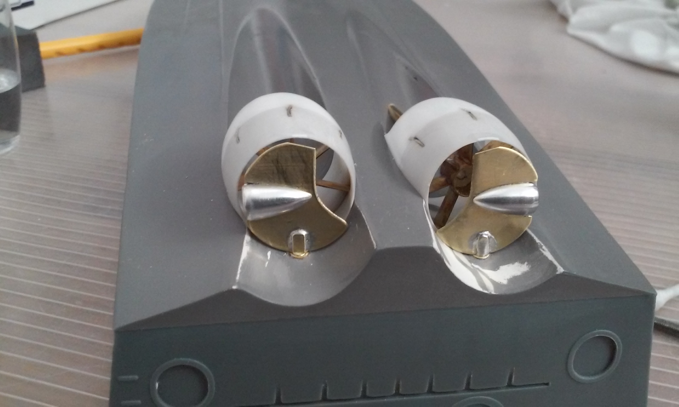

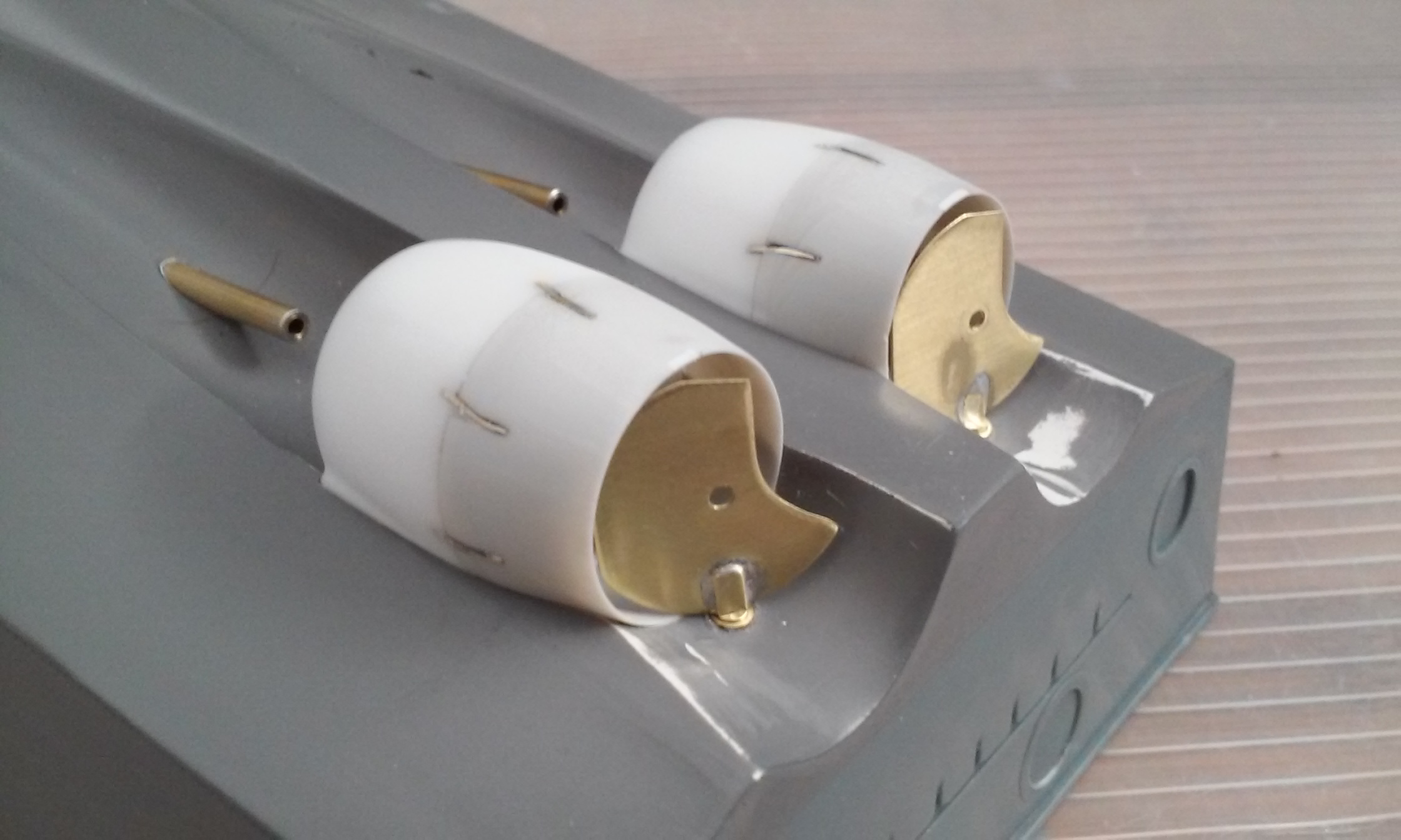

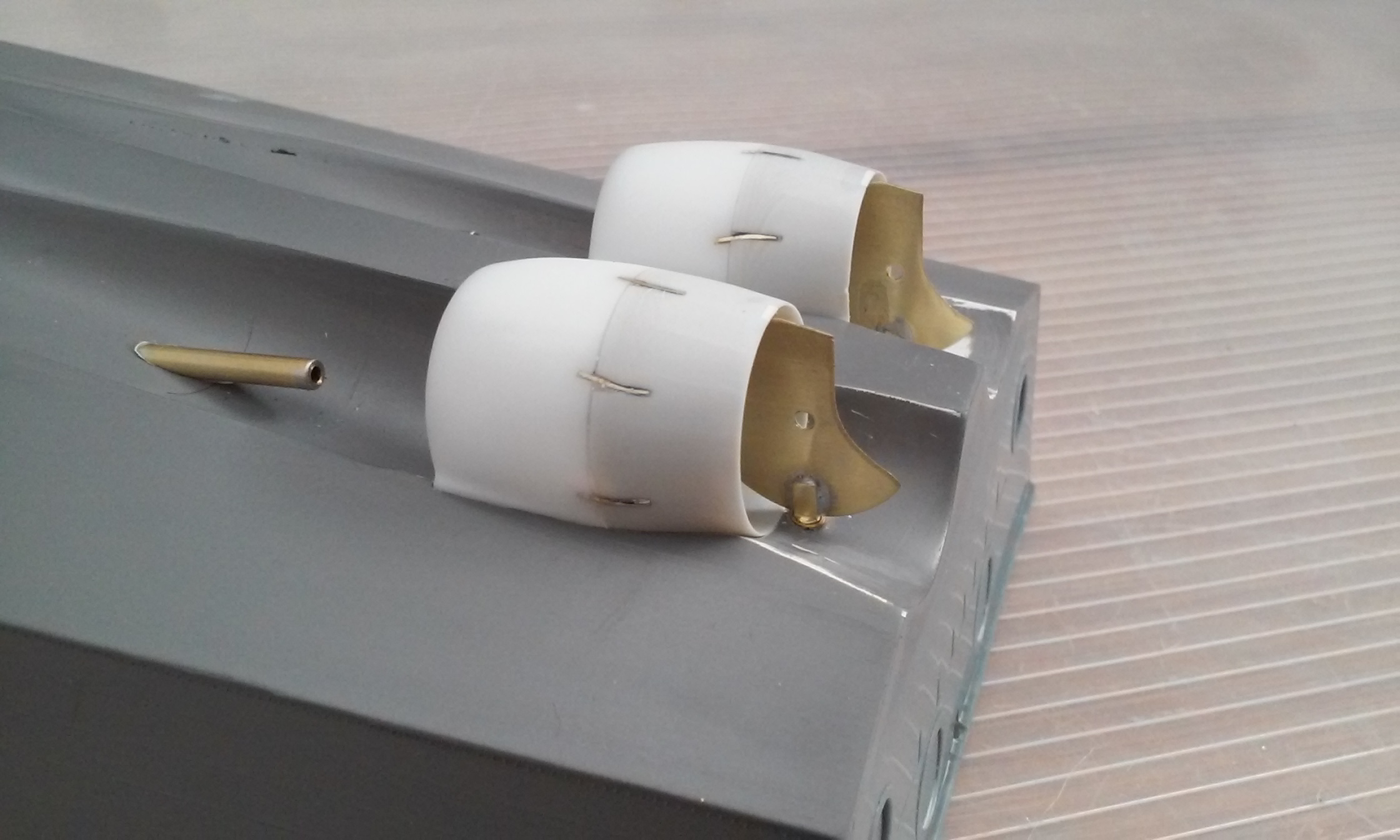

MechTech Posted February 5, 2017 Posted February 5, 2017 YA-MA-TO!!! That came out awesome Arbit, especially for a project that small! Congrats! That's some serious paint NZEOD! The paint probably weighs more than the plastic. - MT Got the running hardware DONE! The rudders now have a "bulb" on them to improve the flow and hydrodynamics. They will probably stay paintless since the paint will get water blasted off eventually anyhow. I also found a bad solder joint on the starboard side rudder so fixed that too. It just won't be as "clean" as the other side. On to the hull and topside now. - MT Quote
