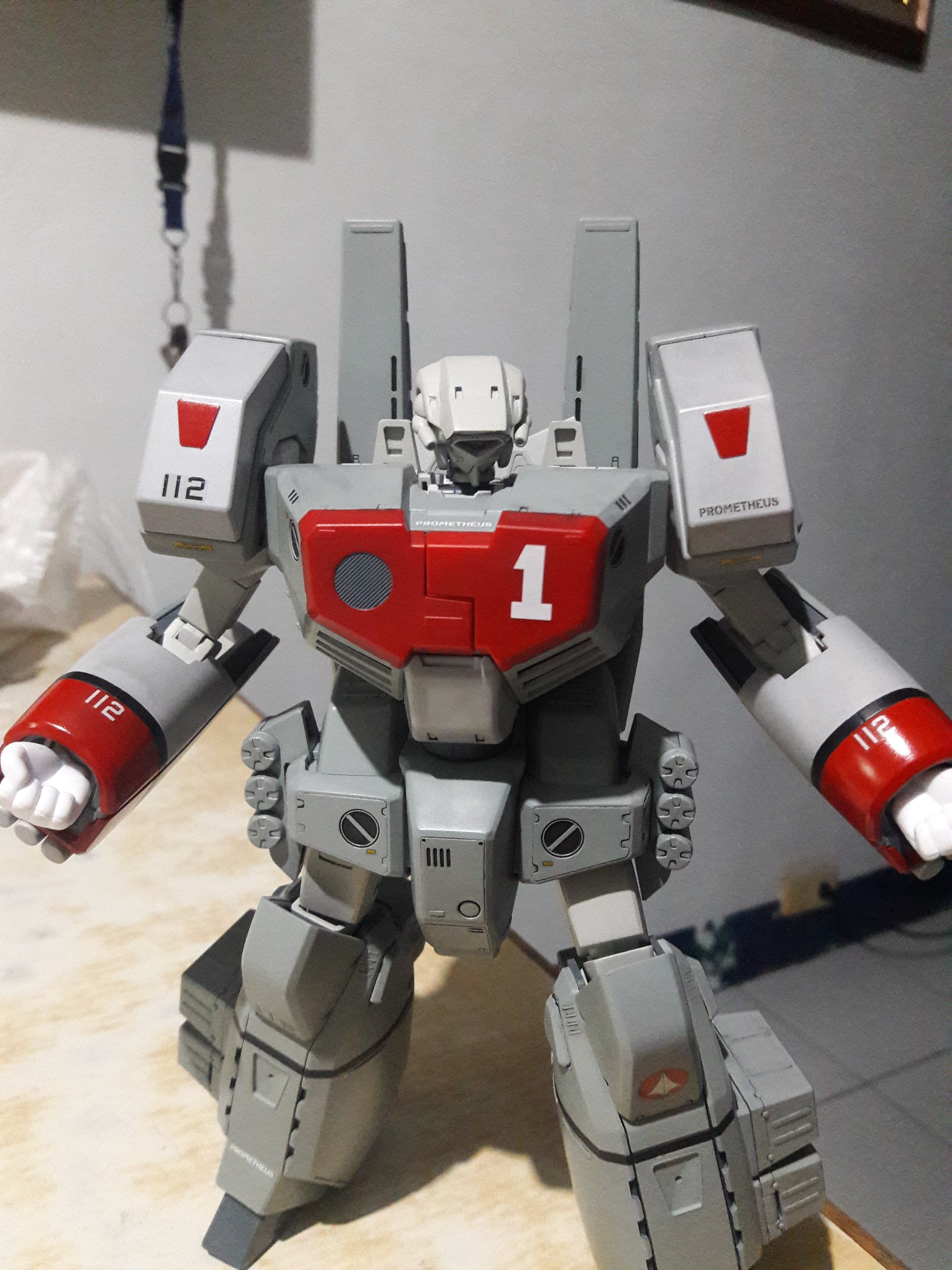

chyll2 Posted January 23, 2017 Posted January 23, 2017 Decal is done I guess. Just need to refix the head that I dropped for the Nth time. Once done, I can spray the flat coat and be done. Quote

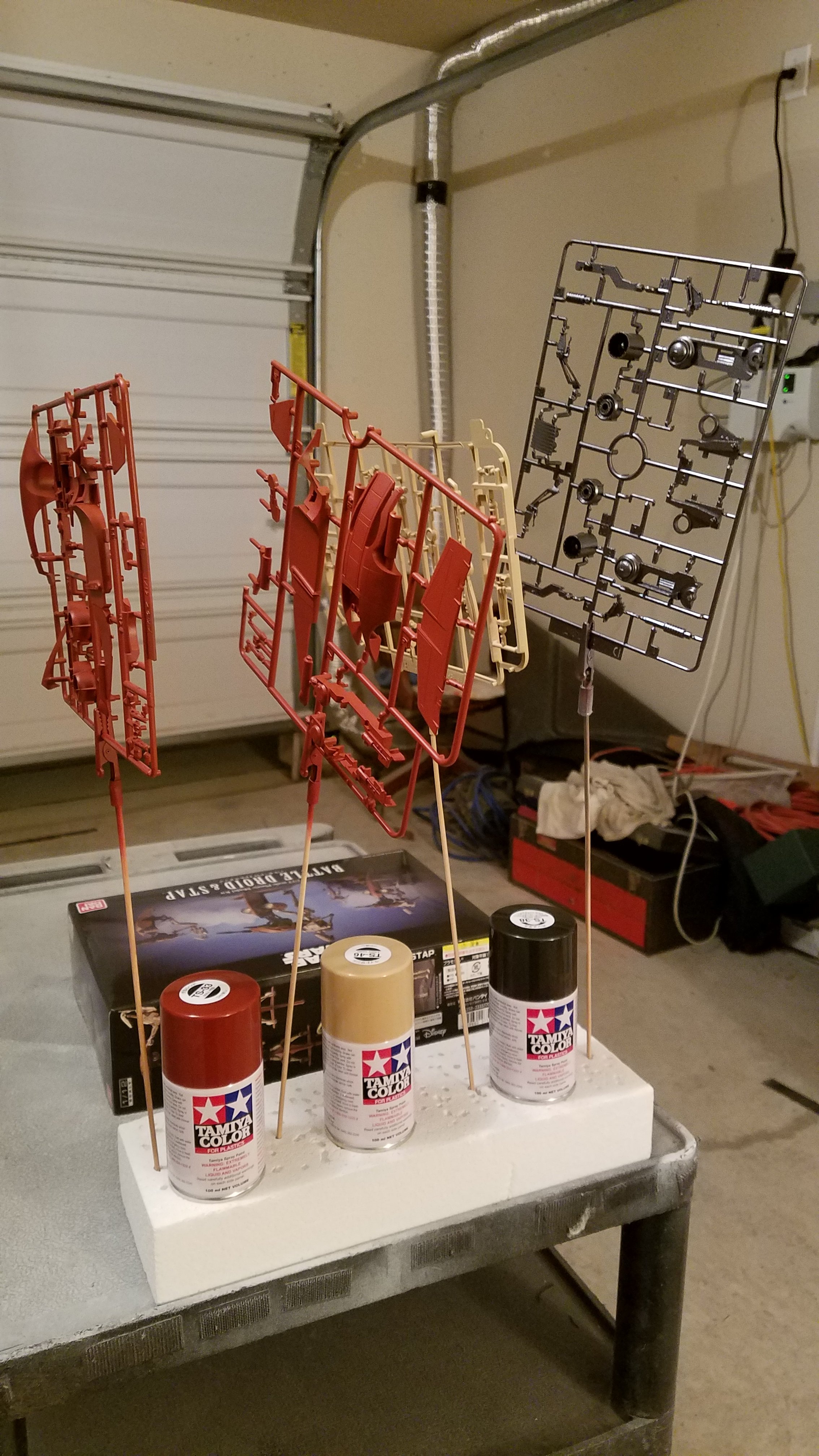

derex3592 Posted January 24, 2017 Posted January 24, 2017 weeknight battle droid painting session because the weather is just gorgeous right now!... and the Hobby Shop had the three colors I needed today! Quote

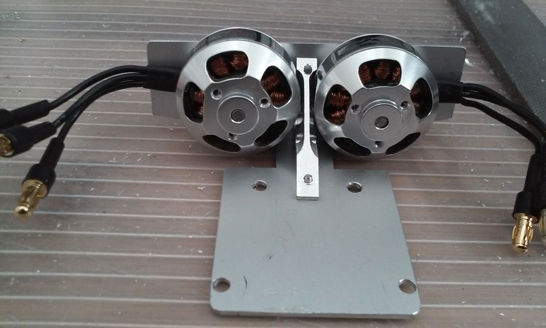

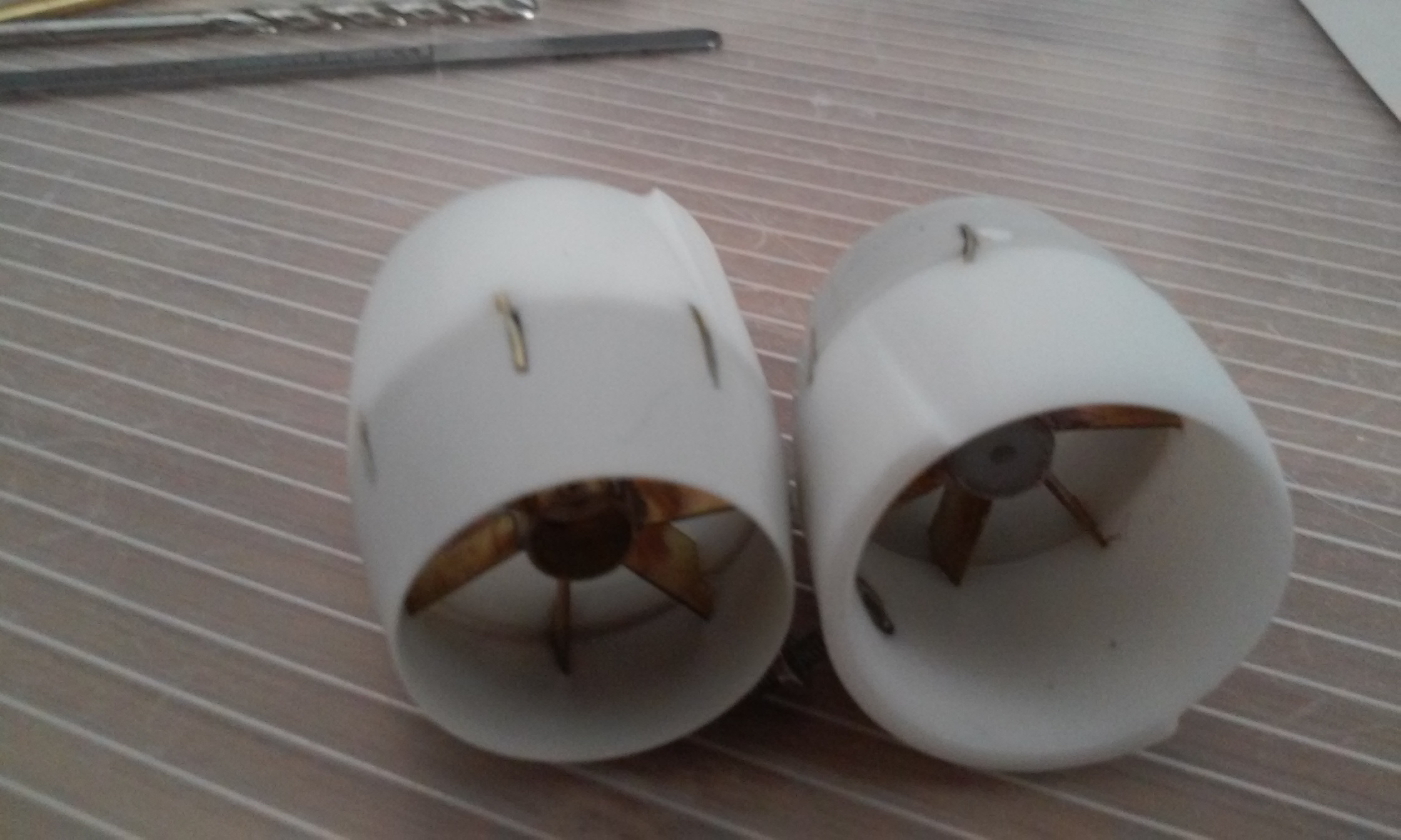

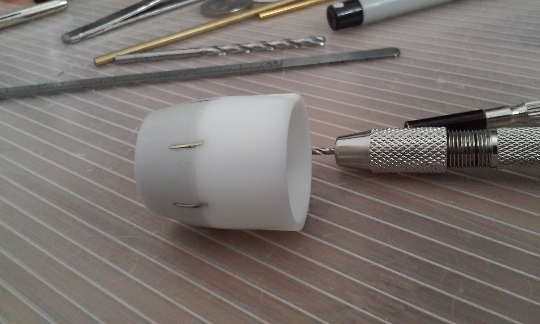

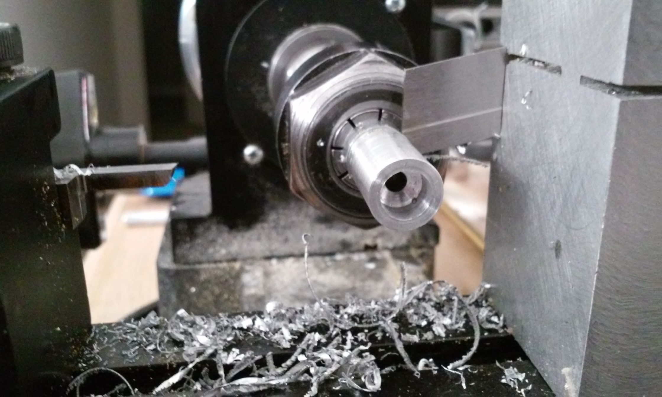

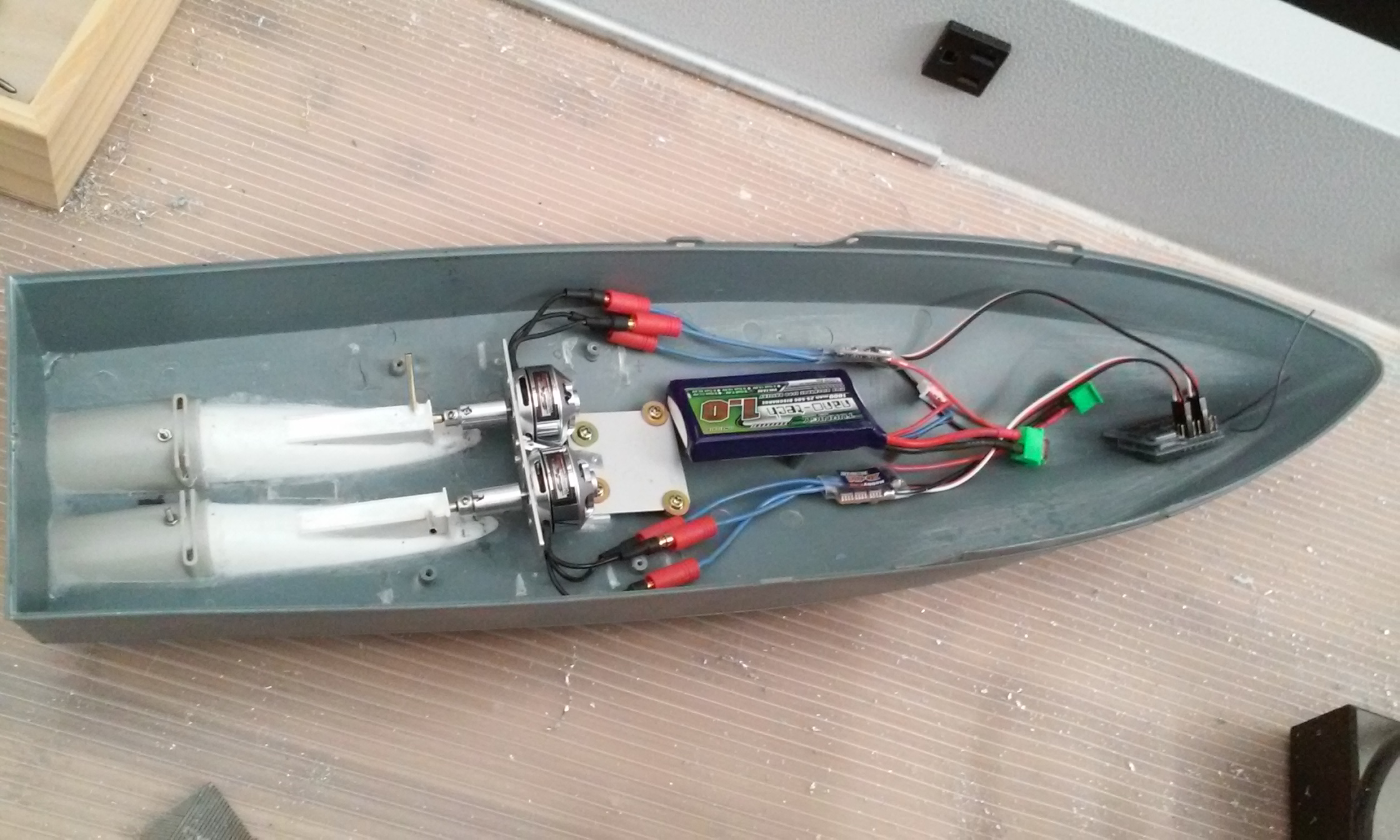

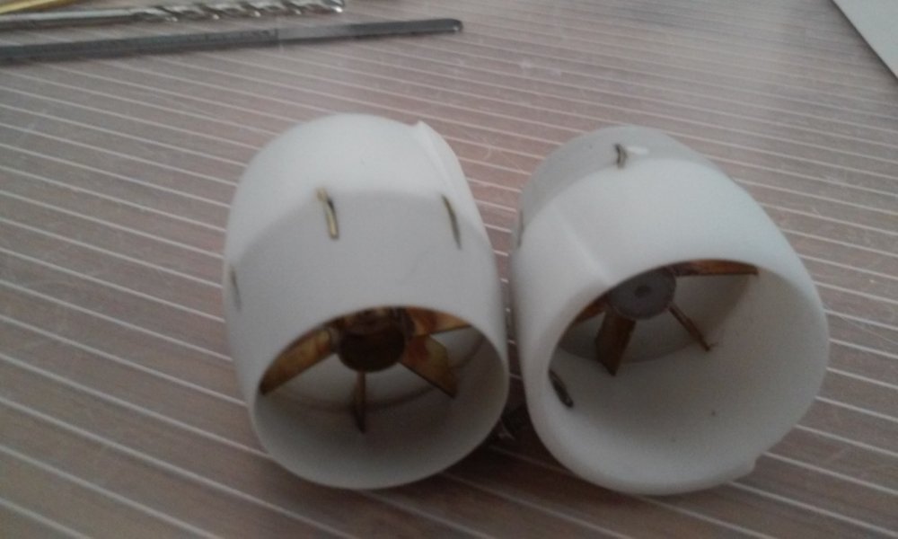

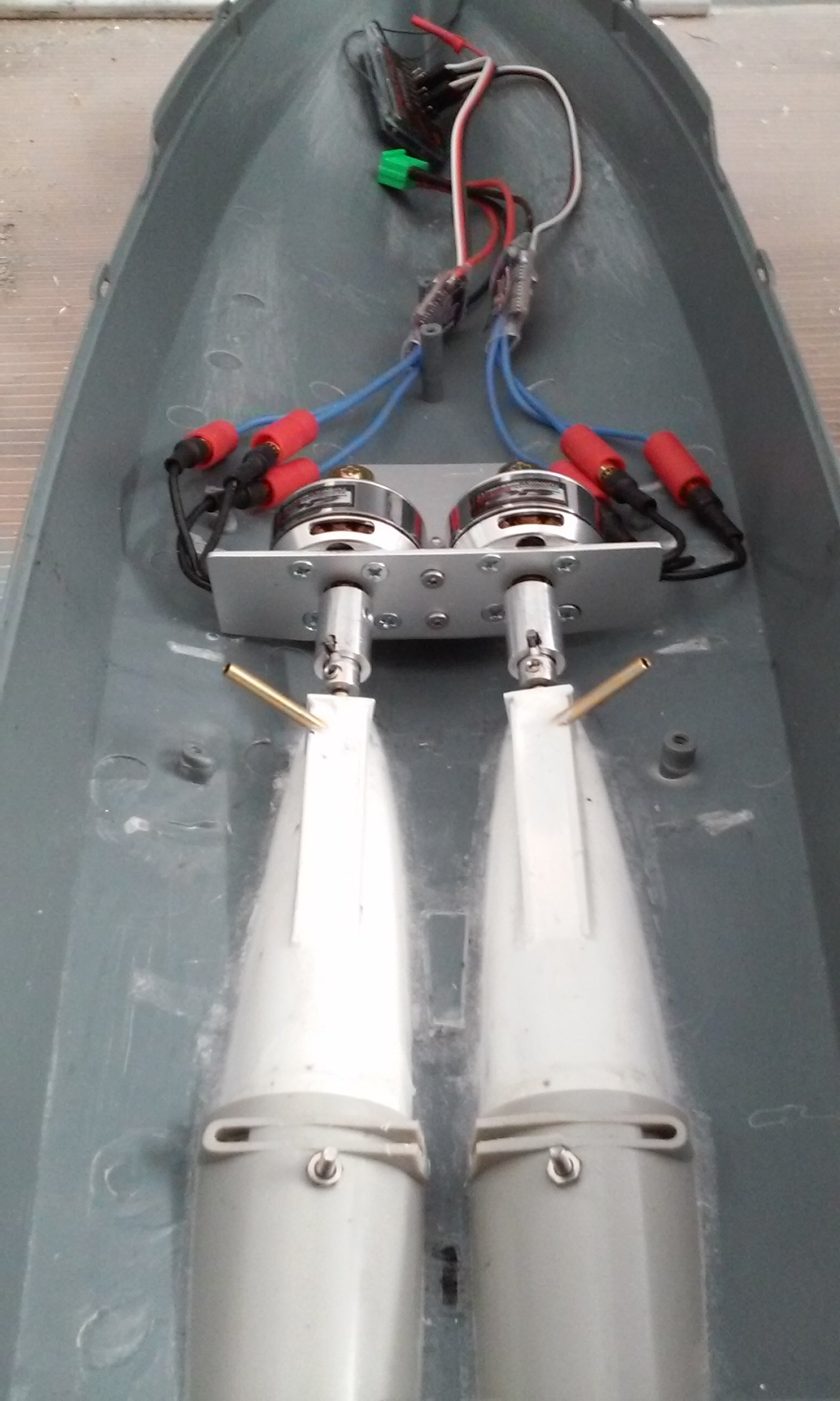

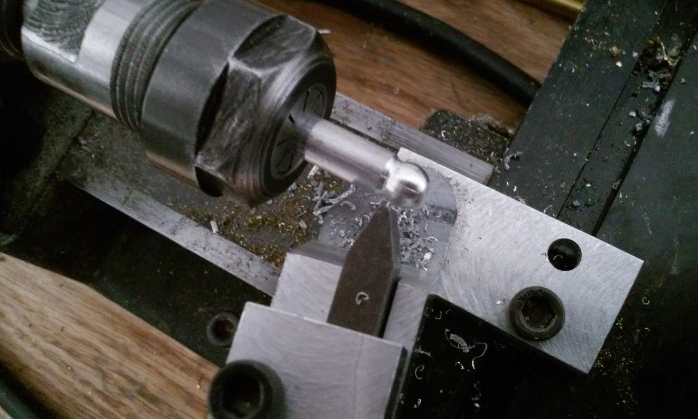

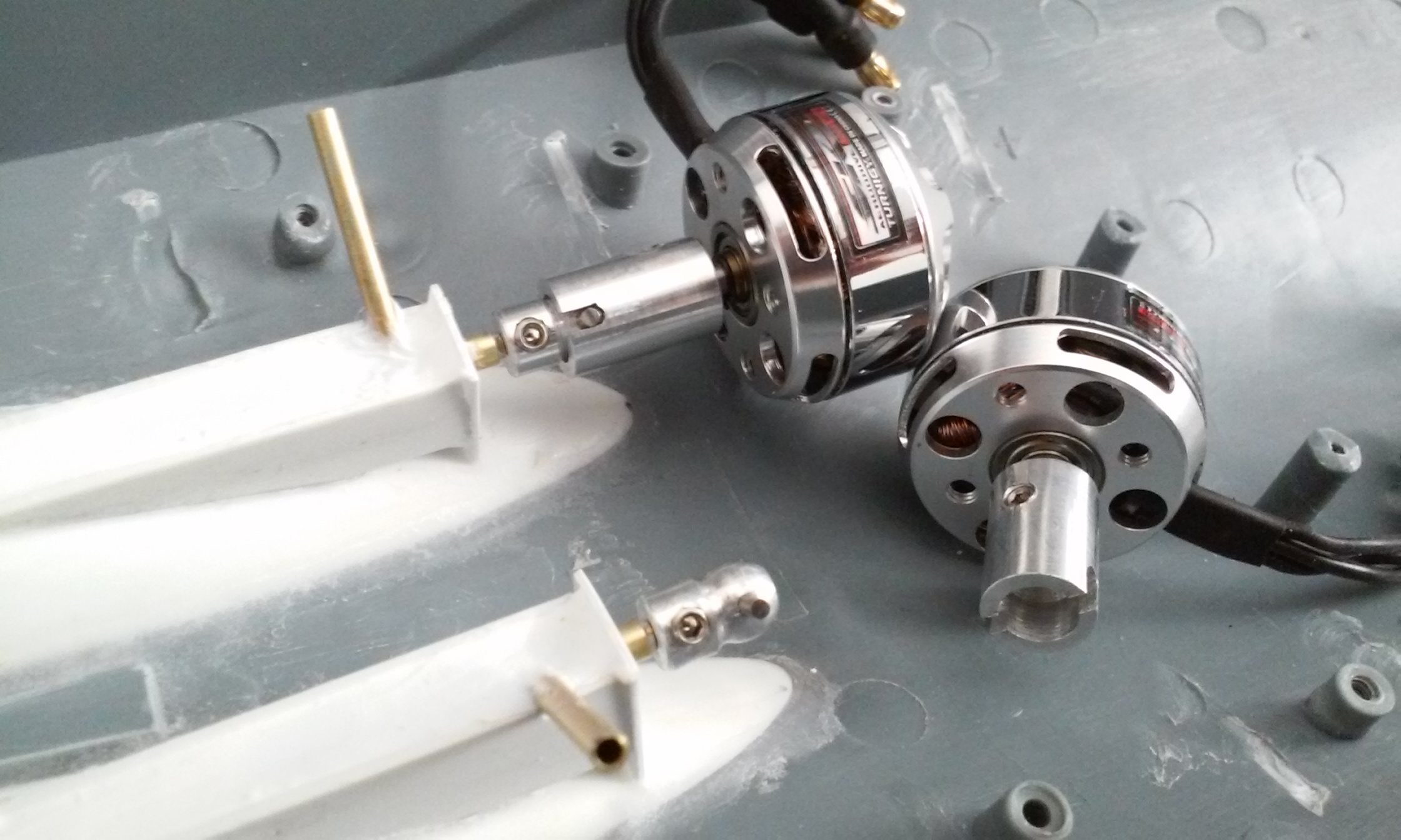

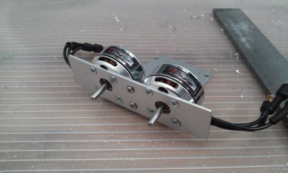

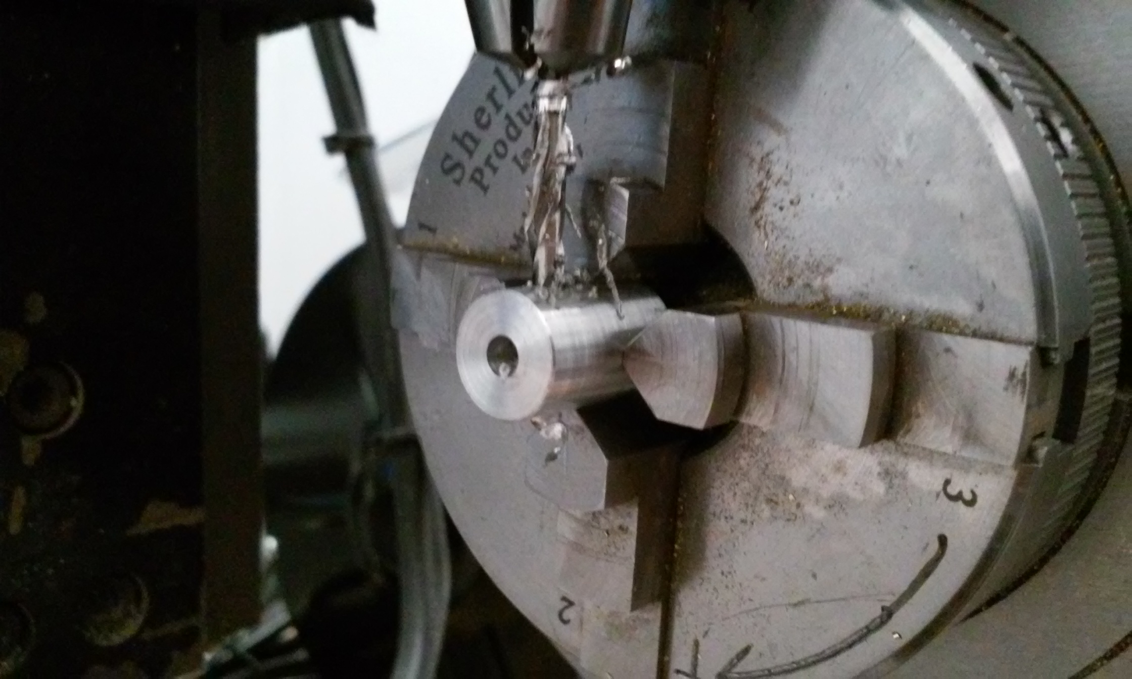

MechTech Posted January 26, 2017 Posted January 26, 2017 Nice Chyll, that new head has great detail on it! Got on the lathe and mill to make half drive dogs , with 3mm set screws to lock them. Then machined a motor mount out of aluminum. I could have made a styrene one in half the time, but I don't know how hot the motors will get and the aluminum will also act as a heat sink (and can easily be removed). Filled the tub with only 1.5 inches of water and it was more than enough! This design has a shallow draft. Both motors running on high equate to about a pound or two of thrust! I had to back off to keep water from flowing back up into the hull! Next step will be to design and make some rudders. As best as I can tell from the tub, the jets are flowing smooth and straight. The lake will tell! Sorry, the server keeps randomizing the photo orders despite my attempts to fix it! - MT Quote
arbit Posted January 26, 2017 Posted January 26, 2017 (edited) Holy Simoleons! Give a walk through for us non-RC specialists. Edited January 26, 2017 by arbit Quote
Lt. Z0mBe Posted January 26, 2017 Posted January 26, 2017 10 hours ago, arbit said: Holy Simoleons! Give a walk through for us non-RC specialists. Also the is interesting. I'd love to get myself a lathe. Finally, when is MT going to build walking Destroids? Looks like he can. Kenny Quote

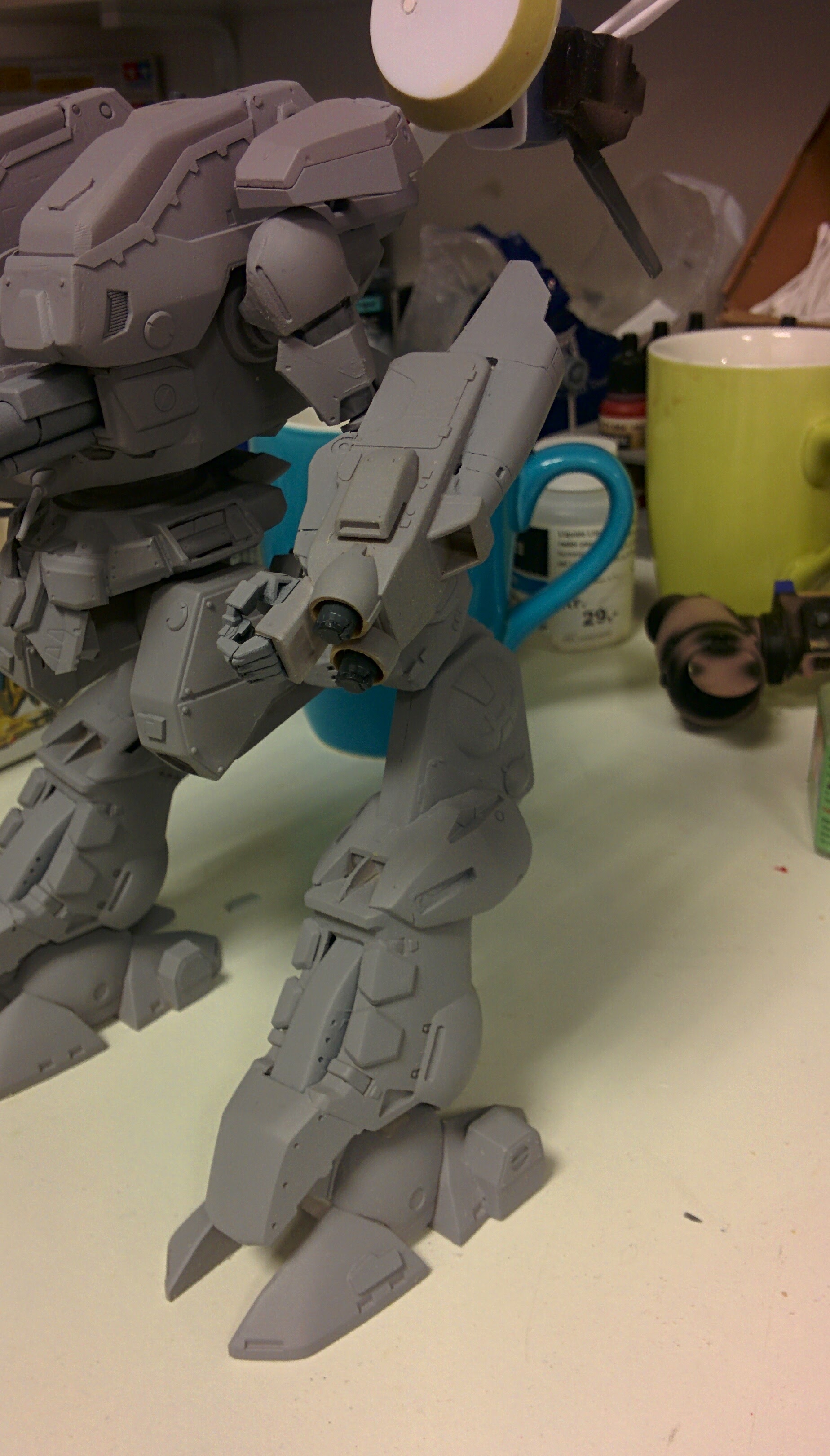

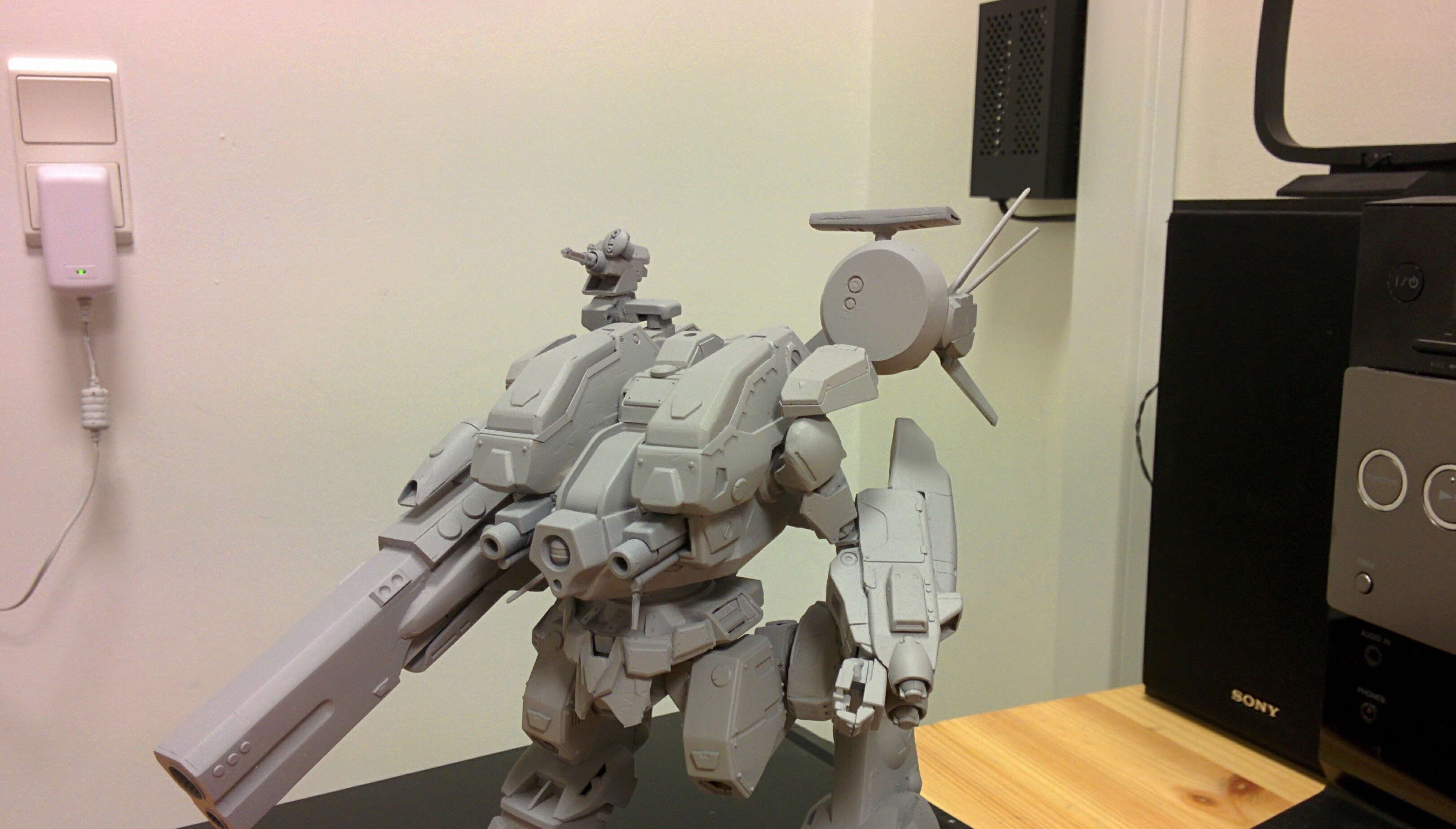

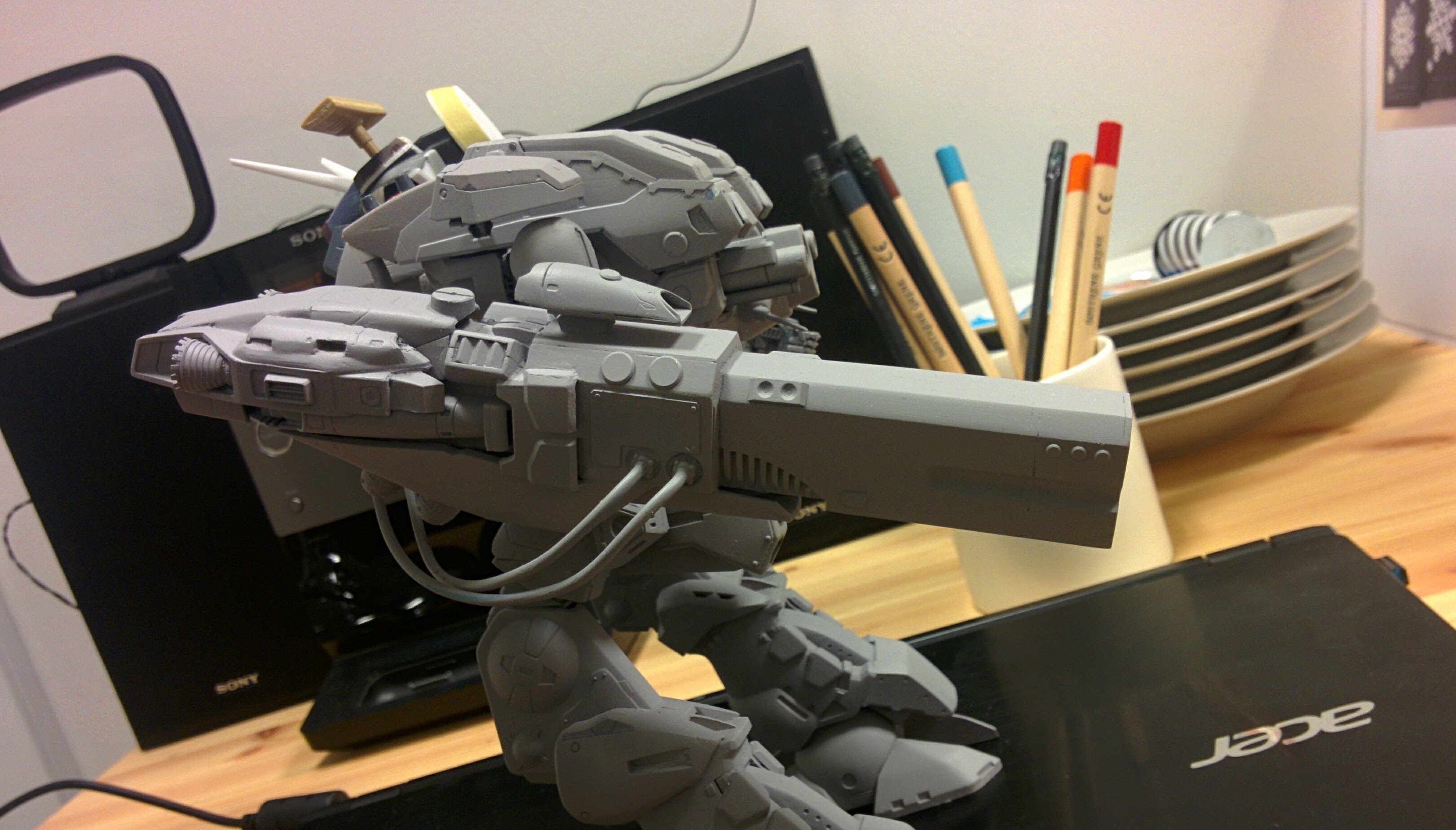

Nyankodevice Posted January 26, 2017 Posted January 26, 2017 Looks awesome MT! first draft of Battle scanner/rader suite also a little change on the left arm. Quote
arbit Posted January 26, 2017 Posted January 26, 2017 Brilliant! It needs some fan fiction to go with it. Quote
Big s Posted January 27, 2017 Posted January 27, 2017 One of the best kitbashes I've seen in a while. Quote

MechTech Posted January 27, 2017 Posted January 27, 2017 Your mech is looking awesome Nyankodevice! It's got a good look to it and plenty of armament too! Thanks guys, I appreciate it! I wouldn't go that far! I haven't rebuilt a plane tossed across the room, but I did rebuild one my daughter "played with" to pieces. It never was the same if it makes you feel better :^) I've been building R/C boats for a while (working in a hobby shop back in the day helps too). Basically I took Voith's design and modeled it (guessing about dimensions and stuff). Here's more if you're interested (movie and booklets): http://www.voith.com/en/products-services/power-transmission/voith-linear-jet-40389.html So that's what's in the nacelles, a five bladed impeller and seven stator ring. It's a water jet but with more low speed efficiency, more power and reverse without a reverser bucket (and another channel / servo / more weight). They are in tunnels in the hull to make the draft (depth) of the boat shallower. Less stuff hanging down to drag the boat back too. The motors are just brushless outrunners and two two brushless speed controls coupled to two transmitter control sticks. That means I can use one motor to save battery or use both to haul butt! It also means I can reverse them for tight turning in place like a tank. The metal ball and cups are what transfers the power to the nacelles. I waited YEARS to get a lathe, but it was well worth it! They say you can build just about anything with a lathe and a mill - it's nearly true. They're expensive, but the Sherline lathes and mills are HIGH quality and rock solid - no play and no calibrating or clean-up needed. My Chinese mill has had A LOT of work on it, and it still doesn't compare or work as well and has lots of play in the movements still too. But it works! If you guys are serious or curious, drop me a PM and maybe I can save you some hassle and research I had to go through. Next step is to get some rudders going. - MT Quote

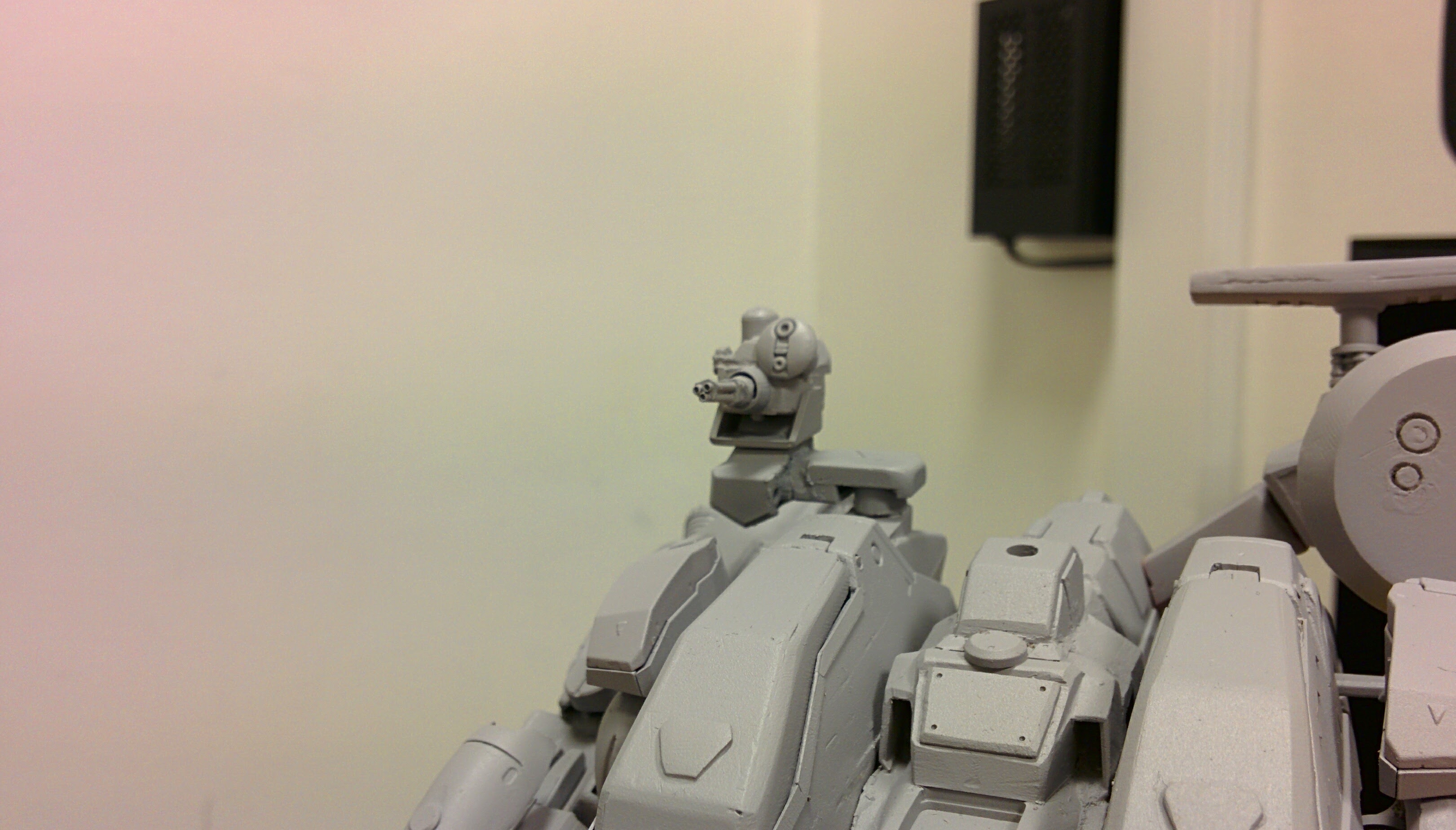

arbit Posted January 27, 2017 Posted January 27, 2017 I think it could take out any Destroid, except the Monster. (Whats the CIWS from?) Quote

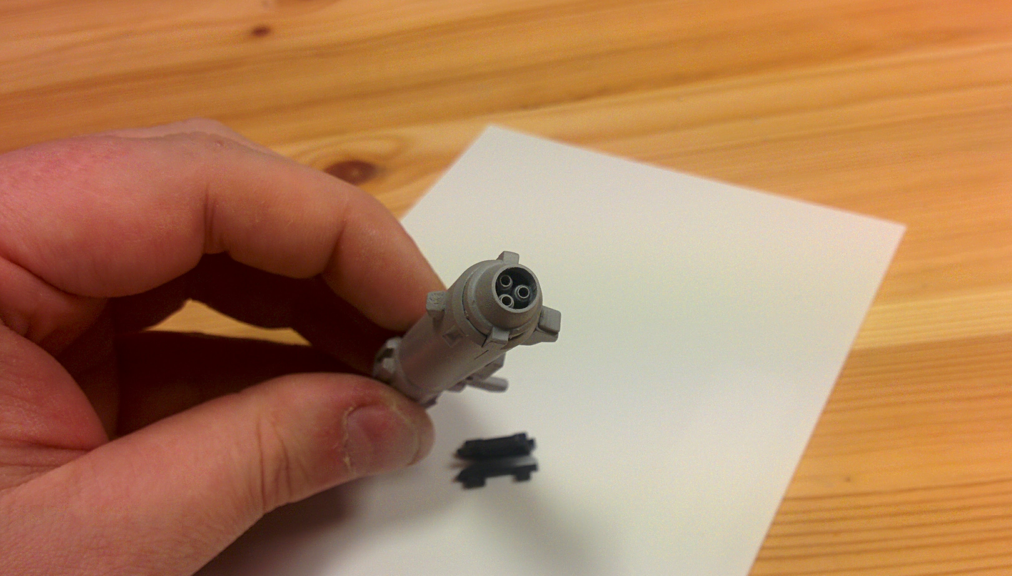

Nyankodevice Posted January 28, 2017 Posted January 28, 2017 6 hours ago, arbit said: I think it could take out any Destroid, except the Monster. (Whats the CIWS from?) It's made from the destroid phalanx searchlight and styrene sticks and a Gundam arm joint xD It should be able to take out monster, that right arm cannon should be able to take out smaller ships and installations.. Quote
arbit Posted January 28, 2017 Posted January 28, 2017 3 hours ago, Nyankodevice said: It's made from the destroid phalanx searchlight and styrene sticks and a Gundam arm joint xD It should be able to take out monster, that right arm cannon should be able to take out smaller ships and installations.. Maybe in close range, it could deal with the Monster. It has good maneuverability, lots of scanning radar, and serious firepower with good variety. But sorry, from a distance, the Monster would smack it down. Maybe I'm biased Quote

Nyankodevice Posted January 28, 2017 Posted January 28, 2017 3 hours ago, arbit said: Maybe in close range, it could deal with the Monster. It has good maneuverability, lots of scanning radar, and serious firepower with good variety. But sorry, from a distance, the Monster would smack it down. Maybe I'm biased The monster is awesome... In the end it comes down to who shoots first.. (which of cause Han did ) Quote

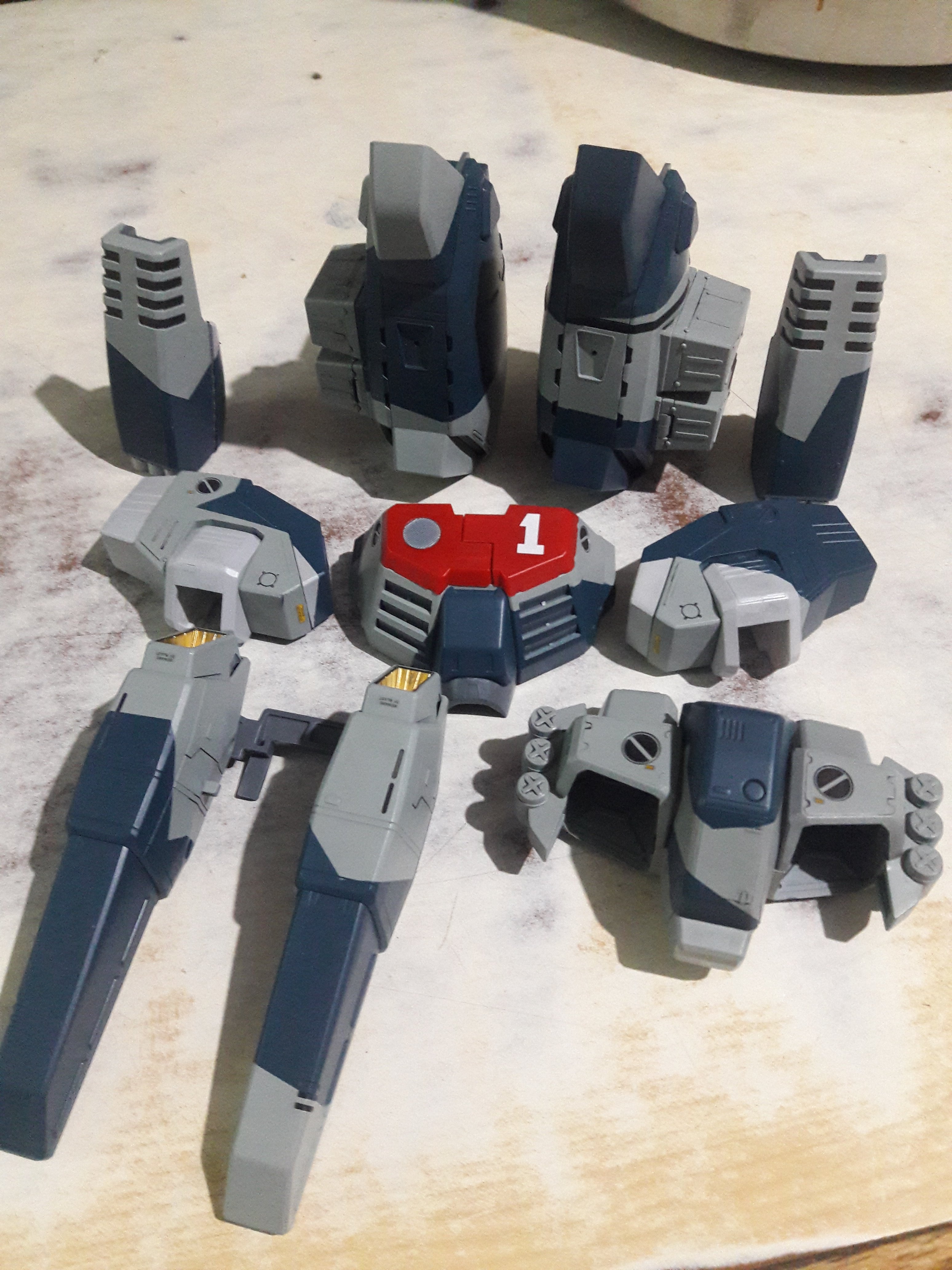

chyll2 Posted January 28, 2017 Posted January 28, 2017 (edited) I find my custom armor boring. Will still add some black and ghost grey in the mix The red part in the chest will be painted after I remove the circular vent Edited January 28, 2017 by chyll2 Quote

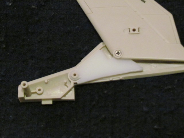

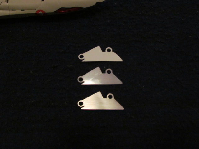

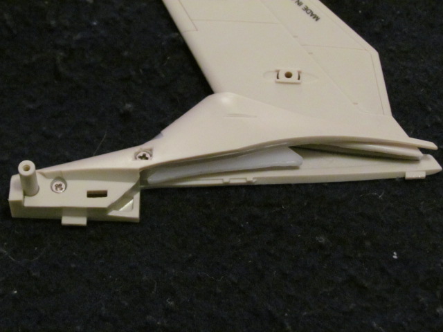

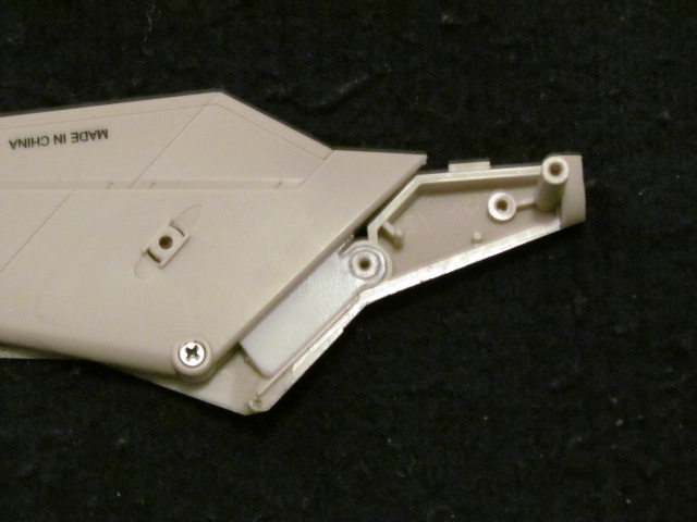

Chronocidal Posted January 29, 2017 Posted January 29, 2017 Not quite a model, but my workspace has been covered in bits of YF-19 for the past couple weeks. Working on getting these new wing pivots set up for laser cutting. Takes a little work to get the original swingbars out, but the wings are rock solid with the new pivot points. Quote

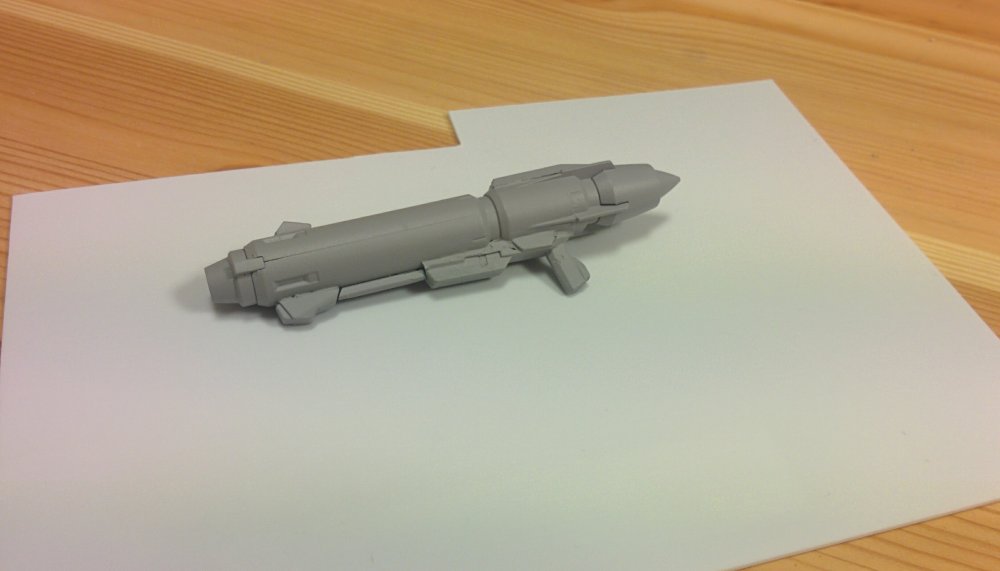

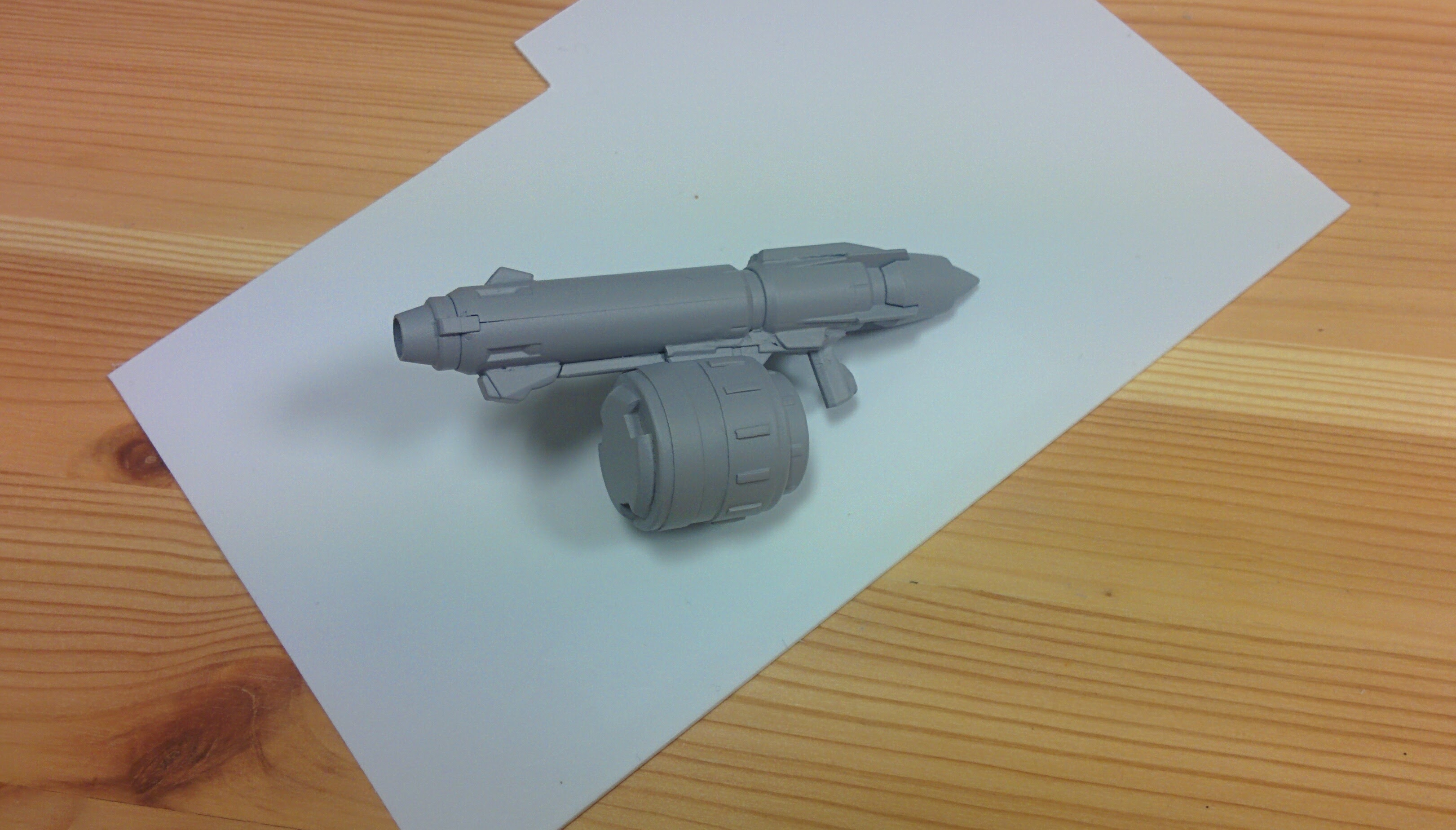

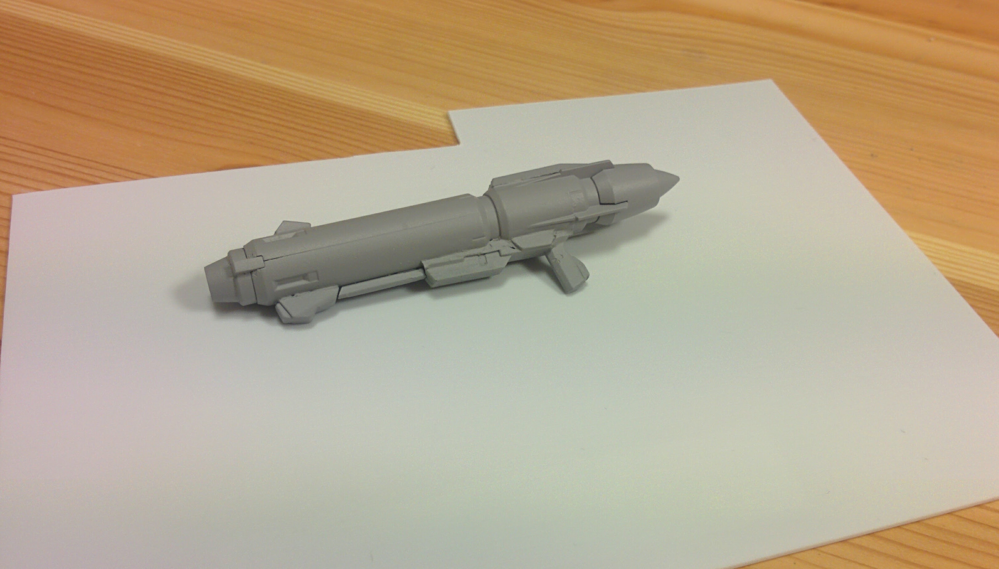

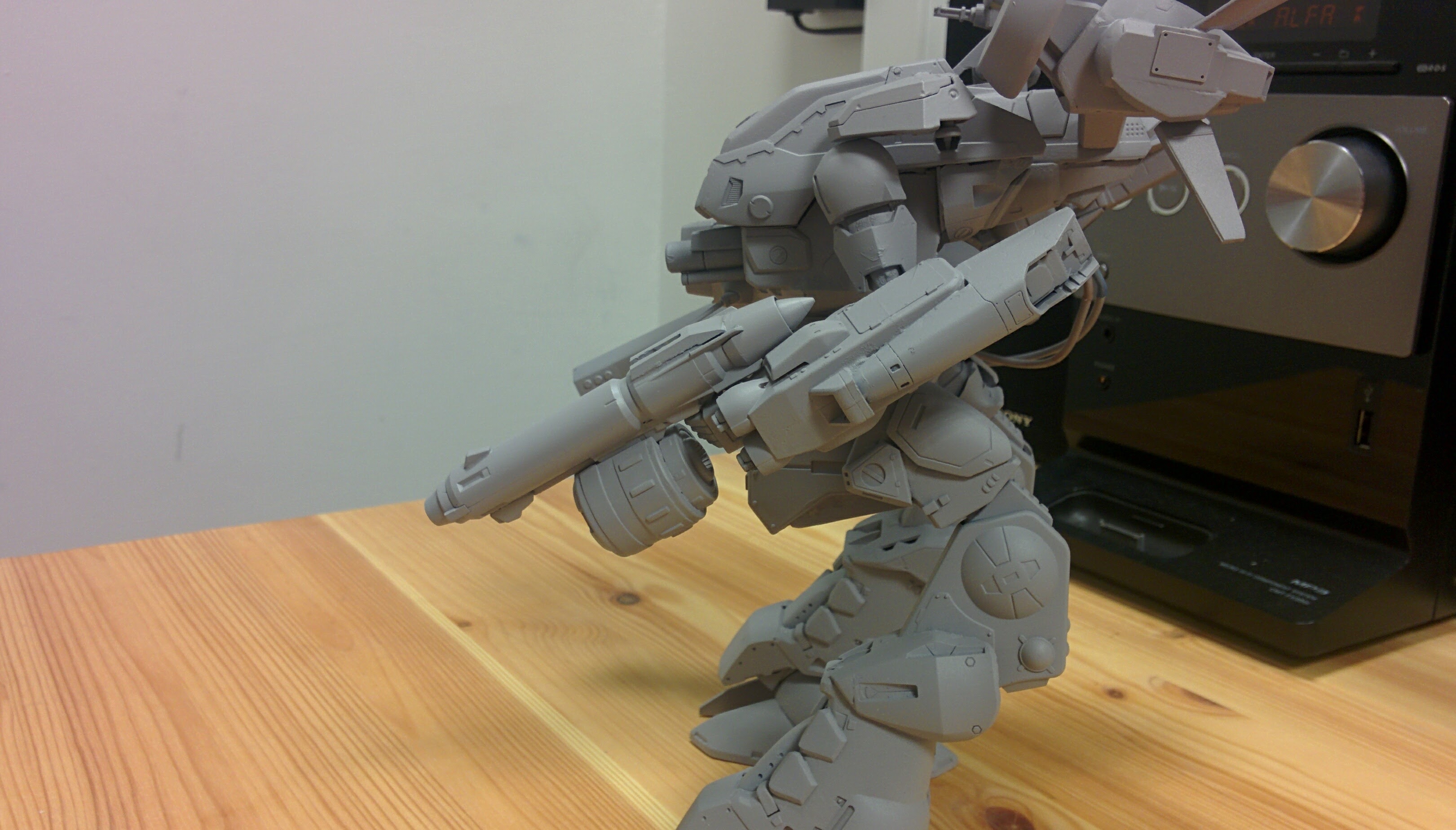

Nyankodevice Posted January 29, 2017 Posted January 29, 2017 and of cause a gun pod and a ammo drum to go with it! Quote
mickyg Posted January 29, 2017 Posted January 29, 2017 If you'd told us all about this before starting it, "it'll have this gun, and this one, and this canon, and a lasers, and energy weapons, and missiles..." I'd have thought it was seriously overkill and would look crazy busy and well, ridiculous. But now that you've built it, it's just awesome! Love what you've done with it and all the parts I recognise from other kits, but they all blend so well. Can't wait to see it painted and finished! Quote
Chronocidal Posted January 29, 2017 Posted January 29, 2017 3 hours ago, MechTech said: Chronocidal, what work are you doing with a laser on them? I'm not doing the lasering myself, but I've been working on a CAD model to get these parts easily reproduced. It's a replacement wing mounting point for the Arcadia YF-19 that removes the high-speed mode, and keeps the wings much more solid in fighter mode. Top is handmade out of 1mm styrene, bottom two are laser cut from 2mm POM and stainless steel sheet. My first test batch came out almost perfect, but the lower edge needs adjustment to not collide with the sides of the legs. The POM works, and is much cheaper, but has some variability due to the laser cutting. The metal came out nearly flawless, and just feels sturdier all around, so I ordered a second set of those with the necessary adjustments. Quote

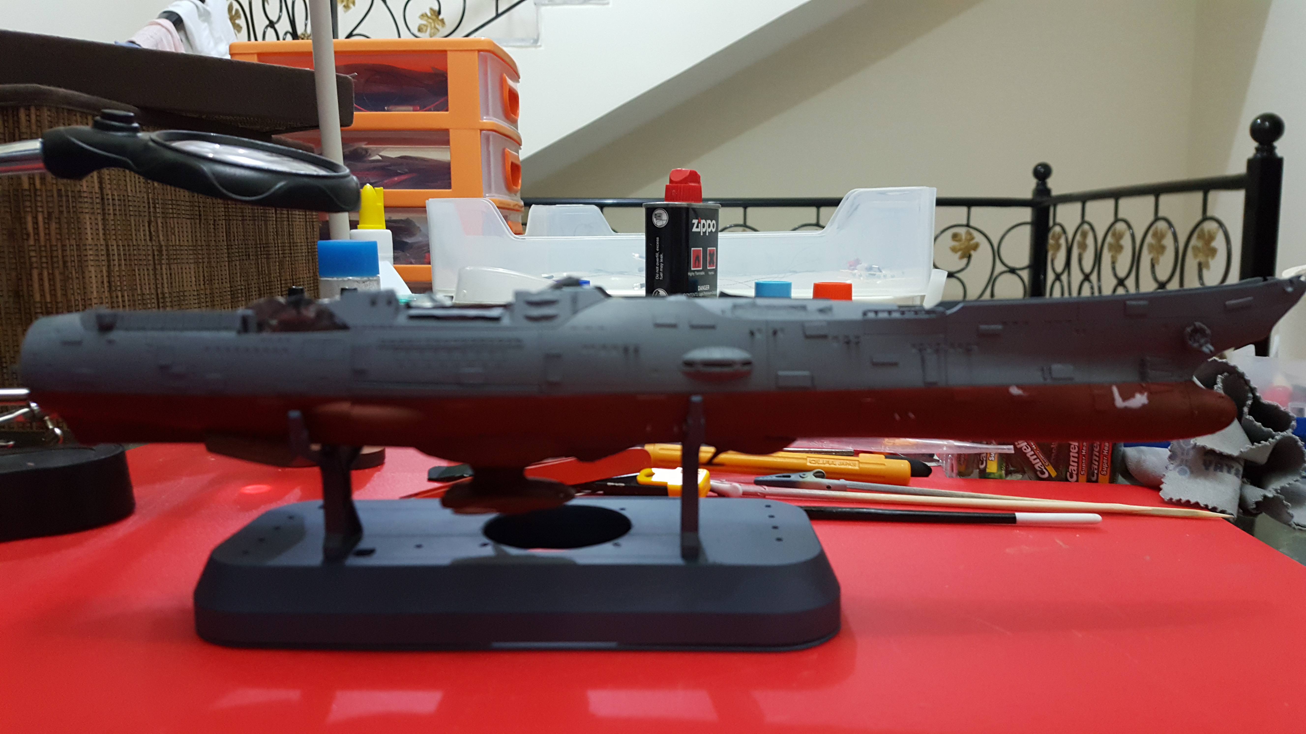

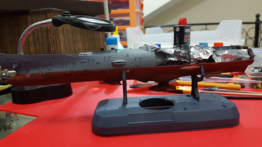

arbit Posted January 30, 2017 Posted January 30, 2017 (edited) Had some paint peel with Mr Hobby Primer Surfacer 1000. I am hand retouching as you can see, because I can't strip with all the wiring inside. I let it cure for 48 hours. So I either had some greasy thumbs, or I was too light with the primer based on the "before" picture. Edited January 30, 2017 by arbit Quote
NZEOD Posted January 30, 2017 Posted January 30, 2017 On 27/01/2017 at 10:14 AM, Nyankodevice said: Looks awesome MT! first draft of Battle scanner/rader suite also a little change on the left arm. Very Mech Warrior Online... like it alot! A pilot leaning on the leg would look awesome Quote
