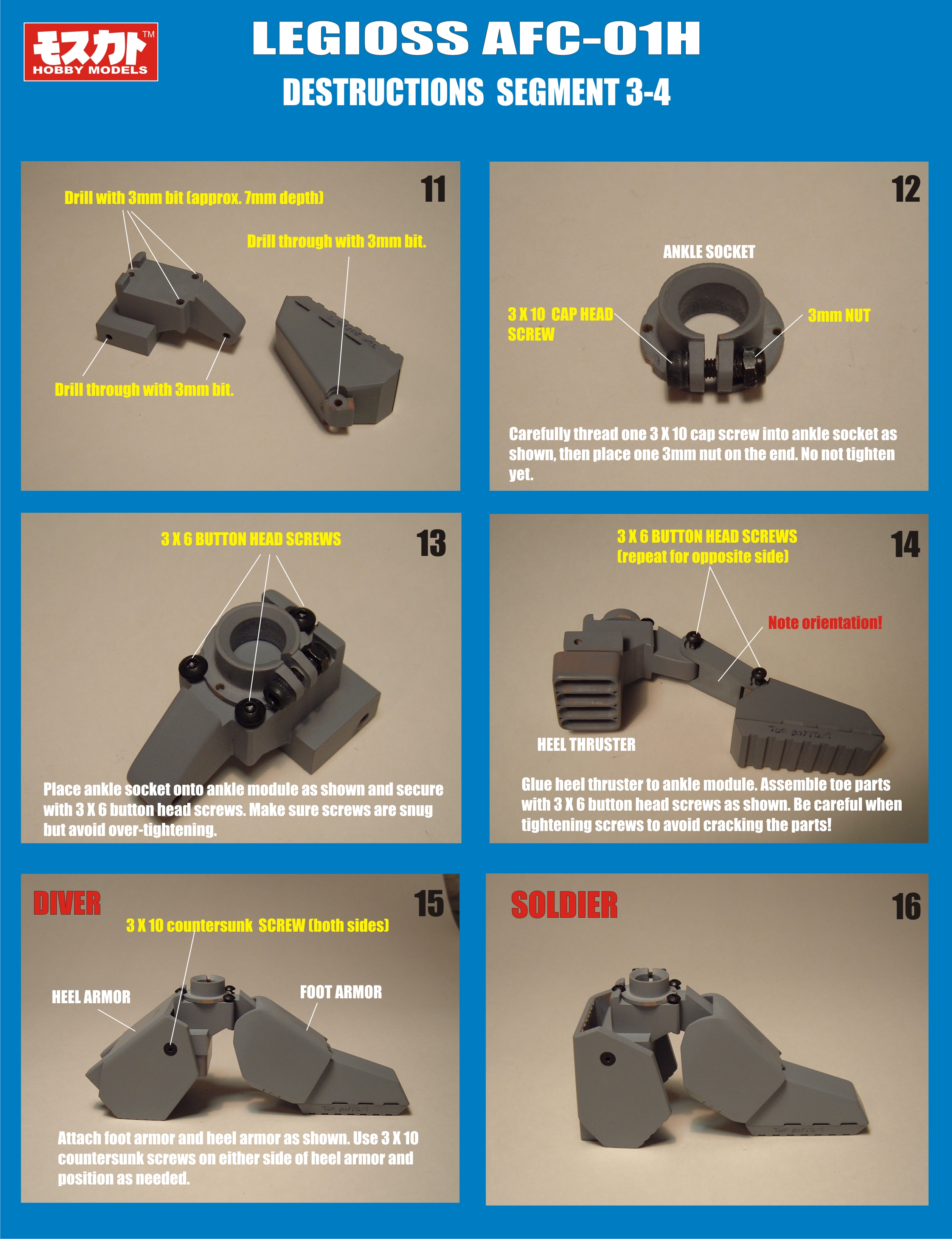

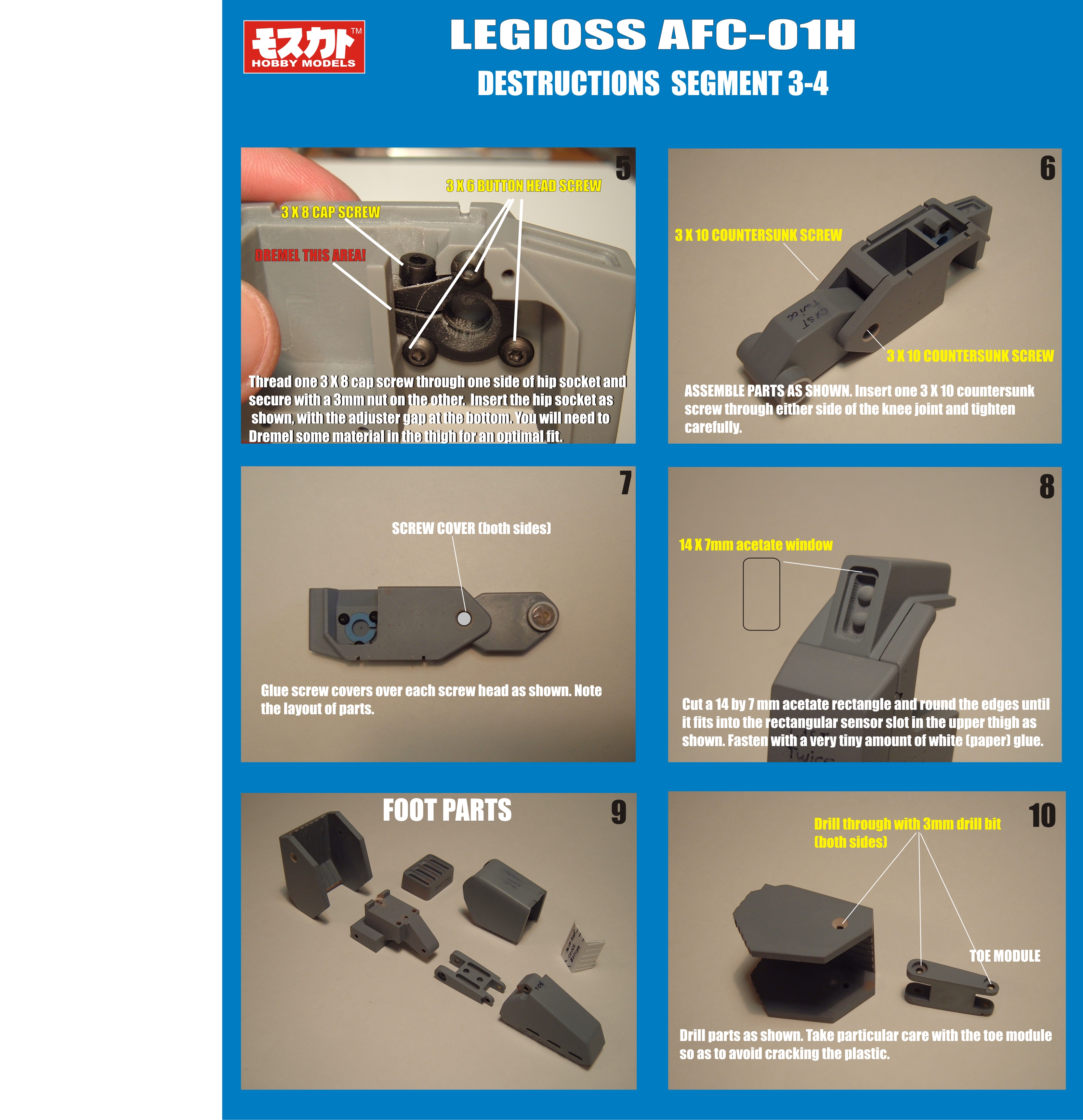

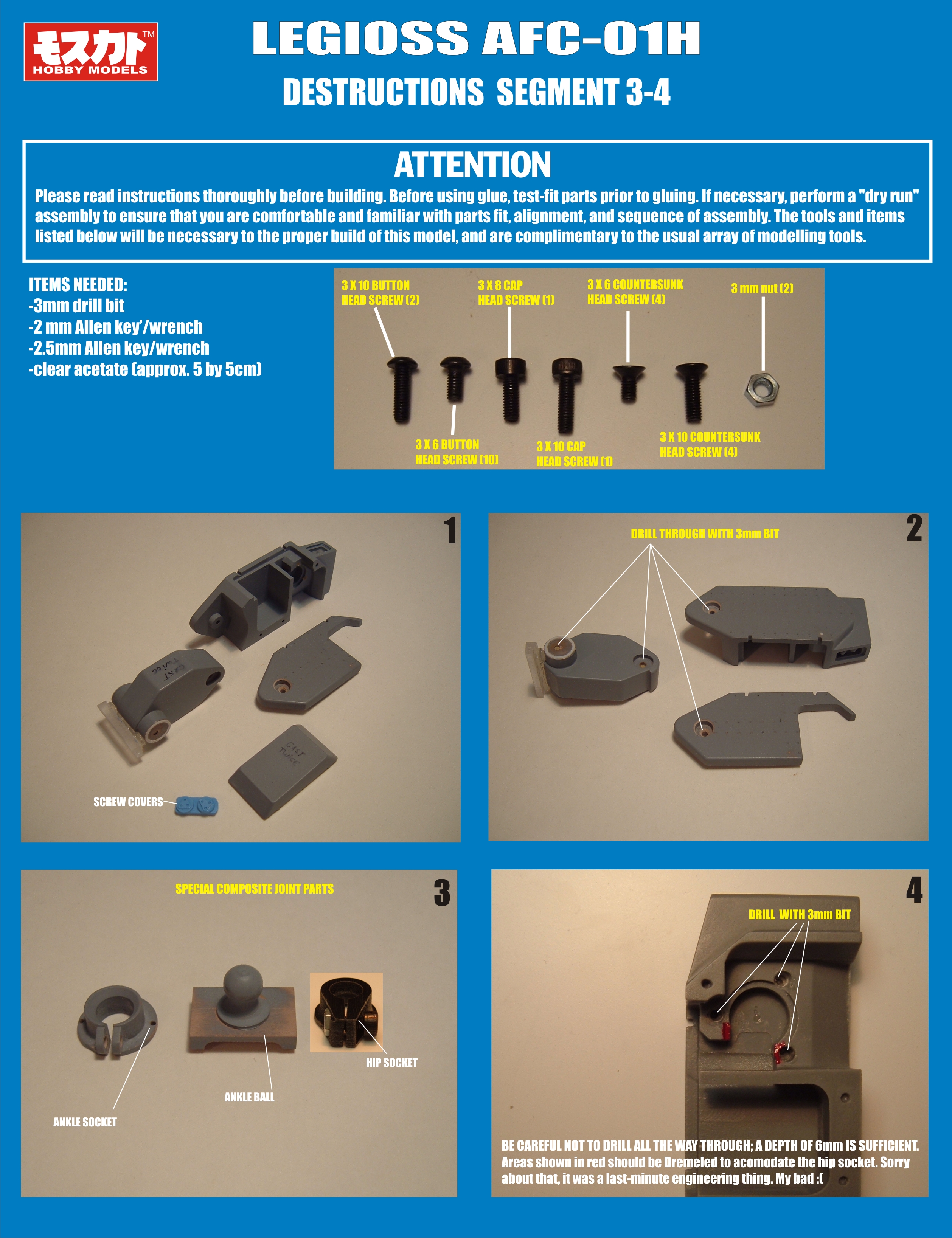

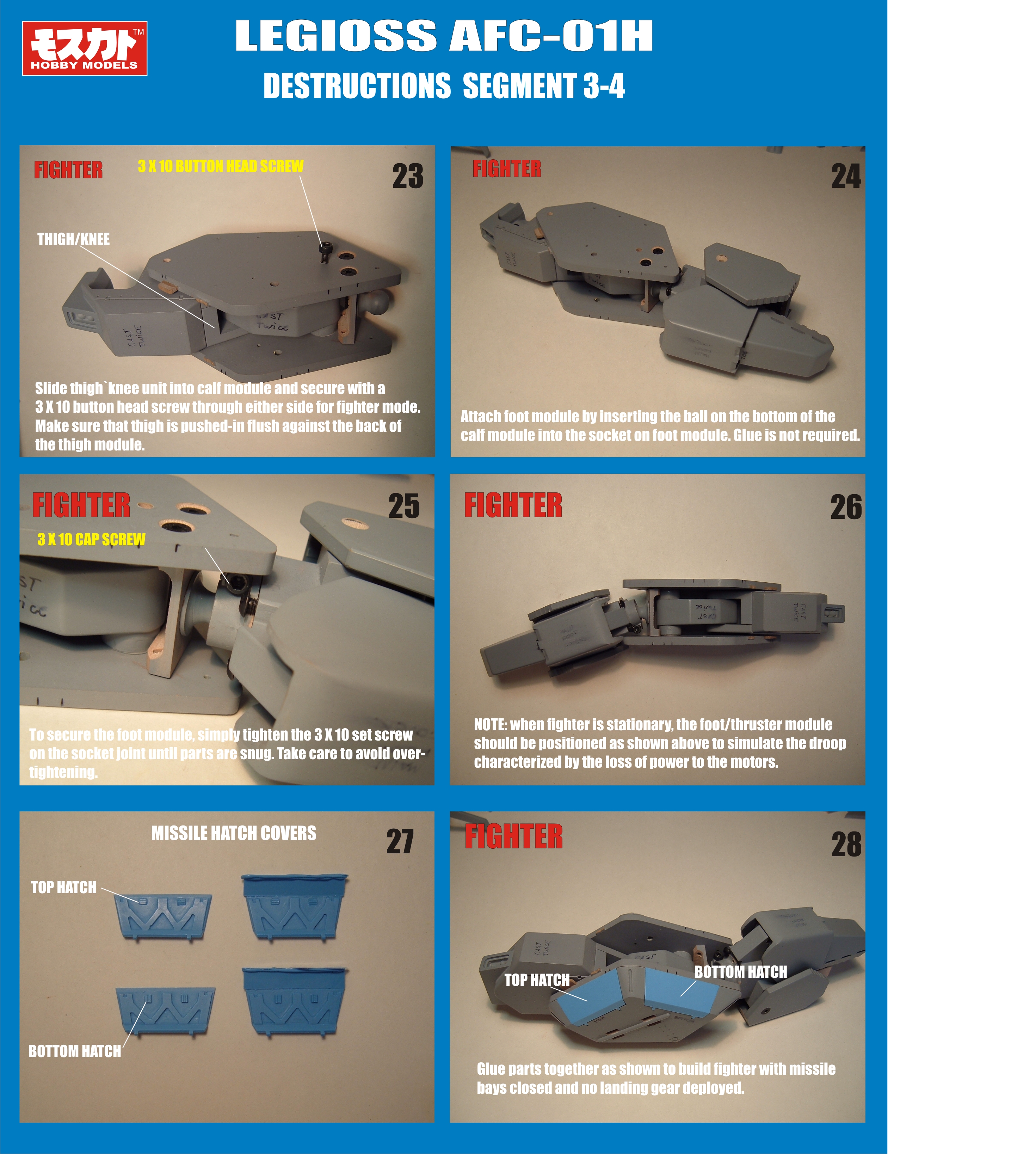

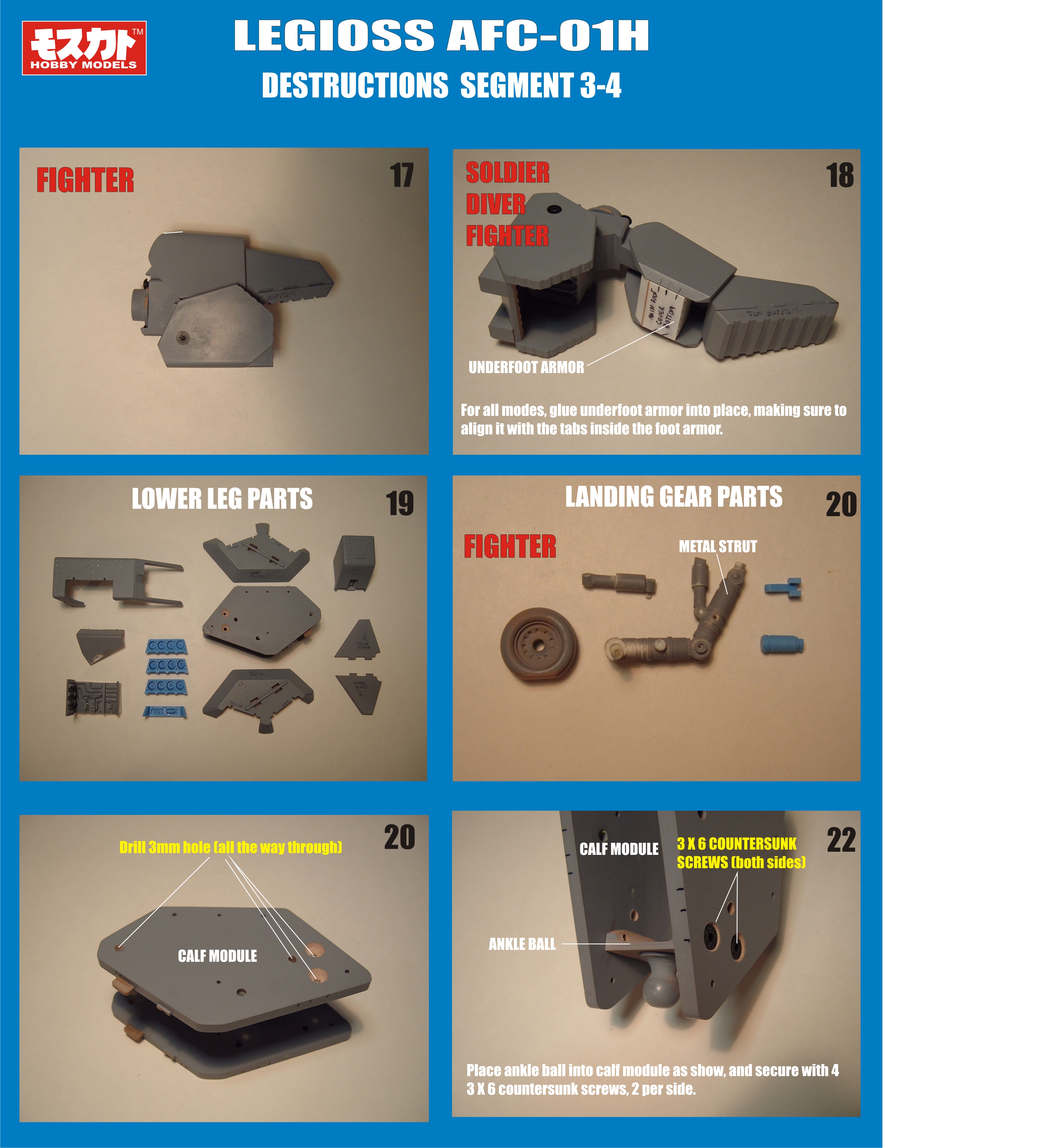

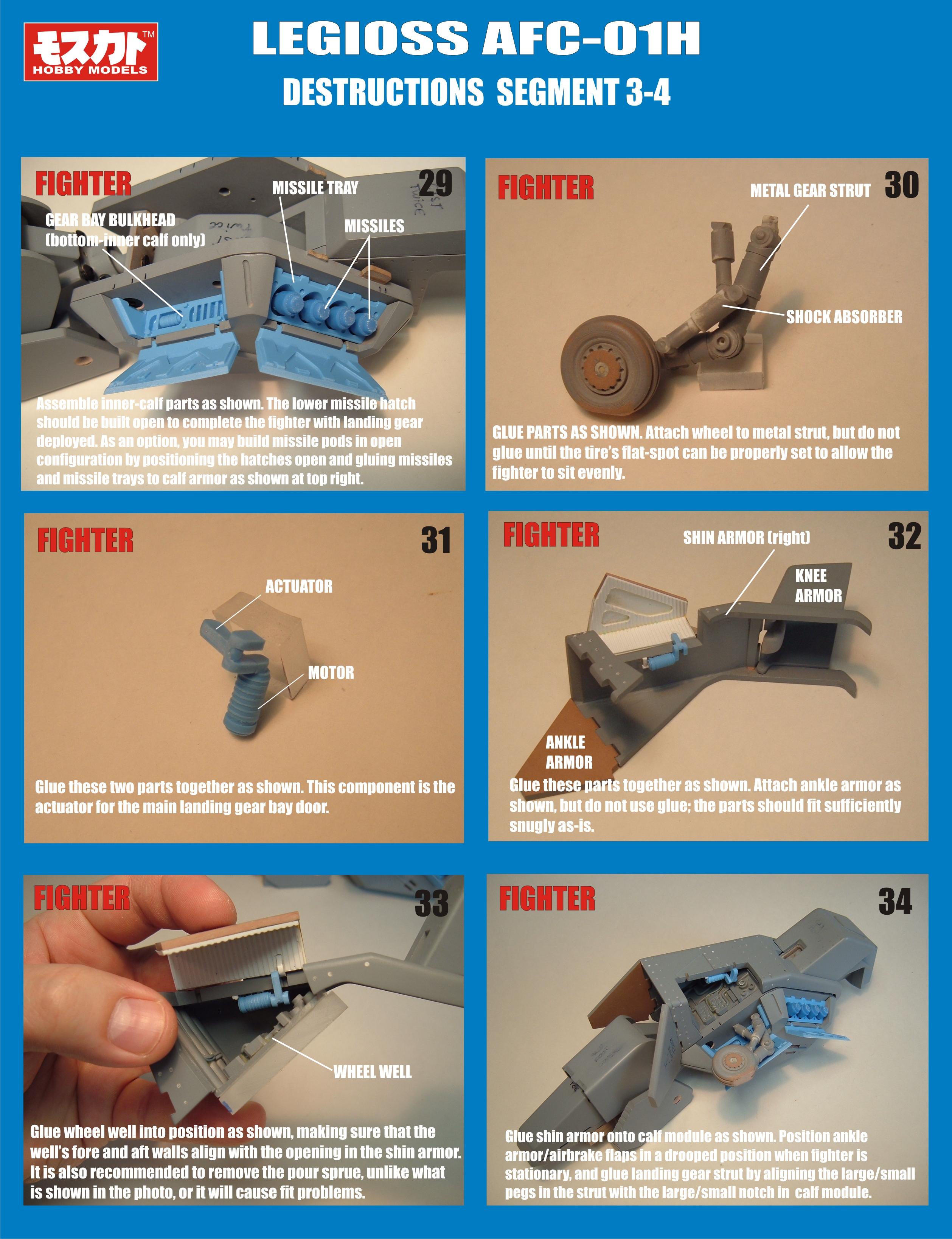

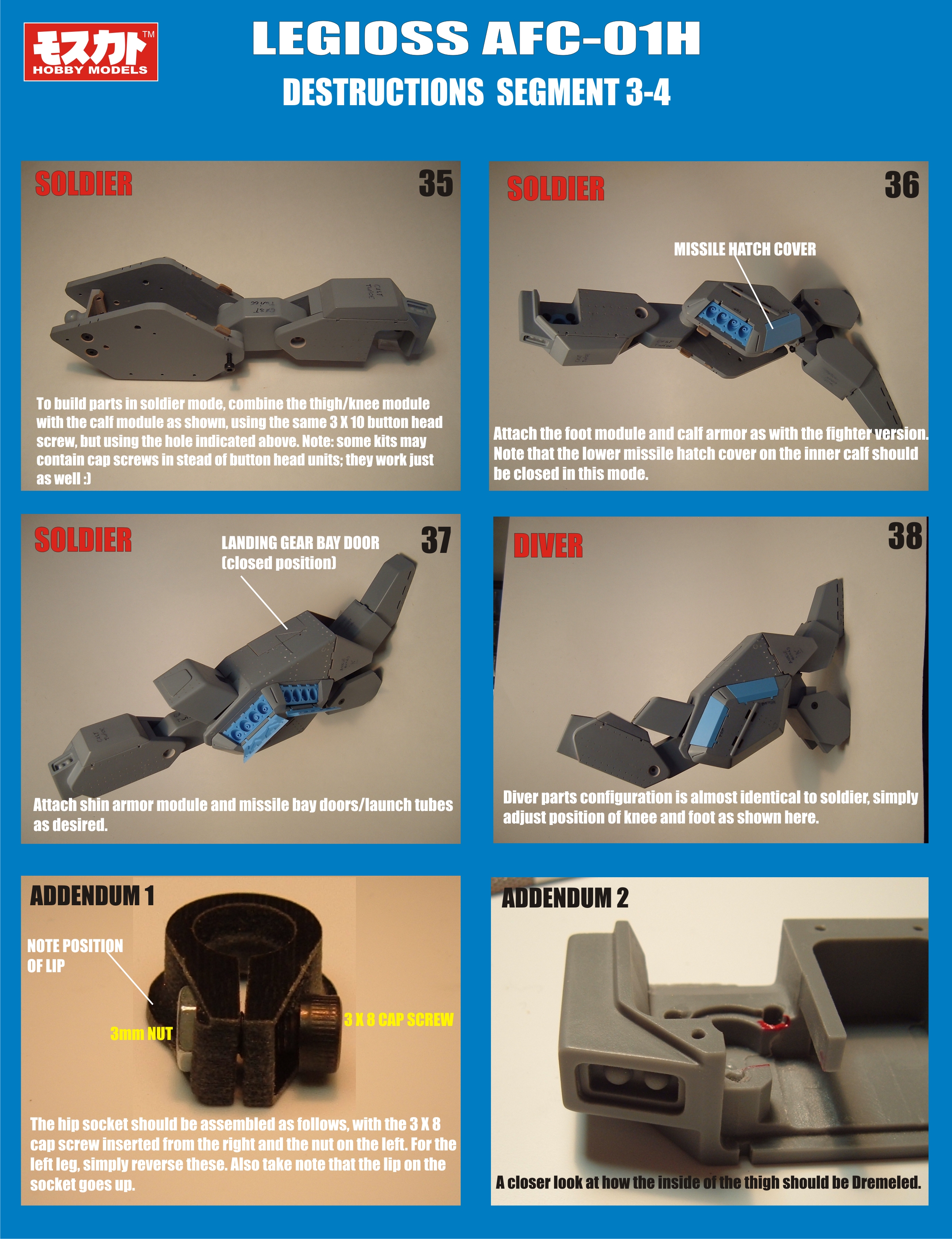

captain america Posted May 26, 2011 Posted May 26, 2011 As promised, here you go guys! 7 freakin' pages of destruction goodness!!! Quote
DarrinG Posted May 26, 2011 Posted May 26, 2011 Drooping air-brakes? Simulating 'loss of power' to motors? Motor actuators? Tires flattened on one side to show weight? FREAKING MASTERPIECE Guess I'll be getting the 01I Greeny version next for resting fighter mode... Quote

captain america Posted May 26, 2011 Author Posted May 26, 2011 Drooping air-brakes? Simulating 'loss of power' to motors? Motor actuators? Tires flattened on one side to show weight? FREAKING MASTERPIECE Guess I'll be getting the 01I Greeny version next for resting fighter mode... Oh yeah, I went nuts: droop-able air brakes, positionable flaps, multi-axis thrust-vectoring main engine nozzles, FOD doors for the engine intakes, maintenance/access panels, detailed radar array, you name it, it's in the kit. Without wanting to seem like I'm bragging, when you see all the technological goodies that I designed into the Legioss to make it real-world, a VF-1 would simply pale by comparison in terms of performance and survivability. Quote
