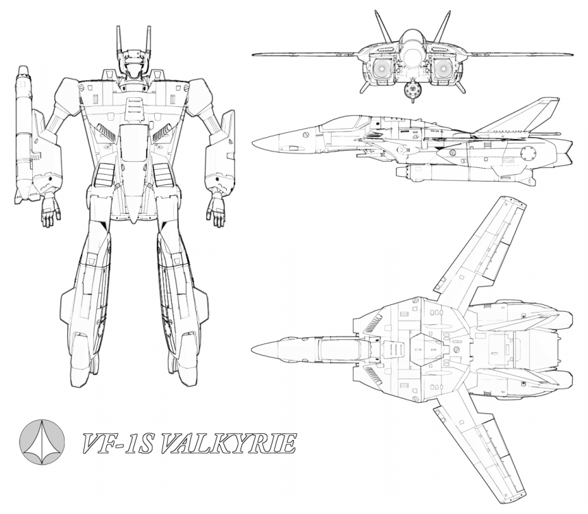

Doktor Gonzo Posted March 16, 2011 Posted March 16, 2011 (edited) Dan, For what it's worth, here's the orthos of my old model. I'm sure your solutions to the proportion issues will blow mine away (it's been a few years and I can see many things I'd've done differently!) but might make for an interesting discussion point nonetheless Edited March 16, 2011 by Doktor Gonzo Quote

tipatat Posted March 17, 2011 Posted March 17, 2011 Dan, For what it's worth, here's the orthos of my old model. I'm sure your solutions to the proportion issues will blow mine away (it's been a few years and I can see many things I'd've done differently!) but might make for an interesting discussion point nonetheless Doktor Gonzo, nice model - it's definitely one of the best looking battloid I've seen. You did a great job with the proportion issues (something I am also struggling with). I'd love to see more renders of your model. Do you have an online gallery somewhere? Tipatat Quote

Doktor Gonzo Posted March 17, 2011 Posted March 17, 2011 Doktor Gonzo, nice model - it's definitely one of the best looking battloid I've seen. You did a great job with the proportion issues (something I am also struggling with). I'd love to see more renders of your model. Do you have an online gallery somewhere? Tipatat Tipatat, thanks for the kind words! I don't have a dedicated image gallery anywhere but I found some old renders here and here. That said, though, it wasn't my attention to threadjack Dan's WIP thread, but rather to toss up my own interpretation as a point of comparison in the proportions discussion he inititated. Back in the stone age when I started this, I only had access to scans of the Hasegawa 1/72 blueprints, and I guess that's sort of still the model's DNA. But that left me with a gangling, thin-limbed, awkward battloid that I loathed and immediately began proportions-tweaking to revise. it also left me with the downwards-canting engine nacelles, which I never liked and soon abandoned, but I never beefed up the height of the nacelles the way the recent Yamato and Hase offerings did -- looks like I should, eh? The 1/72 profile also left me with backpack problems via the shape and positioning of the tailfins. I resolved those by cheating mightily - nothing changes shape or size, but the backpack is on an armature with additional joints to get it into a reasonable position against the back in battloid mode. Quote

Doktor Gonzo Posted March 18, 2011 Posted March 18, 2011 Thanks for the pointers IIRC I do have a printed book on the subject that was given to me by a client, it's in storage though along with almost all my Macross collection. If it's any consolation, my undergrad degree was in comp sci, not anything cg-related. Anything and everything I've learned since came from books, certificate courses, and on-the-job learning. Quote
danbickell Posted March 19, 2011 Author Posted March 19, 2011 Thanks for your input, Doktor Gonzo! Your VF-1 model has been one of the best around for many years, and I have a number of your renders among my reference. Those orthos are very appreciated, and will certainly be studied and compared to other interpretations. The fighter front ortho is of particular interest to me, and it confirms some thoughts I've had regarding your interpretation, specifically the more circular cross section of nose (much like the original ortho lineart, TV era), rather than the more triangular/trapezoidal cross section (wider and flatter at the bottom) direction that some of the more modern interpretations have moved to. Studying the many interprations of the VF-1 design is a big part of the fun of working on a project like this, for me. I would probably have a lot more of the model worked out by now if I spent less time comparing and scrutinizing the details of all the available artwork, models, and toys. I think patience has certainly come with age for me, though, and I am very happy to have such a wealth of work that has been done by all the artists and craftsman before me availble to learn from. As far as the schooling discussion, I have never had any formal training. There really wasn't much availble when I was in college 20 years ago, and I was studying bio-chem anyway. CG art was merely a hobby of mine back then, and I learned by doing. I have never had a class, and never read any books relating to the subject. I'm coming up on 16 years in game development soon, and everything I know has come from self-learning and experience working alongside other artists (many of which, especially the older folks, also never had any related formal education). Quote
Doktor Gonzo Posted March 19, 2011 Posted March 19, 2011 Thanks for your input, Doktor Gonzo! Your VF-1 model has been one of the best around for many years, and I have a number of your renders among my reference. Those orthos are very appreciated, and will certainly be studied and compared to other interpretations. The fighter front ortho is of particular interest to me, and it confirms some thoughts I've had regarding your interpretation, specifically the more circular cross section of nose (much like the original ortho lineart, TV era), rather than the more triangular/trapezoidal cross section (wider and flatter at the bottom) direction that some of the more modern interpretations have moved to. Studying the many interprations of the VF-1 design is a big part of the fun of working on a project like this, for me. I would probably have a lot more of the model worked out by now if I spent less time comparing and scrutinizing the details of all the available artwork, models, and toys. I think patience has certainly come with age for me, though, and I am very happy to have such a wealth of work that has been done by all the artists and craftsman before me availble to learn from. As far as the schooling discussion, I have never had any formal training. There really wasn't much availble when I was in college 20 years ago, and I was studying bio-chem anyway. CG art was merely a hobby of mine back then, and I learned by doing. I have never had a class, and never read any books relating to the subject. I'm coming up on 16 years in game development soon, and everything I know has come from self-learning and experience working alongside other artists (many of which, especially the older folks, also never had any related formal education). I hear you. I'm tempted every so often to restart from scratch, both to partake of all the available versions out there (when I started this, all I had available to me were screencaps, the Hase 1/72 blueprints, and the Yamato 1/60 v1) AND to approach it as a fairly accomplished modeler rather than a novice (this thing was the first full character model I ever made, used it to teach myself modeling, and the quality of the original parts' meshes definitely shows it.) But if I were going to undertake another hobby project this size, I guess I'd rather do something wholly original than engage in the futile endeavor of trying to out-model guys like you That said, I've been tempted into revisiting parts of this thing at intervals as new interpretations became available. I thought about making the nose more trapezoidal in cross-section, but I'm not all that unhappy with the way it looks now (it would probably best be characterized as egg-shaped, with the narrow top of the egg flattened forward of the canopy.) I redid the fronts of the lower legs to give the bottom panels a bowed-in hourglass shape, rather than rectangular. I beefed up the forearms at some point as new interpretations showed me how. Most radically, I redid the nose shape and the positioning of the forward fuselage in battloid mode once I saw the Yamato 1/60 v2, since their solutions blew away prior interpretations and gave by far the cleanest, most heroic silhouette. I think this piecemeal "magpie eye" approach to the vf1 has given me a model that's very pleasing to ME, as it incorporates my favorite interpretations of various parts. The downside is that the whole perhaps appears a bit disjoint, like the collection of pieces from many different vf-1s that it in fact is! Bottom line I guess is that I'm watching avidly to see how you approach these issues and what your ultimate solutions are. Quote
