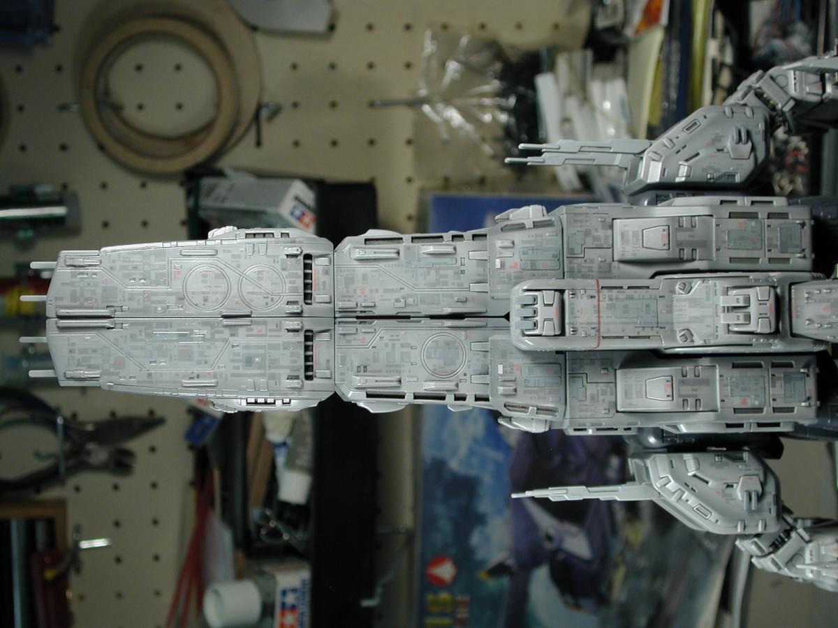

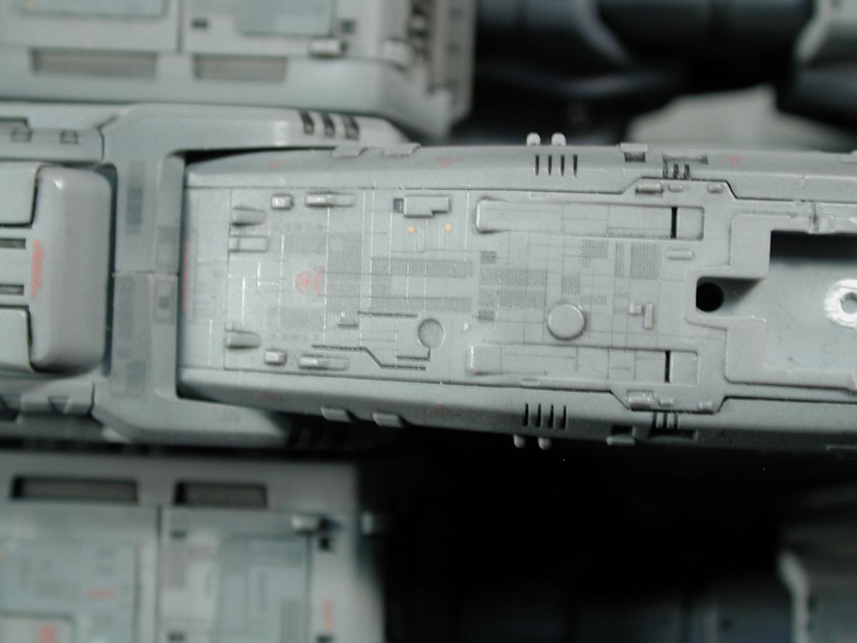

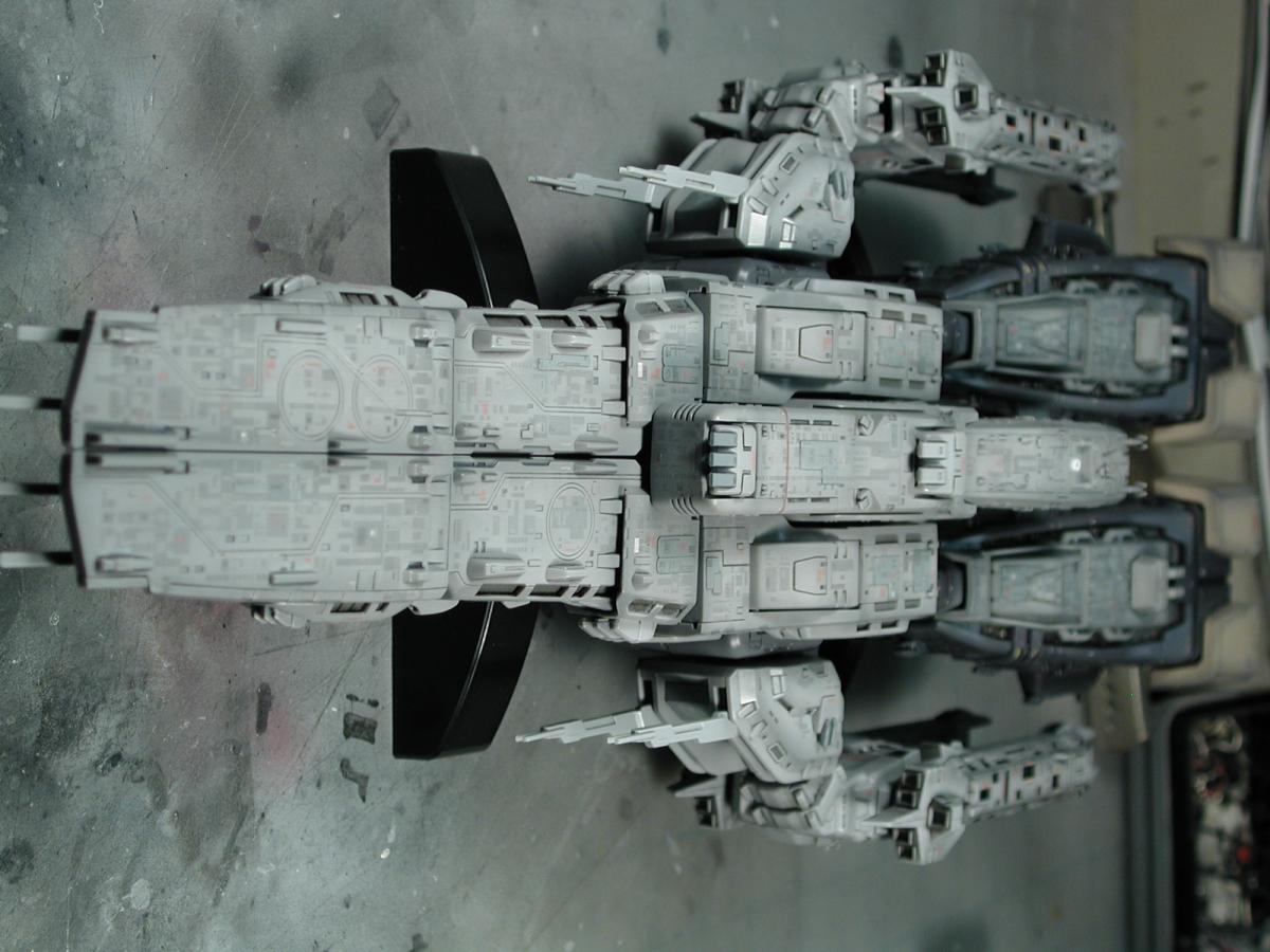

Well, I finally got the panelling toned down to what I wanted - I sprayed a few light coats of grey over the decals, and they now look more painted on than decals, more subtle surface texture than markings. This overall "graying" is intentional since large objects then to "haze out" in the distance and lose contrast - its a trick to create scale as well as the flat/matte finish.
post-244-0-18732600-1334950616_thumb.jpgpost-244-0-41776700-1334950612_thumb.jpgpost-244-0-62801900-1334950608_thumb.jpg
However, it toned everything down, some of the deeper vents and details were lost due to being sprayed over with grey. All the details don't "pop" anymore. So I now have to add another step and clear coat this light grey spray with a glossy coat so I can do another dark oil wash to pick out / punch up the details before I can seal everything in with a flat/matte finishing coat.

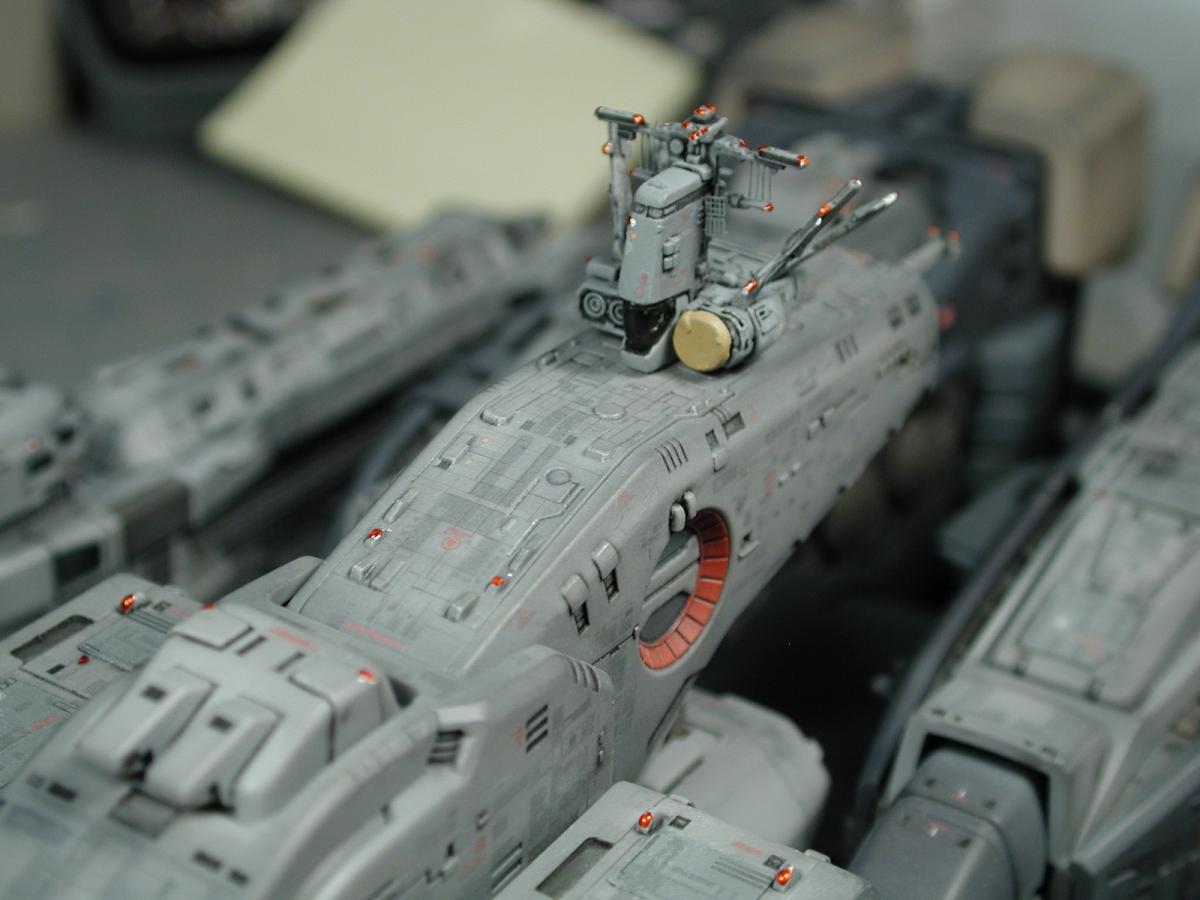

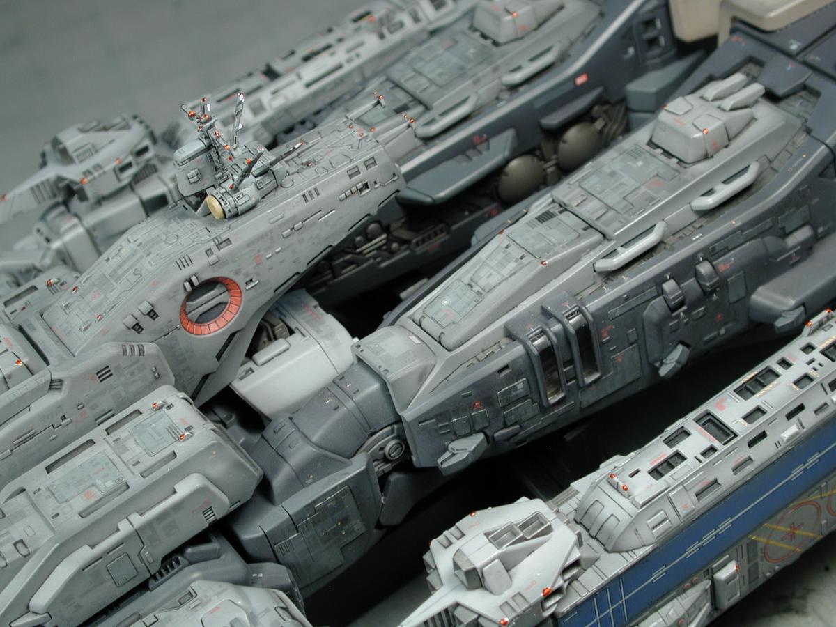

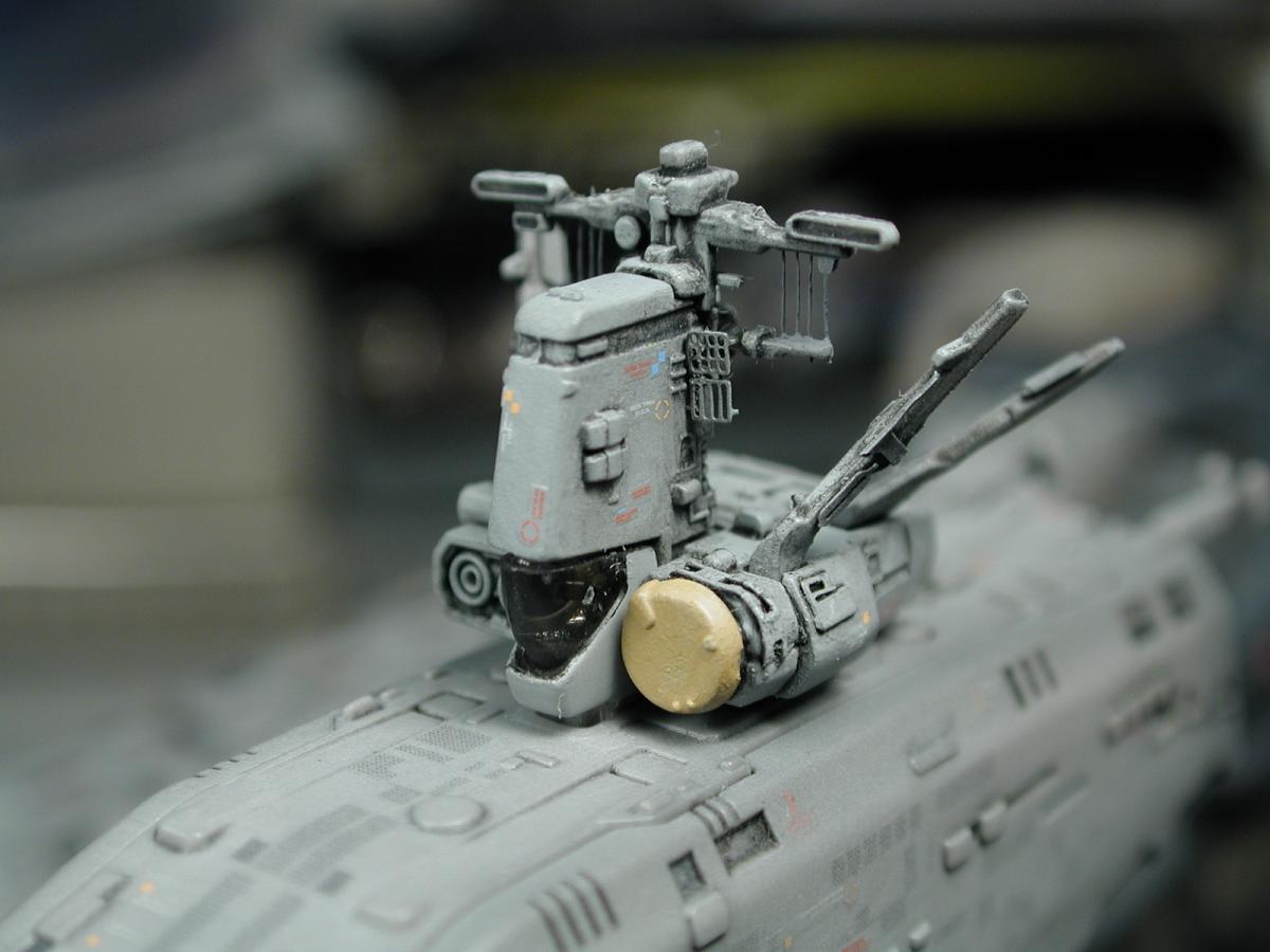

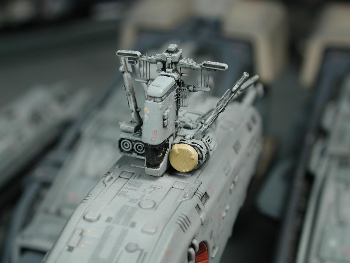

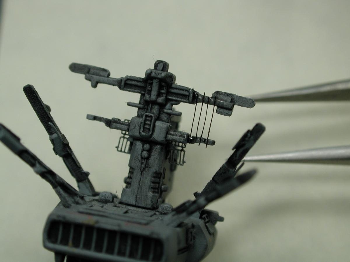

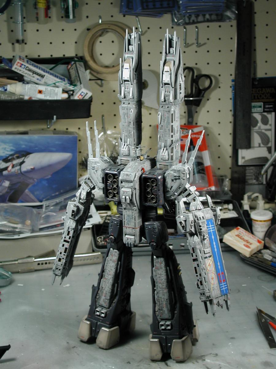

Well, I've really put a bit of myself into this build! It's my hair!! Someone earlier on suggested that I use human hair for the antennas vertically spanning between the radar array since I couldn't get stretched sprue thin enough and strong enough to hold. Well, originally I had planned 8 per side, but I guess either age, eyesight or just being old got the better of me so I just ended up with 4 per side.
I then painted them grey, so they looked less like hair and it thickened them up a bit - but they were strong!

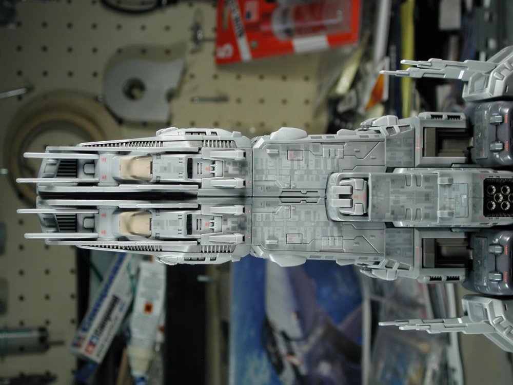

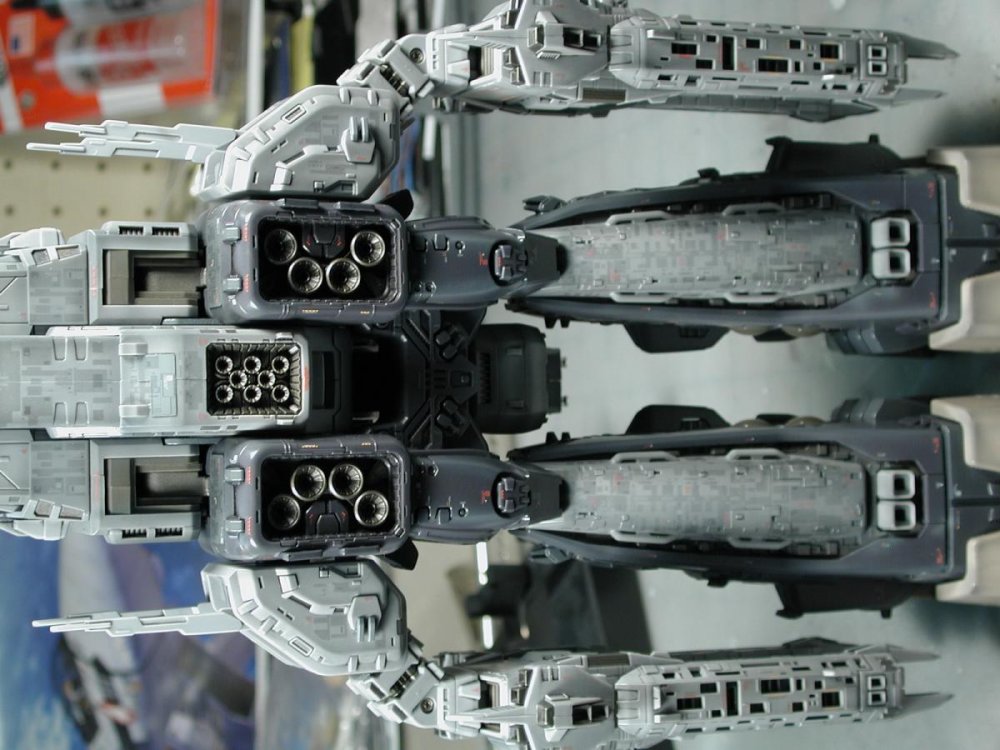

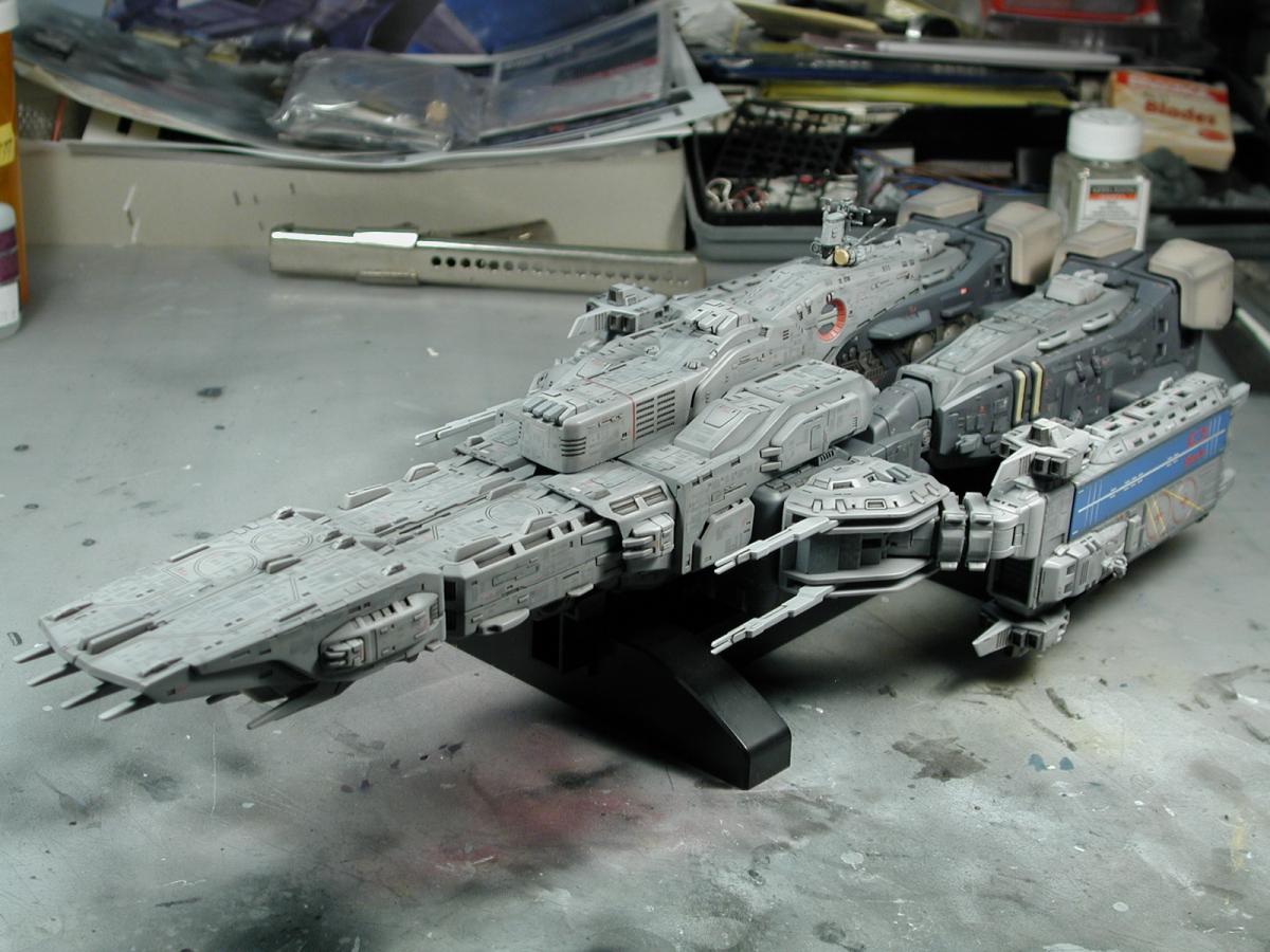

The second oil wash did wonders popping the details out! The overall flat/matte clear-coat lightening everything quite a bit, including the dark grey areas, I always thought they were too contrasty, but now they might be too light and blended into the overall scheme a little too much.
post-244-0-05308000-1334964461_thumb.jpgpost-244-0-80036600-1334964464_thumb.jpgpost-244-0-59776600-1334964468_thumb.jpg

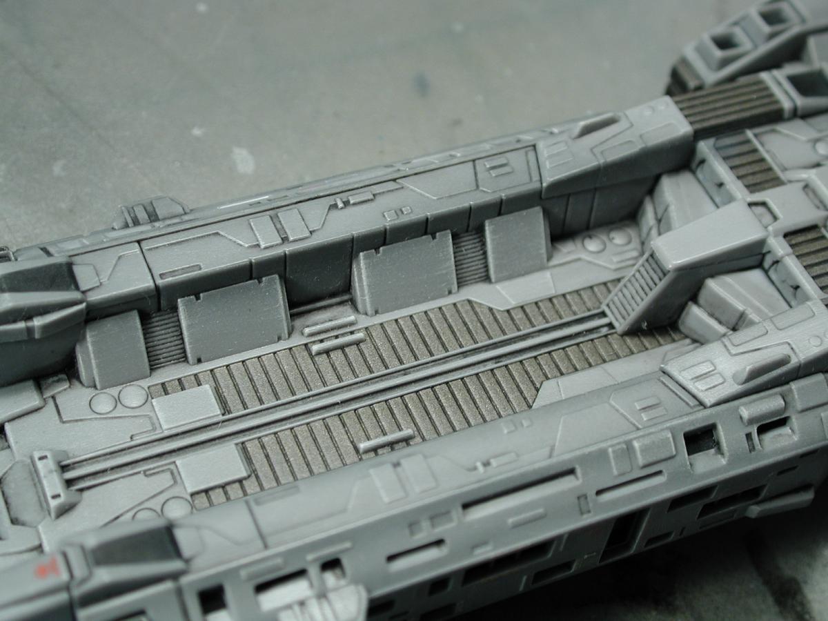

I still have a dry brushing stage to go to pick up the highlights and then a mechanical pencil pass like they did on the Star Wars Star Destroyers, but I am glad I'm finally finished with the decal stage! The panelling ended up to be a much bigger job than I had anticipated.

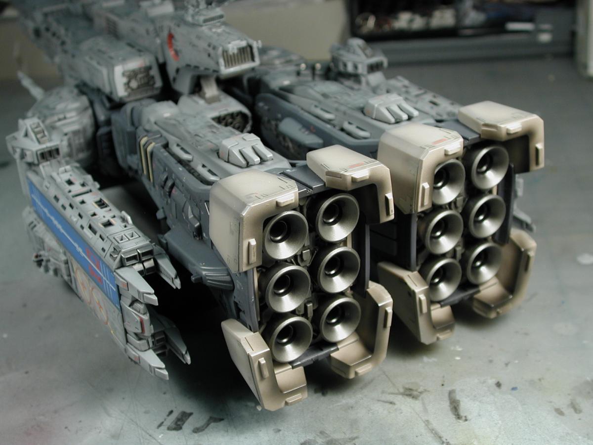

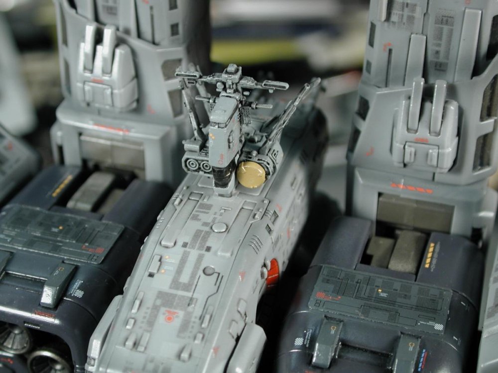

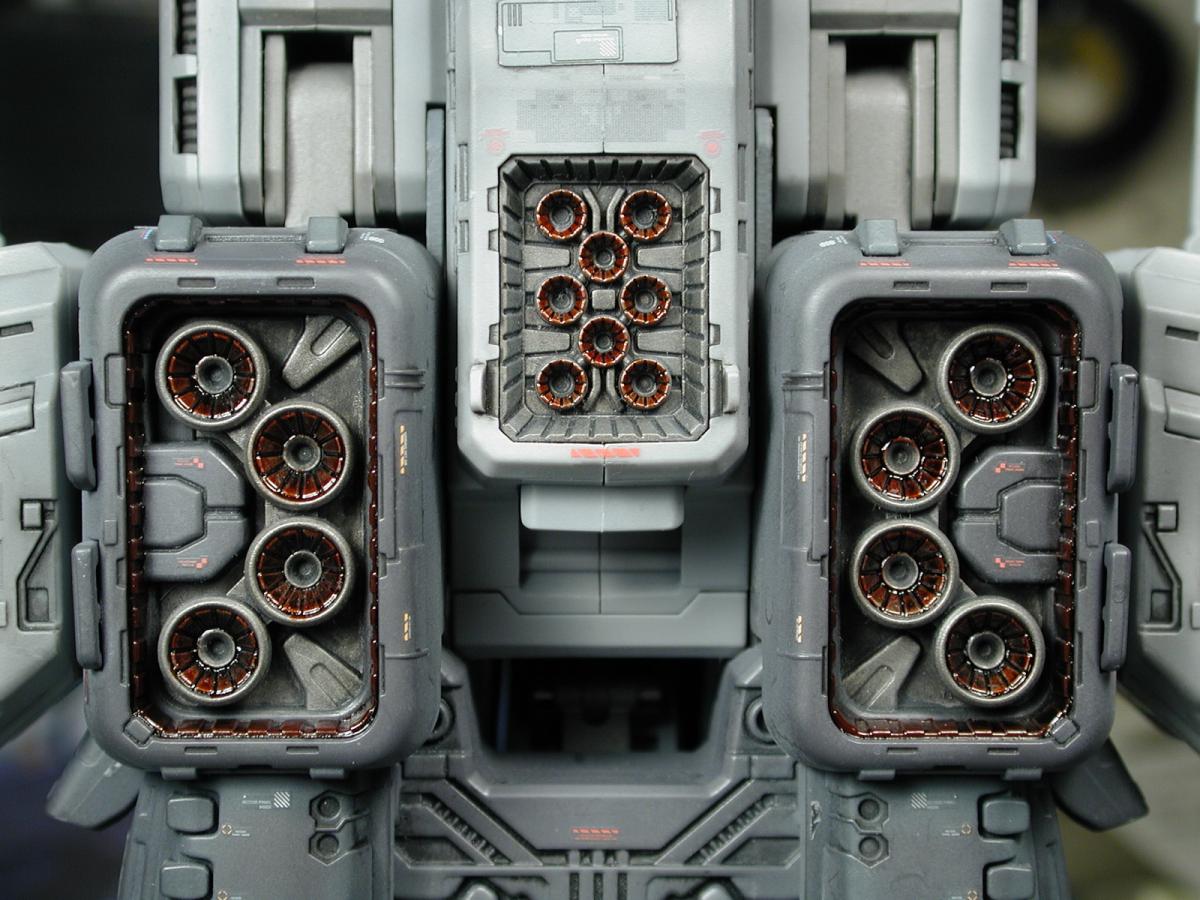

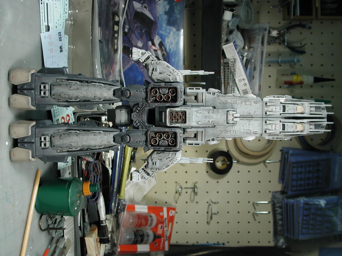

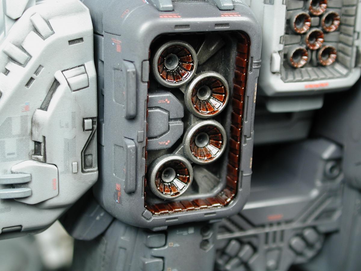

I airbrushed the interior of the engine bells Alclad Burnt Exhaust - I hated the tan colour of the plastic in there. I then "charred" the edges of the ends of the legs to tie them into the engines
The final parting shot...

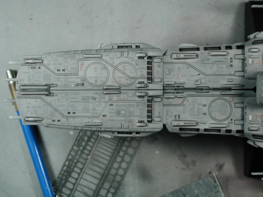

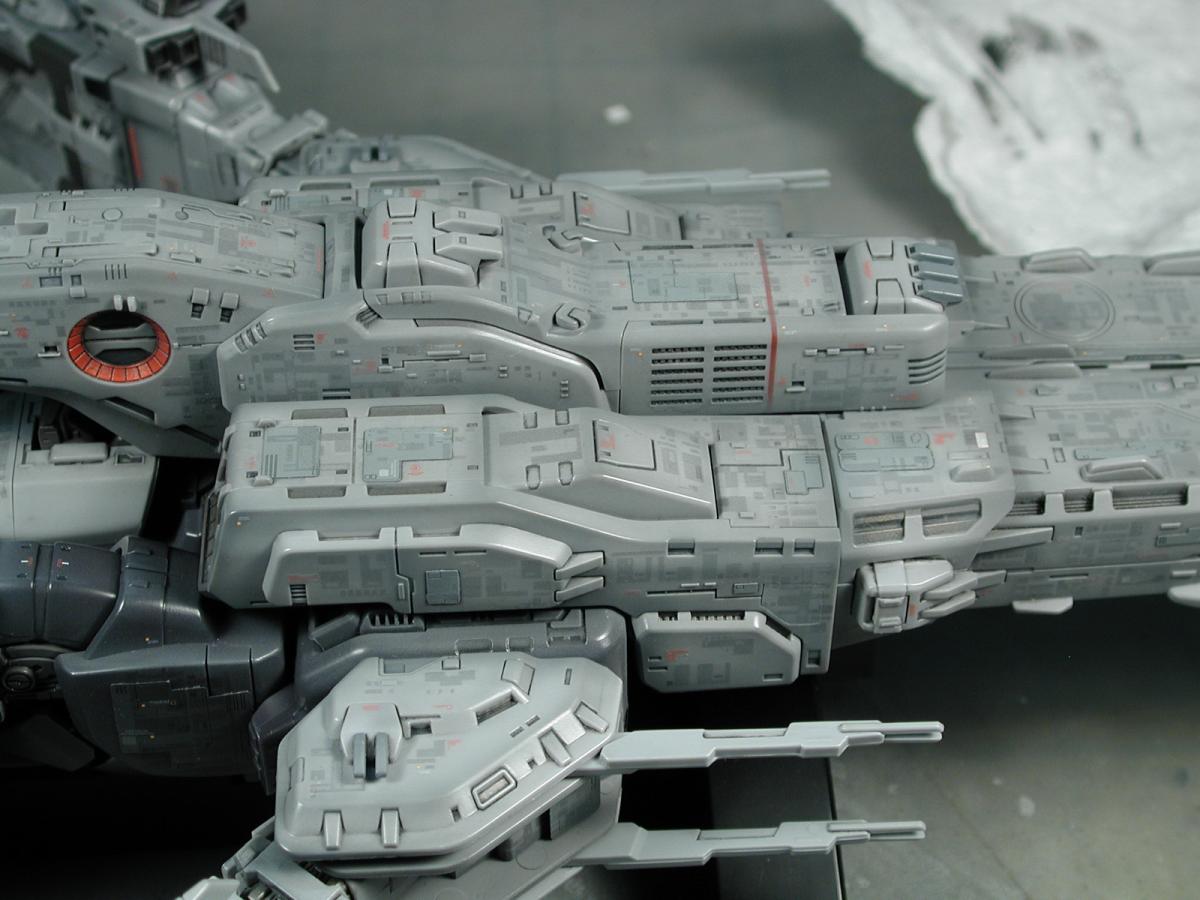

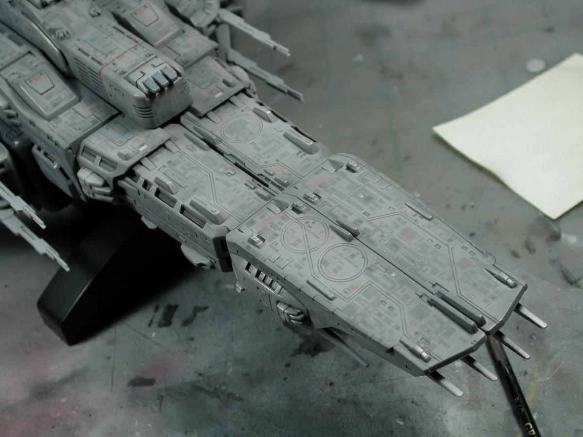

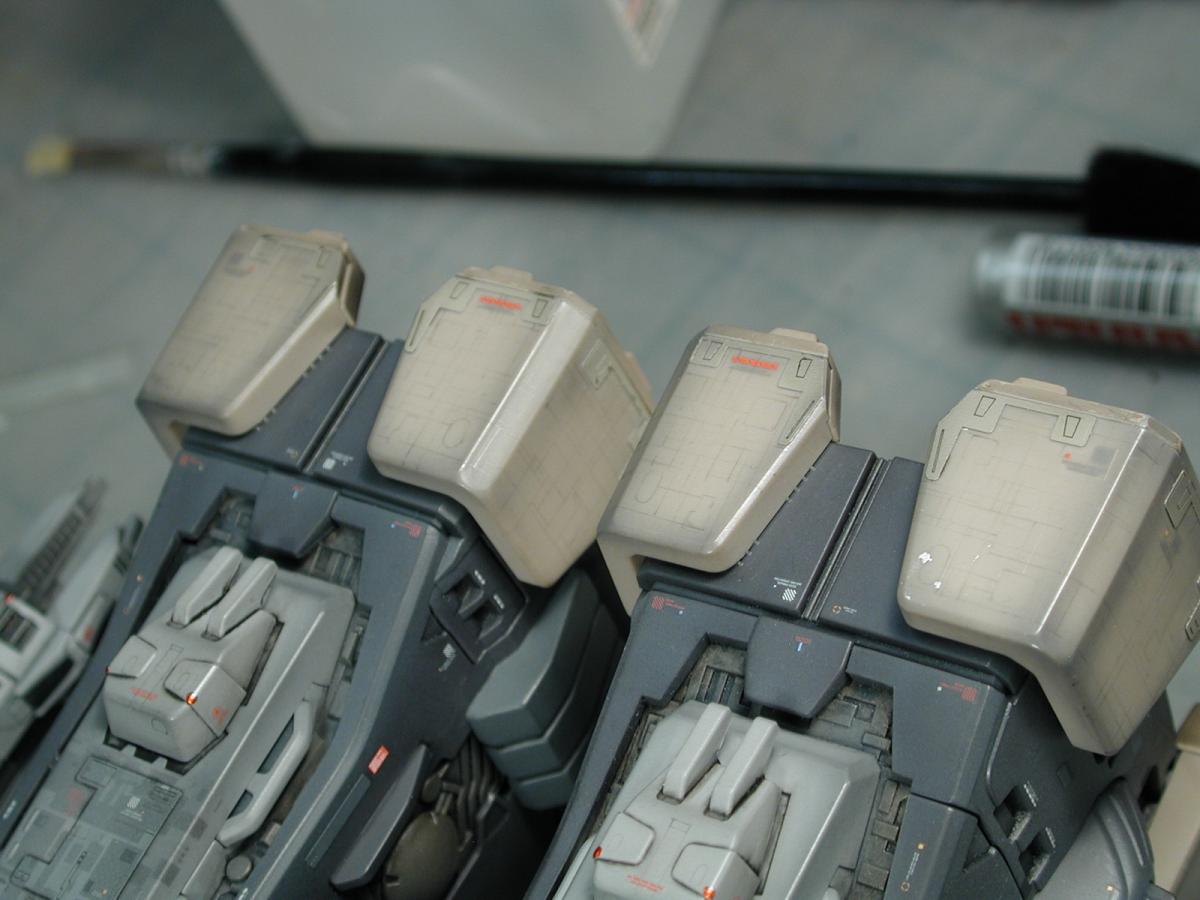

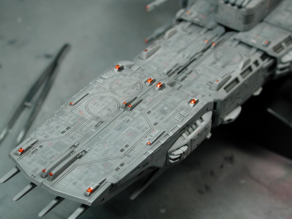

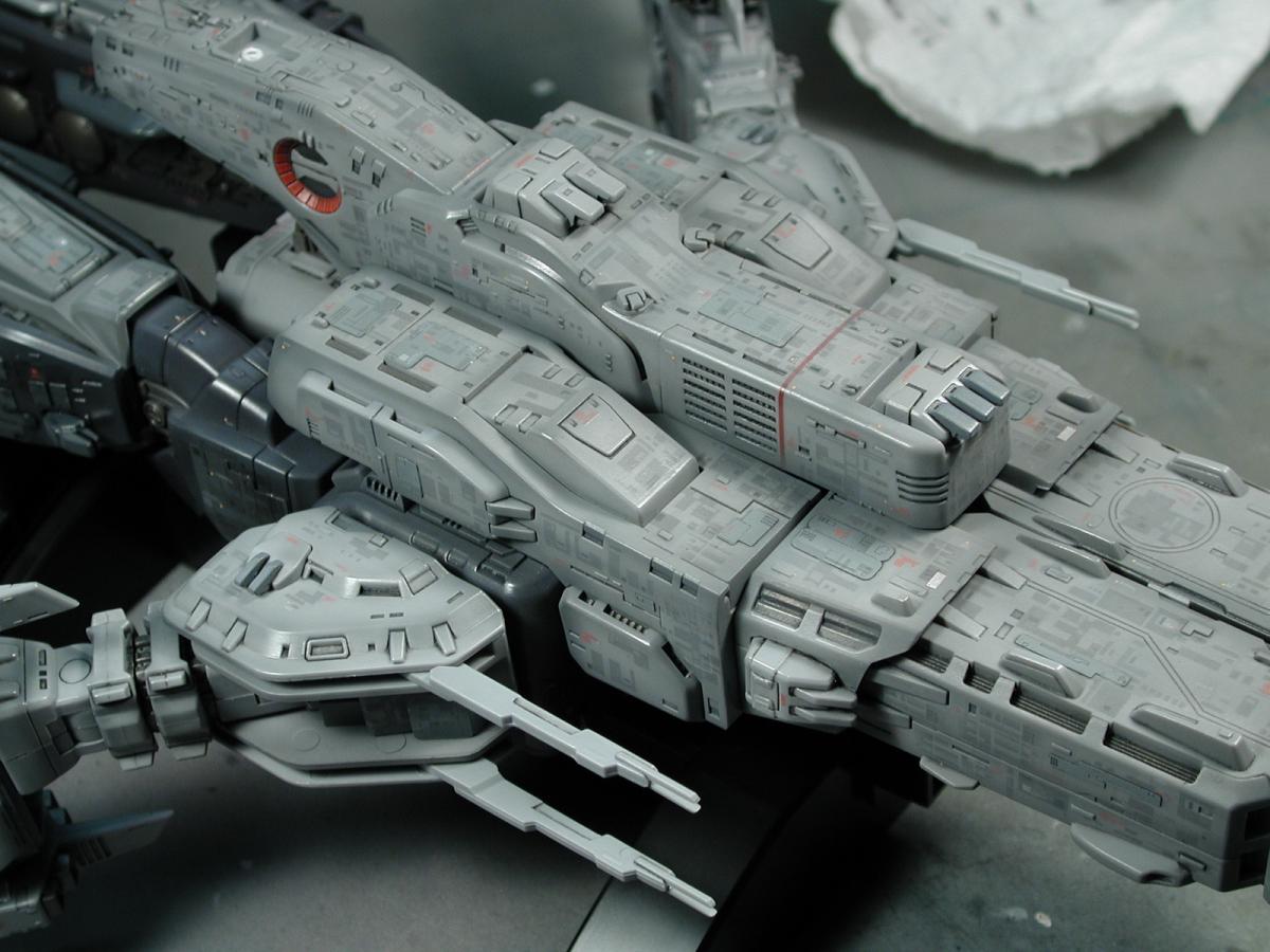

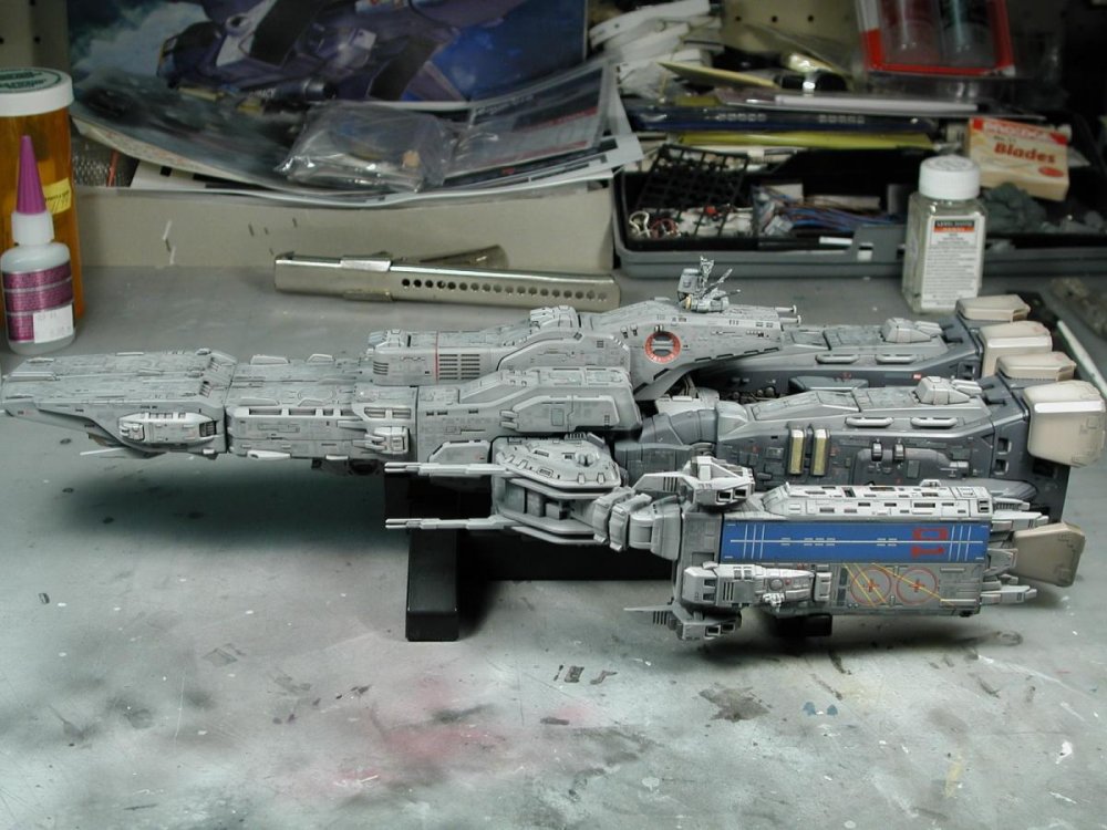

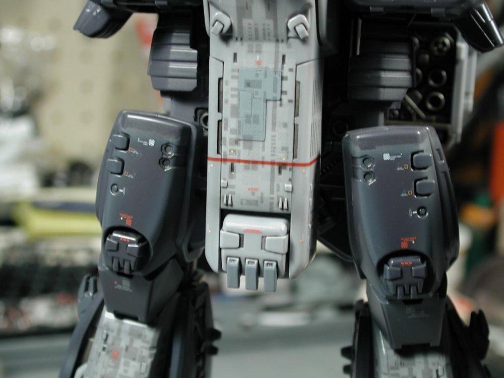

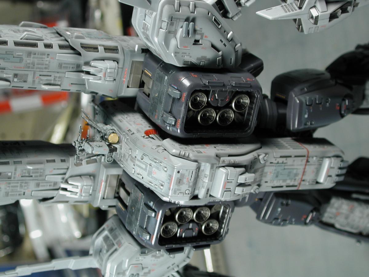

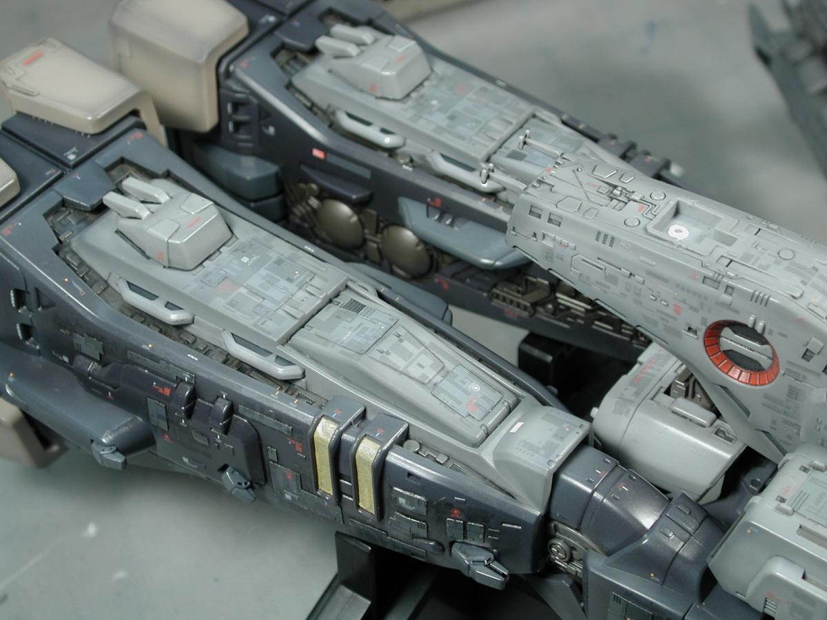

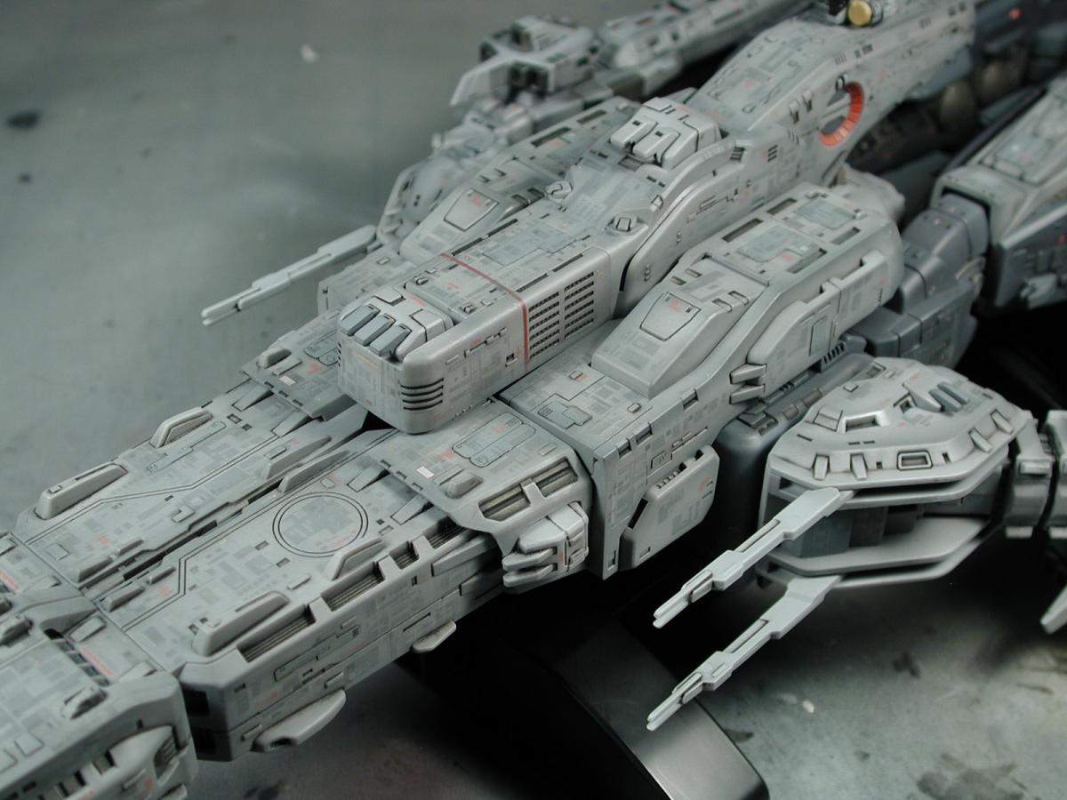

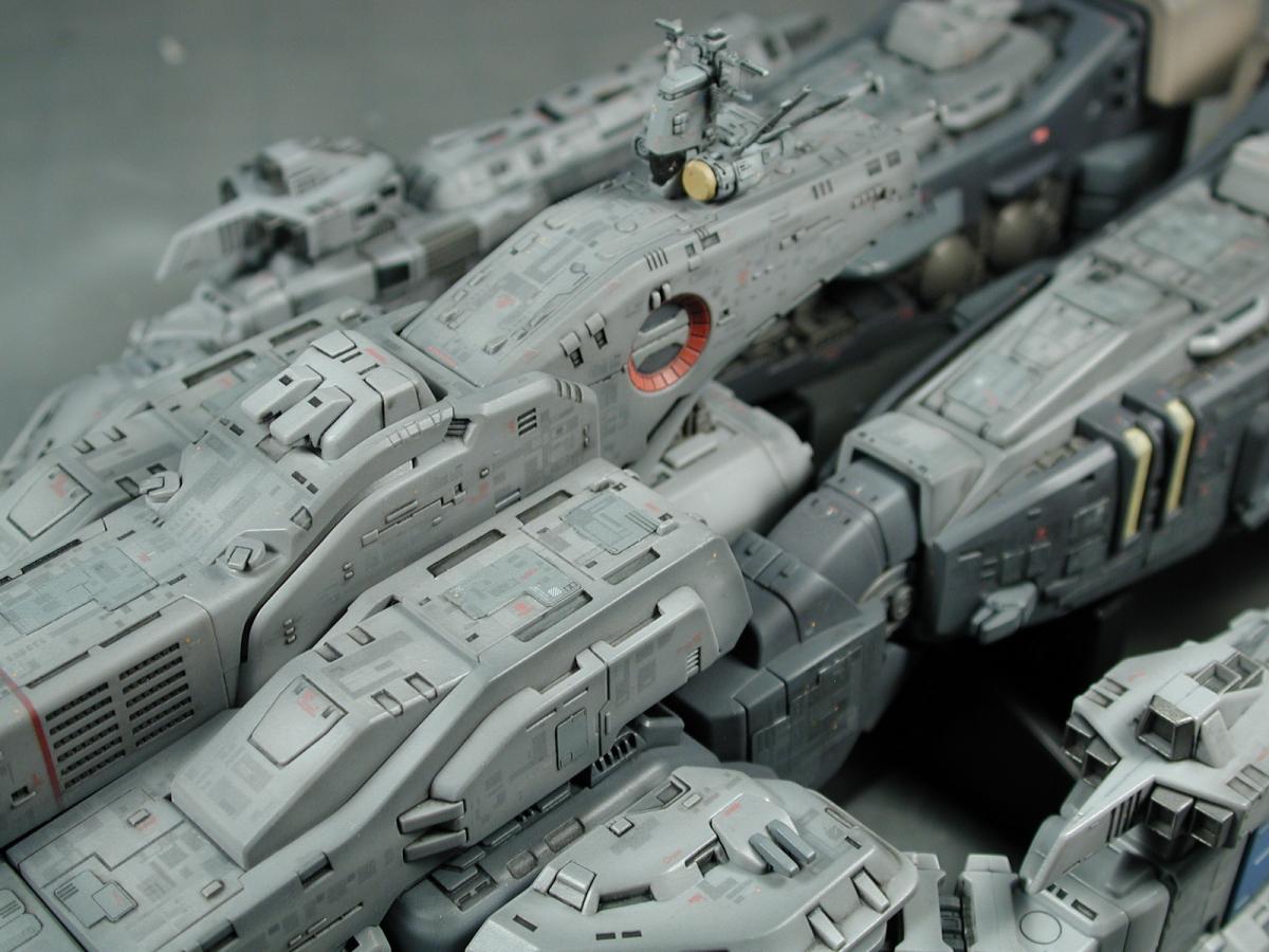

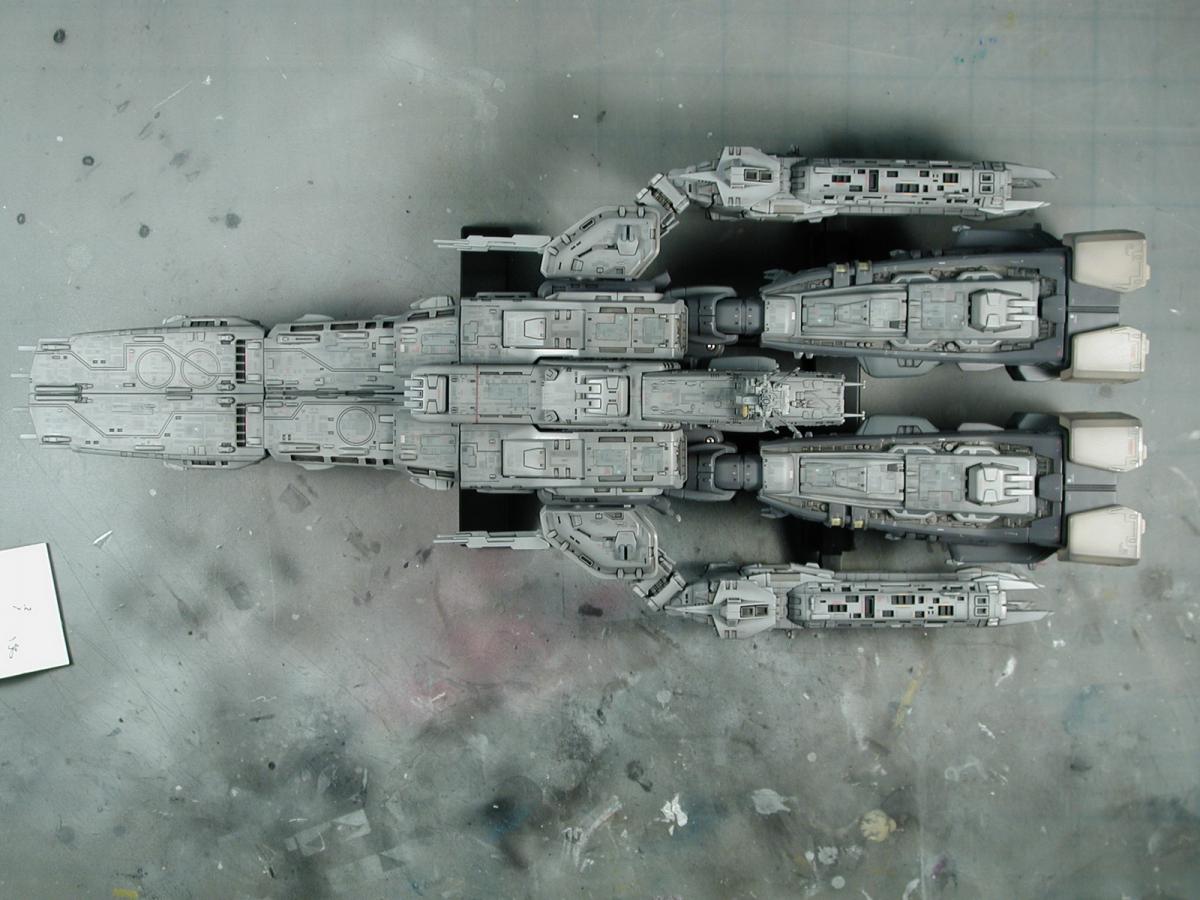

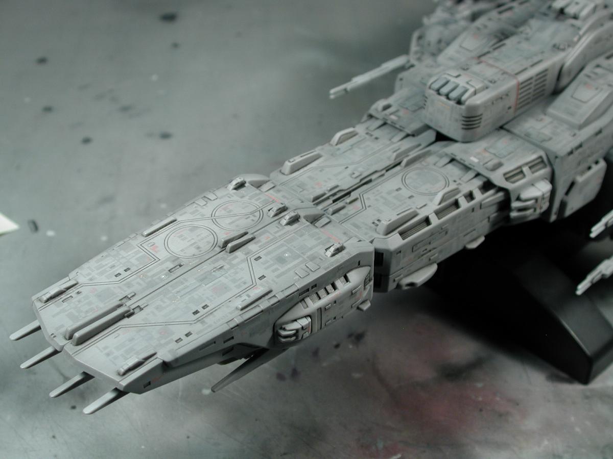

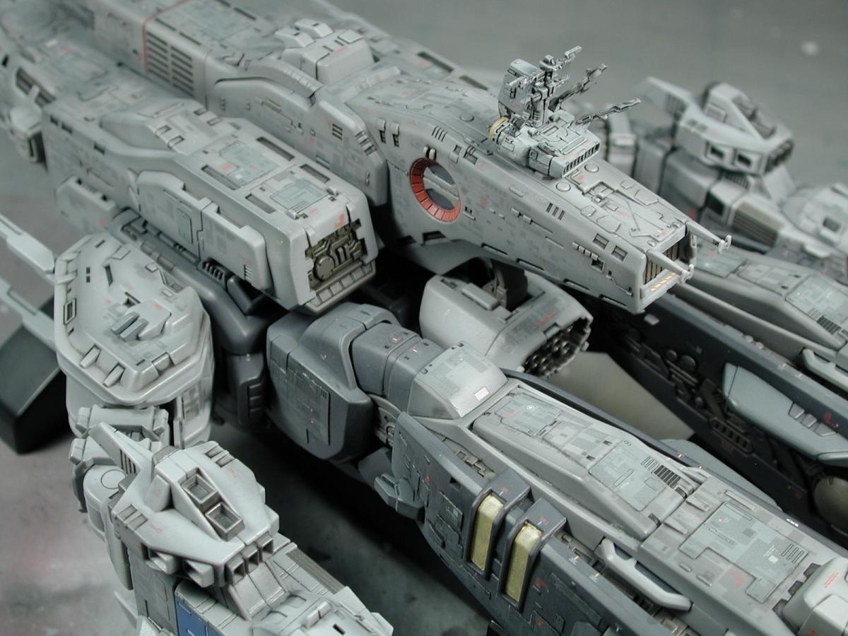

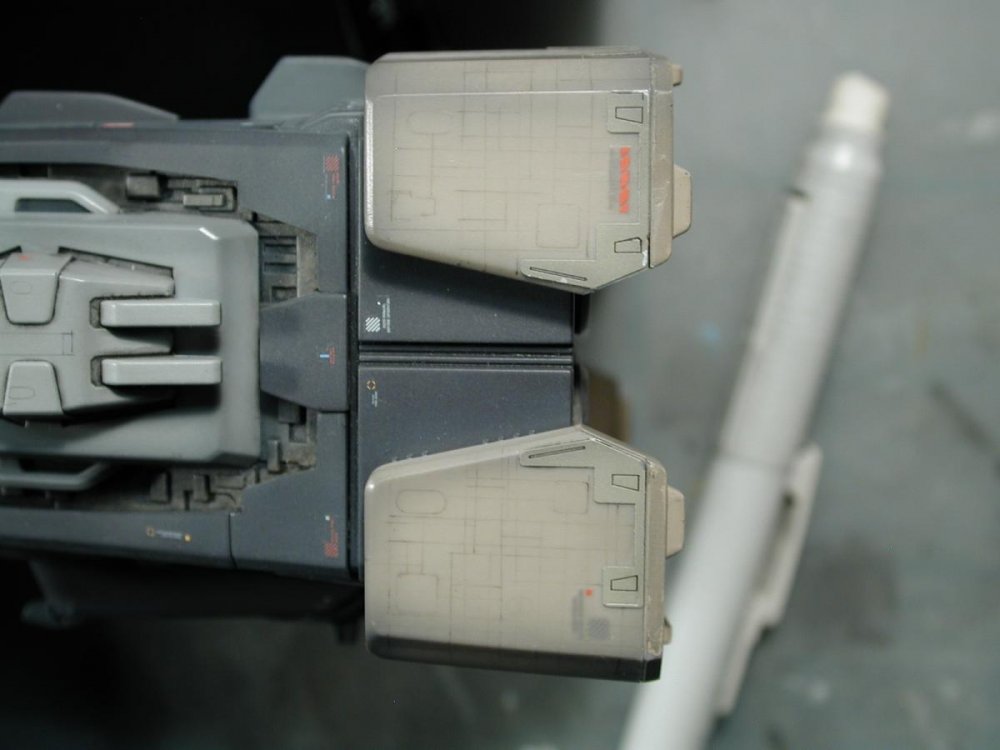

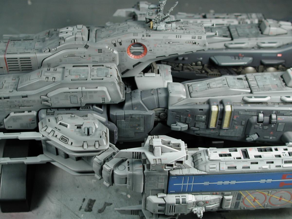

I got a little time to do some pencil panel lines all over the SDF-1 - the key is subtle here! But it was a lot of surface area, at least some of the flatter areas like the rear engine tan portions are a bit more detailed now.
Some light grey/white drybrushing to pick out the raised details,
Unfortunately, when I started to dab around for the nav lights, I used the Tamiya marker chrome on a fine 000 brush, and didn't realize I got some on my palms! Argh! I accidentally transferred some tiny hits of silver around the toy. I thought, I'd use some organic solvent to wipe away the bits of silver, but unfortunately, the solvent ate through all my layers of clear-coat and greys!! So I've gotta do a bit of a repair job to that tiny section I tested it on - well, one step forward - 2 steps back!
I did add the Tamiya red clear over the tiny hits of chrome silver to simulate the red nav lights all over the SDF-1. So here it is for now... still a ways to go!!
Edited by wm cheng

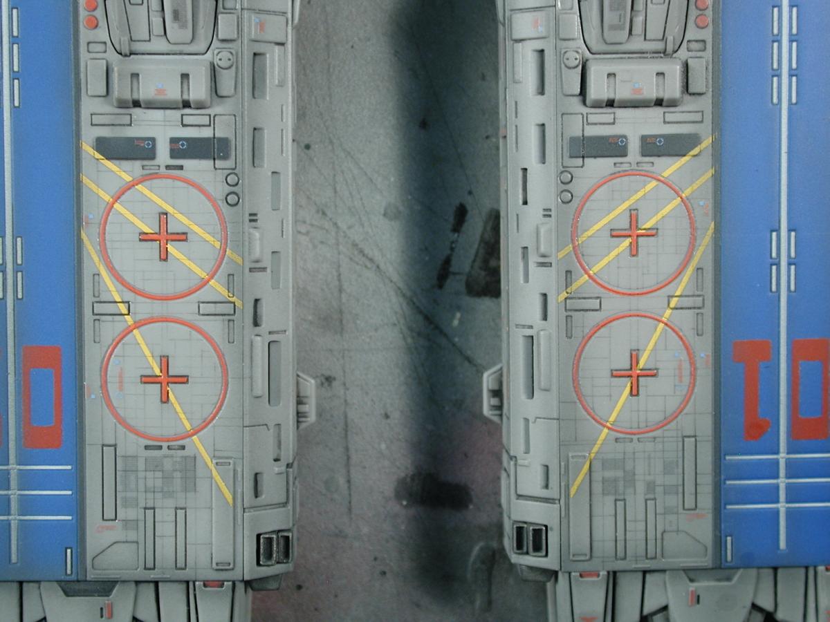

I just noticed the grid lines on the feet. It's so simple yet so awesome. I never would've thought of anything like that.
Are you sure you're not just looking at the thumbnails? The last pic posted here is 500kb.
When you open the preview it gives uploaded size, but if you check the file size after you download it or in the "save" page the actual available file is much smaller...

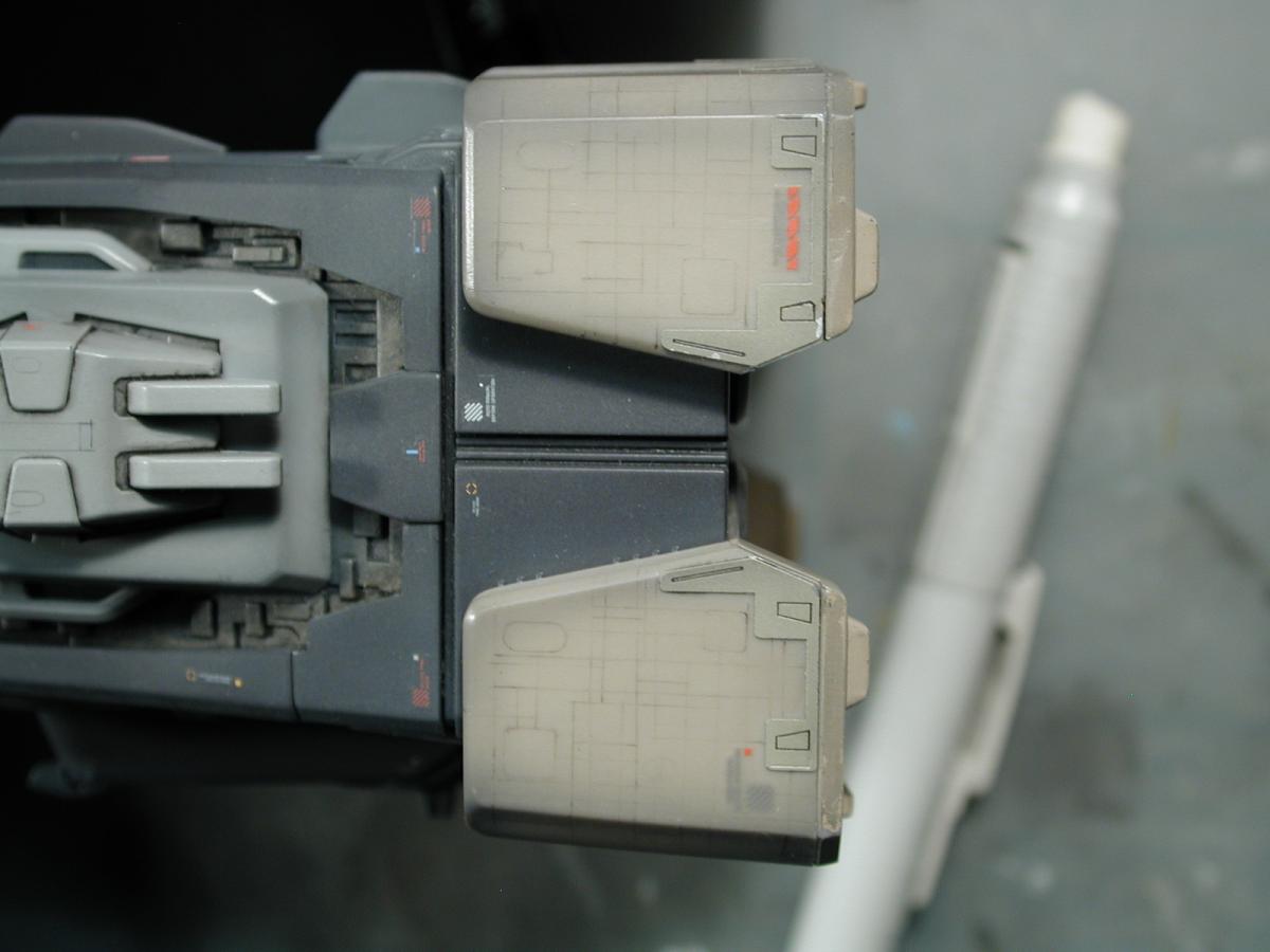

How exactly did you do those anyway...the whole pencil thing???? Inquiring minds wanna know! :ph34r:
It's those fine details that really bring this toy to life. Not to ride your jock Cheng, but you really are an asset to this community. Thanks for taking the time to create a tutorial on all your projects and providing inspiration to our own projects.
I just used a ruler and a mechanical pencil, very sharp - I usually use a H lead (harder lead) and started to draw on the surface. It works best on a matte surface (which is why I waited till my matte/flat coat) and you have to seal it again afterwards since it will rub off with your fingers. I got the idea from Star Wars - its how they detailed their Star Destroyers. I also use a Photo-etched template that has weird shapes on it for the odd access panel here and there.

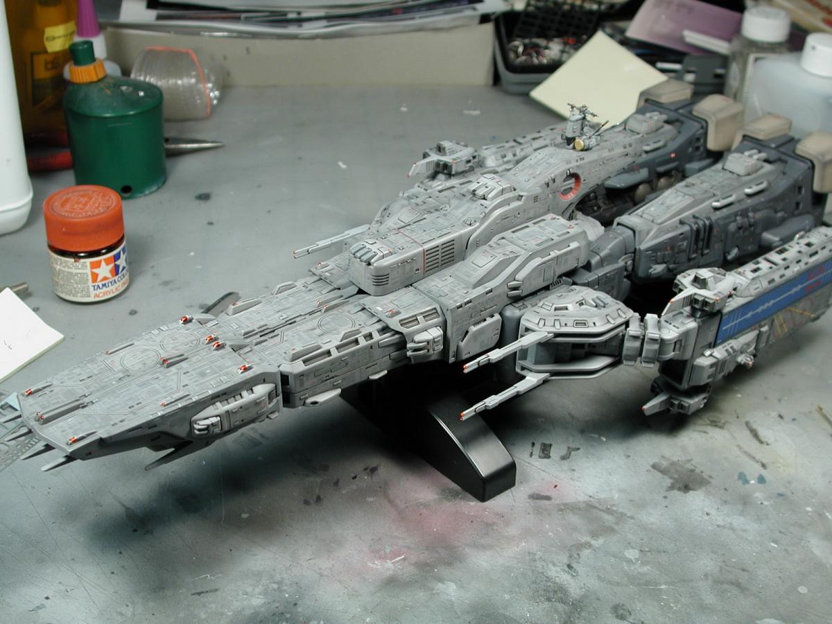

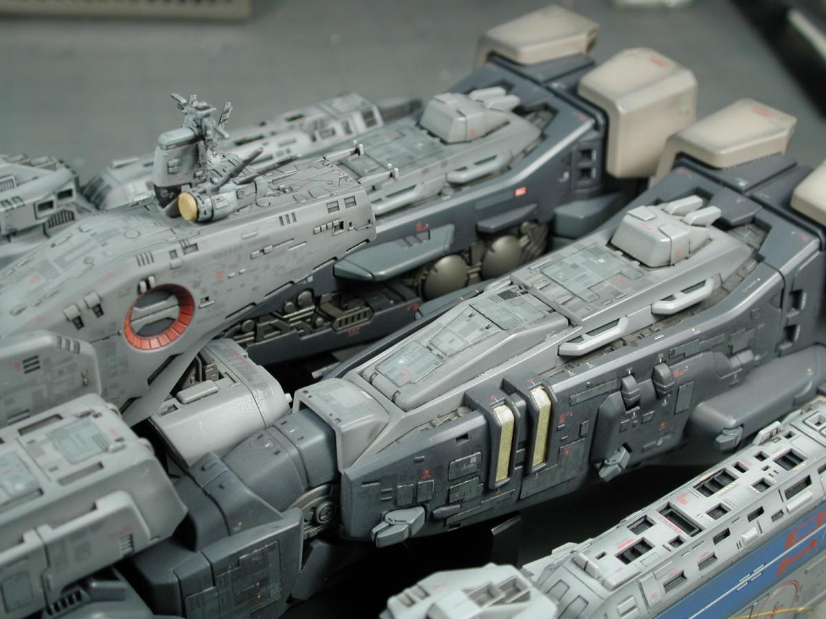

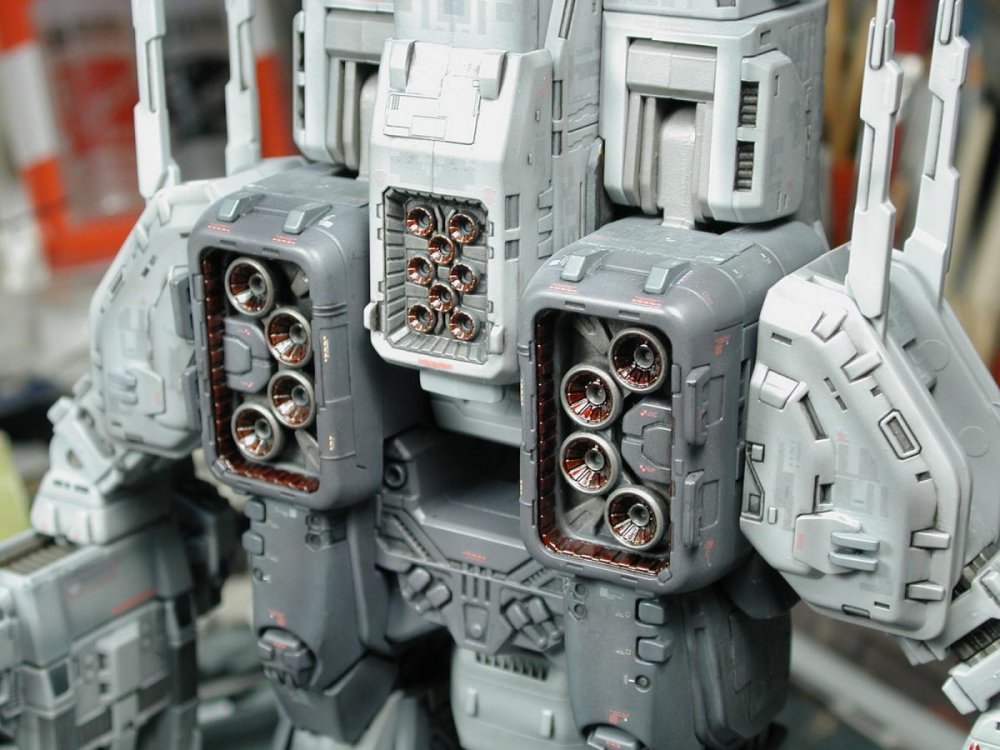

Thanks for the kudos everyone. I had a few hours and thought I'd try to finish this thing after a long hiatus.
I decided to just paint with Tamiya Clear Red over some of the engine thrusters on the bottom, it already had a metallic under coat and created a darker red rimmed effect that I wanted for my more muted version of the SDF-1
