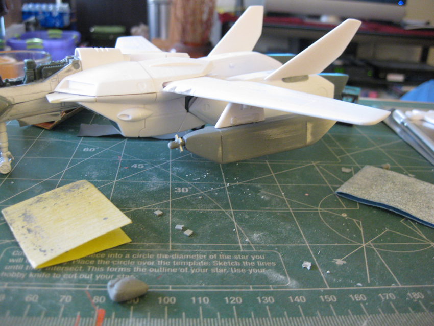

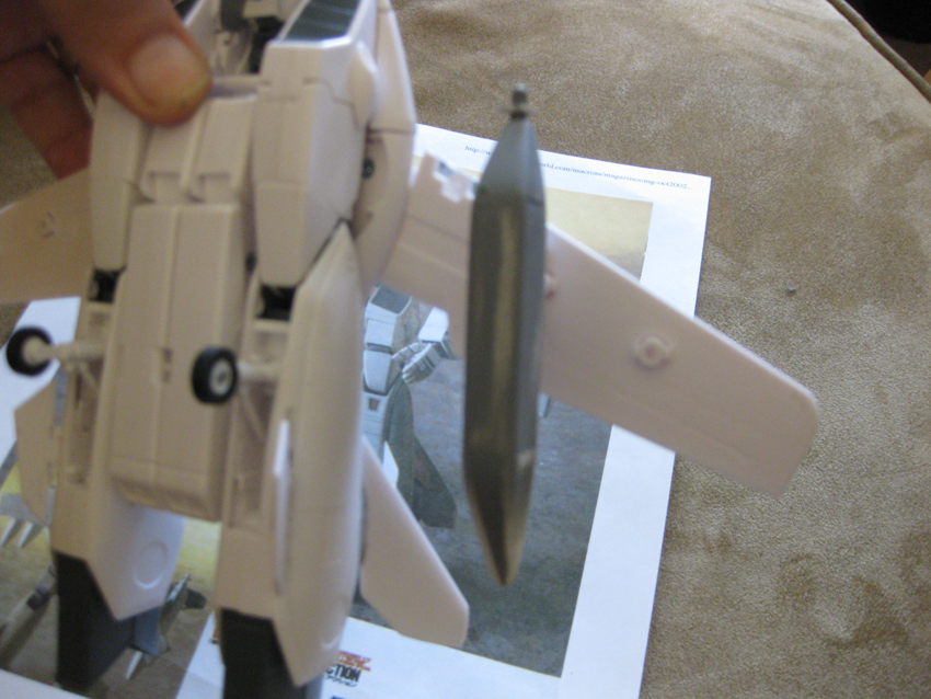

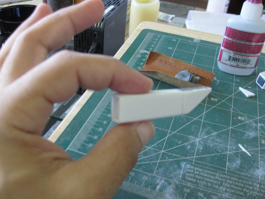

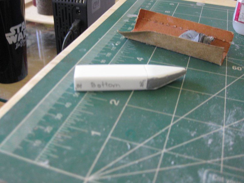

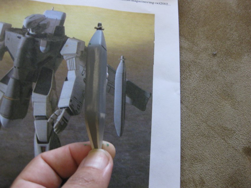

Jasonc Posted February 3, 2011 Author Posted February 3, 2011 (edited) While waiting for a scribing set of tools, I decided to work on something a little different than the actual Valkyrie. So, I started working on the drop tanks with the propellers on the wings. I think I'm gonna make just one, and then have it recasted, so I'm putting a lot of work into making this one as straight and clean as possible. I've made this mostly out of styrene, and for the curved rear, I filled it with resin. The harness that attaches it tot he wing will be the cluster missile attachments, since they are a white color as well. Sorry for the poor blurry pics, my camera doesn't take the best pics without the flash. Building the correct sections have given this really good, defined panel lines. I should have the basic shape of the front done tonight, if not, tomorrow. Enjoy. Also, I've been thinking about making these drop tanks as maybe something to recast and sell for those interested. I may also be making additional armaments after this project is done, most based in the Valkyrie profile books, and then even some totally custome ones. Let me know what you guys think and if you'd be interested in that. (Hahaha, I'm derailing my own thread a bit). Edited February 3, 2011 by Jasonc Quote
big F Posted February 3, 2011 Posted February 3, 2011 Also, I've been thinking about making these drop tanks as maybe something to recast and sell for those interested. LOL there are some here who'd prefer if you dip the whole thing in silicon and cast it Your work is great. Shame Hasegawa never tried this Quote

Model-Junkie Posted February 5, 2011 Posted February 5, 2011 Excellent work so far! I've been following this thread with great interest. Just a heads up, those are Jamming Pods and do not contain fuel. Their real life counterparts can be found here. Also, the fan at the front of the pod is part of the RAM air turbine generator and is used to provide power to the pod and does not provide propulsion in any way Quote
Jasonc Posted February 5, 2011 Author Posted February 5, 2011 Excellent work so far! I've been following this thread with great interest. Just a heads up, those are Jamming Pods and do not contain fuel. Their real life counterparts can be found here. Also, the fan at the front of the pod is part of the RAM air turbine generator and is used to provide power to the pod and does not provide propulsion in any way Interesting...Thanks for the info on what the pods are. I thought it might have something to do with electronics, but didn't know what to call it. Drop tanks was just an easy default to give it. Quote

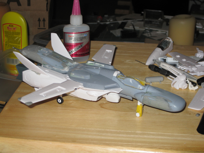

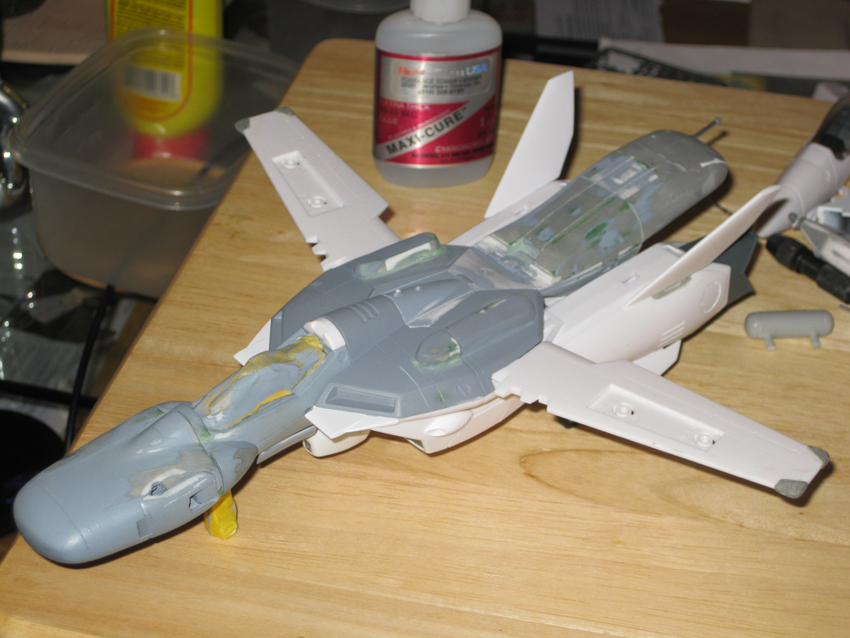

gwfalcon Posted February 9, 2011 Posted February 9, 2011 (edited) Woooooooo, it is the only word jumping into my mind!! Man, do you have any plan to sell the kit? I am extremely interested. Best wishes to your project. It is truly awesome and really looking forward to see the finished vea-1. One small suggestion: the connecting part right under the cockpit seems slightly oversized (compared with the 1/72 model), sanding it down a bit would be better. Edited February 9, 2011 by gwfalcon Quote
Jasonc Posted February 9, 2011 Author Posted February 9, 2011 Woooooooo, it is the only word jumping into my mind!! Man, do you have any plan to sell the kit? I am extremely interested. Best wishes to your project. It is truly awesome and really looking forward to see the finished vea-1. One small suggestion: the connecting part right under the cockpit seems slightly oversized (compared with the 1/72 model), sanding it down a bit would be better. Thanks for the reply. I was thinking about making some sort of kit, but because it uses parts of the valkyrie toy in different places, it's not really kit ready. Someone had asked about me commisioning one for them, and I'd probably do that, but the time and work that goes into this kit don't make it cheap. It's also easiest to make these from the unassembled kits, as all the parts are not glued, and specific pieces can be worked on in segments and not as whole pieces. Today, as I've been waiting on my scribes and squares, I started work on the handgun. Found some round round styrene that is about perfect for the diameter of the gun. So, with some work, I've managed to put the handle onto the rigged piece, and tomorrow, I'll be cleaning it up and I'll post up pics of the WIP of that. Quote

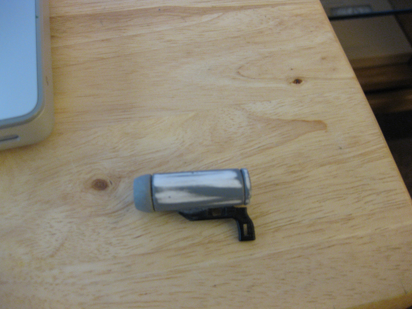

Jasonc Posted February 10, 2011 Author Posted February 10, 2011 OK, not a big update, but since I'm still waiting on more tools, I'm working on the little details and accessories. Here is the handgun that the Platypus will carry. Basically, it's the GU-11 handle (used so that it'll connect in fighter mode), attached to styrene 3/8" styrene tube wrapped over 3 times. I did that so that I could taper the tube, and so far, it's coming along nicely. Just need to put a round cap on the back of it, and the inside barrel, and it's all done. It'll be another accessory I'll end up recasting for a set later, or if I do another one of these, as I might do if someone wants one of these. Today, I'll be working on finishing this if possible, and adding the other small tanks and build up pieces on the Valk itself. Quote
Mommar Posted February 15, 2011 Posted February 15, 2011 OK, not a big update, but since I'm still waiting on more tools, I'm working on the little details and accessories. Here is the handgun that the Platypus will carry. Basically, it's the GU-11 handle (used so that it'll connect in fighter mode), attached to styrene 3/8" styrene tube wrapped over 3 times. I did that so that I could taper the tube, and so far, it's coming along nicely. Just need to put a round cap on the back of it, and the inside barrel, and it's all done. It'll be another accessory I'll end up recasting for a set later, or if I do another one of these, as I might do if someone wants one of these. Today, I'll be working on finishing this if possible, and adding the other small tanks and build up pieces on the Valk itself. Having a few VF pistols around would be pretty cool actually. Quote

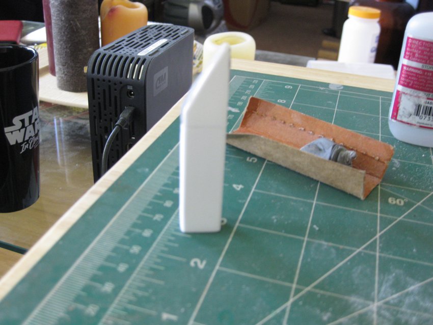

Jasonc Posted February 16, 2011 Author Posted February 16, 2011 Today, I have finished what are the external tanks located on the back calf of the legs. All scribe tools have come in, and I've begun to sort out what I need to put lines on. Pretty soon, I will recast what I need to duplicate on this thing, and can then start the process of super clean-up, and paint. I still need to put the top piece to the backpack, but that can be done in a day or so. Almost there. I'll start on the decals soon, as well. Quote

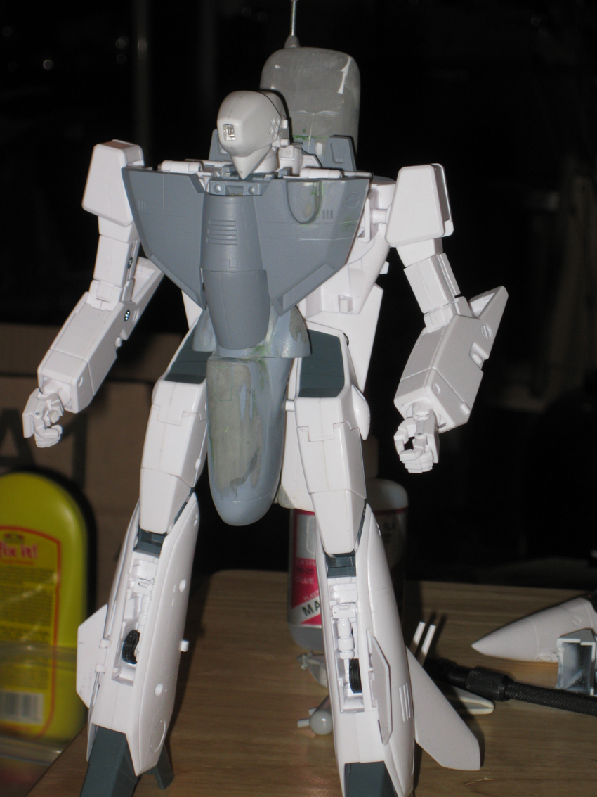

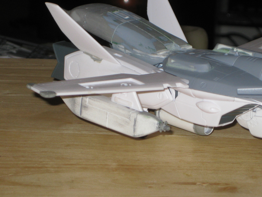

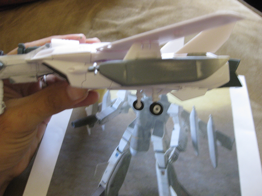

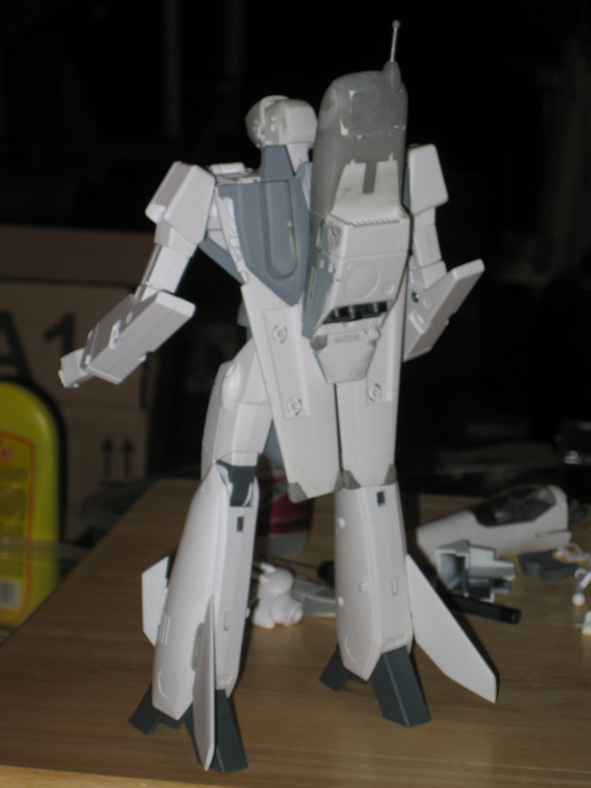

Jasonc Posted May 4, 2011 Author Posted May 4, 2011 Today, I spent some time working on some of the updated stuff that I've been doing with this project. While it still has a way to go, it seems to be looking more like it needs to. It's quite ugly right now, due to all the patch work and stuff, but I think once the paint is on, it should look like it needs to. Anyways, here are the pics of test fits for today. Last pic has the new jamming wing attachment, which I will be making recast of to fit all hard points on the wings. The actual attaching point to the wing is from the larger missile cluster that holds 3 missiles, and I'll be using those instead of recasting this piece, just so that it has a solid point of connection. Comments are always welcome. Thanks for looking. Quote
Ignacio Ocamica Posted May 4, 2011 Posted May 4, 2011 Almost there!!! It's looking great, it's an awesome project. Quote
Jasonc Posted May 5, 2011 Author Posted May 5, 2011 Almost there!!! It's looking great, it's an awesome project. Thanks, it's coming along. Tomorrow I put the tanks on the legs, and will try to get some scribing done for panel lines on the backpack. I'm also gonna see if I can make the stoppers for the upper and lower leg connector parts of the side piece that connects the legs. Probably a little ambitious for me, but I should be able to get at least something done. Quote
valhary Posted May 5, 2011 Posted May 5, 2011 Im not big fan of fighter mode but the battroid kick ass congratulations excellent project you should made a convertion kit Quote
Jasonc Posted May 5, 2011 Author Posted May 5, 2011 Im not big fan of fighter mode but the battroid kick ass congratulations excellent project you should made a convertion kit Thanks, and yeah, I agree. I didn't like the way it looks from the original pics of it in fighter either. I think with my version, I've made the nose a little shorter, which doesn't make it look so awkward. But hey, it's called a "Platypus" and I don't think those are really too pretty anyways. functionality over beauty I guess. Quote
Majestic Posted May 5, 2011 Posted May 5, 2011 Looking good, good job! I love the Platypus design. I'm sure fighter mode will look better once it's fully painted, etc. Quote

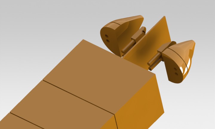

Jasonc Posted October 7, 2011 Author Posted October 7, 2011 This is a sorta bump and an update. I'm still working on this project, but now using the beauty of 3D modeling, I will be making some of these parts through that. I've only been doing this for maybe a week or so, but the accessories are coming out well, and I'm going to be putting up an interest thread for a weapons set shortly. So far, I've had some success creating a 1/60 2000lb. Paveway II bomb, and then a MPBMS multi missile system from Macross Frontier. Next up is the jamming pod for this project, and then set 1 will be available. But, in conclusion, PROJECT IS NOT DEAD. Quote

valid Posted November 5, 2011 Posted November 5, 2011 hey jason.. is that one of the ecm weapon set that you produce with 3d print? Quote

Jasonc Posted December 21, 2011 Author Posted December 21, 2011 hey jason.. is that one of the ecm weapon set that you produce with 3d print? Man, sorry I didn't see this earlier. The site is supposed to inform me on when I get posts on this thread. To answer your question, the first one I did was scratchbuild with styrene. The other ones will be done with 3D print. Hi Jason, any updates? Really interested! Not really much to update on. I finished the legs, but did not like the way the tail fins are positioned. I'm probably going to recast some of the VT-1 or VE-1 fins, and use those, as they are shorter, and should work much better. As for the nose, I want to clean it up, but just trying to find a good way to do it. The mechanism works great, but it's got a bit of weight on the front, so if I can fix those two main issues, this should be done. Oh, and the head. I have to finish up the head. It's really close before I paint it. Quote
