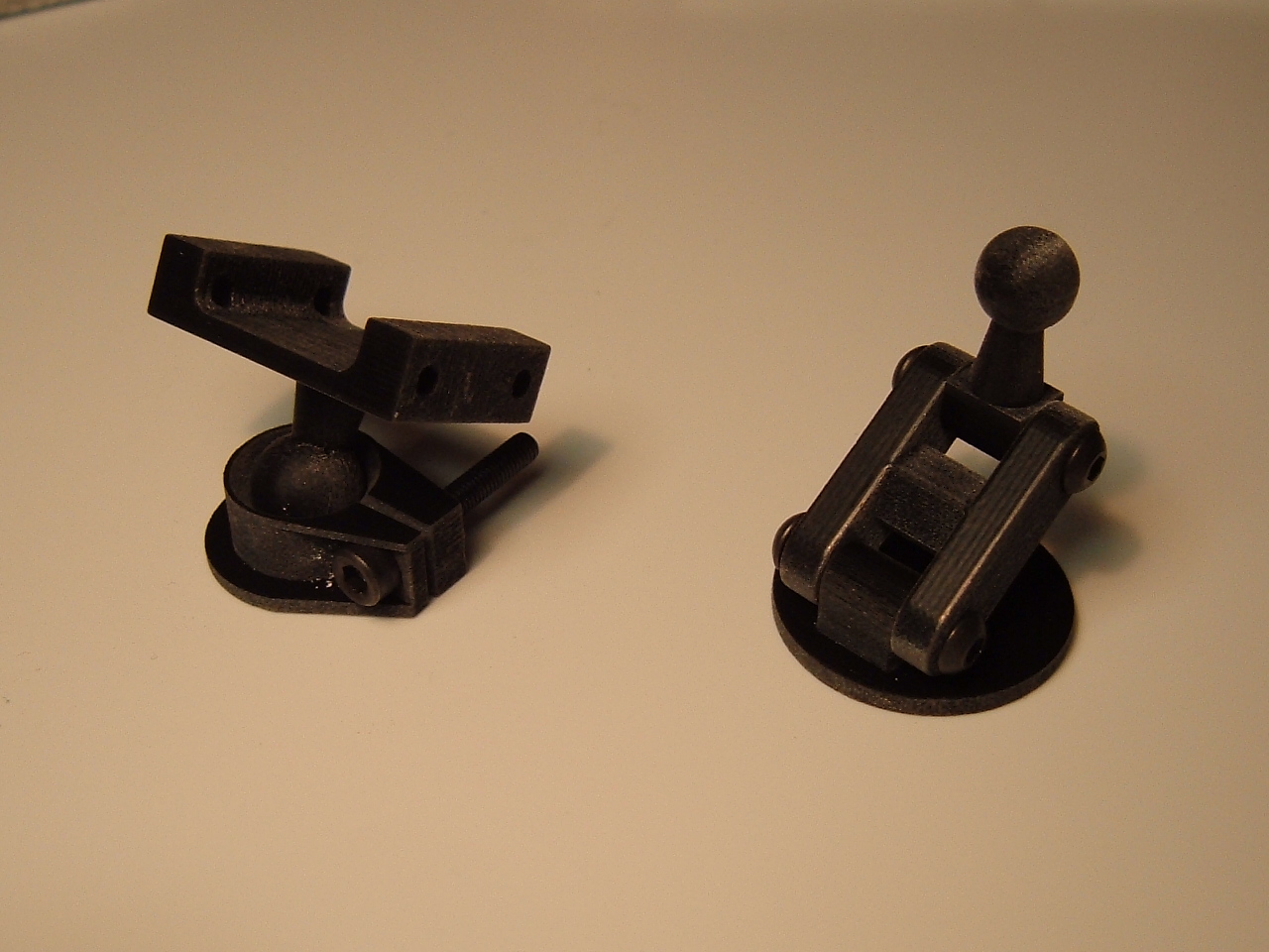

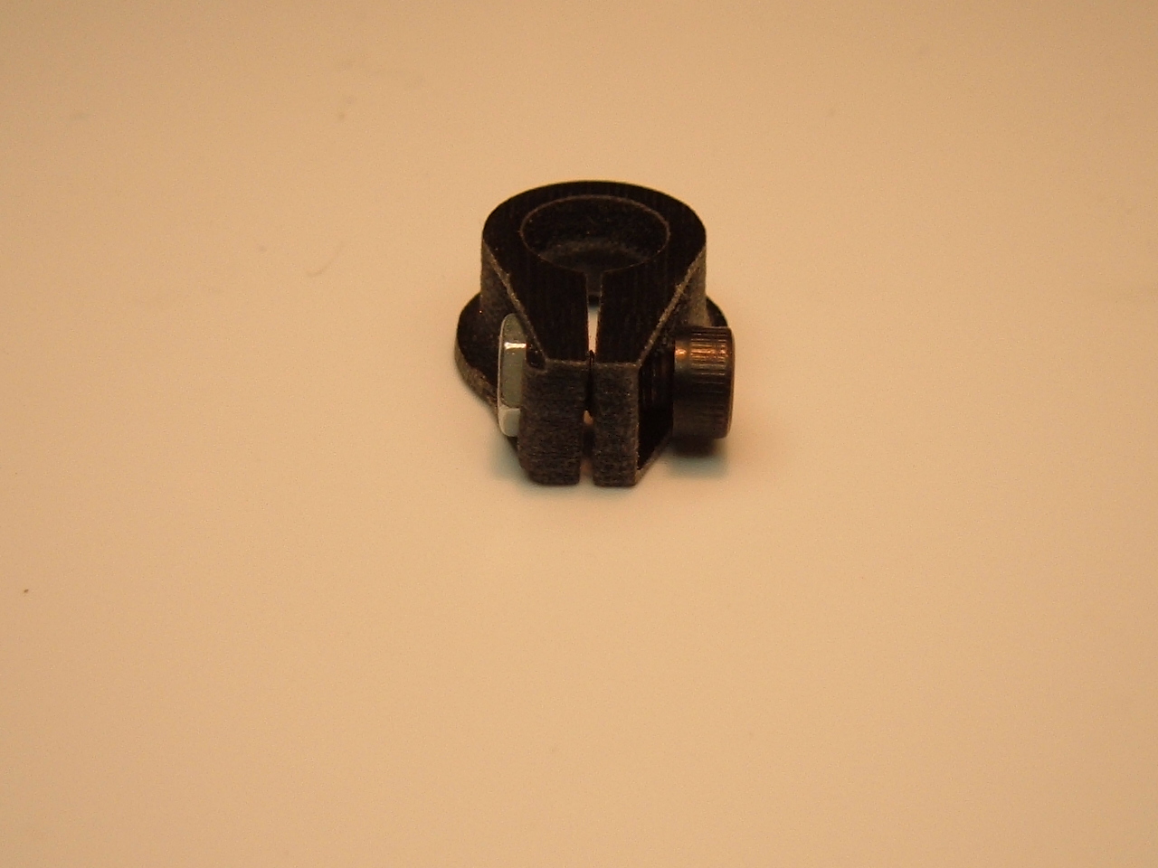

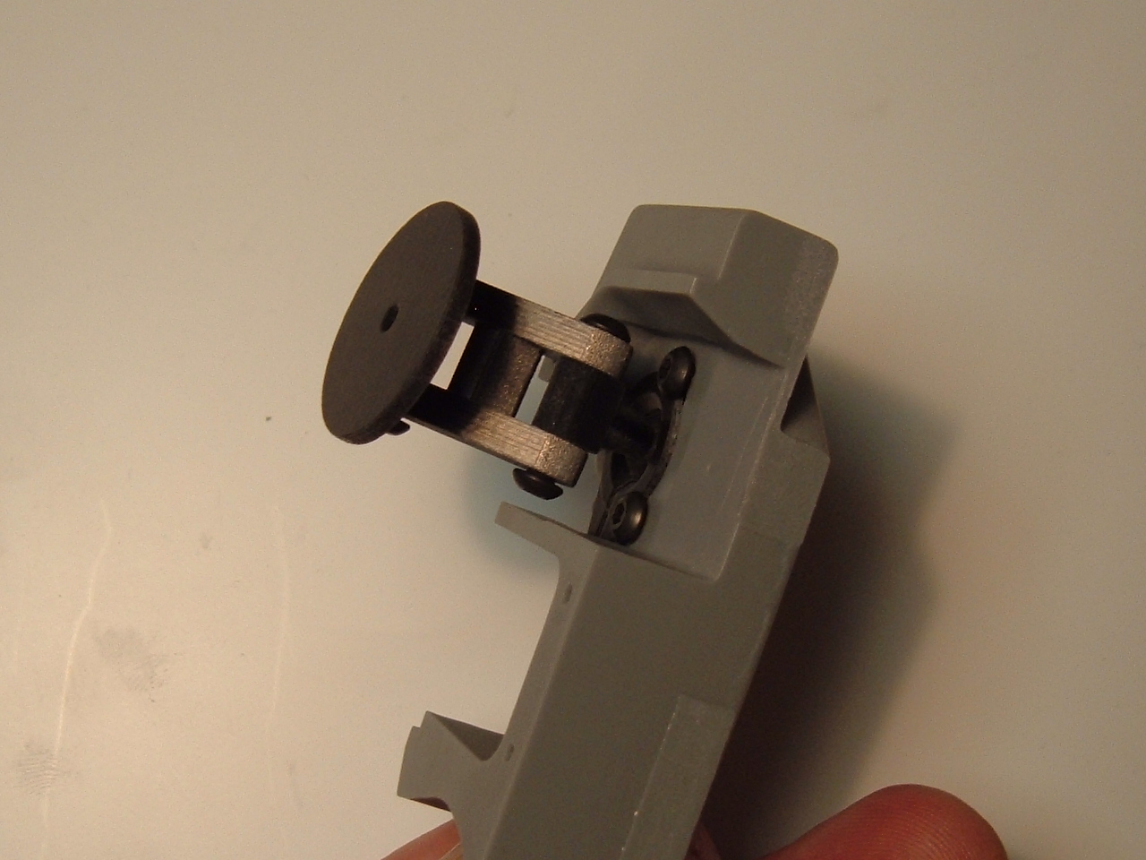

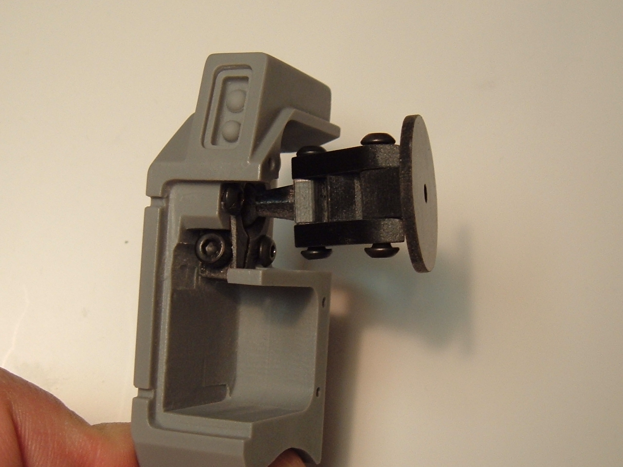

captain america Posted May 26, 2011 Author Posted May 26, 2011 Hello again, it's me: The Beast Master! I just thought I'd provide a mini-update with the new joint parts that I've been raving about lately. These are provided courtesy of fellow MWer Codam23, whose help and expertise have helped make this project possible. As I'm told, the parts I have are actually pre-production prototypes, and the material to be used for the final parts will actually be even stronger than what I have now, which are already ridiculously tough, especially considering that they were made in a 3D printer. Pics 1 and 2 show the joint parts in question, complete with 3mm alloy screws for optimal strength. Pic 1 shows the socket joint for the hip, while pic 2 shows the ankle joint (left) and hip hinge assembly (right.) Pics 3 and 4 show the assembled hip joint as it will fit into the thigh module. While complex, this elaborate setup was needed in order to not only allow the joint sufficient range of motion, but also configure the parts to allow them to line-up correctly when in fighter mode. Pics 5 and 6 show the same parts mated to the main body in both fighter and soldier modes, respectfully. While CNC technology was available a decade ago when the Legioss was being fabricated, the 3D printing technology certainly was not, and consequently, the parts would not only have been devastatingly expensive to make, but would have had to be made of aluminum, which I'm told is perhaps even a tad weaker than the new composite material, and the latter is much lighter. Quote
Ignacio Ocamica Posted May 26, 2011 Posted May 26, 2011 Those joints are unbelievable awesome. John's Legioss undoubtedly deserves the title of "Masterpiece"!!!!! Quote

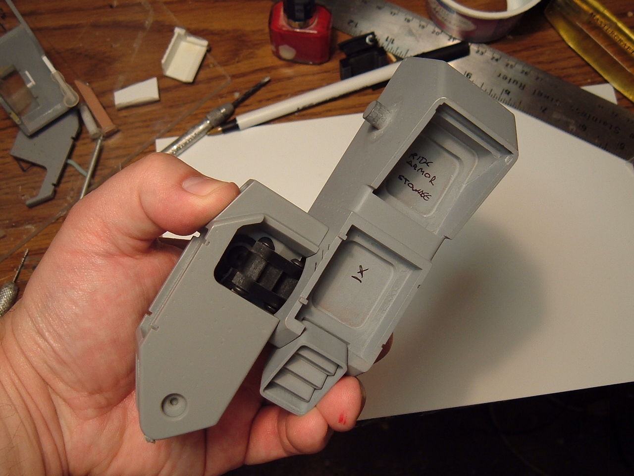

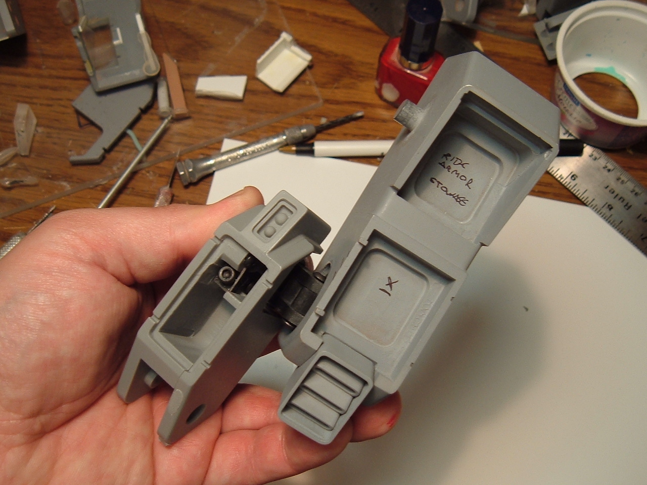

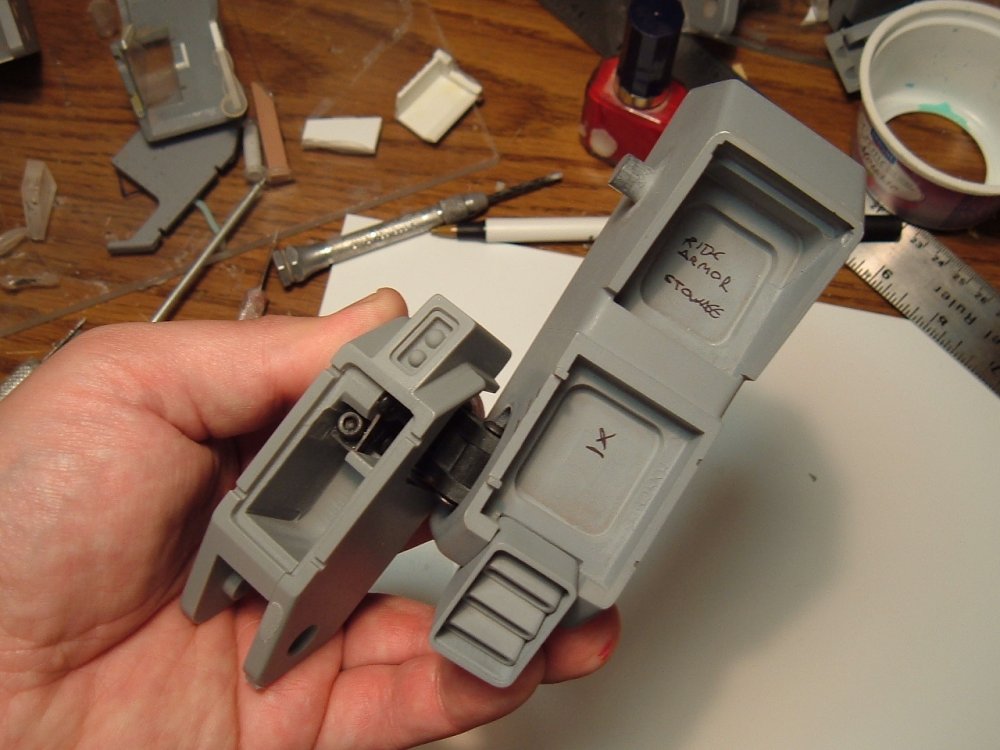

electric matthew Posted May 27, 2011 Posted May 27, 2011 Hey Capt, The new stuff looks great. The joints are coming along impressively. I look forward to seeing the next 2 installments (more pictures please). I just noticed something though. In picture 5 that you posted, the upper torso has "ride armor stowage" written in marker. Is this an indication of things to come? I would love to get a 7th installment featuring the pilot/ride armor + all the variant specific Legioss parts. Keep up the good work. Also, when do you next(4th) installment payment? Quote
captain america Posted May 27, 2011 Author Posted May 27, 2011 Hey Capt, The new stuff looks great. The joints are coming along impressively. I look forward to seeing the next 2 installments (more pictures please). I just noticed something though. In picture 5 that you posted, the upper torso has "ride armor stowage" written in marker. Is this an indication of things to come? I would love to get a 7th installment featuring the pilot/ride armor + all the variant specific Legioss parts. Keep up the good work. Also, when do you next(4th) installment payment? Good catch! In fact, the bottom of the ride-armor stowage compartment is visible under the chest thruster when the model is complete. No ride-armor will be included in the base kit, but dimensionally, the stowage compartment space was taken into consideration when I did the design. However, I feel that it's important to mention that for reasons of moldability and structural integrity, you can't actually put a ride-armor in the stowage location. When I did my re-design, I made it such that the ride-armor would have to be manually lifted from the compartment by the pilot or a technician: the compartment is accessed by removing the main viewing monitor inside the chest module. I did it this way because it seemed more realistic considering the space limitations on the fighter, and I also wanted to do away with any unnecessary gadgets; just makes for more stuff to break-down and cause problems in a real-world scenario. Payment 4 will be due June 1st; just about when i'll be shipping installment 3. Quote

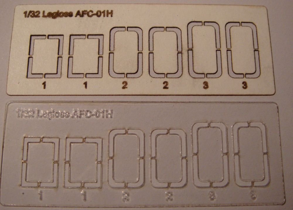

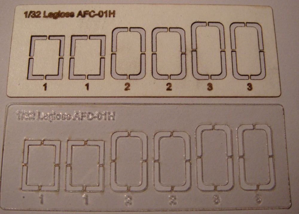

Valkyrie Posted June 24, 2011 Posted June 24, 2011 I was looking over the 'destructions' a couple days ago, and saw the clear lenses that it calls for to be cut out. And I got to thinking, that'd be a good application for my snazzy new laser engraving machine! And 30 minutes later, I had a lens cut for the hip that fit like a glove. Then I got to thinking, it be too much trouble to just make them for everyone, and make that my little contribution to the project! Since then, I think I might have gotten a little carried away with it... but I just finished the first prototype, and I'm pretty proud of the results Above, there's my test 'print' on a piece of cardstock, and below is it cut out of .015" PETG plastic. The edges look slightly scorched in the pic, probably because I had the power set too high. But I still have some time to refine it Quote
Myersjessee Posted June 24, 2011 Posted June 24, 2011 I was looking over the 'destructions' a couple days ago, and saw the clear lenses that it calls for to be cut out. And I got to thinking, that'd be a good application for my snazzy new laser engraving machine! And 30 minutes later, I had a lens cut for the hip that fit like a glove. Then I got to thinking, it be too much trouble to just make them for everyone, and make that my little contribution to the project! Since then, I think I might have gotten a little carried away with it... but I just finished the first prototype, and I'm pretty proud of the results Above, there's my test 'print' on a piece of cardstock, and below is it cut out of .015" PETG plastic. The edges look slightly scorched in the pic, probably because I had the power set too high. But I still have some time to refine it Wow!!! Awesome! Thanks V~ Quote
captain america Posted June 24, 2011 Author Posted June 24, 2011 I was looking over the 'destructions' a couple days ago, and saw the clear lenses that it calls for to be cut out. And I got to thinking, that'd be a good application for my snazzy new laser engraving machine! And 30 minutes later, I had a lens cut for the hip that fit like a glove. Then I got to thinking, it be too much trouble to just make them for everyone, and make that my little contribution to the project! Since then, I think I might have gotten a little carried away with it... but I just finished the first prototype, and I'm pretty proud of the results Above, there's my test 'print' on a piece of cardstock, and below is it cut out of .015" PETG plastic. The edges look slightly scorched in the pic, probably because I had the power set too high. But I still have some time to refine it Epic win!! Thank you so much for doing this, the parts look fantastic!! Gotta love it when the community pulls together like this, you guys are awesome! Quote

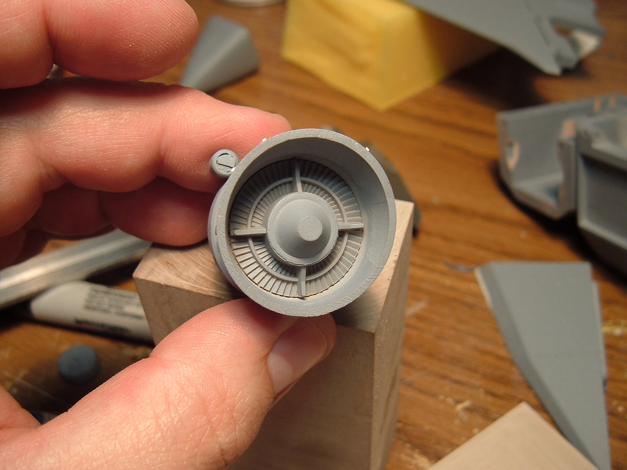

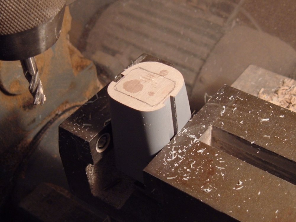

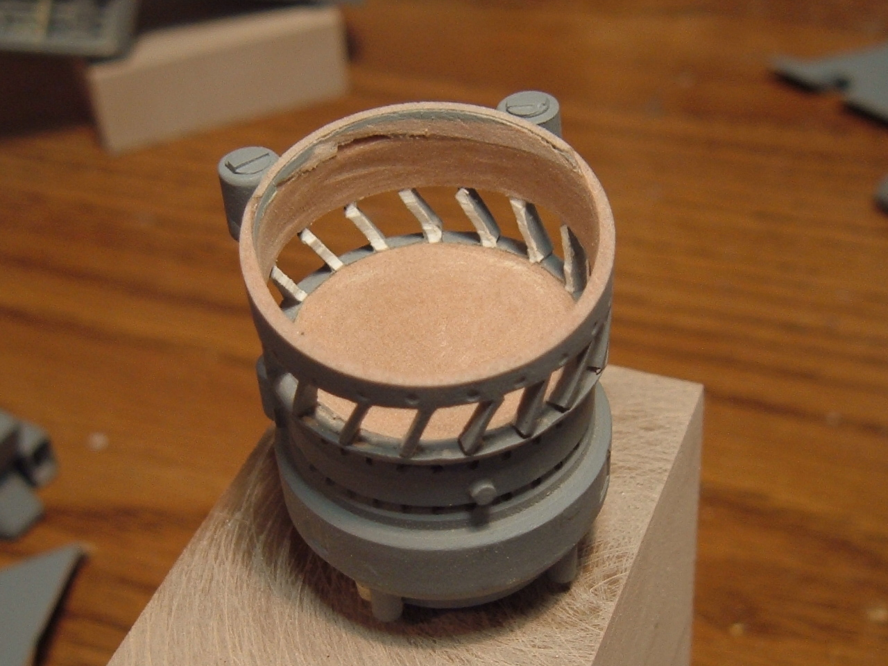

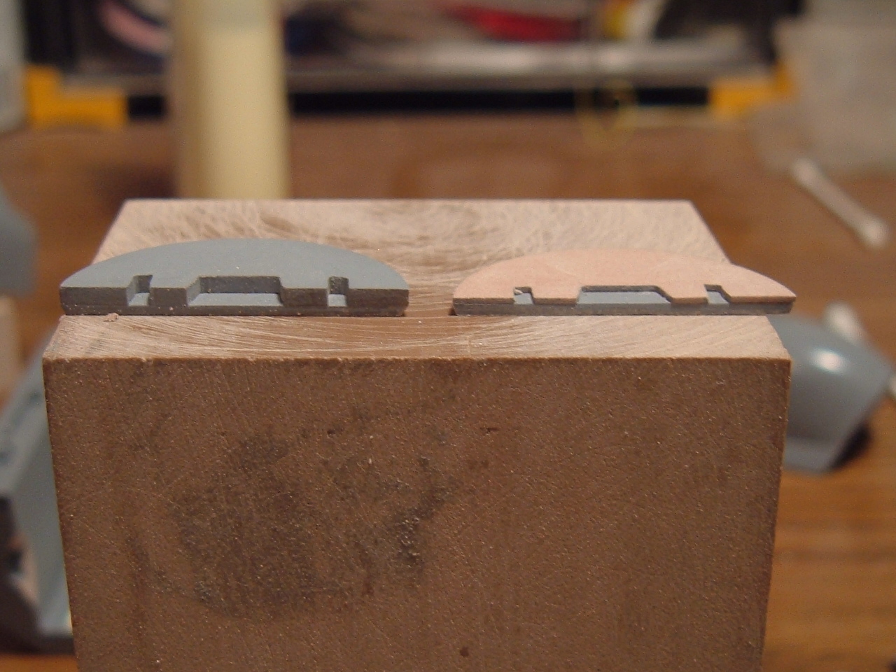

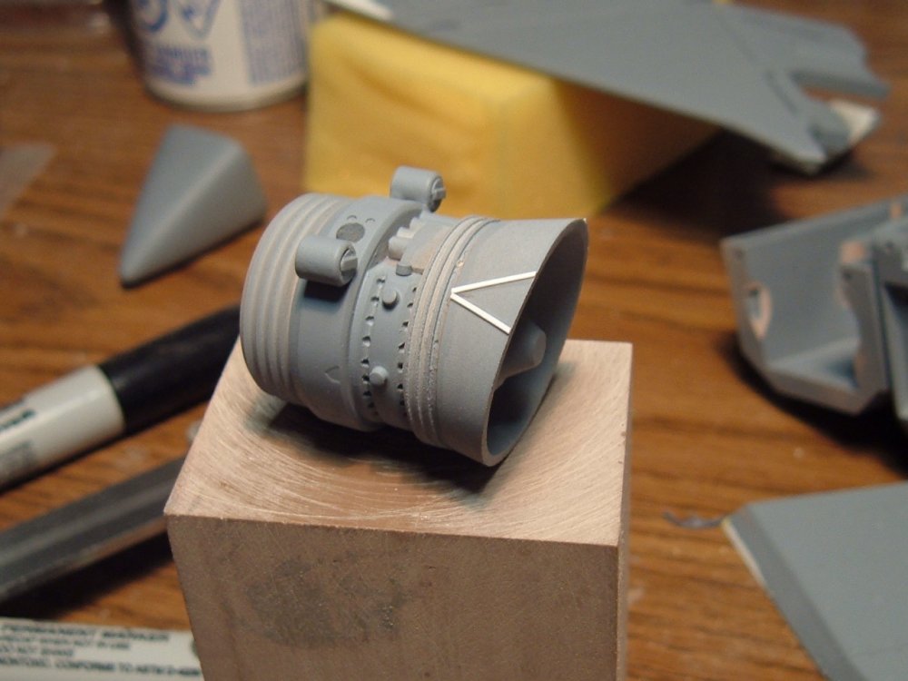

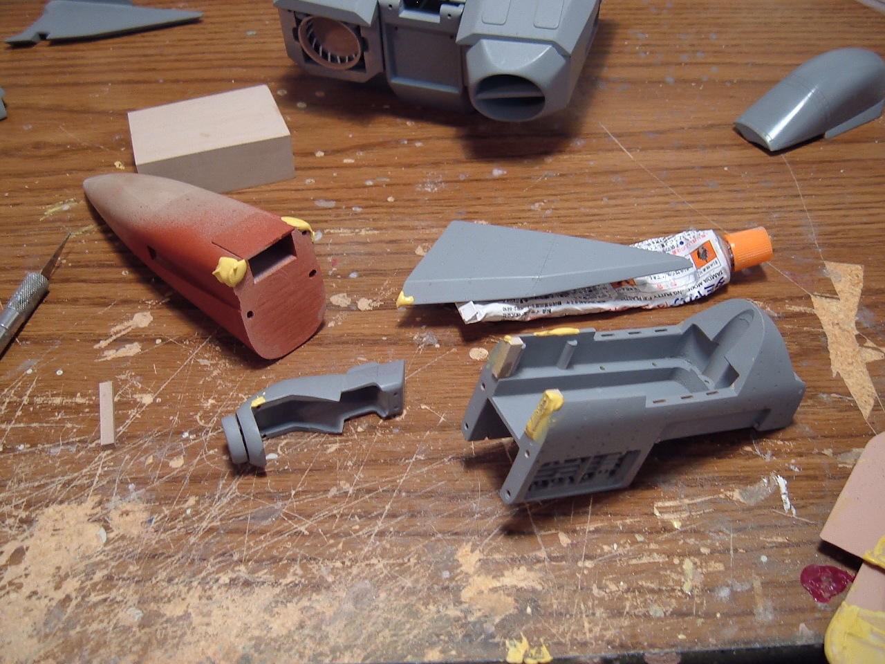

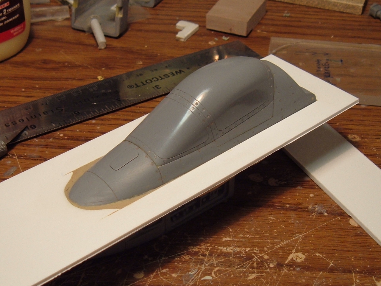

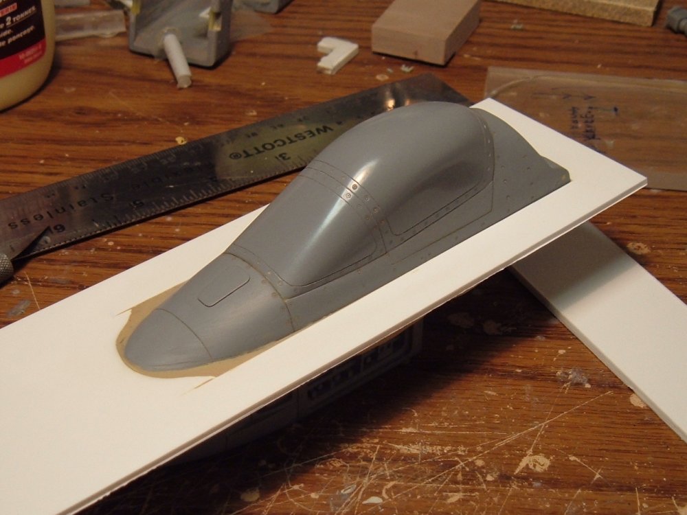

captain america Posted August 5, 2011 Author Posted August 5, 2011 Hi everyone! As promised, I've compiled a short update of my current goings-on with the Beast, which is coming along nicely. One of the realities of old masters that have been handled and moved around over the course of a decade is, unfortunately, damaged parts. This is due primarily to 2 things: one being the very fragile nature of modelling board, and the other being very sharp and delicate edges crafted from that delicate material. Therefore, before anything else, little chips and dings have to be repaired, as seen in pic 1. I find that Tamiya's Polyester Putty is great for this because it's very fine and cures harder than Bondo. Next, I wanted to re-work the compressor face for the engines/generators to better fit in the nacelles and allow all the parts to integrate harmoniously. It's something that I had neglected back in the day, and will now finally be addressed. Step one involves correcting both the diameter and deleting the "bullet" on the compressor face. This is where a lathe comes in handy Pic 3: On the left is the part before the mods, and on the right is the updated piece. More work is coming so as to integrate everything, but I'll get into that more in next week's update. Stay tuned! Quote
PetarB Posted August 6, 2011 Posted August 6, 2011 Is that Mori-Mori I see there? I thought you'd sworn off that stuff. Quote
captain america Posted August 6, 2011 Author Posted August 6, 2011 Is that Mori-Mori I see there? I thought you'd sworn off that stuff. Mori-Mori & Tamiya Polyester putty are pretty much the same product based on my experience; it's a fine grade of automotive polyester build putty and I love it to pieces! It's spendier, slower to harden and harder than Bondo, so I don't use it quite as frequently, but it's definitely a top-notch product. See, you can get a similar grade putty from a local automotive finishing supply provider, but the putty comes in this huge-a$$ tin, and what happens is that since I'm only using a small amount at a time, the stuff starts to harden in the tin (exposure to air from constantly opening the container) and goes bad before I'm half-way through. Therefore, even though a tube of Tamiya is 18 bucks, it's still cheaper than a huge tin that will mostly end up being wasted. Quote

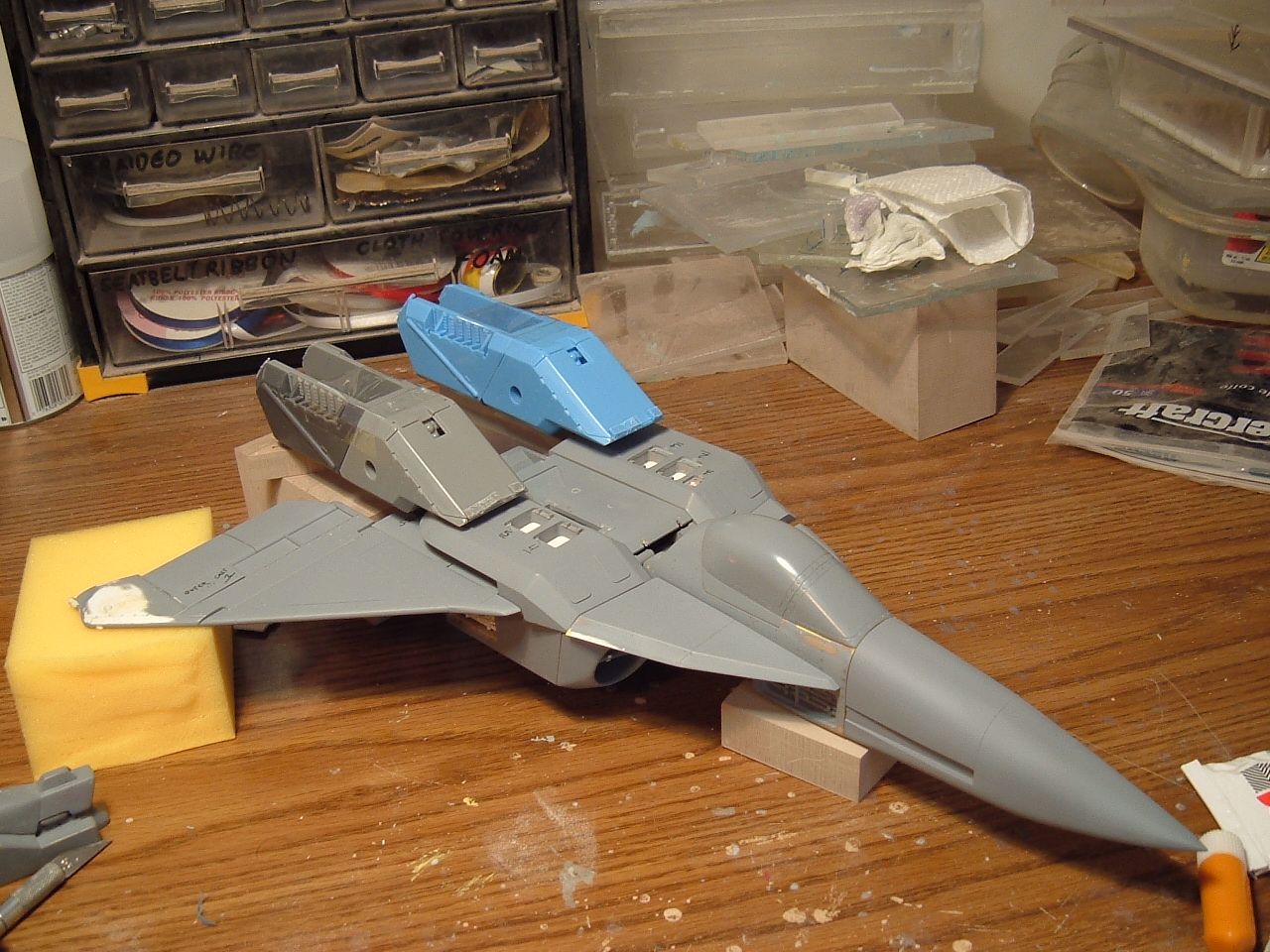

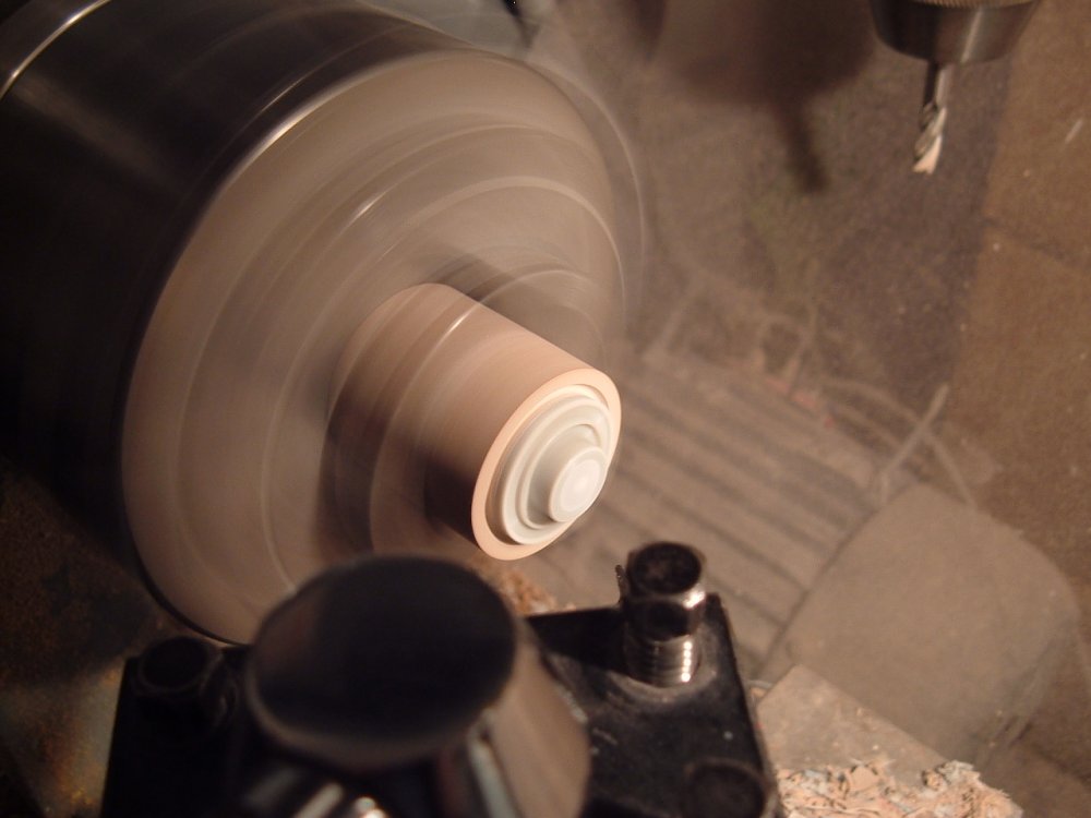

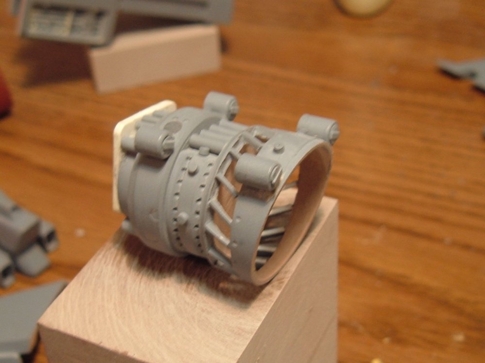

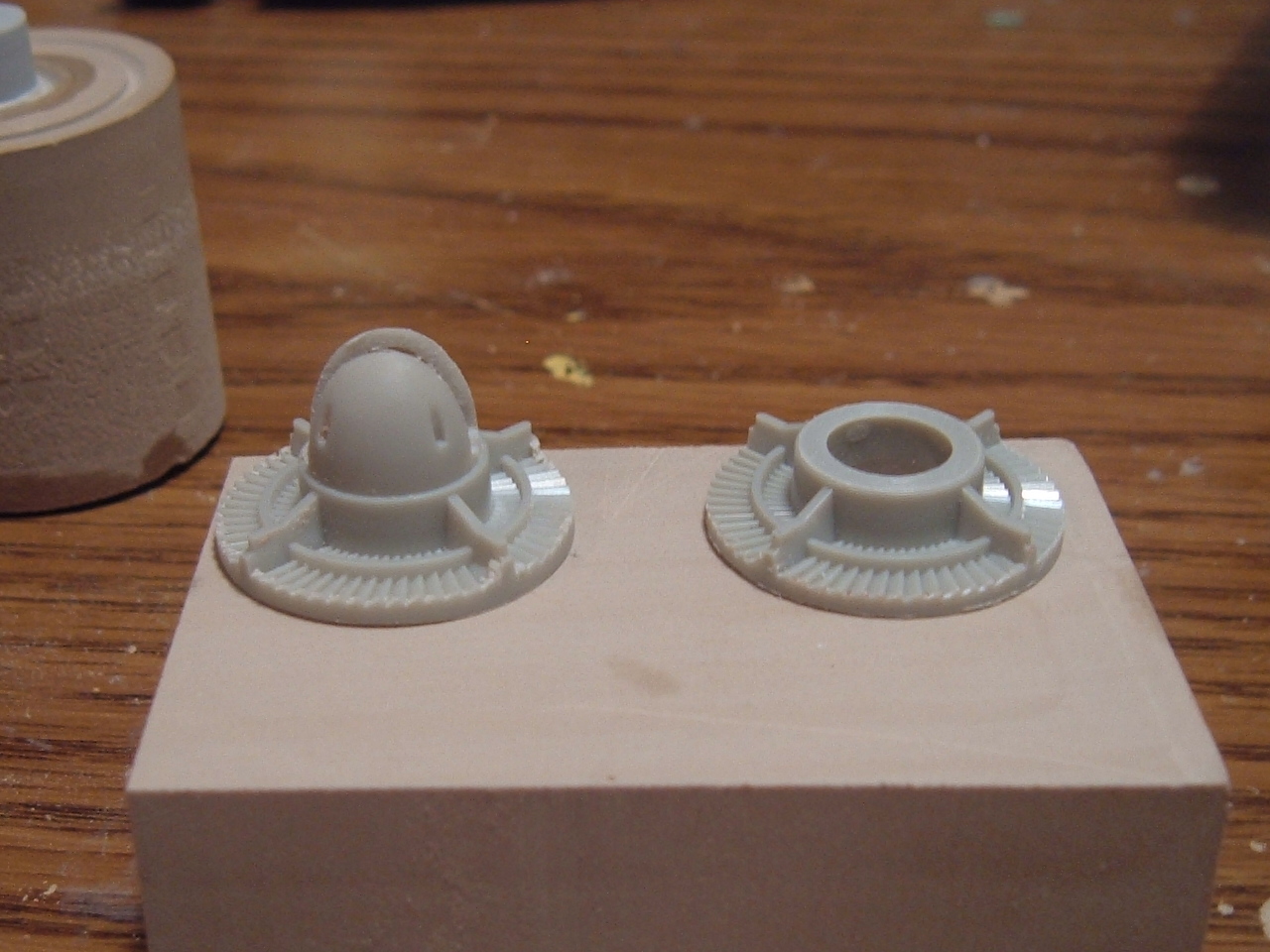

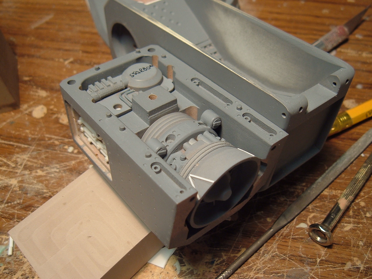

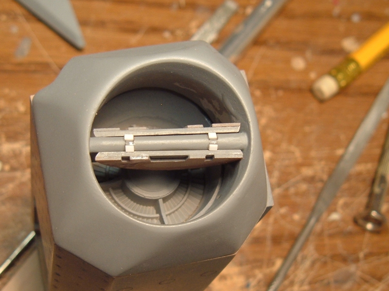

captain america Posted August 12, 2011 Author Posted August 12, 2011 Hi guys! Welcome to the latest installment of Building The Perfect BEAST. Today we're going to take a look at parts for the 2 last installments; namely the main body and the nosecone. Though normally I prefer to concentrate on one segment at a time, these two sets of parts are such that they must mate very carefully with each other when building, so alterations to one part inevitably spills-over and affects other parts: a simple principle that translates into more tedious and time-consuming work. In pics 1 and 2, we see the old-style JG-97M power generator, as it was made almost 10 years ago. I was never quite happy with the look of it, and wanted something that was a little more realistic in appearance, not to mention that as it is in the pics, it would be a complete casting nightmare. Therefore, with a bit of clever machining and fabrication... …I end up with something much nicer (pics 3 and 4.) The new powerplant is more along the lines of what I'd envisioned, and sports re-tooled fan blades and no bleed-slots; much more efficient looking IMHO. Pic 5 shows the engine in its chest housing. Since the entire mouth/intake of the powerplant was re-tooled, I wanted to ensure that there were no fit problems with the unit. Pic 7a: the movable intake doors. THe one on the left is the old version, while on the right is the 2.0 version. Pic 6: The engine/housing and intake doors. This shows the parts in flight configuration. Pic 7: intake doors in closed (armoured) position. In my head, I'd envisioned the doors to serve 3 purposes: one to protect the engines from Foreign Object Damage while taxiing on rough runways, two, to serve as intake ramps to control the high-speed airflow to the compressor face in high-speed flight, and third as armored shutters in heavy-duty engagements. Pic 8: the new forward fuselage/radar tray about to be machined. The nose section took quite a while to shape adequately, since I really wanted to nail the shape that would allow the fighter to really come alive. The rough version I'd shown previously was too bulbous and really didn't work with the rest of the fighter. Pic 9: the new nosecone tested for fit and aesthetics. All I can say is wow! The old 1.0 nosecone really doesn't hold a candle to the new one. Be warned though, the Fighter mode should be over 20 inches in length: it has presence!! Well, that's it for this update. I should have all the masters ready to begin mold prep by next week--stay tuned! Quote
