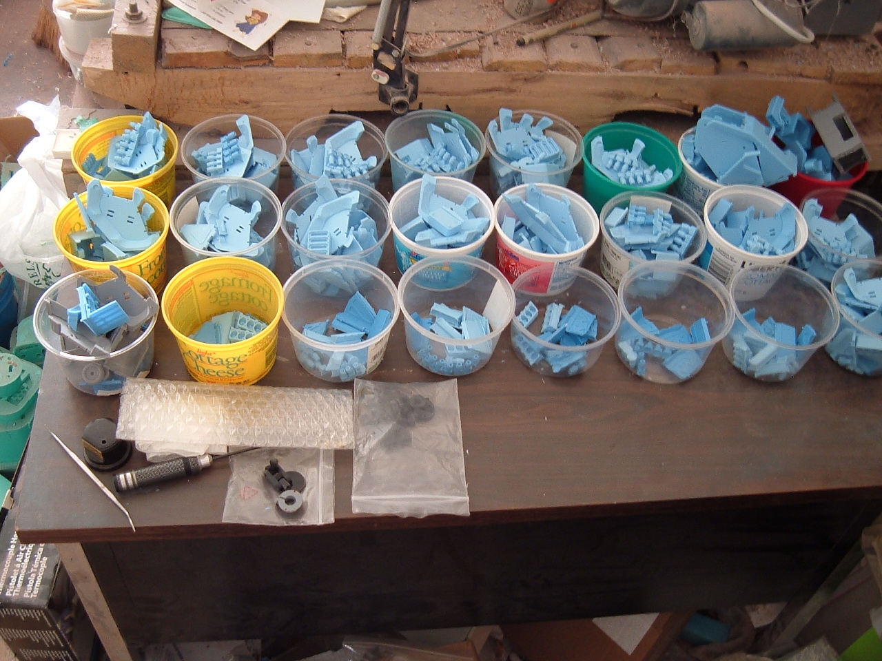

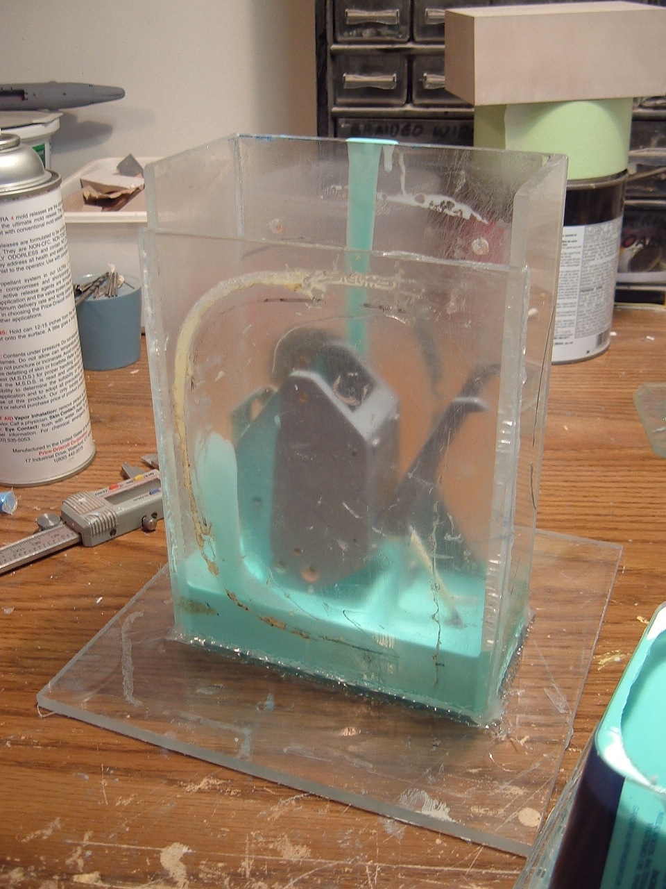

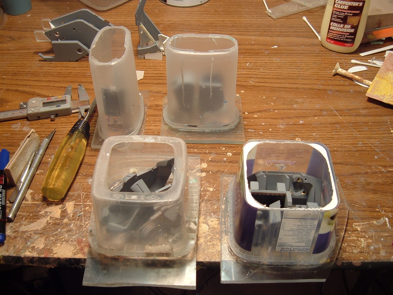

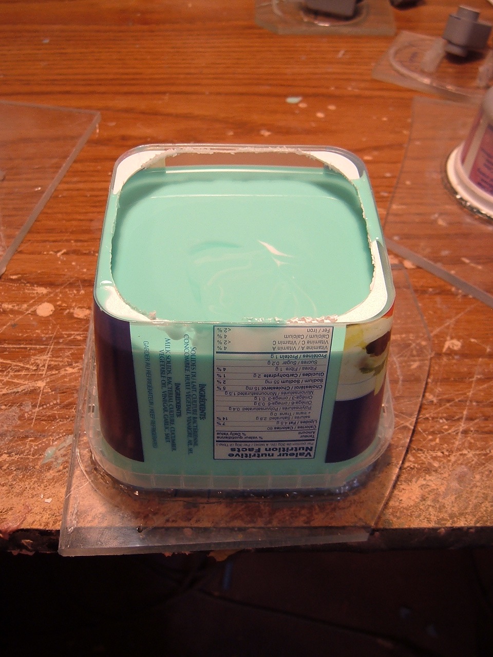

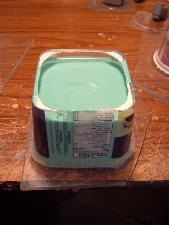

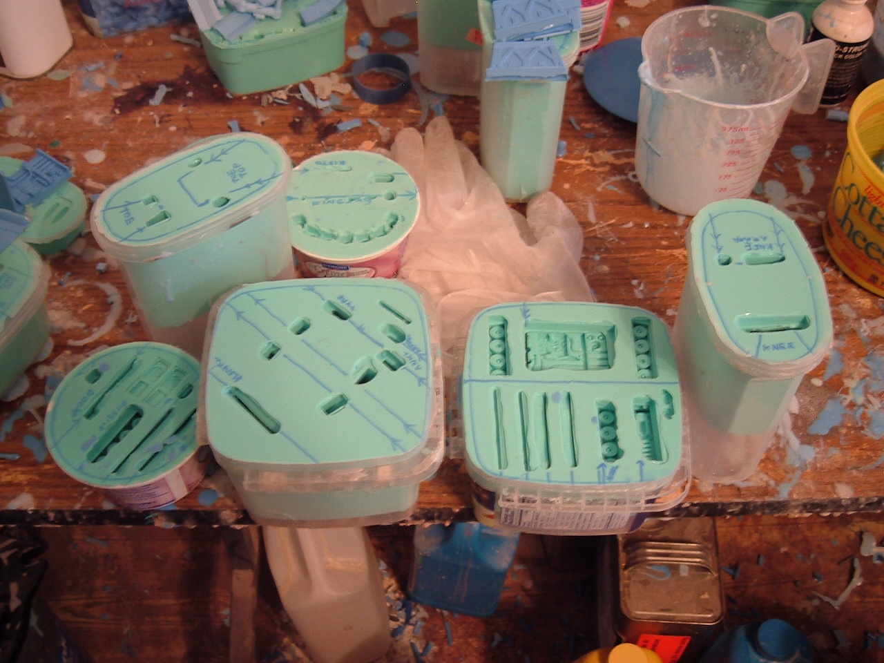

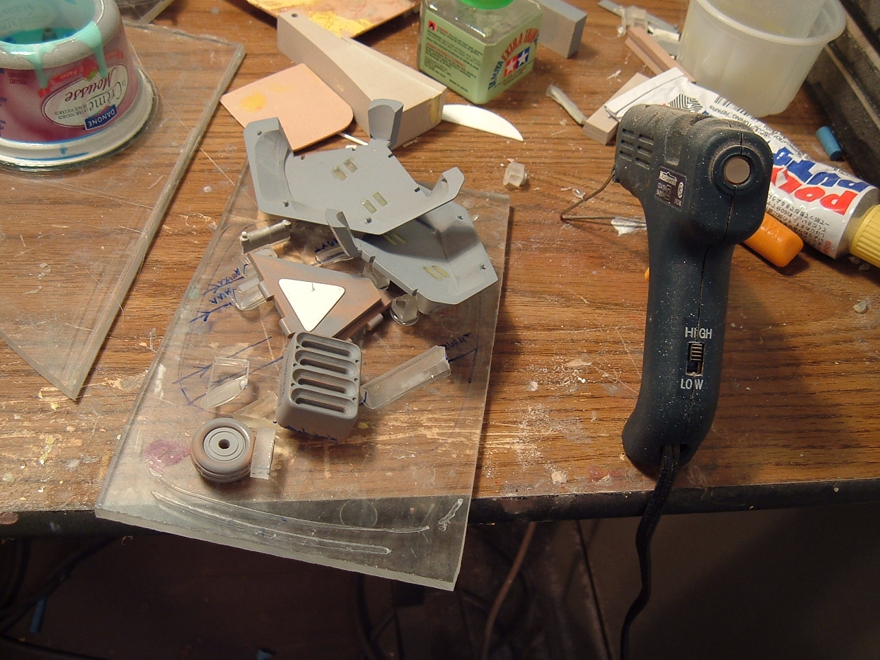

captain america Posted April 6, 2011 Author Posted April 6, 2011 Hi everyone! As you may or may not have seen from my previous post, the next segment of the Legioss is now underway. As such, I figured I'd offer a cursory glance at the mold-making process. Pic 1: using a hot glue gun, I proceed to glue runners to the parts and then glue the runners to a base made from acrylic; I like this method as the material's transparency allows you to more easily visualize the part and vital resin flow characteristics. Once things are set to my liking, I glue the mold box over the parts, once again using hot glue. Pics 2 and 3: this is my vacuum degassing setup; I use an industrial vacuum pump to suck the air out of my newly-mixed silicone rubber. The pump can pull a little over 29 inches of vacuum, but the chamber's (just an old paint tank) lid design is such that I only get 27 inches of vacuum realistically. No worries though, that's quite sufficient for my needs. Pic 4: A newly-degassed batch of green rubber goo! Don't let those few bubbles atop the mixture fool you, these will break as soon as I begin to pour the mix into the mold. Speaking of pouring… Pics 5 and 6 show 2 mold boxes in different stages of pour. The first is actually custom-made with acrylic, as some parts are just too large/awkward for me to use tupperware containers. Pic 7: a series of parts extracted from a mold. These will need a once-over, and any damage to the part will need to be repaired. It's rare, but it does happen. Pic 8: the finished moulds! I generally let these air-out for at least 48 hours prior to using them to make sure than any residual ammonia has evaporated. I should have some test-shot pictures by next week; I'm also testing the prototype ball-joints that I received from Codam23. Stay tuned! Quote
CoryHolmes Posted April 6, 2011 Posted April 6, 2011 What's the writing on the moulds in that last pic? Also, I love your super-sophisticated mould-boxes Quote
captain america Posted April 6, 2011 Author Posted April 6, 2011 What's the writing on the moulds in that last pic? Also, I love your super-sophisticated mould-boxes Sophisticated mold boxes are for suckahs!! I use a Sharpie to mark cut lines and also indicate what part is in the rubber block; the writing on the plexiglass imprints onto the rubber so that I have a basic guide to extract the parts as cleanly as possible. Quote
Model-Junkie Posted April 7, 2011 Posted April 7, 2011 Thanks for the latest photos and descriptions. I always find it fascinating to see how artists create their work and not always have to use fancy tools / equipment. Is there a certain way to cut / extract the parts from the molds? Are the molds only good for one use or are you able to get a few pulls from them? Quote
captain america Posted April 7, 2011 Author Posted April 7, 2011 "Is there a certain way to cut / extract the parts from the molds? " -Yes, very, very carefully! "Are the molds only good for one use or are you able to get a few pulls from them?" -The life of a mold depends on a whole bunch of factors; some molds die after fewer than a dozen pulls, while I've had others last well past 50. It's always a bit of a crapshoot. Quote

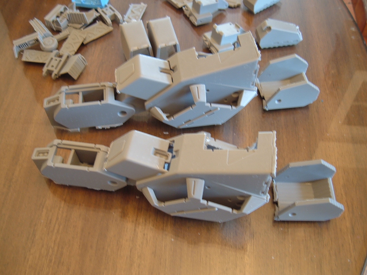

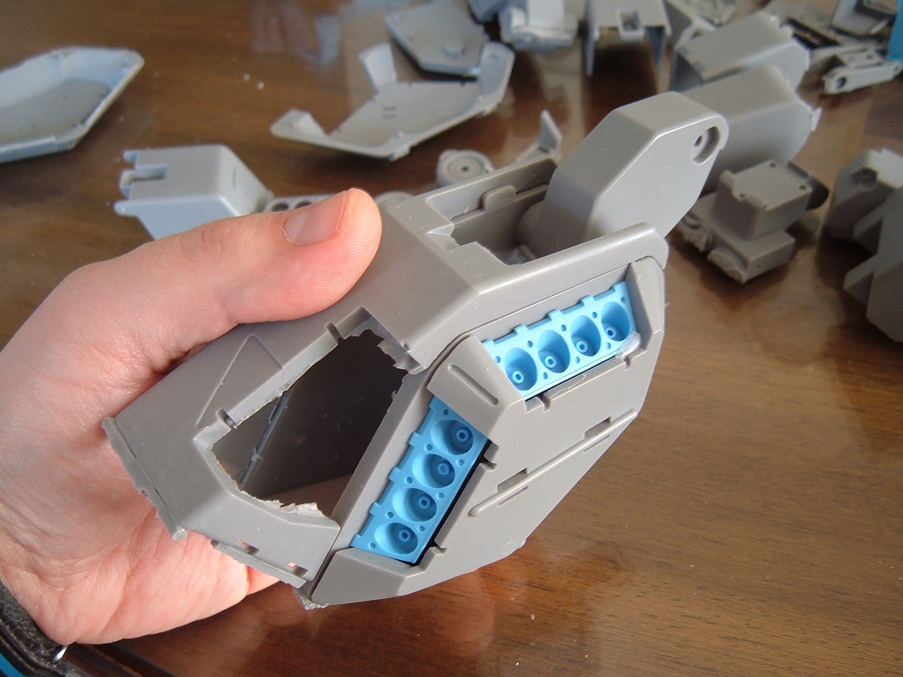

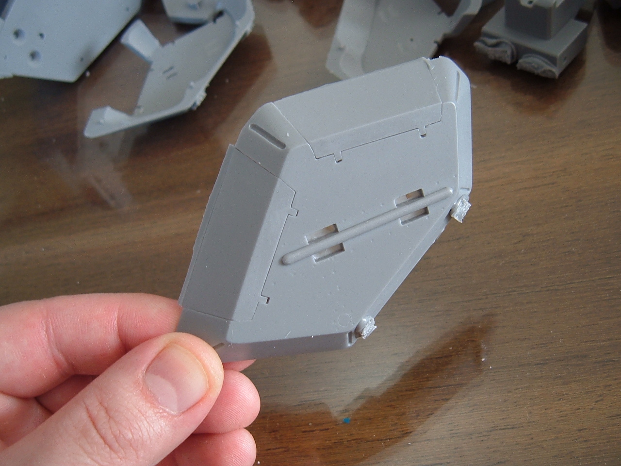

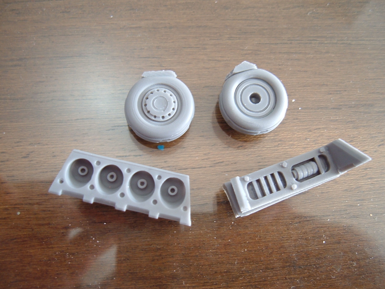

captain america Posted April 19, 2011 Author Posted April 19, 2011 Hi guys. I took a few random pictures of the castings I have so far, which are coming along excellently well. I should have some news on the landing gear by week's end, and hopefully on the joints as well. Needless to say, I'm also looking forward to a quiet moment when I can start mocking-up my parts and experience, for the first time, my own creation with all its limbs without the use of Photoshop Quote
Ignacio Ocamica Posted April 19, 2011 Posted April 19, 2011 Wow, I'm speechless!!! It's better than perfect, and it's going to be huge It's my holy grail kit materialized. Thanks again for making this possible. Quote

505thAirborne Posted April 21, 2011 Posted April 21, 2011 Hi guys. I took a few random pictures of the castings I have so far, which are coming along excellently well. I should have some news on the landing gear by week's end, and hopefully on the joints as well. Needless to say, I'm also looking forward to a quiet moment when I can start mocking-up my parts and experience, for the first time, my own creation with all its limbs without the use of Photoshop Your a Madman Captain!! Keep it up!! Quote
