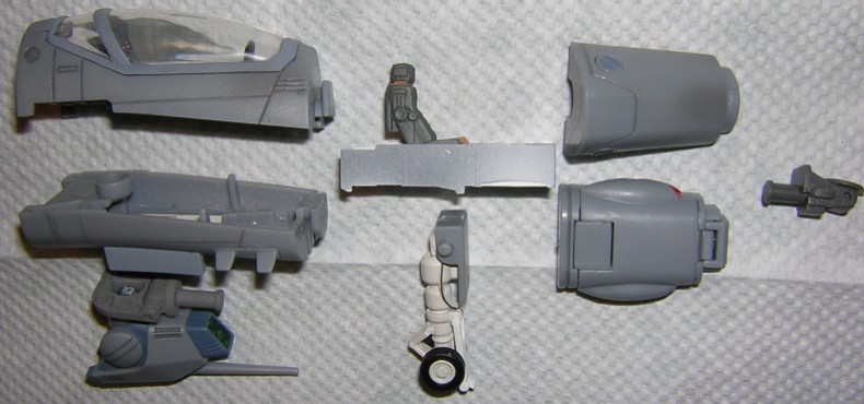

Valkyrie Hunter D Posted August 25, 2003 Posted August 25, 2003 Once the screws are removed, the parts shown below will easily come apart. Be careful of the pegs inside the hatch assembly (the hinged pegs used to cover up the holes for the leg posts), they may fall out. Quote

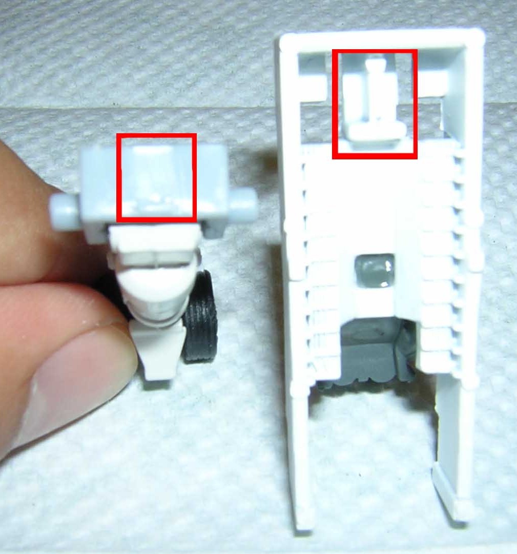

Valkyrie Hunter D Posted August 25, 2003 Posted August 25, 2003 The parts that need to be looked at are the wheel assembly and the underside of the pilot seat. The areas highlighted in red are the surfaces that could be sanded to reduce the gap in the nose when the wheels are down. It’s just a matter of sanding the right amount to attain the smallest gap possible (or none at all) and get enough grip for the wheels to stay in place when lowered. The cockpit area can be assembled separately to see if the sanded amount is just right. If it’s not enough, just take it apart and repeat. One of my 1/48s actually had the opposite problem: the front wheels were too loose when lowered. It could support the valk just fine, but rolling it forward would make it take a nose dive. Anyways, I hope this helps. Quote
wm cheng Posted August 25, 2003 Author Posted August 25, 2003 Hey thanks so much for the step-by-step. This is great!! I am only worried that right now, my landing gear is a bit loose (with no modification). When I push it to roll it, the forward gear pivots back a bit - slightly, I am worried that if I eliminate the seam, then that makes my existing problem worst - especially when the fast packs come out and the bird is always nose down slightly adding to the problem. Is there an alternative solution that will even tighten up the landing gear lock-down and prevent the diagonal seam for splitting? Thanks though. (I will definitely be referring to this thread often) Quote
EXO Posted August 25, 2003 Posted August 25, 2003 Yikes! That's too scary. You can either have the gap or end up with a loose landing gear. Thanks anyway, VHD. Quote
Valkyrie Hunter D Posted August 26, 2003 Posted August 26, 2003 Is there an alternative solution that will even tighten up the landing gear lock-down and prevent the diagonal seam for splitting? Yeah, I wish Yamato chose a better method of keeping the front wheels locked. I've been thinking of a way to add some bumps on the front landing gear door that could lock into some dimples carved into the sides of the wheel well once the gear has been lowered. BTW, only my DYRL valks have the nose seam prob, the low-vis' seam is neglegible. Quote
