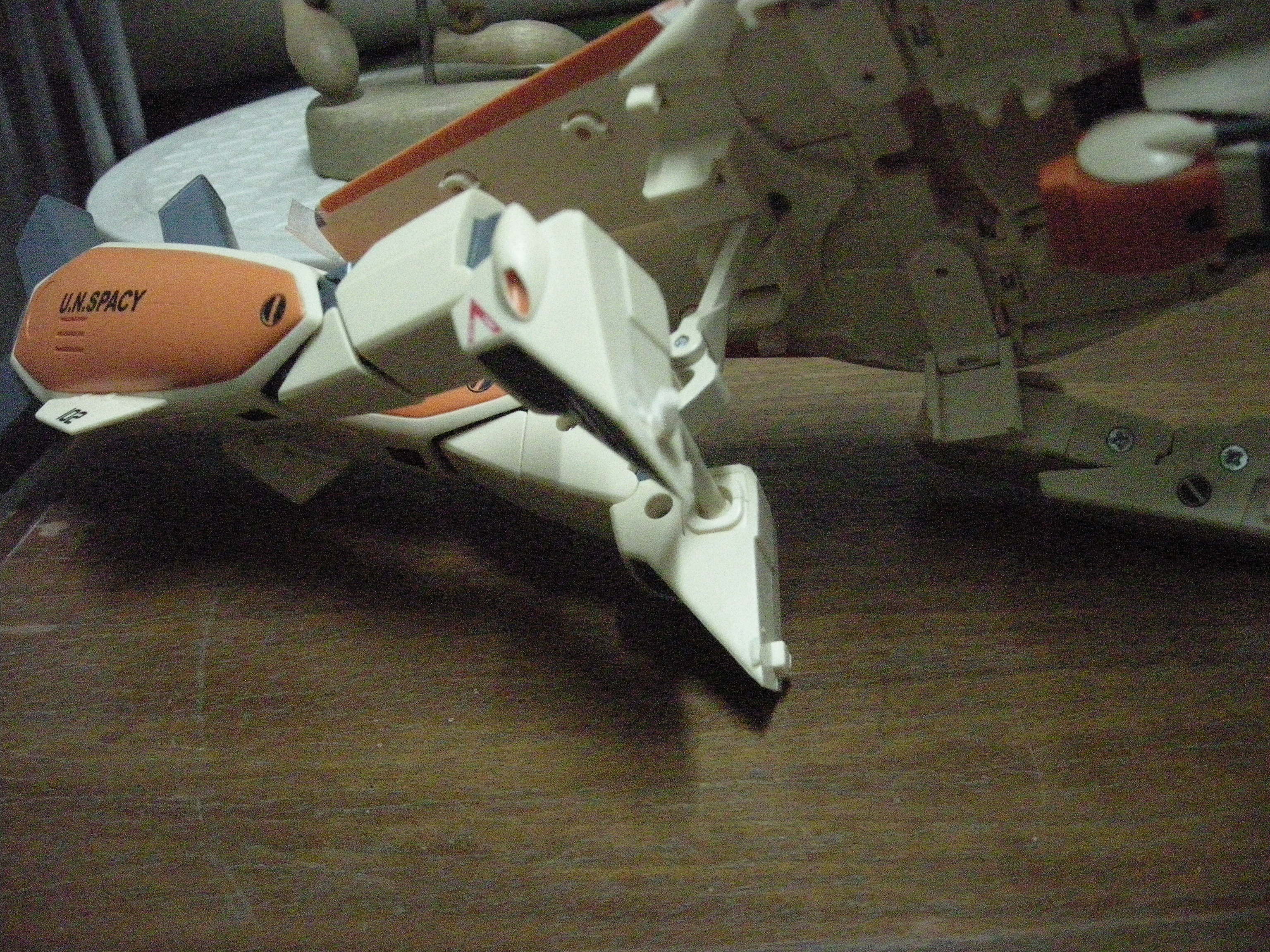

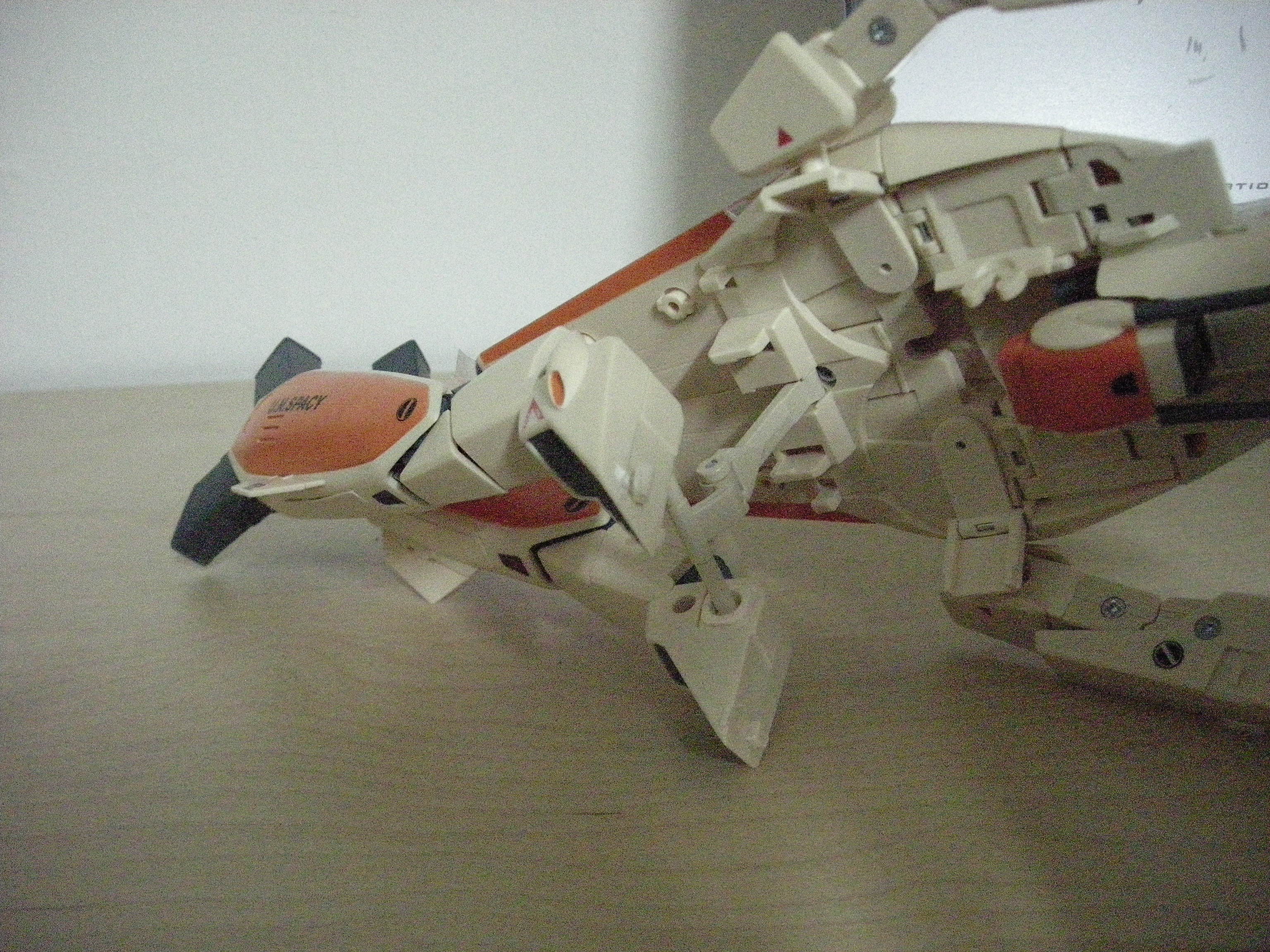

About to go get some batteries for my digital camera later. Tomorrow, I'll post a copy of the pics I plan to send to HLJ for a replacement right leg for the VF-1D.

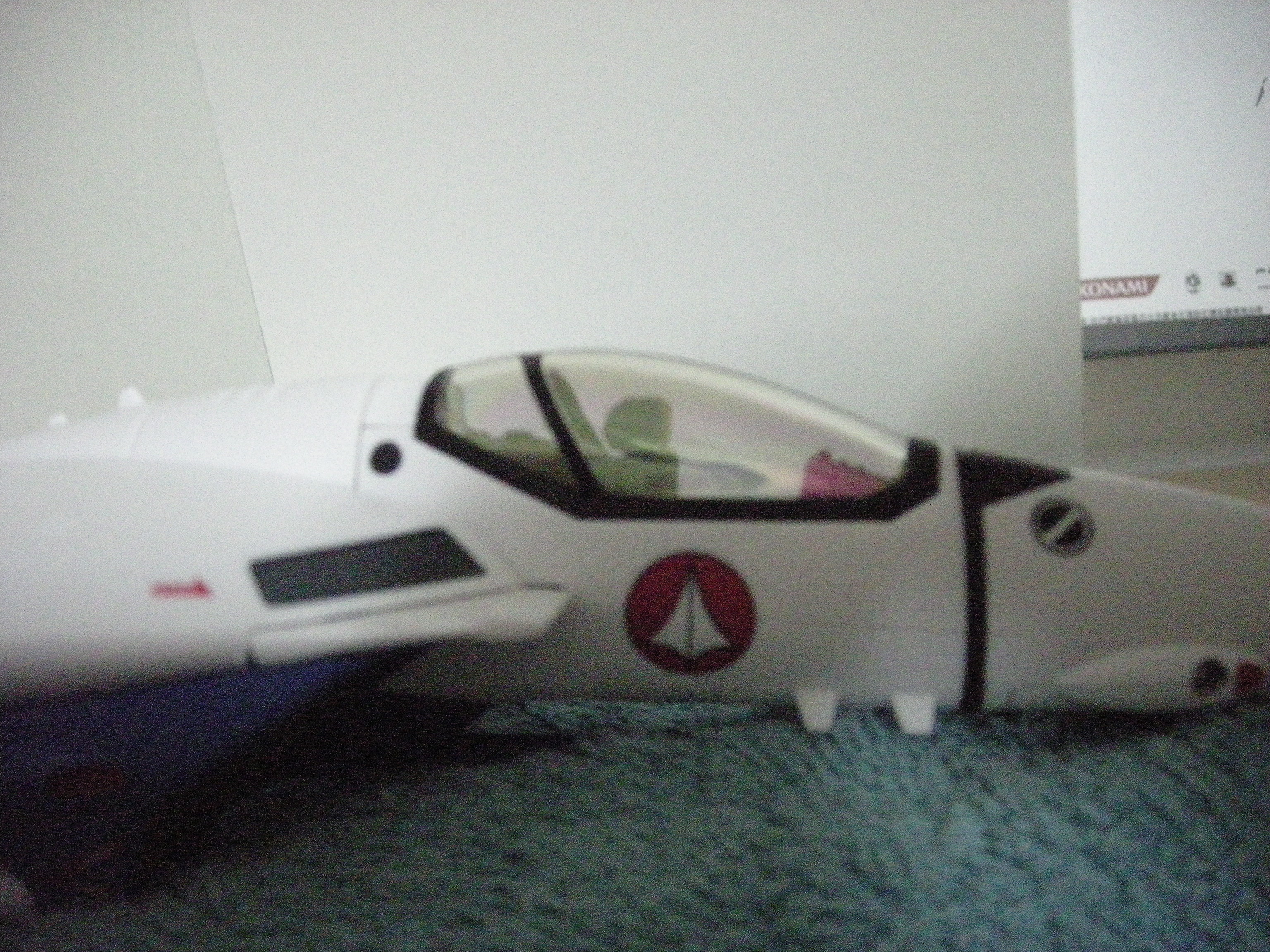

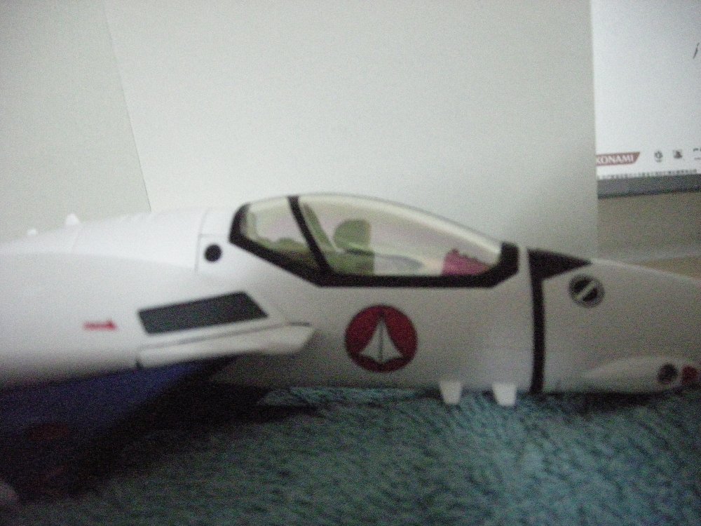

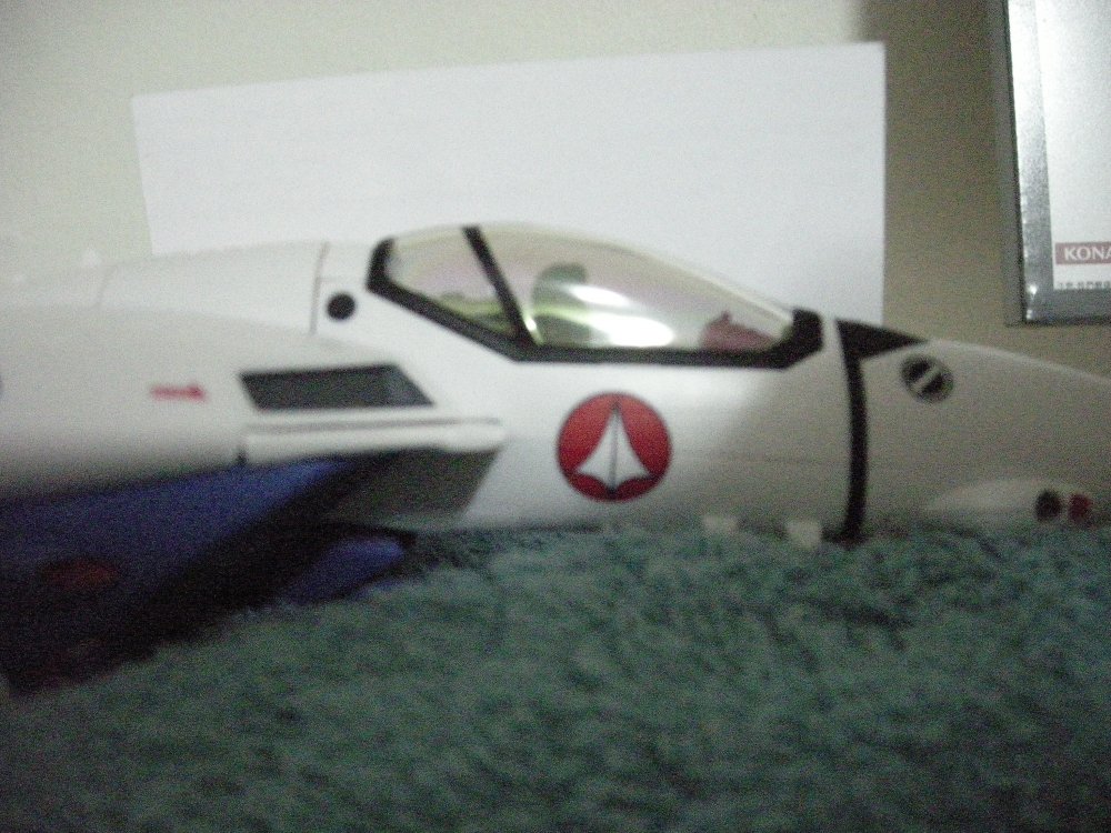

After taking several photos with a proper camera, it seems that the -1D's beige/tan is indeed the same tone as the promo pics. I guess it just looks darker in person. I gladly announce that the yellowed color was just my mistake.
One problem down, two to go.
As for the cockpit canopy, the yellowed tint is visible on the photos I've attached to this post (sorry about the rather grainy pics; the pics were taken indoors at night under fluorescent lighting, using a shitty first gen digital camera). There's only a slight tint, but you can still see it.
The pics of the broken peg are kind of blurred, but it's the best I can do, as the camera I had doesn't handle closeups too well. You might want to load the image on a new tab and have it resized to fit the browser for a clearer view.
Edited by GU-11
Hard to tell from your pics but it looks like that's just the rainbow tint coating they put on (which can look yellow in certain light)
I certainly hope you're right. I think I'll try it with the TV Max's canopy and see if it exhibits the same yellowish tint.

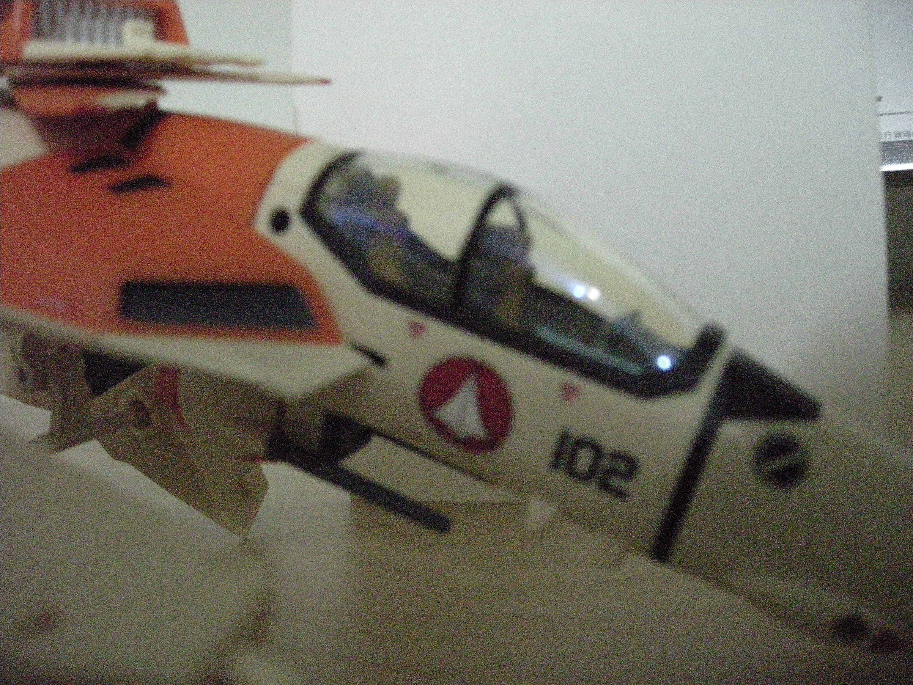

I agree. I just opened up my VF-1D today and I couldn't discern whether or not the canopy had yellowed or if it was just the rainbow coating. I will tell you that the beige coloring on the Valk certainly looks different depending on the lighting. When I first saw it I thought mine was experiencing the "jaundice" affect. Still haven't had a chance to transform her yet. I'll keep you all posted. Still waiting on those comparison pictures from GU-11, since the VF-1D is the only Valk I have opened with the rainbow coating.

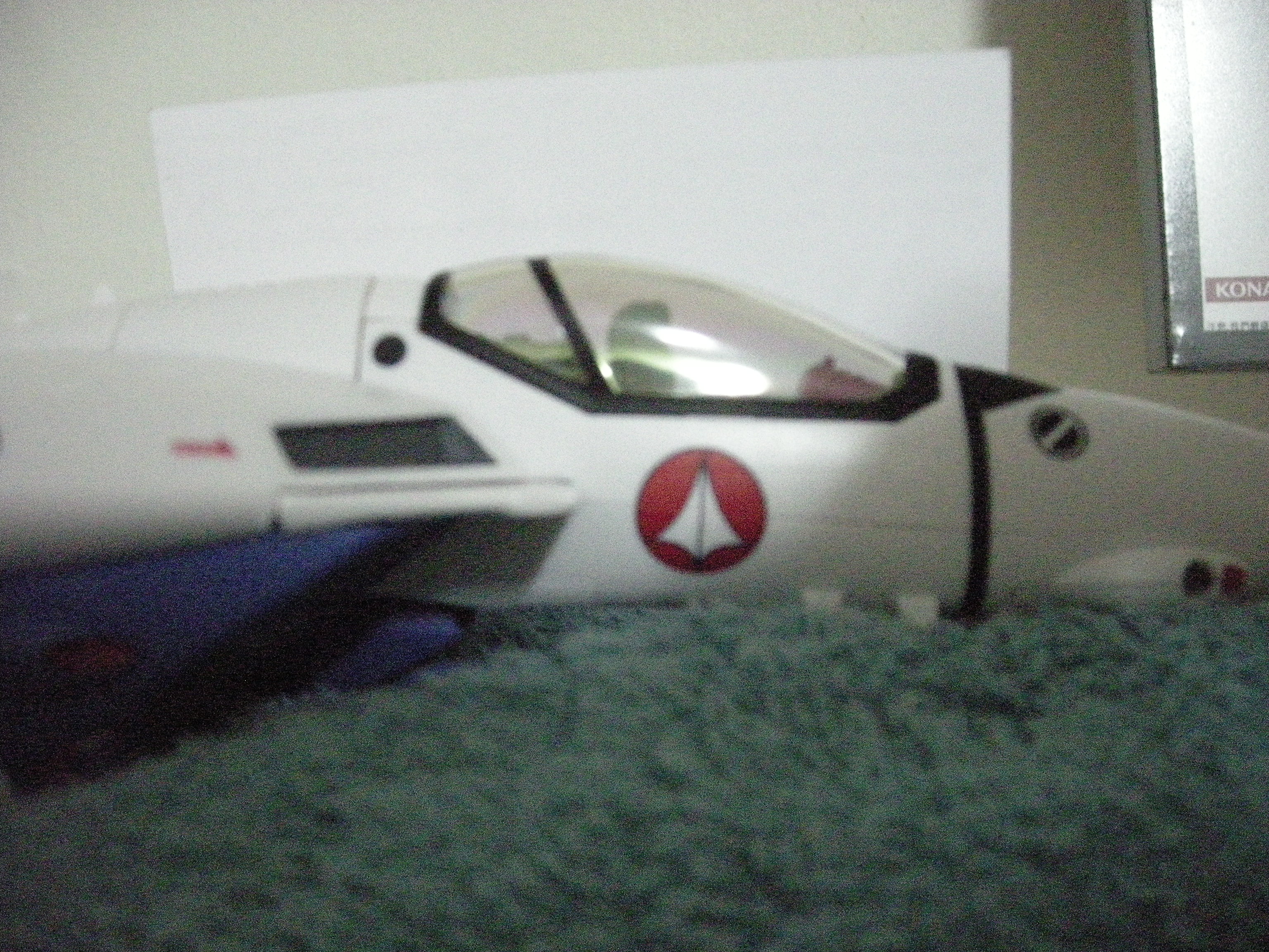

Here are a couple of comparison pics using the TV VF-1A Max. Same camera, same settings.
I don't know if it's just me, but it looks as if the yellow is more obvious on the VF-1D's canopy than on the TV Max's.
