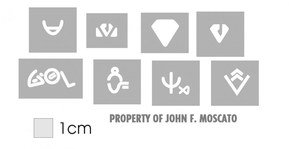

neptunesurvey Posted June 12, 2010 Posted June 12, 2010 Good start. I stopped using the dremel for sanding when I sanded way to much off a couple of times. Are you planning on making it with the cockpit open or just in flight like I did with mine in the workbench section page 34? I painted my Zentraedi/Zentran emblems on. With the first Regult release Capt made some emblems that you had to printout and are too scale. I cut out the shape and taped them on to the right spots and painted. I attached the image for you. Quote
