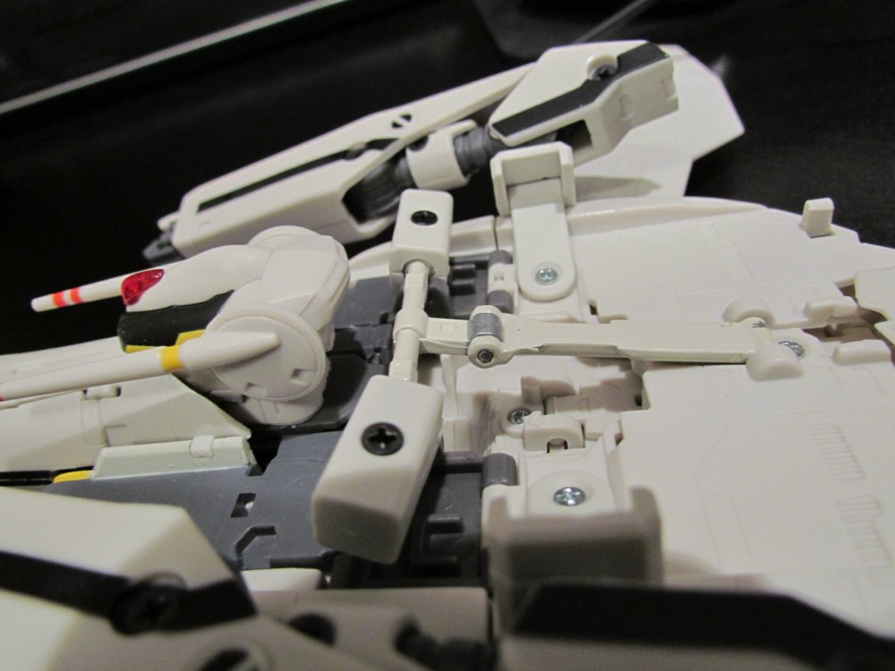

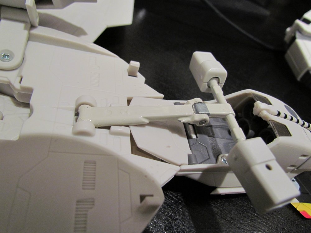

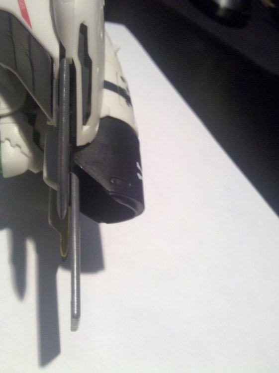

boyarque Posted October 14, 2010 Posted October 14, 2010 (edited) Just to share; pic of the metal bar which has been installed backwards on my VF-0S and the rather stubborn end of the metal: Edited October 14, 2010 by boyarque Quote
firmpulse Posted October 14, 2010 Posted October 14, 2010 Just to share; pic of the metal bar which has been installed backwards on my VF-0S and the rather stubborn end of the metal: god, that suuuuuuuuuuucks you had to do all that Quote
Chronocidal Posted October 14, 2010 Posted October 14, 2010 (edited) Looks to me like that metal swing bar should pop right out of the backplate, but I guess the stress to get it out might be too much. It might just depend on rotating the bar to a specific angle, actually. It looks really possible from your photos, but I haven't tried taking mine apart that far, so I don't know how tightly that upper bar is lodged in that slot. Edited October 14, 2010 by Chronocidal Quote
boyarque Posted October 15, 2010 Posted October 15, 2010 Looks to me like that metal swing bar should pop right out of the backplate, but I guess the stress to get it out might be too much. It might just depend on rotating the bar to a specific angle, actually. It looks really possible from your photos, but I haven't tried taking mine apart that far, so I don't know how tightly that upper bar is lodged in that slot. trust me, it's virgin-tight. I dunno, maybe it was designed for the bar to pop in, not out. I tried pushing straight up, I tried twist and shout..errr..I mean, push....the only thing I accomplish is a nasty, creaking sound and stress marks around the centre plastic. But I believe u can drill holes at the sides and push the pin out, except I dun have any drills with me... Quote
firmpulse Posted October 15, 2010 Posted October 15, 2010 trust me, it's virgin-tight. I dunno, maybe it was designed for the bar to pop in, not out. I tried pushing straight up, I tried twist and shout..errr..I mean, push....the only thing I accomplish is a nasty, creaking sound and stress marks around the centre plastic. But I believe u can drill holes at the sides and push the pin out, except I dun have any drills with me... did you try using a drop of teflon or small dab of wd40? it can really help with friction. seems like you've tried everything but thought i'd throw it out there. maybe buy a tiny brass punch (generally used in gunsmithing) and a small vice. then try tapping it out. just another idea... Quote

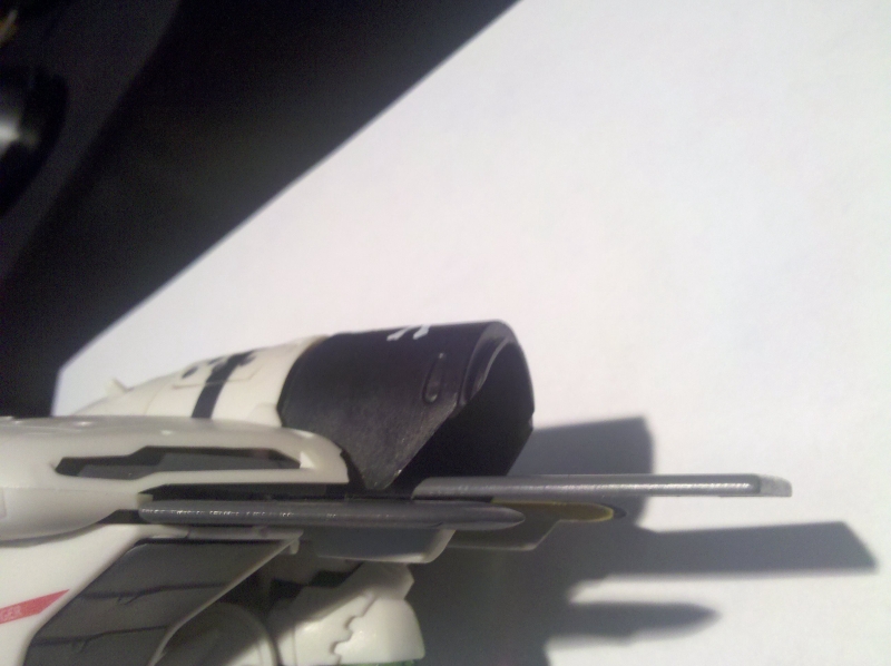

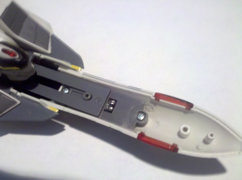

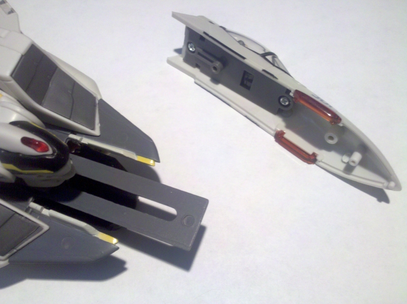

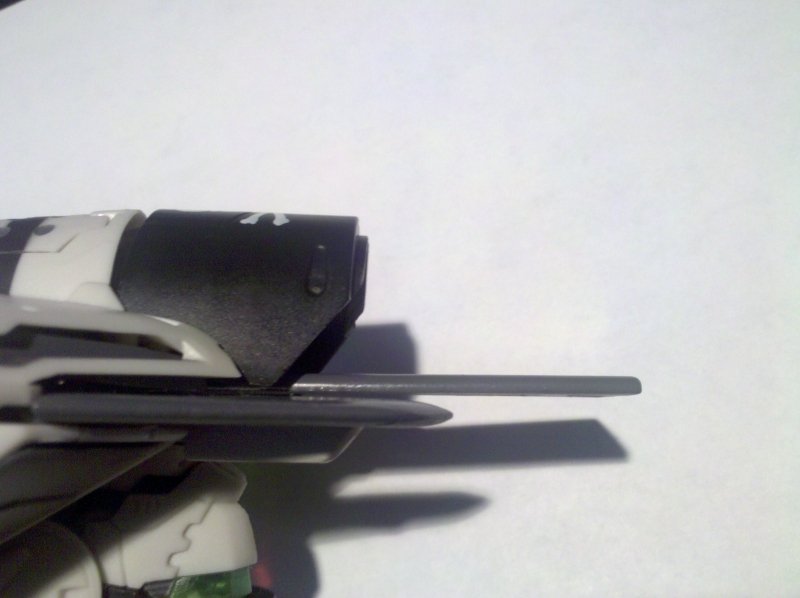

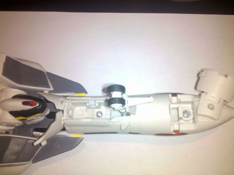

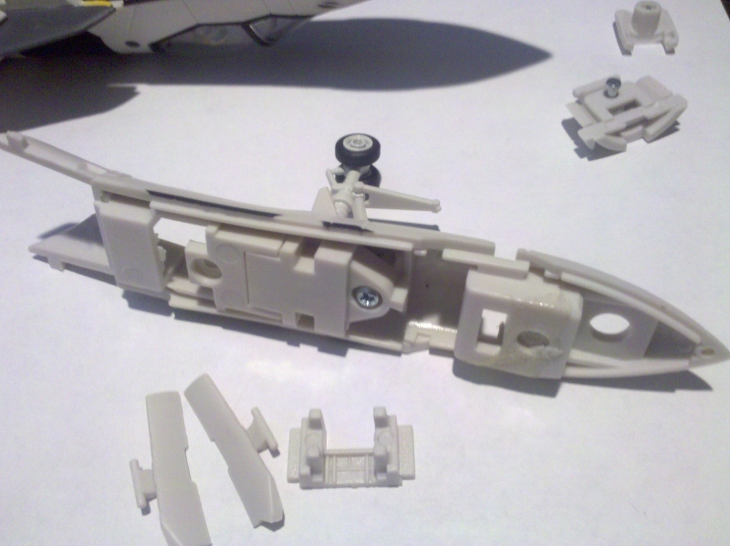

m0n5t3r Posted October 21, 2010 Posted October 21, 2010 finally got off my a$$ and did this fix for my 0A. works like a charm. Ok, here's a series of pictures showing what I did to fix my nose droop. Unfortunately I don't have shots from before I changed it, but it's pretty easy to understand what I changed. The first step is taking apart the nose, and hoping Yamato didn't glue it shut. There are three screws you'll need to get to. The first is a small screw that holds down the door that covers the hip bar mount, which removes that door and lets you get to the second screw, which actually attaches to the upper half of the nose. The third screw is inside the landing gear well. After you take out those screws, the nose should come apart with a little bit of pulling. Mine had some adhesive tape near the front that you can see, but it wasn't hard to pull loose. The nose is pretty sturdy, so as long as you're careful I don't think this will damage anything. Note, the insert that holds the main gear doors is just held in by pressure, so it, and the doors, will fall out when you pull the nose apart. Be careful to keep track of the pieces. As a side note, if your front gear is difficult to pull down, this is the perfect opportunity to fix this. The front gear is held into the nose by the screw you see here, and loosening it a little will lessen the tension on the gear. I don't recall how much I turned the screw, but I was able to make the gear easier to extend, while still holding decently in the down position. What you're left with now is the following. It's easier to remove the upper nose with the plane partially transformed, since it moves the chest plate away from the nose, but I was able to get the nose out without taking it out of fighter mode. You really just need to pop the large peg out of the slot in the metal plate, but it's easier to do once the nose is slid back from the front a little. What I did was pull the cockpit shield out from under the lip at the back of the nose, and raise the chest just enough to slip the nose back under it a little. The nose peg popped out of the metal plate without much trouble after that. Now, you've got this: When I first took this thing apart, the large center plate with the track cut out of the center was quite bent. It was bent down far enough that it reached down between the two plates ahead of the intakes. What I did was just gently bend it back up with my fingertips, pressing against the center plate with my thumbs while pulling on the intake plates with my other fingers. Make sure to press evenly on both sides at once so the plate doesn't warp sideways. After a little gentle pressure, the plate should be aligned to look like this: The center metal plate should be parallel to the outer plates, so everything slides in a straight line when moving to battroid mode. Now just a word of caution if you do this... I'm not sure how strong the metal used in that plate is. Die-cast is obviously stronger than plastic, but it's also rather brittle in terms of metal. Don't force the plate to bend, and be very gentle. I probably held my thumbs against the plate pressing it upwards for a good few minutes before it was level. It doesn't take a lot of force, but it does take patience. I really don't want to hear that anyone snapped that plate, and ruined their VF-0. That being said, it really helps the nose stay in place well, and after I did it, I could detach the legs entirely and the nose still stayed pretty level, with almost no gap behind the cockpit shield. Good luck! Quote
