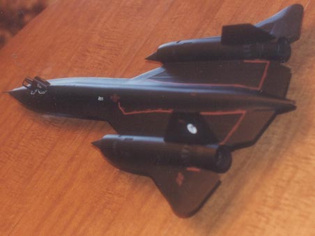

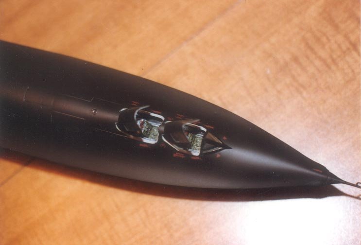

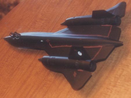

B-52 GUNNER Posted November 24, 2003 Posted November 24, 2003 Here is a couple photos of the before referred to SR-71 that I sanded off the raised panel lines. I hope this will sway you to sanding off the panel lines and not rescribing. If you were to reduce the size of the real aircraft to 1/72 scale the panel lines would be very fine to the point that they would almost be invisible. I would understand rescribing the lines if it were 1/32 or 1/24 but 1/48 and 1/72 would be way to fine. Consider this, If you had a 1/4 inch gap between the panels of an aircraft at 1/72 scale that gap would be 0.003472 of an inch wide. In other words Way to fine to bother scribing. Hope this helps Scot Quote
