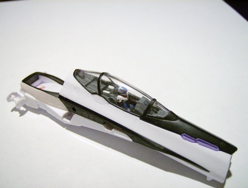

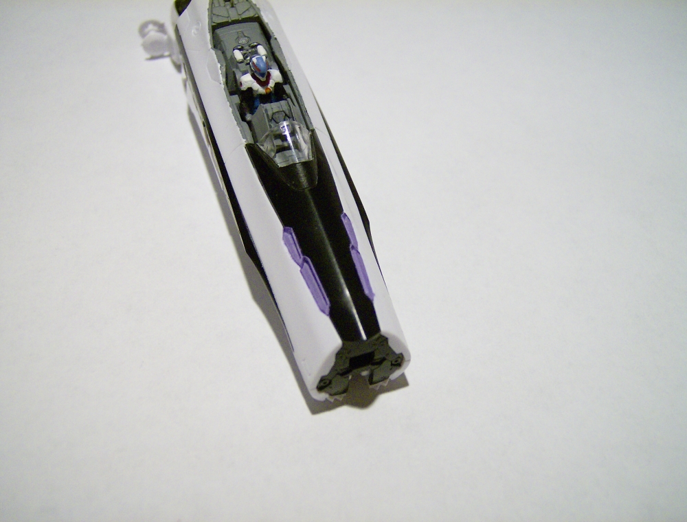

Chronocidal Posted May 13, 2010 Author Posted May 13, 2010 (edited) Before I forget, just a quick note... I'm trying to avoid buying any specific colors for this build up. Most of the more complex colors I've been mixing on the fly (the lavender for the sensors, Alto's suit colors, etc.) because I don't need to paint anything very large. In many cases though, I'm going to be using rough approximations using colors I already have handy, which include a lot of military standard colors. Now, next up, the canopy frame. Most aircraft I know have canopy frames that match the cockpit interior on the inside, so I figured I'd just make a dual layer paint job on the canopy. For the first coat, I used dark gull grey, the same color I used on the cockpit interior. That made it so the canopy frame appears gray on the inside. Second, I painted the black over that (after it was VERY dry). So, although it's tough to see, the end result is that the canopy frame is gray on the inside, black on the outside. For the cockpit interior, I didn't really do anything special, except drive myself nuts painting the details with a tiny brush. While I've seen many people use printouts of the instrument panel in the cockpit, I got a bit lazy.. and decided to make a bunch of extra work for myself. (As a side note, there's going to be a LOT of that during this build... my lazyness toward doing certain things usually winds up making me do a lot more work. Whether the results are worth it, I have no idea.. I just like doing things differently to see what happens. ) For the instrument panel, I basically went from my memory of the show... which wasn't great, but didn't give terrible results. I essentially painted the background of the screen a bright green, and outlined a couple of divisions in yellow while the green was still wet. It's nothing fancy, and I might go back later to revise it, but I'm okay with it for now. That's about it for tonight, I need to get back to actually doing some work on the kit now that a good bit of painting is done. Next up will probably be the head, and I have plan for how to get those white pinstripes painted on with a minimum of pain. Edited May 13, 2010 by Chronocidal Quote
mickyg Posted May 13, 2010 Posted May 13, 2010 Good stuff man! And don't worry, you've never derailed my thread. I'm still all for your own though - I like the variety these boards offer! Quote

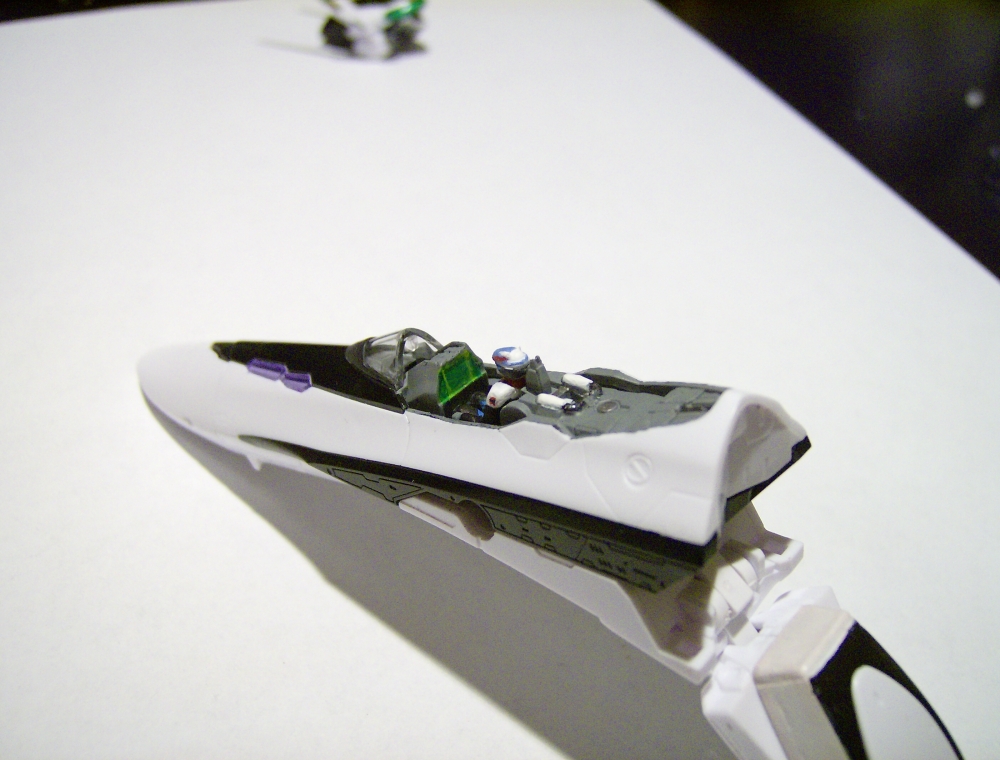

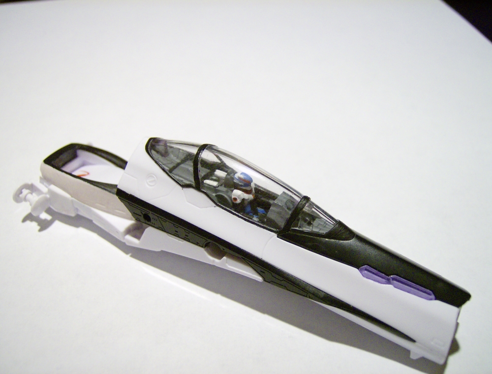

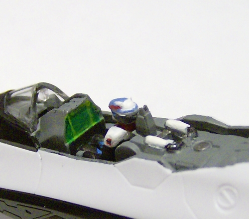

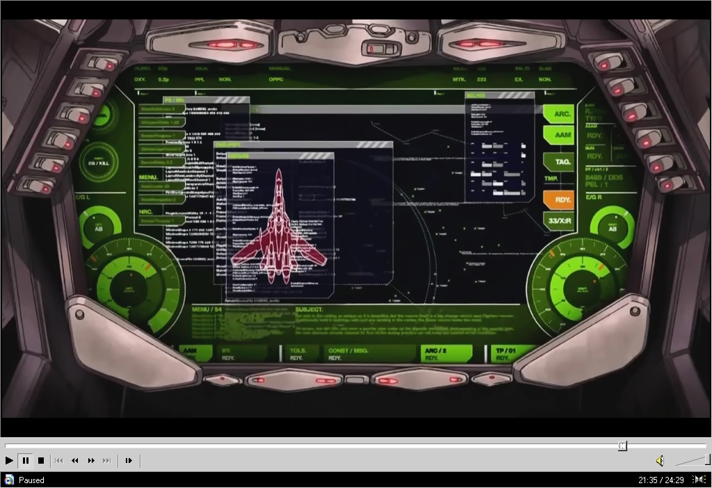

Chronocidal Posted May 13, 2010 Author Posted May 13, 2010 Thanks At least it wasn't too far off color wise, I just need a darker center screen, and more of a gray border. It probably would look better to print it and stick it on, but part of my personal challenge with this is to see just how far I can get with just painting things. I'm probably going to be punishing myself a lot (already have with the tails actually, but that's another story), but I want to see how it goes. Btw, somewhere along the way, I discovered a really useful tool for cleaning up paint that went out of the lines: a filed down toothpick. I just filed a round toothpick to a chiseled point, wet it a bit, and used it to smooth out rough paint edges. Worked wonders for cleaning up the tails, and it's a great tool in general for scraping paint off when it's still semi-wet, since the wood usually won't hurt the plastic at all. Quote

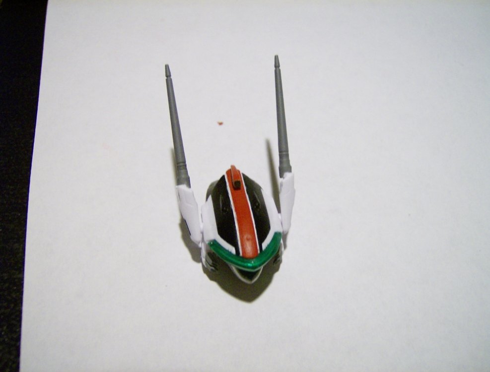

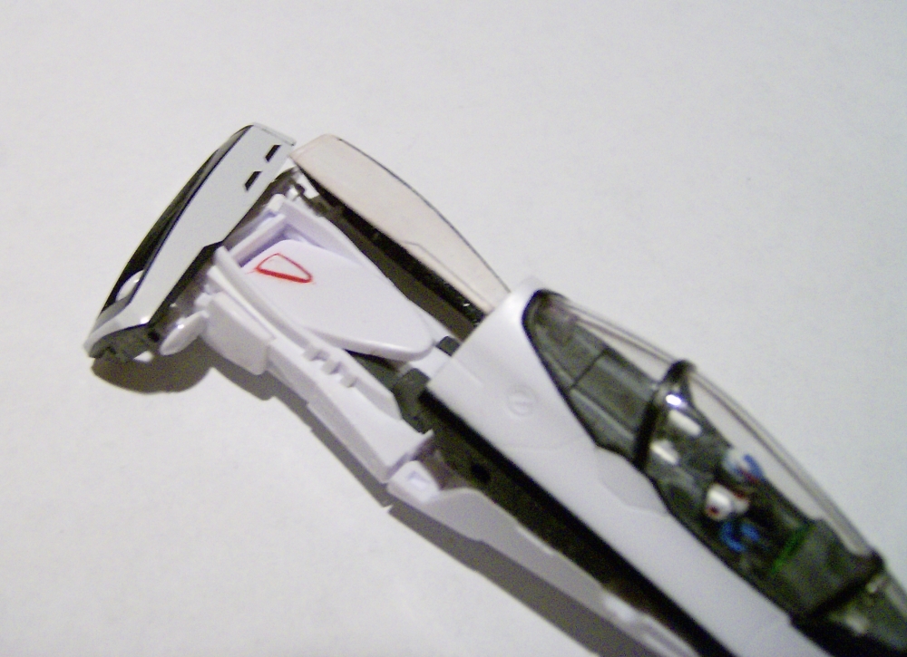

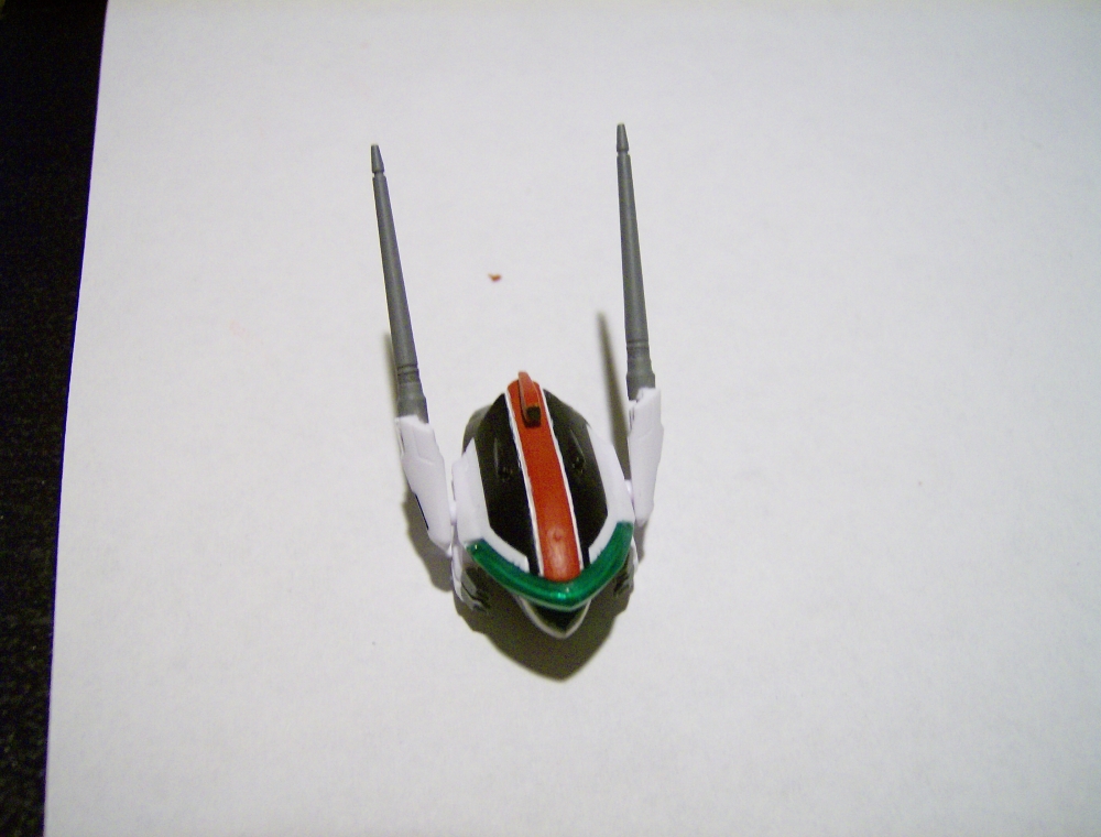

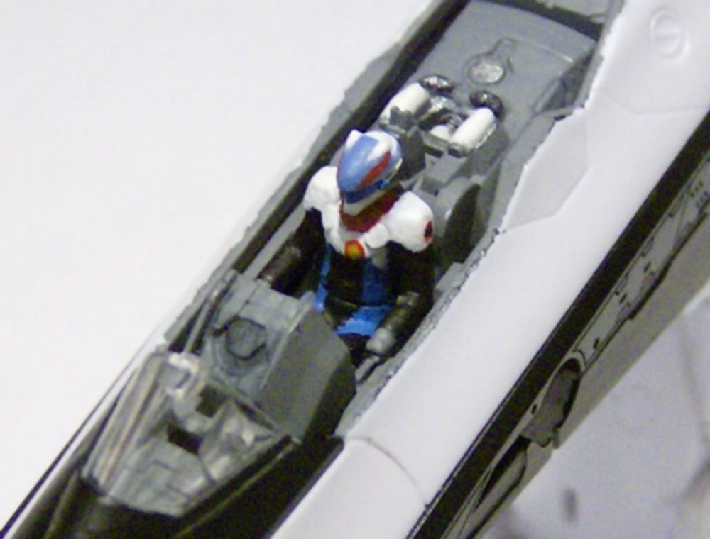

Chronocidal Posted May 14, 2010 Author Posted May 14, 2010 Next up, time for the head. I didn't do too much of anything special with this, mostly just painting with a very small brush. For the visor, I painted the entire back side a pure silver color, as well painting the place where it mounts, just in case it thinned out a bit as it was drying. For the front.. well, I didn't have any transparent green, so I just dipped my brush in the top of an unmixed bottle of bright green paint. It coated surprisingly well, and left the visor a nice bright green color. I used almost the same method for the front of the sensor on top of the head, first painting a layer of silver, then dabbing a drop of thinned green over it. For the top part of the head, I remembered all the problems mentioned with the white pinstripe decals going directly over the seam, so I thought I might actually use that seam to my advantage. Before putting the head together, I sanded down the edges of the red center piece slightly, at about a 45 degree angle. Once the head was together, I just let white paint run into that crevice, leaving a nice even stripe in the joint once the excess was wiped off. I may redo this piece though, since the black and red paint I used didn't smooth out as nicely as I'd like, and the stripes are a little uneven. Btw, it took a little touching up, but I was able to get the red stripe painted at the base of the head lasers. I think I used a 10/0 brush for it, but it might have been a toothpick. Quote

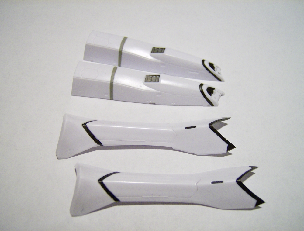

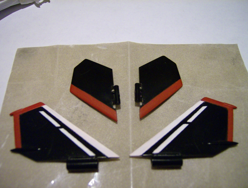

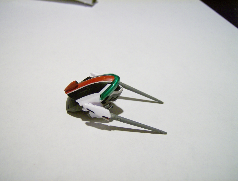

Chronocidal Posted May 15, 2010 Author Posted May 15, 2010 (edited) Now for the two things that gave me numerous fits over the past week.. the tails and crotch plate. I must have painted and stripped the tails and stabs at least a couple dozen times due to the paint getting lumpy on me. Mostly it was because I was just impatient with adding additional coats, and I kept pulling up the previous coat. Lesson learned: paint a coat, and find something else to do for a while. In the end, they turned out okay, but the paint is still a little uneven in those two tail stripes. I might try to redo those with a smaller brush later. Next.. a slight personal rant, so feel free to skip this part. What really tends to bug me above all else about these kits is Bandai's facepalm-worthy decisions for which parts are made in which colors. I don't mind painting a few details a different color, but casting parts an entirely wrong color drives me nutty. I know some concessions are made for the purposes of molding, but really... the big fat blue hinges that wind up on the VF-25G's belly are just dumb looking and, being hinges, probably the most likely pieces to scratch the paint off of on top of that. Maybe the worst of all though.. the crotch plate. I want to smack the guy responsible for that upside the head. The piece is molded in black, and you have to paint the entire thing white, with a bit of black trim. I lost count how many times I tried to paint it evenly (by hand, so yes, it's my own fault). Really, even this wouldn't be so bad, except that in order to get that piece to match, you need to paint it with the most utterly angelic, holy, not-of-this-earth shade of white. I mean, seriously. I could ask the Pope to bless and purify my paint, and it wouldn't match Bandai's plastic. I mean, not even the included foil sticker matches the plastic, and it's actually darker than my white paint! Seriously.. if they're going to give you stickers to make up for pieces being the wrong color, the least they could do is make them the same color as the plastic. My latest work has been with the arms and leg assemblies. For the most part, I'm going with an acrylic gunmetal on the mechanical parts, so we'll see how well it holds up under the rubbing of transformation. For the feet though, I'm trying some enamels instead of acrylics. I have several types of Model Master metallizer that I've used before, want to see what they look like. They're recommended for airbrush only, and they're very thin, but that might be just what I need for these brown feet. So far, I've put a test coat of an anthracite gray over some of the leftover brown parts tree, and it looks like it will give a nice metallic gloss to the plastic without actually covering up the brown color. I'm going to let it dry for a while and then see what happens if I buff it out a little. Edited May 15, 2010 by Chronocidal Quote
David Hingtgen Posted May 15, 2010 Posted May 15, 2010 What'll happen? Not much. You've got to buff Metalizer before it dries hard. Quote
Chronocidal Posted May 15, 2010 Author Posted May 15, 2010 Heh.. figures I'd remember that backwards. It's been far too long since I did any serious model building, if you can't tell.. I'm pretty much re-learning as I go. I did try buffing before it dried too much, but it stayed tacky a long time, and just coated the plastic in fuzz. Probably what I get for brushing instead of spraying. Oh well, back to the drawing board then. I might have to try and see if I can get a good bronze acrylic to try. Quote
Chronocidal Posted May 19, 2010 Author Posted May 19, 2010 I'm realizing that practice with acrylic paints has been what I needed most, since while they clean up nicely, most of my previous experience was with enamels, which dry much slower. Most of my problems have been coming from trying to even out the paint after the first few brush strokes, only to find the paint had alread started to dry, and the extra brushing was causing clumps. Mostly I just had to learn to be patient, put down one even coat, and let it sit for a good few minutes. After that metallizer failed on the feet, I just stripped it off the best I could, and put them aside for a while to work on the rest of the legs. I've been trying to go as much by the anime as possible in terms of the pattern, looking up the various colored patches that bandai didn't include on the kit. I'm simplifying the colors a bit though, just sticking with a couple consistent colors that I don't have to mix. I think I might redo the kneecaps, after realizing how close the tolerances are between them and the shin plates. If I filed down the lower edges a little, or maybe the upper edges of the shin plates, there would probably be plenty of clearance to keep these from scraping. The legs have been put together and taken apart probably a half dozen times now. While those parts were drying, I decided to see about painting the wing stripes on. I took a few liberties with the stripes, and instead of the lines the decals follow, I just stuck with existing panel lines for the black stripes. Likewise with the grey strips, I pushed them back to the front edge of the control surfaces, which actually looks closer to what the anime has than the kit directions show. The underside stripes went on easily, since they have a nice dividing line marked. I discovered that my red paint sticks much better over a base coat, so I painted the entire tip black, and then added the red on the tip, just dividing the black in half at the inner edge of the light on the tip of the wing. The lights I intended to be slightly transparent over silver, but both my gloss red and the bit of greenish-blue I mixed turned out too thick. They did pick up a bit of metallic sheen to them though, so I'm happy. Again, with the red paint over black, I did the shoulder plate pinstriping, and it turned out okay, but I might redo it more evenly later, or at least even out the rough edges. The red may also need another coat or two here, it seems more dim than the wingtips turned out. The red stripe might look better a bit wider as well, so there is less black showing. Sadly, I've got to wait for one of the elbow joints to harden after gluing it.. I managed to snap one of the hinge loops while trying to move the arm earlier, since I'd forgotten to move half of the joint after painting it, and it stuck. Next up should be the foot assemblies, after I decide what type of paint to try on them. Quote
anime52k8 Posted May 19, 2010 Posted May 19, 2010 What'll happen? Not much. You've got to buff Metalizer before it dries hard. how exactly are you supposed to buff it, just rub it with a piece of cloth or something? (seriously I never use the buffing type because it always comes out looking like ass and the non-buffing looks just fine.) Quote

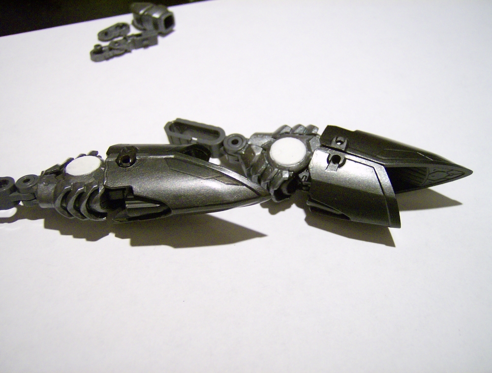

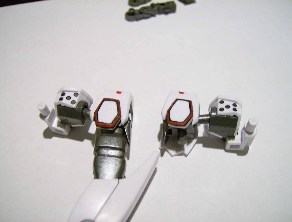

Chronocidal Posted May 20, 2010 Author Posted May 20, 2010 (edited) After a little bit of experimental paint mixing, I think I'm really happy with how the feet turned out. What I wound up doing was making a blend gunmetal and metallic gold, with a bit of flat black to darken it. The mixture went on very smooth, and gave me a nice semi-gloss metallic look, with a hint of brown to it. It kind of looks like antiqued brass in person. For the insides of the feet, I just mixed a little more flat black with gunmetal, and got a nice dull metallic black. I remember reading about various problems with the decals on the foot cuffs, and how they refused to fit correctly for some people, but I don't remember which half didn't fit. What I did realize while painting them though... Bandai got the heel cuff decals backwards. While the colors are right with the red on top, the decals bend the wrong direction. Looking at the cuffs, the stripes on the toe dip downward at the edges, but the decals for the heel bend upwards. From all the pictures of the anime I have, it looks like the heel strips should curve to match the cuff, and join up into a roughly continuous stripe when the feet are closed, so I painted them that way, except I skipped painting the small tab that overlaps since moving the feet would just rub the paint off there. Edited May 20, 2010 by Chronocidal Quote

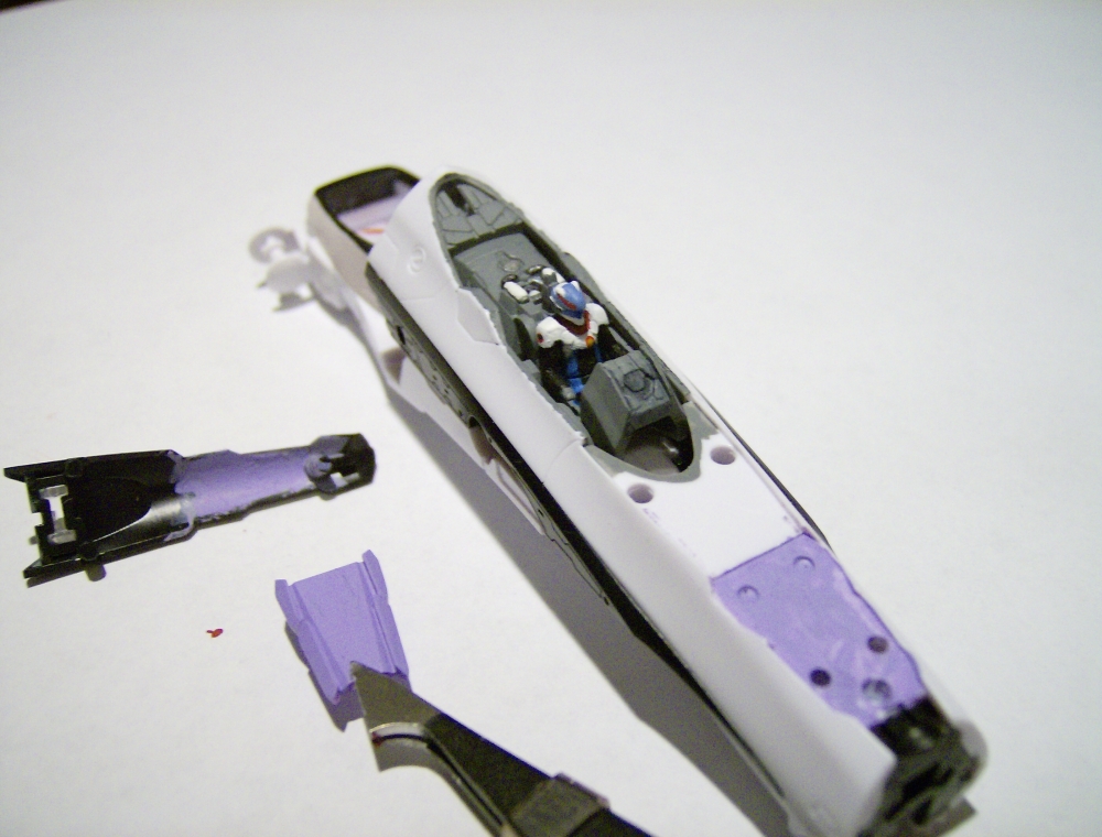

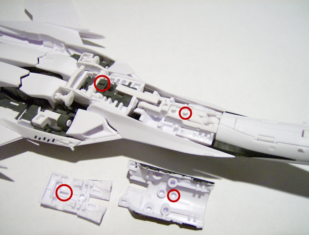

mickyg Posted May 20, 2010 Posted May 20, 2010 In other news, I might have to make one of these in fighter mode only. That arm that broke glued decently enough, but split in a second spot the instant I tried to reassemble it. I've got it re-soaked in glue again, but I doubt that piece will ever be strong enough to bend much. I'm going to have to file down the inside of the hole to make sure it fits over the hinge pin in the elbow. Did you use super glue or model glue? Model glue won't work on the ABS parts in the kit and I think the joint parts are ABS. Loving your tips so far man! Thanks for putting the effort into your pics and documentation - there will be some very grateful people out there reading this for a long time, I expect! Quote

Chronocidal Posted May 20, 2010 Author Posted May 20, 2010 Did you use super glue or model glue? Model glue won't work on the ABS parts in the kit and I think the joint parts are ABS. Loving your tips so far man! Thanks for putting the effort into your pics and documentation - there will be some very grateful people out there reading this for a long time, I expect! I did use superglue, but apparently I got some on the inside of the hole, and it shrank, meaning pushing it onto the hinge spread it again. Quote
David Hingtgen Posted May 20, 2010 Posted May 20, 2010 For buffing metalizer, I like either socks or kleenex. Note though: the window for buffing is short. Metalizer dries VERY fast. 5 mins may be too soon to start buffing, 10 mins may be too late. In my experience though, it's usually about 10 mins to start buffing lightly, then a few minutes later (after it's fairly shiny) you can start buffing harder. Highly buffed titanium looks AWESOME. I'll try to photograph my F-18 nozzles I did that way. Unbuffed titanium is basically "metallic grey", a bit of buffing adds iridescence, highly buffed looks browner. I only slightly buffed the interior of my VF-25 nozzles, here's a pic: (it's basically unbuffed) Quote

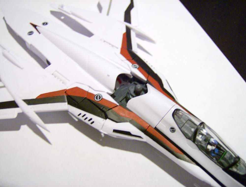

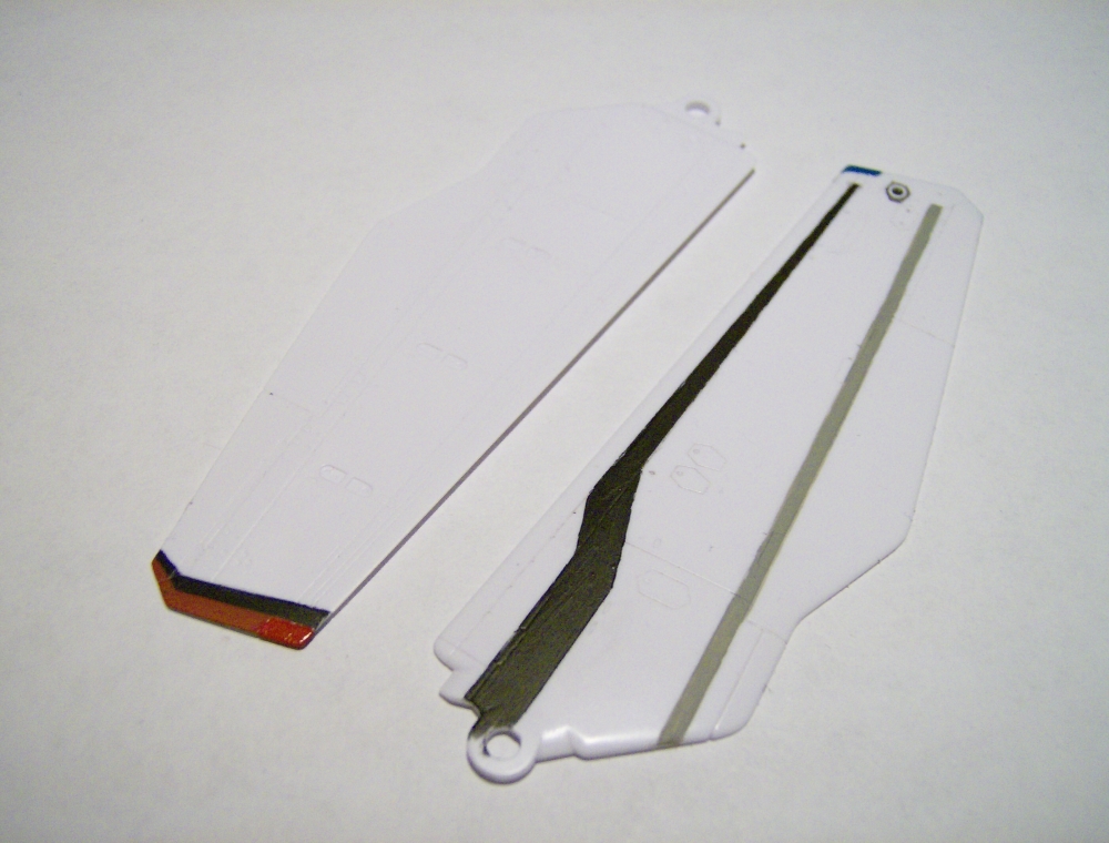

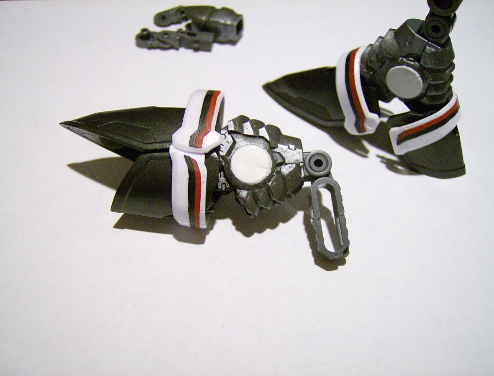

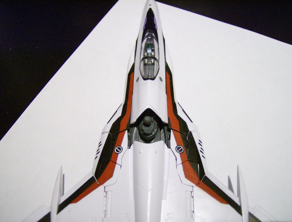

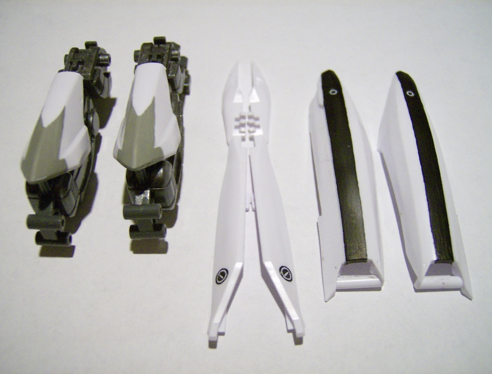

Chronocidal Posted May 24, 2010 Author Posted May 24, 2010 (edited) Well, I did figure out what happened with the buffing.. turns out I mixed up two of my paints. The one I used wasn't for buffing after all. Oh well, I like how they turned out from the mixed color. I've gotten to the point in my kit where I need to seriously start considering whatever reinforcement tweaks I may use. I actually am considering buying a few small magnets, depending on how tiny they can get, while still remaining powerful. I've got two spots in mind. The first is a replacement for the tabs I developed on my first Michael valk, or maybe a refinement of them. I liked how well the first ones worked, but they were very rough cuts in the leg panels, and I know I could do better with a bit more planning and measuring. What I might do is try to locate magnets in the same places I added the tabs and slots. They'll have to be very small to fit though. The tabs were located directly above the tabs in the upper leg plates before, and I'm thinking if I removed those tabs entirely, the front pegs might be enough to hold those plates on, but I'm not sure yet. I know there is plenty of room inside the wing glove for a decent sized magnet, so I might just try and fill the leg plates with metal bits. If I can get a strong enough magnet for the wings, it might not actually have to touch directly on the metal. I don't know though.. it will take some testing. The second spot I'm considering is as a replacement for the tab that holds the hips in place. I pulled off the two underside plates where this connection is located, and there might be a way to do it. There are so many redundant pegs inside these plates, I might be able to remove a couple, and still leave enough to hold them on. I've got the spots circled in the pic below. The front spot is actually directly above the connection tab. If I removed the peg and socket there, there would be enough room for a small round magnet I think. I may have to drill out a little bit of the plate behind the tab. The second spot is right where the tab's slot is currently, so the two spots are perfect for locating the magnets. There is less space in the back due to the hip bar joint, but if I remove some of the reinforcement that holds the tab in place in battroid mode, there should be room to lay a magnet right against the inside of the skin. In other news, I finally got the nerve up to start painting the main markings. While the puzzle-piece pattern can be generally annoying, I actually found the panels very useful for finding solid reference points. I took a couple of small liberties with the pattern, partly to make it look a little more streamlined, and partly to simplify how the pattern lines up with the existing panel lines. What I did for the most part was simple masking with scotch tape, and it worked fine when I needed it. Most of what I did was drawn on with a pencil in straight lines, and filled in. I painted the black first, and it went on beautifully, making a very smooth coat. The red though.. frustrated me for a few days, mainly on the wing gloves. The black paint isn't really durable to mask over without peeling it off, so I had to free-hand the red over it after marking the outlines with a very fine mechanical pencil and a ruler. Overall, it came out nicely I think and the red matches the other portions I've painted with it (very dark from the black undercoat, although enough coats will make the same shade on white plastic). It's not perfectly even in some spots, especially the shoulder blocks, but it looks fine for normal viewing distances. Next step will probably be working on coating the rest of the internal structure with gunmetal, and finally assembling the legs. I've held off putting the entire thing together so far to keep from stressing the hip joints, but it will have to happen sooner or later. Edit: Oh, by the way.. after watching a couple episodes of the show for details, I redid the shoulders. Know how the shoulder decals have a red stripe between two black stripes? While the black really is just a pinstripe around the wider red band.. the inner pinstripe shouldn't be there. The inner hexagon should be indented, and that second black stripe would be a shadow. The outer black and inner red stripe should also be about the same size. Also, there is a black stripe on the underside of the wing gloves that I keep seeing, about in the same position as the black portion of the top stripe, without the red piece. Edited May 24, 2010 by Chronocidal Quote
Lolicon Posted May 24, 2010 Posted May 24, 2010 Whoa those painted on stripes look pretty pimp. I bet they were easier than trying to line up Bandai's messed up decals. Quote
Chronocidal Posted May 25, 2010 Author Posted May 25, 2010 The black definitely was easier.. for a while I was tempted to just leave the stripes entirely black. The red, not so much, but it worked. The best part of this was learning that it's not too difficult to mask off those individual pieces, since most of them follow natural reference points on the plane. I may sticker up one of the kits I have just to try it (probably Luca, since I really only bought his kit for the ghosts ), but I think in general I'm going to stick with painting those markings on, especially once I start learning how to use my airbrush. Quote
regult Posted May 26, 2010 Posted May 26, 2010 I think this is actually the first time I see painted red/black main markings on the VF-25 kit, I've always wondered how they'd look like. Amazing work, and it was painted by hand! Thanks for keeping the updates coming Chronocidal! Quote
David Hingtgen Posted May 26, 2010 Posted May 26, 2010 If anyone wants a perfect match to the red decals, Pollyscale's "Southern Pacific scarlet" is it. Quote
