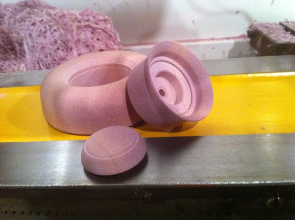

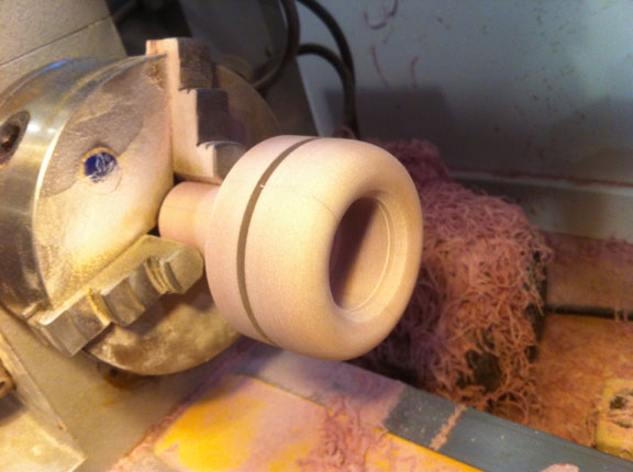

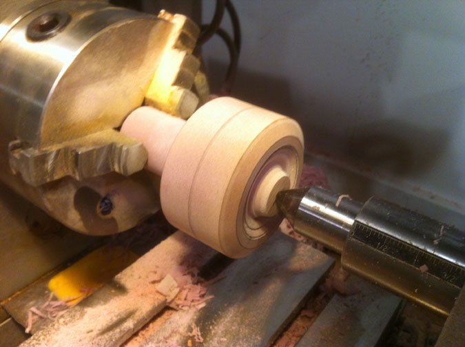

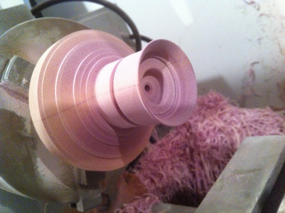

Ahab Posted January 9, 2011 Author Share Posted January 9, 2011 Did I say next week? I meant six months! Here's a small update on the jeep. Blocking in the tire/wheel master on the lathe. Quote Link to comment Share on other sites More sharing options...

Ahab Posted January 11, 2011 Author Share Posted January 11, 2011 (edited) Thanks Troyness. Here's another small update. I know wheels are not all that exciting, but ya got to have em! These are the basic shapes for the tires, wheels and hubcaps (before details are added). The tires/wheel halves will be molded, cast and joined to form the full{symetrical} shapes. Tread will then be applied then molded once more. Edited January 11, 2011 by Ahab Quote Link to comment Share on other sites More sharing options...
