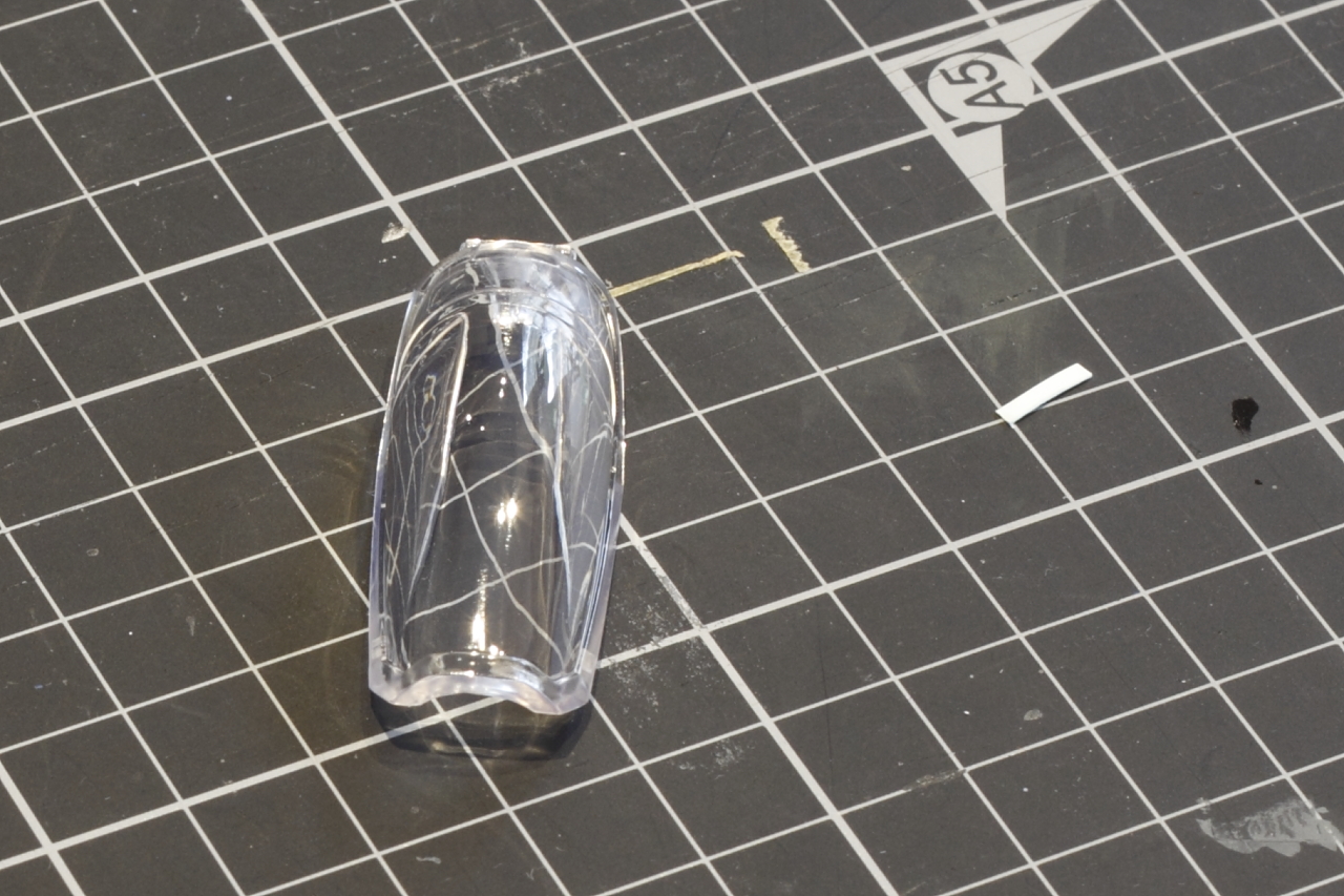

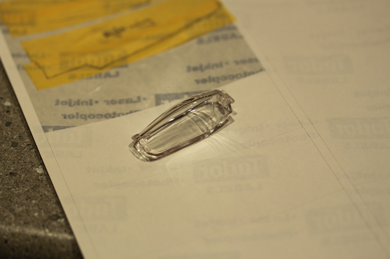

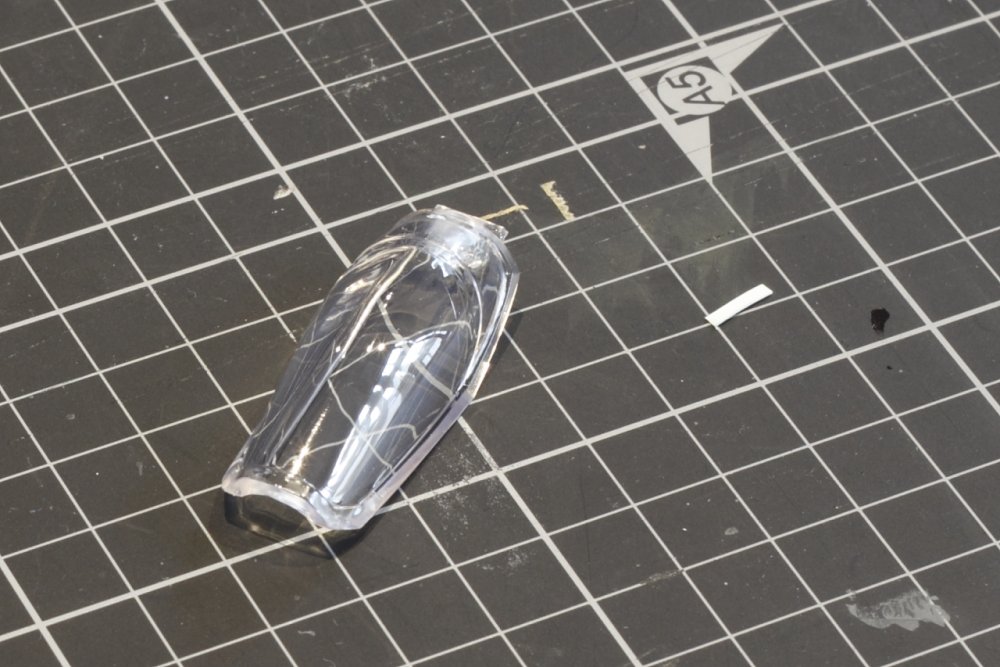

I didn't show pics yesterday of the canopy seam removal. The canopies on Yamato VF-1 v2 toys have a seam running right down the middle of the outside surface. Something to do with the profile of the canopy and how it gets molded. Anyway, you probably don't usually notice it because of the rainbow tint. I don't have a new, untinted version so can't really comment. Anyway, on the kit, it's very noticeable and I thought I'd tackle it. I've never done this on any clear part before and all of my Hasegawa kits have this seam, so I figured it'd be good practice.
I went the typical, "start with coarse sandpaper and work your way up to as fine as you can go" route. I think I started at 300 (which was too coarse, in hindsight) and then to 600, then 800, then 1200, then 2000, then fine Tamiya rubbing compound, followed by the finishing (finest) compound. Probably could have started at 600, skipped 800 and saved myself some time. But the results were pretty good (no pics of the process, unfortunately). I dunked it in the Aussie equivalent of future (Pledge "One Go") and it dried overnight.
Here's how it looks now, though you can't really see if there's a seam or not, due to the reflection on the glossy surface:

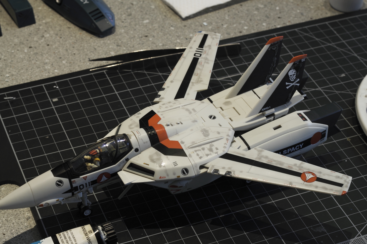

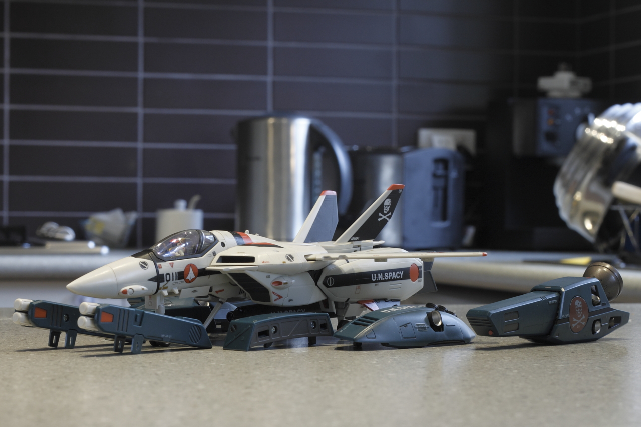

I also finished another ongoing project over the last few weeks - the decals for my VF-1A. These are water slide decals from "ibuyxyz.com" and they're cheap, and surprisingly good quality. The printing is really good, with the only real problem being the semi-opaque white they use. This means anything you put over a dark surface (the green on the fast packs, for example) ends up looking less than white. The other gripes I have are the inconsistency in quality of the clear sealant they use. On half my sheet, it was all cracked and spider web looking. The other half was fine. So on the large skull emblem, you can see this really weird, crazed surface. The only other concern, although minor (hey, these are only $5!) is how thick the decals are. They're so much better than stickers, but they're not quite up to the "melt into the surface" that I'm used to with some better model kit decals.
Once the decaling was finished, I did a quick oil wash on the top of the valk. I tried to do the sides, but realised how badly that turns out - gravity pulls the wash right out of the panel lines when you do it that way. So this will have to dry, get wiped off, then I can move on to the next surface. It's tedious but the results are well worth it, in my opinion.

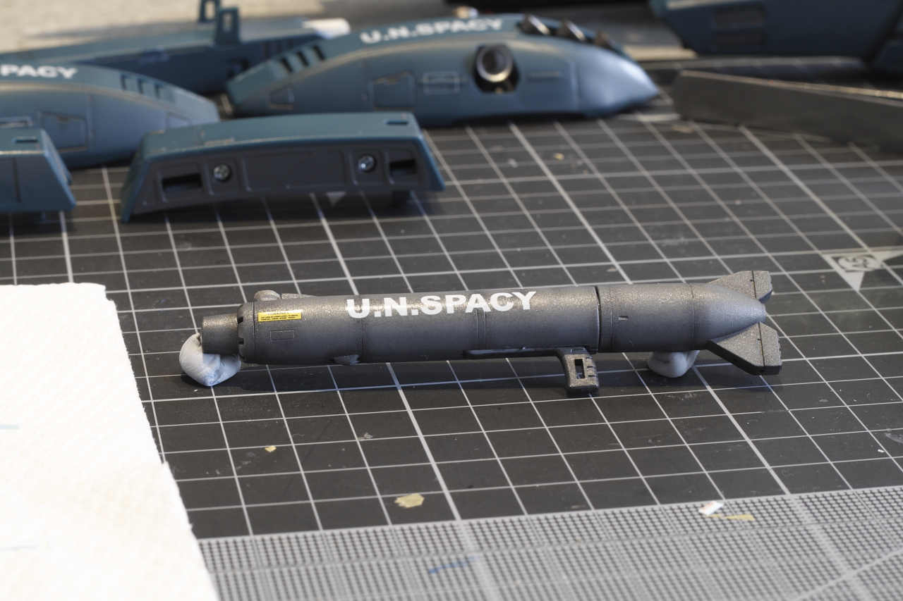

The decals included with the VF-1S kit are amazing! OK, well in comparison to the ones I bought from ibuyxyz, they are. These ones are very thin, and almost completely blend in to the paint. The colour printing is a bit dotty but only if you look really close, and nothing anywhere near as bad as the Bandai Frontier models.

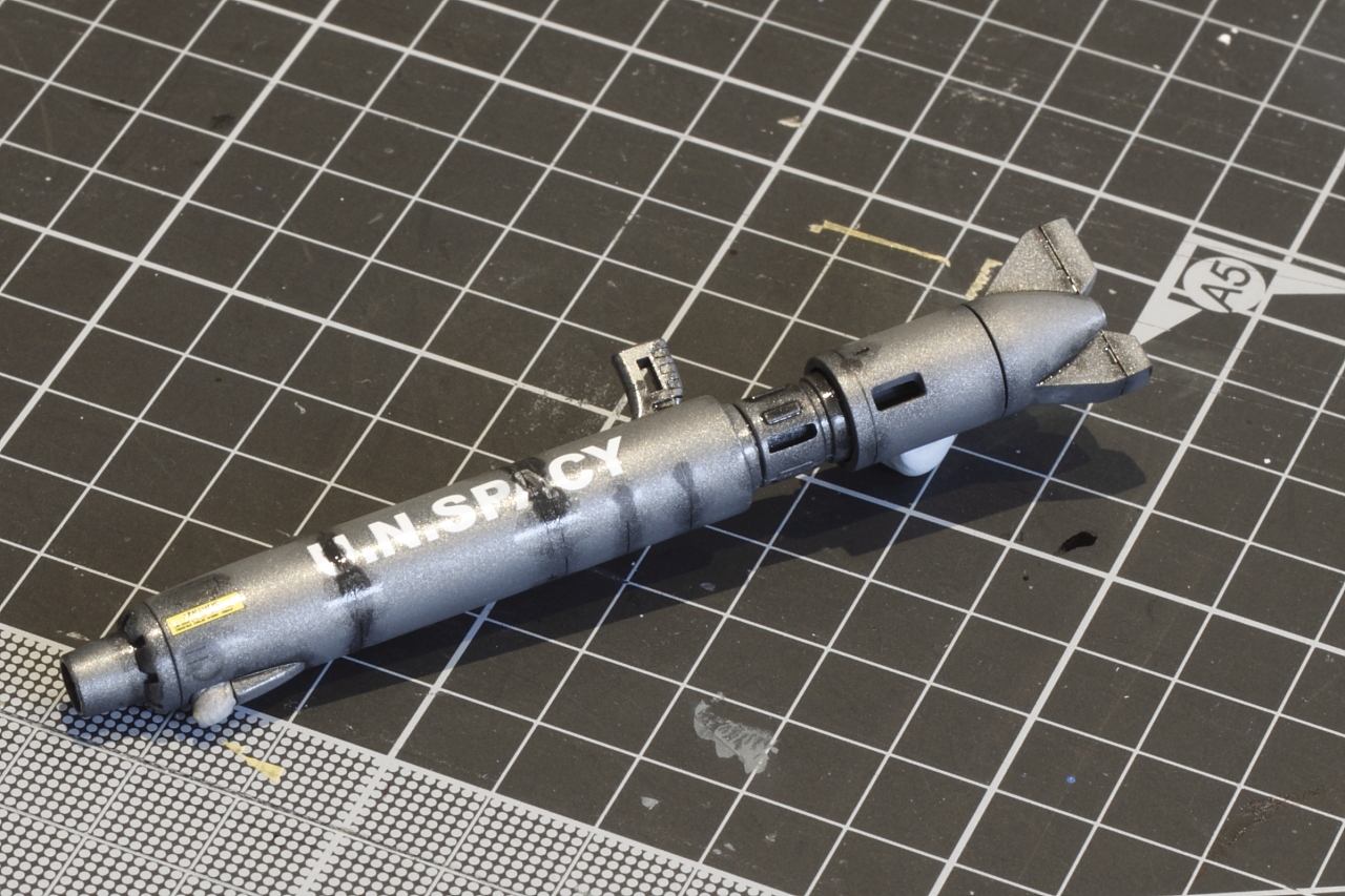

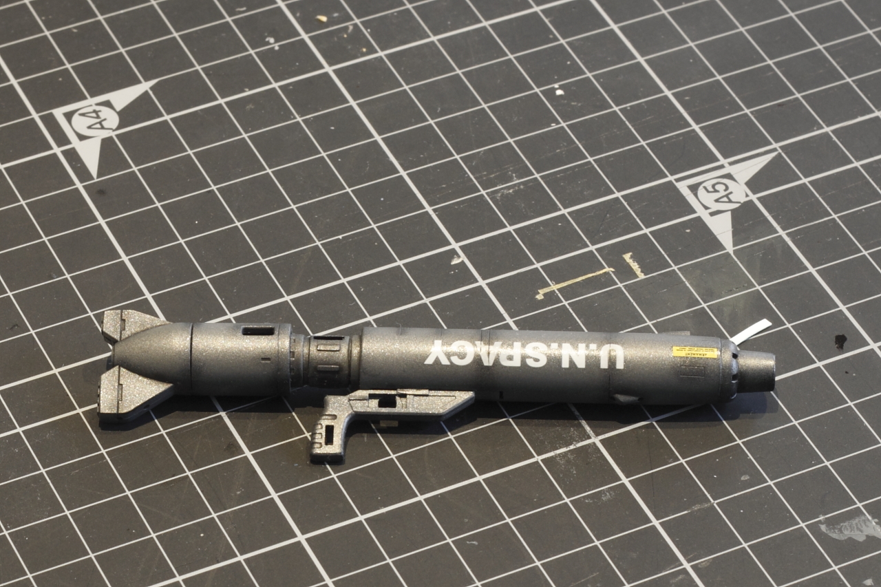

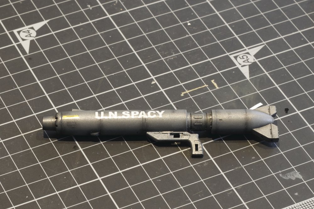

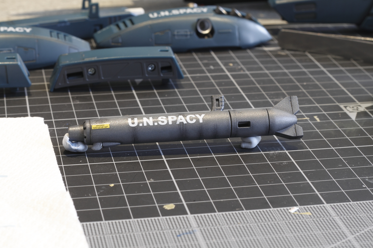

Here's the gun done:
Black oil wash:
And after it's been wiped down (only waited an hour or so - the thinner the wash, the faster it dries. Pure artists oil would likely take a week to dry!):

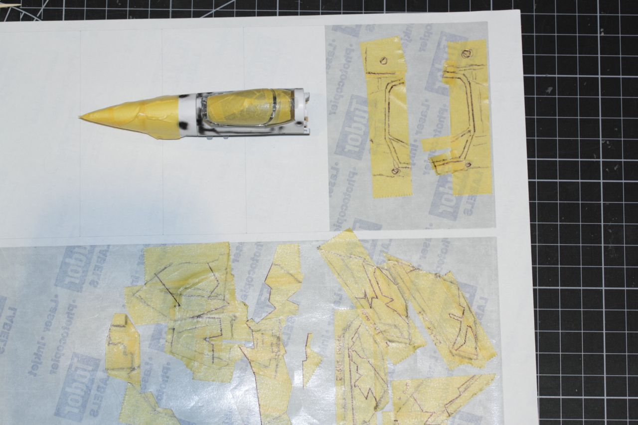

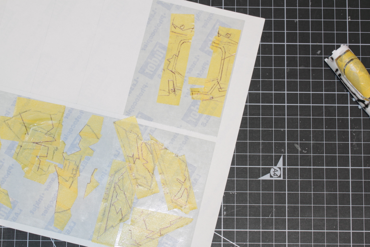

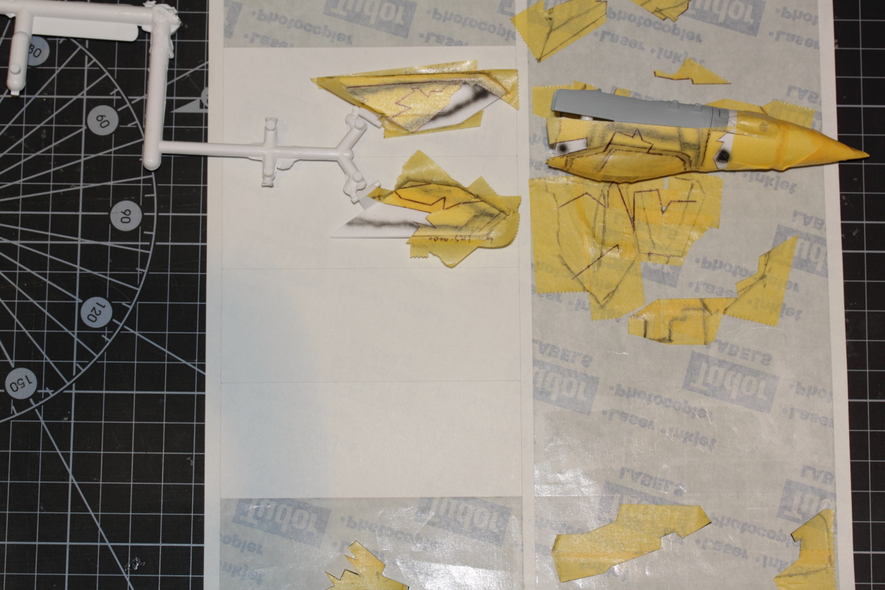

So the other day I decided to start masking the major sections off. My plan is to mask the parts fairly loosely, draw dots where the lines some together in points (the camo scheme is very angular and basically made up of triangles. I figure I'll do the dots, mark out the colours while it's still on the part, then remove the masking, apply it to a sheet of labels for a printer, but remove the labels. That way the masking goes on the page but can be easily removed (perhaps too easily?) and I can cut the patterns out before I even apply them. The scheme is very forgiving so I'm pretty sure this will work and will be fairly simple.
So far, I've only masked the tails (and only the inside surfaces) and the "pancake" section. The rest is yet to come.

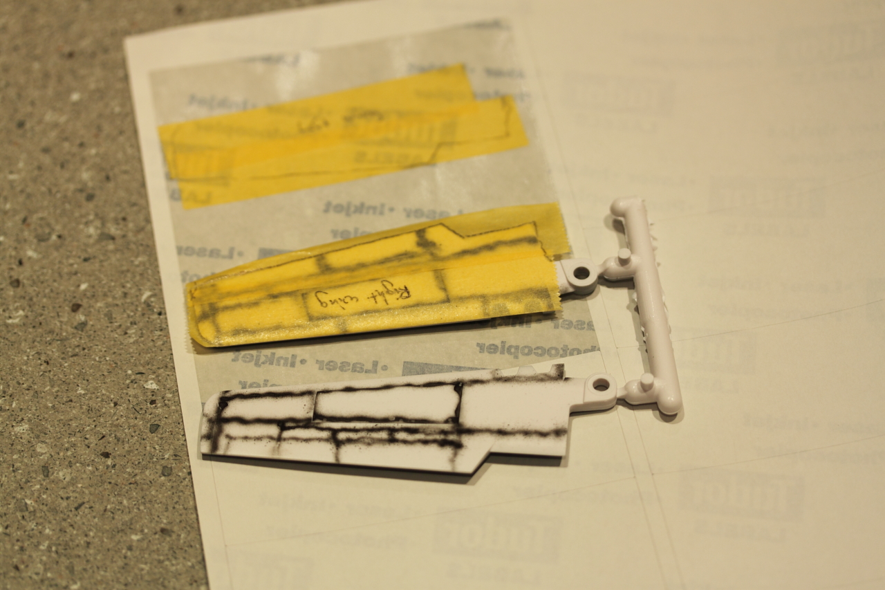

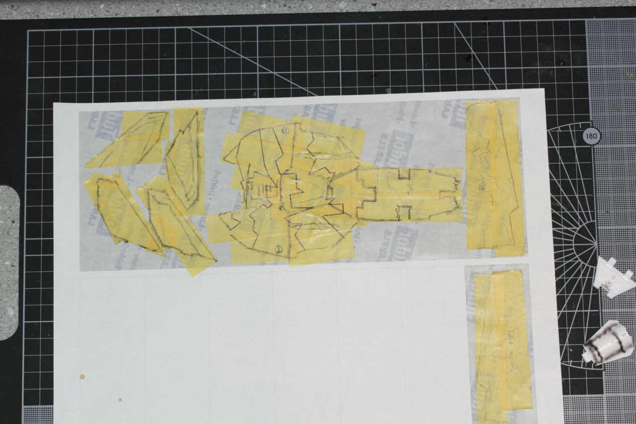

Just shows how I'm mapping out the masking. I apply enough to cover the part, then draw the outline of the part in pen, then remove the masking and put it on a sheet of labels (with the labels removed) so it will come off easily). That way I can trace the camo pattern on the masking, then cut it out and only apply what I need. I figure it'll work pretty easily. And because the splinter pattern is pretty forgiving (straight edges for the most part) it won't need to be super accurate to the original.
Oh, and another gratuitous shot of the super glossy canopy!

I like the canopy, and how shiny it is. Is there a site or link you have where I can get the solution to buff it up like that? I can't wait to see the finished product here, as it's looking really good. Nice job, keep up the great work. :)
Probably. However, I just went with the, "sand with about 400 grit first, then go to 800, then 1200, then 2000, then use polishing compound, then future it, viola!" approach. Not terribly difficult, just a bit time consuming. And as I mentioned, there's still some hints of sanding marks at the back of the canopy. Though it's probably something only I'll notice. Still, the OCD will likely get the better of me and I'll do the dunk in windex to remove the future (at least I think that works...) and polish it more before the final coat.

What is that buffing compound called? I've heard of it, but have never used it, and being that my canopy is scratched up due to work on the kit, I'm definitely gonna need it. I don't know if this has been asked either or mentioned (probably has), what type of paint scheme are you gonna go with?
Tamiya version is called a Polishing Compound.
Yes, I've got the Tamiya stuff and it's called "rubbing polishing compound" on the tube/box it comes in. They've got 3 grades, coarse, fine, and "finishing" as I recall. I've only got the last 2.

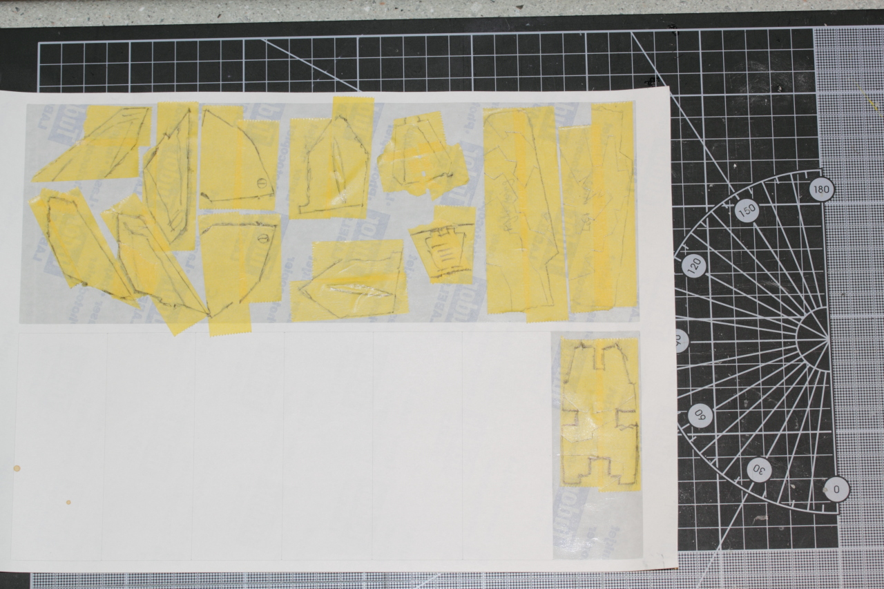

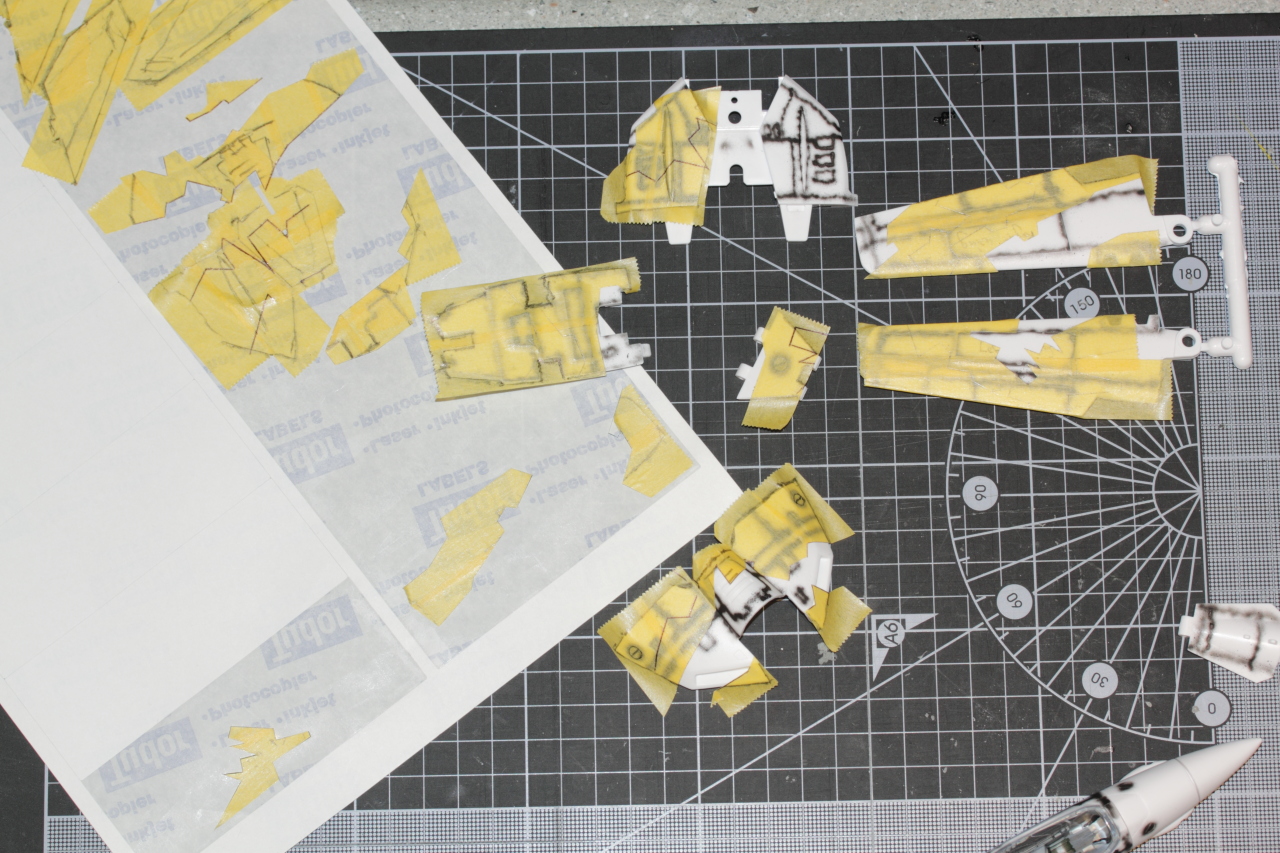

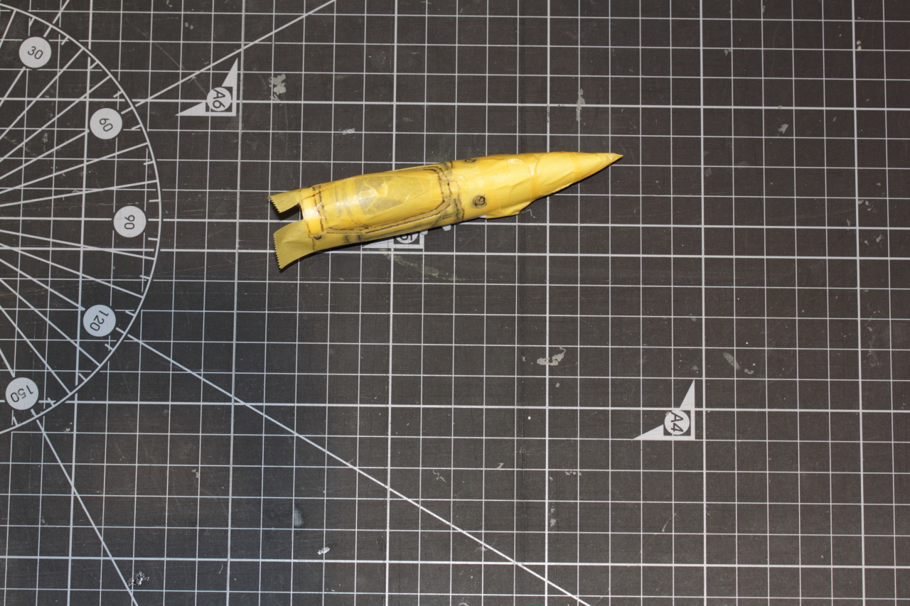

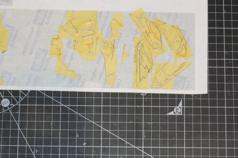

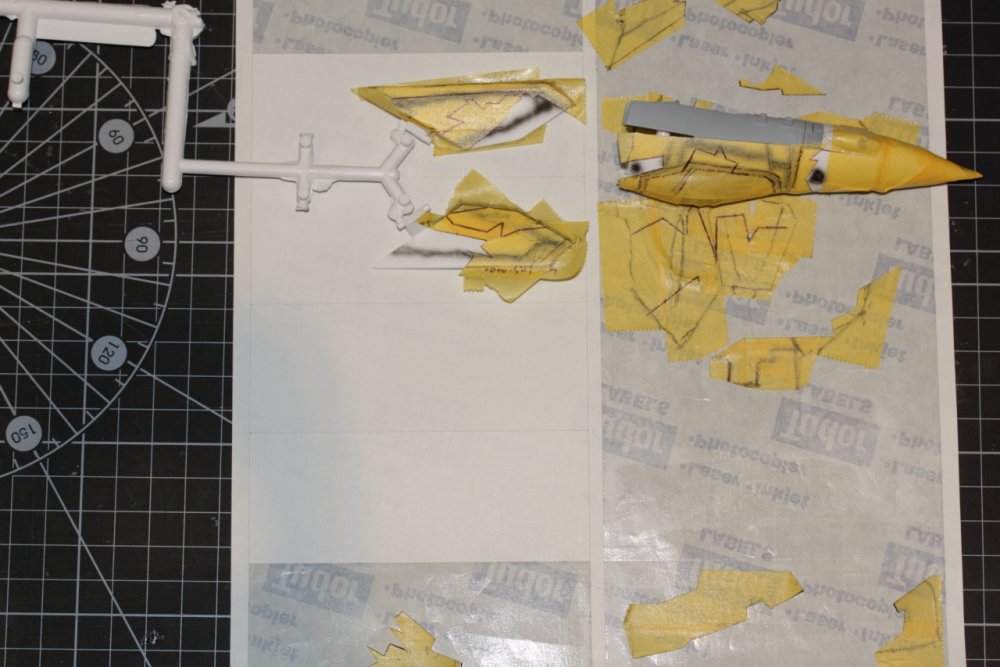

Basically I've been working on masking. I'm not sure my method is the most logical or efficient but for some reason, I decided I didn't want to paint the top in all one colour and then overlay with the darker shades of the camo. I'll probably regret it later but I figured the panel lines aren't terribly deep and 3 layers (maybe 2) of paint would fill them in a bit too much. I don't know because now I'm thinking the extra paint layers would likely be more durable. We'll see I guess.
For now, here's my process: First, I'm loosely applying masking tape to all the major sections, tracing out the edges and major components, then applying each section to a piece of label paper, so I can easily remove the masking tape later. Second, I trace the camo lines on the masking tape. Since the camo is straight edged, this is easily done with a pen and ruler. Third, I decide what colour I want to do first and cut that section of the masking out with a knife and ruler. Finally, I apply this to the part.
Where this might all fall down is when I go to start putting other colours on. I'll have to apply the remaining masking exactly over the previously painted part, which could be both tricky and frustrating. As I said before, we'll see.

Got everything masked and ready to paint the first camo colour. But didn't actually get to paint. Probably just as well - it's cold and wet today and probably not ideal for airbrushing.
