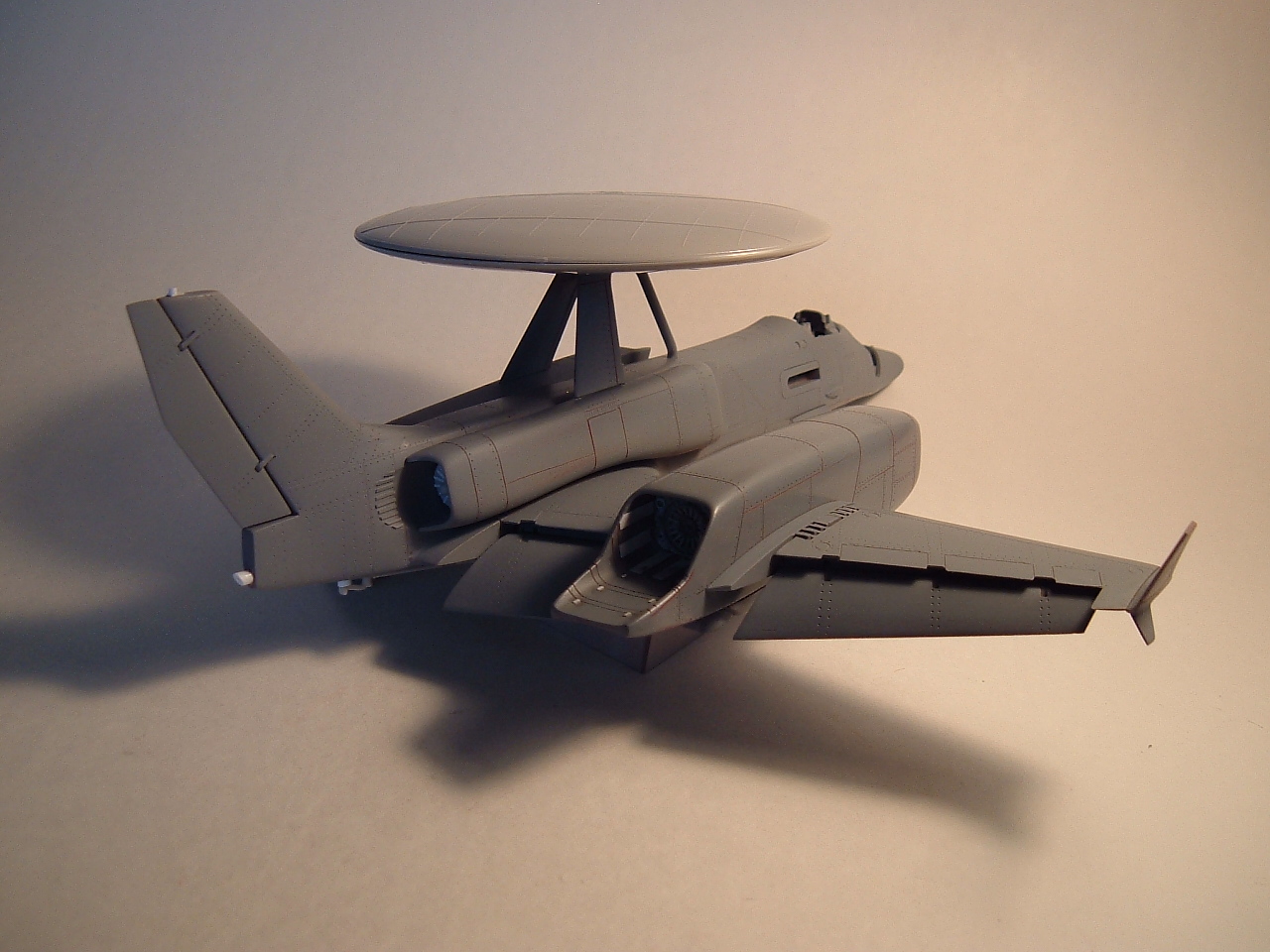

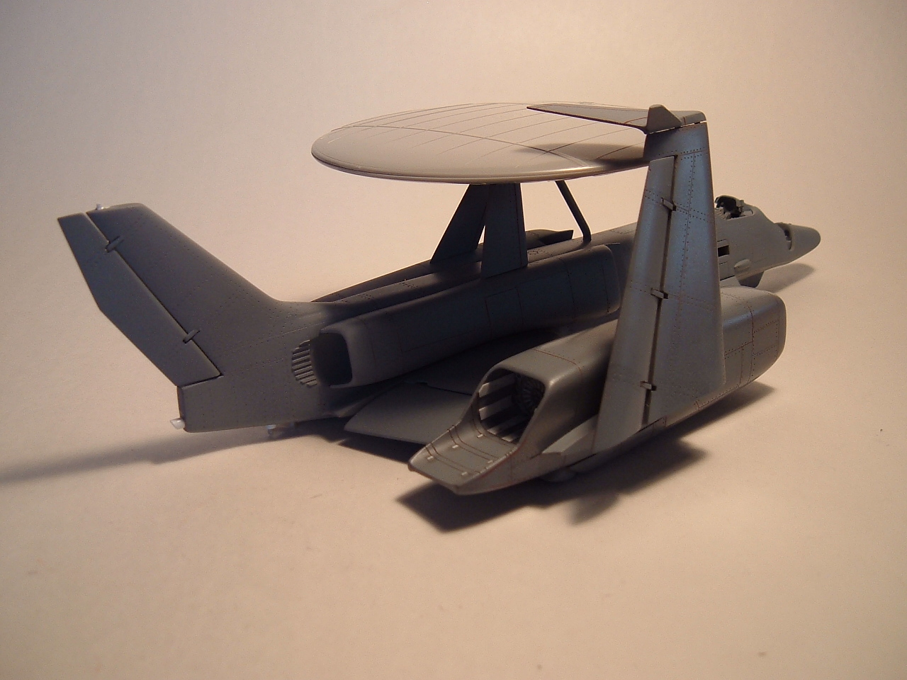

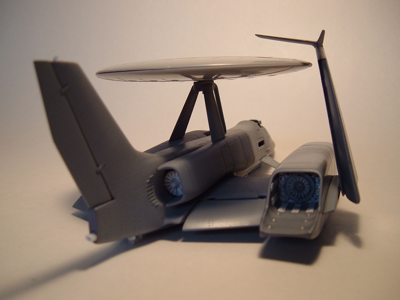

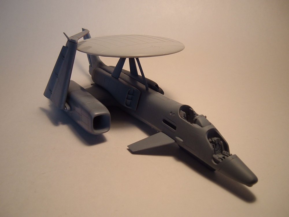

captain america Posted June 3, 2010 Author Posted June 3, 2010 OK folks, here it is: the formidable Kaa 'Tsai master patterns. Finished! Quote

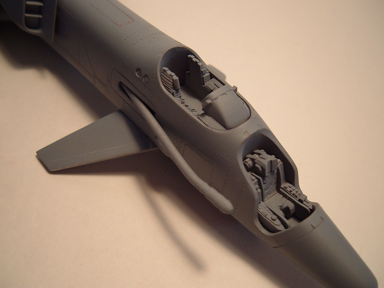

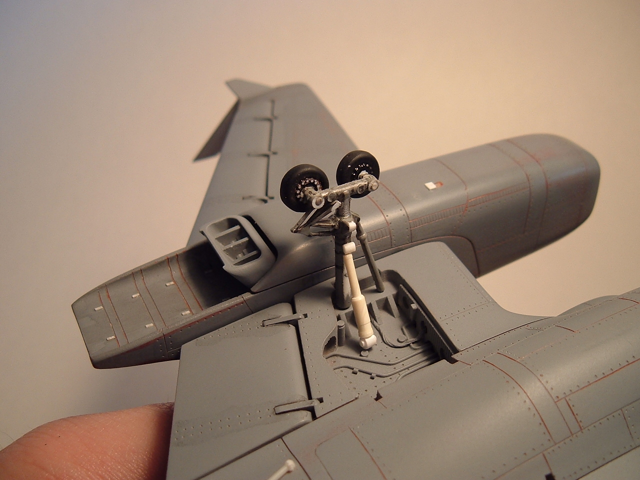

captain america Posted June 3, 2010 Author Posted June 3, 2010 Landing gear and refueling probe. I opted to make the latter an "extender" version, since I feel it's important for the probe to be in the pilot's field of vision for obvious reasons, and the possible places to put it were very few, given the plane's design. Quote

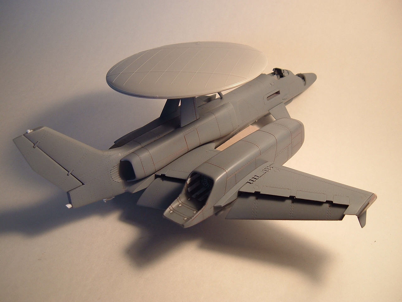

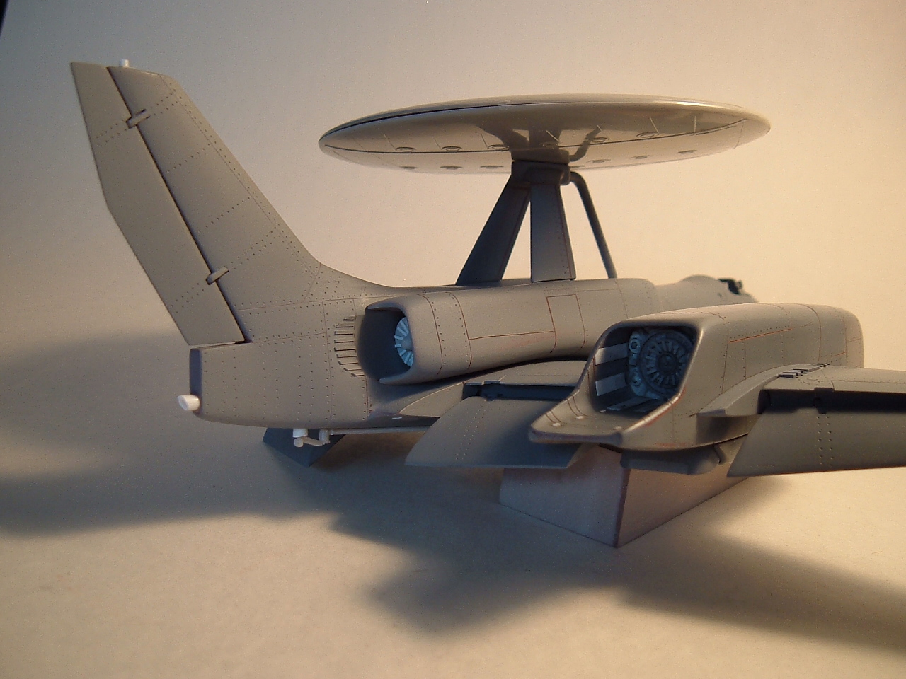

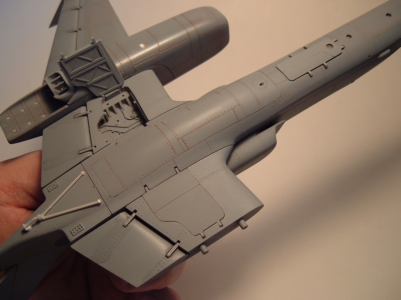

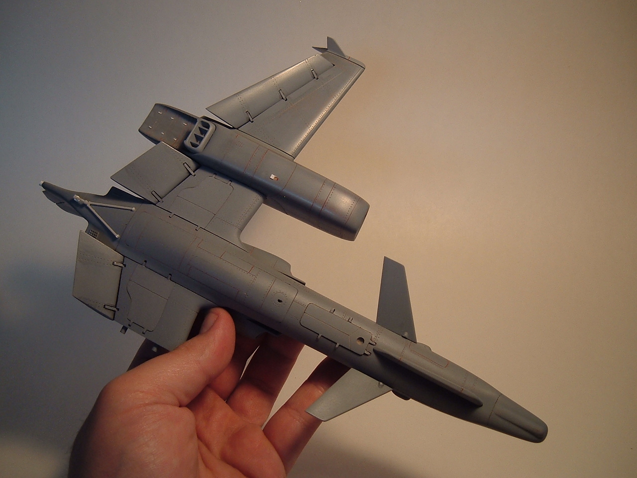

captain america Posted June 3, 2010 Author Posted June 3, 2010 Undercarriage, flaps and engines. Quote

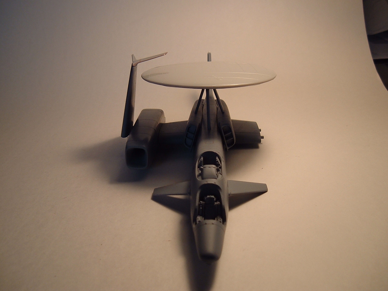

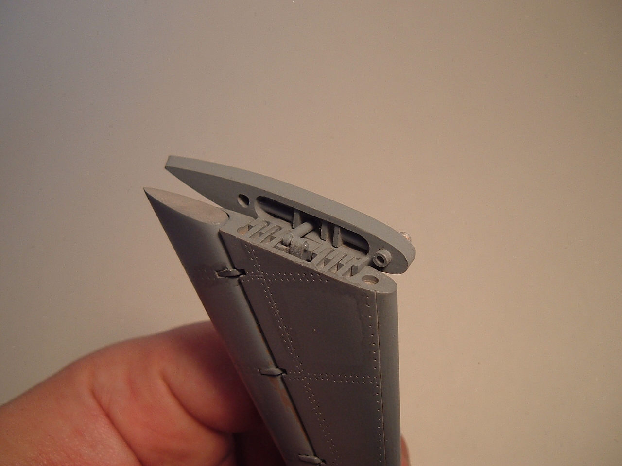

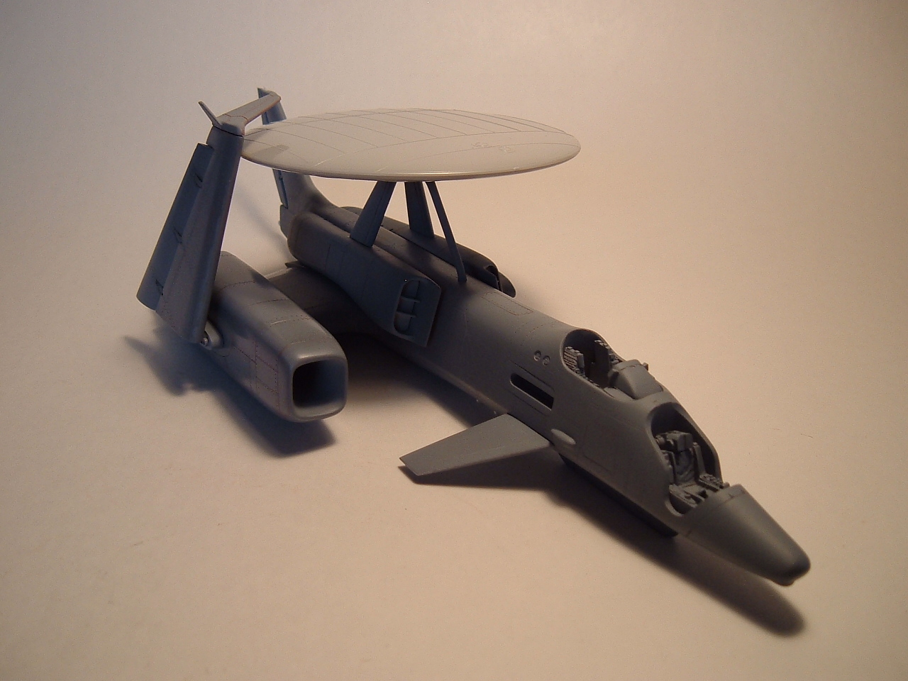

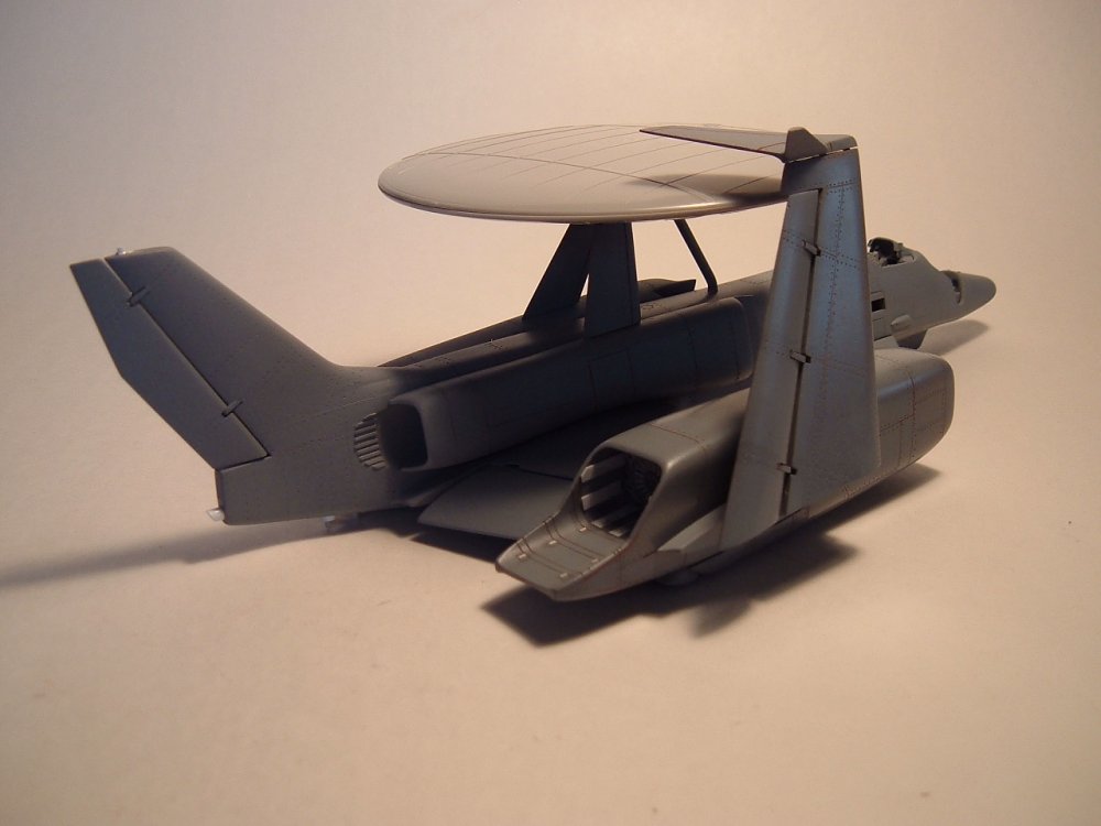

captain america Posted June 3, 2010 Author Posted June 3, 2010 The sto-wing option. As you can see, the wings fold up into a neat little package I'll wait until parts are cast to take more landing gear shots, since the fact that I don't have a second outboard engine screws up the balance and I don't want to take the chance and damage the gear. Naturally, parts are now on their way to mold prep, but sufficed to say, this turned out to be a much cooler project than even I had hoped. Quote

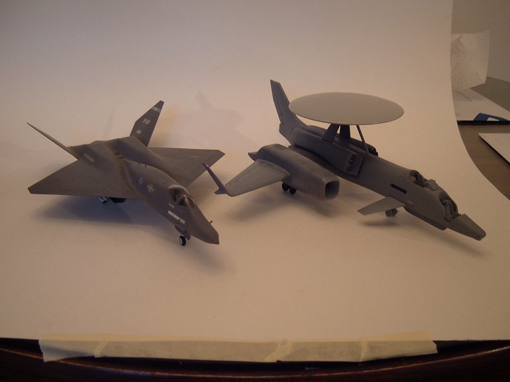

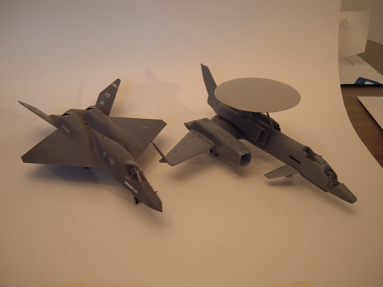

captain america Posted June 3, 2010 Author Posted June 3, 2010 Oh, and remember back when I promised comparative pics with a YF-23? Here they are. Quote
Ranger565 Posted June 4, 2010 Posted June 4, 2010 Hey John, Wonderful kit, but I have a question? Is their anyway for you to put the Circle Marking(Panel Lines) around the Radar Dish? Or is that something we will have to Make a decal for? My only option on something that size, is for me to use a Razor from a Gasket making box( as in Cutting a gasket for Pipe or Large scale pumps) on black Vinyl to create the look.( only way for me to make a Perfect circle) I guess I can use a protractor? If I have confused you my bad. Not sure how else to explain what I am talking about. I know this is anal but for me to be an exact replica I will have to do this Carl Quote
captain america Posted June 4, 2010 Author Posted June 4, 2010 Hey John, Wonderful kit, but I have a question? Is their anyway for you to put the Circle Marking(Panel Lines) around the Radar Dish? Or is that something we will have to Make a decal for? My only option on something that size, is for me to use a Razor from a Gasket making box( as in Cutting a gasket for Pipe or Large scale pumps) on black Vinyl to create the look.( only way for me to make a Perfect circle) I guess I can use a protractor? If I have confused you my bad. Not sure how else to explain what I am talking about. I know this is anal but for me to be an exact replica I will have to do this Carl Hi Carl. In my head, I never saw the black circle on the dish as a panel demarcation. It's actually REALLY easy to do with paint or decal though; just run a compass cutter over either some Frisket film if you prefer paint, or a sheet of black decal and the job is done. 3 minutes tops if you're slow. I wouldn't recommend doing a scribed line over the top due to the layout of the raised antenna pattern, but that's just me. Quote
