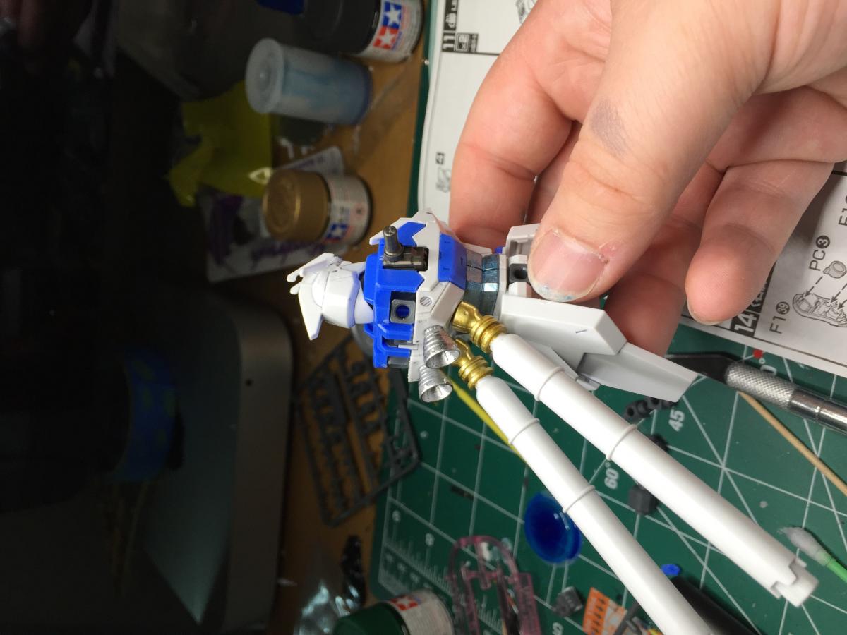

Guest davidwhangchoi Posted March 29, 2015 Posted March 29, 2015 (edited) finished panel lining legs: i used the sharpie silver and a mix of gm20, gm01, gm02. i still need to redo the boxes using a toothpick going to break and then decal next... Edited March 29, 2015 by davidwhangchoi Quote

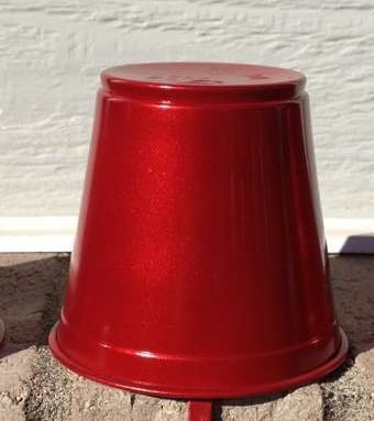

mikeszekely Posted March 29, 2015 Posted March 29, 2015 The auto store is like five minutes from my house. I already ran out, grabbed a can, clipped chunk off a runner, and test sprayed it. Waiting for it to dry enough to handle. It's got the sort of metallic look I wanted, but it's a tad more burgundy that I'd hoped. Quote

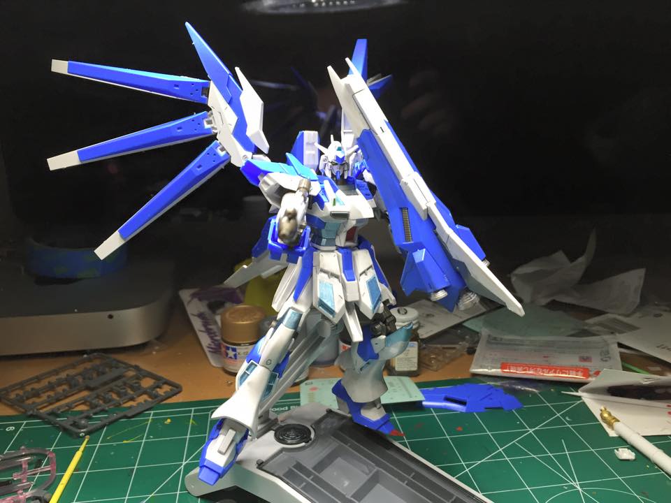

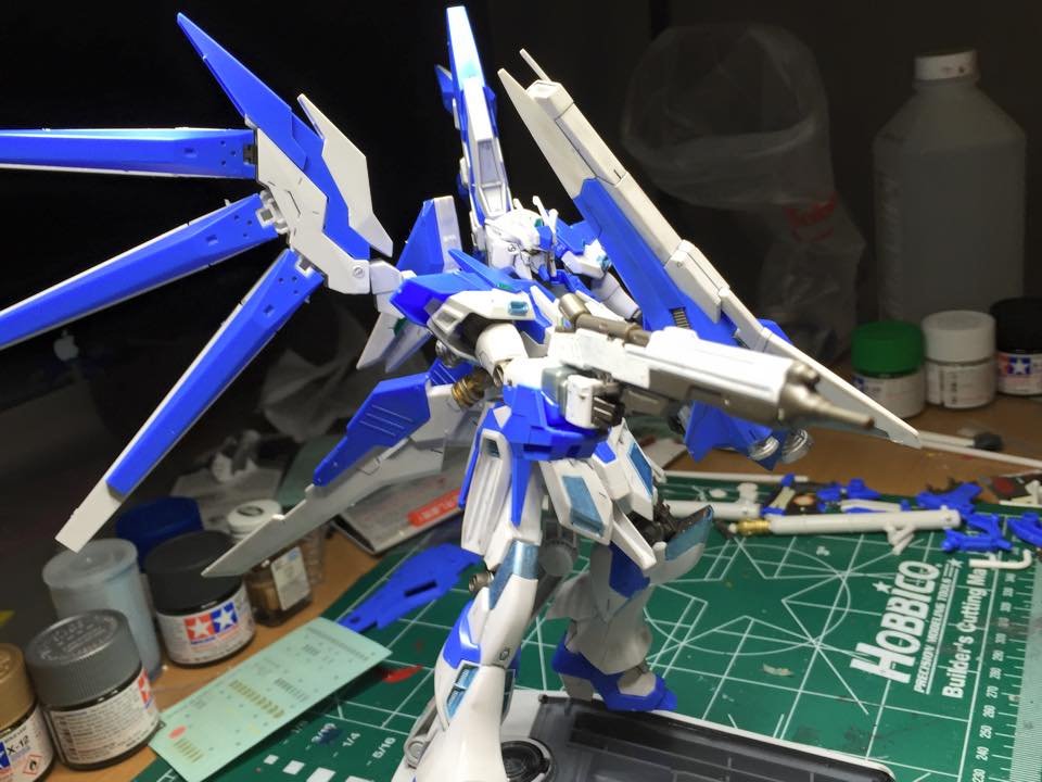

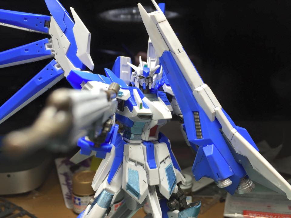

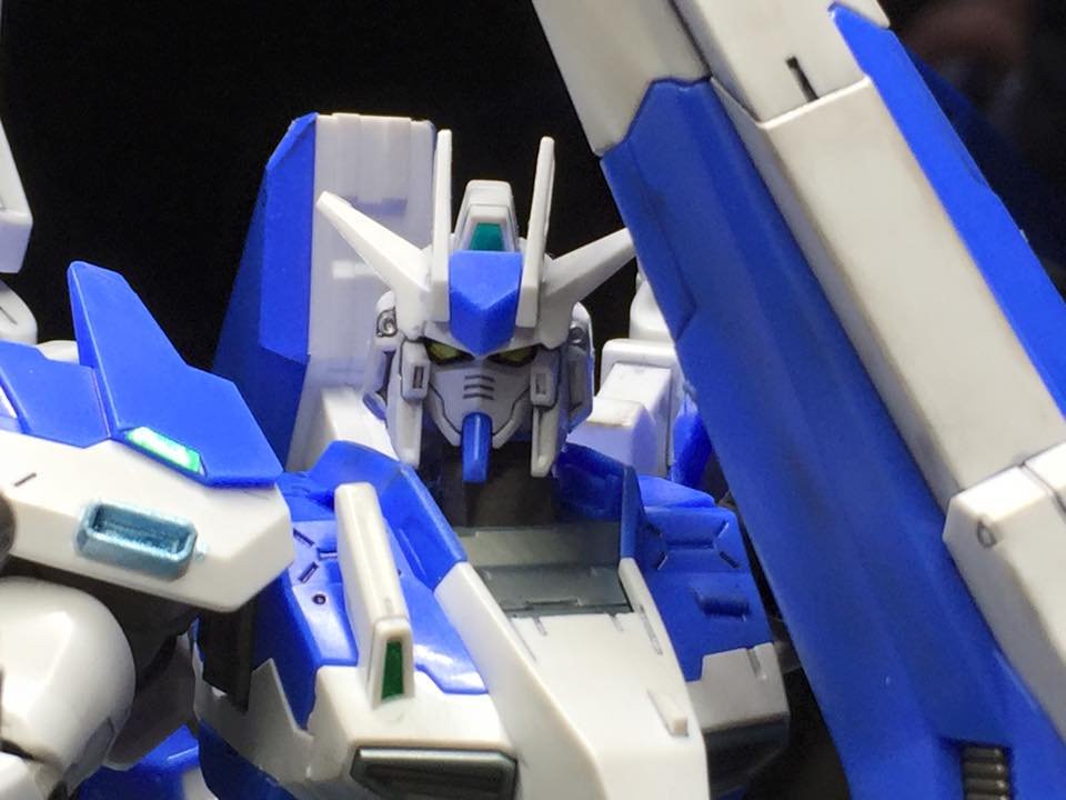

Hikuro Posted March 29, 2015 Posted March 29, 2015 Well here's the progress on the Vrabe. Just a touch of clear blue and silver can really bang your kit. Quote

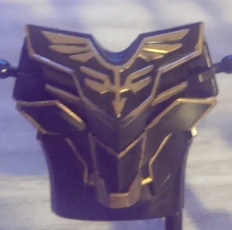

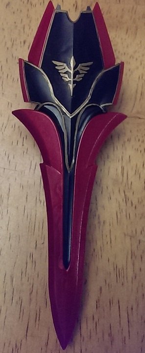

mikeszekely Posted March 30, 2015 Posted March 30, 2015 Is it perfect? No. My inability to stay on the lines for the filigree sure as heck isn't helping, plus the nozzle came off the paint and I got a few splatters before I realized it. I wound up taking the nozzle from the satin clear coat, so now I have to decide if I want to get thinner, clean the nozzle, put it back, then spray, or if I want to use the gloss enamel clear coat I found in the garage. Since the clear coat is primarily to keep the Sharpie from rubbing off, I was thinking I should use a cool clear coat, and try to keep it shiny. I'm actually digging the red. When I noticed the plastic had a maroon-ish look, I realized that the lighting was the issue. In brighter light, this color is exactly what I had in mind. Quote

mikeszekely Posted March 30, 2015 Posted March 30, 2015 So, the gloss enamel clear coat is too hot for Sharpies. The satin acrylic works much better, but the gold is still a little duller. At least it won't rub off. I'm building today. If all goes well, Sinanju will be done tonight or tomorrow. Quote

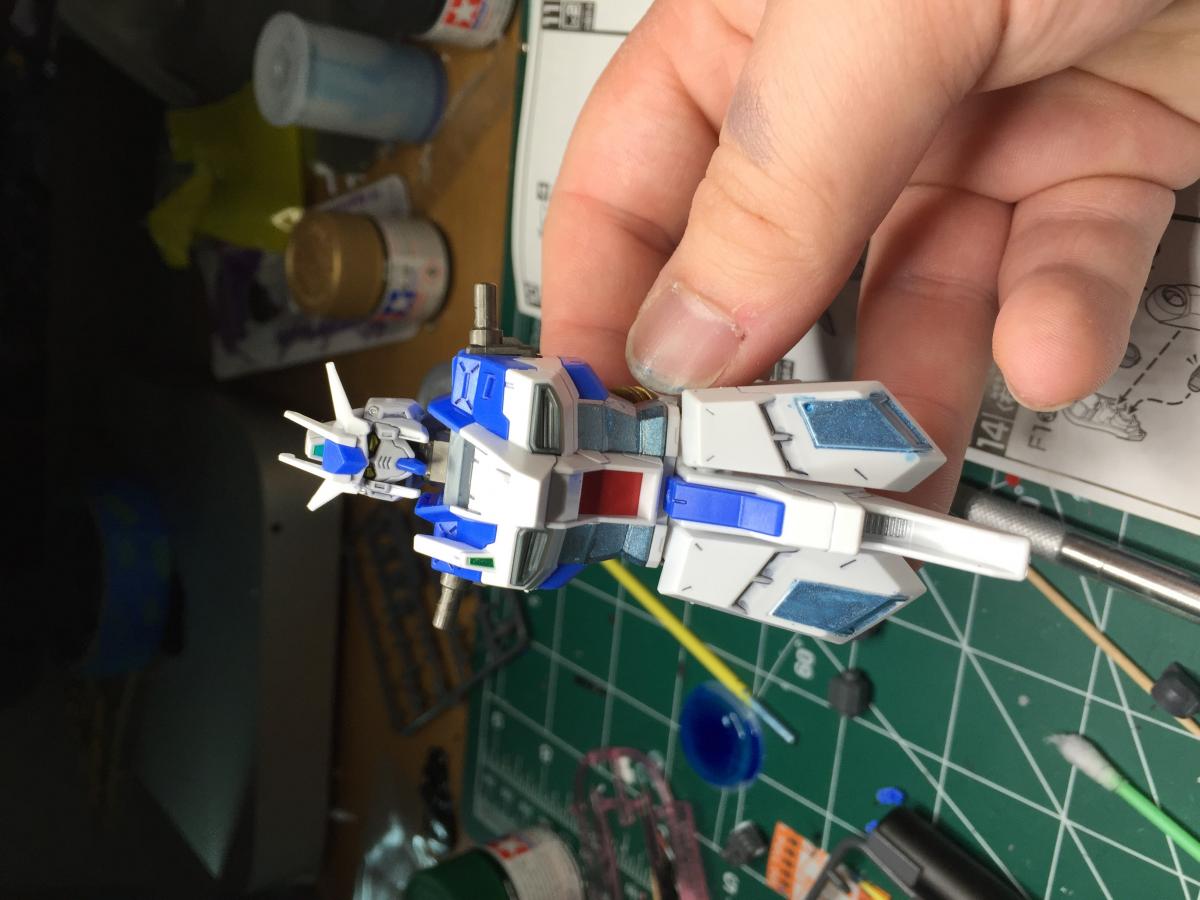

Guest davidwhangchoi Posted March 30, 2015 Posted March 30, 2015 (edited) hey guys, does this look real? i tried following that video beginners gunpla. i attempted using the silver on the side hip bars to make it look like paint chipping of metal using a tooth pick. Edited March 30, 2015 by davidwhangchoi Quote

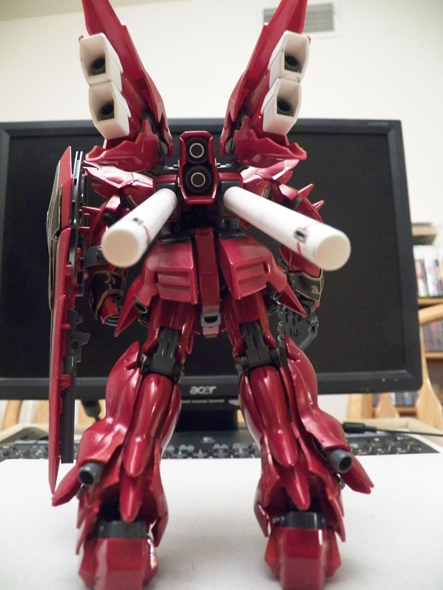

mog_kupo Posted March 31, 2015 Posted March 31, 2015 That looks real enough for me, and pretty cool too I just got my first can of Mr Hobby Topcoat (it took only 6 months from HK to Mexico XD) so I decided to finish my first RG model, the MK II and the Zeta 3 Quote
Guest davidwhangchoi Posted March 31, 2015 Posted March 31, 2015 Mk ii looks really great Mog-kupo, i cant really see the lines on the zeta, maybe the photo angle, but the mk ii looks clear Quote
GU-11 Posted March 31, 2015 Posted March 31, 2015 (edited) hey guys, does this look real? i tried following that video beginners gunpla. i attempted using the silver on the side hip bars to make it look like paint chipping of metal using a tooth pick. Realistic enough, I'd say. I think the one on the left looks better, as the paint chipping effect runs along the length of the edge and is more staggered. Edited March 31, 2015 by GU-11 Quote
Hikuro Posted March 31, 2015 Posted March 31, 2015 hey guys, does this look real? i tried following that video beginners gunpla. i attempted using the silver on the side hip bars to make it look like paint chipping of metal using a tooth pick. So long as you keep it subtle. Don't over do it like I've tend too. Just along the edges and nothing more. I just finished the Vrabe's build. It's a nice kit. There are problems such as polycaps not fitting on the joints well and causing them to drop. Would of loved a new Beam rifle, it just screams for something new like the shield. I did do an awful lot of painting to this kit. But god I just love the headsculpt on this, LOVE IT. Quote

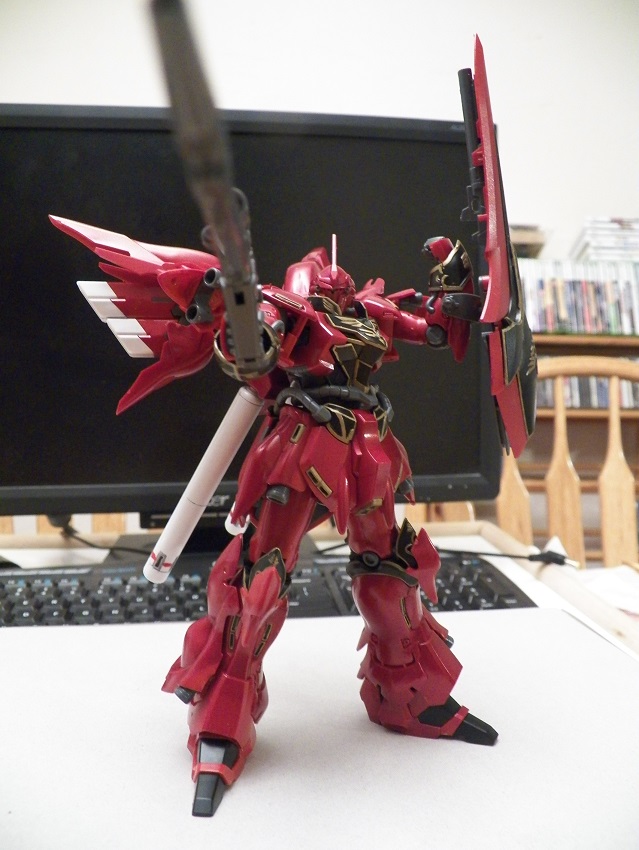

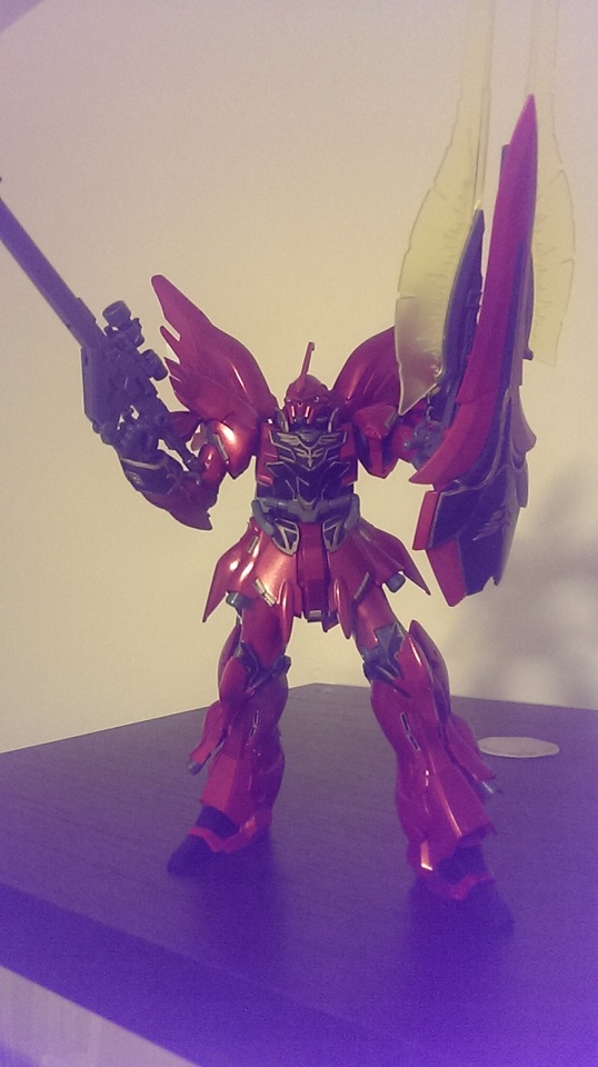

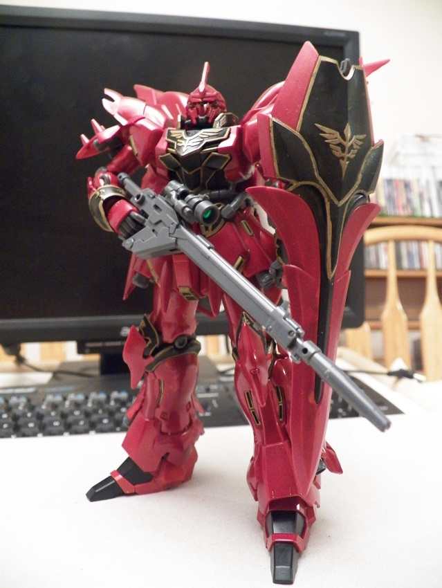

mikeszekely Posted March 31, 2015 Posted March 31, 2015 Looking good, Hikuro. I dig the stuff you painted silver and did the blue clear coat on. It's a subtle effect. In other news... I need to get a better camera than my crappy phone. I took four pics, but none of them really do justice. Maybe tomorrow I'll see if my wife's phone takes better pics, or if I can find a spot with better lighting. But yeah, Sinanju's done. The only stickers I used are the green dots for the mono eye and the rifle scope. All the filigree was done with a gold Sharpie, then clear coated with Kyrlon satin acrylic. I used the same gold Sharpie/clear coat combo to color the yellow vernier parts on the legs, shoulders, and skirt armor so that they'd match the filigree. I painted in the black lines on the yellow verniers and the verniers on the propellant tanks, dabbed a little gray on the head vulcans, used a silver Sharpie to outline the verniers on the propellant tanks, tried (poorly) to draw the red line between the propellant tank verniers with a Gundam marker, and painted the white rings inside the center backpack thrusters. But mostly what I did is spray each and every red part with Dupli-Color Toreador Red lacquer. And while there are spots where, if you look closely, I messed up a little by spraying too much or too unevenly (honestly, I really should have just been more patient), the overall result is fantastic. It's a little darker, but it has a shiny, slightly metallic finish. Even my wife, who really doesn't pay much attention to my models, seemed impressed. Quote
Guest davidwhangchoi Posted March 31, 2015 Posted March 31, 2015 Realistic enough, I'd say. I think the one on the left looks better, as the paint chipping effect runs along the length of the edge and is more staggered. ok, thanks for the feedback So long as you keep it subtle. Don't over do it like I've tend too. Just along the edges and nothing more. I just finished the Vrabe's build. It's a nice kit. There are problems such as polycaps not fitting on the joints well and causing them to drop. Would of loved a new Beam rifle, it just screams for something new like the shield. I did do an awful lot of painting to this kit. Vrabe1.jpgVrabe2.jpgvrabe3.jpgvrabe4.jpg But god I just love the headsculpt on this, LOVE IT. i'll try and keep it on the edges, wow the vrabe is looking good. awesome how you keep pumping out kits at an insane rate:) Looking good, Hikuro. I dig the stuff you painted silver and did the blue clear coat on. It's a subtle effect. In other news... I need to get a better camera than my crappy phone. I took four pics, but none of them really do justice. Maybe tomorrow I'll see if my wife's phone takes better pics, or if I can find a spot with better lighting. But yeah, Sinanju's done. The only stickers I used are the green dots for the mono eye and the rifle scope. All the filigree was done with a gold Sharpie, then clear coated with Kyrlon satin acrylic. I used the same gold Sharpie/clear coat combo to color the yellow vernier parts on the legs, shoulders, and skirt armor so that they'd match the filigree. I painted in the black lines on the yellow verniers and the verniers on the propellant tanks, dabbed a little gray on the head vulcans, used a silver Sharpie to outline the verniers on the propellant tanks, tried (poorly) to draw the red line between the propellant tank verniers with a Gundam marker, and painted the white rings inside the center backpack thrusters. But mostly what I did is spray each and every red part with Dupli-Color Toreador Red lacquer. And while there are spots where, if you look closely, I messed up a little by spraying too much or too unevenly (honestly, I really should have just been more patient), the overall result is fantastic. It's a little darker, but it has a shiny, slightly metallic finish. Even my wife, who really doesn't pay much attention to my models, seemed impressed. IMG_20150330_224928.jpg even with the phone shot, it looks really rich and detailed, (i'm using my cheap phone camera too lol.) Quote
Hikuro Posted March 31, 2015 Posted March 31, 2015 Looking good, Hikuro. I dig the stuff you painted silver and did the blue clear coat on. It's a subtle effect. In other news... I need to get a better camera than my crappy phone. I took four pics, but none of them really do justice. Maybe tomorrow I'll see if my wife's phone takes better pics, or if I can find a spot with better lighting. But yeah, Sinanju's done. The only stickers I used are the green dots for the mono eye and the rifle scope. All the filigree was done with a gold Sharpie, then clear coated with Kyrlon satin acrylic. I used the same gold Sharpie/clear coat combo to color the yellow vernier parts on the legs, shoulders, and skirt armor so that they'd match the filigree. I painted in the black lines on the yellow verniers and the verniers on the propellant tanks, dabbed a little gray on the head vulcans, used a silver Sharpie to outline the verniers on the propellant tanks, tried (poorly) to draw the red line between the propellant tank verniers with a Gundam marker, and painted the white rings inside the center backpack thrusters. But mostly what I did is spray each and every red part with Dupli-Color Toreador Red lacquer. And while there are spots where, if you look closely, I messed up a little by spraying too much or too unevenly (honestly, I really should have just been more patient), the overall result is fantastic. It's a little darker, but it has a shiny, slightly metallic finish. Even my wife, who really doesn't pay much attention to my models, seemed impressed. IMG_20150330_224928.jpg Need a flash on that or something or a lamp, it's still really dark for me to see the colors. Thanks though, if I get a chance, I'll do a titanium Sinanju....there's a guy I know who might comission me to do it after he saw the normal one I did. ok, thanks for the feedback i'll try and keep it on the edges, wow the vrabe is looking good. awesome how you keep pumping out kits at an insane rate:) even with the phone shot, it looks really rich and detailed, (i'm using my cheap phone camera too lol.) Yep, I need to cut back. I still got a ton of kits left in my closet but April is gonna be a tough month with the Apple Watch coming out and all. Quote
mikeszekely Posted March 31, 2015 Posted March 31, 2015 Need a flash on that or something or a lamp, it's still really dark for me to see the colors. The only lamp I have is a dim LED on my nightstand. Actually, my wife decided to go all out on saving electricity and we've replaced most of our lightbulbs with LEDs, so almost all of the lighting in my house is muted and awful. Luckily, I remembered we had a largish, mid-range camera we bought when I went to Beijing. Took me awhile to find it, since I haven't used it since, but I was able to take much better pics with it. Quote
Guest davidwhangchoi Posted March 31, 2015 Posted March 31, 2015 (edited) The only lamp I have is a dim LED on my nightstand. Actually, my wife decided to go all out on saving electricity and we've replaced most of our lightbulbs with LEDs, so almost all of the lighting in my house is muted and awful. Luckily, I remembered we had a largish, mid-range camera we bought when I went to Beijing. Took me awhile to find it, since I haven't used it since, but I was able to take much better pics with it. 103_0342.JPG103_0343.JPG103_0345.JPG oh yeah, the pics are much clearer, it's looks so shiny... tried to practice a little more metal paint scrapes on the knee area and added some more on the side holsters: just practicing,,, Edited March 31, 2015 by davidwhangchoi Quote
McFly!! Posted March 31, 2015 Posted March 31, 2015 Great stuff guys! David, I wonder if using a q-tip with some/very little of the metallic ink would work similar to dry brushing for that effect you're going for? Quote
Guest davidwhangchoi Posted March 31, 2015 Posted March 31, 2015 Great stuff guys! David, I wonder if using a q-tip with some/very little of the metallic ink would work similar to dry brushing for that effect you're going for? that sounds good.. how do i do it? (sorry my technique is limited to what i learned from the videos and MW members. i've just learned to use a toothpick and been trying to use that for a solution to everything now. lol how would i go about using a q-tip, so far i've used the q-tips to wipe off excess panel lines... Quote
Hikuro Posted March 31, 2015 Posted March 31, 2015 Hm I dunno. The essence of dry brushing is to have most of the paint gone by wiping it away with several good strokes on paper or material that isn't your model. What I do and it's brilliant, I buy a standard wide model brush and I cut about half the brush length so it's super stuff. Dab it on a small amount of silver than stroke away till it starts to loose about 90-95% of its paint. Then carefully just lazy like flick around the edges of the plastic. If you used a q tip it'd be difficult. The paint I'd see be absorbs into the cotton and smearing on the plastic. I can test the idea out but I don't see it really working. It's the same problem using the padded tip on my weathering stuff, it's meant for smearing not precise control like a flat head brush. I'll usually cut a few wide brushes so I got multiple materials I can apply for controlled areas. If you look on the shield of my Vrabe you'll see where using a stiff model brush I got the angles more defined. Quote
Guest davidwhangchoi Posted March 31, 2015 Posted March 31, 2015 Hm I dunno. The essence of dry brushing is to have most of the paint gone by wiping it away with several good strokes on paper or material that isn't your model. What I do and it's brilliant, I buy a standard wide model brush and I cut about half the brush length so it's super stuff. Dab it on a small amount of silver than stroke away till it starts to loose about 90-95% of its paint. Then carefully just lazy like flick around the edges of the plastic. If you used a q tip it'd be difficult. The paint I'd see be absorbs into the cotton and smearing on the plastic. I can test the idea out but I don't see it really working. It's the same problem using the padded tip on my weathering stuff, it's meant for smearing not precise control like a flat head brush. I'll usually cut a few wide brushes so I got multiple materials I can apply for controlled areas. If you look on the shield of my Vrabe you'll see where using a stiff model brush I got the angles more defined. ok thanks Hikuro for the tips! i didn't get the brushes you recommended yet bc i forgot once we starting talking about the sharpie and gundam paint markers and i've been toying around with them the last few days. i'll try and get some the next time i get to gundam planet. Quote
