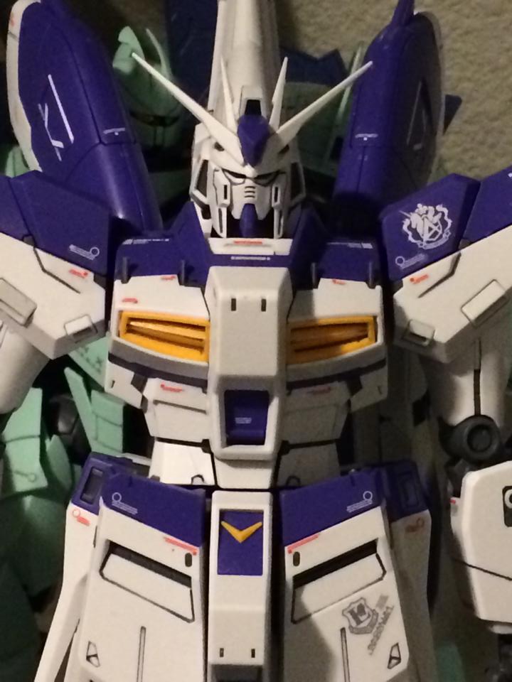

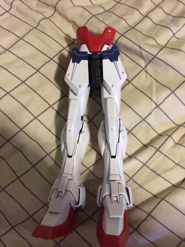

Hikuro Posted September 18, 2014 Posted September 18, 2014 Here's where I'm at after nearly 2 months of working on my PG Wing Zero. Wiring....wiring....wiring. but despite some issues, the overall look of the Hi-Nu Vers Ka came out well! Quote
Nekko Basara Posted September 18, 2014 Posted September 18, 2014 That Hi-Nu is a beast, Hikuro. I love it!I... can't even fathom the PG kits. Very brave. Quote

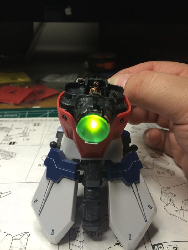

Hikuro Posted September 19, 2014 Posted September 19, 2014 (edited) Oh snap I got my LED dealios in and they were actually 2 sets. So now either my Sazabi or my 1/500ever Yamato can has lights. Well, if I do Yamato I need a red one. Oh woops forgot, wing zero's head now lights up, which is a plus! Most of the torso is built, tomorrow I'll be building the armor around the head and getting that back pack up and running. Edited September 19, 2014 by Hikuro Quote

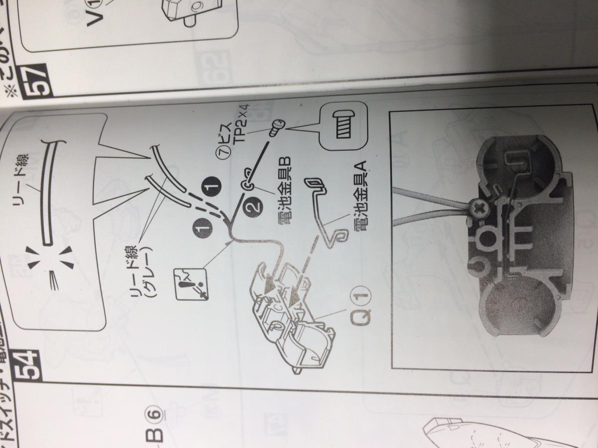

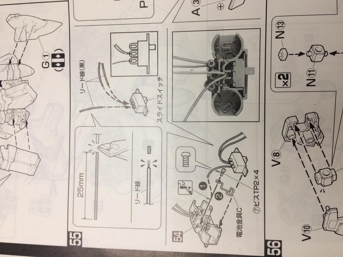

Hikuro Posted September 21, 2014 Posted September 21, 2014 Okay so if I'm understanding it, on step 54 it's telling me to cut the exposed ends of the wires and screw them in place which that'll be interesting cause the screws can't punch thru 1 wire let alone two. But which set of wires? The wires connecting to the chest portion or the wires connecting to the head portion? Does it really even matter? Step 55 is that showing me I need to take the last 2 bits of wire cut them to 25mm and some how loop them around the circuit board? How the hell do I do that with tiny lil wires? Then it doesn't even really tell you where those wires really need to connect too cause they cut the diagram in half! Quote
Scyla Posted September 21, 2014 Posted September 21, 2014 Please take the flowing sentences with a huge pile of salt because I can't read Japanese nor have I ever built such a kit. My best guess is that the two wires from 54-1 there is one from the chest and one from the head and on step 55 there is also one from the head and one from the chest LED because they should create an electrical circuit. He seems to have one gray wire and one black wire fixated by the same screw maybe check this video out to get an idea. He doesn't show the wiring of the part but you get an idea what goes where ad Minute 5:50. The screw in 54-2 should not pinch trough the wires. The washer part of the piece from 54-2 where the screw goes through should pinch the wires between the battery compartment and the metal washer. The same goes for the small 25 mm piece of wire. This is both indicated buy the symbol with the question mark. I would fixate one end of the wire to the switch first and than screw in the washer bit. Second install the switch and third try to fiddle the wire into its position Checking the manual pictures for a second time it could also indicate to insert the wires inside the hole for the screw where the gap is on the piece. However this is hard to tell from the images. So you should probably get a second opinion on this. Quote
Hikuro Posted September 21, 2014 Posted September 21, 2014 On 9/21/2014 at 6:28 PM, Scyla said: Please take the flowing sentences with a huge pile of salt because I can't read Japanese nor have I ever built such a kit. My best guess is that the two wires from 54-1 there is one from the chest and one from the head and on step 55 there is also one from the head and one from the chest LED because they should create an electrical circuit. He seems to have one gray wire and one black wire fixated by the same screw maybe check this video out to get an idea. He doesn't show the wiring of the part but you get an idea what goes where ad Minute 5:50. The screw in 54-2 should not pinch trough the wires. The washer part of the piece from 54-2 where the screw goes through should pinch the wires between the battery compartment and the metal washer. The same goes for the small 25 mm piece of wire. This is both indicated buy the symbol with the question mark. I would fixate one end of the wire to the switch first and than screw in the washer bit. Second install the switch and third try to fiddle the wire into its position Checking the manual pictures for a second time it could also indicate to insert the wires inside the hole for the screw where the gap is on the piece. However this is hard to tell from the images. So you should probably get a second opinion on this. Yeah still a little hard to tell. I've seen this guys video and from what I gathered he couldn't even get his to light up so he goofed somewhere. and I think it was that he just placed the wires wrong area. sadly my day is pretty busy I hope that after I come back from puppy training I can sit down, look these over and figure it out better. It DOES show like what was said couple days ago, you got a ton more slack in the wiring than what's really needed...I could almost see where if you're not careful and you put in to much pressure on bunching them all up you could pop a wire out of place. It was interesting cause when I did the screwing on the chest piece, the screws were very loose fitting, but the time I got to the head unit, VERY tight fit, no way those were going to wiggle off like the chest portion did and that's what took so damn long to do. Just gonna contemplate it for a while, I don't wanna muck this up. Quote
David Hingtgen Posted September 22, 2014 Posted September 22, 2014 On 9/21/2014 at 5:45 PM, Hikuro said: IMG_0062.JPG Okay so if I'm understanding it, on step 54 it's telling me to cut the exposed ends of the wires and screw them in place which that'll be interesting cause the screws can't punch thru 1 wire let alone two. But which set of wires? The wires connecting to the chest portion or the wires connecting to the head portion? Does it really even matter? The wires wrap around the "post" of the screw, under the screw head. As the screw is tightened, the head will press against them, holding them in place against piece "B". The real goal, is to electrically connect the wires to piece B. The screw is doing so mechanically, but it'd be better to solder if possible. Their suggestion to cut off the stripped ends is just nuts. You want the stripped ends contacting the screw etc. You'll want enough stripped length to wrap around under the screw-head. Of these two wires---one should go to the chest, and one to the head, but both meet up at "piece B" and the screw. The on/off switch should be similar----from the middle post of the switch, one wire to the head, one to the chest. Color-wise---I can't recall which color is supposed to be what on this kit, but so long as you're consistent, it should work (assuming LED is wired correctly, they are one-way devices). Color "A" should meet up at the middle switch-post, and one of each should go to the head and chest. Color "B" should meet up at the screw post and metal-piece "B", with one each going to the head and chest. The only really critical thing, polarity-wise, is the LED itself. Make sure to know which is + and which is -, and that you've got everything matching. And make sure head and chest are the same! Quote IMG_0063.JPG Step 55 is that showing me I need to take the last 2 bits of wire cut them to 25mm and some how loop them around the circuit board? How the hell do I do that with tiny lil wires? Then it doesn't even really tell you where those wires really need to connect too cause they cut the diagram in half! Ok, the 25mm piece of wire? Very similar to what you do in the previous step. You are going to use a screw, to hold the wire against a small piece of metal. This time, piece "C". The wire goes from the on/off switch, to the screw-hole. The screw holds that wire and piece "C" together. And the stripped end of the wire should wrap-around the screw-post, looped around underneath the screw head. The entire kit is designed to be solder-free, but that does lead to some "odd" ways of doing things. Like screwing wires in place! Quote
Hikuro Posted September 22, 2014 Posted September 22, 2014 I tried all night to get it going....I F'ed up bad on it somehow and I dunno where. I think it's just more of the line that it's hard to get the screws in place with those damn metal pins. Quote
David Hingtgen Posted September 22, 2014 Posted September 22, 2014 Again--solder if possible. Few of my kit's connections are "as designed"---because screwing wires together simply doesn't work! Quote
