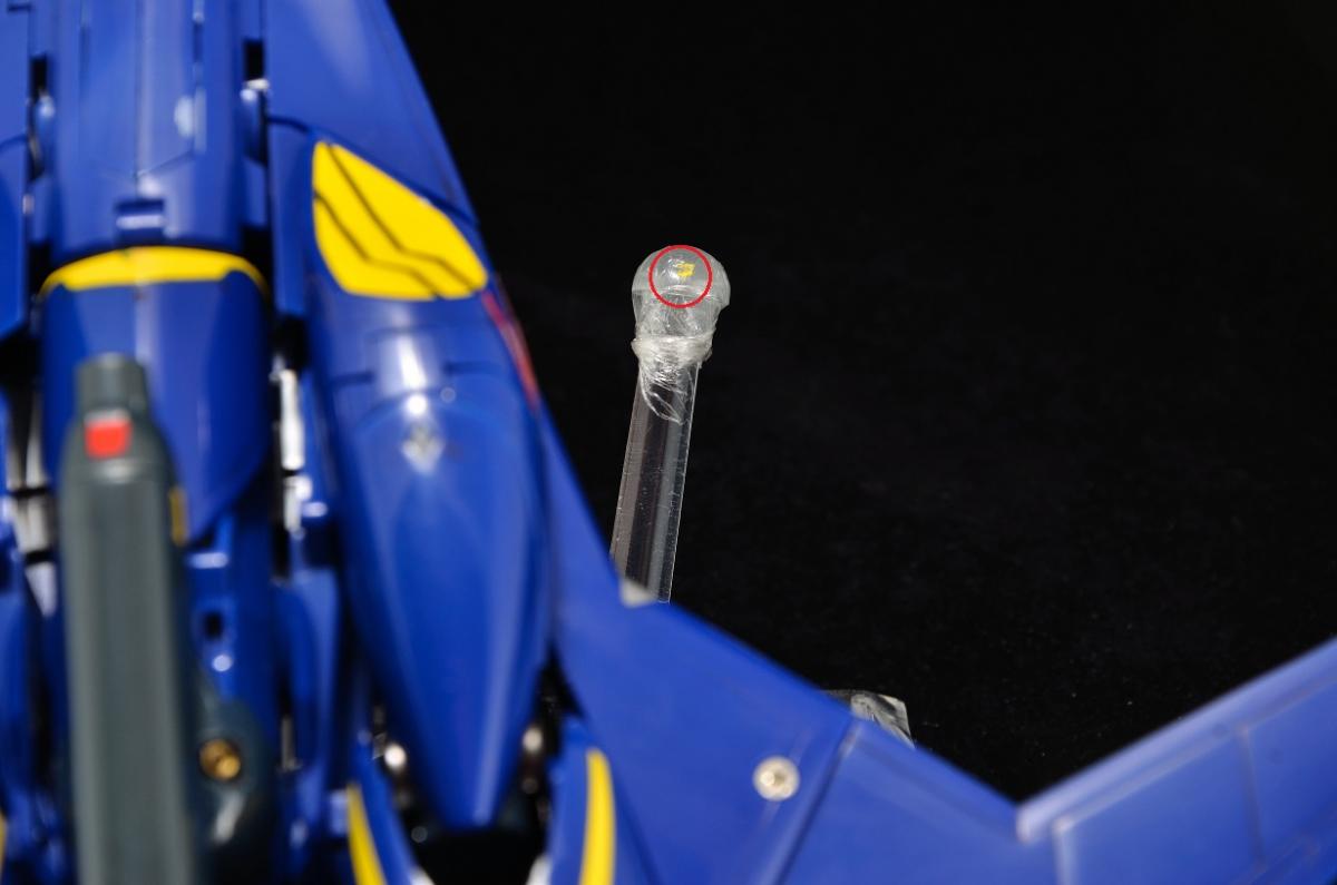

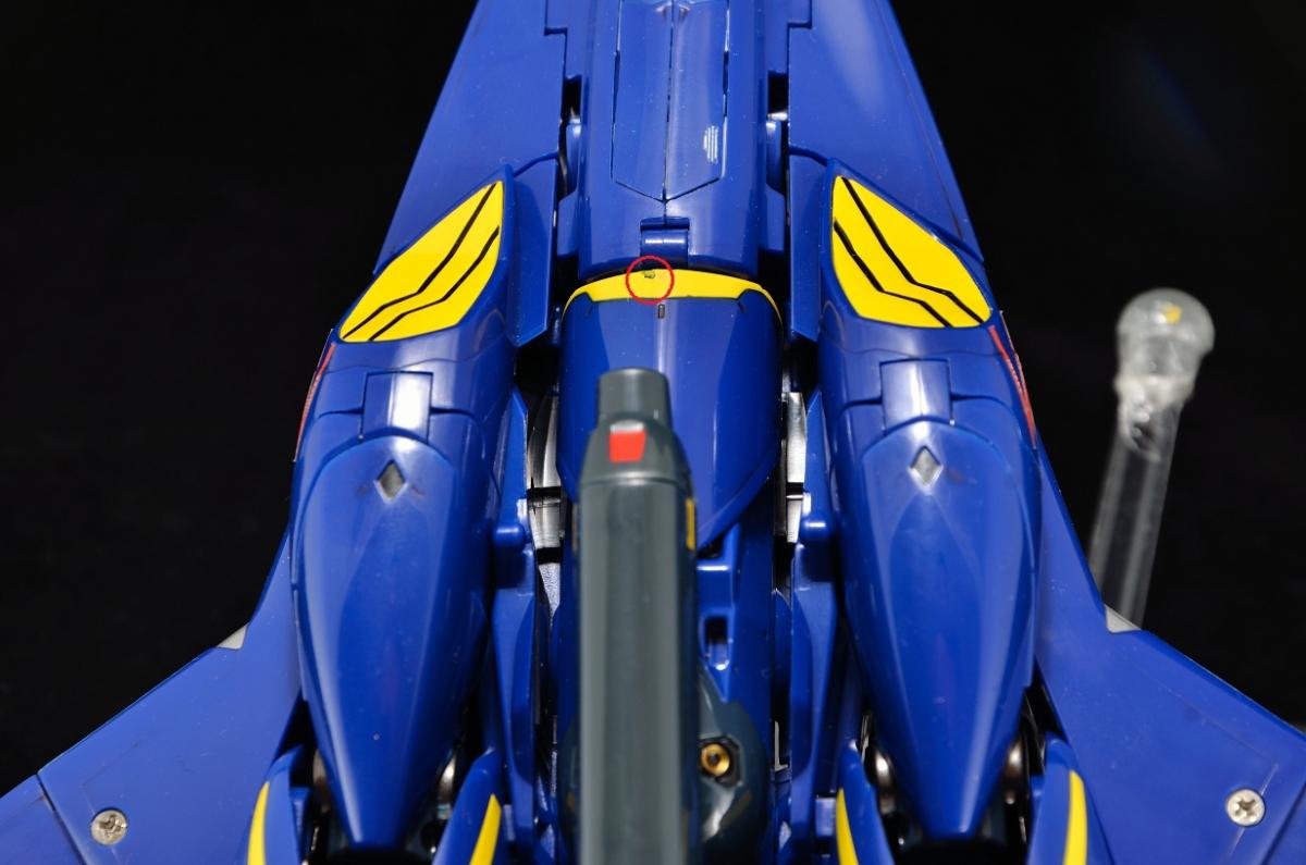

MacrossJunkie Posted October 29, 2012 Posted October 29, 2012 I completely retract my suggestion to use plastic wrap if using the clear tipped stands. This is what happened on my VF-19S when I tried to move it and noticed it was sticking to the stand. Paint missing on the valk: Paint stuck to the tip: The chemicals in the clear tips seems to be seeping through the plastic wrap and reacting with the paint. Either that or somehow plastic wrap became sticky enough to tear paint off. However, I have the black tipped stands also wrapped in plastic wrap and have some clear coated valks sitting on them with no visible reaction or adverse effects. I also had my VF-17S sitting on a clear tipped stand with plastic wrap over the tips but no signs of it eating off the flat clear coat on it. I'm guessing one of two things: Chemicals inside the clear tips (they were washed thoroughly!) are seeping through the relatively porous plastic wrap material and affecting the yamato paints but not future clear coats or... Plastic wrap somehow has enough tack to pull off paint that Yamato uses but not enough to do the same to Future based clear coats. I'm thinking the former is more likely than the latter. Quote

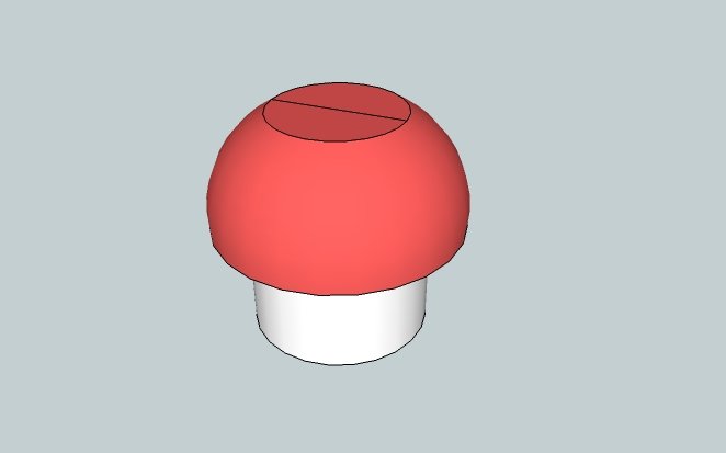

VF5SS Posted November 6, 2012 Posted November 6, 2012 you guys want me to submit those tips i modeled to shapeways Quote
aceoftherebellion Posted November 6, 2012 Posted November 6, 2012 The problem here is that most 'soft' materials that have grip are soft because of chemical plasticizers, AKA chemicals that make the base plastic or vinyl or rubber or whatever softer. That softness makes these materials inherently unstable, meaning chemicals leech out and start to eat at the materials our valkyries are made of- otherwise known as 'paints' and 'plastics'. Obviously, the soft-slightly tacky material the clear tips are made of is particularly bad for this. As for erasers, they're not all created equal. 'soft' erasers are obviously going to be more chemically unstable, and can and will eat through plastics. IDK about the rubber these pencil toppers are made of, but so far all we have are a lot of things that don't work- All we can really do is trial and error and see what would. Quote
