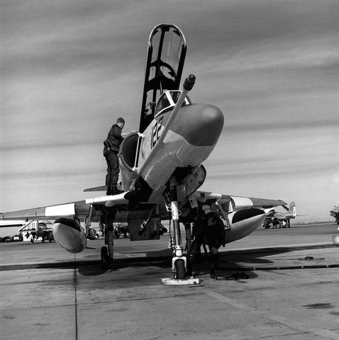

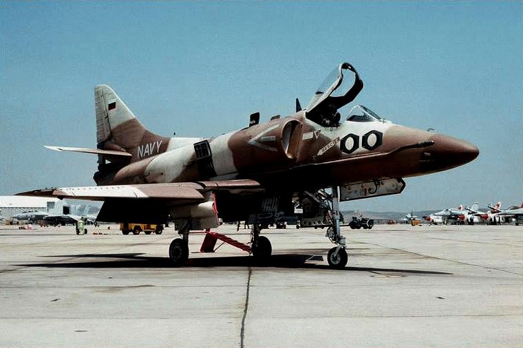

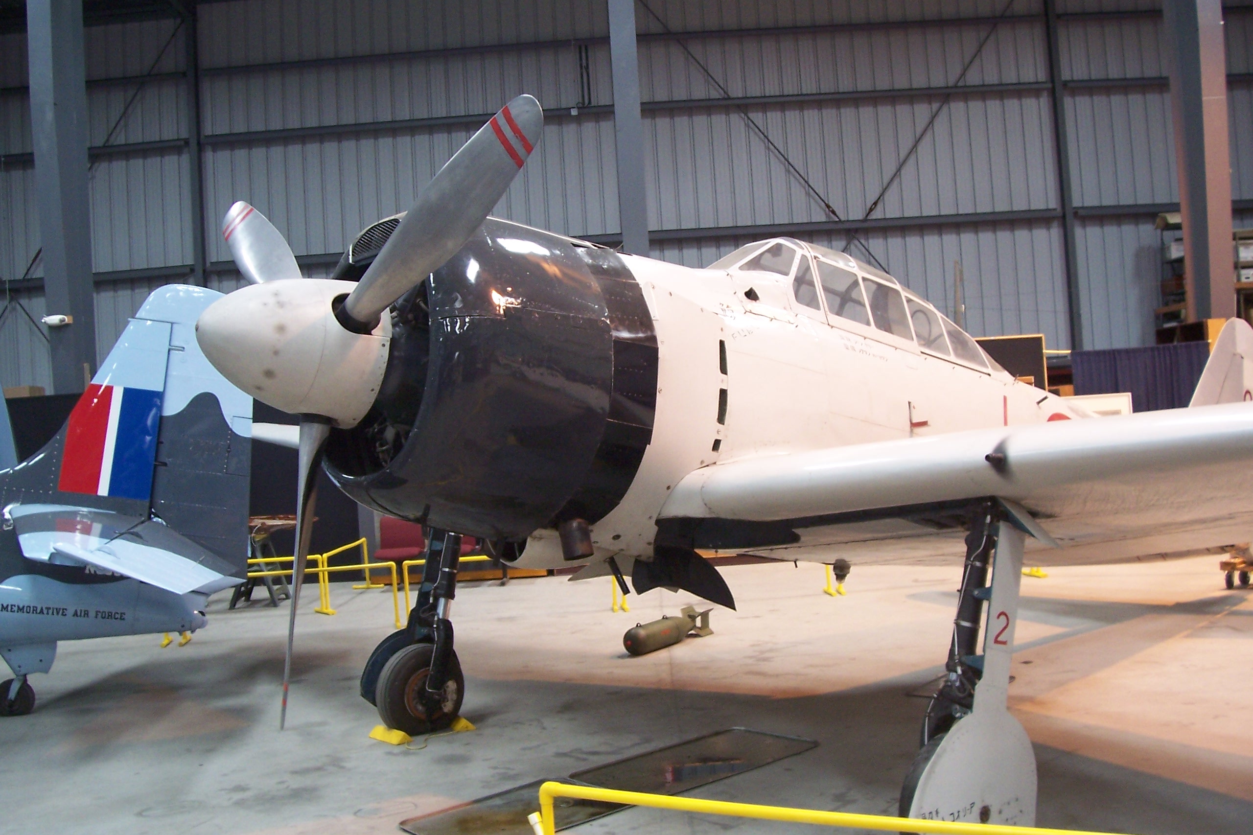

First the front landing gear looks for the front to be similar to the A-4 Skyhawk front landing gear and the two rear undercarriage wheeels look like a Mitsubishi Zero's landing gear I think I have pictures for both. Specificly a 6AMM Mitsubishi Zero Sen X-133 part
The doors are the wrong shape on the Zero...
I can see the airplane in my mind but I can't get it out. I keep coming back to P-47s....
The nose gear is wrong for the A-4 also. Yes it is tall, but it has that elbow... The nose strut on the racer is straight.
