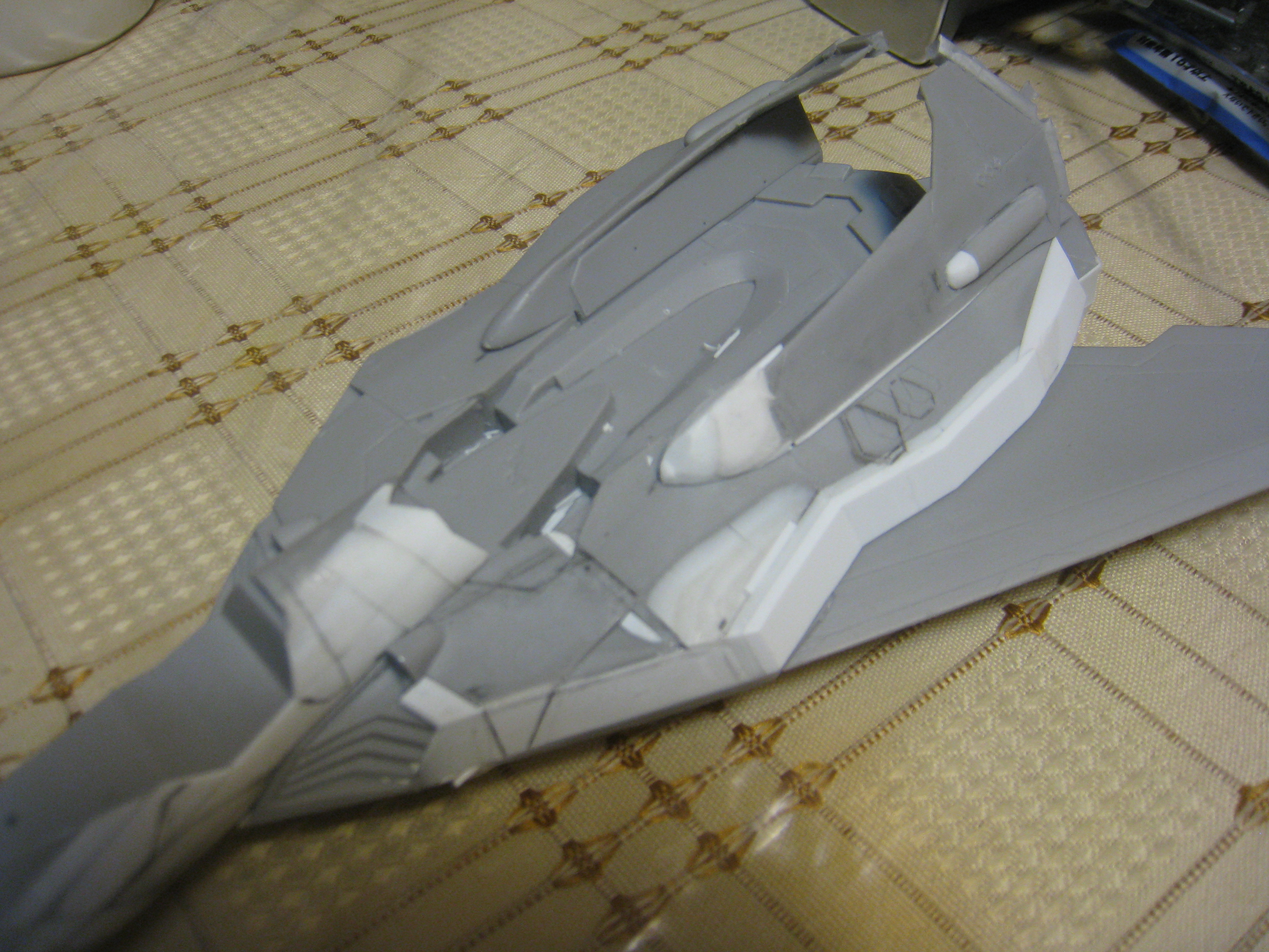

Got the VF-17 kit from the recent WF. After opening the box I'm already very satisfied with what I get. I'd decided to build this kit before Bandai roll out the injection version. This will be my first build on an WF kit.
As I like to build things as close as what the original art work, I started to dig the limited artwork on this valkyrie. I'm lucky to be able to find all that were useful enough for me to refine this kit. Comparing the artwork I found out there are several places that need to work on.

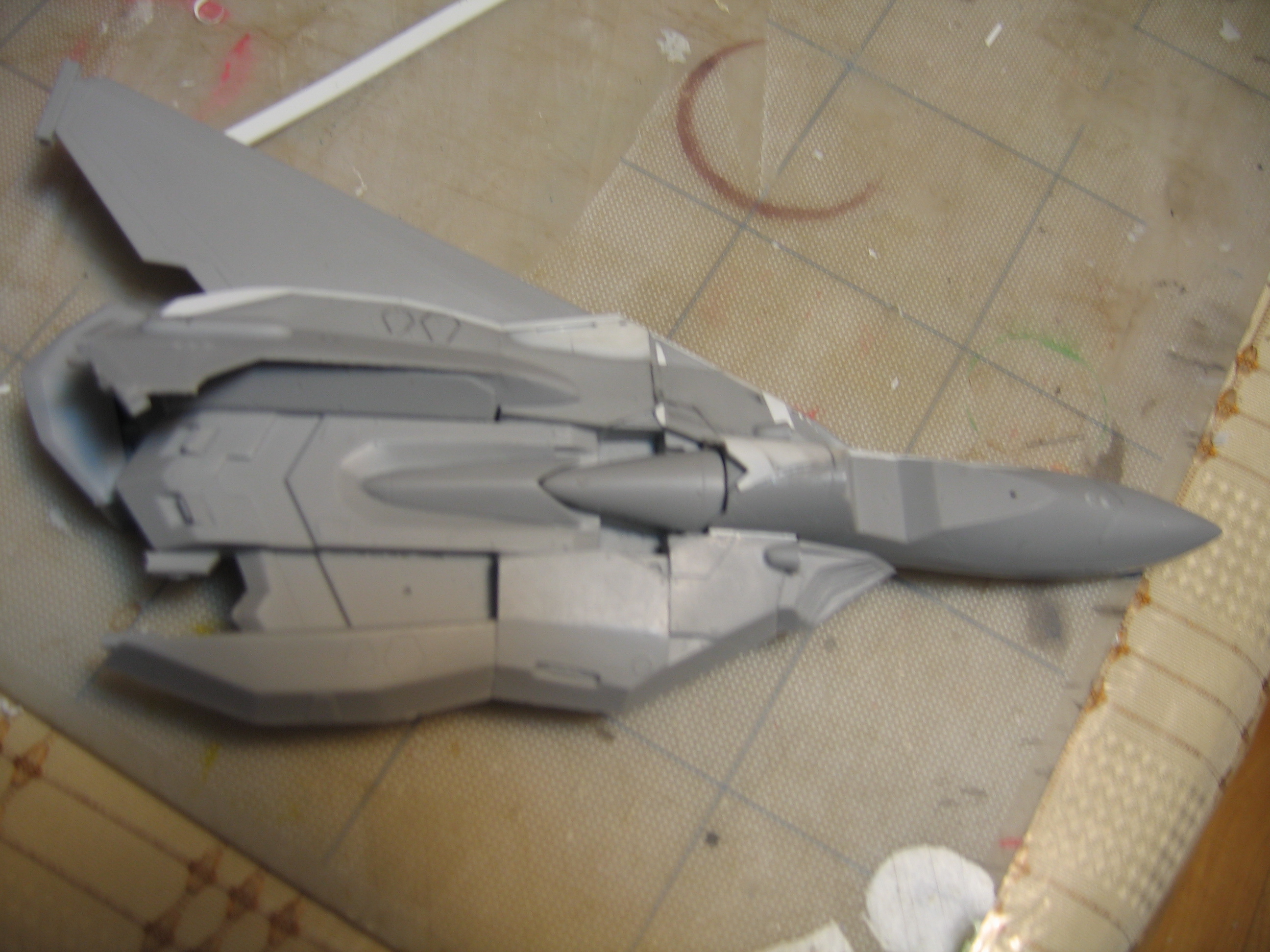

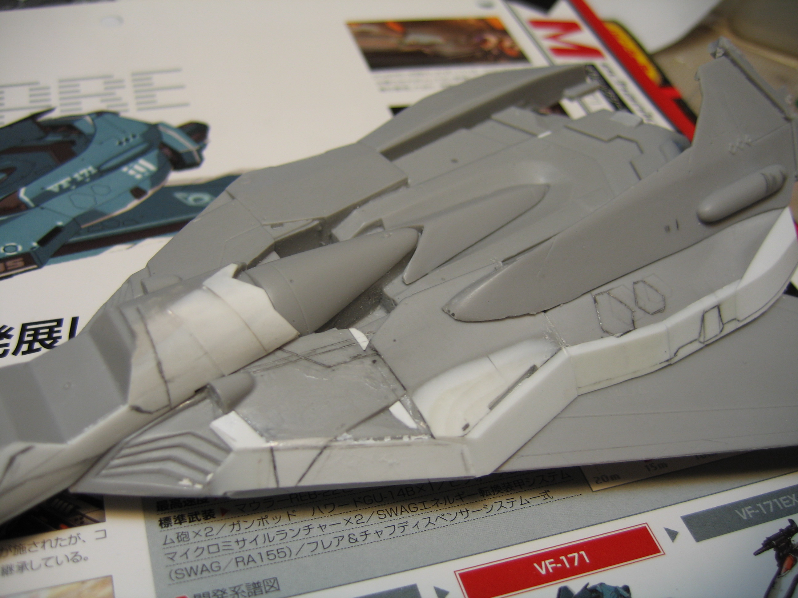

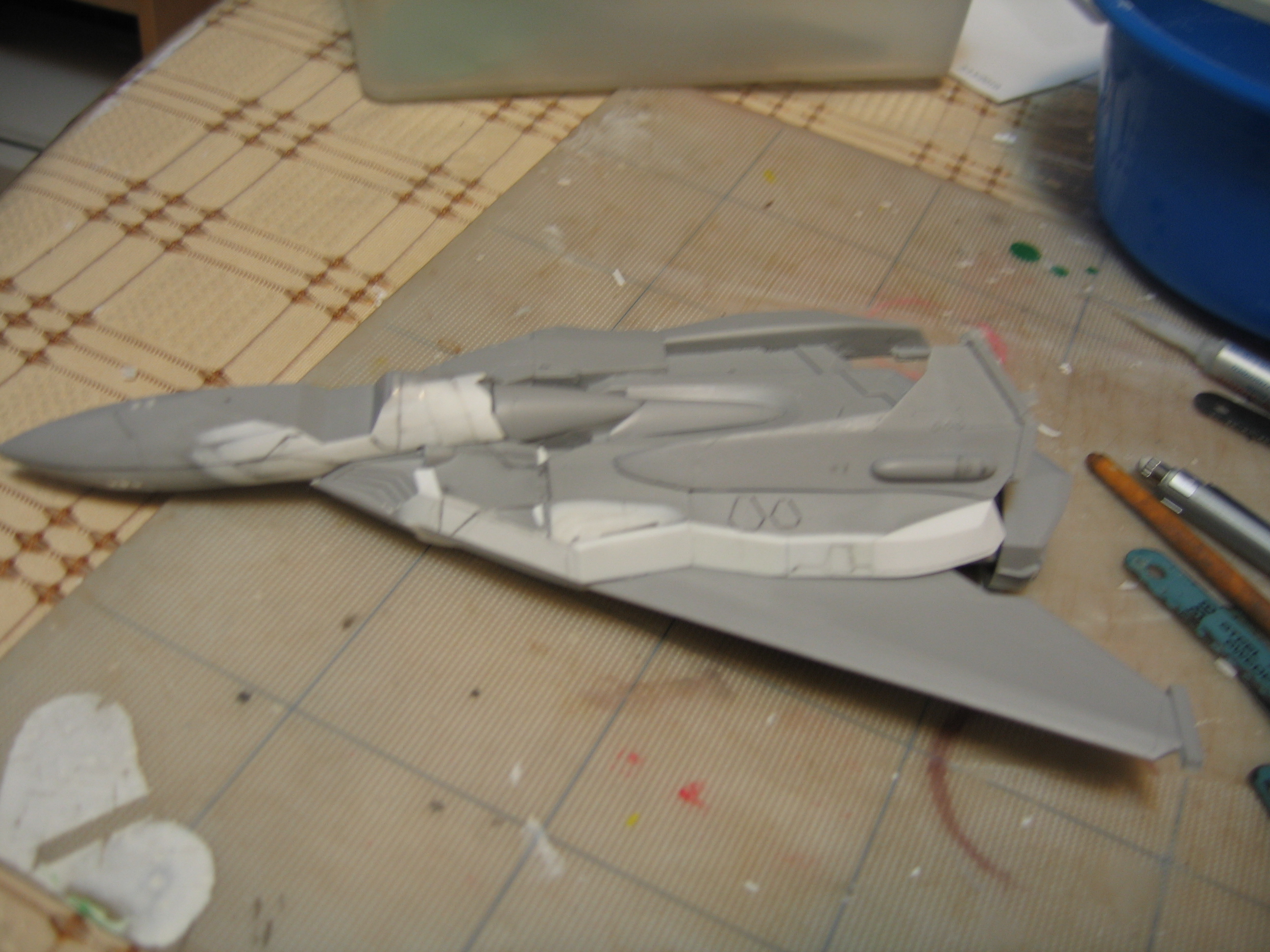

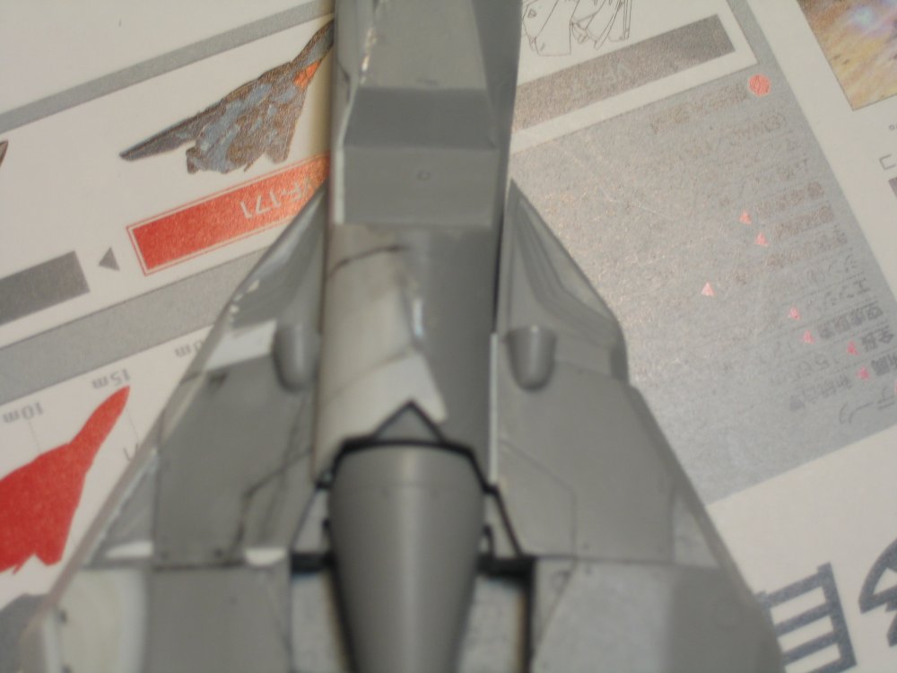

First the side of the fuselage area near the cockpit need to widen. I started to glue layers of styrene at the side then use a sharp chisel to carve the sharp.
Flatten the nozzles at the nose cone and then carving the details.
post-7569-1266685723_thumb.jpgpost-7569-1266685666_thumb.jpgpost-7569-1266685628_thumb.jpg

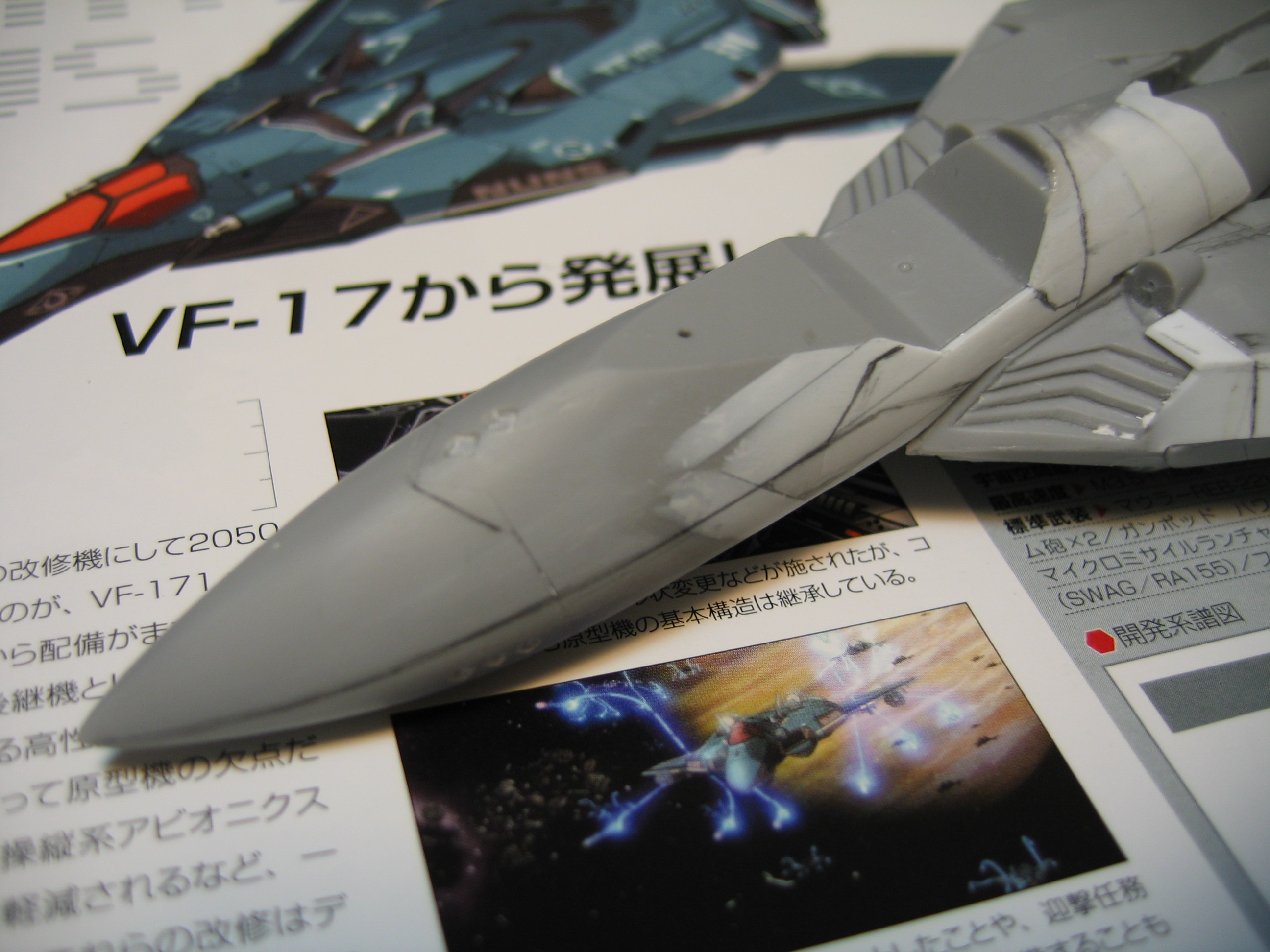

Widening the area near the wing with styrene and then carve out the details. Hope that I can be quick enough to finish this kit.

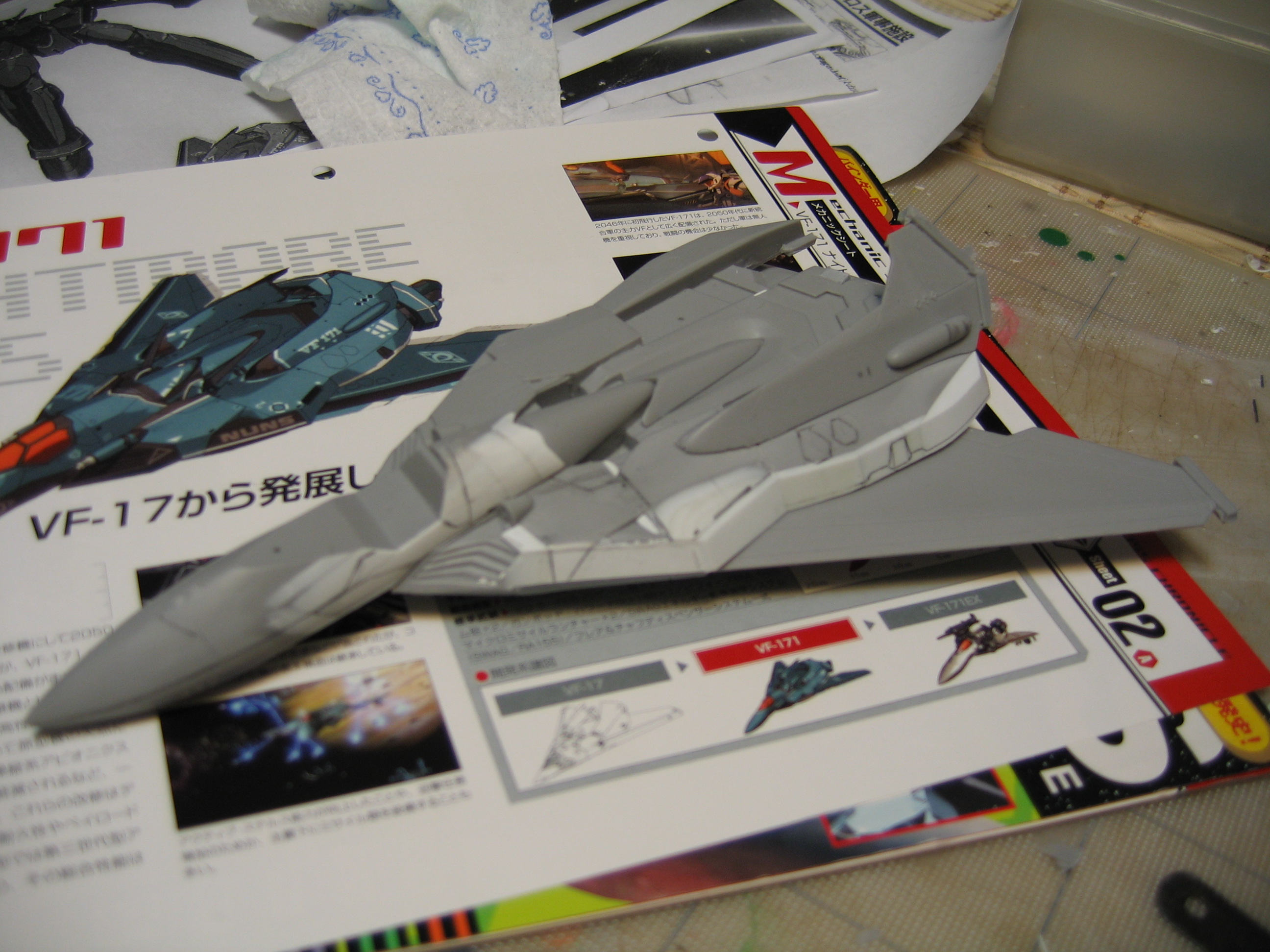

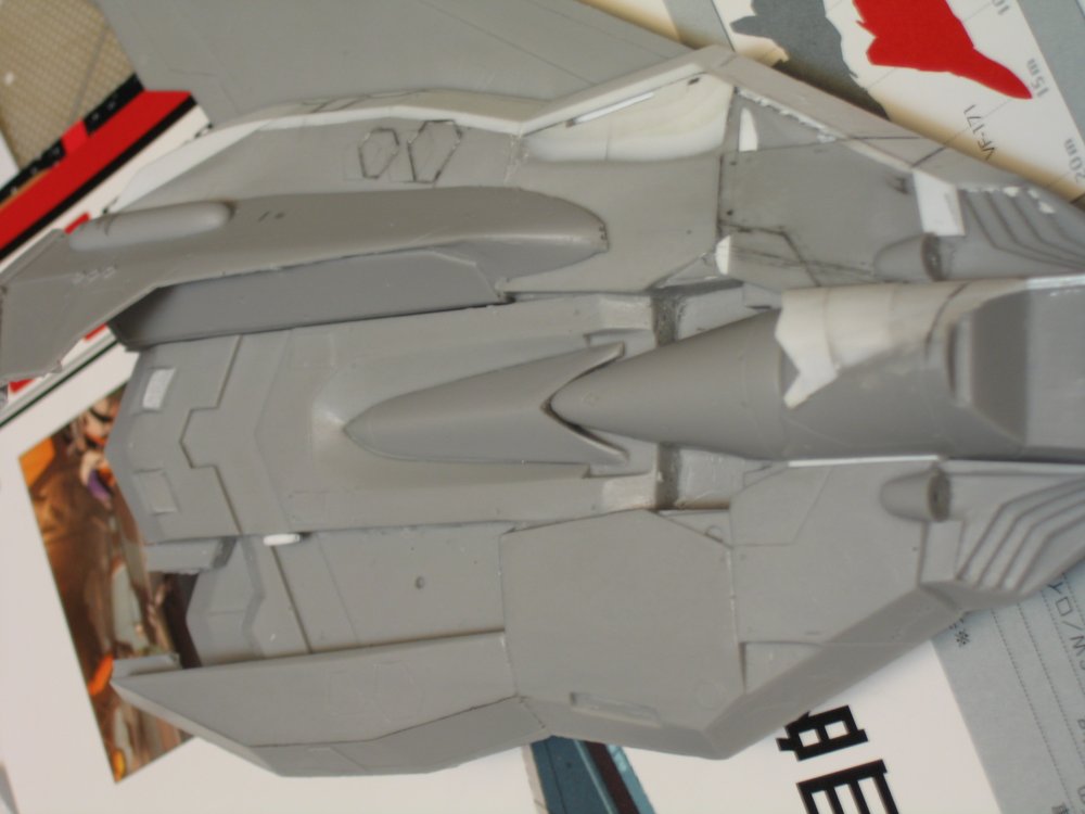

Another update on the VF-171. The modification was first made on the left side of the valkyrie so I can have some guide lines and give you guys on the rate of the modification.

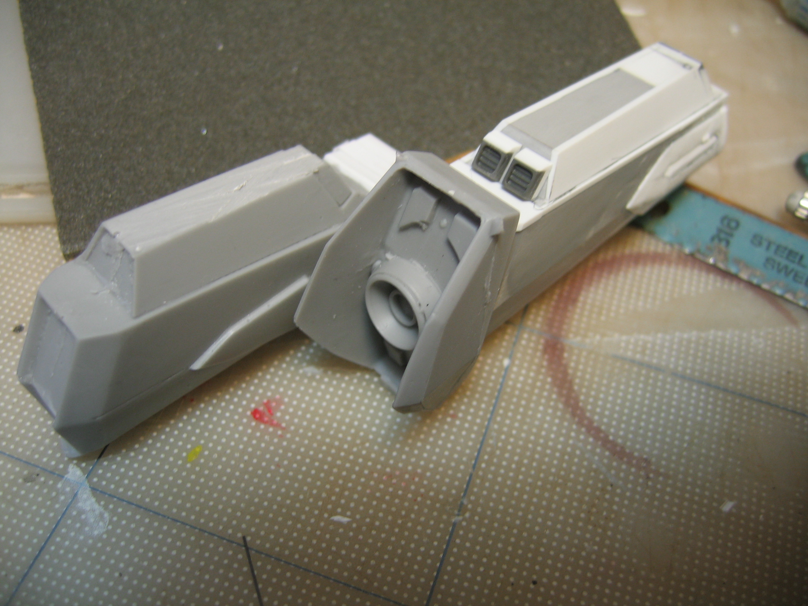

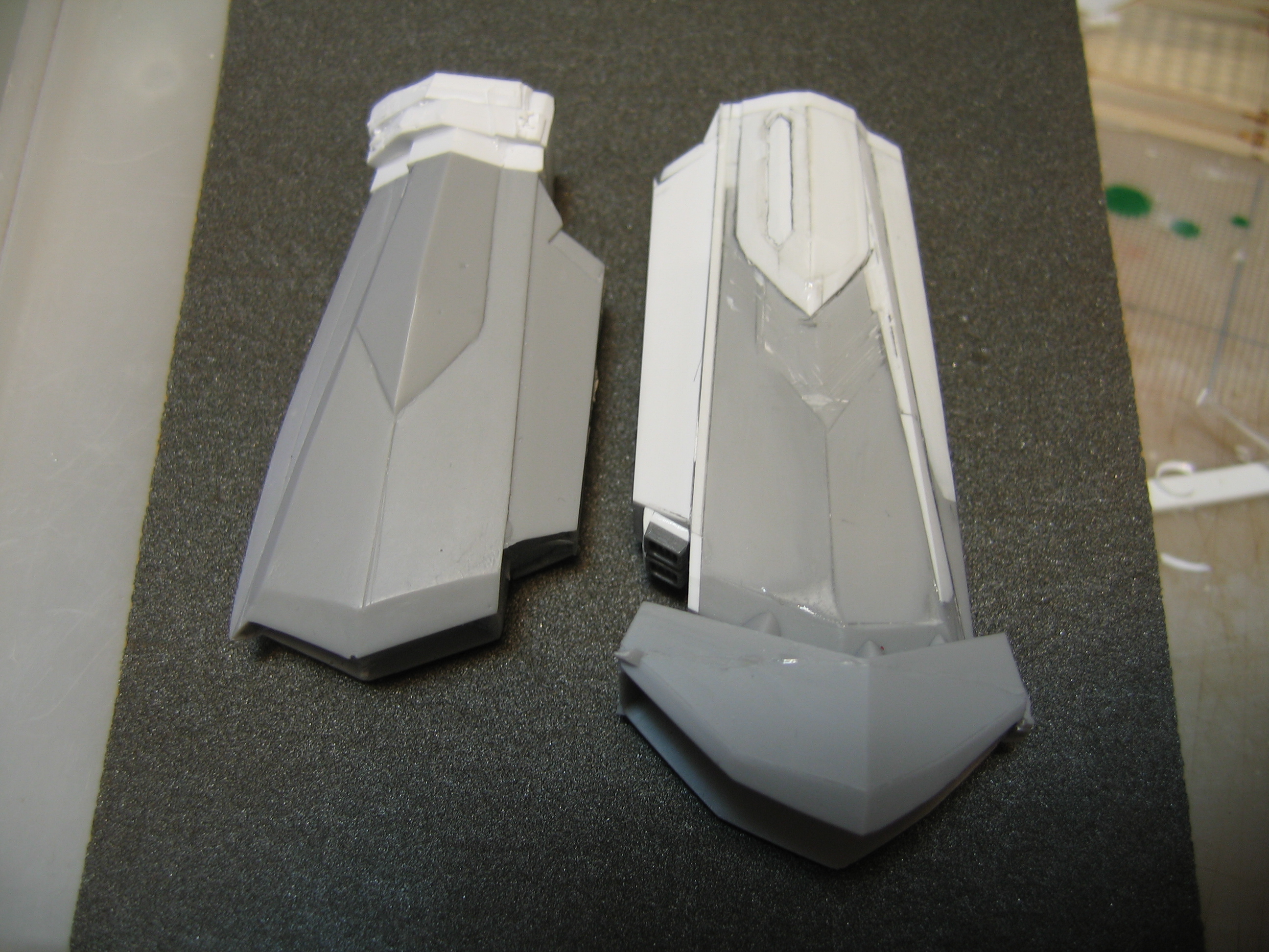

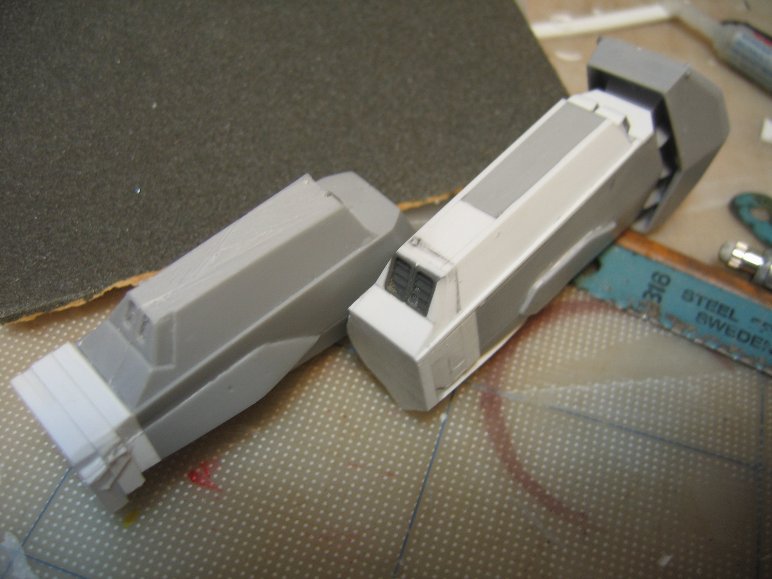

The left upper leg was almost done (engine intake) All white parts on the kit were modifications made with sheet styrene. When comparing the kit with the artworks I found that the lower legs were not long enough so I have to extend it by 10mm. You can all see the comparison at the second picture.
The nozzles at the back of the lower leg part was also modified.
Dry fit to some of the main parts of the valkyrie.

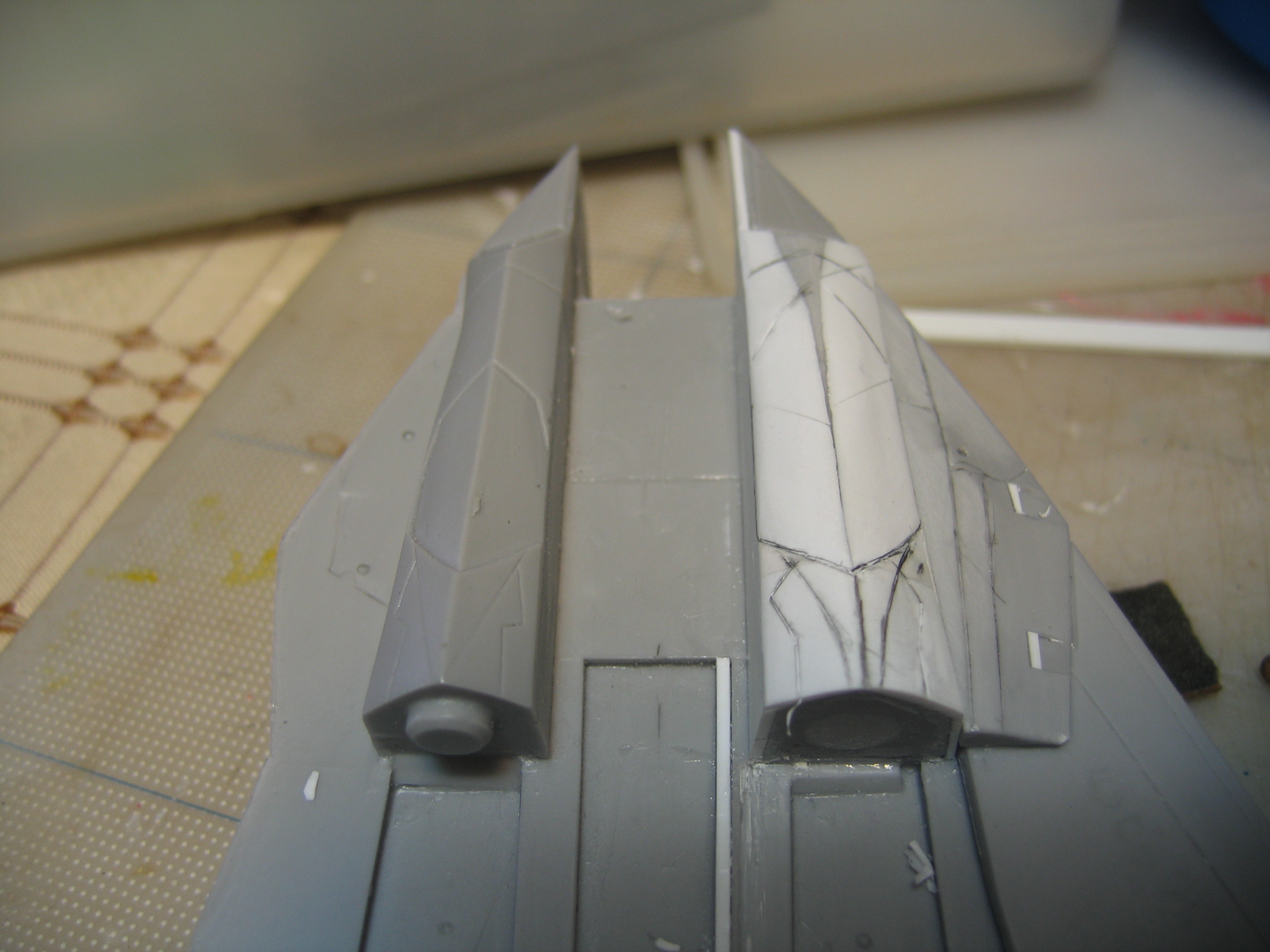

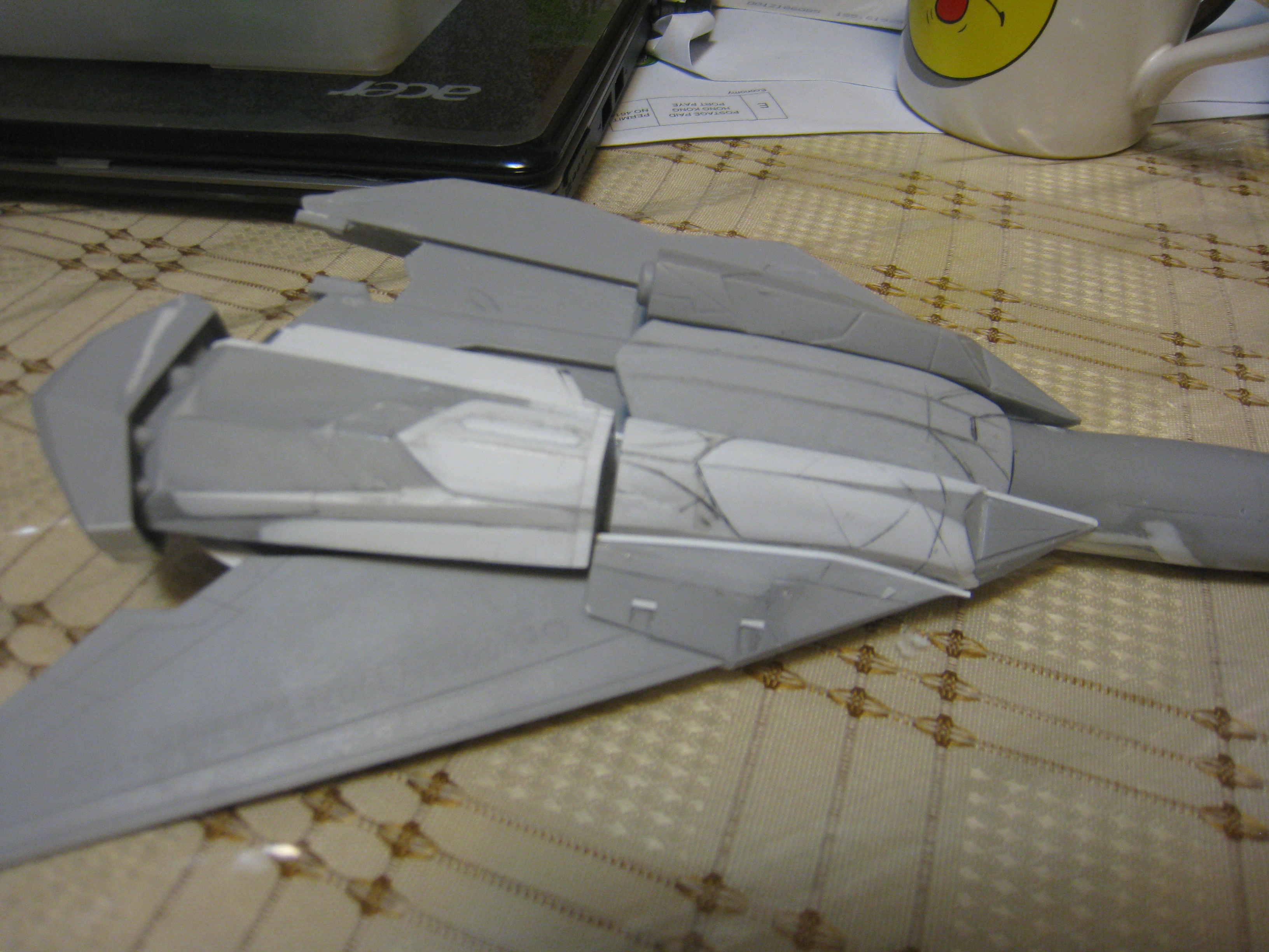

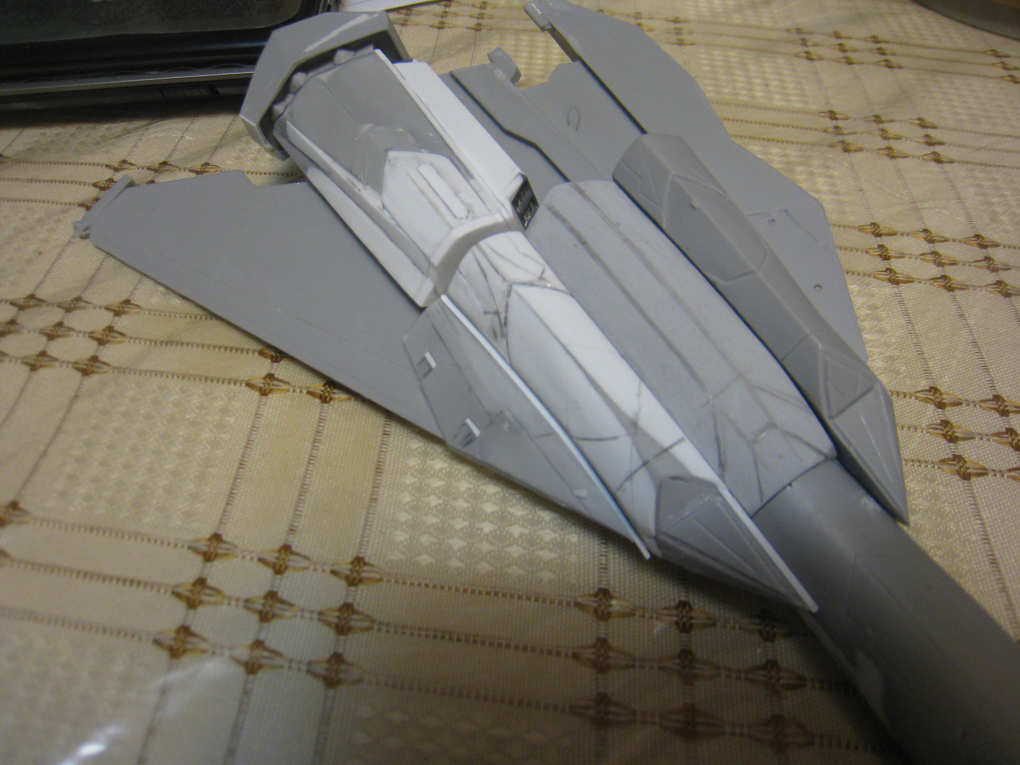

Further progress on the VF-171. A lot of study on the artwork and screen captures made by members here. Here are the pics of the fuselage and the wing. Only half of the plane was modified to show the amount of modification was required on the kit to make it more accurate.
