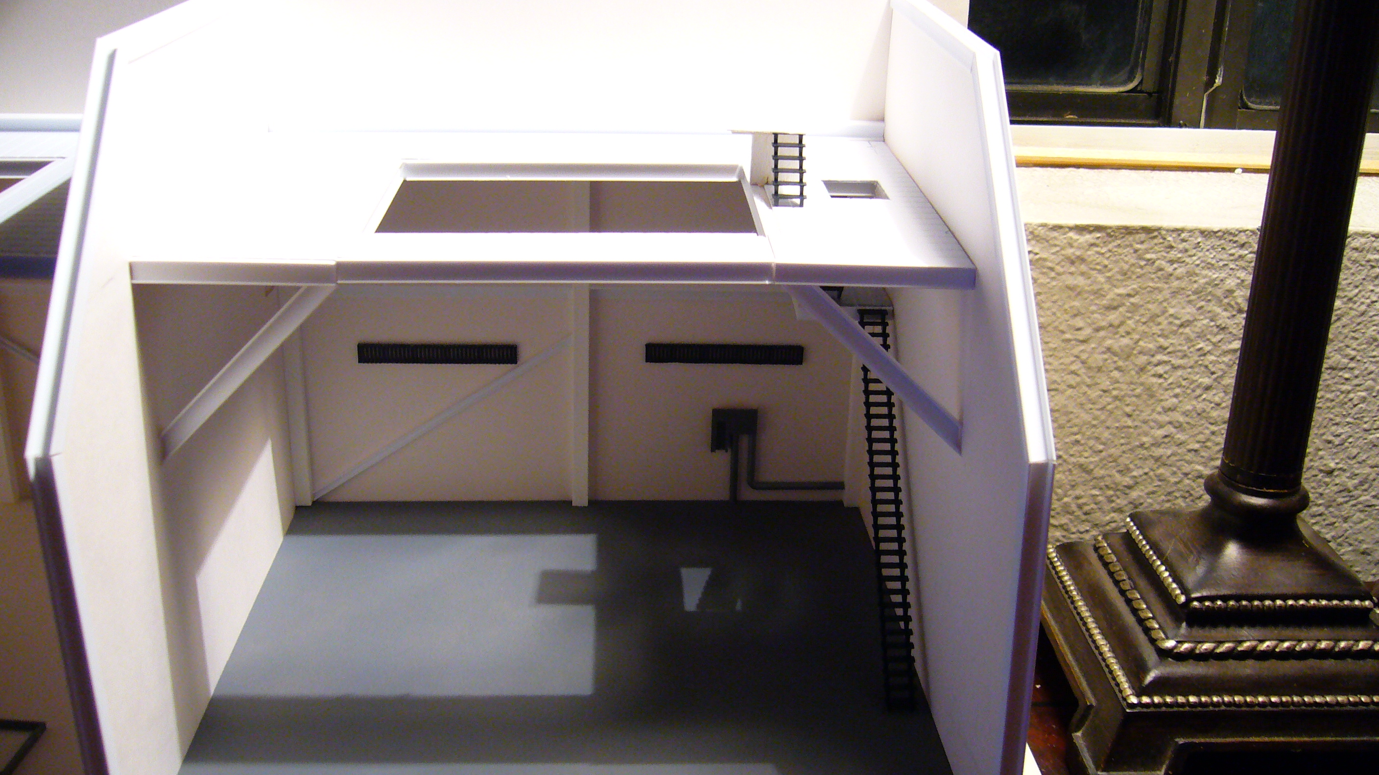

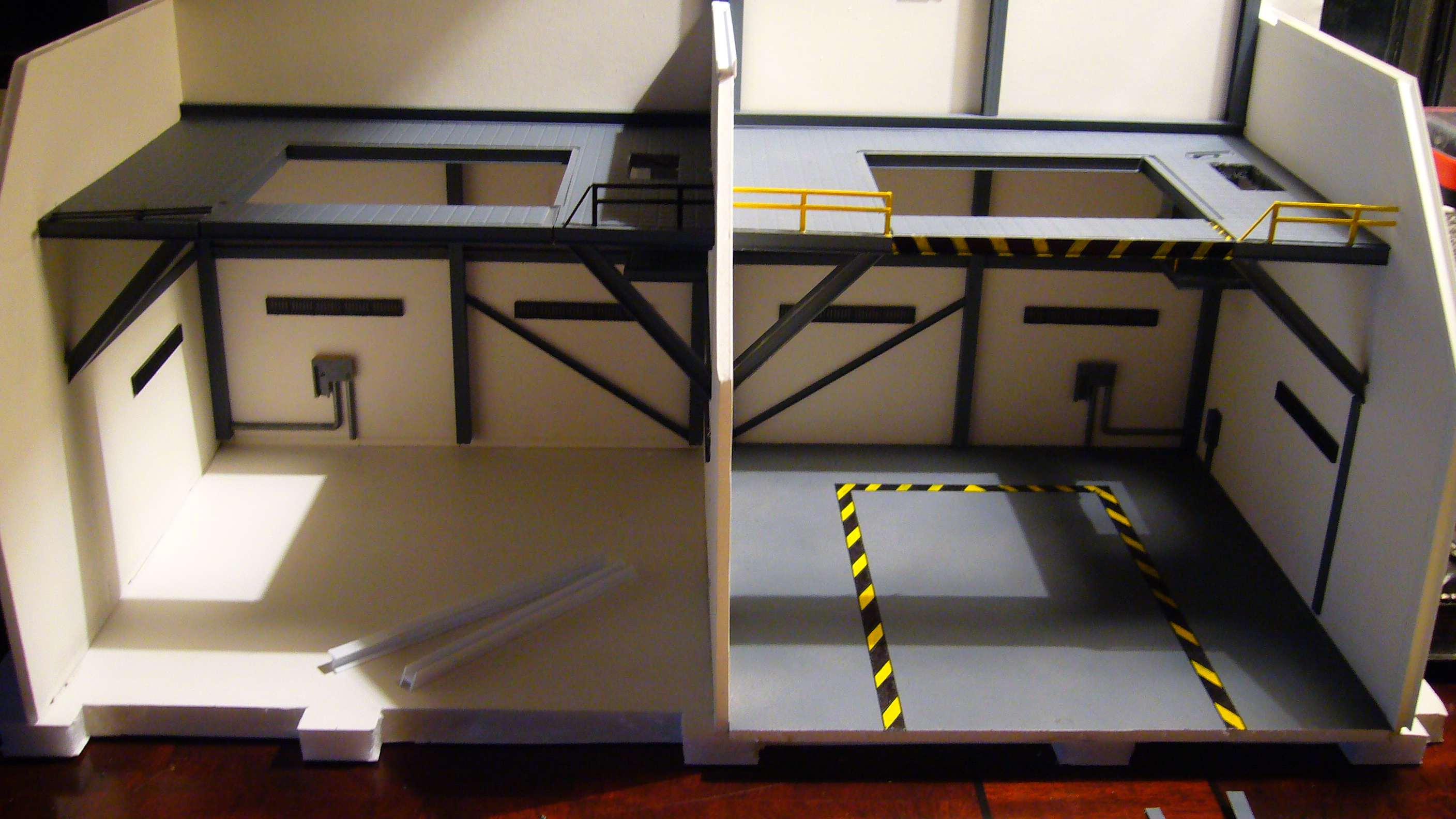

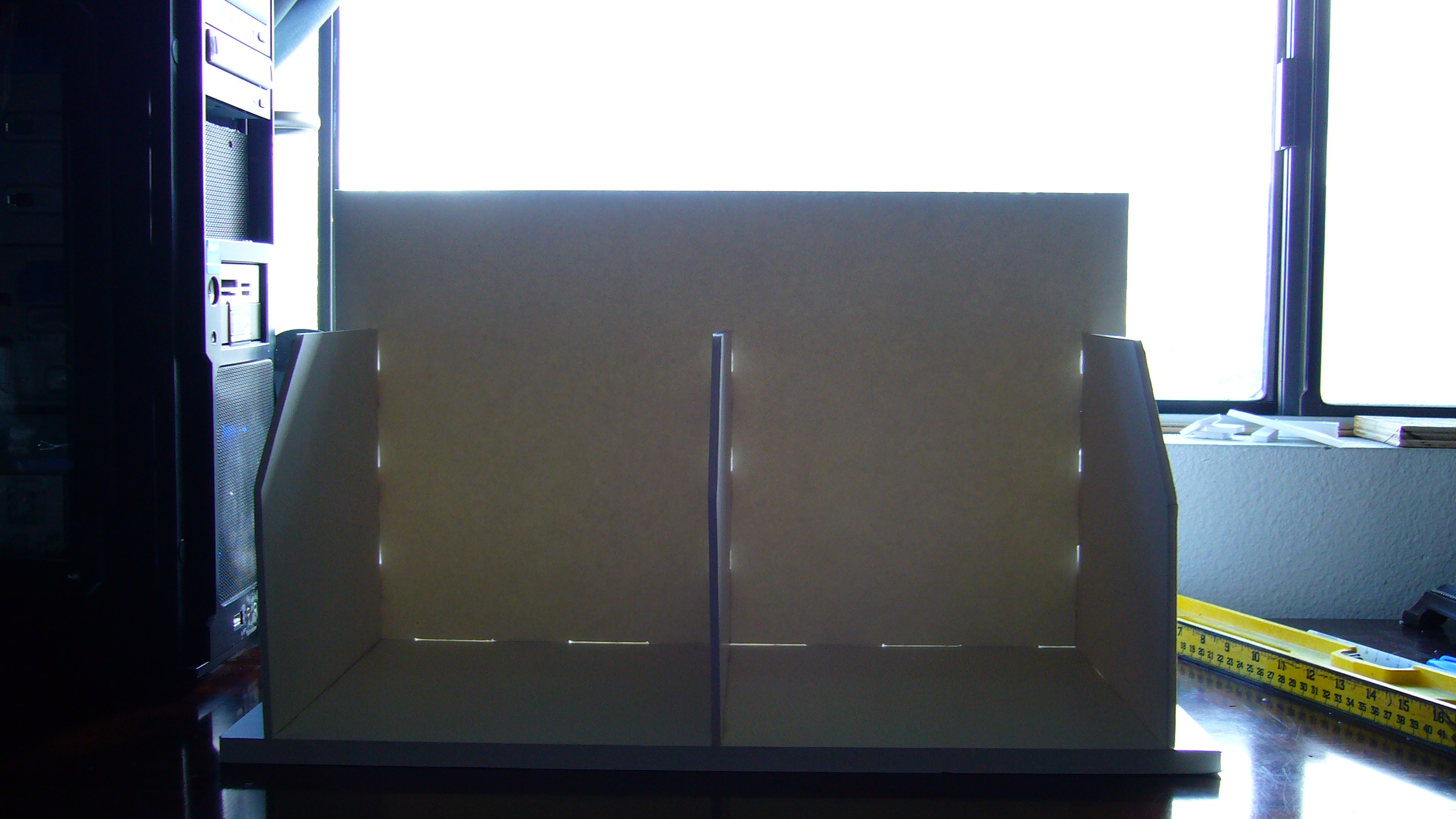

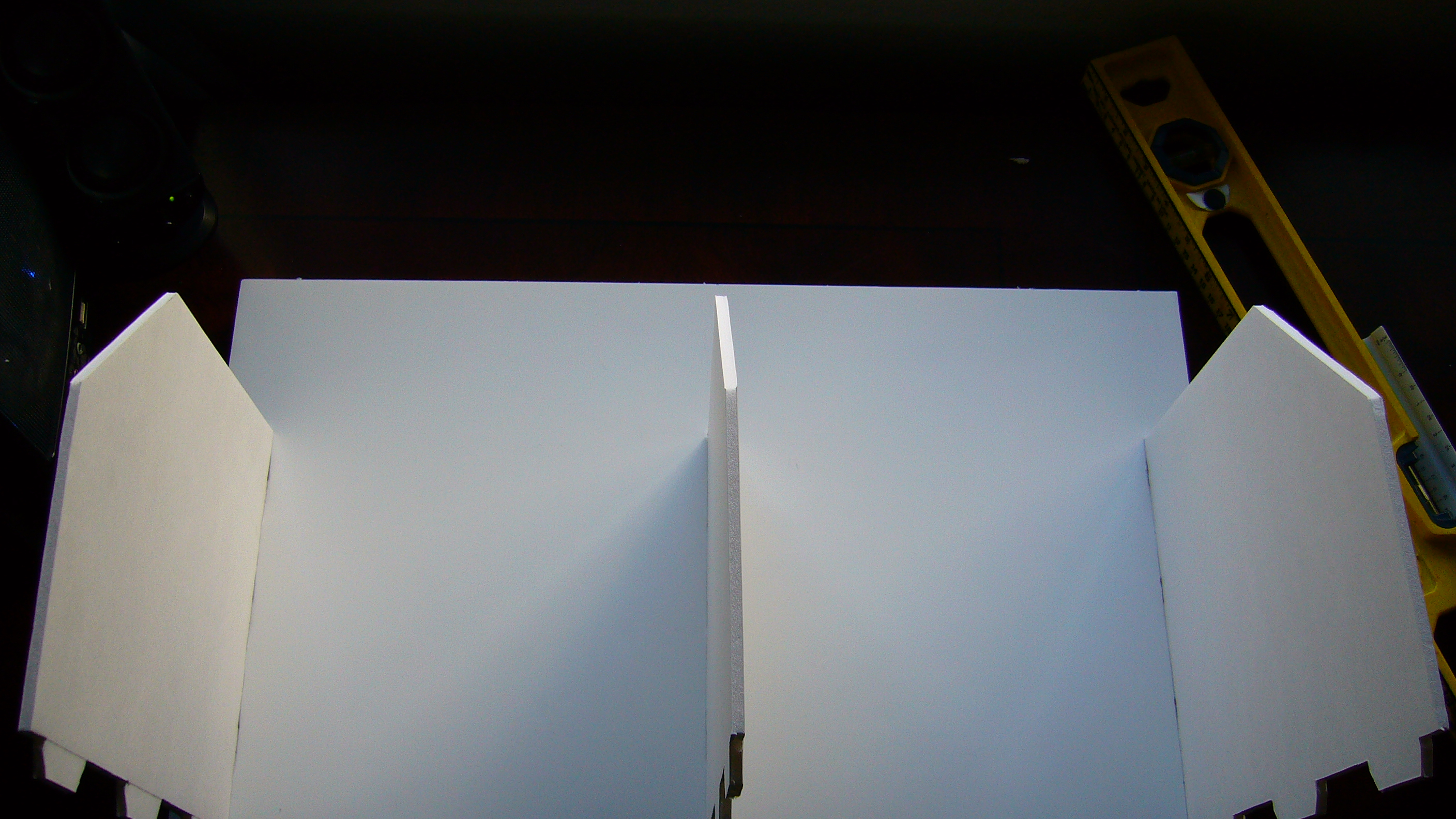

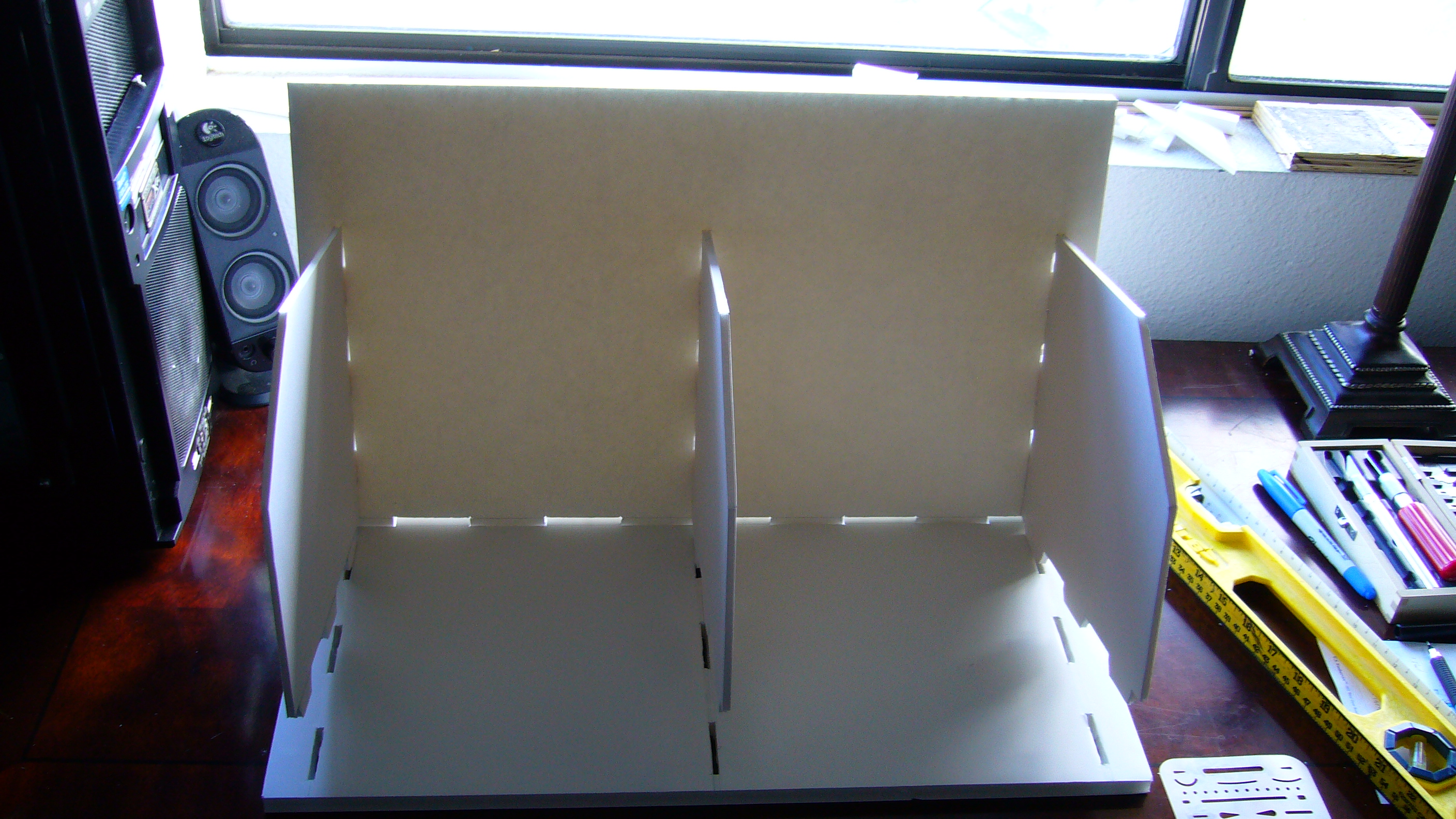

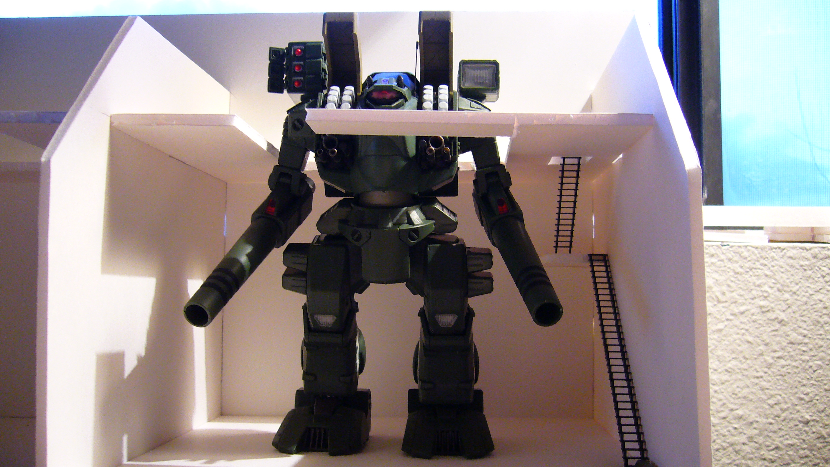

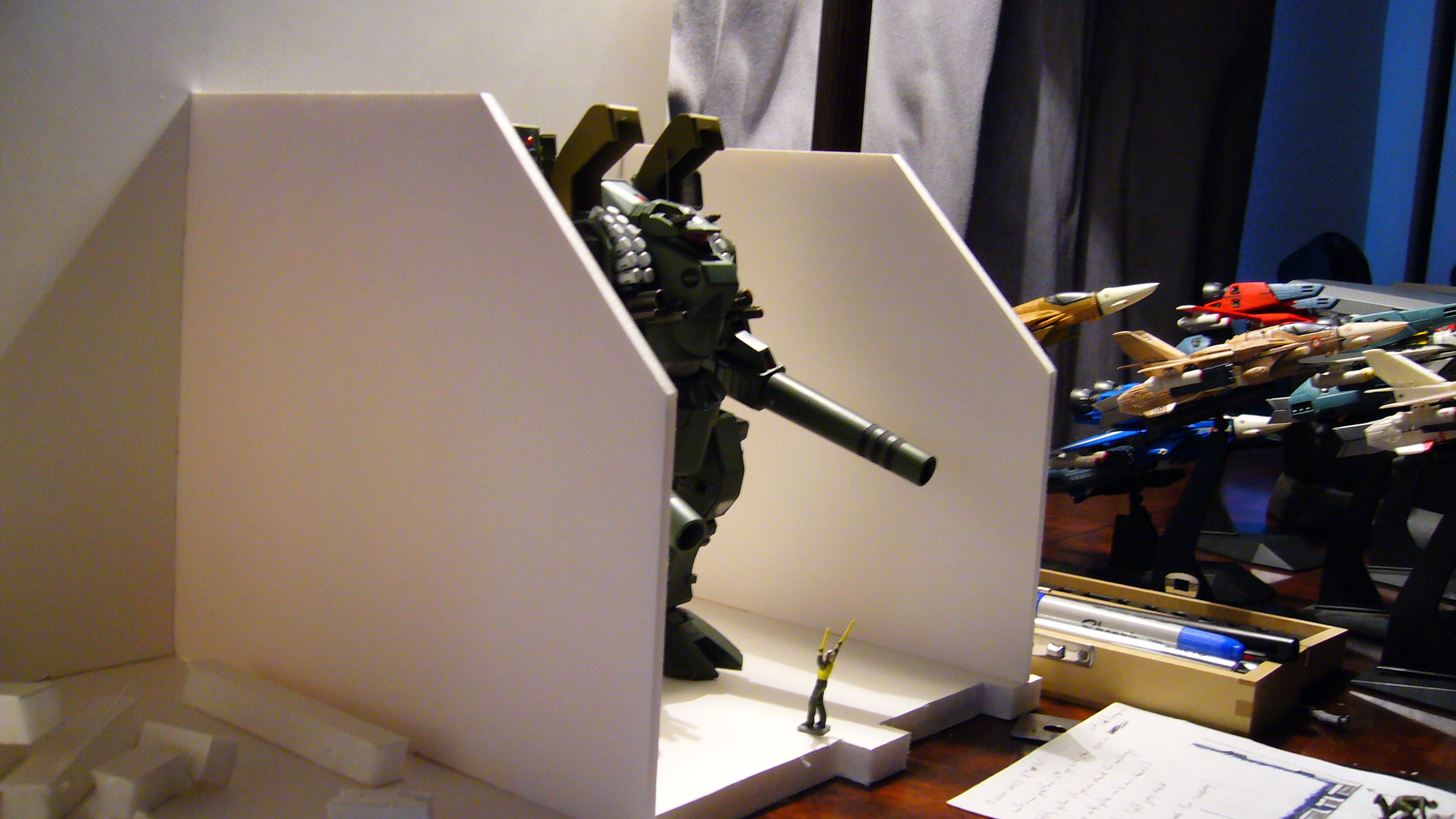

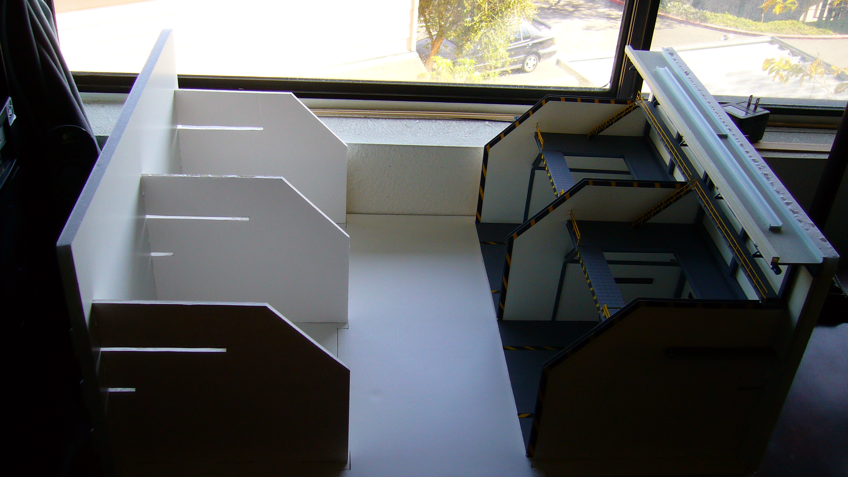

I have decided to post some pictures of some work I have been doing regarding the construction of a Hanger for a 1/60 Tomahawk.
The actual Inspiration was from a friend and a fellow member here on Macross World.
He goes by Viper or Robelwell202 on various sites and is the Author / Creator of a fiction based novel called "The Destroid's Last Dance"
and can be found at www.destroidslastdance.com.
The Model being constructed is per his request and is being constructed to specifications based on his story.
It only compromises a third of what the actual completed project will contain but it is a beginning.
(Note: A future hanger will be built from this layout but to my specifications at a much later date.)

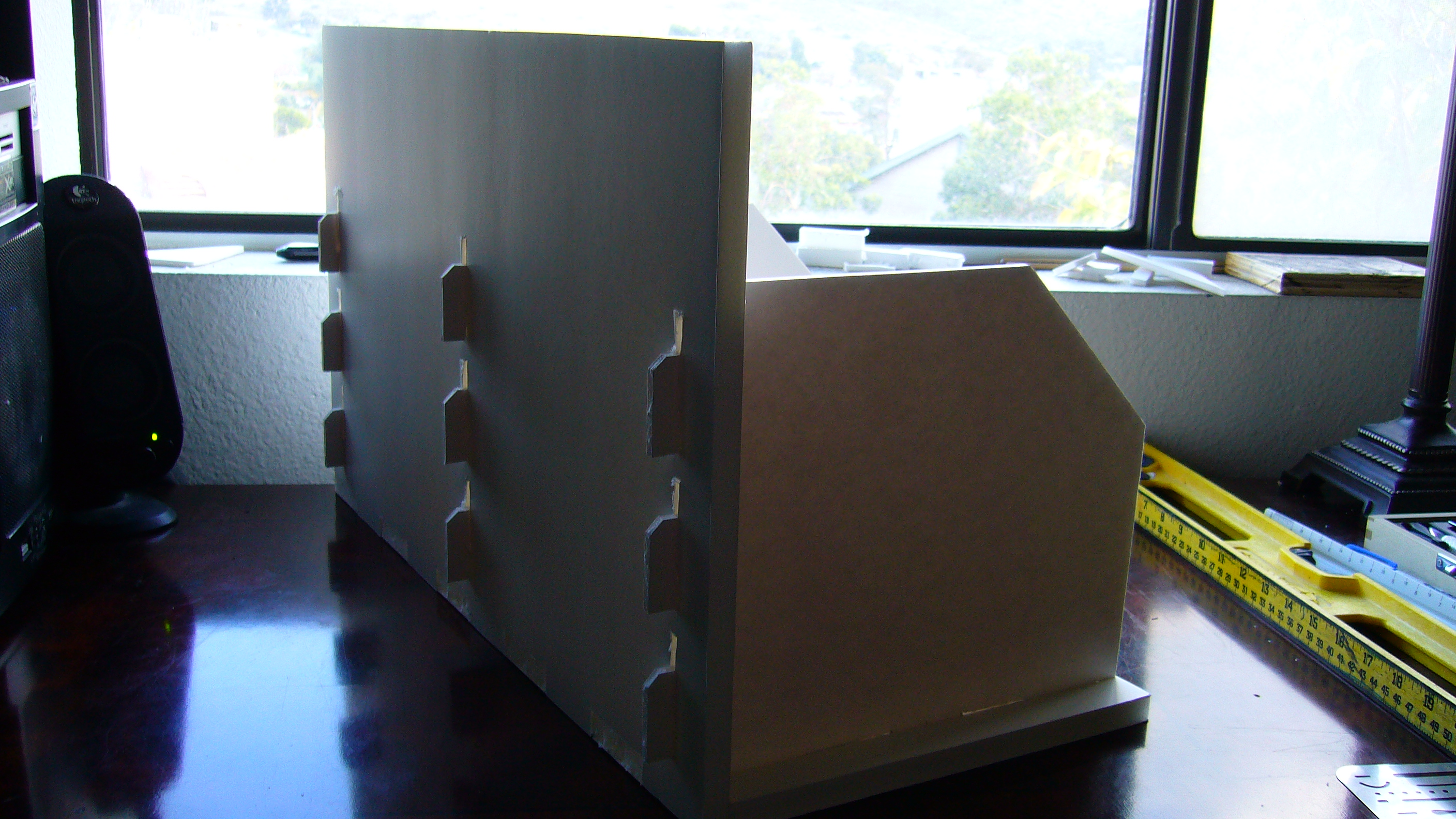

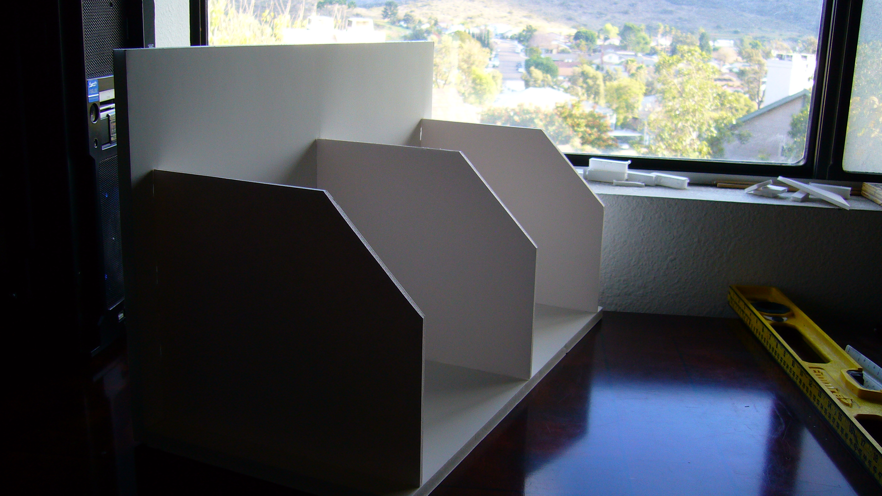

The material being used is Foam board that can be found at hobby or art stores. The Styrene materials are from a hobby store as well.
This particular hanger is built with a modular concept in mind...the sections are built so that there is minimal assembly needed for when
the future product will be shipped.
So without further ado....here are the pictures from start to present...

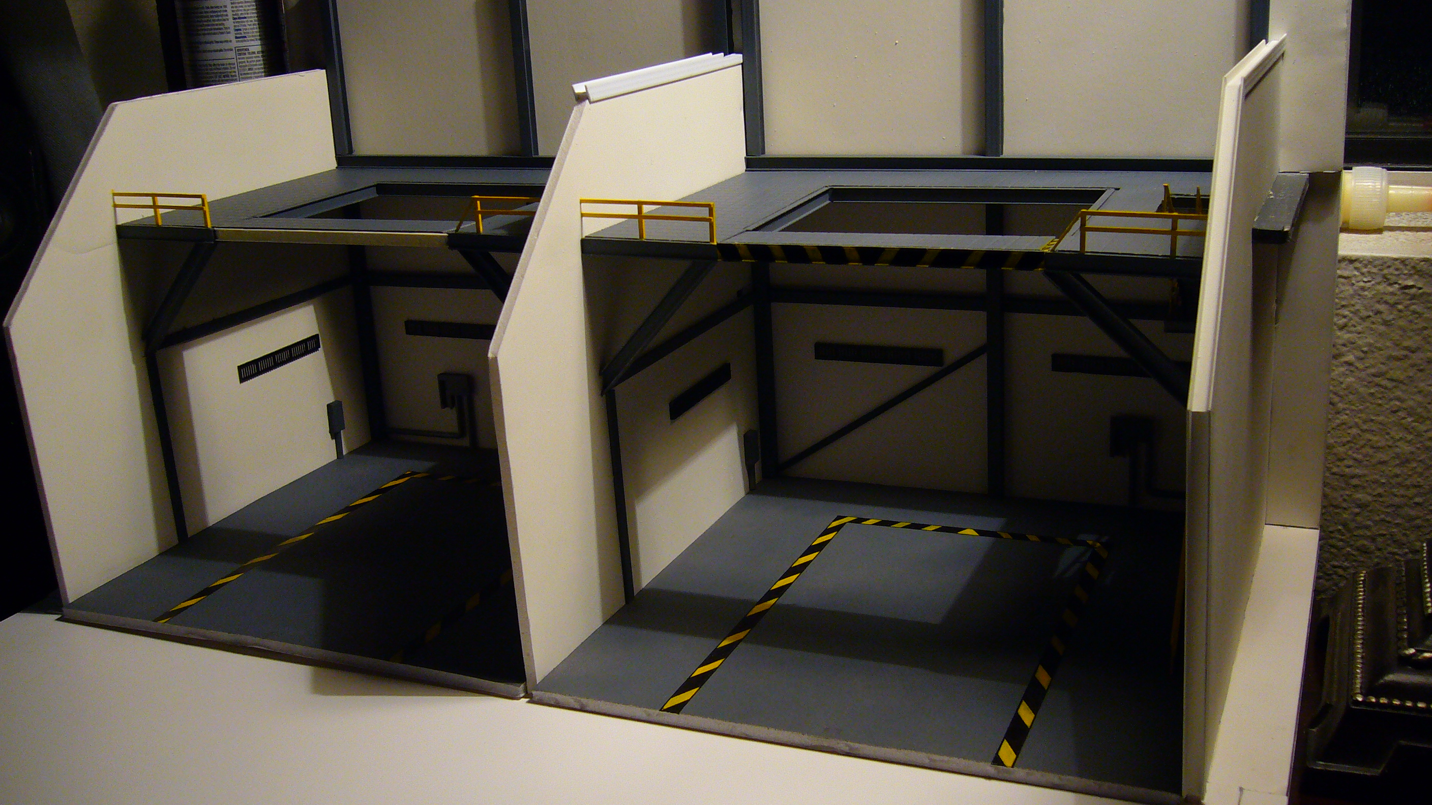

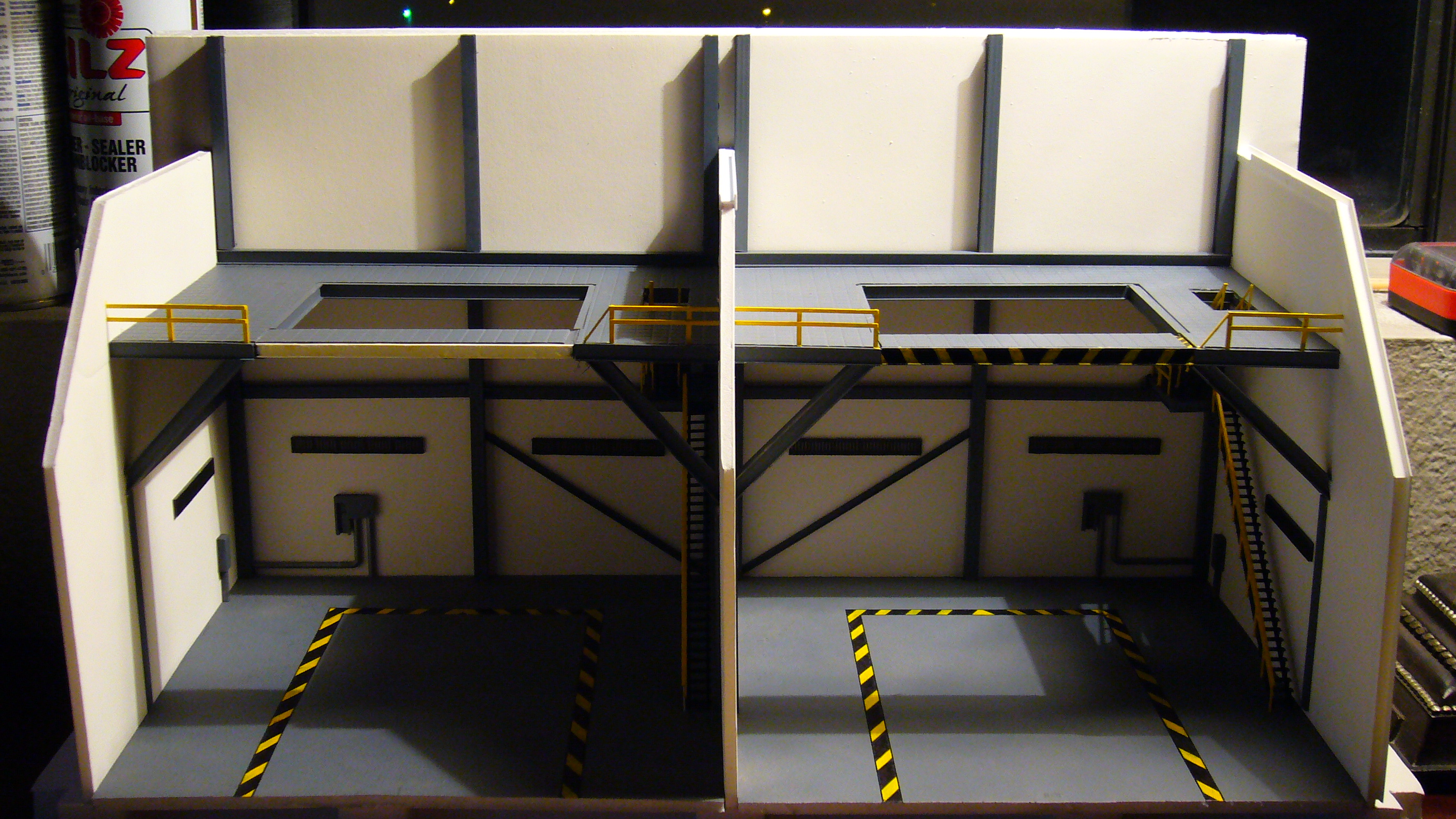

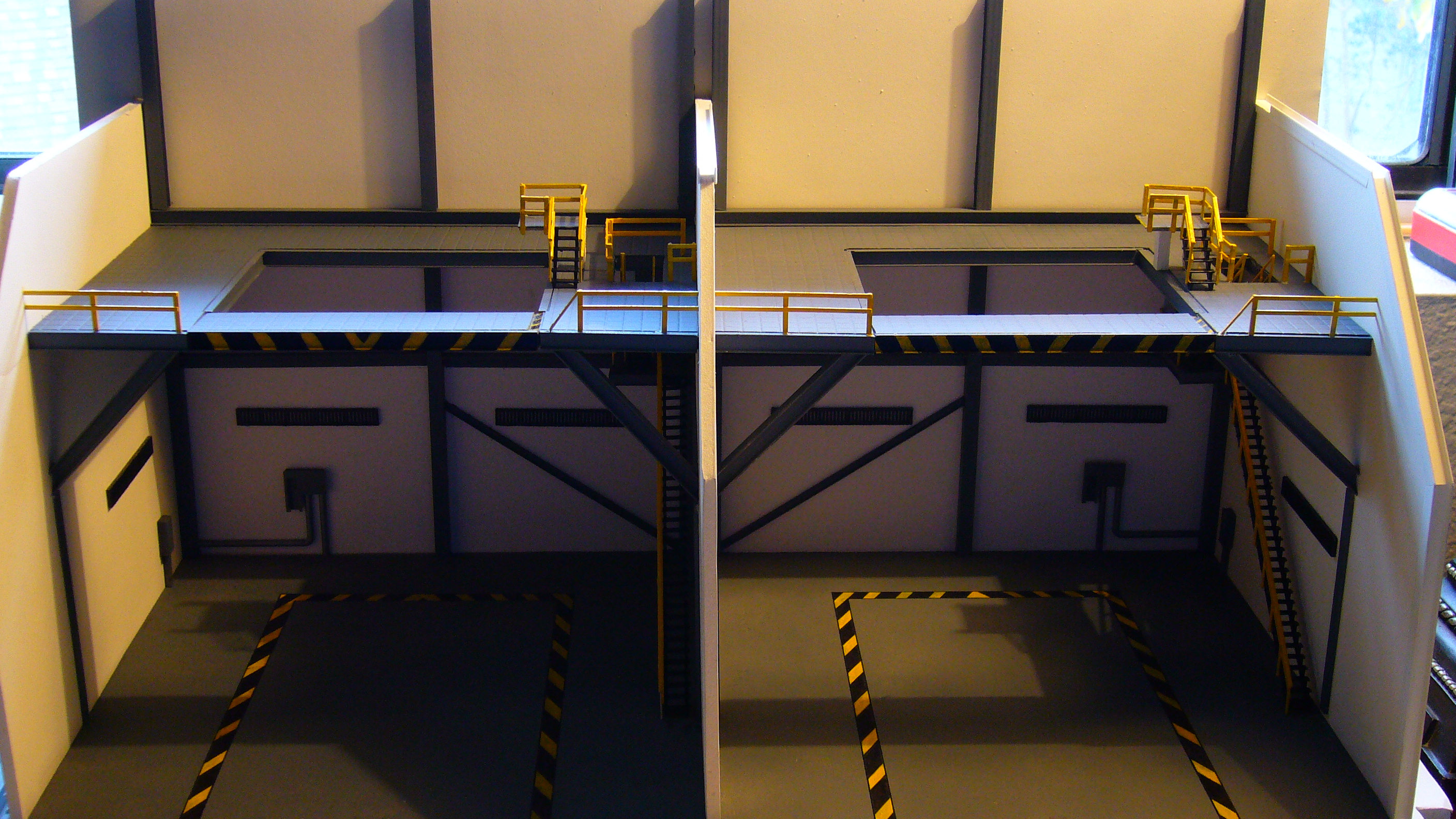

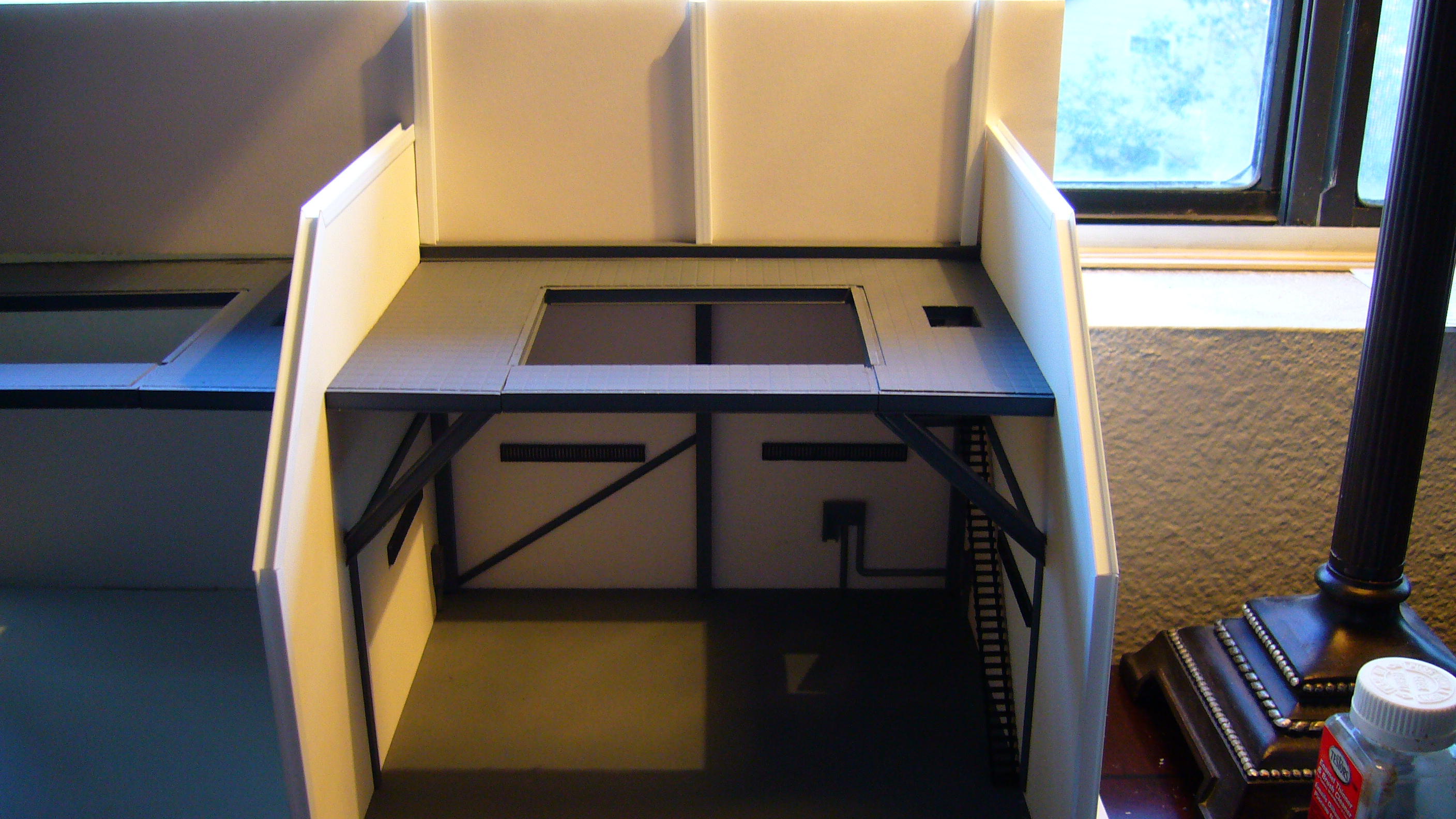

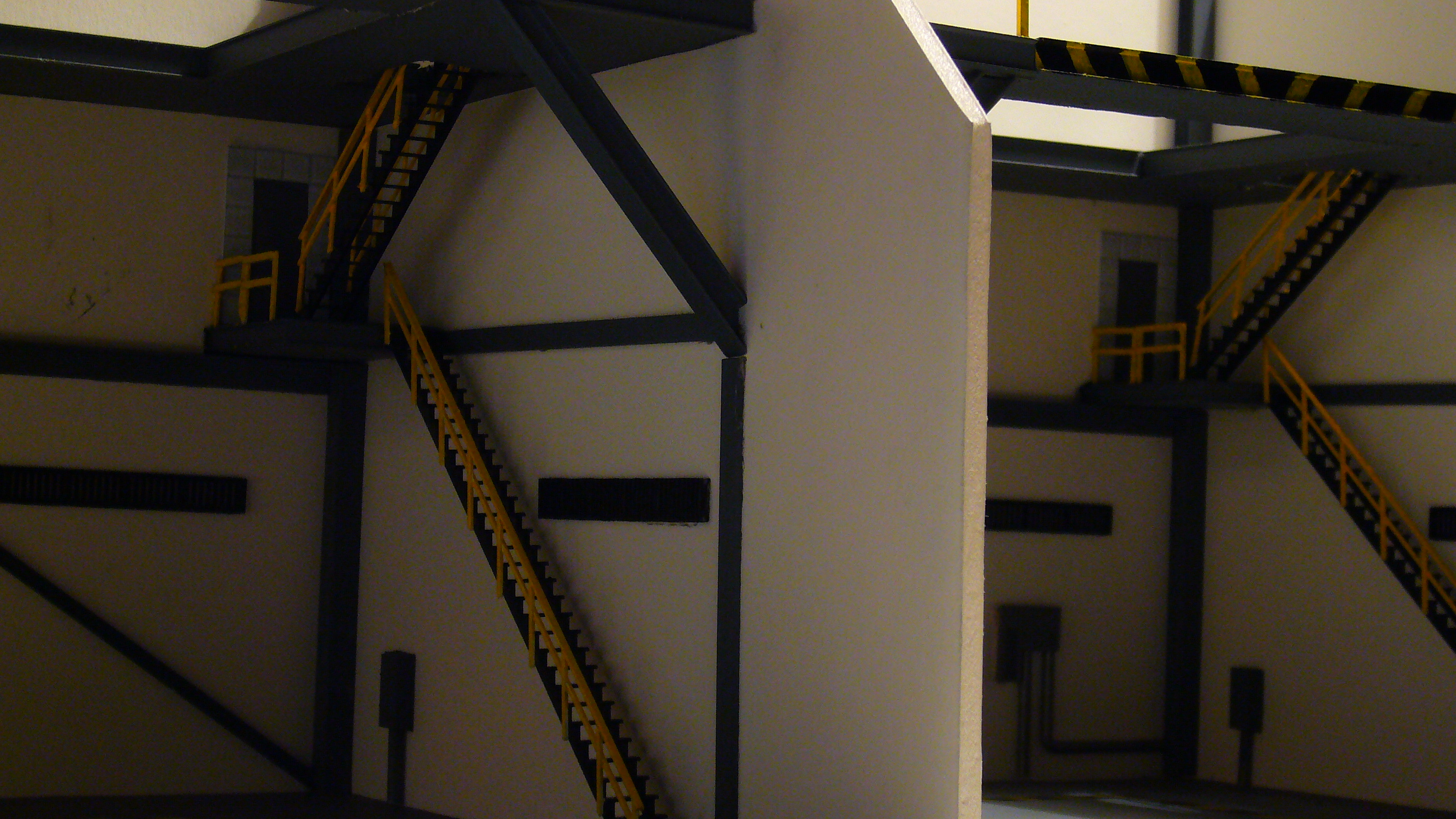

Ok back again with some updates.
In the pictures below I have added wall structure detail as well as some vents and electrical panels.
Also noted is the base coat of paint to the floors and wall structure assemblies.

Super cool project and you are moving along very quickly! It really is amazing how a coat of paint can bring it all together. It looks really smooth!
Can't wait to see this completed!

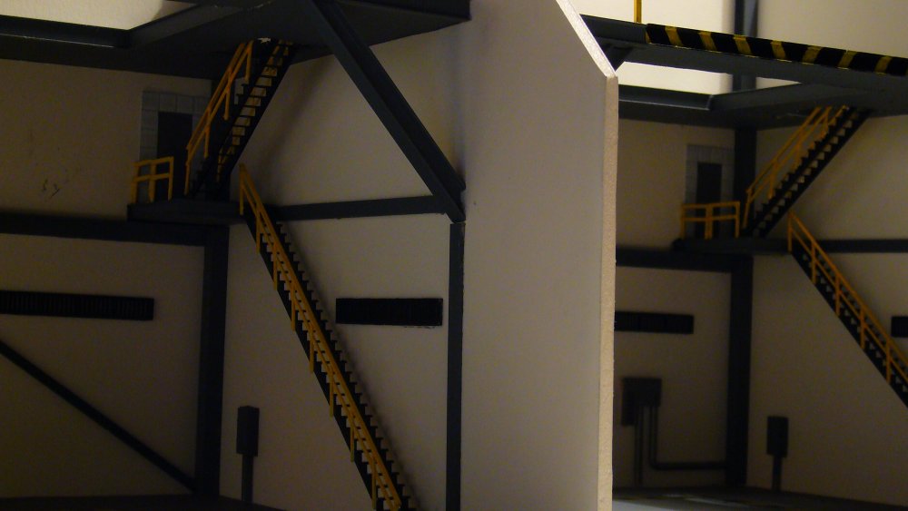

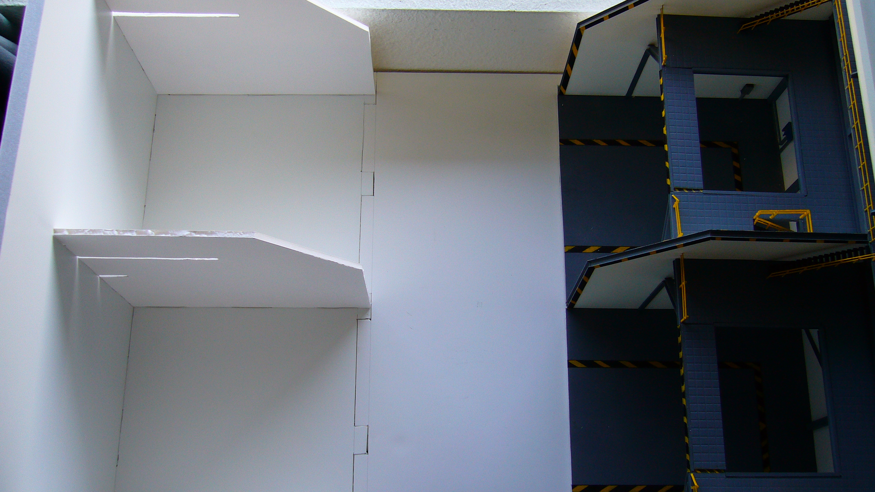

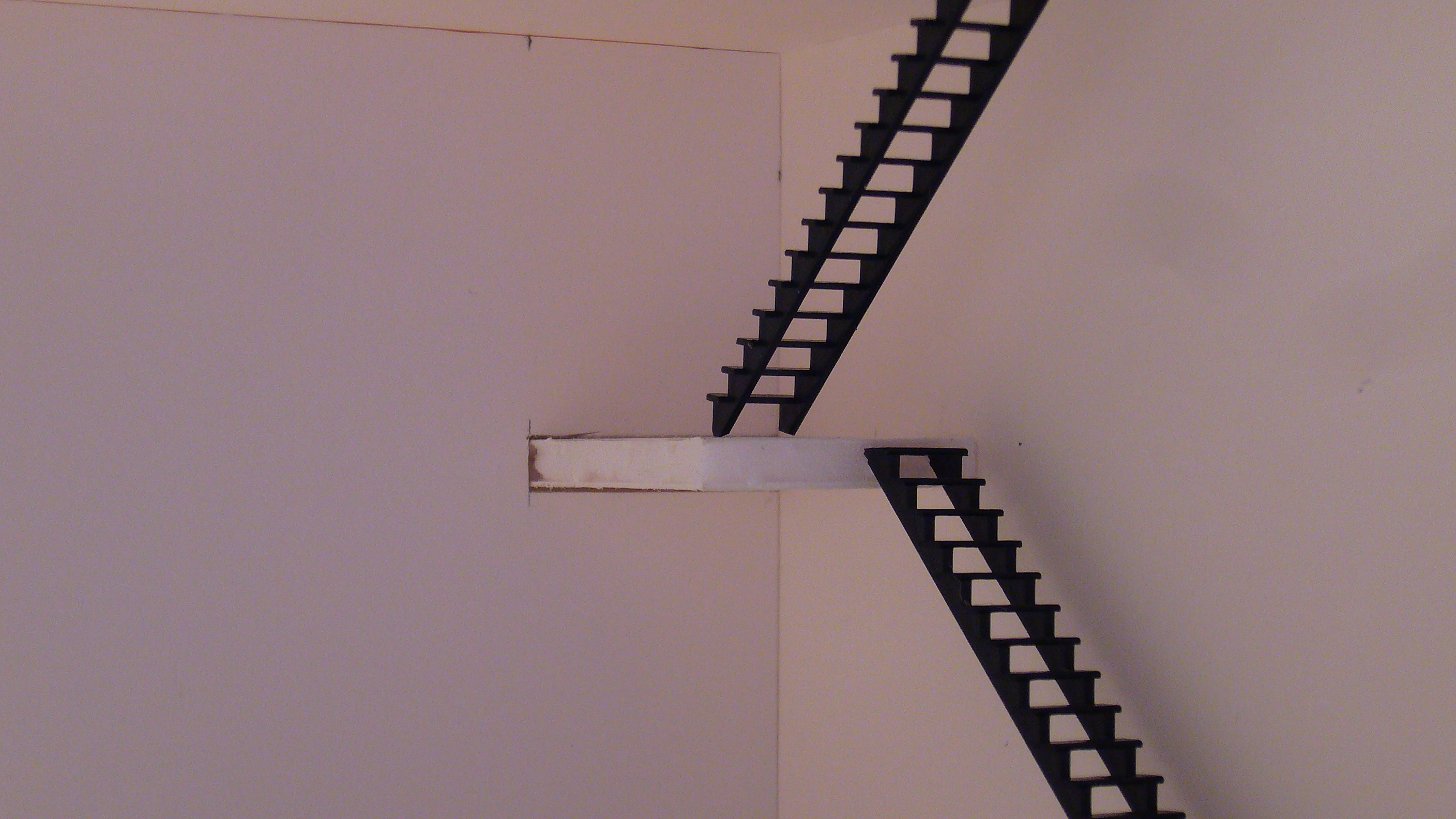

Hello everyone,
I just wanted to update you all on this project. I've only done a few more things since the last set of
pictures but I figured I would share my progress anyways. In the fallowing set of pictures you will see added
detail done to the floor of the hanger bays, new stairwells and railings installed, as well as some frame work
to the backside (upper) wall.

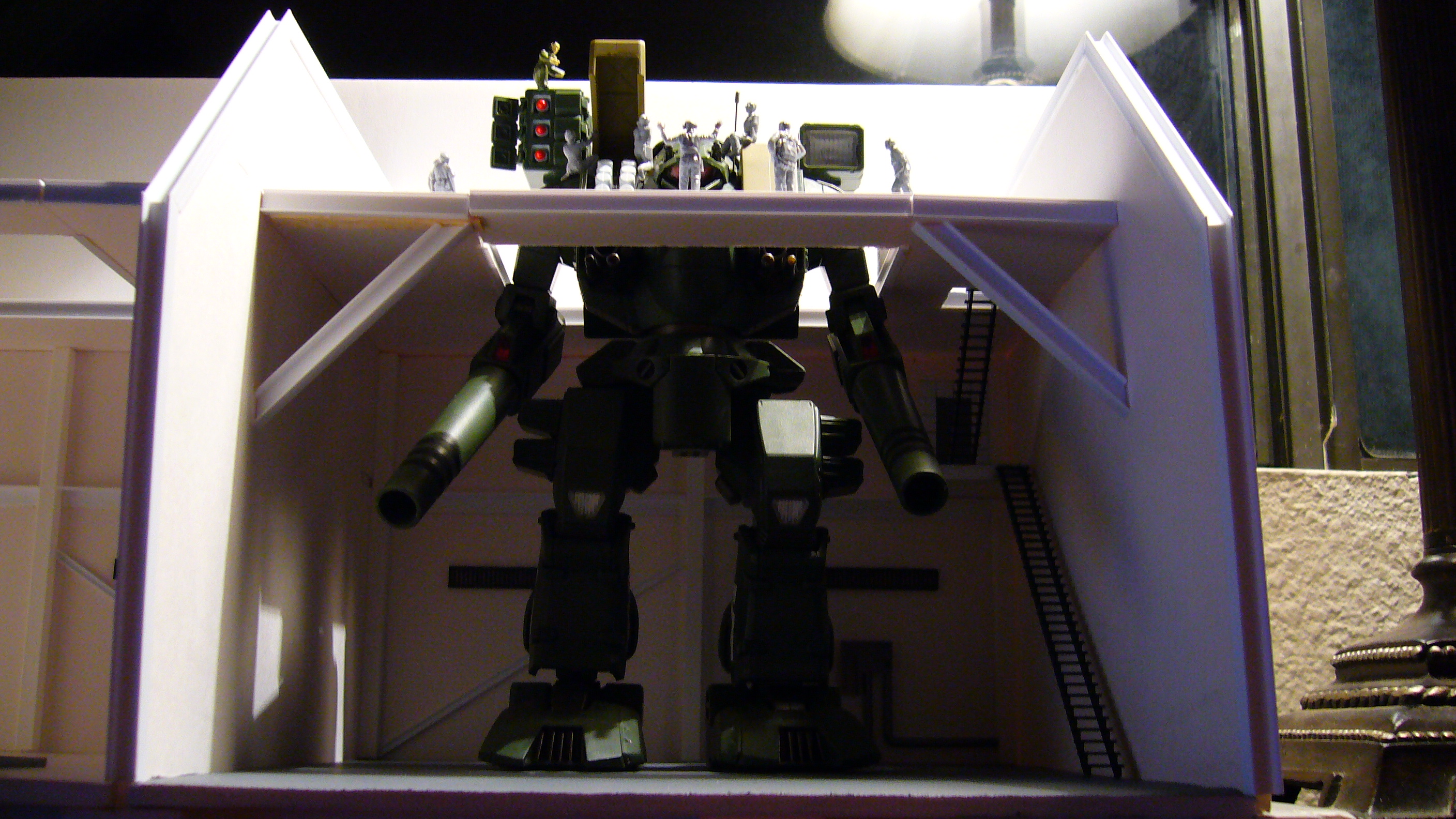

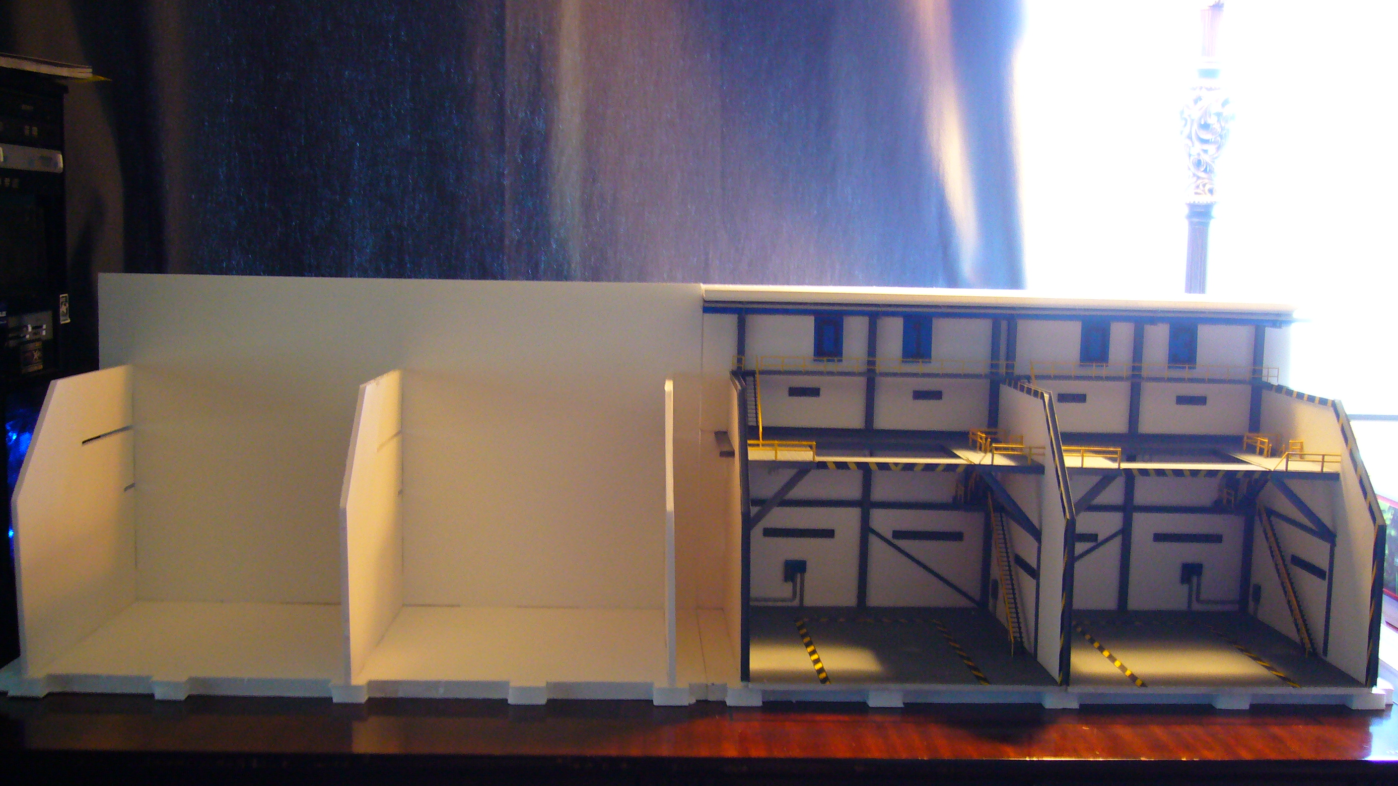

Also here's a sneak peak of a near completed version of what is to come soon!!
Edited by Iceblue106

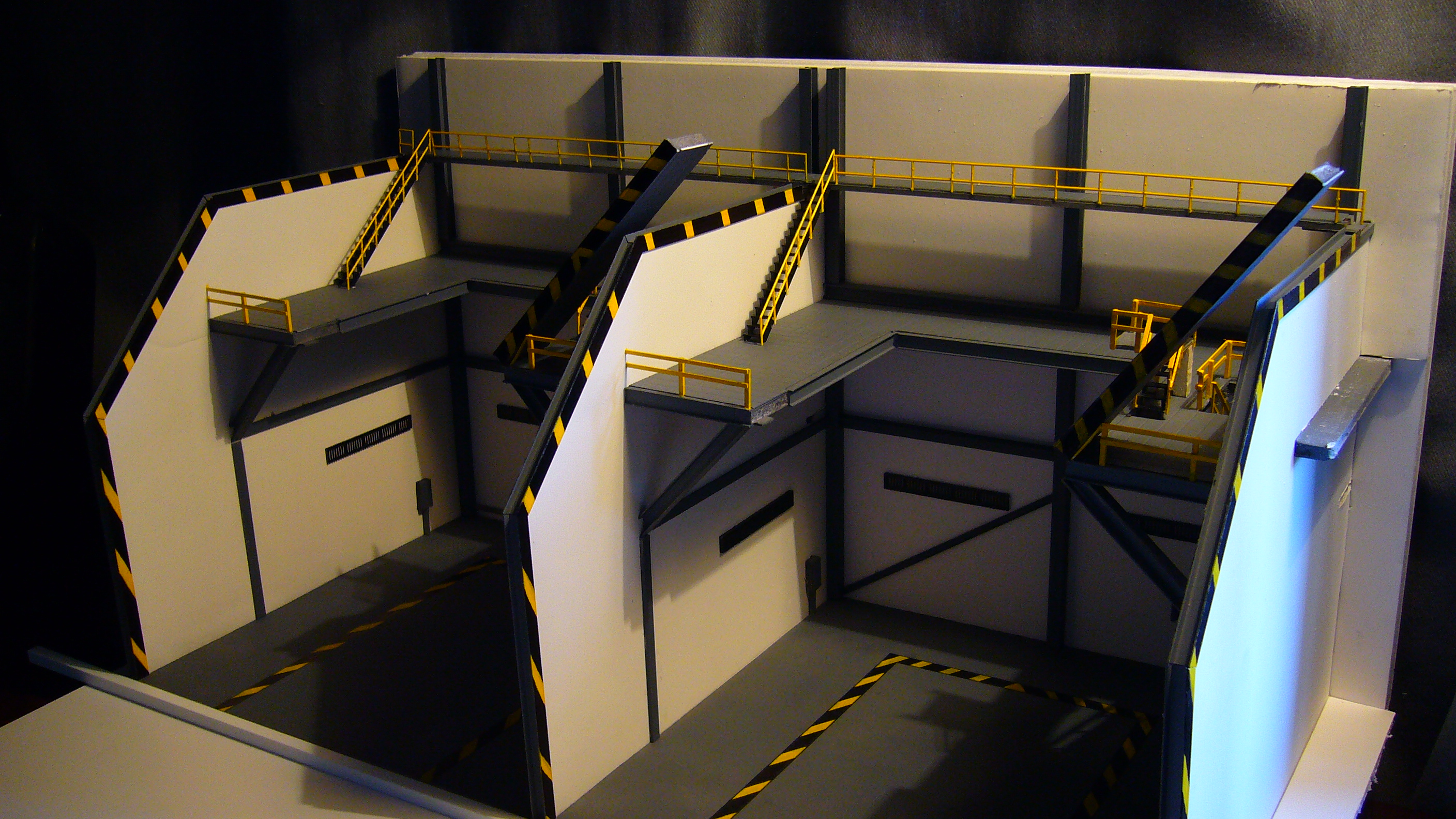

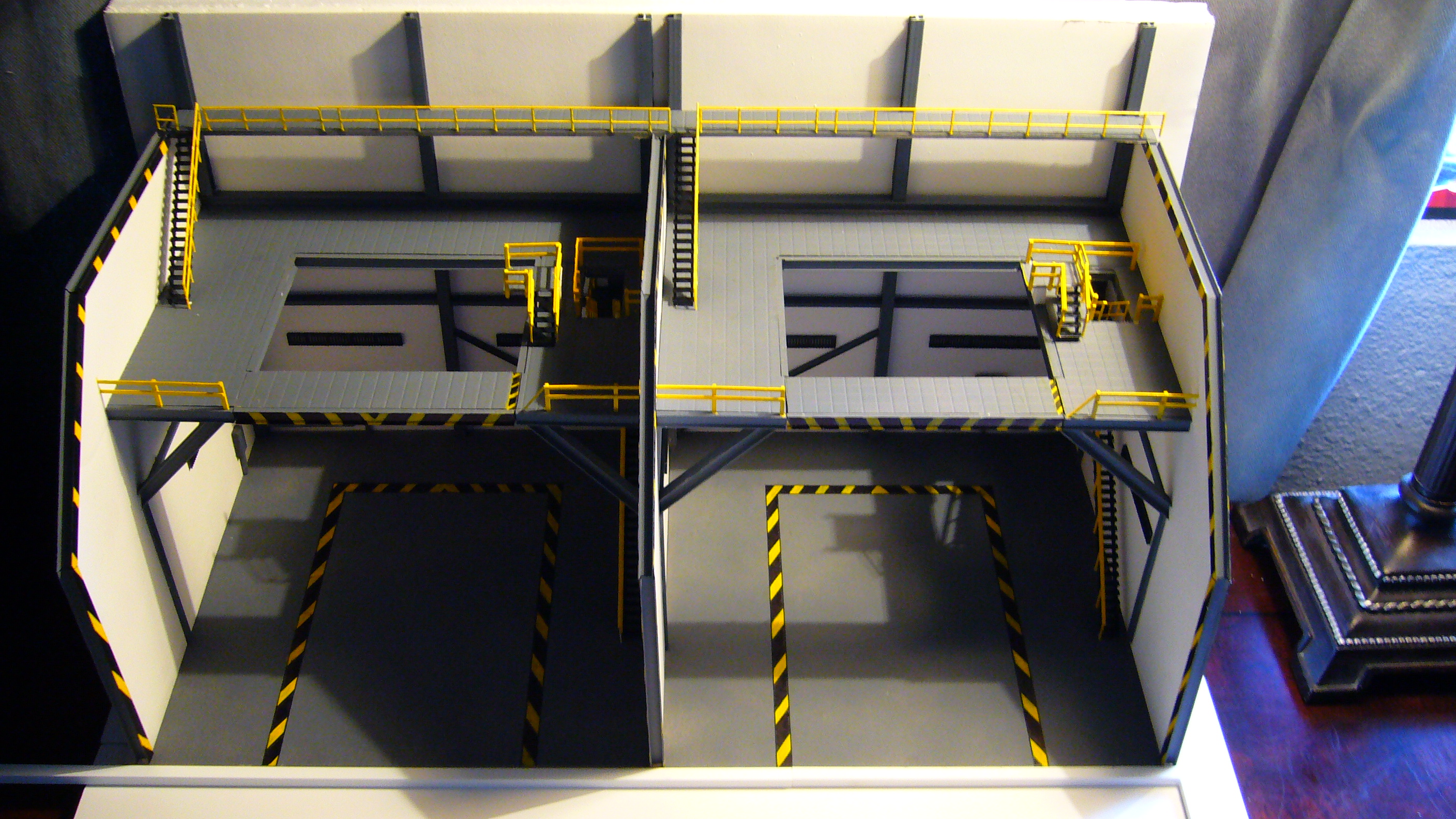

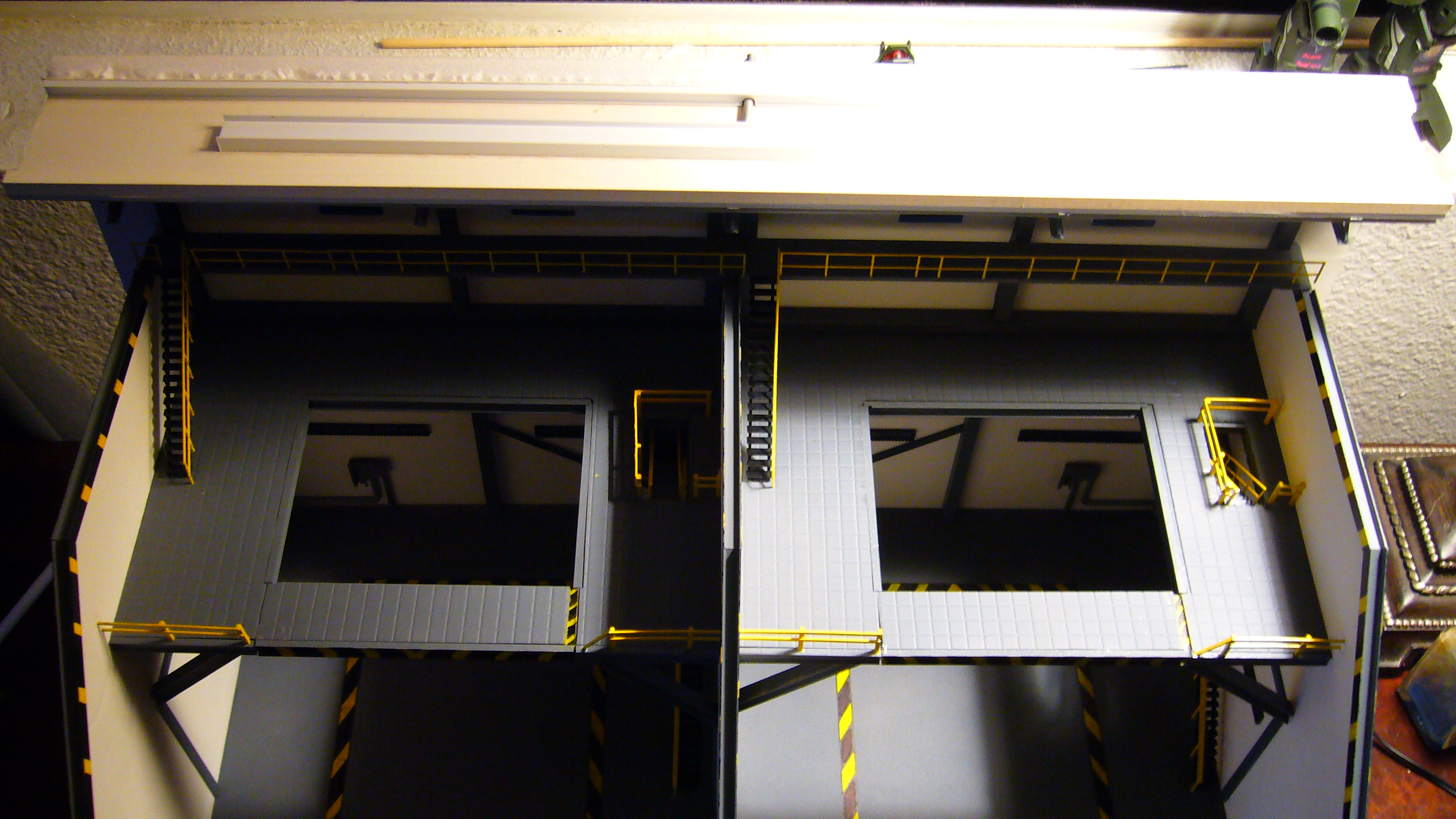

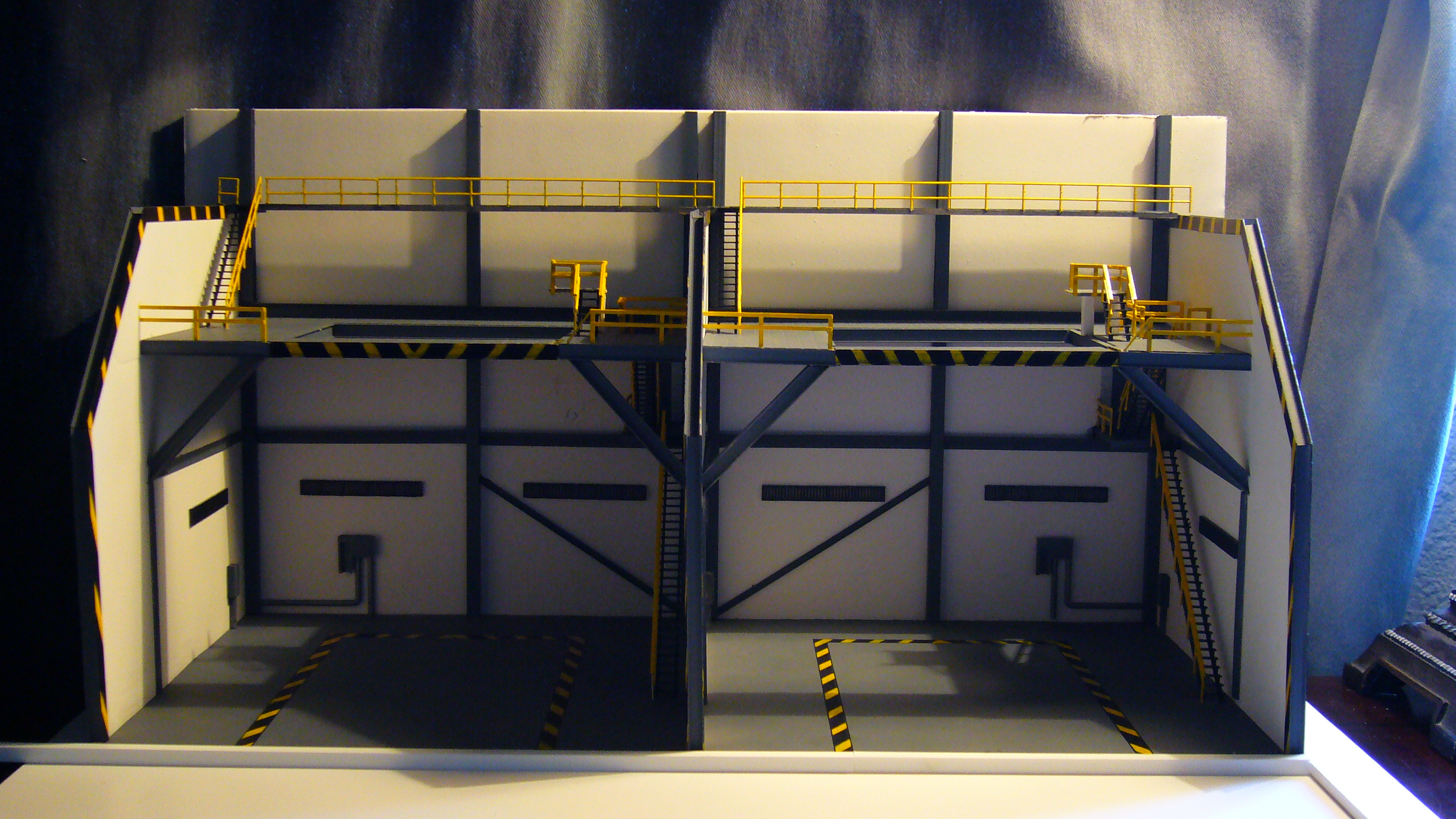

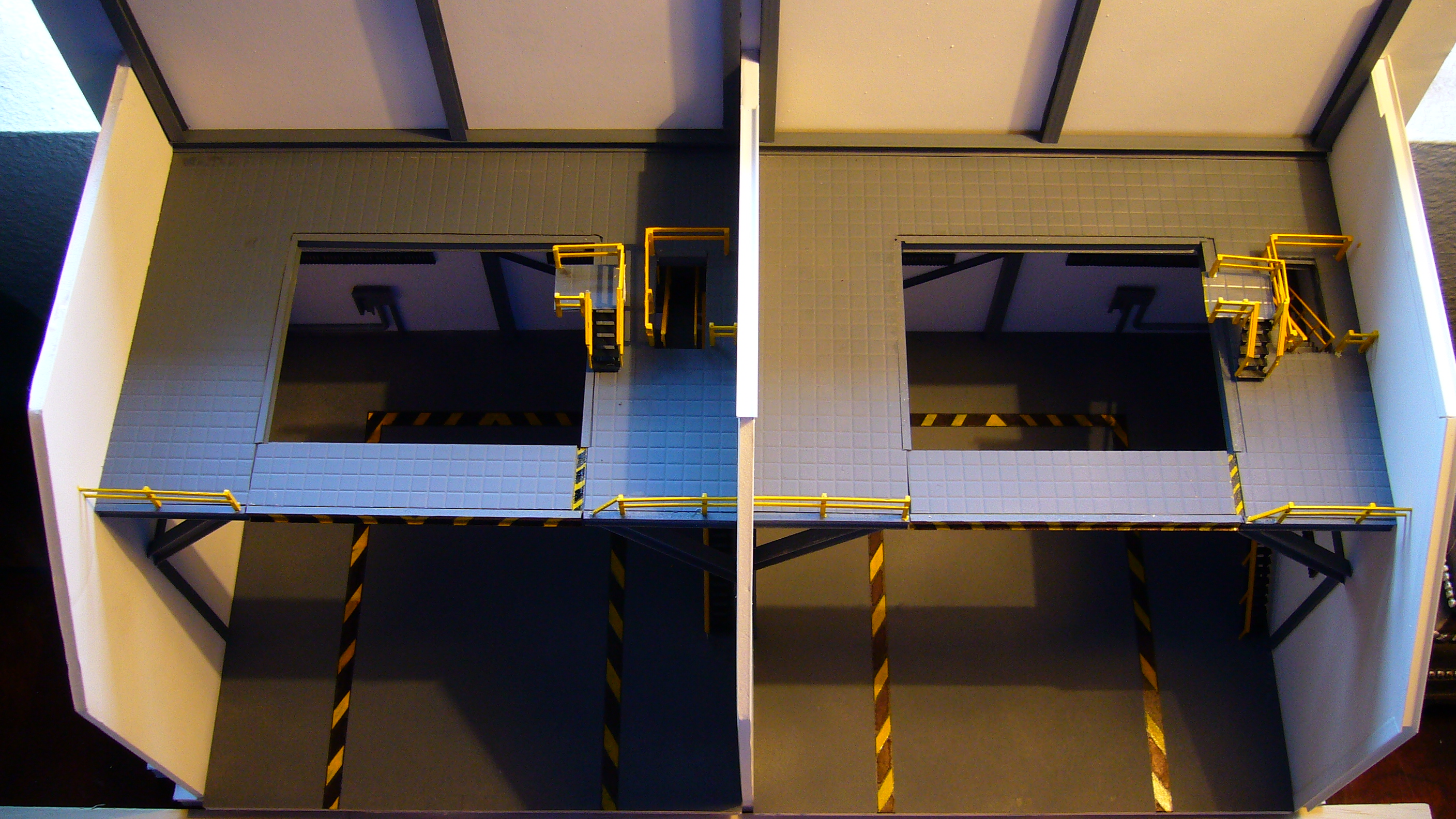

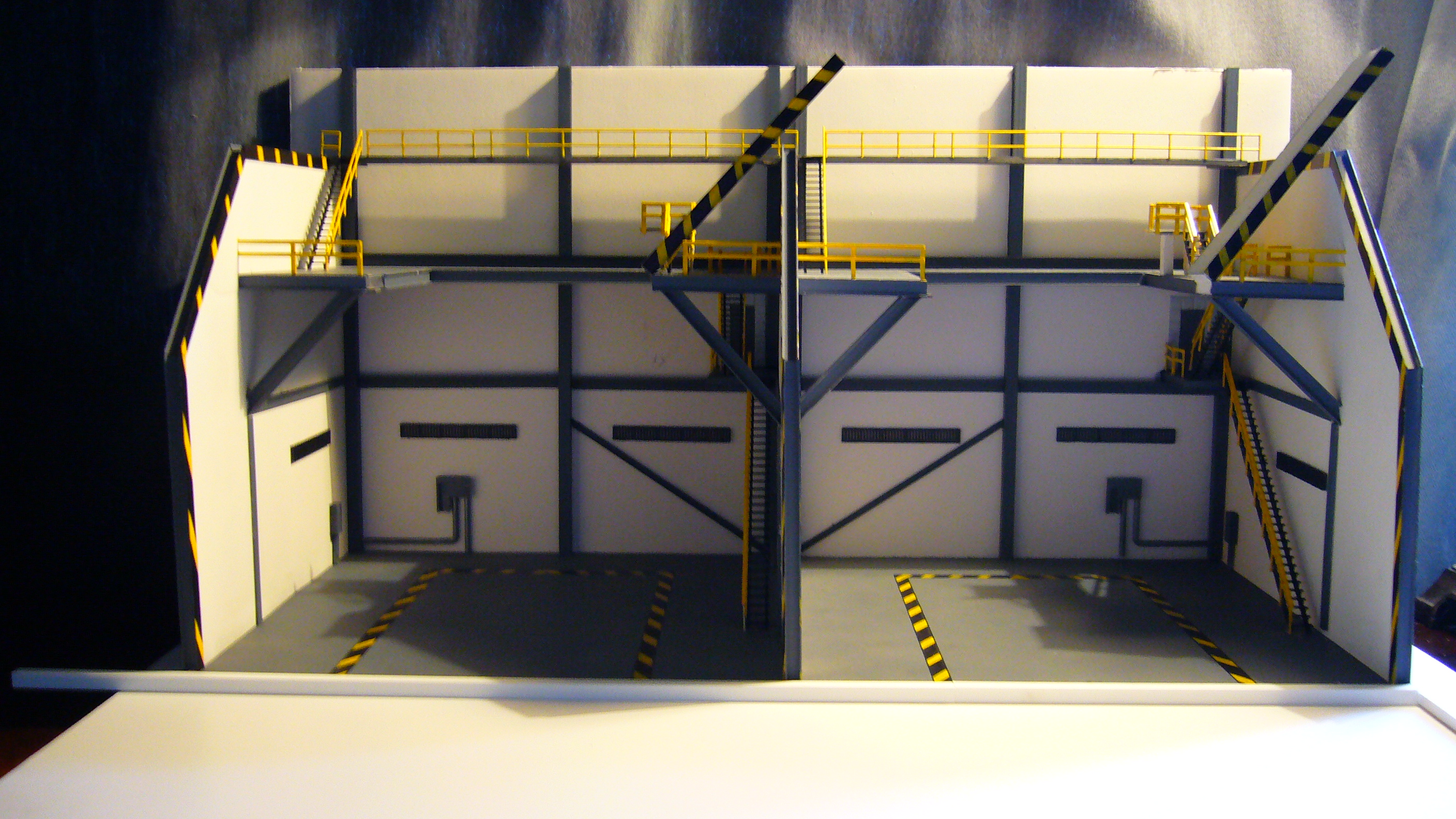

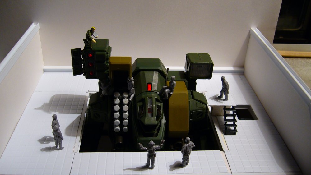

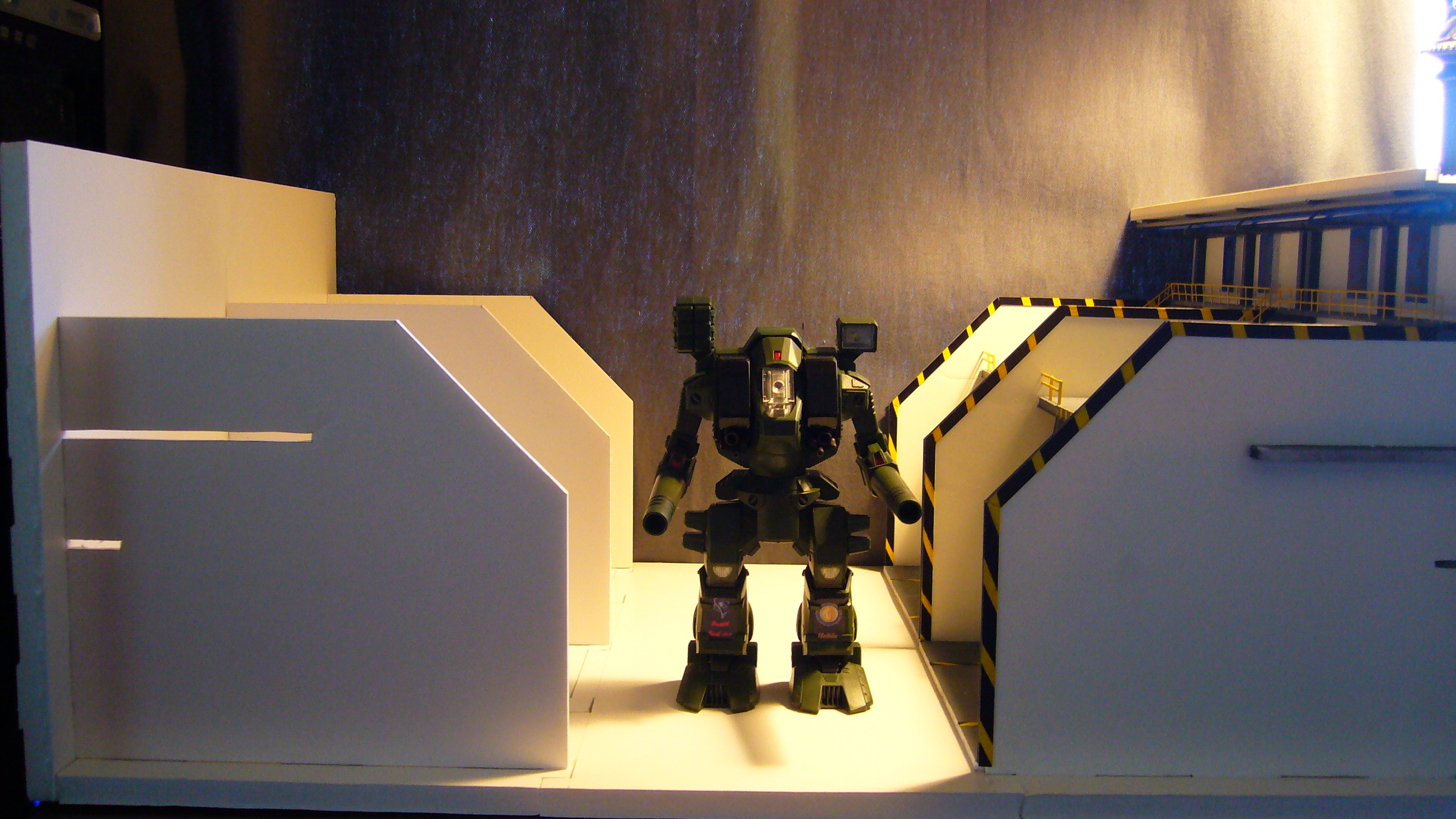

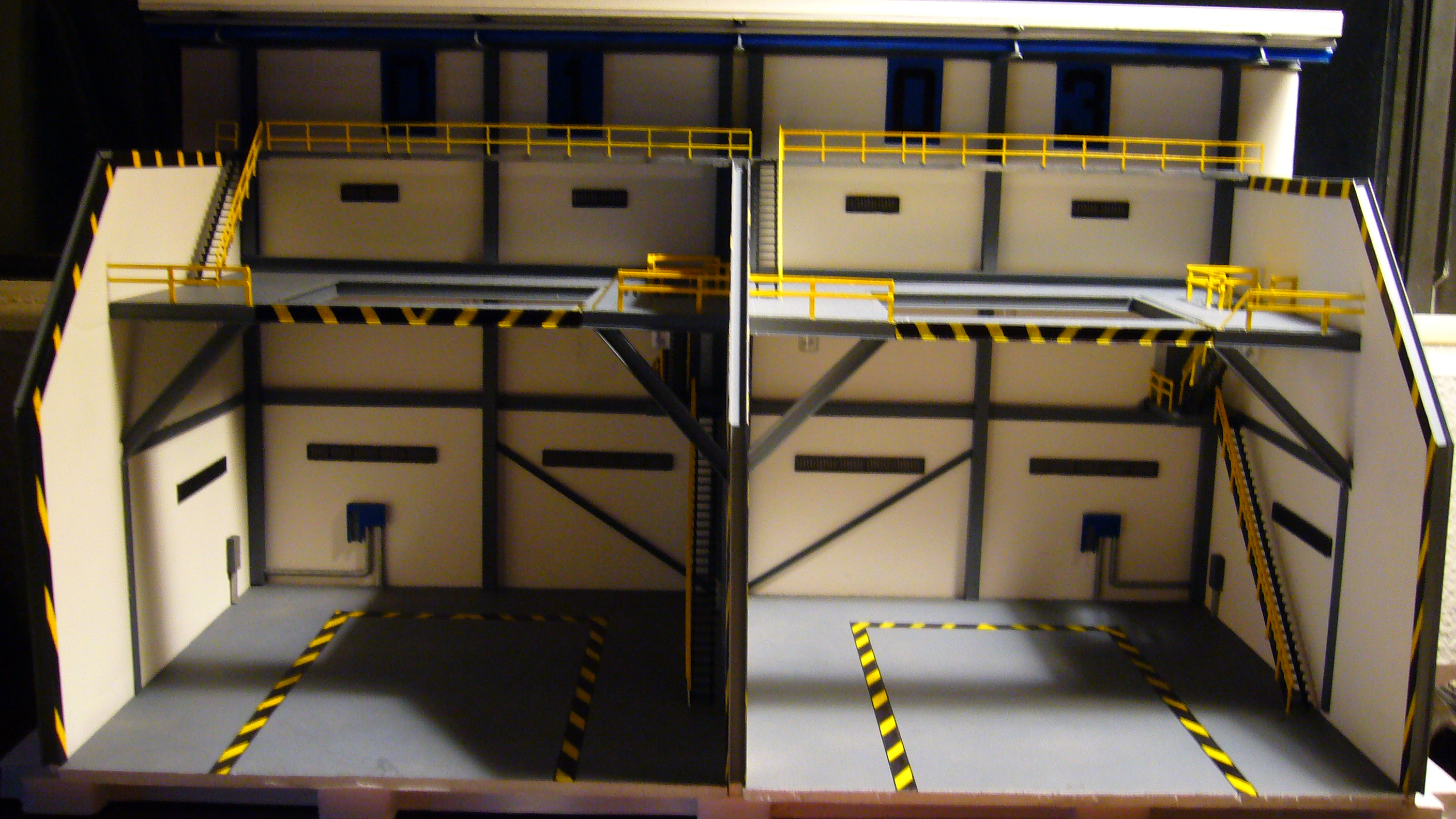

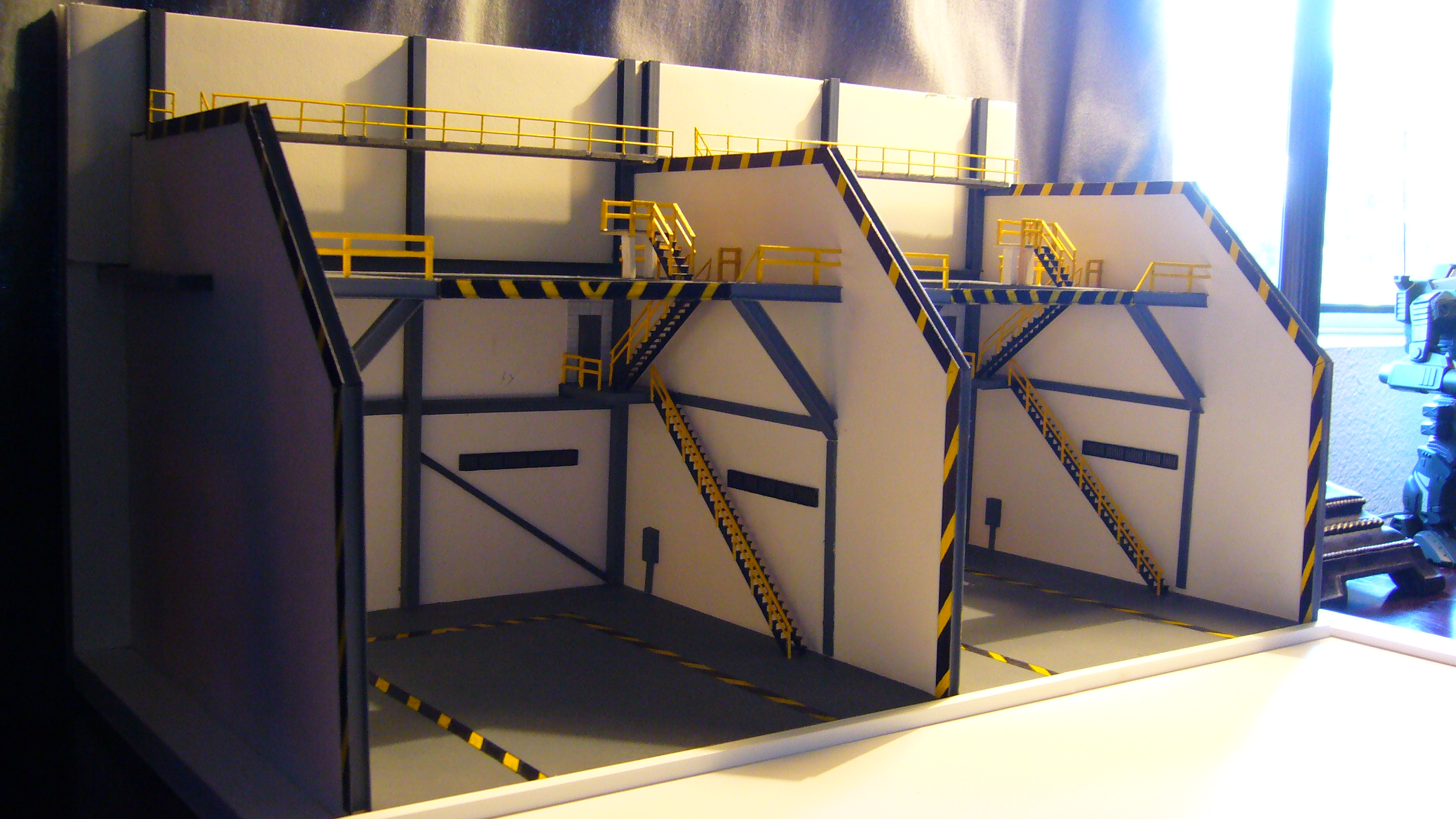

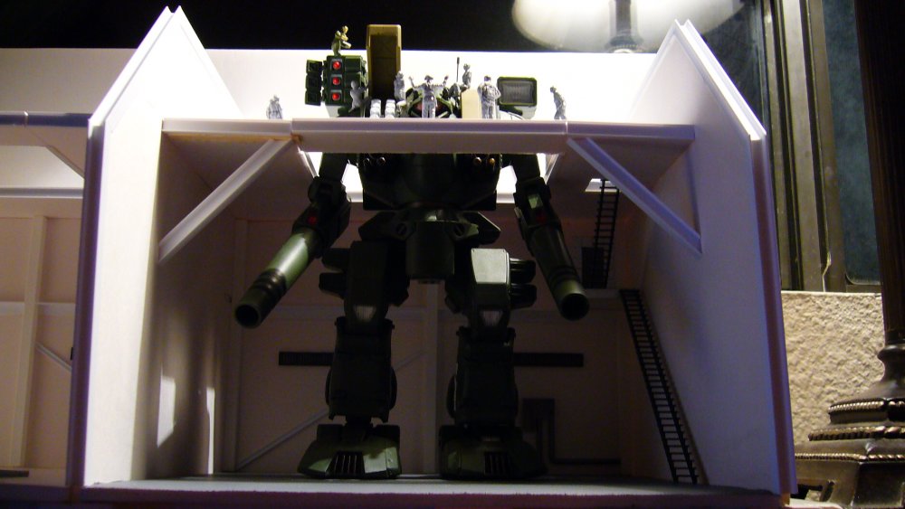

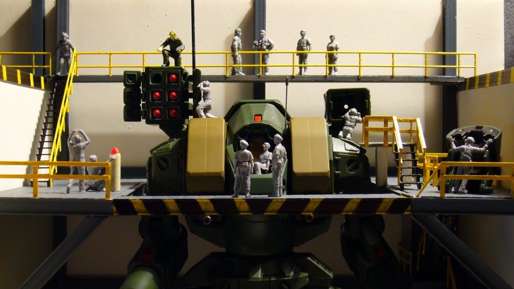

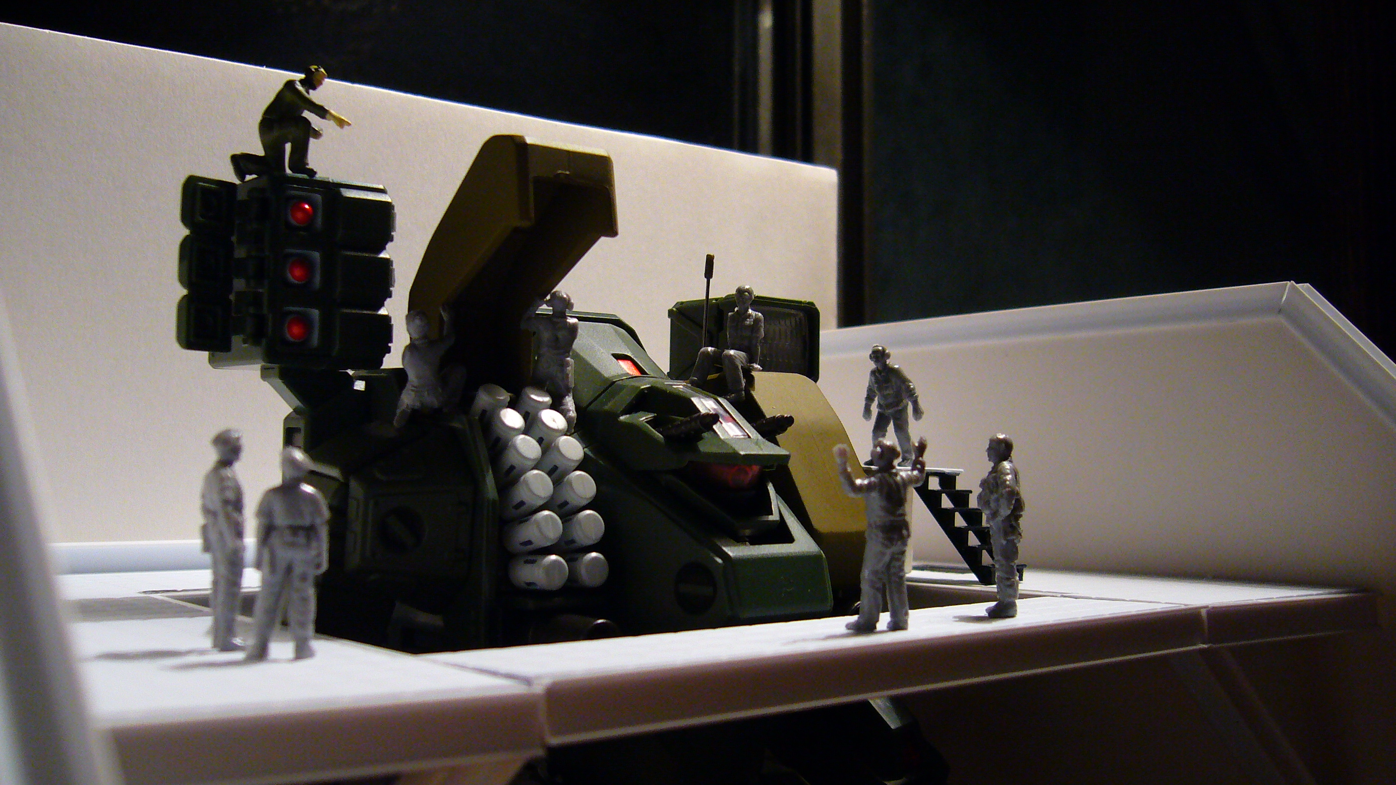

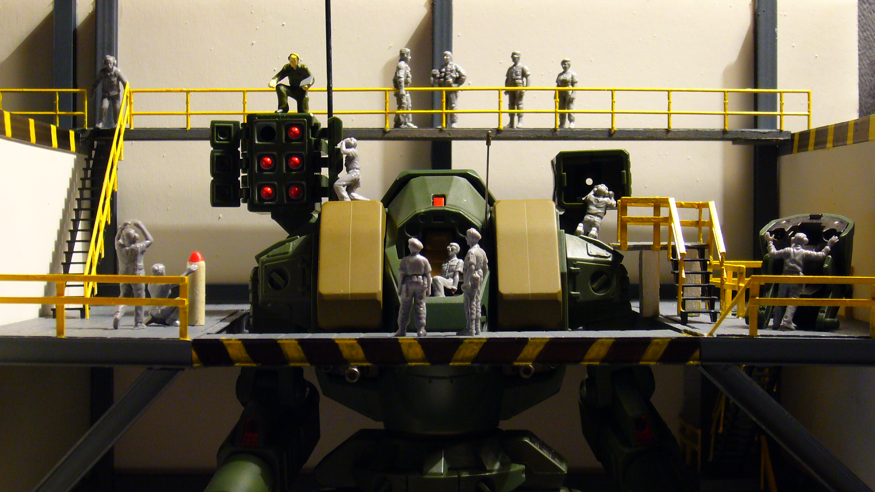

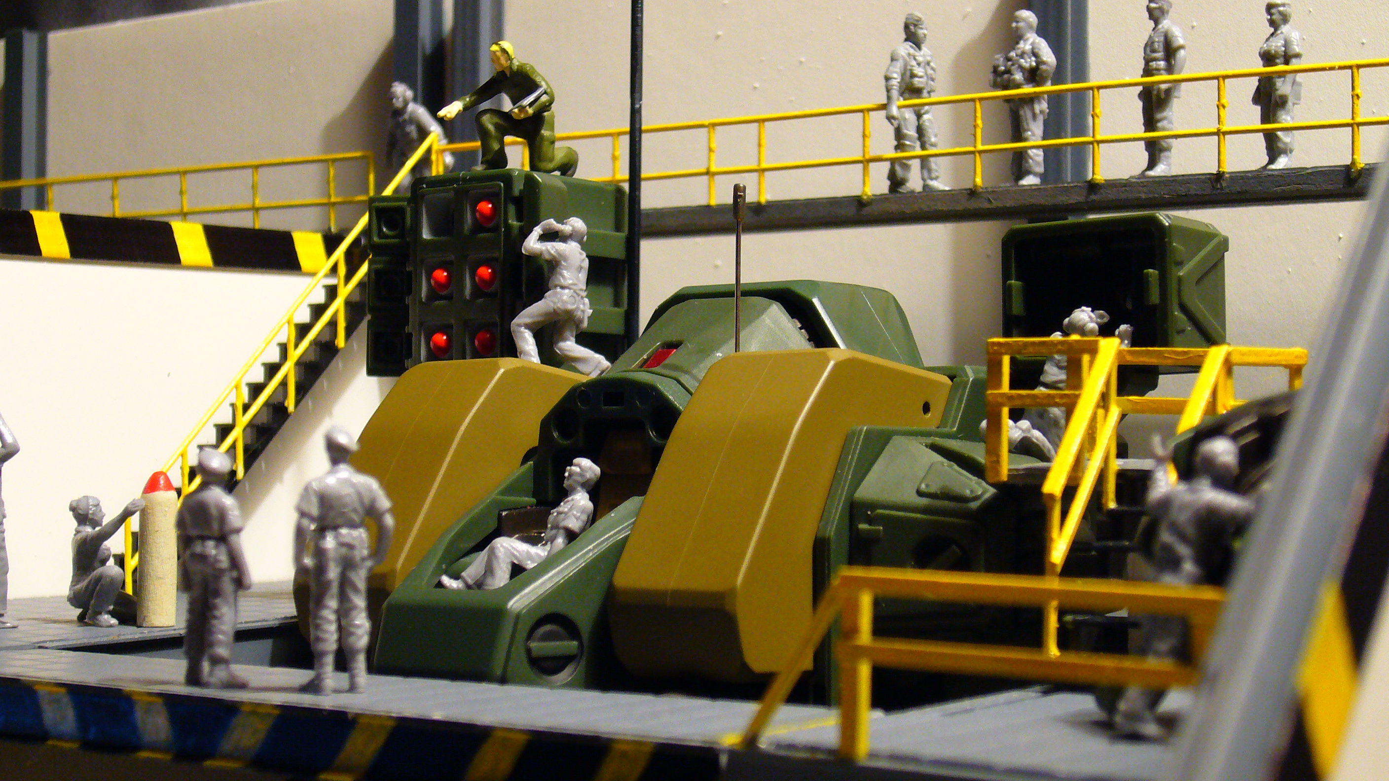

Hello again!!
As promised I have returned with some more "eye candy" for your viewing pleasure ;)

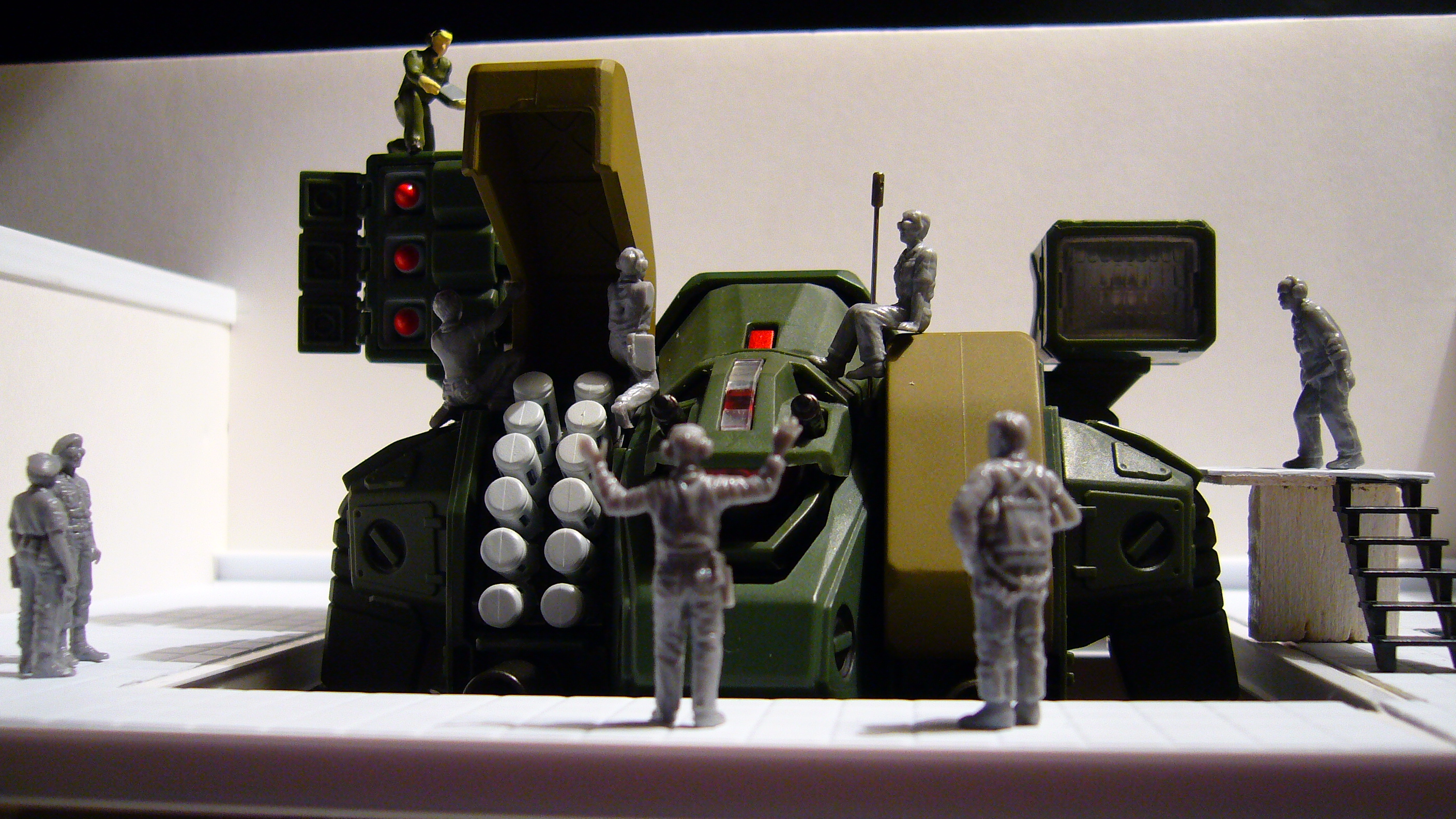

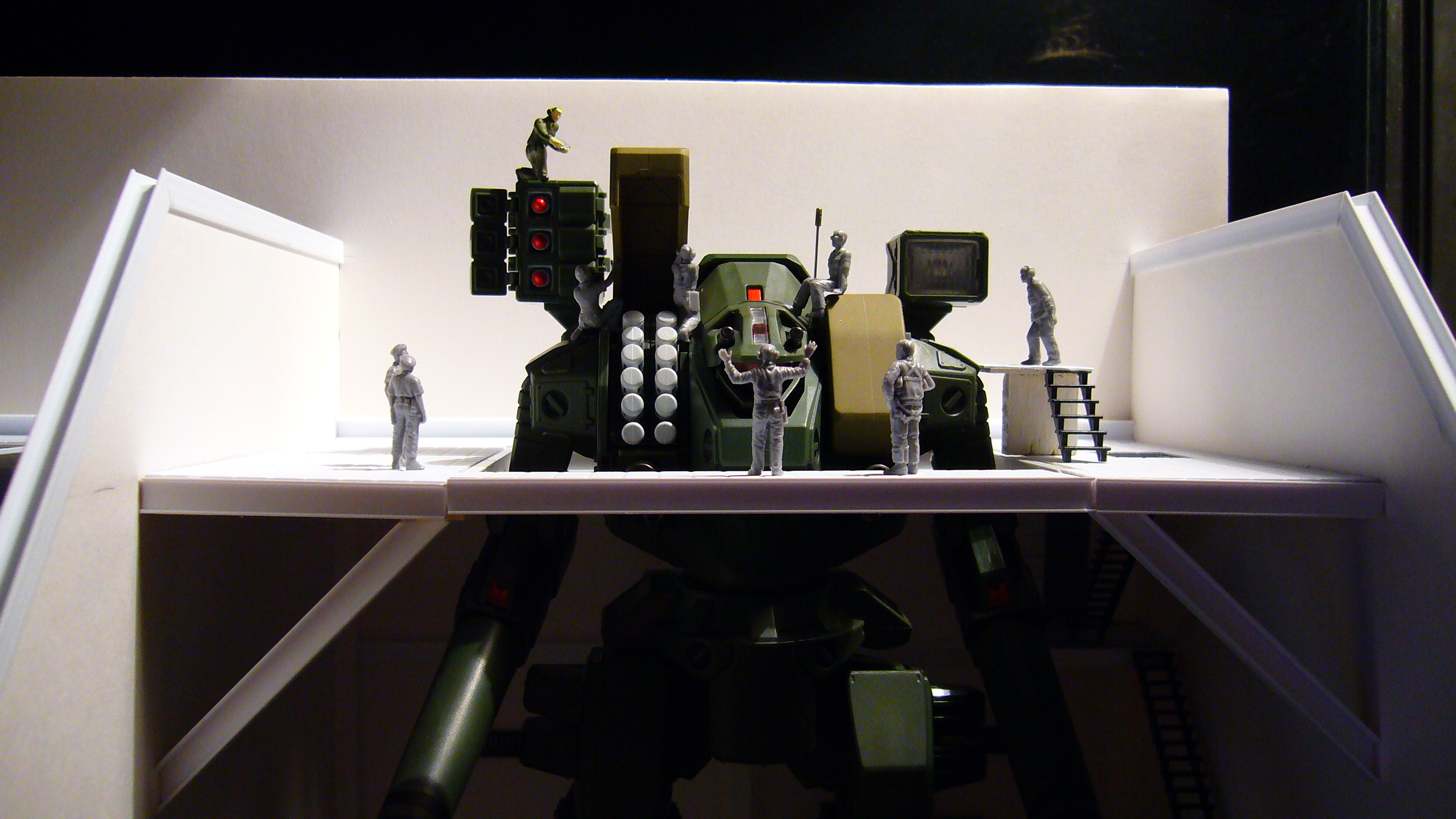

Below you will be able to see my progress on the Tomahawk hanger. In the next pictures you will
see added railings, more detail, and even a mock set up with a (non-painted) crew.
Also shown will be the limited but fully movable parts for entrance in and out of the repair bay.
These pictures are to bring you all up to par with the stage of the build so far.
As always, there is much more to come.
Kick back and enjoy for now and catch you all later,
Blue

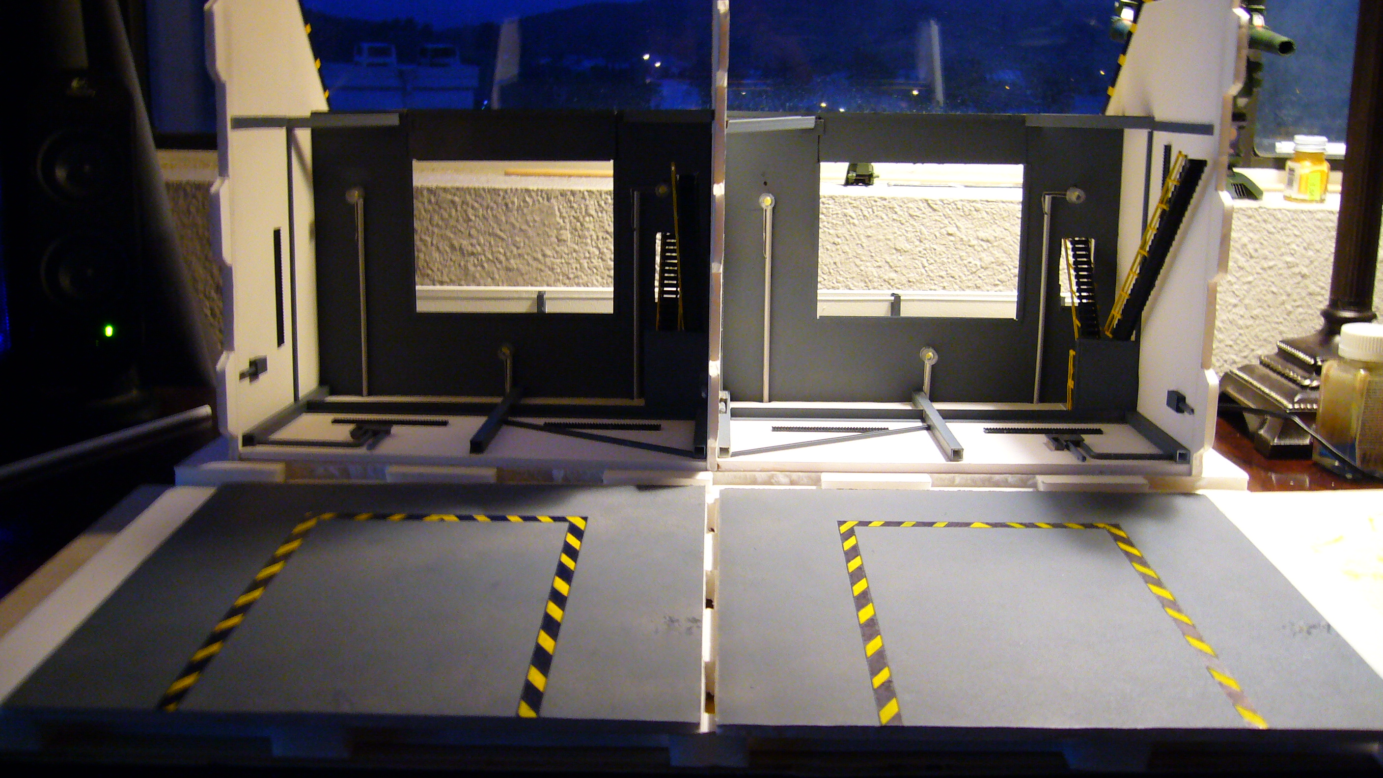

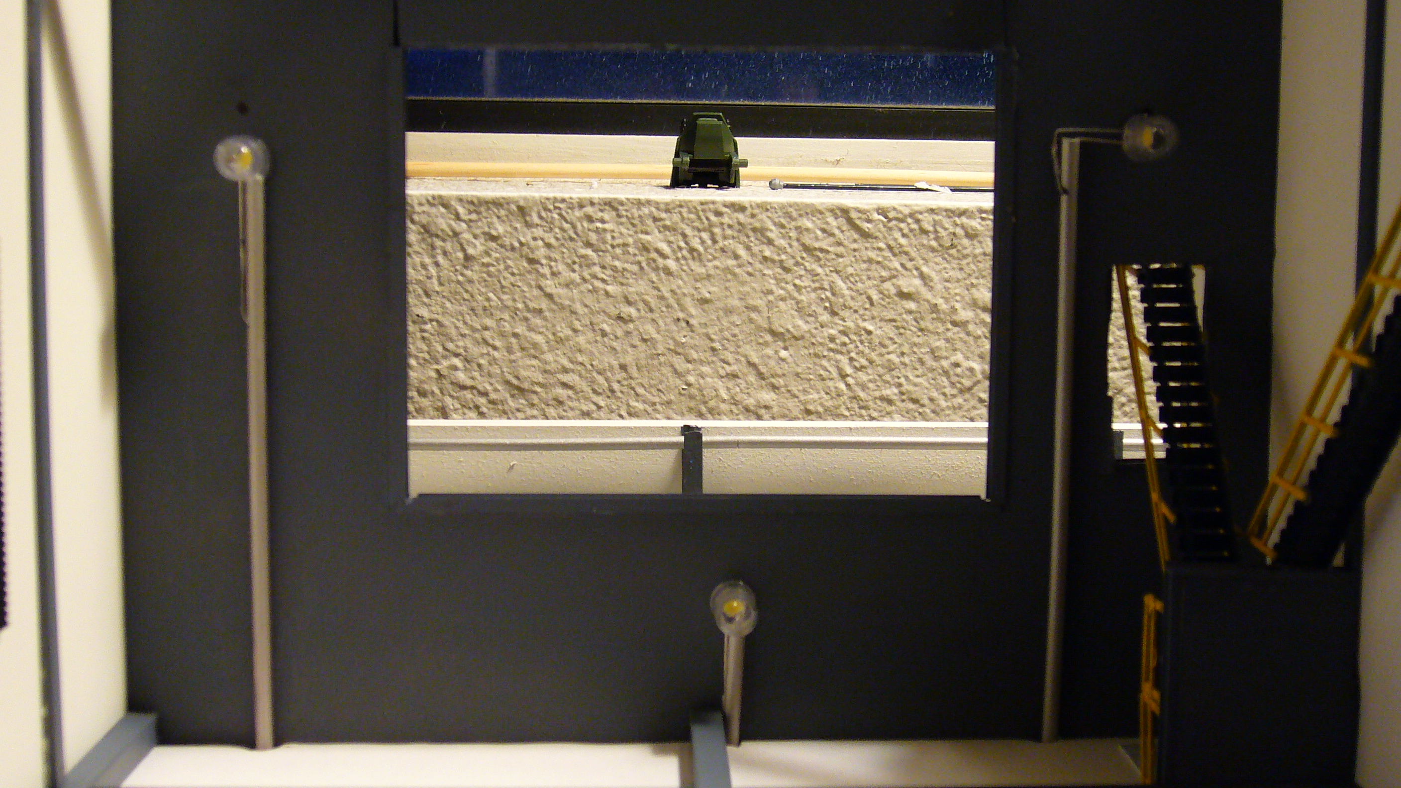

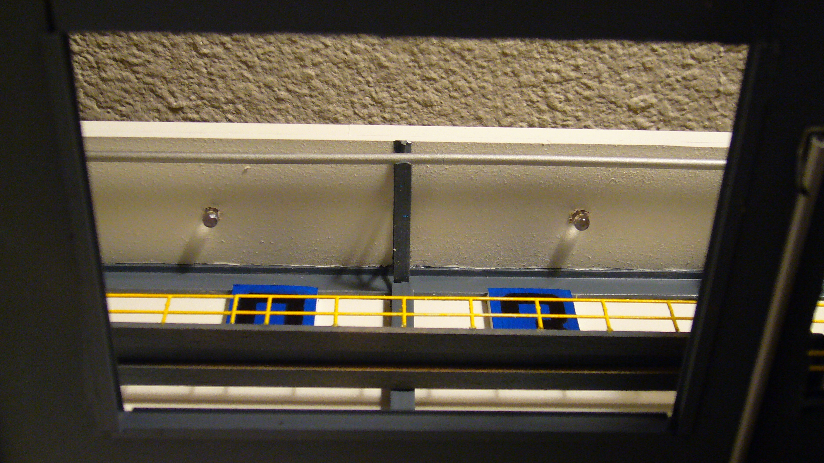

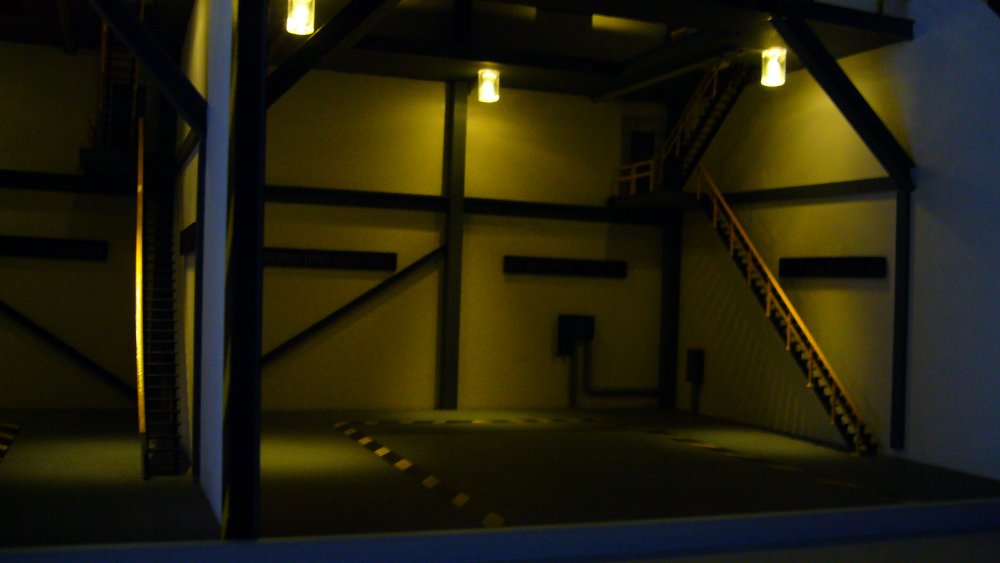

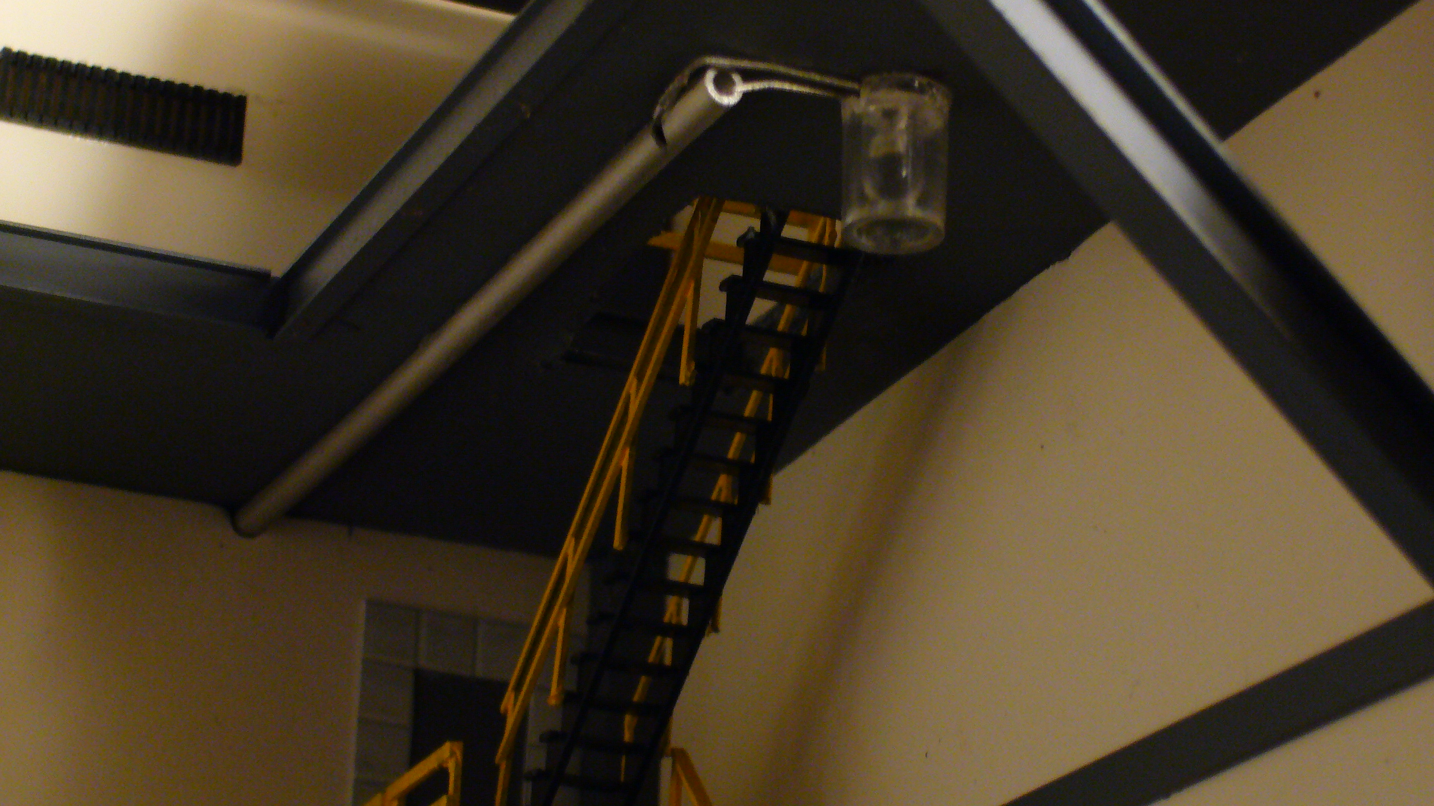

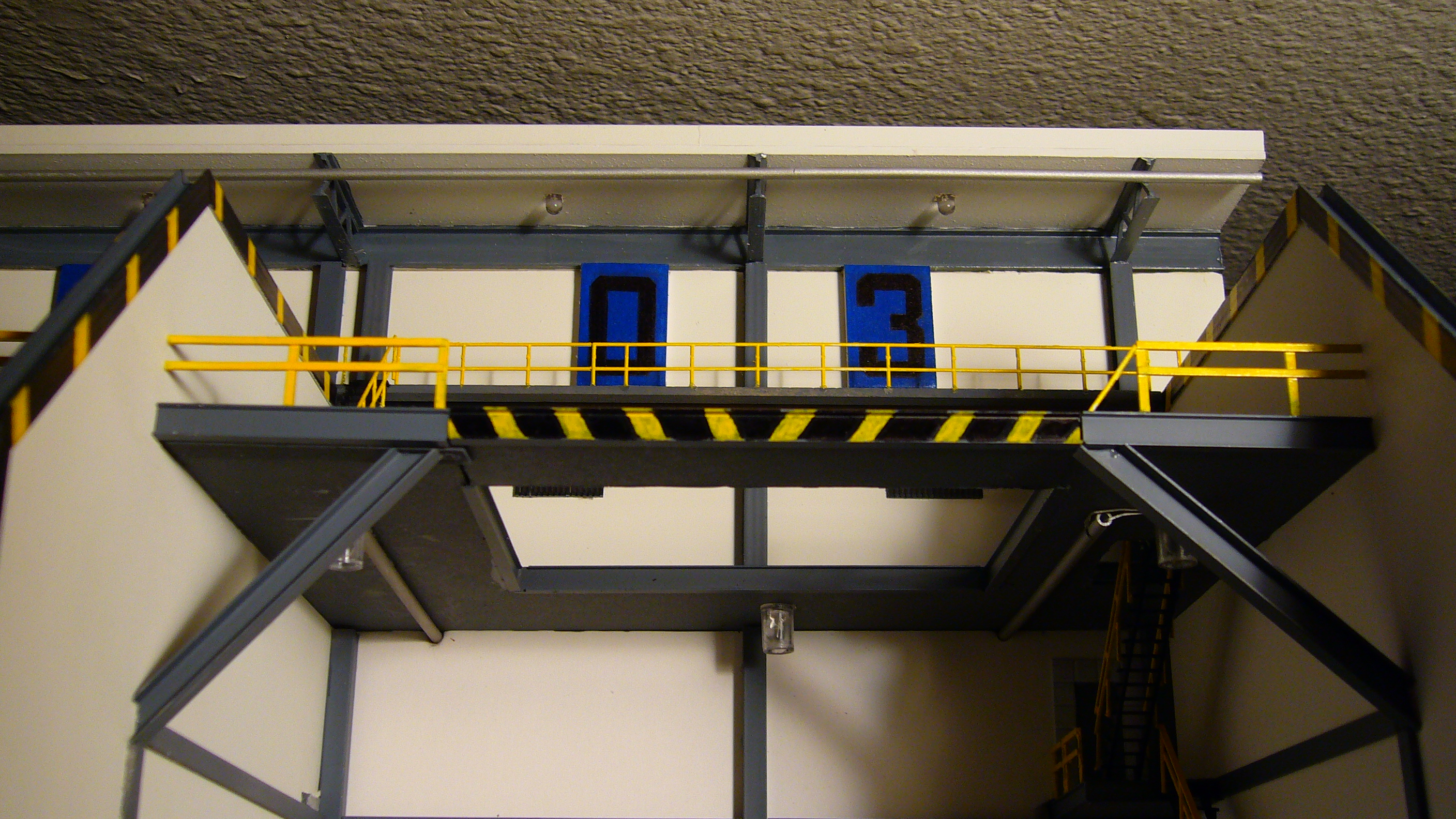

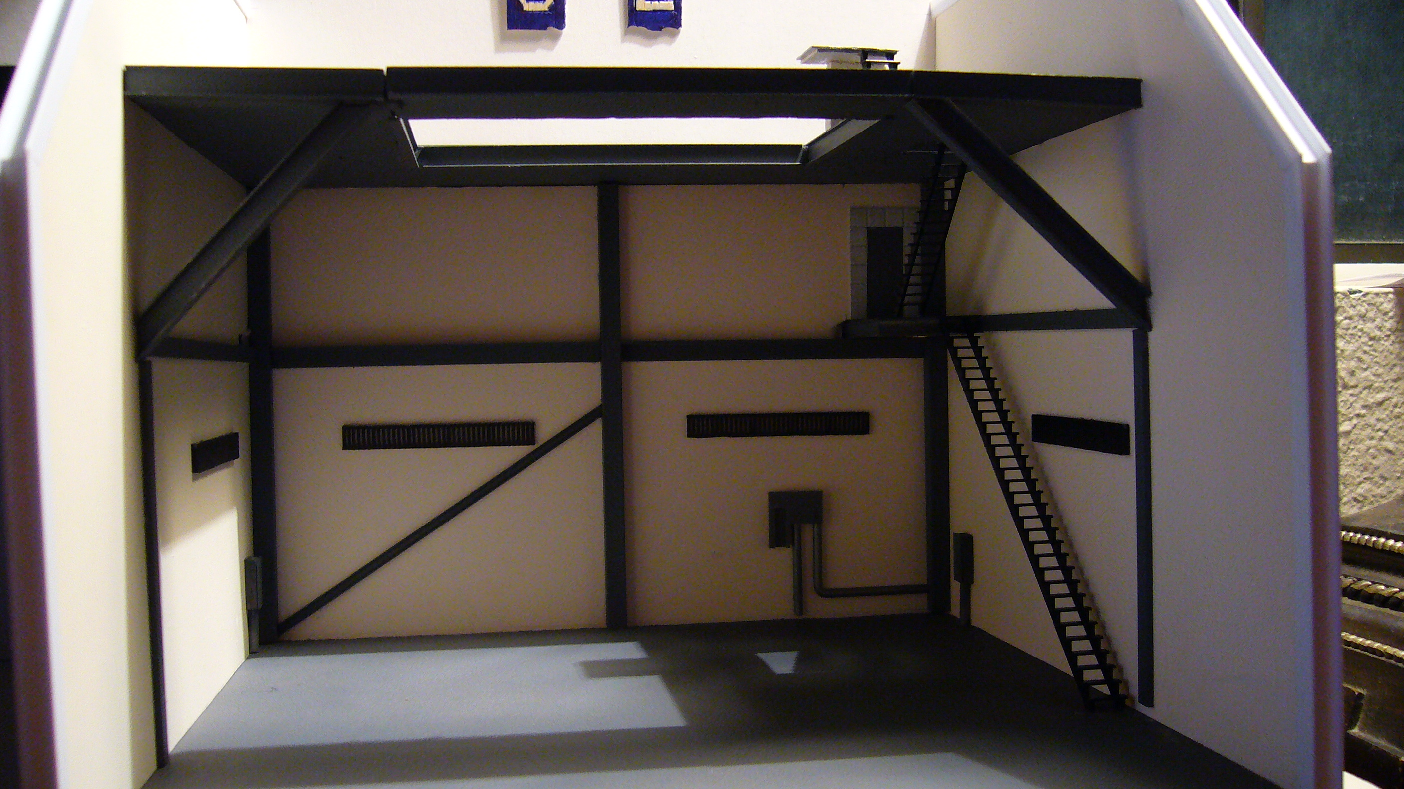

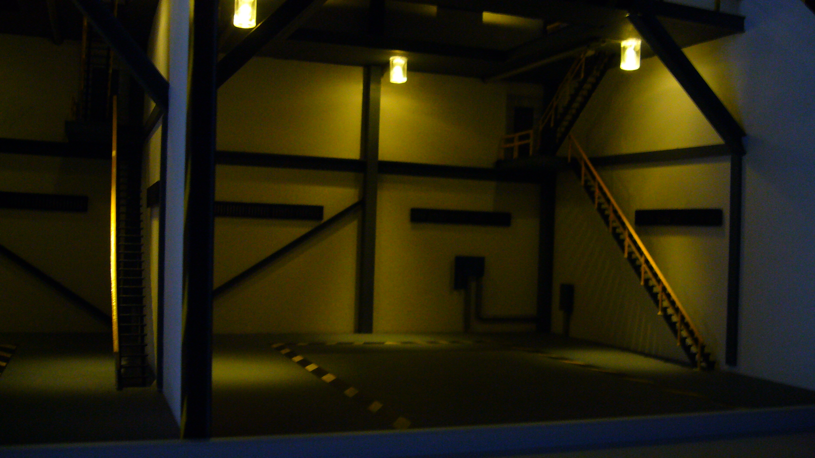

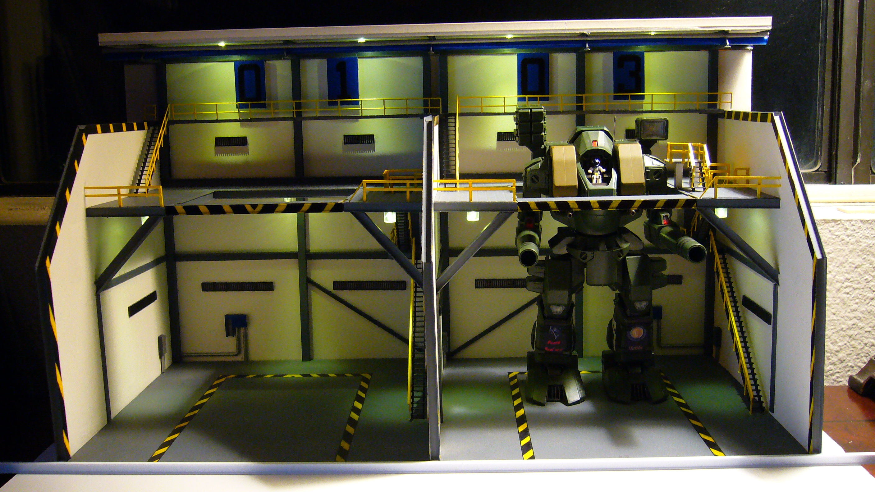

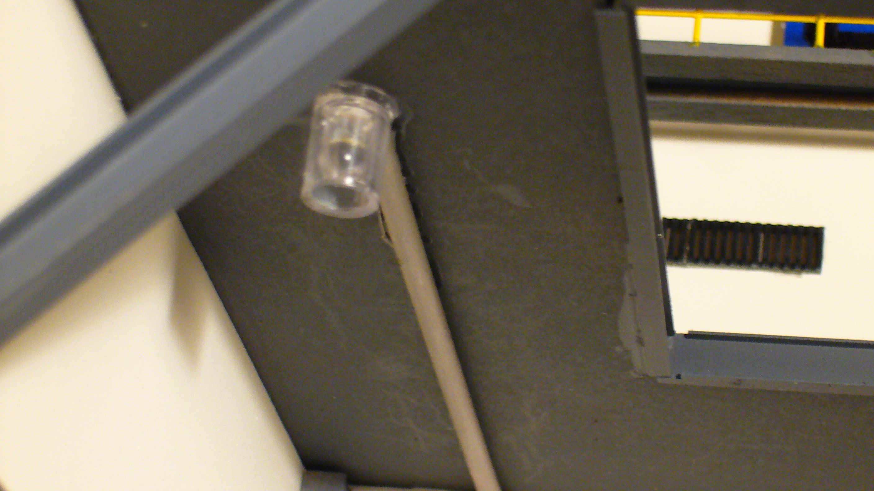

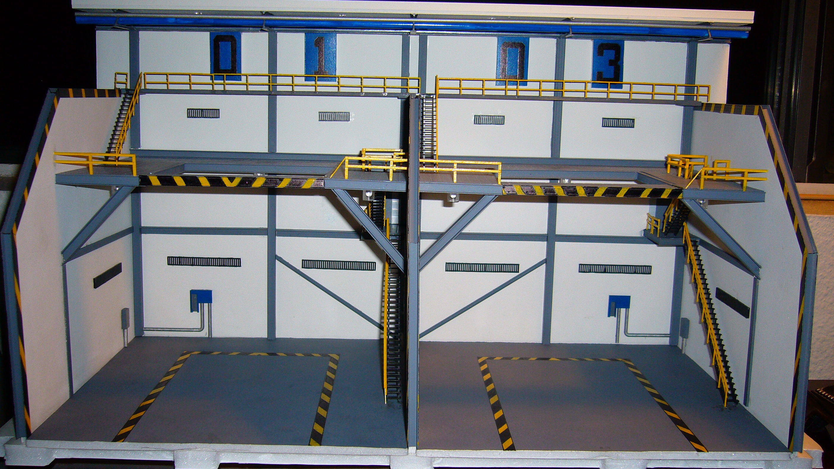

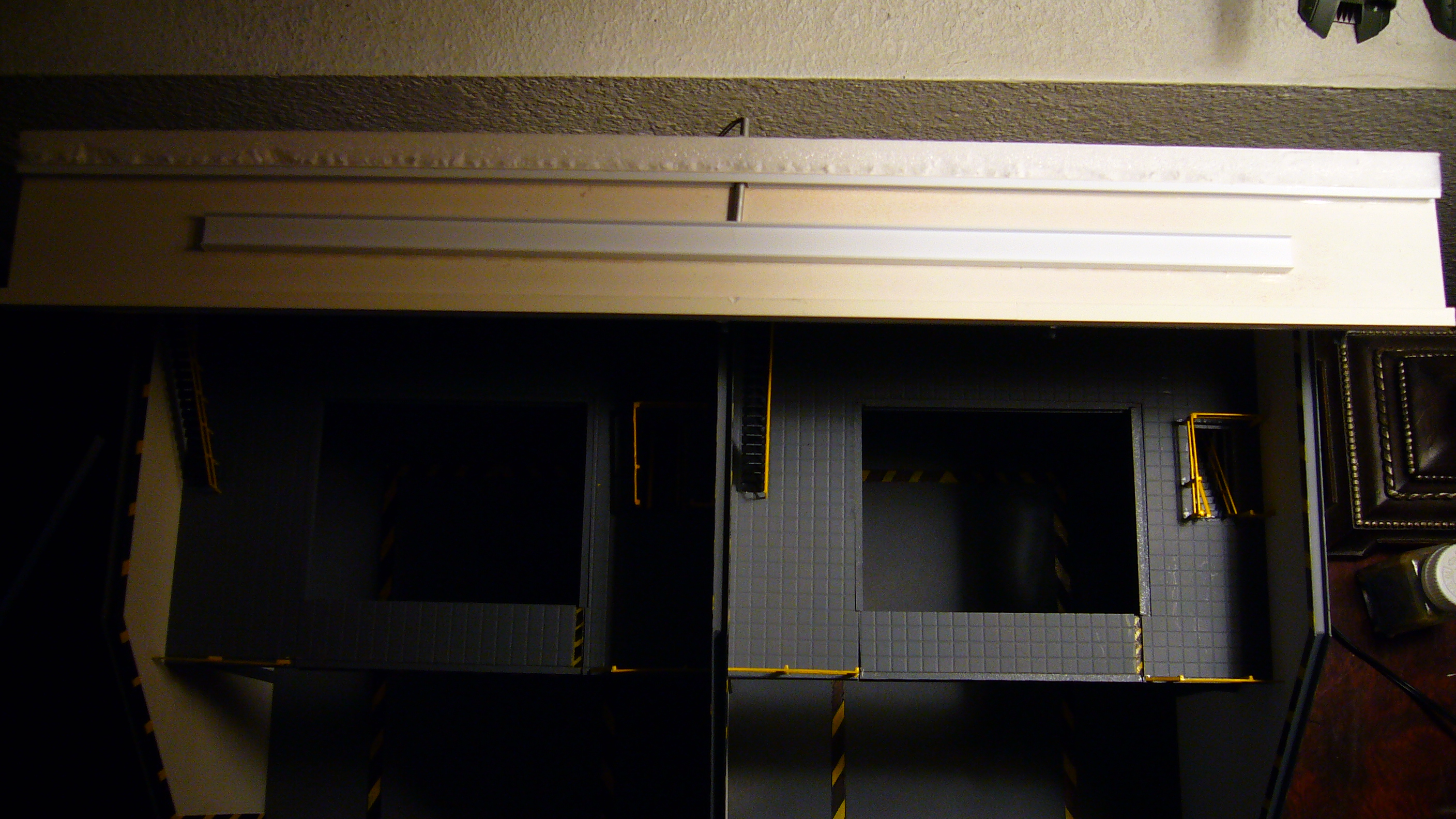

Update: currently working on installing mock lighting for the first floor of the hanger as well as a cross section view of the hanger ceiling structure.
In the first few pictures you will see the partial dissemblance of the hanger so as to show a better view of the lighting detail.
I used plastic tubing as mock electrical conduit and some clear plastic tubing cut to size to make up the lighting fixtures.
Views of the upper ceiling cross section can be seen in the second section of pictures. I used bass wood as a platform, with styrene
square tubing, and styrene trusses for the main structural supports. Styrene tubing was added later for detail of piping.
Also note you can see the requested blue and black hanger numbering as well. Last two pictures are of the frontal view, without
flash and last one is with flash.
And as always more pictures will come as progress is made.
Blue
Freakin awesome! Where did you get those lights? They are perfect.
The lighting assembly is hand made and consists of 1/8 inch round styrene tubing for the conduit and 1/4 inch clear tubing
that can be found at a pet store or anywhere they sell clear tubing for fish tanks and such. the clear tubing allows
a nice fit if you where to install LED lighting as well.

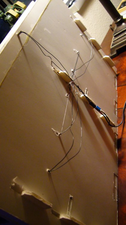

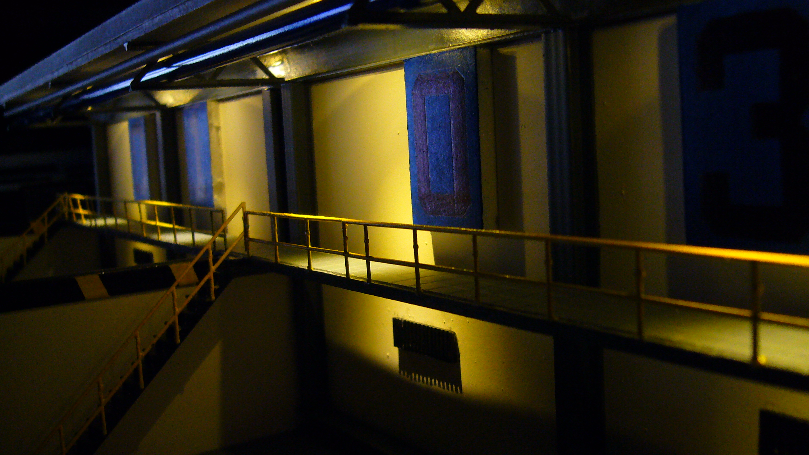

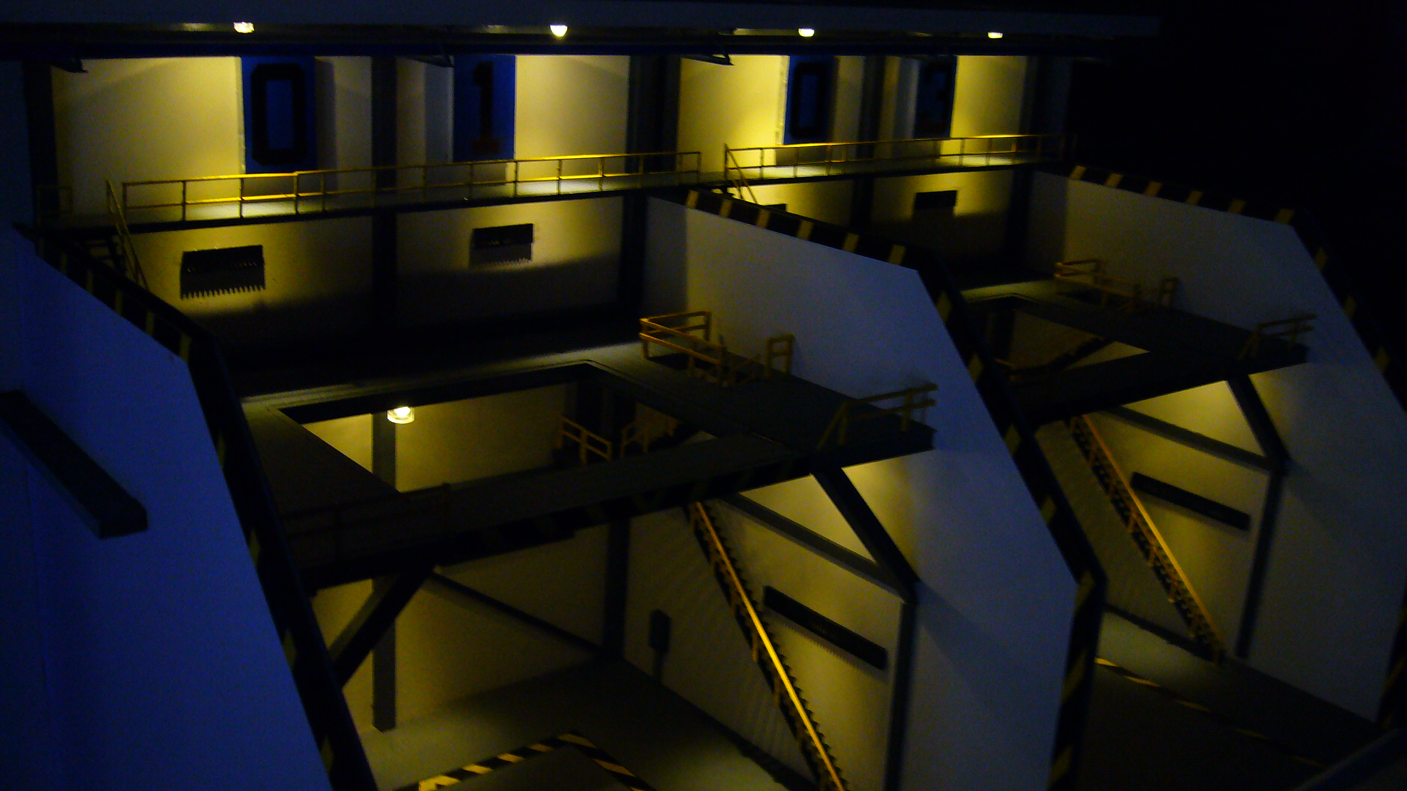

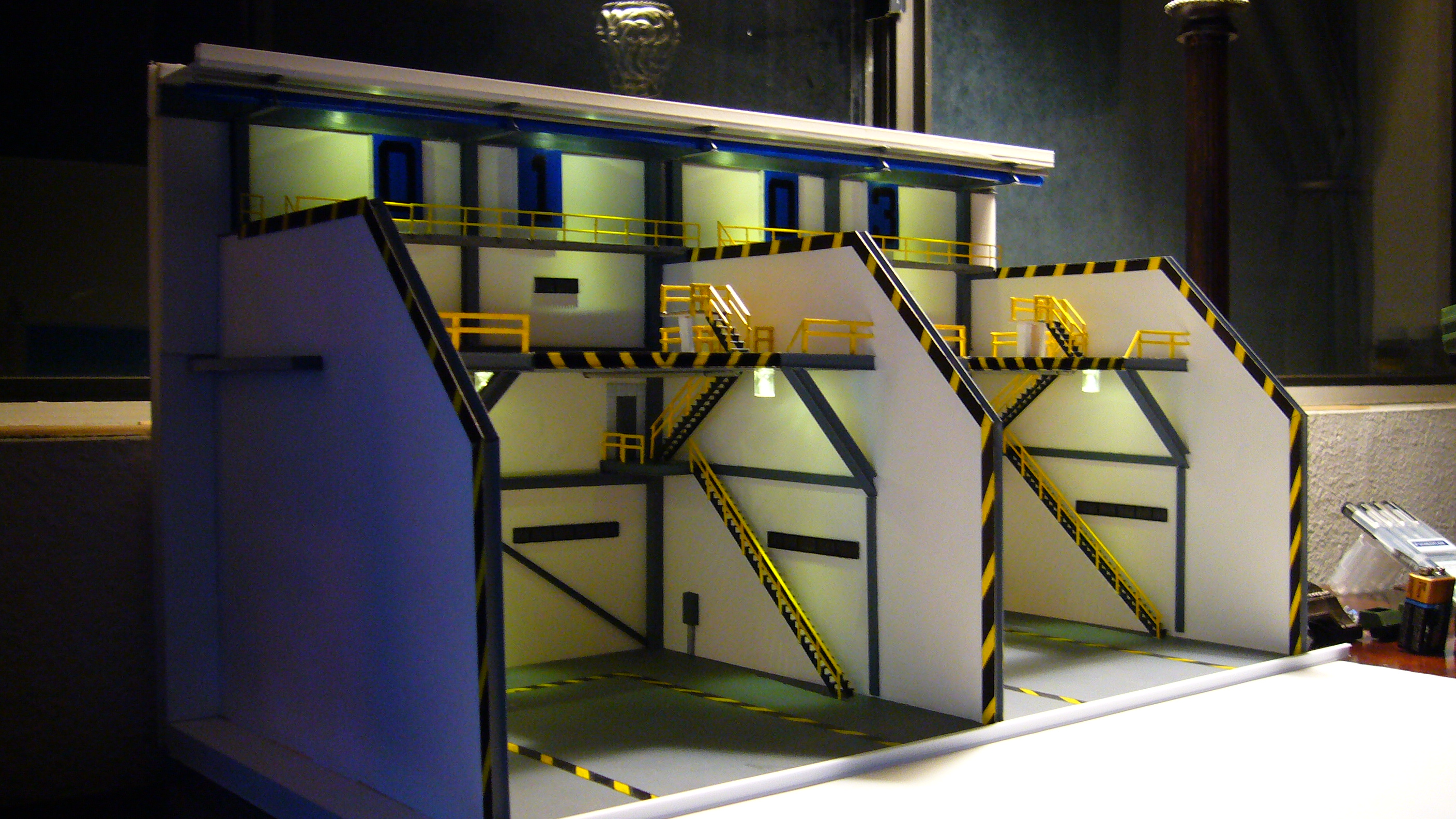

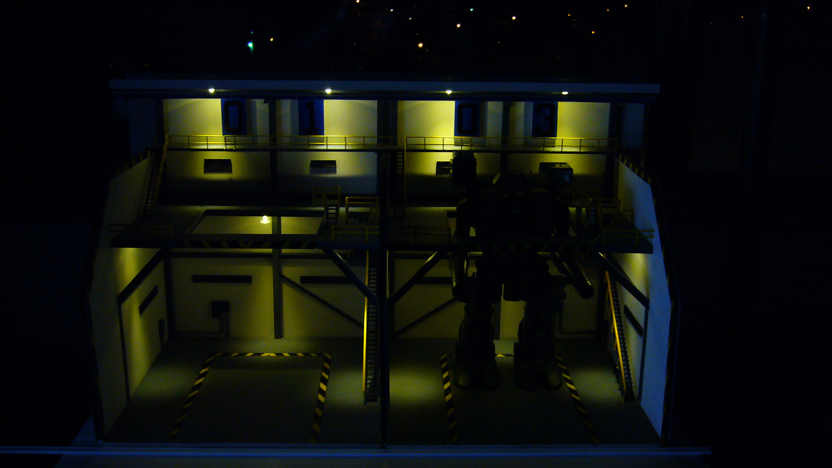

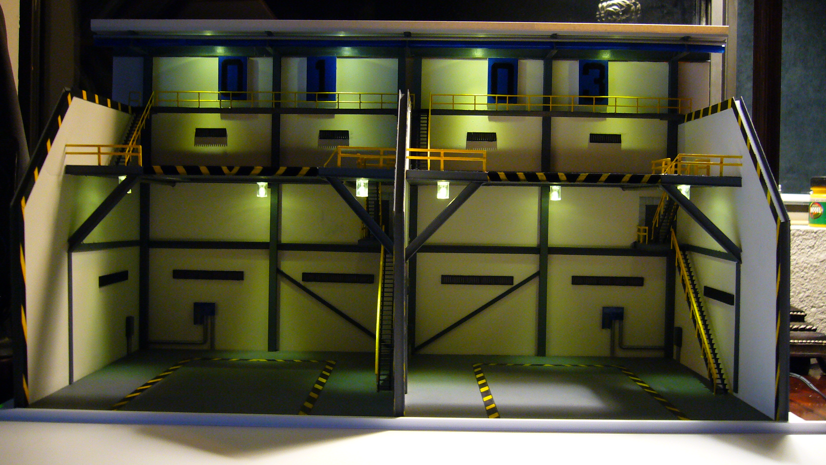

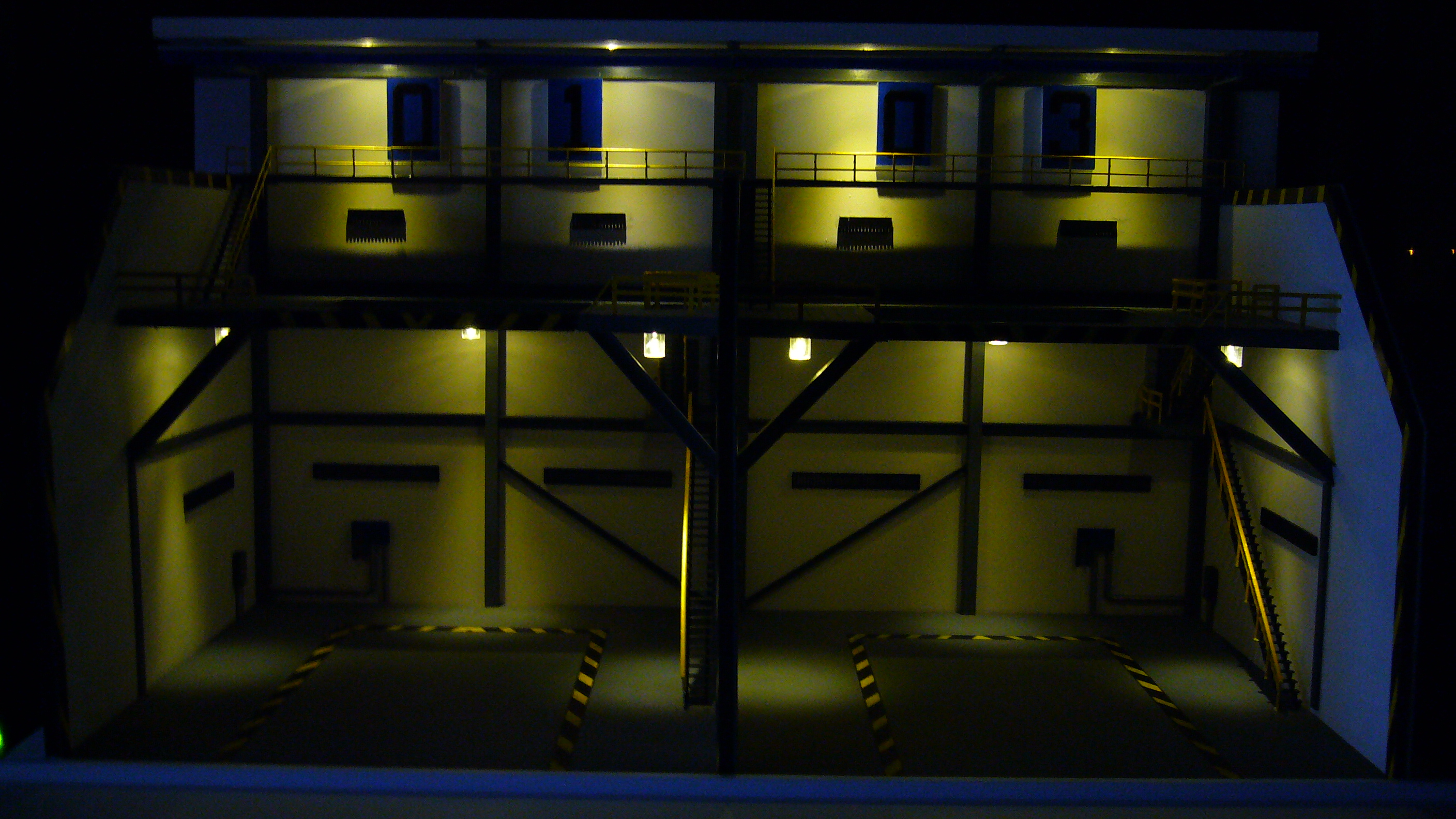

Hello again!!
I'm back with yet another update as this part of the project comes to its conclusion.

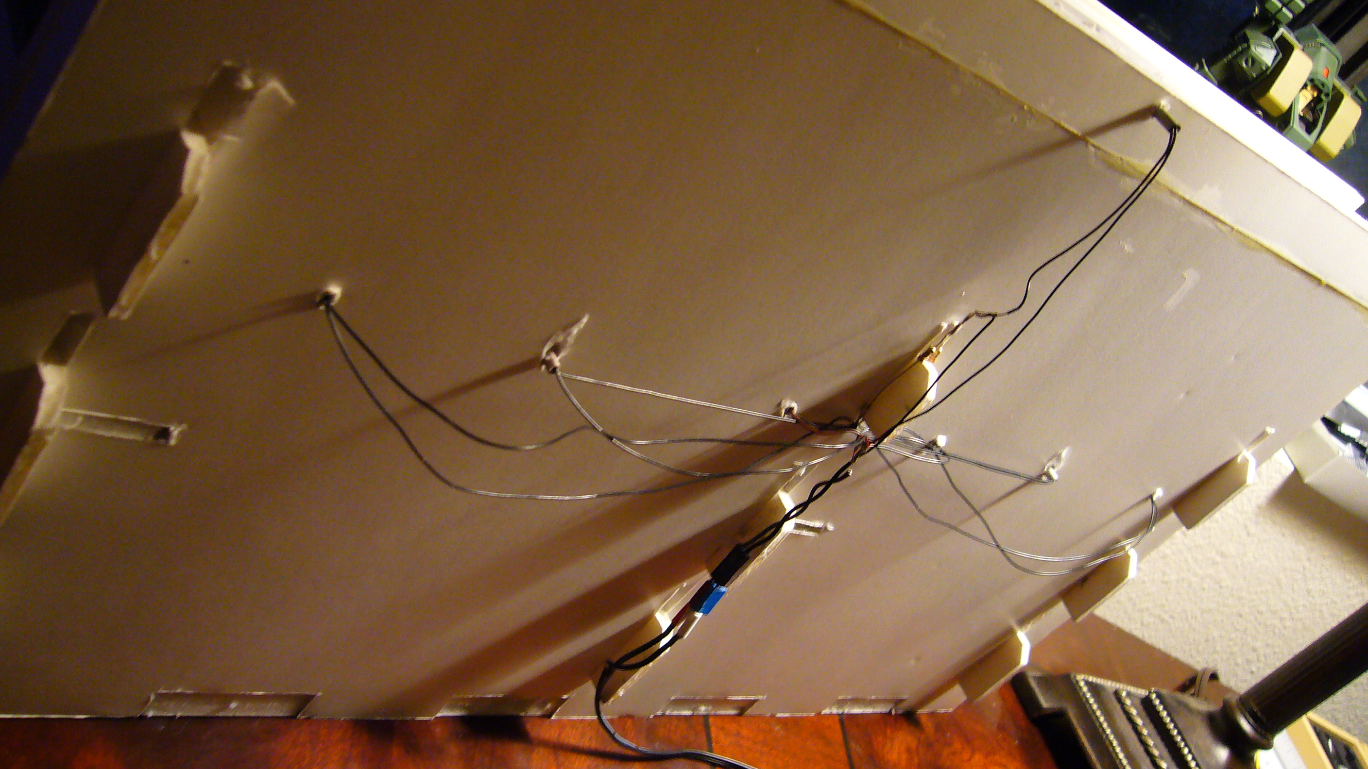

In the fallowing pictures you will see clips of the wiring harness and a temp cover to
provide some sort of safety from snags and such. Also will be included pictures of
the hanger in different lighting settings as well as different angles for your viewing pleasure.
(and even a couple with a Hawk included)
The first few will have normal lamp lighting on and then the fallowing pictures after that will have
only the lighting of the bay itself. (with some reflection lighting from my computer monitors)
I hope you have enjoyed this project thus far and look I forward to showing you the other
sections (in the near future) that will compile the overall display of the diorama called Purgatory.
(as described and detailed by the Author and Creator of Destroids Last Dance, Rob Elwell.)
So without further ado...kick back once again and enjoy the eye candy!! B))
Blue

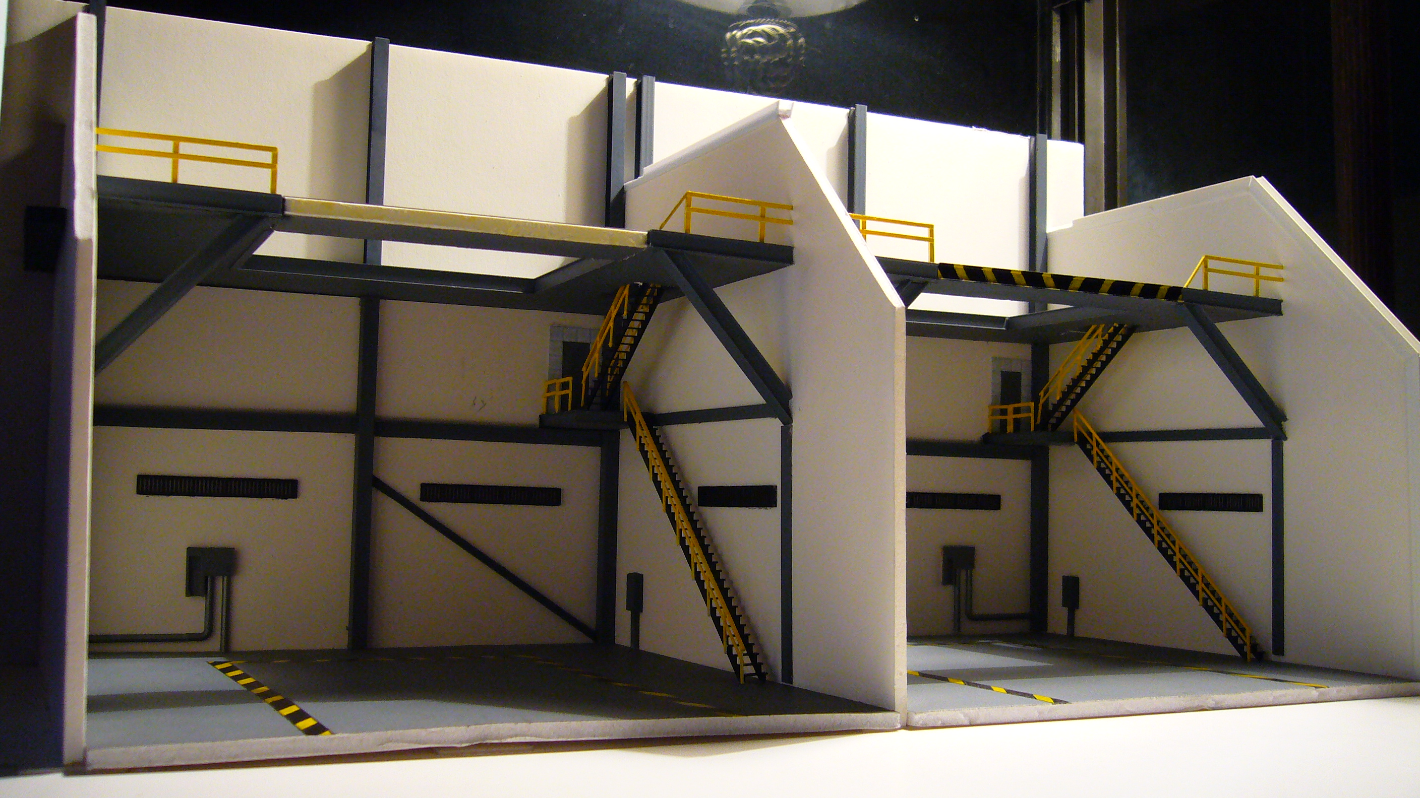

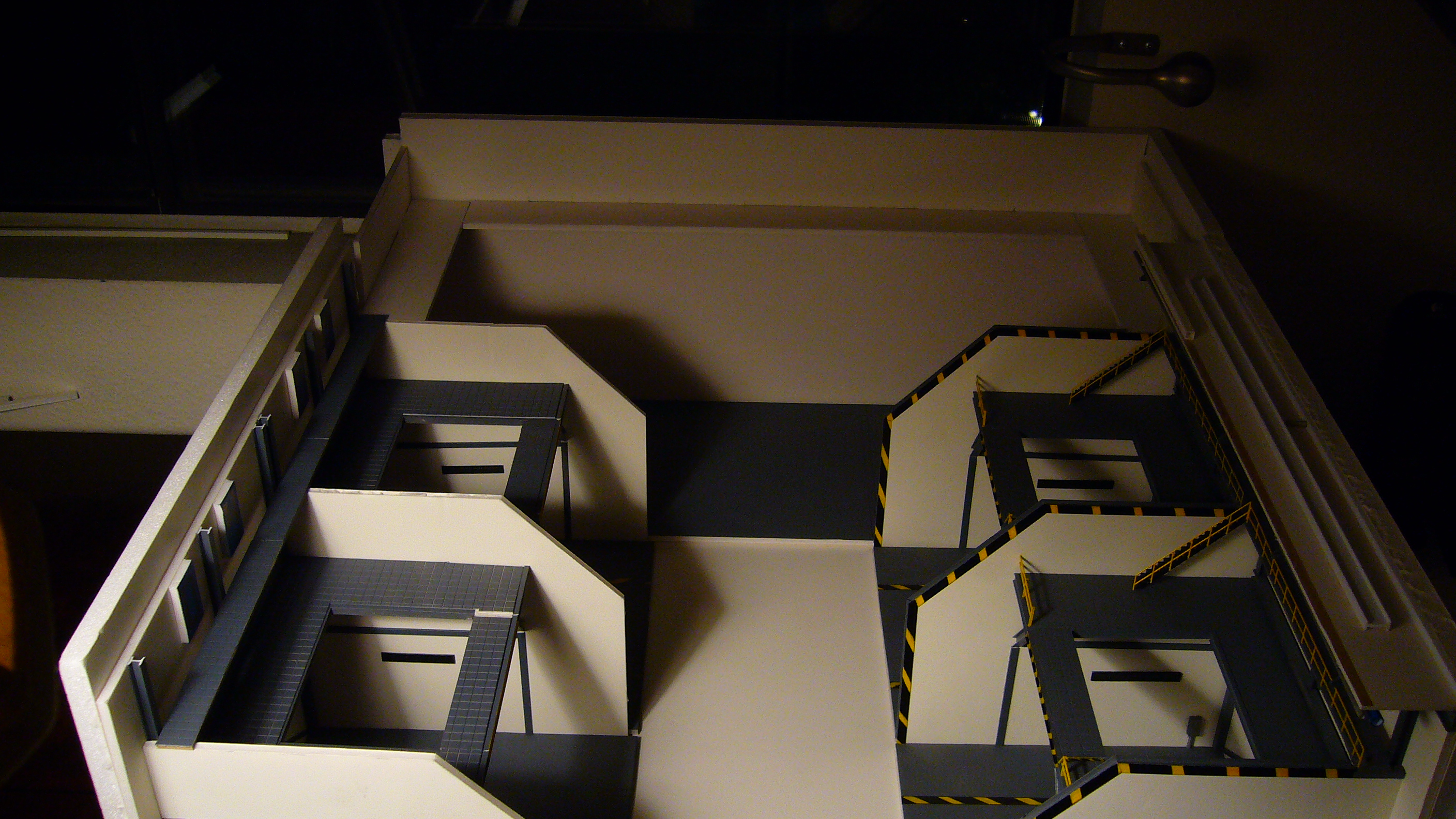

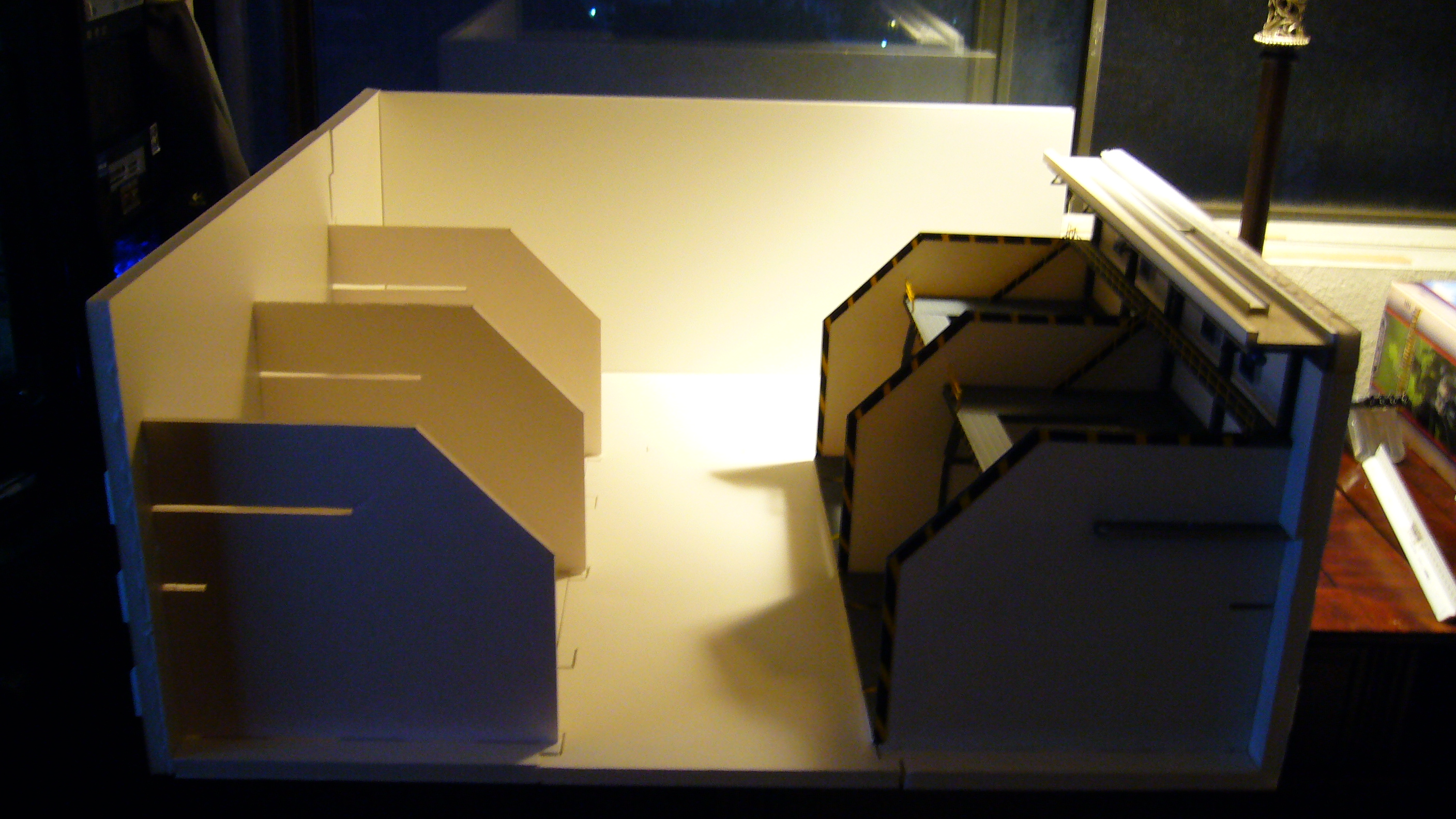

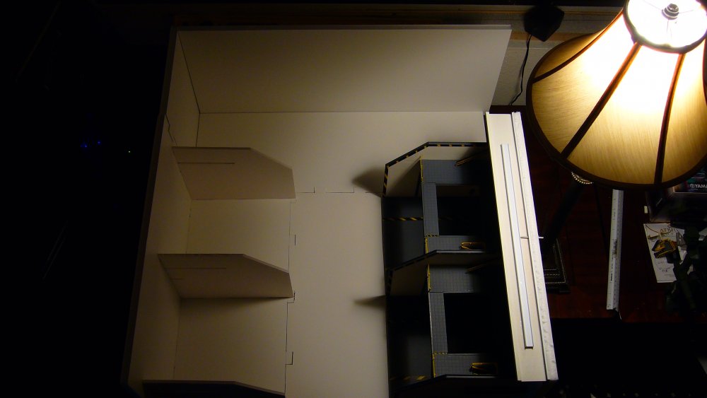

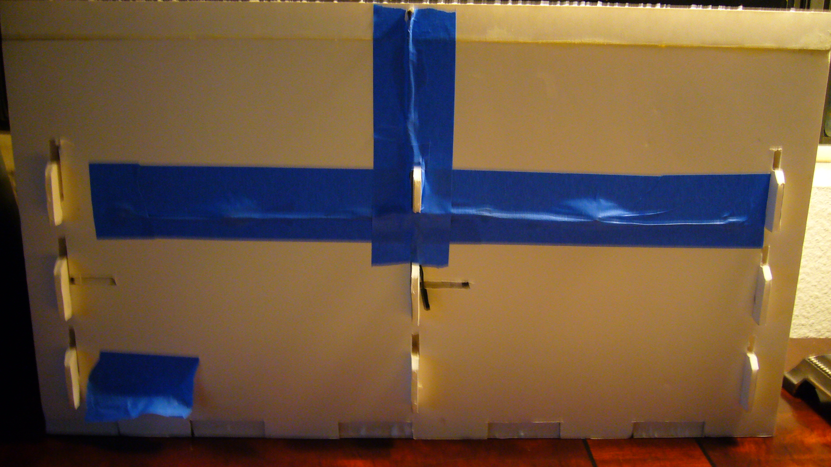

Thought I would drop by and show some more progress on the build.
In the next few pics you can see the additions I have begun to make.
(Included a cause way, a mirrored section of the first hanger build, and a soon to be maintenance area)
Enjoy and feel free to ask questions or make comments B))

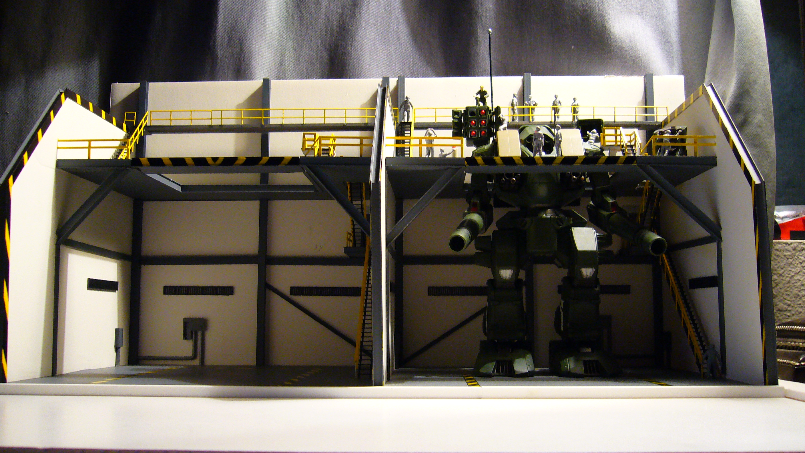

First picture is a demo of a side by side setup, fallowed by across the cause way set up,
and then lastly the mock set up with maintenance area minus one wall.

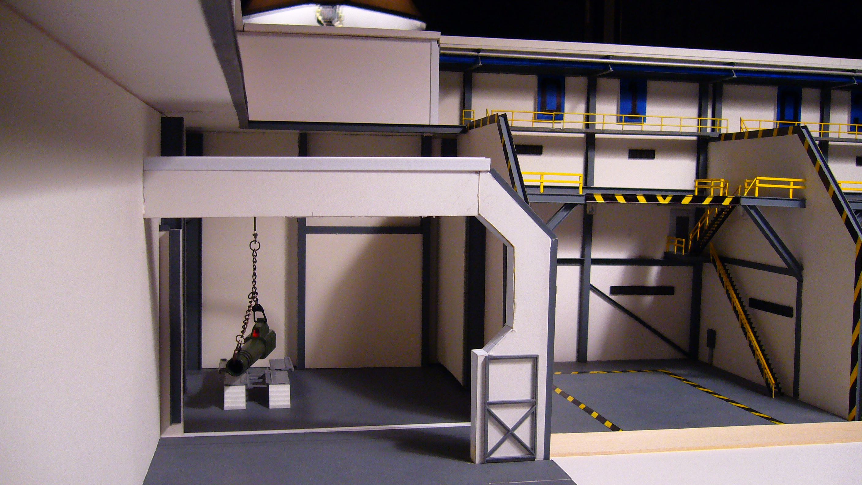

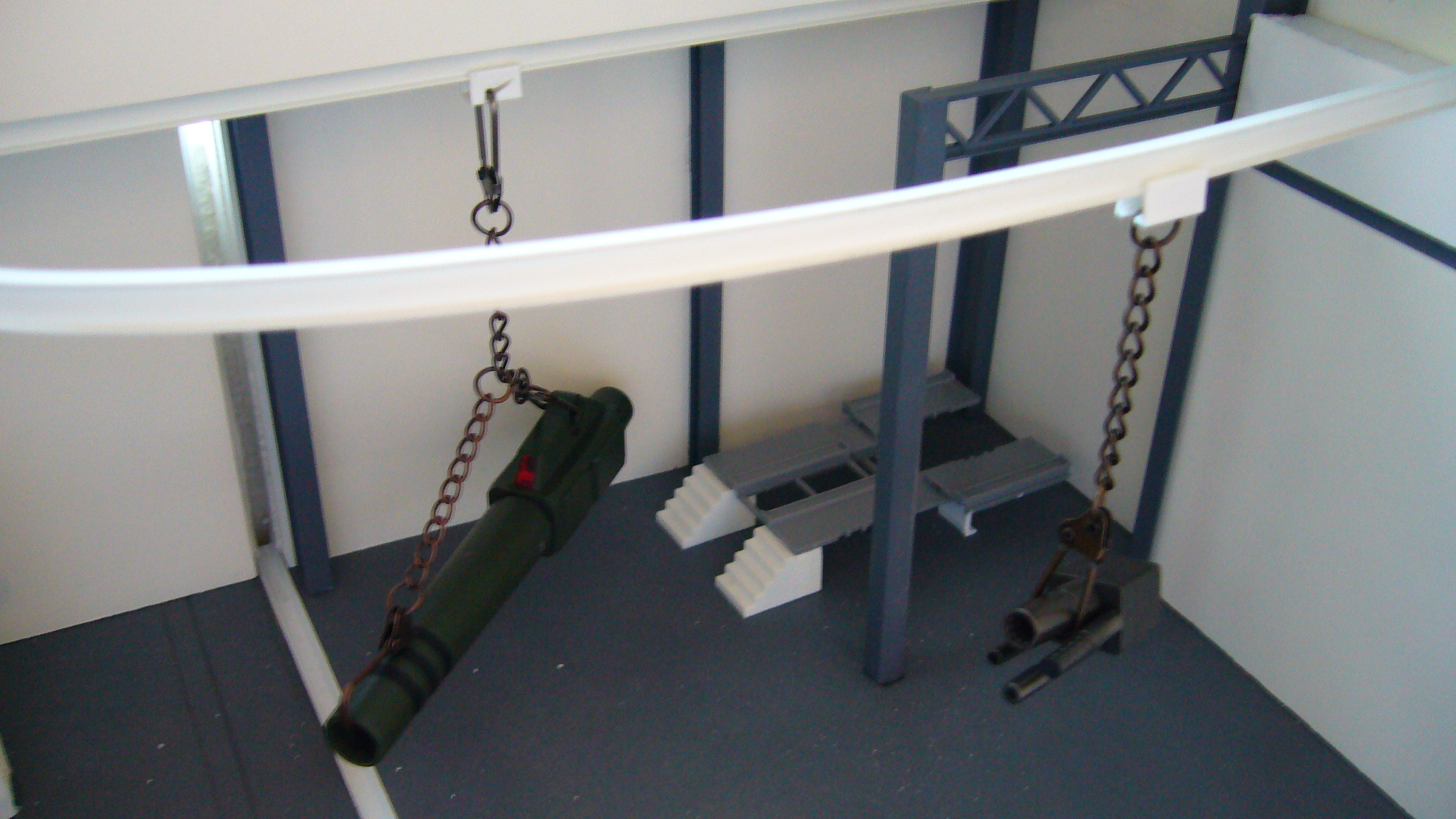

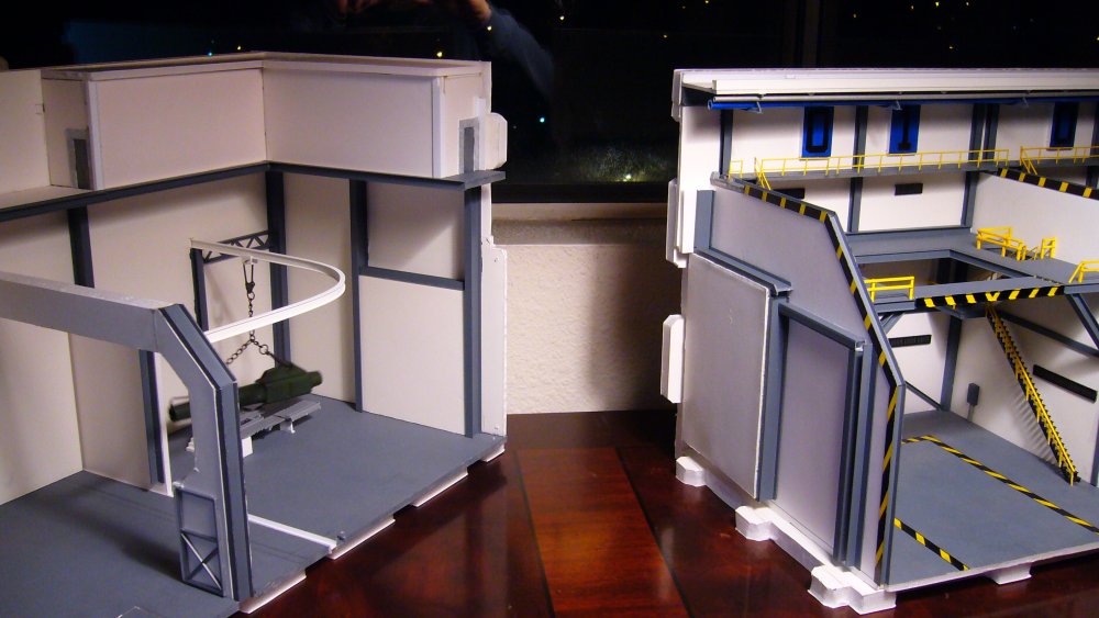

Hello All,
Well after much turmoil with the moving and selling bit of the condo,
I have finally been able to get back to this project. The first picture is a duplicate from
where I last left off and then went from there with new images.
I have progressed with some detailing of the mated (double) hanger, however I have
moved my focus to the Weapons Repair and Ammo Prep stations within the Maintenance
Area section of the overall hanger build.

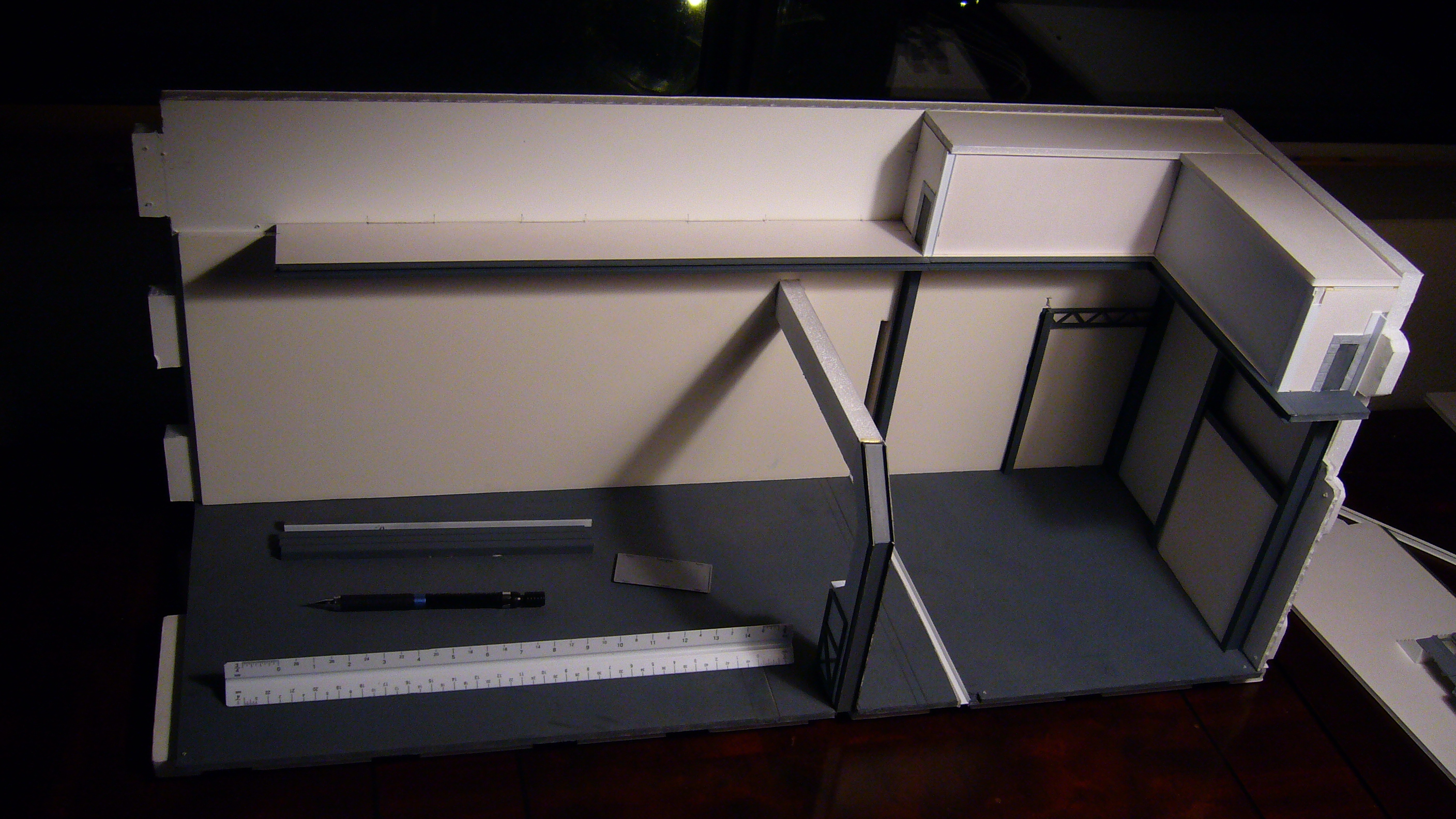

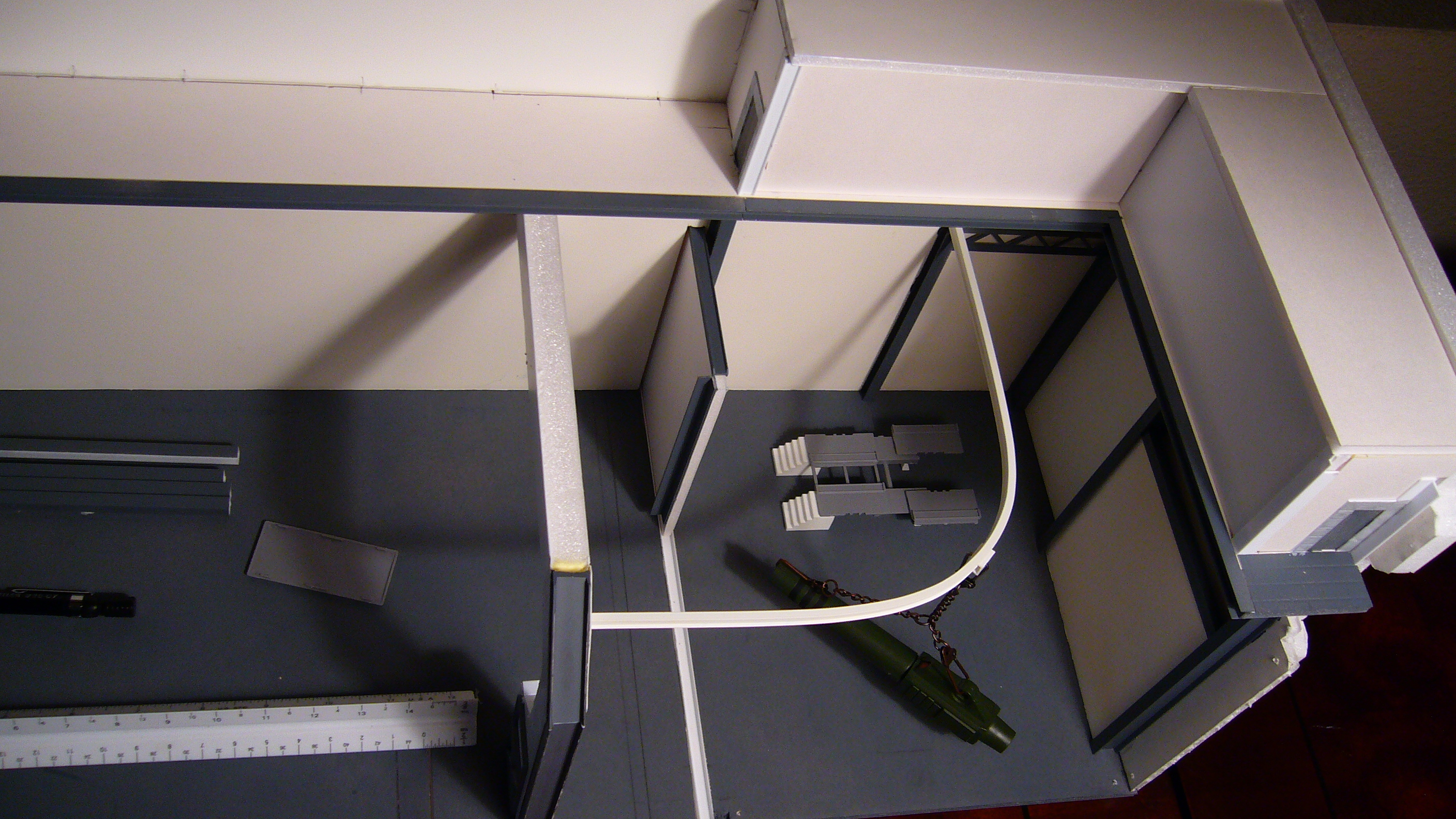

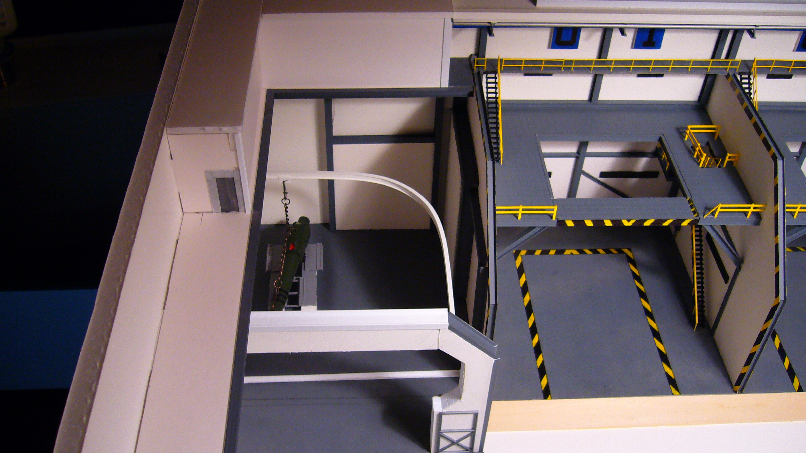

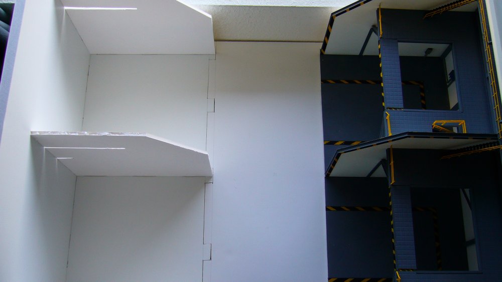

In the prep area you can see the initial foam board construction followed by added detail
to the walls and structure, as well as a weapons crane rail for moving the heavy cannons of the Tomahawk.
Also added is a divider door that slides open and closed to provide added protection and containment
during repair and/or reloading operations.
The last 3 pictures show how the Maintenance area mates up with one section of the (double)
hanger bay and the causeway (thus showing off the modular aspect of this build) and also provides
a close up of the Weapons Repair/Ammo Prep Area.
Hope you all have enjoyed these pictures and I look forward to seeing you again with more progress soon. B))
Blue

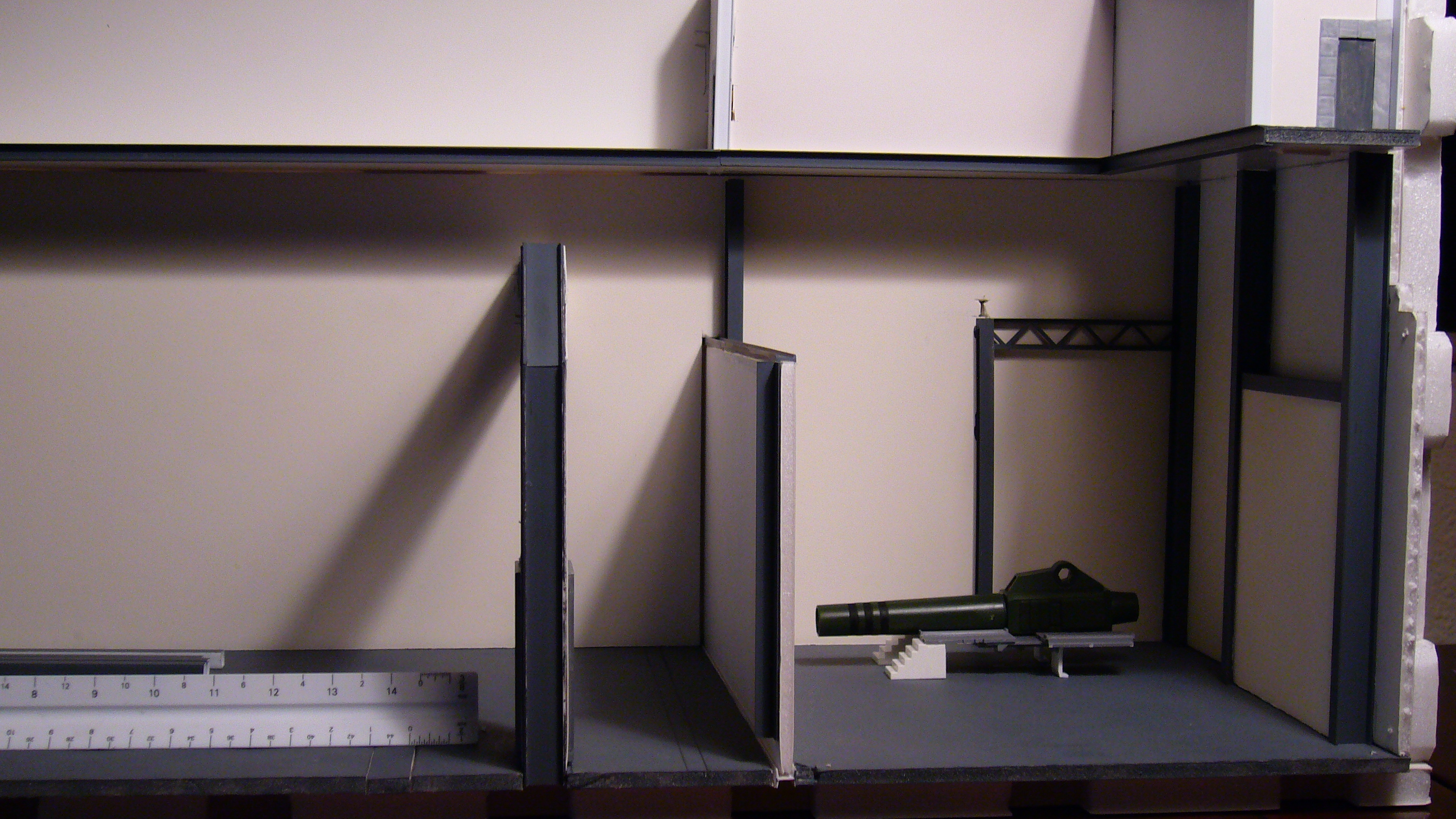

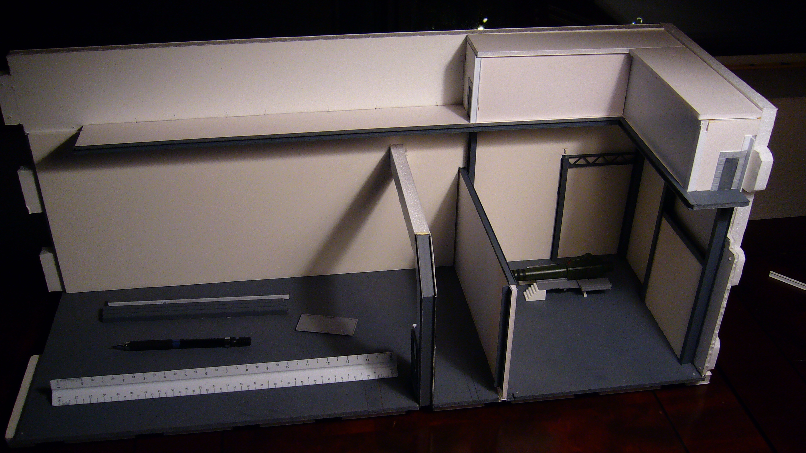

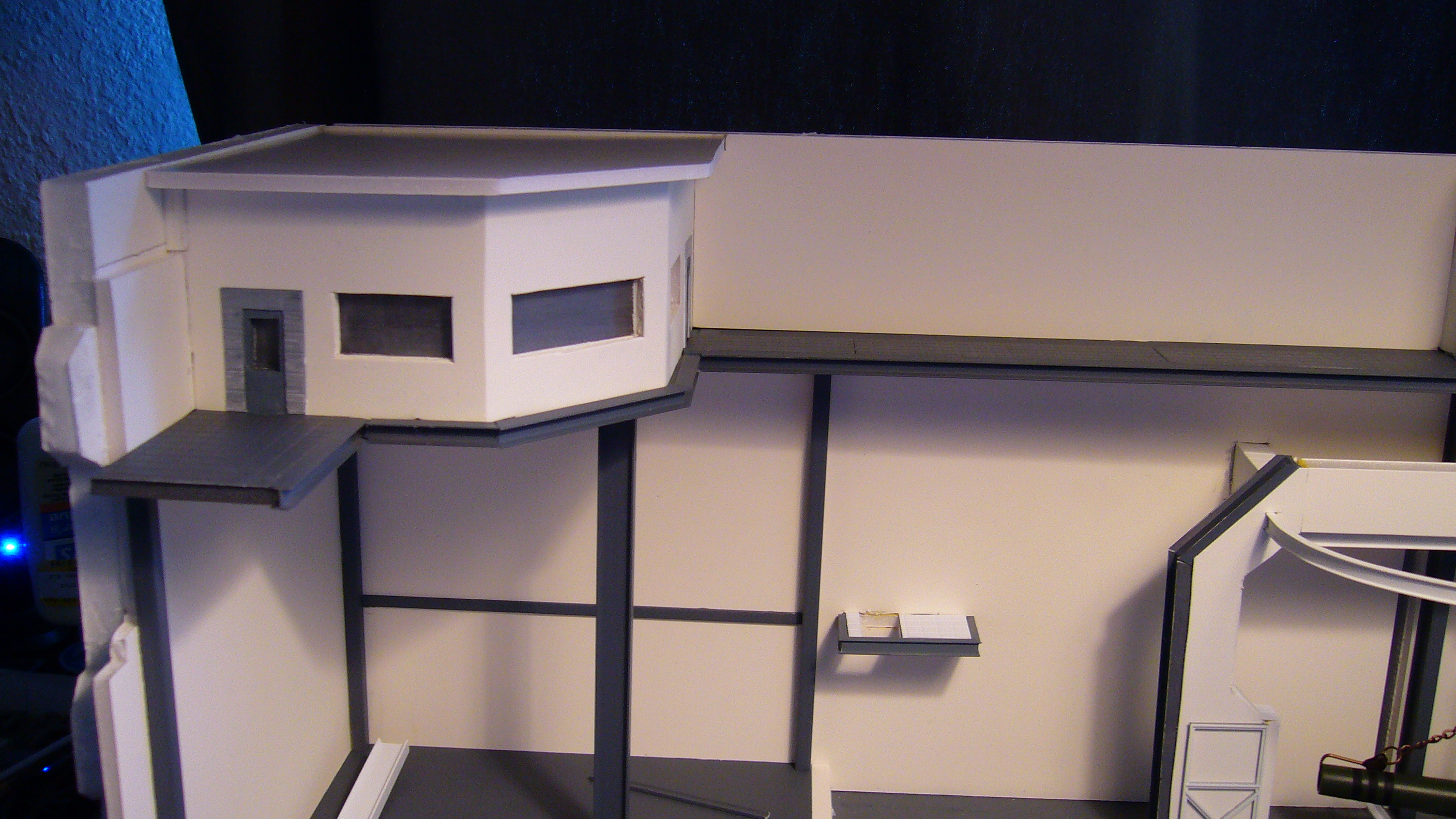

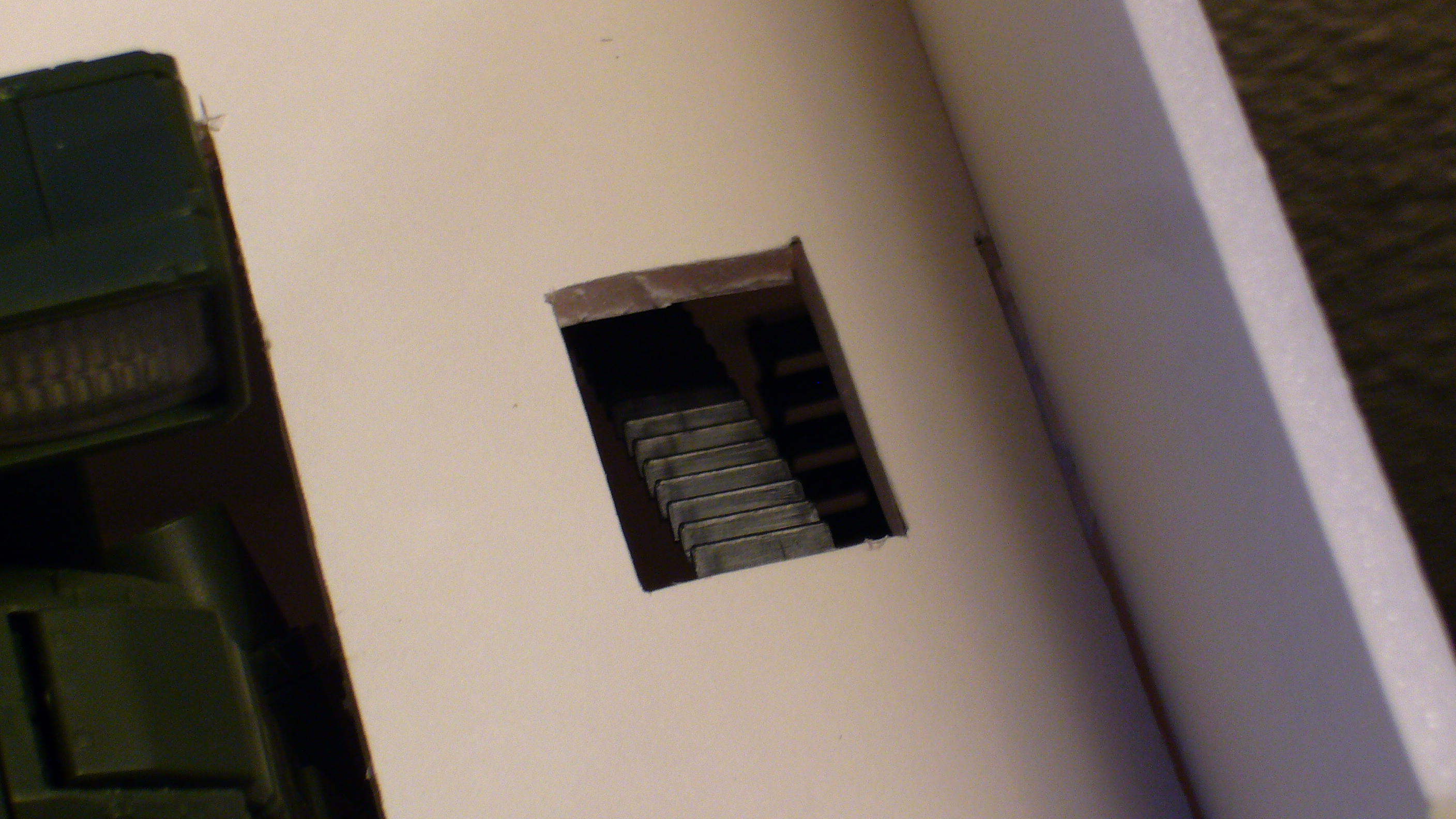

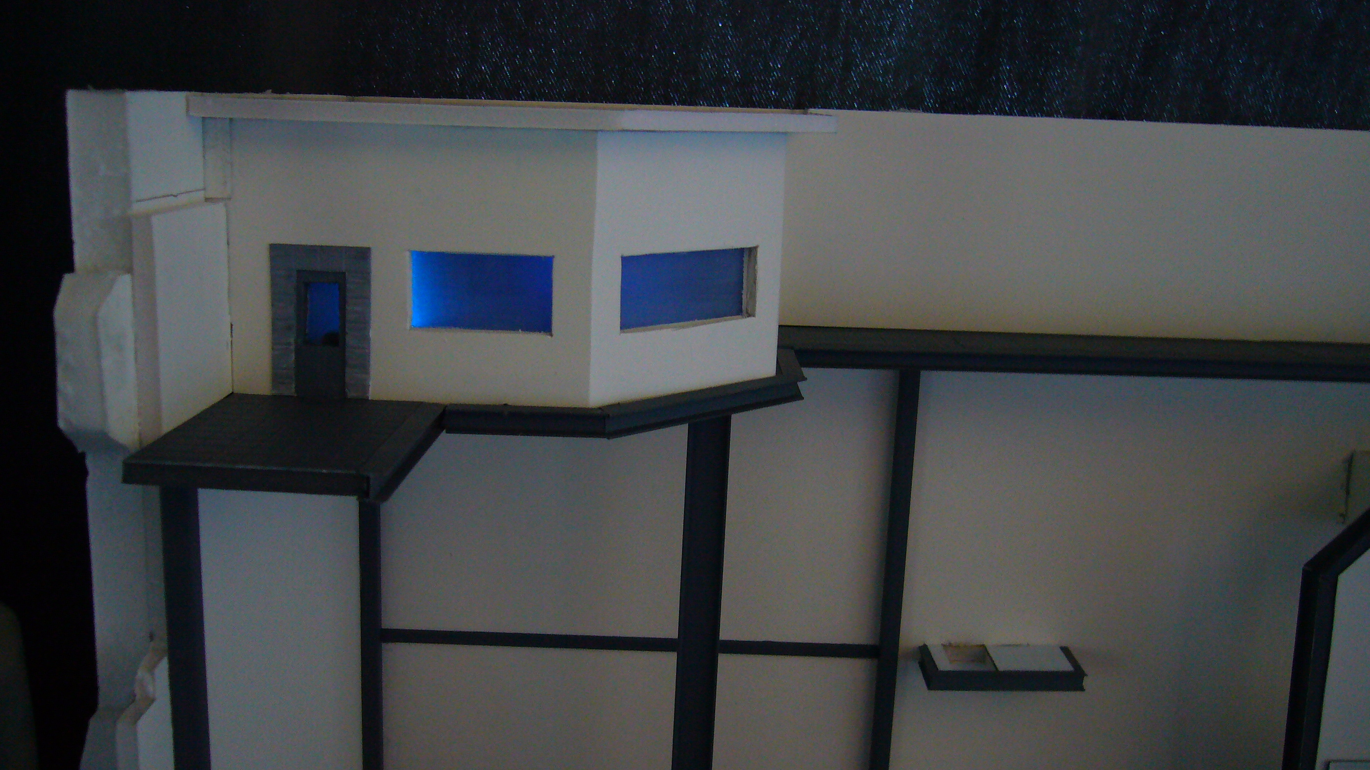

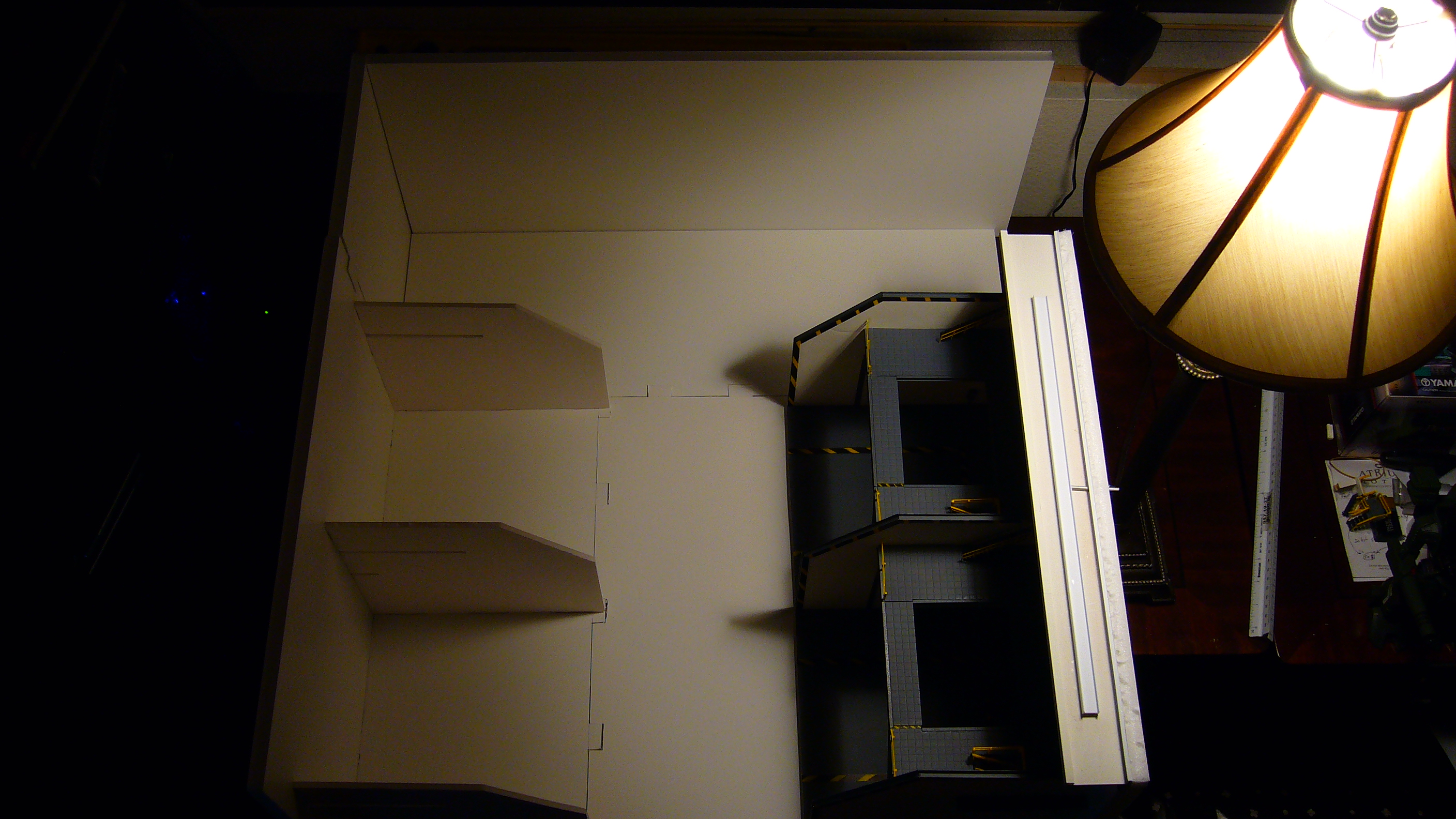

Back with some more progress to the build.

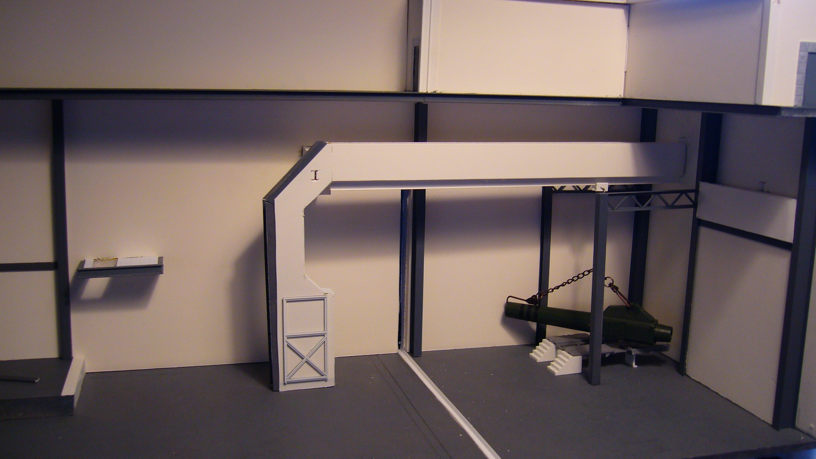

I have made some changes to the weapons repair/ammo prep stations. The first picture shows how the stations
used to look like and the changes made are shown is the pictures there after. I ran into a conflict with the crane
structure as it was too close to the divider wall structure when mated with the duel hanger cell.
I fixed this problem by moving the main crane structure and incorporated 2 crane systems out of the single structure.
Now the main beam is used for repair of the "big guns" and is more structural compatible for the weight/size ratio of the guns.
The initial crane rail is now connected to the same wall as the main but now supplies support for moving/loading ammo and
ammo containers (chest packs, shoulder packs, gun clusters etc.) as shown in the picture below.

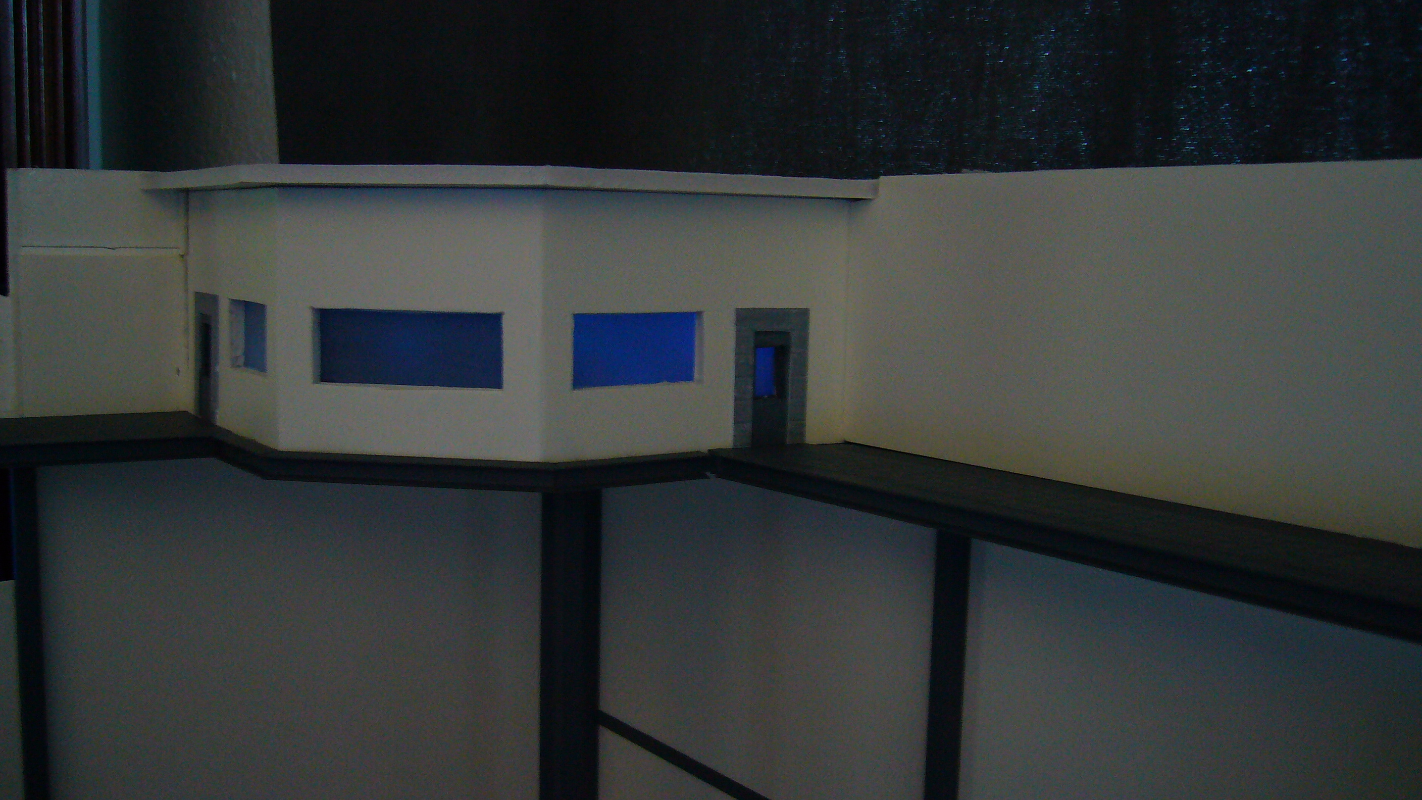

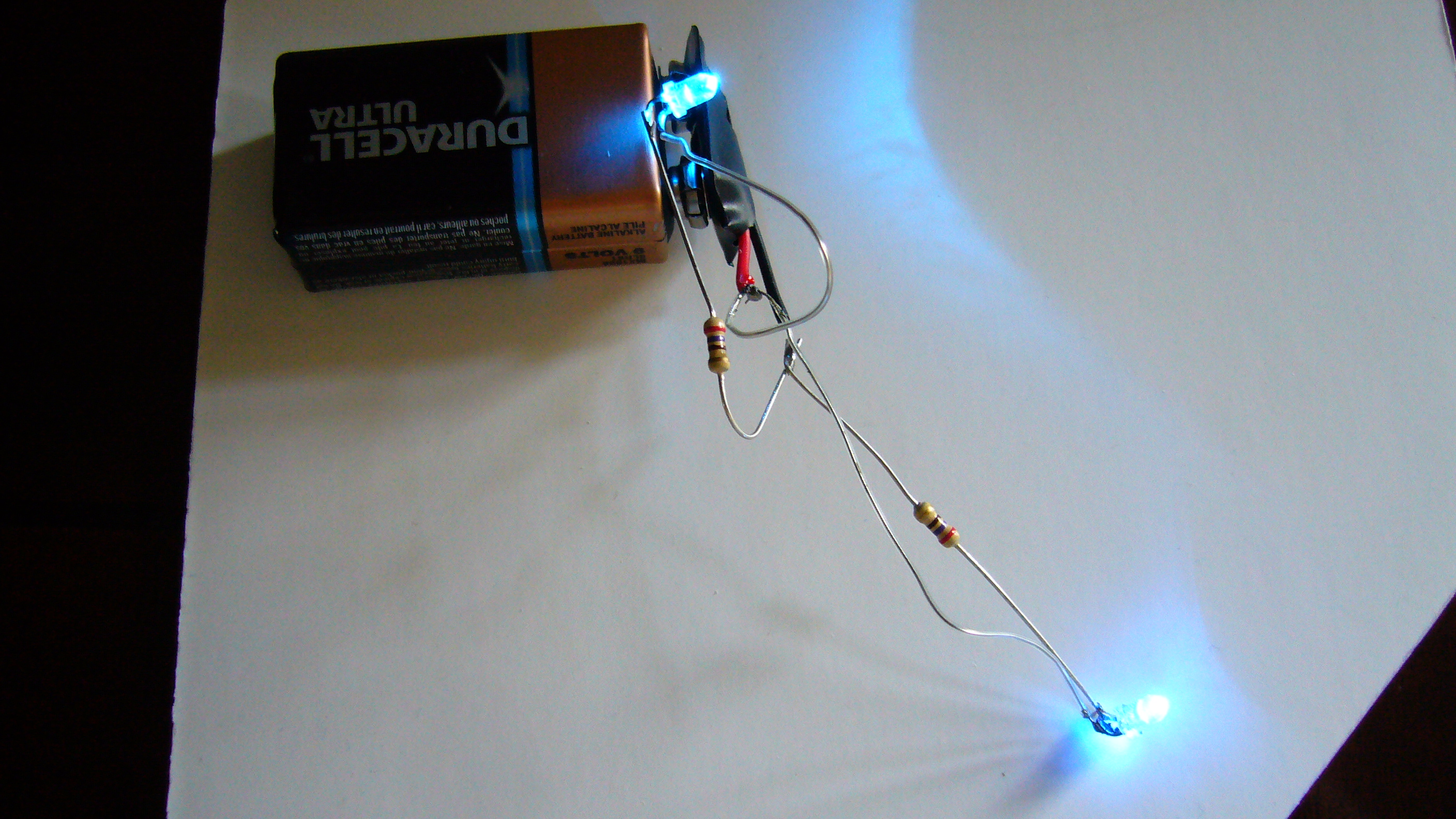

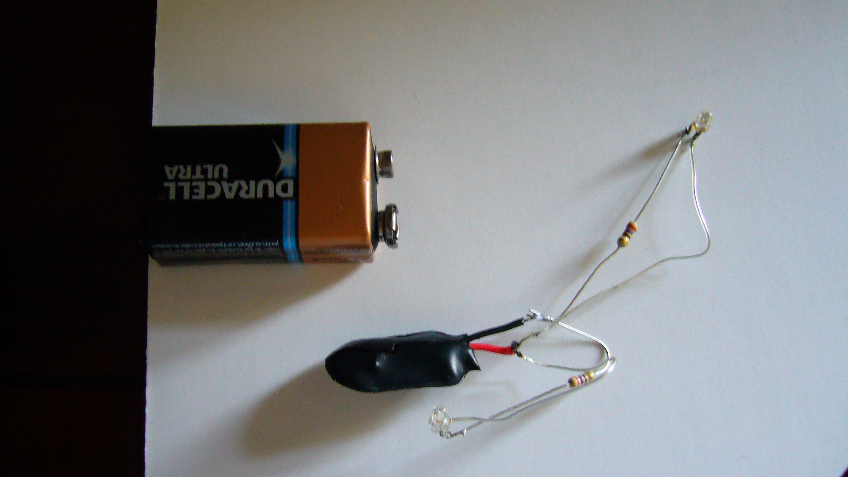

I also build a control room with windows and doors made with clear sheet plastic that was sanded with
polishing sand paper to give it a milky look. I then soldered up a simple light harness with LED's, resistors,
and a 9V battery to perform a light test in the control room.
After the test I decided I will need at least one more Blue LED for the desired lighting.
This is all for now but as always I will see you next time with more progress and/or changes to the build. B))
Blue
