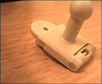

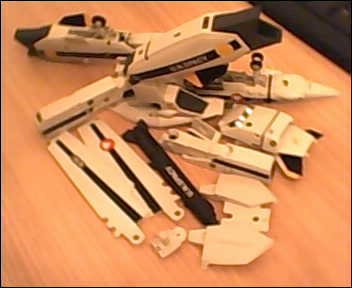

valkfighter Posted June 5, 2010 Posted June 5, 2010 Hi, my vf-1s dyrl is geting worse I posted before a picture of the right side arm with broken hinge now also the left side is showing stress too I would say big stress mark which in a few days is going to become an oficialy broken shoulder(hinge2.jpg).I removed the right hinge I was trying to remove the pin but is not posible any idea on how to remove this? I want to replace it with plastic is the best solution til i get new hinges. Well from my point of view this problem should be solved directly by yamato but they take not responsability if the toy is purchased outside japan which for me is WRONG if we pay the shipping we should recieve the same atention as a japan costumer.In my country this is not a cheap toy I paid 177usd YES ONE HUNDRED and SEVENTYSEVEN USD and I own 5 1/60s and 5 1/48s so you can imagine how much money I spent on YAMATO products and how frustraiting this is. I joined this forum to share the passion for macross not the suffering for YAMATO.I also have problems with 2 of my 1/48s but that is for another post.sorry about this post I did not wanted to get to this point but since I found the second broken shoulder things changed. As someone said before POORLY DESIGNED TOY!!! this could have been avoided with the proper testing before releasing the toy. Well I´ll continue waiting for any news from Graham as he is our only hope. Quote
jenius Posted June 5, 2010 Posted June 5, 2010 Yamato isn't allowed to service areas outside of Japan because of licensing issues. It's not really a choice Yamato makes to not help you out. Yamato would love to be able to legally sell and service toys outside of Japan. Since they can't we essentially buy toys without warranties which does make it that much more frustrating when a clearly poorly researched design element is foisted upon us and then not corrected before more variations of the toy are released. Quote

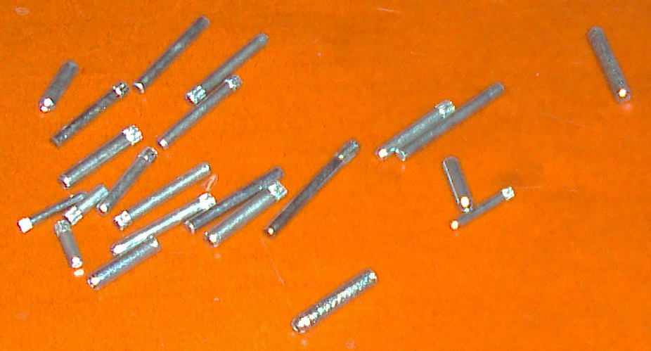

valhary Posted June 6, 2010 Posted June 6, 2010 ready to start my vf 1s unassembled kit but im worried because the curled metal pins are the reason of break shoulders and all my pins have it so it is possible fixed or no matter Quote
BlueMax Posted June 6, 2010 Posted June 6, 2010 Just file them down, then you probably won't have to worry too much. Quote
Shin Densetsu Kai 7.0 Posted June 7, 2010 Posted June 7, 2010 ready to start my vf 1s unassembled kit but im worried because the curled metal pins are the reason of break shoulders and all my pins have it so it is possible fixed or no matter You can shave them down with a metal file I think. M0nSt3r posted something about how to do so a few months back. Quote
David Hingtgen Posted June 7, 2010 Posted June 7, 2010 Only file down the knurling on the shoulder pins. All the others should stay knurled. (and really, the knurling isn't the problem, it's actually the smooth part that's wrong with the shoulder pins---but it's easier to remove the knurling than change the pin shaft itself) Quote

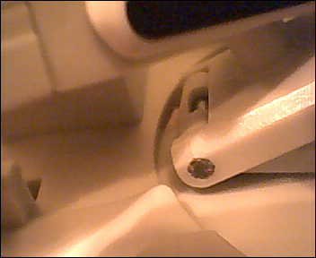

boyarque Posted June 9, 2010 Posted June 9, 2010 I thought my VF-1j was safe...then I noticed..: well, just have to wait my turn then..... Quote
anime52k8 Posted June 9, 2010 Posted June 9, 2010 that's... different. usually it's the part connected to the arm that cracks, not the part that connects the the torso. Quote
boyarque Posted June 9, 2010 Posted June 9, 2010 that's... different. usually it's the part connected to the arm that cracks, not the part that connects the the torso. eh? then is this a new case? I dun hold any grudges with Yammie though...I've learnt to accept lemons in life..at least they make for good lemonade! P/s: My past purchase of 1/48 VF-1J miria, the left engine intake cover was not included....ah well... Quote
